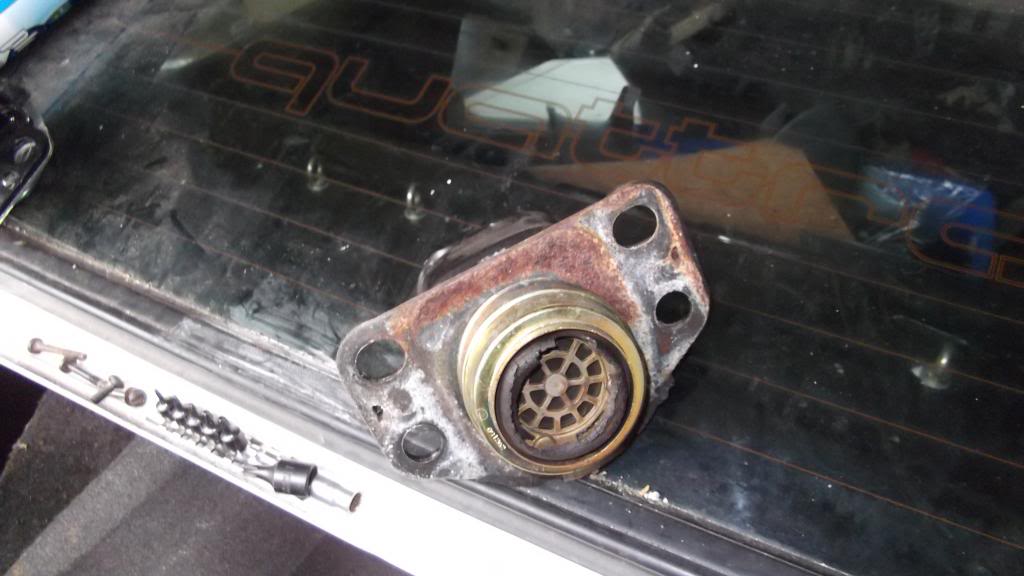

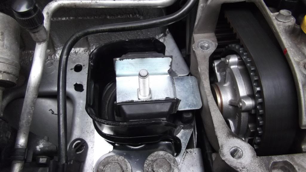

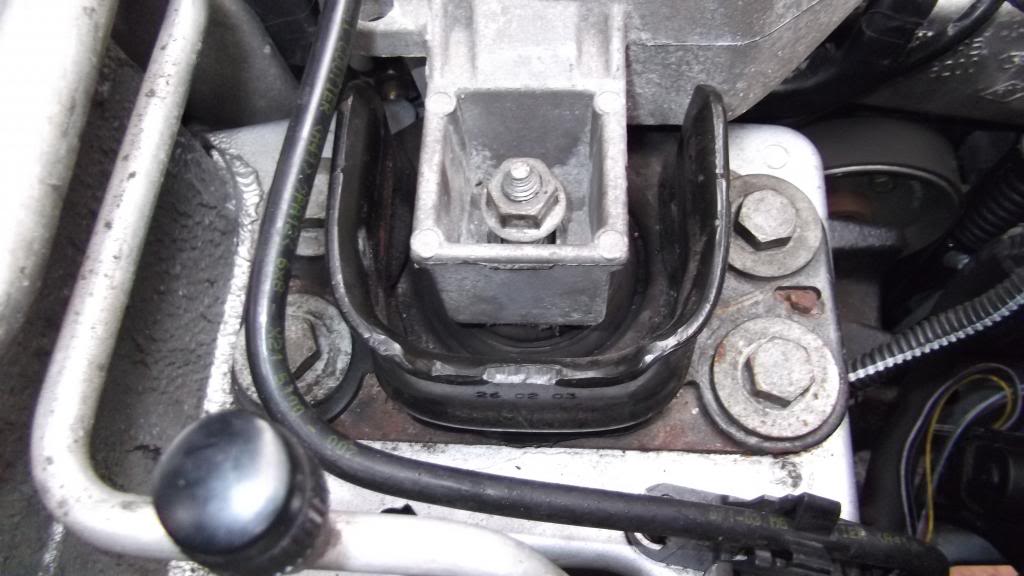

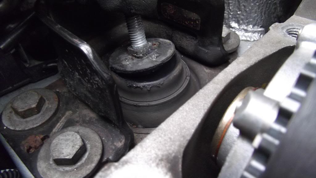

Well sorted now. Had the auxillary belt and tensioners done week after Christmas and funnily enough the noise has been since then. New parts arrived, Powerflex Dogbone bushes fitted and so onto this

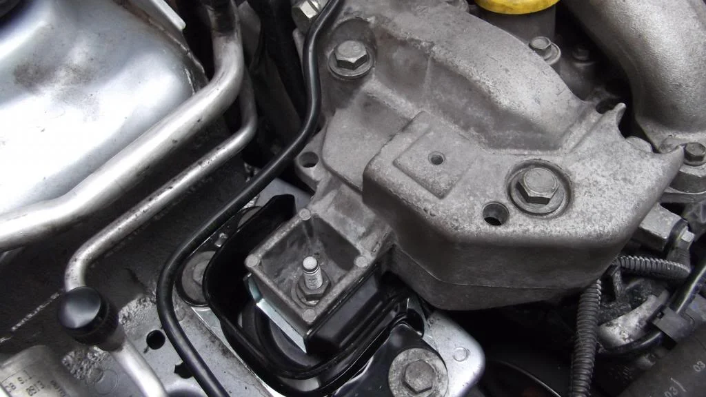

Anyone see whats missing?? Original one too going by the date. A conversation has been had with the garage that put belt on!!!
Old one Donald Ducked when stripped...
And the bottom of it....
New one gong in...
Tightened up..
Gearbox mount done also and all now 100% with no clunking at all and car feeling very tight. Thanks for the help folks.
The U shaped metal and rubber spacer that sits between the mount and the engine. No wonder it was moving, but glad I replaced as it's all tight as a drum again now.
