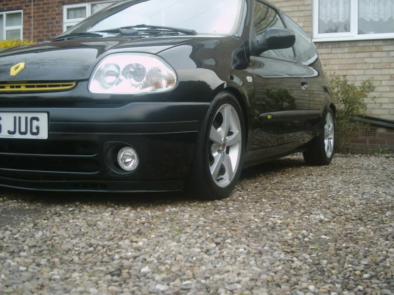

Mine on vmaxx.

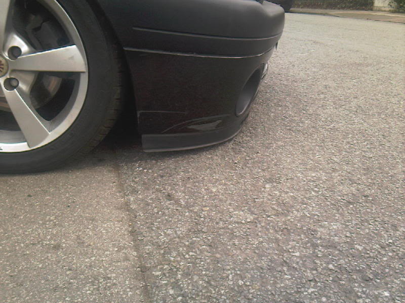

Got 30mm left to go on the front aswel.
Doubt the rear would be anywhere near that low with it stripped though, the fronts can go stupidly low but will rub like f**k when driven properly. You can remove the rear platforms but the rear shocks will then nicely sit on the bump stops and make your Clio handle like bag of balls :)
get custom rear springs, chewitt on here can get them cheap for you, iv gone from 140-150mm before to 120mm now,
it does not sit on the bump stops mate. even on 90mm springs there is still some travel left in the shocks.
