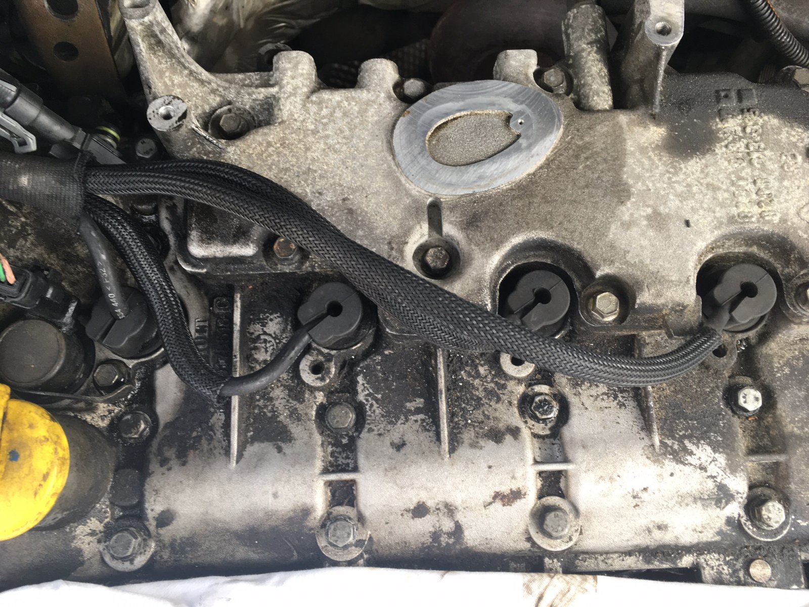

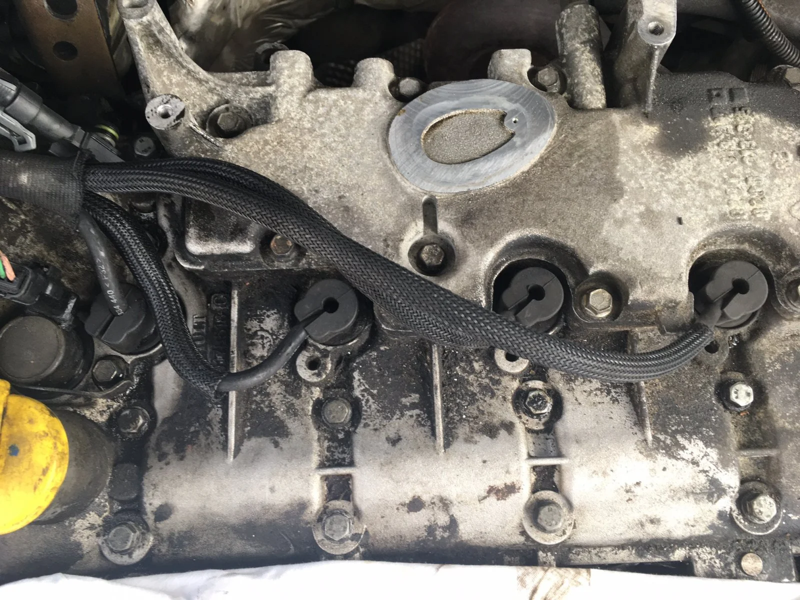

I think they're the original leads, they are grouped together and have that sort of meshing around them just before they meet the plug caps.
squeeze the end of the plug caps and see what they do, don't be surprised if they split and fall apart.
also before you take the upper inlet off check none of them are trapped under it.

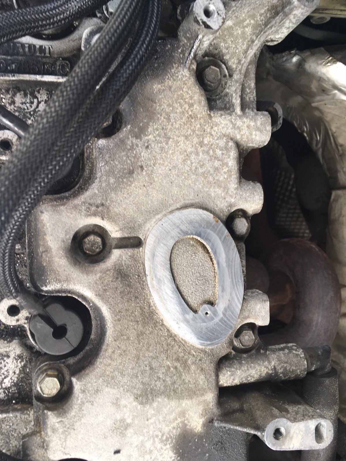

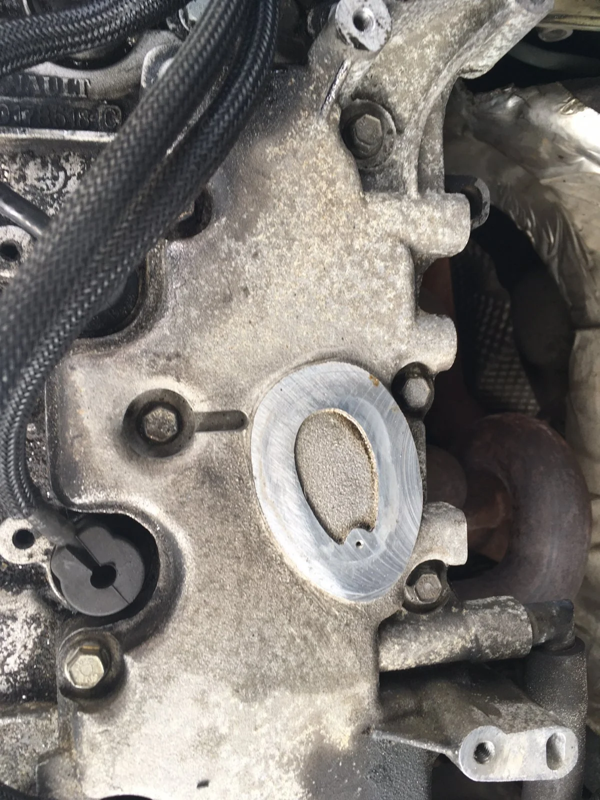

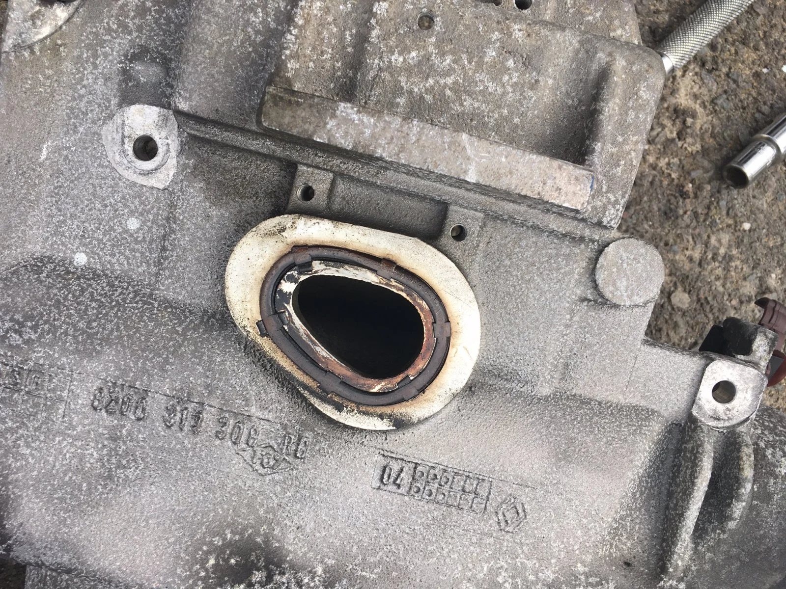

Just took the inlet manifold off and the leads and plug caps all look fine [see photo]

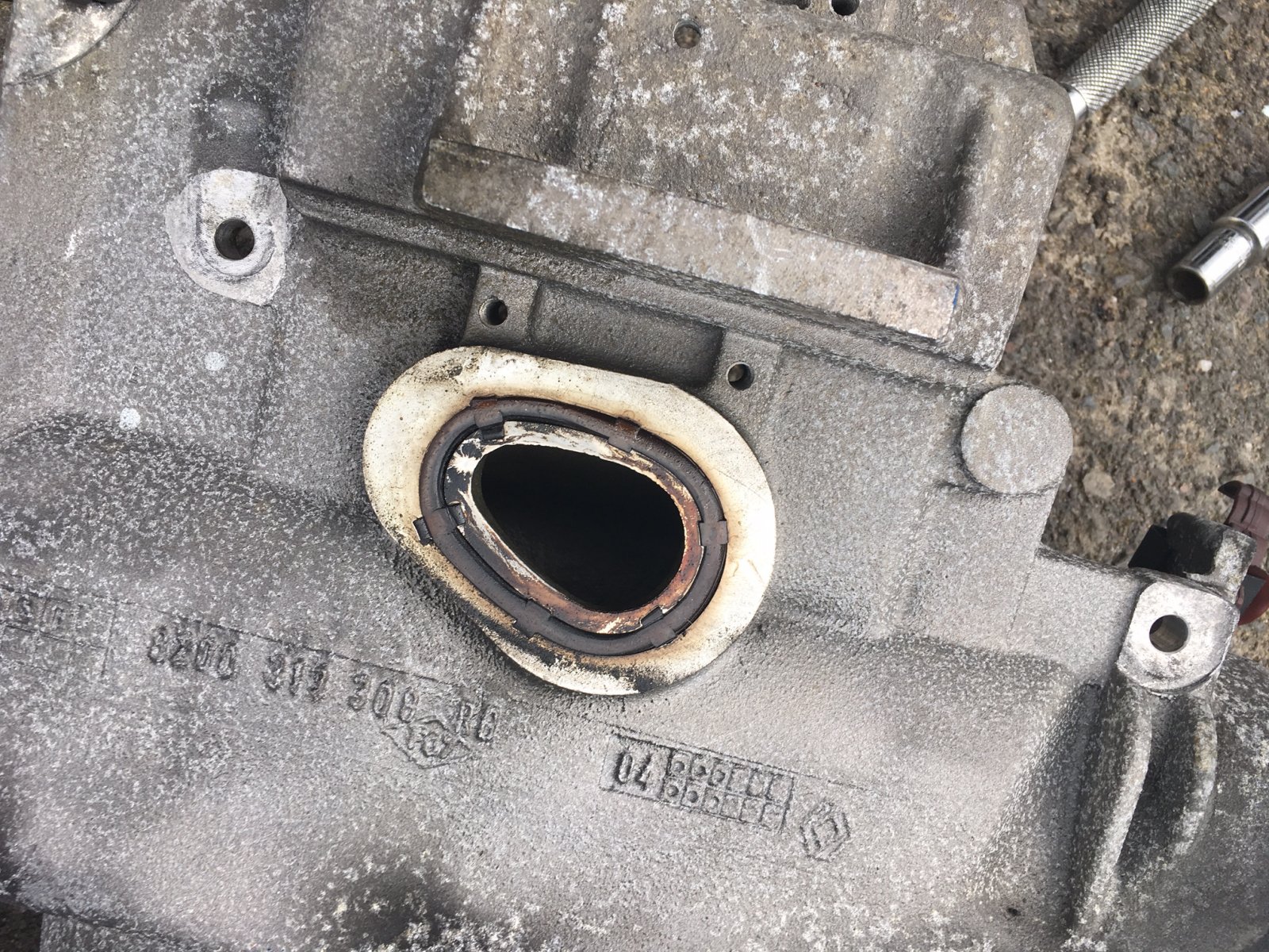

I'm just wondering about that seal on the underside of the manifold [see photos]. I took it out and it looks OK... it's flattened a bit but still proud off the aluminium. Not sure if that and/or the manifold gasket should have been replaced when I did the work. I feel I'm clutching at straws here though. I would have thought I could hear air whistling or hissing from these places if they were leaking.
As an aside I did the screwdriver test on the injectors and all four of them are clicking. It means they're opening and closing but of course there could be dirt/debris etc... reducing their effectiveness that I wouldn't know about.

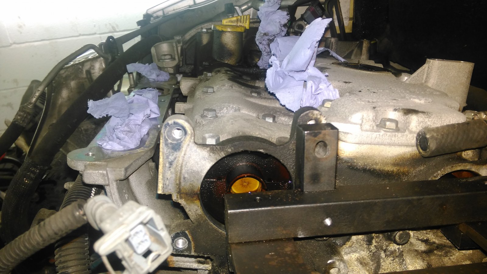

are you 100% sure the crank pin was in the timing slot? it's easy to miss that and get it in the balance drilling.
I know exactly what you mean about that other slot. I spent quite a while fiddling with that to be as sure as I could be that I had the crankpin in the slot and not one of the balance drillings. I had a screwdriver down the plughole to monitor TDC while I was doing it.
I'm getting that sickly feeling that I'm gonna have to go through the pain of opening it up again and go back over the timing procedure. The thing that's perplexing me about a possible timing problem is that it runs fine all the way through the rev range. It's just idling that's an issue. I kinda thought if it was out on timing there'd be problems elsewhere as well as on idle.

did you check on the flywheel to see if that was lined up? screwdriver gives you a rough idea on tdc but the drilling must only be a degree or two out.
Could you get the tool into the groves there ? Mine was a little closer than that but I had still to jiggle and force the tool to lodge it in the grooves. The reason I wasn't too perturbed about doing that was because I had to do that initially before I removed the original belt.
