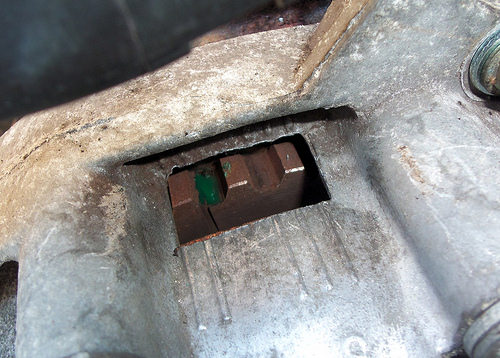

It looks like I'm going to have to pull it apart and check the timing again 😧 I didn't realise there was a window on the bellhousing and timing marks there. I had been using that Renault manual PDF 3286a and there was no mention of it there. So there are four numbered timing marks on the block and I line the grove on the flywheel up with mark number '0' ?
