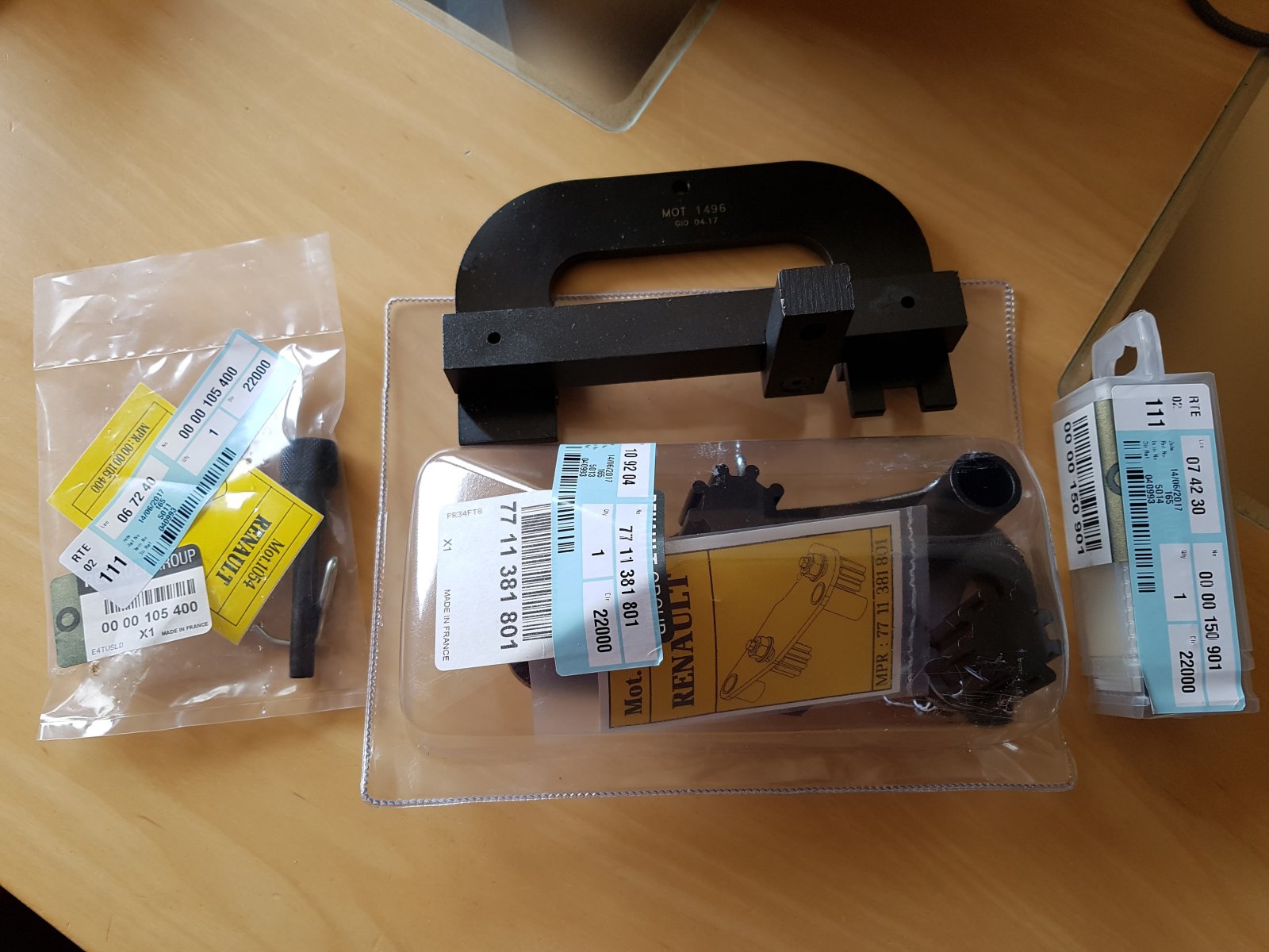

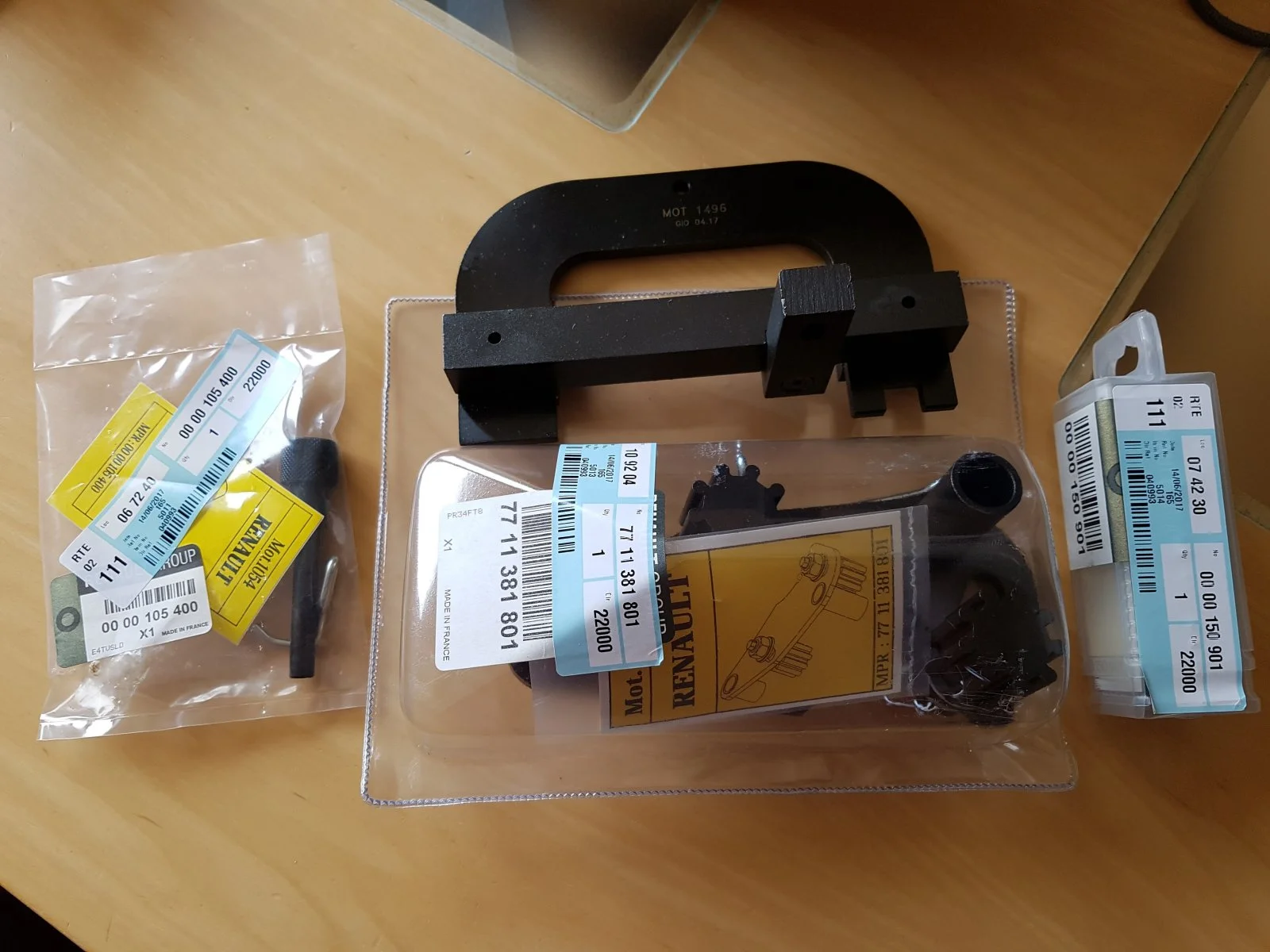

Now......first thick question. I ordered it. I don't know why.
But can someone tell me what the extra cog (0000150901) is for? Bear in mind, I wont be taking the belt of or messing with the tension.

Ok.....I see from the top end manual that the extra cog looks to clear the lip of the exhaust pulley. ok on that.
Question.
1.) The manual references tool MOT1509. I have seemingly bought tool MOT1801. Have a been a stupid boy?
J

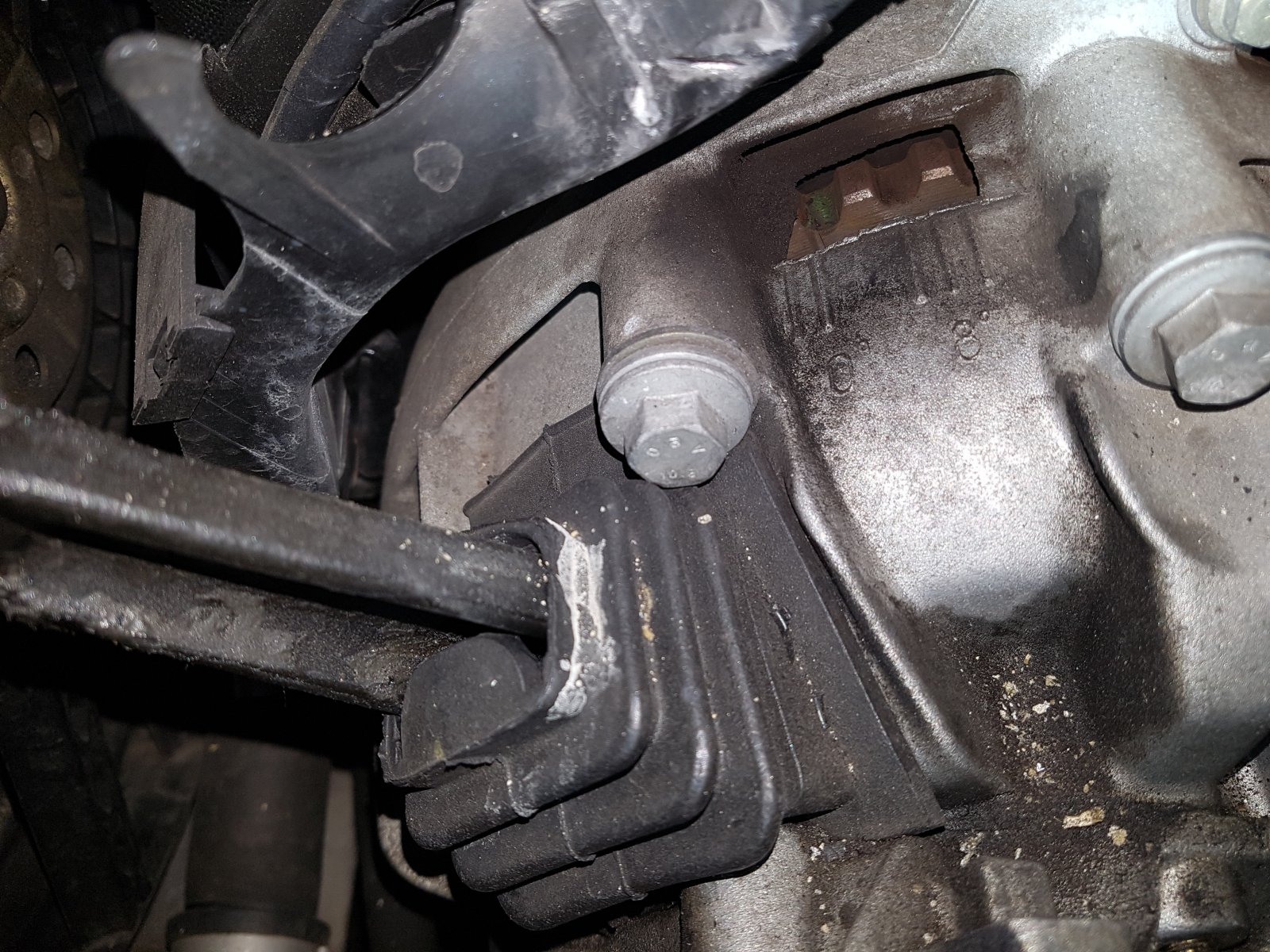

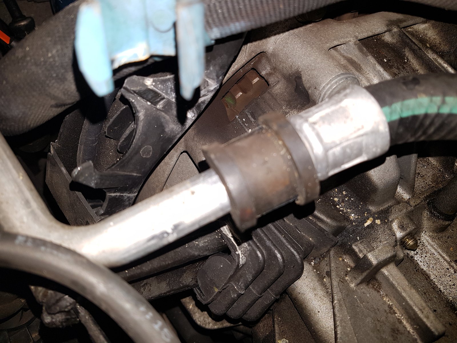

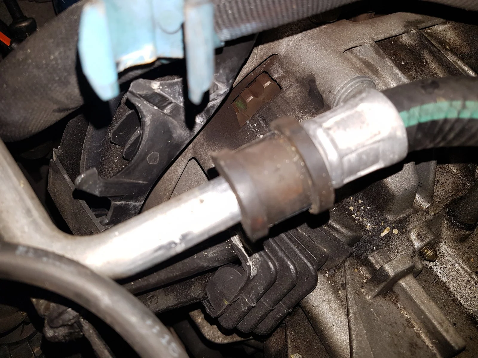

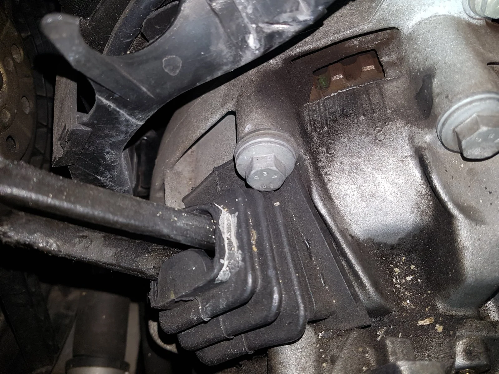

Locked with the proper Renault pin......slowly from juuuuuust before tdc until the green/line was in line with the line on the bell housing.
And went to slip the horse shoe effortlessly in and
So......
blx
  2003 Clio 172
No bud.....I had made a line in the dirt by mistake trying to clean the MAIN line with a screwdriver.
DOH!
So.....deffo at tdc then. Horse shoe - no chance.

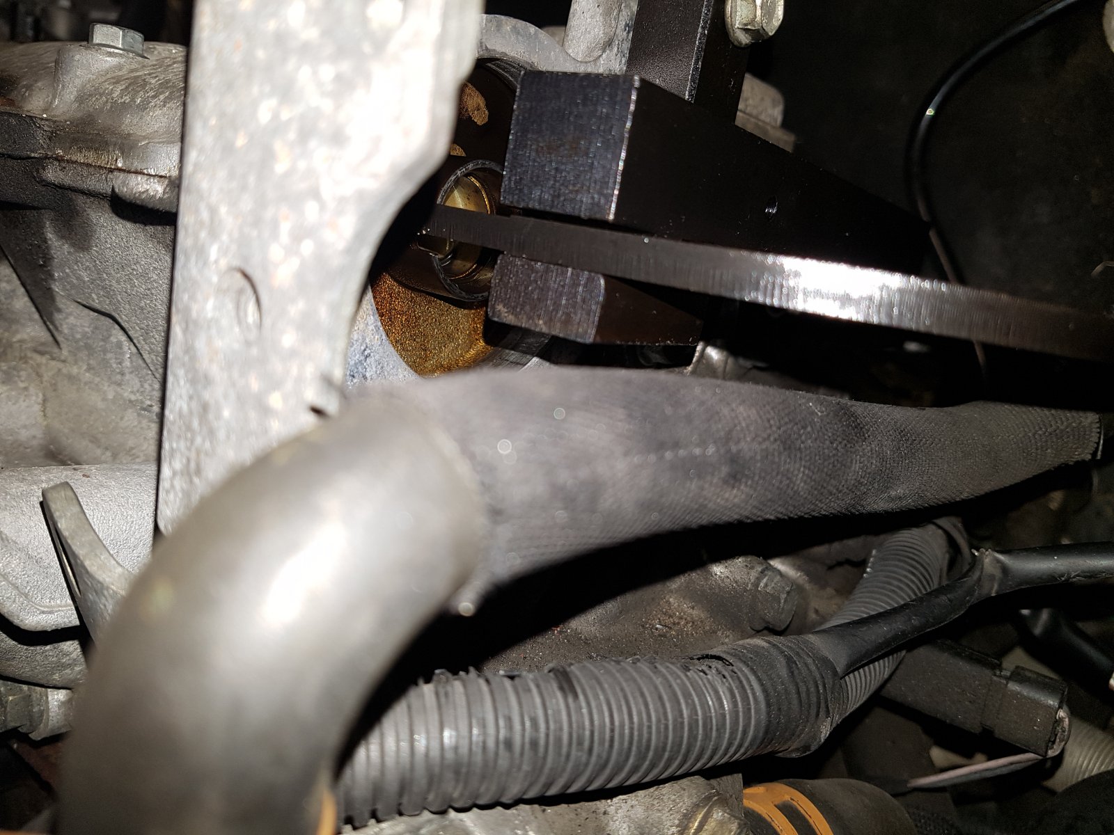

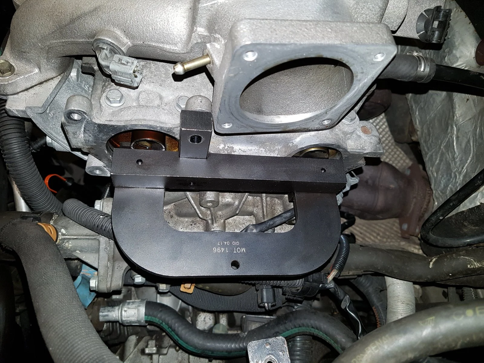

Right. That was awful. Anyway.......got it timed and checked many times. Struggled to get the elusive horse shoe slipping in....seem to be some rough edges on the cams where the tool goes. Looked like it should go in but it rarely did......even when everything was locked up.
Anyway.......it goes in with a bit of a heave.

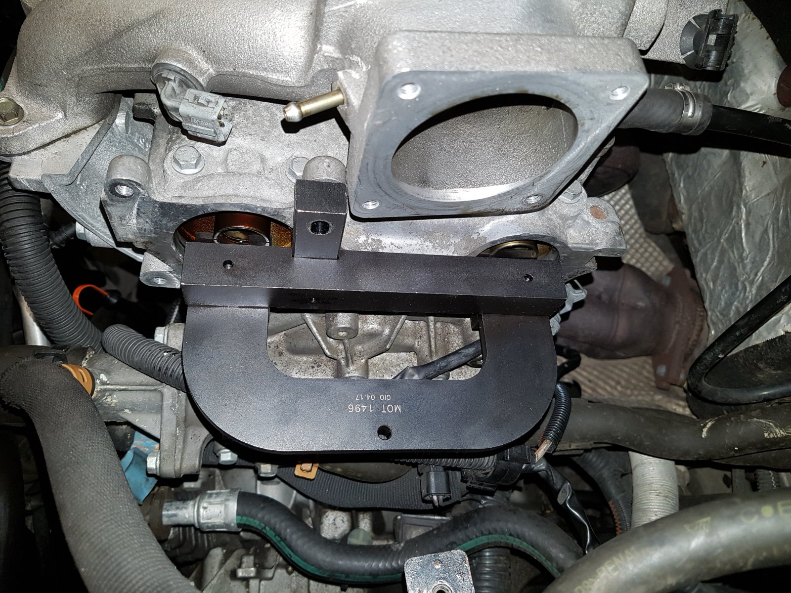

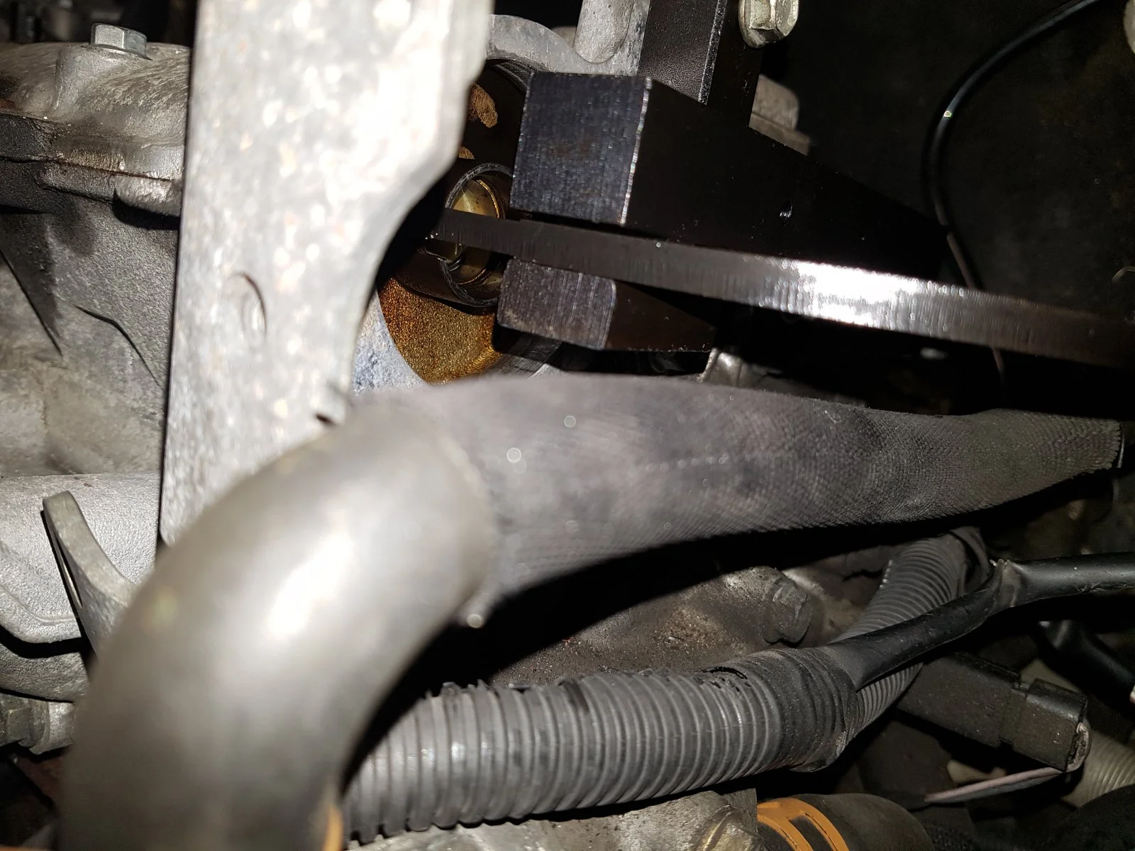

After timing and 2 rotations of the crank with all the tools removed, I re-locked at tdc
Will this do? :)

R3k1355
So the horse shoe slips in fine and it's locked with the proper locking pin?
Have you replaced the map sensor and injectors?
yeha.....pin in (proper tdc) and horse shoe literally slips in and slides about.
