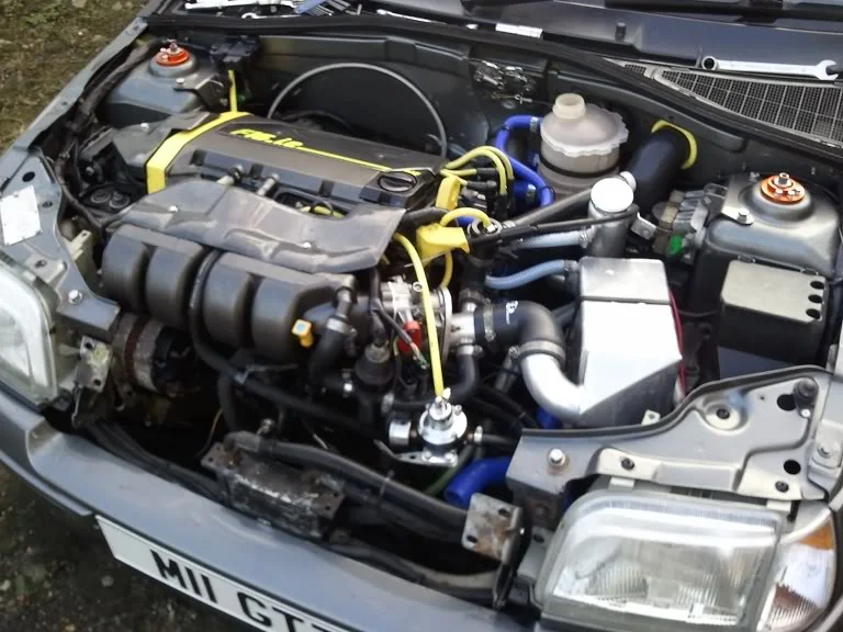

Right, update!
Finally decided to crack on and get the car apart and see whats causing the over-pressurizing issue i've been seeing this season on track.

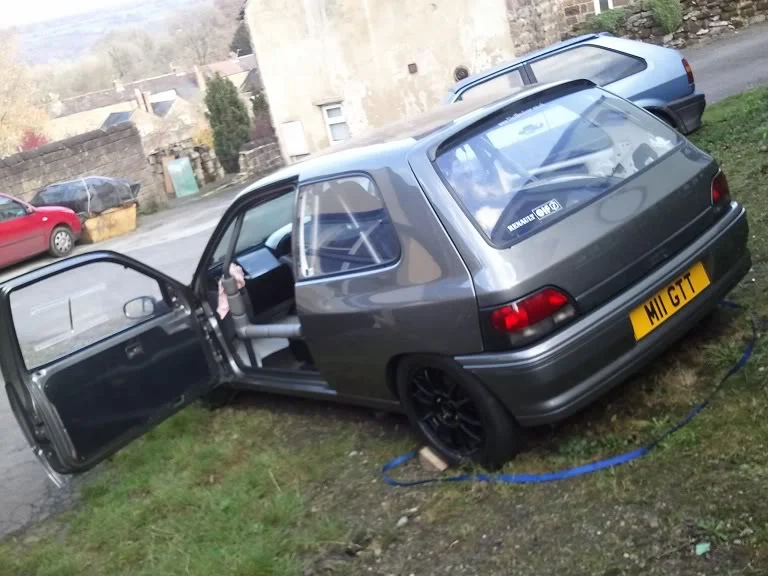

So this is how the car is stood currently, looking a bit forlorn on the 'drive' and a bit unloved
the damps caused a bit of mould inside, but next to none really and i've chucked loads of silicone bags in there to soak up the worst of it, so the interior still looks okay :-) really need to get a garage when i buy a house next year though, not happy about damp and old clio tbh!!!lol!!

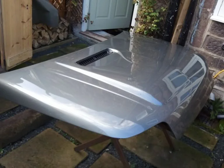

so bonnet off;
radiator and front coolant pipework out, i will be purchasing an alloy rad and silicone hoses to replace the final ones that aren't silicone yet. This is going to include some custom pipework, which i have made templates for and will be sending off to SFS performance to be made up over the winter :-)

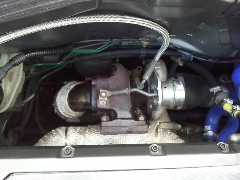

the idea is to remove the downpipe as well as rest of the exhaust system and get a new one made up. i plan to put a flexi section in the downpipe and then get hold of a mongoose or similar and modify it into a full stealth system. all just ideas currently and as such i figured to save scrabbling about on the floor under the car, i'd whip the turbo off the manifold and leave it in situ for now!

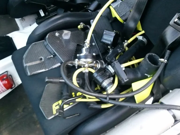

parts pulled off for ease of access

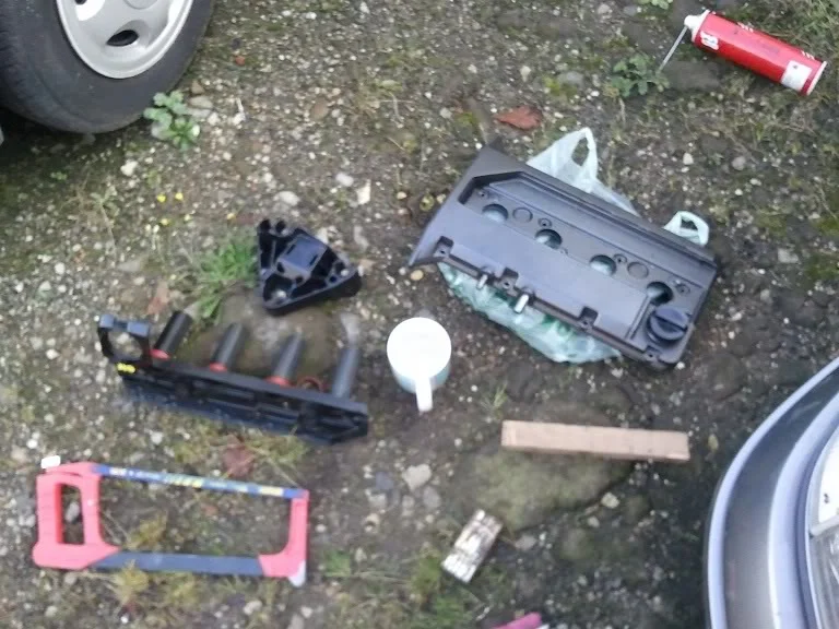

and more bits off to get to head bolts

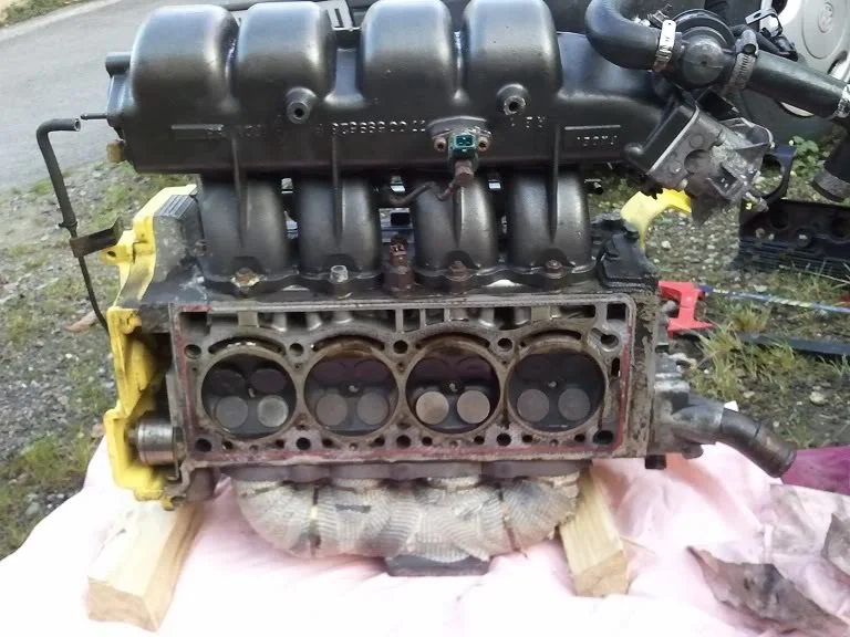

and head off, i cheated and cut the cambelt, hence the top cambelt cover is on ;-)

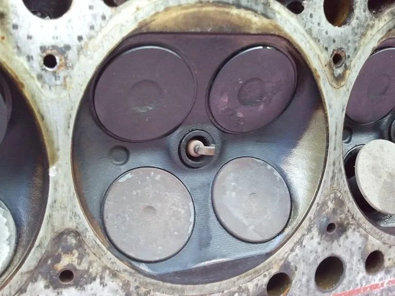

this is the head/valve/combustion chamber area after 4 years and 16k miles on high boost, not too bad me thinks, seems to be running lovely. small bit of pitting on the exhaust valves and some build up on the inlets, but nothing to write home about.

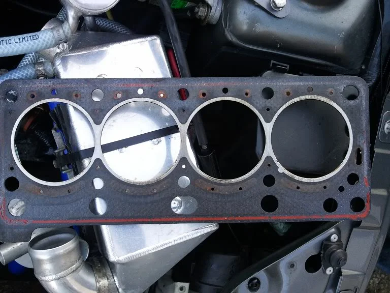

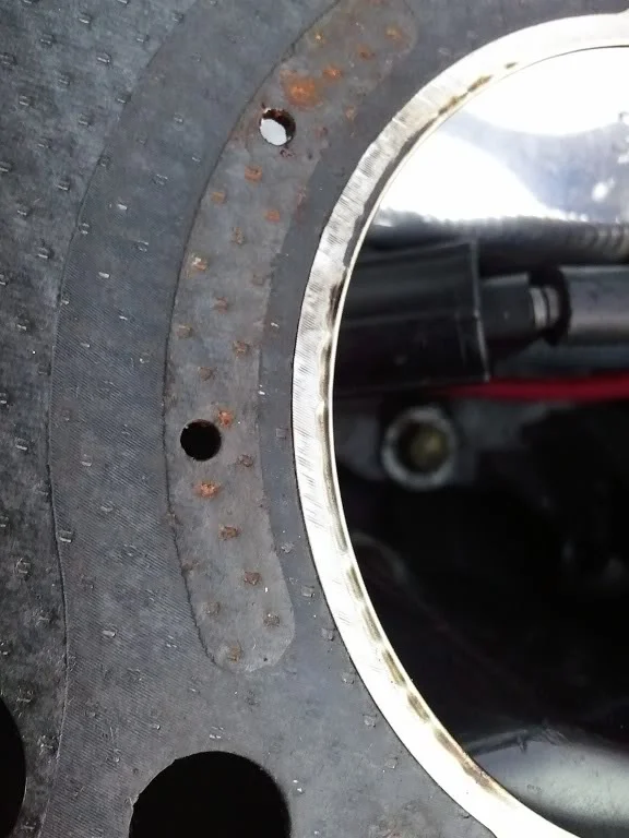

head gasket, still looks fine from a distance........
but whats this...............fire rings a bit damaged and theres clearly been some blowby as theres striations all across the fire rings

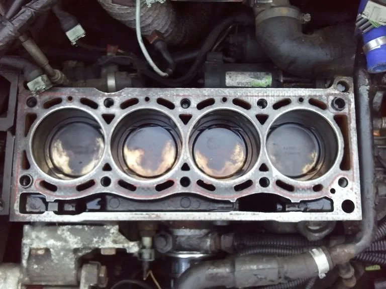

and heres the block.....again pistons seem okay, no build ups and evidence of poor running, and the bores are still lovely.

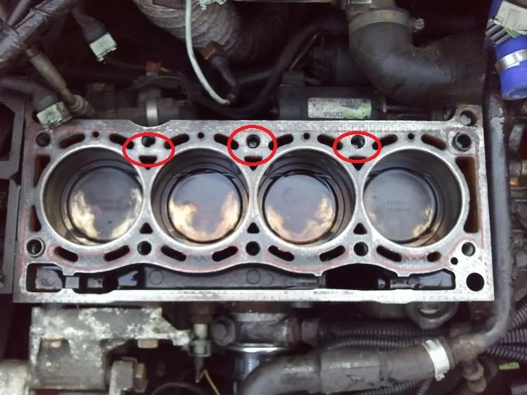

but if you look closer in the red circles..............cracks........the damn blocks cracked across from the water ways to the head bolt holes.
so it seems that the blocks cracked and the headbolts have lost clamping force, allowing blowby into the coolant system under full boost and as such pressurising the system!
so at least i've found a fault, but its some work now to fix.

Seen that cracking before, and it's normally down to there being fluid in the bolt hole, or too much grease on the bolt when it's torqued. You get a hydraulic effect which finds the weakest point to move.
