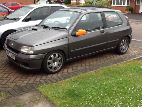

I bought this on a whim last week with the initial intention of using the heart of the beast for the turbo and dare I say it, getting rid of boost.
So the plan was to strip this for parts, sell the shell rolling and keep the engine/box/wiring for GTT, sell the turbo gear and make some cash.
However, after one last spin out in GTT I just can’t part with boost, it makes me laugh too much and I just can’t imagine GTT without a turbo tbh. So plans have changed.
The firm idea now is to strip GTT of all its track goodies, and return it to a standard (ish) valver with standard (hopefully 19 16v leather) interior and a few subtle tweaks on the suspension and brakes to keep the 300 odd mad French ponies reigned in!
as such, I need a track car........which is where Woody comes in (WDY in case you didn't get it ;-) )

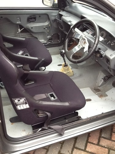

I will be putting the cage/plastic windows/CF door cards and other bits and bats onto this shell over the next few months. Brakes will stay as they are, I can lock up all 4 wheels as it is so no need for anything more for now unless it starts to let me down on track.

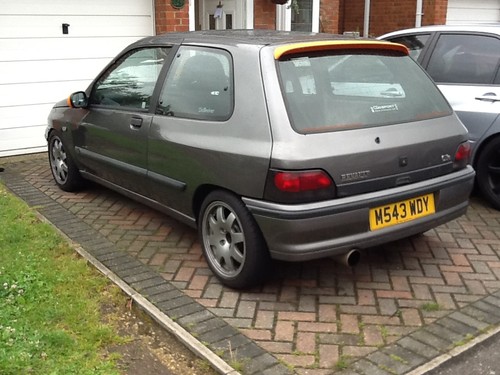

So here he is as bought the other week, warts and all with the orange bits :-( lol! pics are from eBay advert earlier this year but cars same

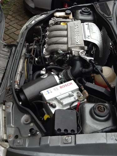

Had a quick spin out and the car feels very tight and very pleasant to drive. I’m loving power steering again, been ages since had it on a mk1. So I think that'll be staying with the addition of a catch tank for the overflow in the scuttle.
Only major issue with the car is the darn idle, it won’t sit at 1000, runs from 1500 to 2000 all the time and I’ve changed all the usual suspects bar the TPS, so that’s next once I’ve double checked the inlet for leaks.

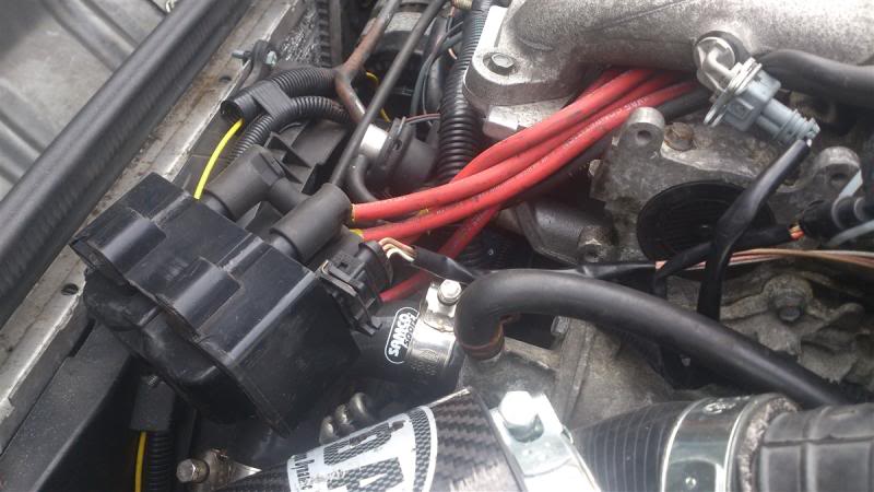

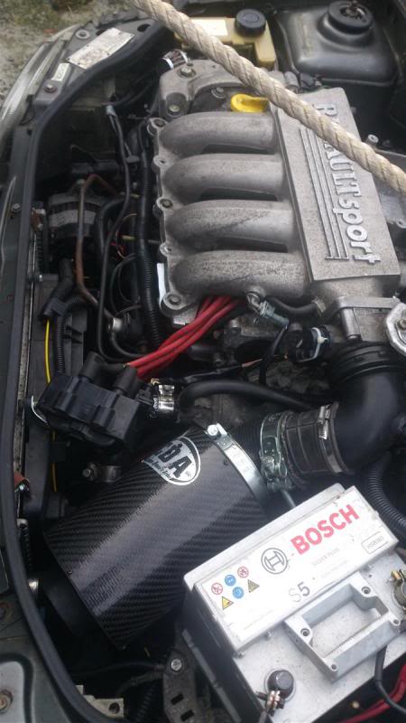

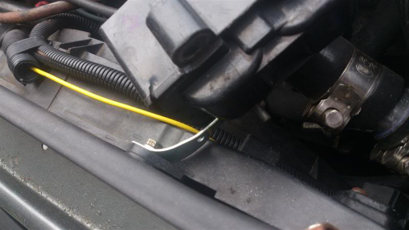

When I got the car, the front grills weren’t fitted (bonnet and front itself) but were all supplied so I fitted the front grill and then looked over the bonnet one. This wouldn’t fit as the coilpack on the F4R was in the way, as was the pikie hacked up rain cover. There was another issue with this, the weight of the bonnet had been rubbing the whole assembly and causing the HT leads to arc and misfire. So first job was to relocate the coil and lead runs to stop this and enable me to fit the bonnet grill.
Little bracket to the radiator later, and done!
So that’s cured the misfire but not the idle issue, further investigations to be carried out this week/weekend!

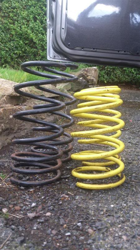

The car also came with some eibach 172 springs, which may or may not be suitable for GTT, here they are next to what I think are crappy apex springs, bit of a difference!!lol!!
