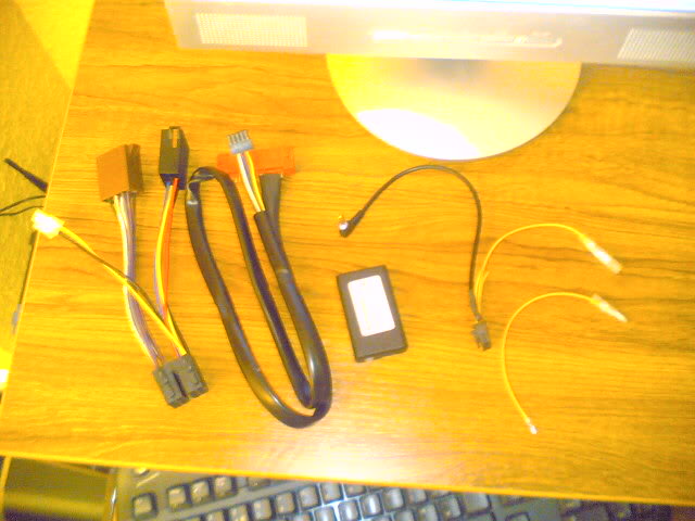

Here is a pic of what i have:
The far left cable is what im putting one end of into the wiring of my Alpine head unit, and the wiring in the back of the clio. Then the clear looking plug is going into the multistalk adapter box.
The next cable in, the long red plug is going into the red plug at the back of the dash display, and the other end of the cable going into the multistalk adapter box.
The patch lead for the alpine is therefore going into the other end of the multistalk adapter box, and then the 3.5mm jack going into the back of my alpine. Question - what is the orange wire that is also coming out the patch lead for? It has a female bullet on it! Also, if you can see on the far right cable of that pic, i found a small male bullet connector and the wire is exactly the same colour, but i dont remember this coming with the patch lead i bought, it just turned up at the bottom of my box of goodies. Confused! Does the orange female bullet neet to be connected to anything or is it left exposed?

well the left hand loom would simply connect between hu and dash wires with male iso going to hu and female end to dash the clear plug would go in one end of the interface module then the lead with 3.5mm jack to back of hu with plug to module leaving a third terminal for the dash loom i see everything there to make it work can only be some problem with the car perhaps best left to renault??

im not sure why it has that extra yellow/orange cable coming off it.........maybe it needs to be connected to a live as thats the kind of cable to looks like to me
ive got stalk controls on my Mk1 and i dont remember having to give the box a live feed
i think that extra yellow wire may be for units without the 3.5mm jack socket??
