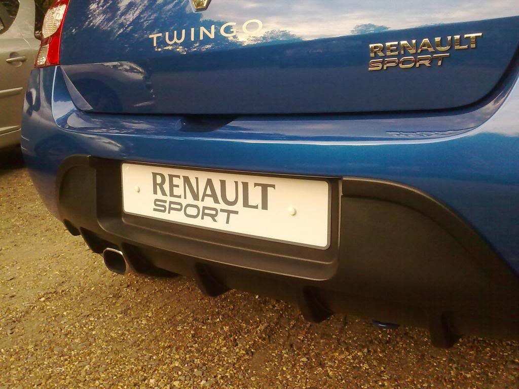

one of these :D
a slight drop on 182 alloys just to compliment the other mods
then we can think about power could always do a dci conversion ;)
Martin_172
you get DCi Twingos in Europe think they are a 90hp model! - would like of one of they diffusers if i could find one!

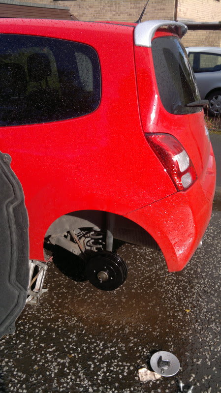

a job i done yesterday and forgot how much i f**king hate doing it (never had to do it for years!)......
nice shiney black drums lol
