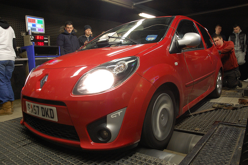

Car was on the rollers again, this time made 119.8bhp @ 5000rpm and 146lb/ft @ 3000rpm
