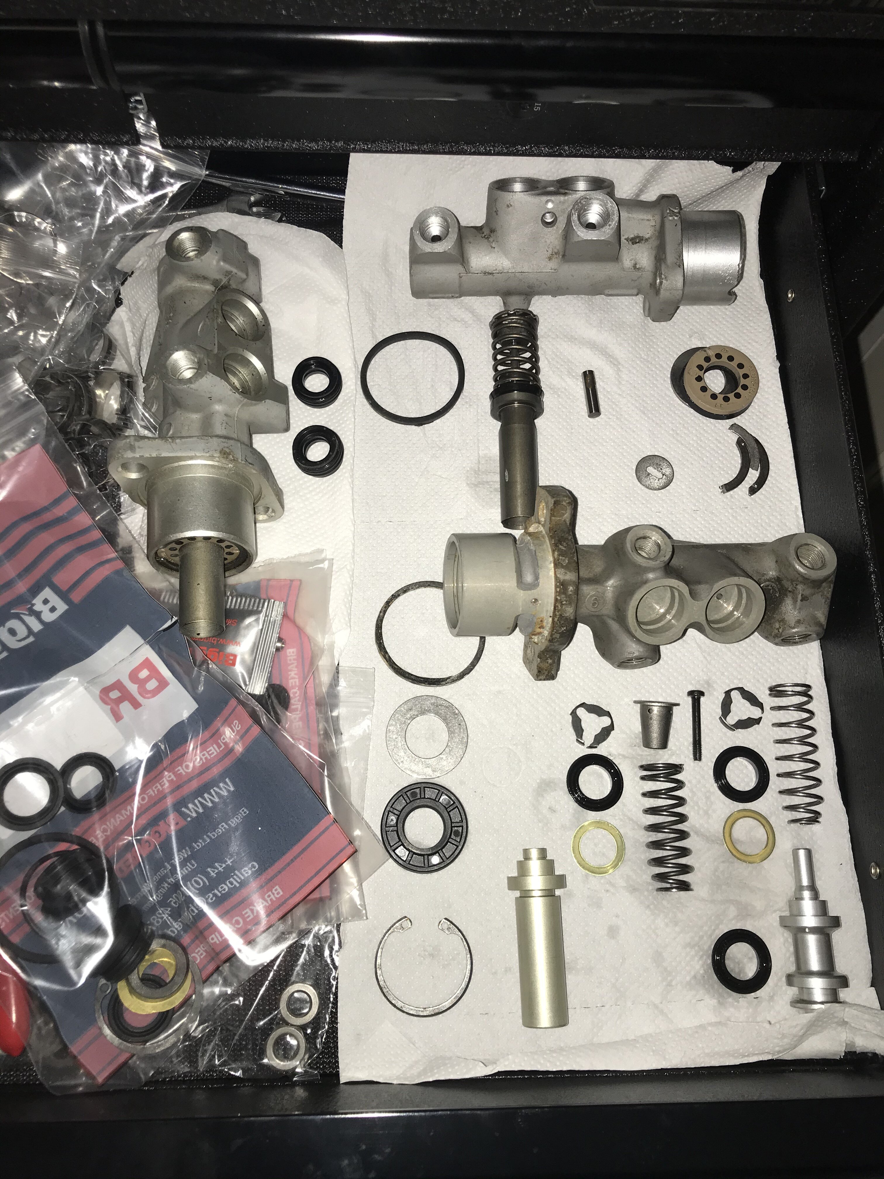

How did you get on with this Zach? I need to refurb my MC. It’s an Ate one. Does anyone know if the seals are the same for all the different manufacturers. I see the biggred description doesn’t mention Ate as a manufacturer.

I contacted big red when mine failed they don’t do a kit for the ATE one
@ripp This is a 172 cup mc. Im having trouble taking the 197 one apart. The 182 is the same design as the 197, both ATE and the circlip needs drilling/grinding to open them up. Once you have it open the rear piston seems to be stuck.

You have any idea what the piston diameter is on the 197 unit?

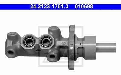

No problem. I really dont know how to get that piston out, Ive given it some proper wacks as well. Ive just found a new 4 port 23.8 ATE peugeot 406 mc which I think is going to be the best thing to use.

Did you get the piston out in the end? Mine moves freely, as in I can push it further in easily and the spring returns it easily. Tried making a hook out of a coat hanger but no luck.

I havnt looked at it since ordering the new mc. I think it will need compressed grease but I wont be doing that anytime soon.

I bought a Peugeot 406 ATE one, which is the same fitment as a 172 cup (4 port) but larger bore size of 23.8, same as 197.
