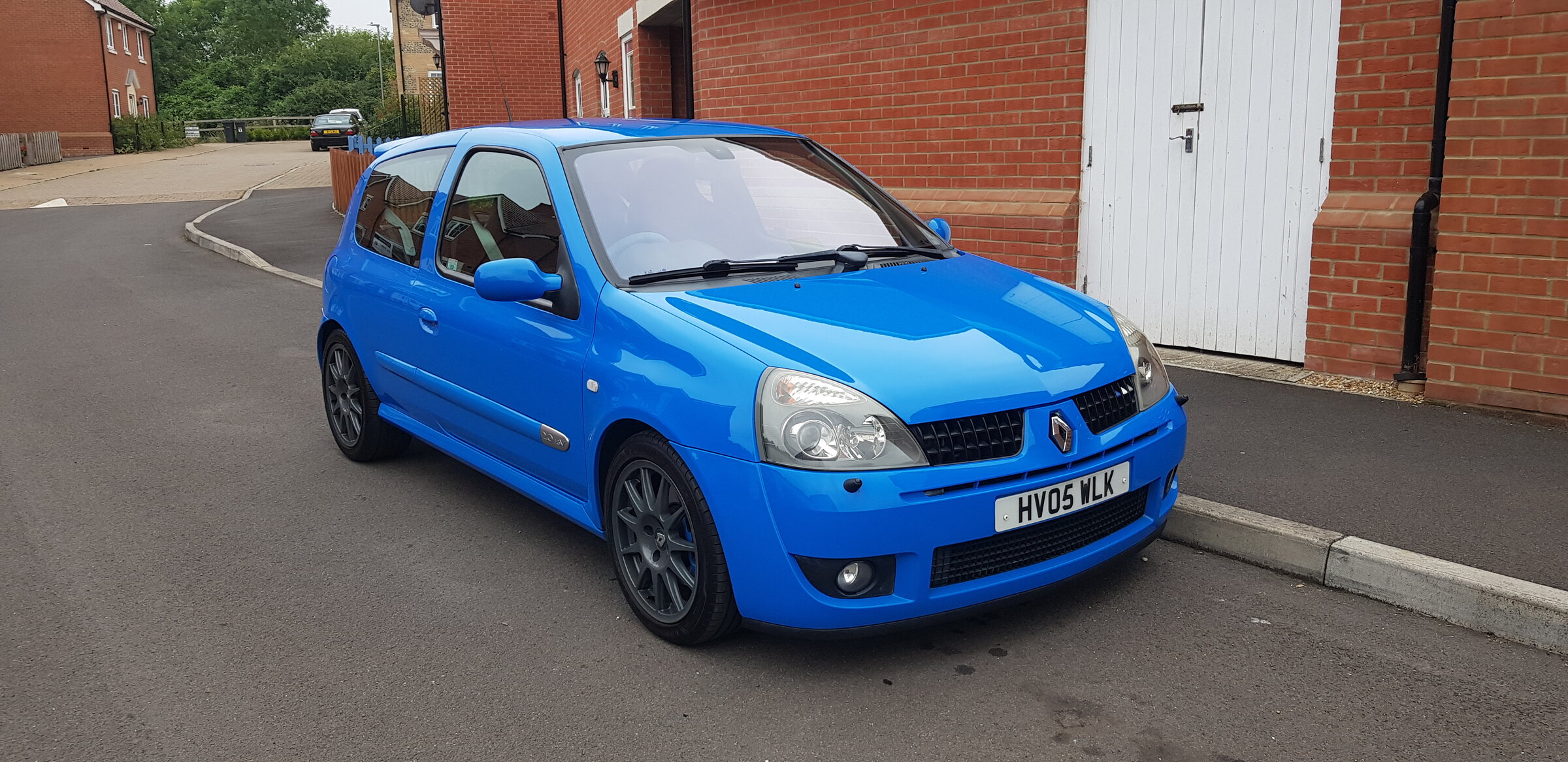

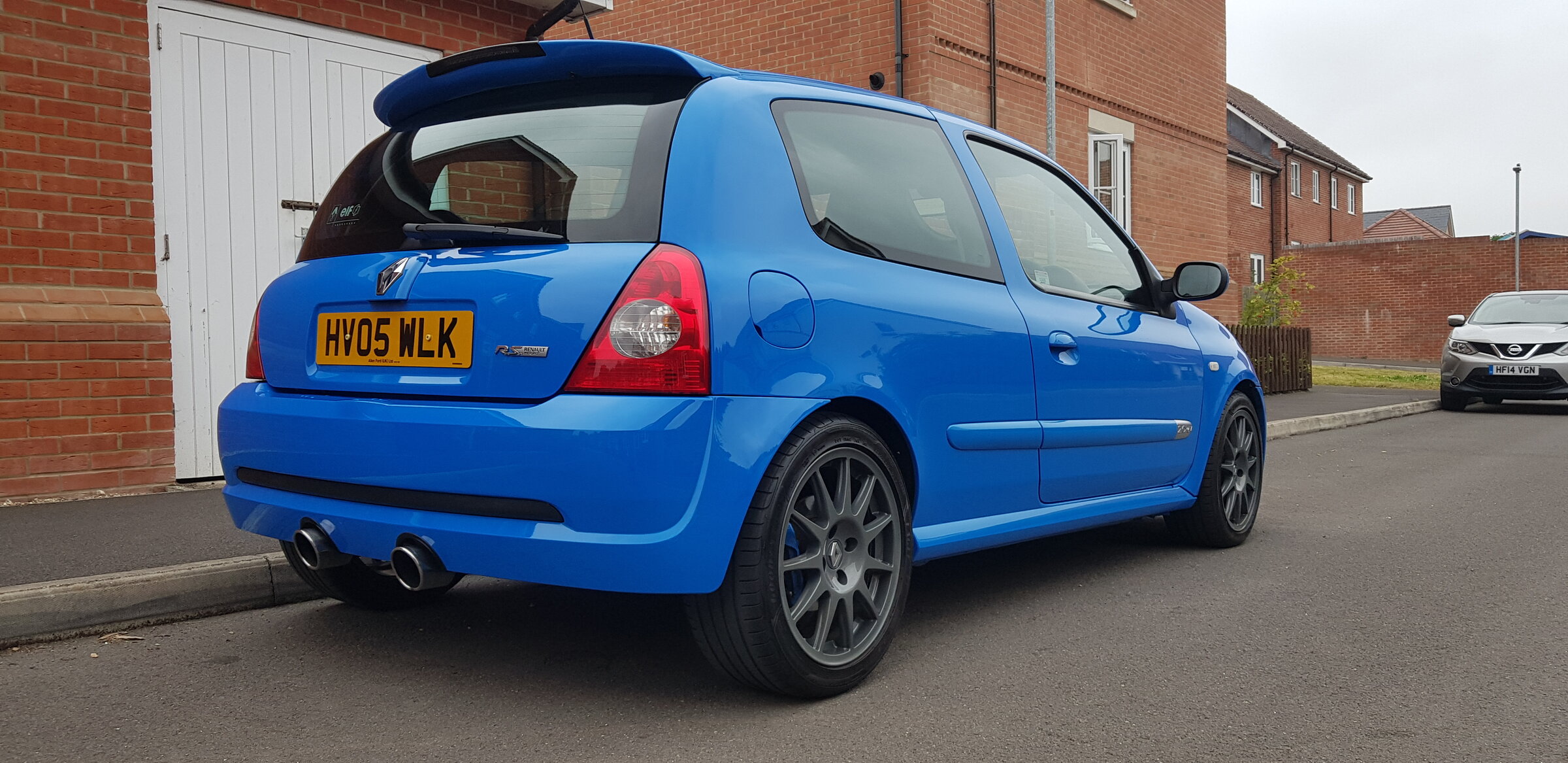

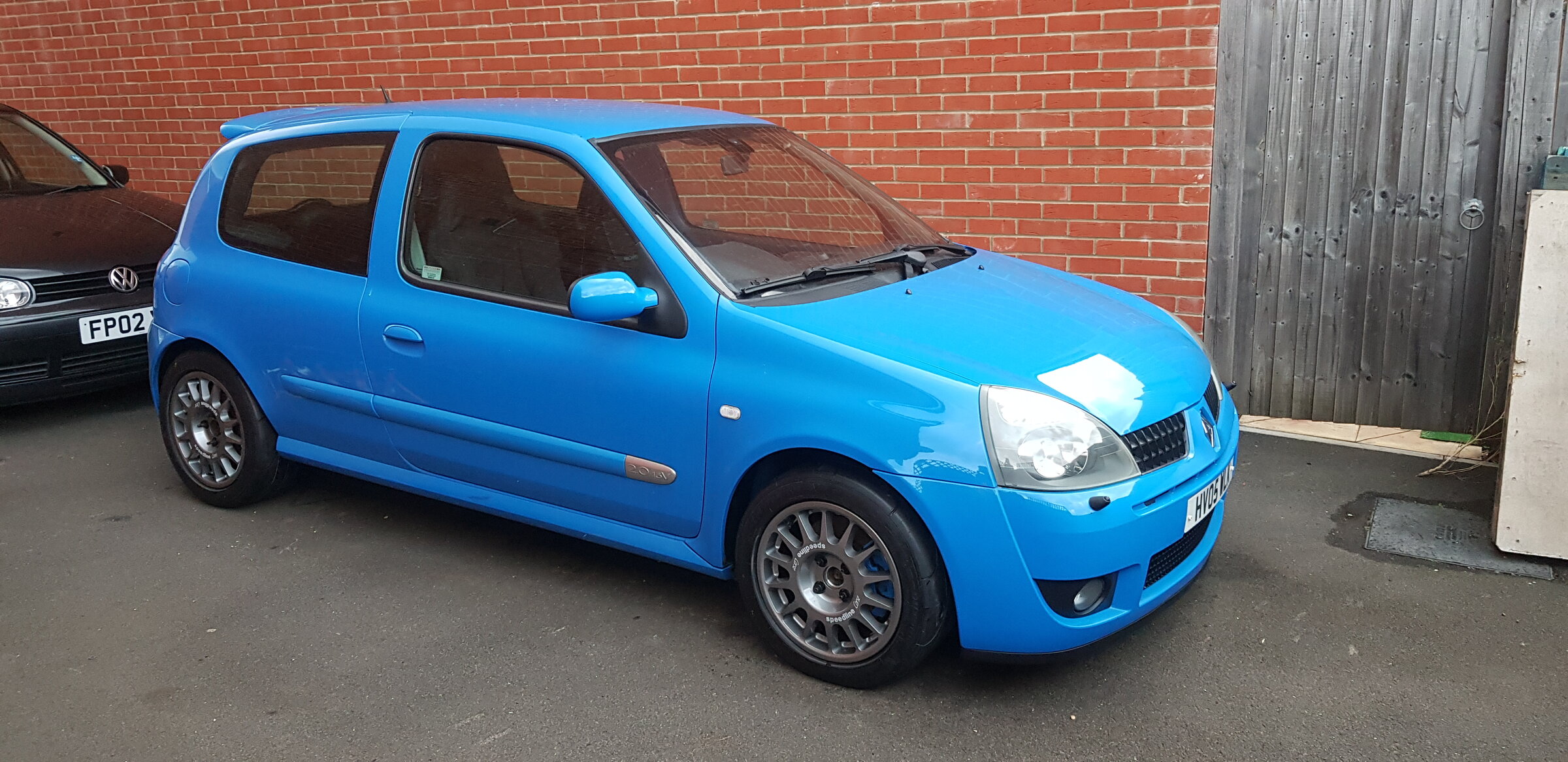

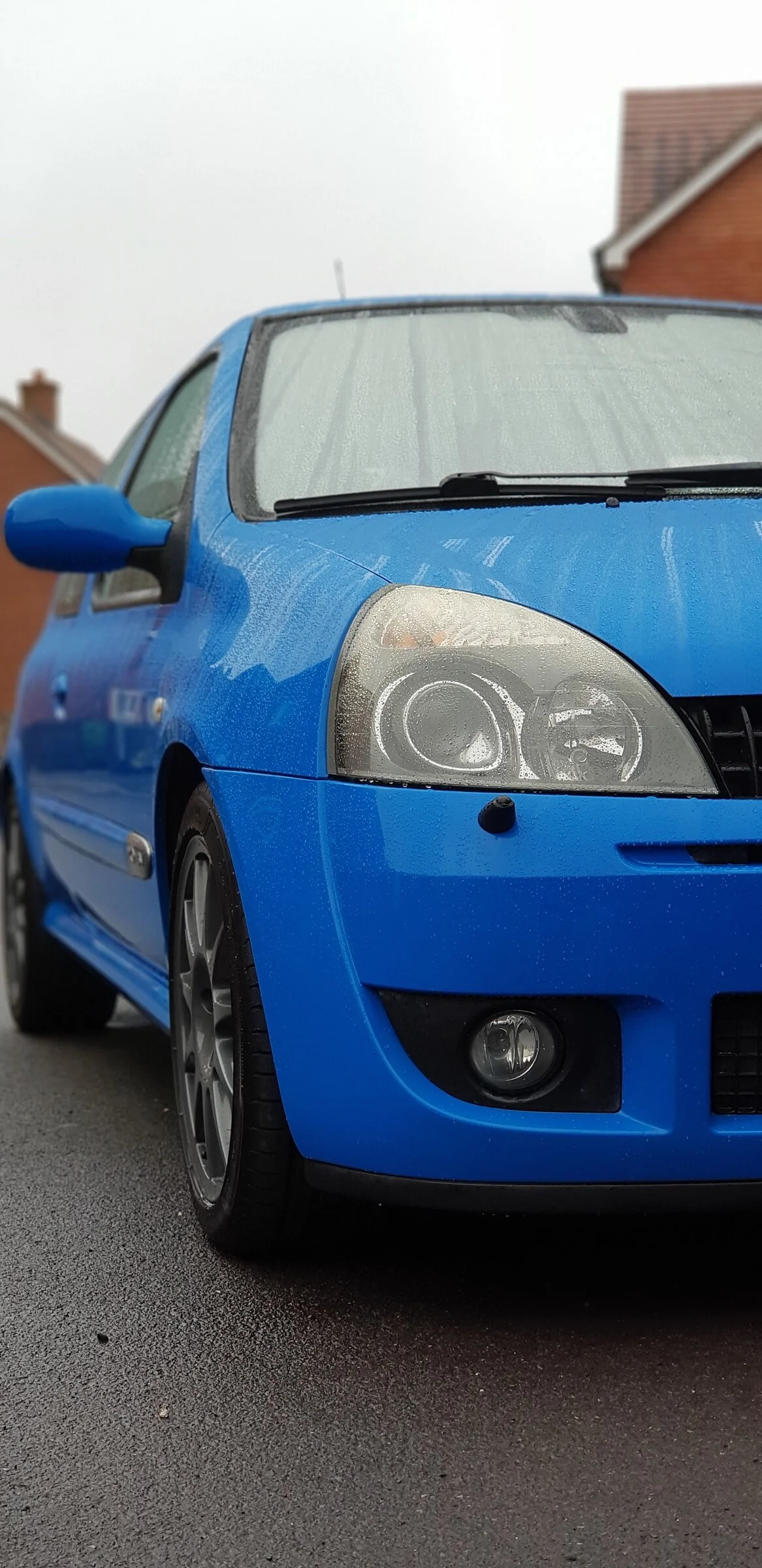

So, having owned the car a week (and now my 6th RenaultSport Clio) I thought I would start a project thread.
After looking for a while, this Racing Blue came up for sale, it was 2.5hrs away, so a trip up on a Friday afternoon had me leaving a deposit, to be collected the following day. A quick picture before leaving friday.
The car drove home faultlessly and with half a tank of fuel still in it, I didn't even need to stop. Picture on the driveway, chuffed to bits when I returned home.
So, as the car stood, the spec:
Engine/Drivetrain:
  • Remapped by EFI – 192BHP
  • KTEC cold air intake
  • KTEC decat
  • KTER C2RS 182 Supersport Centreline Catback Exhaust
Suspension/Exterior:
  • Cup offset turini wheels with Goodyear Eagle F1 all around
  • New genuine front and rear Renault shock absorbers
  • Eibach proline springs
  • Whiteline clio 2RS rear anti roll bar kit
  • Braided brake lines
  • Mintex Racing M1144 brake pads
  • Brembo Front UV (HC) Brake Discs
  • Genuine rear discs with new bearings
  • Debagged rear with new style RS badge
  • Painted brake calipers
  • Slim front number plate
Interior:
  • Recaro trendline front seats
  • Megane shifter bent towards driver along with Yanoo stiff shift 3.0
  • KTEC re-trimmed steering wheel
  • Refurnished door handles
  • KTEC floor mats
  • LED interior lighting
More to follow...

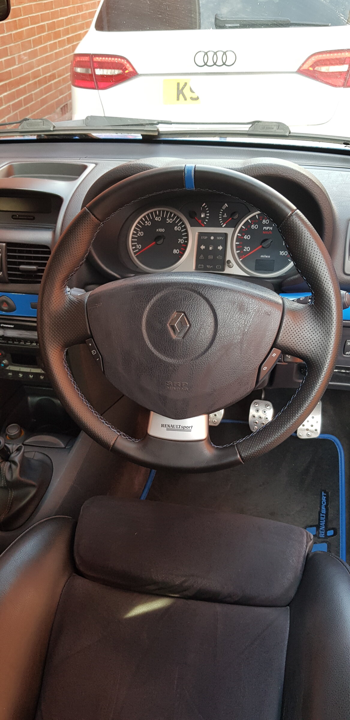

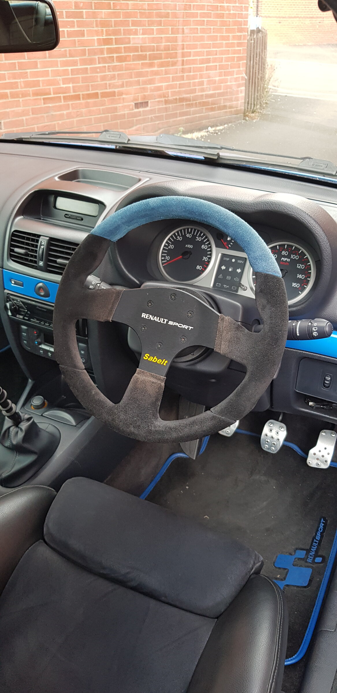

I had already bought a Sabelt wheel before I had a car, I was going to wait to get it refurbished, but my impatience got the better of me.
Old wheel:
New wheel is a Sabelt with OMP boss and phase 1 indicator stalk. I've not bothered with the cruise, as I never use it in the clio.

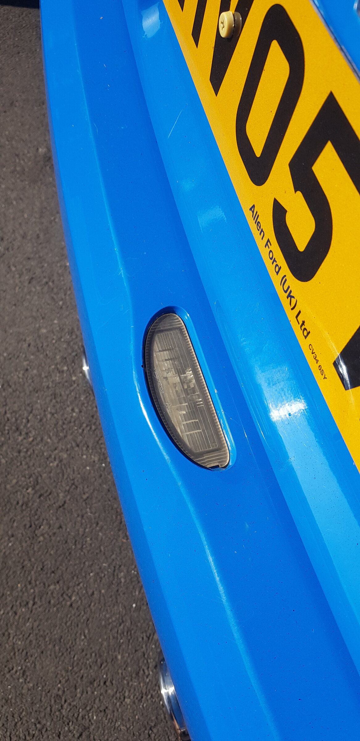

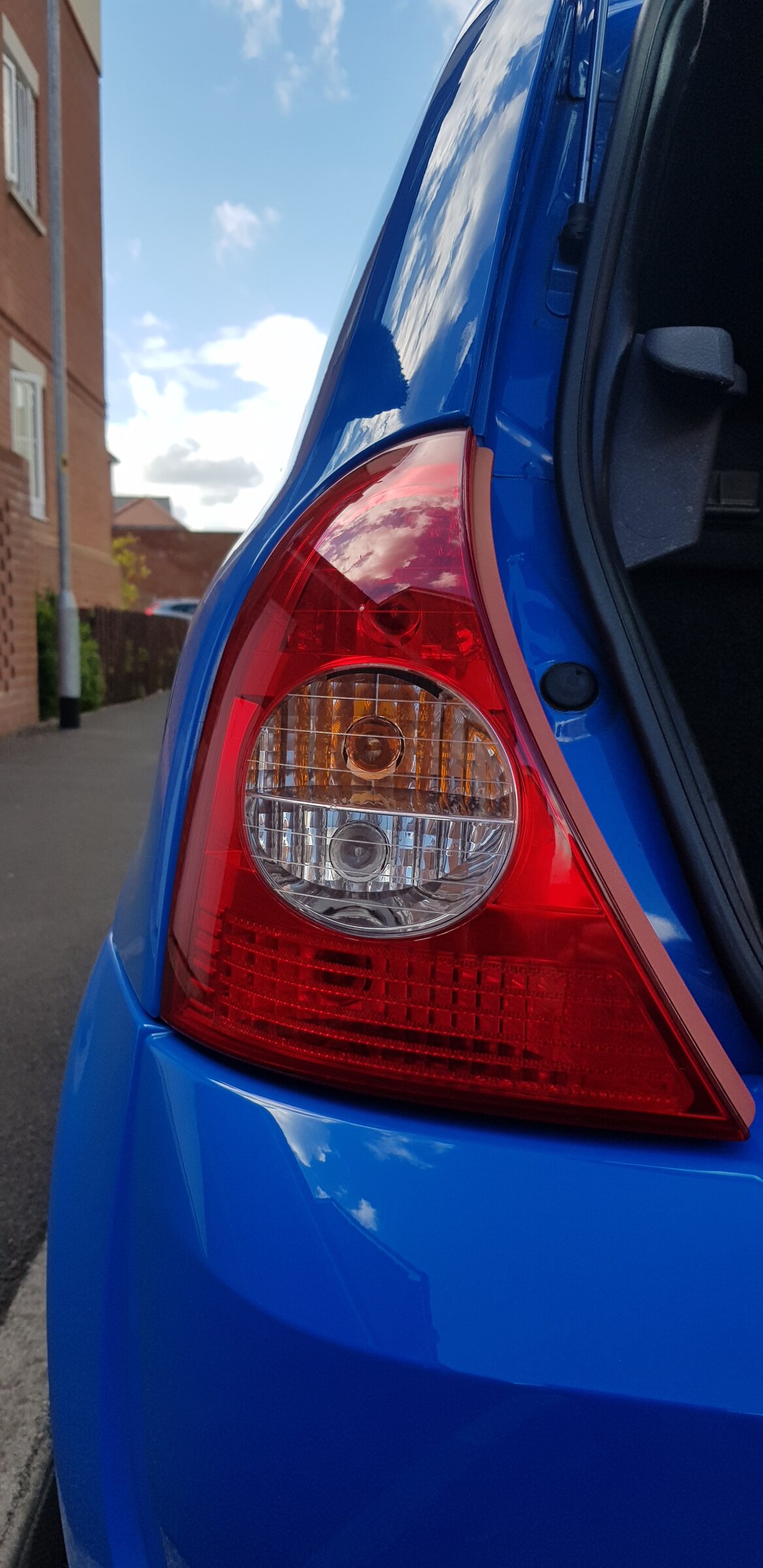

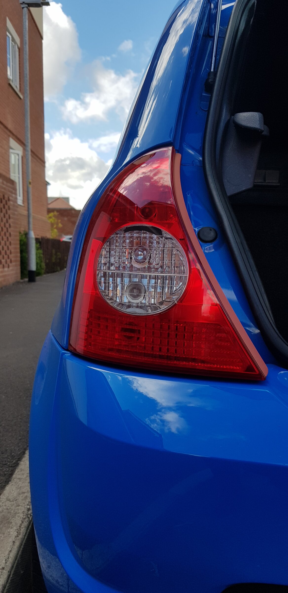

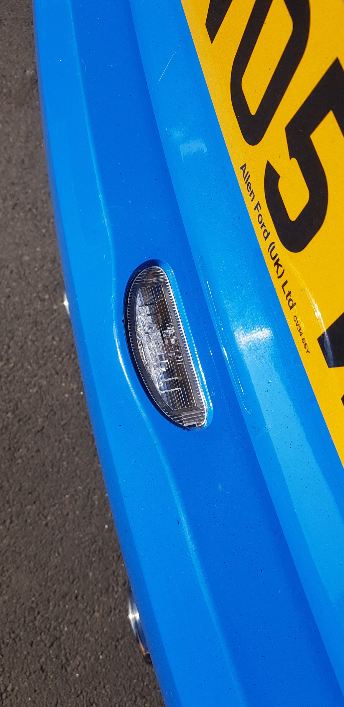

Next up was the rear number plate light, small easy change, but makes it look much nicer.
Old light:
And new light in:

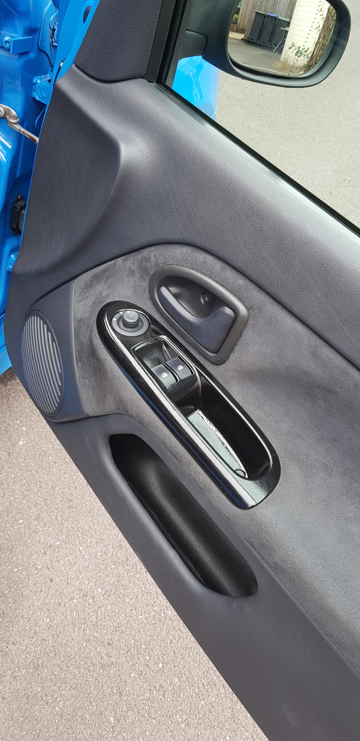

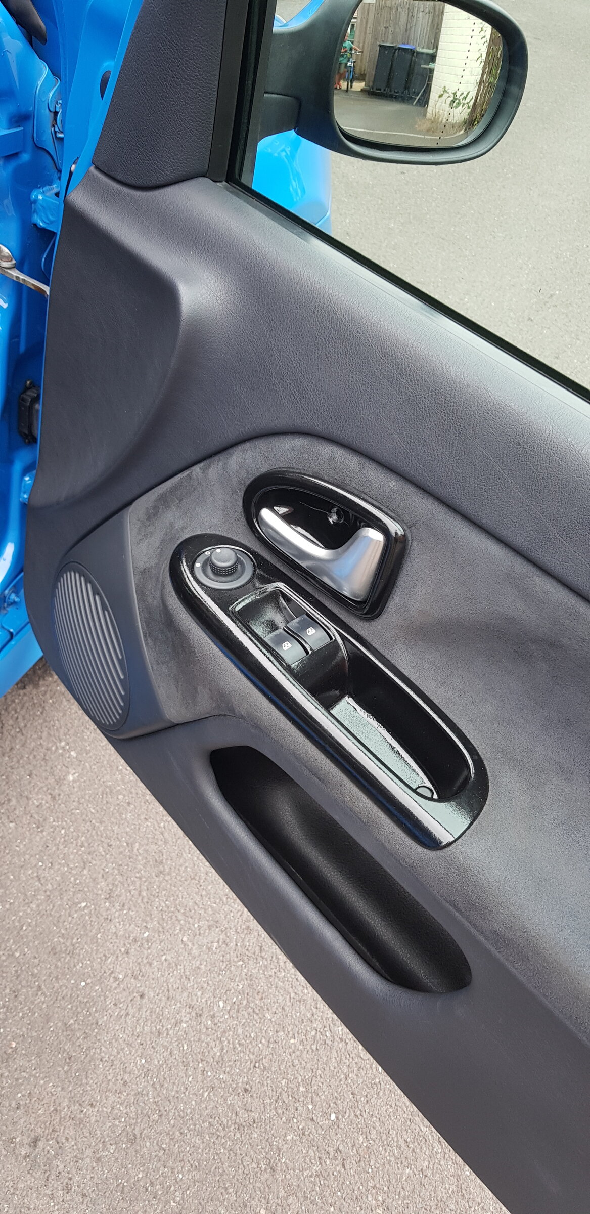

Next up is to remove some of the painted items inside the car, as I'm personally not a fan.
Old door handles being replaced for all black (clio 1.2 handles).

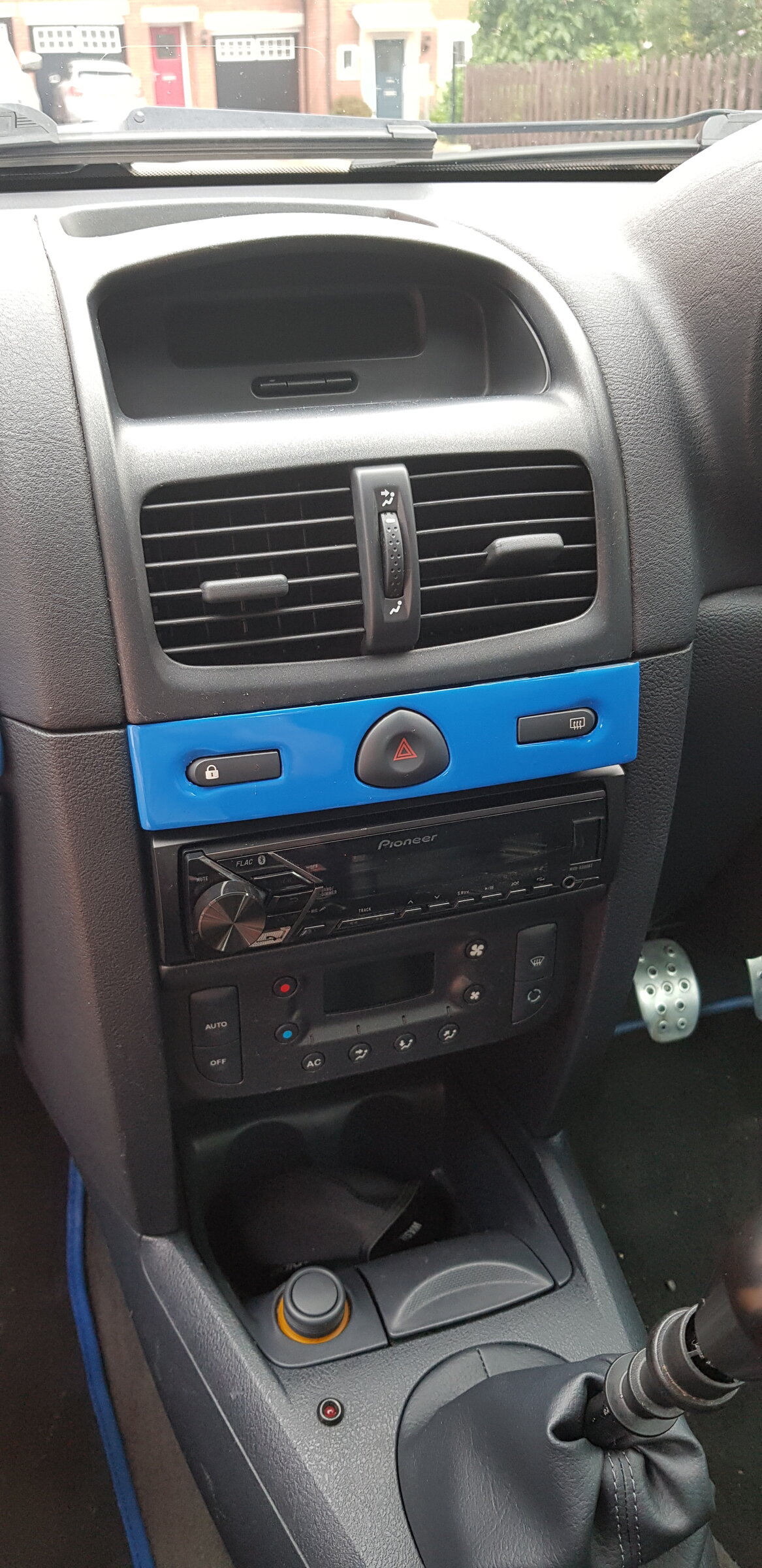

And then the RB painted hazard panel being swapped for original:
The plan is to change the grab handles back to original when I can find some.
The remaining interior trim that is currently RB will be changed to Anthracite.

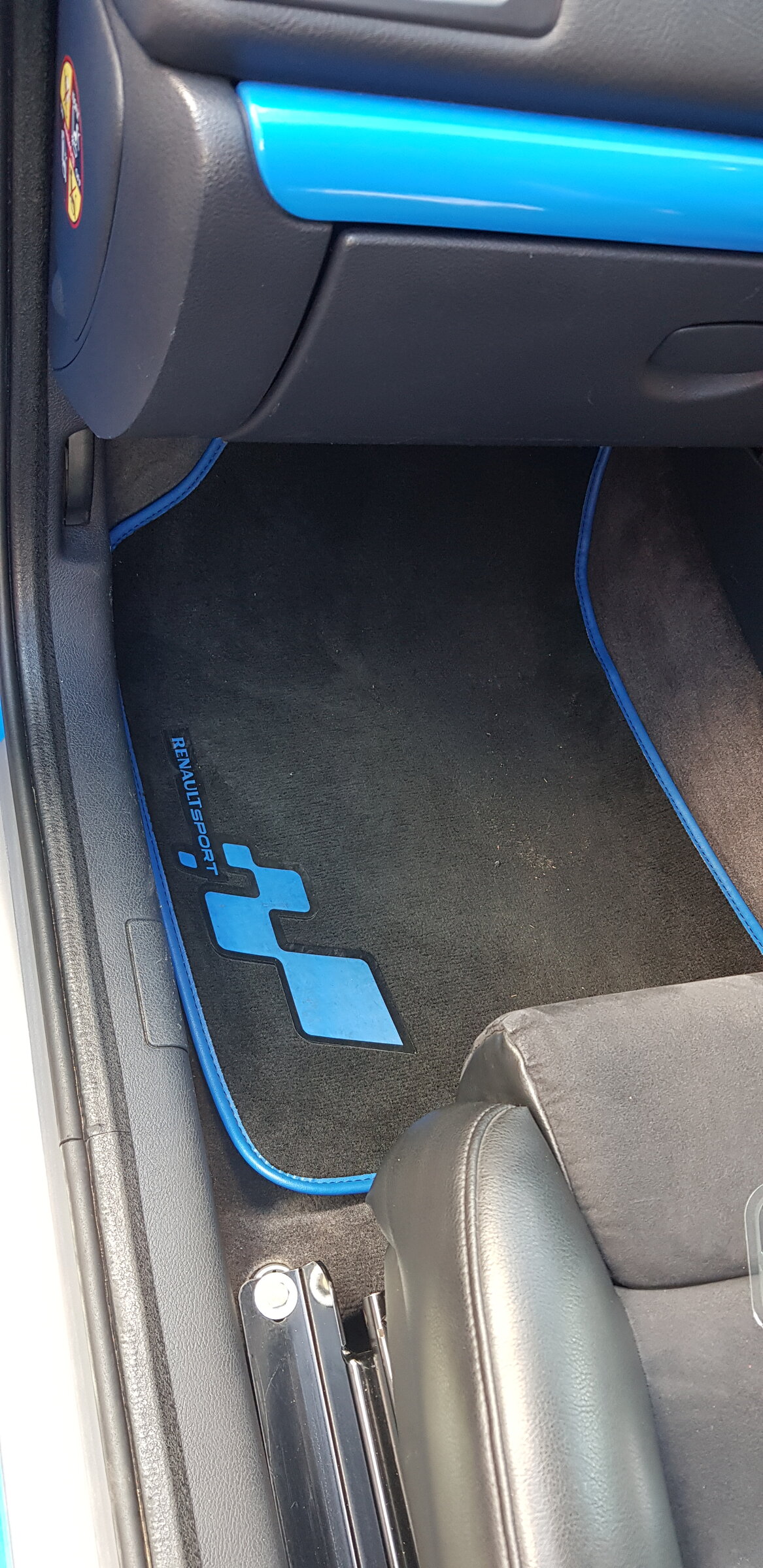

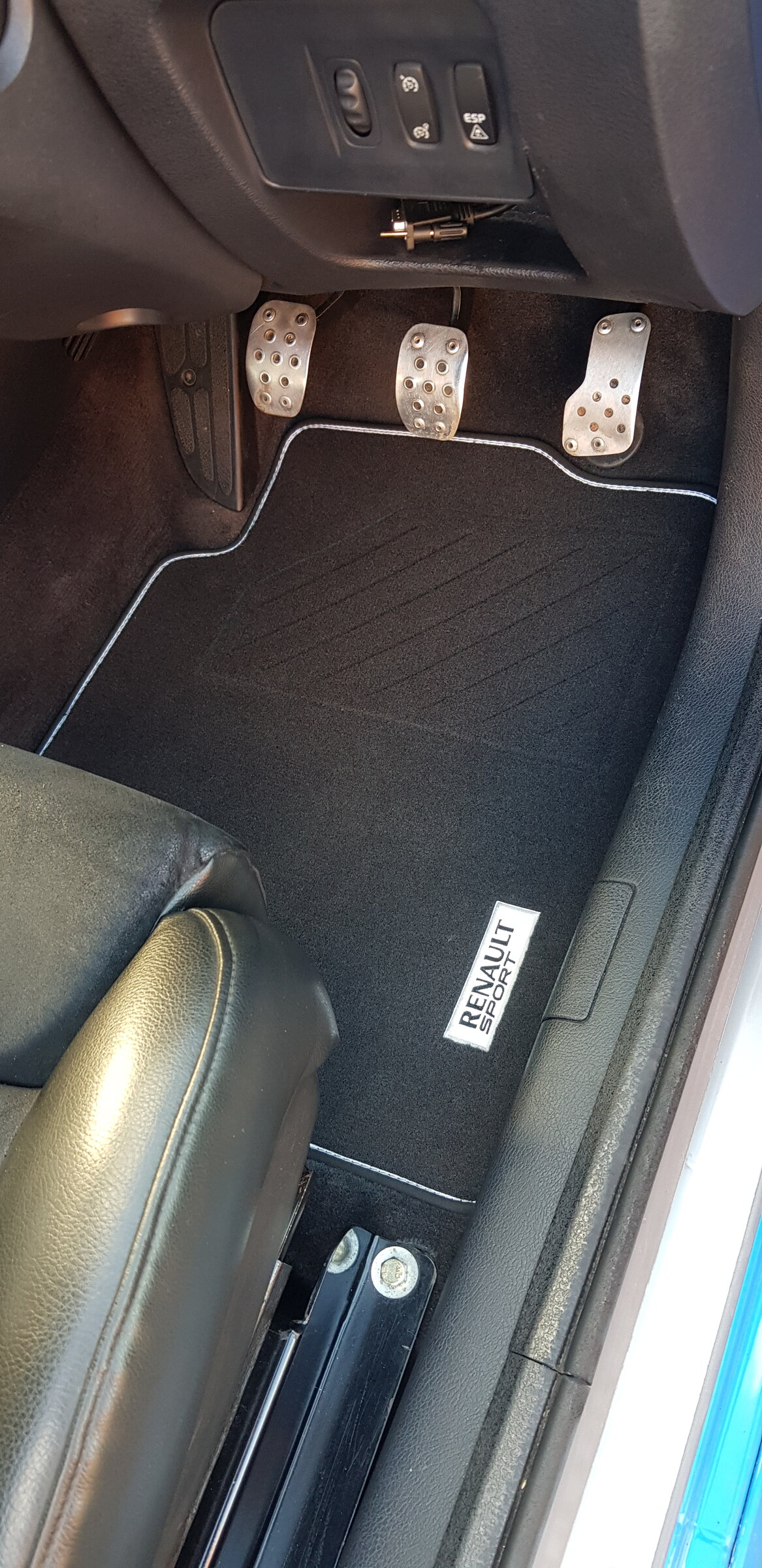

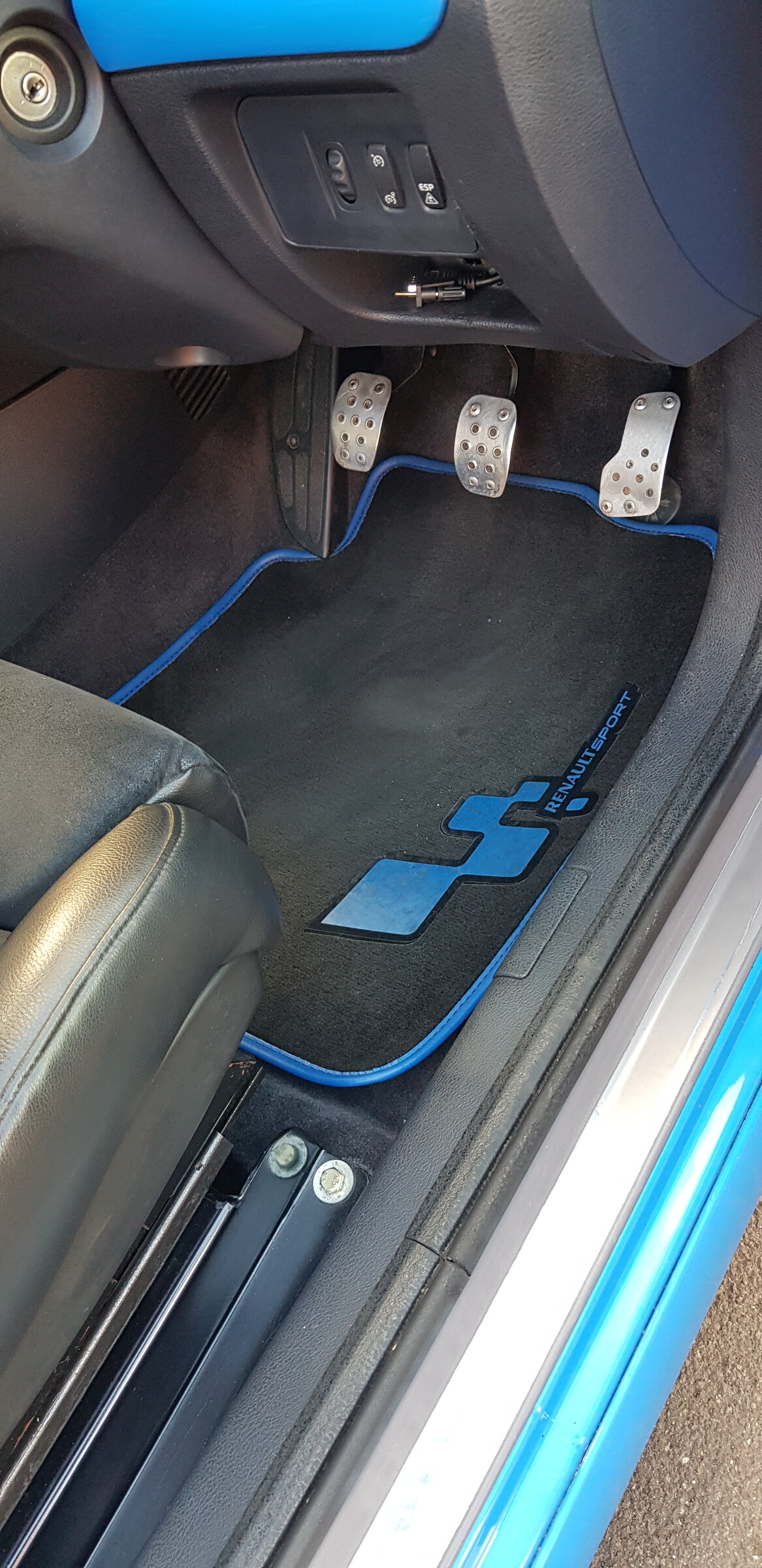

A few more minor bits arrived today and fitted after work.

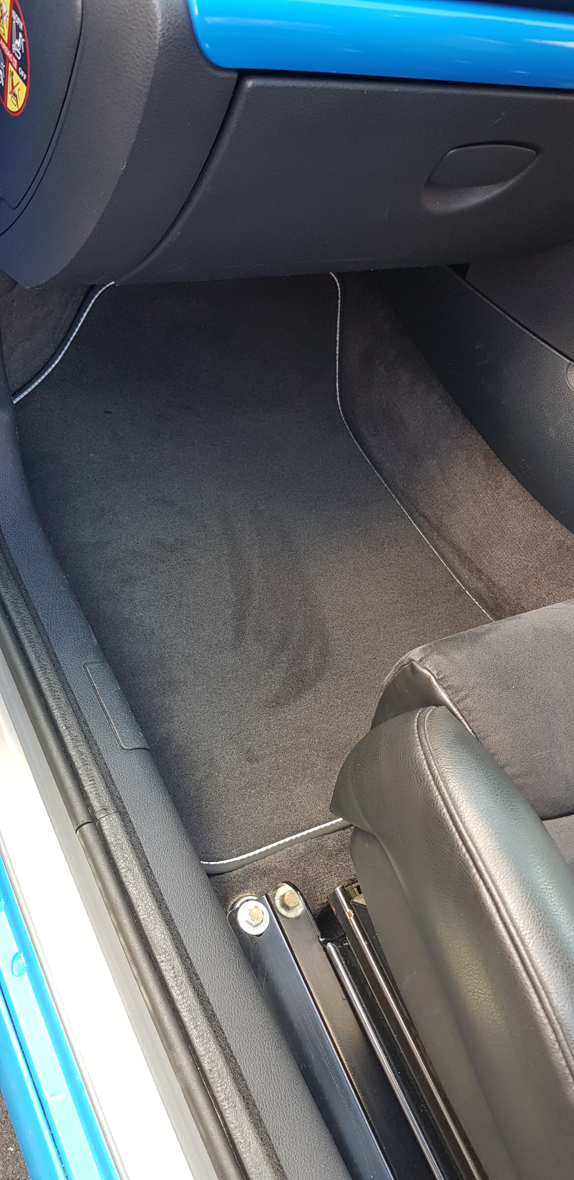

First off new interior mats, as I personally wasnt a fan of the old colour coded mats. Only genuine Renualt Sport mats would do.

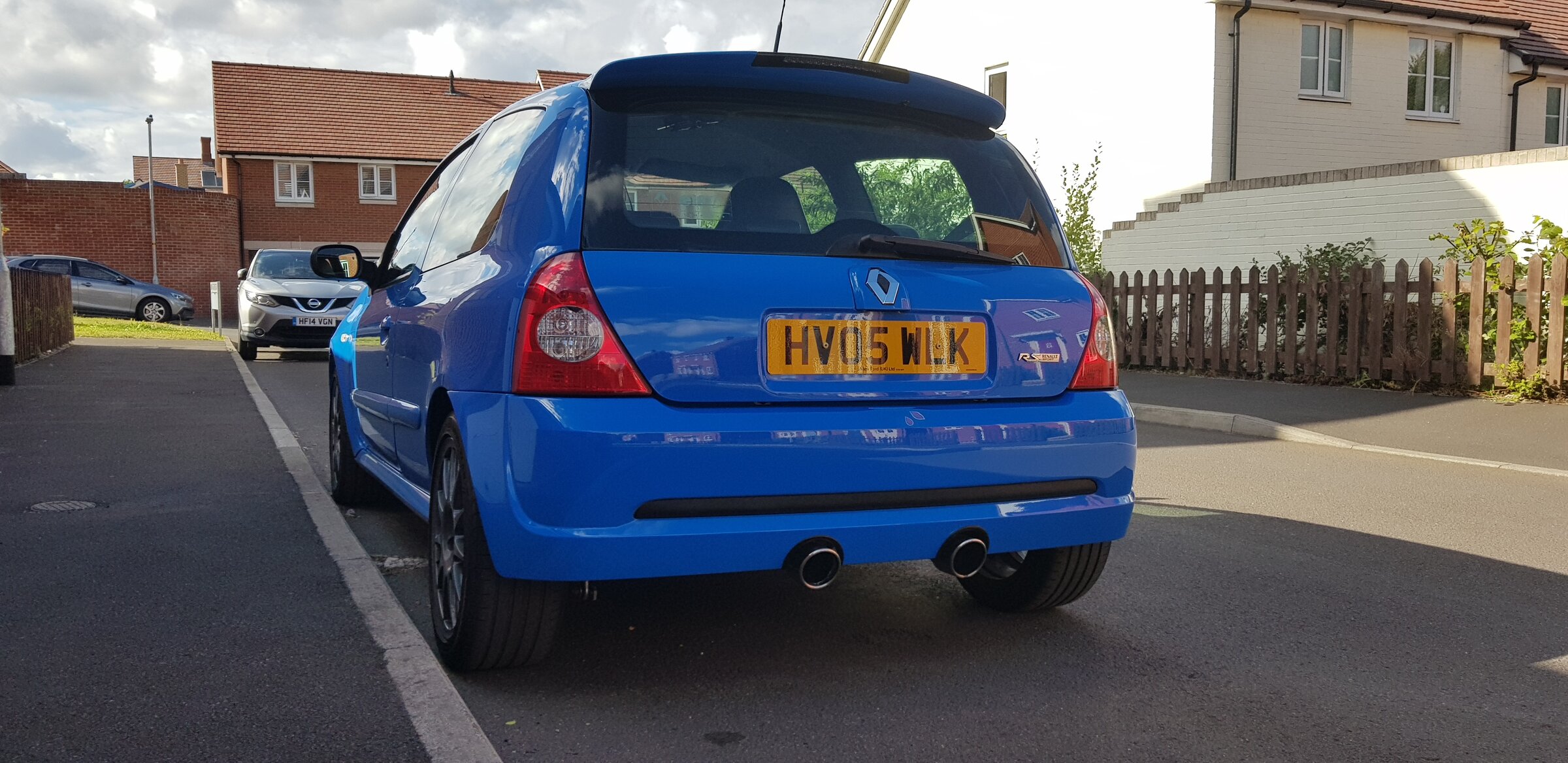

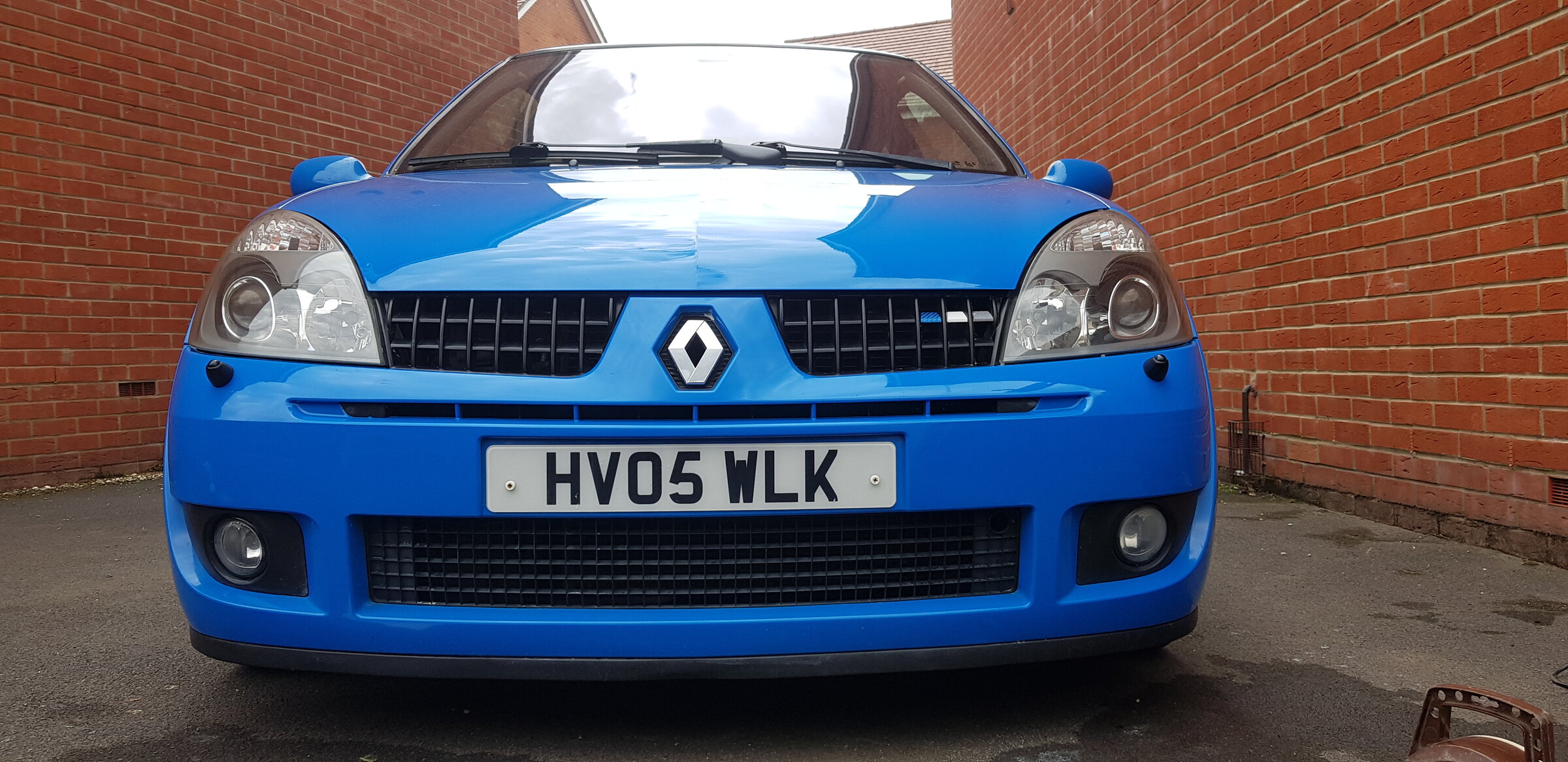

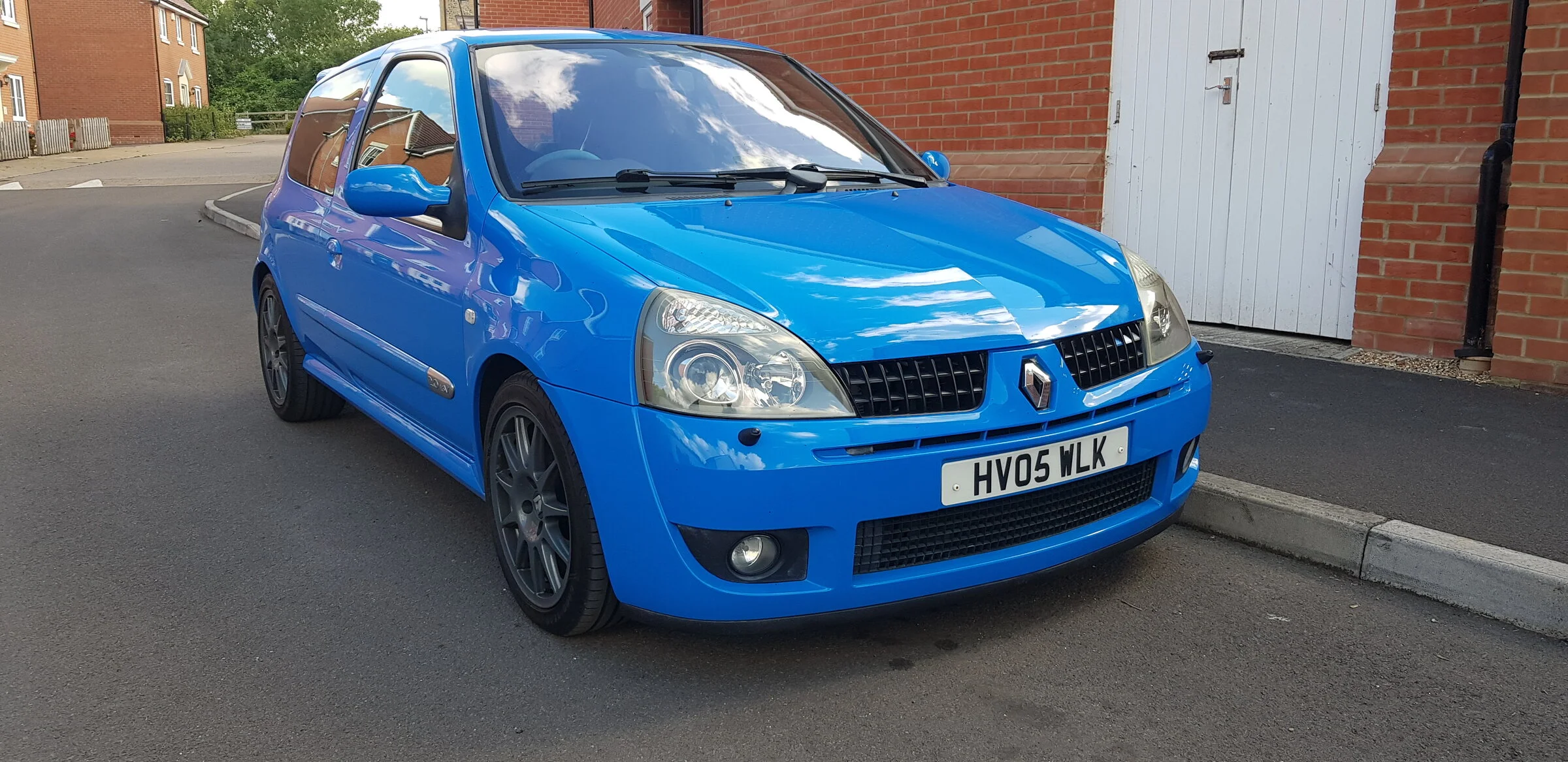

And a couple of the car for good measure.
The only other thing I'm waiting for is new plates, these will be attached with velcro, which I can then remove easily when cleaning.
I've only really been pottering back / forth from work, so not given it a proper drive yet, but hope that will change over the weekend with some nice weather. The engine in this one certainly feels strong vs my many other 182s!

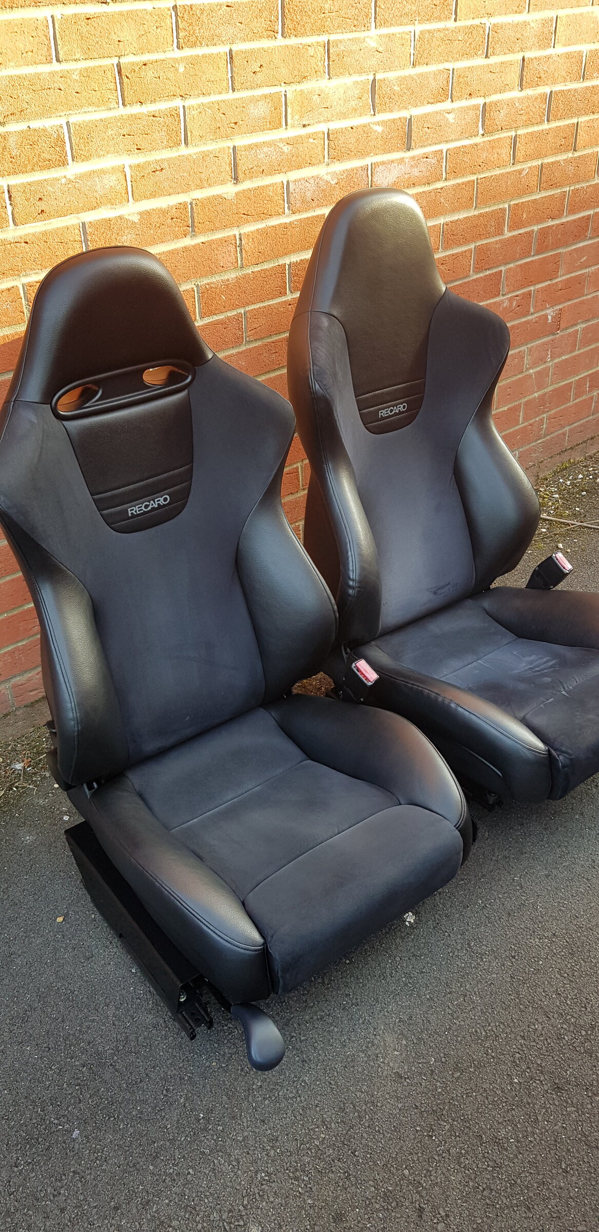

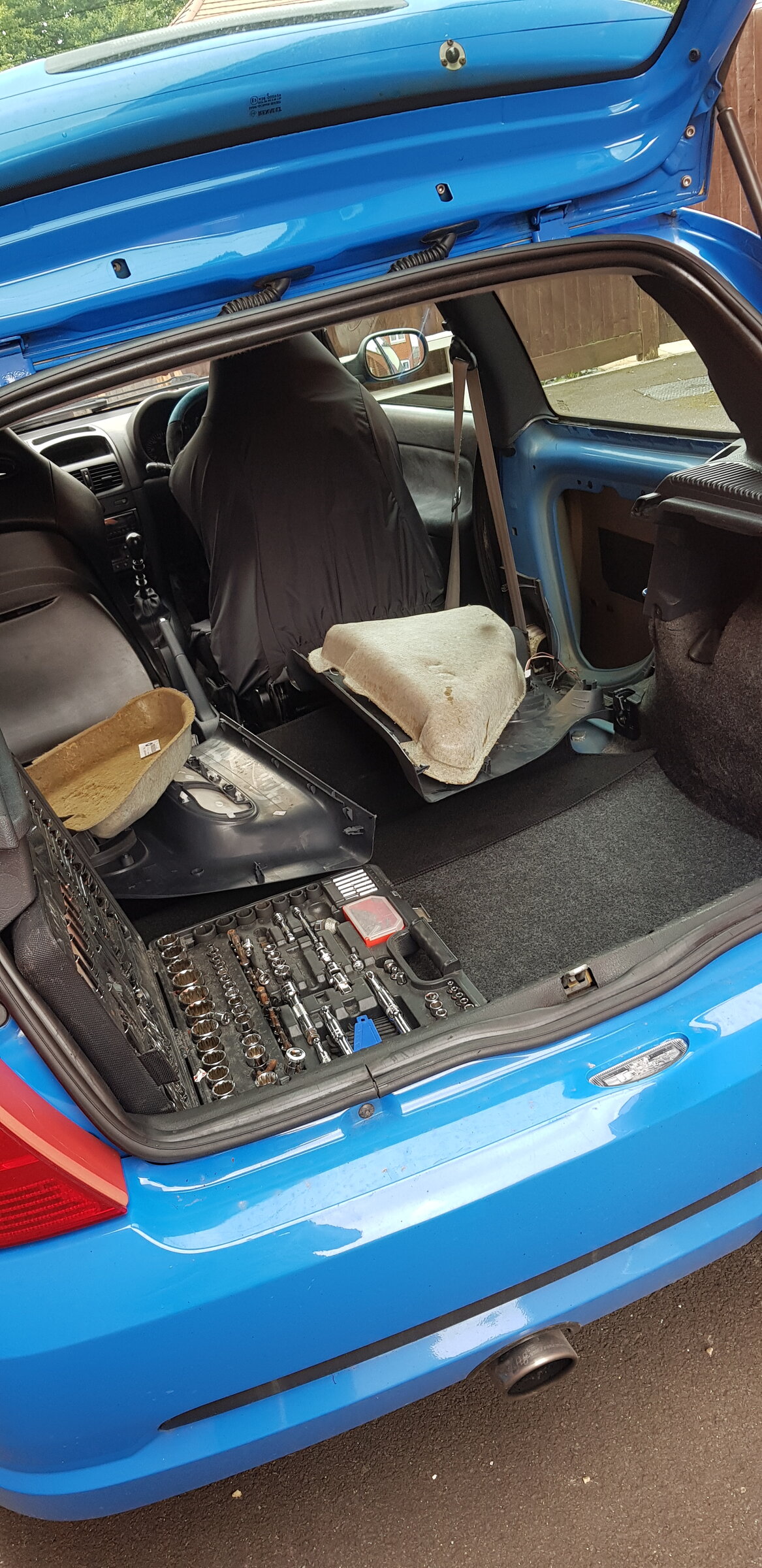

Small update:

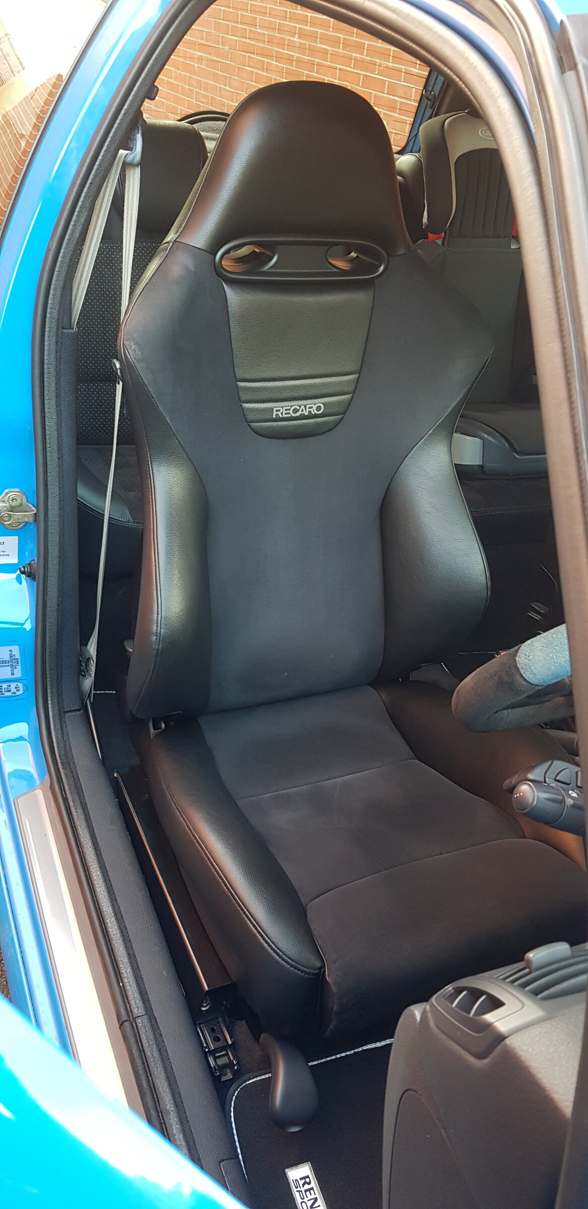

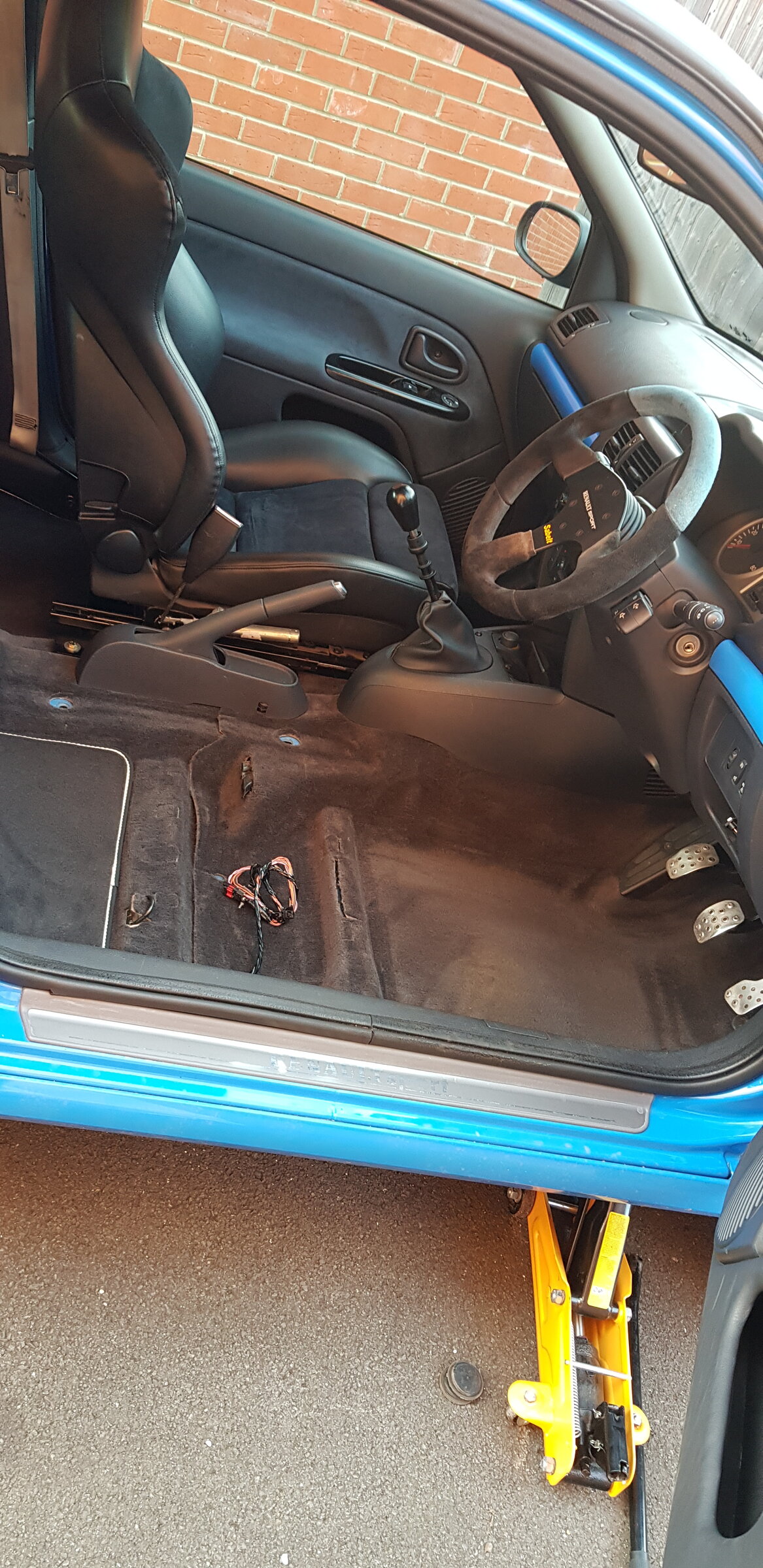

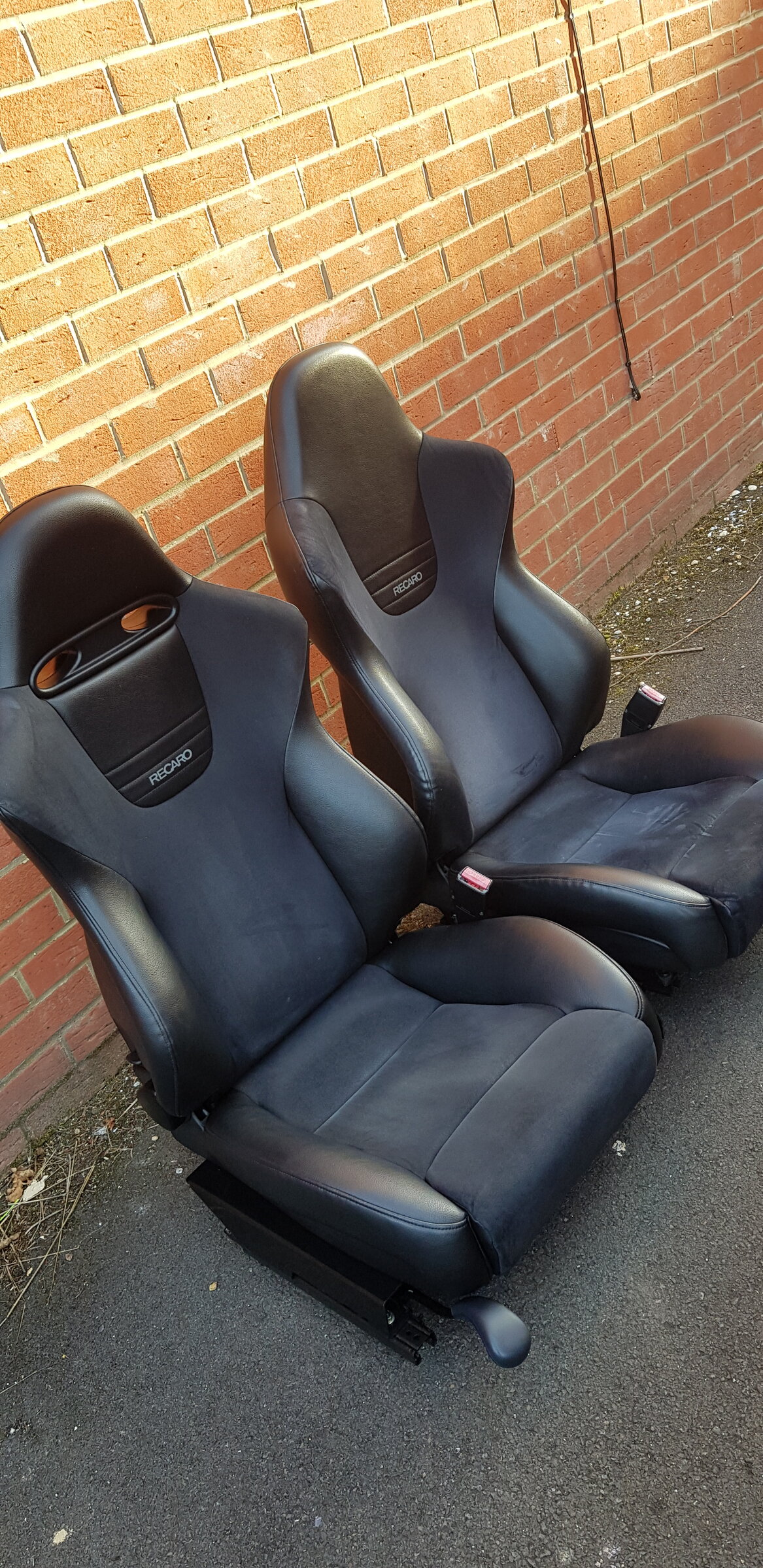

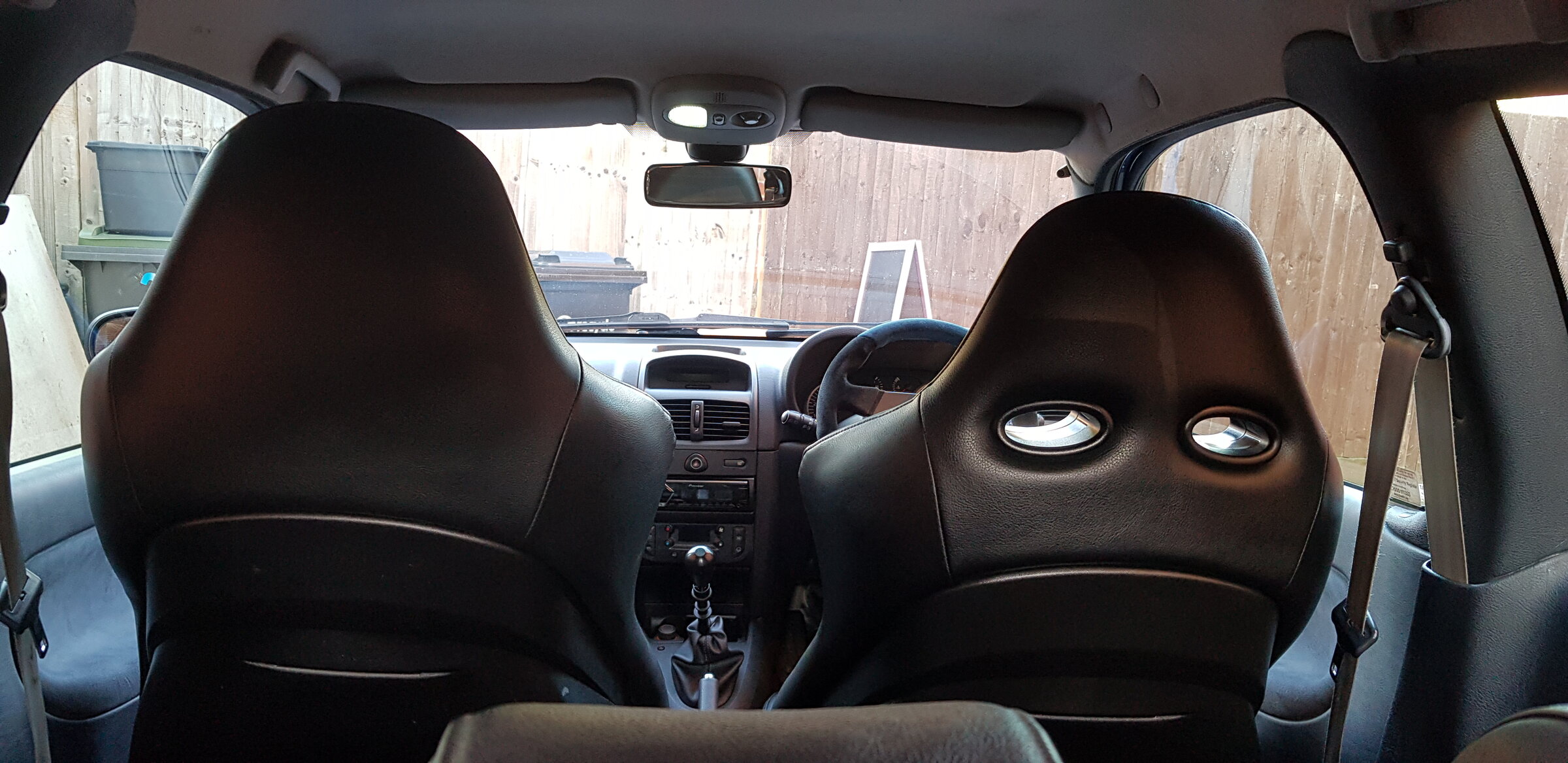

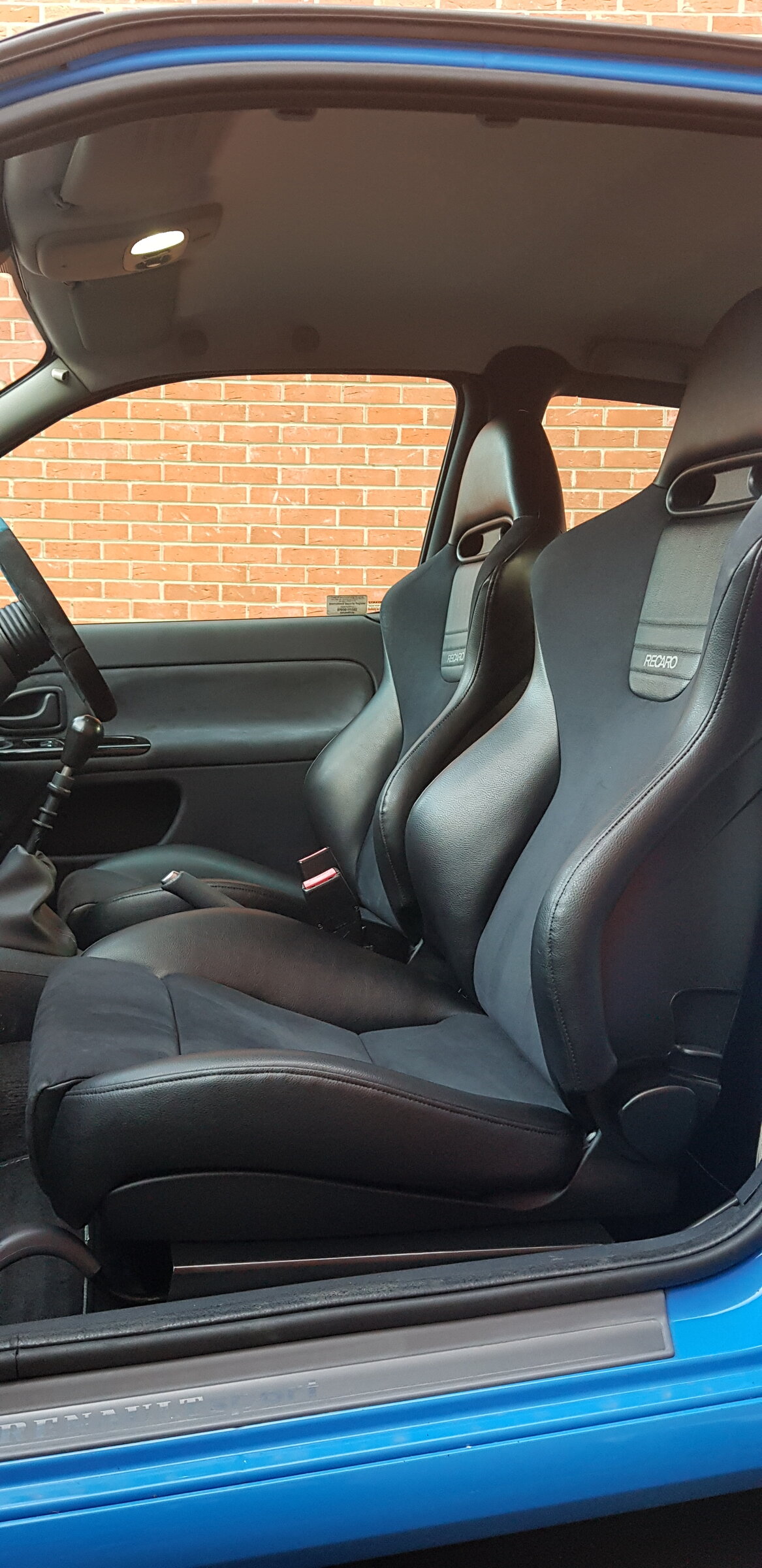

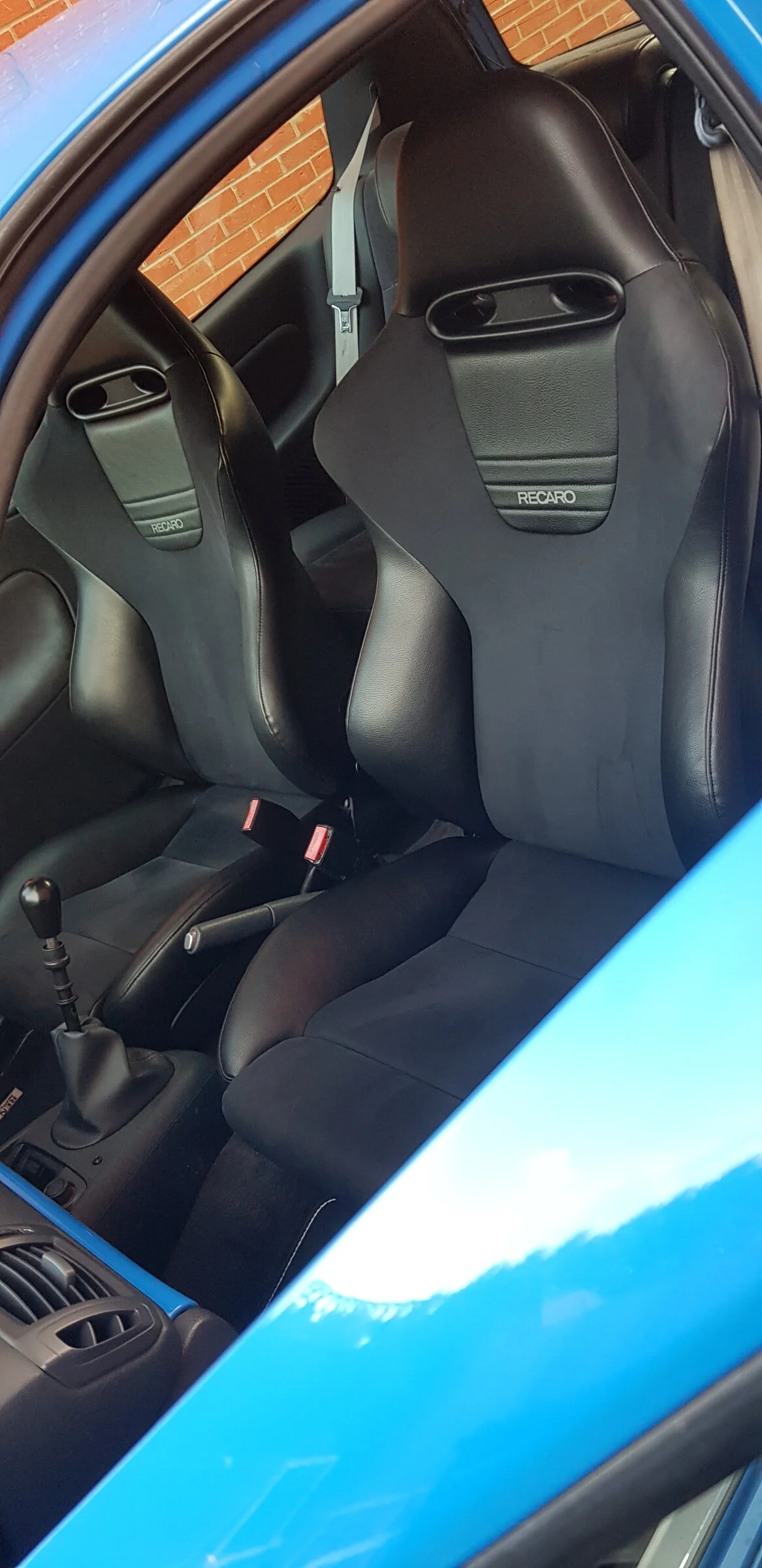

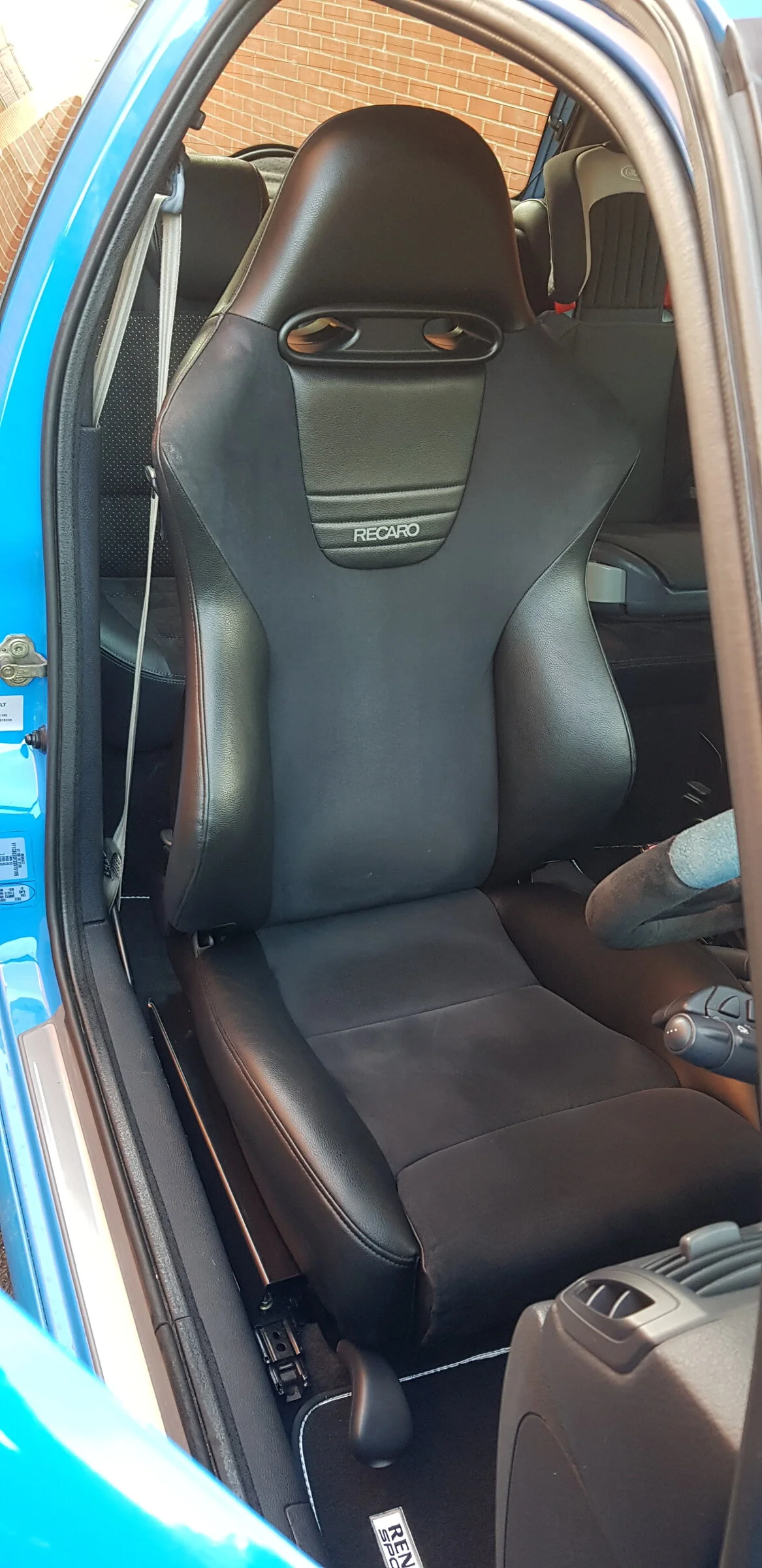

After @Ash J fitted his awesome pole position, I managed to poach his Recaro Trendlines from him. Popped down yesterday evening to collect them and managed to get them fitted today.
They are on Jon Foz X-Low frames, which have improved the driving position 110%. Ash even threw in the cover for the drivers seat, which I will use as the car is used daily.
The other recaros were on OMP mounts, and didn't have the holes.
If anyone are interested in the old Recaros, please let me know.
Couple of pictures

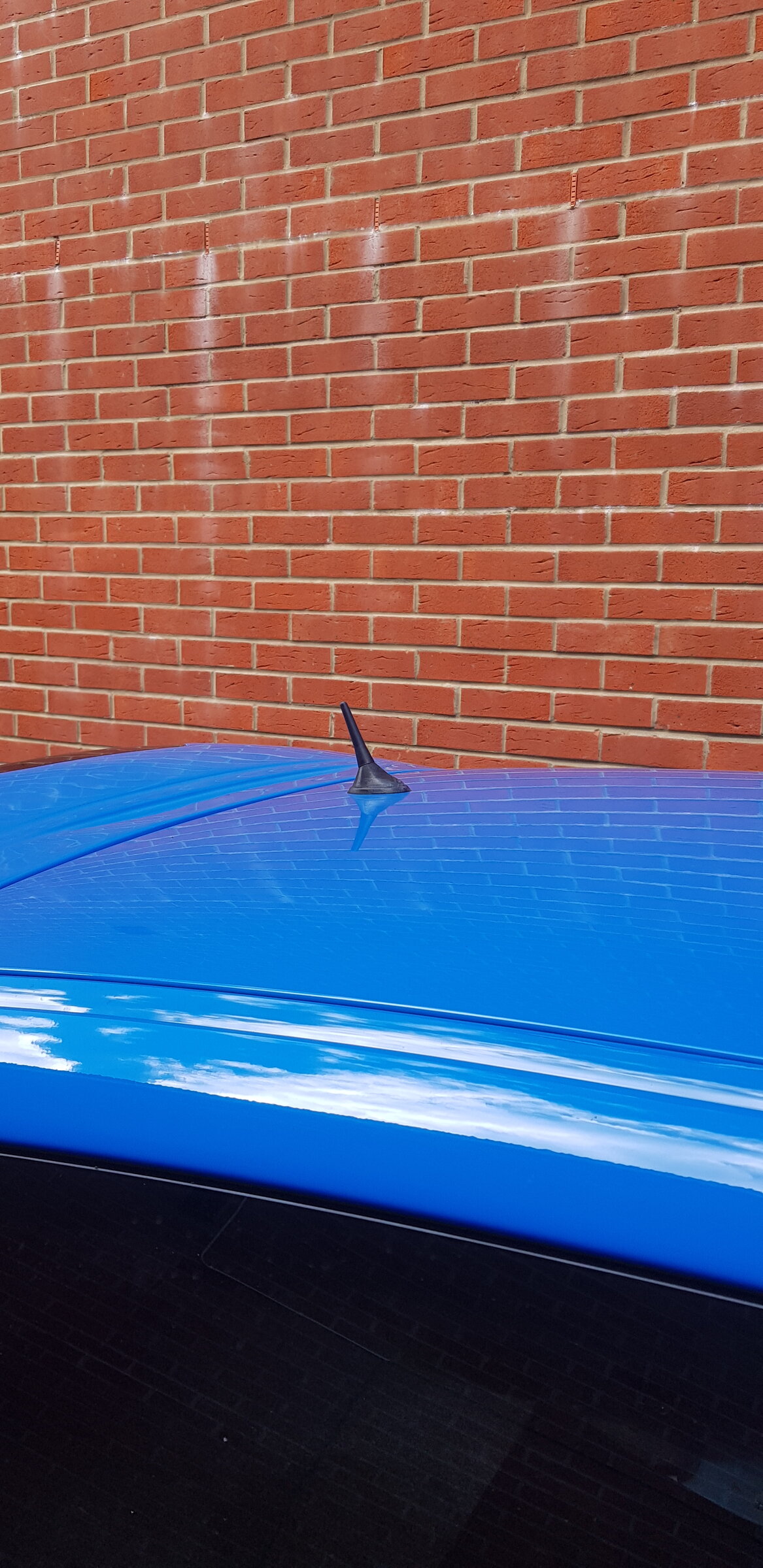

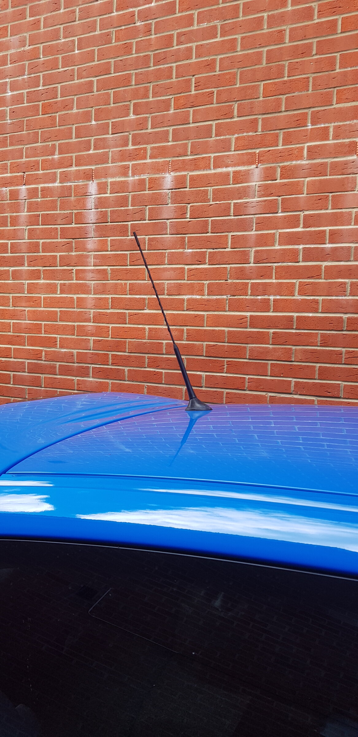

First of all the easiest change, I swapped out the large aerial for a bee sting, I'm guessing the signal will drop, but I'm not too fussed by that, as it looks much better.
Before:
After:

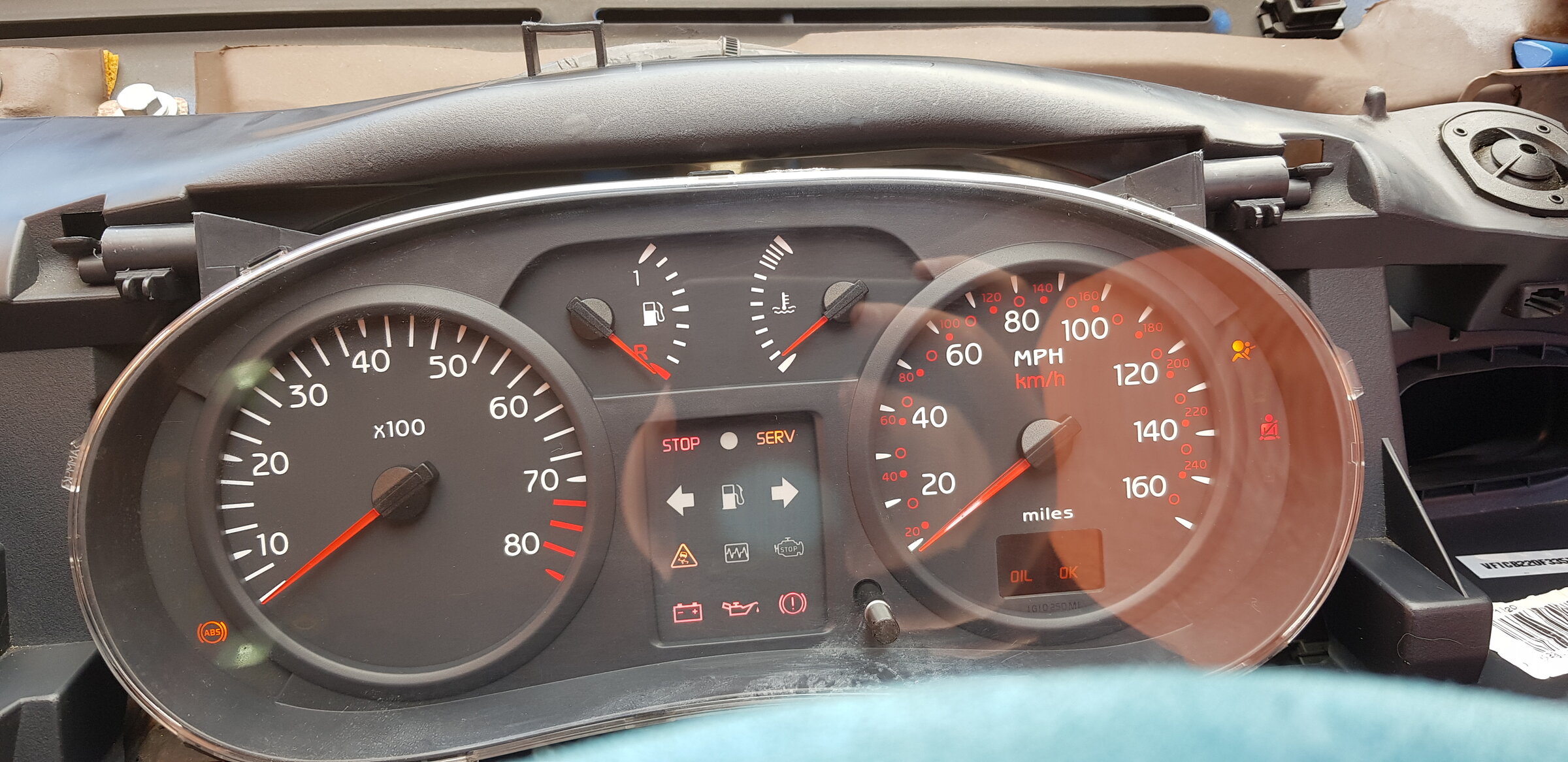

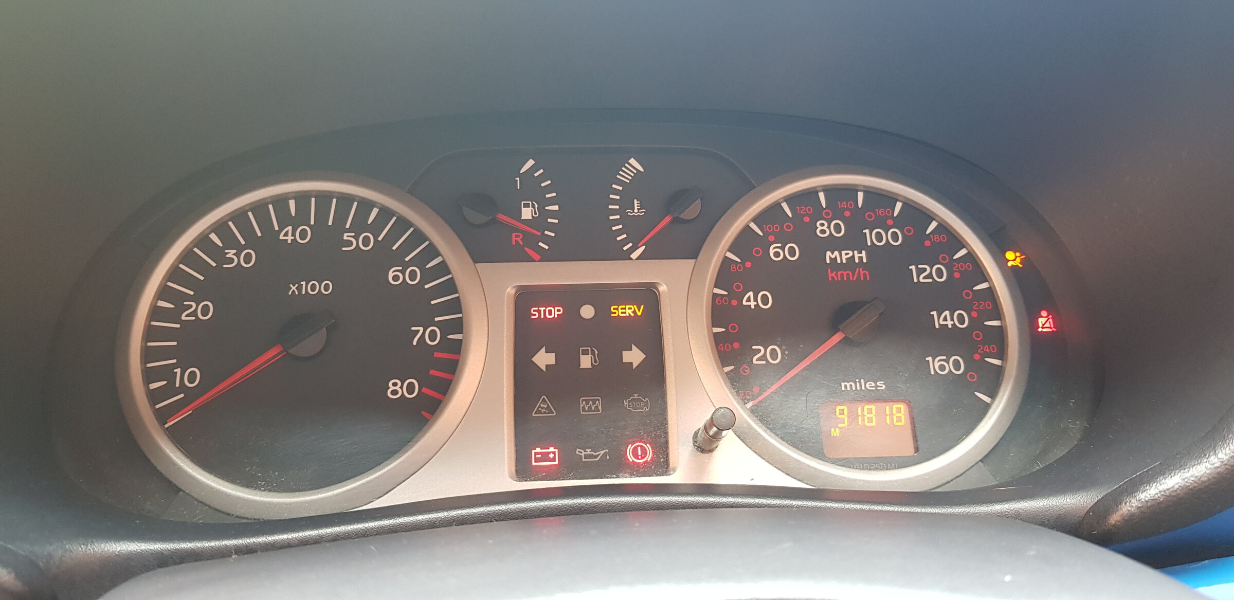

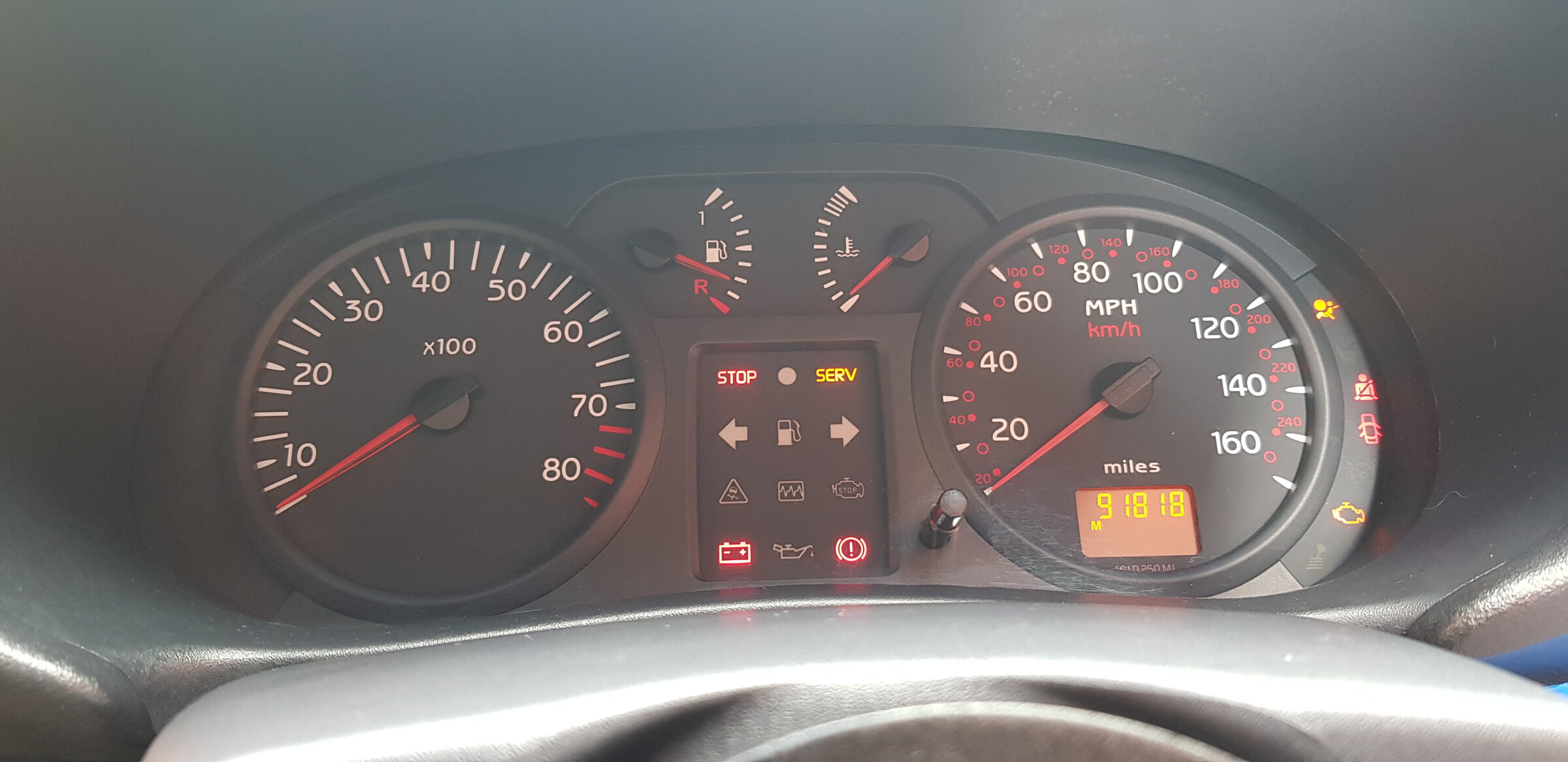

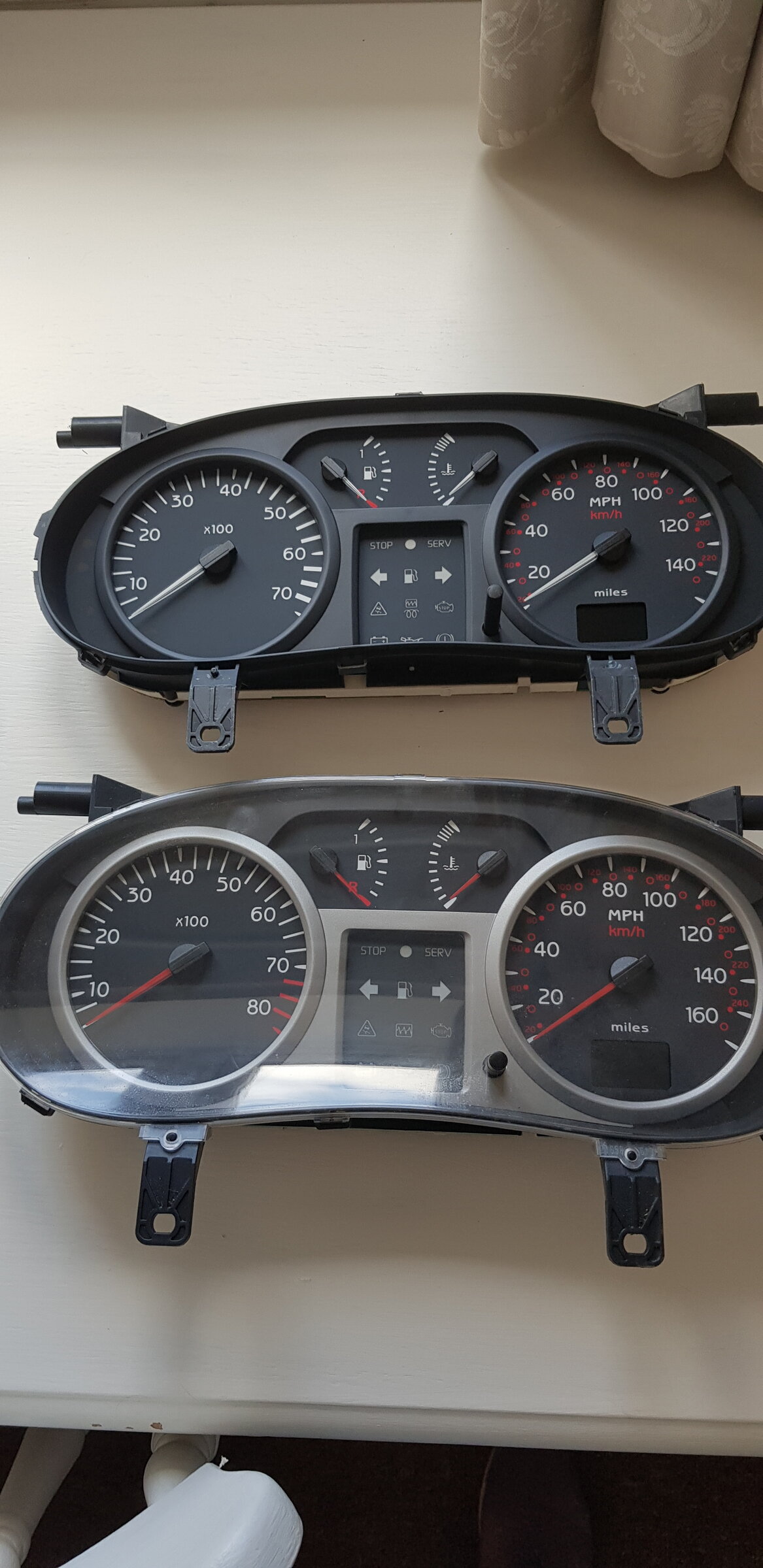

Then I changed the speedo surround, I'm not personally a fan of the silver surround. I thought about spraying, but wasnt sure if I'd be 100% happy, so ended up with a black plastic, as per the 1.2/1.5 clio.
Current silver surround with milage showing as 91,818.
Old and new:
Back in the car and quick check before putting the dash back in.
And in place with the same 91,818 milage.

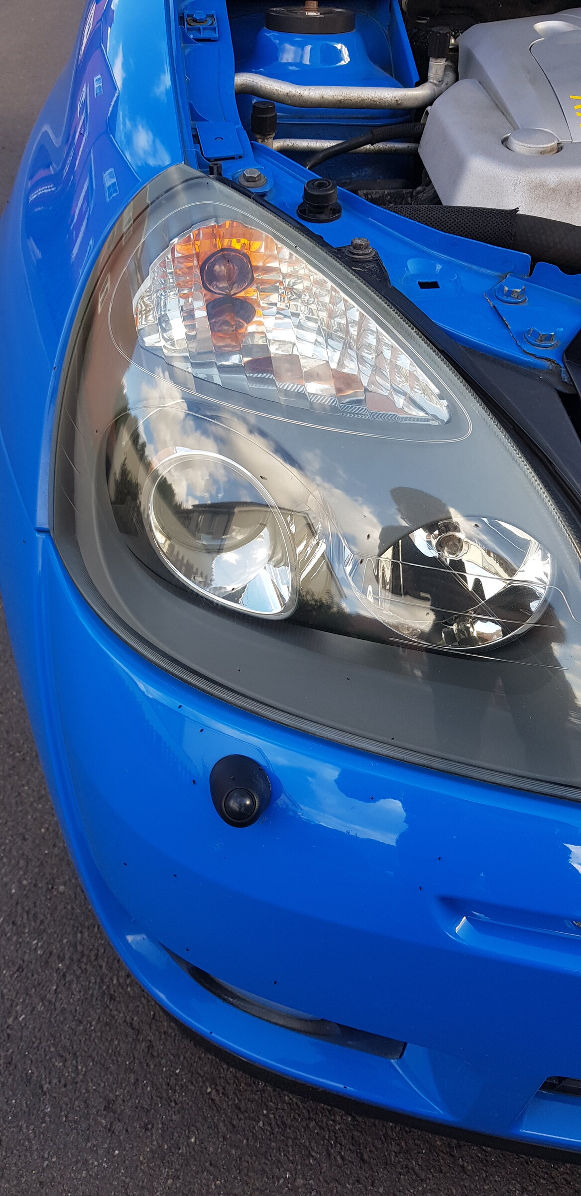

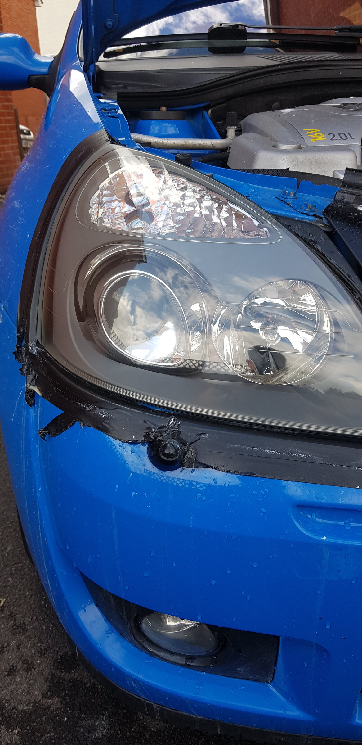

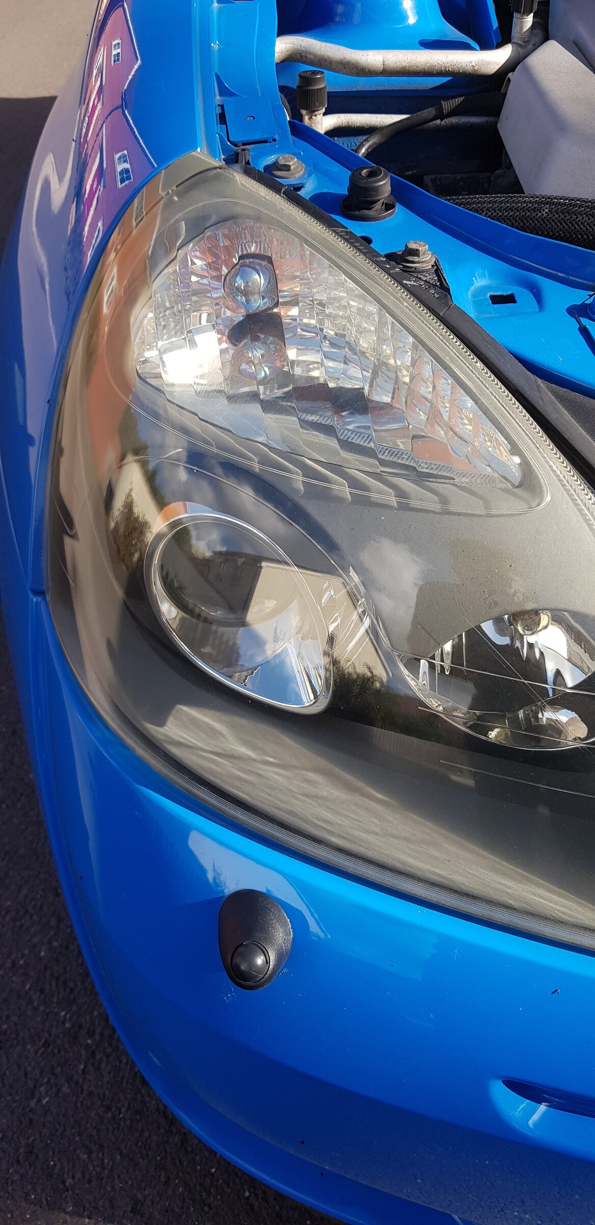

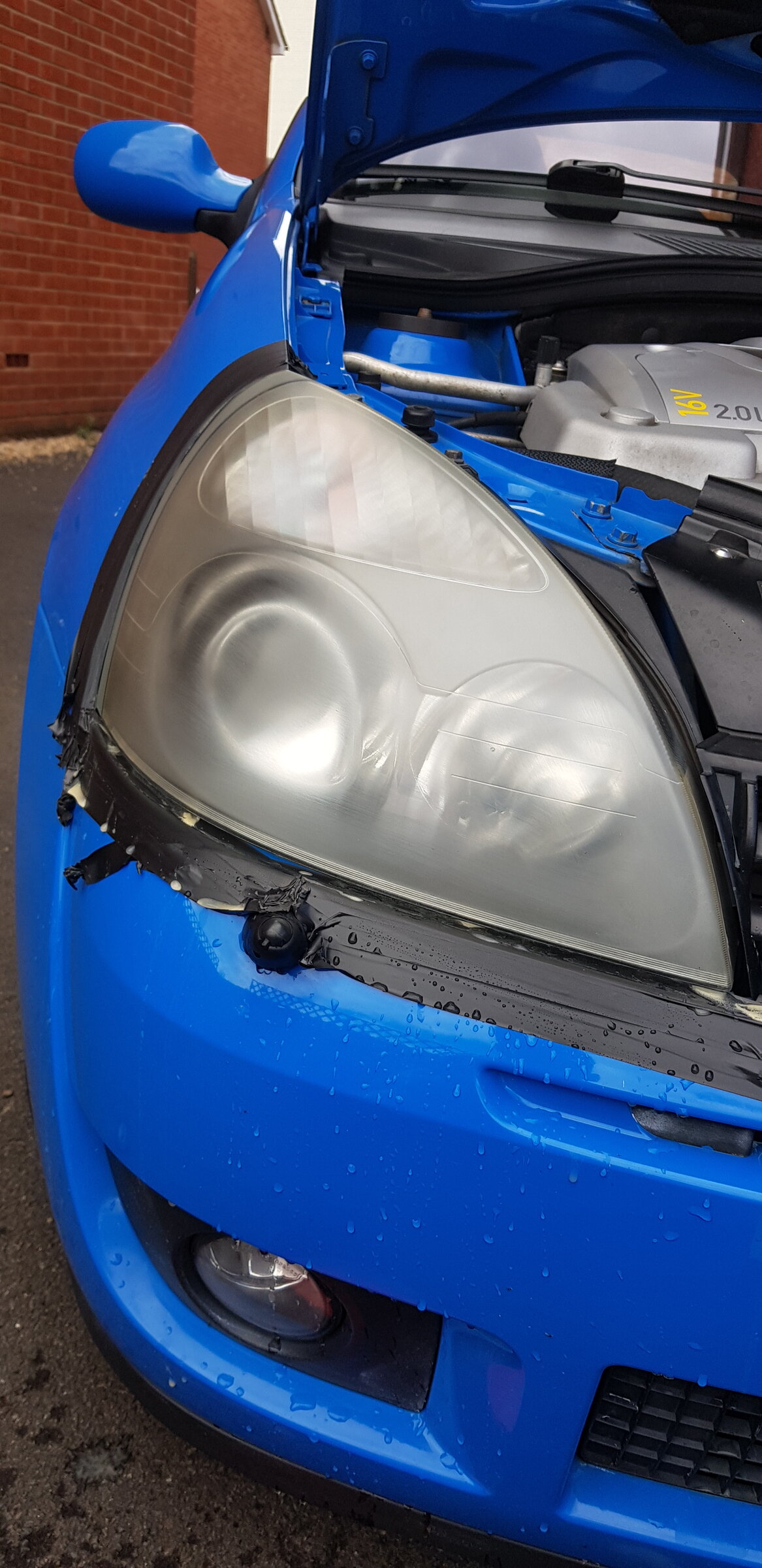

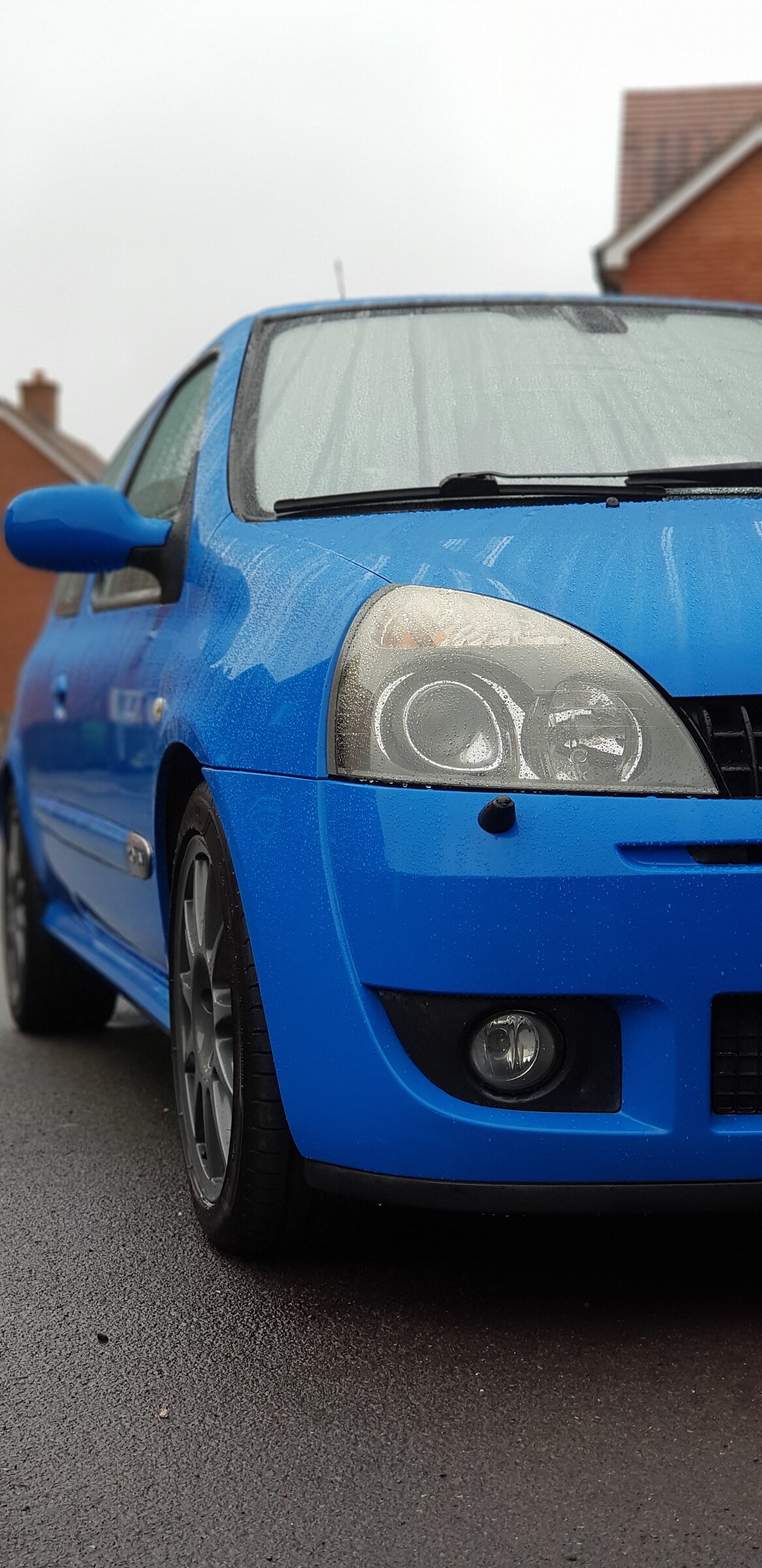

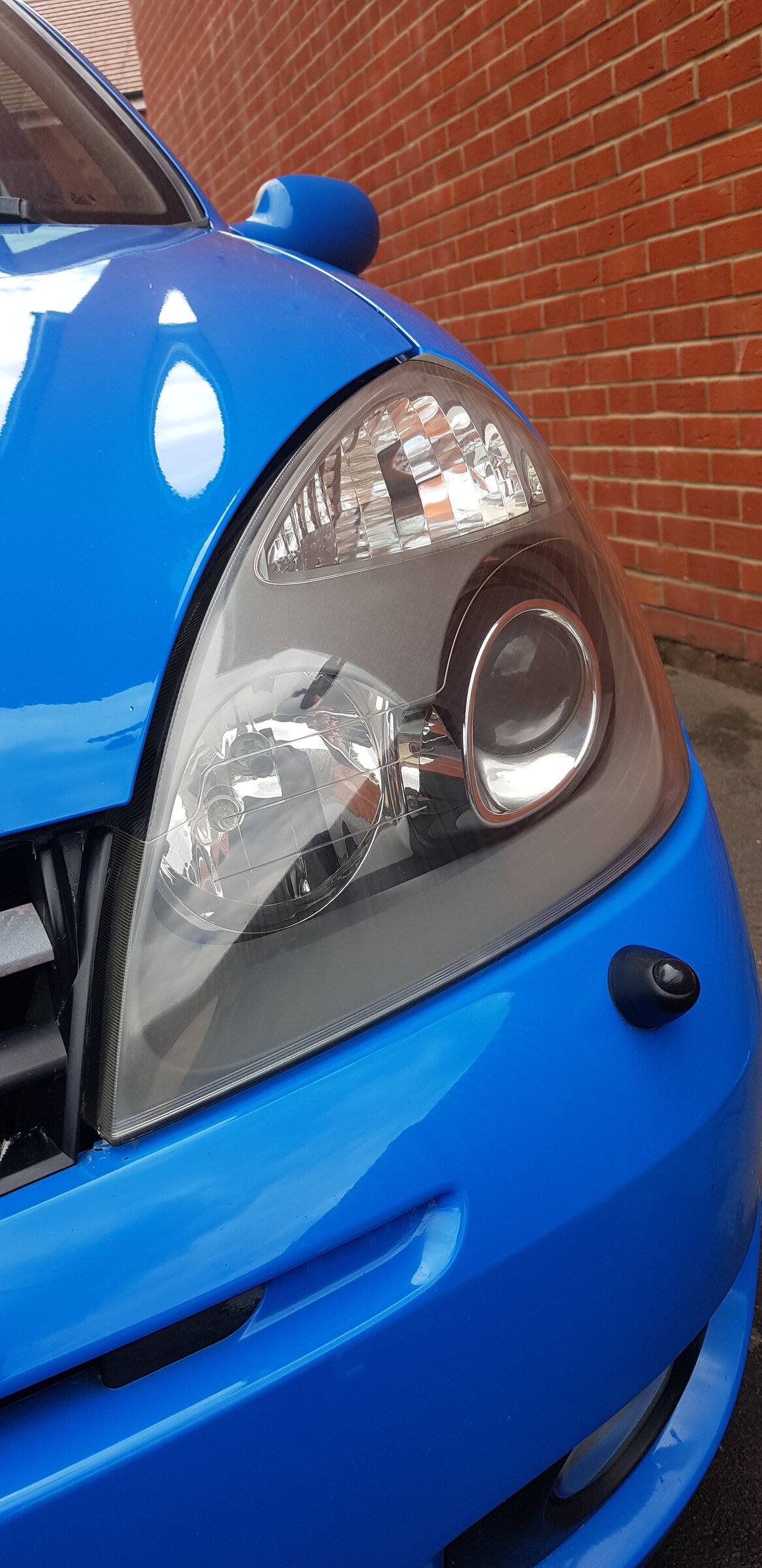

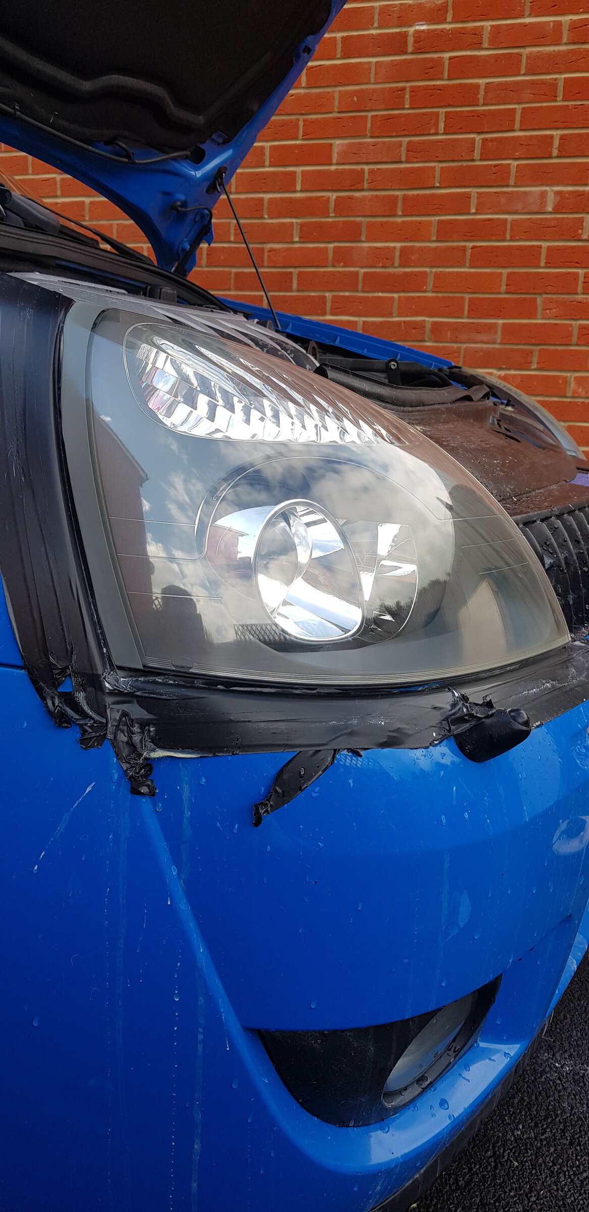

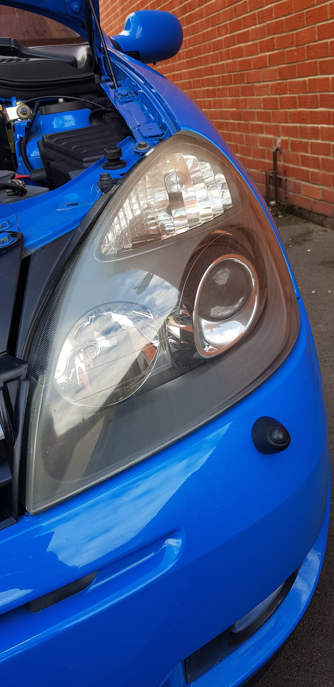

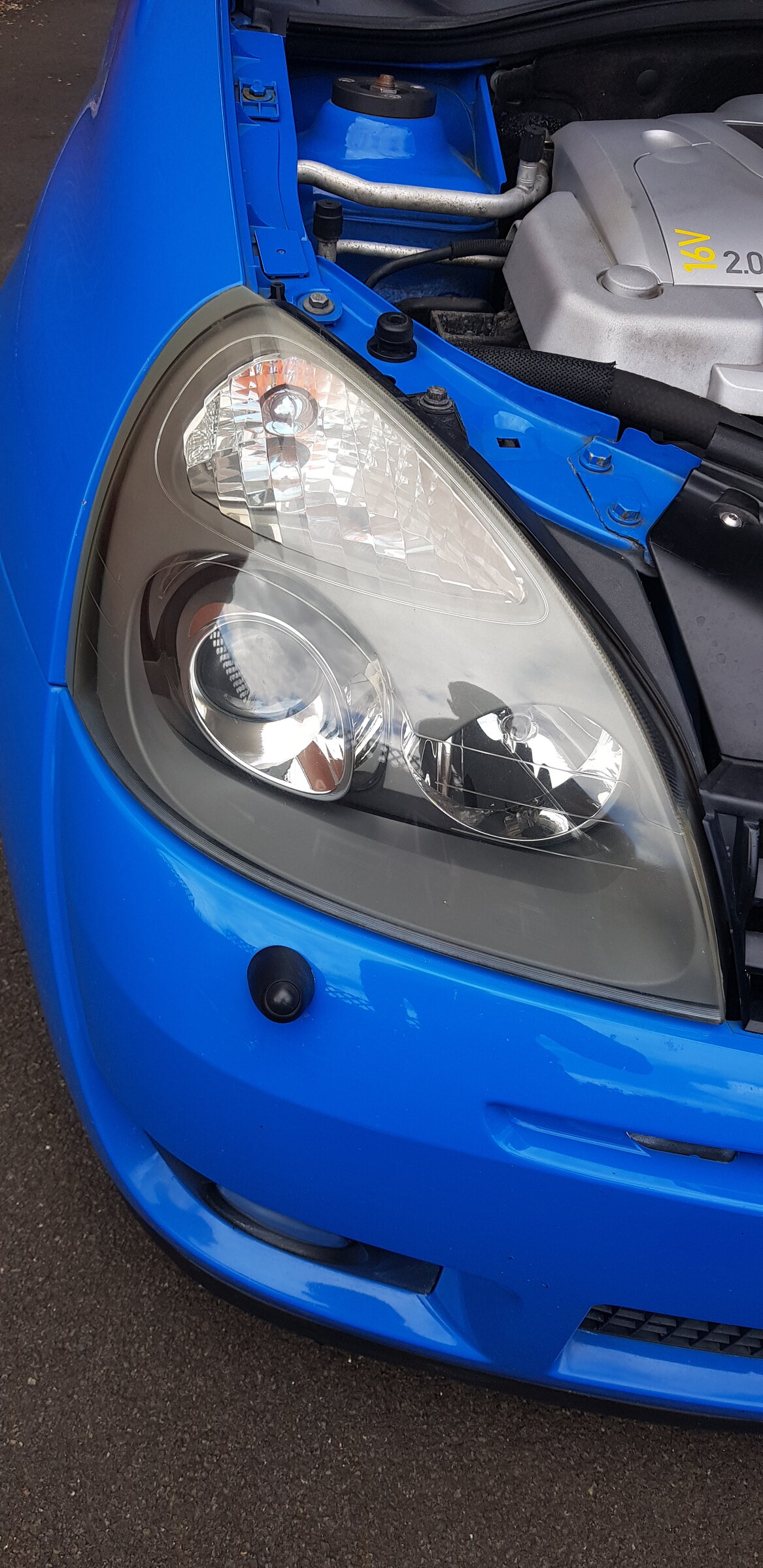

Finally I refurbished the front headlights, they were not too bad to begin with, but its another job done and look much better.
Drivers side before:
Sanding in progress:
And complete:
  E46 M3, Clio 182
... and then onto the passenger side:
Before:
After:
Much much better imo!

Looks great Matt, do you have a link to the aerial please? Funnily enough I bought a 1.2 binnacle earlier myself. Following on from seeing @MrBlonde do the conversion. So will be tacking this job myself shortly
It makes a big difference! See link below for the aerial, as mentioned, I cannot comment on reception with it yet.

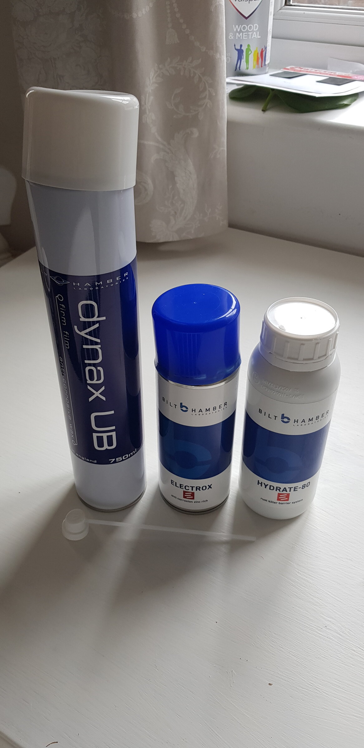

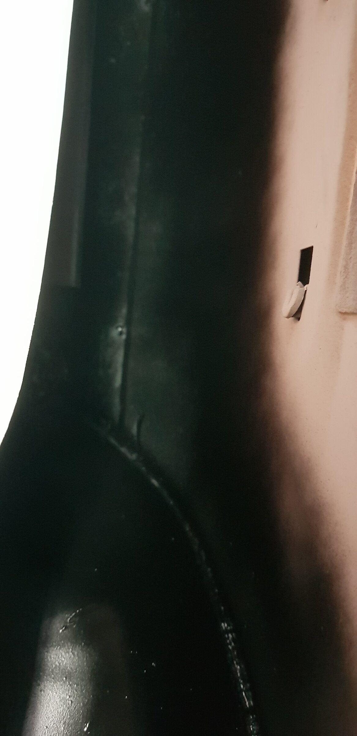

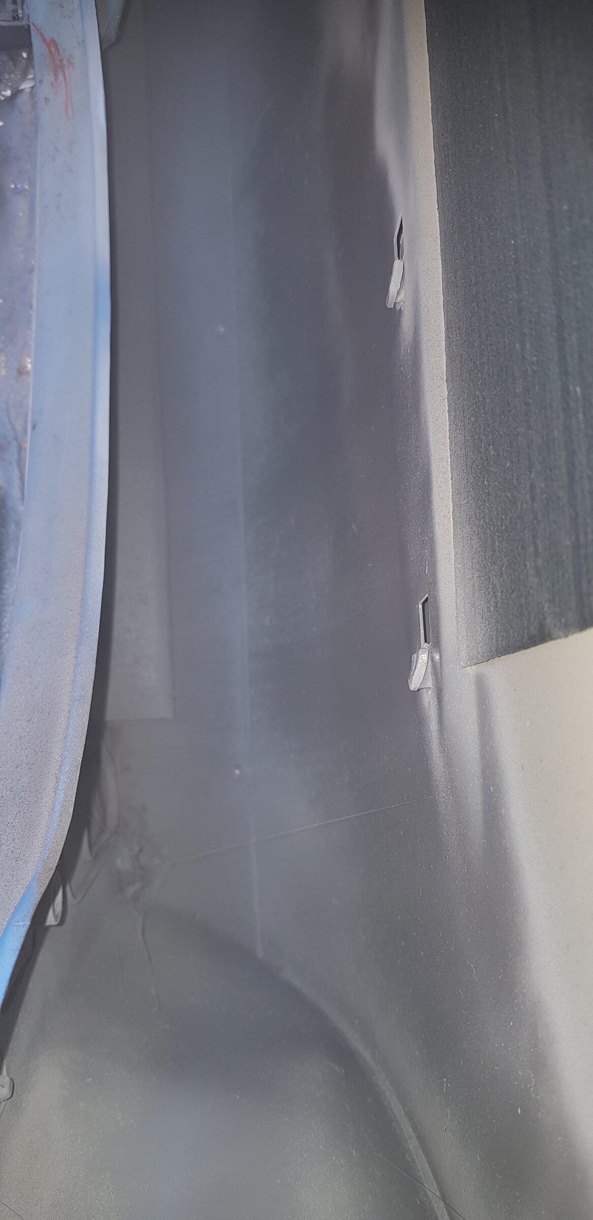

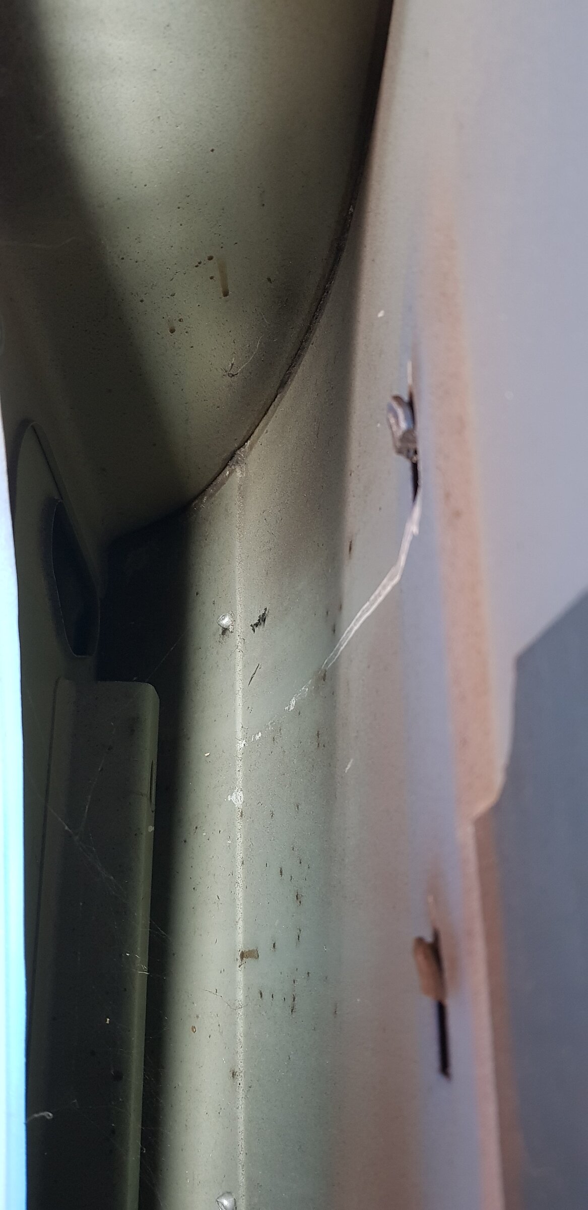

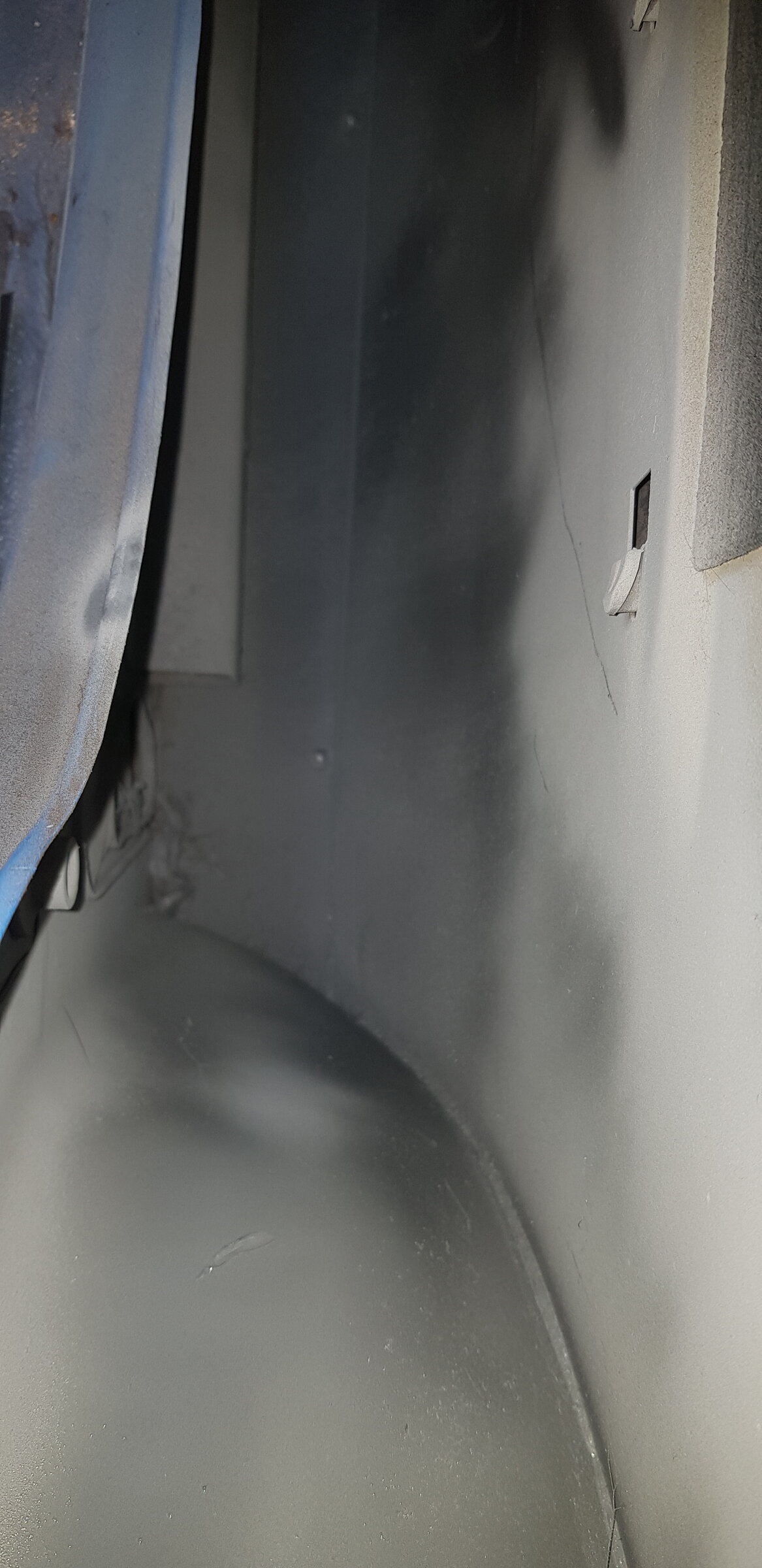

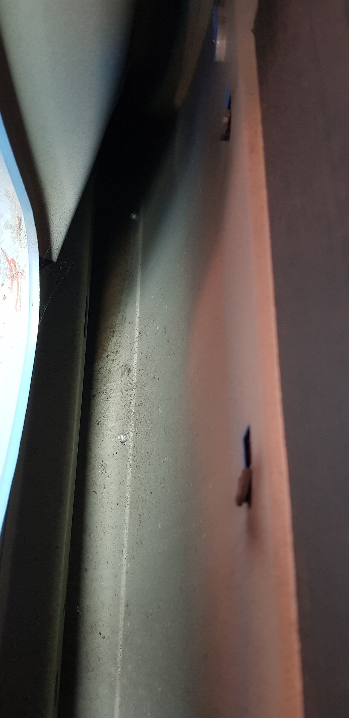

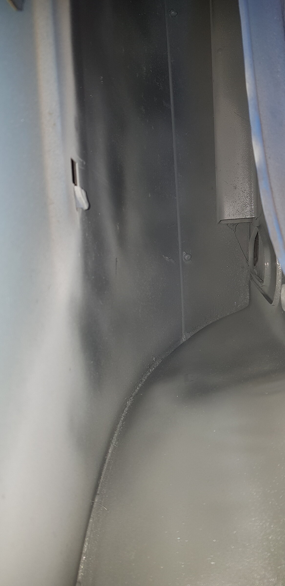

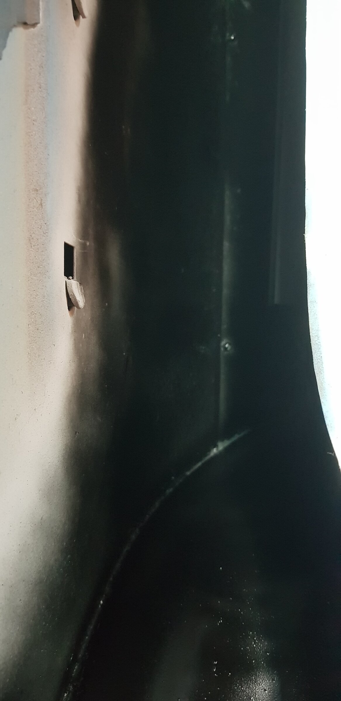

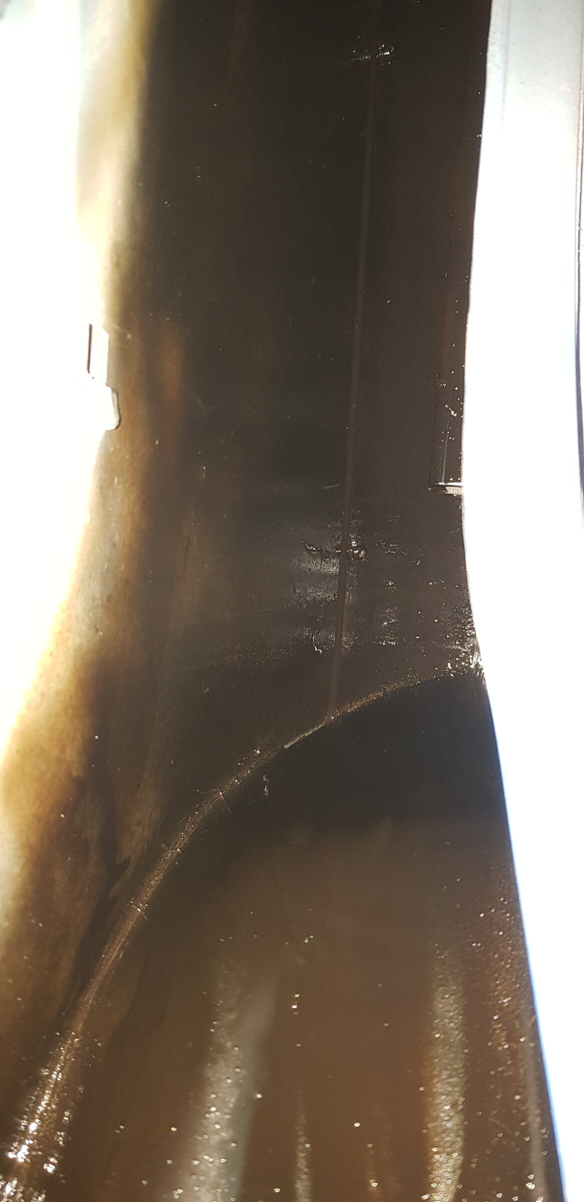

Inner rear arches protected...
After seeing a few people inspecting and finding some rust inside their rear arches, I bought some Bilt Hamber products, and expecting the worst, I tackled the rear arches today. My products consisted of:
Hydrate 80 - rust remover
Electrox- Anti rust primer
Satin black spray
Dynax UB - Anti corrosion wax.
As mentioned, I was expecting the worst, so was pleasantly surprised to reveal no rust when removing the door cards (I apologise in advance for the poor photos, its difficult to get in there and grab a good photo!)
Because their was no rust there, I didnt bother with the Hydrate 80, I went straight onto the Electrox primer, 2 coats was enough to get a decent coverage.
I then moved onto the Satin black spray, again, I found 2 coats enough.
And finally, the Dynax UB wax. I ended up giving 3 thick coats. I found the long nozzle useful to get right down In the arch. I also went up over the back seam as precaution.
Hopefully that will seal the rear arches for years to come without having to worry about rot!

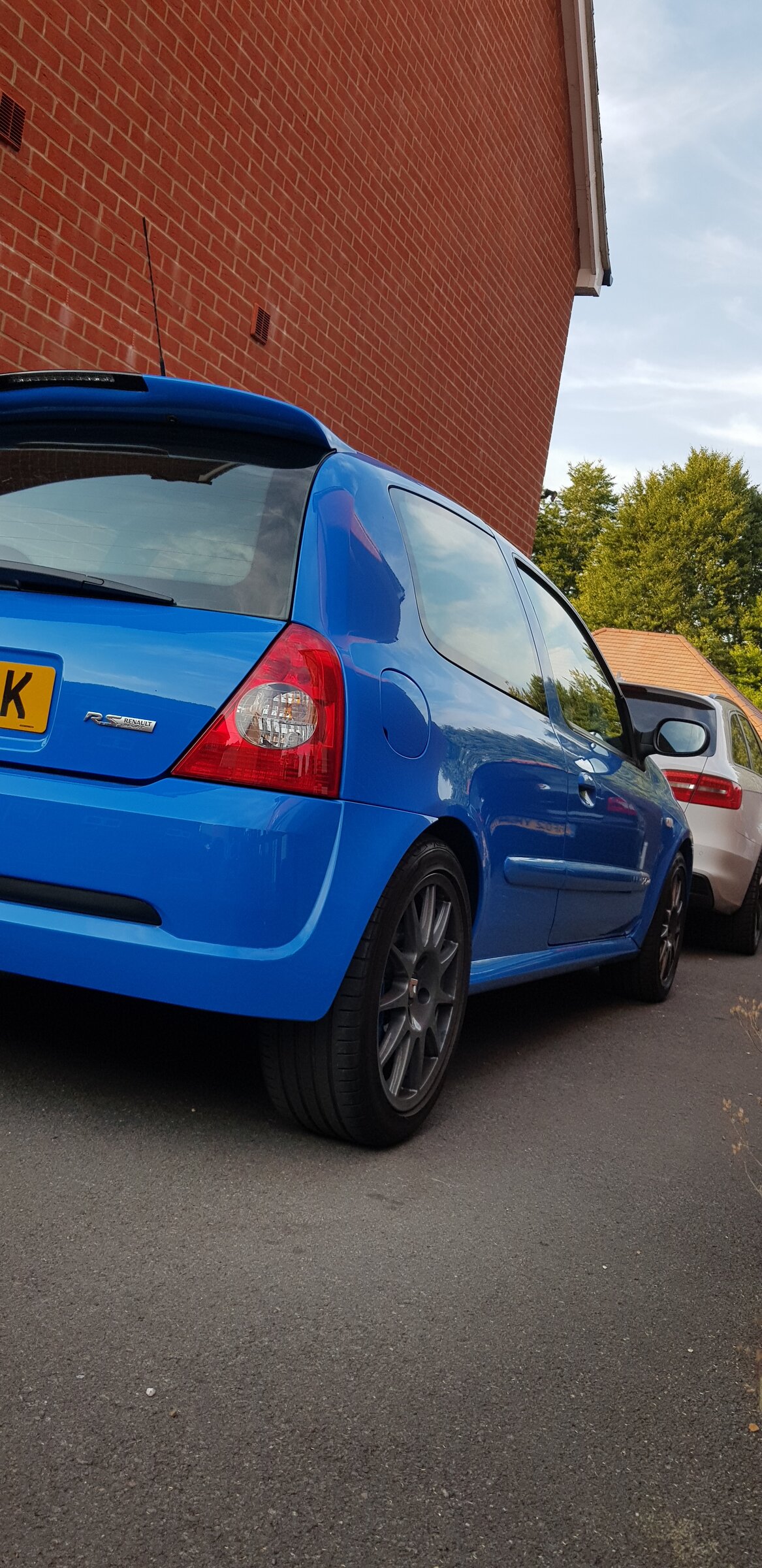

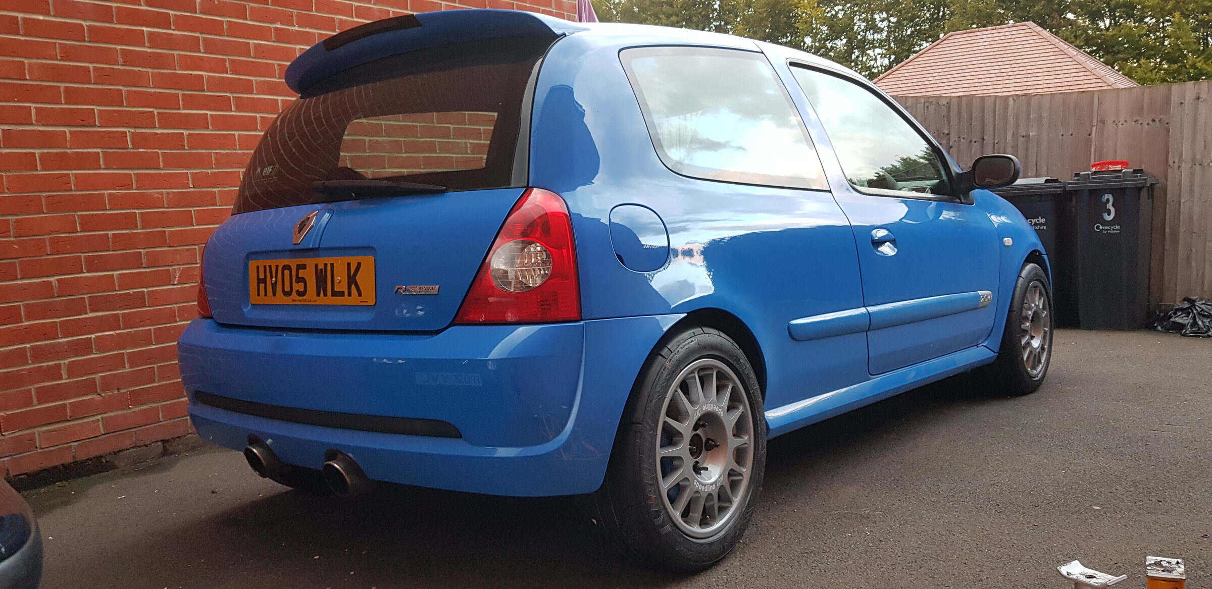

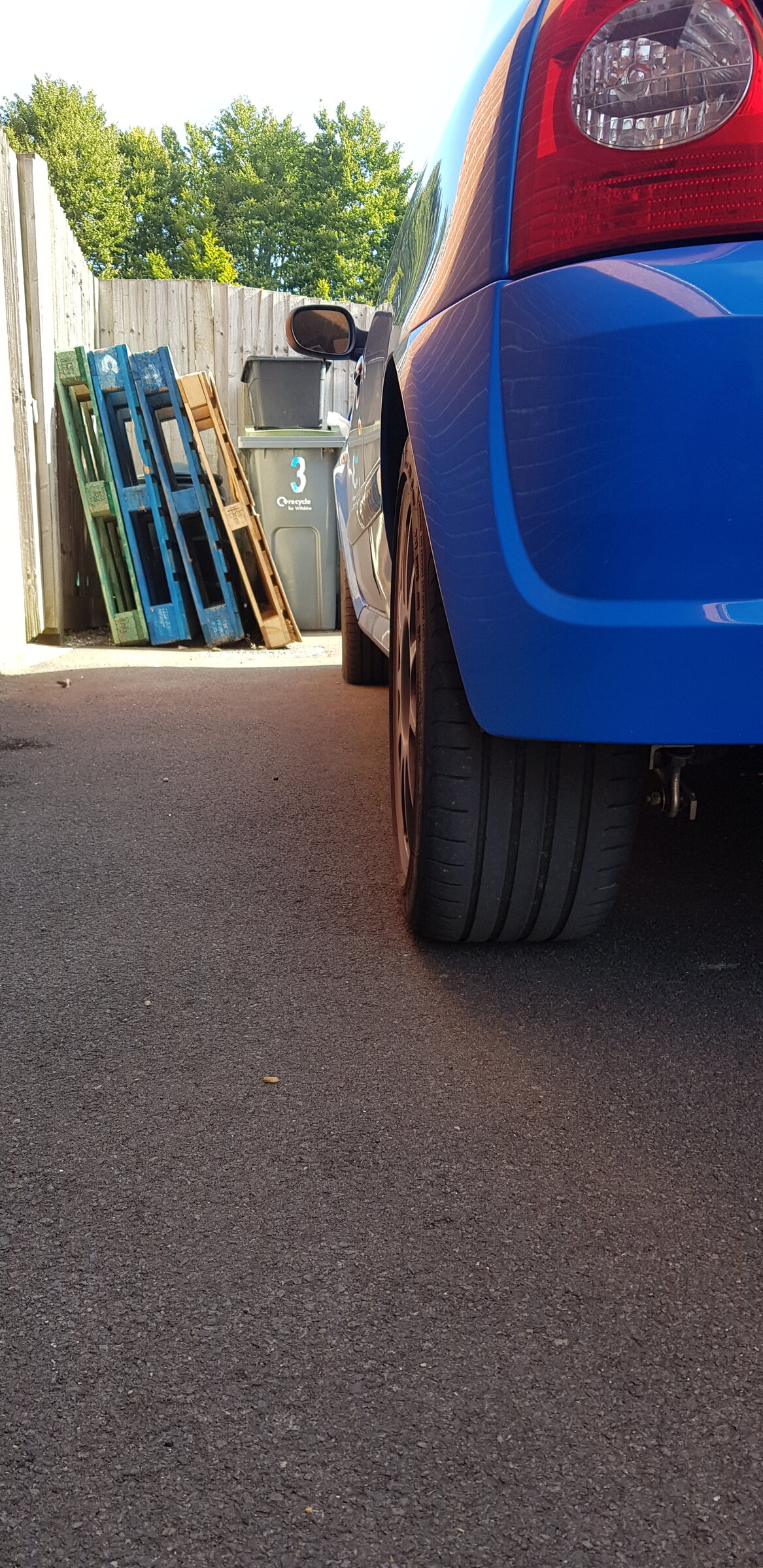

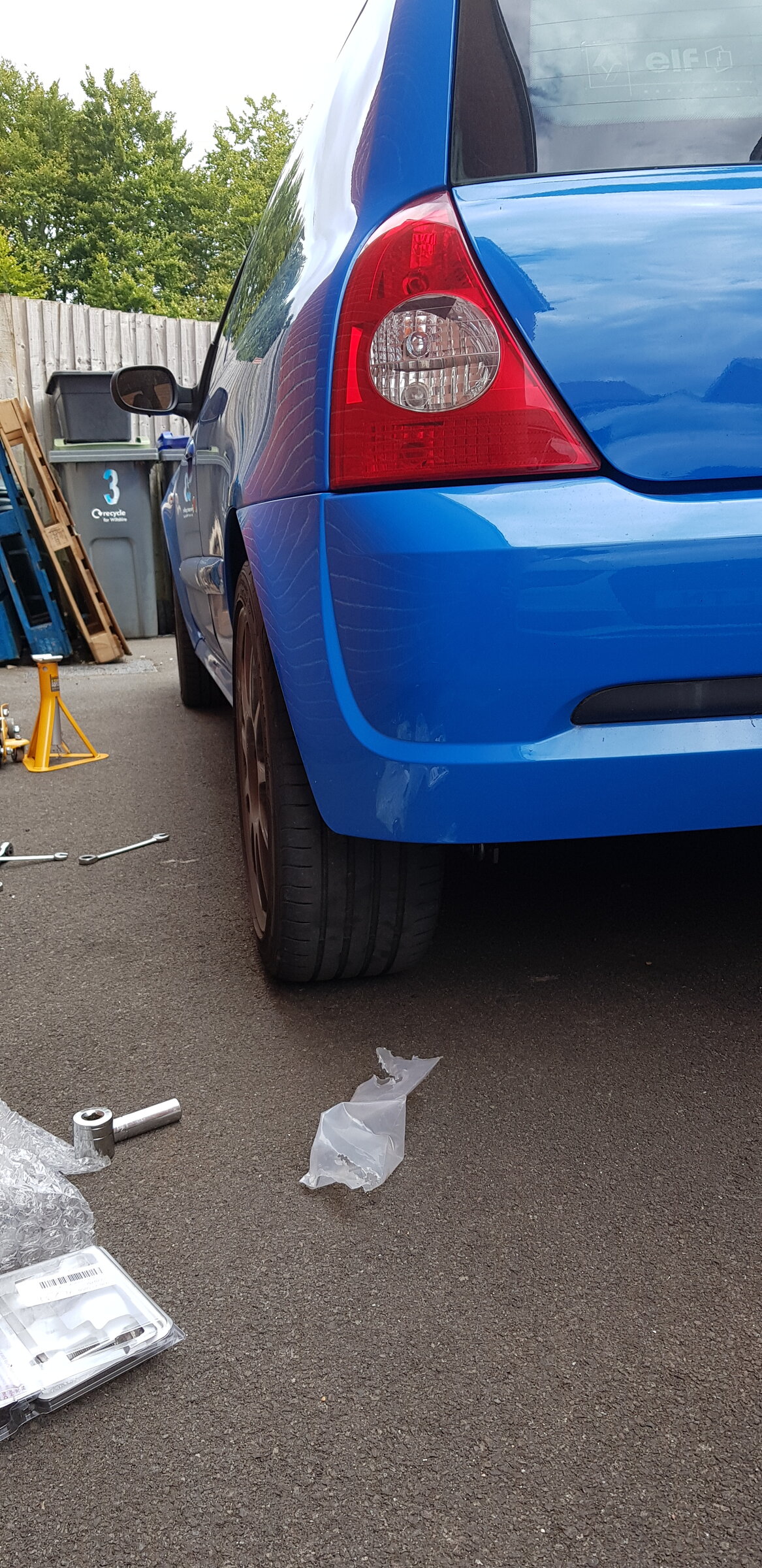

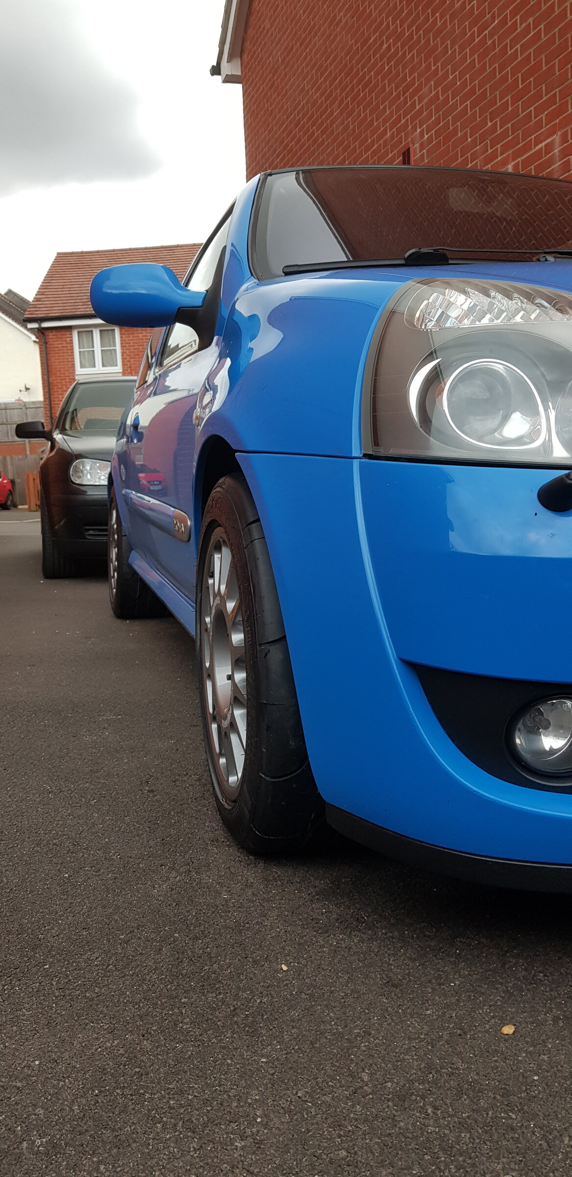

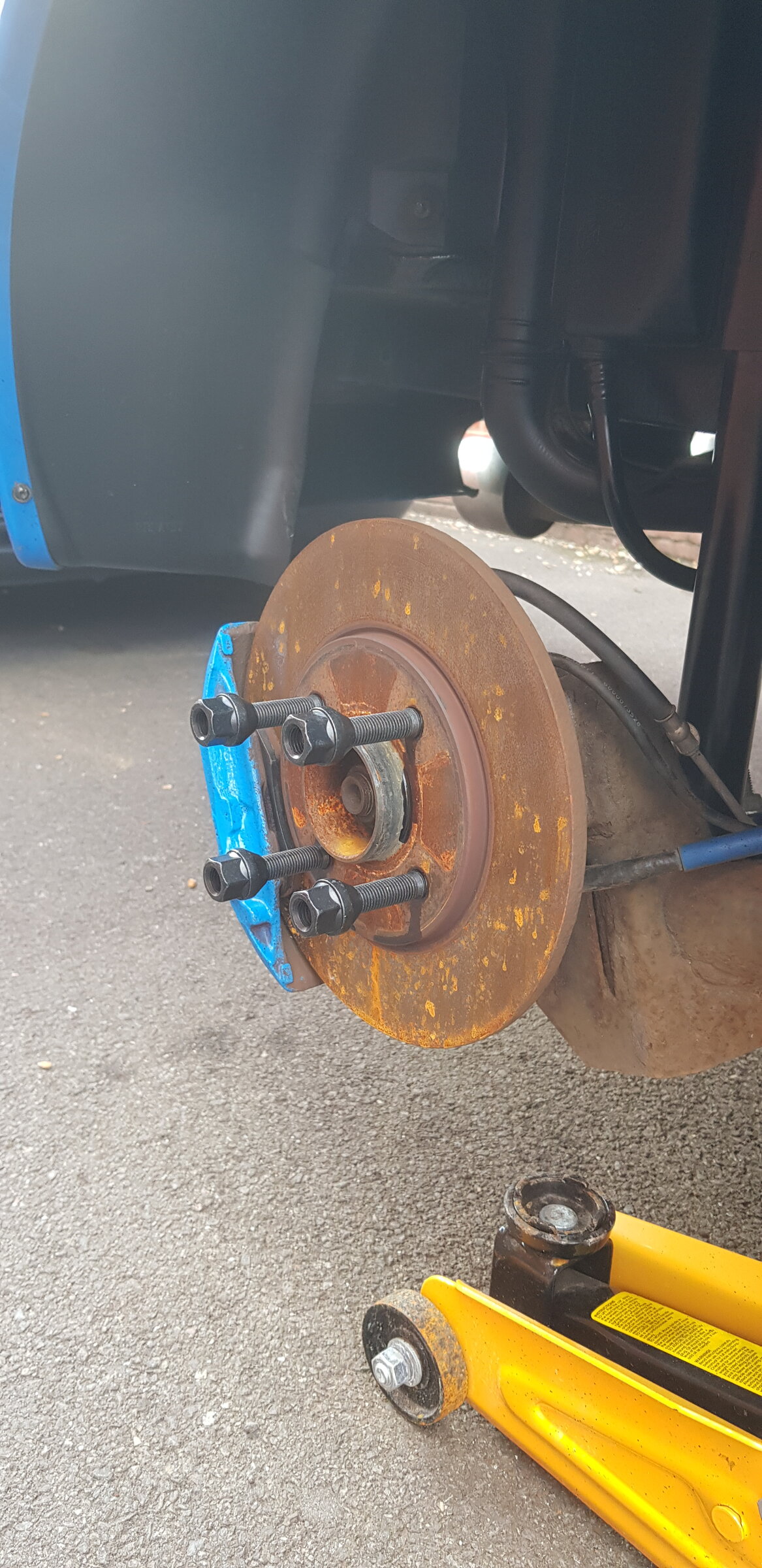

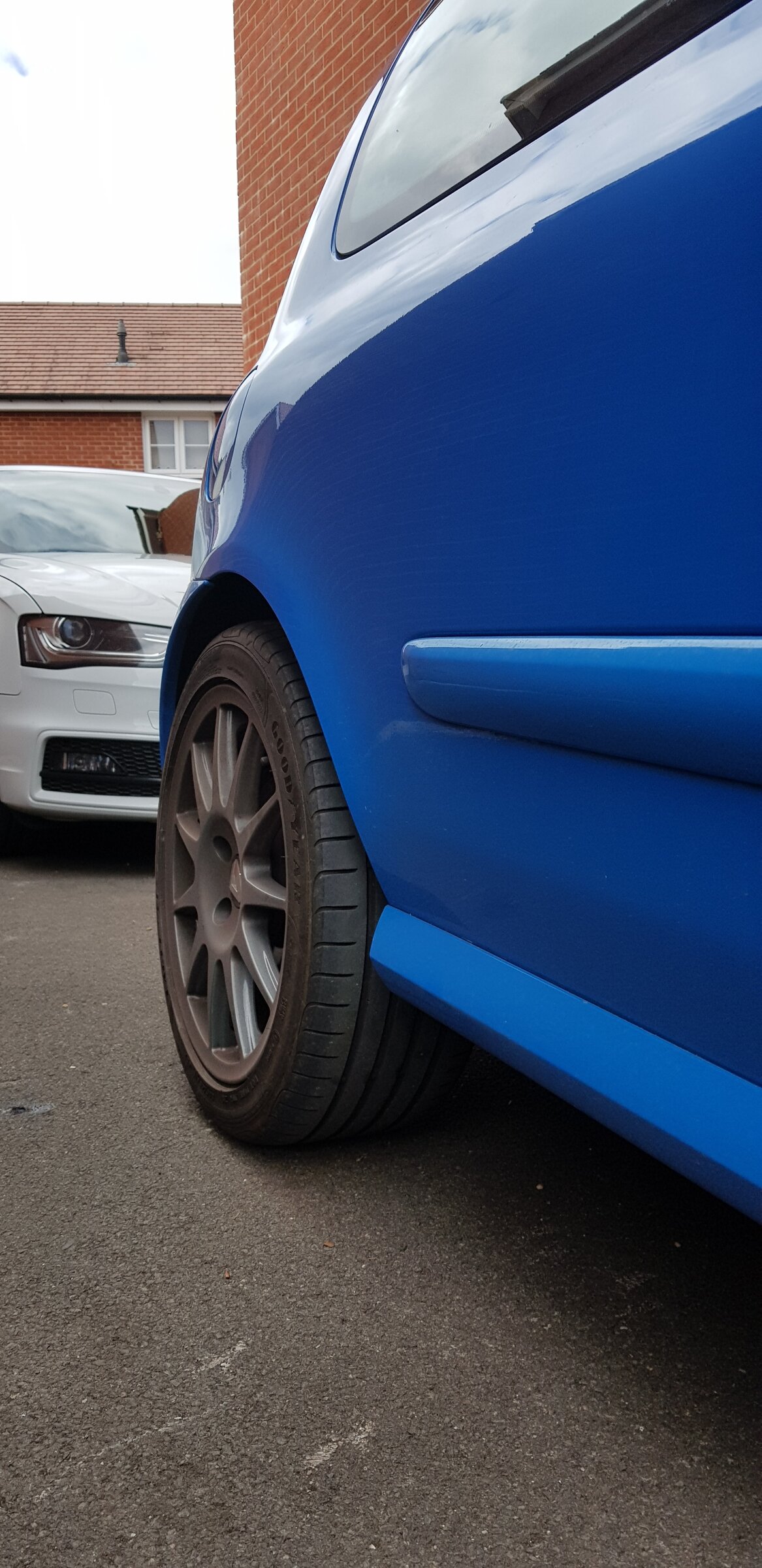

Managed to fit the rear axle spacers today, 10mm either side, was fairly straight forward and looks much better.
I've got some 18mm PMS fronts, but they are for some 2118s when I get some, they're too large for the turinis.
Before:
After:
And the other side done..

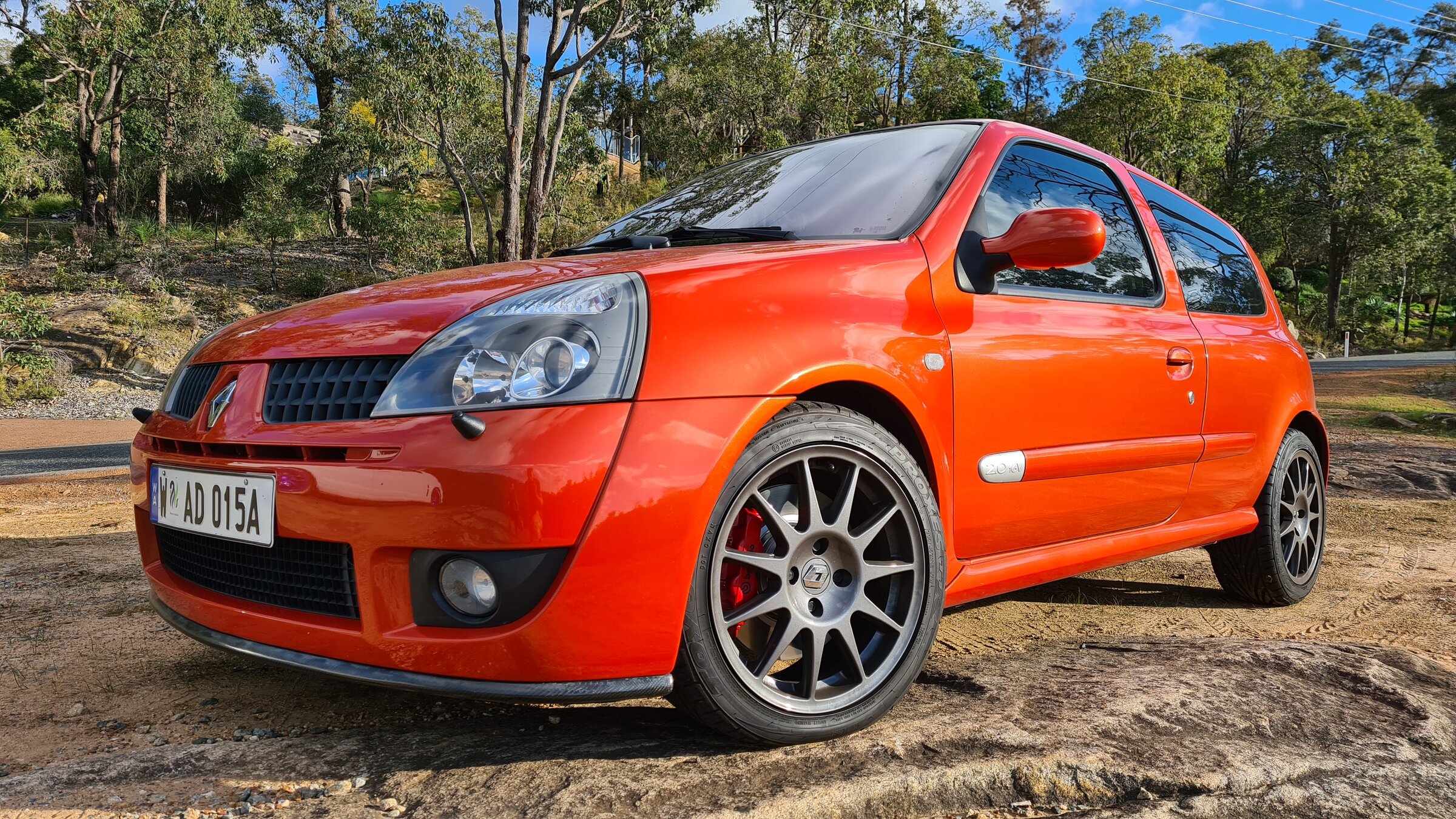

I've got 18mm PMS spacers on mine, using ET45 Trophy Turini's.
It probably sits between 1mm-3mm within the wheel arch measured from the very top. Looks very purposful. (my car also has the 10mm PMS rear stub axle spacers)
I have experieced scrubbing at the front on both sides, but thats probably down to my car still using its original stock 104,000kms (~64,600miles) suspension components.
I'm currently playing my cards to possibly buy new OE shocks with proline springs. Not sure yet.

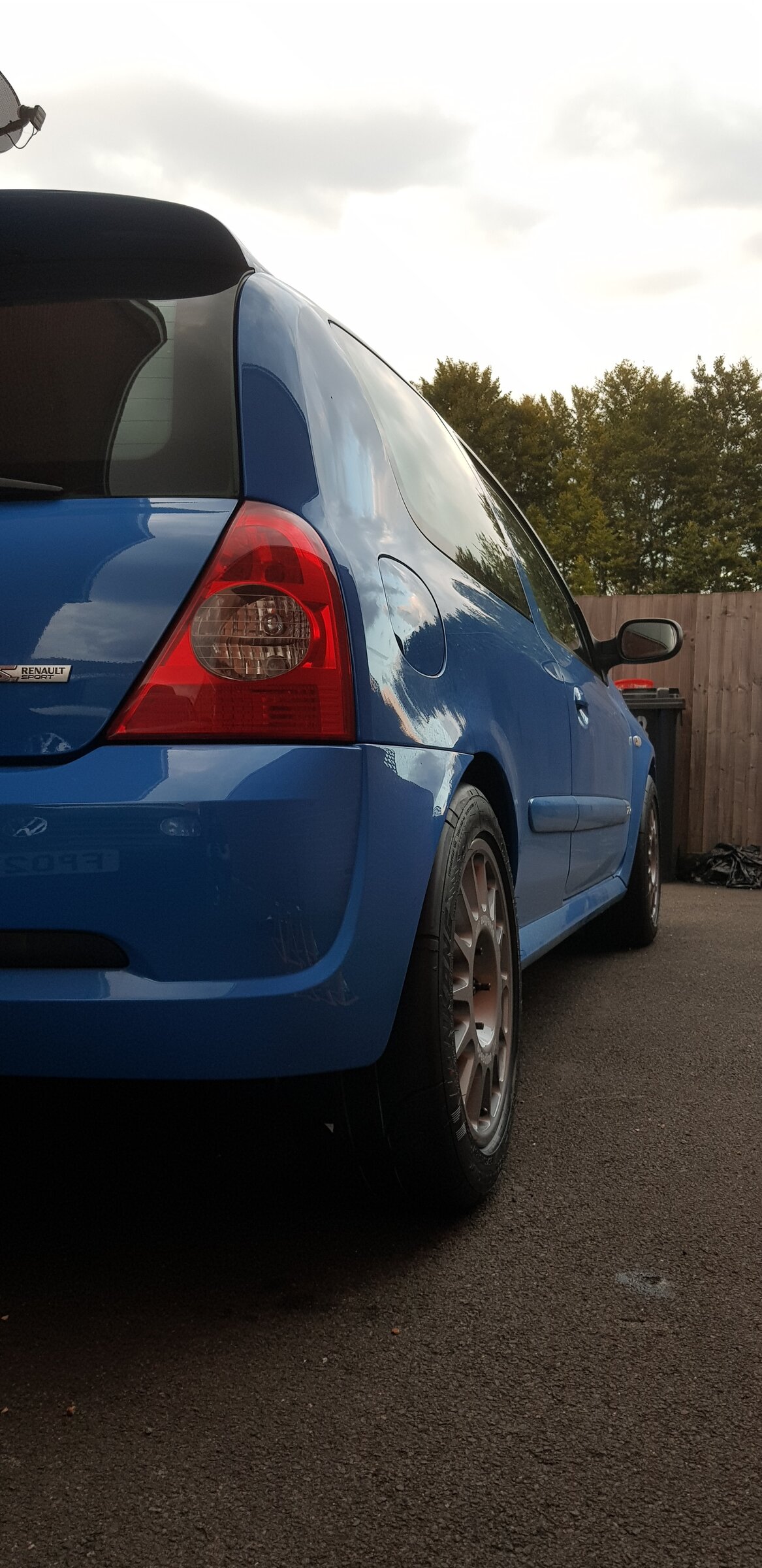

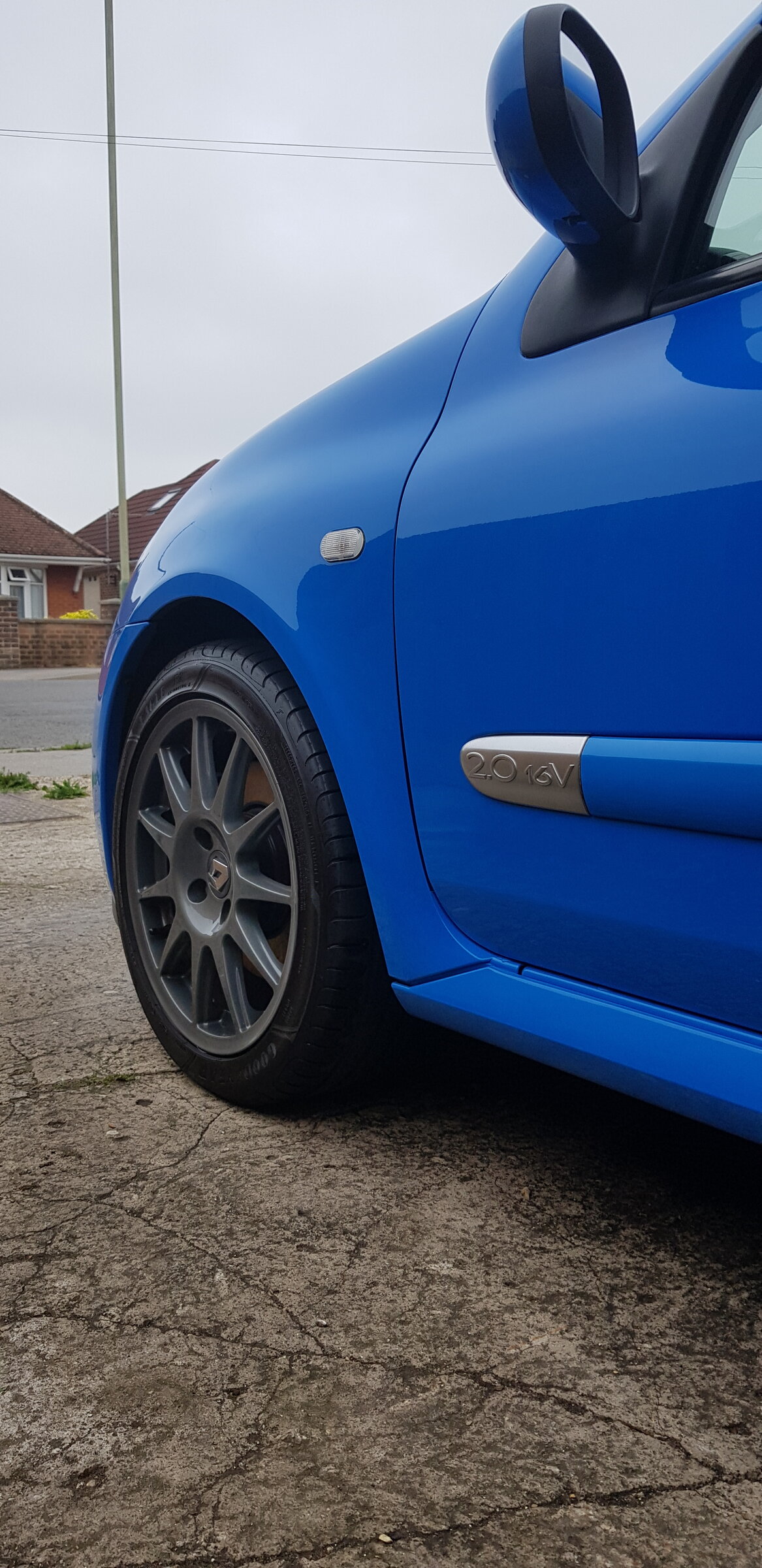

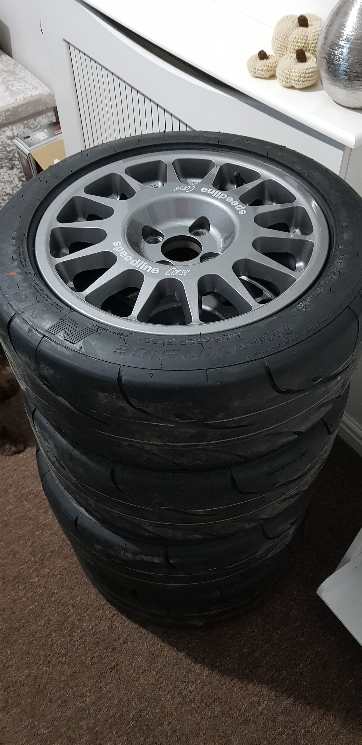

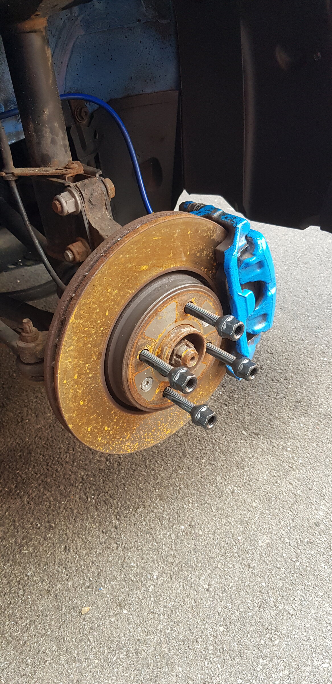

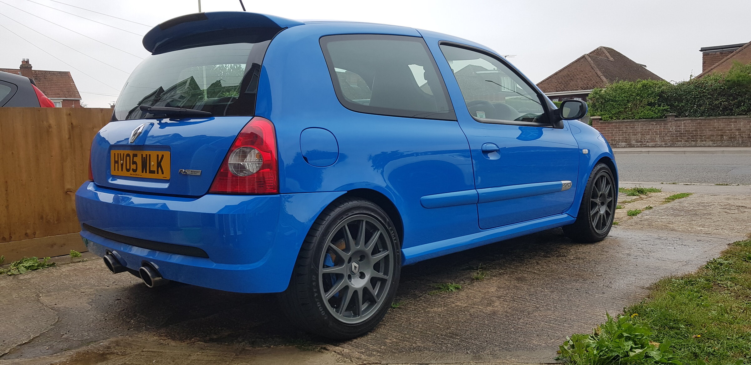

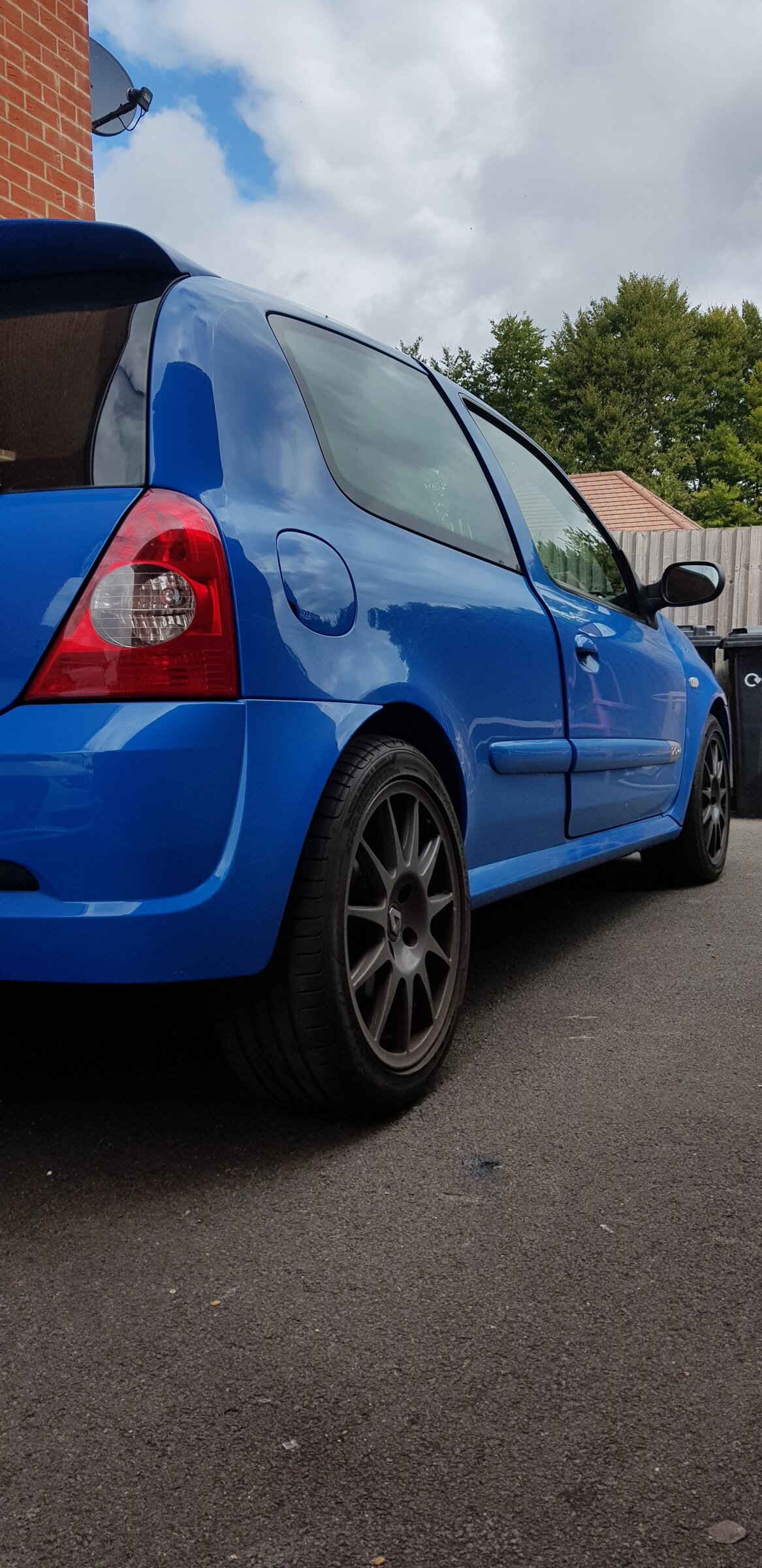

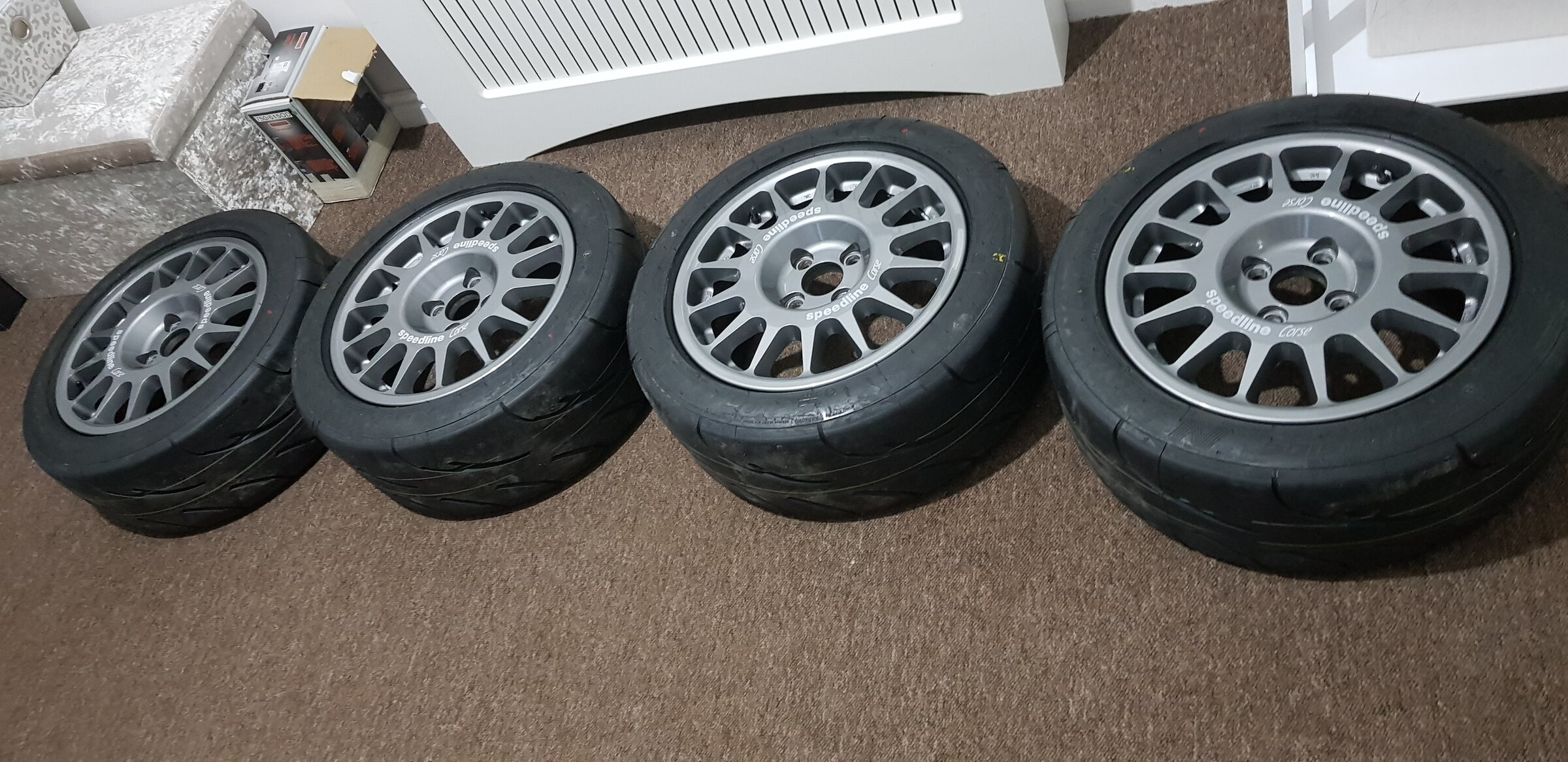

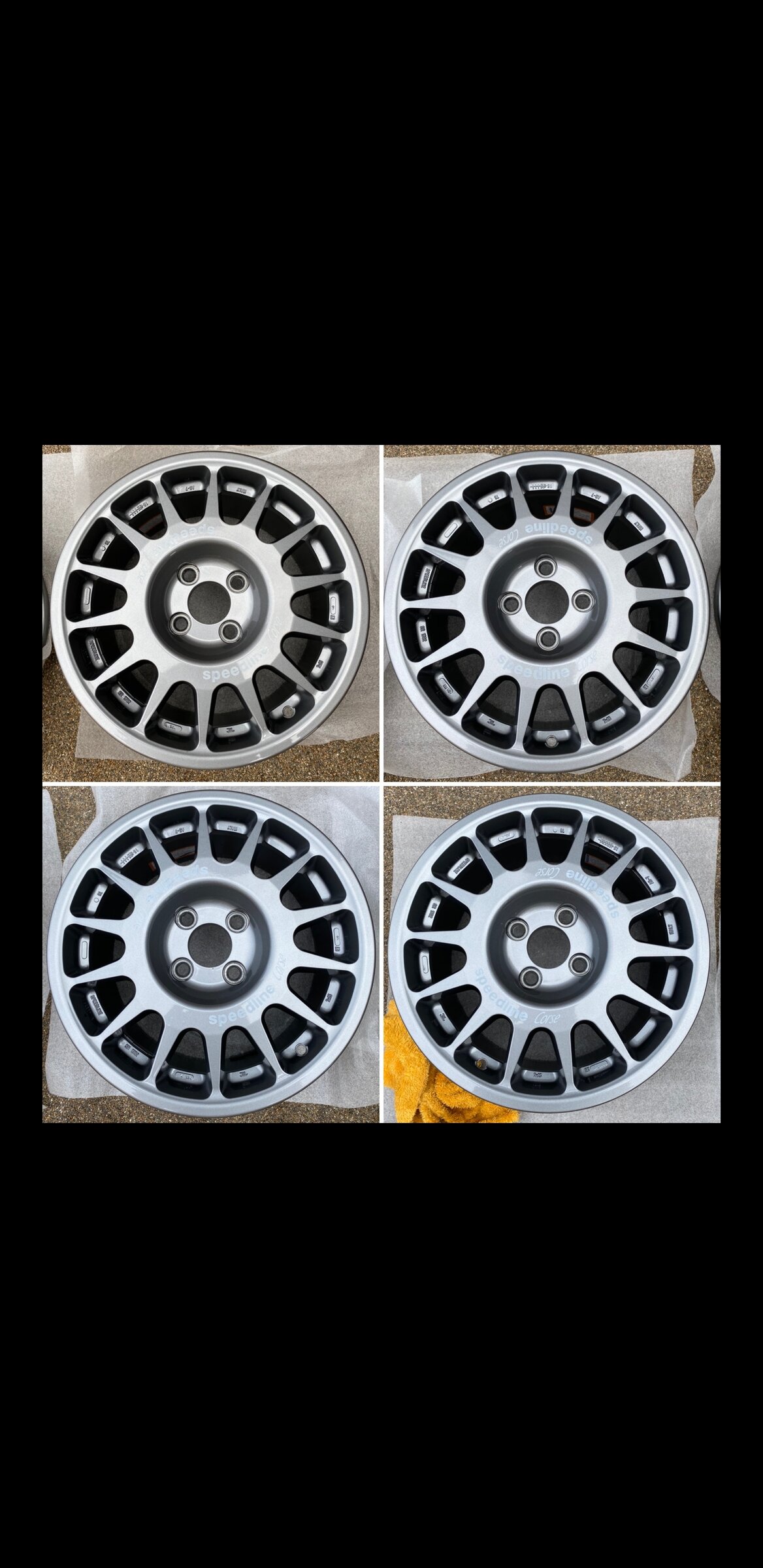

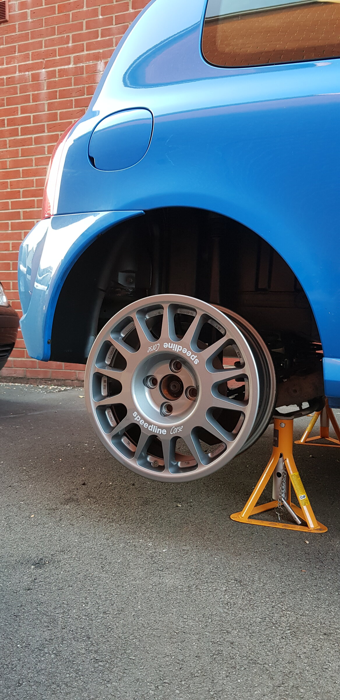

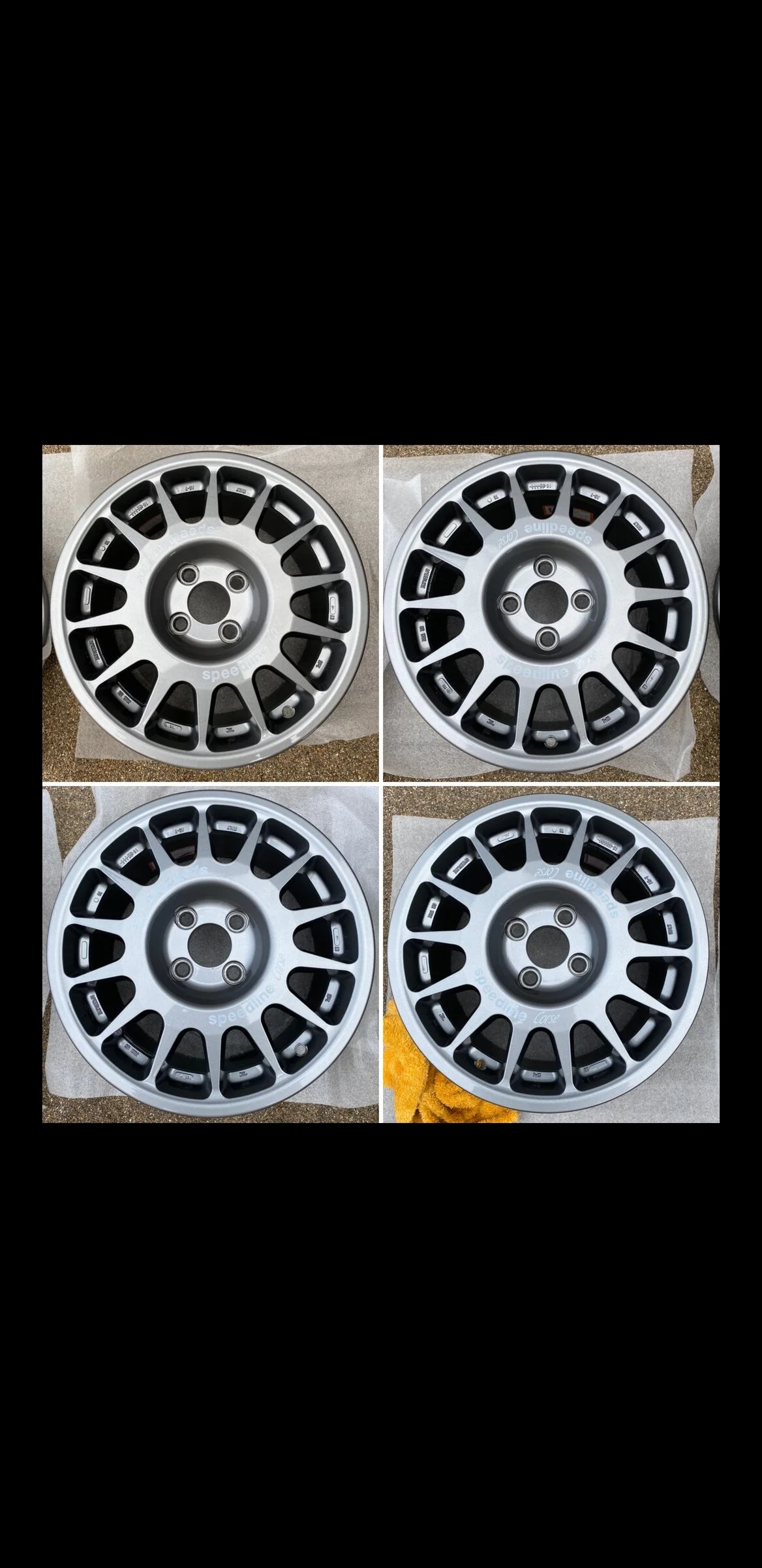

So the turinis have gone and replaced with 2118s, which I managed to source from @frayz (sorry for the picture pinching)
Test fitted to the car:

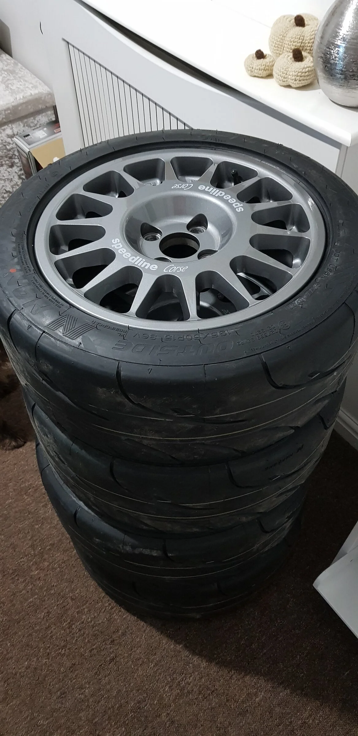

I was unsure on what tyre, but finally settled with AR1s.
Tyres fitted and wheels sealed.
While the car was on stands, I also cleaned the arches out and fitted the PMS stud and nut kit (excuse the rusty discs, the car had been sat on the stands for a week or so).

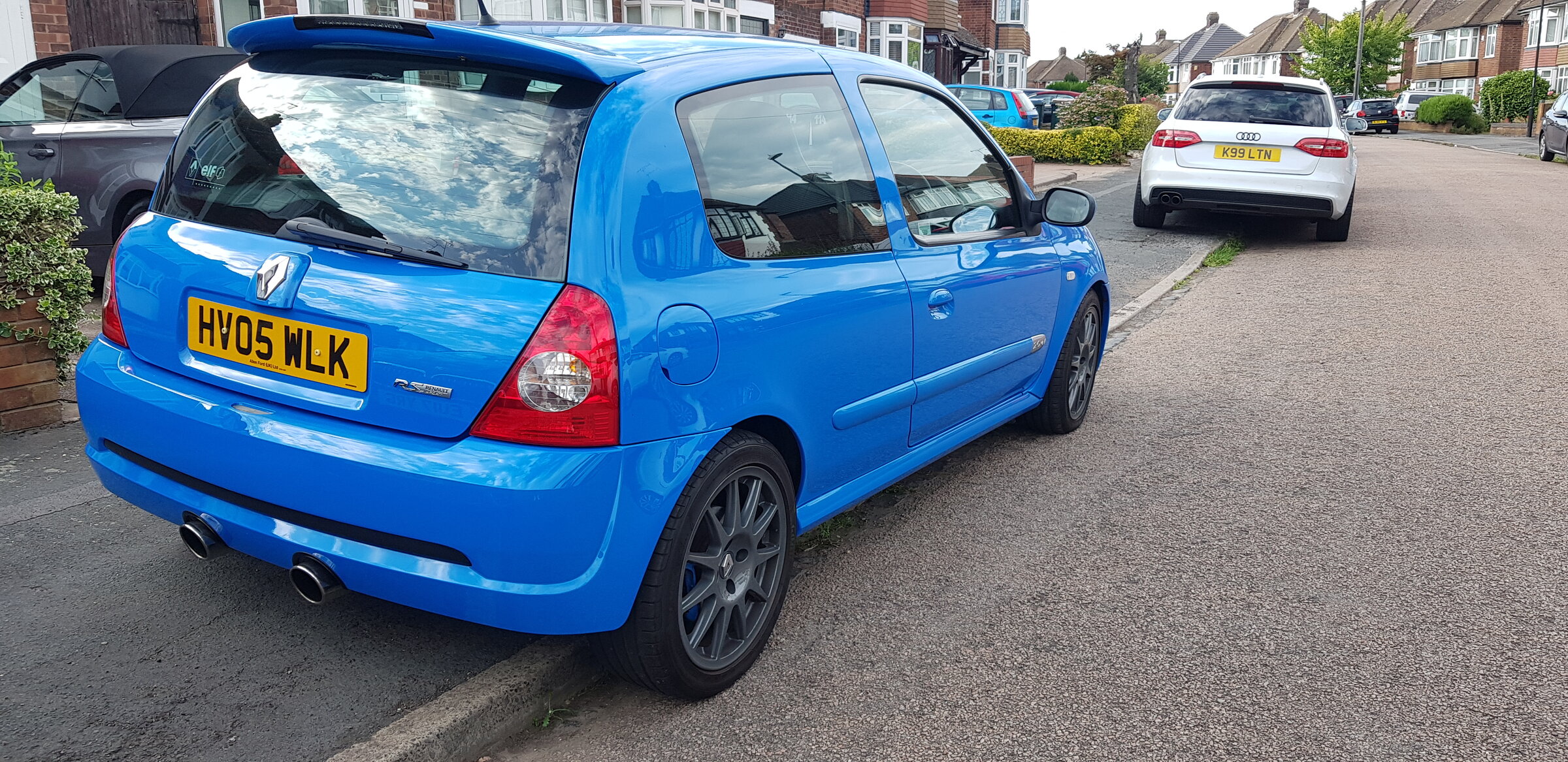

And then lowered down on the new wheels.
I have the 10mm axle spacers and went for 18mm PMS front spacers, the wheels sit really well in the arches and I love the racey look (again, please excuse the dirty car, it's been sat unused and unwashed for a few weeks).

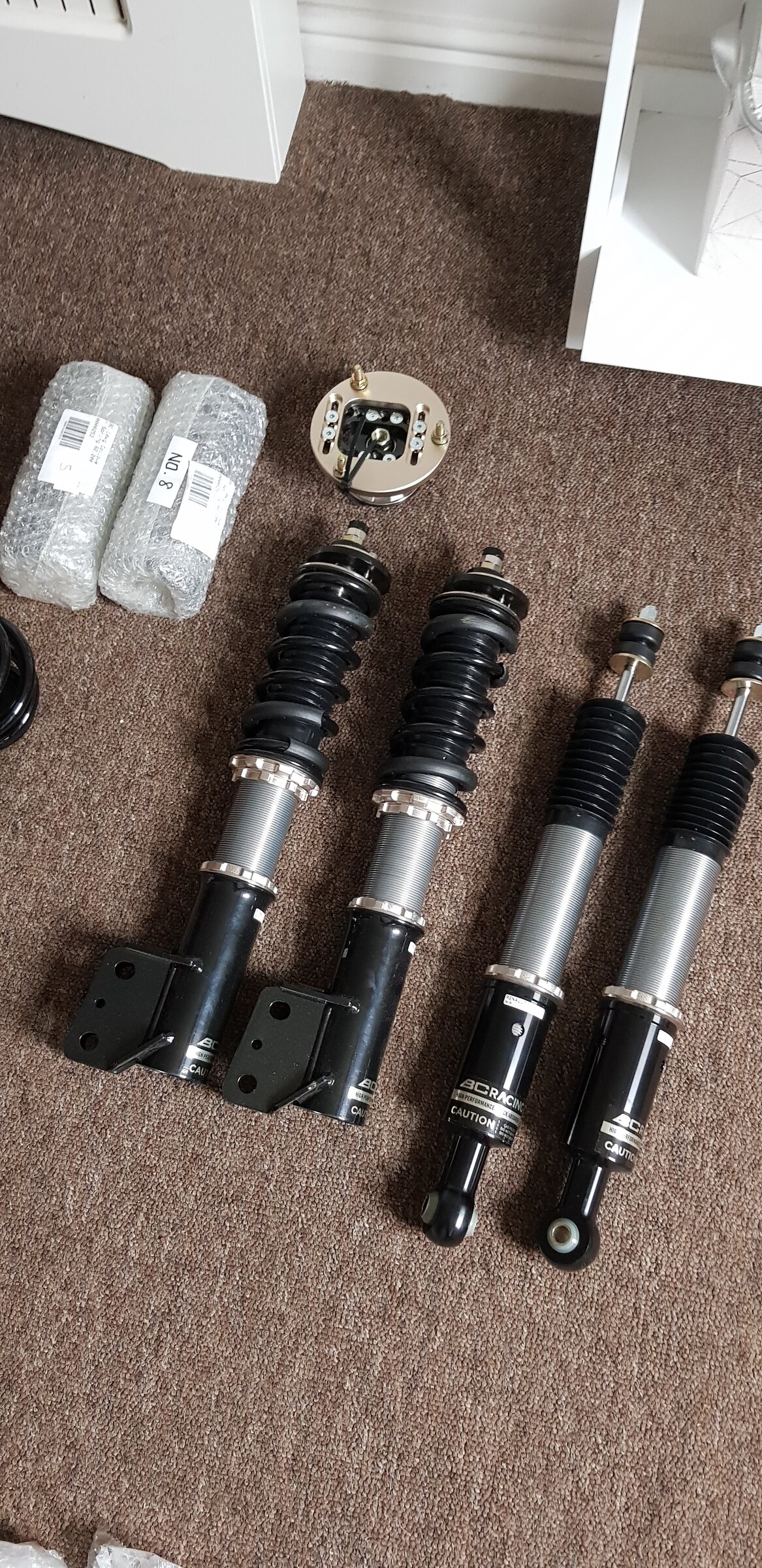

I've also ordered a few parts that turned up during the wheel swap.
Went with BC coilovers, I was really impressed with Ash's when he took me out in his trophy.
Delivered and coated in AFC50

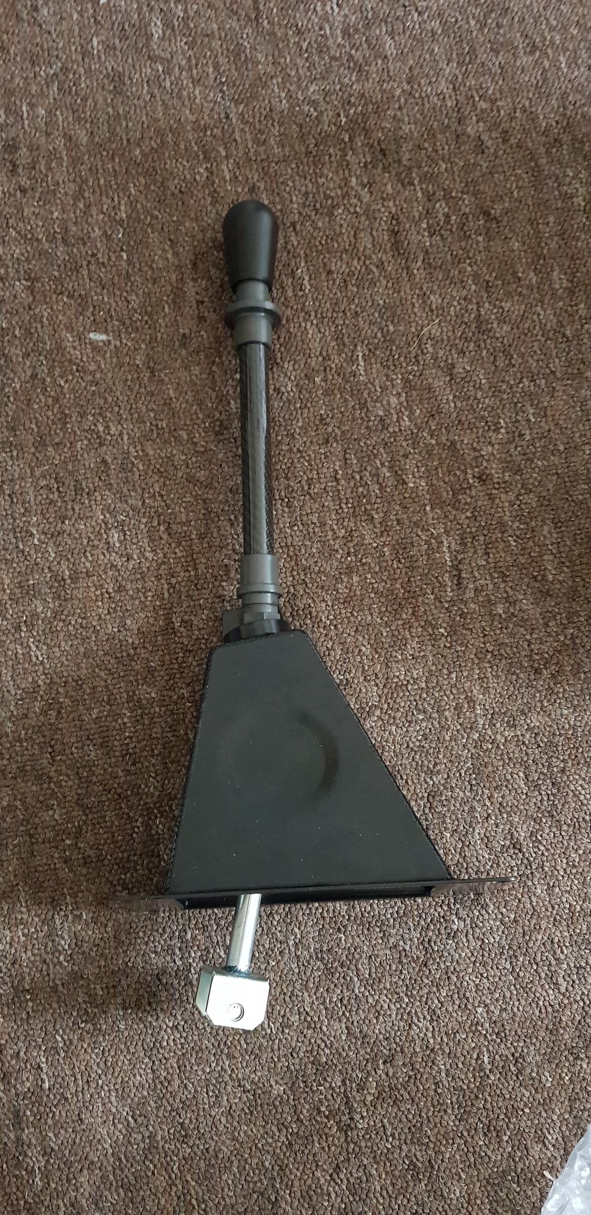

Along with the coilovers, I also ordered a PMS shifter, I've had one in my previous car and it was really enjoyable.
The car is booked in with Alex at AW early November to have the above fitted.

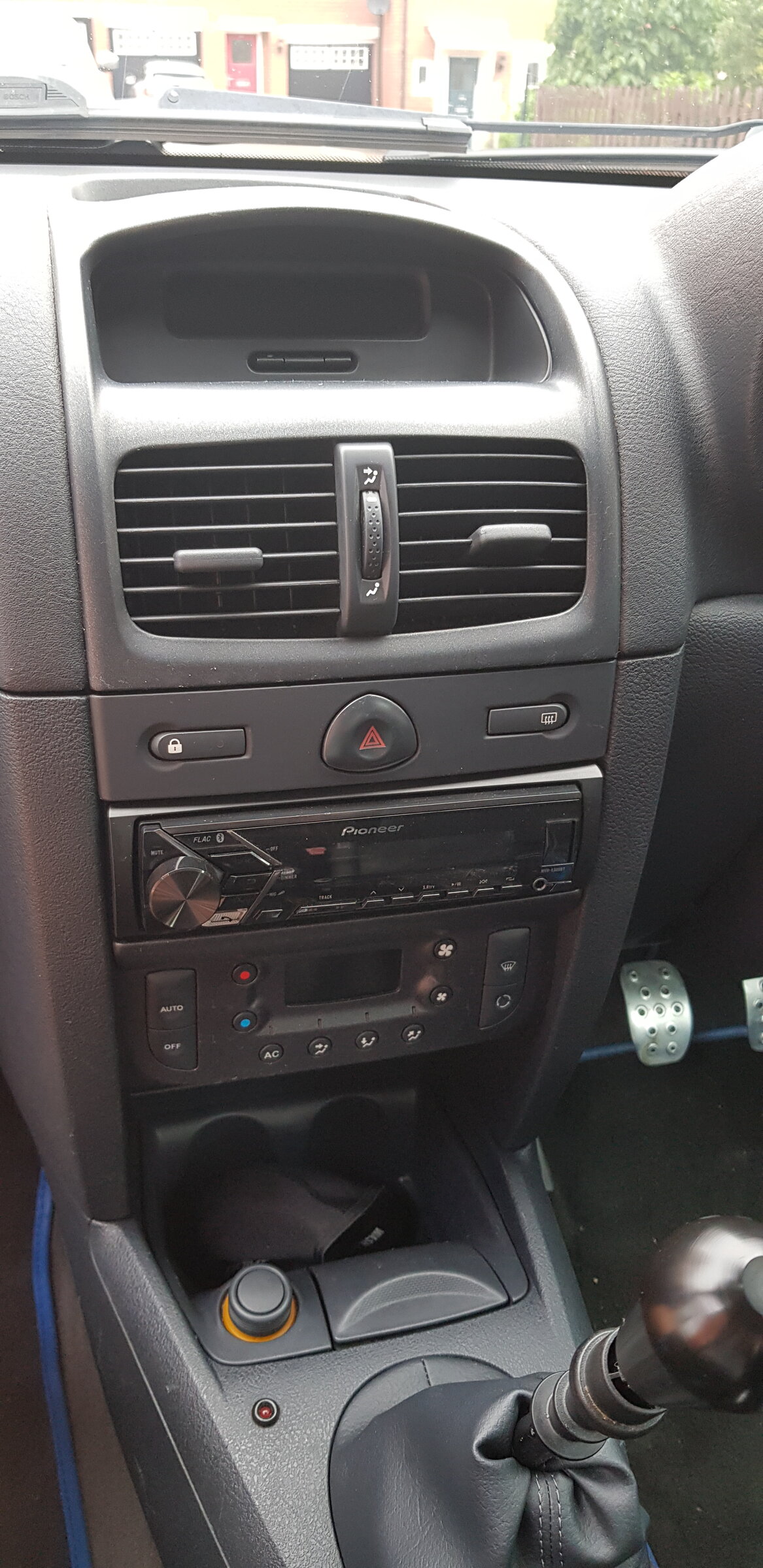

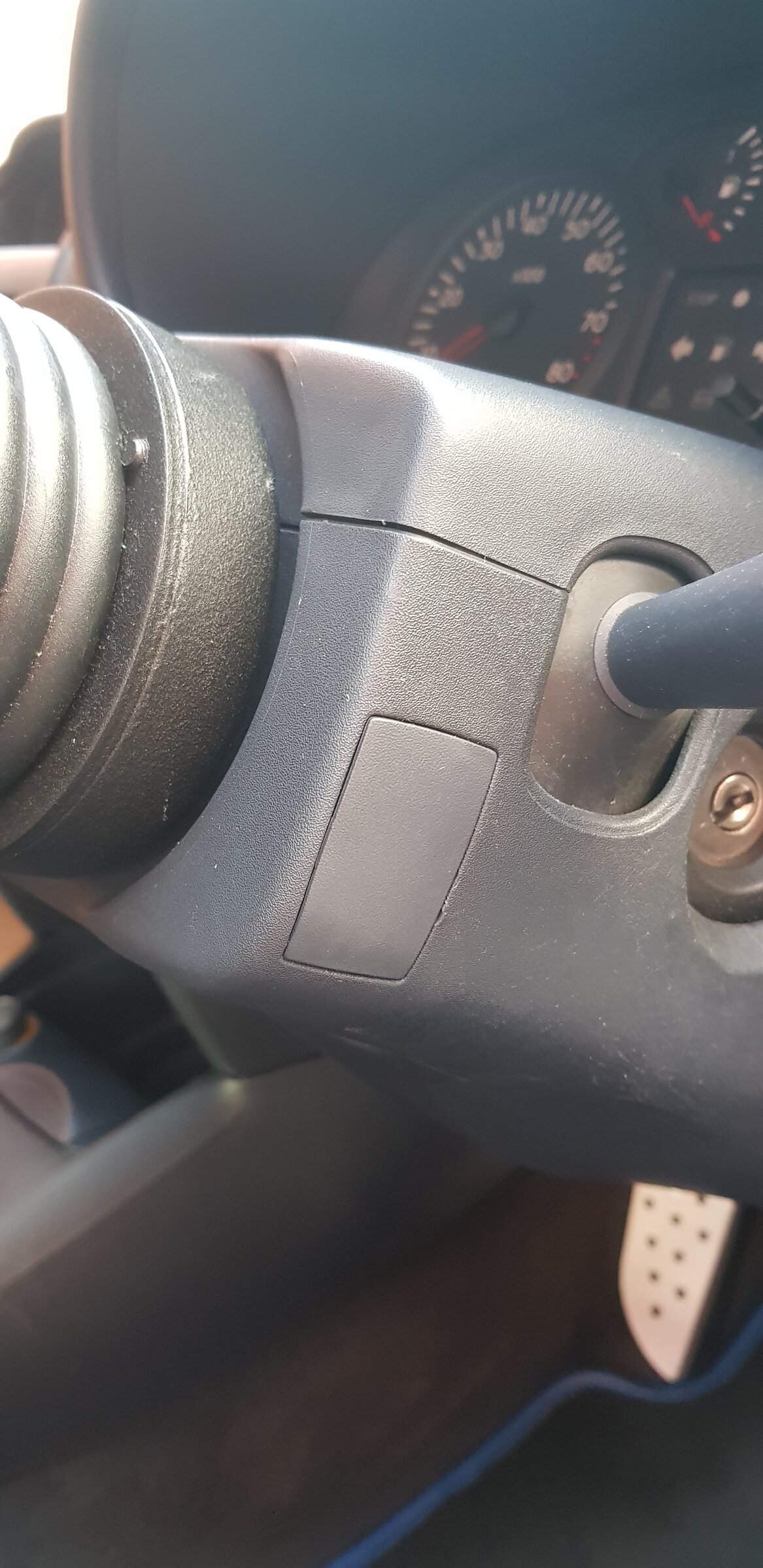

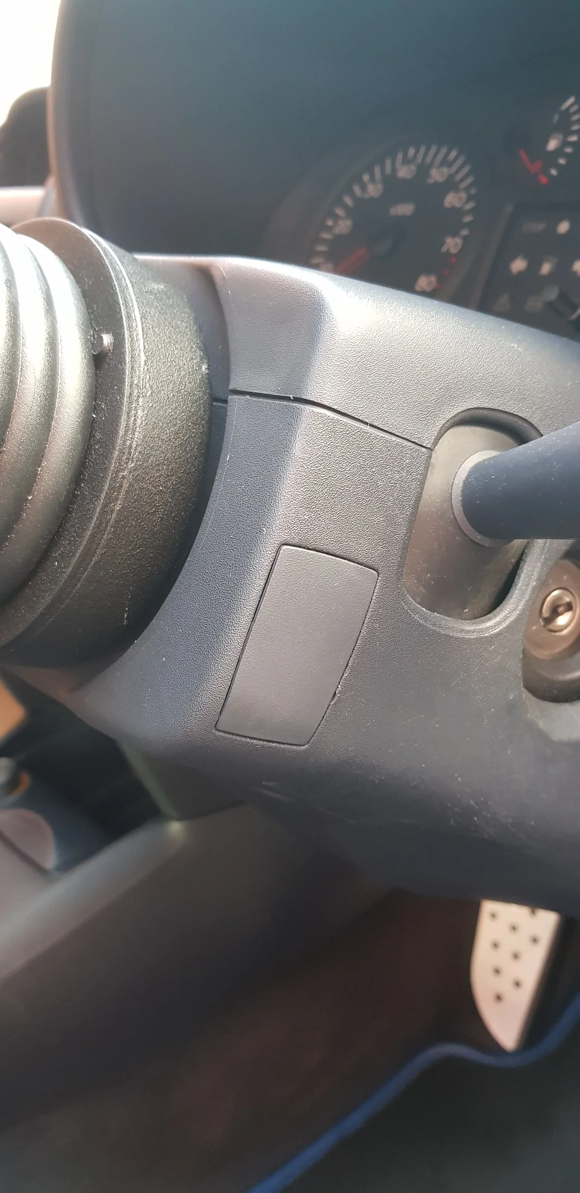

Few other internal parts done, radio stalk delete, from RPD.

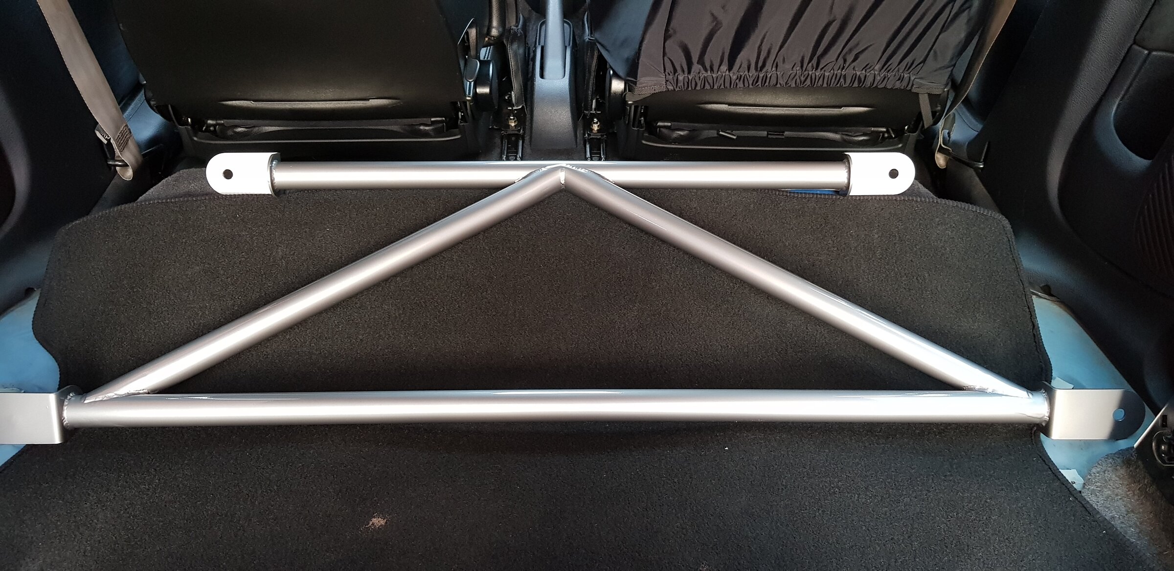

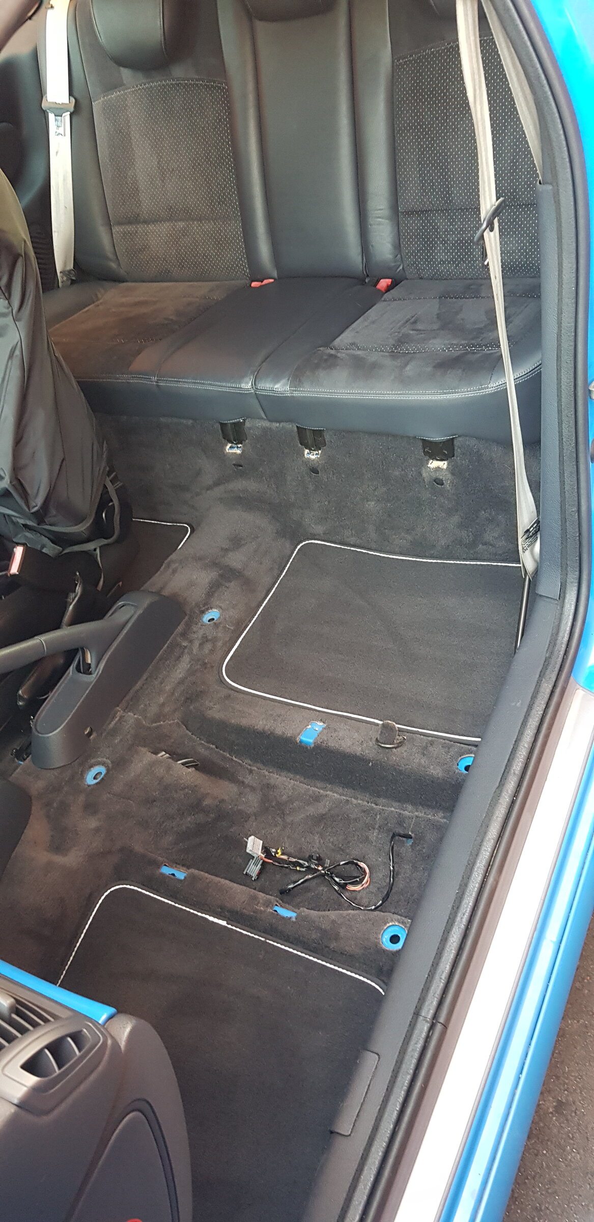

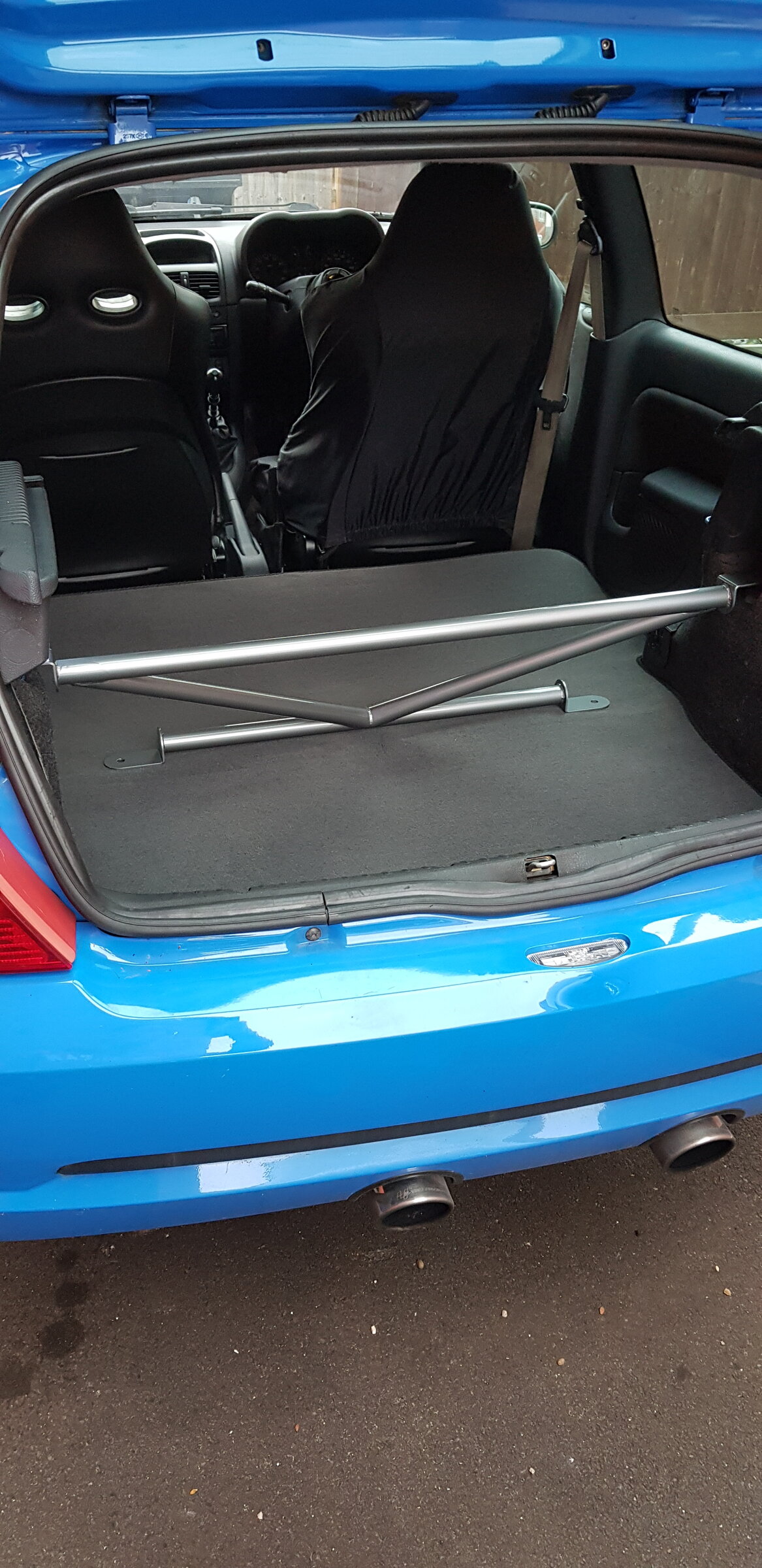

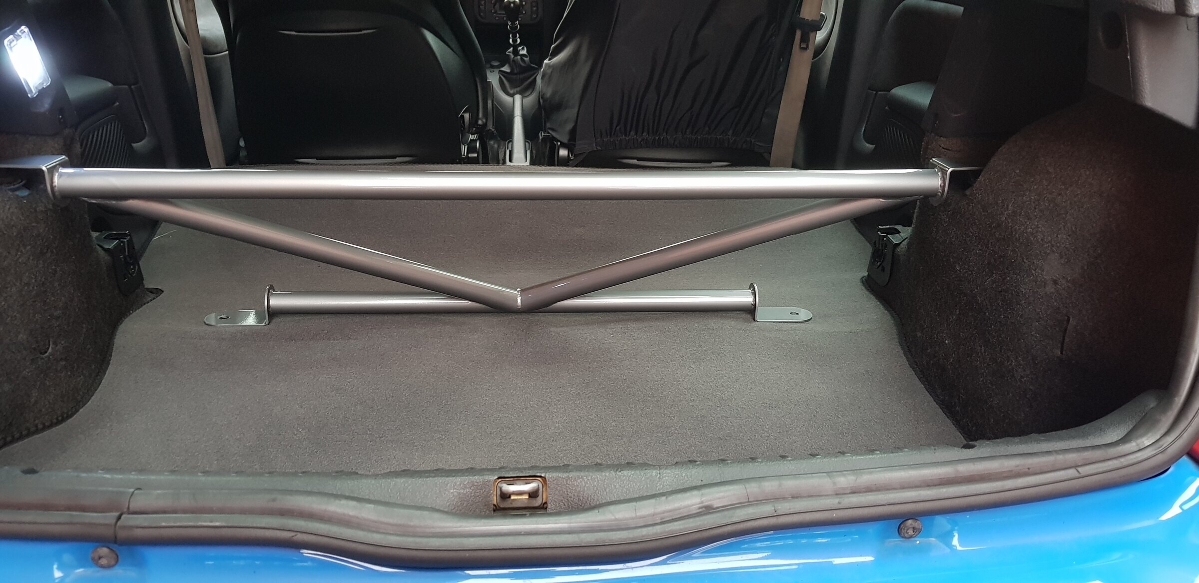

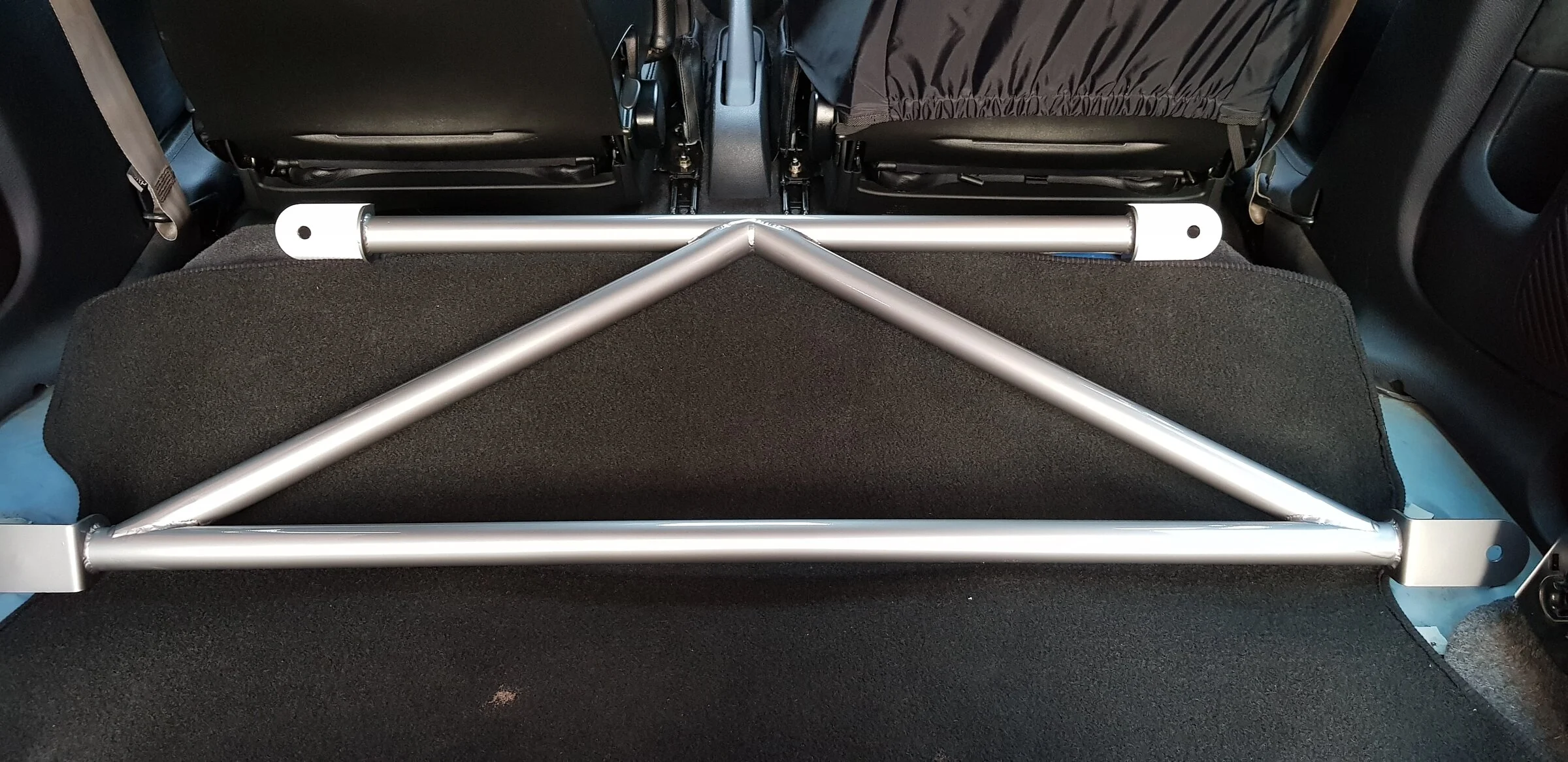

And a K brace, it's been painted to Anthracite to match the 2118s, I've also had the (was blue) dash trims painted Anthracite too with a boot mat.

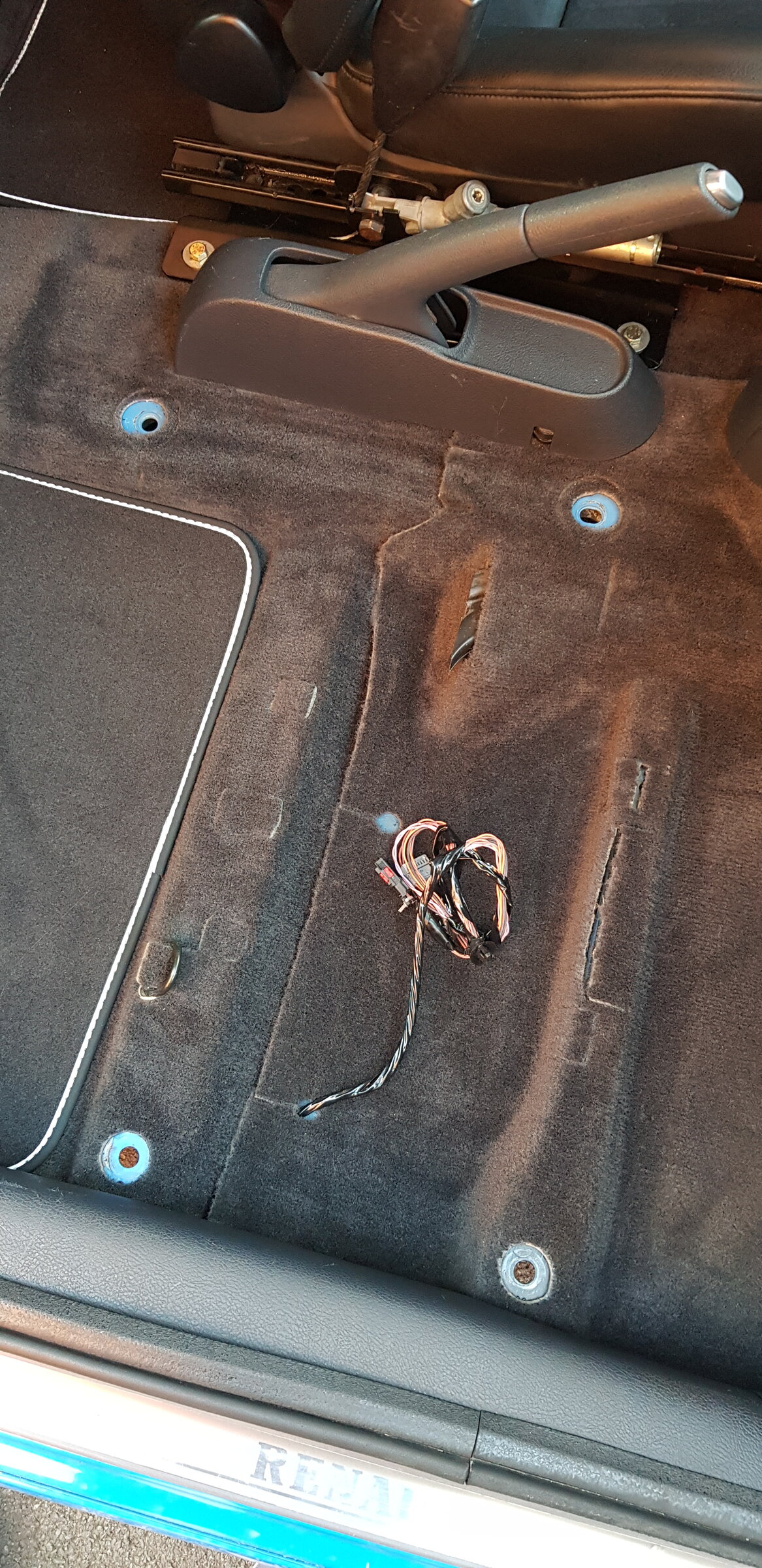

I went for anthracite rear carpet, as I feel the black clashes with the other internal carpet, however I feel the anthracite is too far the other way, so I may be ordering another.
