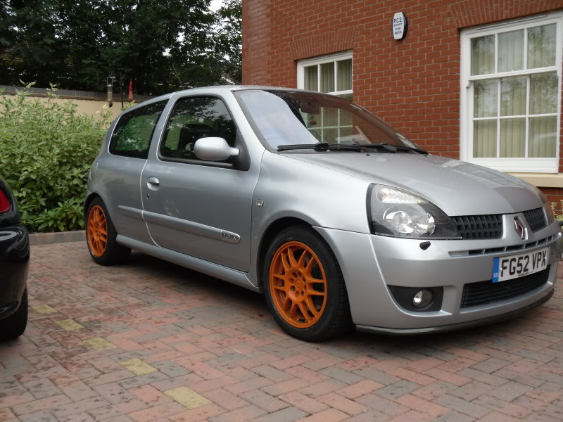

mmmm both the green and the orange look mint, but i think i prefer the orange!

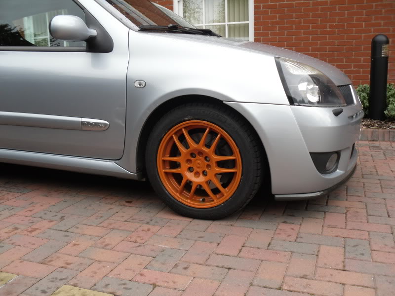

i refurbed my track wheels in orange but i'm not overly happy with how they have come out so will pay for them to be redone in a couple of months, it's not exactly a priority at the moment!!

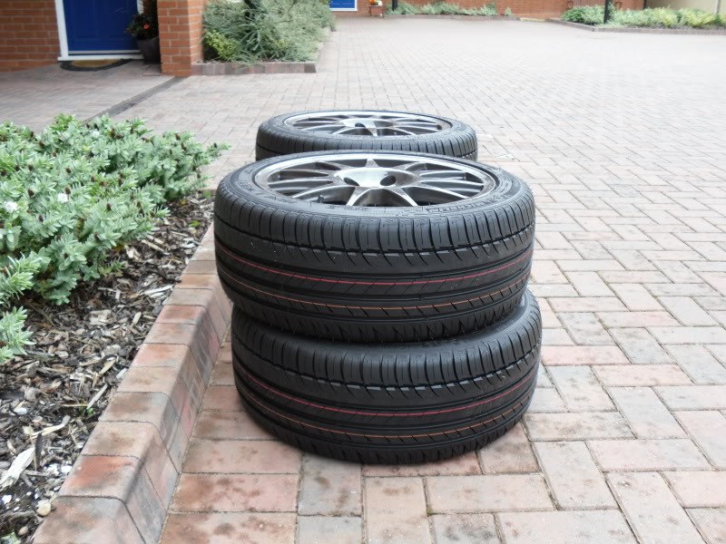

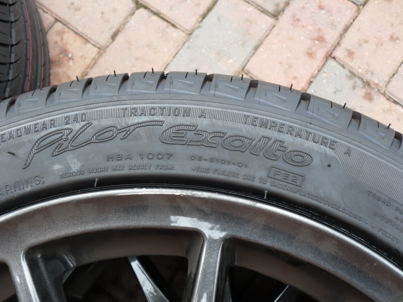

also i had to take the plunge and buy 4 new tyres for the turini's, was going to go the cheaper option and buy contisport contacts but in the end thought stuff it and spend the money! 4x brand new 205/45/16 83v Michelin Pilot Exalto PE2's!
Nothing more to update at the moment as I'm busy saving for other upgrades and MOT is end of next month but I think it'll be ok. Might get it checked over just in case there is anything I haven't spotted. C&C welcome as usual :)

Car looks perfect by the way, must be nice to be able to choose between Turinis/F1's!

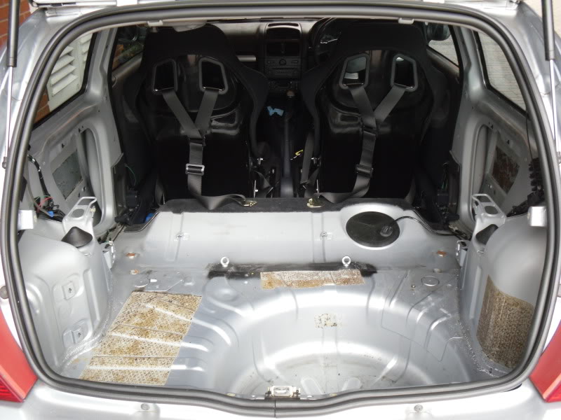

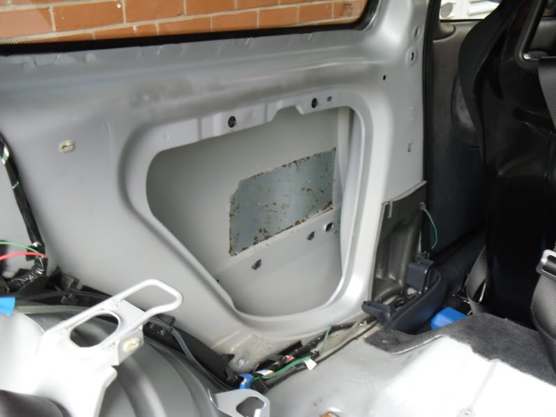

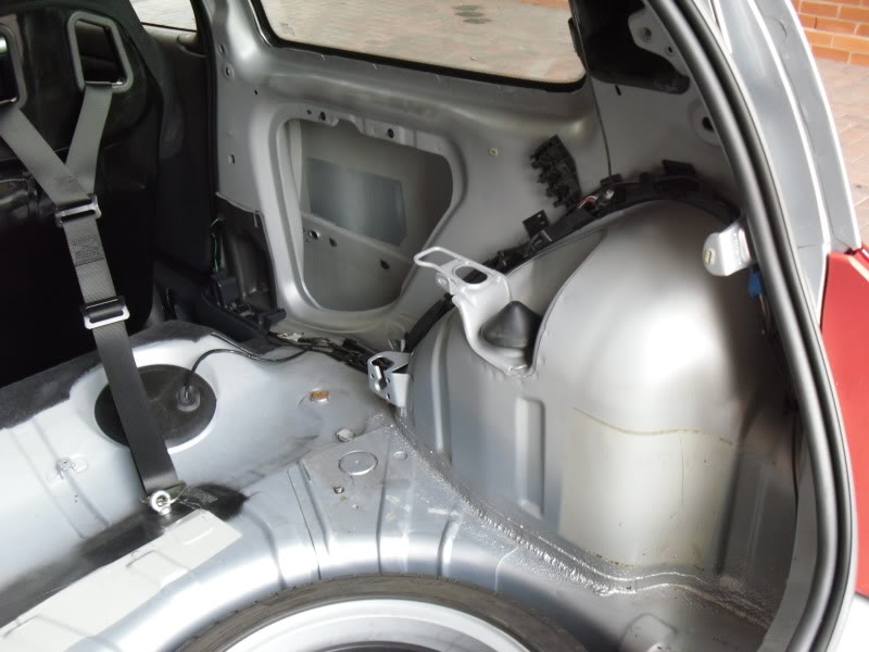

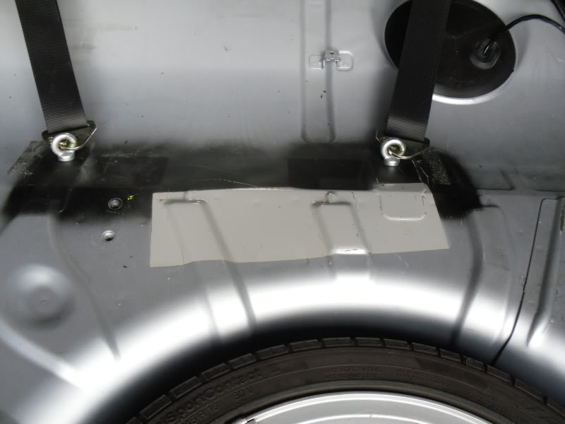

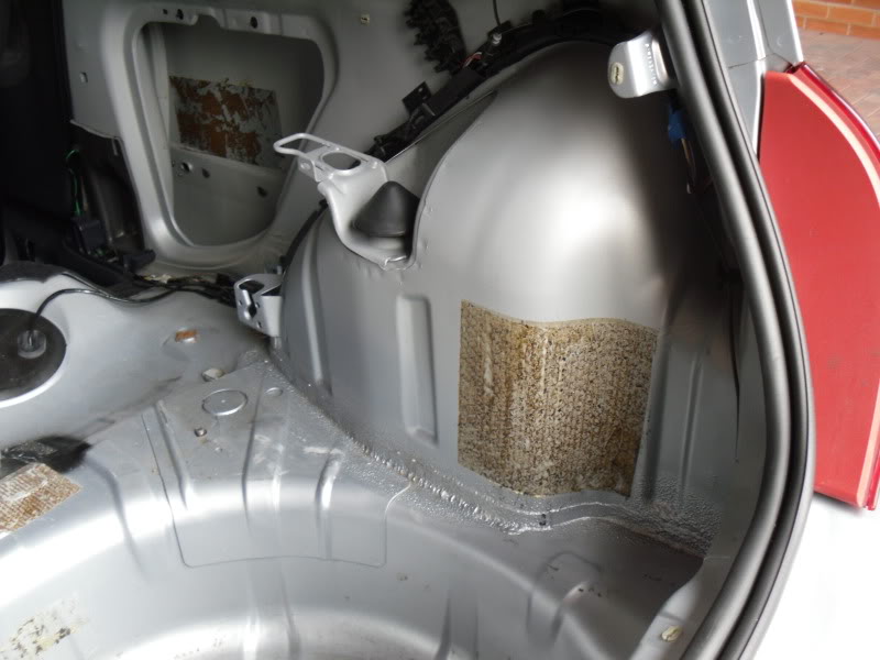

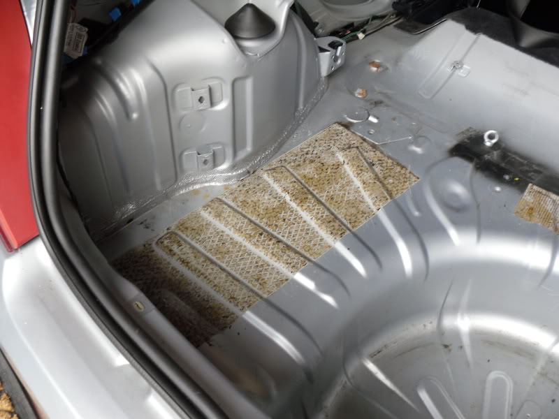

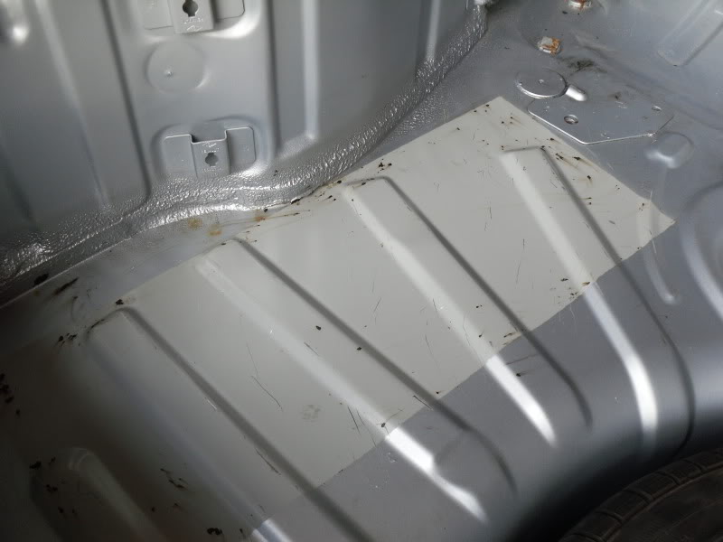

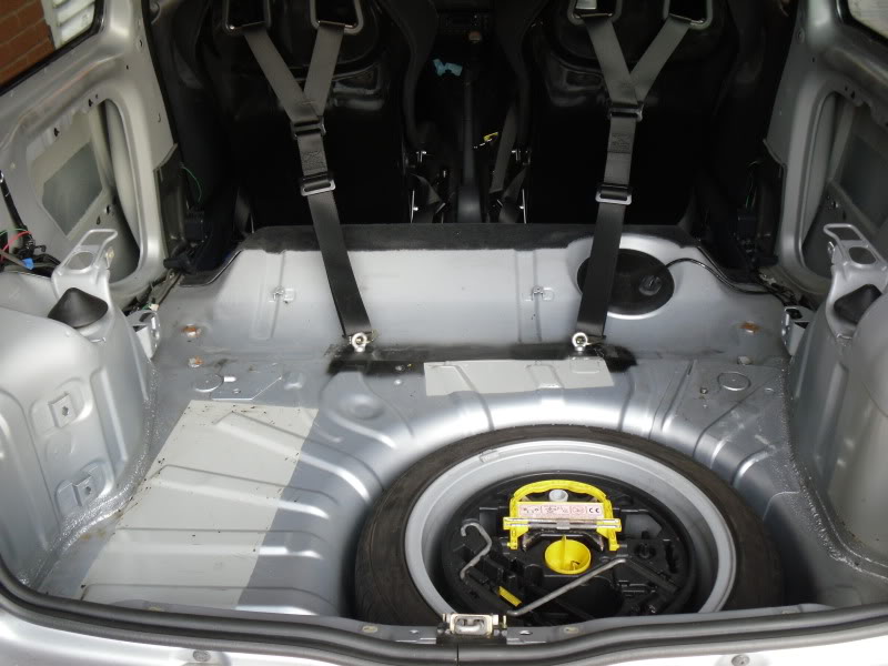

update for today...

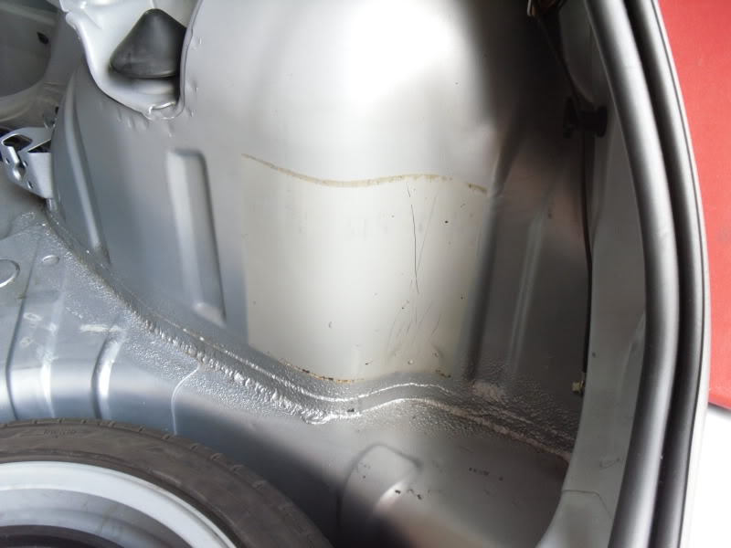

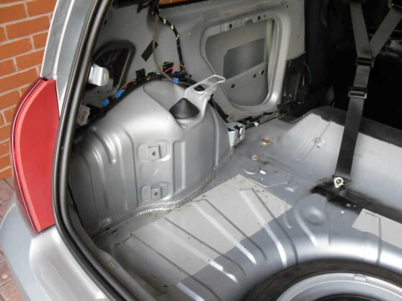

... went to town on the tar patches/sound deadening in the back of the car. 5 of them in total. 3 on the boot floor, and one on either side of the chassis.
bought myself a heat gun, wallpaper scraper and some white spirit. this is the heat gun i bought:
http://www.diy.com/diy/jsp/bq/nav.j...refview=search&ts=1257781374042&isSearch=true
first off, i heated the tar patches in sections with the heat gun and then attacked them with the scraper. works a treat and got all the tar off within about half an hour. result.
then it was time to get the glue off. it came off fairly easy with a bit of elbow grease on the one's on the boot floor. just took an old rag and a helping of white spirit and the glue dissapeared. but the one's on the chassis were a right pain in the arse! absolutley tonnes of glue and the one side took me forever to get off! got there eventually though, and here's some finished pics.

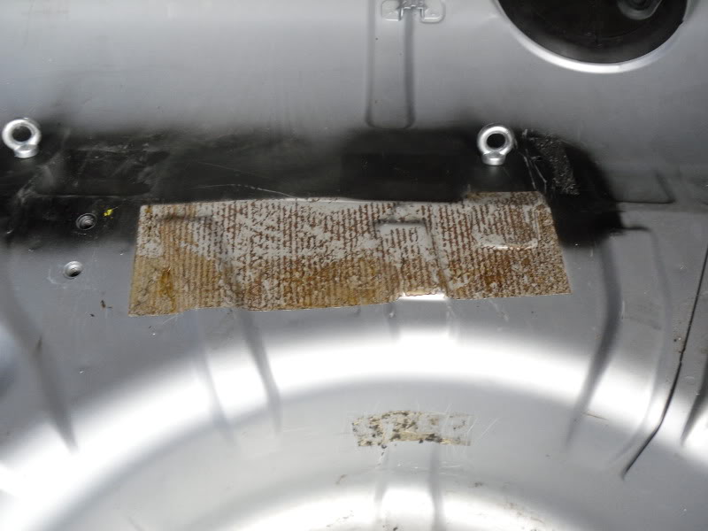

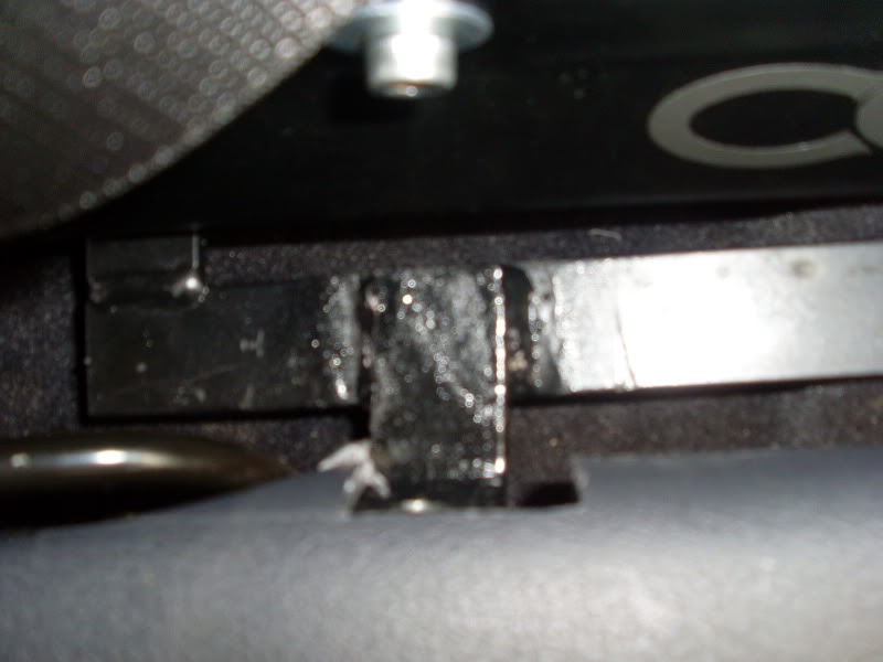

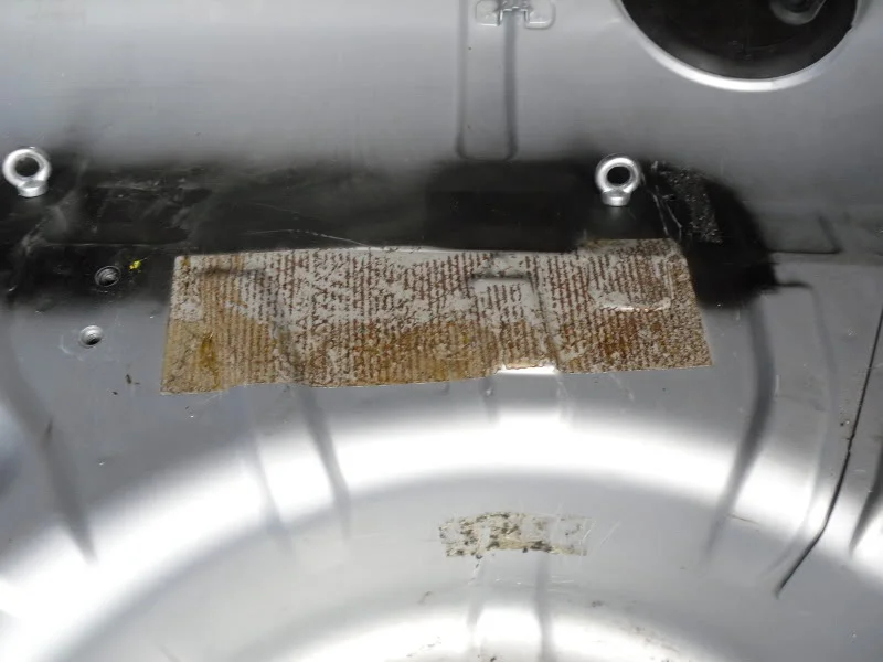

meek - that picture shows the drivers seat outer lug which is meant to be for the harness eyebolt to attach on to.
frame is great apart from the untidy welding and poor choice of location for that lug. Therefore in that postition it is unuseable. Numpties.
  RB 182
Grrrr.... they told me the frame was updated too... Will just gring it off and have it like the other side. Have no idea why they put a bent lug in the first place!
maynard
  ph2 172 track car
I know it's stupid. Before I ordered mine like 9 months ago I told them the design of the frame was incorrect - they sent me pics of the frame before I ordered - and they assured me the frame had been modified to fit properly, but sure enough turned up the same as before.
