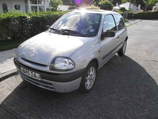

So here it is when I bought it...

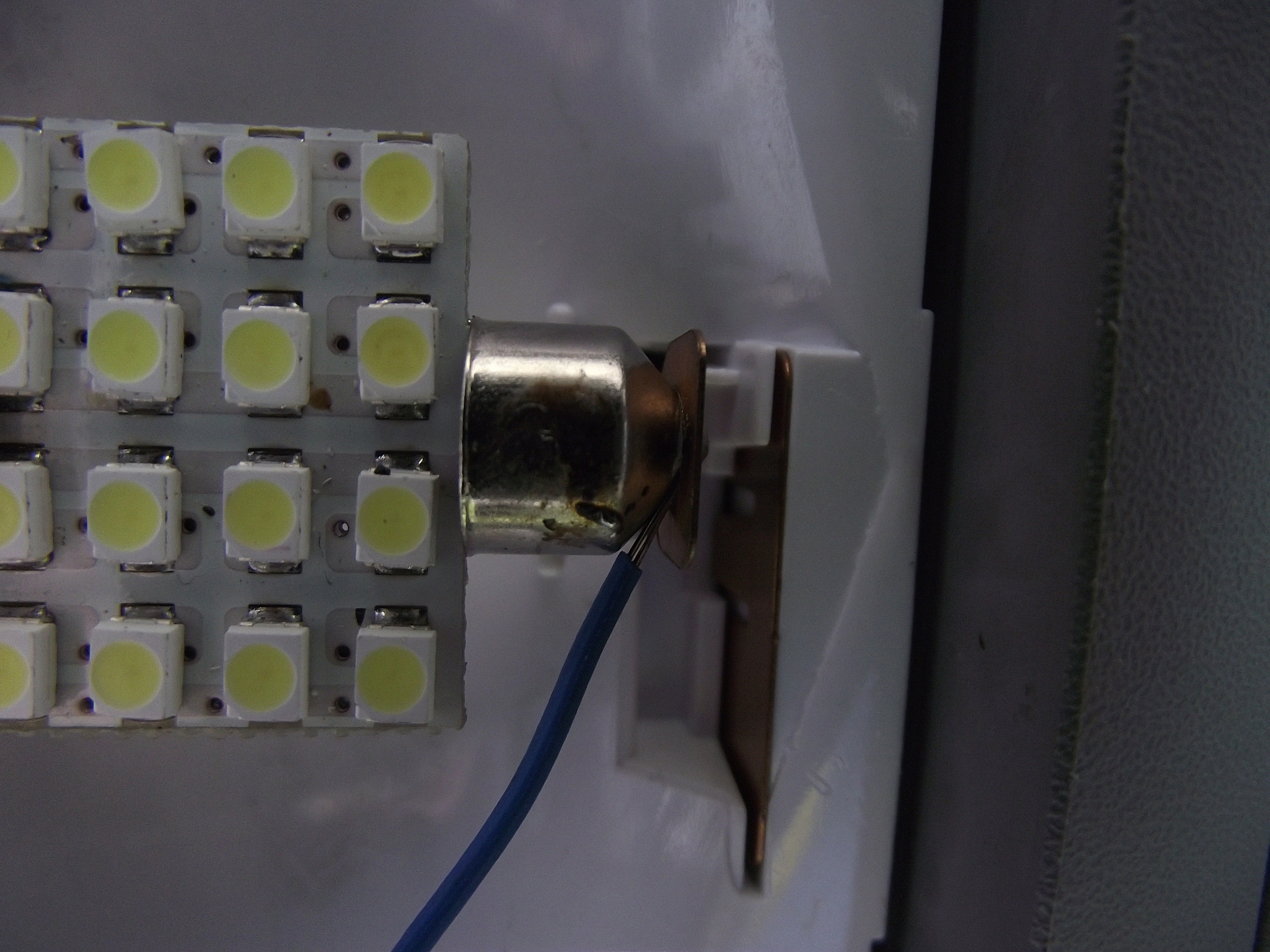

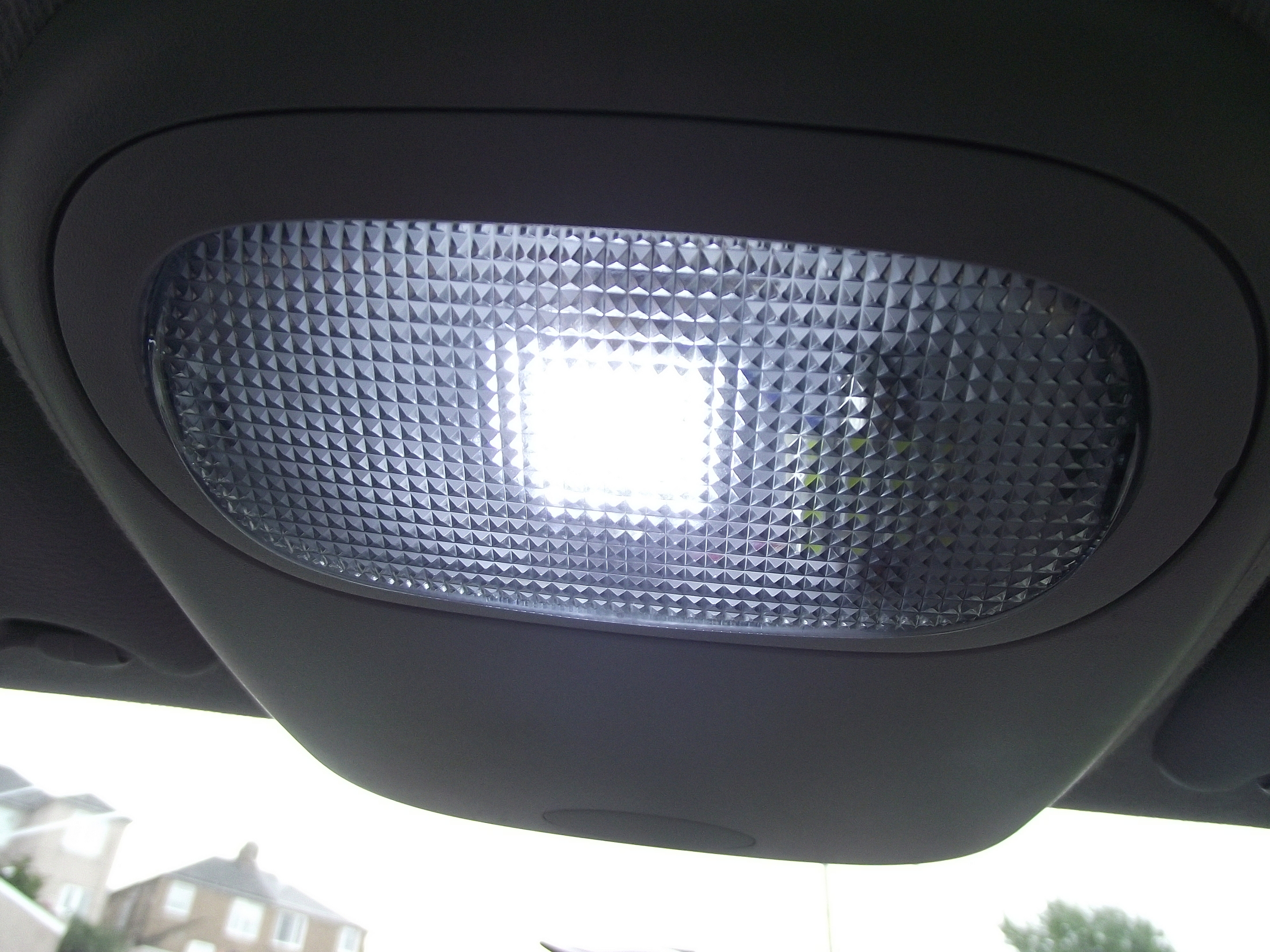

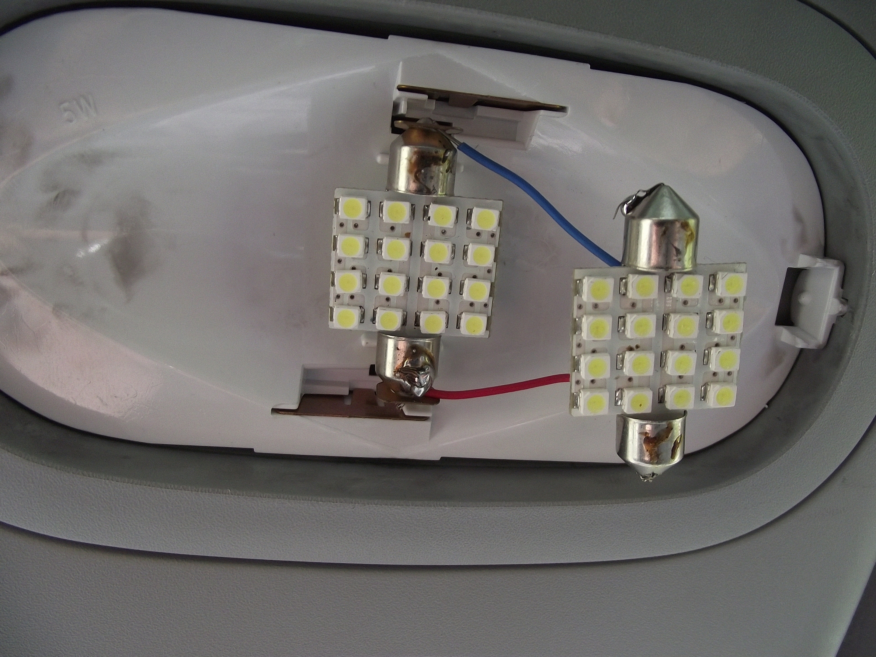

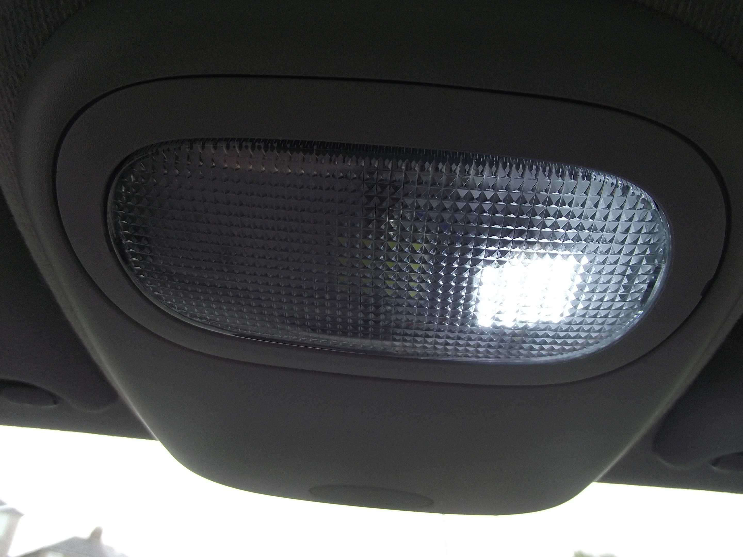

First thing to do was change out the interior light for LED - couldn't see very much with the standard one. So I got a pair of 16SMD LEDs and went to put one in the interior light. I soon found out that the power flows in opposite directions depending on how the light is turned on. So there was nothing for it but to get the soldering iron out, solder a second set in parallel (and opposite polarity), and replace in the car. Not perfect, but the slight aesthetic loss is made up for by the better qualities of the LEDs.

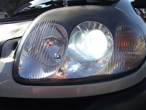

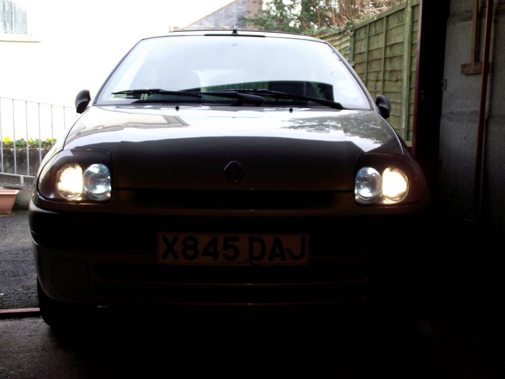

Next up were new headlight bulbs, Halfrauds (I needed them quick) Xenon 60/55w, whiter, 120% brighter light. Which is a good thing because the old bulbs were every type of s**t imaginable. May go try some osram nightbreakers, but my bulbs are fine at the moment.

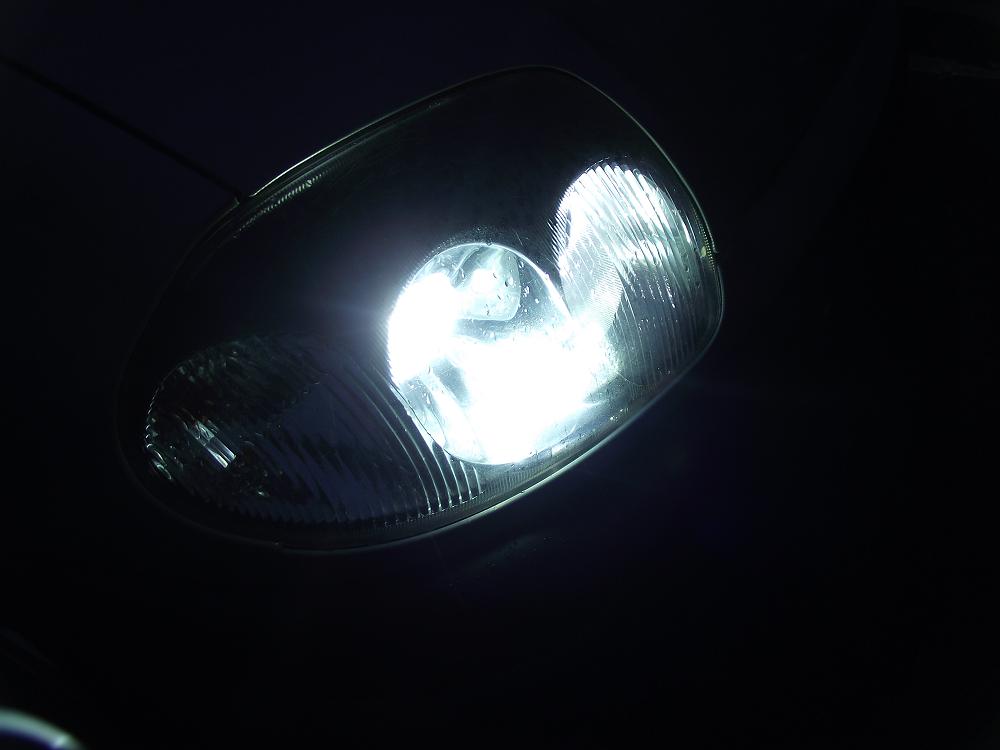

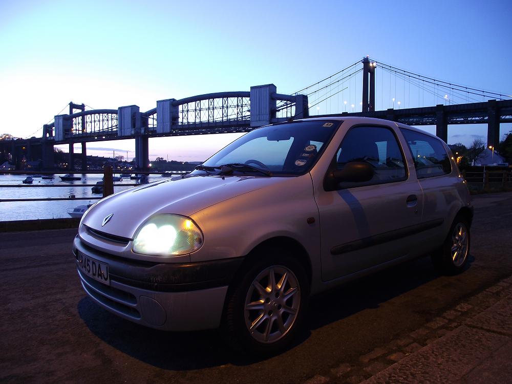

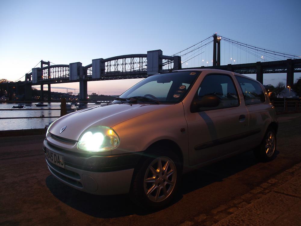

Then the latest mod was some LED sidelights - again not expensive but an easy way to make a car look better. These pics are as of this morning ;)

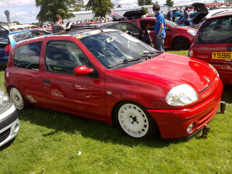

Looking nice and clean the way it is. Same as my project (except yours is a lot cleaner).

Dual optics make the front end look 100x better. Ph2 rear lights also much nicer IMO.
Aside from that, nice work.

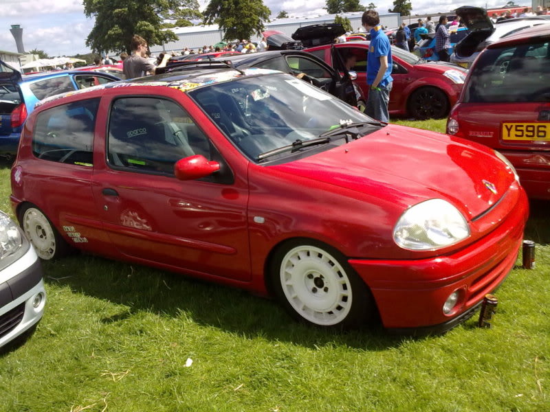

Also can anyone tell me what my rims are? Mine are a bit wrecked.

EDIT: Can't be Giraffe, mine have exposed bolts, and they seem to be straighter than those.
Gherkin's are 9 spokes and the 172 ones are 10 , they aren't standard alloys tbh i've got no idea lol.
the wheels you have are the standard ones off the megane "sport"

Can't find a match for those wheels anywhere... Think you may have meant these?
Close, but no cigar.

nah thats not the ones i meant... im damn sure i saw a few old meganes rocking the wheels you have....

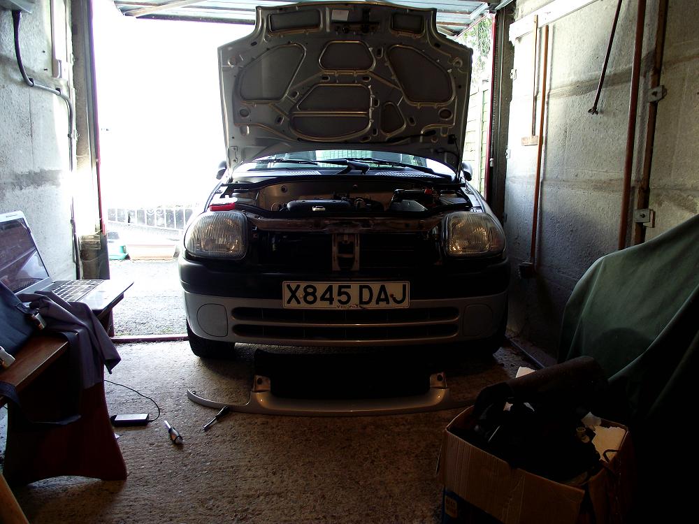

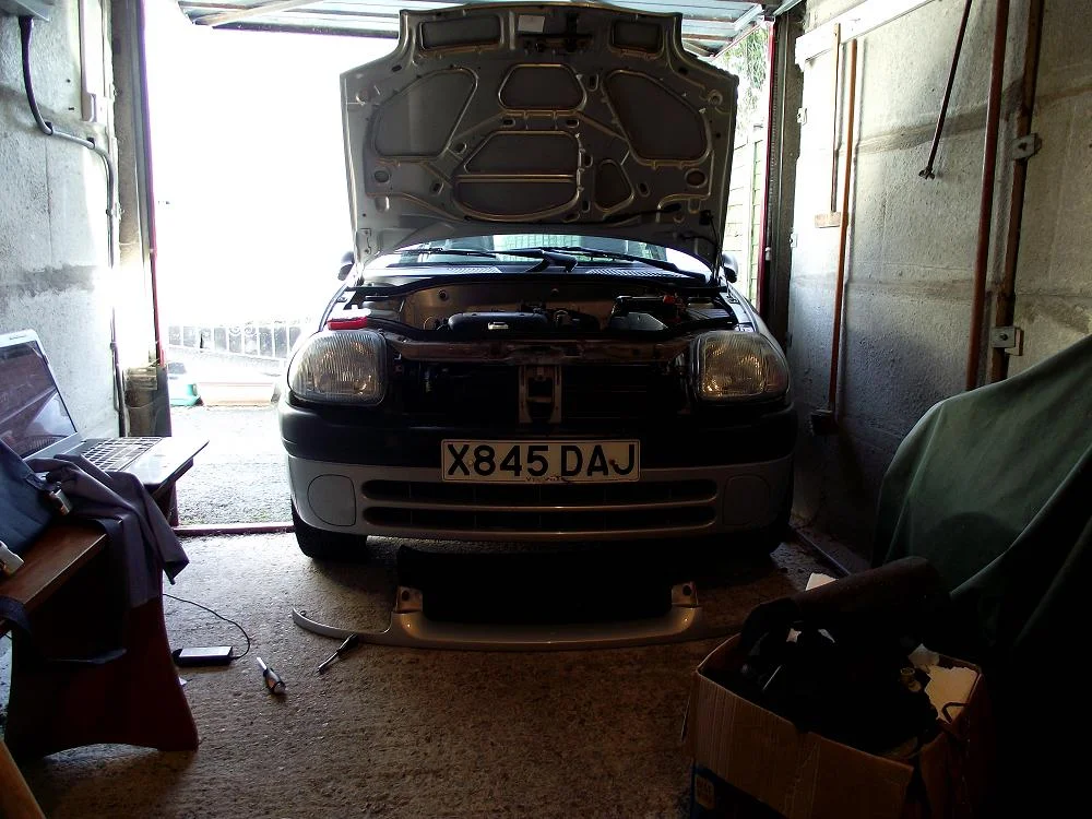

Well, I don't want to chance it. Just spent 20 mins pulling the remains of the splitter off, looks much neater but undecided whether to put a skoda one on or just leave it.

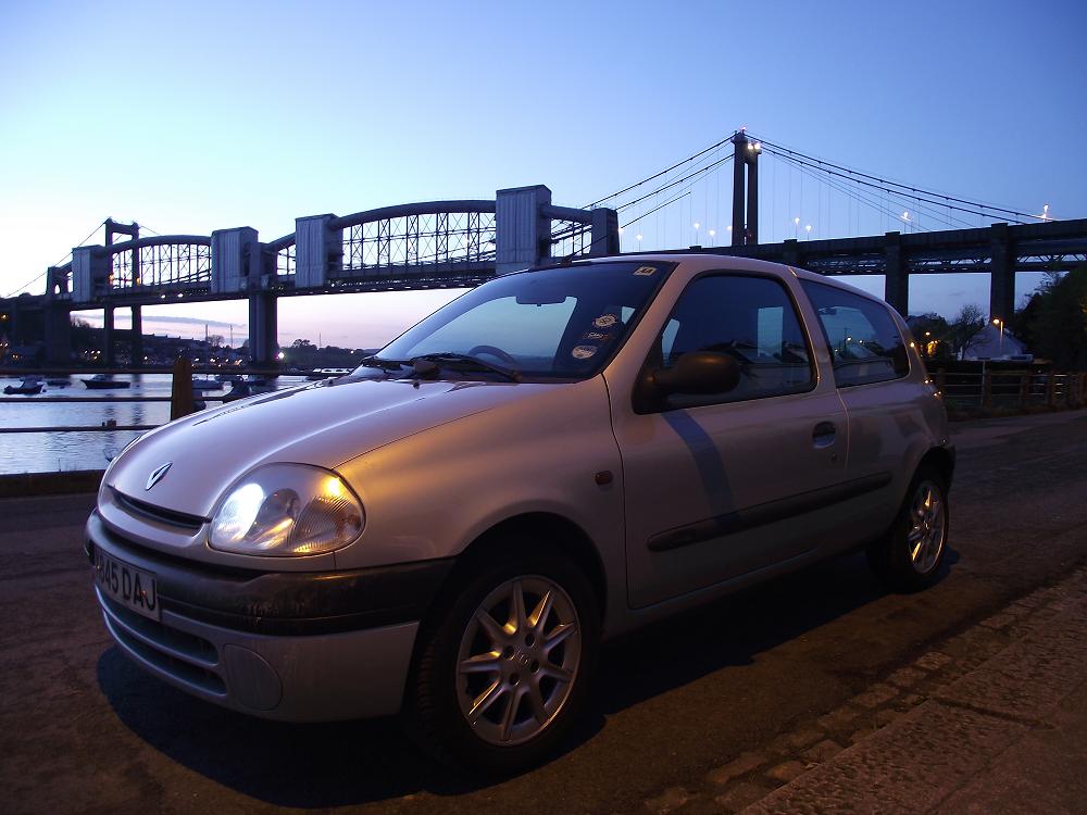

And this is the result...
Also the interior boot light has been replaced with LEDs. Strangely, however, there seems to be a slight current running through the main interior light at all times when it's set to doors. Therefore the interior light is dimly on at all times unless I set it to off. Any clues?

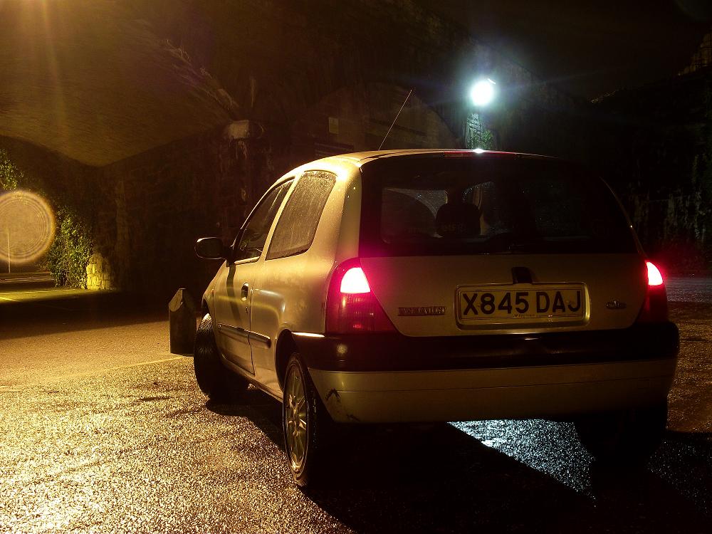

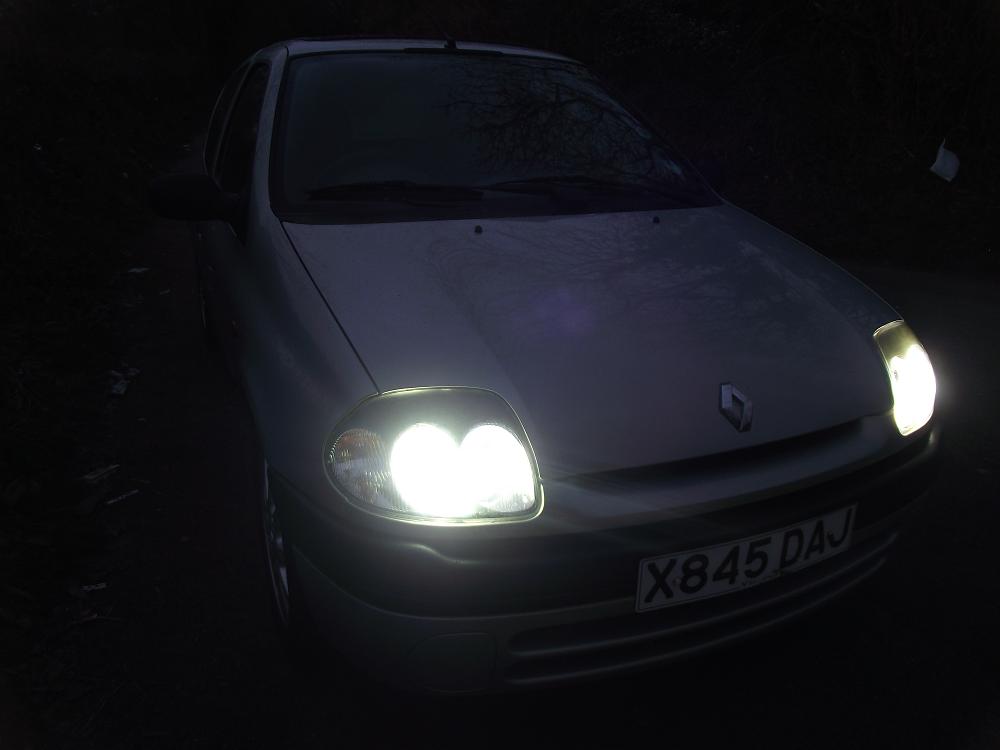

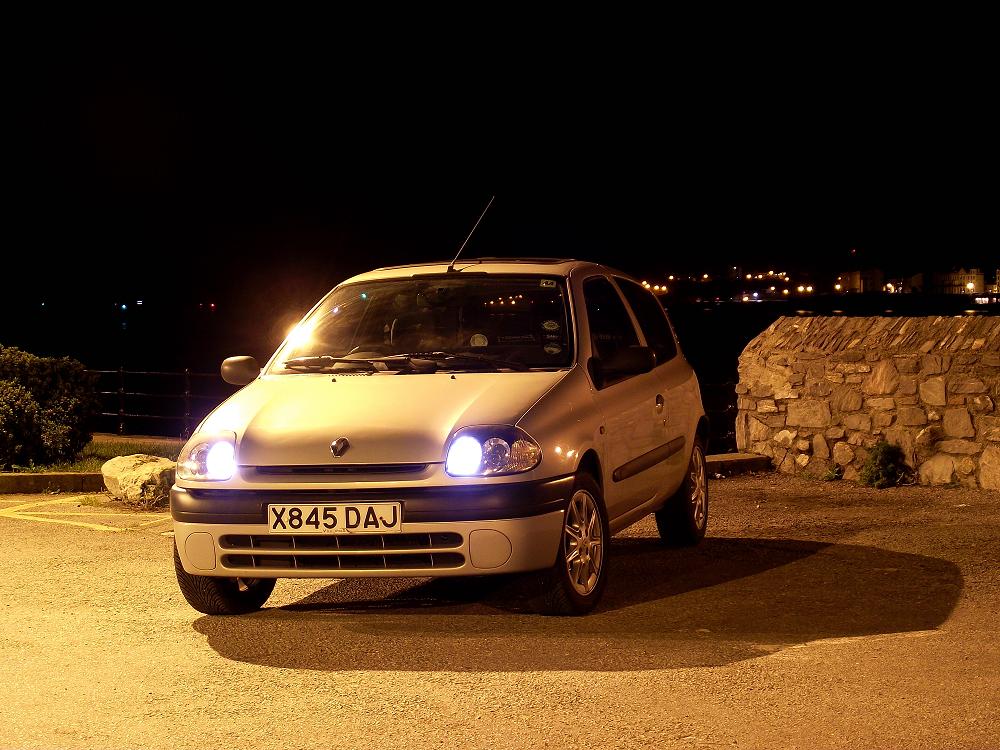

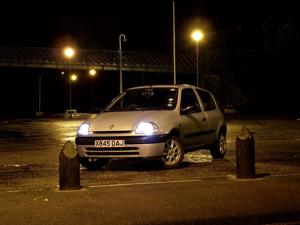

Fitted my HIDs today. Looks better than the pics but I can't see much improvement in illumination. Fairly quick night pictures too, it just started to rain :dapprove:

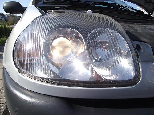

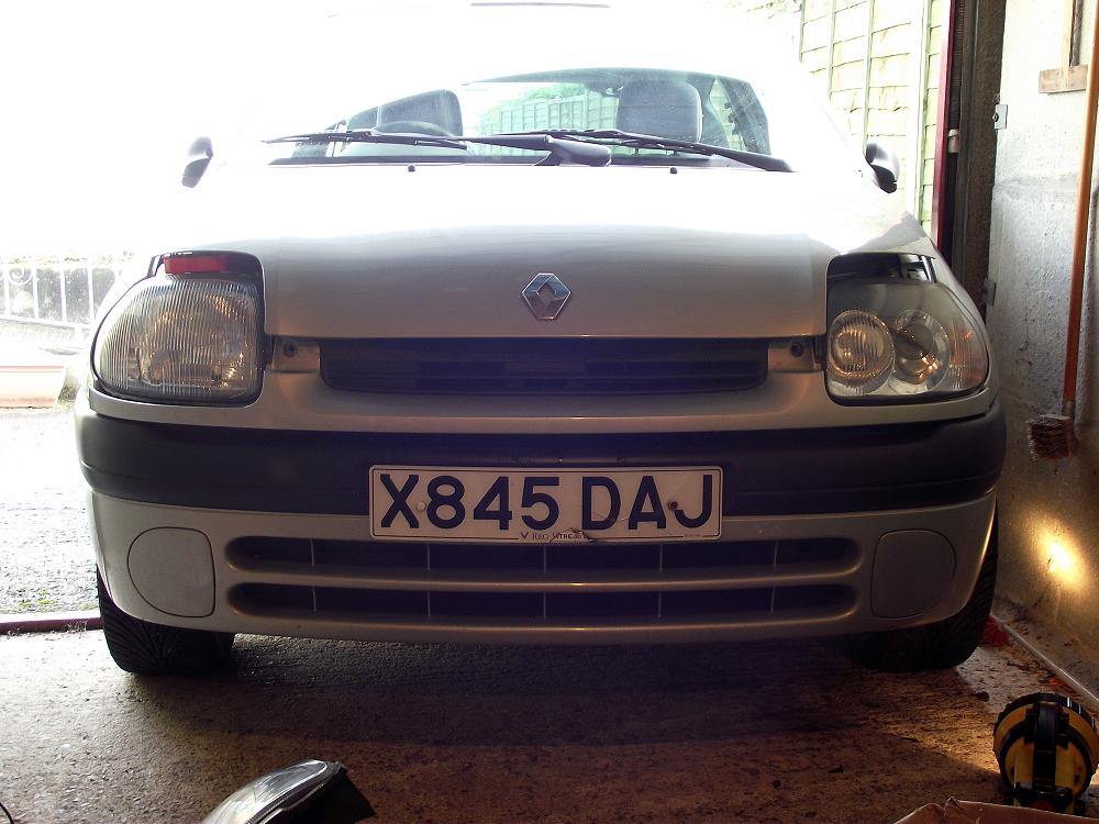

New headlight blocks, much better. The driver's side block was broken, meaning that the headlight was pointing down and not doing much lighting. Note in the first two pics of the last post, the driver's headlight lens is visibly lower in the block.
So, out with the old ones and in with the new ones. These are all silver and original rather than the last pair which the previous owner had painted black. However they were caked and yellow and I didn't hold much hope of them polishing out, but they did. Still haven't cleaned the car since then, so apologies for the cack on the front bumper.

hi mate. does your interior light come on when you open the dor. if so do you have any advice on how to do this.
cheers
Yes. Open the spoiler for a guide ;)
Doors Open
Manual
Here's how they're wired up. One's wired opposite polarity to the other (put one in, set to manual on, take out and remember which way it went, then put the other in and do the same with the doors)Solder the wires at the ends of the one that won't be in the holder(mine had a hole in the end of the cone you could thread the wire through, see pic above),
Then trap the wire in the holder at the ends of the other bulb like so:
another option if you want to keep a single bulb is to use a bridge rectifier, feed the wires that would go to each side of the bulb into the AC connections of the rectifier the connect the dc output to the bulb holder and fit the bulb, rectifier will then output correct polarity to the leds no matter which direction the feed into the rectifier
