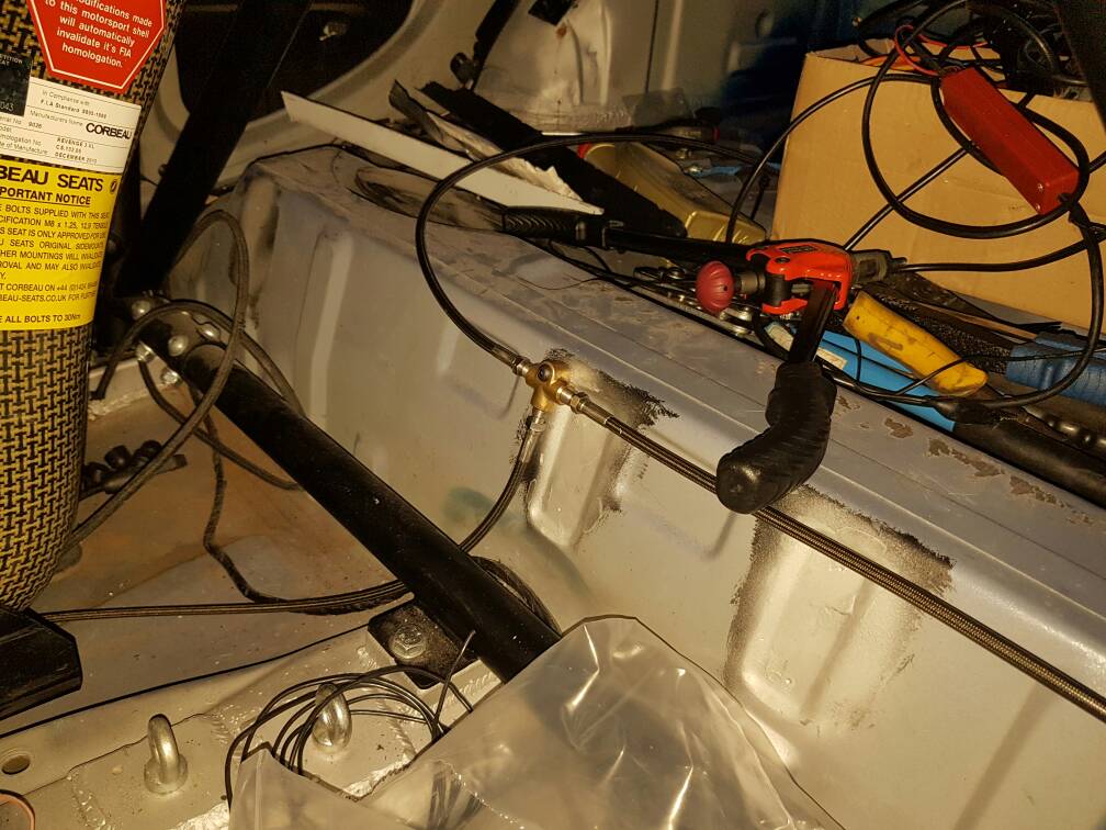

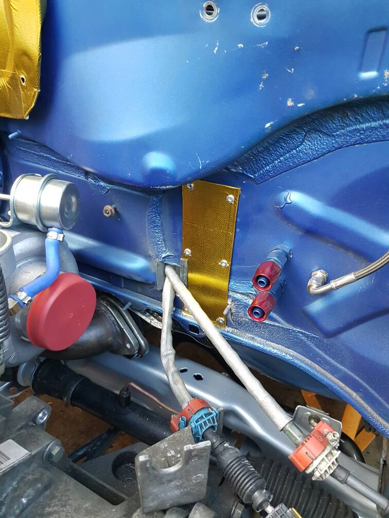

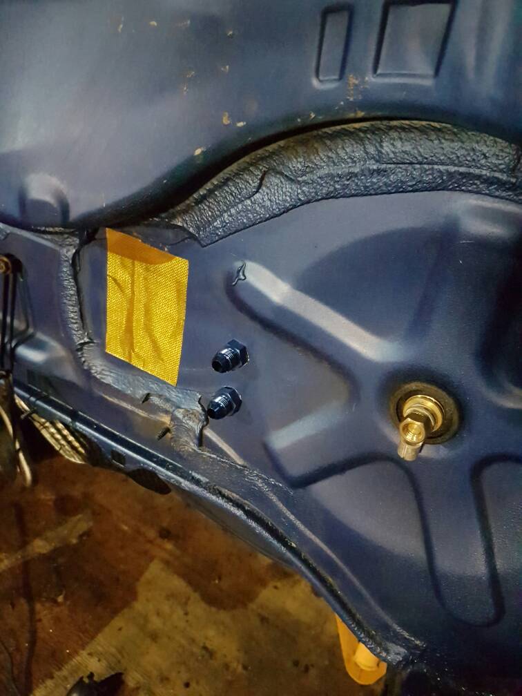

Some aeroquip bulkhead fittings ready for the fuel lines aling with the longacre bulkhead through.

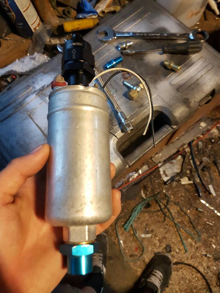

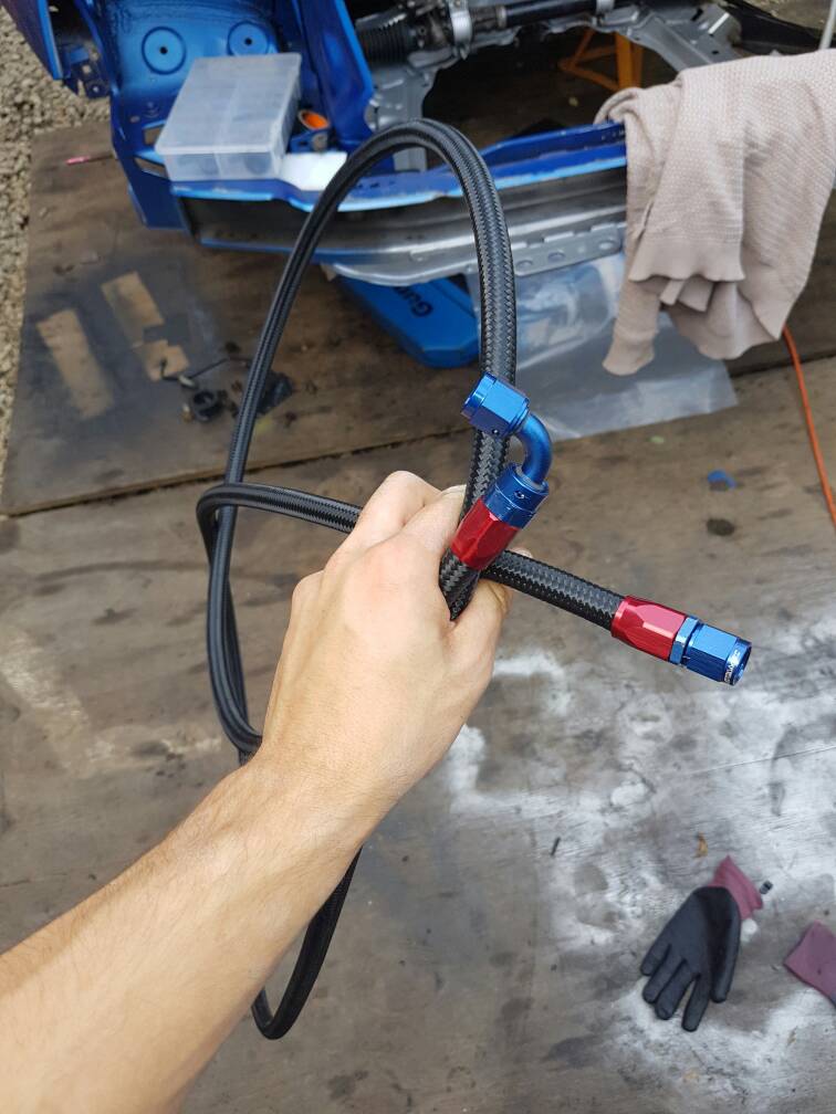

Started getting all the fuel filter, pumps etx ready so they all drop down to an6 fittings, as it was a right jumble between different threads.

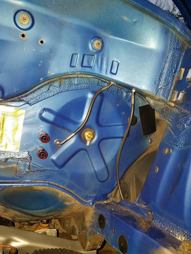

s**t picture, but the fuel rail with aeroquip fittings..

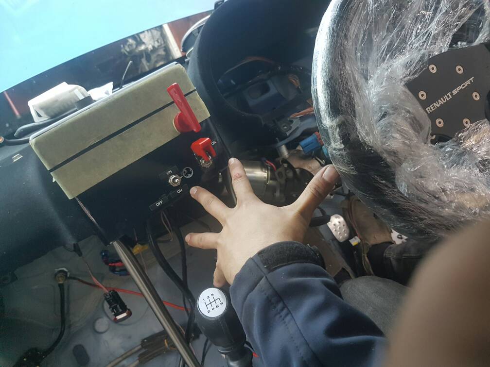

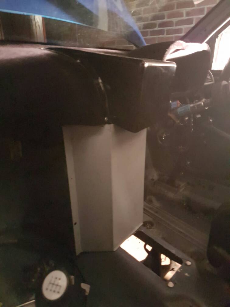

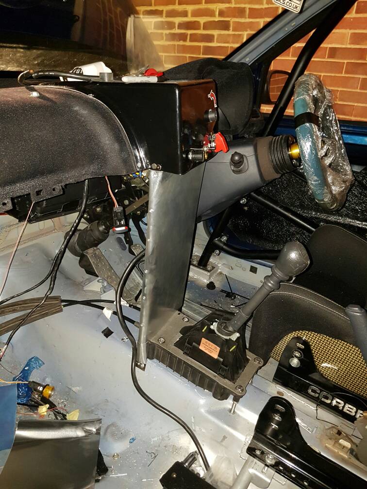

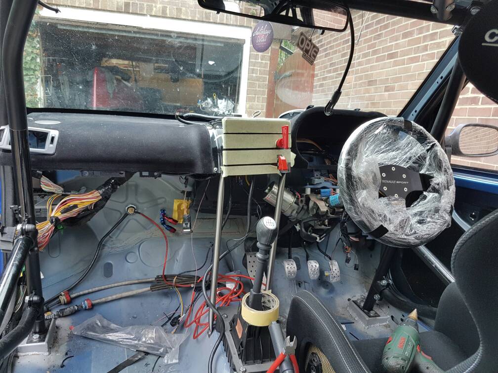

Fitted the CMC dash pod and started mocking up a dash panel like in the previous 182 that supports and acts as a guage panel etc
Also going to make some brackets from the bulkhead to support the dash, especially if the fire extinguisher is gonna be mounted from there...

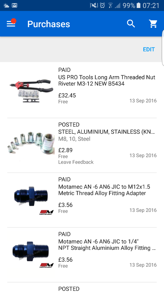

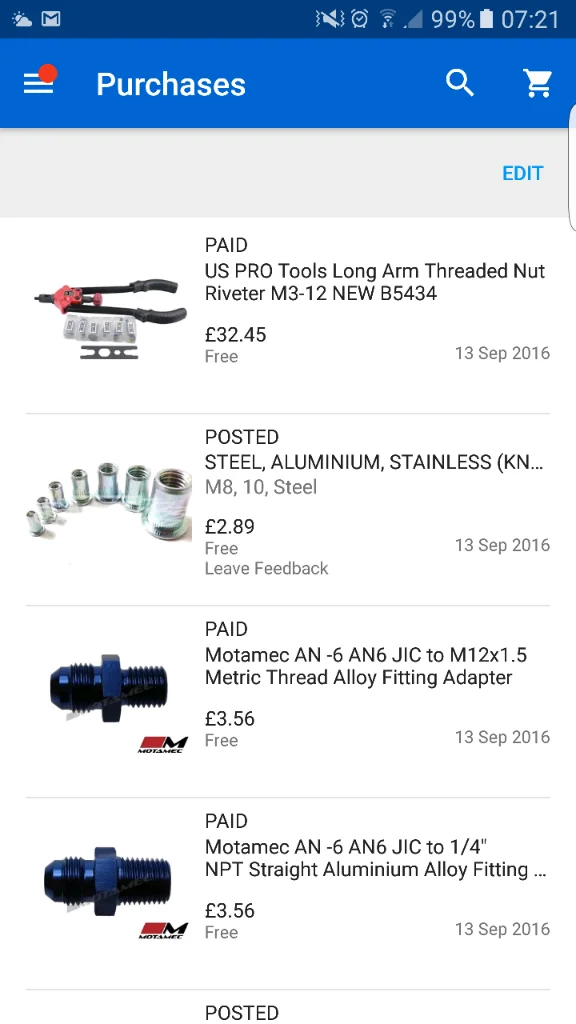

Bought a new riv nut gun, my other ebay special broke yesterday, so went for a more expensive one, only time will tell

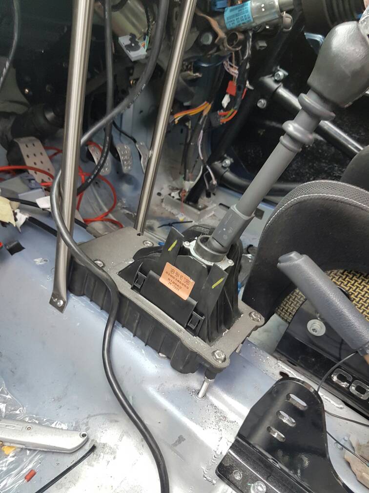

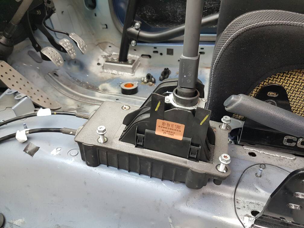

Finalized locition for shifter, gonna rivnut where the holes are and put threaded bar up to support and adjust tilt of shifter. Then will make up an alloy housing to hide all the plastic and what I can mount bias valve too.
Sent from my SM-G935F using Tapatalk

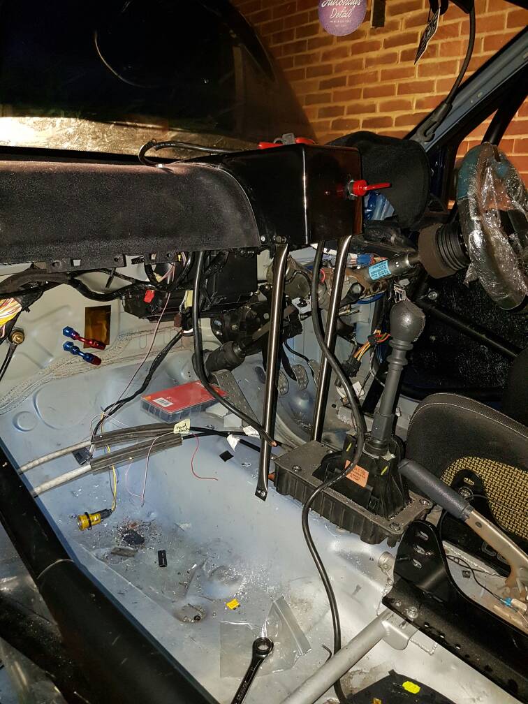

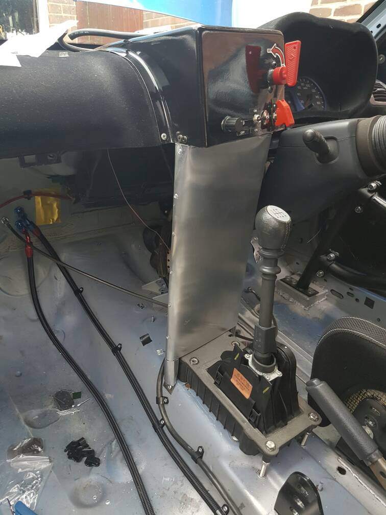

Inteior is starting to feel like an interior again.

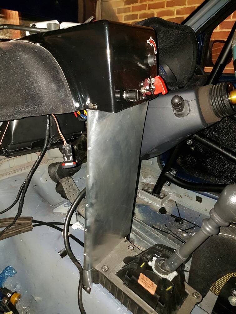

Made some support stands for the dash which some alloy sheet will be folded around...

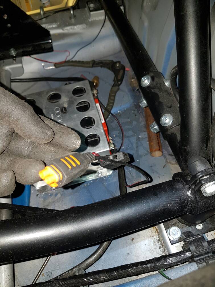

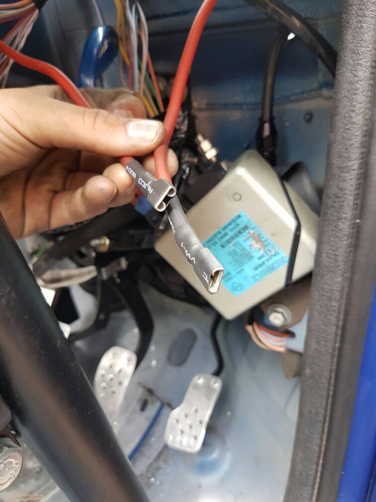

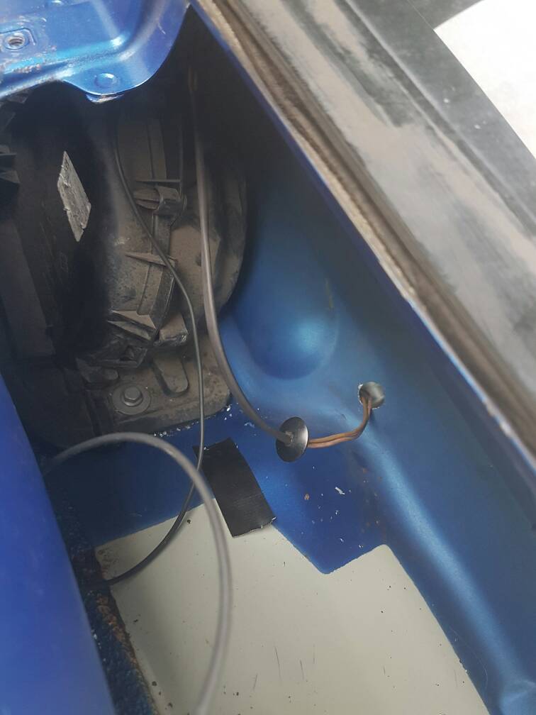

Fitted electrical cut off and wired that into the earth cable - putting the live wires behind the dash like that scares me a little so earth is much much safer and means you dont have to run the alternator discharge resistor thing.
Realised I had a ctek battery charger lying around so made up sone terminals to go into the battery.

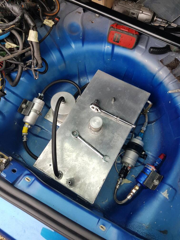

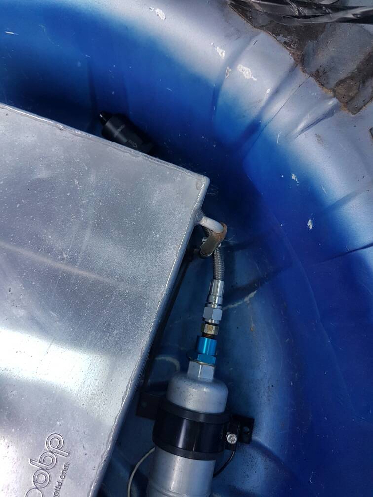

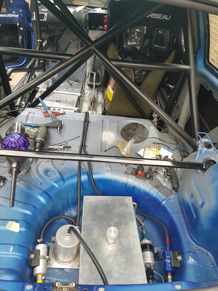

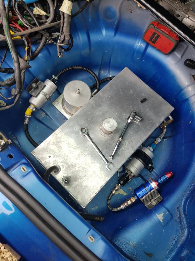

Started mocking up positions for the fuel pumps and lines etc
Set up will be:
25litre internal tank - lift pump - 1 litre swirl pot - 30 micron filter - bosche 044 - check valve (keeps pressure in the system) - sytec automotive filter 100 micron - 630ccs - pressure regulator - return to swirl pot.
Most of this is getting put in the wheel well, just need to make up some tank straps and make a alloy cover for it all to keep it msa compliant.

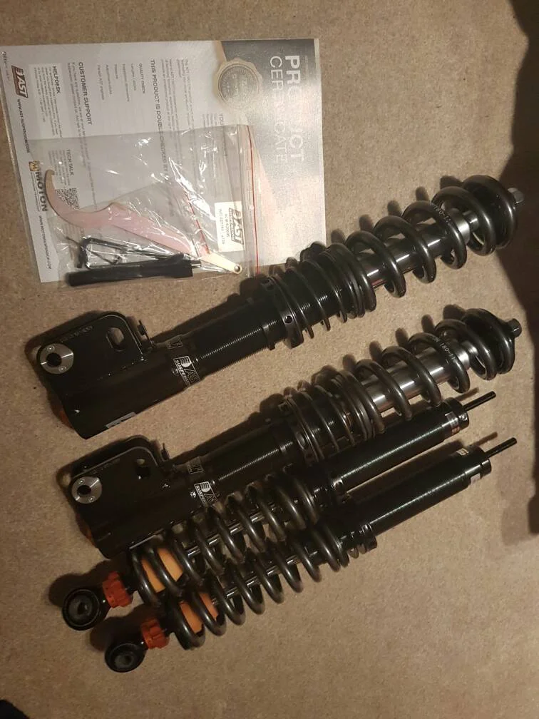

Picked up these tonight also! Love a new set of asts!

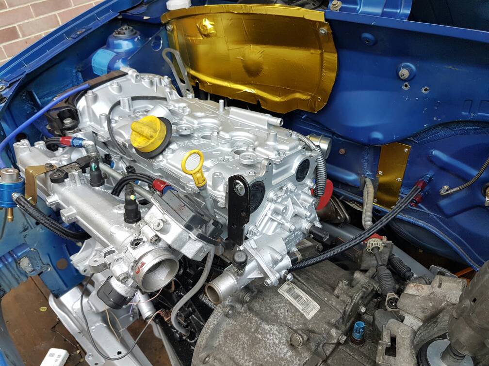

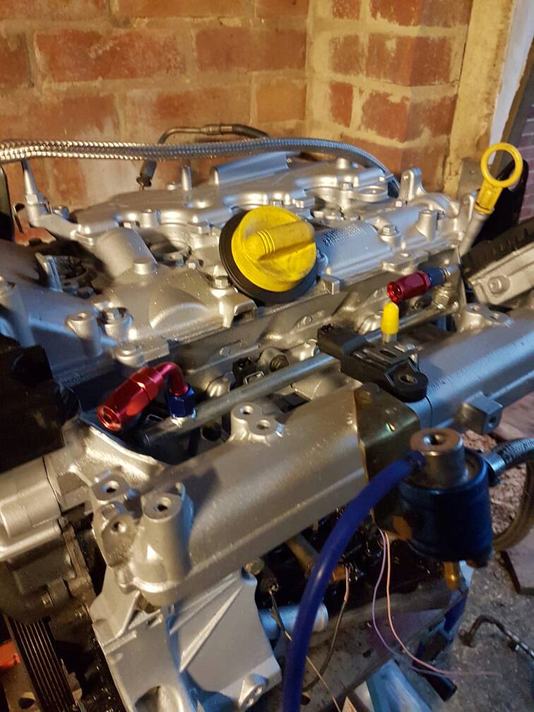

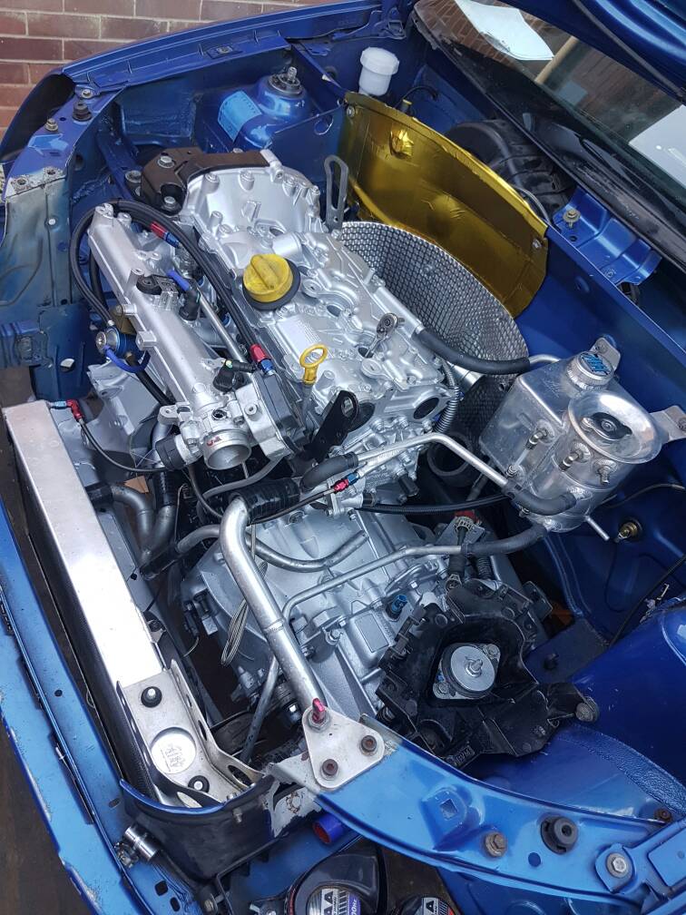

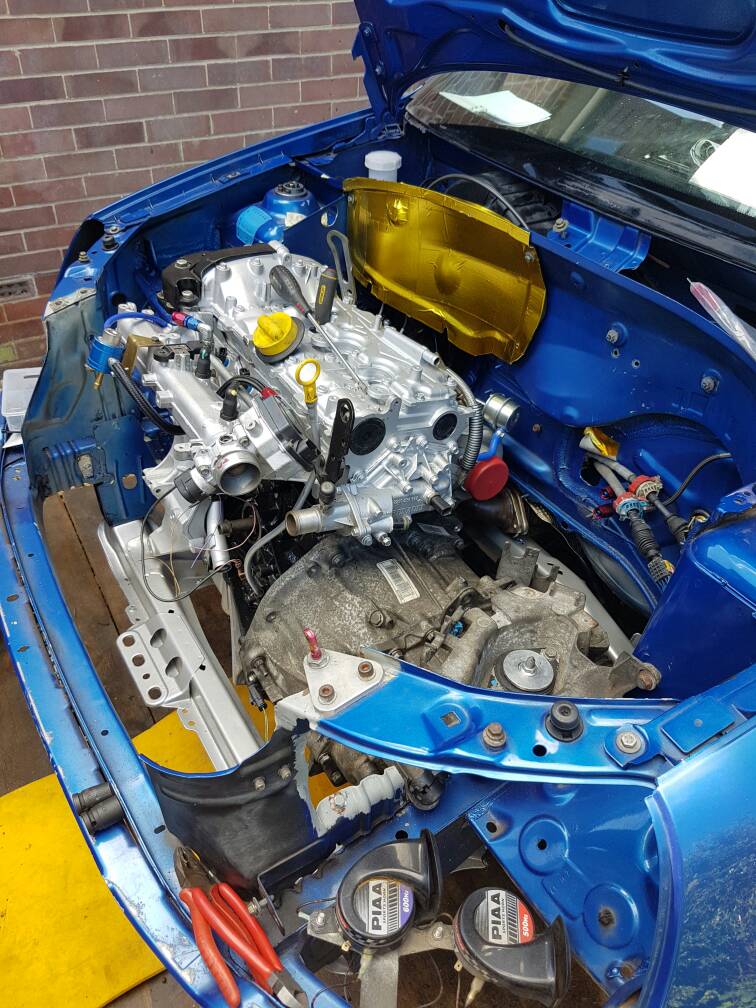

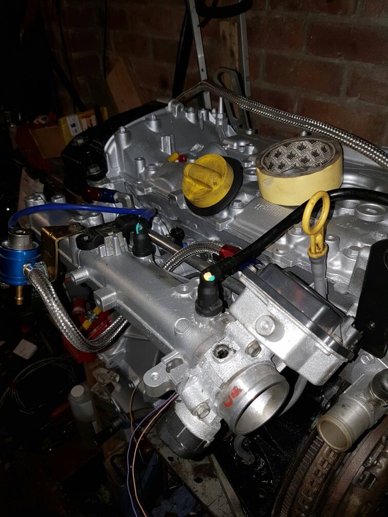

Little engine picture to finish.
Hopefully over the weekend the gripper will go in, and the engine fitted with a new cambelt and water pump.... meaning I can start bolting stuff back in! Wooo

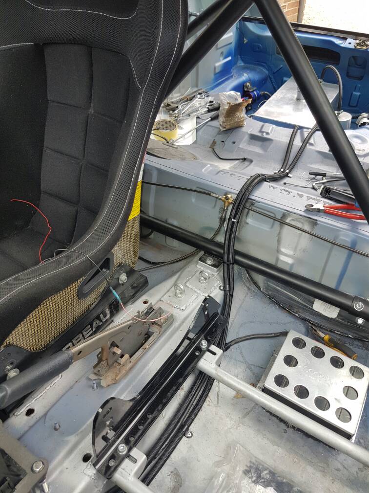

Productive saturday!

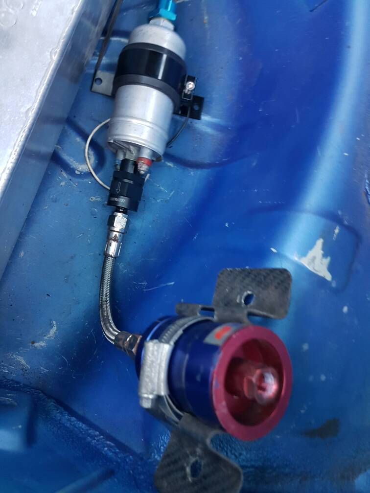

Fuel set up is nearly complete, got the new riv nut gun working, so mounted all the brackets bar one in place.
All I have to do now is plumb in the fuel rail to bulkhead and run to and from the bulkhead to the swirlpot!
And make a fire wall for it..

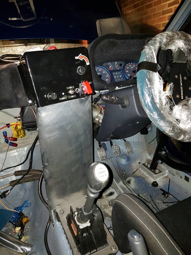

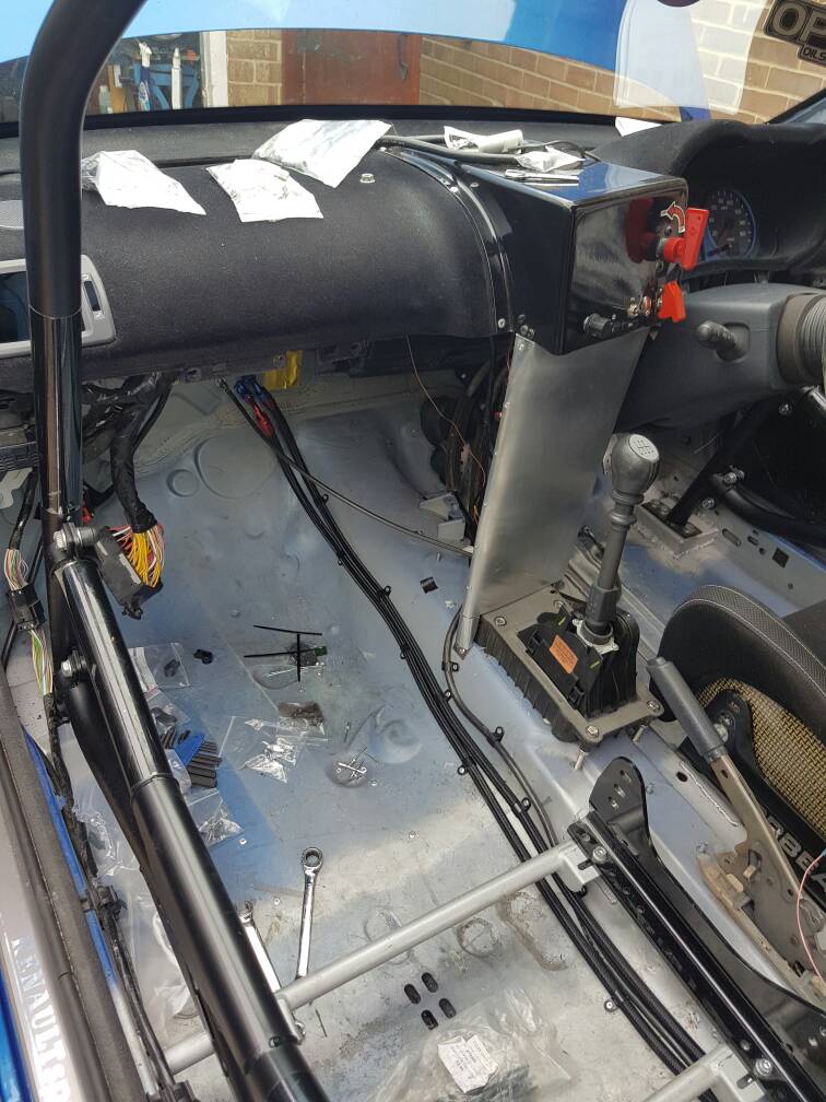

Secondly.. bit bloody messy but that cannot be changed at the moment mounted a few more switches to dash panel
Really happy with the position of everything! Just gotta rivet some alloy to the support bars and put a few more switches on.
Finished the loom for the heater just gotta throw a live and fuse to the switch.
Thirdly - shifter is nearly mounted, just gotta make a spreader plate that goes across the shifter gap to bolt the front 2 bolts too but its strong enough for the moment.

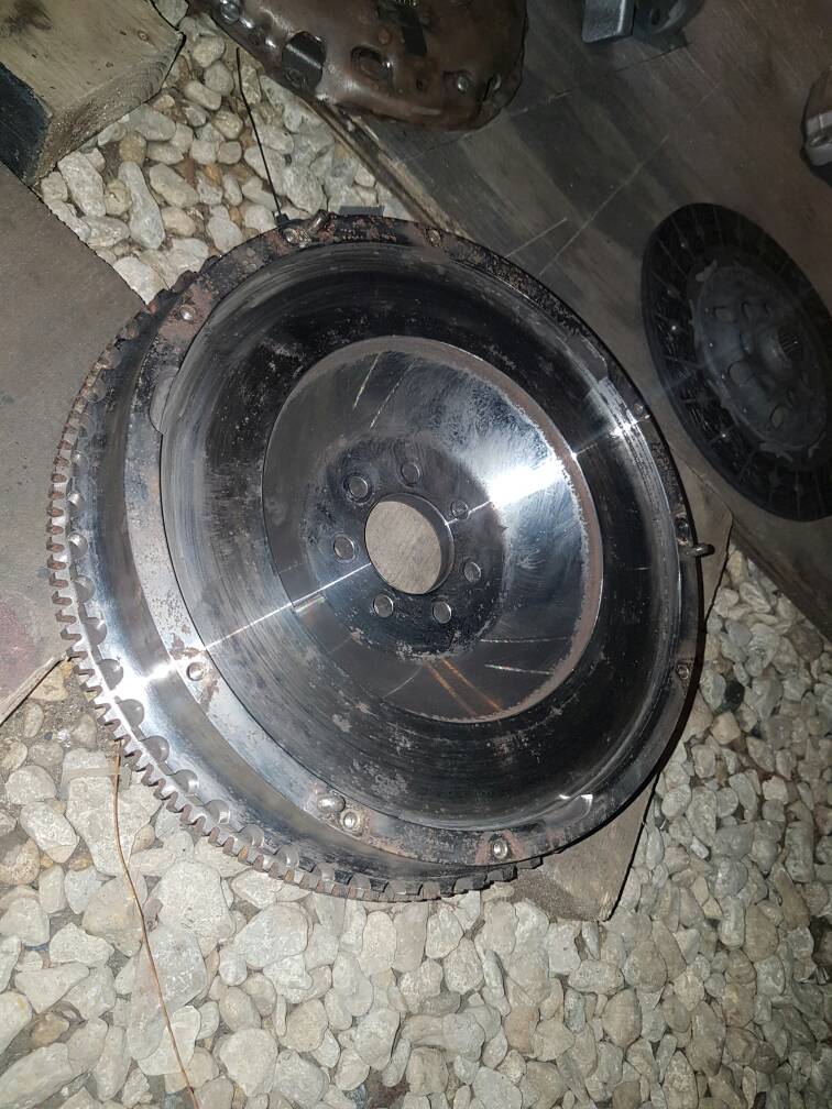

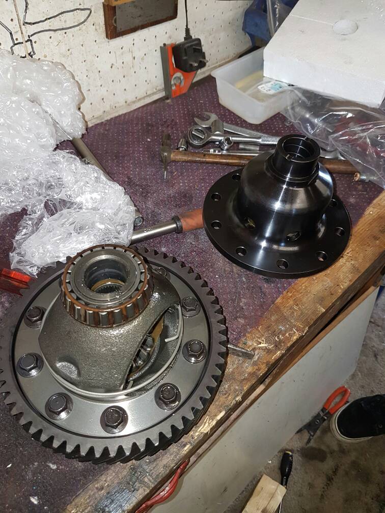

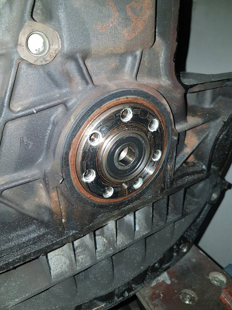

Single mass ready to go on,
Gonna replace crank seal as its here

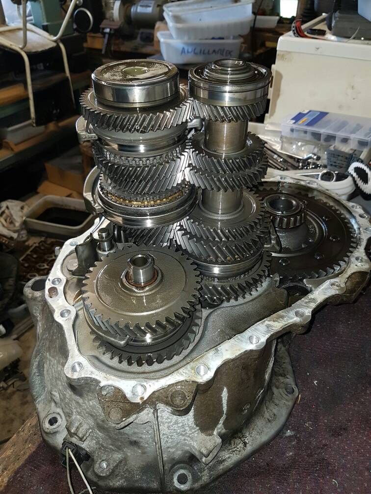

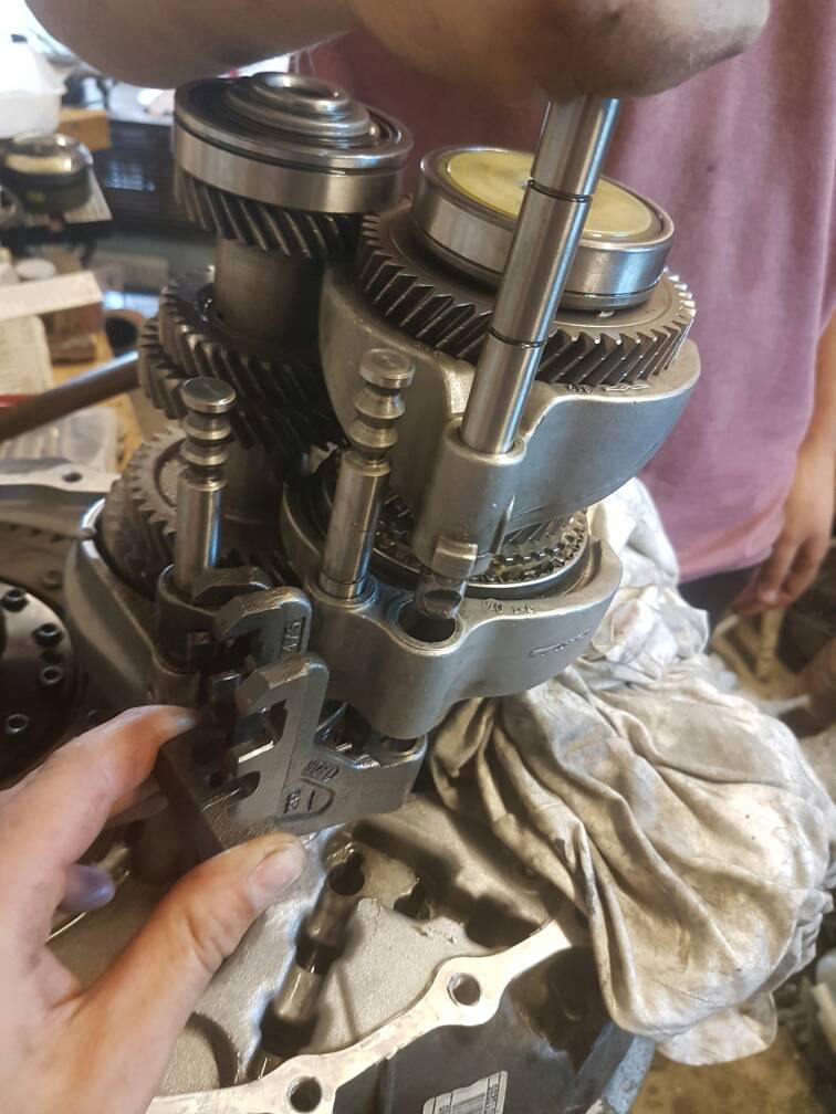

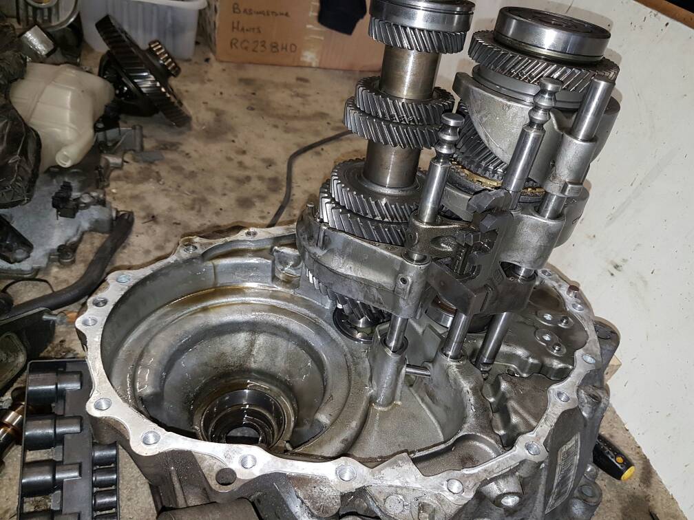

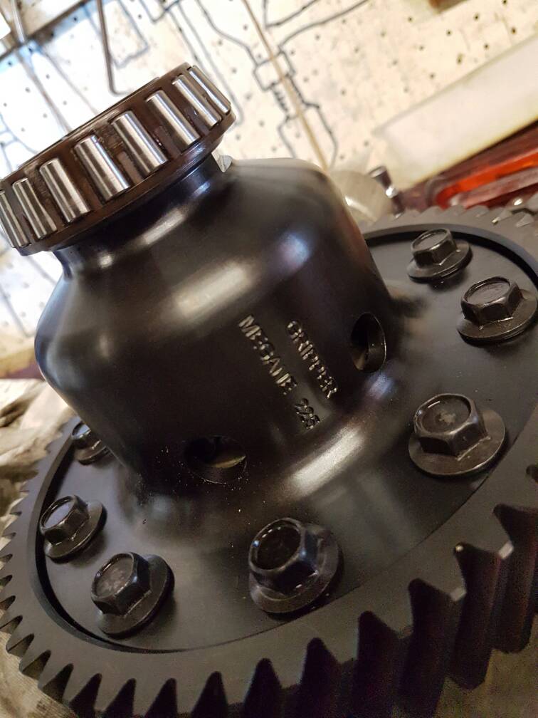

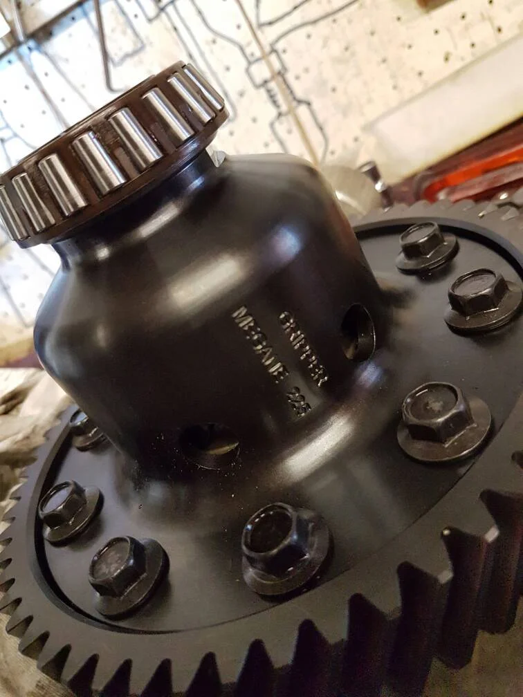

Anyway the big part of the day - Gripper! Thanks to the help of stephen venning and @NorthloopCup over the phone to guide me in place I got stuck
Cover off
After removing all the pinions and ball bearings (well those and some really small roll pins falling out along with what i think is the reverse fork coming out) you give the input shaft a little tap to raise everything up a little, which meant enough room to squeeze the diff out
Gripper is awaiting bearings been pressed on so next weekend we should have the box back together, little nervous on putting it back together but its just remembering which pinion slides in to lock the rods in place before doing the other rods etc should be reet!
How hard was it to do? Never opened a gearbox before and picked a diff up today
Yeah pretty tricky, but that was going in blind!
I had a mate with me whos stripped his clio box and knows what hes doing so its not something id do if i couldnt learn from someone
Fair enough, I'll take it somewhere to get it fitted. Ta
Are you running the gripper at 10% locking to start to bed the plates in?
We did that with mine, only done 1 day session so far so after next session (or maybe before) will increase it to 50%.
I have no idea, if you run it at 10% would that mean further down the line splitting the box and changing it again?
Im not really aware i thought all the ramp angles etc were set in the factory and couldnt be changed...

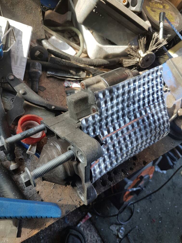

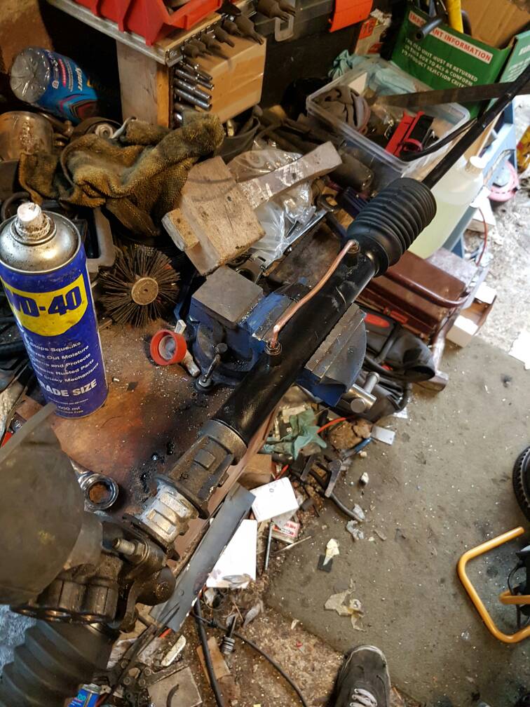

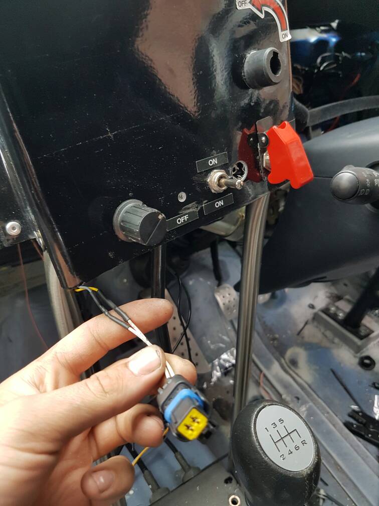

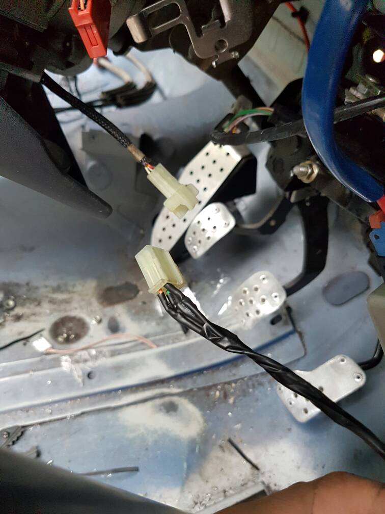

Finally got round to sorting out the epas, the seller for the epas column didnt provide the plugs for live so just got some bigger terminals and insulated them and thats seems to work perfectly!
Also mounted the variabke resistor on the dash, loving the position of everything currently well within reach.
Recycling at its finest using old plugs from redundant looms to make it easily removable from the main loom, if dash/loom needs to come out quickly etc
Should of prethought about that one and covered it in heatshrink first, but bit of leccy tape will sort it hha

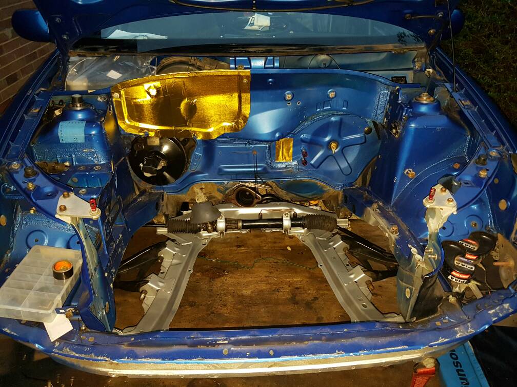

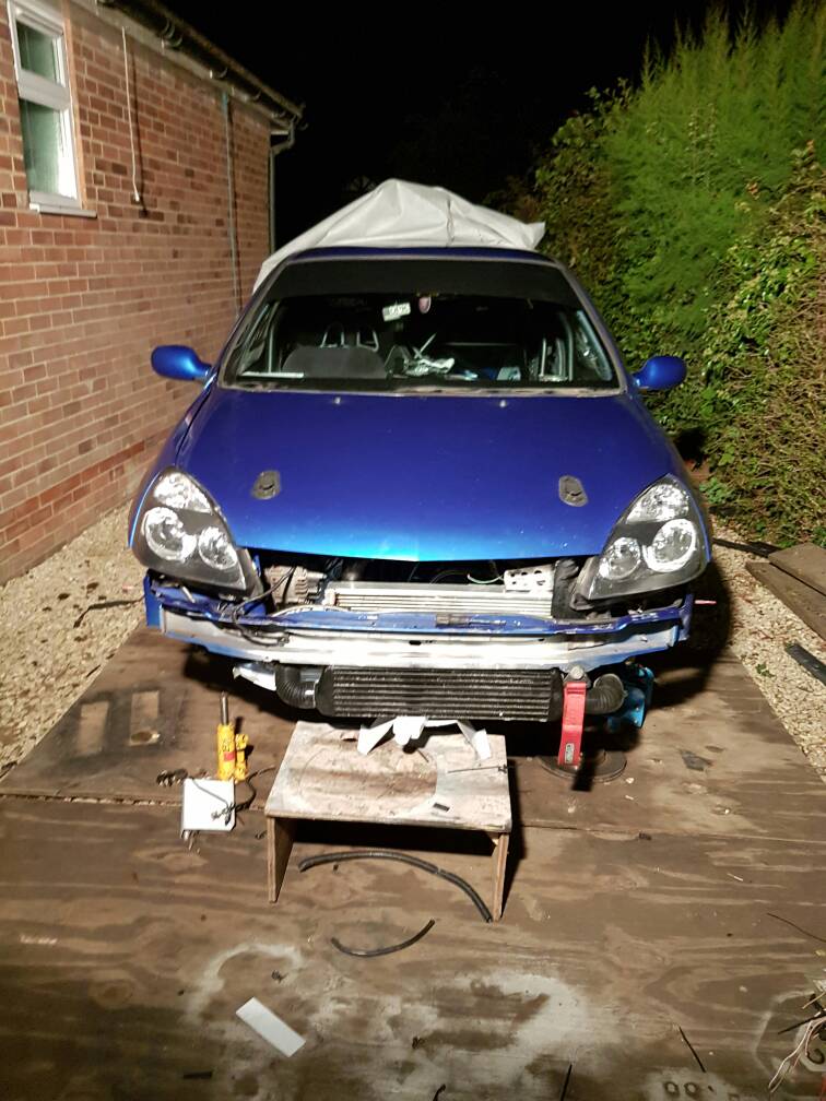

Ey up, so as always come home from work try and make the most of the fading light...
First job, steering rack looped. Was a quick 5 minute job so not perfeto but itll do for what use it does.

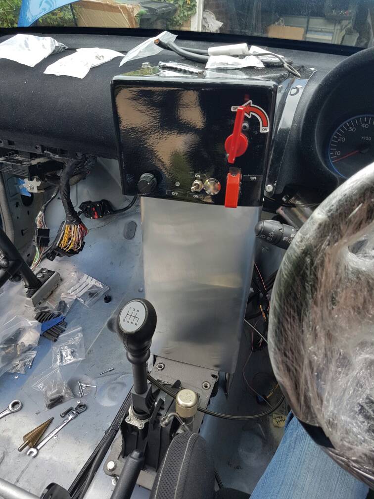

2nd job, sort centre console/dash panel out.
Pretty happy with it, gonna wrap it black so it blends in, and then obviously get drilling to mount some guages on etc
3rd job, subframe on. Not sure if ove put it on to early and will need to take it off later on, but i think itll be ok. New pf black steering rack bushes put on, all the other pf bushes look ok so left them.
Jobs a gooden, hopefuly sort brake lines out tomorrow evening :)

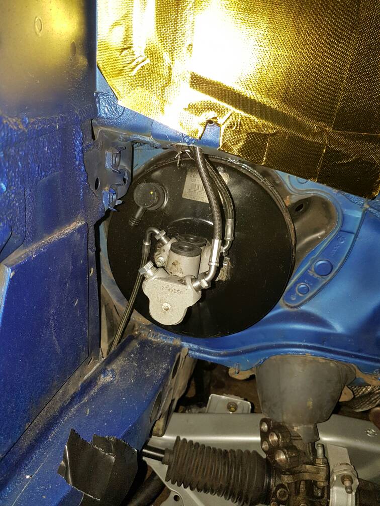

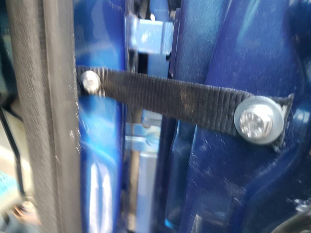

Check strap for fiberglass doors, check..

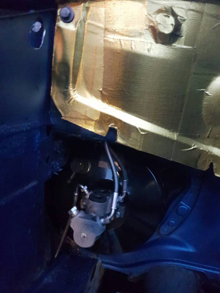

Custom brake lines, check

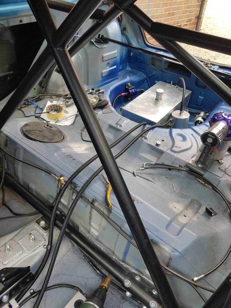

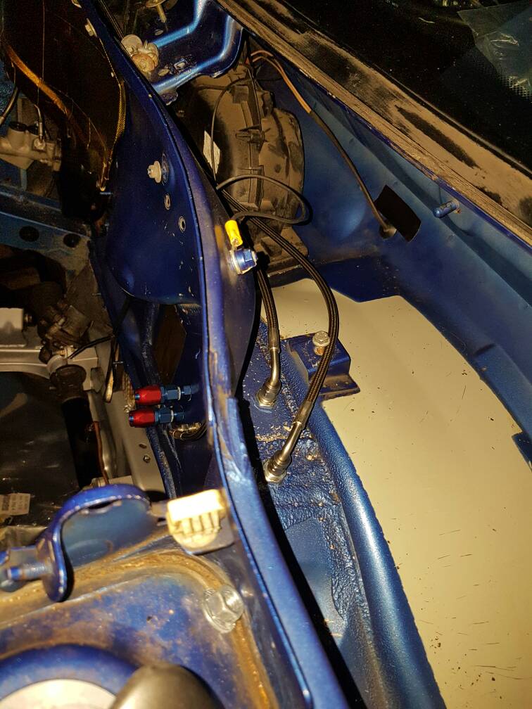

Todays job after a quick morning trip to renault parts direct, fuel lines!

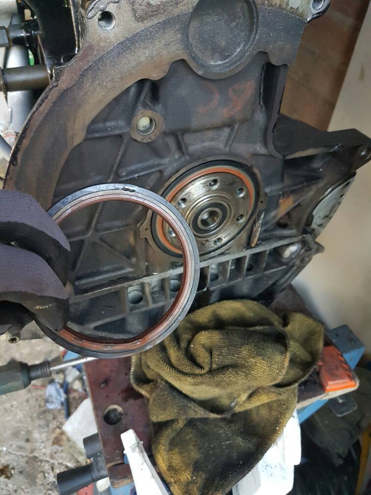

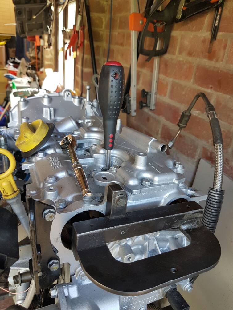

Crank seal fitted as it makes sense to fit it while im here...

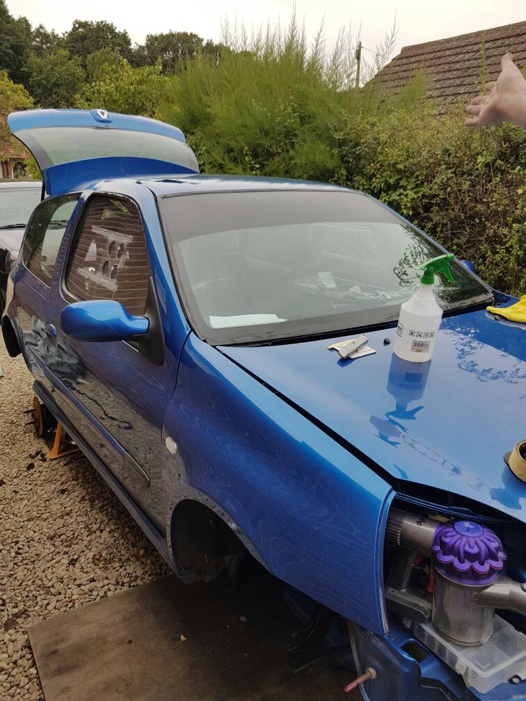

And the last job of the day, fitting the sunstrip which went well, no bubbles, creases etc youd think id have the hang of it by now!

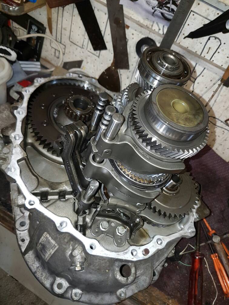

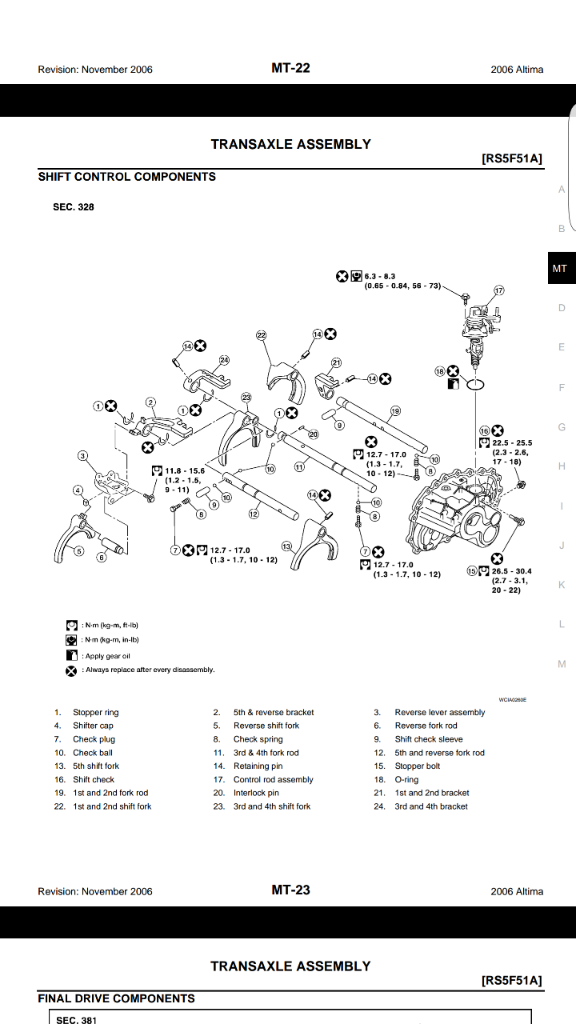

Today was uneventful but eventful.
Went to finish of the gearbox and ended up taking more bits off.
Where the selector rods enter the gearbox and use the retaining pins to act as the "clunk" and to make sure you dont select 2 gears at the same time. Basically wouldnt go far enough in like something was blocking it
The holw gearbox assembly is full of moving pins around to locate the rods but it turns out number 20 had found itself under one of the selector rods number 11. Meaning nothing would sit properly.
In the end this mean completey taking apart the selctor rods punching out the retaining pins to seperate forks from rods.
That meant progress stopped as more pins and circlips were needed.
Hey ho another day

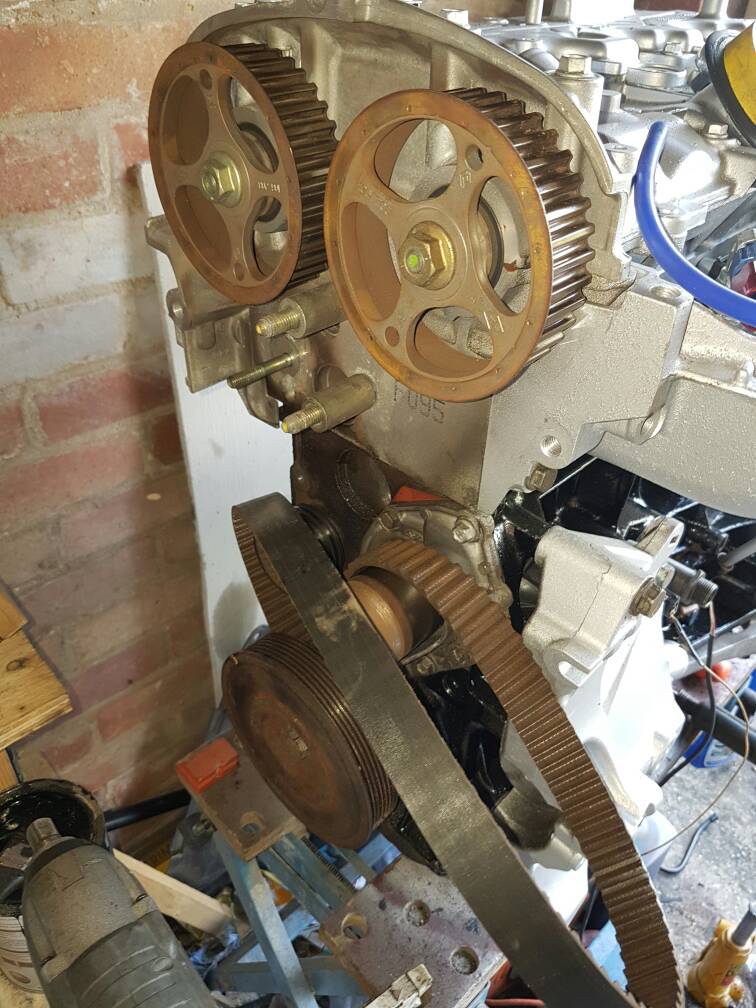

The rest of the day was spent getting the cambelt sorted. This was the first time ive done one on my own and i can safely say its a eaiser job on a f4rt than an f4r.
http://uploads.tapatalk-cdn.com/20160925/2c1ae259844acecef17810c16d9cc659.jpg[/IMG
There we go, 2 things id thought id never be able to do, with a bit of time researching and asking a lot of questions possibilities for learning are endless! Onwards and upwards

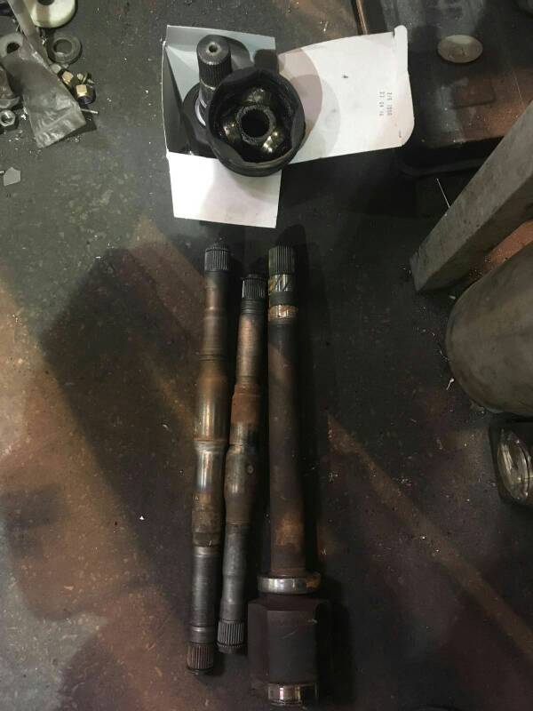

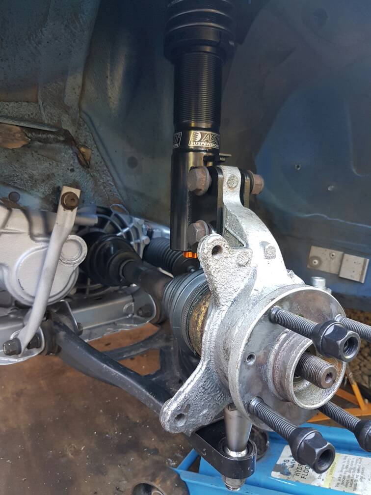

Driveshafts are done!

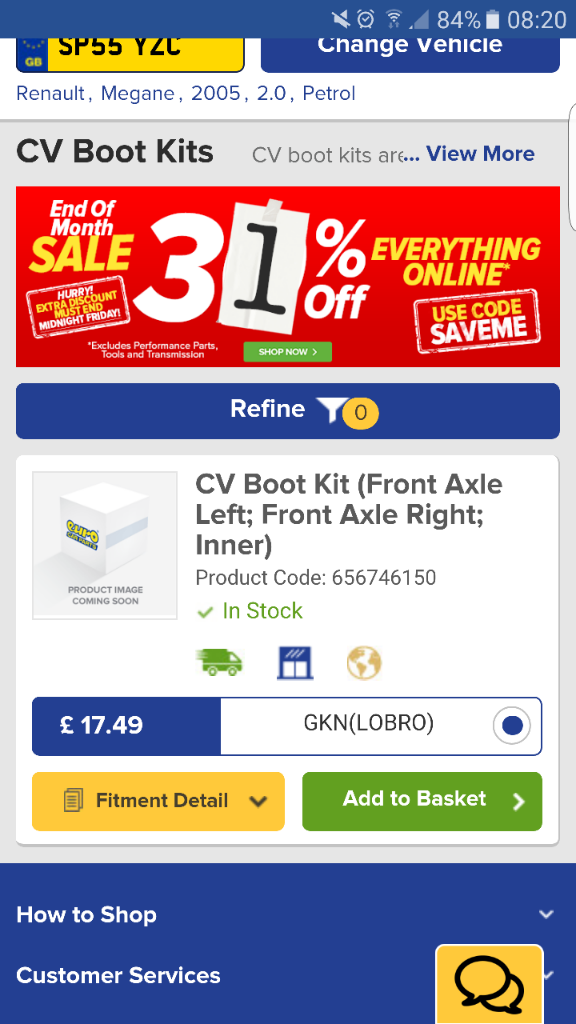

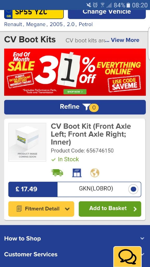

Anyone know of any good aftermarket inner cv boots? And outer for that matter...
But cannot find any aftermarket inners.
Renault do them at £40 but x 4 becomes a bit pricey.
Old girl
If they do them, you can't go wrong with 'GKN Lobro' boots mate.
Sent from my HTC 10 using Tapatalk
Alright bud ill have a look!

Just ordered these from euros should be good for inners

I can get those though work for £11.76 inc VAT bud if your'e interested? Every little helps and all that!
Dont worry mate already paid for them at £27 for both, but will bare you in mind next time! Cant seem to find any outer boots though on their site?!

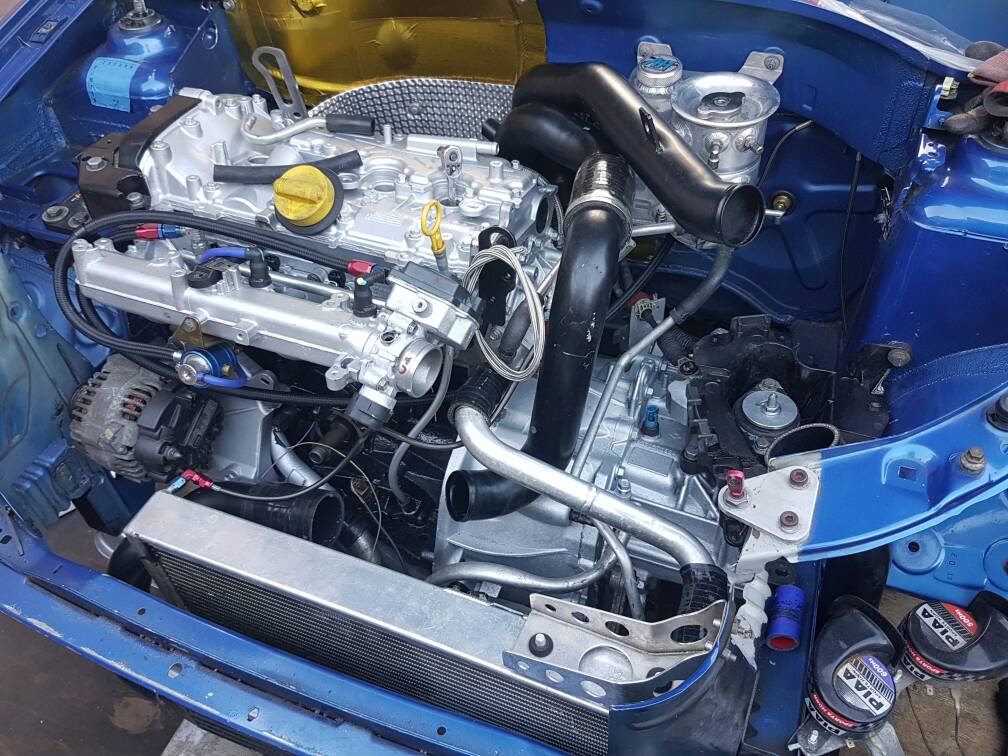

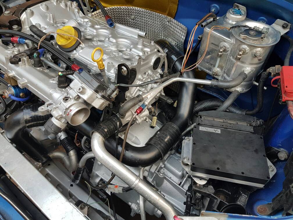

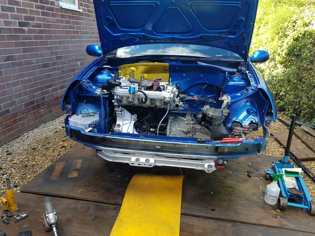

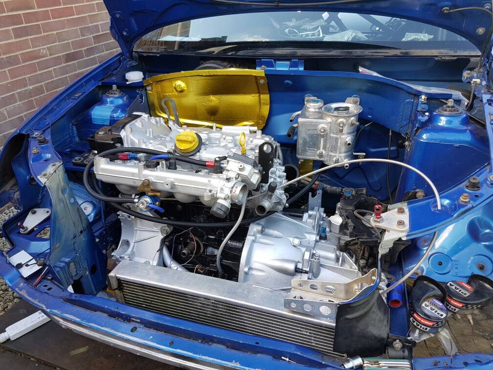

God im happy with how its coming together!

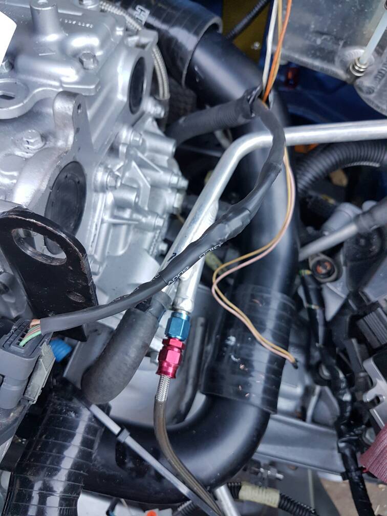

Boost pipes are a right c**t!
Should be getting there with it now ive finnaly realised how things go, although header tank will need to be moved for space.
Pass side driveshaft fits, didnt have the cv boots for the drivers side so no progress on that side

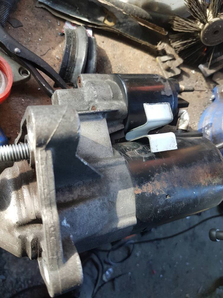

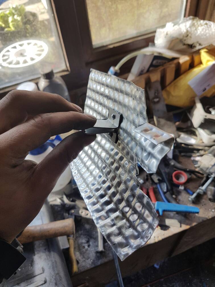

Lost my heatshield for starter

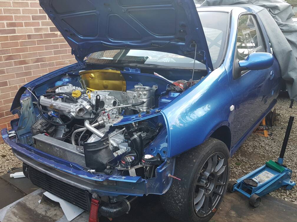

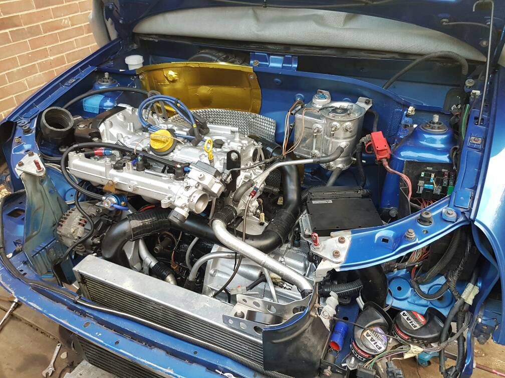

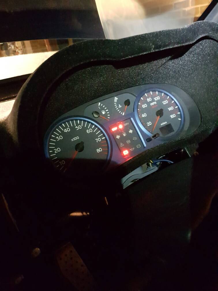

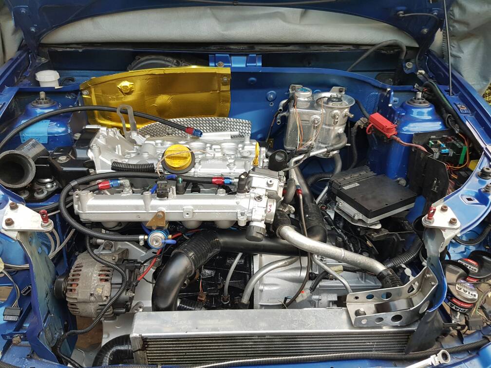

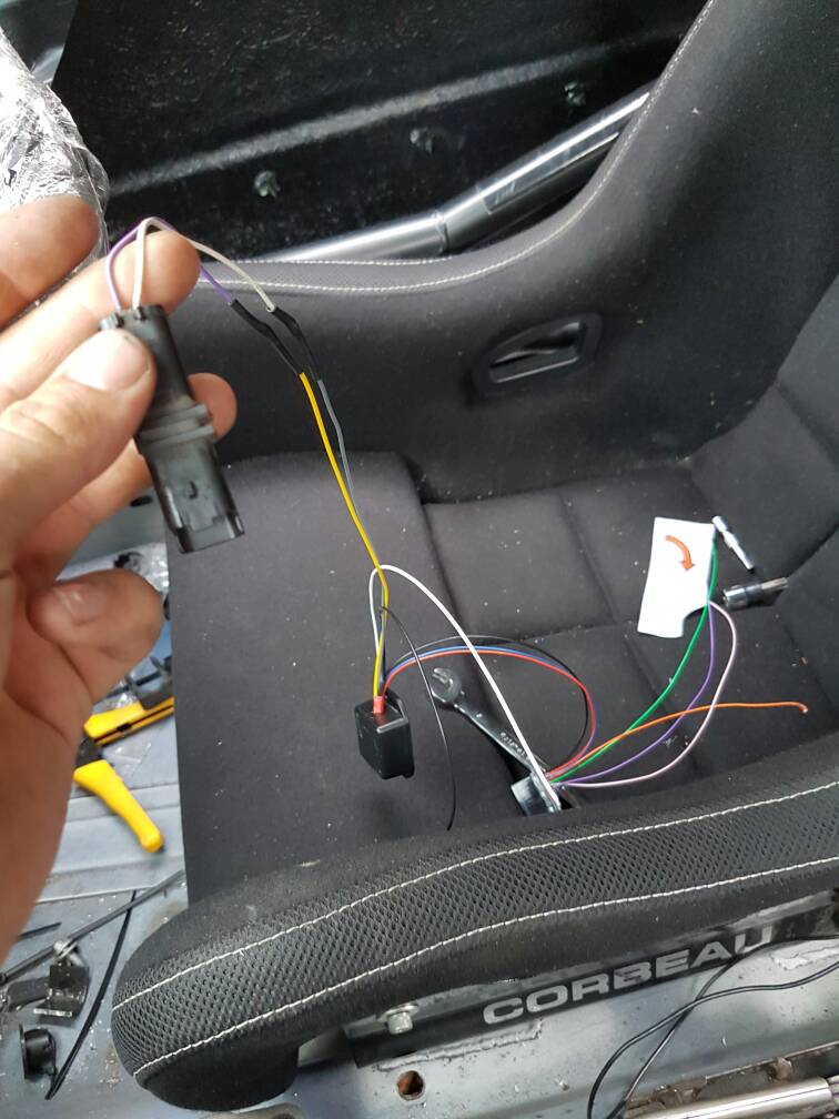

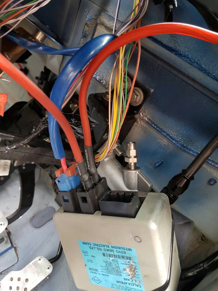

Few updates, loom is grtting there, throttle body loom has been modified, just map sensor and cranks sensor to go.
The engine turns over and i have ignition and lights, not much else though due to no speedo or fuel guage - the dash is pretty useless now haha
There we go, throttle body isnt responding when ignition is on so i dont know whether it needs some sort of calibration with the ecu... or i have wired it in wrong or something, but we'll get to that stage later on...
Still gotta finish off boost pipes and as above map sensor and crank sensor, sort a bracket for coilpack, and when the fuel line arrives plumb the engine bay return line in.
Then look at getting base map on it so it can be started...

Oh also the trip computer or anything isnt lighting up? Not sure if thats related to the throttle body?
