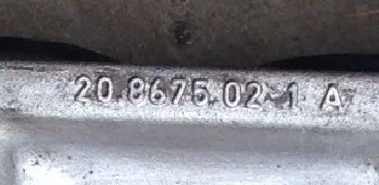

This is a crop of my own picture of a caliper taken from a Megane 225 which is the same caliper as the 197's etc. The code is found on the leading edge that goes toward the front of the car when fitted.
Afaik, 130mm is the same bolt spacing and if I recall correctly, the piston diameter is 40mm x 29mm height for all four pistons. I do recall speaking to someone who had some brembos taken from a Porsche and I think he was saying that at least one pair (leading or trailing, I forget) is smaller than the other, but I think his were rear calipers. Google suggests they're not the same caliper, albeit very similar. That doesn't mean they can't be fitted though, you just need to check the dimensions.
