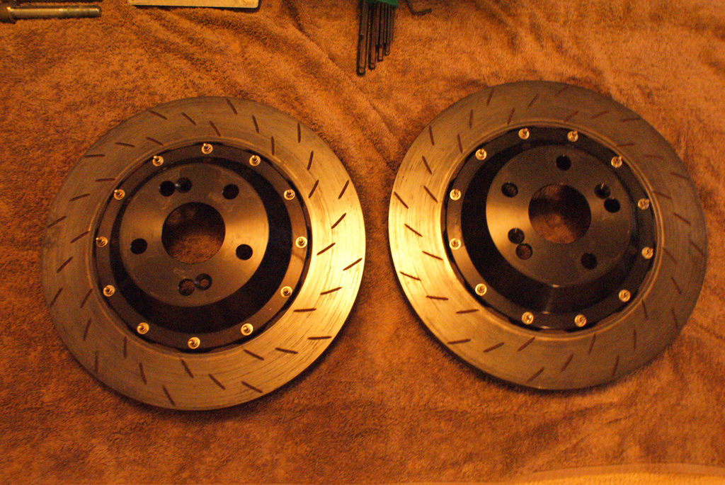

Another quick update. Had a drive over to Chester yesterday and exchanged a small amount of currency for these beauties:
PF 330mm Discs by PoobahUK, on Flickr
Performance Friction 330mm 2 piece fully floating disc set-up. I hadn't intended to uprate the discs just yet but at the price these came up at, i'd have been a fool to ignore them.

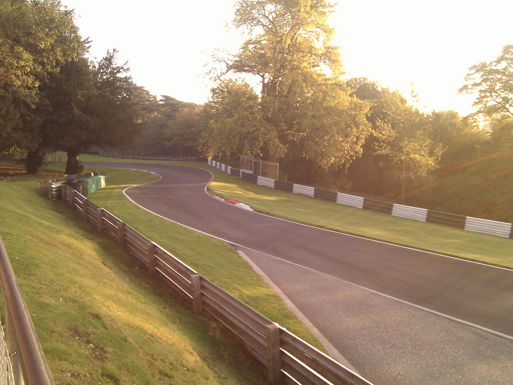

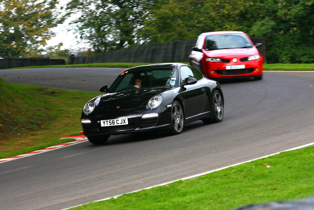

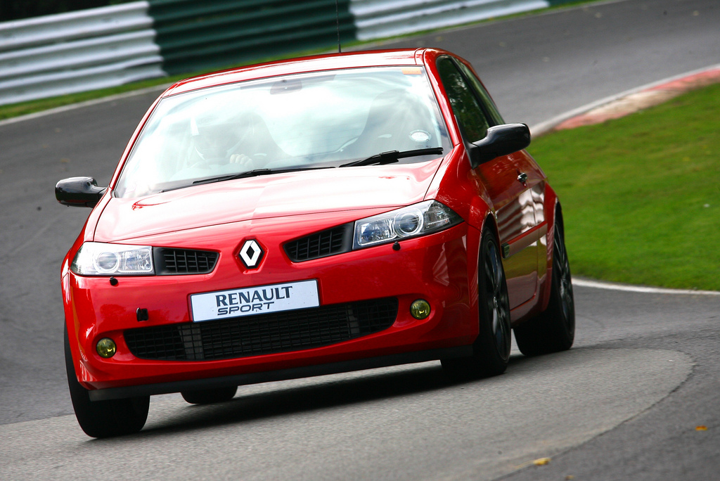

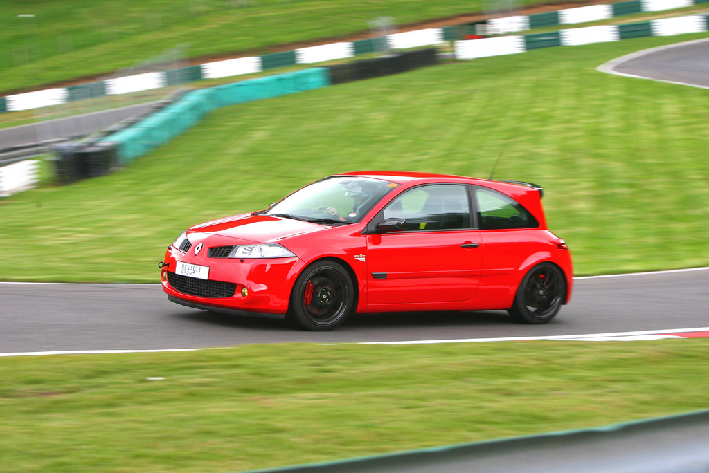

Had a great day at Cadwell Park today with MSV. The car performed faultlessly, so well that I wasn't passed in the entire day. Chuffed with that. Also had a great 6 lap play with a very pleasant chap in a 911 Carrera which was fun.
Strong points of the car at Cadwell were definately the 330mm PF brake set-up. The 911 was a fair bit swifter on the straights but I could make up so much ground under braking. A really fantastic set of brakes which provided fade free braking all day, even if they do sound like smashed crockery!
Other than that, the chassis just gave so much confidence. So intuitive and predictable going from grip to slip. Fantastic.
Weak points were again the tyres. Don't get me wrong, the Vreds performed admirably but after 6 or 7 laps you could tell they had too much heat in them. Still impressive for a road rubber with such decent wet weather grip.

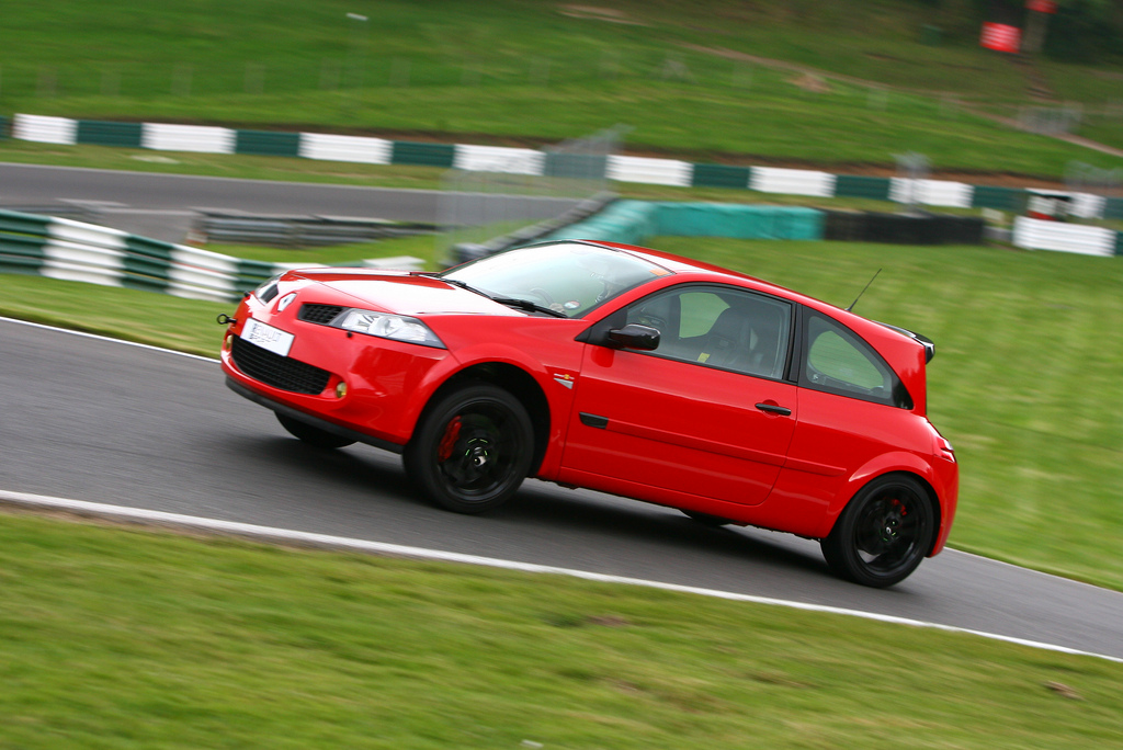

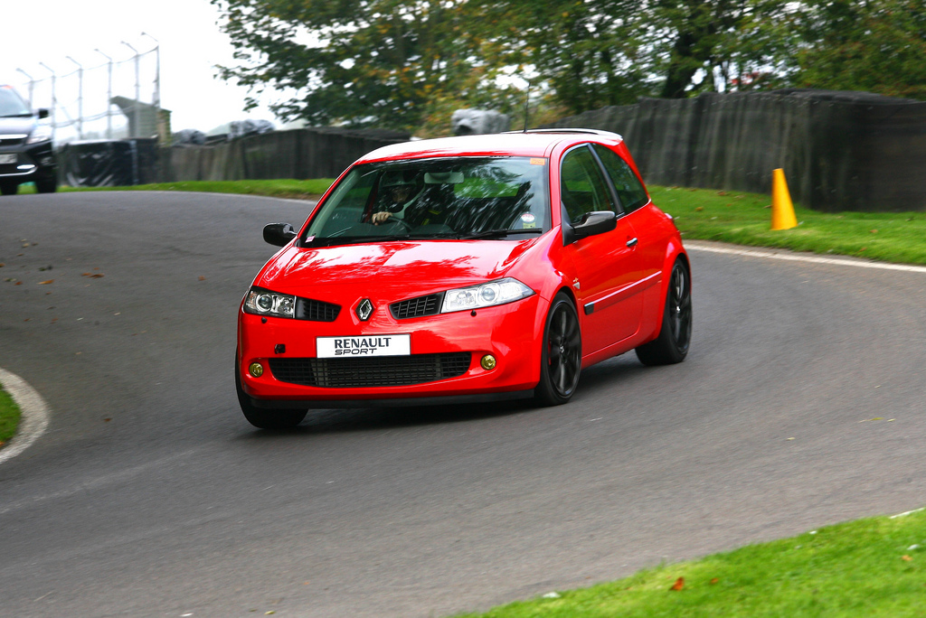

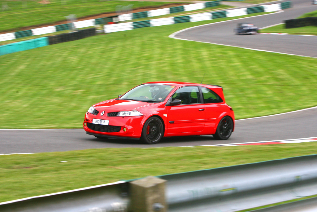

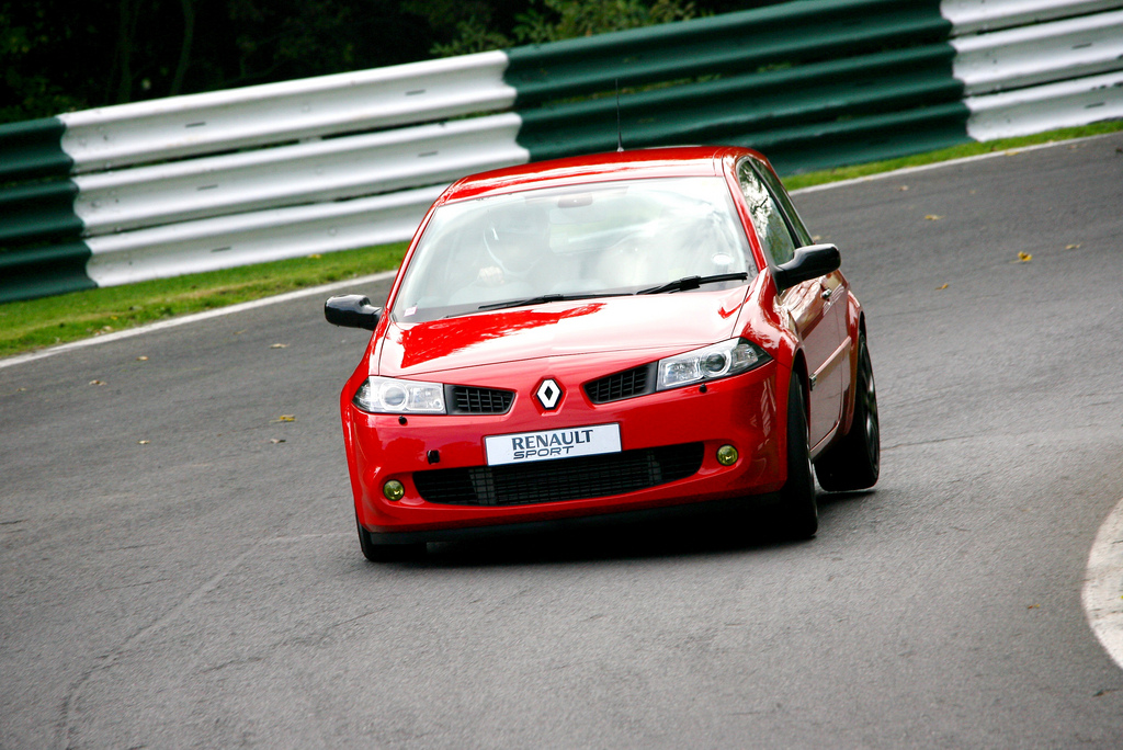

Out on track.
LMP_9482_9.00 - 9.20 by PoobahUK, on Flickr
LMP_4503_15.00 - 15.20 by PoobahUK, on Flickr
LMP_4418_15.00 - 15.20 by PoobahUK, on Flickr
LMP_4422_15.00 - 15.20 by PoobahUK, on Flickr
LMP_2417_12.00 - 12.20 by PoobahUK, on Flickr

Absolutely. This was the situation with the 911 in the above pictures. Had a great 6 lap play with the Porsche which pulled away on the straights but I could make up so much time on the brakes and corners. A really close match-up with both cars having their benefits.

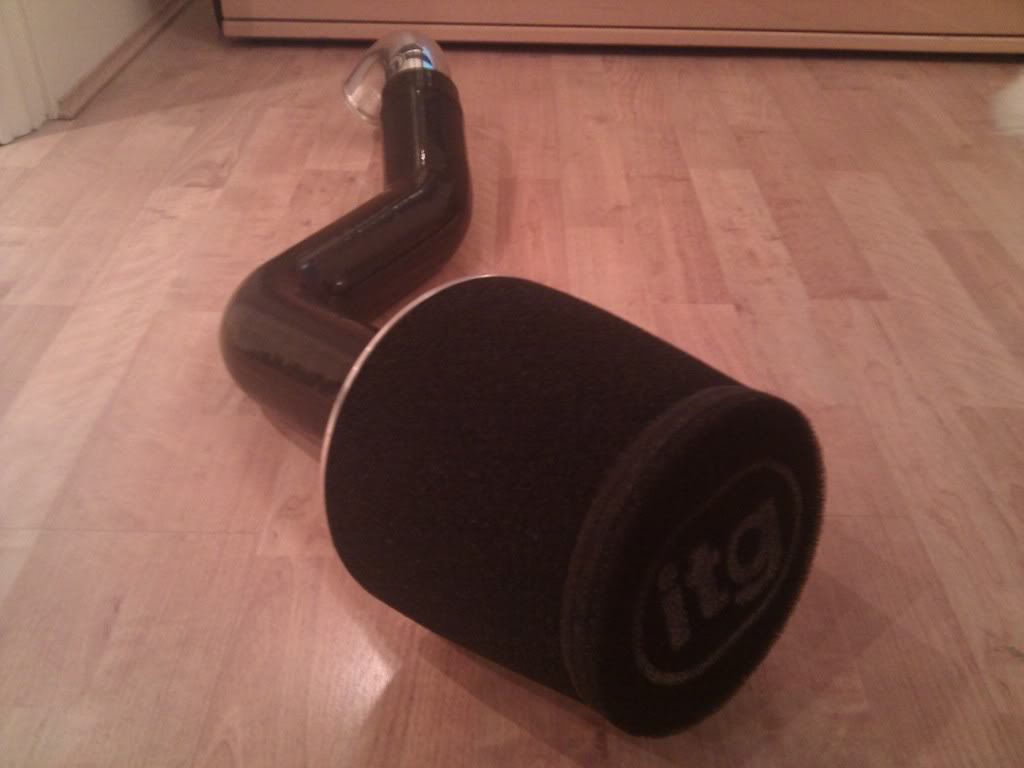

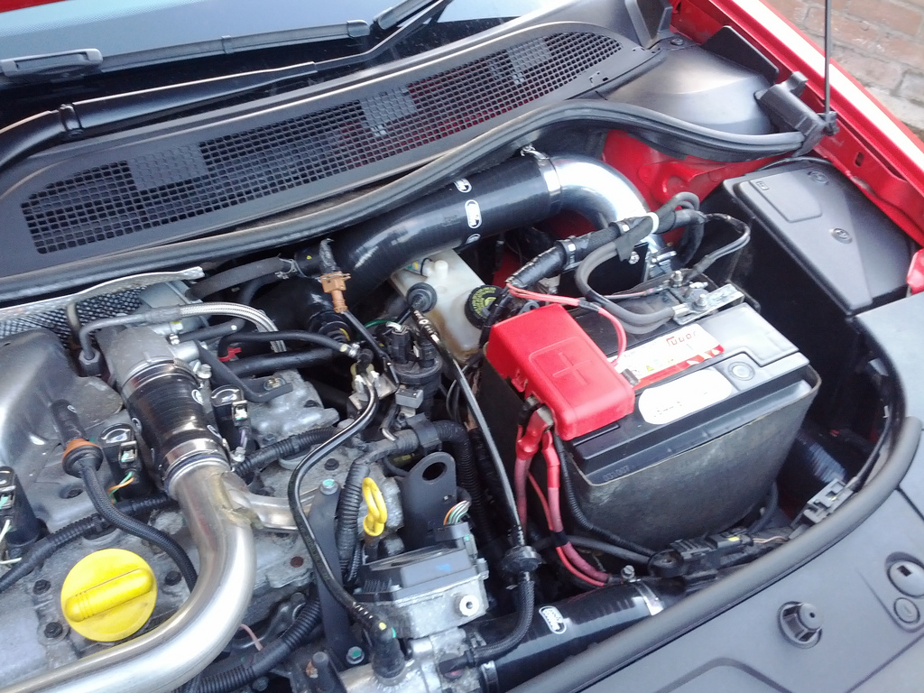

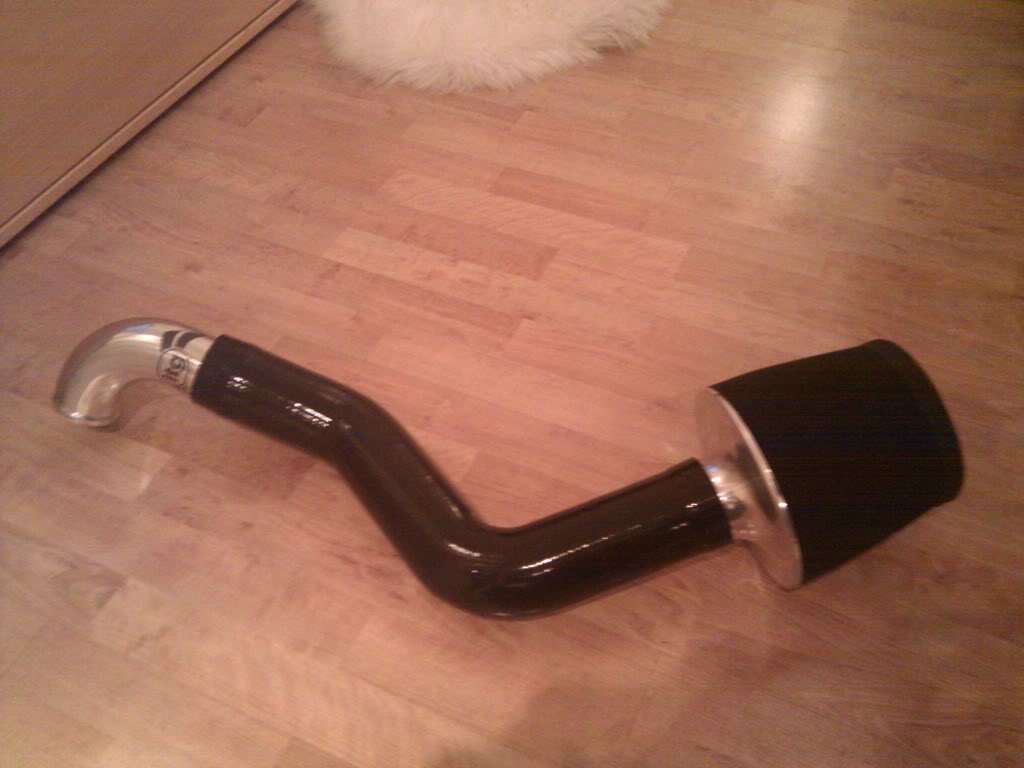

Small update. The car hasn't really moved since getting its 4 year service at Birchdown but since the last update i've had a new set of rear drilled discs, performance friction 97 rear pads and another flush through with RBF600.
I also finally got round to using my ITG Cosworth 60/67 filter which i've had sat around for the last few months.
ITG Intake by PoobahUK, on Flickr
Air filter relocated inside the front arch/bumper cavity.
Seems keen with this set-up on. Intake temps on Scangauge are comparable to the standard set-up so assume the increased 'urgency' is down to it being a less restrictive intake rather than it being supplied with colder air. The noise is ridiculous so we'll have to see how long I keep it on for. Looking at the hosing used for the ITG kit I suspect it's not going to compress down unless you're going for forged engine type power however I might consider asking ITG about the possibilities of it being hard-piped.
  Nimbus Megane R26
hmmm would be interested in that setup for mine.. does that come as a kit with the pipework included??
  R26 + EV0 FQ340
How much bigger is the Cozzie filter Poob and would it make any difference to the amount of available air? I can see It helping up to a certin point then thinking it would be governed by the ITG hose size.
