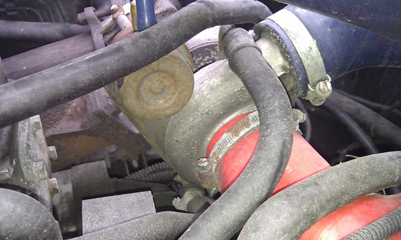

few questions, is this the turbo? im pretty sure it is but ill check anyway
secondly im gonna be fitting an incar boost controller. from what ive read, i need to remove this actuator (think its called that), and extend the pipes to the inside of the car.

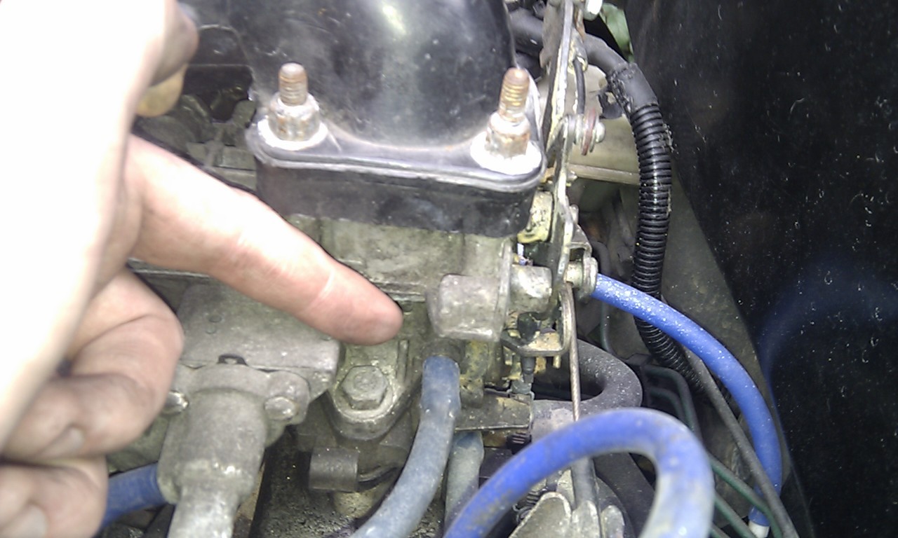

now, from this actuator, i have a pipe running to the turbo (?)
and a pipe running to the throttle cable unit thing

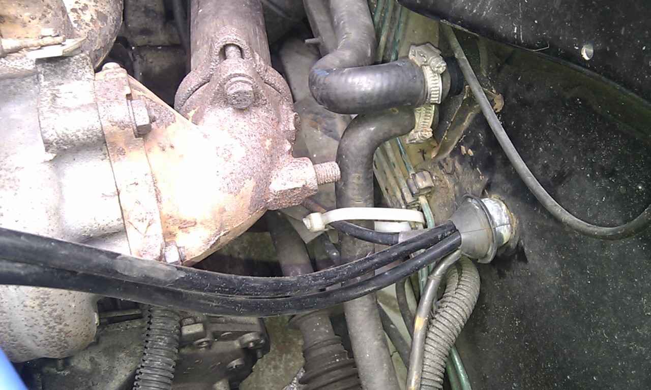

ive got the hose plumbed into the bulkhead and ready to fit the controller, ive also plumbed in the hose for the boost gauge

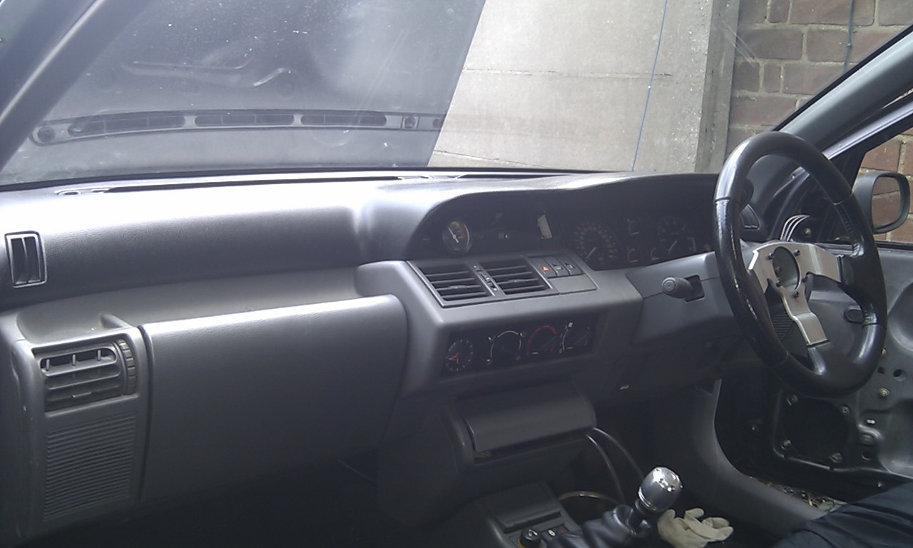

heres a picture of my rebuilt dash for anyone that helps, ta! ;)

This is the actuator mate:

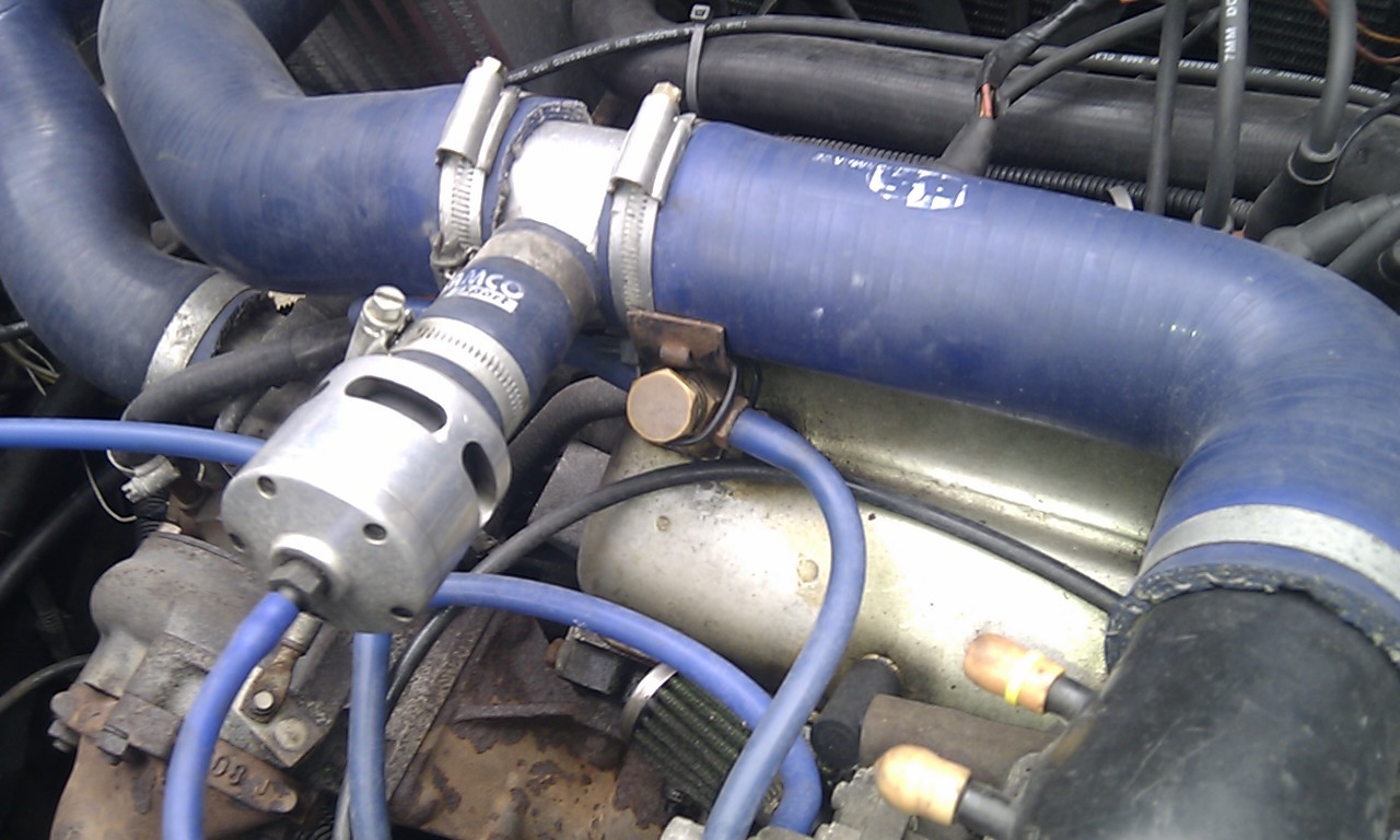

This is a dump valve:

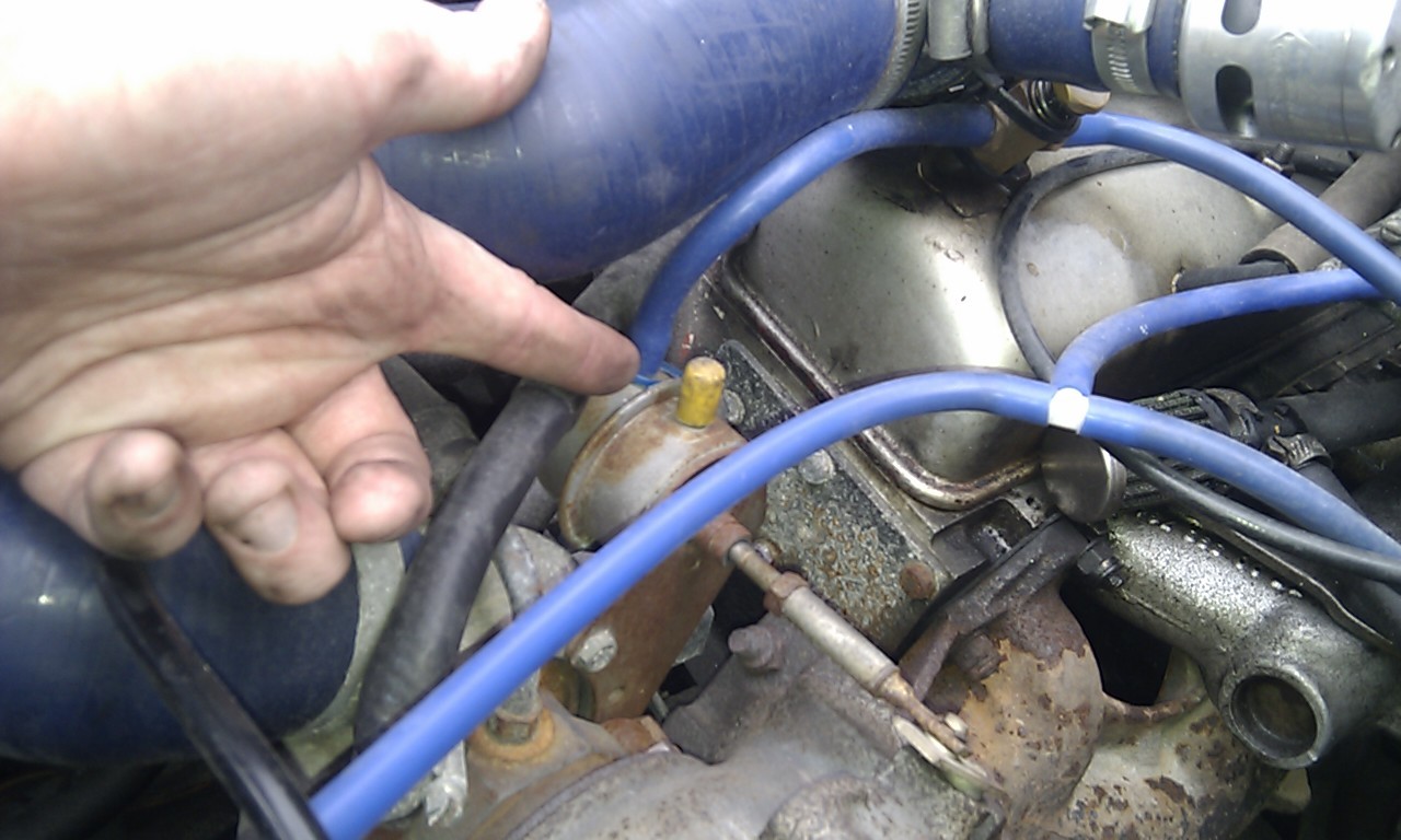

You already have a boost controller installed by the way:
The thing cable tied under the dump valve.

so that thing is a boost controller? someone said there was another way to adjust the boost levels, either by the circle thing, or you can adjust it on something else?
