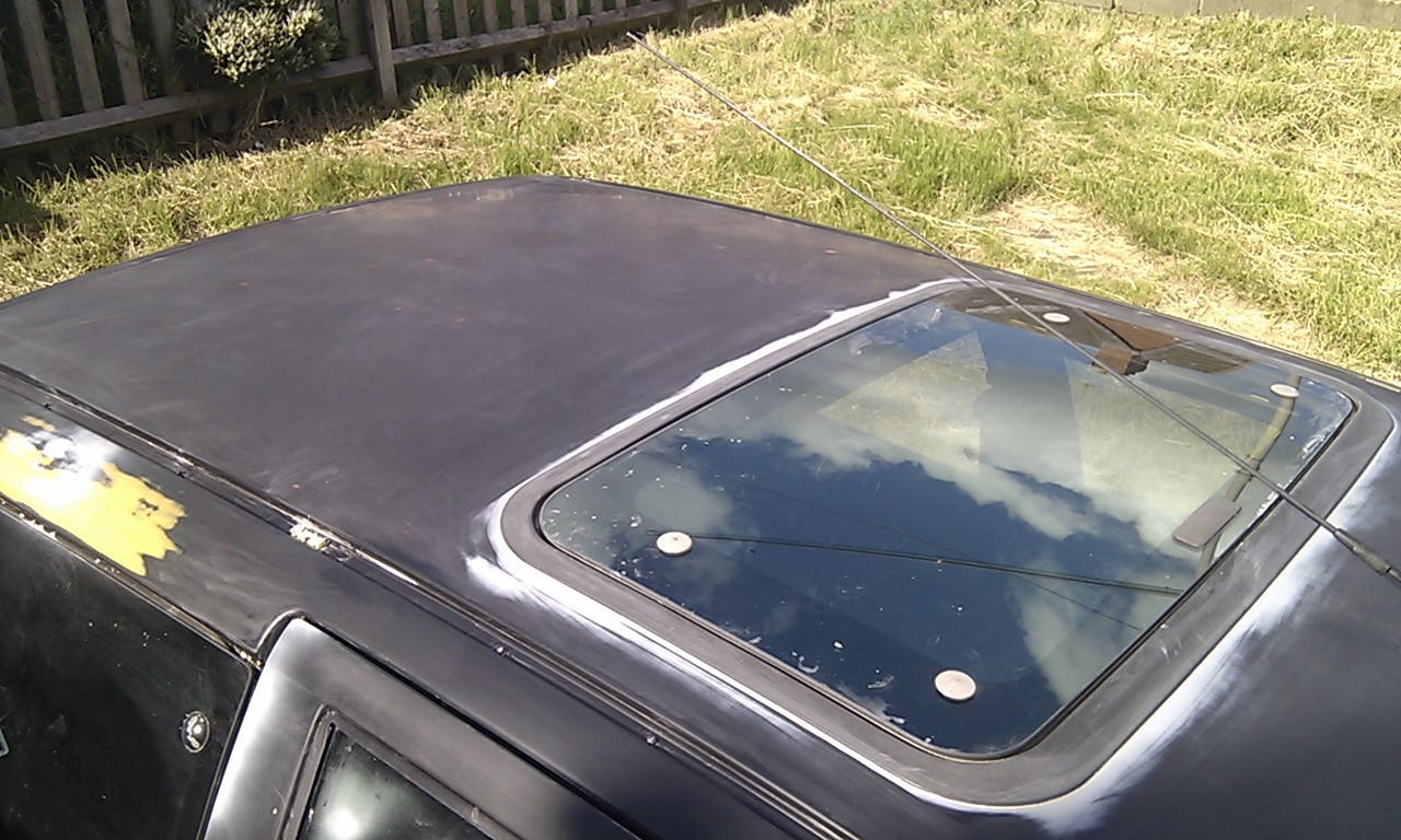

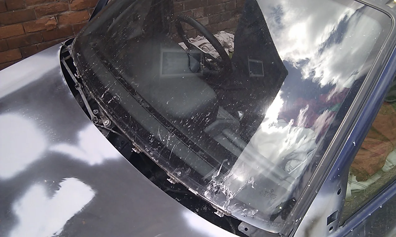

sunroof bonded in

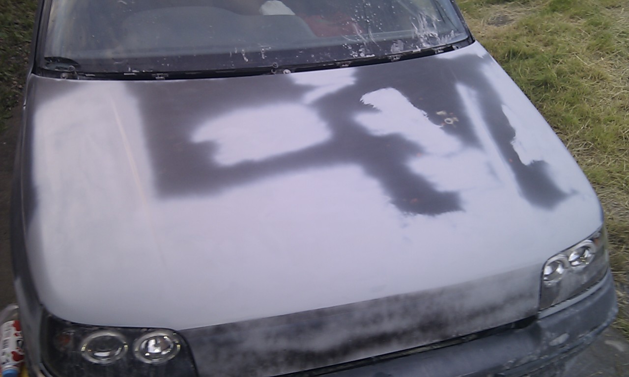

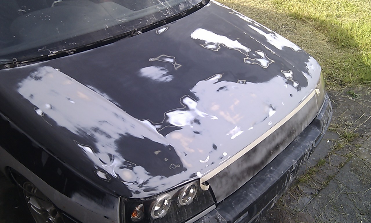

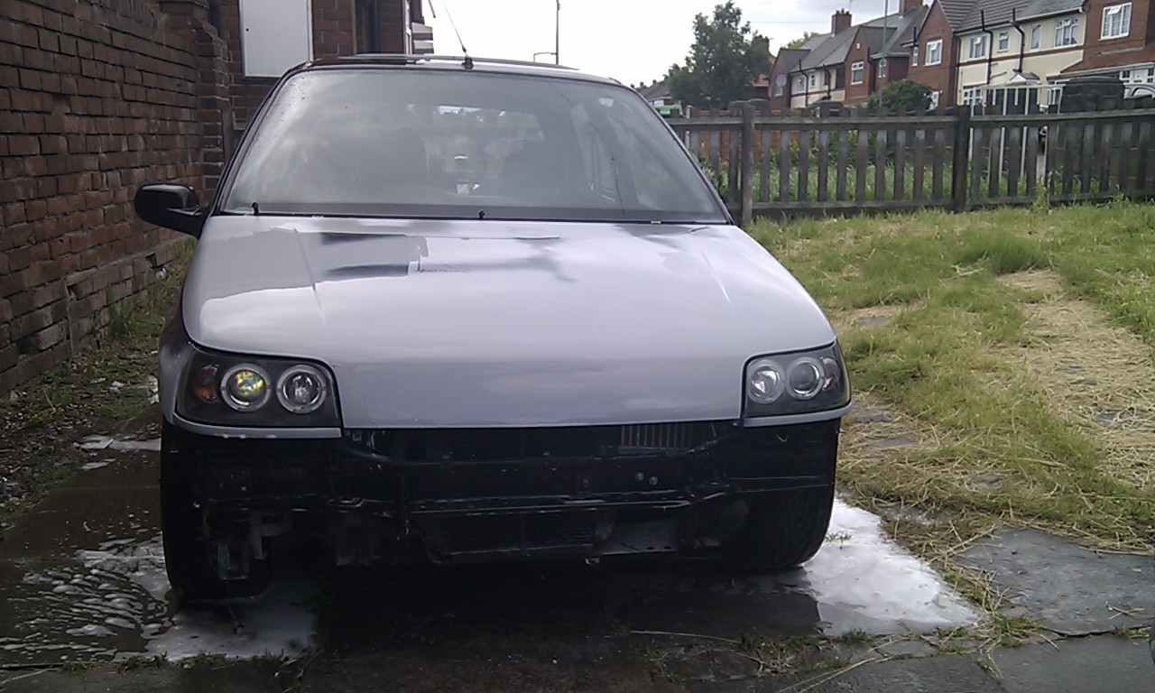

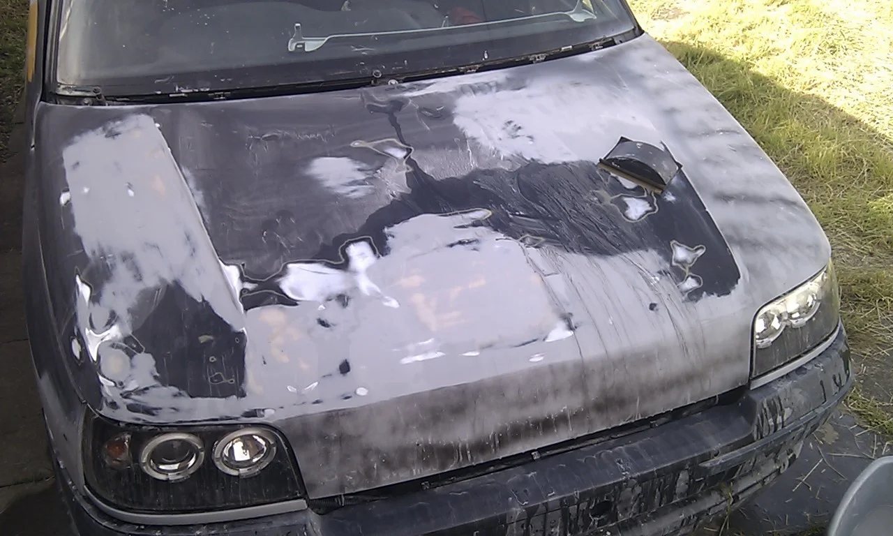

bonnet filled

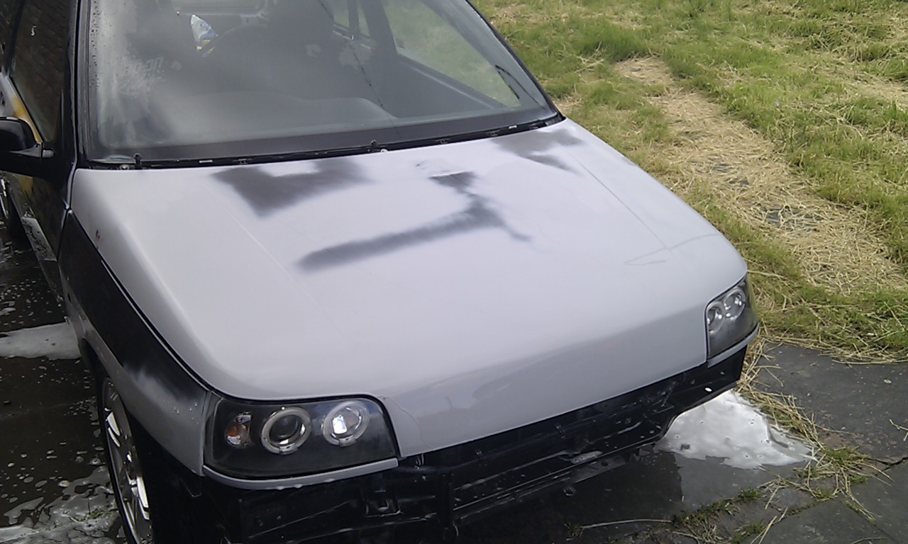

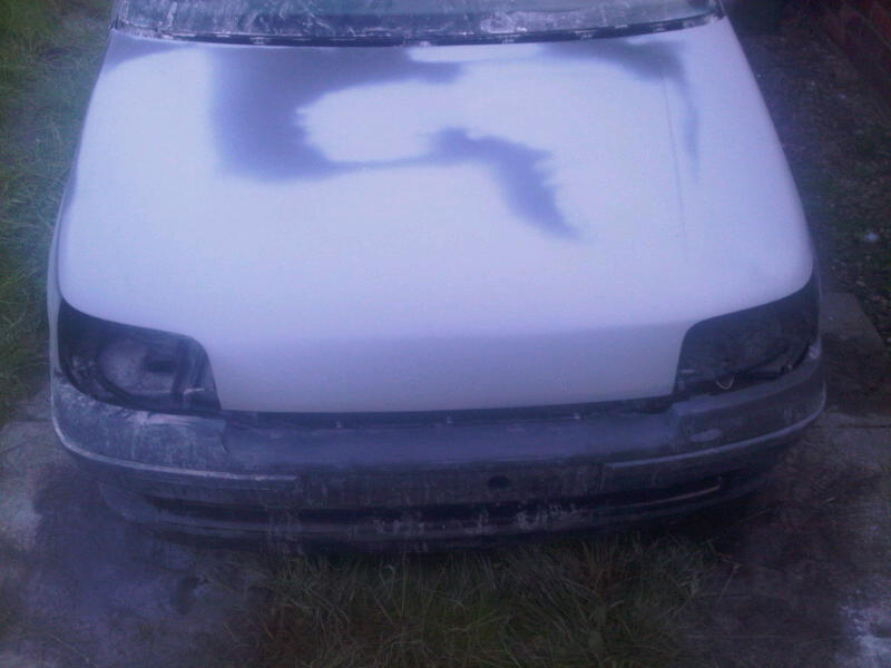

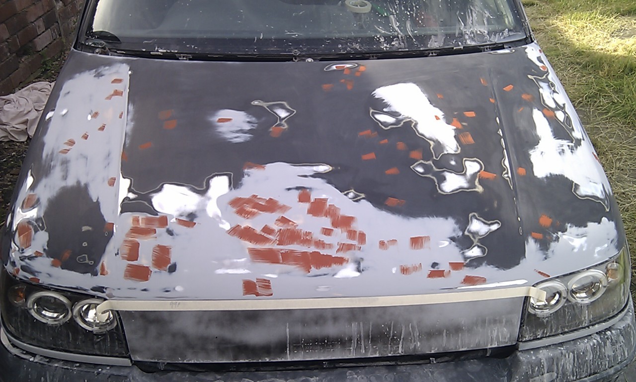

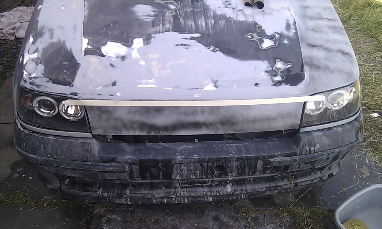

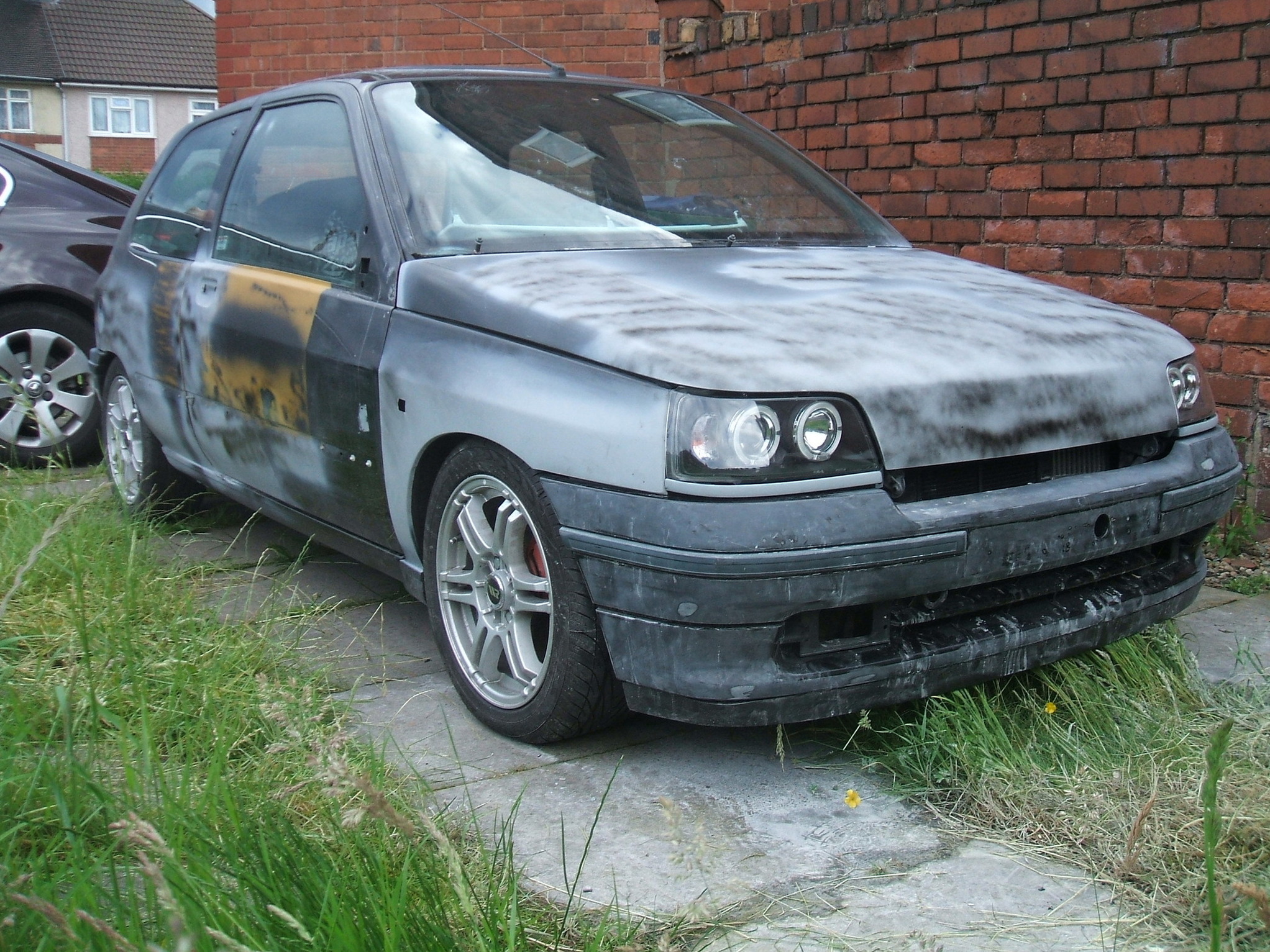

bonnet primed, just needs guidecoating and the line straightening up, few pin holes to fill in aswell

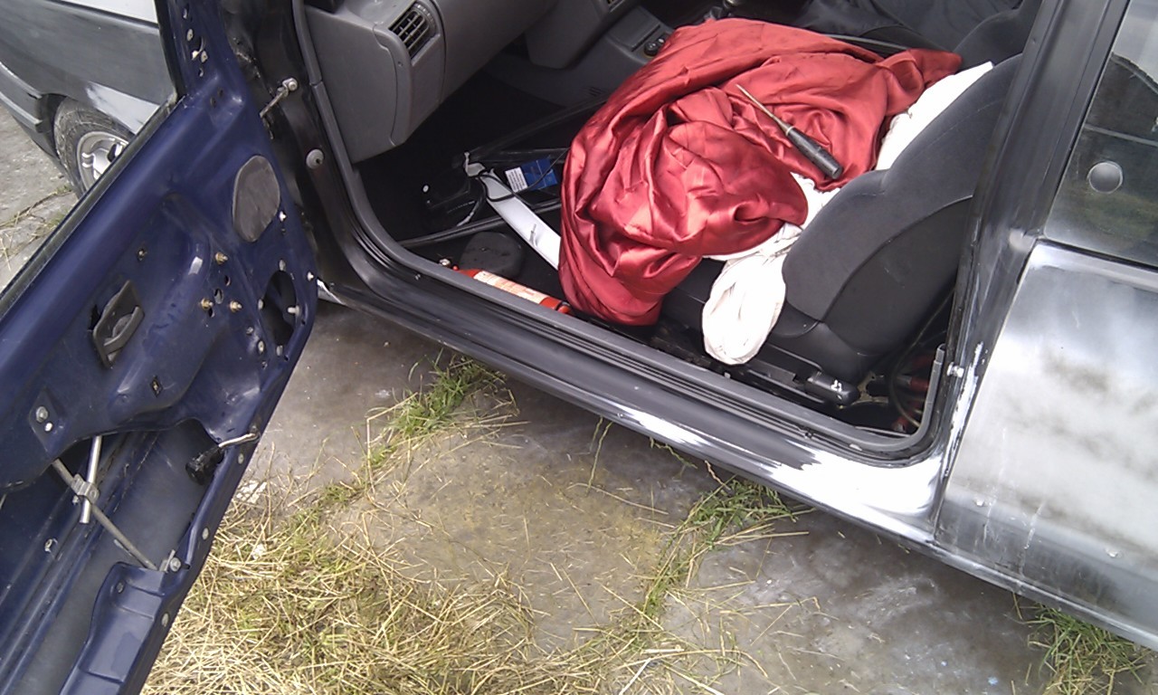

bit of work today before the football. making sure everything fits properly now, so when i come to rebuilt it when its painted, i aint gonna scratch anything messing about.
adjusted bonnet,
fit hockey sticks,
ph2 grille ive had to modify slightly as i have no way of mounting it with the angel eyes. ive had to fabricate a couple of little rubber mounts to go on the bumper, then it will be screwed and fixed to the bumper.
headlights all working fine,
sunroof aint leaking,

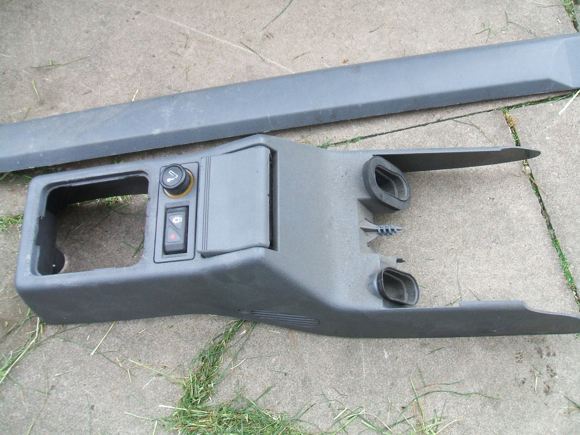

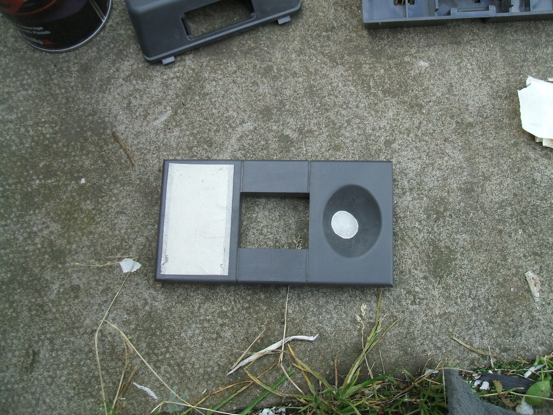

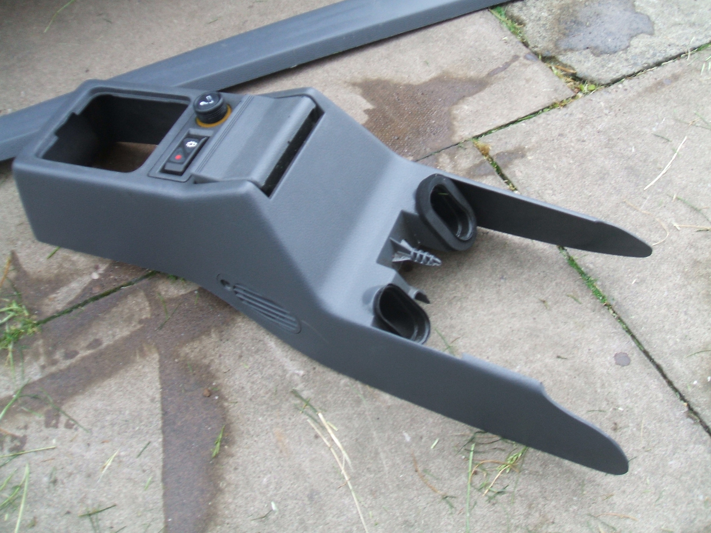

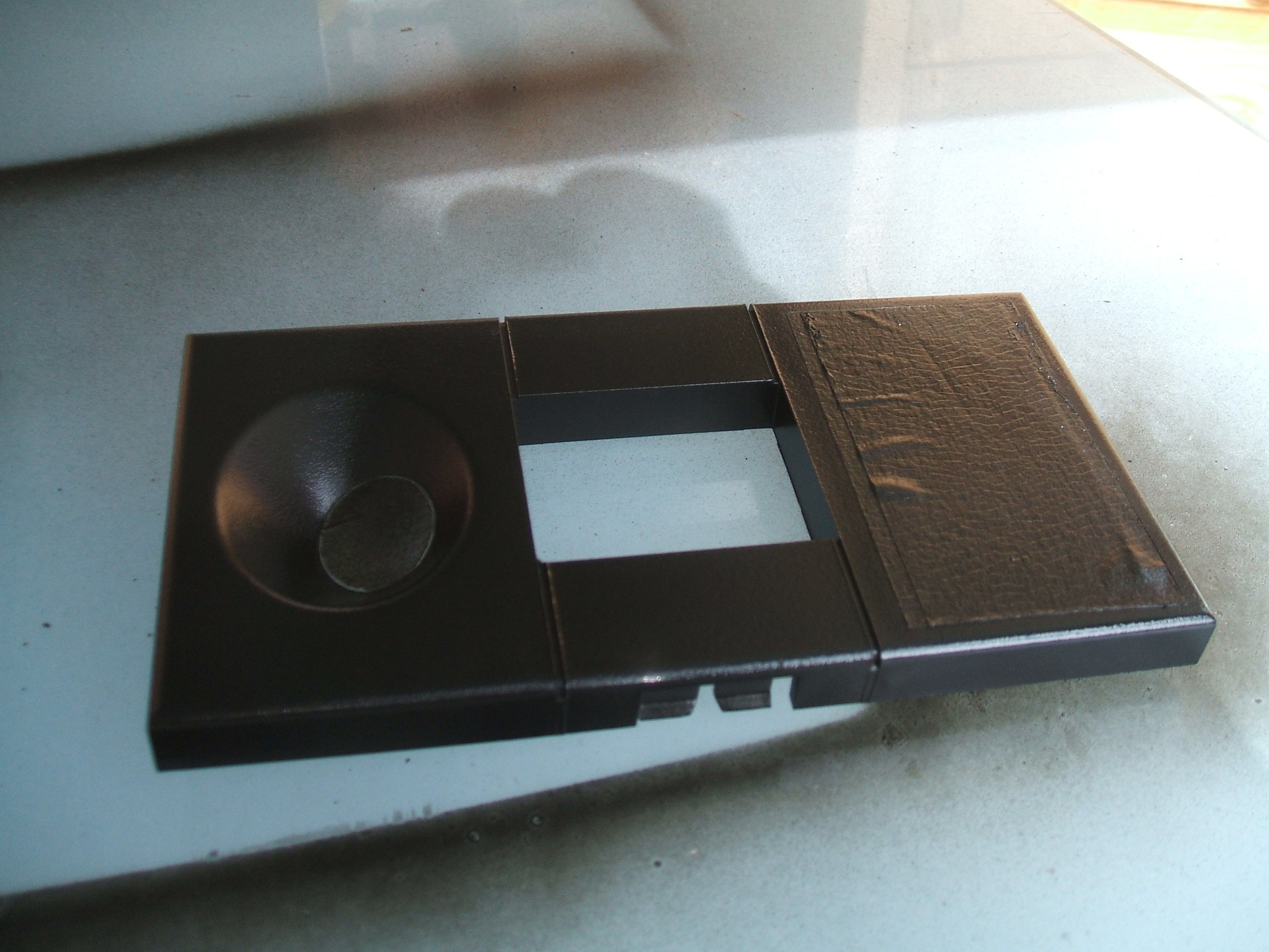

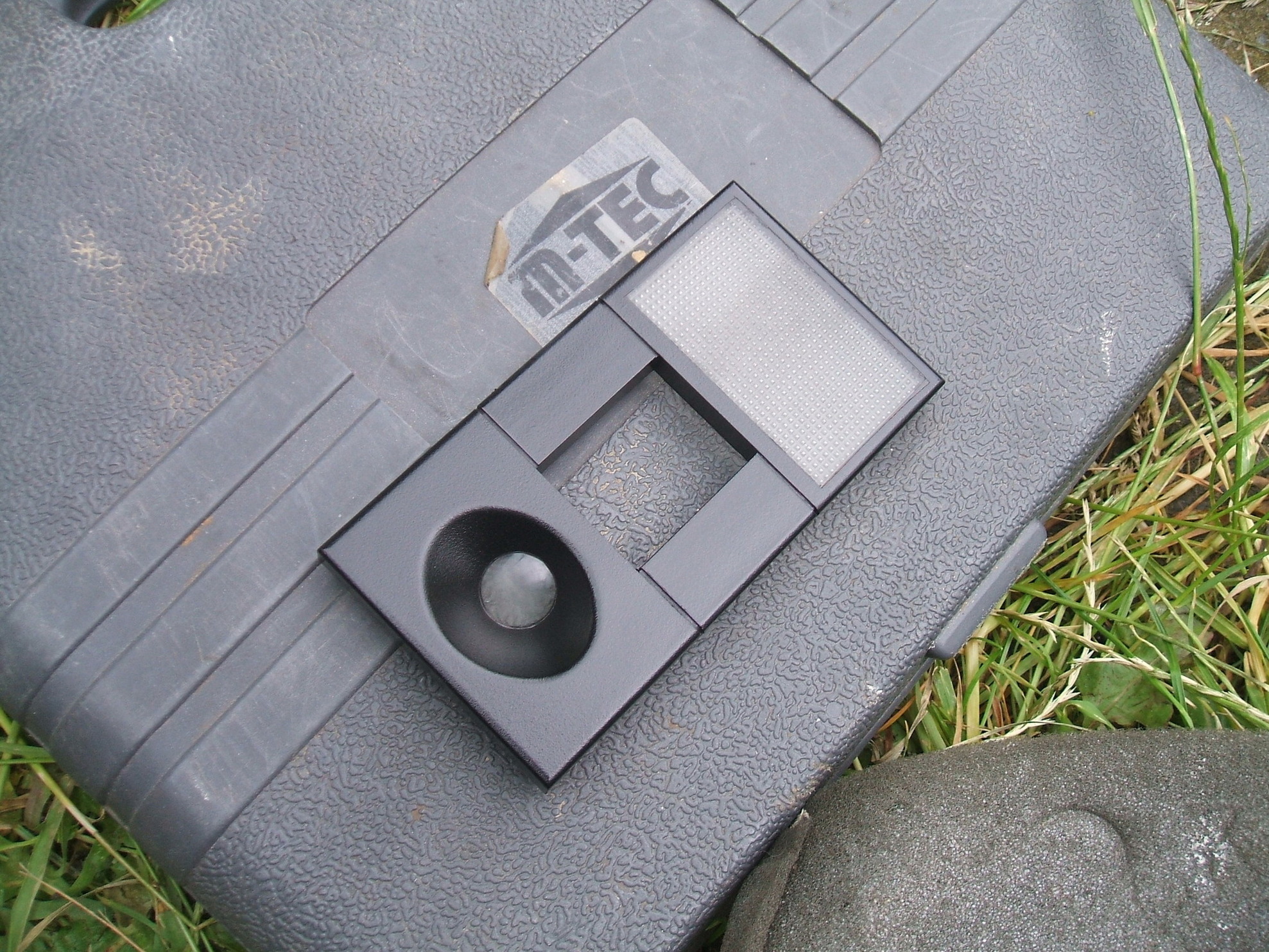

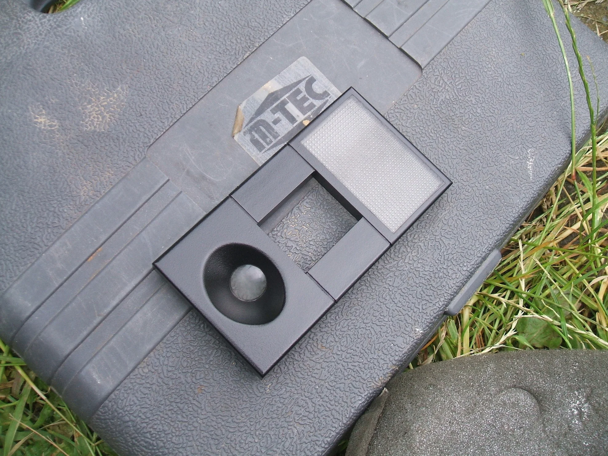

centre console in roof all fit back together and painted black.

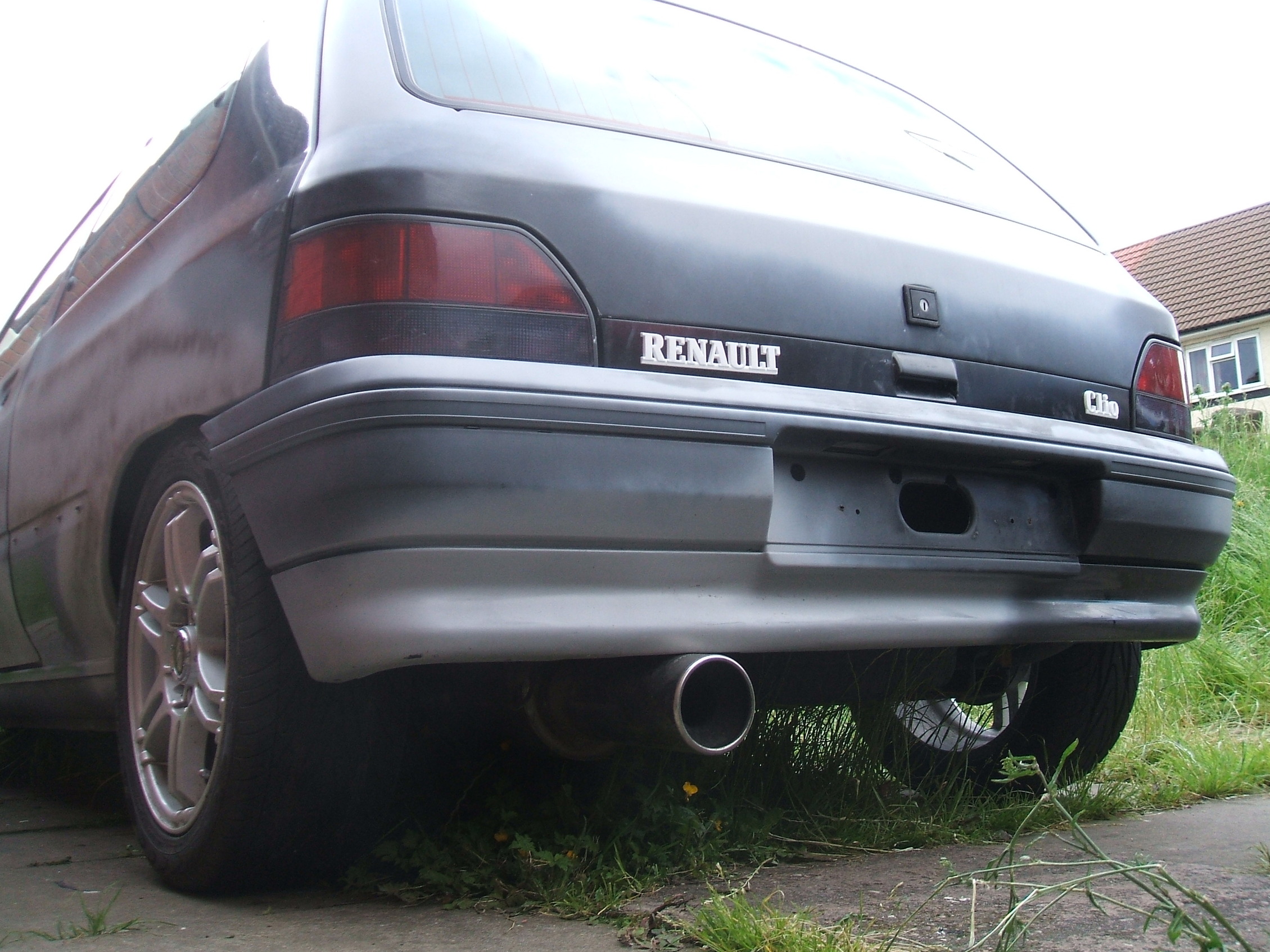

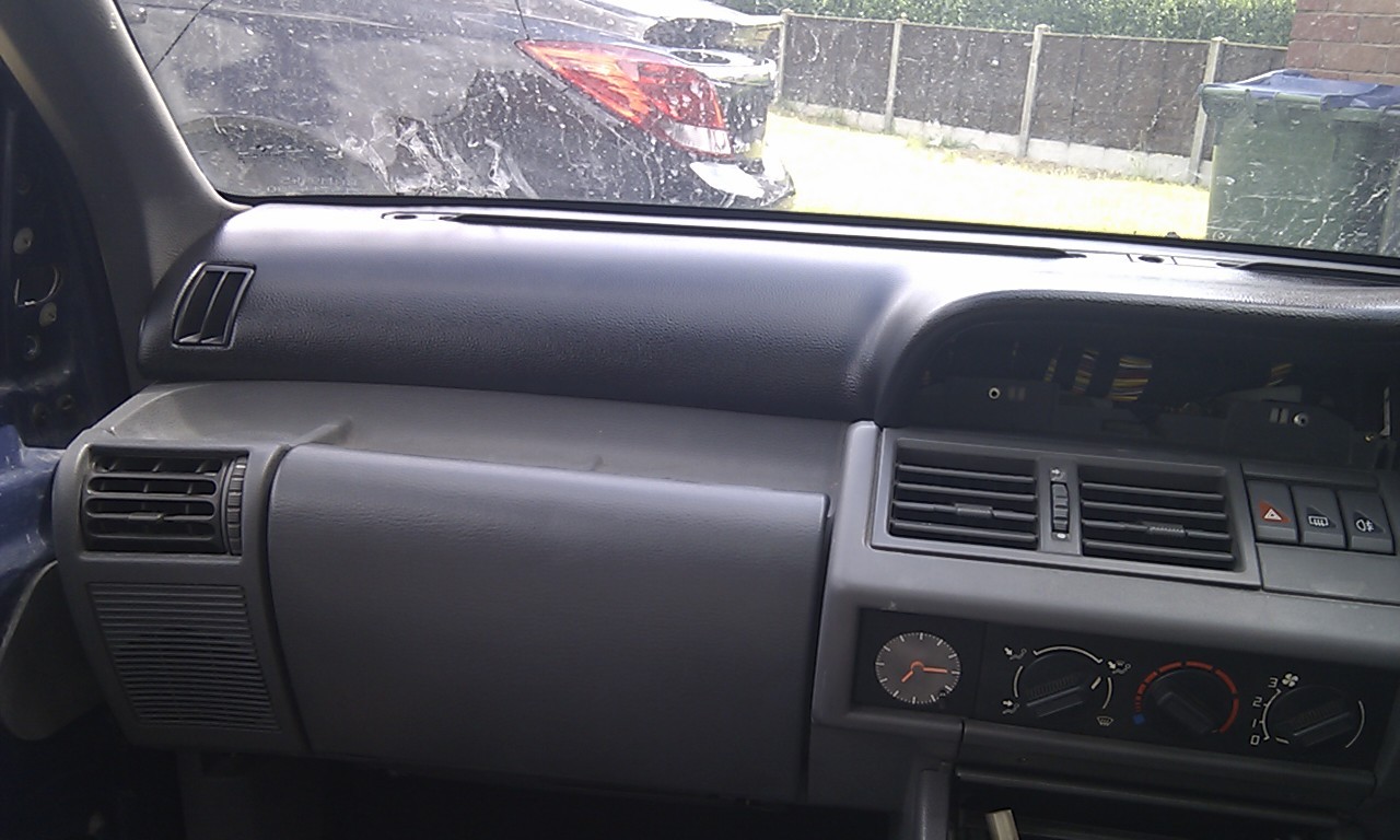

considering spraying the top dash black and the A pillar trims too along with the sil trims. i want all the inside as black as possible! few pics i took today, its getting there! back bumper needs mounting properly tomorrow, i know its on the piss

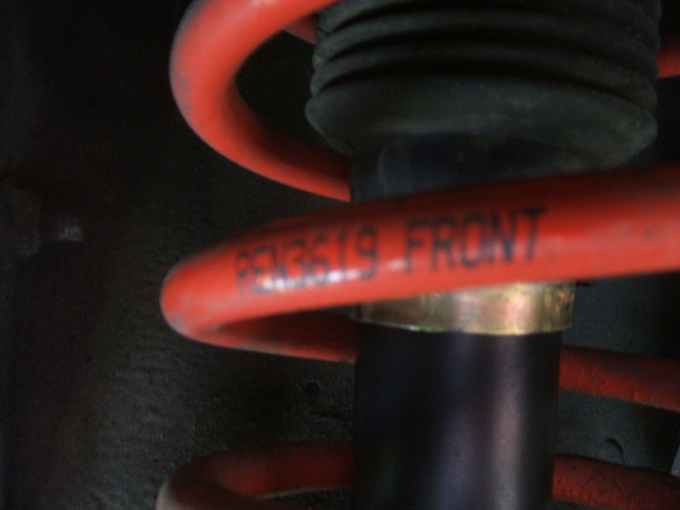

also anyone know what make of springs these are?

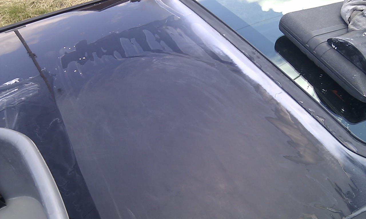

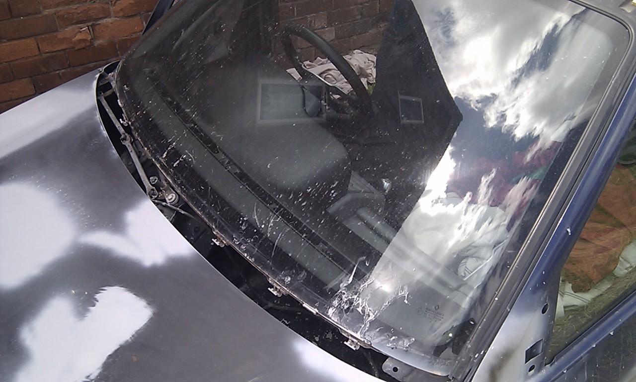

pmsl it still leaked??? what you do, rivet and bond it?
i did have a sheet of perspex i was gonna cut down to size and bolt/bond it down, but i just went for cutting it all out and resealing it, ill probably need to do it again next year!
Tiger seal and rivets yup, still leaked !

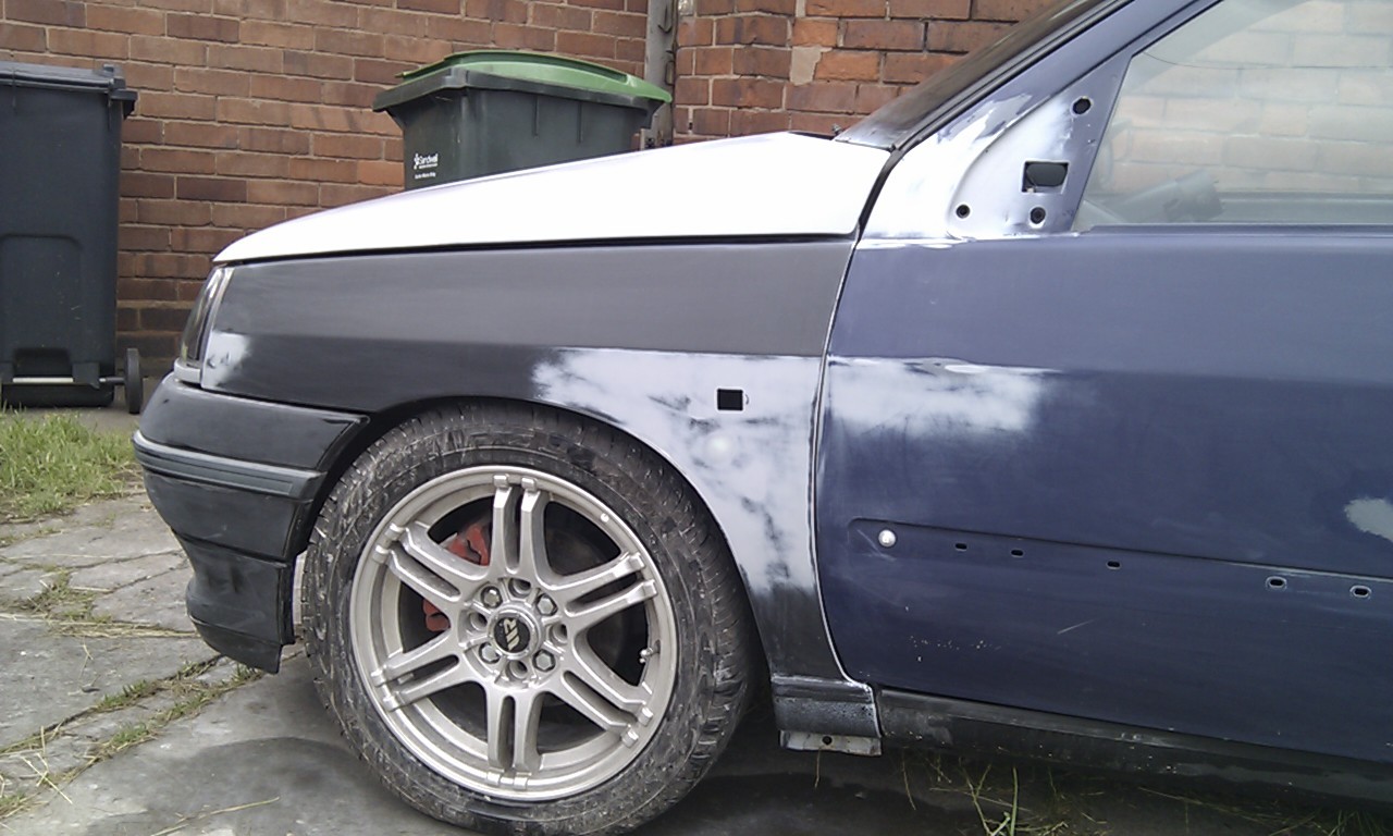

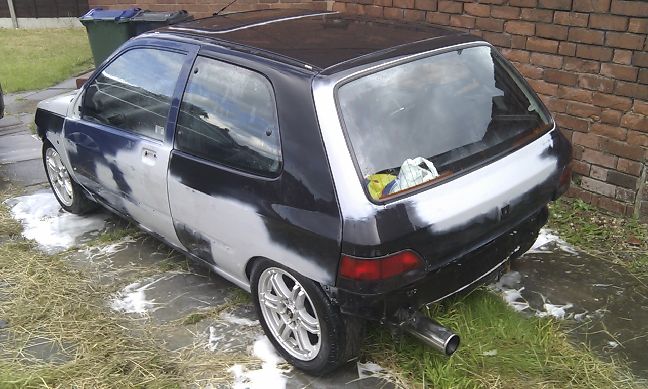

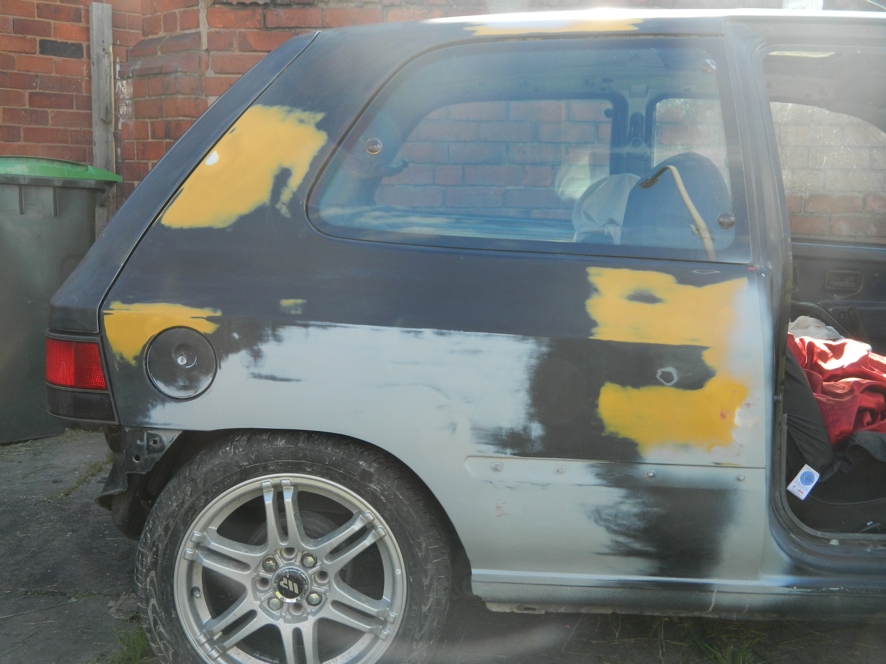

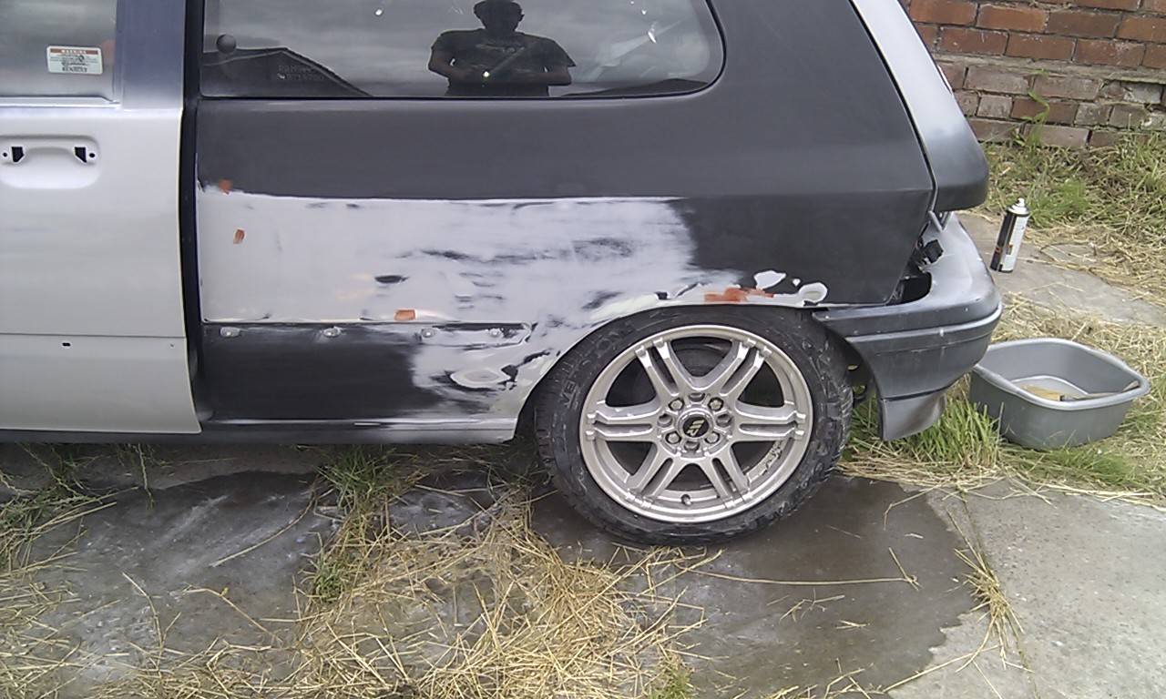

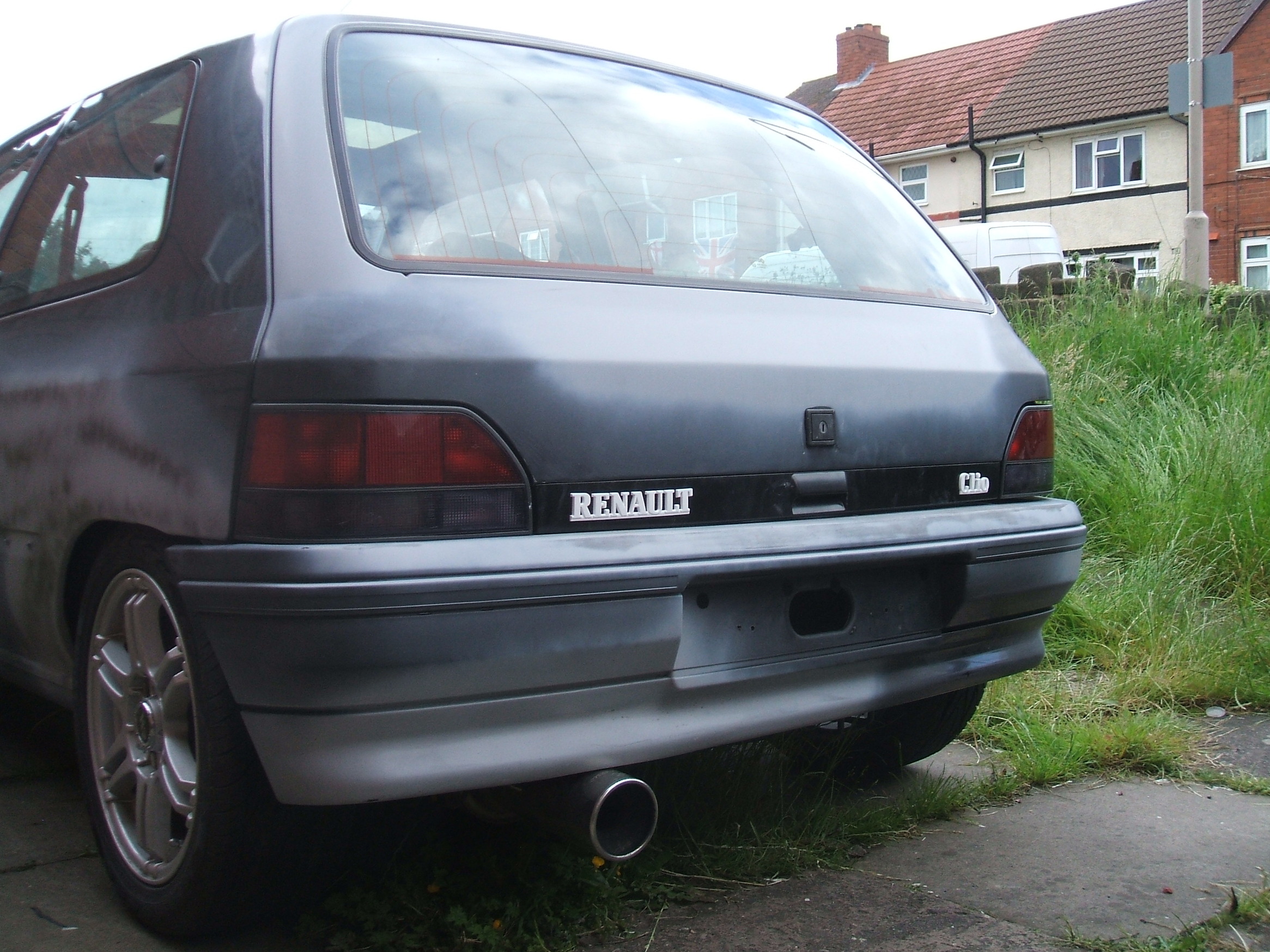

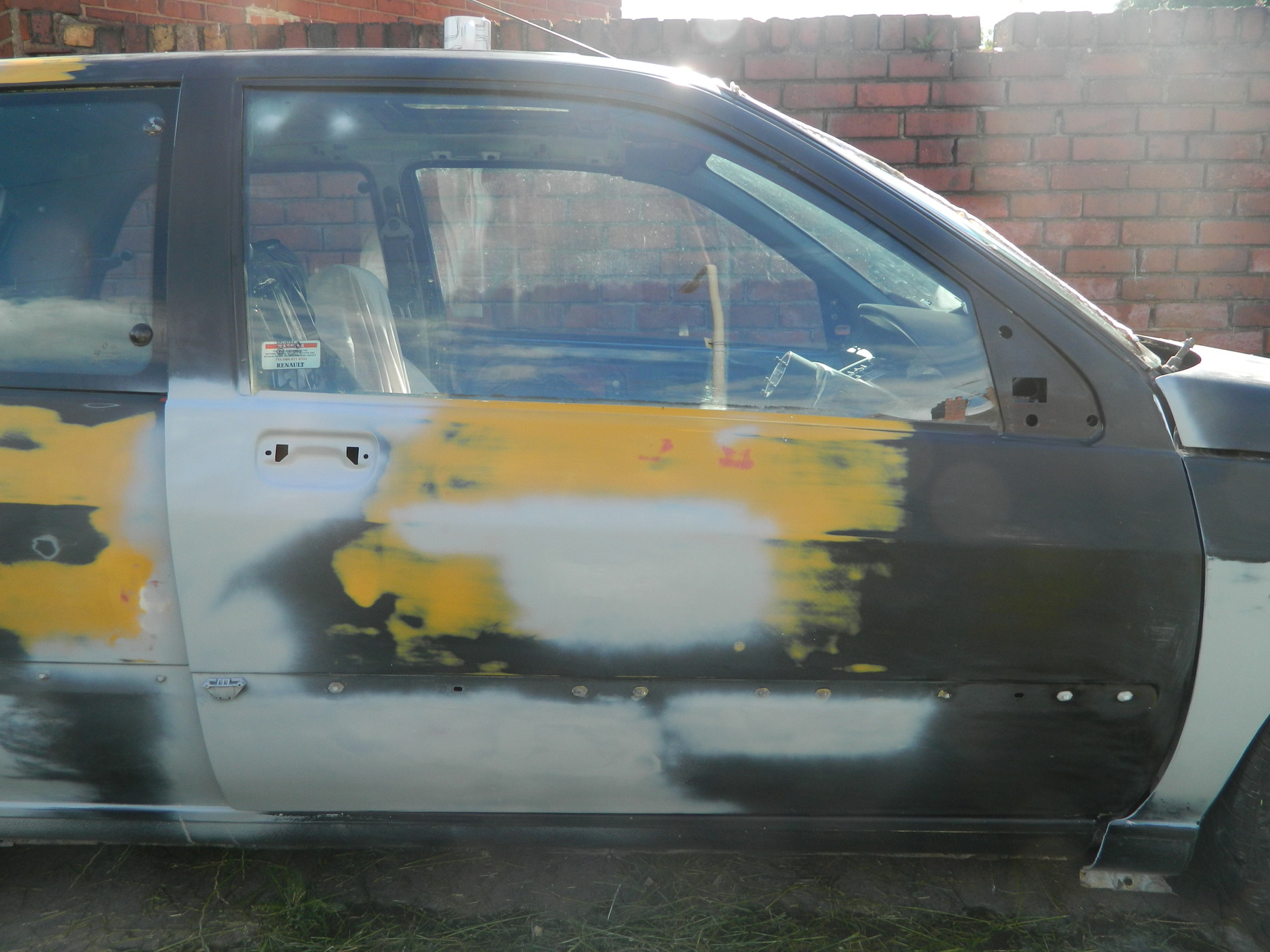

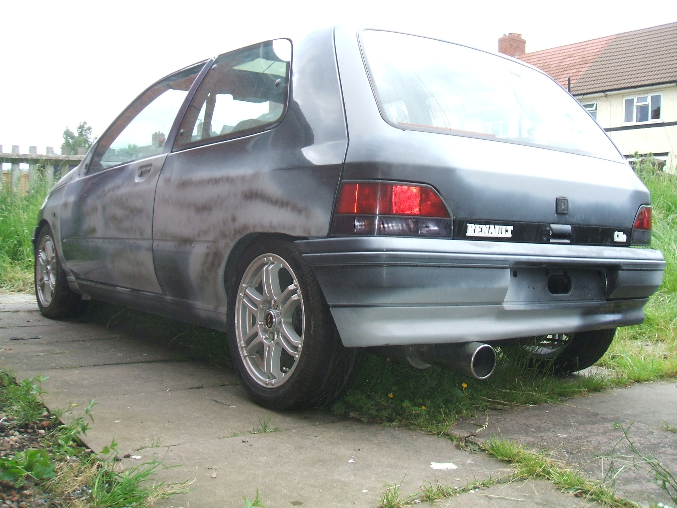

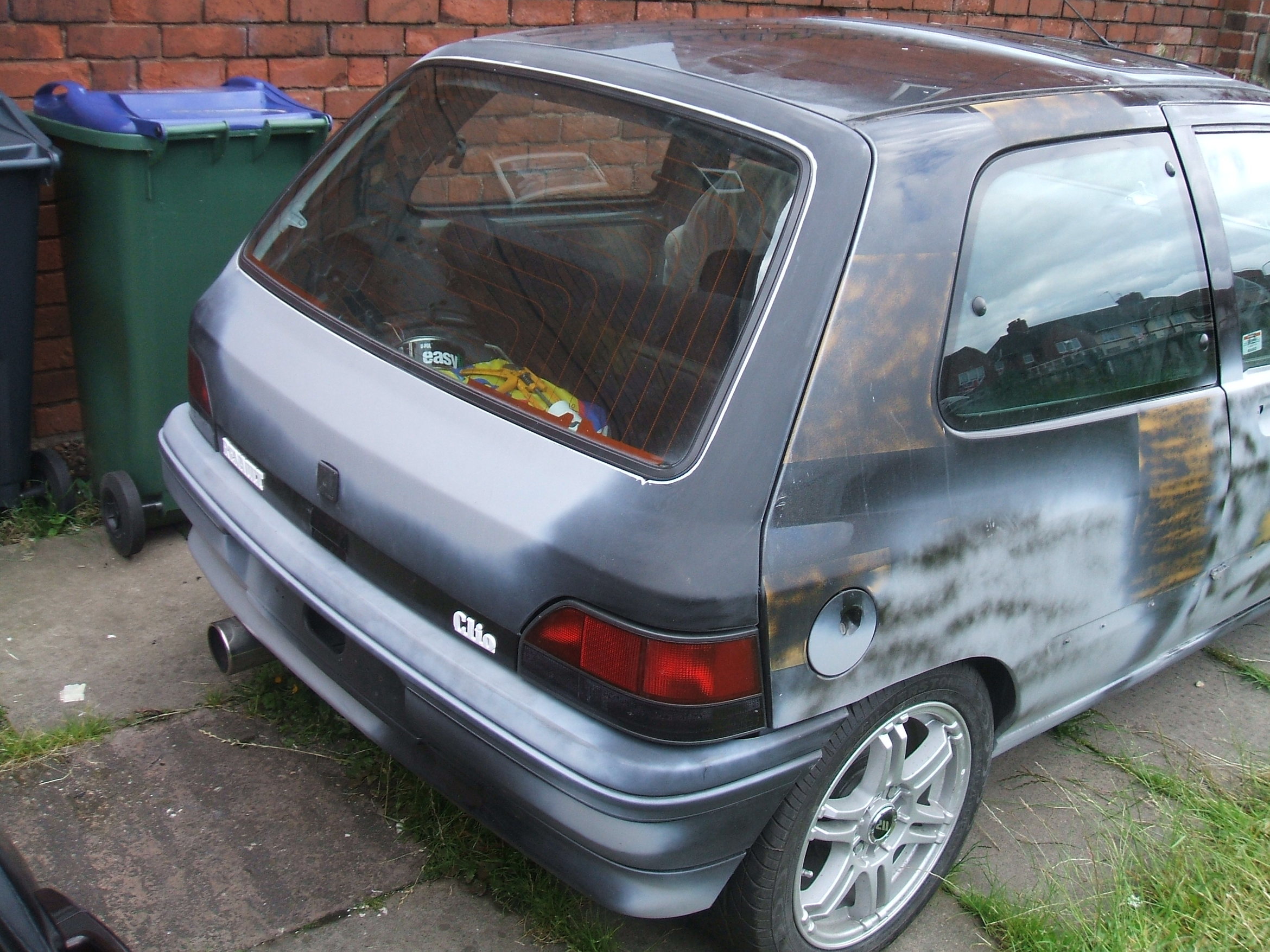

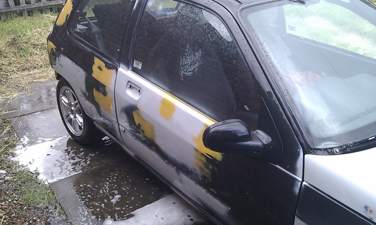

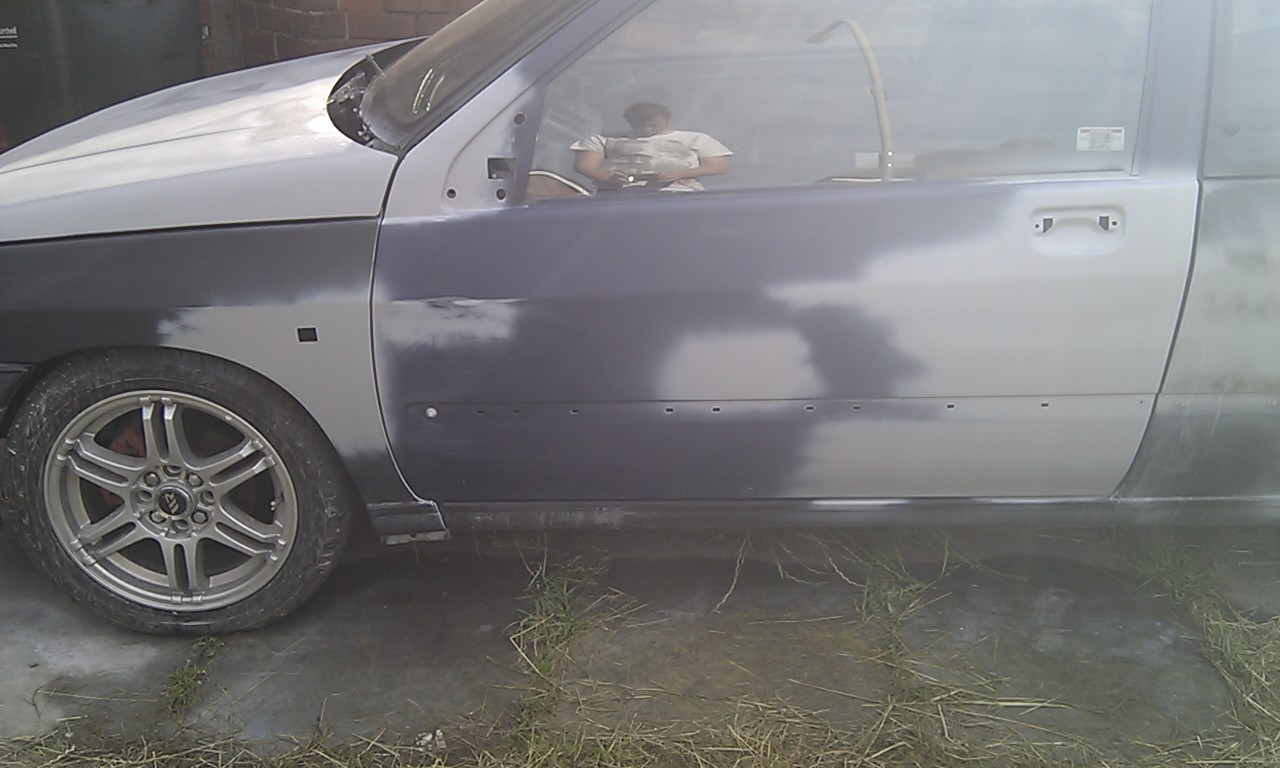

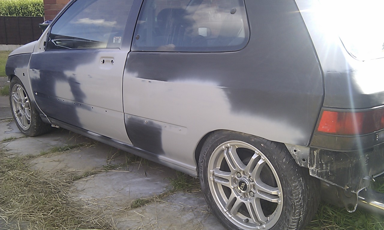

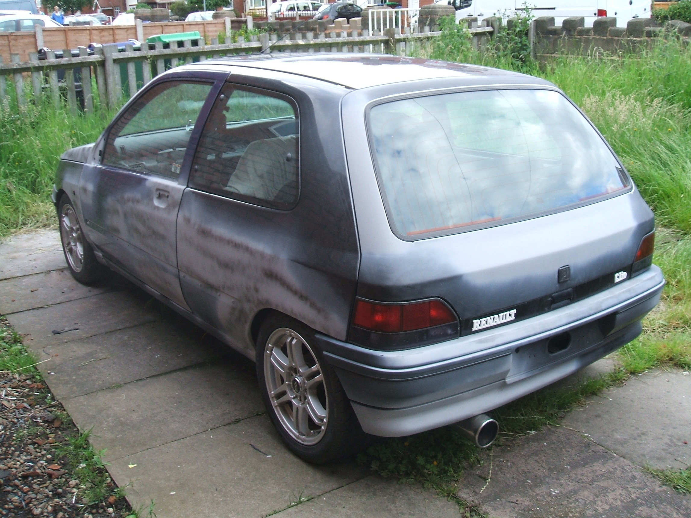

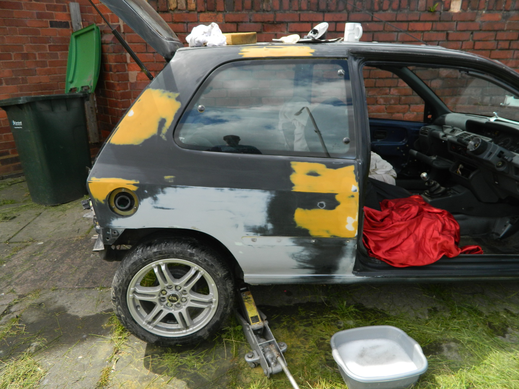

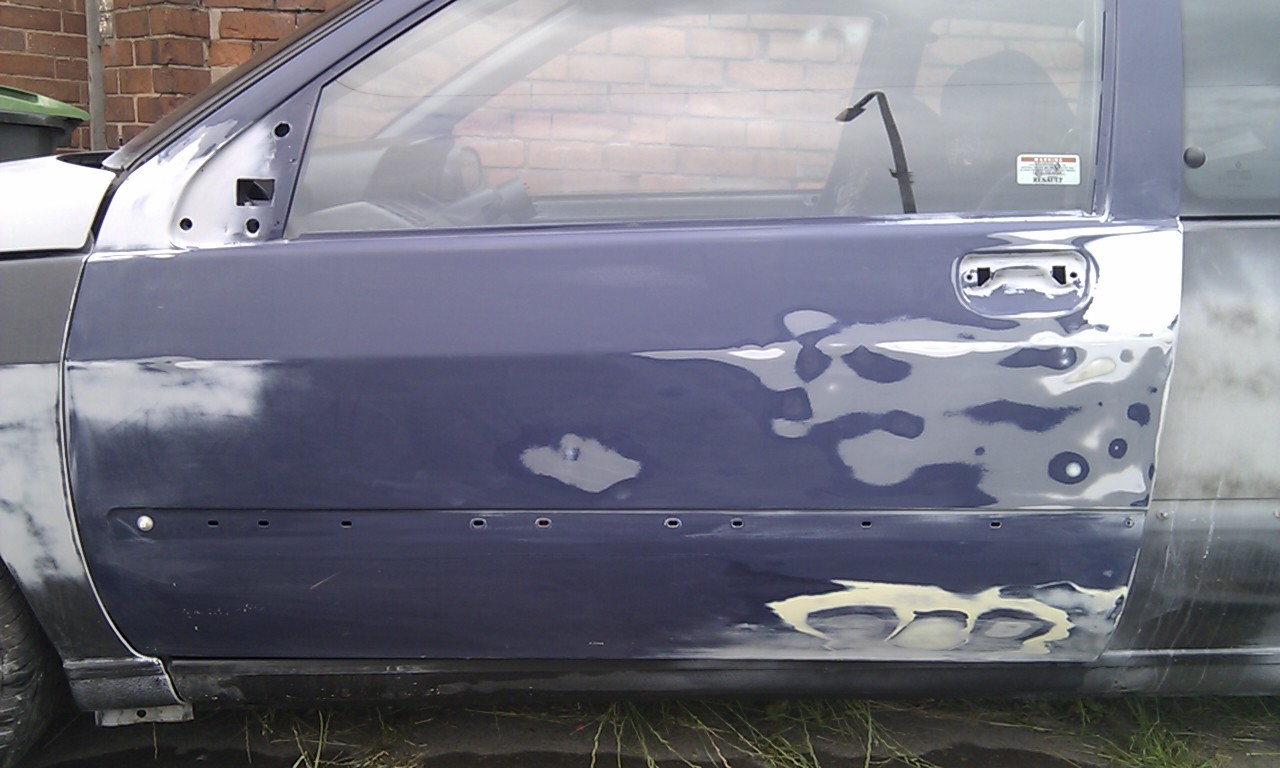

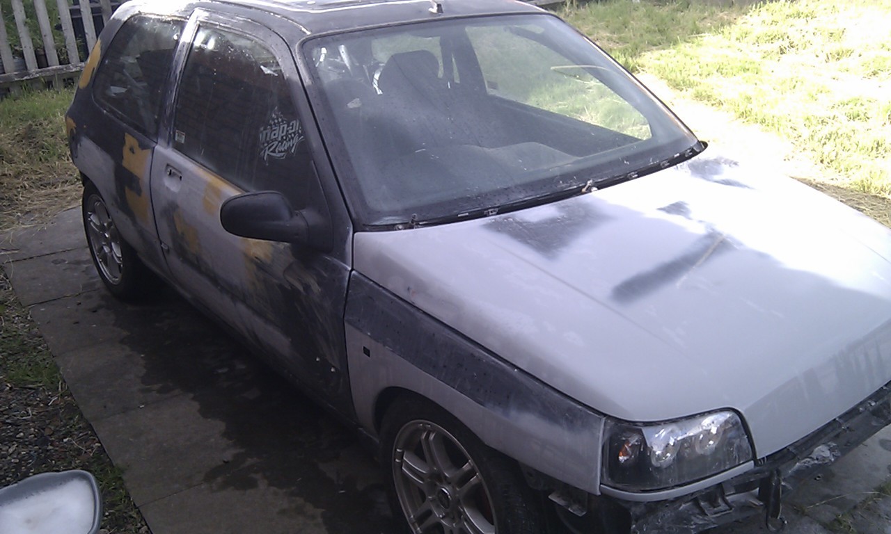

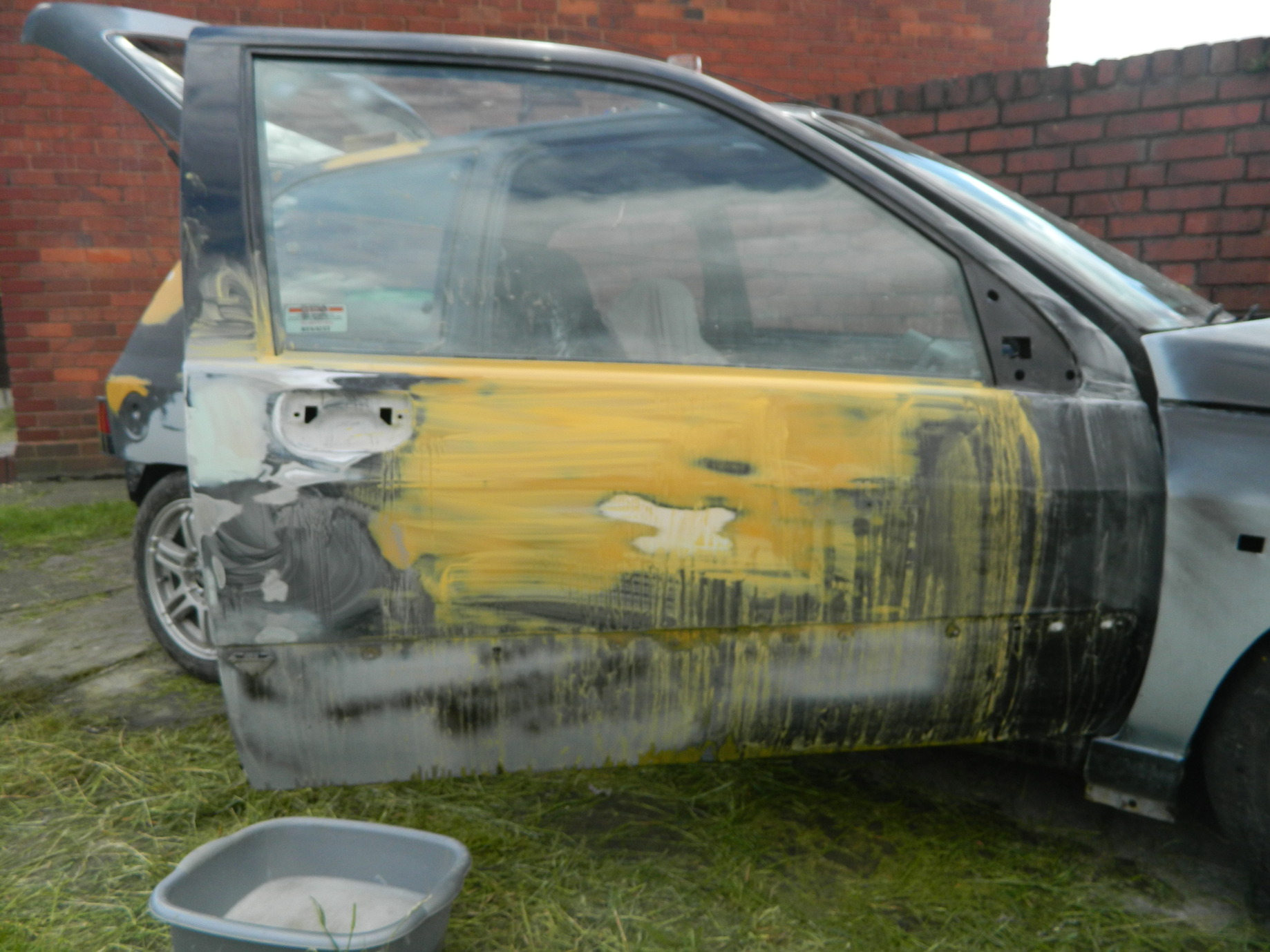

few progress pics from today, managed to get 1 side done ready for painting. the yellow primer had been on for a couple of years and not flatted, my god it was such a b**ch to wetsand!
bought me a new tube of stopper aswell, £12, bye pinholes!
rear quarter flatted n cleaned

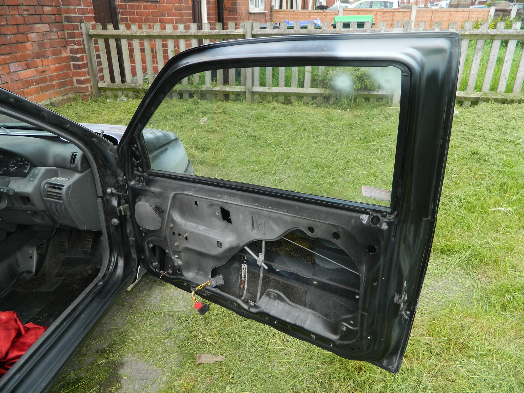

inner door scotched n scratches sanded out, primed, flatted
door flatted, nightmare to do, ended up putting a bit more primer on as there was scratches to flat out
quarter done
door done
wing done

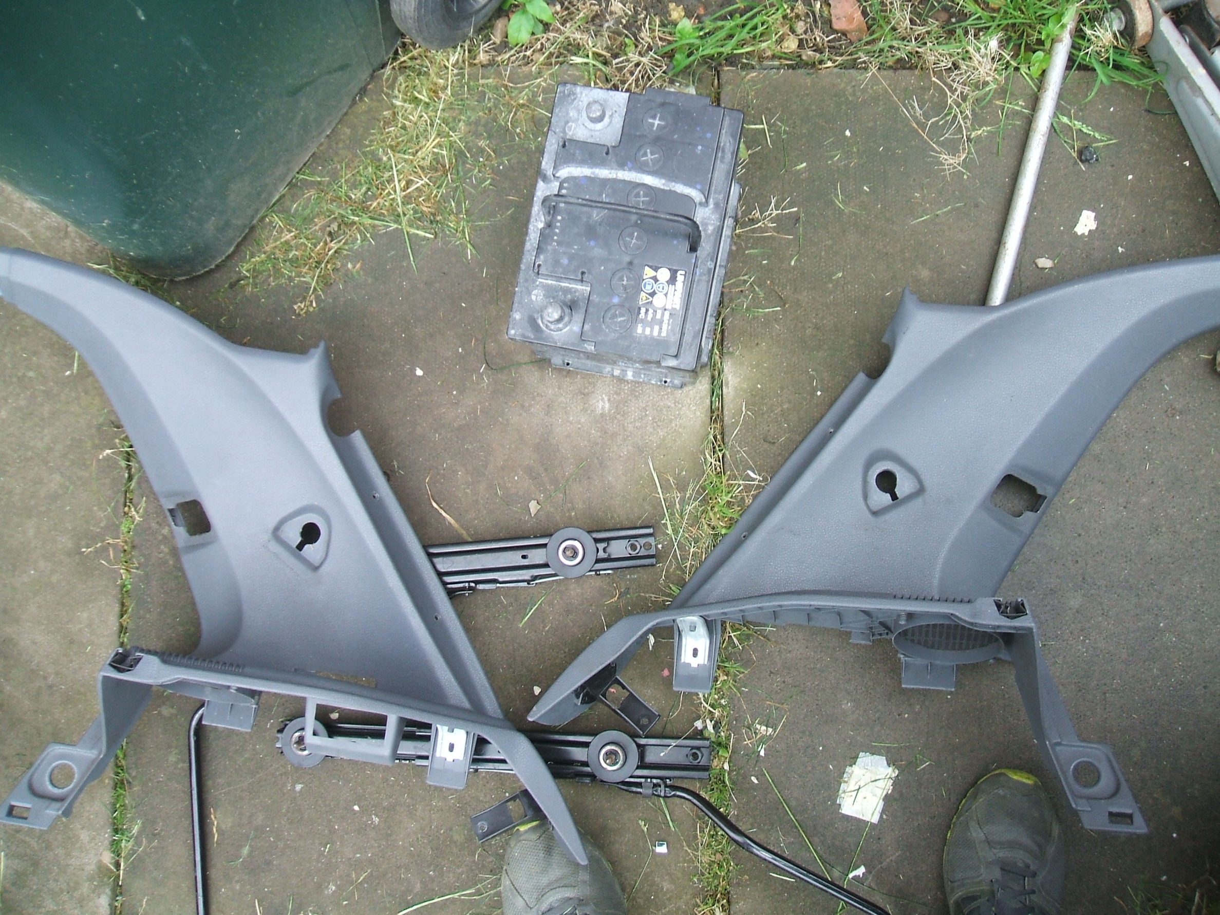

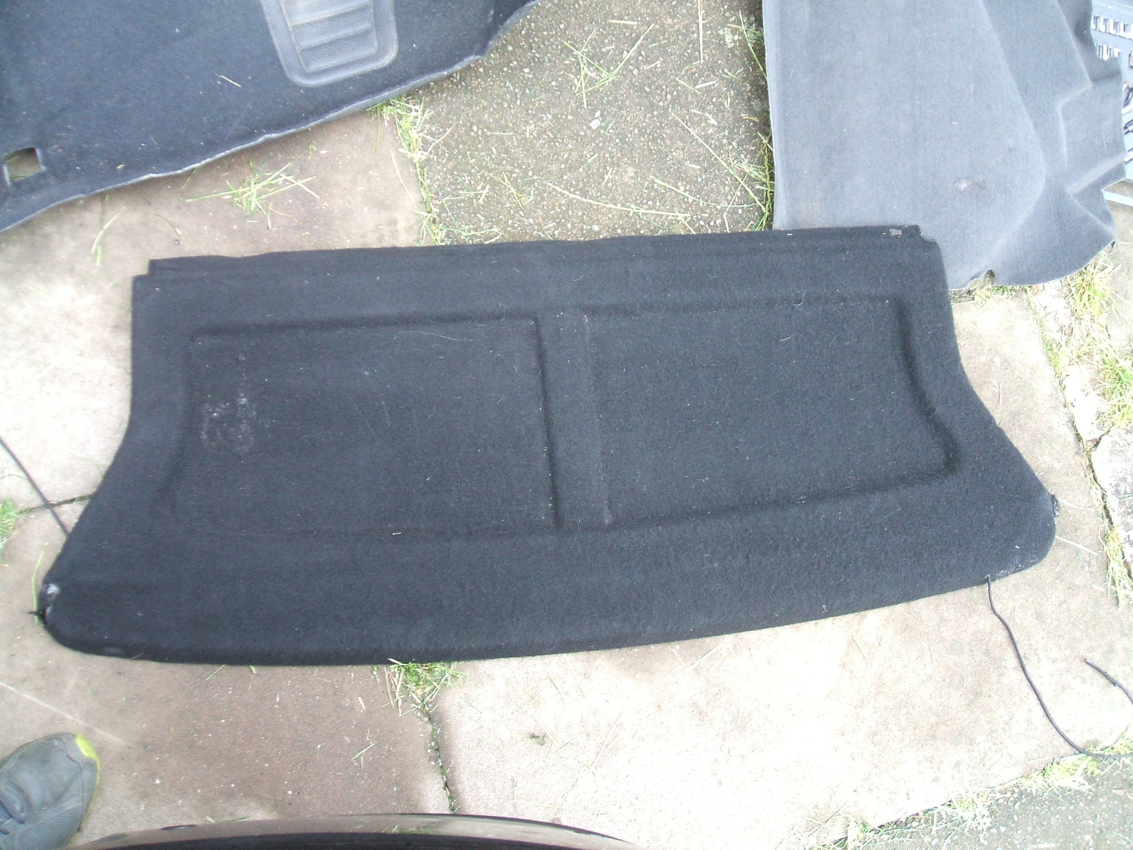

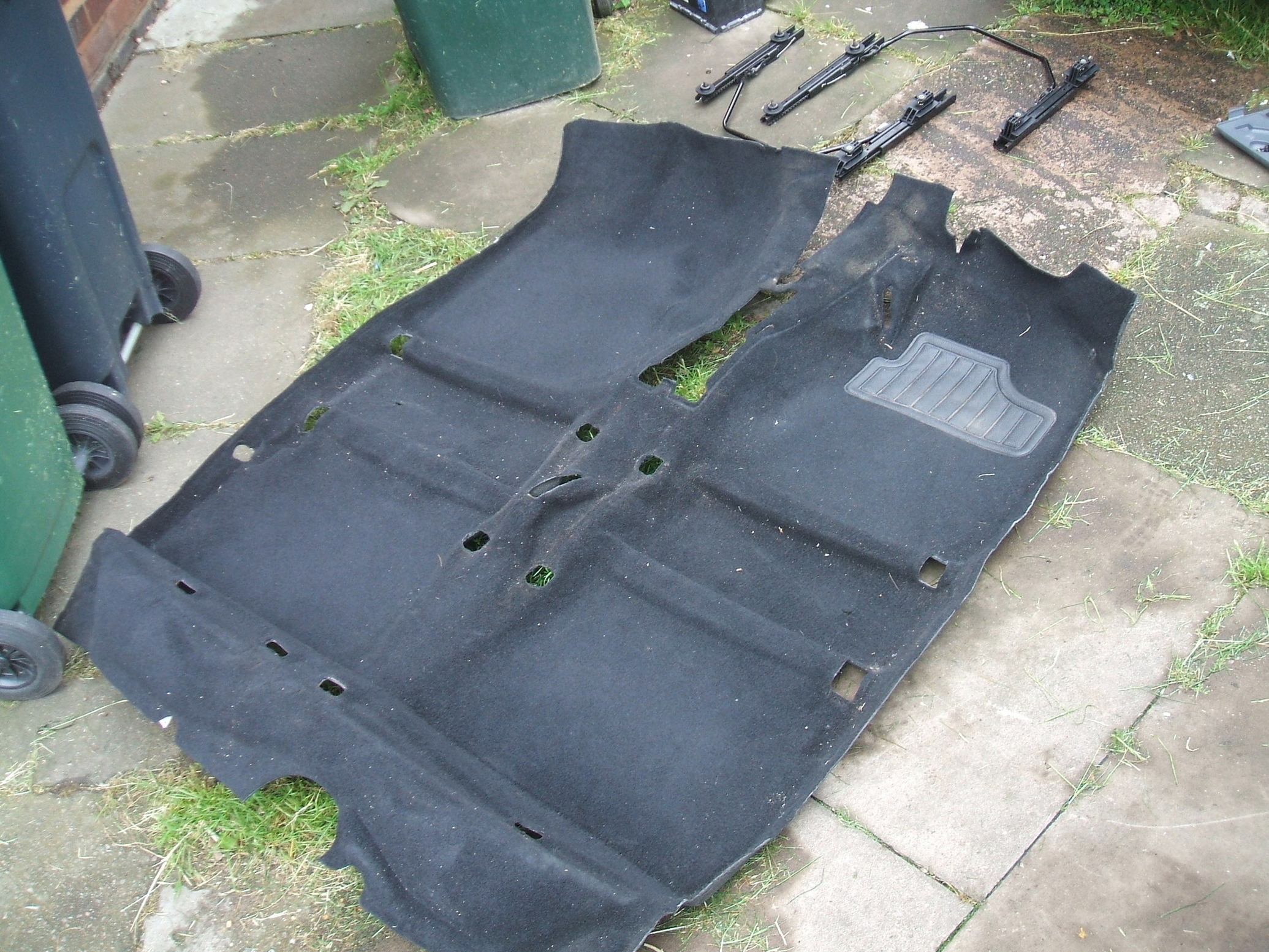

stuff i bought today
- battery
- carpet
- boot carpet
- inner quarter plastics
- inner arch carpets

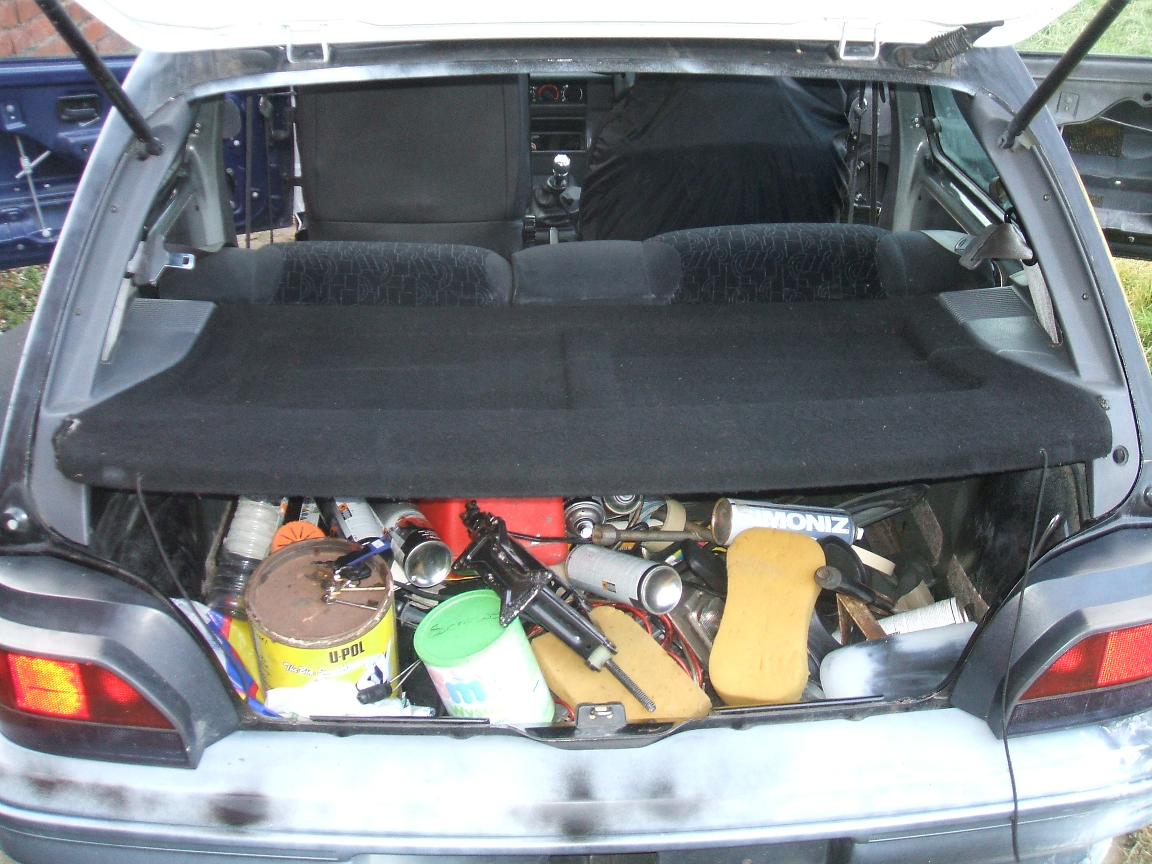

- boot carpet
- parcel shelf

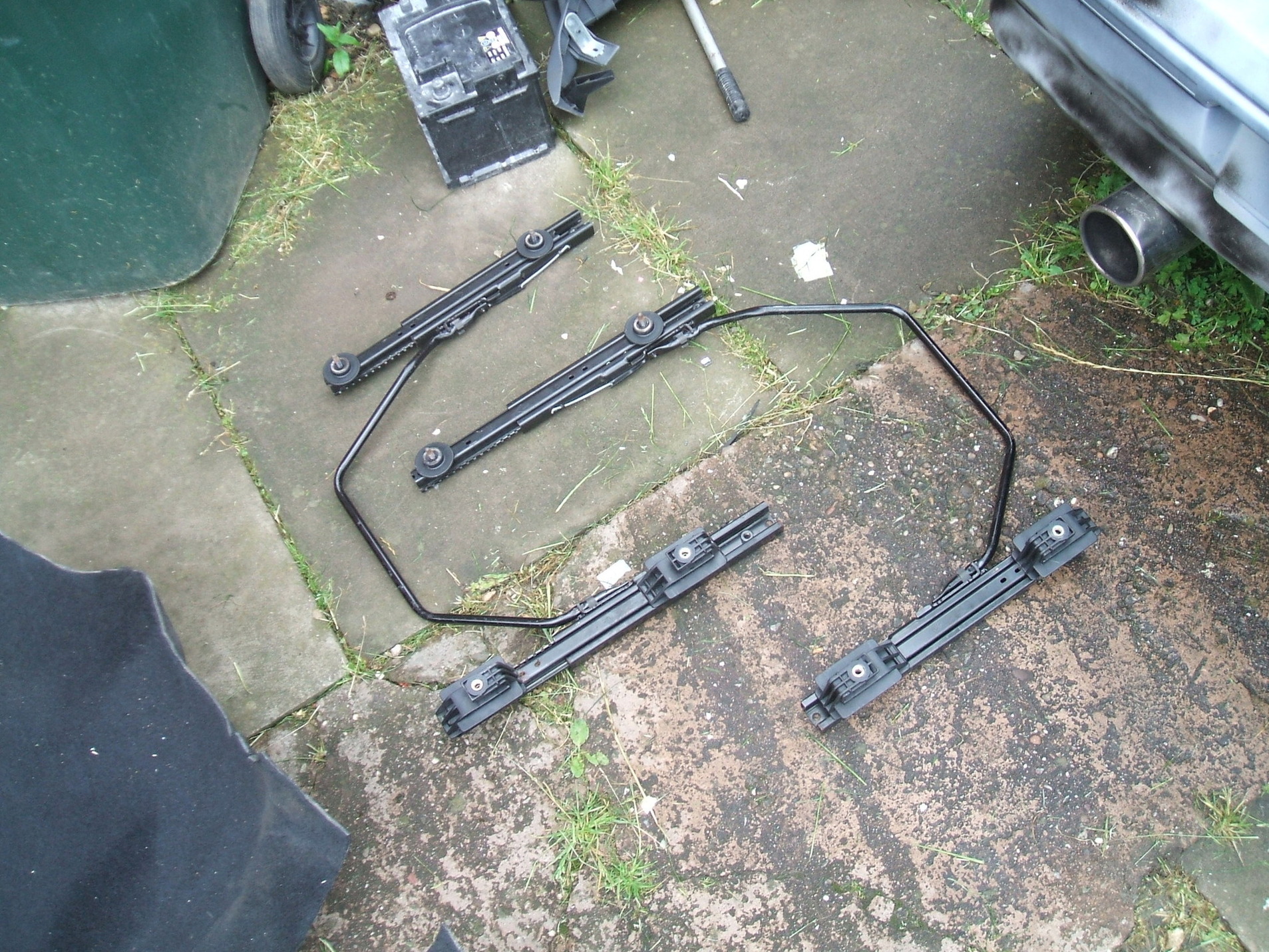

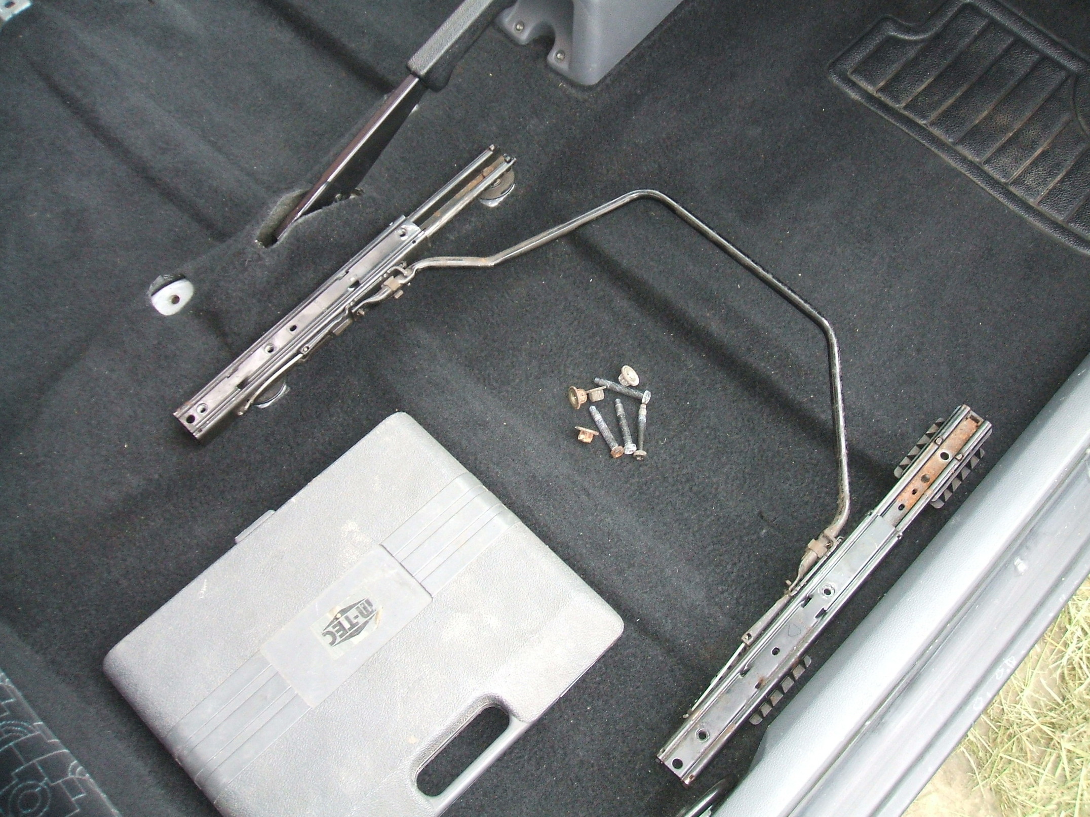

- subframes for seats

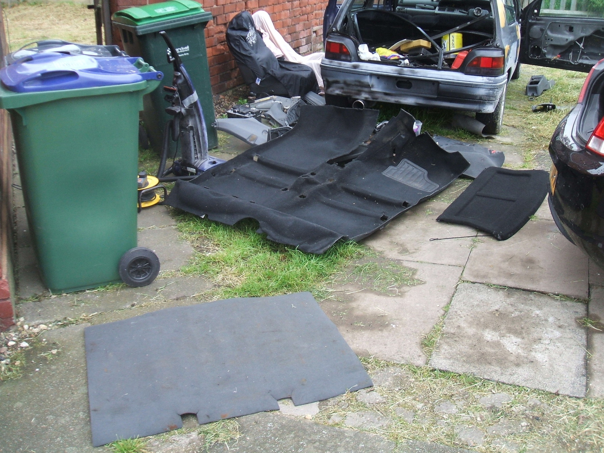

tomorrow i gotta hoover the carpet, fit that, fit subframes n seats, fit boot carpet, quarter plastics, parcel shelf. then if i get time ill flat the bonnet, other side of the car and the roof. wednesday ill do the bumpers and just go over everything. should be ready to paint by wednesday if the weathers good

looking good my friend, when i saw that that yellow primer hadnt been flatted i felt like commenting there and then but i thought i would carry on reading lol take it you do body repair and prep? currently what im doing. coming along nice tho matey looking forward to seeing it in paint
  Punto/Clio GTT
cheers dude. yeah body repairer since i left school 12 years ago, can paint too, but most places ive worked ive mostly done repairs. how long you been doing bodywork?

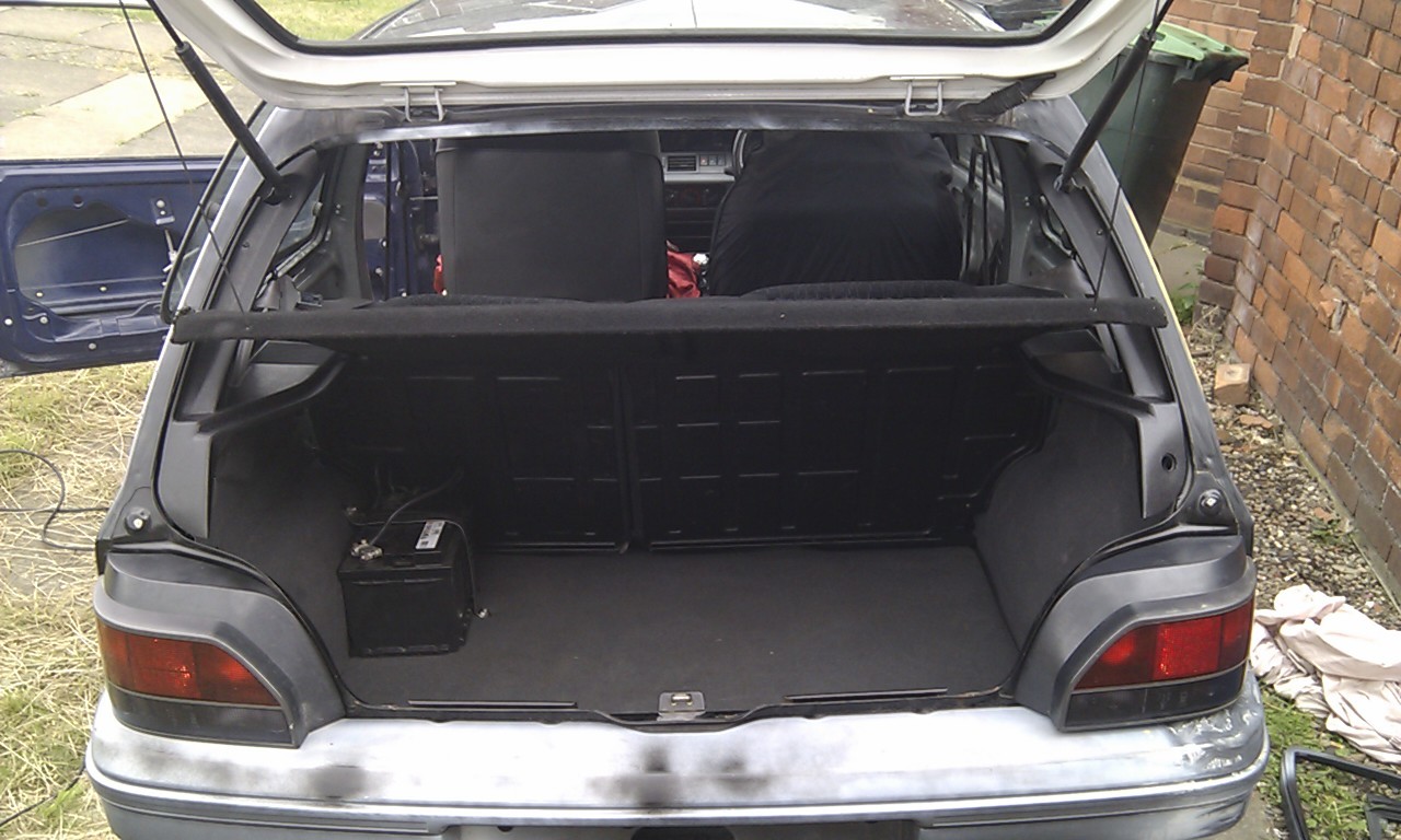

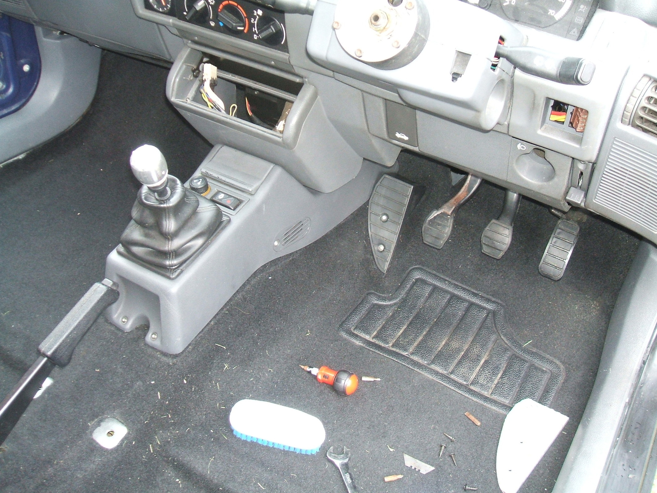

monster day, im knackered!

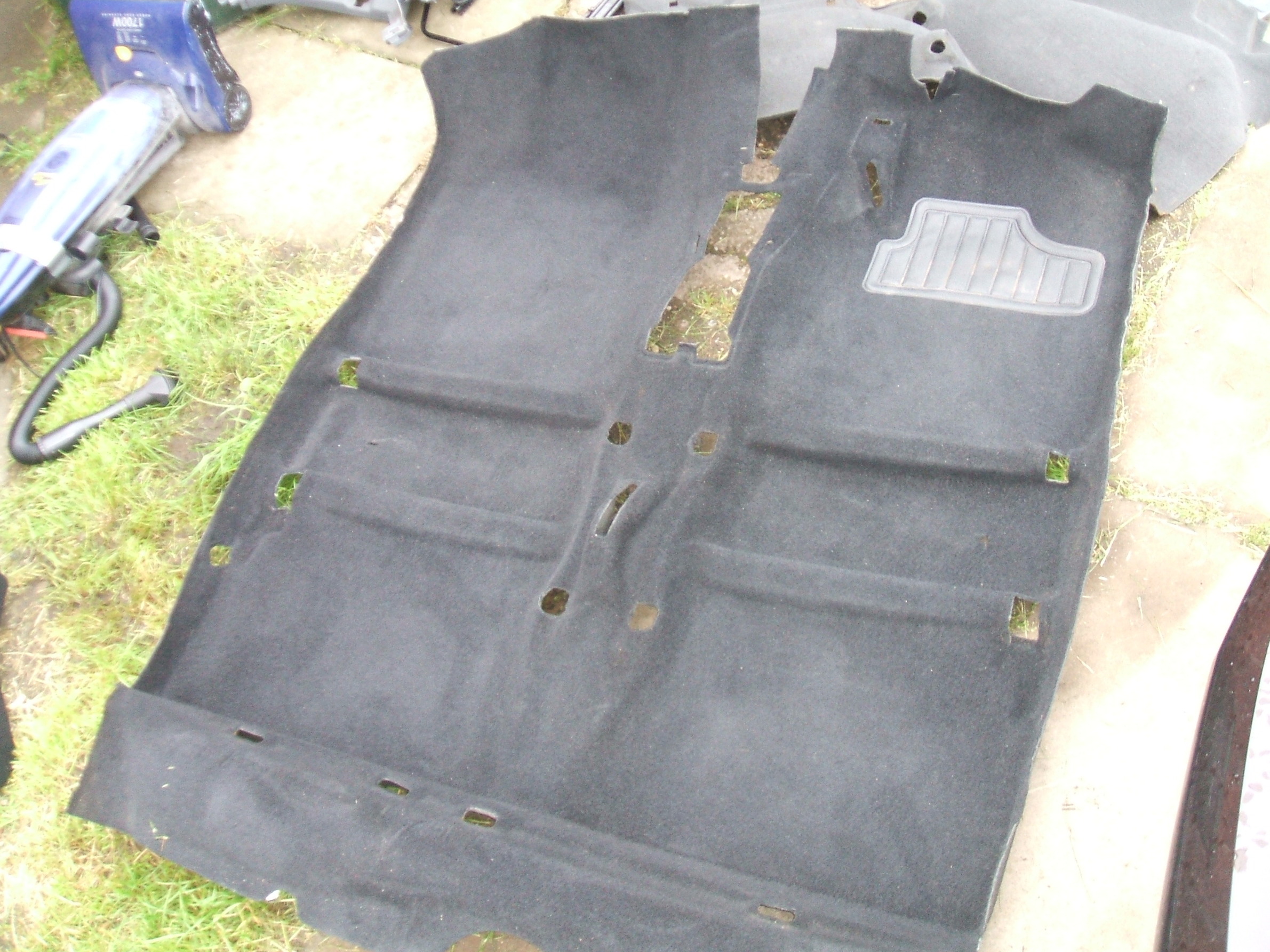

new stuffs

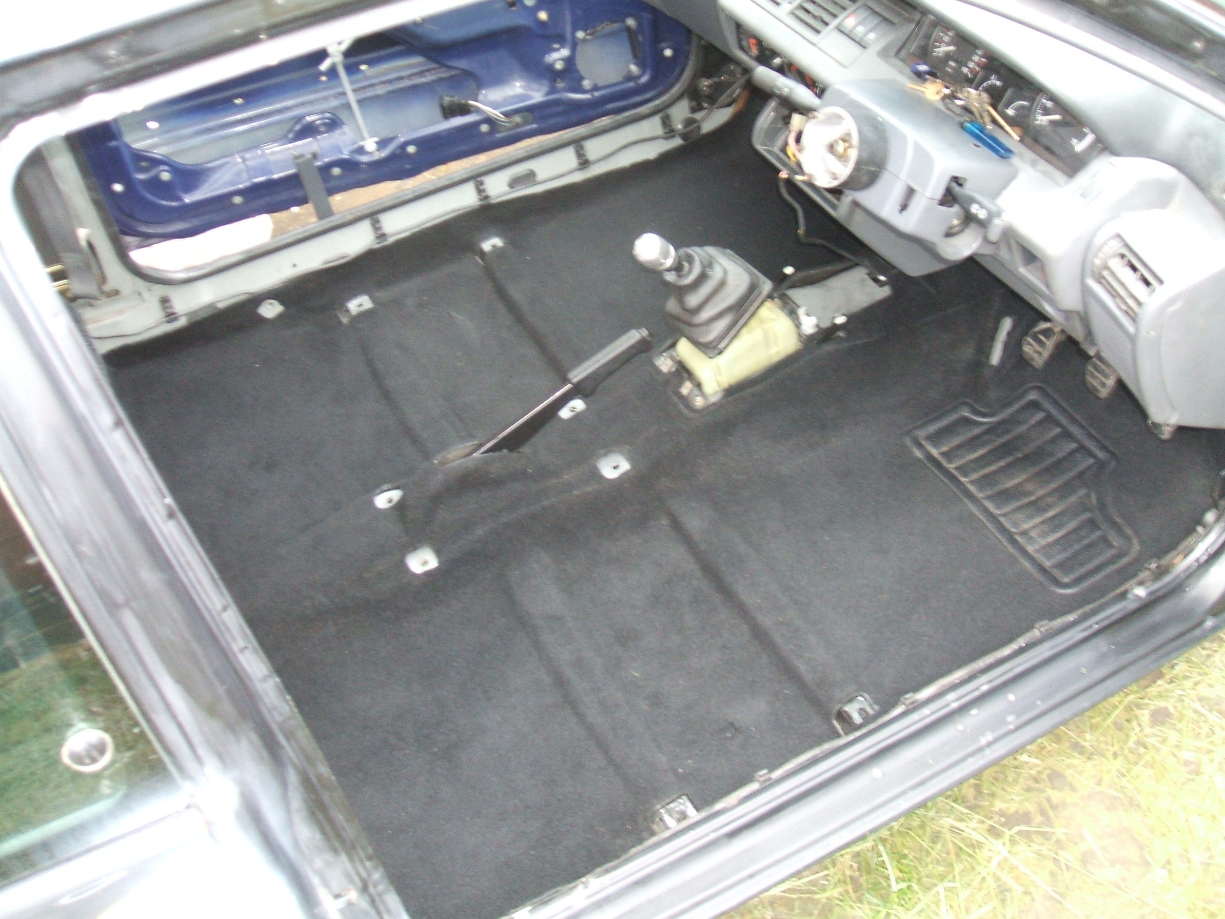

carpet cleaned
dirty console, cleaned with no bucket method, tea towel and flash spray
alloy footrest plate removed and old one cleaned up, looks better i think

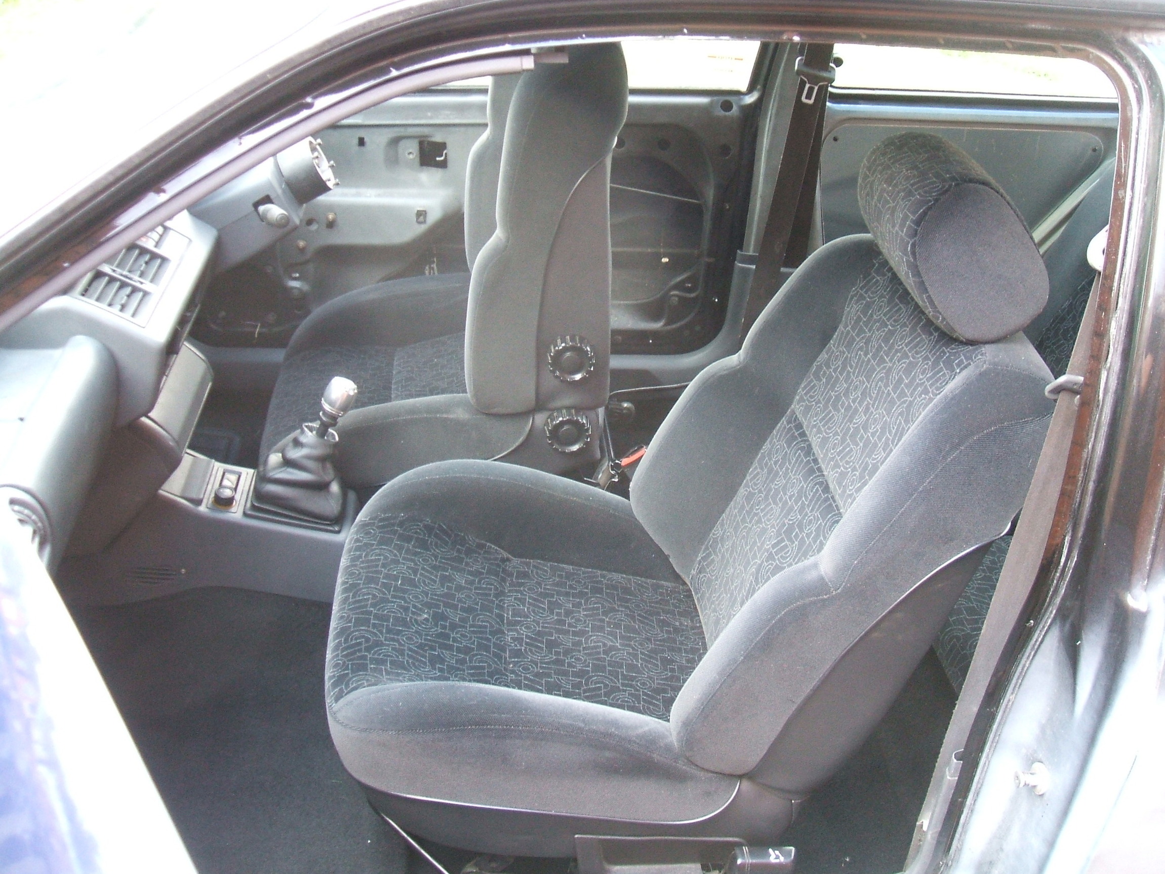

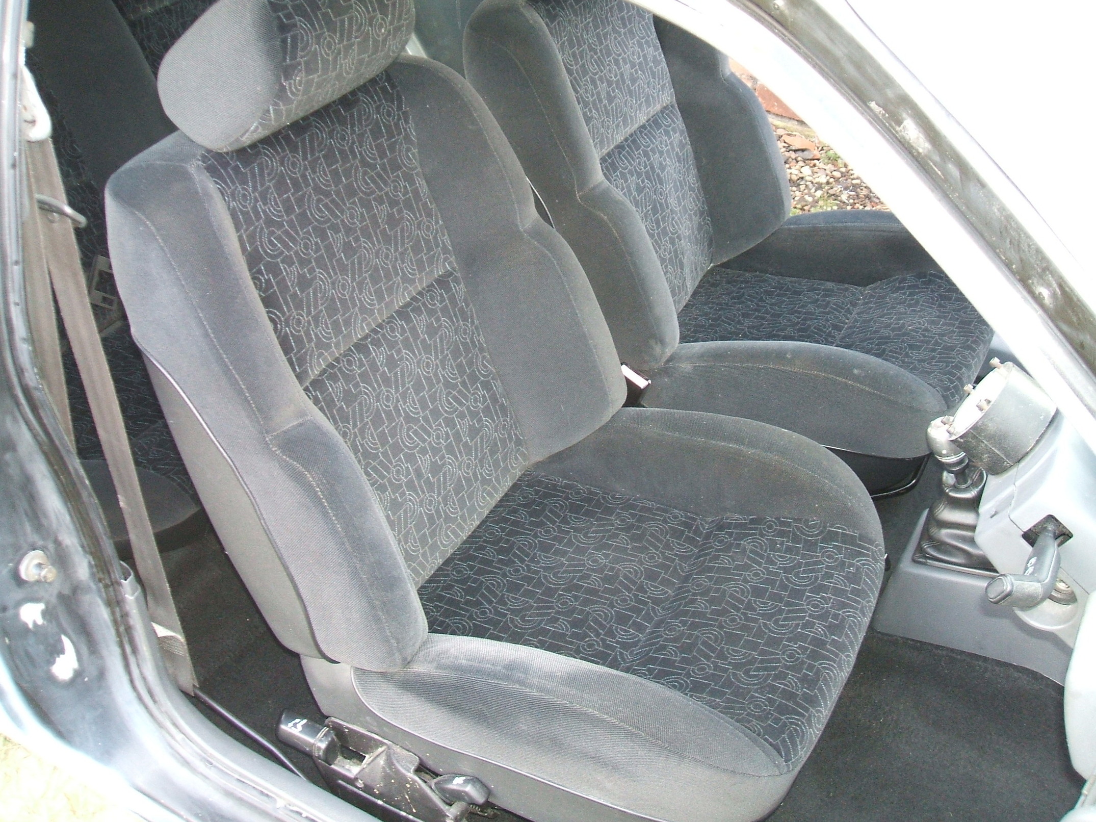

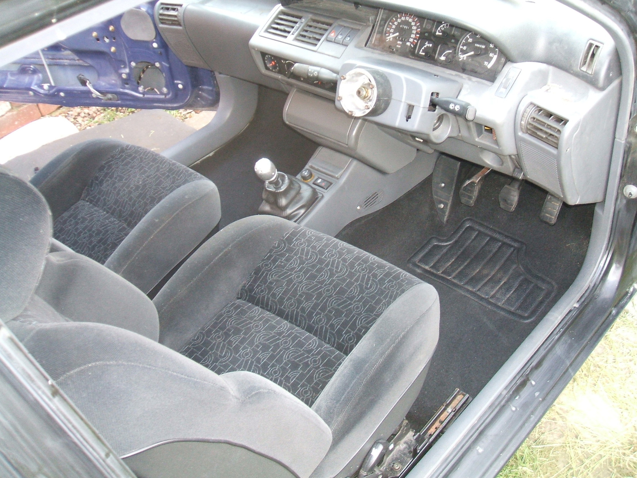

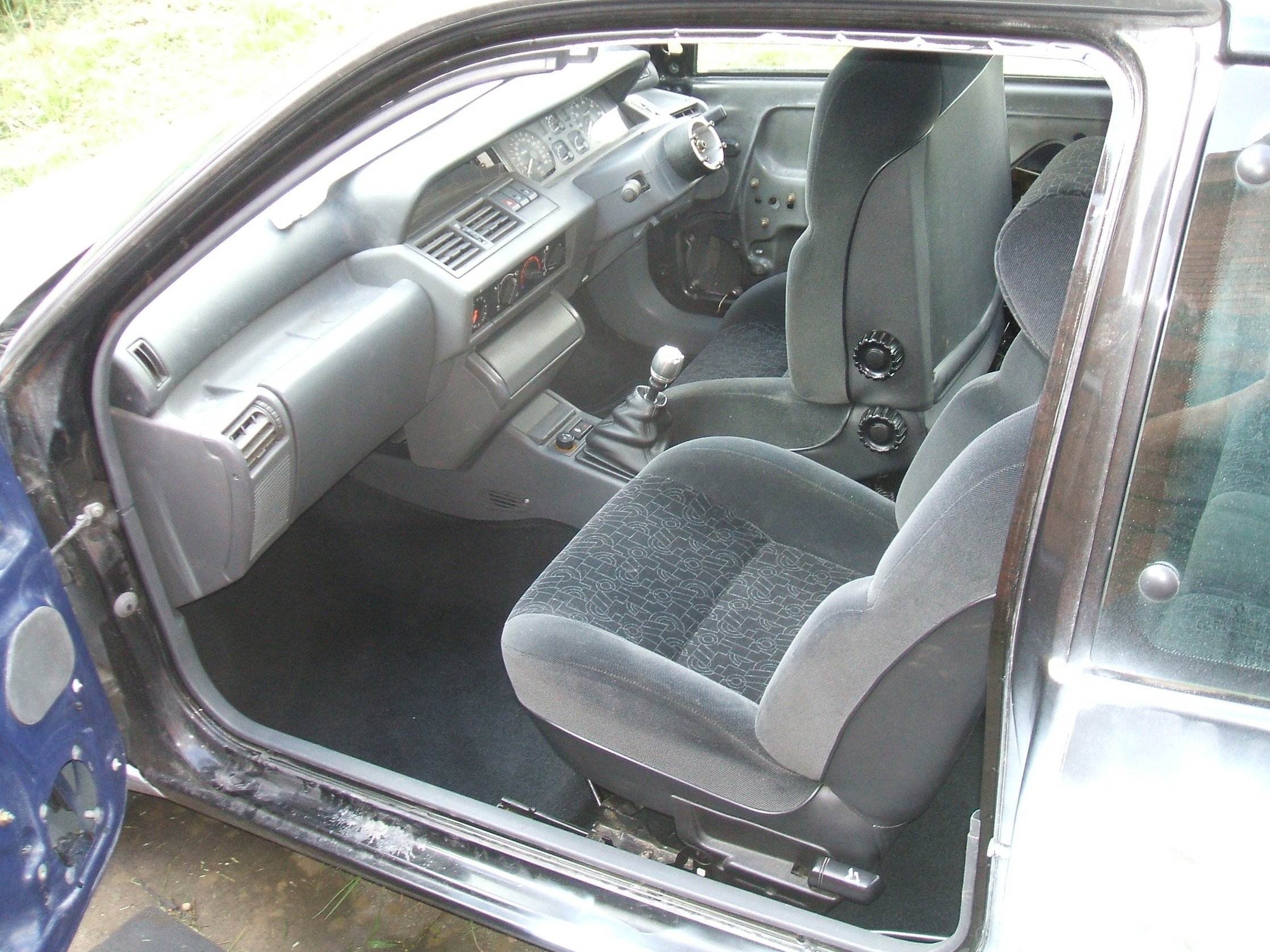

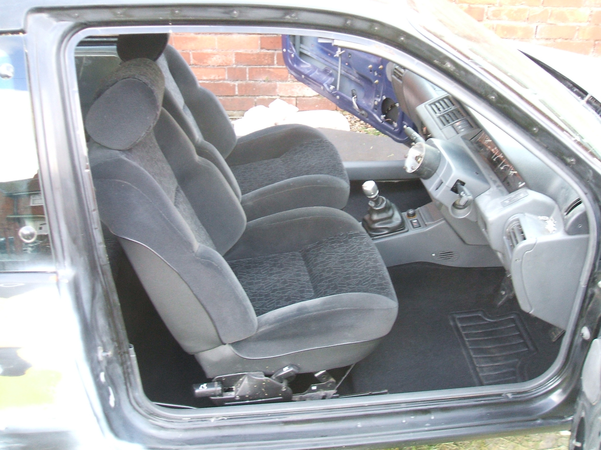

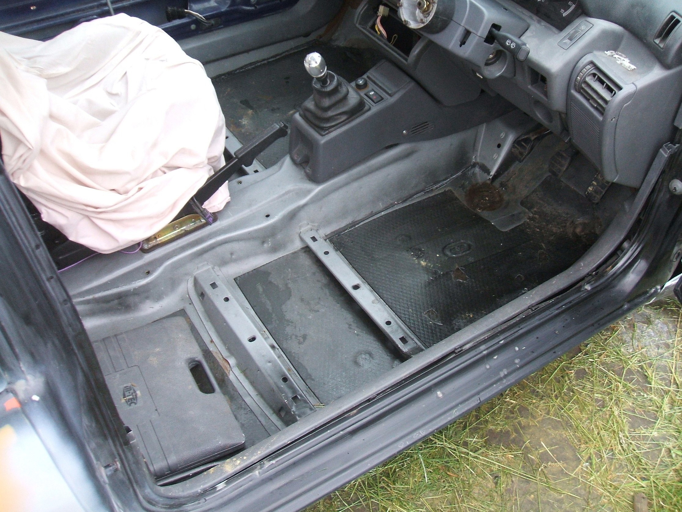

seats in carpet in
carpet has no marks or real wear and tear tbh, comes up immaculate, same with seats, no signs of wear, no rips or anything, interior looks good!, just need to tidy the dash up, gonna paint top dash black i think along with sil section trims and A pillar trims

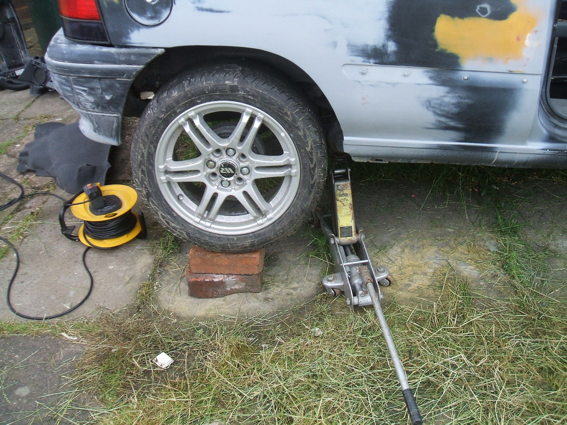

bit sketchy going under there to do up the subframe nuts lol

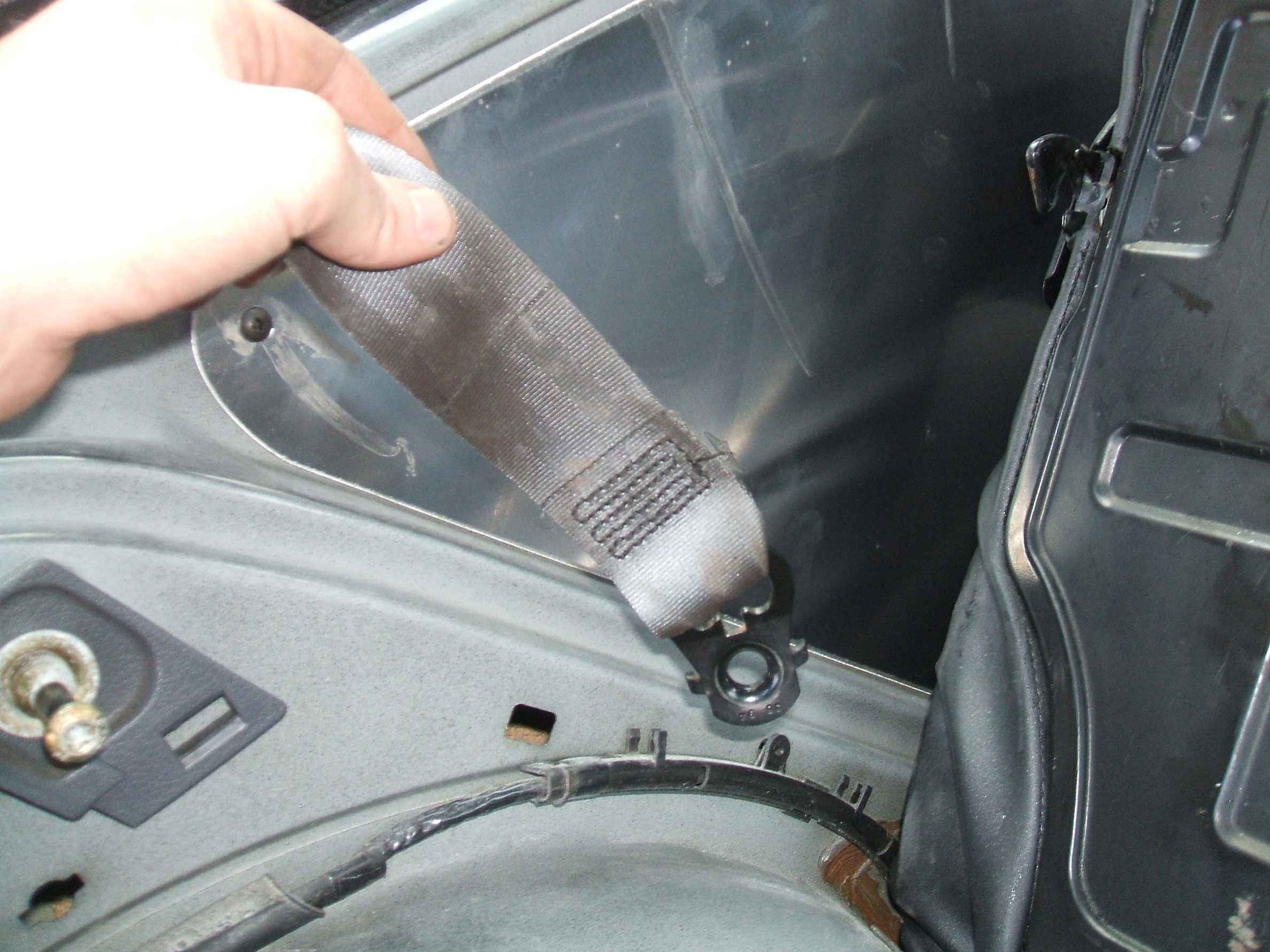

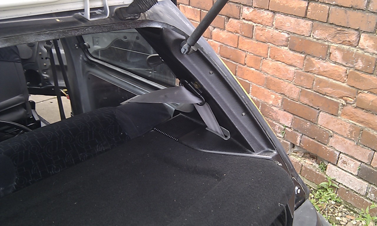

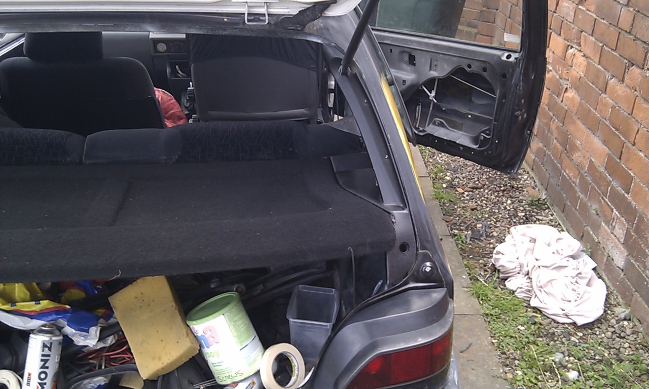

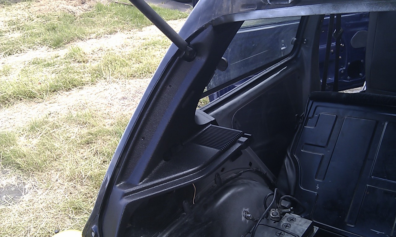

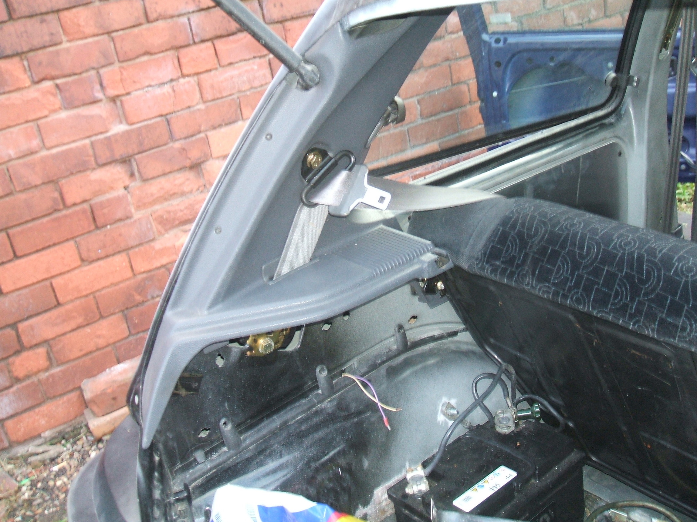

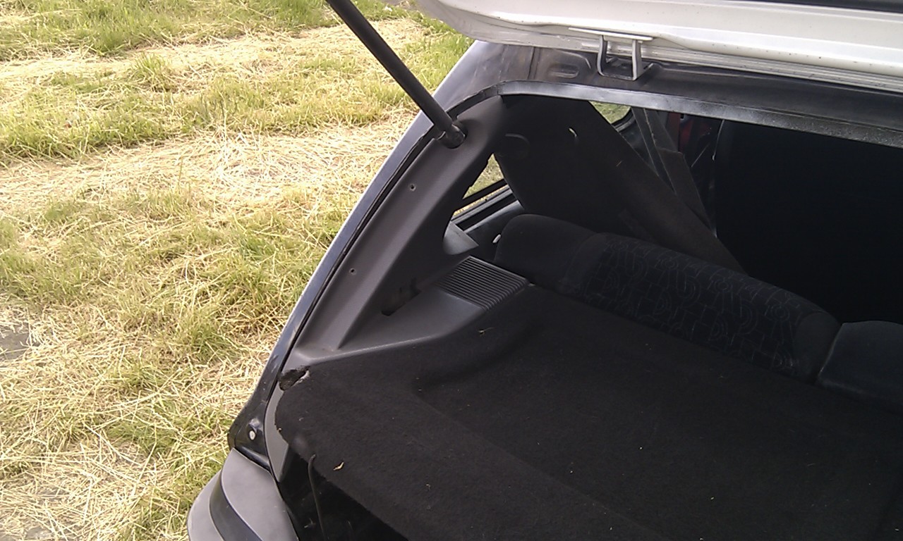

rear quarter plastics in, belts in,although i have no idea where it anchors down

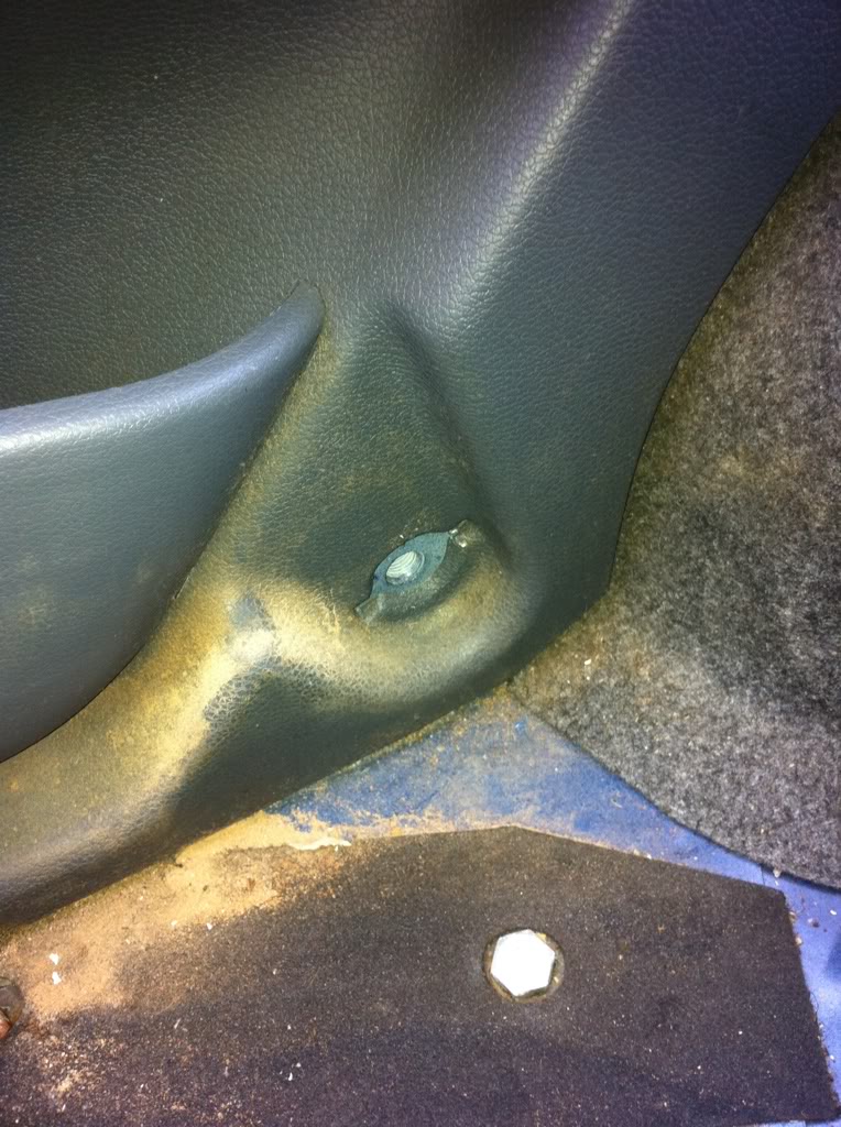

where the f**k does this bolt too??? i looked under seats, on rear quarter, couldnt see it?

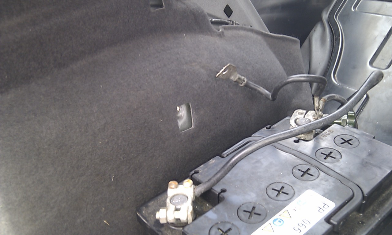

hooked the new battery up too to test stuff and everything is working as it should except the clock, dunno wtf is up with it, makes a noise but dont move :S

i must have sat in my boot for about 30 minutes trying to get the rear belt to open up for me so i could thread it though the quarter plastic. the buckle was like an inch away from the actual reel and no matter what angle i put it, it just would not reel out -.- nightmare

If you look just infront of the rear seat upright with the lower part lifted/removed you will see the mounting point, even more noticeable if you had the rear doorcards as it goes though them.
  Punto/Clio GTT
actually! im guessing its behind my ally quarter sheet if it goes through original plastic trim? does it bolt to the inner arch skin? and come up through the quarter plastic?

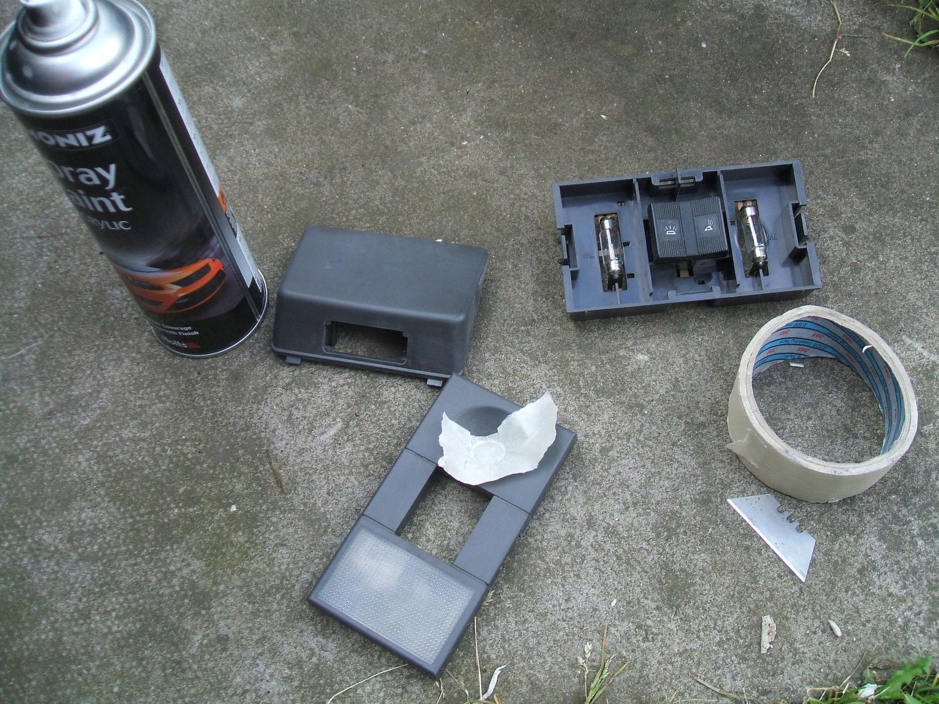

gonna just give it a grey scotch in some soapy water, get rid of any silicone. panel wipe, then i reckon itd be alright using just satin/matt black paint. parts aint gonna be moved at all, rarely touched. think the only movement from the dash will be from bumps in the road and engine vibration, should be fine!
ill be using these on my trim pieces and top dash http://www.ebay.co.uk/itm/x2-SIMONI...ssories_Car_Care_Cleaning&hash=item43a8d411e9
gave a nice finish on my centre console in the roof

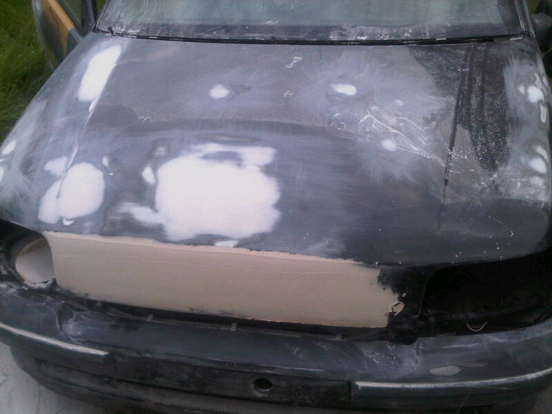

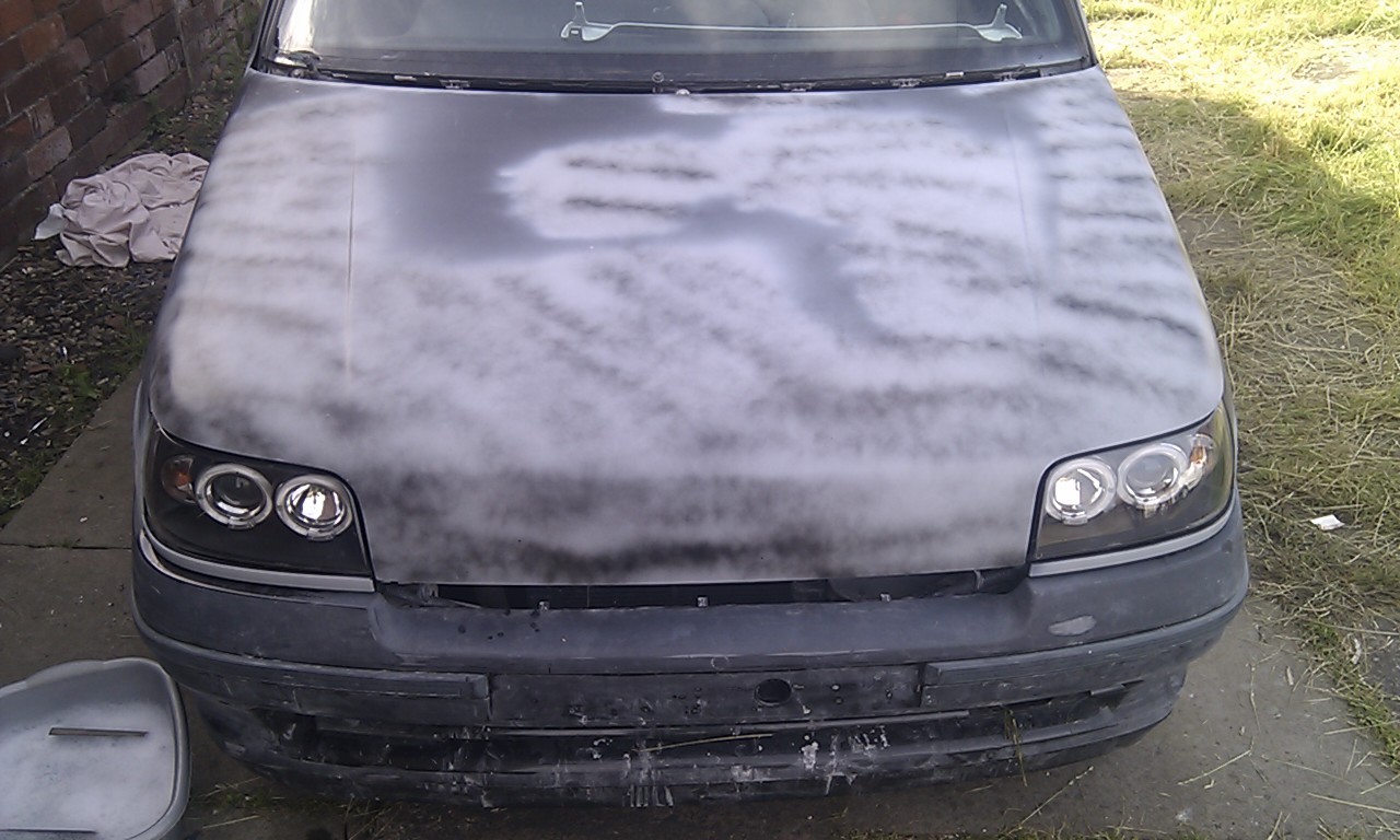

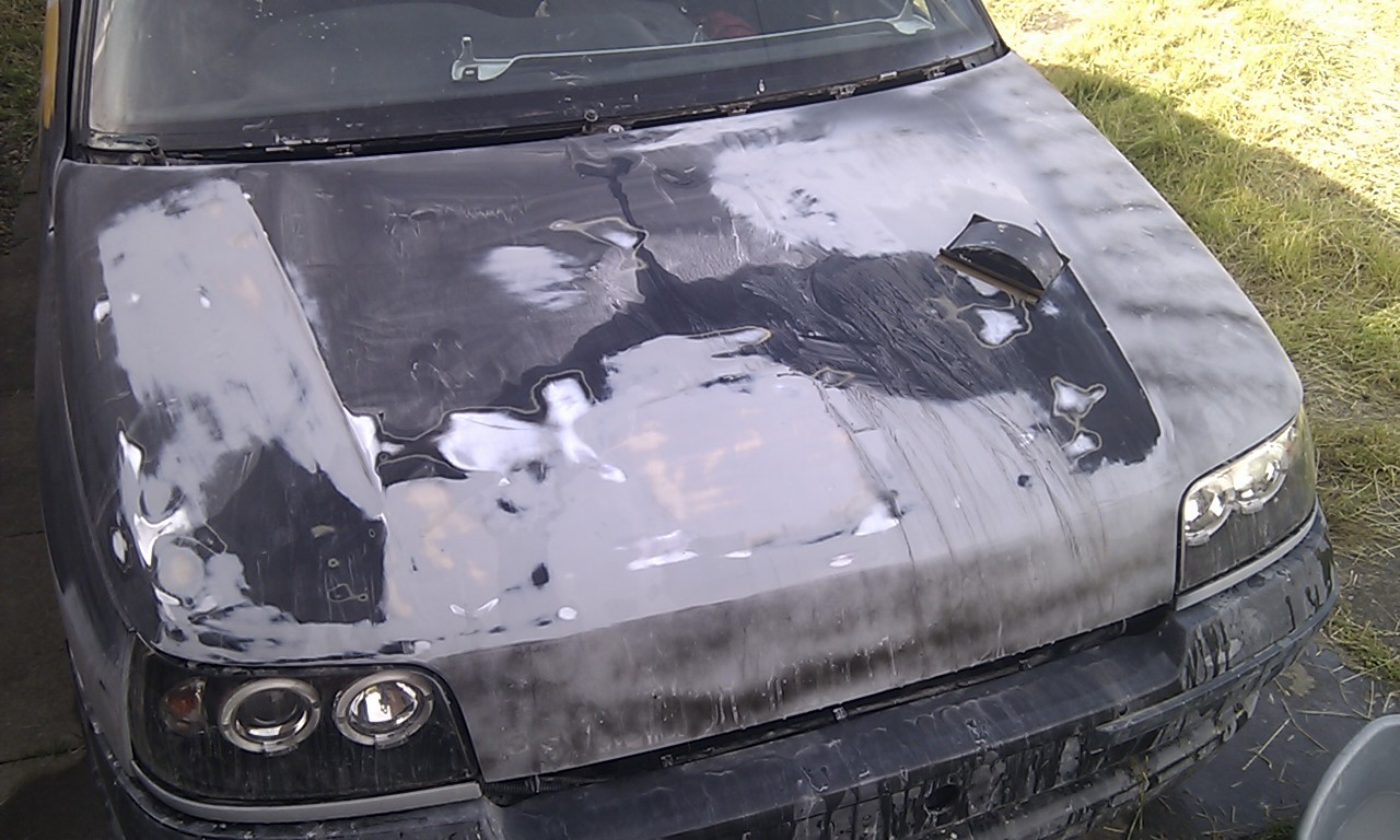

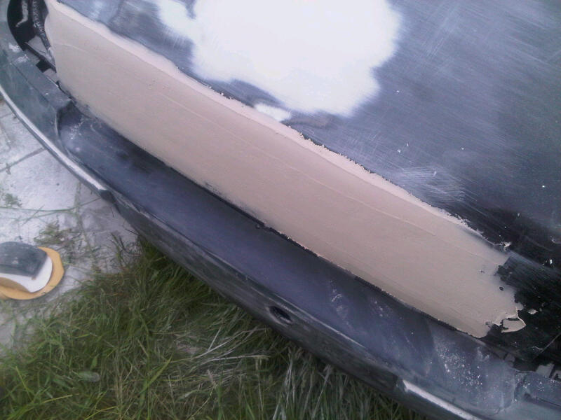

done a bit of work today, just the bonnet, started late n i was volunteered to cook the tea, for 8! spag bol it was :p
ran out of primer so could only go over bits of baremetal and a few other places, couple more tins ordered
how it was

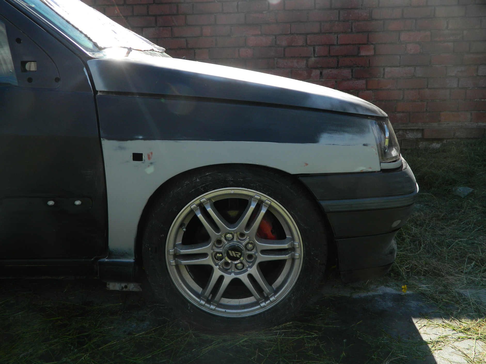

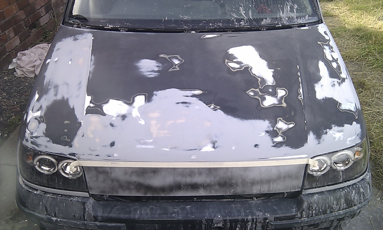

wetflatting progress, sanding out scratches, lots of scratches
getting my line straight

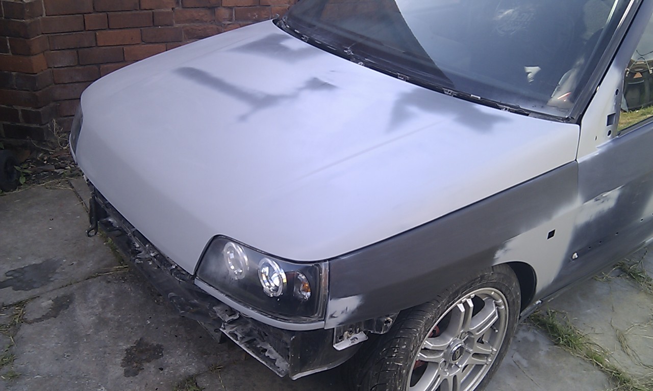

flatted
stone chips filled with stopper
primering
and how i left it for tonight
busy tomorrow, so friday ill hopefully have the primer and ill be able to finish that off and the front where the badge was, then sand the side. the side looks alright tbh, hoping it will sand down nicely, definatly wish id have just put a new bonnet on it now, but then again id still have had to fill dents and took out chips, so i guess the effort was worth it

woahh lots of stopper, ive only ever been taught to use stopper very very finely just as to fill in the chip, ( call it chipping up ) then wet flat, yours looks so thick :S progress is good tho man
  Punto/Clio GTT
yeah you should only really use it as a really tight skim, and you put in 2 or 3 tight skims to fill a chip. but it was getting late + im lazy and i just wanted it filled in 1 go, so made it a little thicker

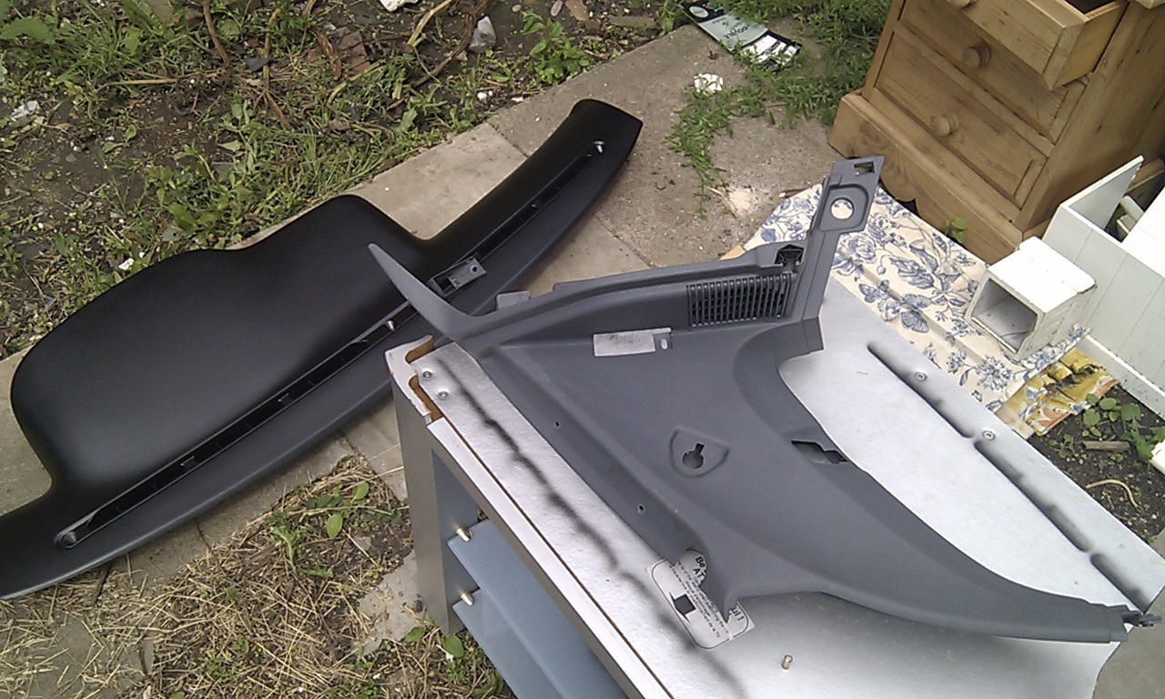

couple cans of black spraypaint for painting topdash, other plastics, scuttle, door handles, boot lock etc
and few tak rags for when im painting
  Punto/Clio GTT

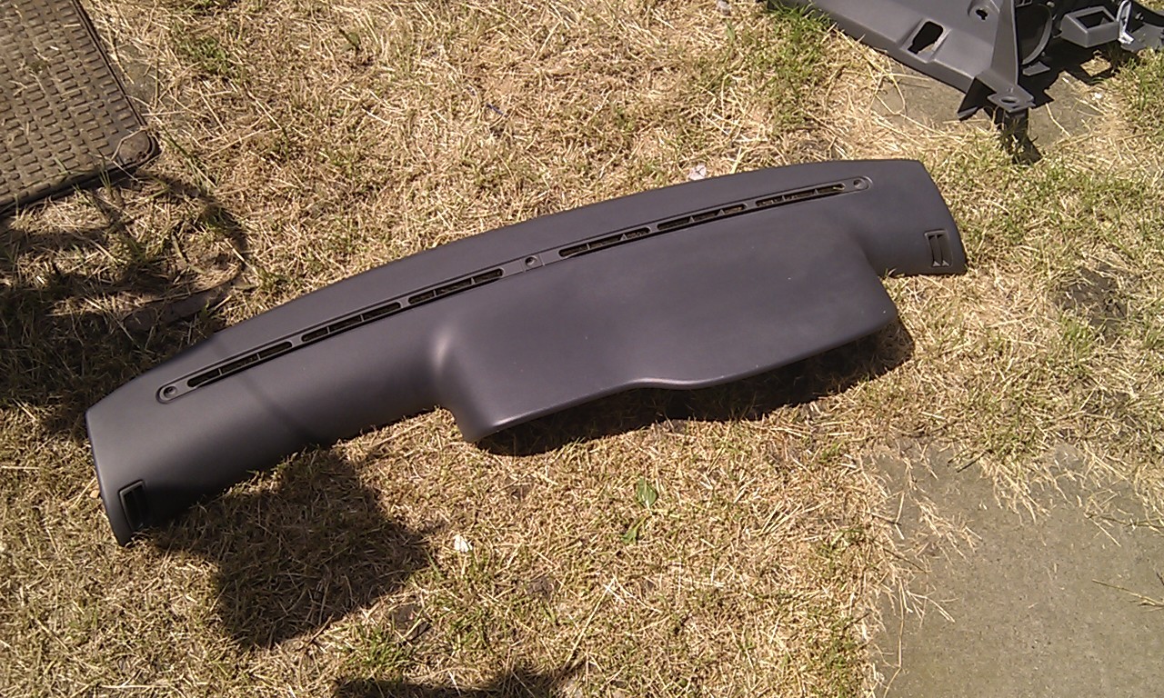

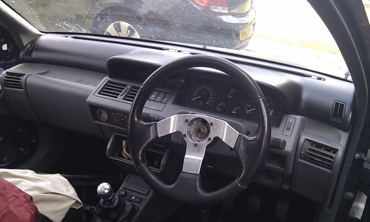

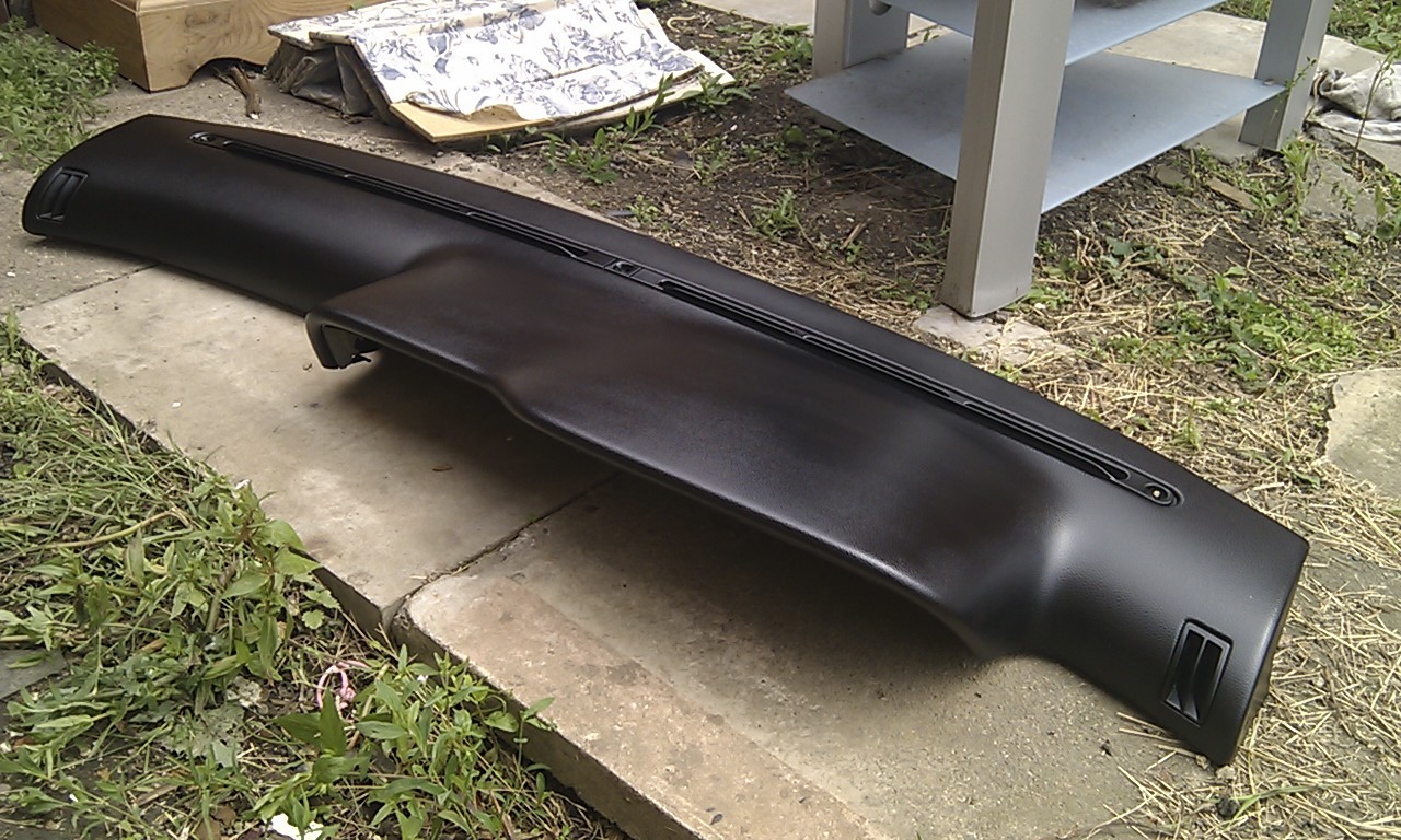

another monster day -.-

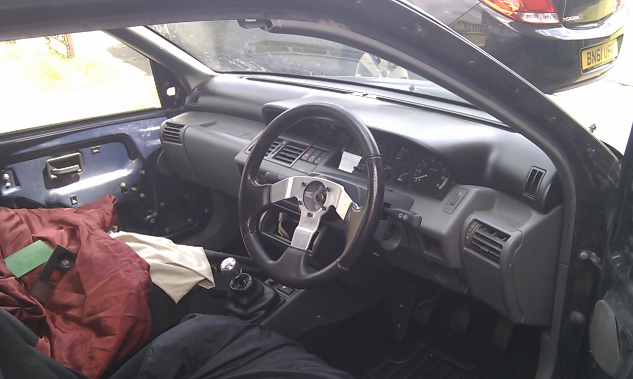

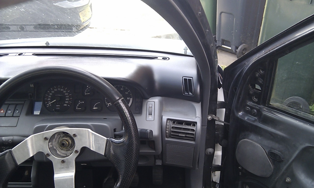

top dash out

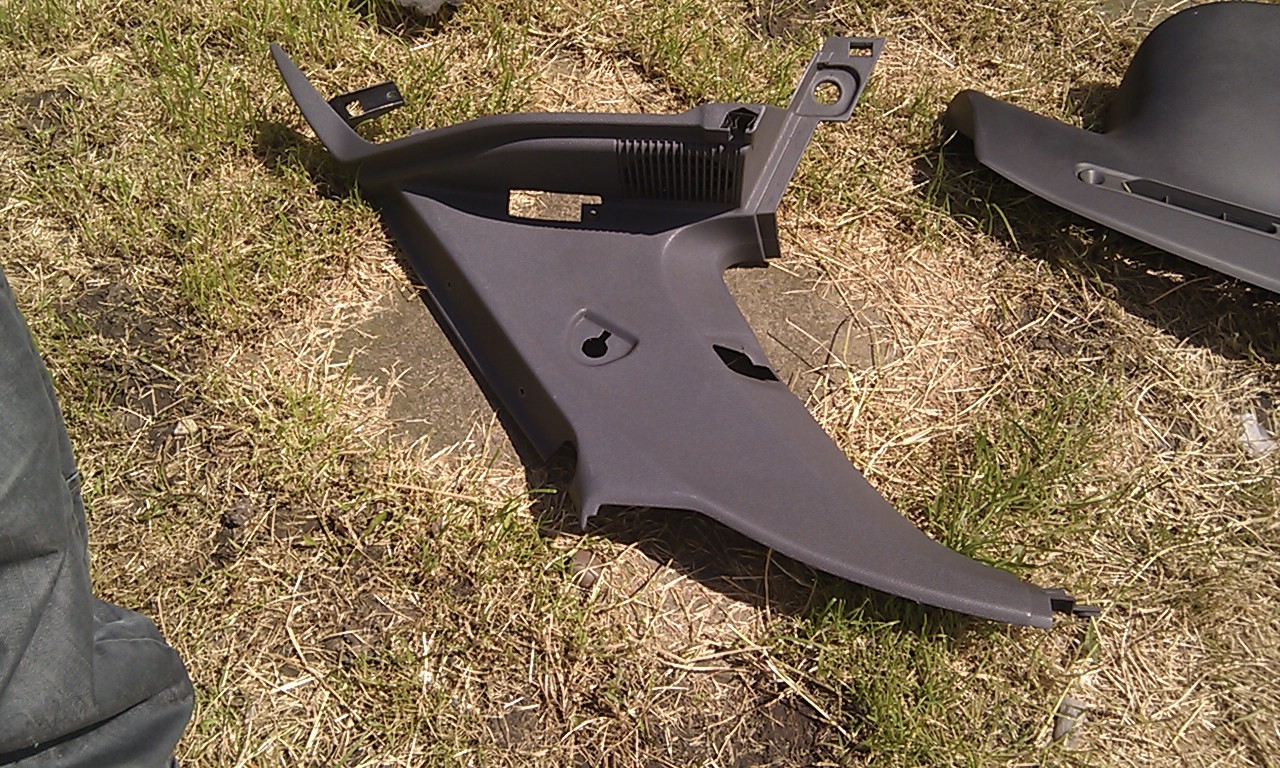

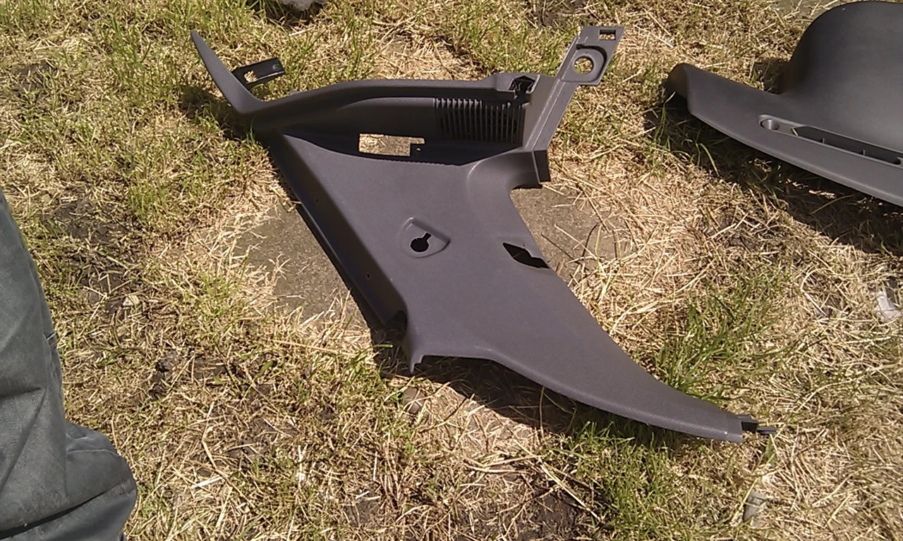

quarter plastic out
dash painted
colour compared to original colour (same as quarter plastic)
refit, i think it came out mint tbh, looks awesome, freshens the dash up
shoulda cleaned my window really lol
quarter plastic painted and fit, again, looks great i think
from grey
to black

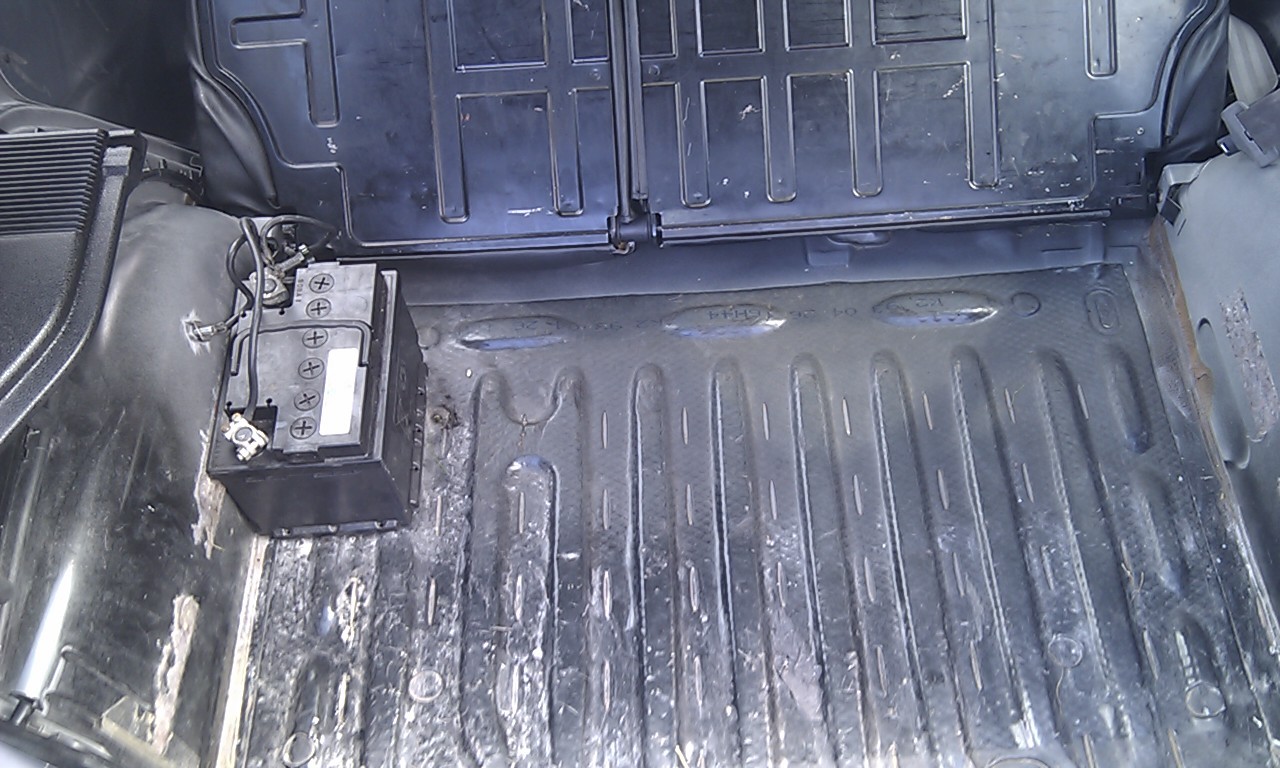

side carpet in, battery earthed
carpet in, other side carpet in, parcel shelf in

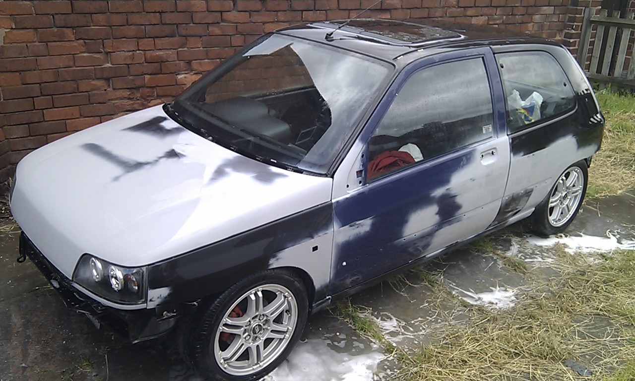

ok, FINALLY, the car is ready to paint :D finished everything off today
quarter flatted, chips filled

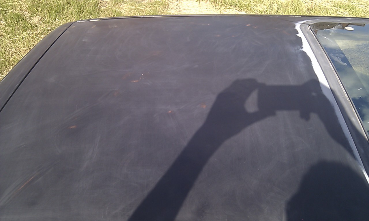

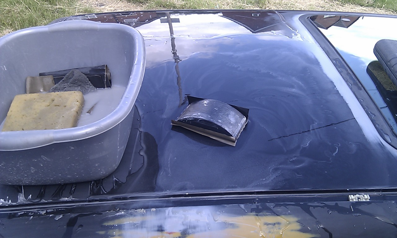

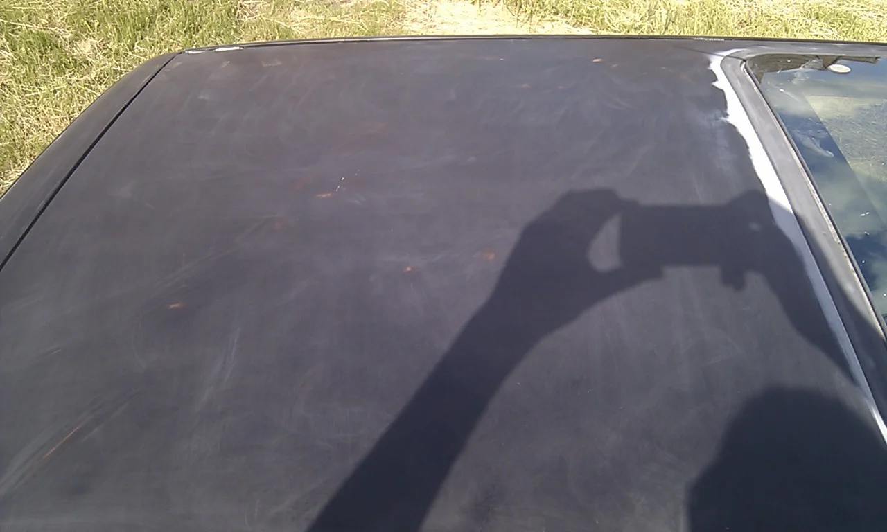

roof flatted
roof scratches filled n couple of chips
quarter reprimed
bonnet primed

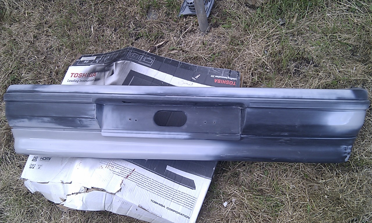

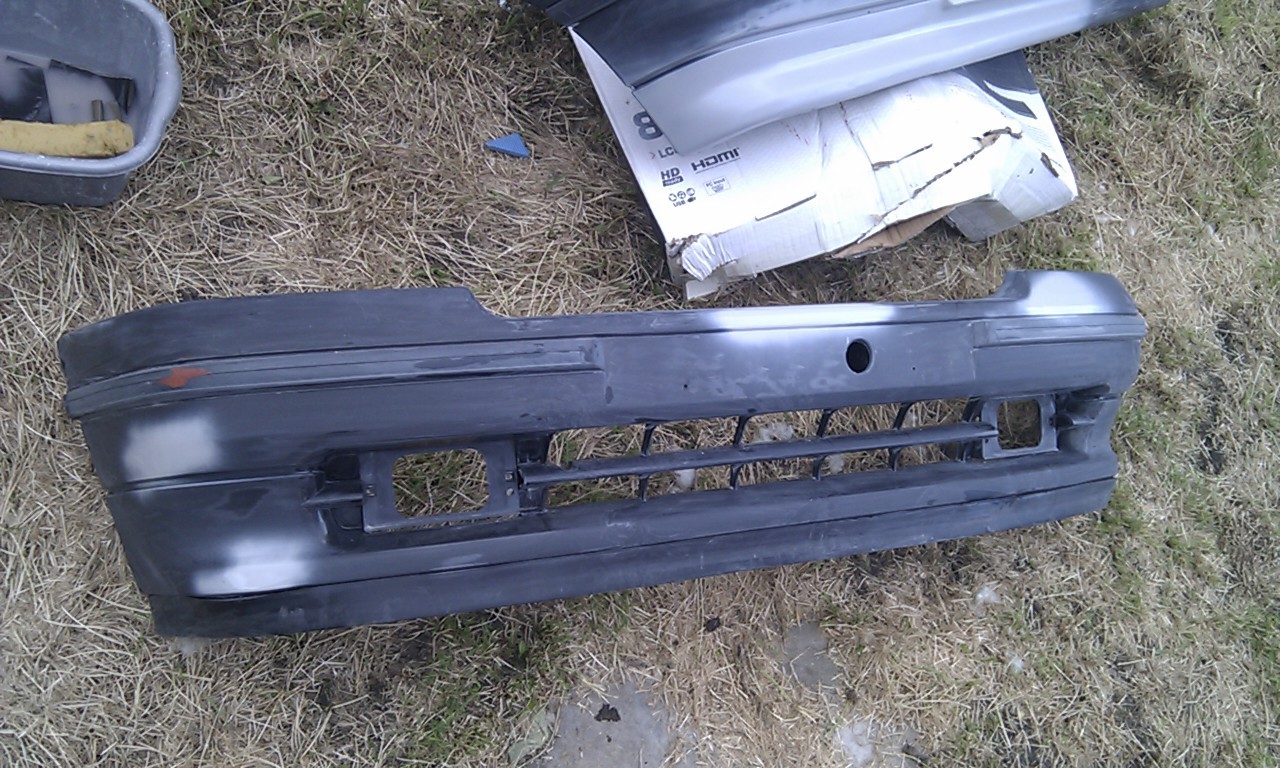

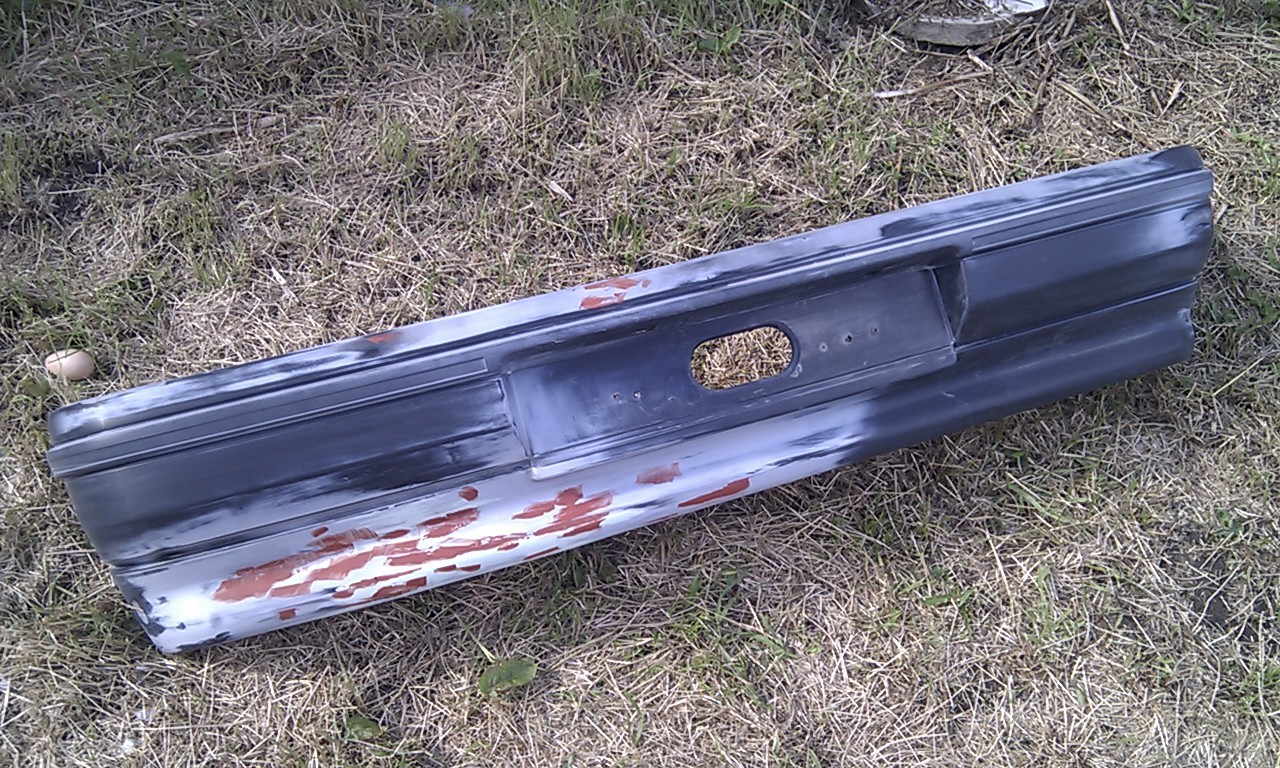

back bumper flatted and chips filled
bumper reprimed, has been flatted n its ready for paint
front bumper flatted n primer, has been flatted aswell ready to paint
entire car gone over with P500 scuffpad wet just to get rid of any overspray from primer and to scuff any bits i'd missed previously
car cleaned, 1 bowl with fairy liquid method
paints being bought next week, vauxhall glacier white. need to get few other bits aswell, hardener, panel wipe, thinners, masking paper, masking tape. then its going to my cousins not this friday, next friday and ill be painting it all over the weekend, excited!

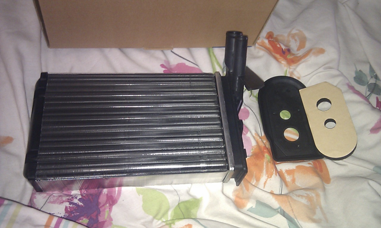

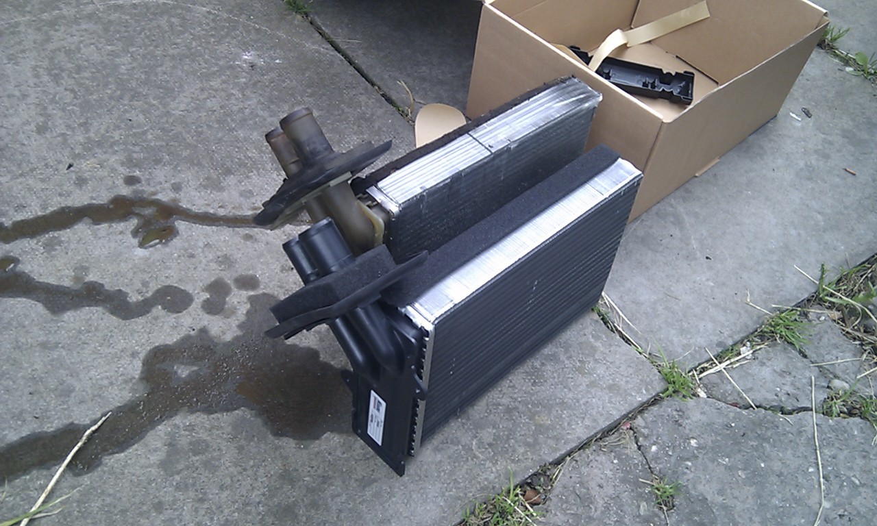

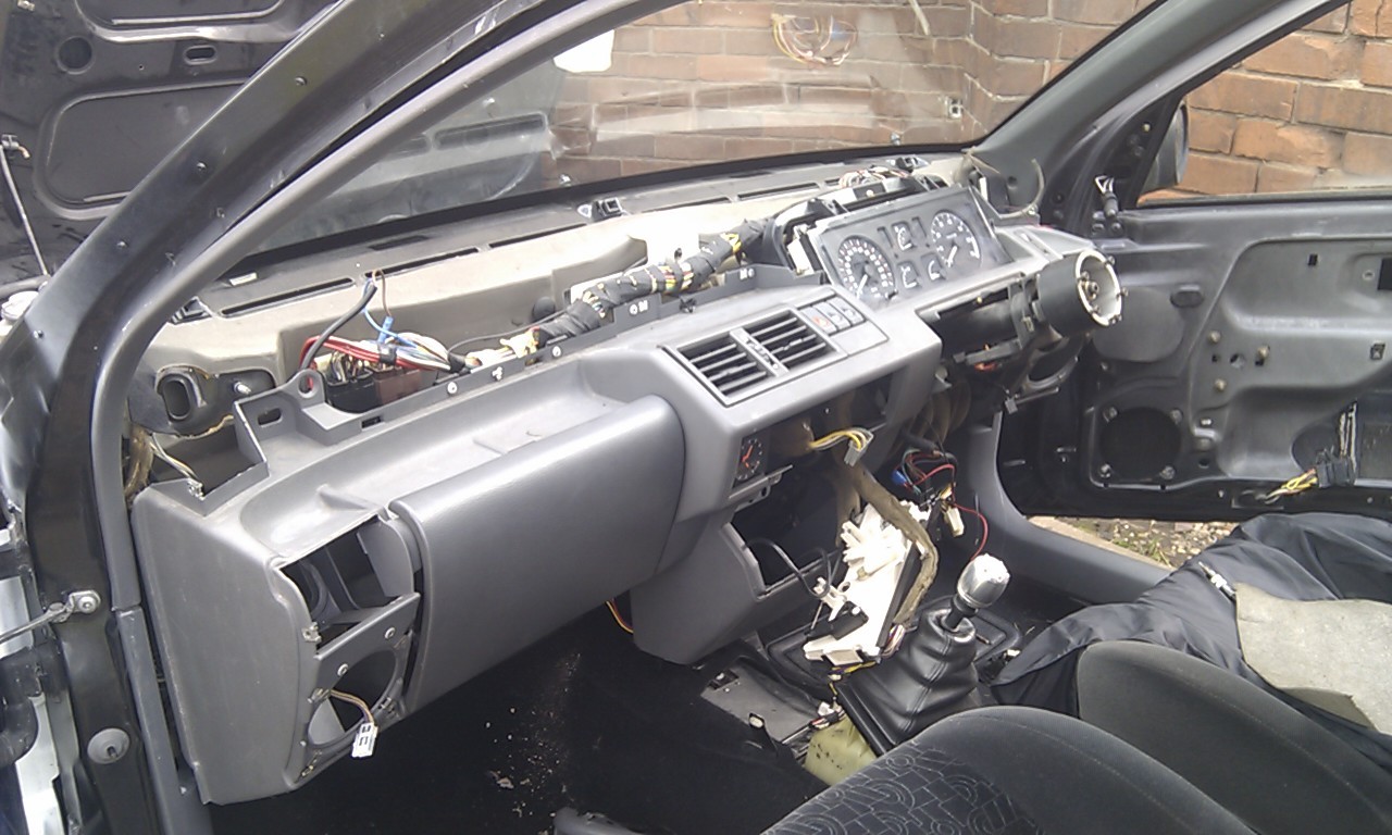

heater matrix came today, rapid delivery from GSF car parts and also the cheapest around!

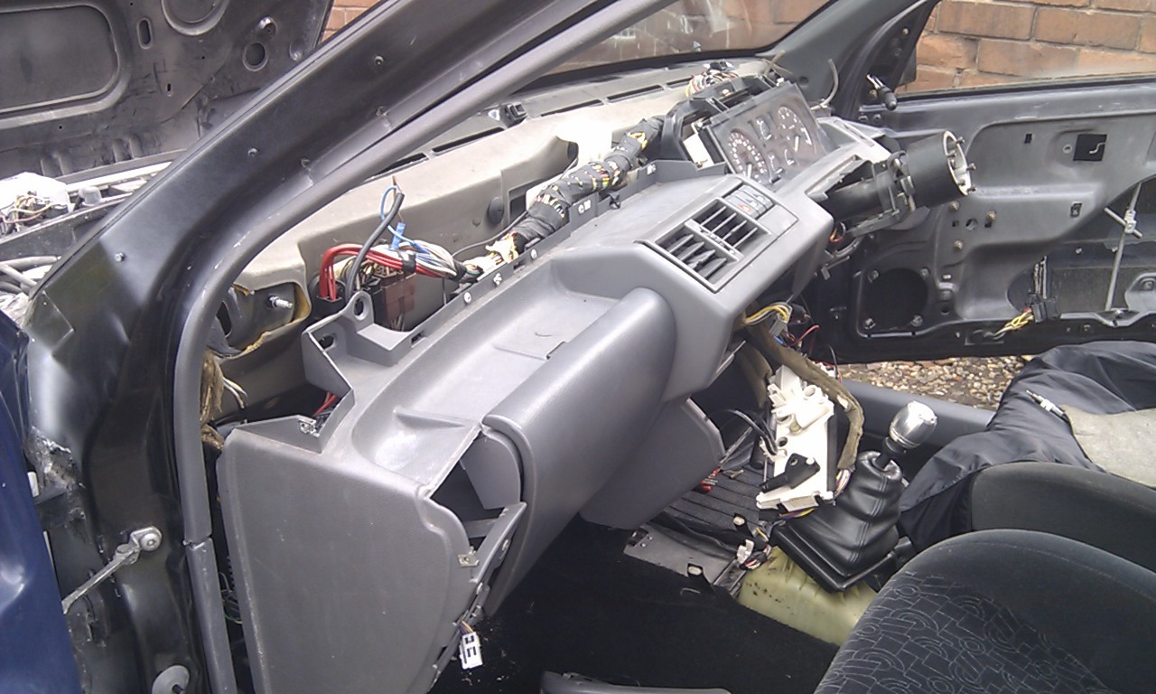

dash out n pulled forward following the guide on williamsclio. never really done anything as extensive as this before, but i managed it. was a ballache to get it out, but it went back in nice n easy, just gotta get some coolant now and flush the system properly
old one out, compared to new one
in total, probably took me an hour n 15 minutes to take the old one out and put the new one in, aint fitted the dash back together yet as i wanna run boost pipes through the dash

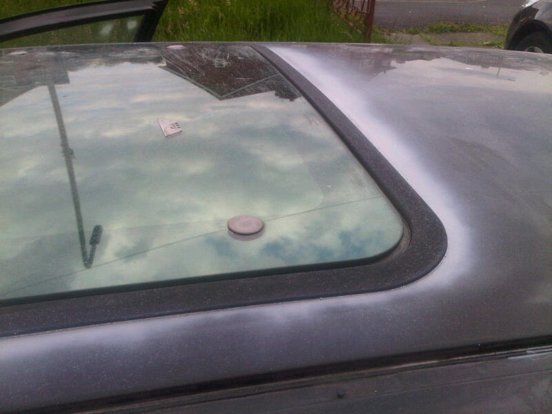

oh and the sunroofs still f**king leaking haha
ive found that its coming in at the actual glass, it dont sit flush with the rubber seal, theres a small gap and its running down to the inside. dunno what im gonna do yet
