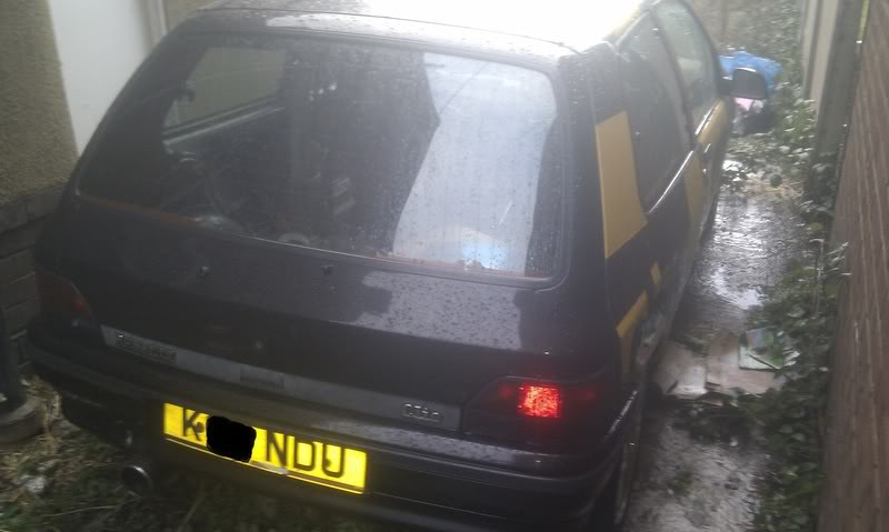

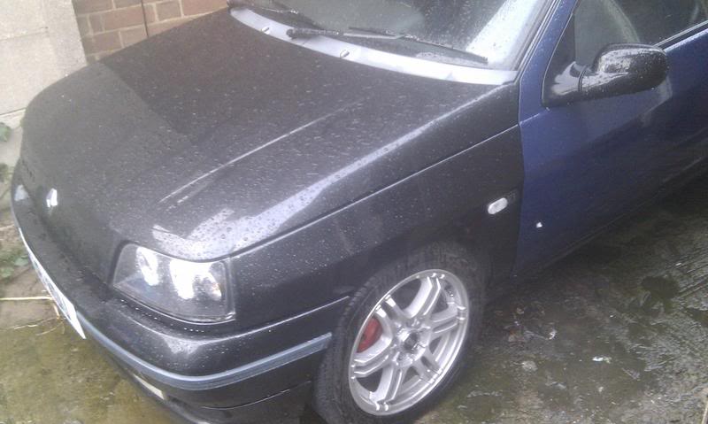

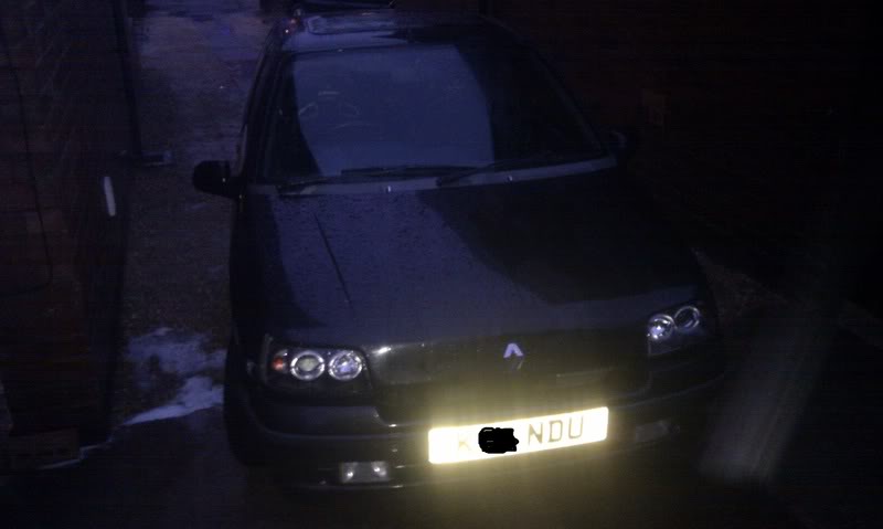

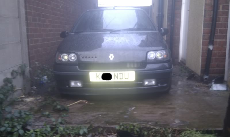

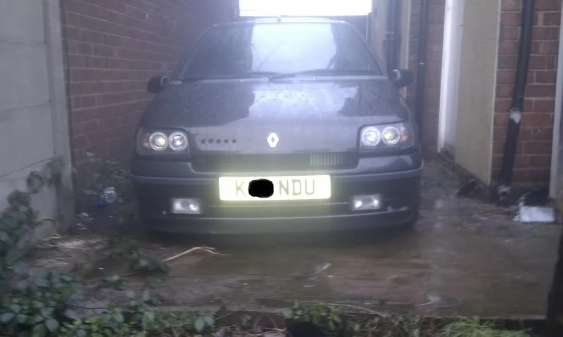

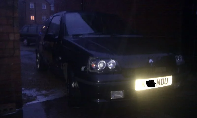

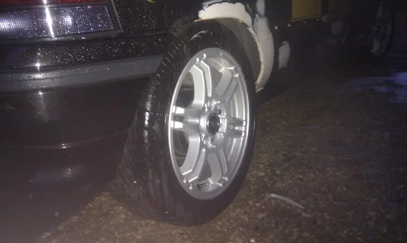

After 5 years with no car, ive finally bought a new one to restore ready for spring time.
ATM it aint very pretty to look at, filler/primer all over the place, bumpers hanging off and the interior ( or lack of) needs some serious TLC.
Its been sitting in my cousins garage for a few years now just been messed with every now and again, but he couldnt really be bothered with it, so i made him an offer and he took it, it now sits in my back garden ready for me to attack the bodywork and make it mint. Currently it sports 2 bucket seats, a dashboard and thats it.

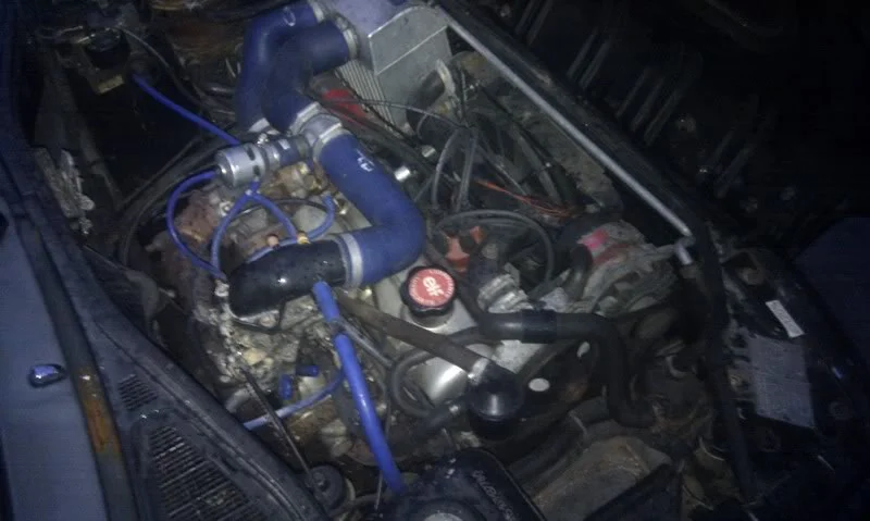

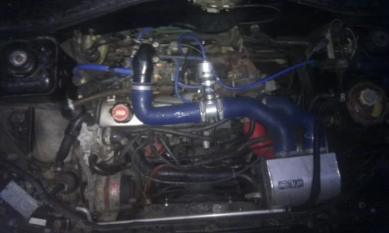

So, spec;
Its a K plate 1.4RT shell, very minimal rust which is good
its running a R5GTT engine (phase 2 120bhp)
KTR camshaft and rebuilt bottom end
Brand new R5GTT intercooler
dumpvalve
PAS removed for weight saving
janspeed (?) straight through exhaust with decat

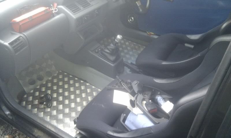

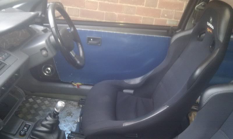

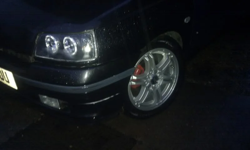

Corbeau Forza Sport bucket seats

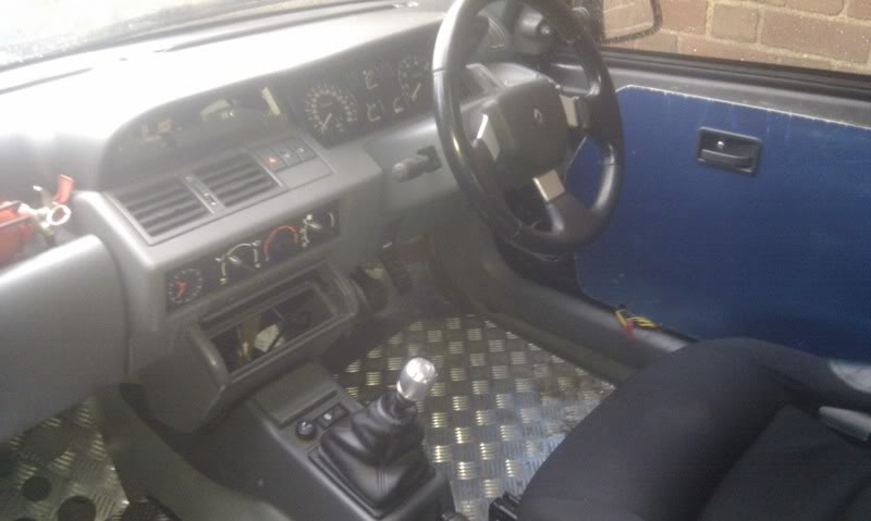

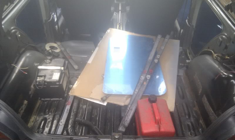

Aluminium custom plates for doors/rear quarters/foot wells
Black Angel Eye Headlights
Battery mounted in the boot
195/50 15" alloys with new tyres all round
samco(?) hoses
lowered 55mml+ front/80mm rear
it has an induction kit and uprated brakes but i aint had chance to look at them yet to find out what they are
sorry for the s**tty phone pictures, it was raining and dark, ill try get better ones up if its dry tomorrow

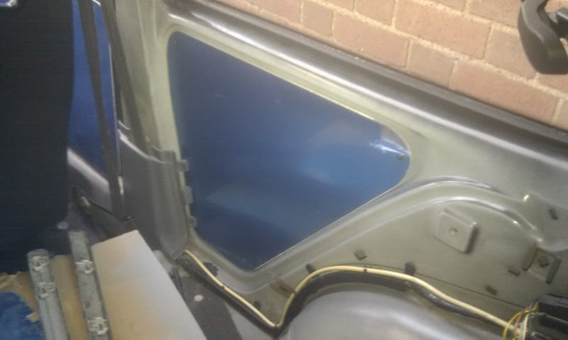

- fit alluminium door/rear quarter cards which i have ready to fit, fit custom handles and window switch housings

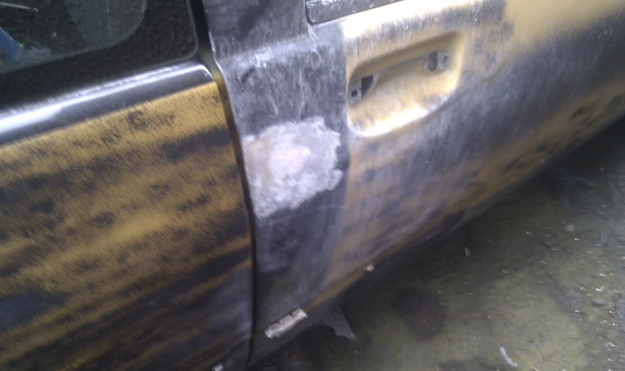

first day of progress! had sunshine all day. managed to delock the doors, weld it up n get it in fibreglass, dewipered and welded up the hole for the washer jet on tailgate too.

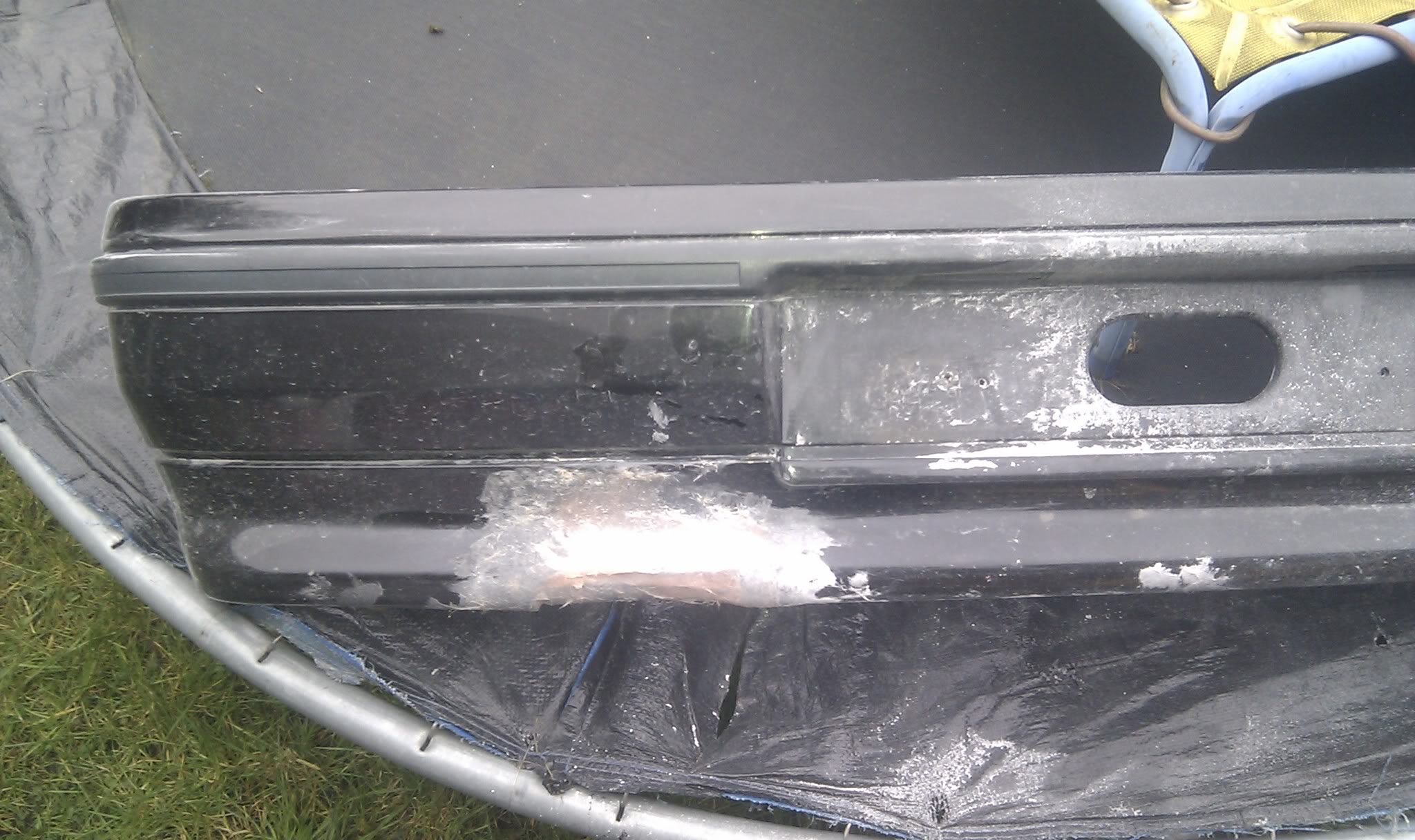

bumper had a big crack in it and a shoddy old repair, all grinded out and fibreglassed. ill throw pictures in tomorrow as it went dark!

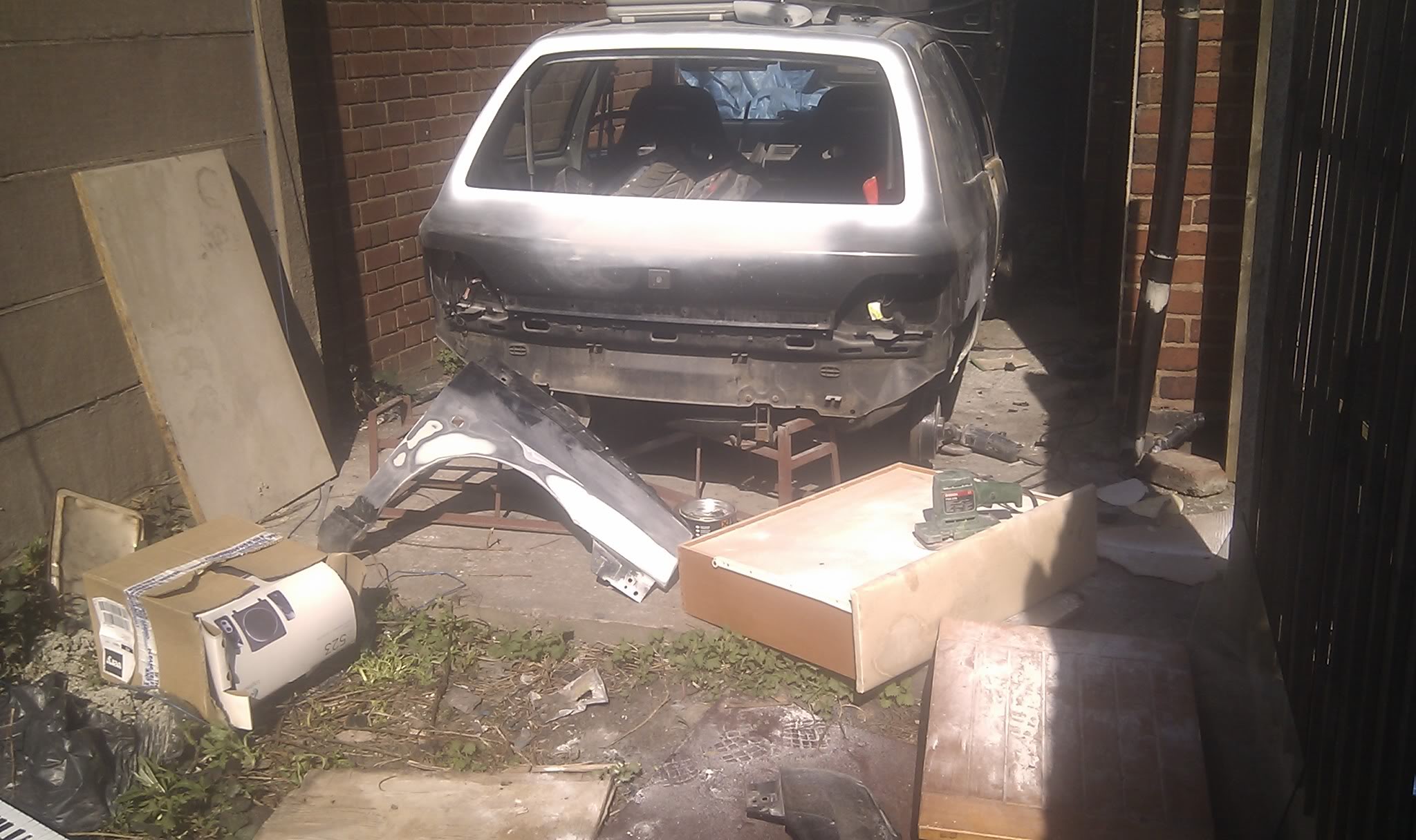

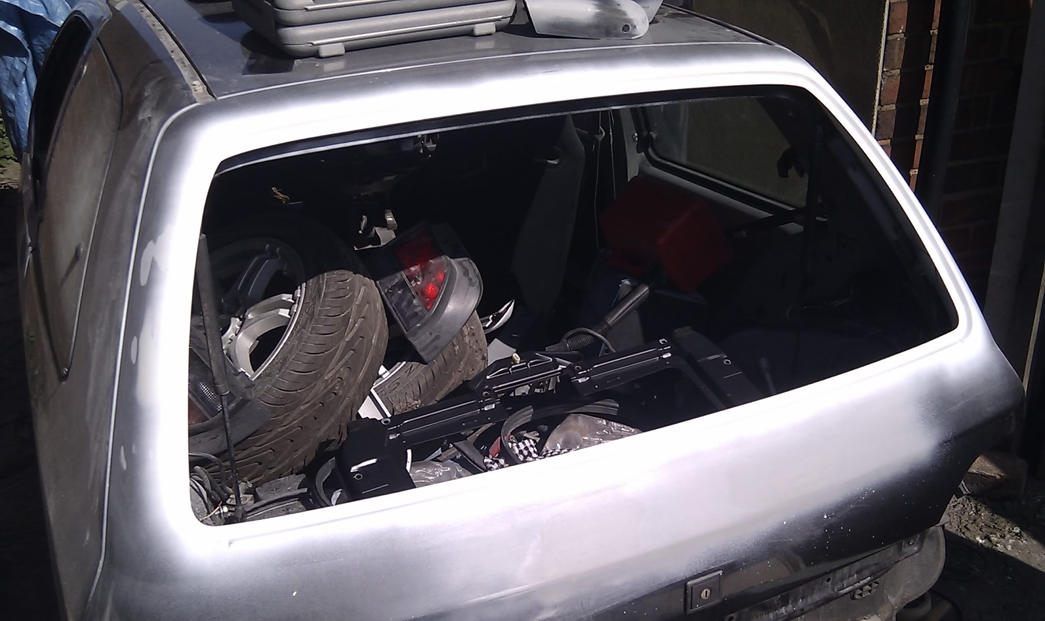

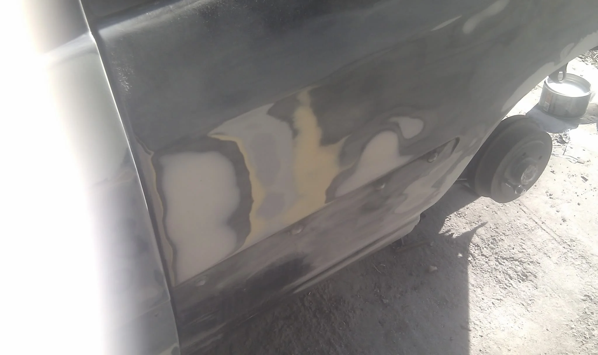

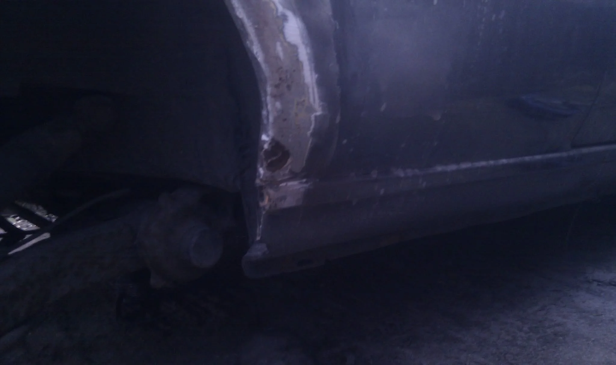

managed to get some work done today as the weather held off!

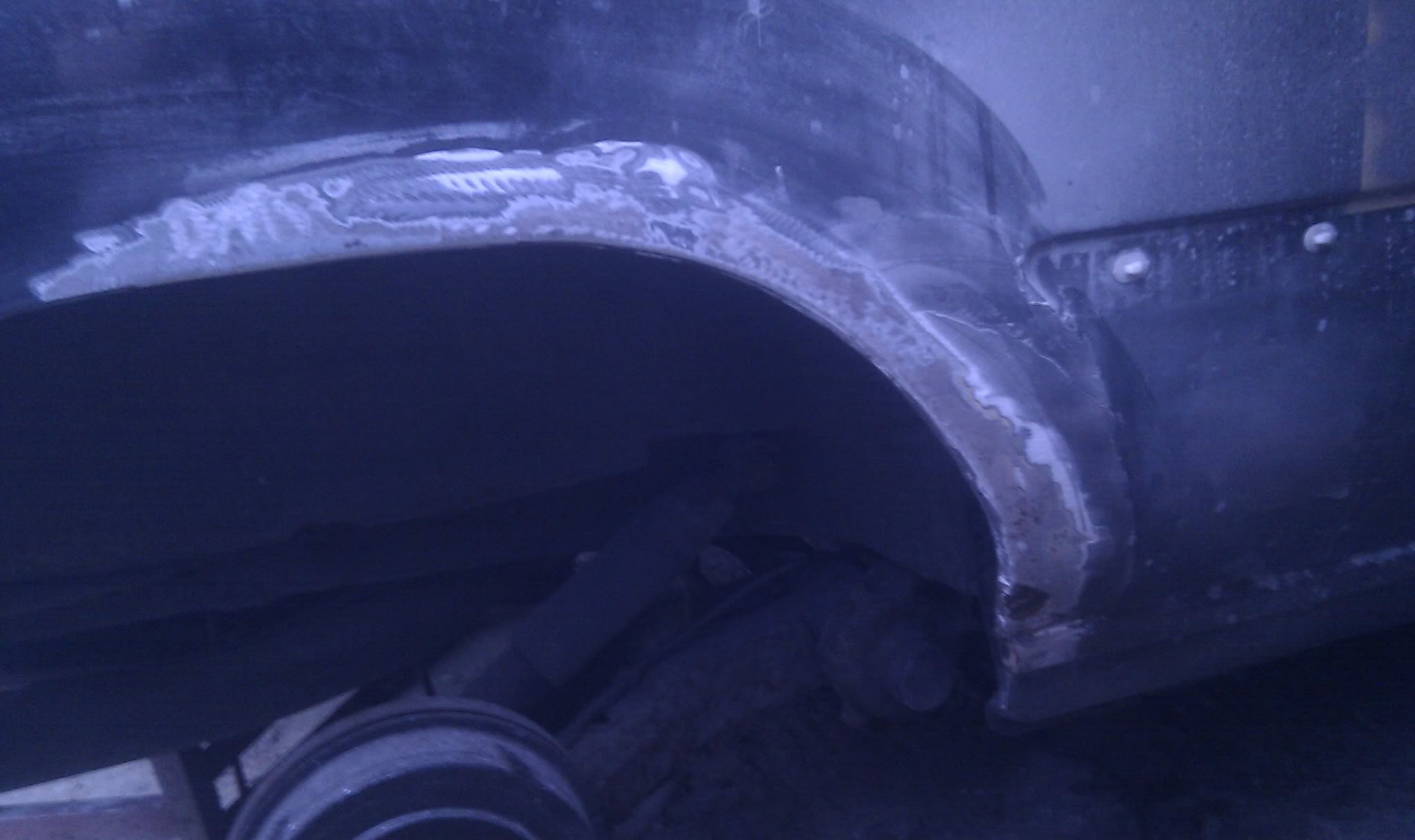

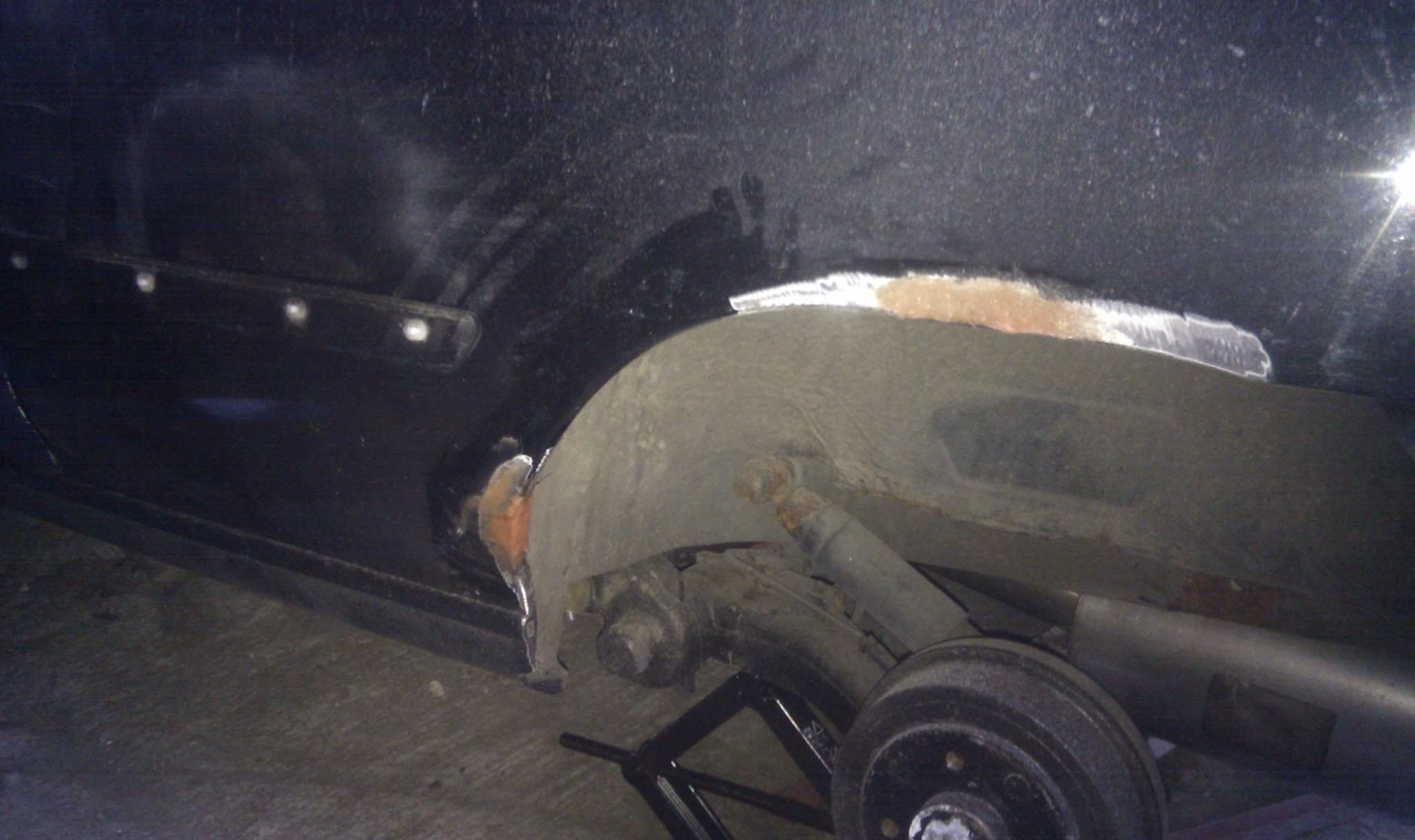

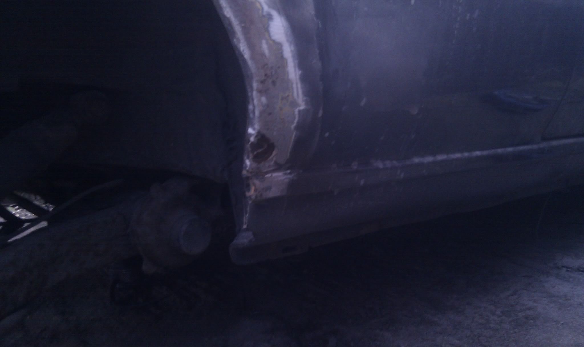

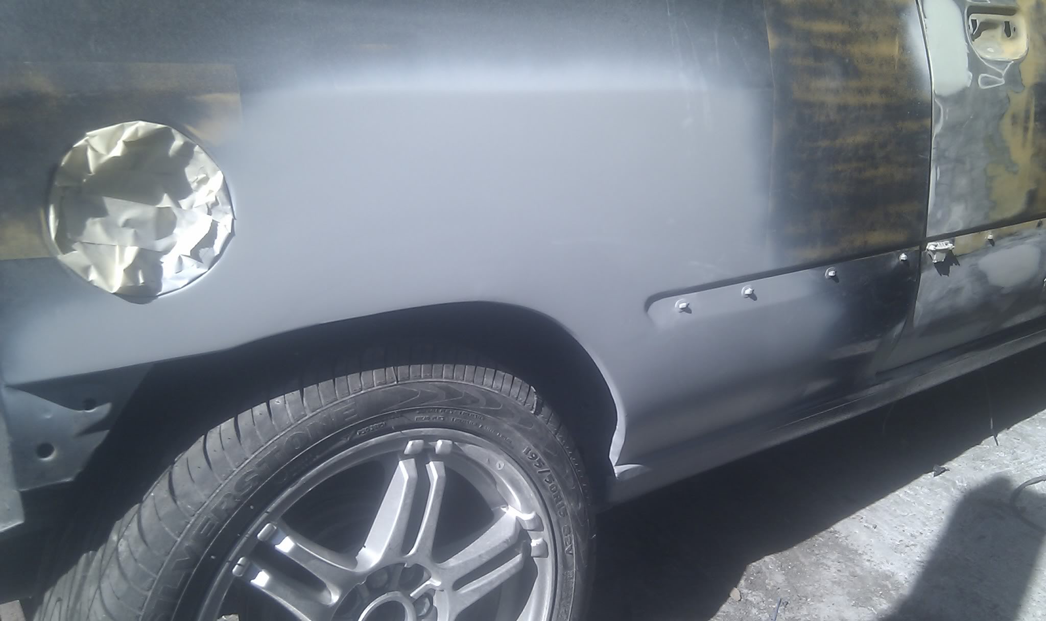

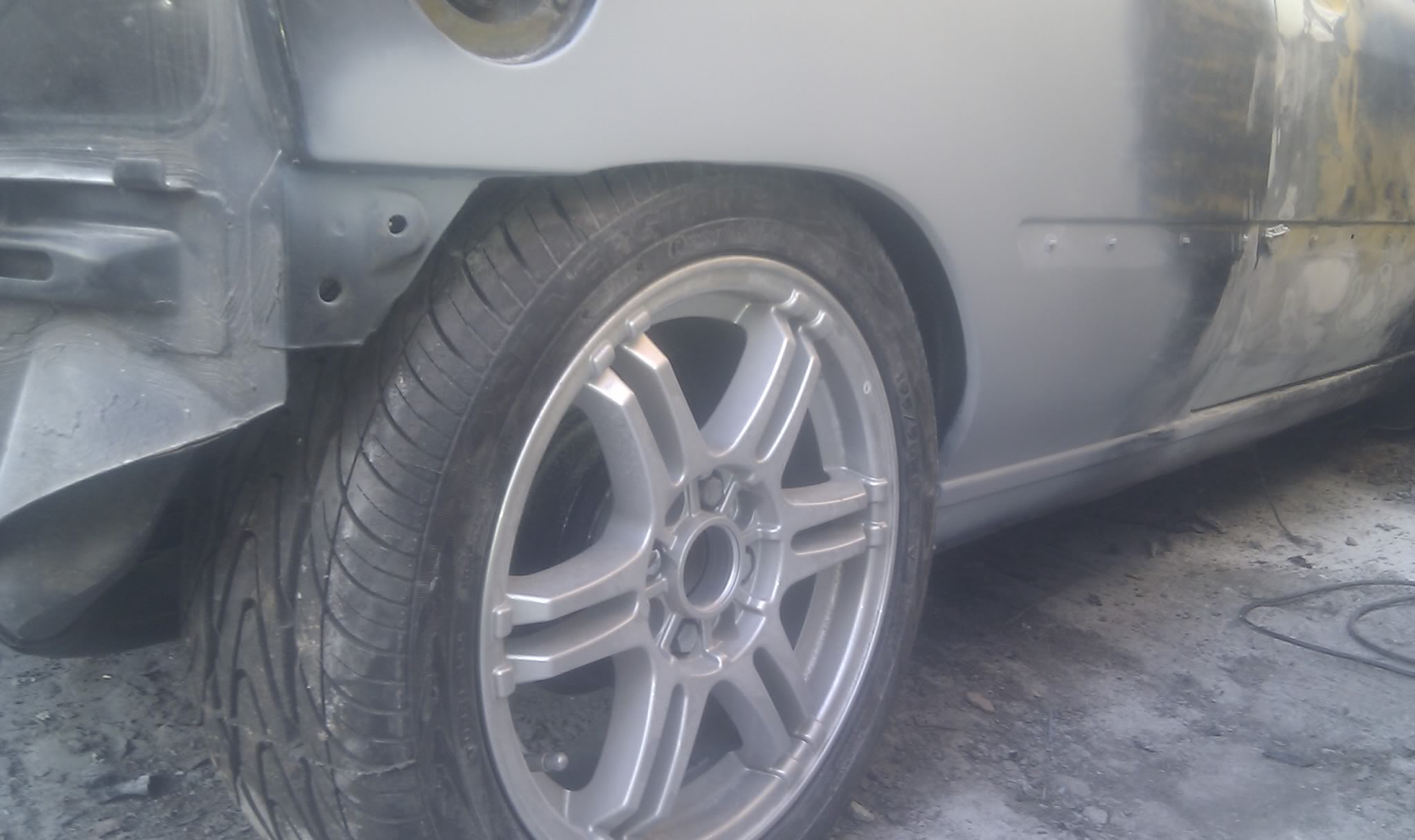

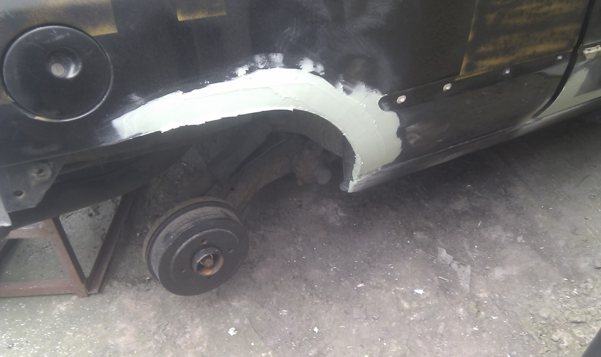

ground out all the arches to get rid of any rust, 2 holes, couple bits of surface rust, but mostly in good condition for a K plate!

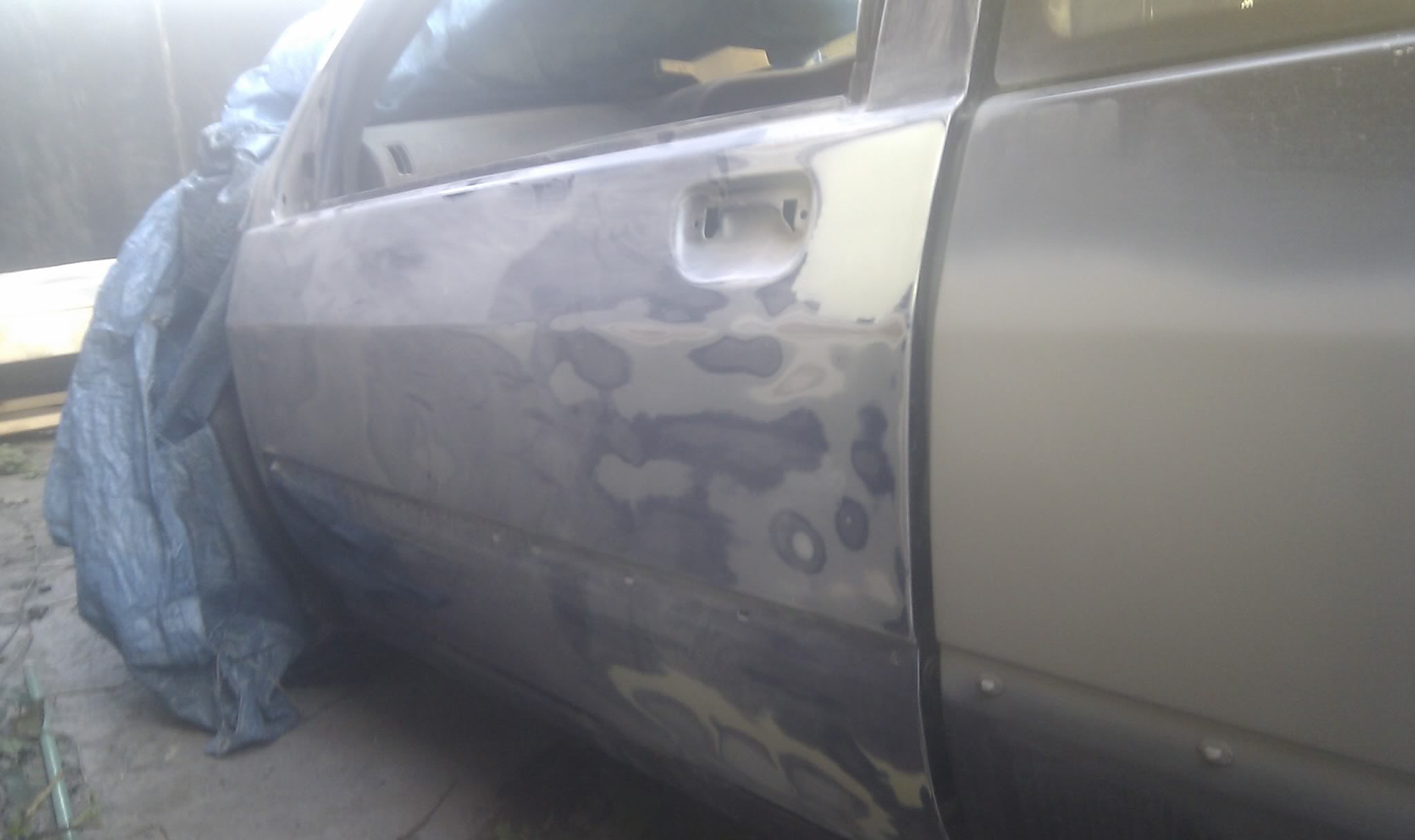

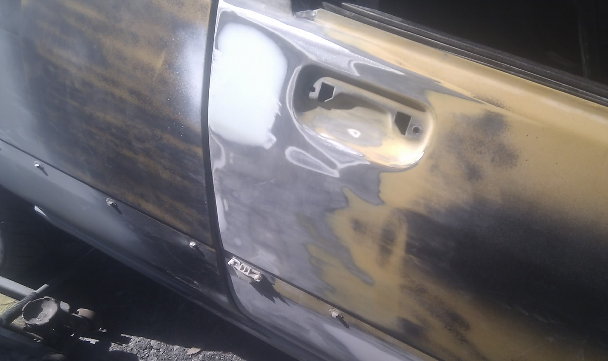

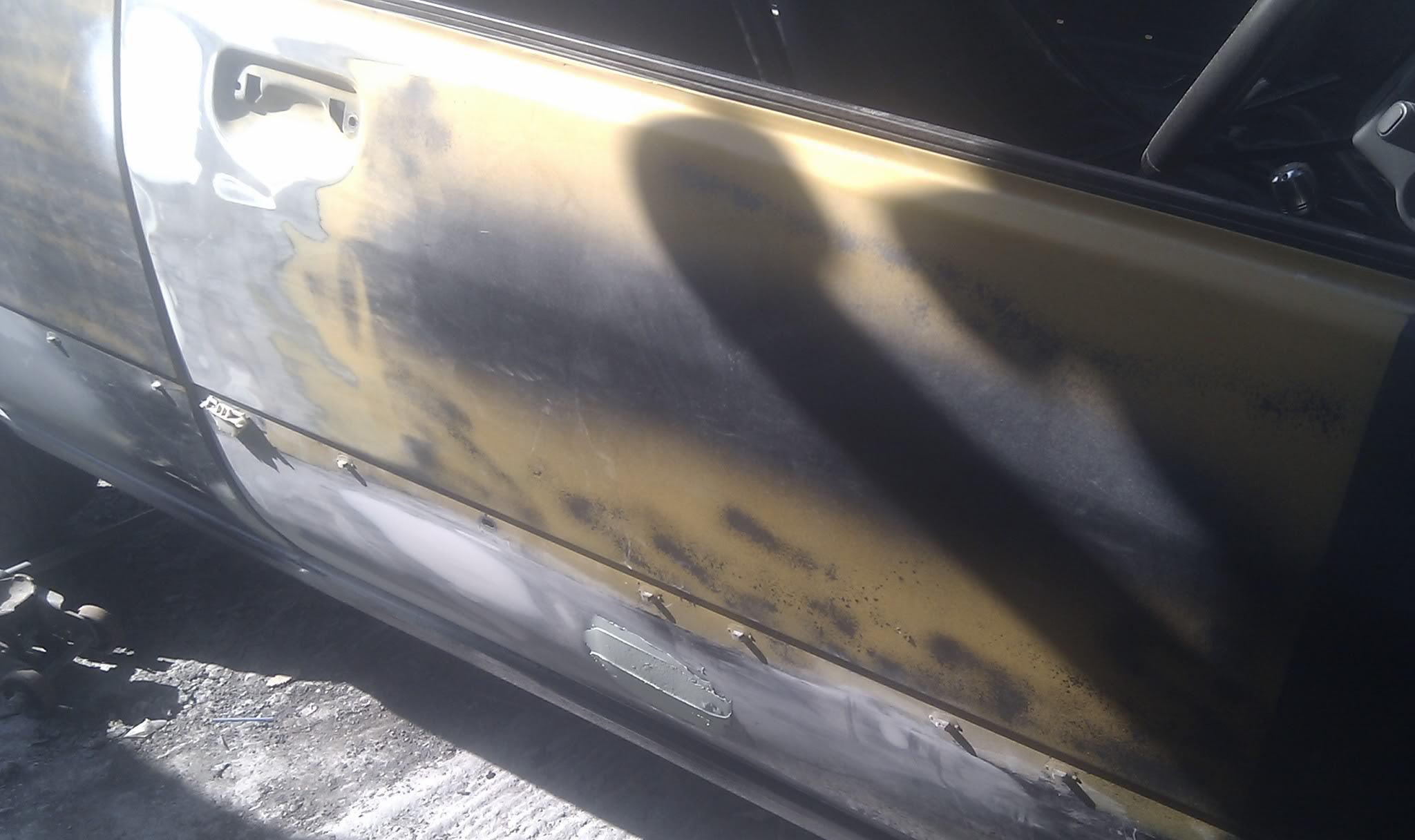

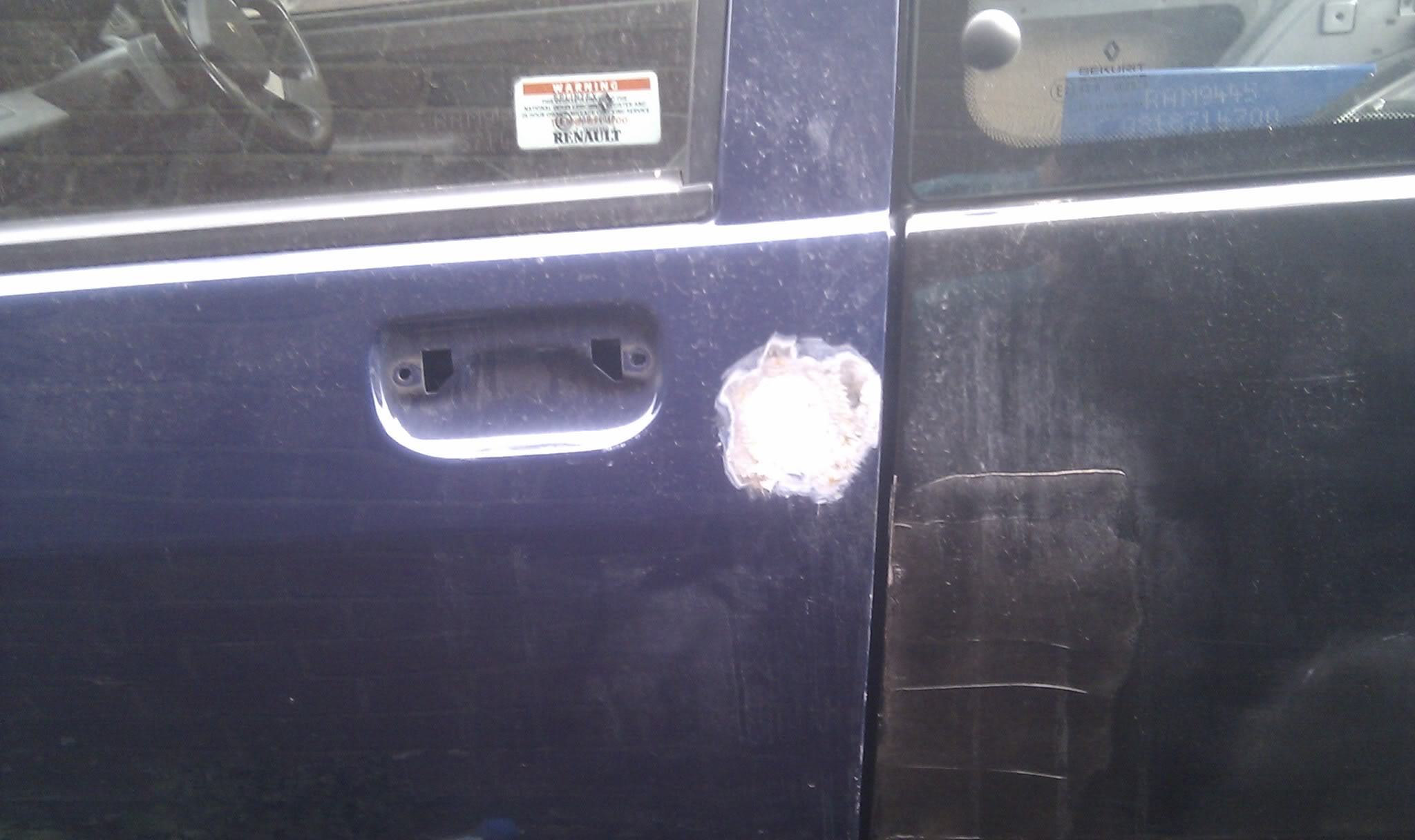

O/S door welded up, fibreglassed ready for filler
N/S door welded up and fibreglassed ready for filler

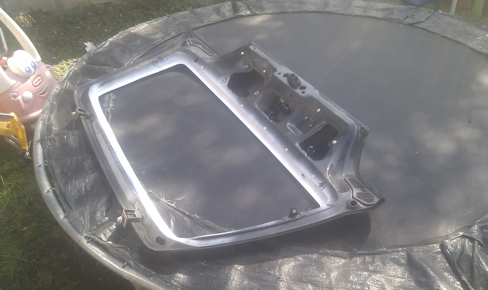

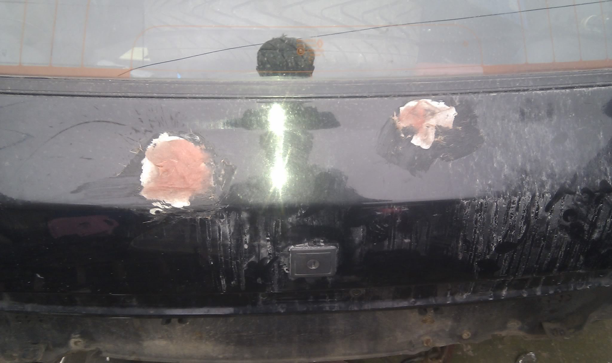

tailgate wiper hole n washer jet hole welded up, fibreglasssed, i did grind these down and its ready for filler
bumper had a big crack along it upto the middle and what looked like an exhaust cut out done with a spoon, ground it all out, pop riveted a plate, fibreglassed
ground down ready for filler
arch had filler on it, but it had sat for a few years so i wanted to know what was under it, pretty much nothing, good metal, only 1 hole at the bottom
otherside the same, hole in the same place at the bottom and slight surface rust at the top, fibreglassed, ill grind it down tomorrow
mmmmm <3 the smell of fibreglass
even had my 2 little helpers giving me moral support! even got a " wow nice car daddy " from ava lol and seth was taught what fibreglass does, who needs schools?
so tomorrow im gonna be grinding down the bits of fibreglass i put in and get some filler in it! ill keep ya updated

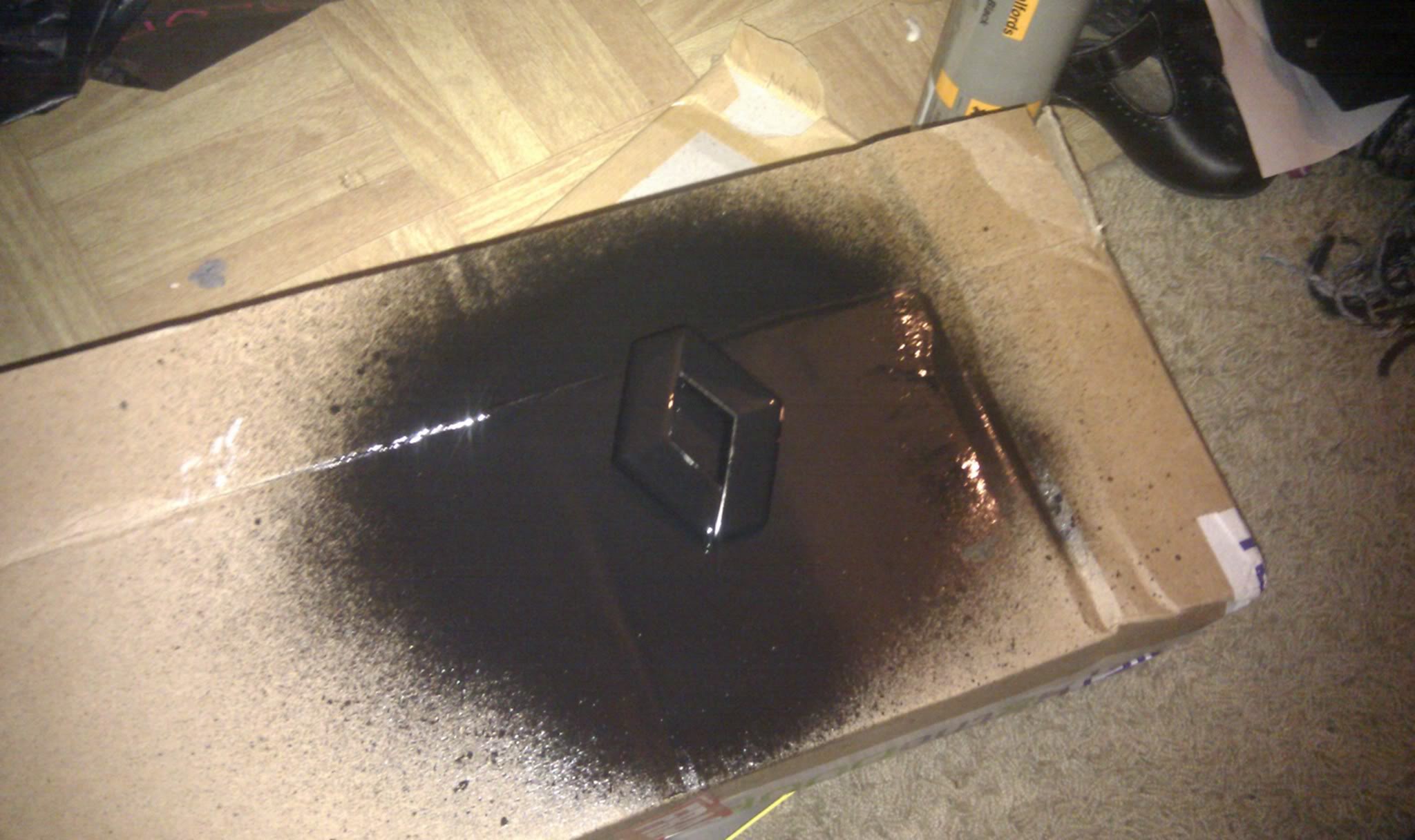

decided against debadging, painted the back ones white, renault diamond will be sprayed black when ive popped it off, excuse shitty pics!

cheers dude, didnt get anything done today as im decorating the living room, felt bad, so i painted the front badge, fumes in the bedroom ftw!

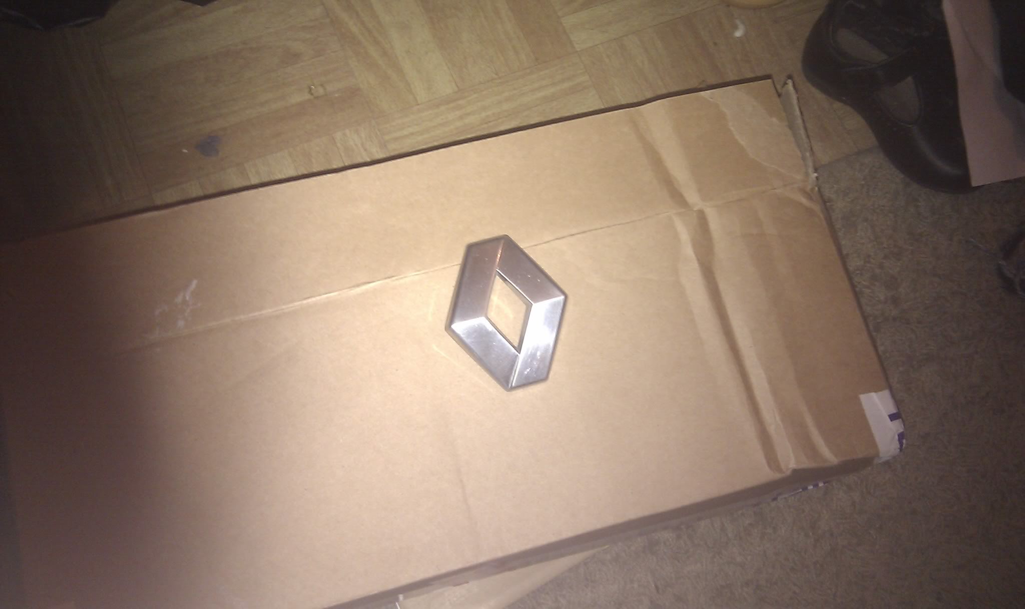

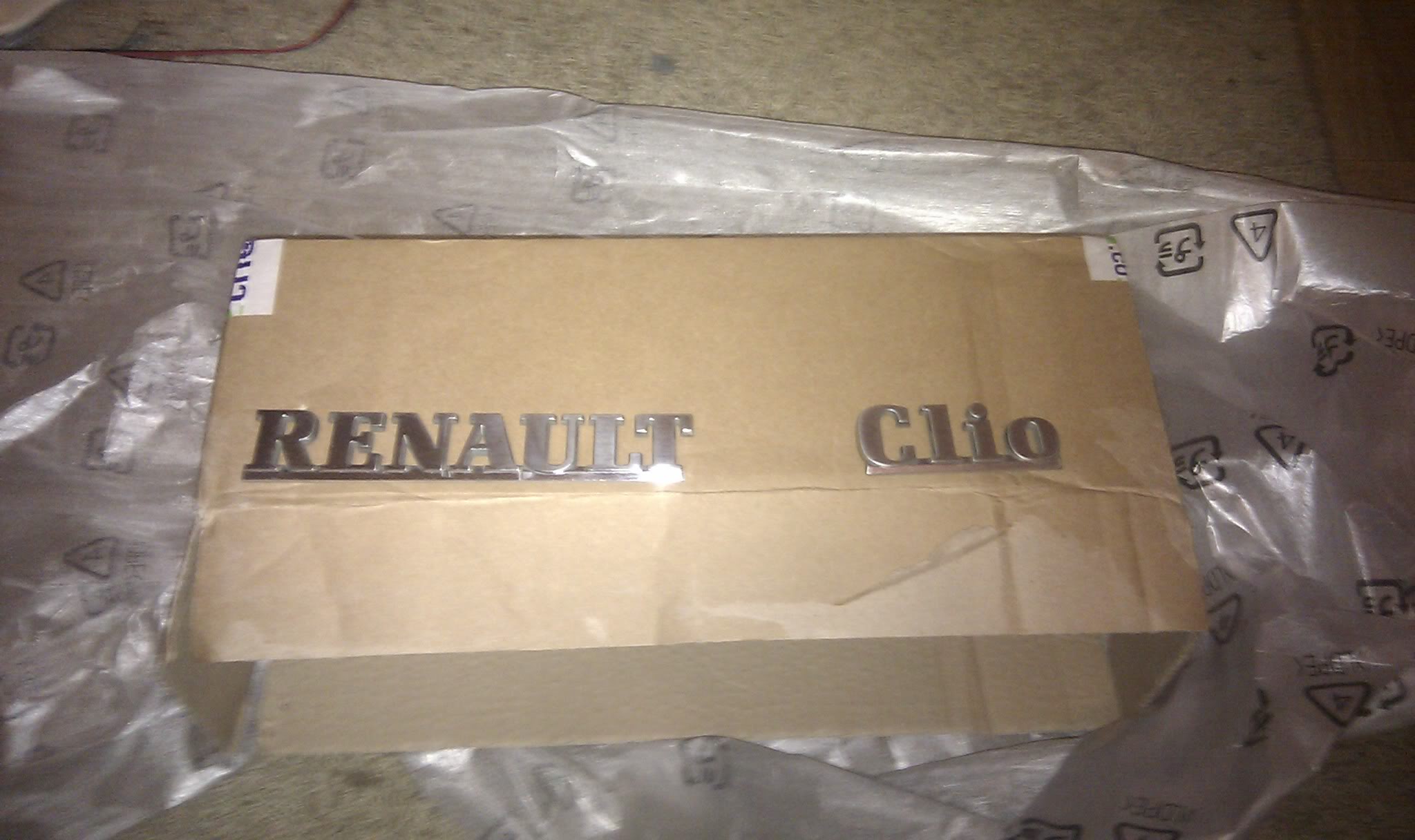

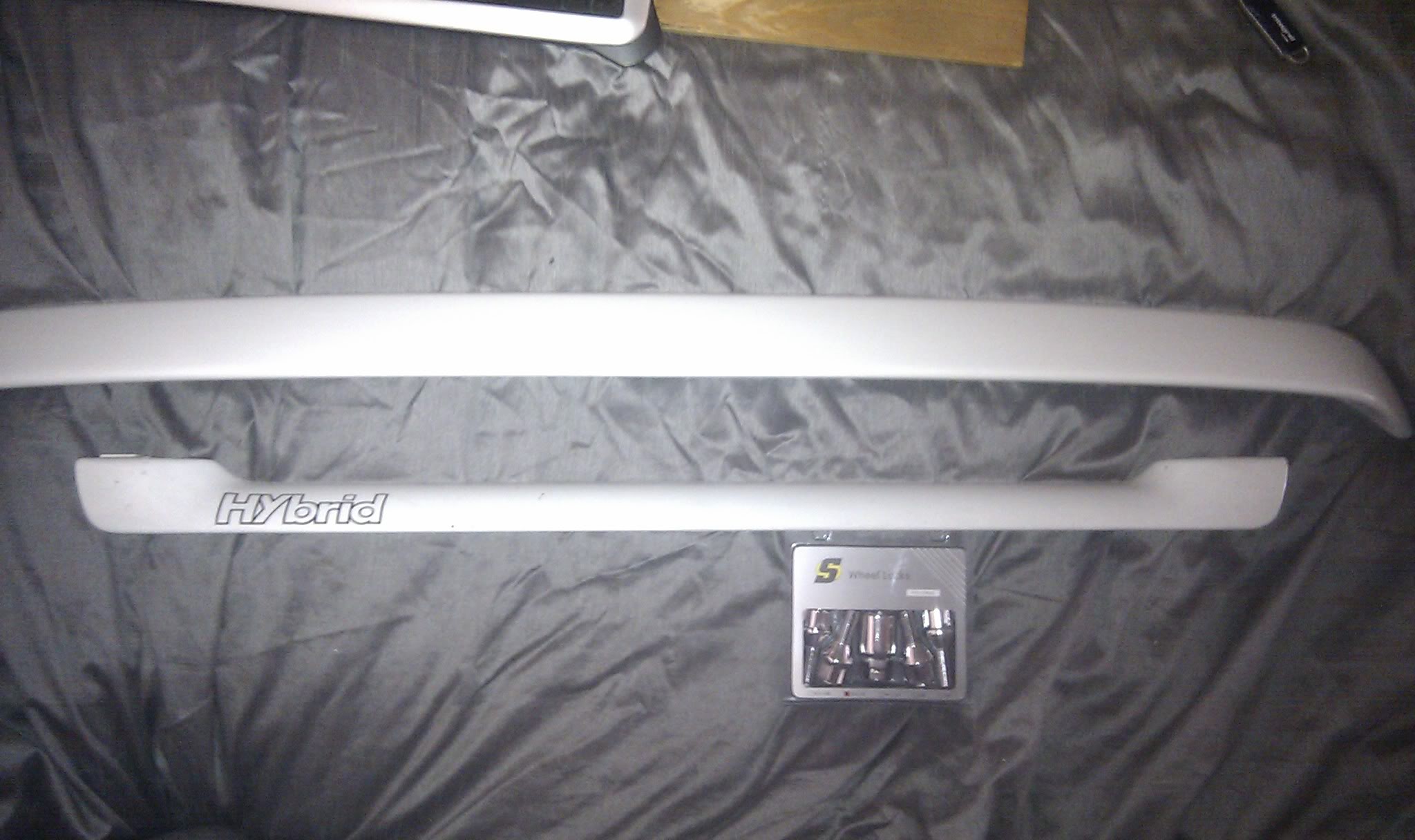

flew in some overnight parts from japan (cheers Clio_Squeak!)
phase 2 grille, 16v spoiler n some locking wheel nuts off t'bay
im thinking paint the spoiler black, will look good against the white car

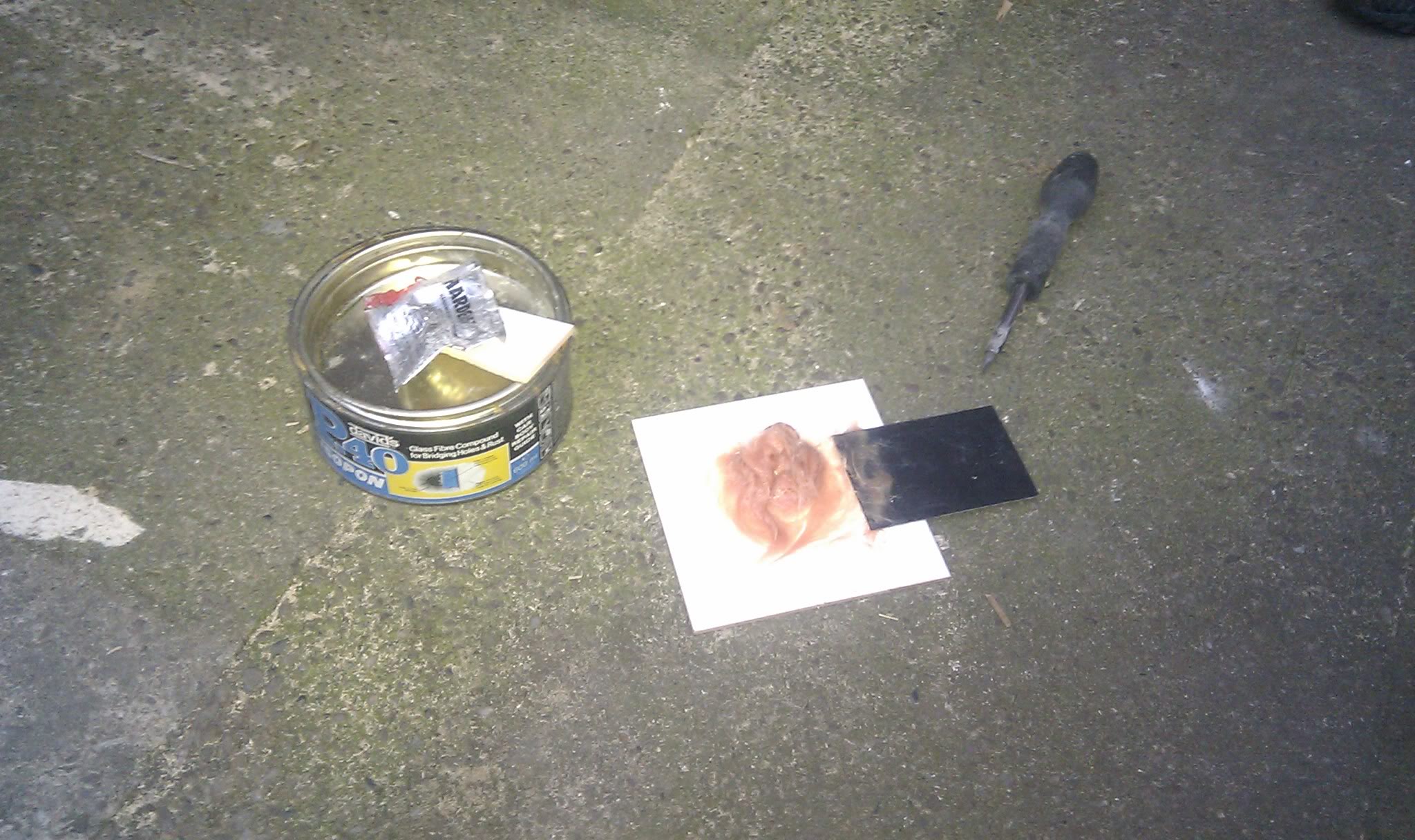

got most my fillerwork done today! cut my finger though n got a couple of blisters where the sandpaper rubbed me :( been too long since i dont some proper bodywork!
gotta drop my wing off tomorrow n fill that then fill my bumper
1 dent on my sil i gotta fill then ill be ready to prime n sand the whole car!
should be ready to paint by next weekend

ready for primer, wiper n washer jet removed

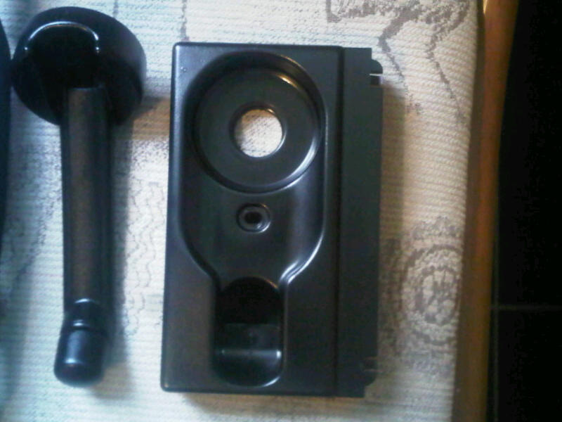

im thinking about delocking the tailgate, but im unsure if i really want a popper on the outside of the car somewhere, dunno yet, ill have a think

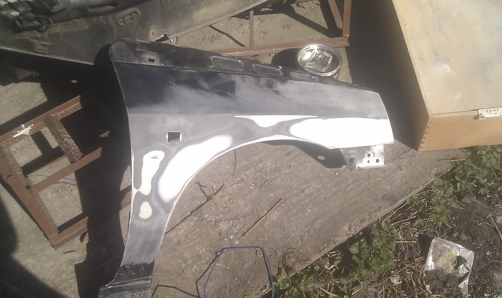

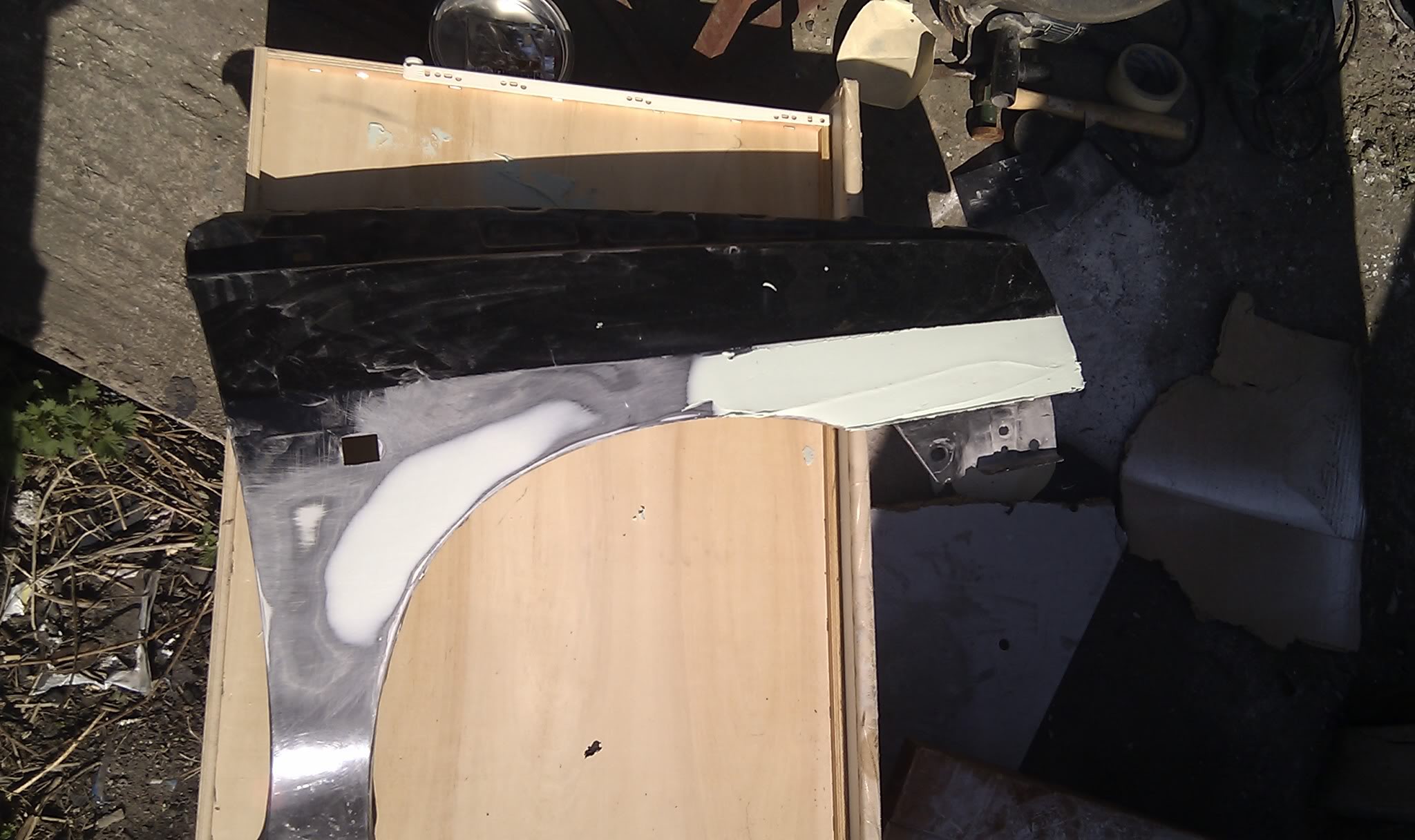

wing filled n repaired, other one was done aswell, both ready to prime then paint the wing edges ready to refit
How messy i am!
so yesterday i managed to get both wings repaired, dropped off and ready for primer. went over one side of the cars repairs with P180's so 1 side is ready for primer except 1 dent in the door which is only small. dropped off the inner sunroof and found out the b*****d has already been sealed!!, so im gonna reseal round everything on the inside of the roof and also seal around the aerial.

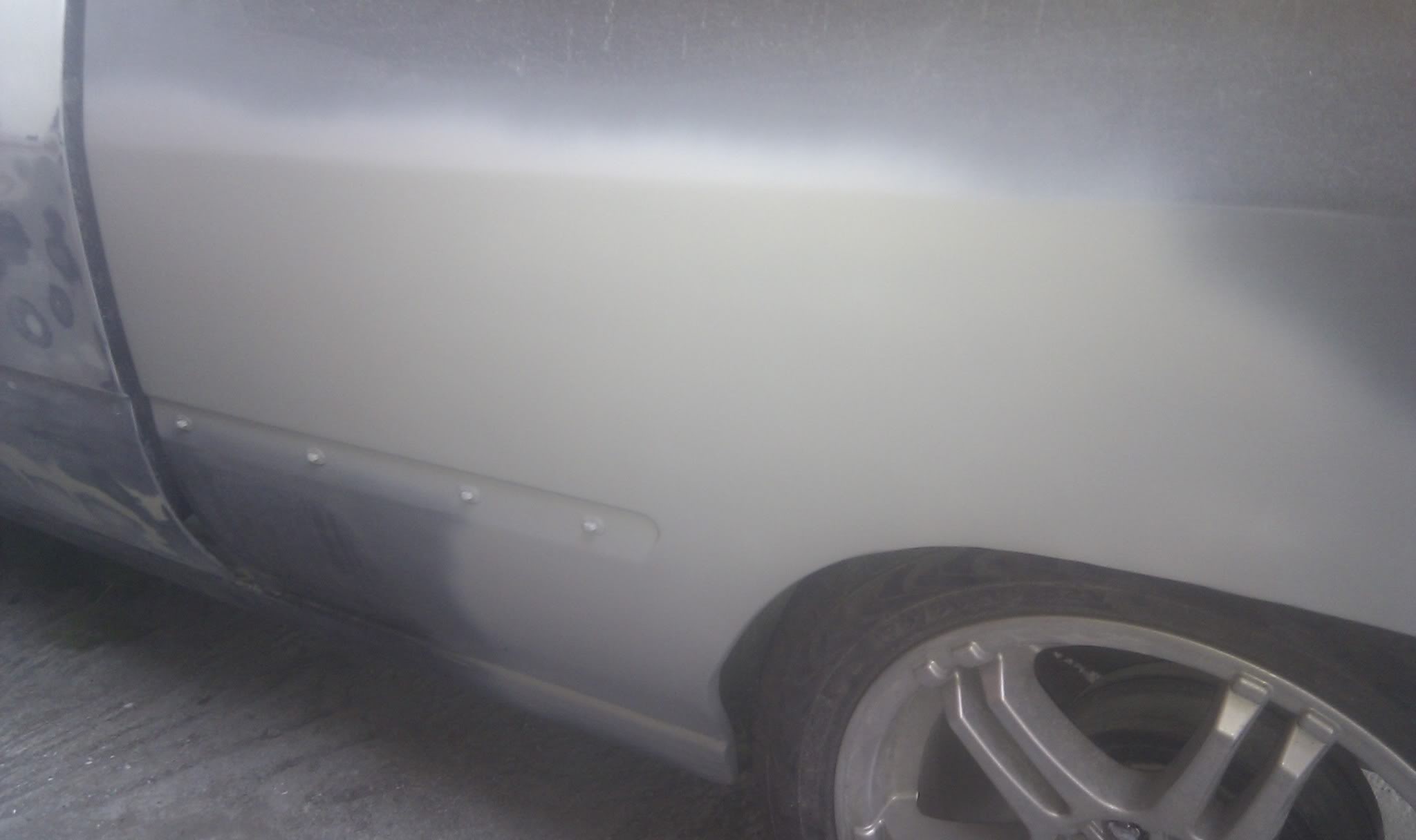

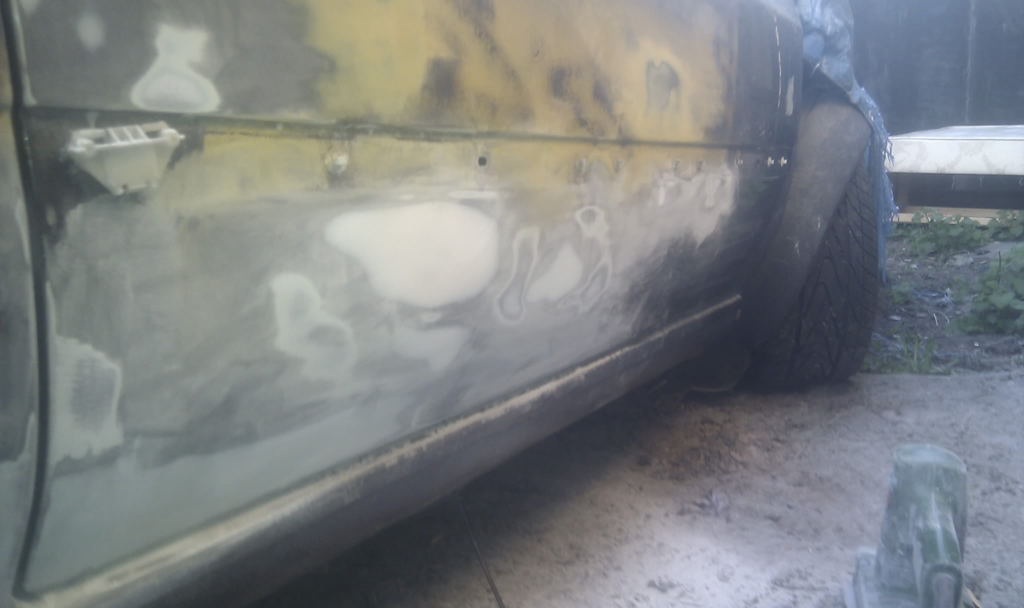

ok, N/S rear quarter ready for primer
i think the filler at the bottom of the drivers door is the only fillerwork left to do, so f**king pleased its all done, gone through a fill tin!
drivers door ready to prime except the filler at the bottom

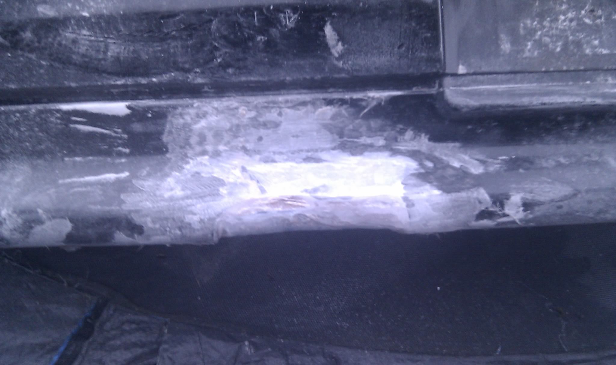

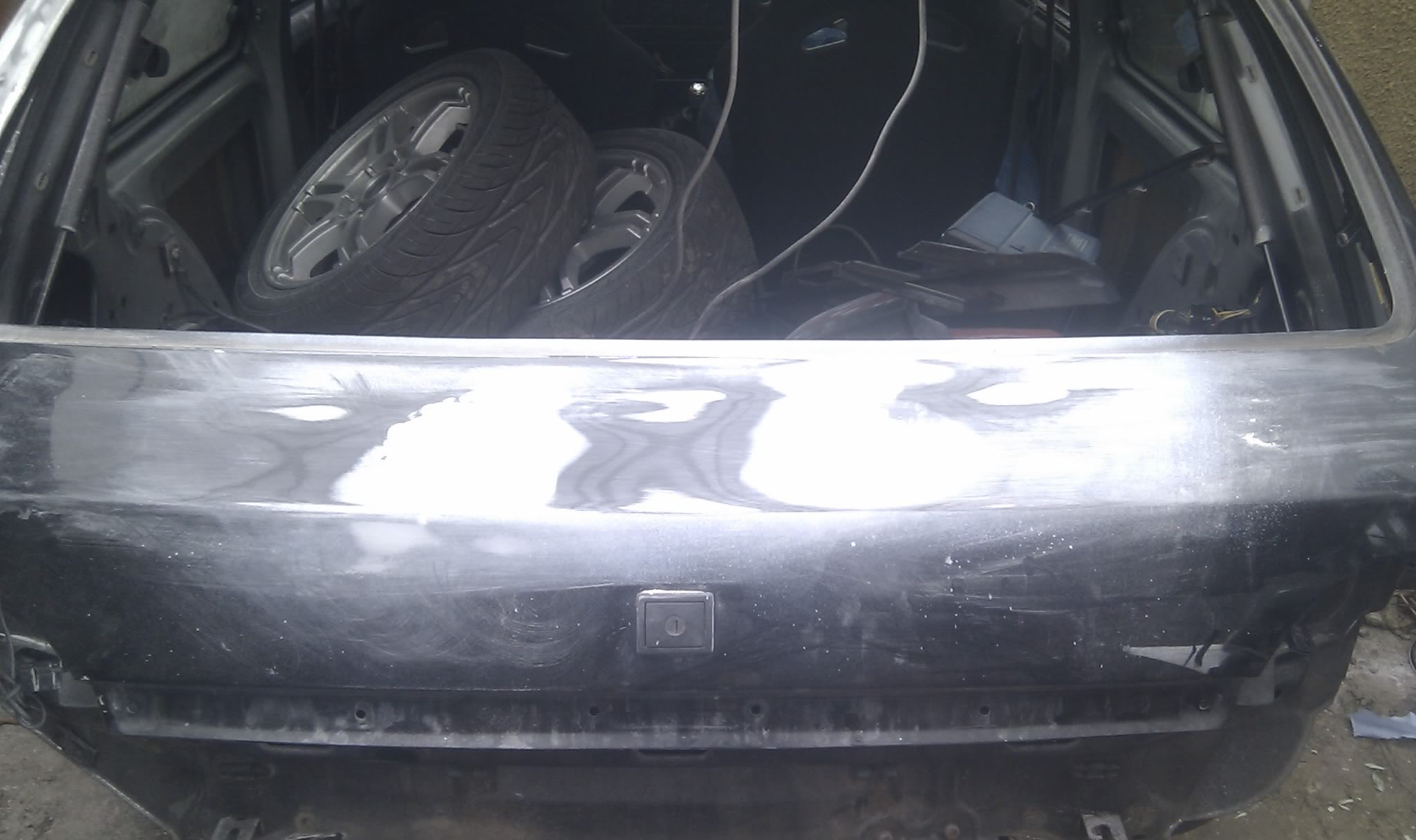

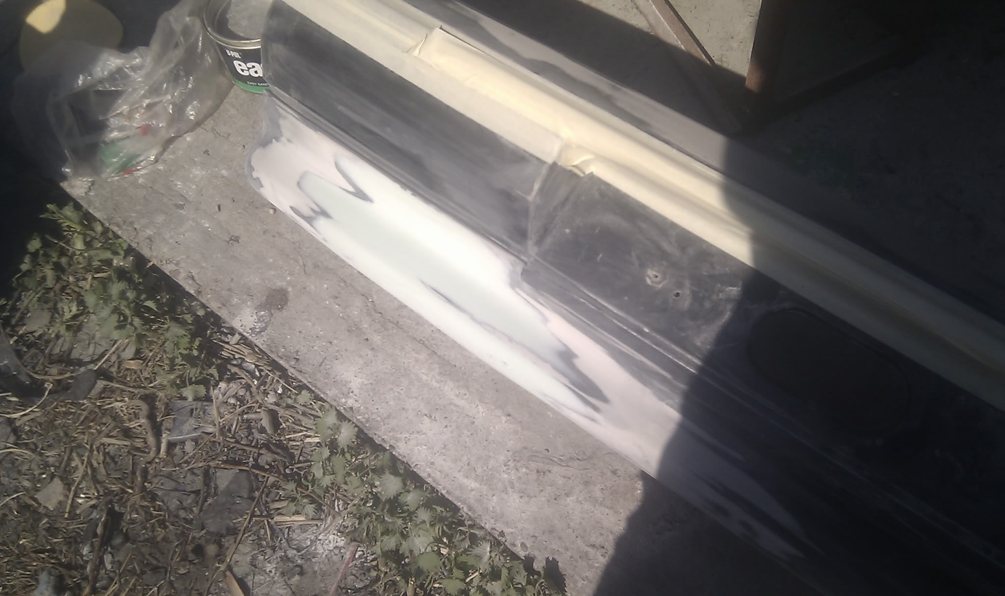

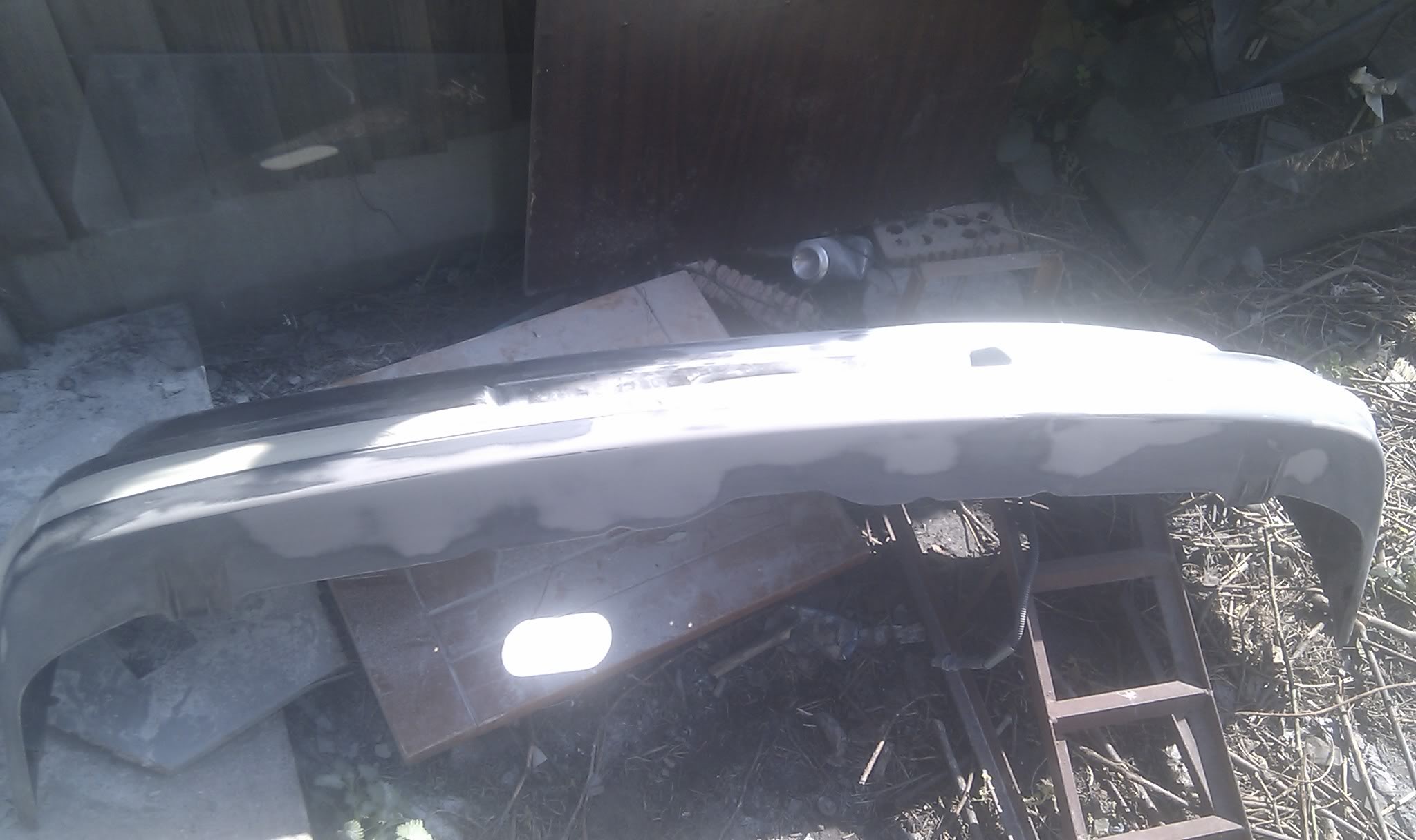

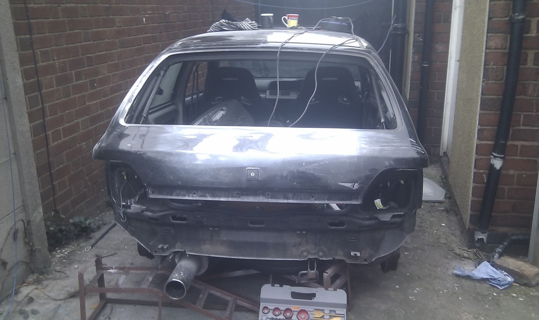

rear bumper, PROPER pain in the arse. ground it all out, put a plate in, fibreglassed, filled, nearly got it all ready for prime and i dropped the bumper, cracked where id repaired, pissed off is an understatement, i was gonna snap it in half n buy a new bumper. grabbed a beer, calmed down, then redid it all again, new plate, fibreglassed n filled. its now ready for a good wetflat as its furred up quite a bit due to it being a big repair n using P80
sanded out all the chips on the top of it aswell
O/S rear quarter filled and primed, ready for guidecoat n wetsanding down

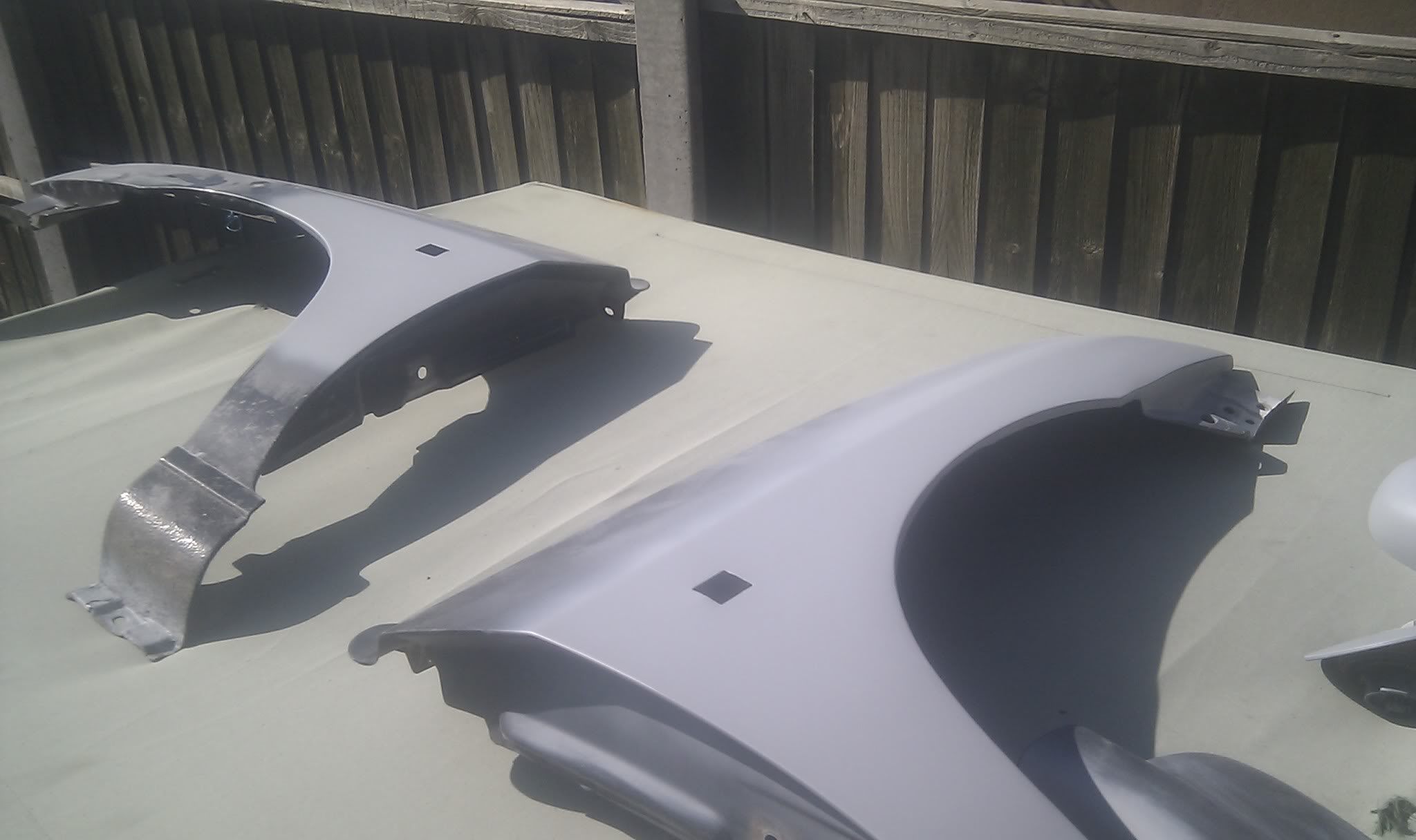

Both wings, filled, primed, out in the sun drying. also prepped n primed the wing mirrors

back wheels finally back on and off axle stands! wheels are gonna be powdercoated gloss black eventually

N/S door ready to prime, will do that tomorrow
and o/s door ready to prime, will also do that tomorrow

(Those wheels are utter pony!! Get some standard ph2 valver wheels on there)
  Punto/Clio GTT
i agree mate, but they came with the car, brand new, brand new tyres all round too, done about 5 miles on em
i think when theyve been powdercoated black you wont really see em tbh, thats what im hoping anyway lol

oh and one of my wheel bolts wouldnt tighten up properly, it was just spinning, is that a new drum? or something inside the drum ill need too?

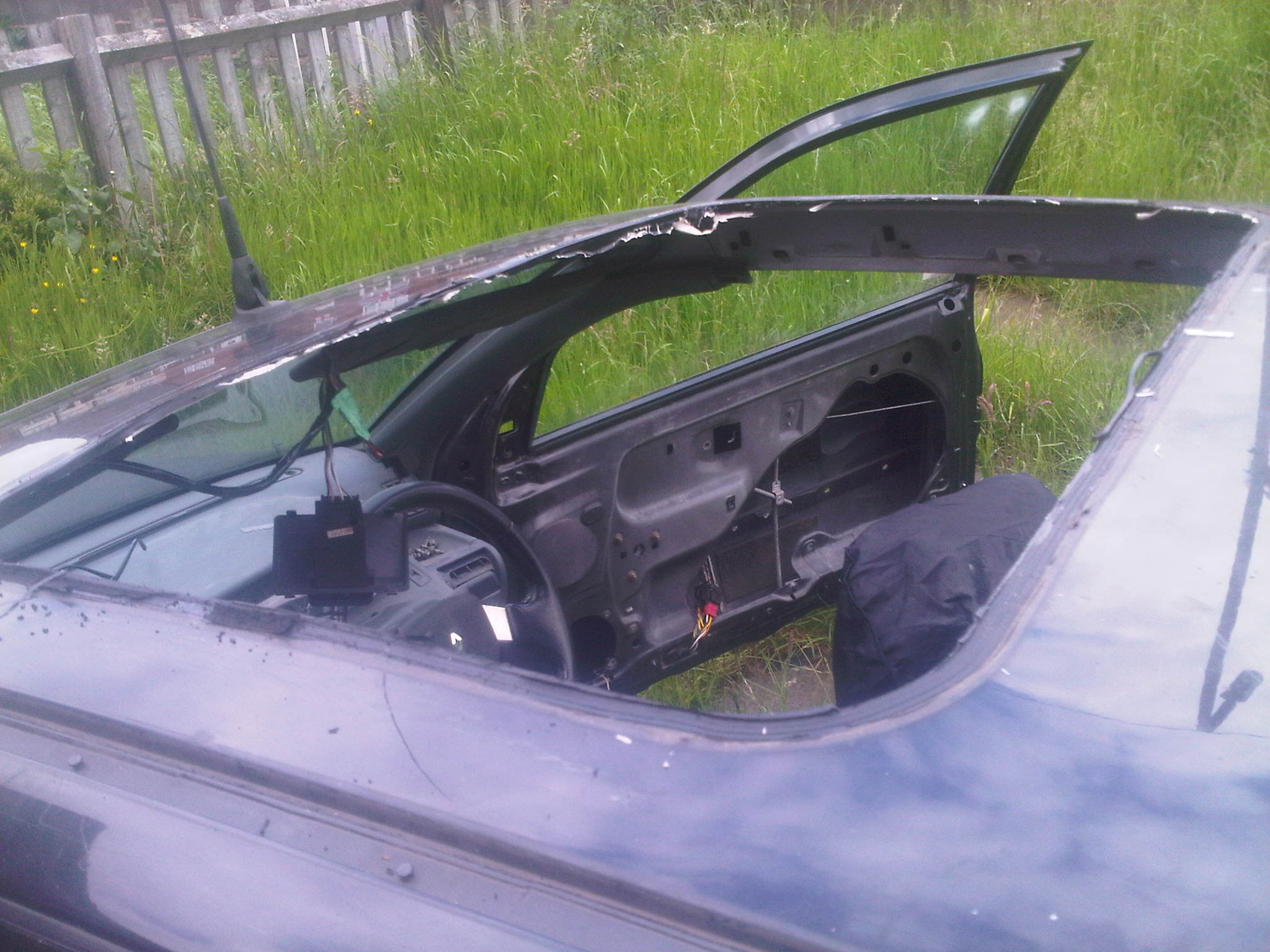

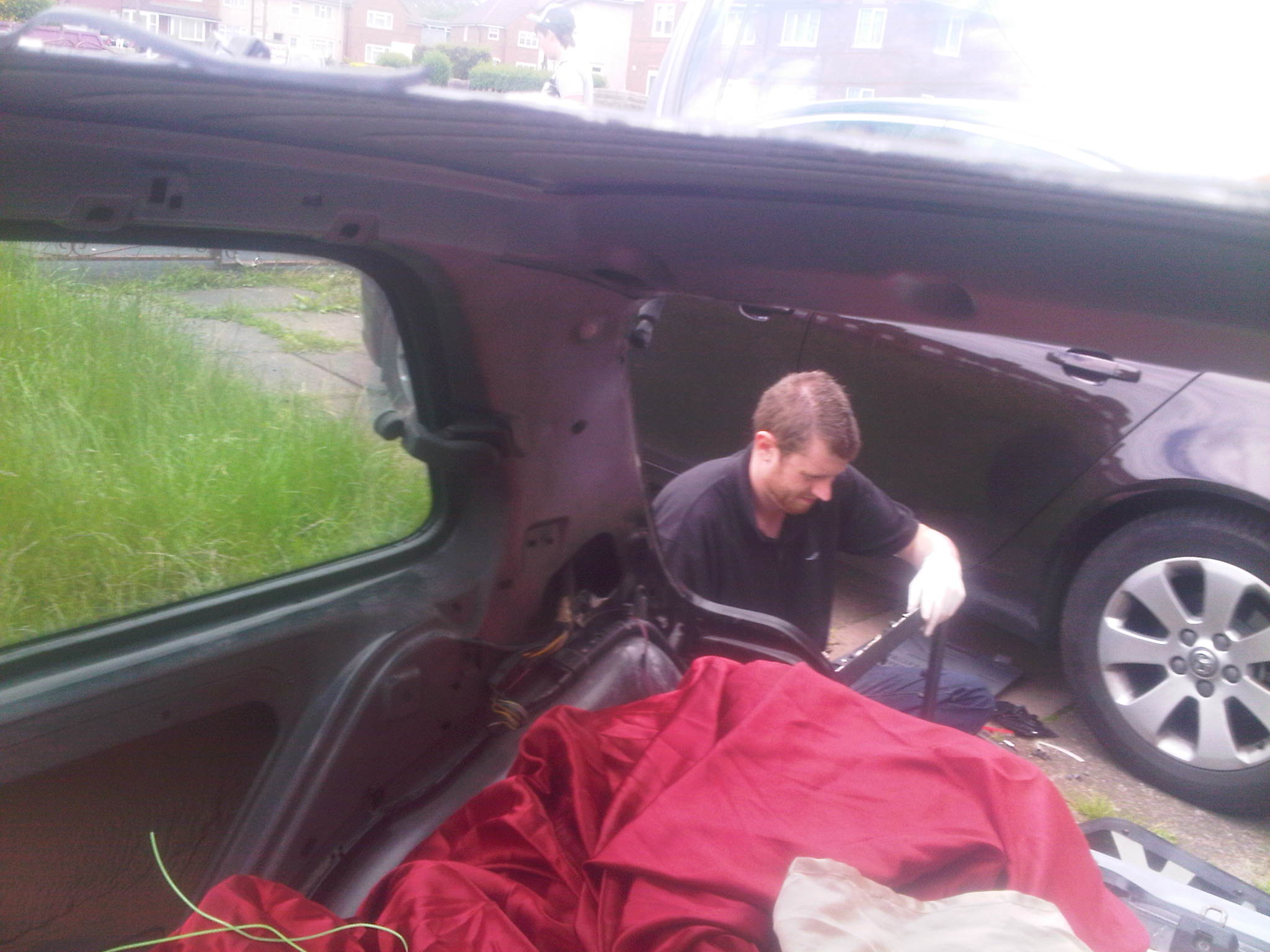

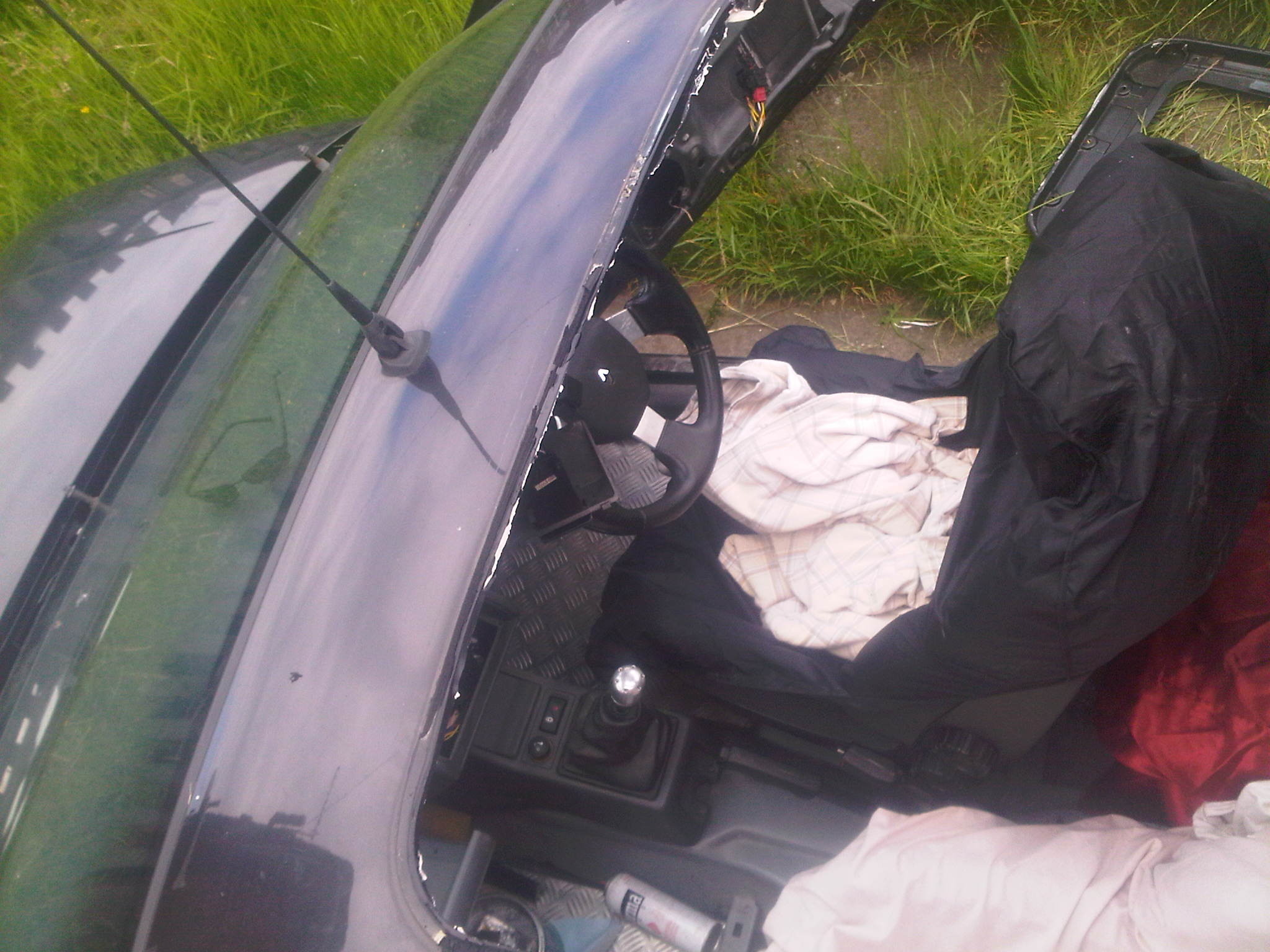

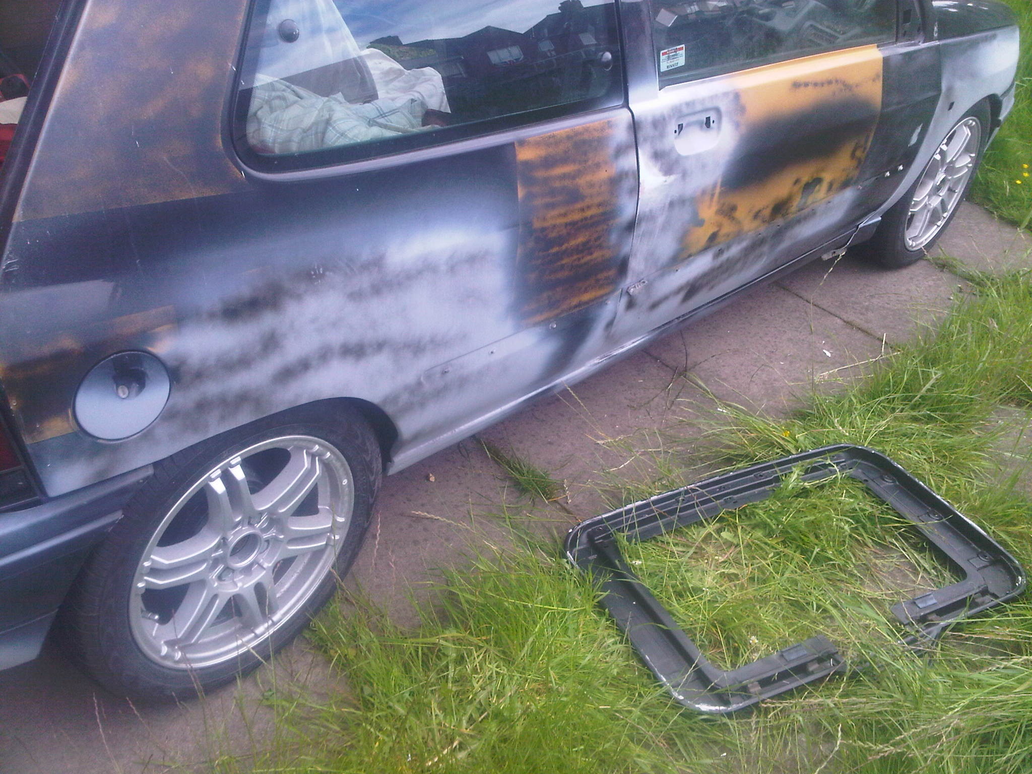

finally got round to doing a bit on the car this week, weather had picked up. few s**tty pics from the sisters phone as i forgot my camera

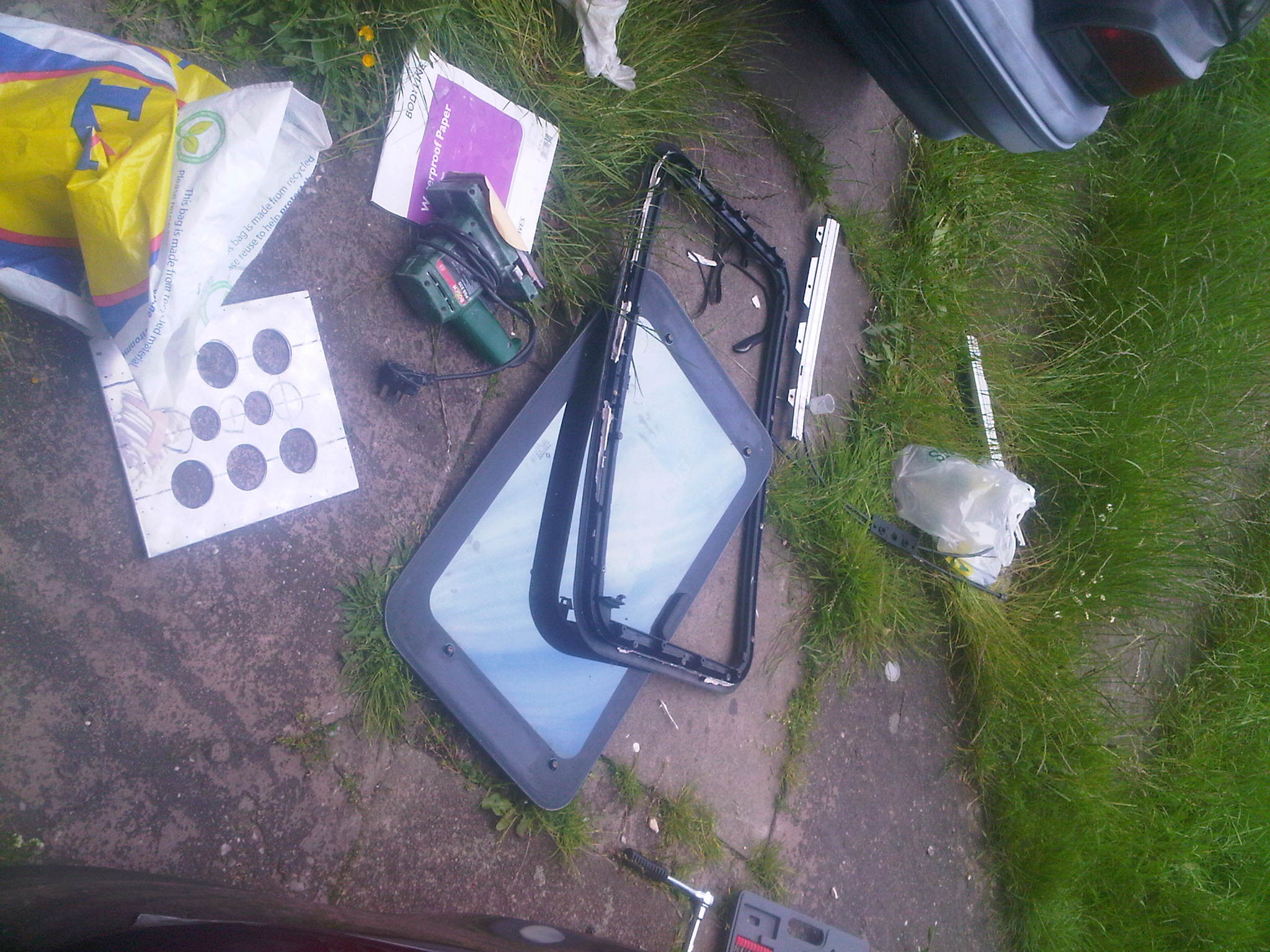

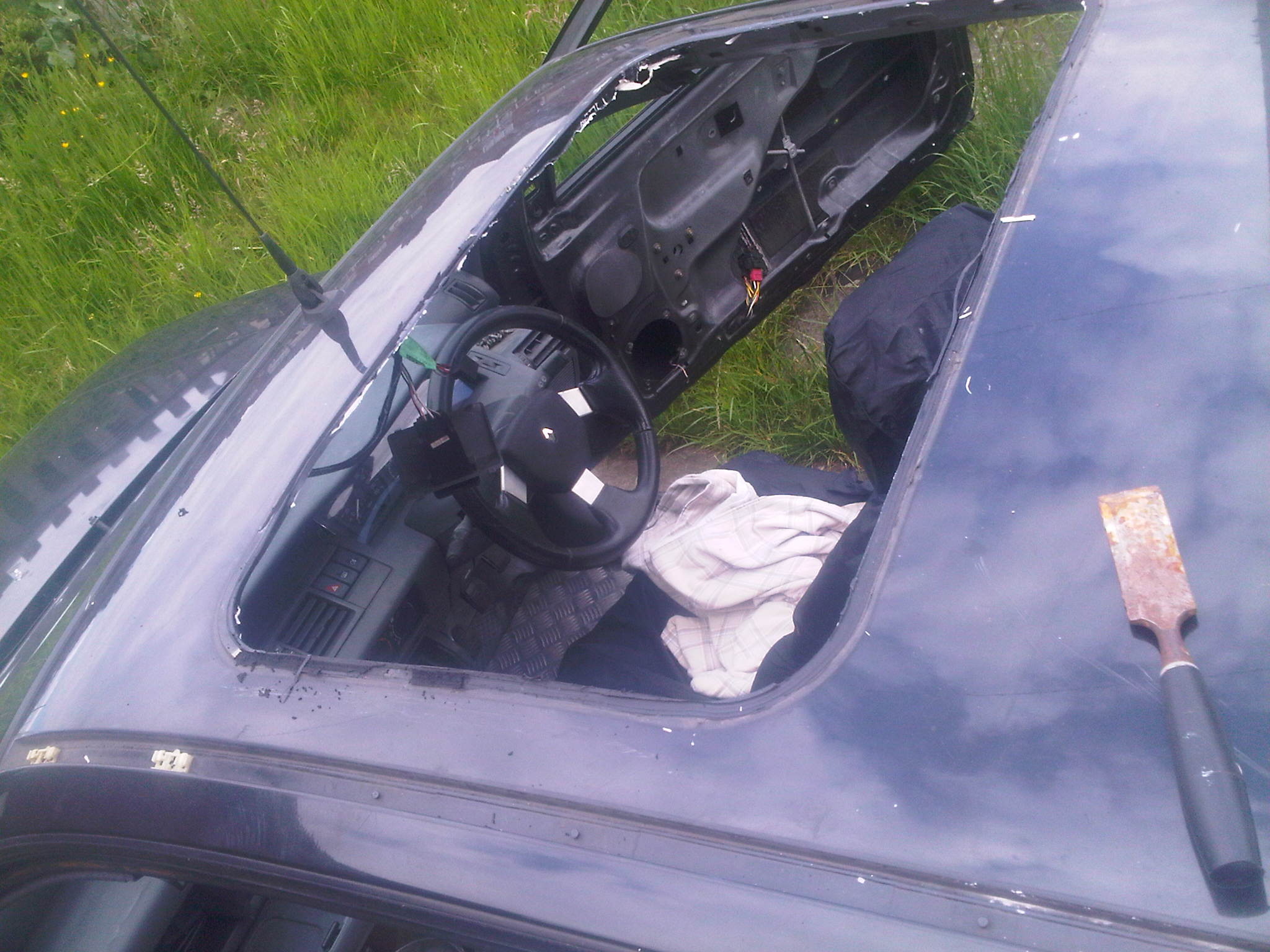

sunroof was leaking, had been bonded before but it had perished, cut that out which was a bit of a ballache, but its all bonded back in now and not leaking!
me hard at work!
sunroof out, completely stripped, cleaned and put back together

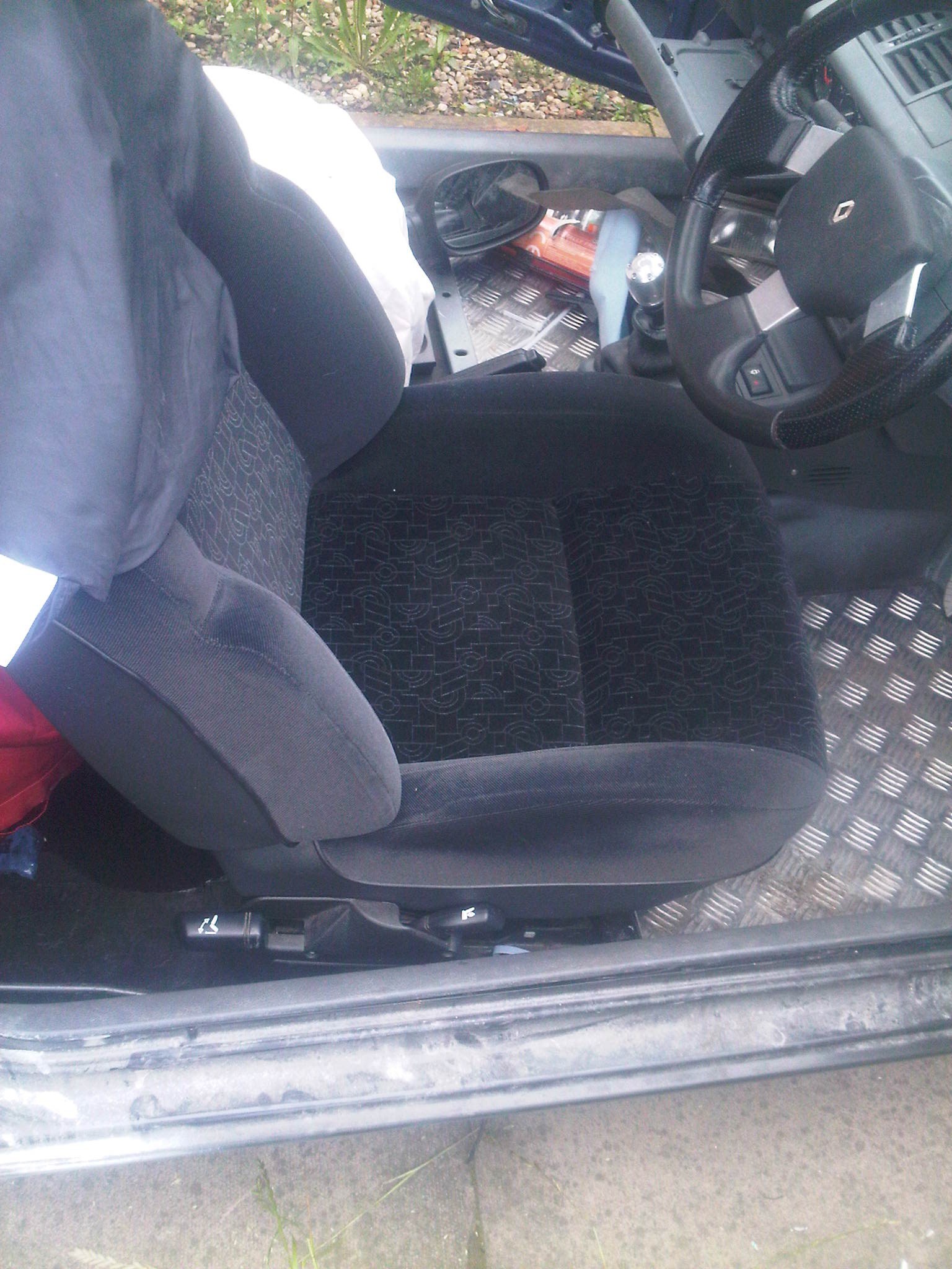

pic of my new 16v seats, seats are immaculate, no wear or tear, no marks, nothing. gotta pick up subframes and a few other bits off matbrown in the week so they will be bolted down. managed to rip up the floor pan alloy sheets that had been bonded in, didnt think they would come up but i managed it, carpet gonna be going in aswell which im happy about

I was so happy to see a update on this thread. Love the mk1s still, seeing them at FCS made me want another.
Ps Should have plated over the sunroof and it would have NEVER* leaked again.
*(Thats a total lie, mines still leaked like a friday night *****, the GF hated the clio shower)
  Punto/Clio GTT
pmsl it still leaked??? what you do, rivet and bond it?
i did have a sheet of perspex i was gonna cut down to size and bolt/bond it down, but i just went for cutting it all out and resealing it, ill probably need to do it again next year!
