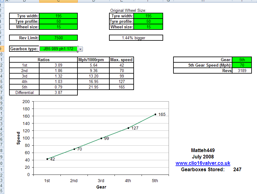

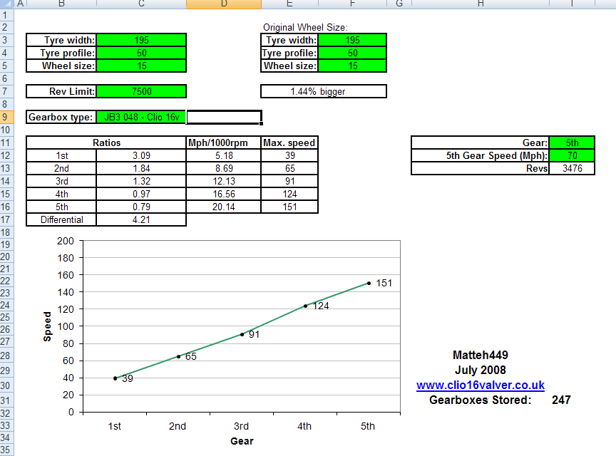

Valver is shorter ratios... Using Matths clever tool you can see the difference :)
A williams JC5 would be a bit better, similar to a 172 Ph1, but Its finding one....the valver one is ok for now :)

there's a nice handy guide over on clio16valver ;)
ratios were found from Renault

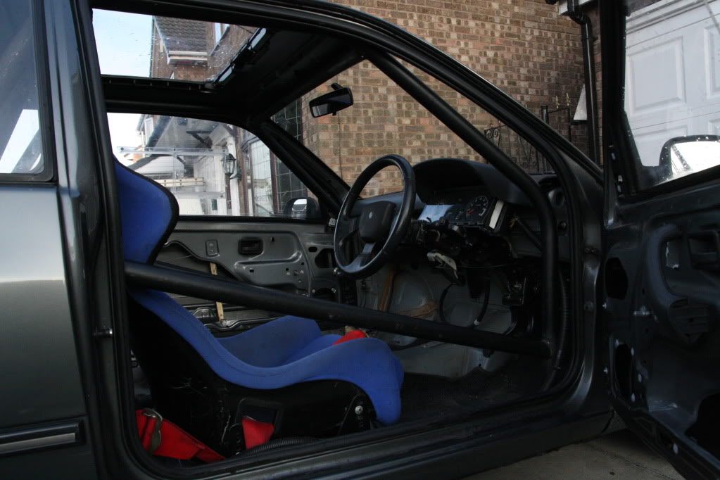

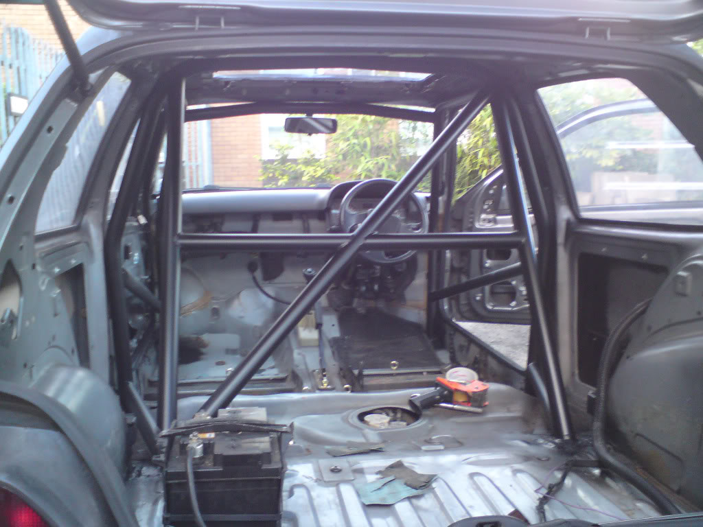

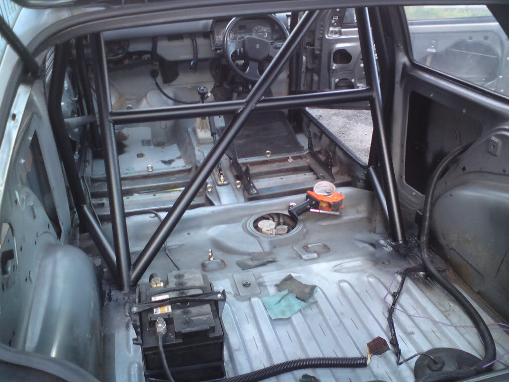

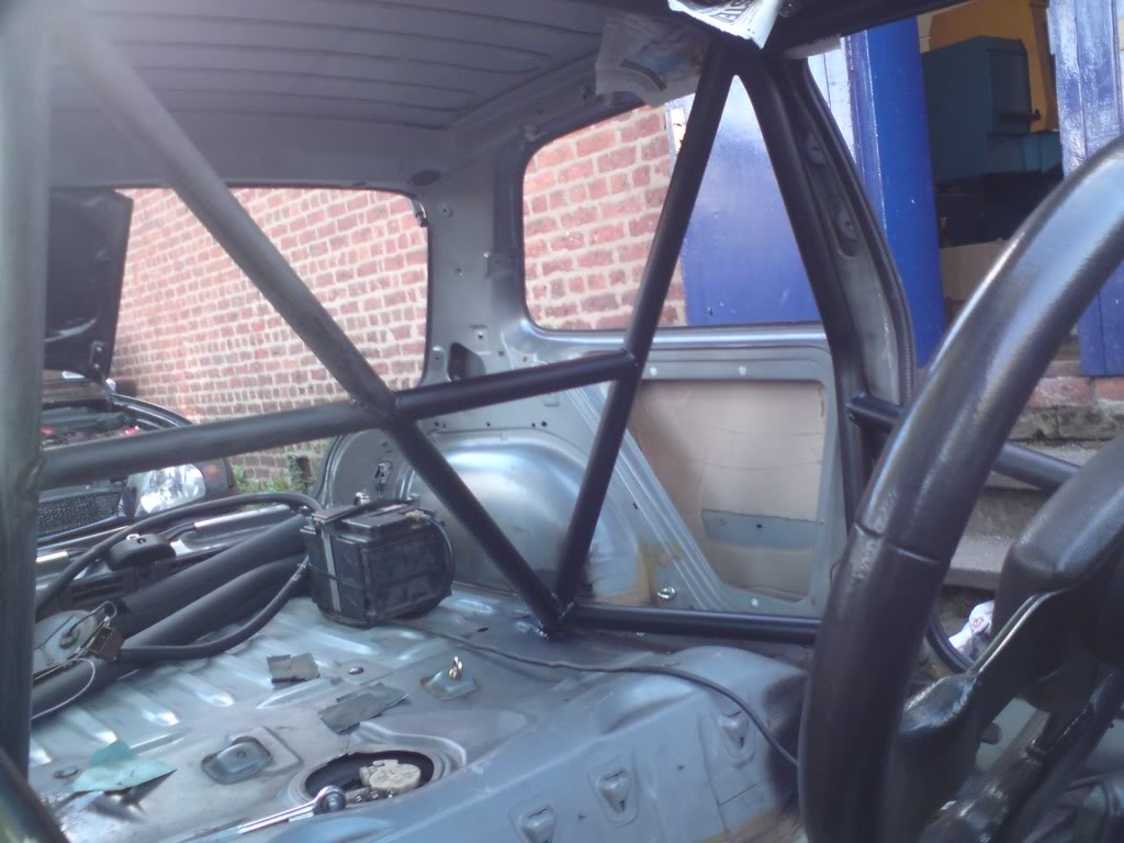

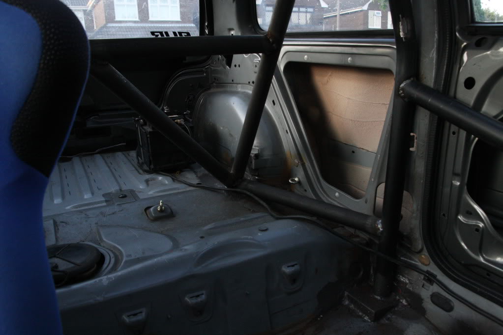

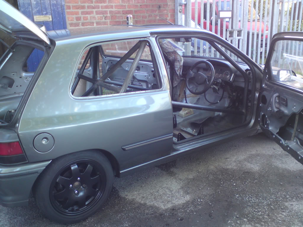

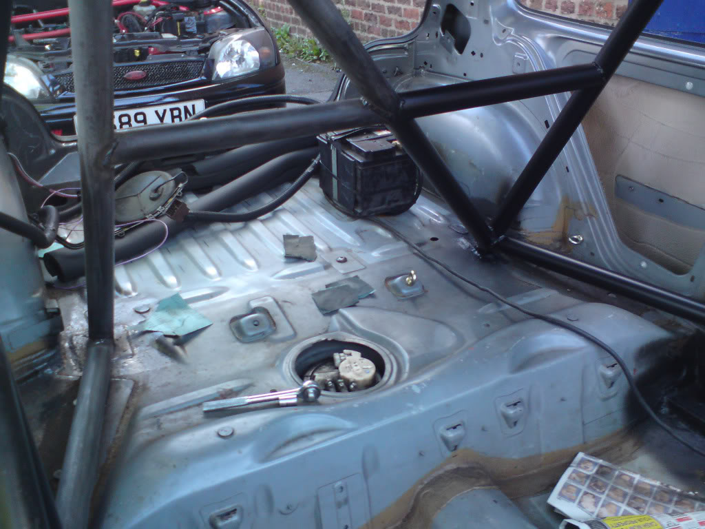

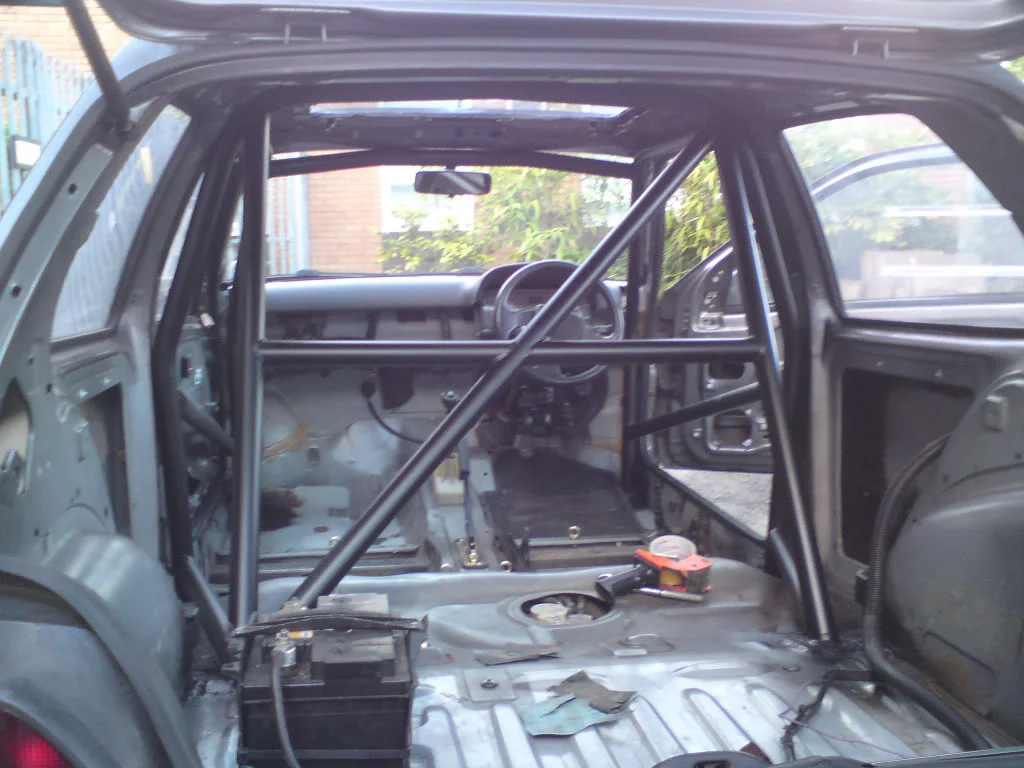

cage is now fully in (well apart from bulkhead bar, coming soon, just needs changing slightly).....found someone literally 1/4 mile away from me who is a friend of a friend, certainly knows how to weld :)
My own version of the doorbar, slightly lower at the back and slightly higher at the front...
Rear lower stays in too...
Will sort some proper pics next few days when ive sorted the other bar on the bulkhead and given it some paint :)

cage looks sound! is it a pain in the arse climing over that bar to sit in the seat?
Re: Mk1 172 Hybrid Track Car Project
lol.
cage is partially painted satin black in areas where you cant reach, rest of it will be going the same over the next few days :)

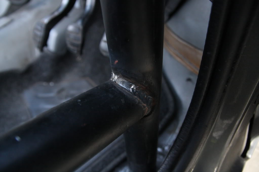

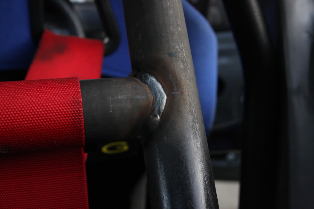

them welds look seriously neat! looks like a great cage too, say you're well happy with it.

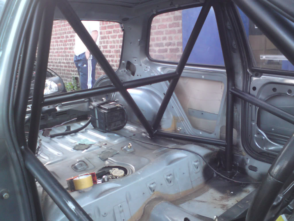

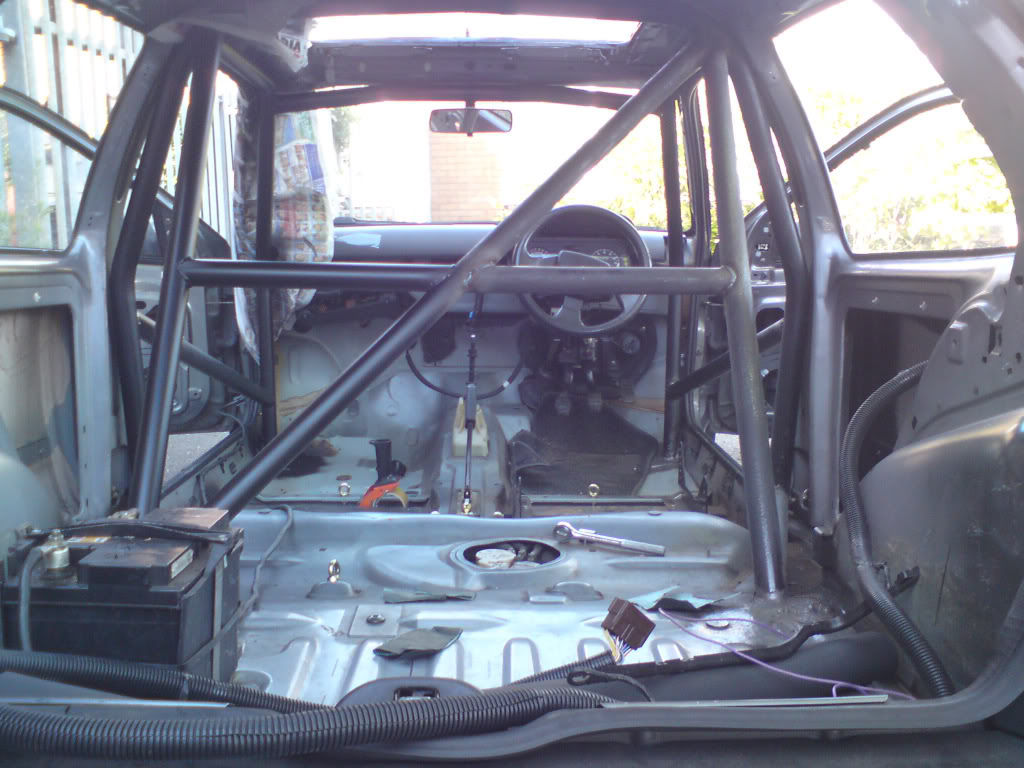

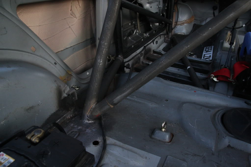

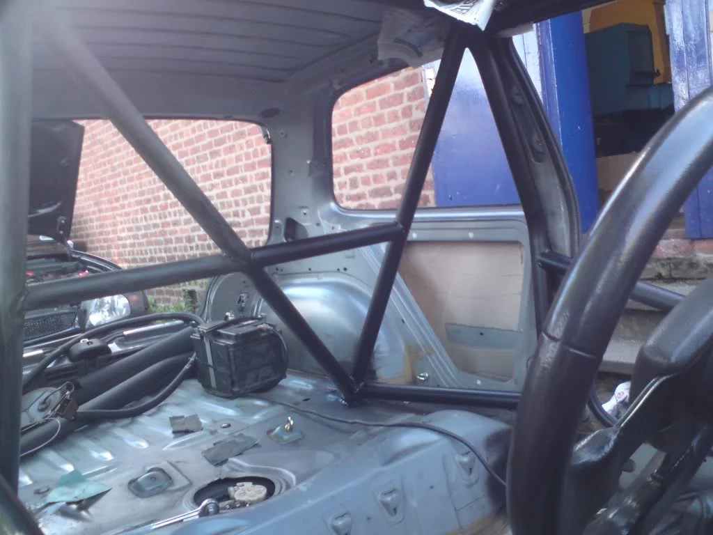

Few more pics of the cage, painted satin black today. Dosent look bad, it will do until the whole interior is resprayed over winter :)
One more bar to go in across the bulkhead/behind the clocks too. Door bars were not painted as they have black pipe lagging round them now too :)

Nah not yet, pointless for the gains though really, its wafer thin as it is...
Doors will be cut out shortly, save some weight with the inner door bars etc...

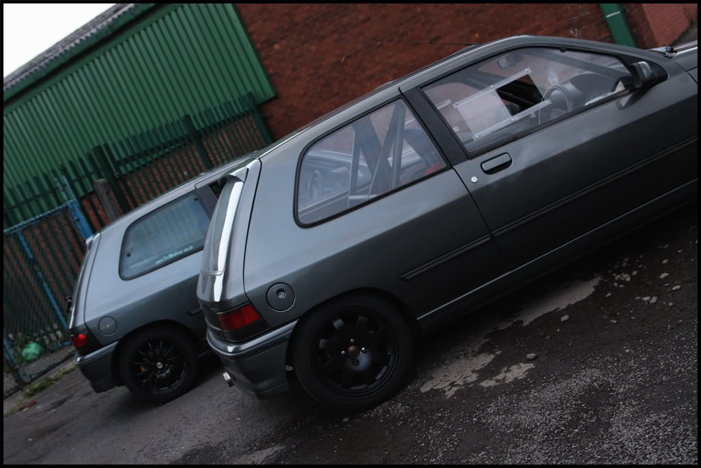

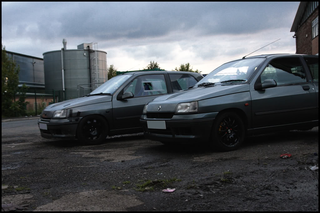

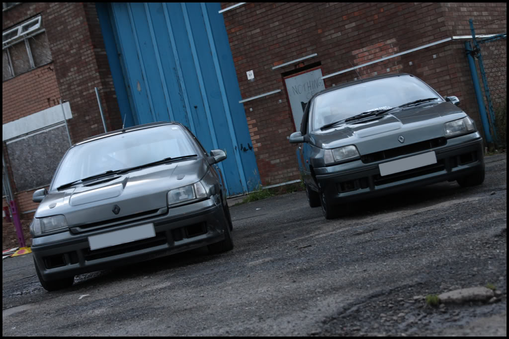

Mine is the Xeros, snick01 is the Tungy....got these few pics yesterday. Difference in front track width is noticable even more so with them side-by-side!

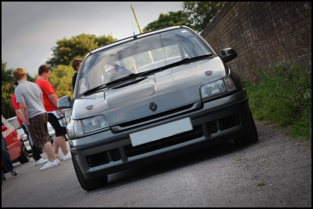

From the other day, need to fix my bumper now :rolleyes:

them polycarb windows look smart! what happened to the bumper?
was driving down a country road, round a bend to be faced by a wall/gate/dead end...slammed on and locked up, slid 60-70ft on this crappy tarmac and just stopped on a bit of grass, snapped the bolt off holding the bumper on....lol
