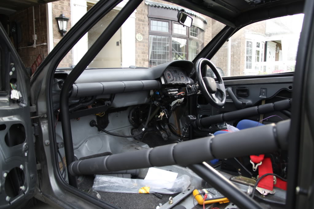

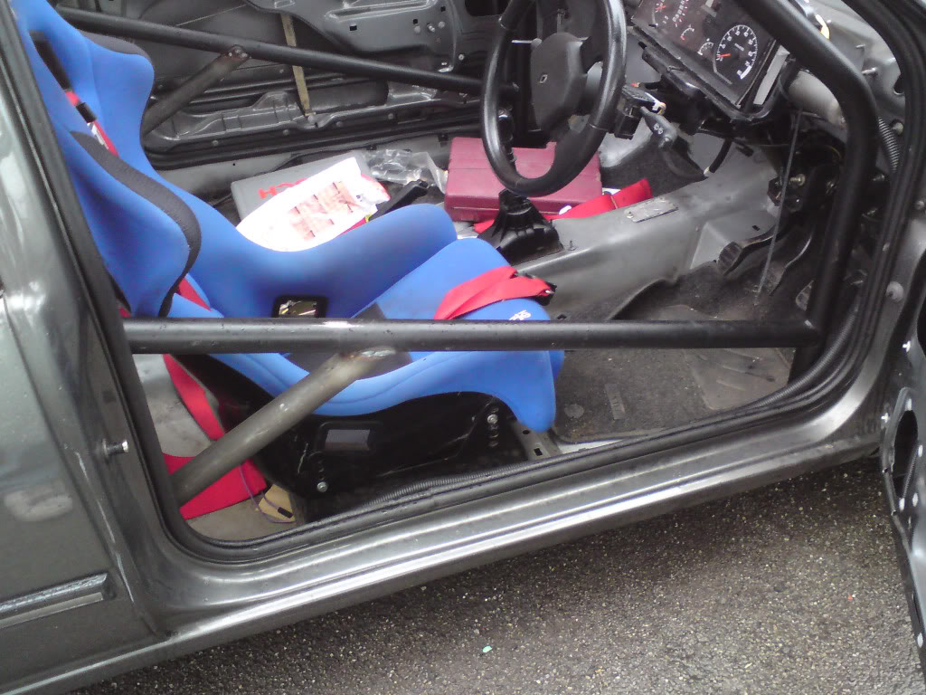

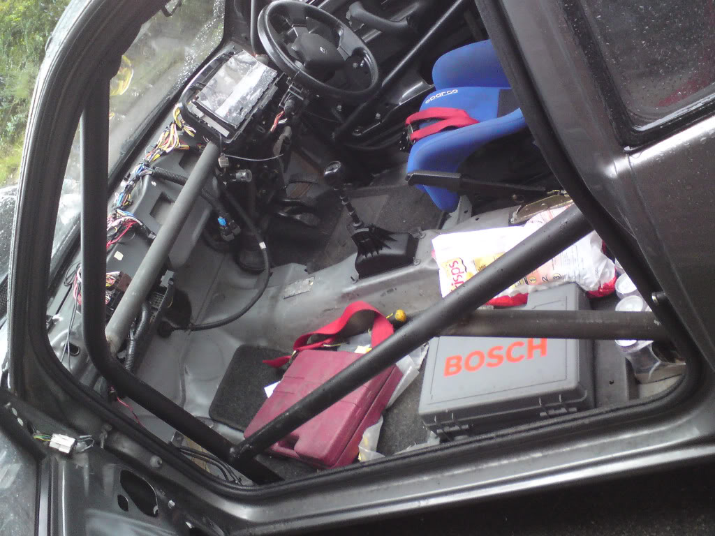

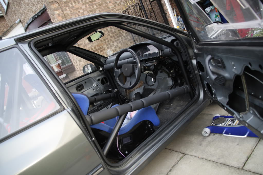

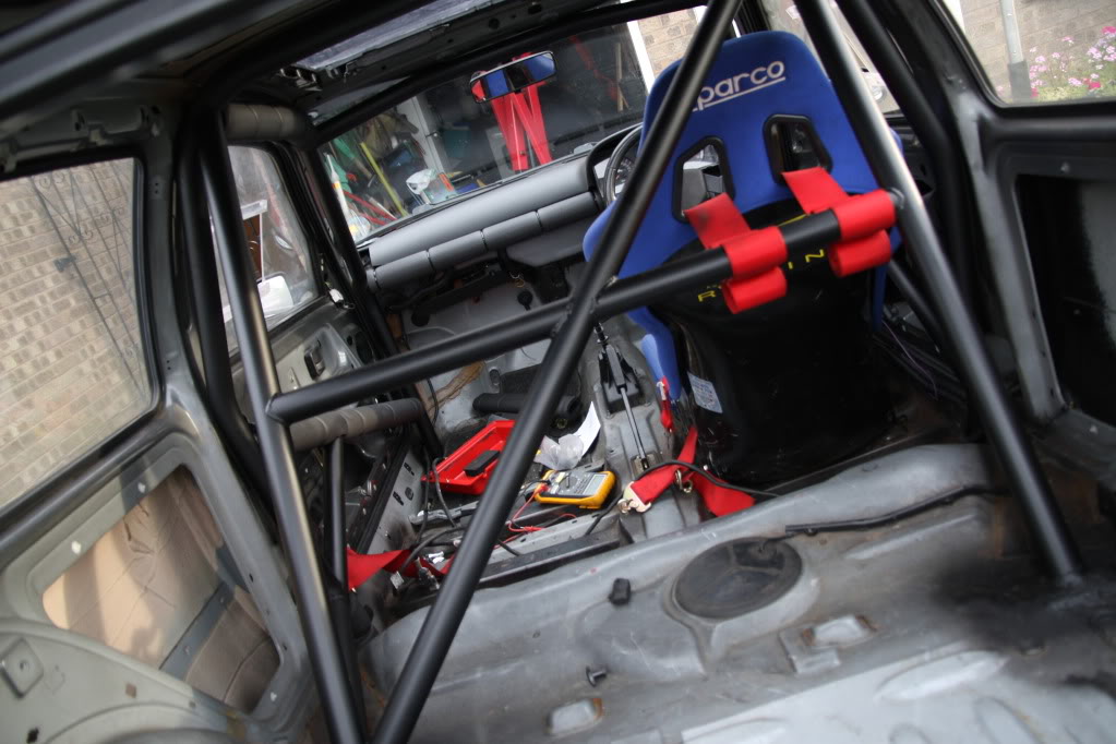

Bulkhead bar done, will be fully welded in tommorow...

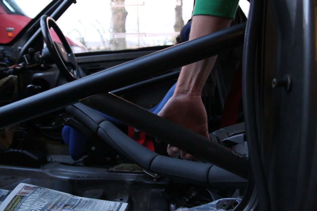

I had around a meter of tube left, so made two more small bars...
These go from the main hoop, at the same height as the lower rear stay, upto the door bar... I decided to put these here (for the sake of an extra 2kg) so there is a bit more protection once ive cut the doorskin and bar out, incase I was ever to get hit from the side...
That will be the cage all welded and done then....welding tommorow :)

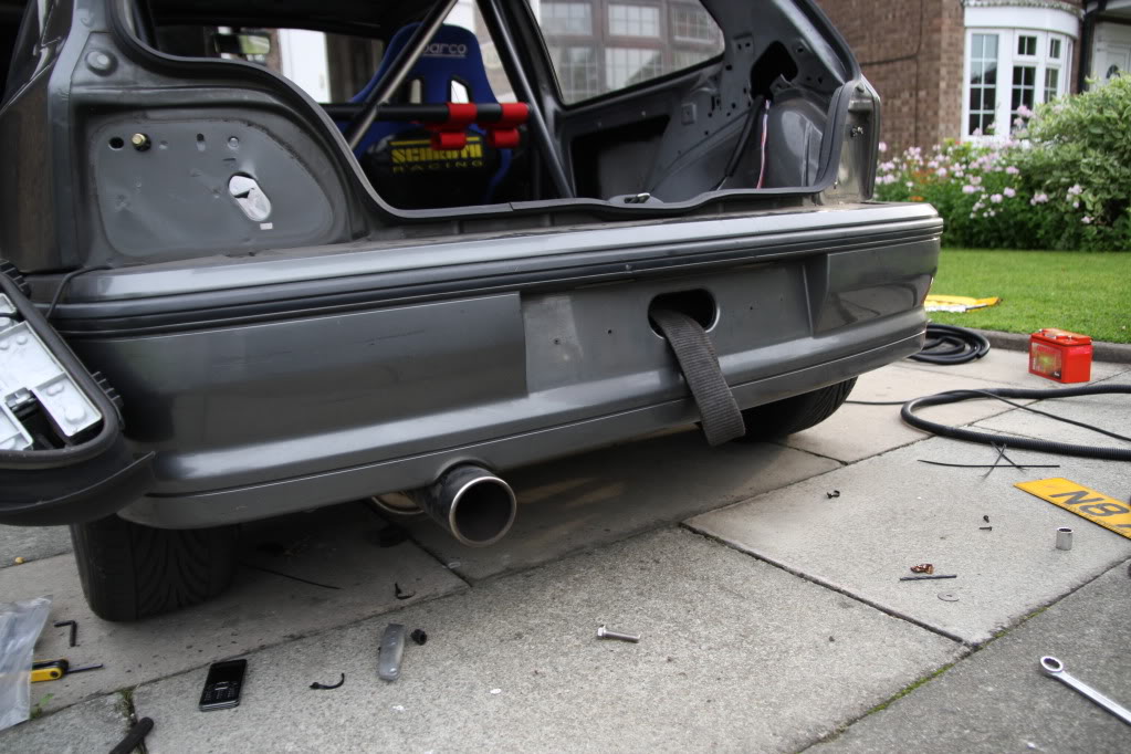

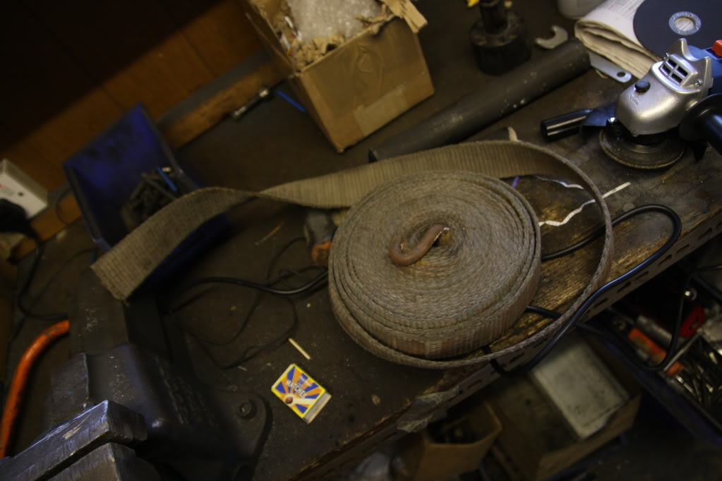

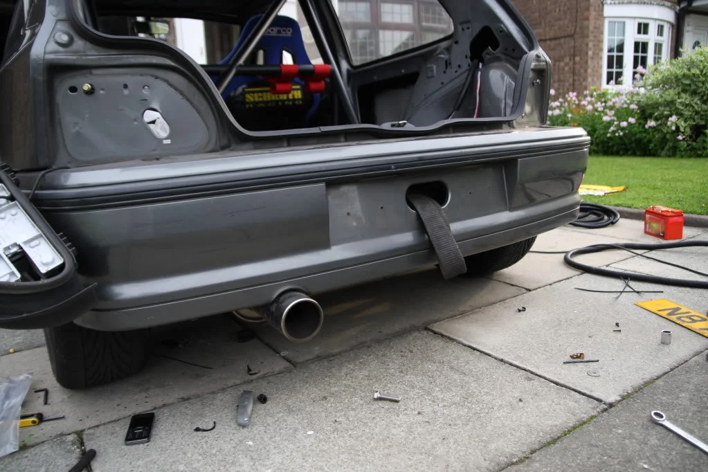

Made a rear towing strap also, which comes out from the hole behind the rear number plate....
While on track it will just hang out and is there if required....when back on the road, just tucks up into the hole and the plate hites it...sorted!

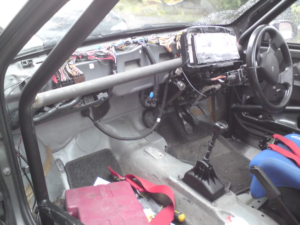

While that does look awesome, I couldn't live with so much nakedness inside!!
Re: Mk1 172 Hybrid Track Car Project
Im used to it now, top dash will be back on etc and clocks mounted, then left for the remainder of summer (if you can call it that).....I hate how the metal inside is all different colors, but itl be reet for now
will be having a full respray inside over winter :)

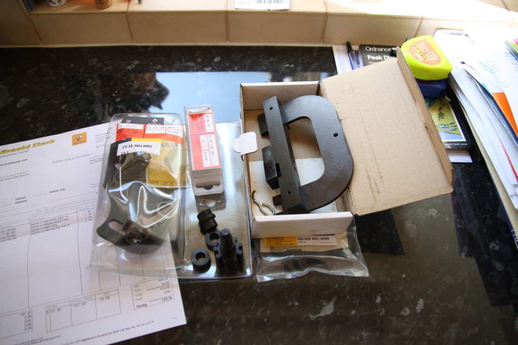

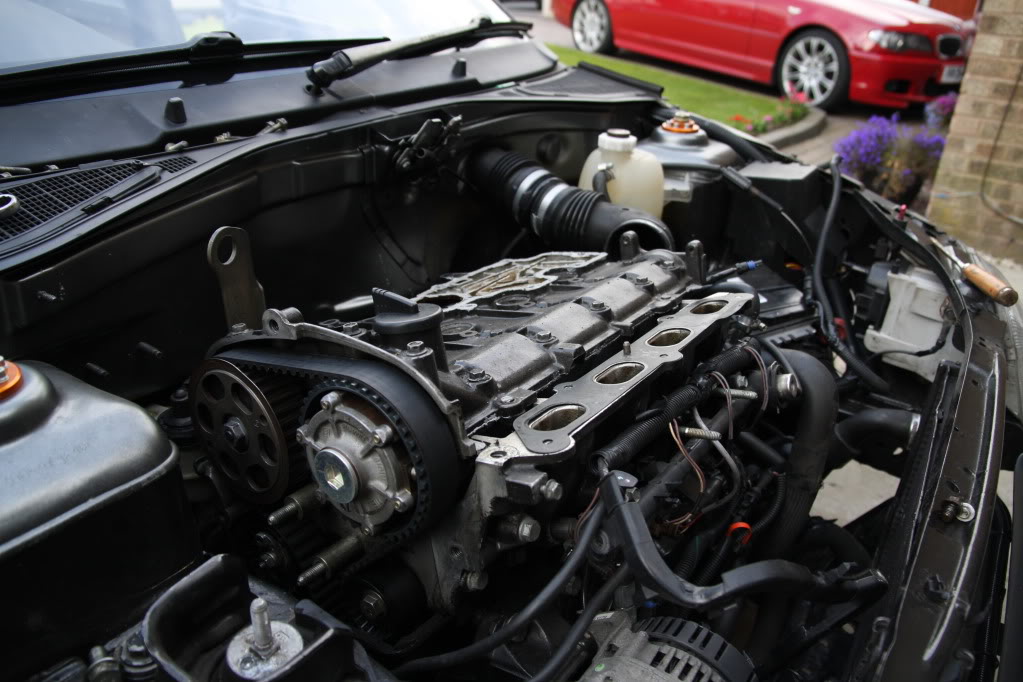

Ordered the F4R timing tools from Renault earlier, as im putting the standard cams back in for now. Thought I may aswell buy my own tools if I keep swapping stuff, and a few people I know will probably want to lend them in the near future.
Dont trust the Schricks in the engine without the proper map, got two trackdays (11th and 15th) before I sort out an aftermarket ECU, so they can stay out until then.

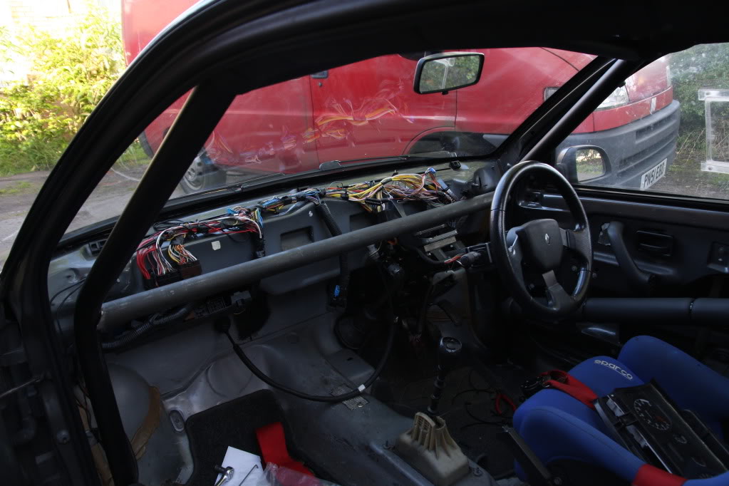

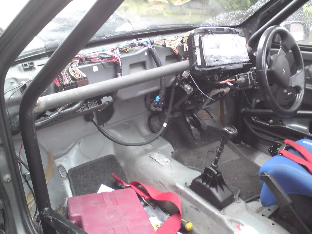

Picking up some 172 clocks later, as now the bulkhead bar has been welded in the Mk1 clocks sit a bit too high (bar is in the way for them to sit in the original position)...Getting the 172 clocks will mean I can do away with the speedo cable coming through the bulkhead and have a tidier looking clockset/top dash :)

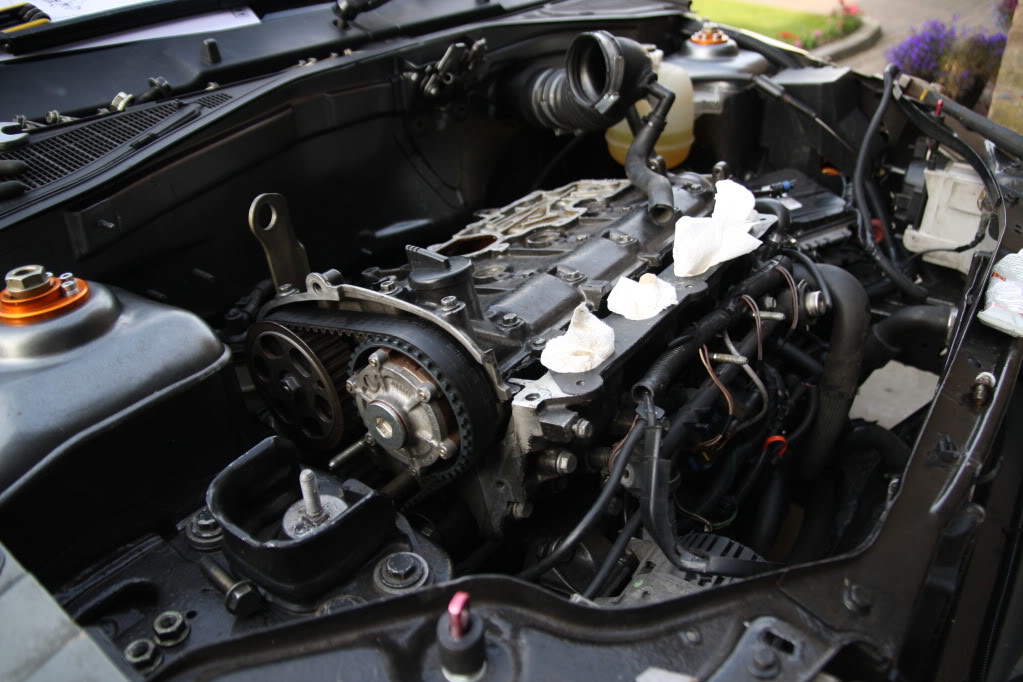

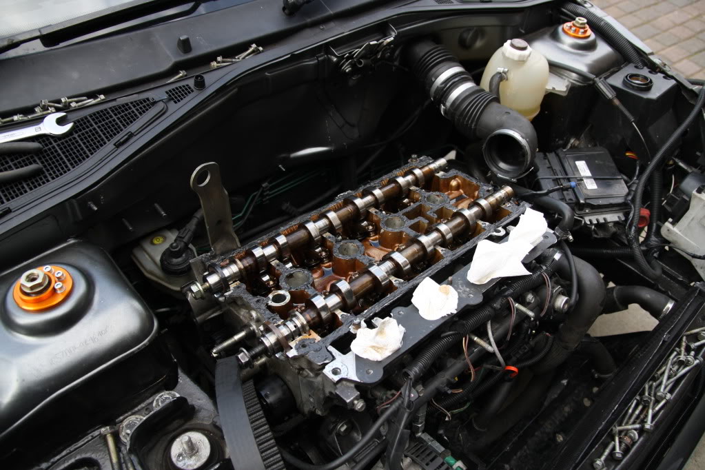

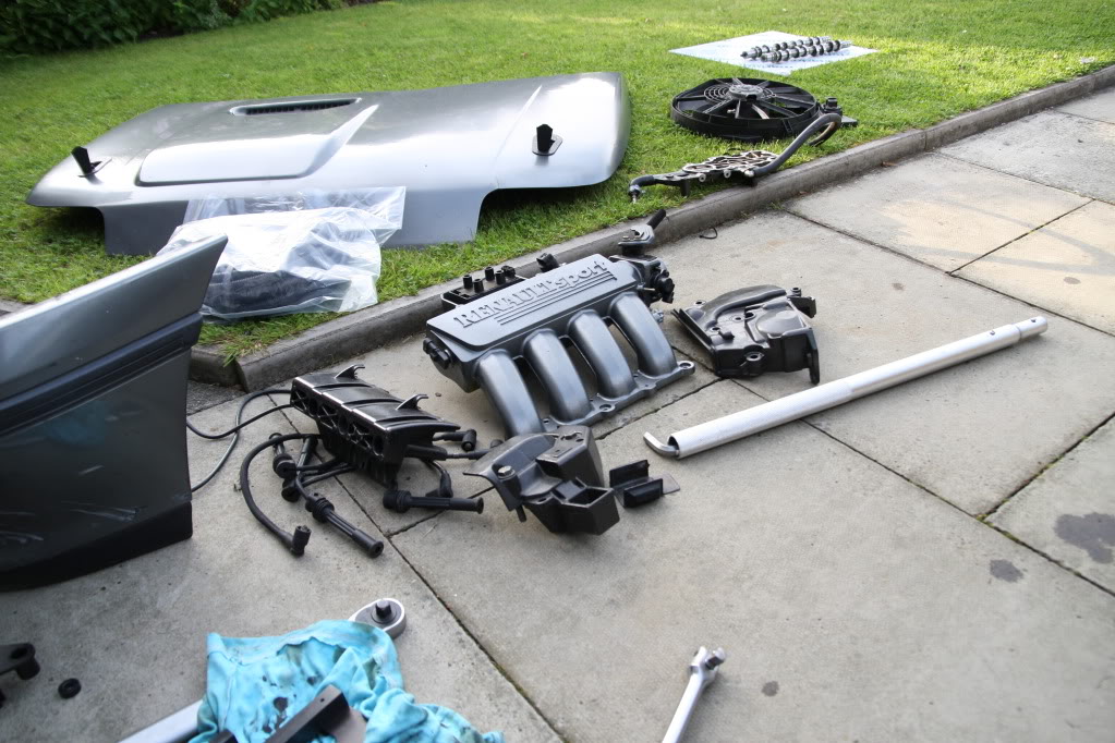

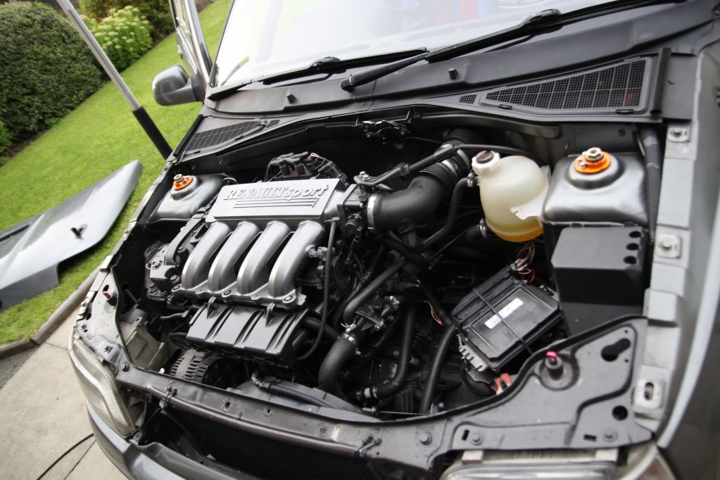

Anyway, Inlets and covers removed...
Schricks removed, standards back in...
Timed up and ready to go...
Fired up first time, drives so so so so much better, dare I say it, its faster lol.
Definately not good running the Schricks without the proper map, but I was only forced to remove them after the poor service from Fastchip, saying he could custom map it then turning round saying he is not doing custom jobs at the moment, after I had fitted the cams.
Anyway, totally different car. The 172 Ph1 Group N map (from RSTuner) is still on there from a while back, drives well. Cant wait to get aftermarket ECU now and put the schricks back in, then get it mapped properly, should be even better :)

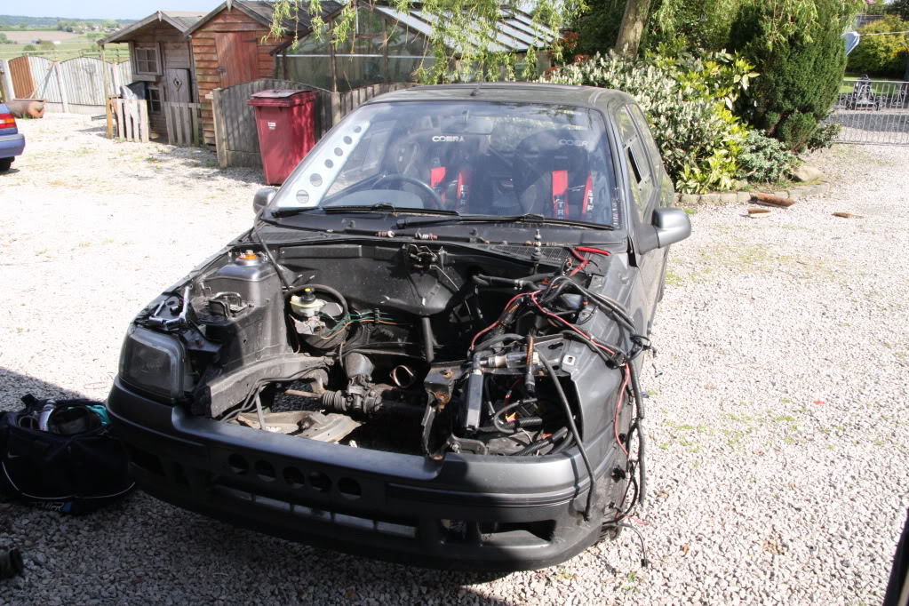

I was originally going to take the engine out and swap the gearbox at the same time, but then thought whats the point in draining the coolant etc when im getting a new radiator next week and im going to have to do it all again, so that can wait!
Took me just under 3 hours with a lot of chatting inbetween to remove, clean, re-fit and time it all back up....not too bad :)

For reference...
TDC/Crank Pin - 0000105400 - £8.98
Extra Longer Cog + Spacers + Nut - 0000150901 - £16.56
Camshaft Locking Tool - 0000149600 - £40.50
Pulley Locking Tool - 7711381801 - £40.50

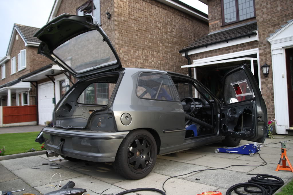

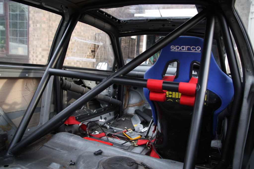

Few pics from today, quite a bit more done...some of the inside/cage first...
Full shot...
Bay is still clean-ish after 10k... :)
Anyway, spent a while replacing the manifold gasket (again) today, so much better to drive once again now without any blowing, should be spot on for cadwell on tuesday. Also put rubber piping round all the exhaust mounts to stop vibrations, seems to have worked for now :)

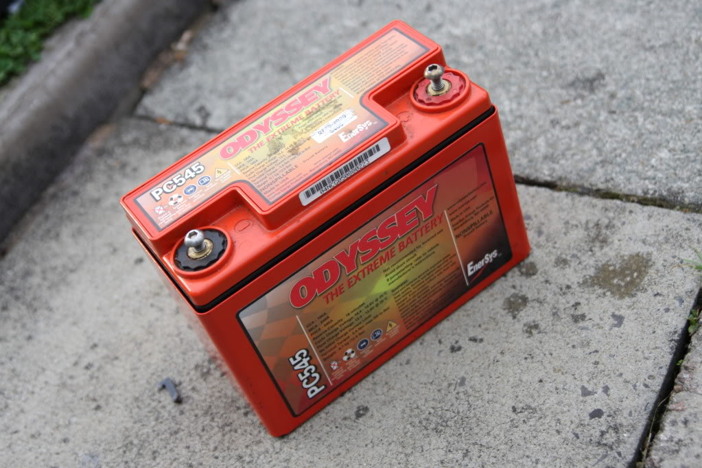

Picked up this off Winston earlier too ;)
Which is now fitted in a box behind the passenger seat.
I also relocated all the rear loom through the rear quarter and behind the rear bumper, then removed the old battery box and wiring, finally have a tidy empty boot again!
Last job was to fit my rear towing strap....bolted through the chassis with some hefty bolts and washers....tucks up into the bumper when not needed, and plate goes back on....nice tail eh?

Just in the middle of wiring up the 172 clocks at the moment....wires wires wires meh!

il be back at somepoint with them lol....the nut from the 1509-01 does not fit into the pulley locking tool like it should....its like 1mm too big?
Freds fitted fine when I used his set of tools....will come and show you anyway
