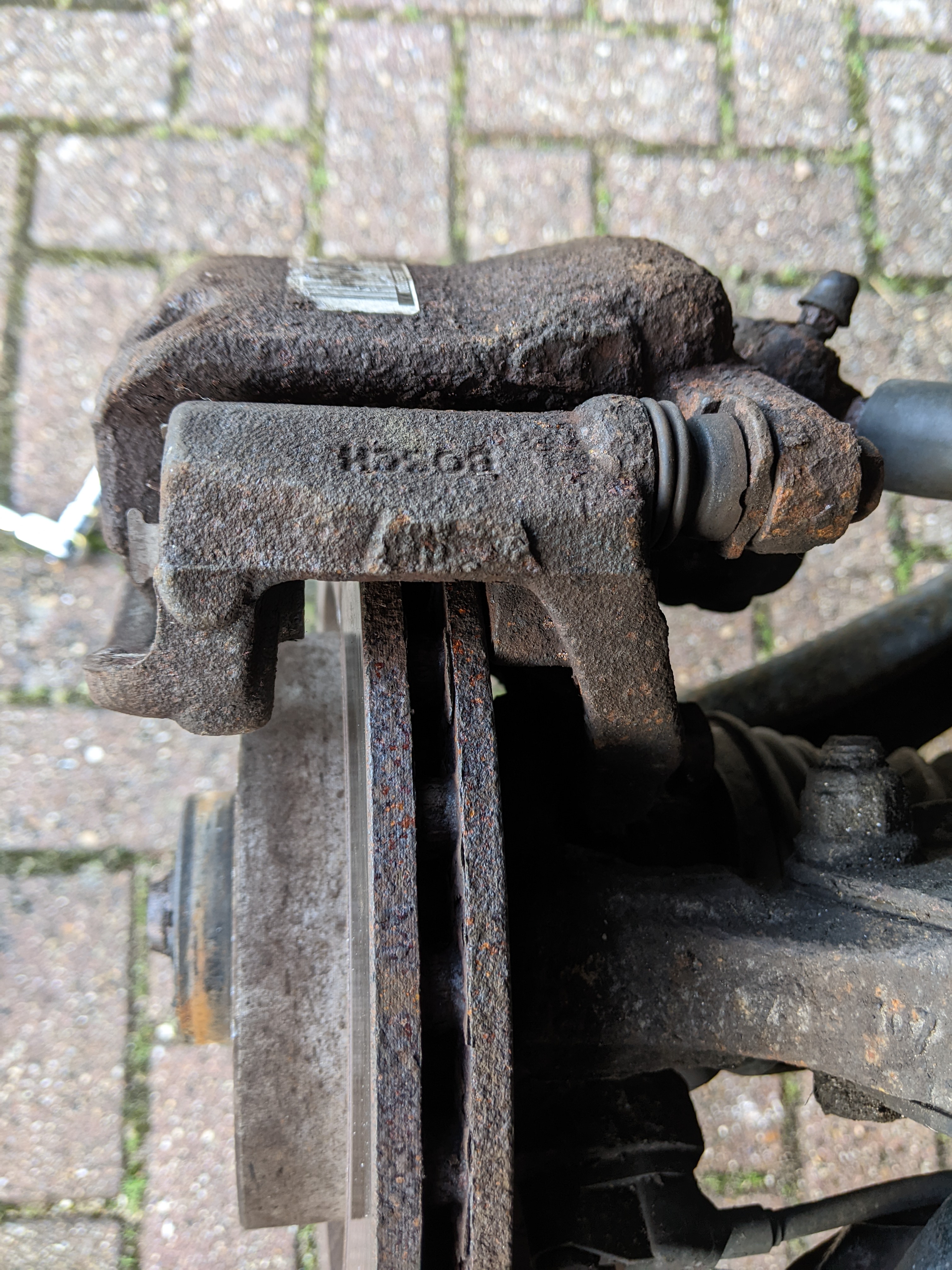

@Adey. Bit of a revival, going down the route of 307/280mm conversion. I did a test fit today and I wanted to ask if the carrier gap looks about right.
I haven't used any spacers here so it would come out another 1-2mm - does this look similar to your twingo set up?
I assume the carrier sits offset and the caliper floats - that, or it's mega off 😅

No, you need the spacers in between the carrier and the hub mounting. That disk needs to end up in the centre of the calliper
Thank you for the info, even with the few extra mm on the 280 disc it will be well off then
Won't be as easy as using 1mm washers as you did in your TurboRenault write up
