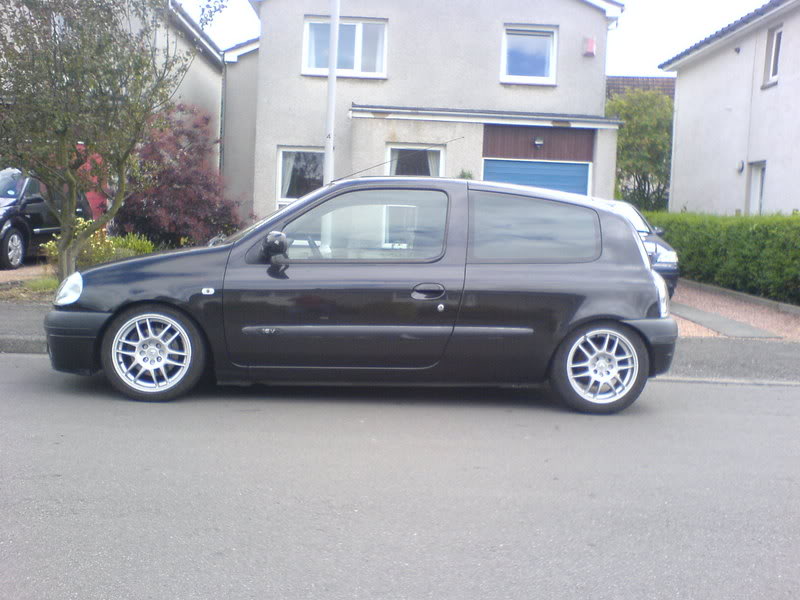

hi there im new to all this i currently own a mk2 phase1 1.2 clio lucks quite smart to be honest sunburnt orange lowered 60 mm on 16" 172 alloys its chipped got bigger injectors fuel pressure regualtor uprated fuel pump a moddified 1.4 cam and a vernier pully goes fairly well for what it is 93bhp on the rollers

off topice but nice clio you got there i got the same in red buy myn dont look that good lol mayb it is the colour?
thanks for the comment bout it looking good the wheels fit the arches just nice with no rubbing n 15" look far too small
