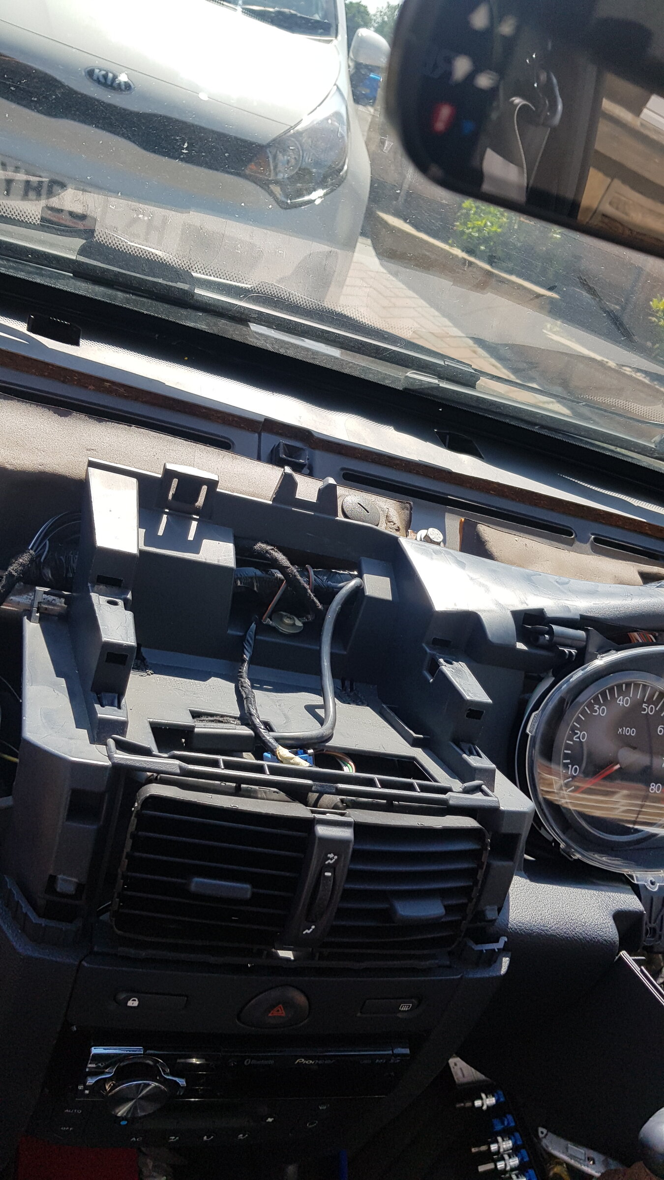

I'll be fitting a 7" raspberry pi touchscreen into my satnav unit but it will require modification to the lower dash first as there just is hardly any space in there.

What do you mean you have the dash part? They're just a standard top dash with a different centre section.
For a decent size screen the bottom bit needs chopping out.

For a decent size screen the bottom bit needs chopping out.View attachment 1490714

Ahh, you mean the plastic housing that takes the OEM screen? Sits very far back if using it as a touchscreen.
Have you had a look at a smaller screen mate? I bought a 7 inch one but it was way too big for the MK3 satnav housing. Bought a smaller one which is practically the same size as the factory one.
I'm wanting to get it as big as possible really, but obviously dont want to make any changes that will stop it being put back to factory.
For a touchscreen it's really far back as oem.
