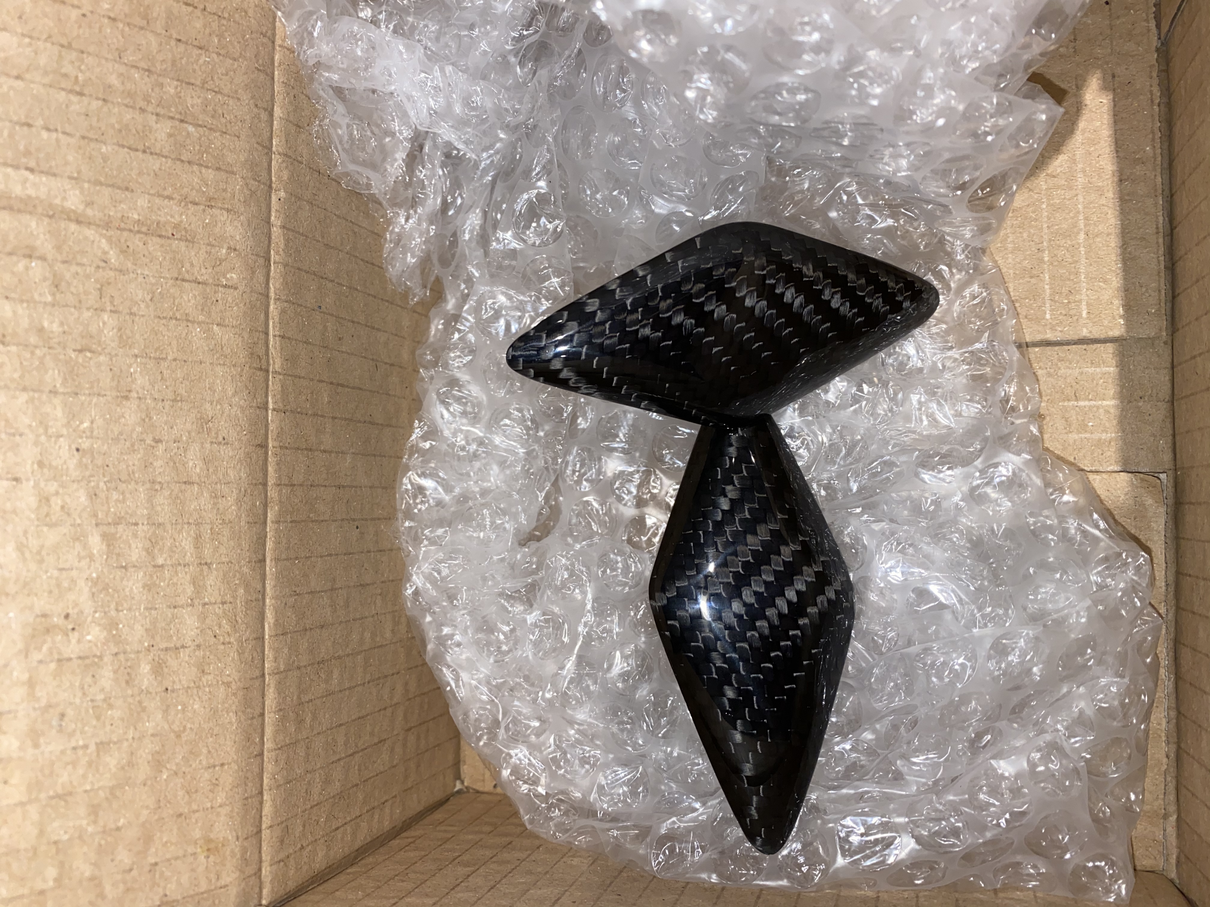

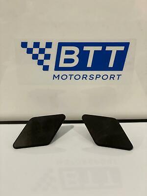

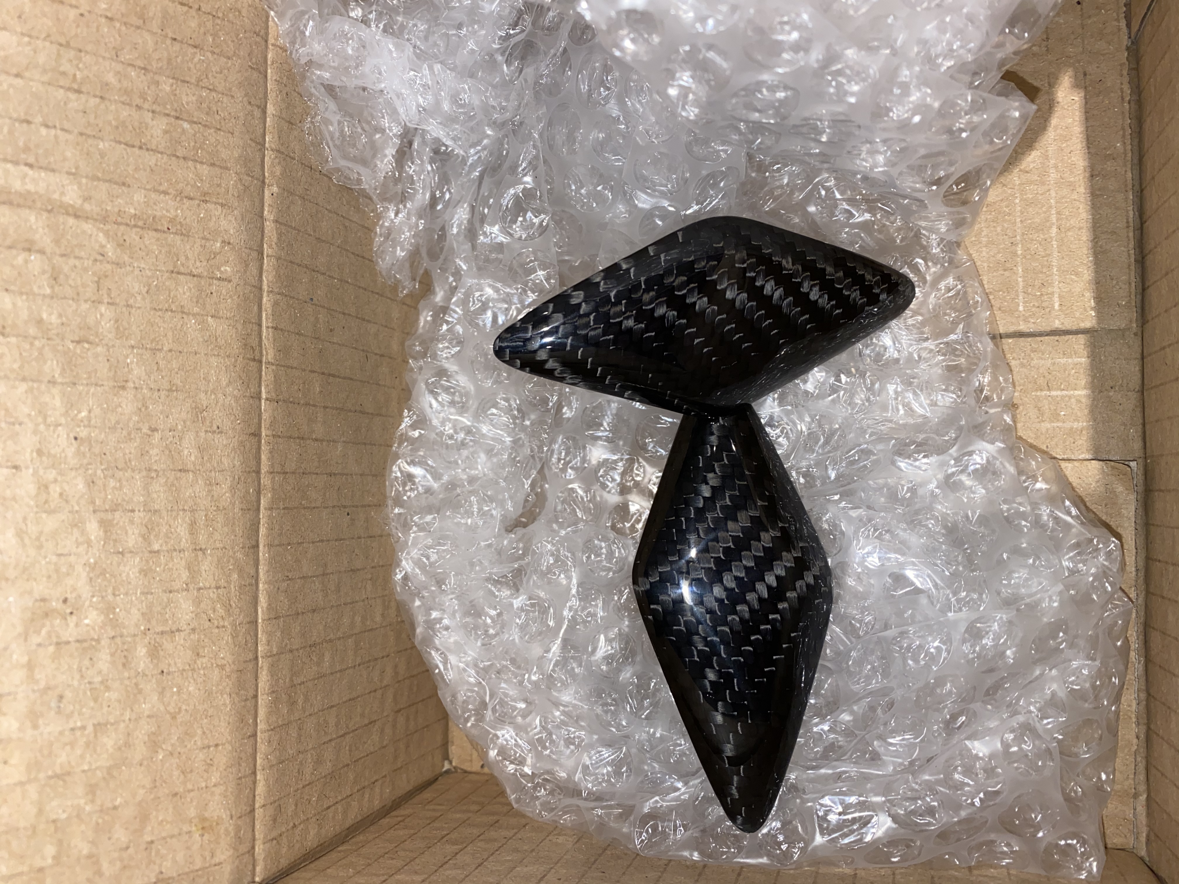

Also I got a delivery while I was out
Where were these from, I'm amazed nobody is making the standard ones yet

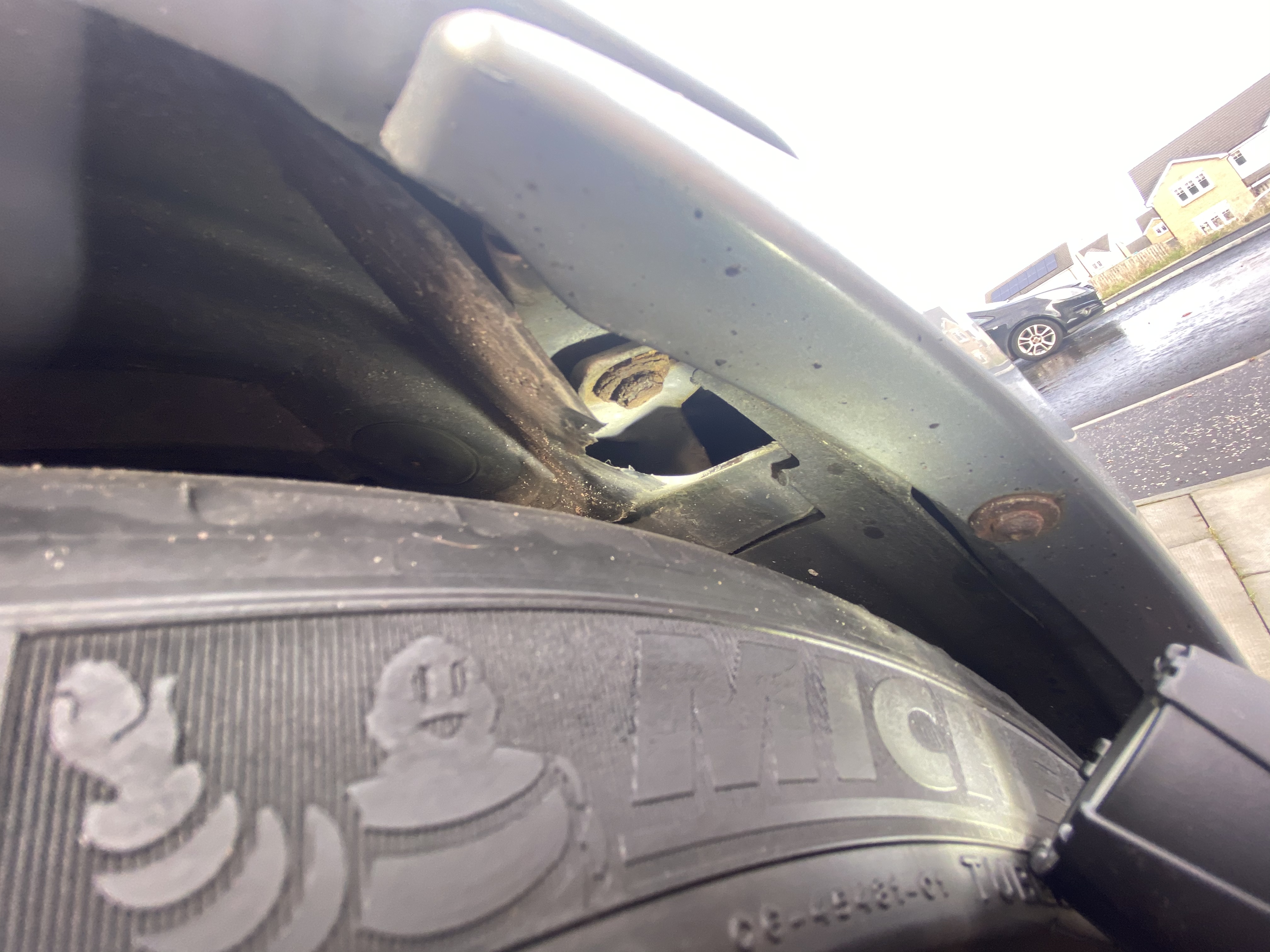

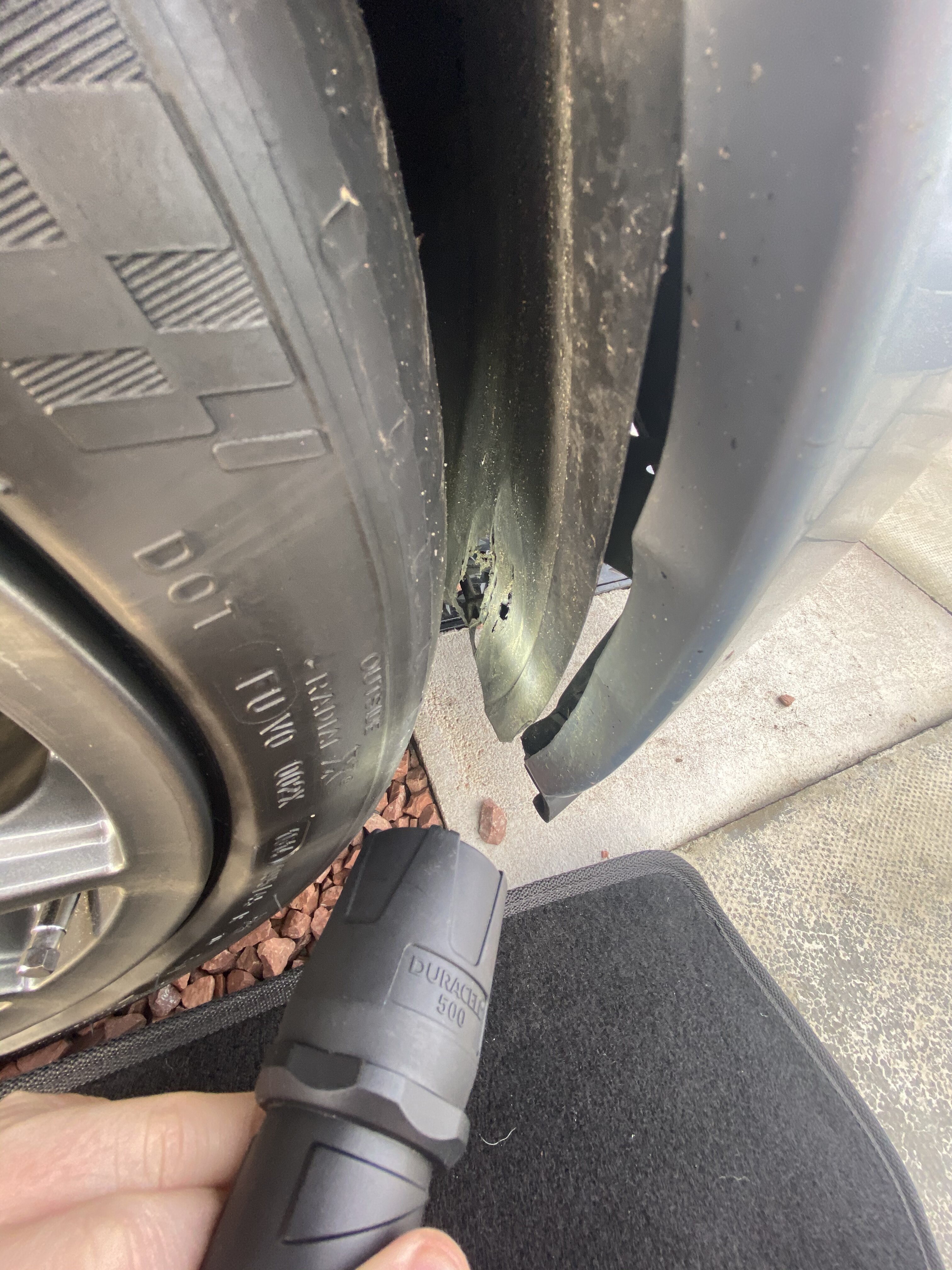

I managed to get a good look at the arches, no bubbling in the paint and felt OK behind. This morning I’m going to go out and get a better look at some of the other places mentioned.
Won’t get it up on stands till the weekend, but when I do, bumpers off, wheels off, maybe arch liners too. Get everything nice and cleaned out and get a good idea if there’s anything that needs treated!

I’d get the plastic ones, they’re way more OEM looking in shape and actually have proper angles to them. The Carbon ones look way too rounded and not at all good. Even if you paint them it’ll look like some odd rounded bulge.
RustyMojo
Bon Jovi Officianado
I like the carbon ones, think they look smart. I have a carbon splitter so it ties up nicely
jameswrx
Well yeah, that’s great if you love them doesn’t really matter what anyone else thinks. I have them on my track car (bought like it) and I’d happily swap for some iceberg plastic ones as they just look way too smooth, round and ‘homemade’ to me.

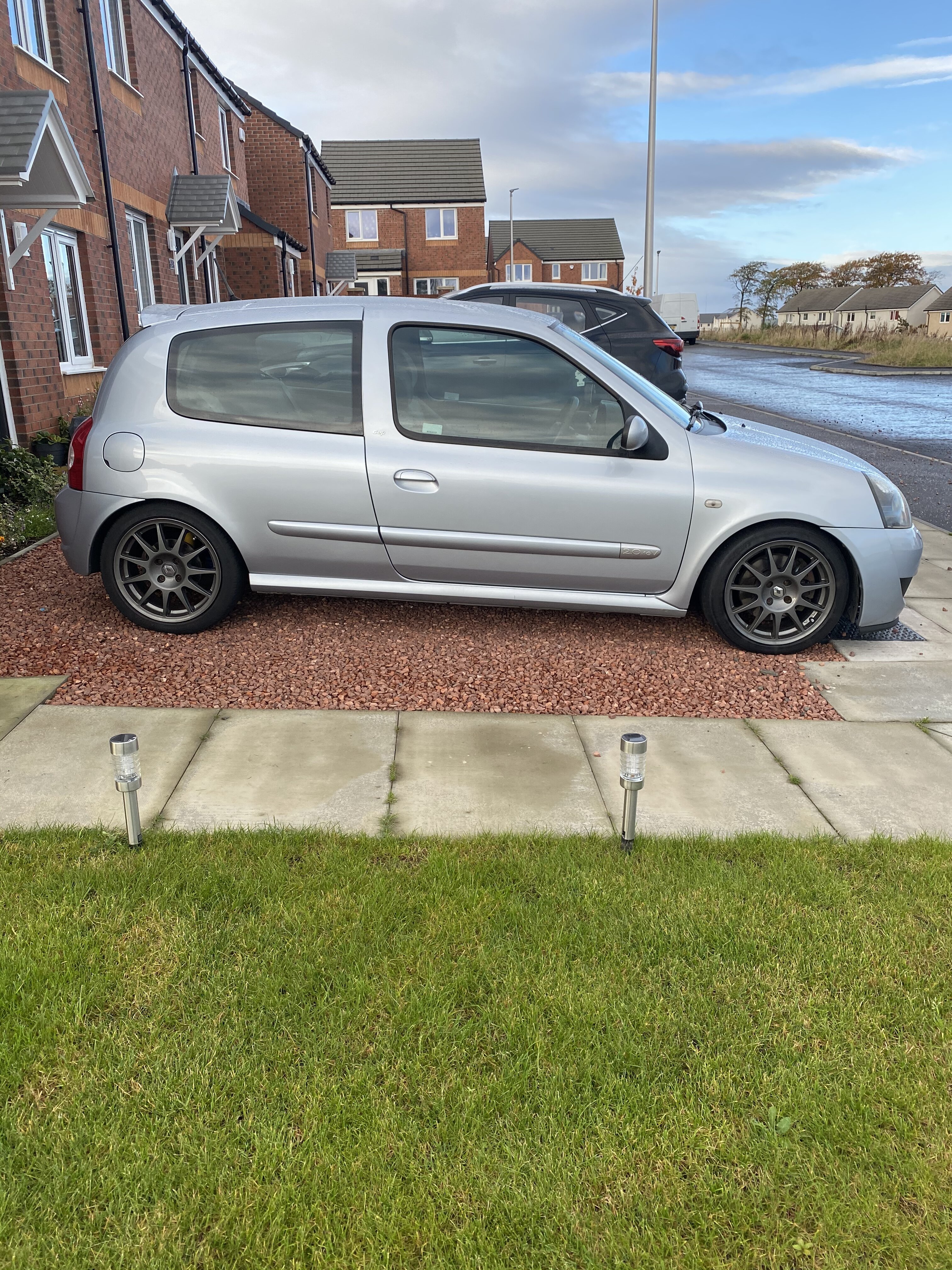

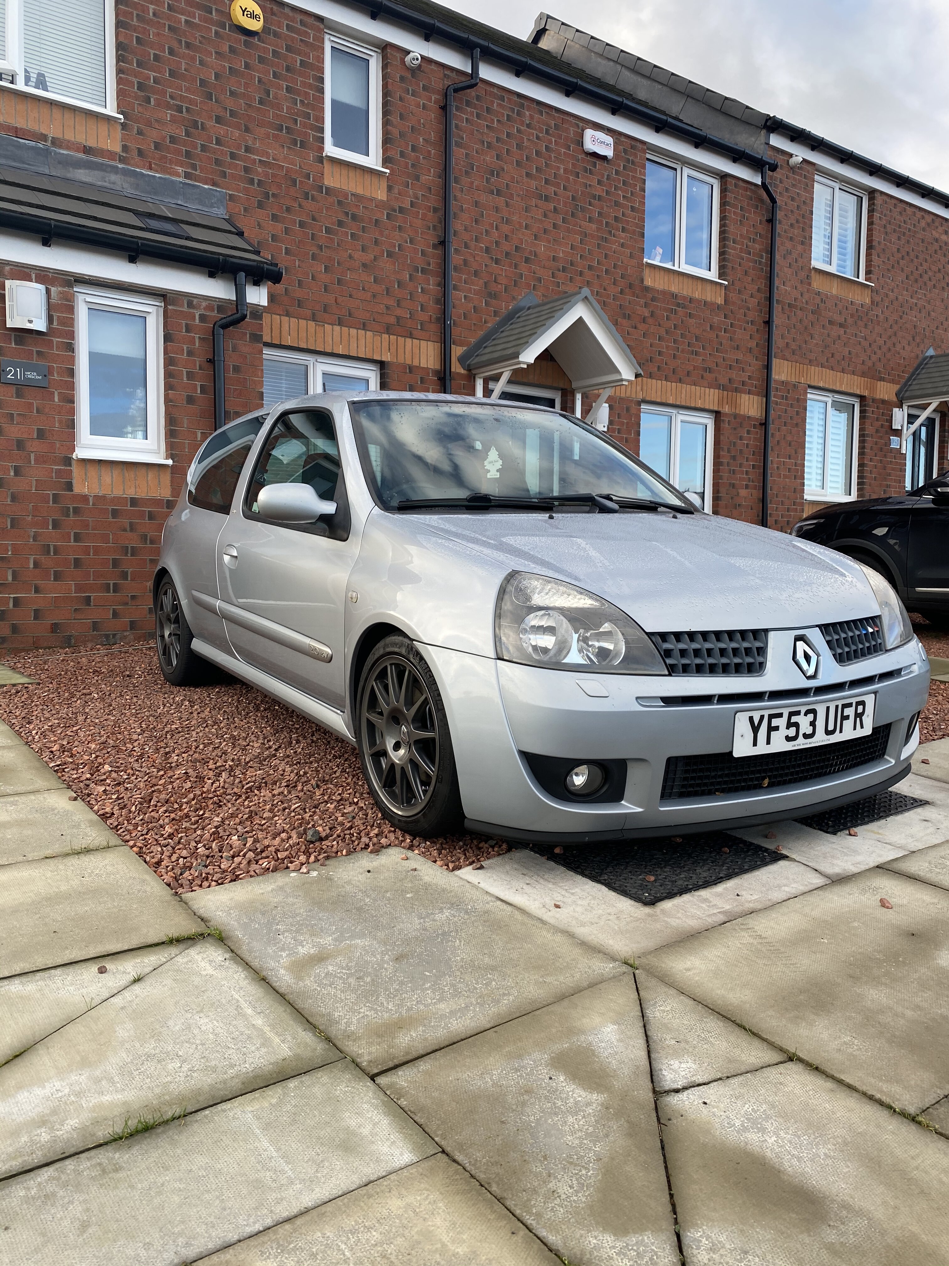

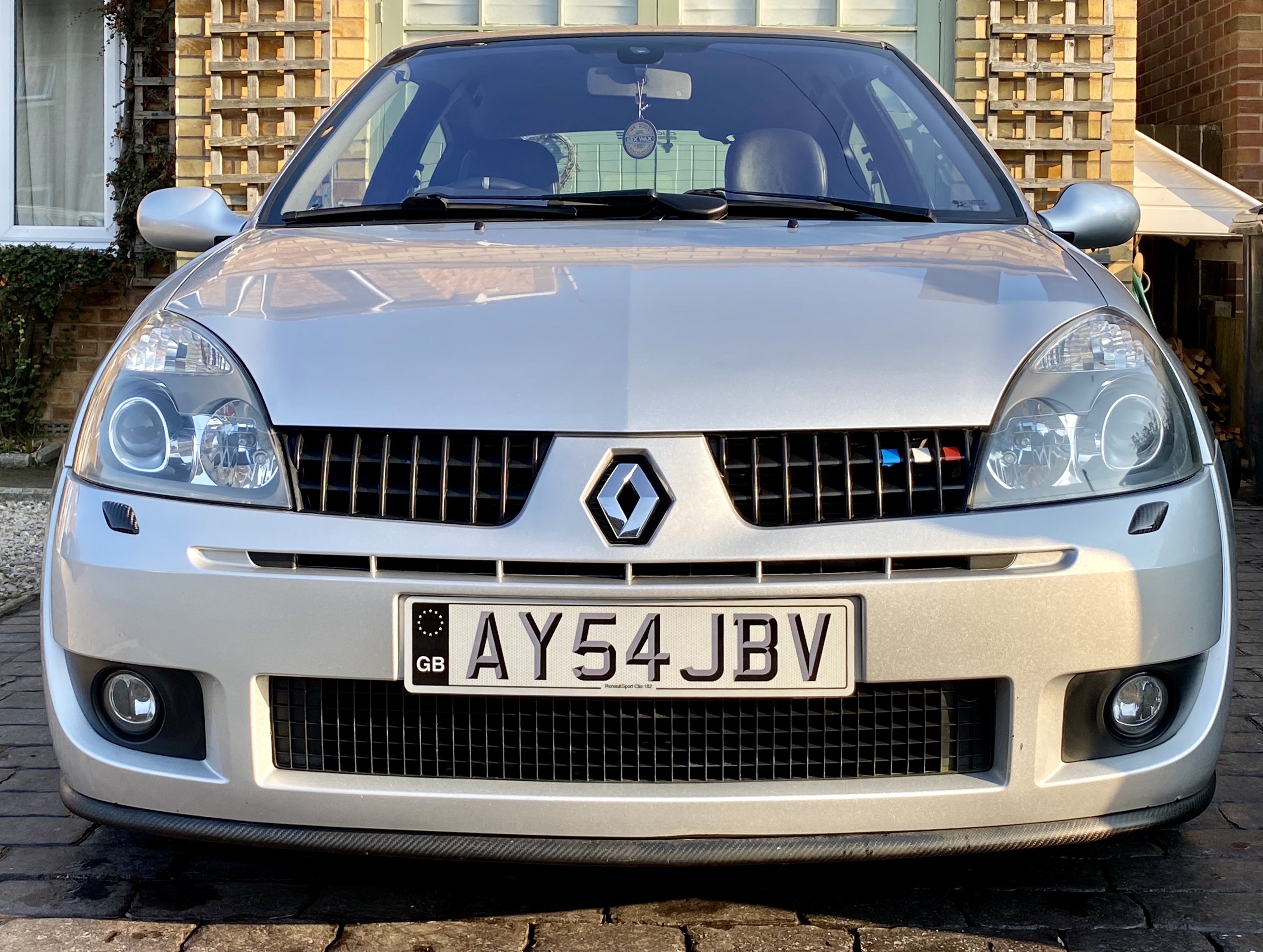

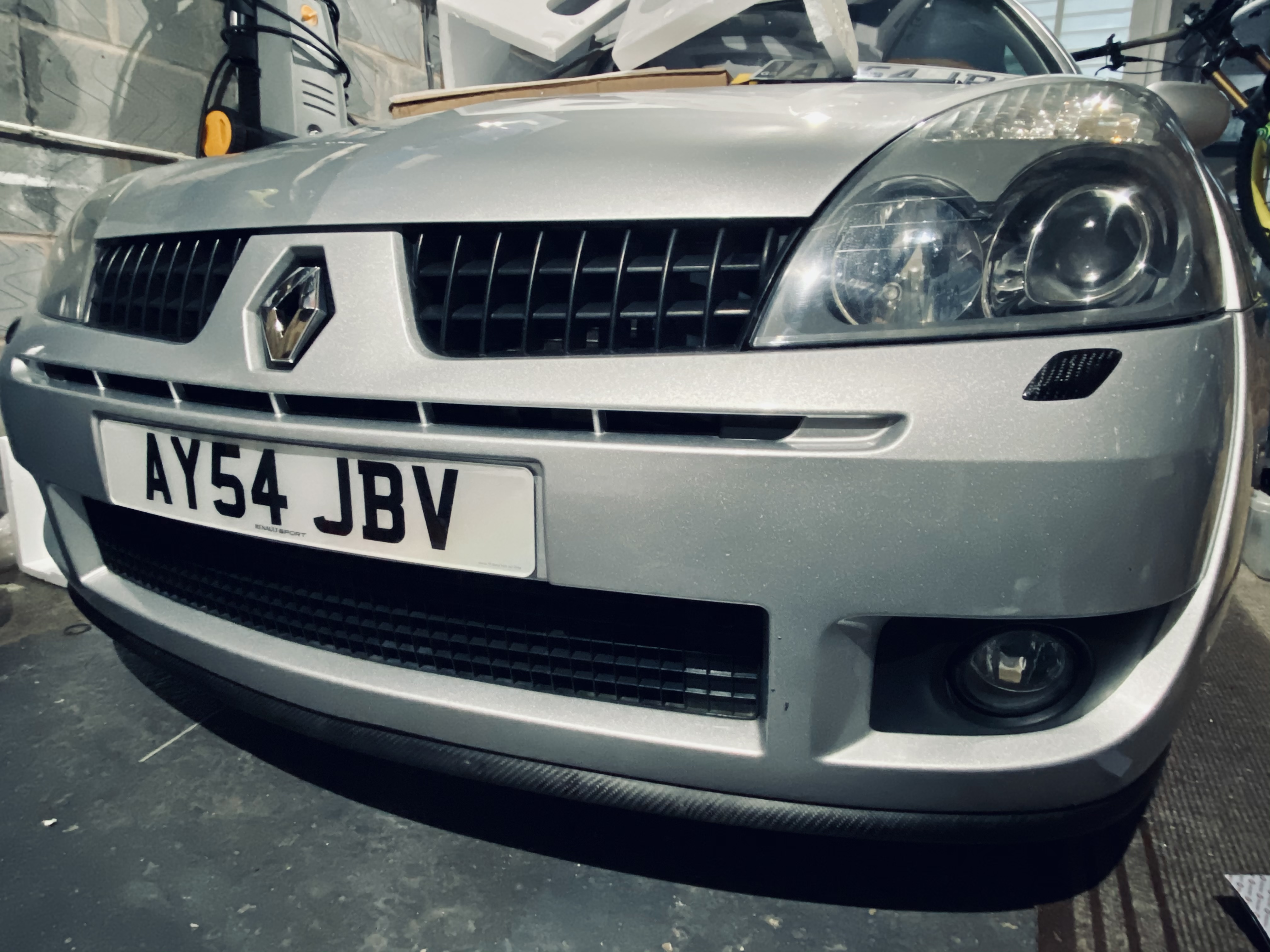

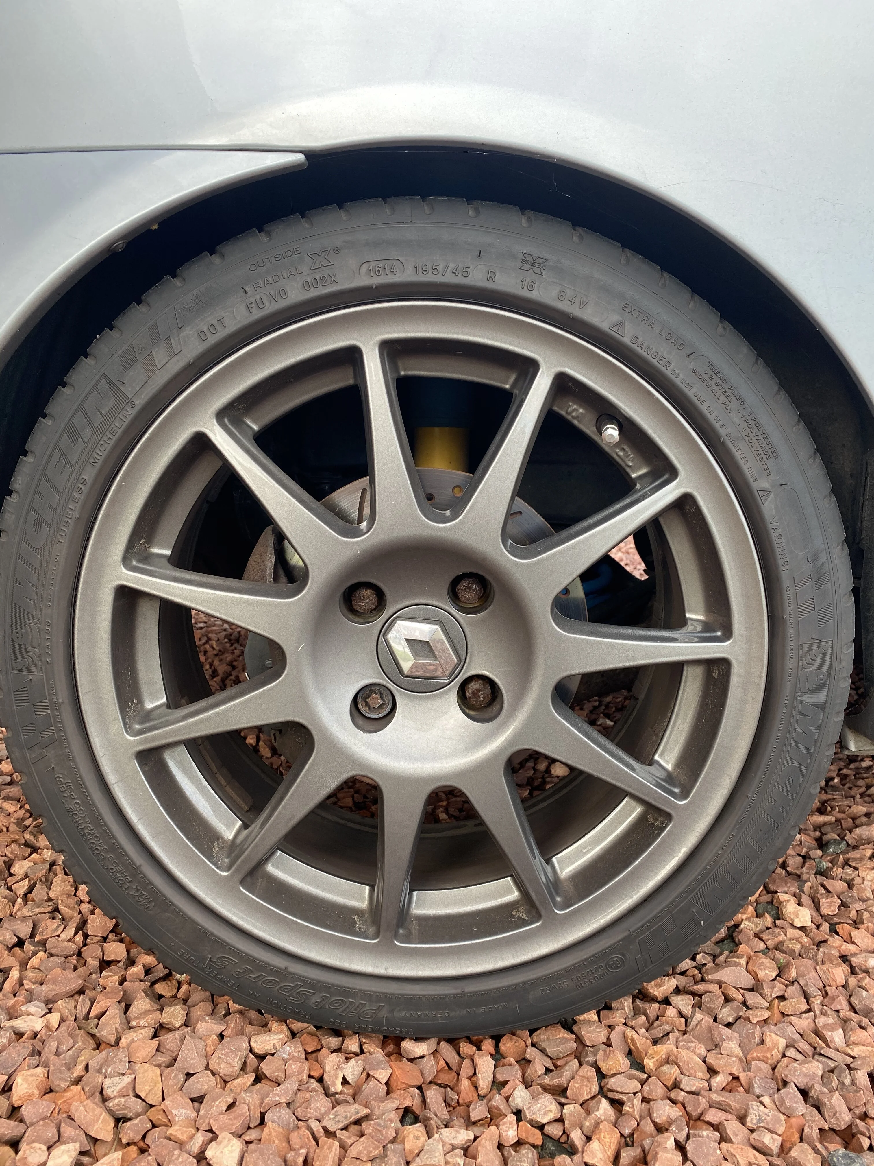

So I managed to find a bit of time to get out to the car before work and have a bit more of a detailed look.
Few pics of the overall look, really clean, quite happy so far. From 5ft it’s perfection. Start to get a little closer and some stuff pops up.
Firstly, all the turinis are mint. Absolutely perfect. But look at the wheel bolts....who puts bolts that rusty on wheels that clean ? So need to order ASAP. Any recommendations?
Staying in the lower wheel area for now, tyres are all PS3s, 6mm right across both the back tyres, nice and even. Fronts are a bit worn on the outer edge, I think this is probably down to the wheels rubbing on the arches due to how it sits. I don’t think it’s particularly low ? Unless there are any other suggestions it might need raised a touch at the front cause the wheels have rubbed away the arches a bit.

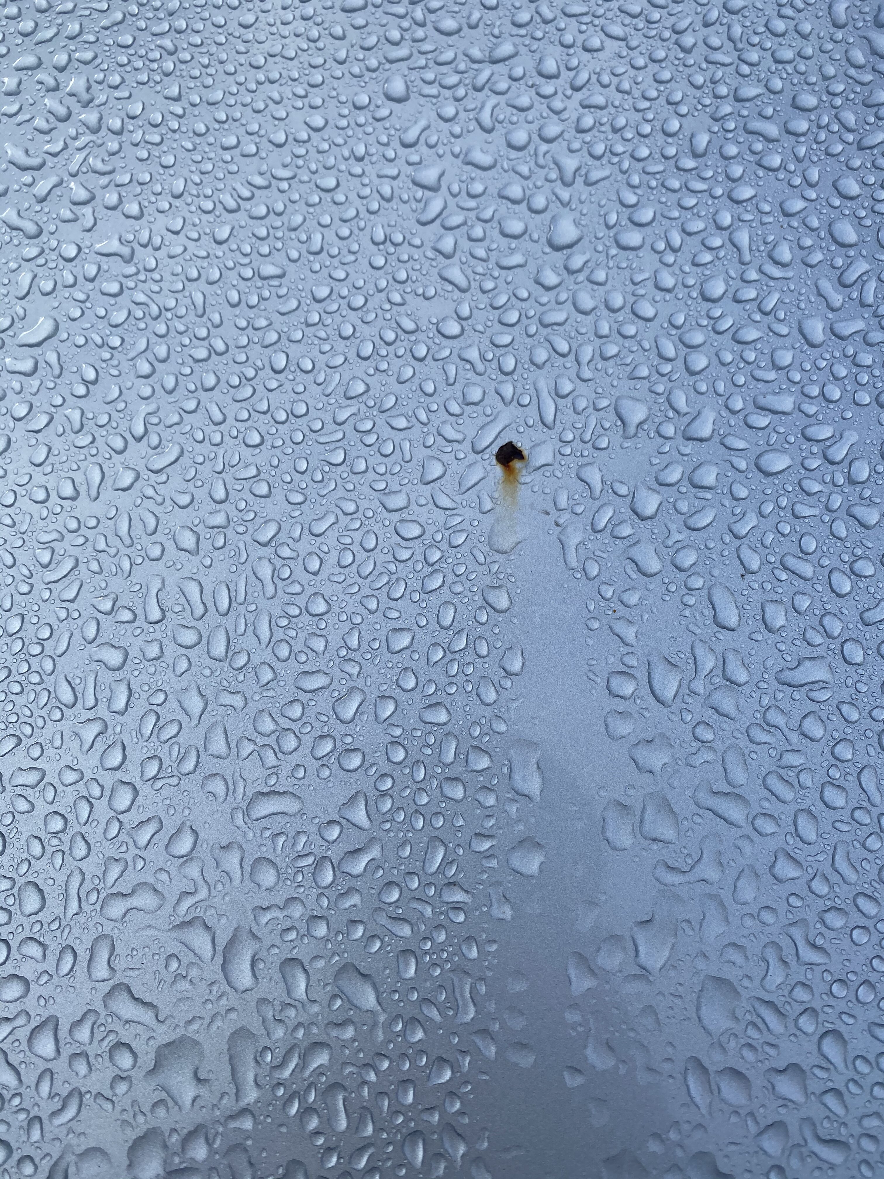

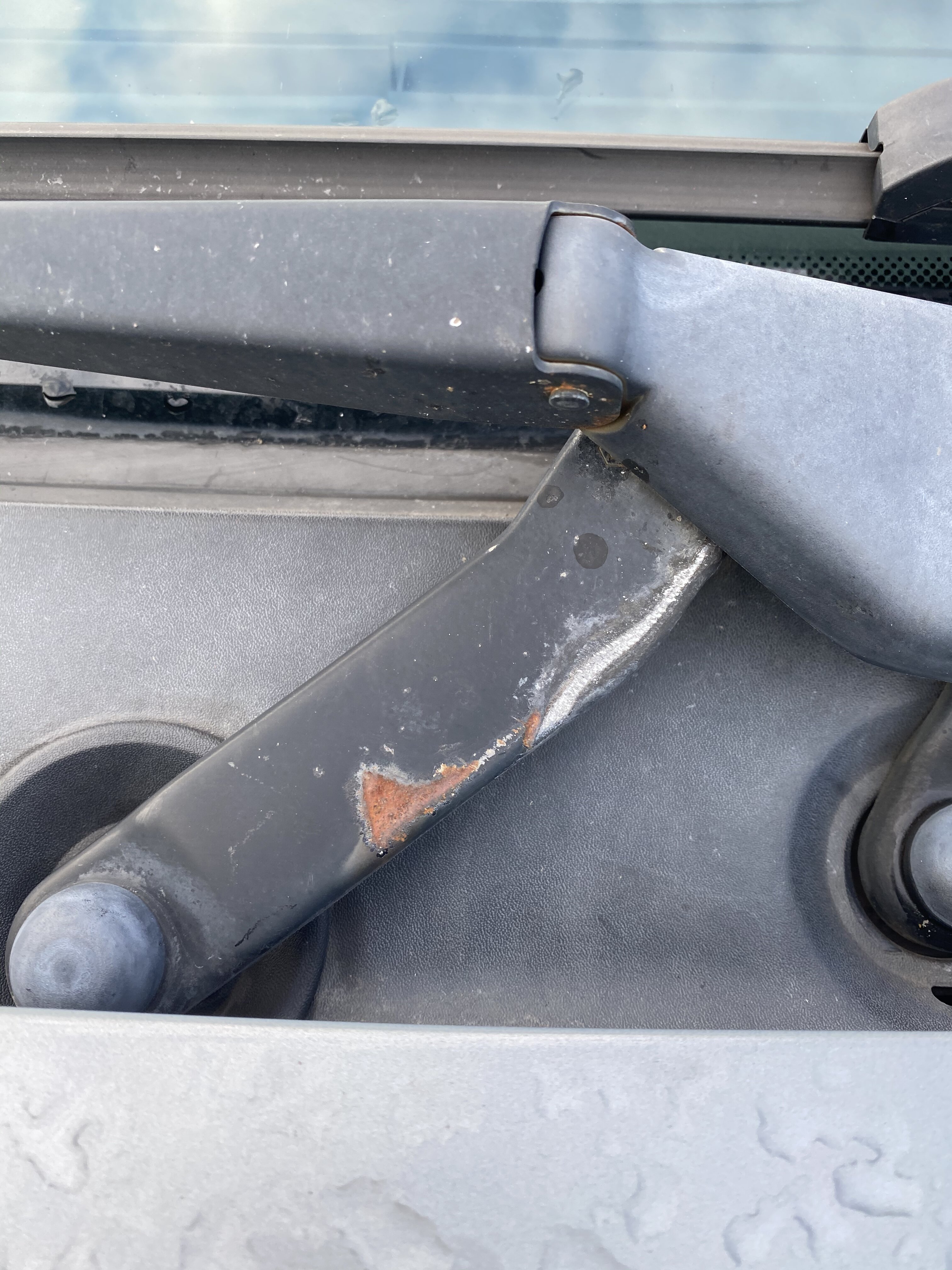

Couple of other very minor bits, rusty stone chip on the bonnet and a bit of rust on the wiper assembly.

Now for the main thing I had a look at this morning, wanted to sort out the water in the wheel well, see what damage there could be. There was a bit more water than I initially though, so I removed everything, cleaned it out and gave it a quick scrub down with some quite weak APC. It’s come up a bit better but I think I’ll go down the route of sanding it back and painting. Will just be a spray can job since no one will see it 🤷‍♂️ Just looks like surface rust so shouldn’t need to sand back much.

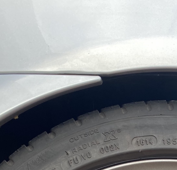

jameswrx
I’d say it may be going on the rear arches where it meets the bumper, looks the same as my iceberg one. If you zoom in on the pic you can see it’s wavy on the edge & blowing out a bit above that. I’d clean it off from behind and rust kill it but I’d suspect there’s a fixing there and rubbage that’s starts the issue maybe. Not sure it’ll help much at this stage but worth a go. My car has been painted previously so god knows what’s gone on in its past. My black car is still perfect despite being 20k higher but it’s original paint.

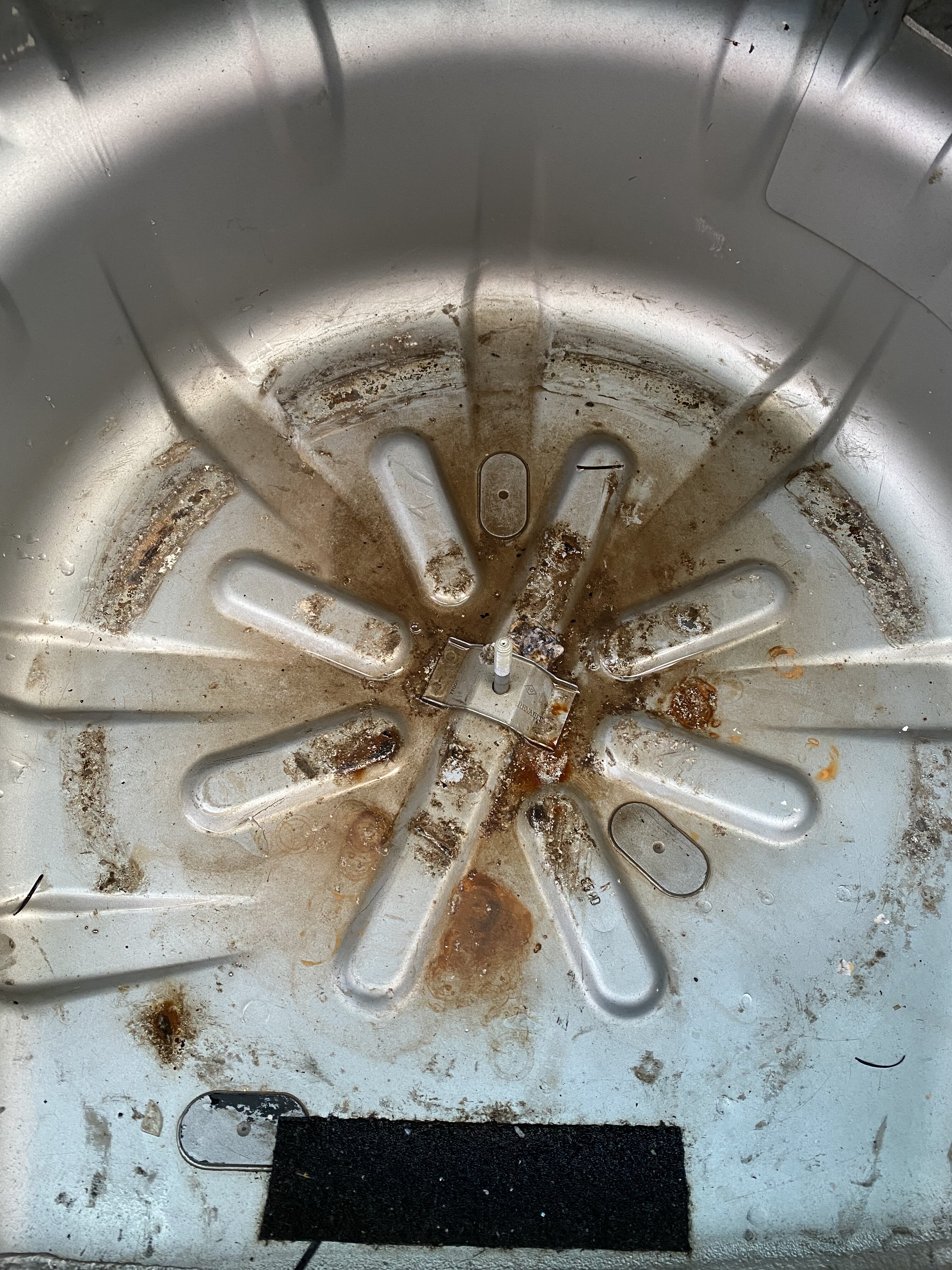

The wheel well is a swimming pool again and the carpet at the left hand side is soaked, so I’m pretty sure it’s the left headlight grommet that’s letting it in. Bought some sealant and that’s tomorrow’s job. Want to make sure water is stopped from getting in before dealing with the rust and painting it.
Gave it a quick wash since all my plans were ruined.
Too dark for an after photo but it scrubs up well for near 20 years old.

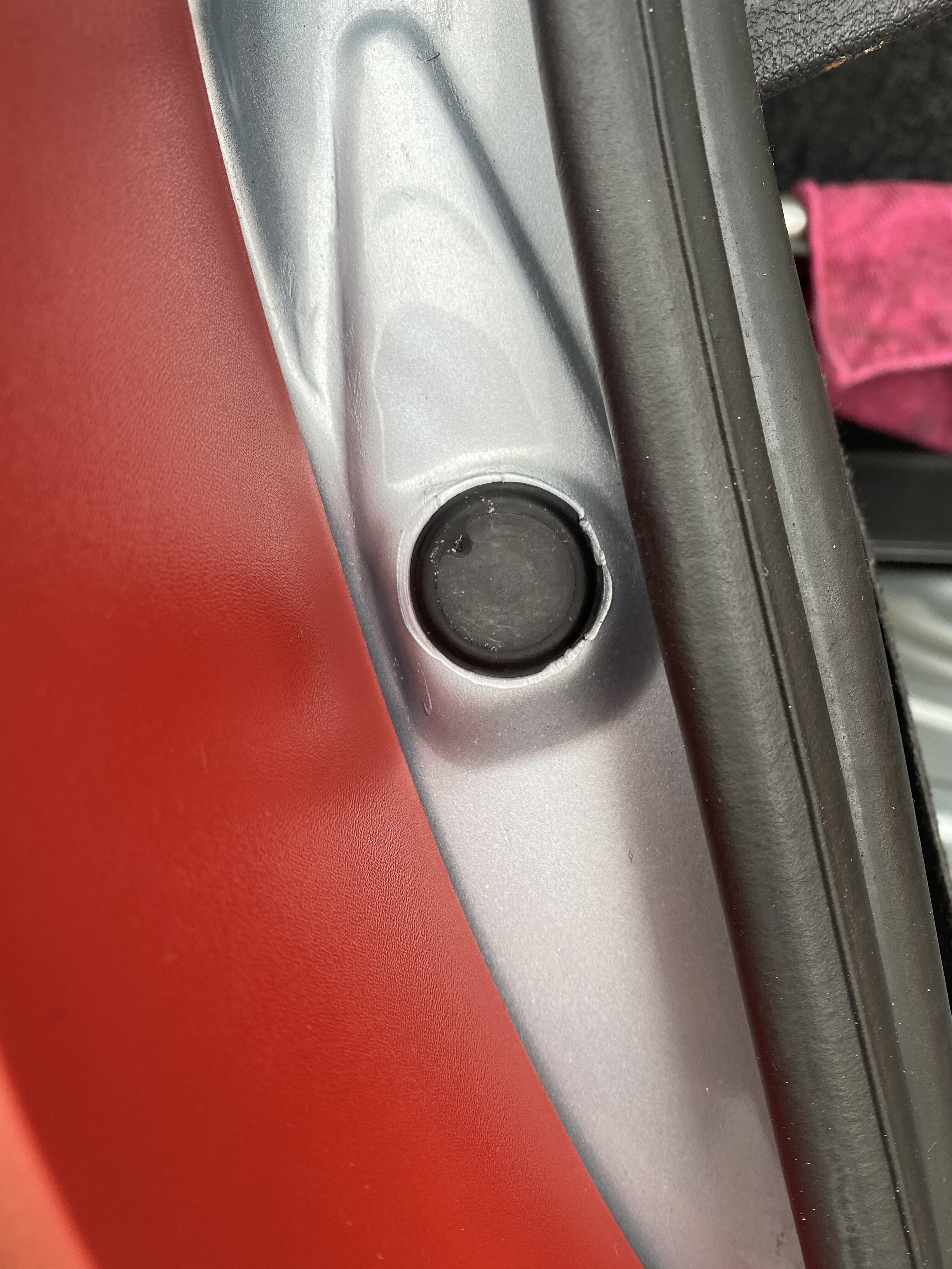

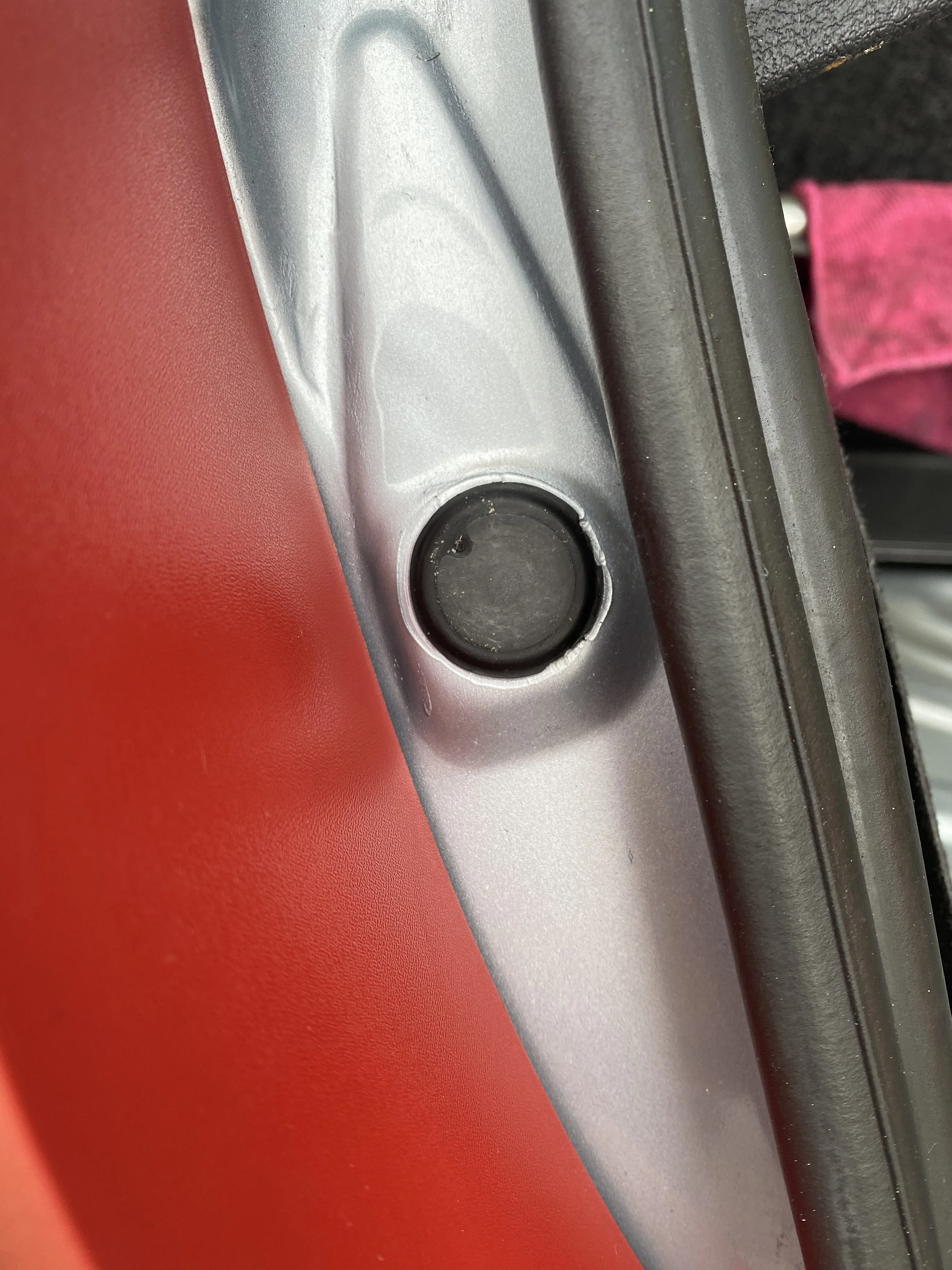

Got the grommets all cleaned out and sealed up.

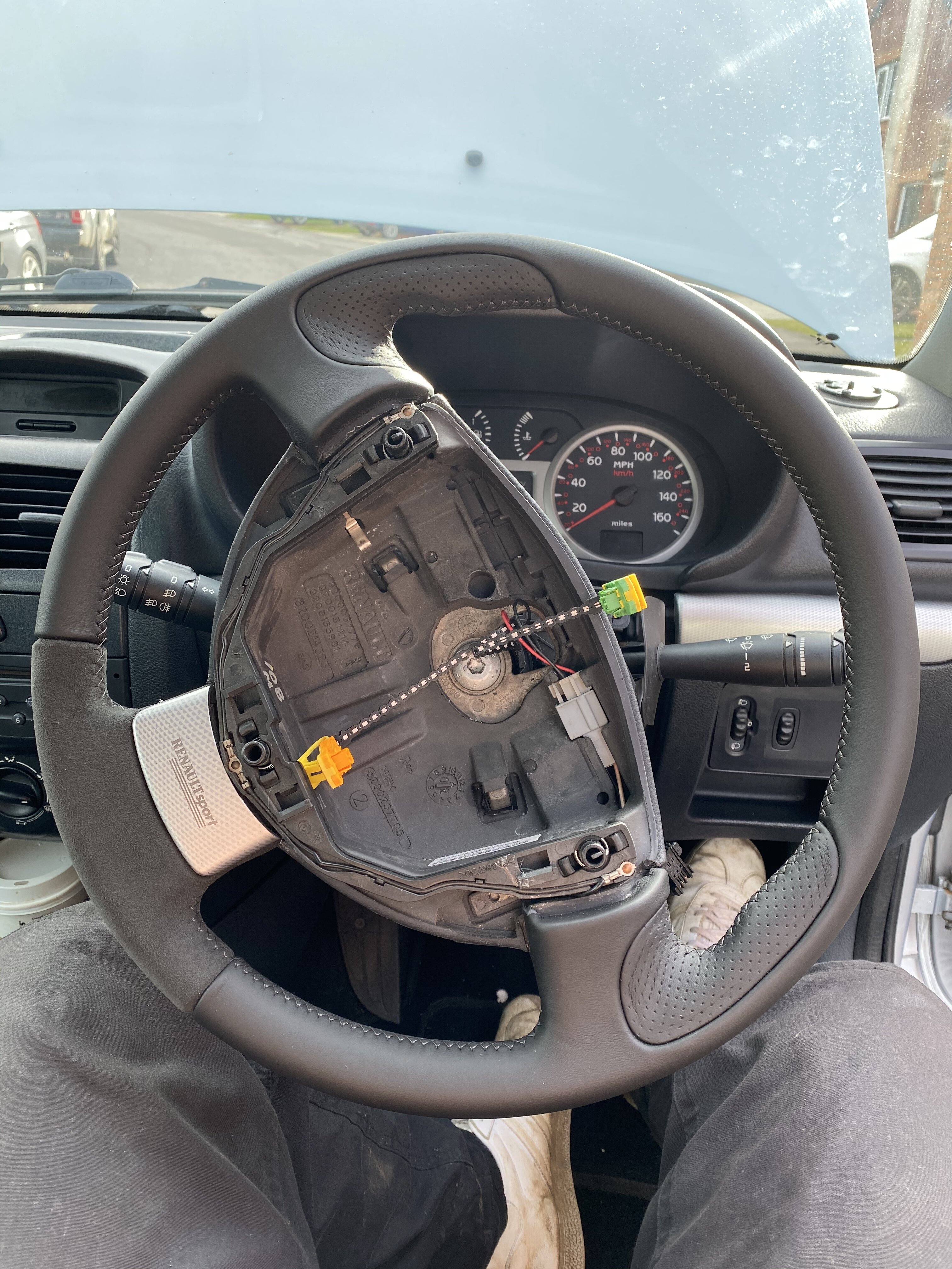

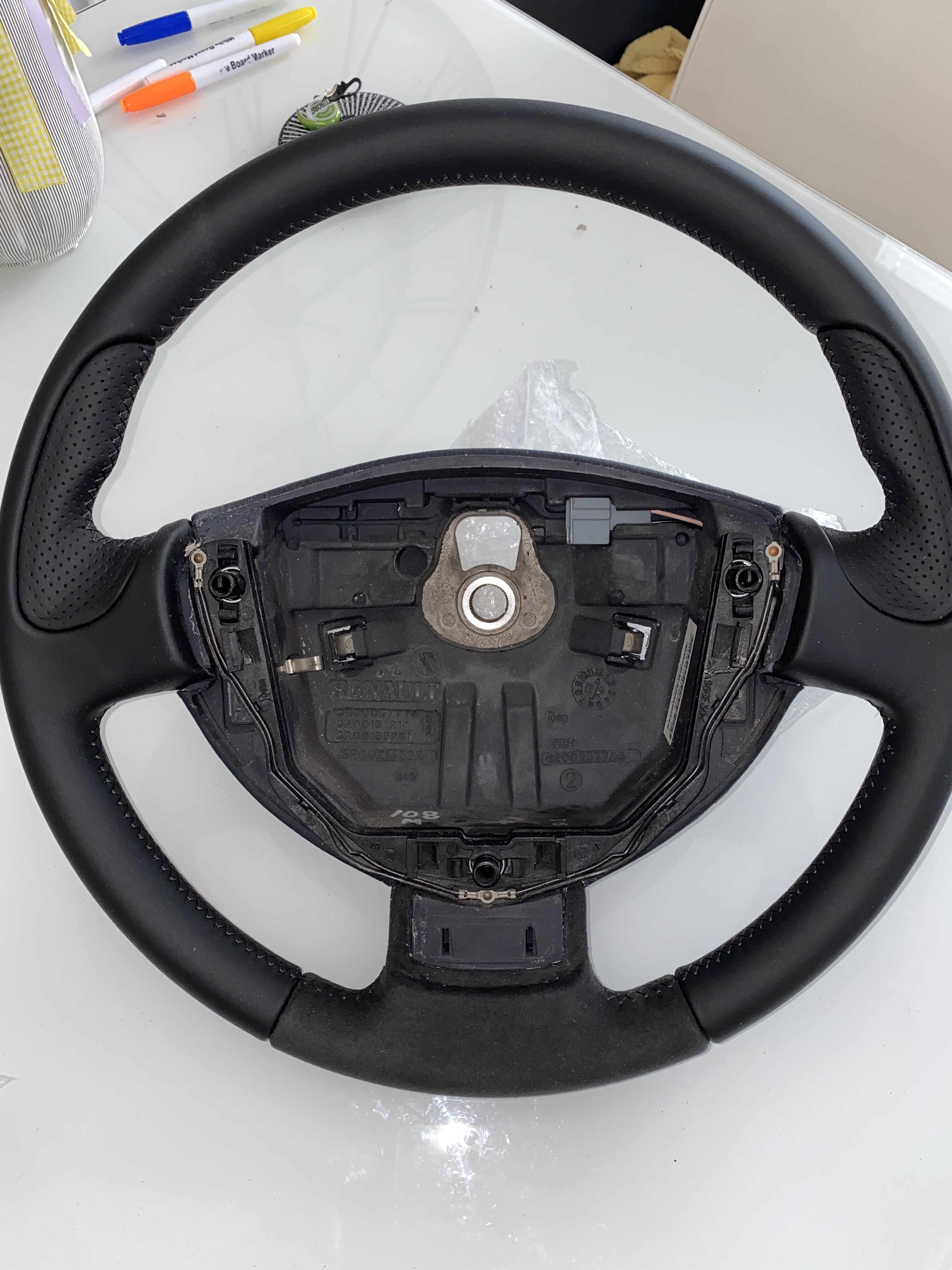

And I absolutely couldn’t resist fitting the snappy wheel, looks so good.
Out with the old....
In with the new 😎

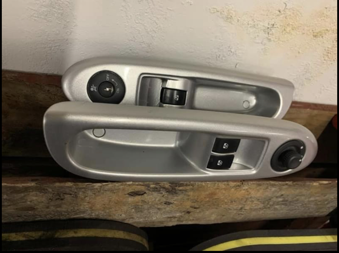

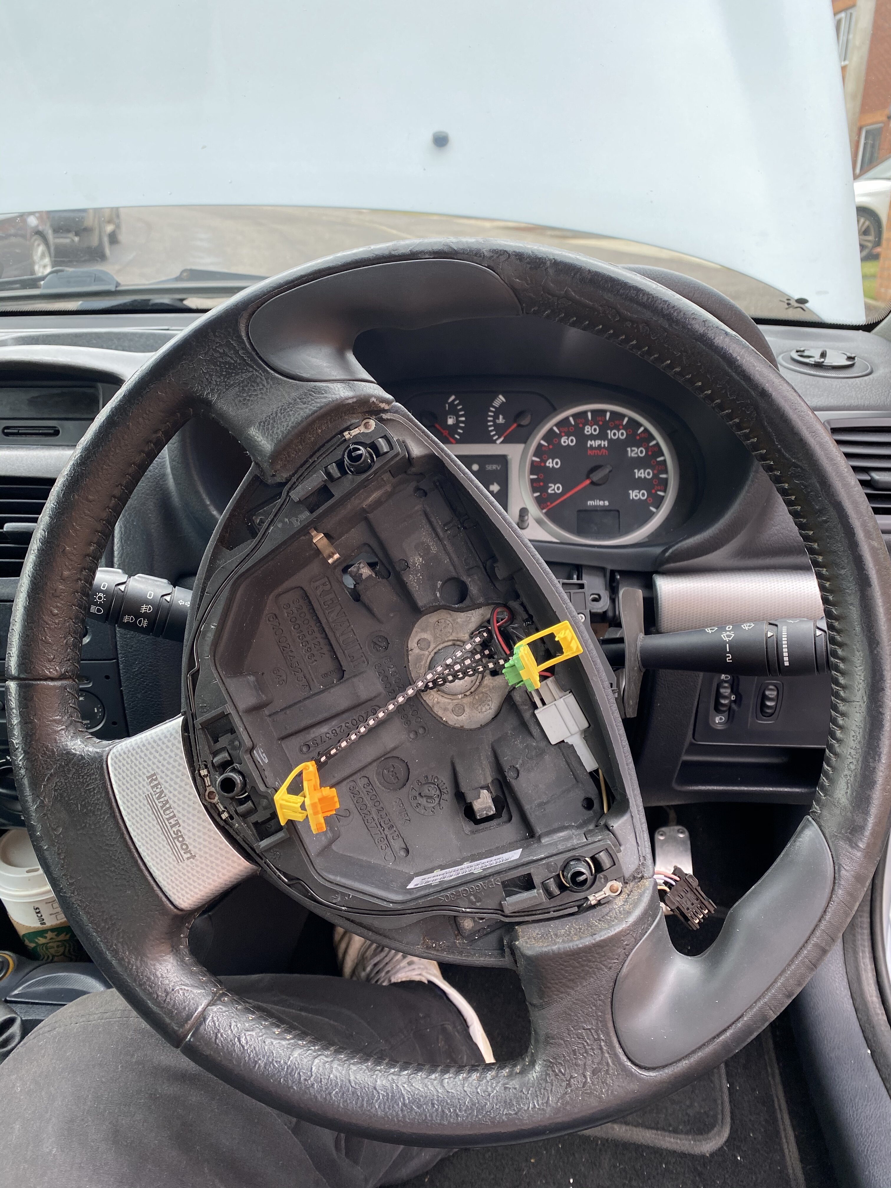

I also disconnected the door pulls and started removing the sticky stuff and I learned 2 things. Number 1) It does come off with a lot of effort and a little bit of GTR. Number 2) I don’t like scrubbing that hard.So instead I bought a set that’s been painted titanium.

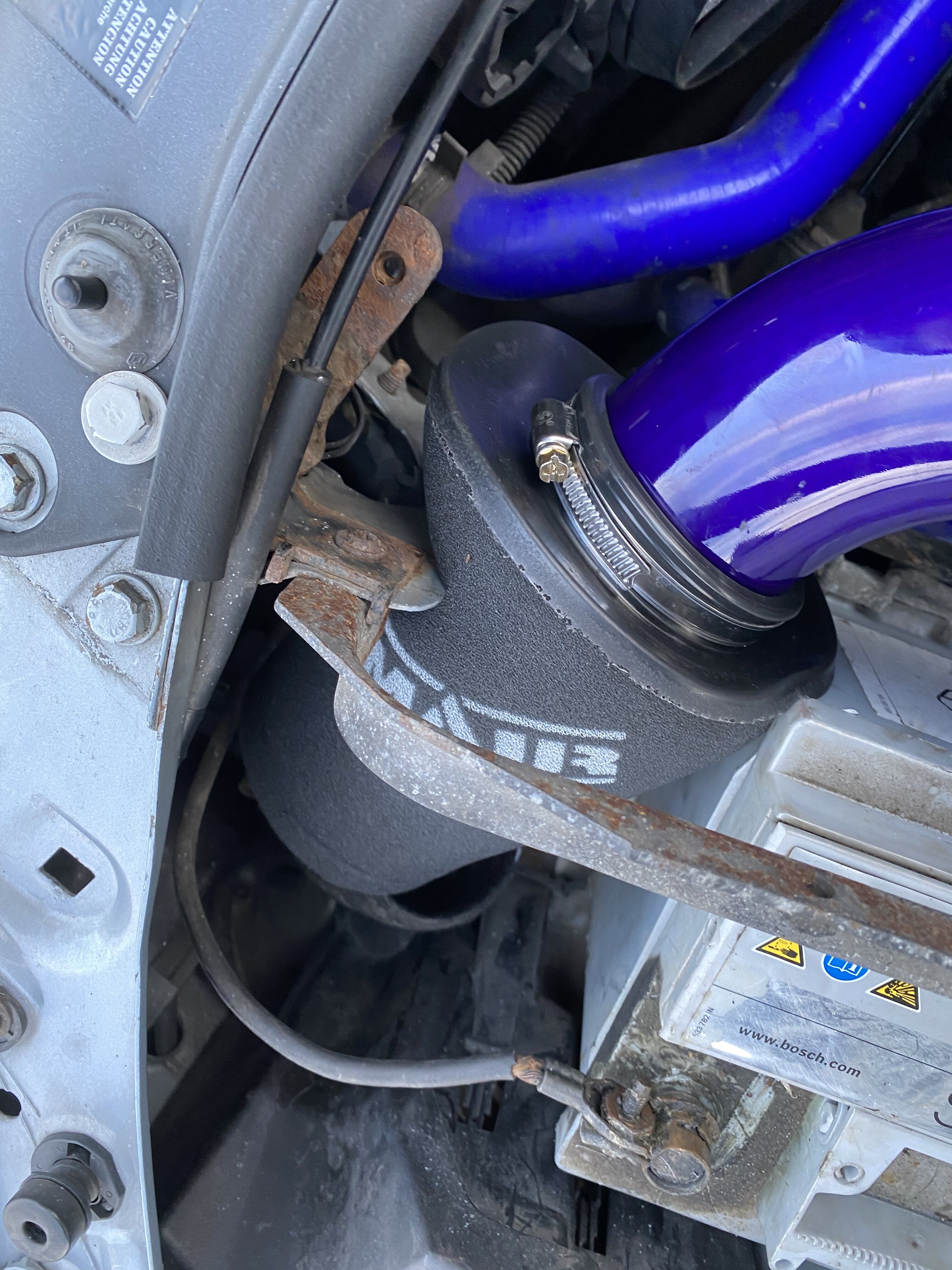

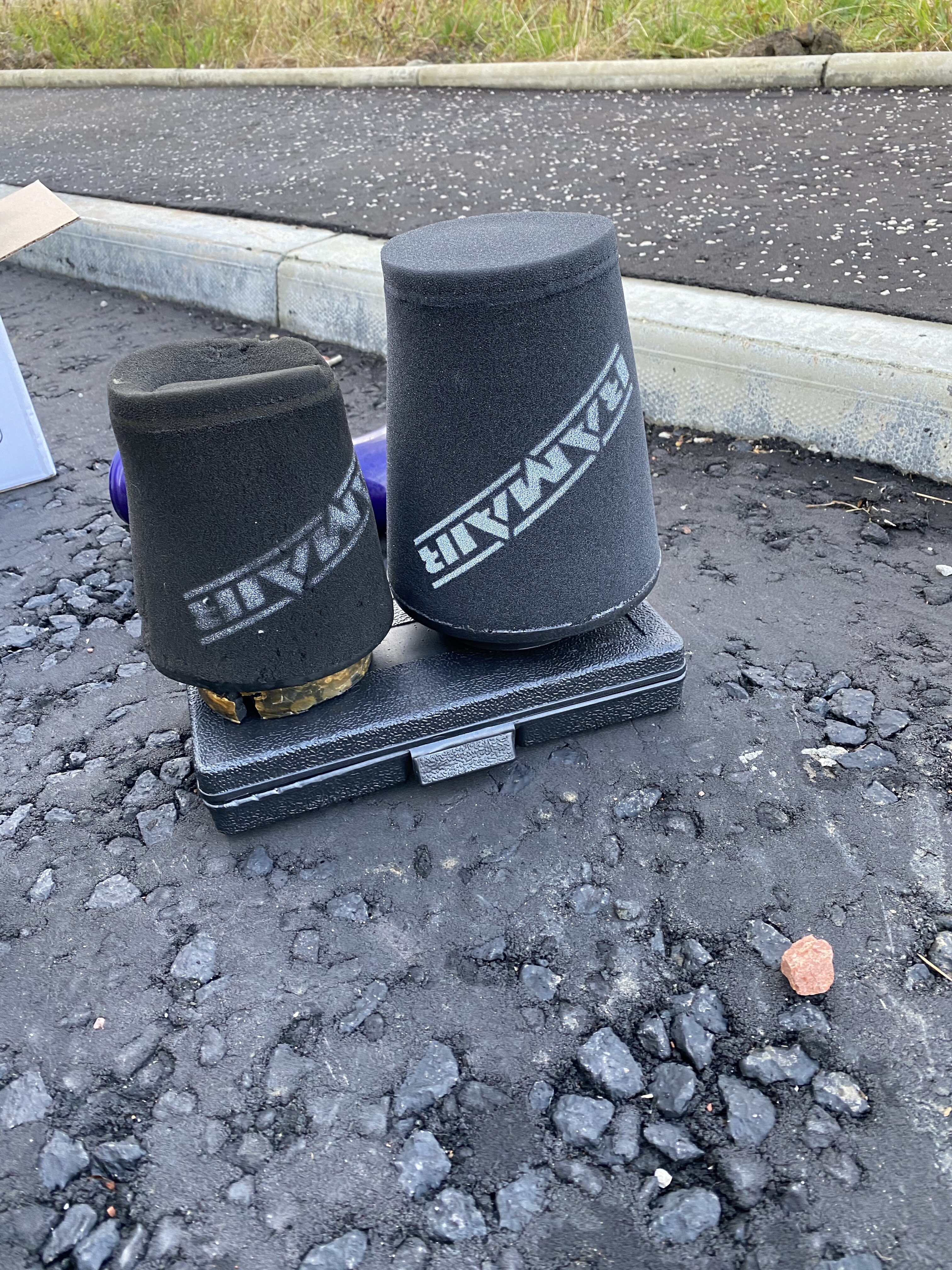

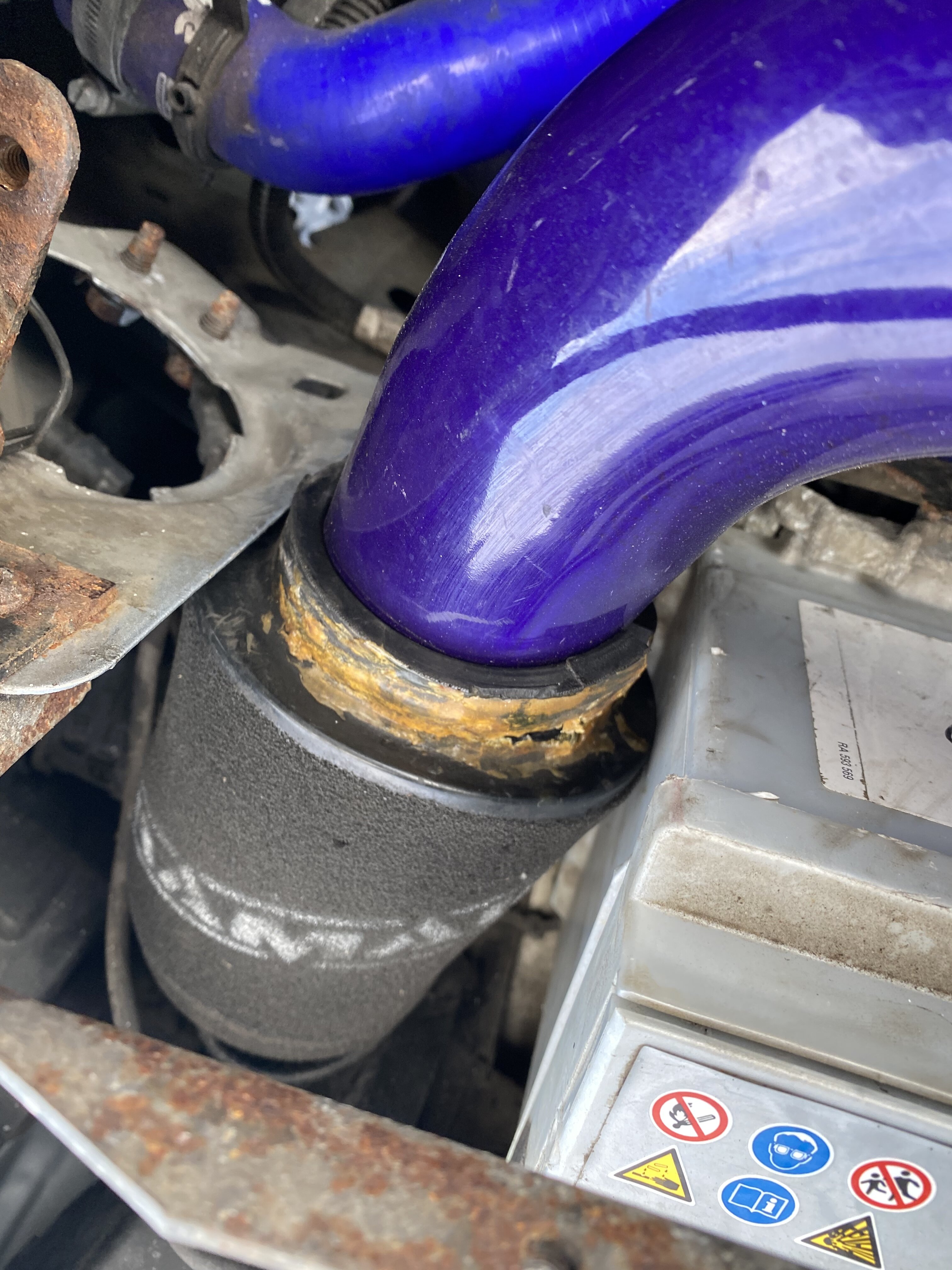

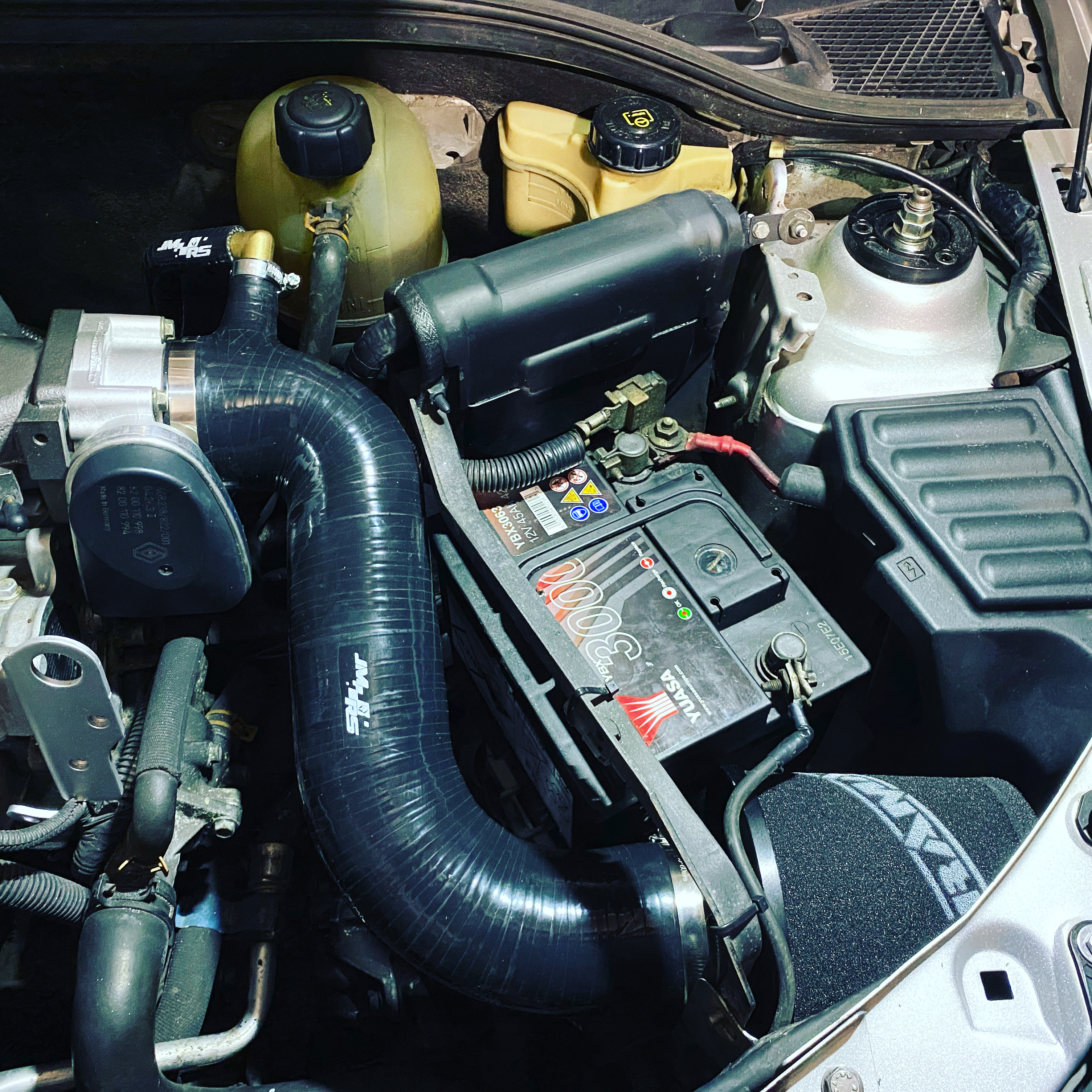

Got a new air filter delivered so set about tackling that and caused a bit of an issue. Number 1, I ordered a filter that’s way too big 😂😂
So that’s all squashed in there in the mean time till I order a new one lol.
After fitting the filter though the car wouldn’t start, cranking over for a second or 2 then just cutting out. Few recommendations to check the crankshaft sensor but there’s no chance I knocked that while fitting a filter, it’s miles away. Anyway, took the intake off, shoogled a few wires and it fired up straight away. Will investigate more at the weekend.
Yip, sounds like a Clio!
When I bought my Cup, it had an induction kit similar to what you have and thankfully the original airbox was in the boot. I’ve put the Airbox back on and sold the induction kit.
If i was to go for an induction kit again, it would definitely be a KTec. My brother has one on his 182 and there are no fitting issues. Maybe not the cheapest but it’s been properly designed.

I have fitted the JMRS kit which is similar to the Ktec but much, much cheaper. I’m willing to guess the issues you are having will be the big white plug beneath the fuse box worth removing it all and giving the connectors a good clean.
  Focus ST
Yeah if it was me I would have the Ktec one but this was on when I got the car! So will just be keeping it, albeit with the correct filter size.
I don’t like the sound of something called “the white plug of death” lol. To be fair it doesn’t look that tidy under the bonnet, so need to have a good clean at the weekend.

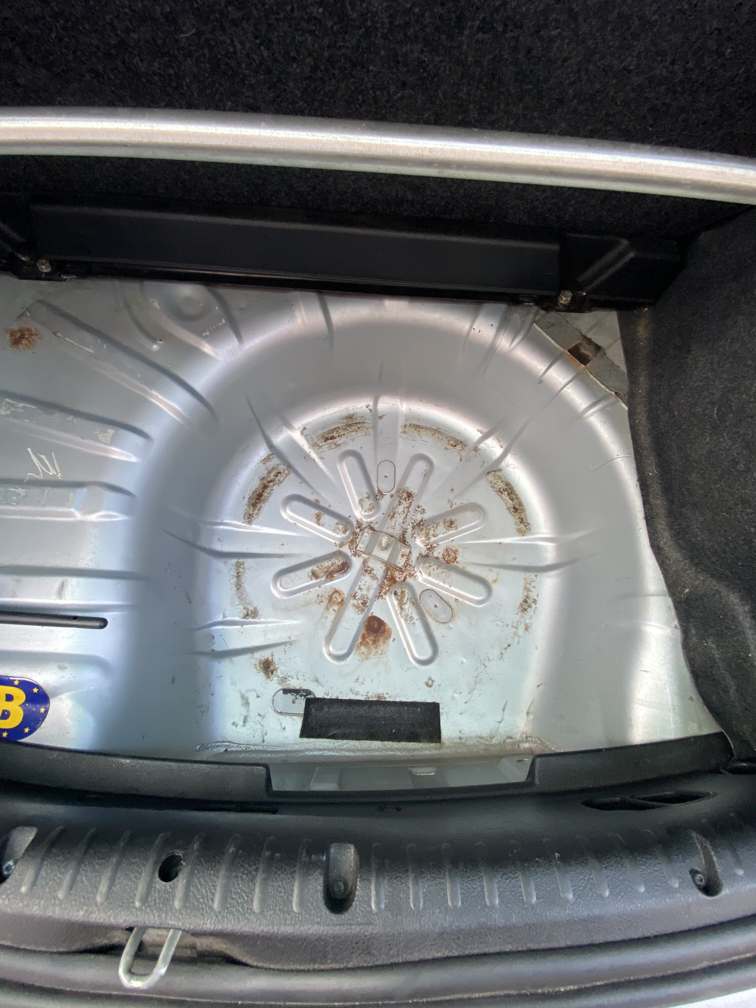

Also sealed the grommets in the boot and there is still water getting in. Ideas ? The grommets are water tight cause the carpets behind them aren’t wet anymore so it’s coming from somewhere else.
Did you look at the back lights ? I think they are known to let water in if the seals have perished.

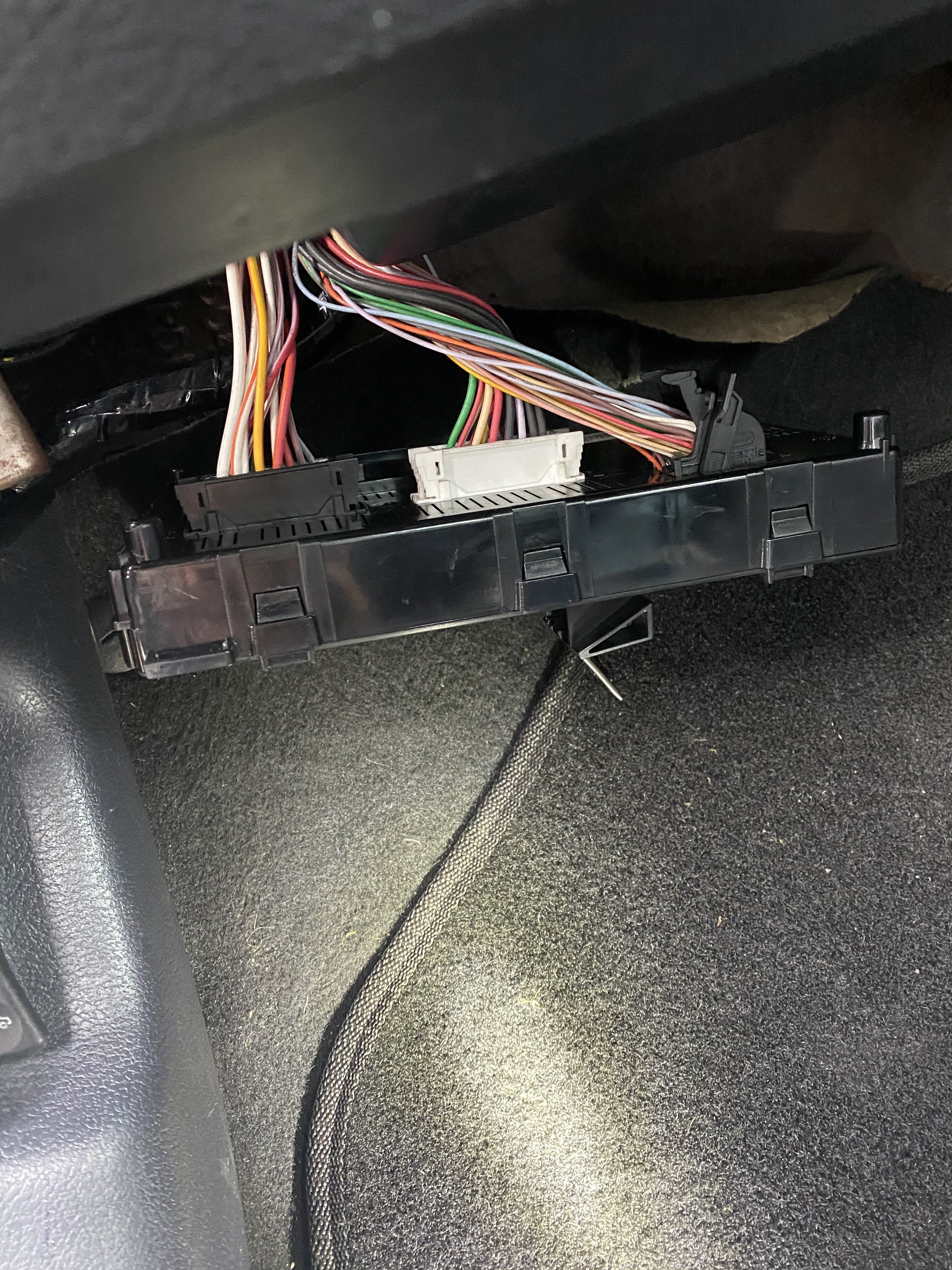

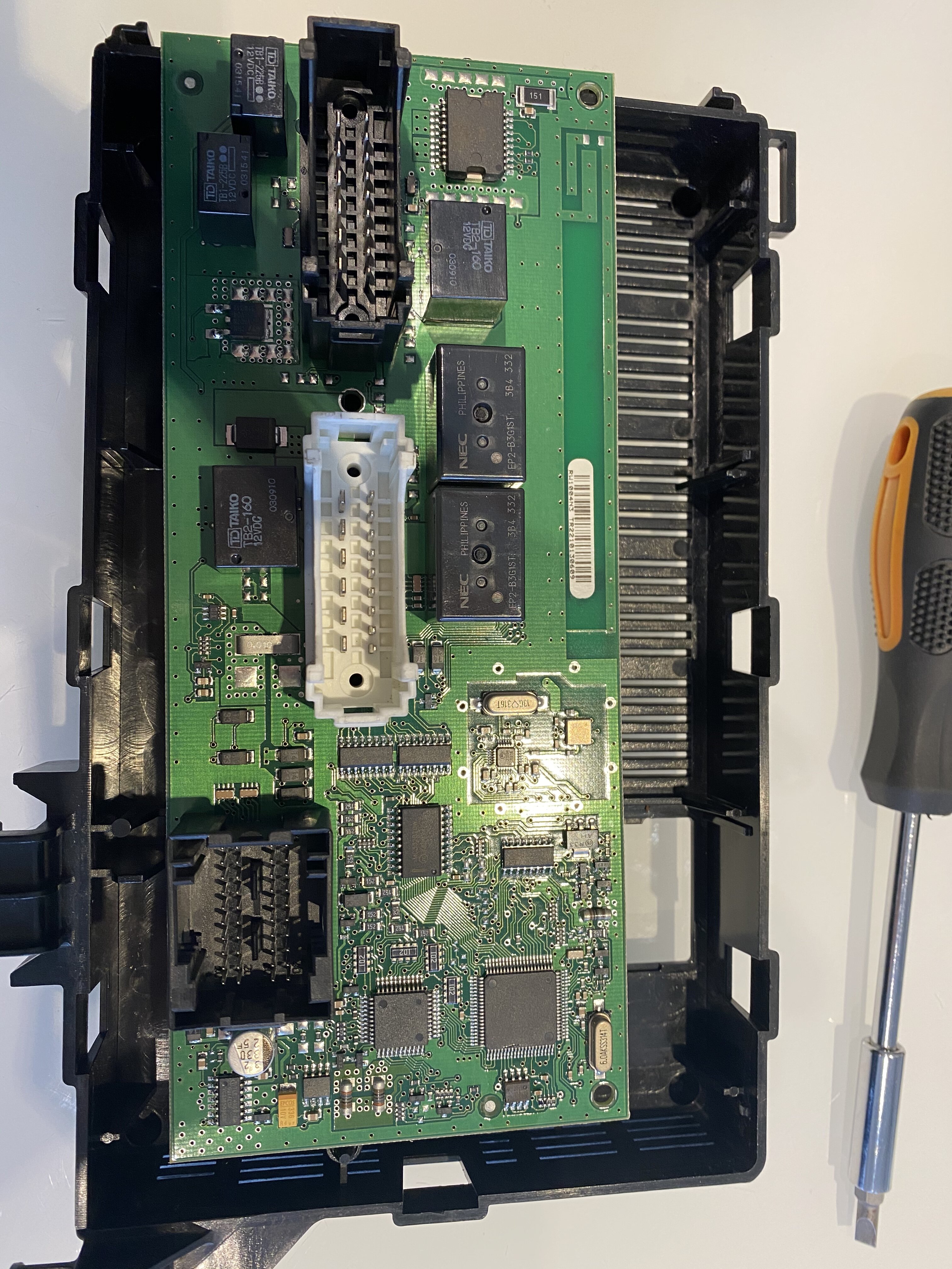

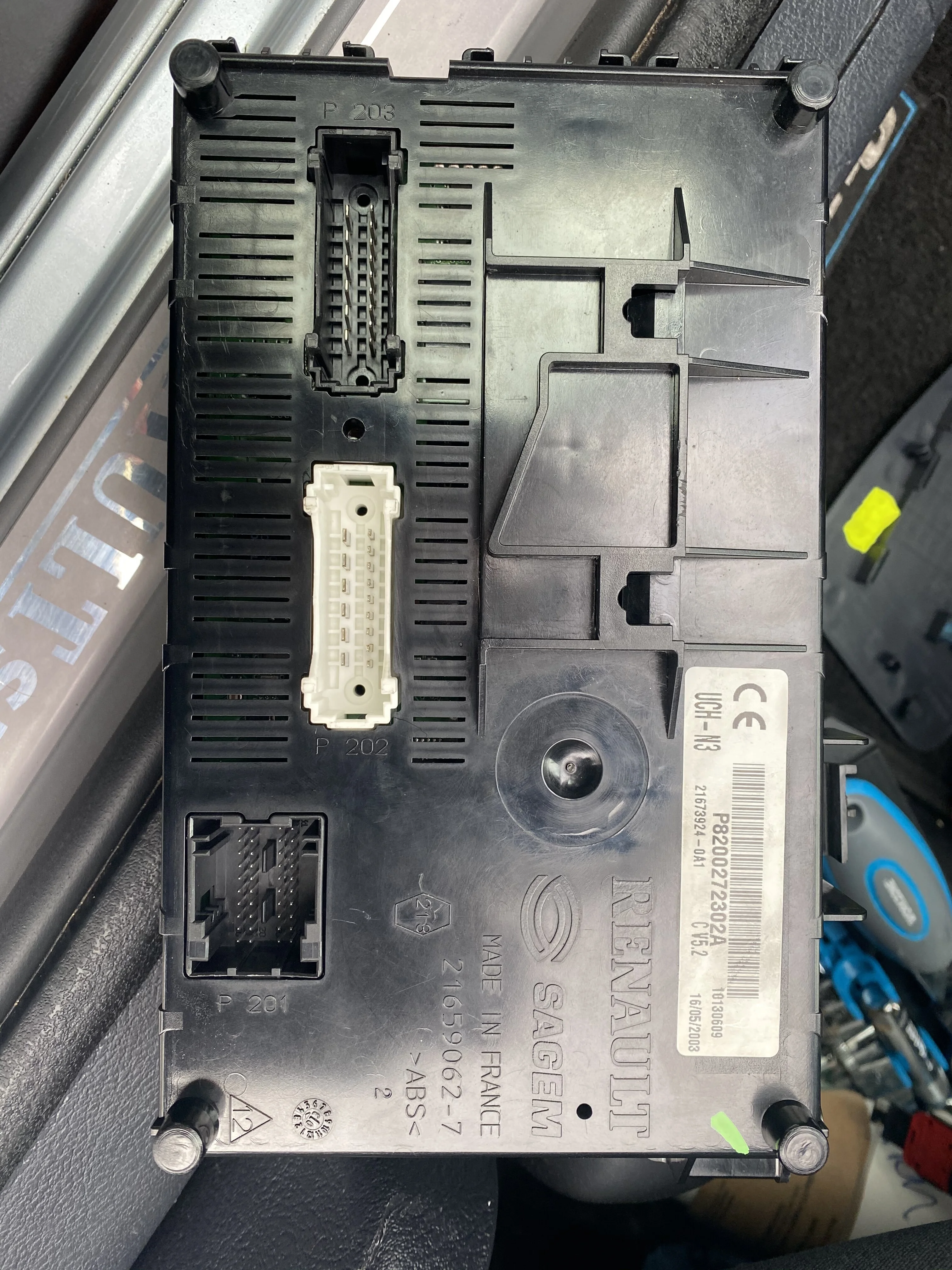

Ok so I’m having a little bit of electrical trouble and am not too sure where to go.
Key fobs won’t unlock the car. When I go in via passenger side, the alarm goes off. Only way to get it off is to DC battery / wait it out.
Car starts. No immobiliser issues. Dash lights all work etc
Lock button on the hazard panel doesn’t do anything, hazard lights don’t work, wipers / indicators etc all don’t work.
All of the above begins to work again after the battery is DC and reconnected or after the central locking fuse is removed and replaced. Although the issue kicks in again after a few minutes.
So far I’ve tested the battery and it’s all good.Terminals / connections have all been cleaned. Checked the negative earth and all is well. All fuses have been removed and checked and put back in.
Any ideas ?
RustyMojo
Have you checked the big white connector at the bottom of the fuse box like I suggested? It’s definitely worth removing, cleaning the pins and refitting. Also have you lifted the cup holder/ash try out. That’s where the UCH is make sure it’s not had a can of coke dumped on it and that there is nothing loose

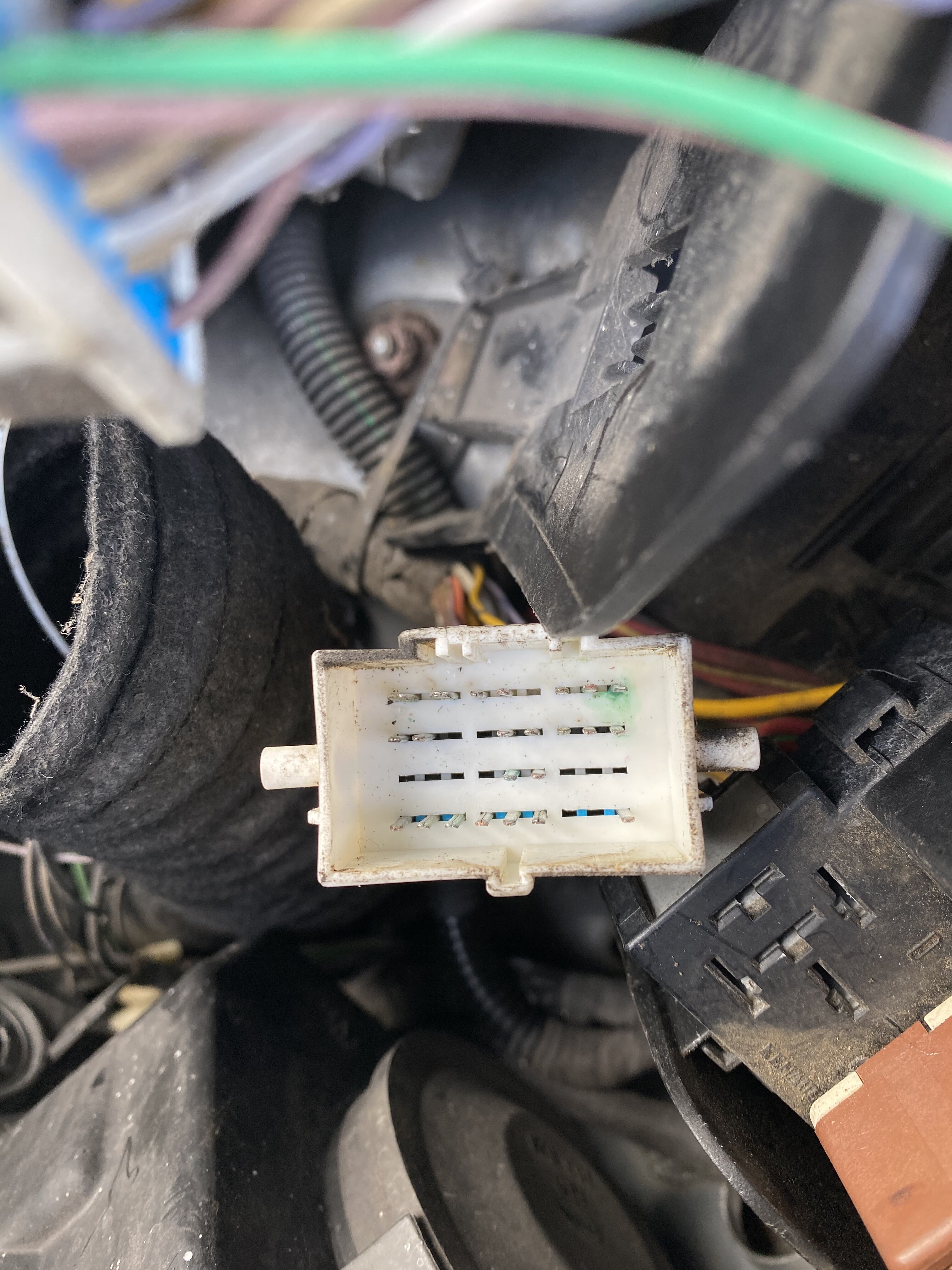

Thanks for the replies guys. I did look at the white plug of death but looks relatively undisturbed. Will get a closer look today and give it a clean etc.

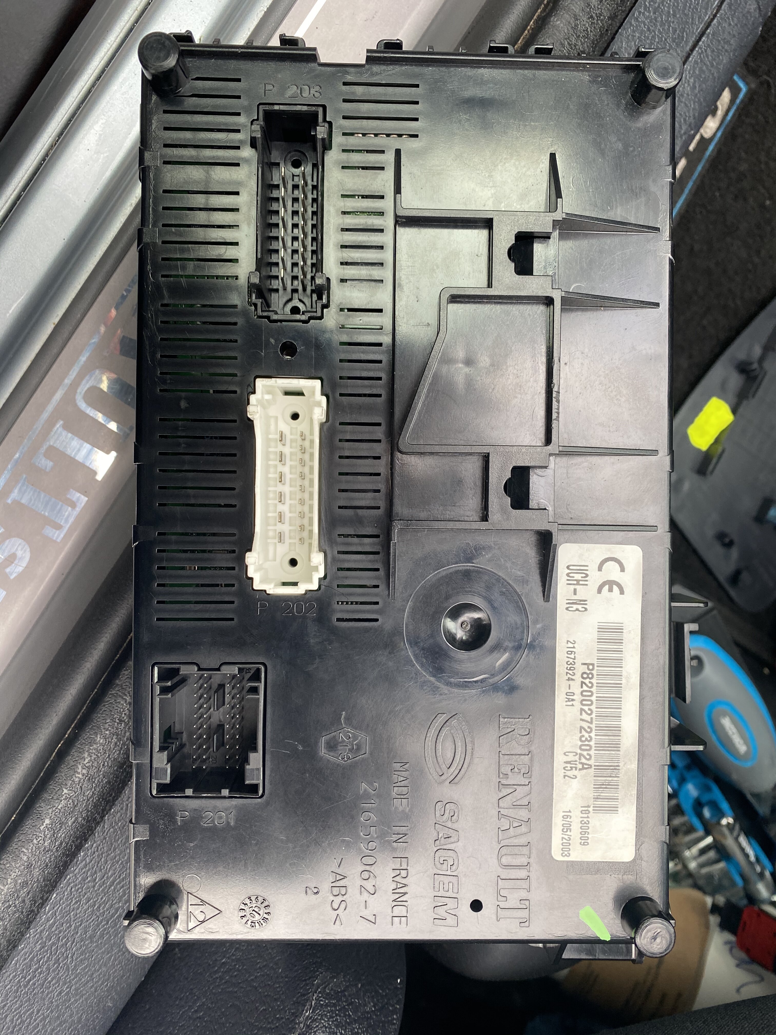

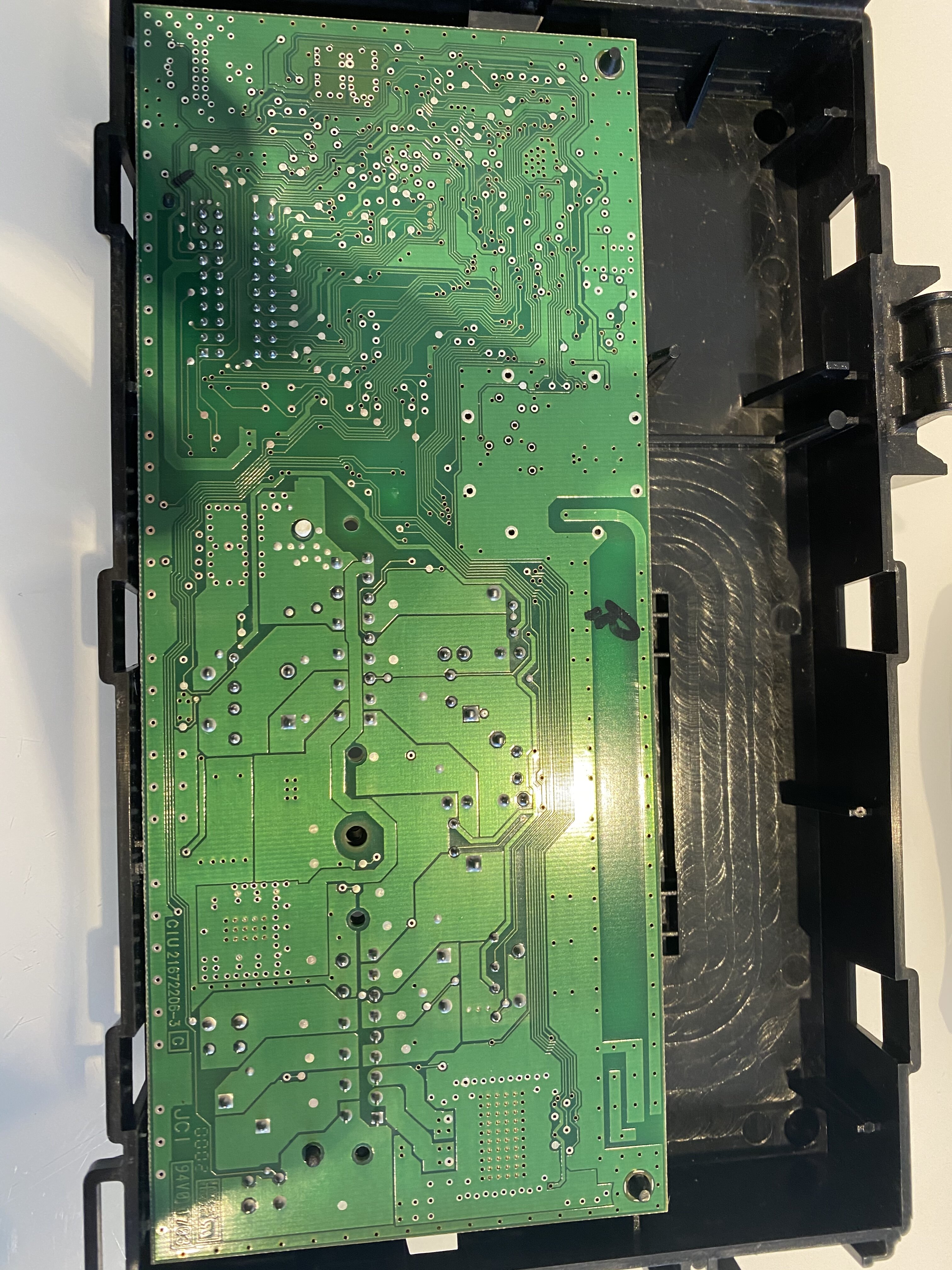

UCH out and all checked, doesn’t look damaged in any way...
On to further inspect the engine bay big white plug of death it would seem. I’m too hungover for this business.
  Focus ST
Right OK, so slight corrosion on one of the pins in the big white plug of death. Cleaned with contact cleaner and all tied back up.
I *think* we have progress. Hazard lights are coming on, keys are working, lock button is working. And I’ve just noticed as well that I’m getting a beeping when the lights are on and engine is off / key isn’t in ignition. Don’t think it’s done that before.

Great news, if you can try and get some wire wool on the pins to remove the corrosion. Then hammer again with contact cleaner that definitely looks like we suspected the culprit
