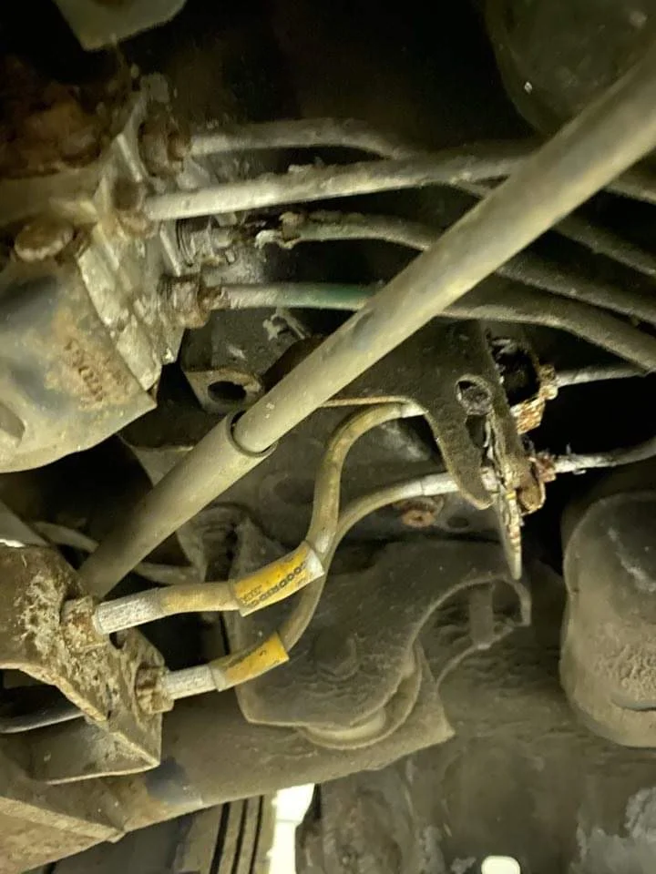

Ok so while waiting on an ECU / UCH kit from @Mbeau (thanks again) I asked @David Stuart to put it up on the ramps and have a look to see if anything needed done.
It’s mostly good apart from some worse for wear brake pipes before the rear axle -
Decided just to go ahead and sort this too while it’s up in the air so David has removed all 4 brake pipes and made up 4 new ones. Two running the length of the car and two joining the rear compensator to the rear axel. Then bled the system.
Should have it up and running for the weekend and we’ll be back on track :)

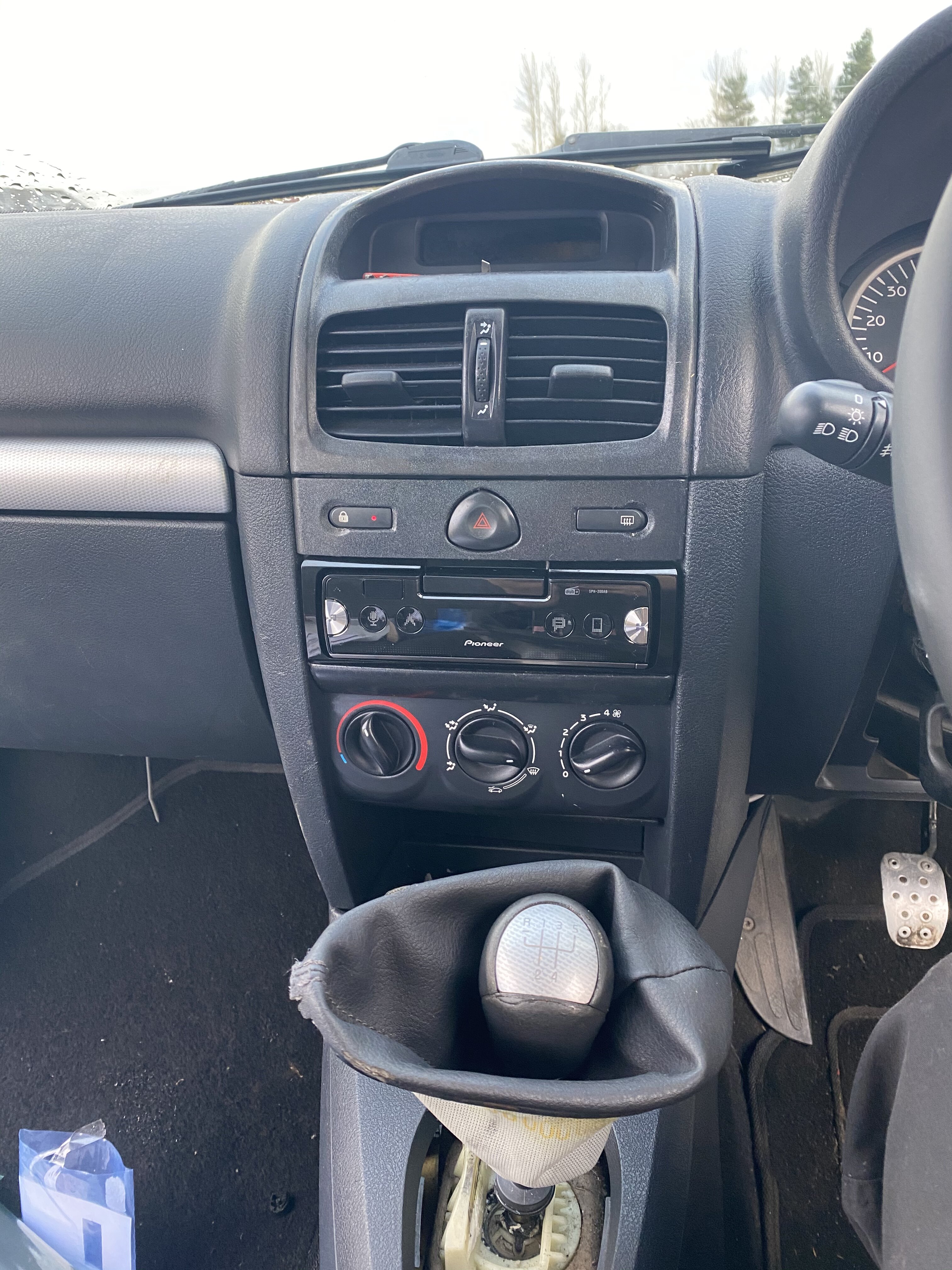

Quick update, put everything back together at the weekend there, dash etc all back on. Need a replacement gear gator / gaiter 🤔as the clips have snapped.
Fitted a new head unit, a pioneer SPHDA20, it gets good reviews but I’m a bit disappointed with the app, feels like it’s been built as a project by kids at school. Car doesn’t get driven much though so it’ll do. Front passenger speaker isn’t working either so think I’ll just replace the speakers with something, won’t be anything fancy. Will fit tweeters as well as someone has previously cut into the mesh on the dash.
Also I was looking at getting custom door bullets and interior trim (dash pieces and steering wheel insert) and got a quote of £170 to paint them. Seems excessive ? Or am I underestimating the work ? In any case, will give it a go myself when I have a spare minute.
Main thing for now is a quick service, oil and filter, pollen filter and spark plugs will be getting done in the next couple weeks. I haven’t actually looked at the plugs and they may not need it, but will do anyway for peace of mind.
Have only driven it 20 miles since the new ECU/UCH but so far it’s been spot on with no drama at all, touch wood. Hopefully that’s it from now on.

You can put self tappers into the gaiter to replace the clips. Works as good as new.
