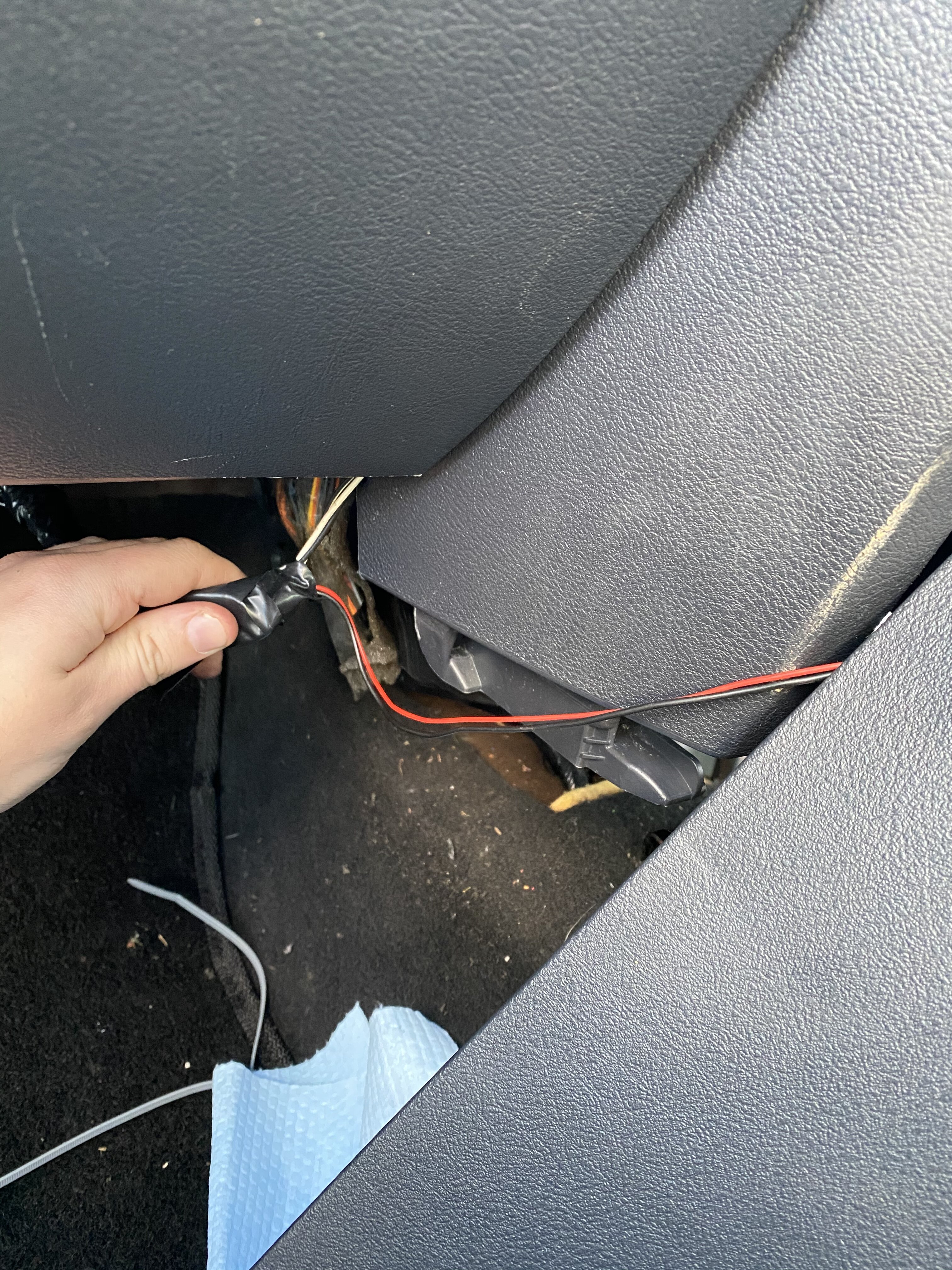

Side note, found this on my travels. Any ideas ?

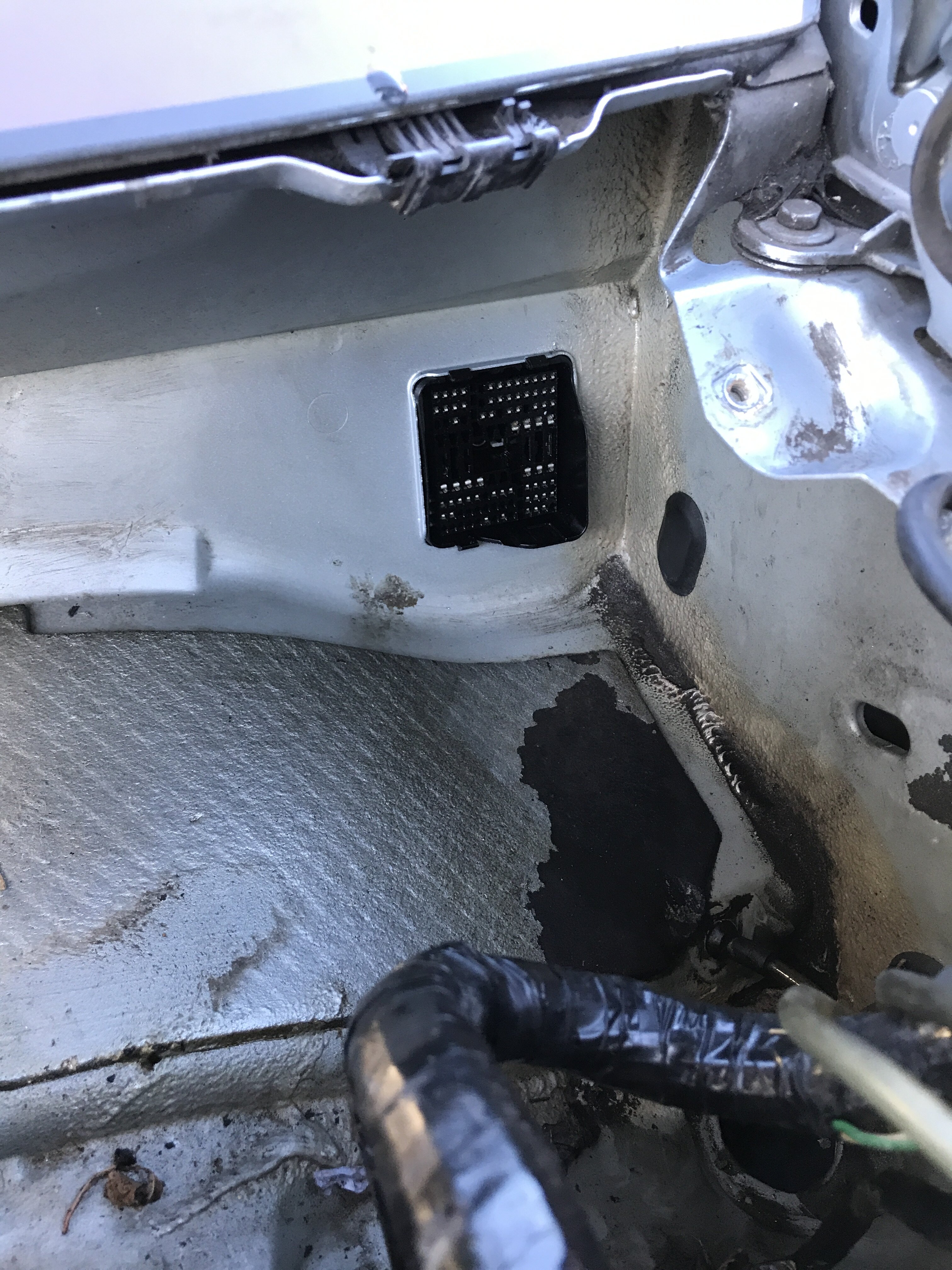

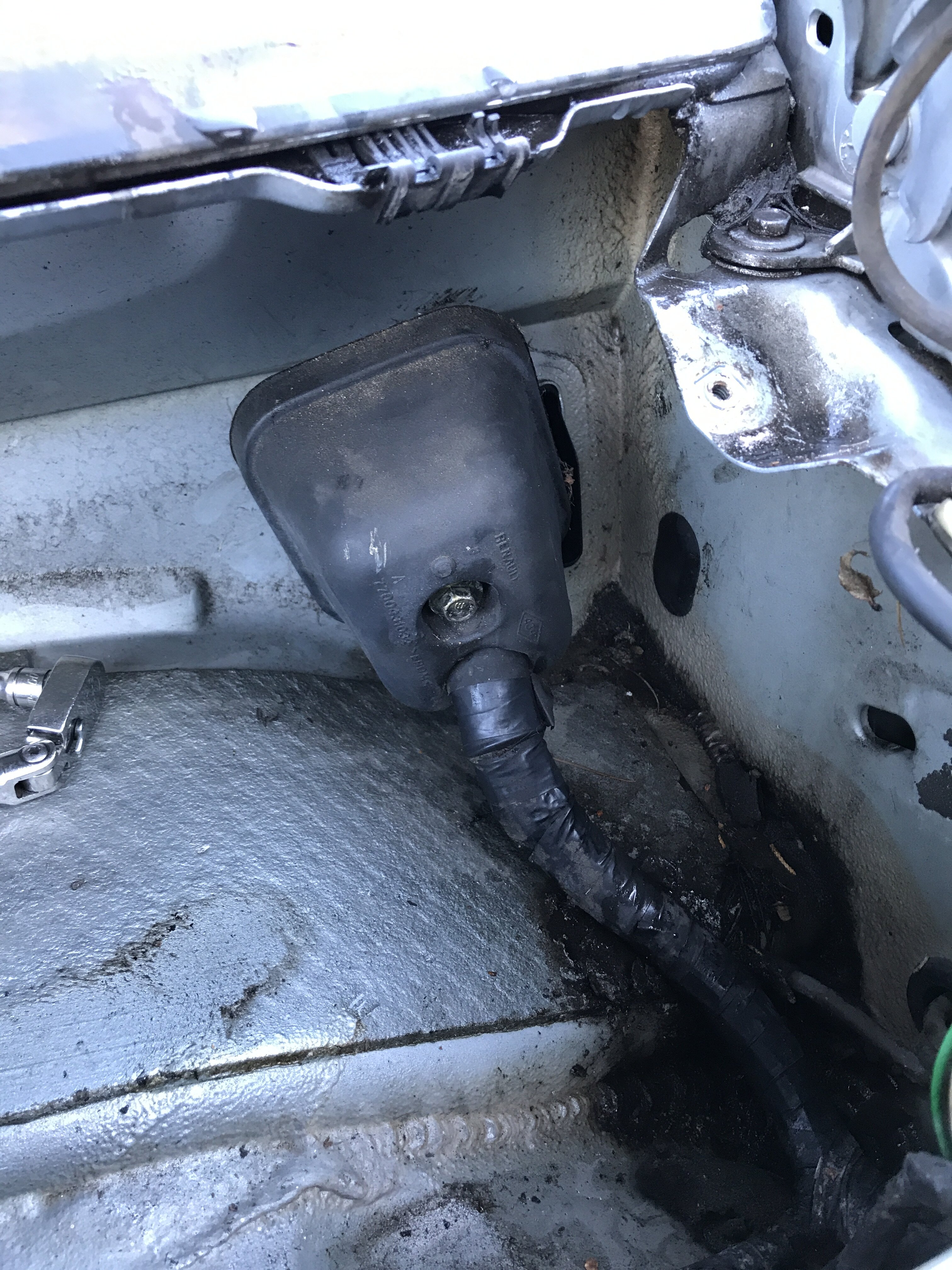

Also, while you’re at the electrical connector checking have a look at the loom plug on the bulkhead.
Gotta be a dodgy connection somewhere going off the symptoms.
My car was all fine until the weekend and I started having electrical issues (not alarm though), after the non stop rain. Thought it must be something to do with the wet weather as it’s been relentless for couple of weeks.
I went through all the usual areas but there’s also a main loom plug on the bulkhead under the washer bottle. Had a look at mine today and it had a load of water and a couple of slightly manky pins.
I think any clio new to someone I’d recommend to strip the fuses and relays out the engine bay fuse box, take time to clean every pin and the female sockets, same with the white plug in that box (I’ve had issues with this before and thought I’d done a decent enough job but going over the white plug again sorted a reoccurring issue) remove the bulkhead plug and clean that up, remove all the fuses inside the car on dash end and clean all those up (these also oxidise up) and then I’d replace the earth straps.
Even if they’re ok now they’ll prob s**t out in the near future if all this hasn’t been done before.

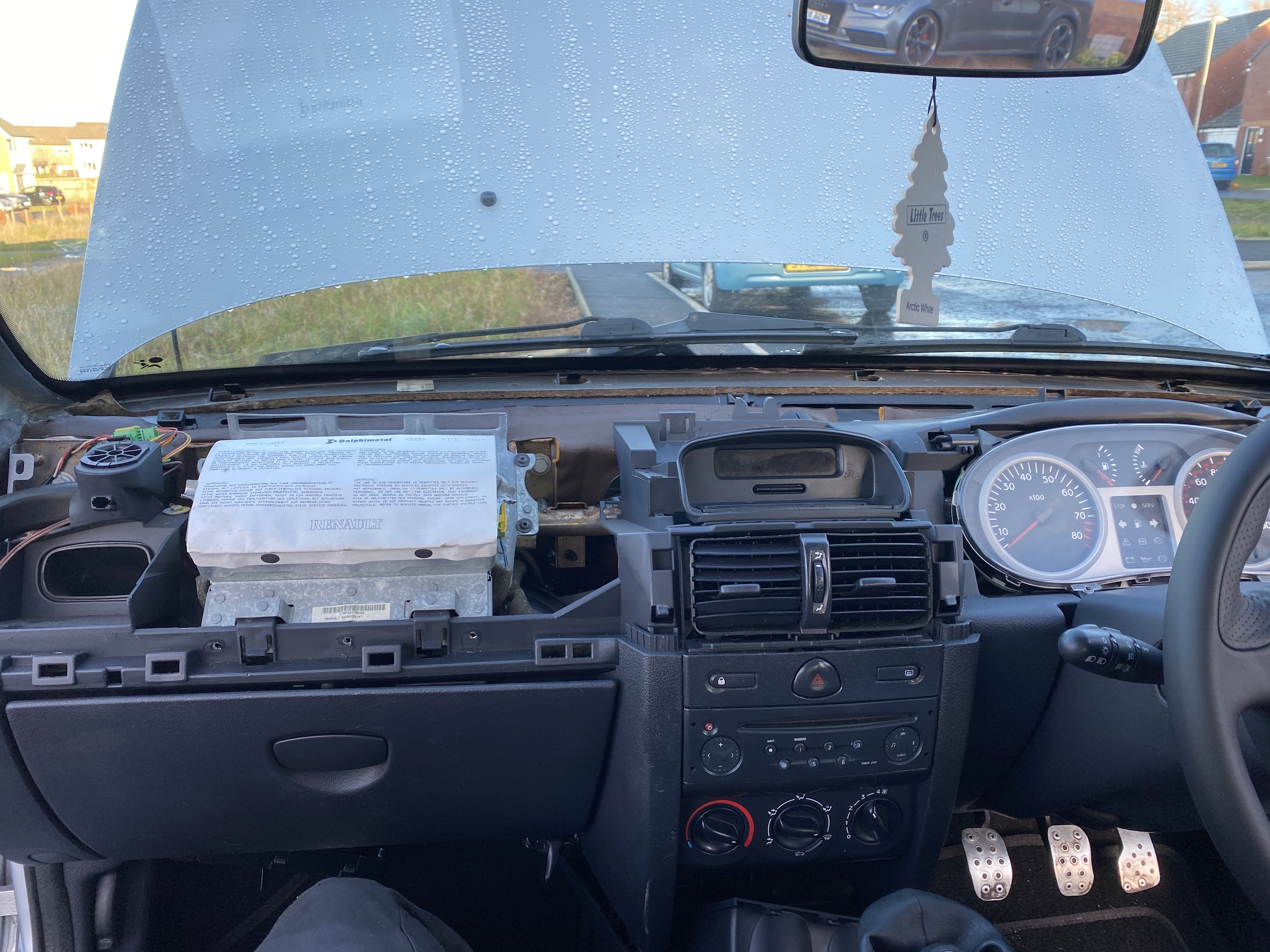

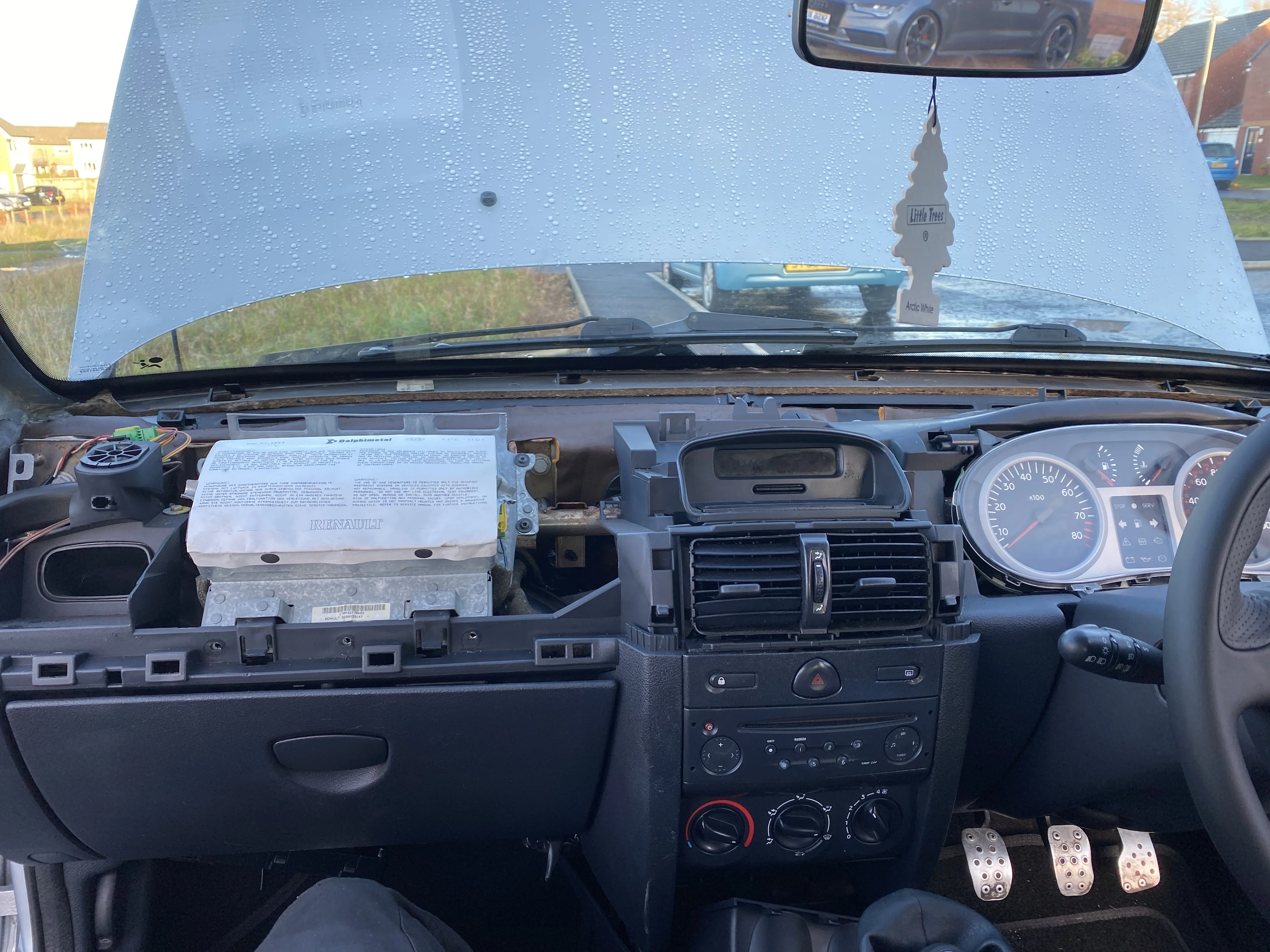

Ok so top dash was off today to check those earth straps.
Fortunately, or unfortunately, they are all sound.

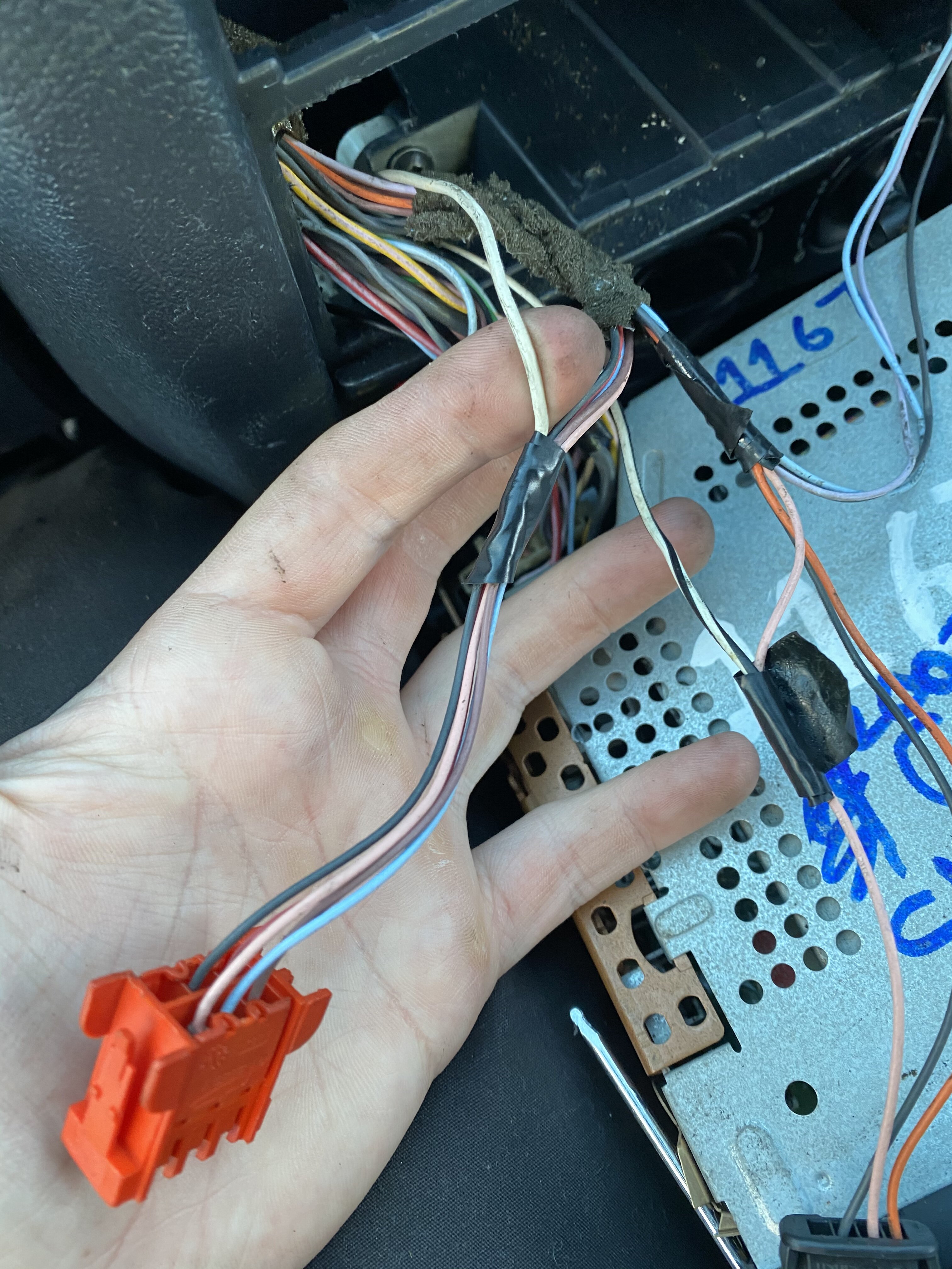

I found a couple questionable bits and bobs though, which seems to be a
Couple of wires spliced into the central lock switch and the window heater Switch. They look to initiate from the loom under the glove box.

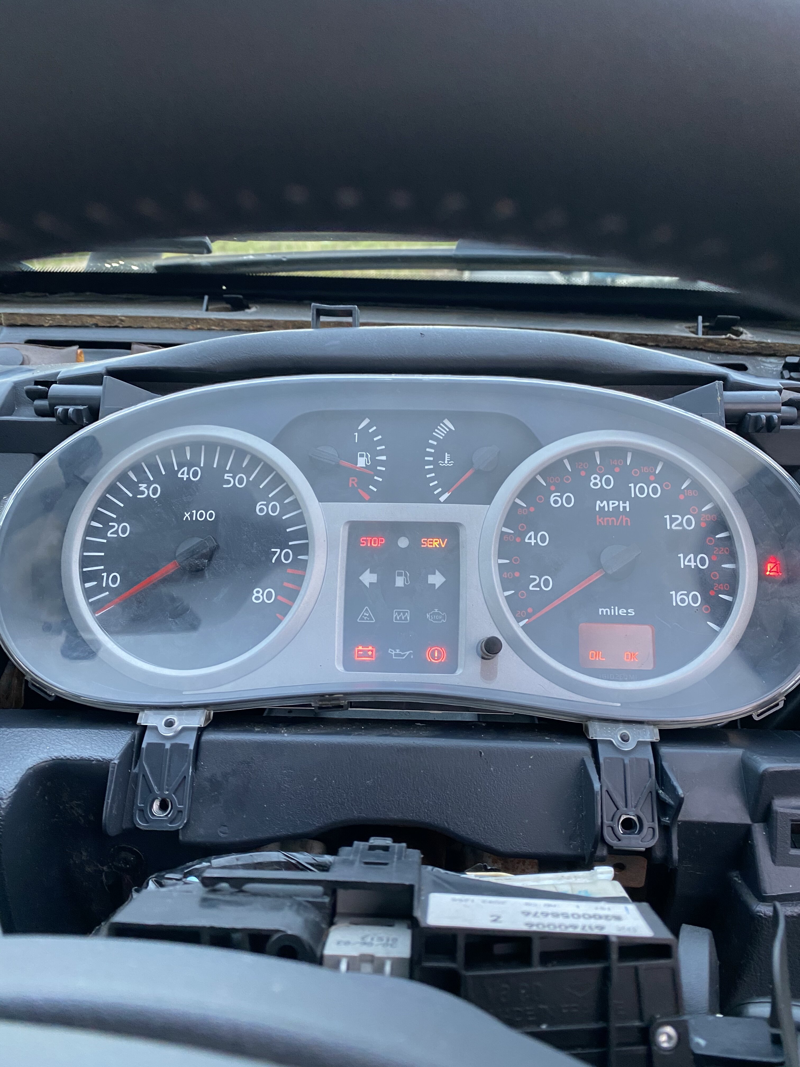

I’ve had the SERV light on since changing my steering wheel and thought it could be a steering angle sensor. But am I right in saying they don’t even have those on 172 cups ?
Phoned my auto electrician today as well as I need to get a pro to take a look. His response was not good. He is going to take a look for me next week but he’s pretty sure I’ve already checked everything obvious so it’s going to take a proper deep dive.
Another member on here runs DRS motorsport and is very close to me so going to see if we can get a look maybe at the weekend.

You need to...
remove wipers
Remove scuttle (two Clips one either end and remove O/S part first pulling toward you as the Clips go under screen)
Remove wiper assembly (3x10mm bolts and lift bonnet right up for easy removal)
Remove washer bottle (one 10mm bolt)
Then you’ll see the plug. Undo the 10mm and pull the whole thing toward you.
Sounds like a faff but it takes 5 mins. It’s worth a look.
I’d personally make sure the fuse box plug is perfect too. Is it pushed back down into it’s recess at the bottom that keeps the plug together?
