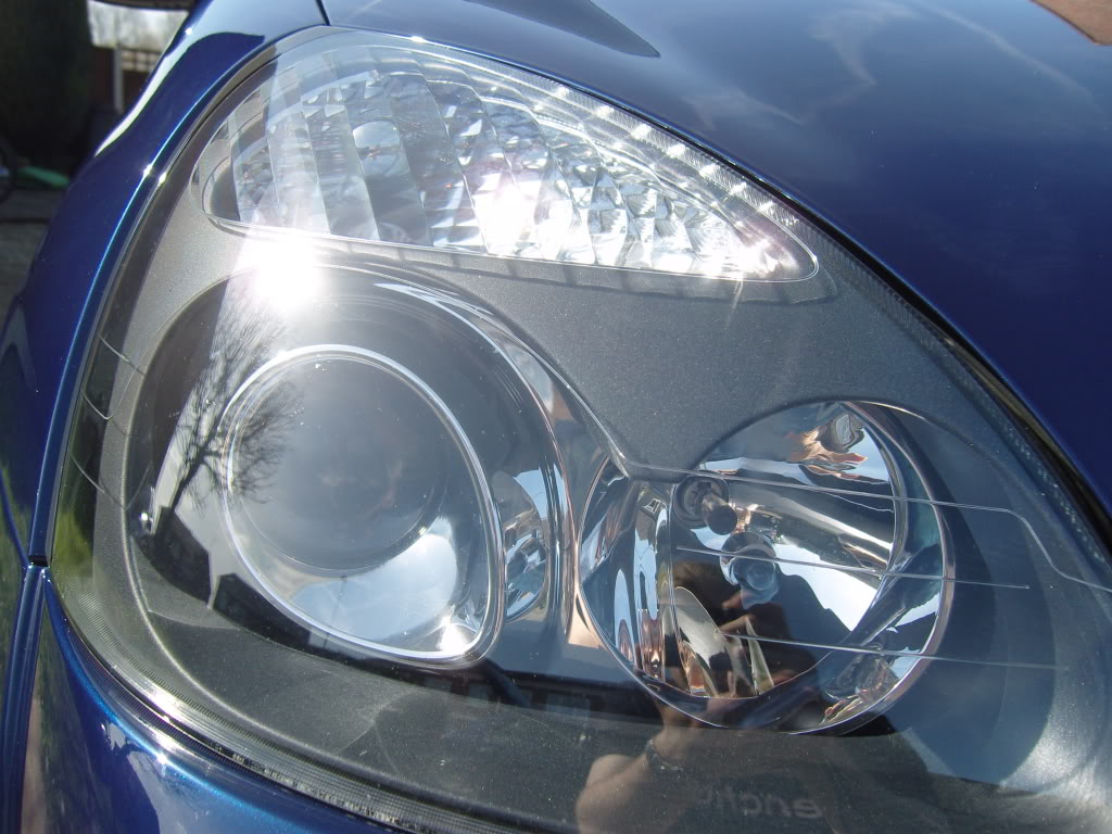

The headlights have been bugging me for a while now, so decided to wet sand them and machine polish to see what results I could get. I did pop a thread up recently, but here it is for anyone who missed it:
Before:
As you can see there is alot of UV damage, stone chips and general degradation. Arming myself with:
After some wet sanding (1000, 2000, 2500, 3000) I got a nice consistent cloud:
and a helping of some PO203S on a Menz 80mm white, followed by some PO85RE5 on a 80mm yellow, I was happy with the result:

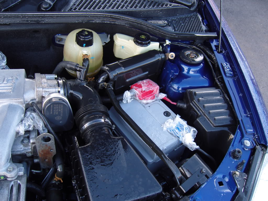

After a long hard winter (with regular cleans) the car isn't looking too bad, but under close inspection leaves alot to be desired. Next job was to tackle the engine:
After covering the necessary areas with cling film, I got to it with the Autoglym Machine Cleaner. Ive found it is the best product for this kind of job, worked in well with a brush:
After a careful soaking (regular hosepipe gun, no pressure washer):
and a nice dry using the air dryer (pic later on in the write-up) and some Kent microfibres, It came up very well:

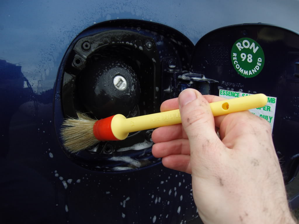

On to the filler cap with the APC:

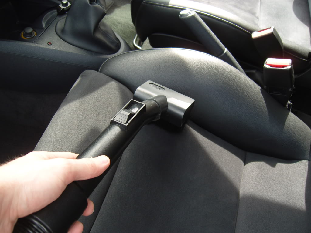

Onto the Interior, first off was to give the car a good hoovering using my Vax 6131:

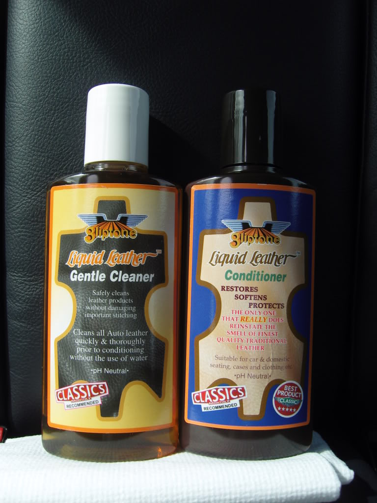

The Gliptone set was picked for the Recaro's. In my experience, this is the best product for leather.

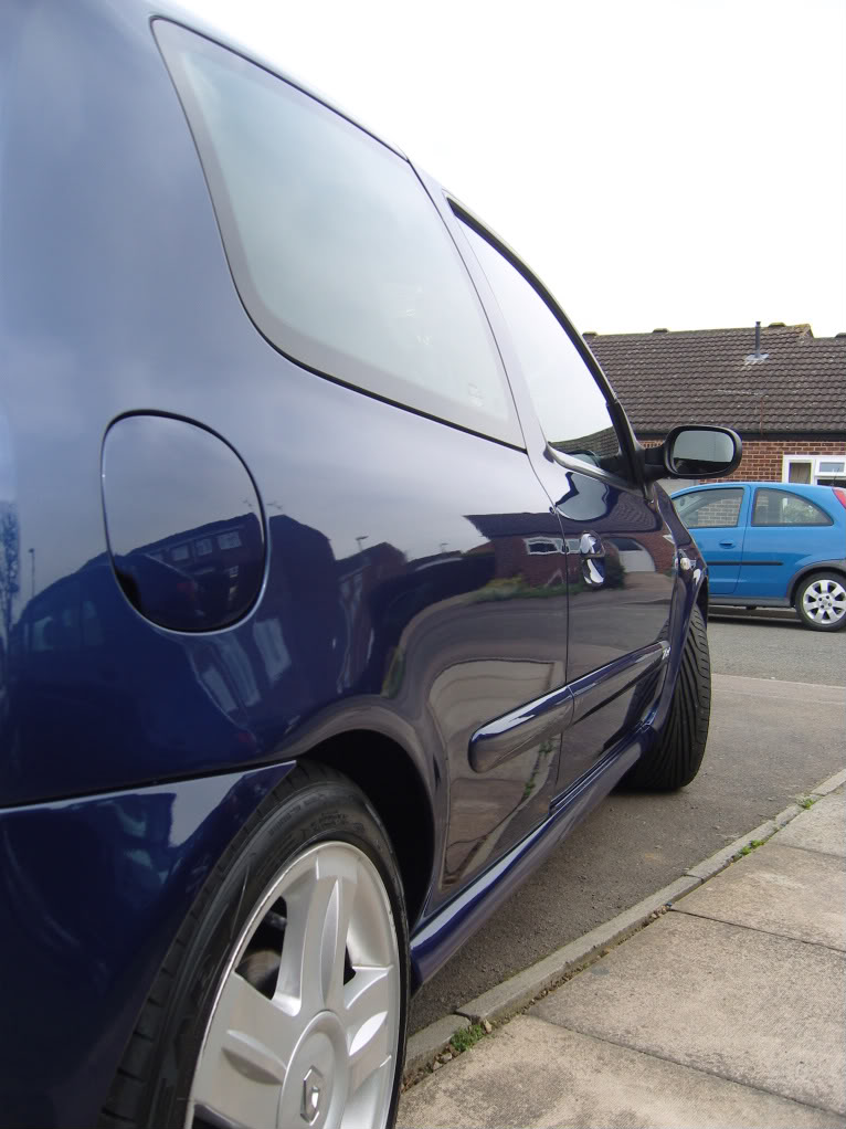

Here are some pics of the finished article, 12 hours (of detailing) after I began:

I hate to say it but the recaros arent actually real leather so you are kinda wasting your time using leather conditioner on them! ;)
SSHhhhhhhhh. It makes them smell nice. :o
