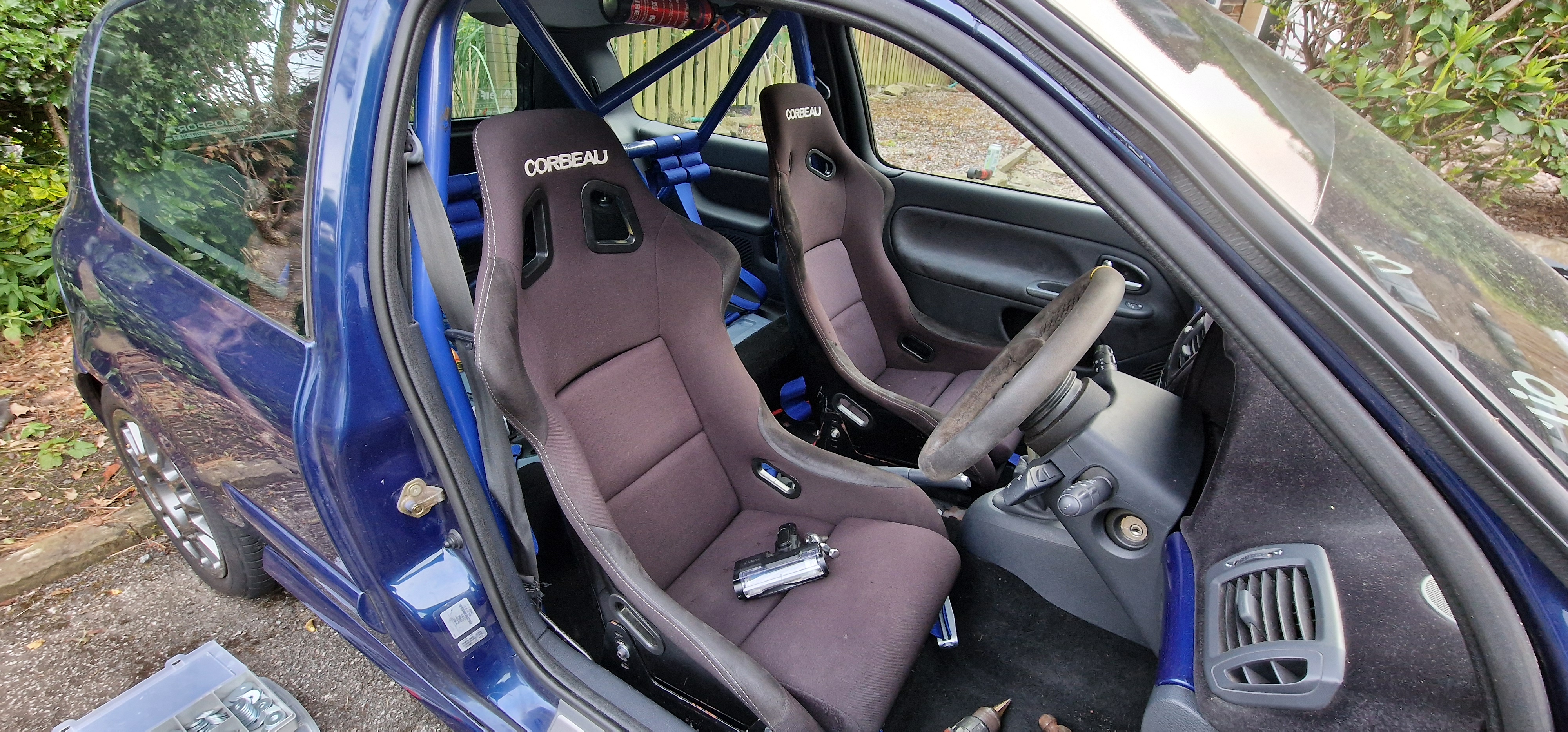

Came home last night and cracked on with fitting the drivers side bucket. Got it all hunky dory and happy with the seating position
I made the passenger one match too because it felt a lot better a bit lower down with a slight amount of rearward angle. A nice edition is that my doors shut easier now🤣

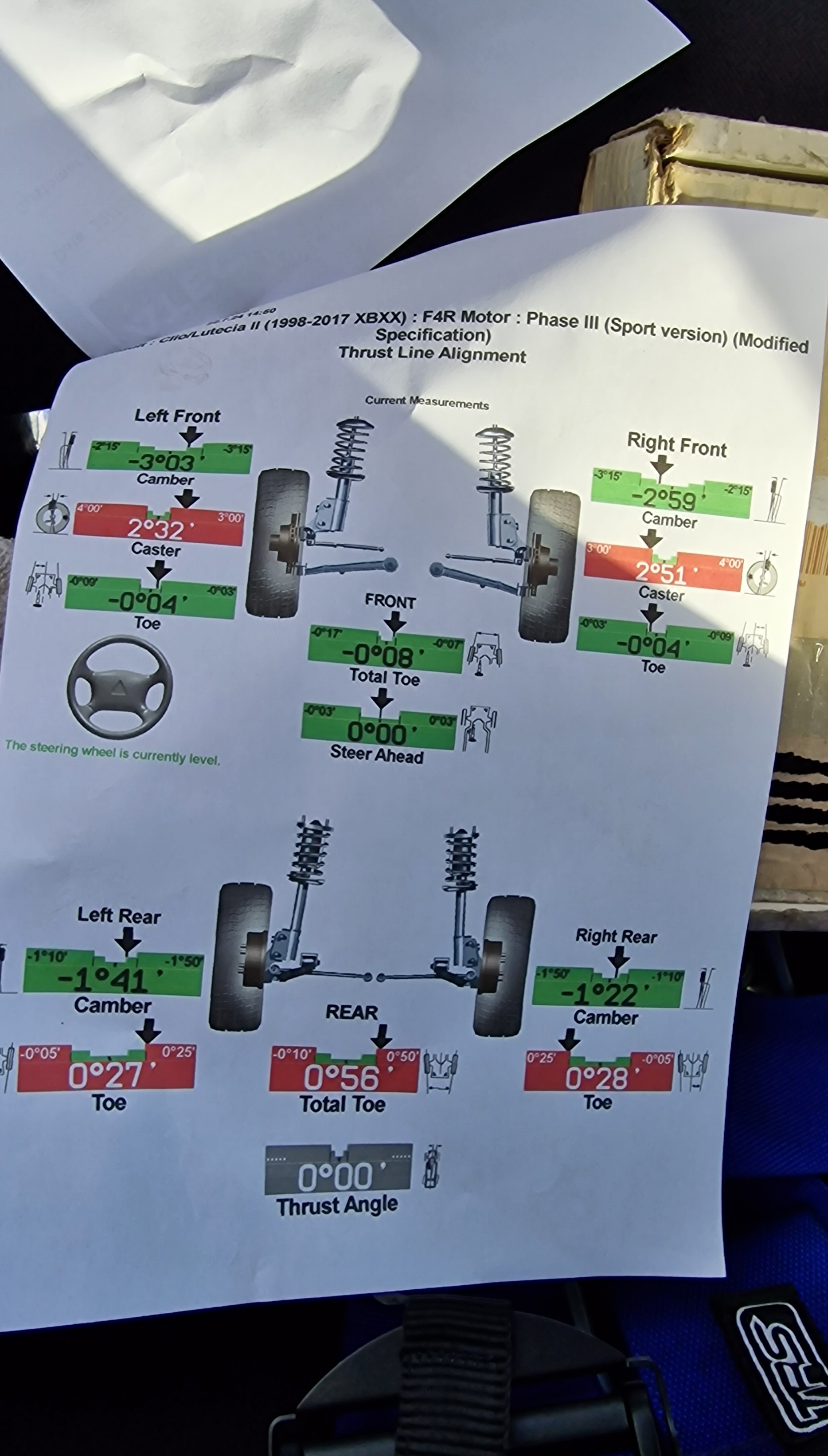

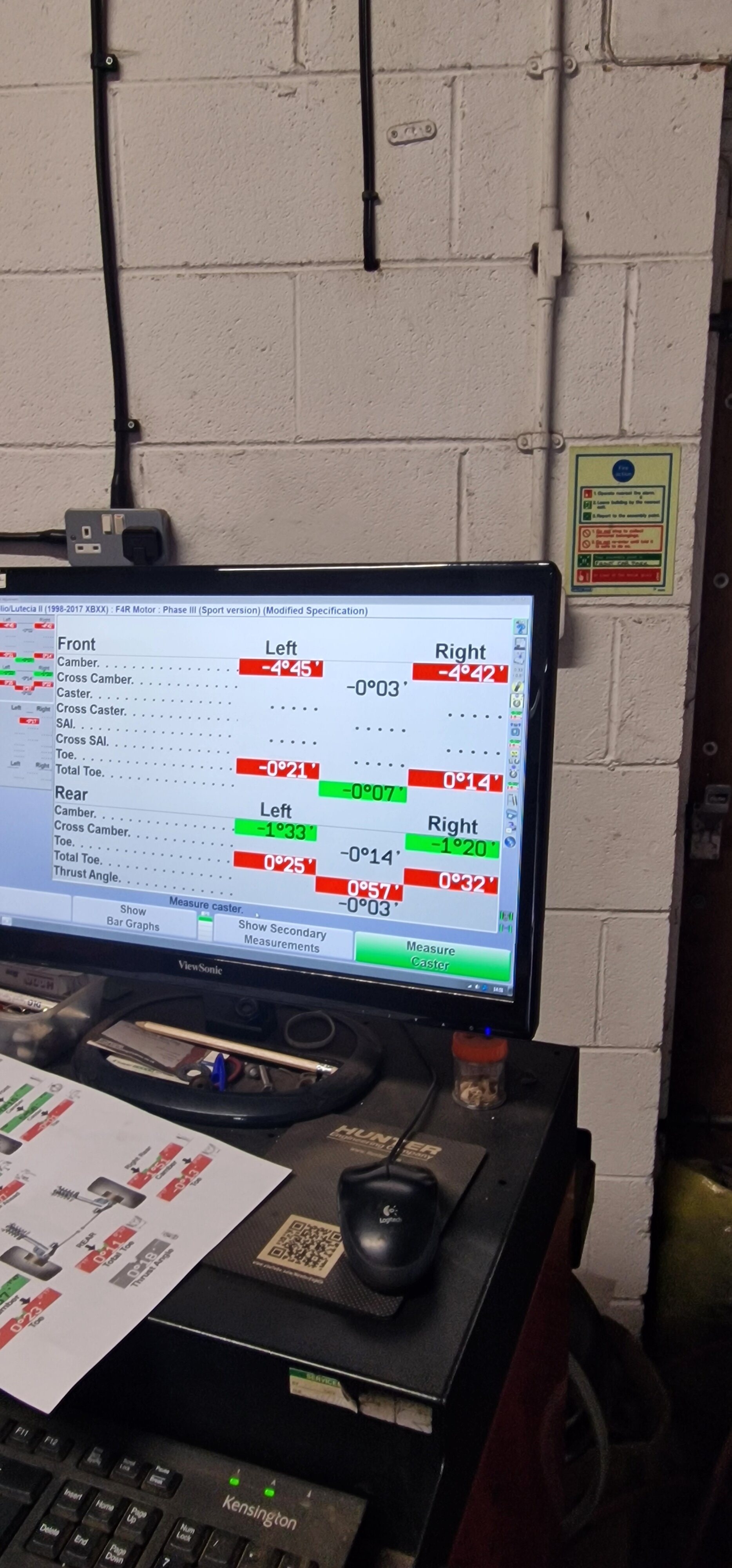

The car had massive amount of front camber as I maxed the slots out on the coilovers. So much so that it was nearly -5⁰🤣
Bit of fettling and we're at -3⁰
Need to shim up the rear to get a bit of camber and to straighten the toe a bit since I've fitted the coilovers

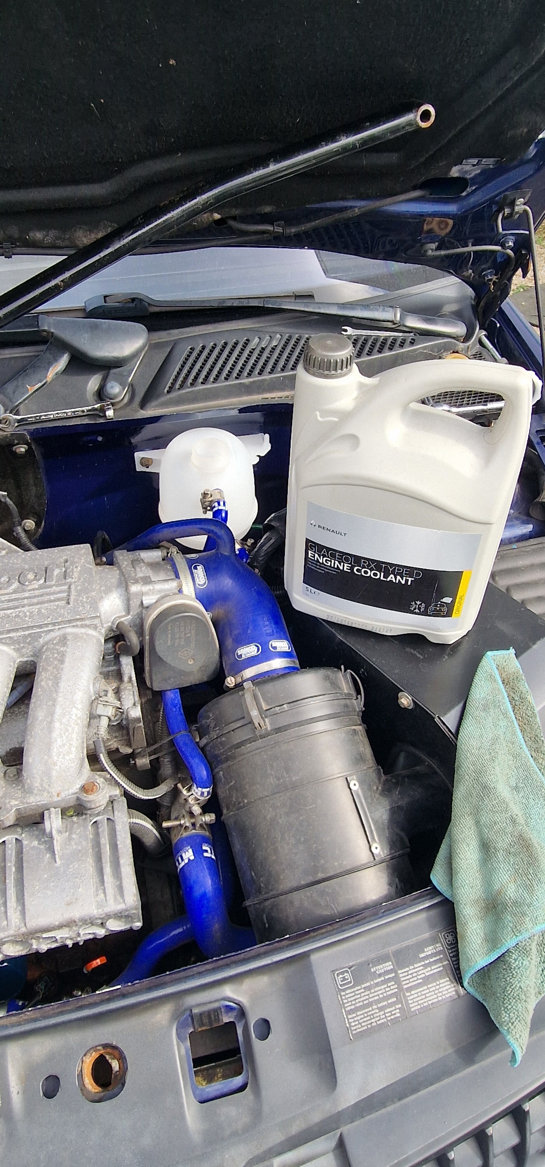

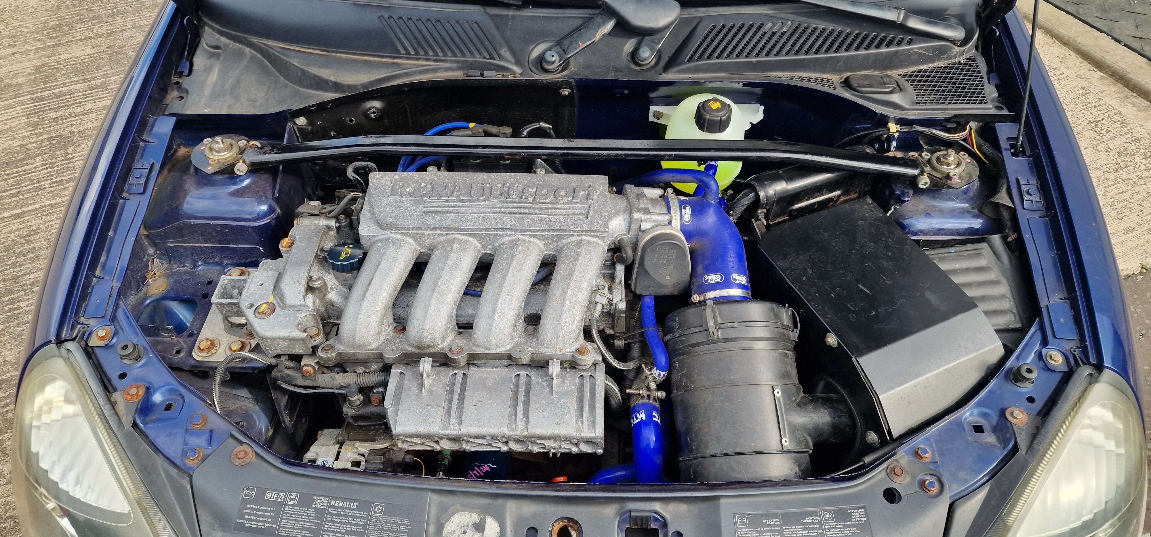

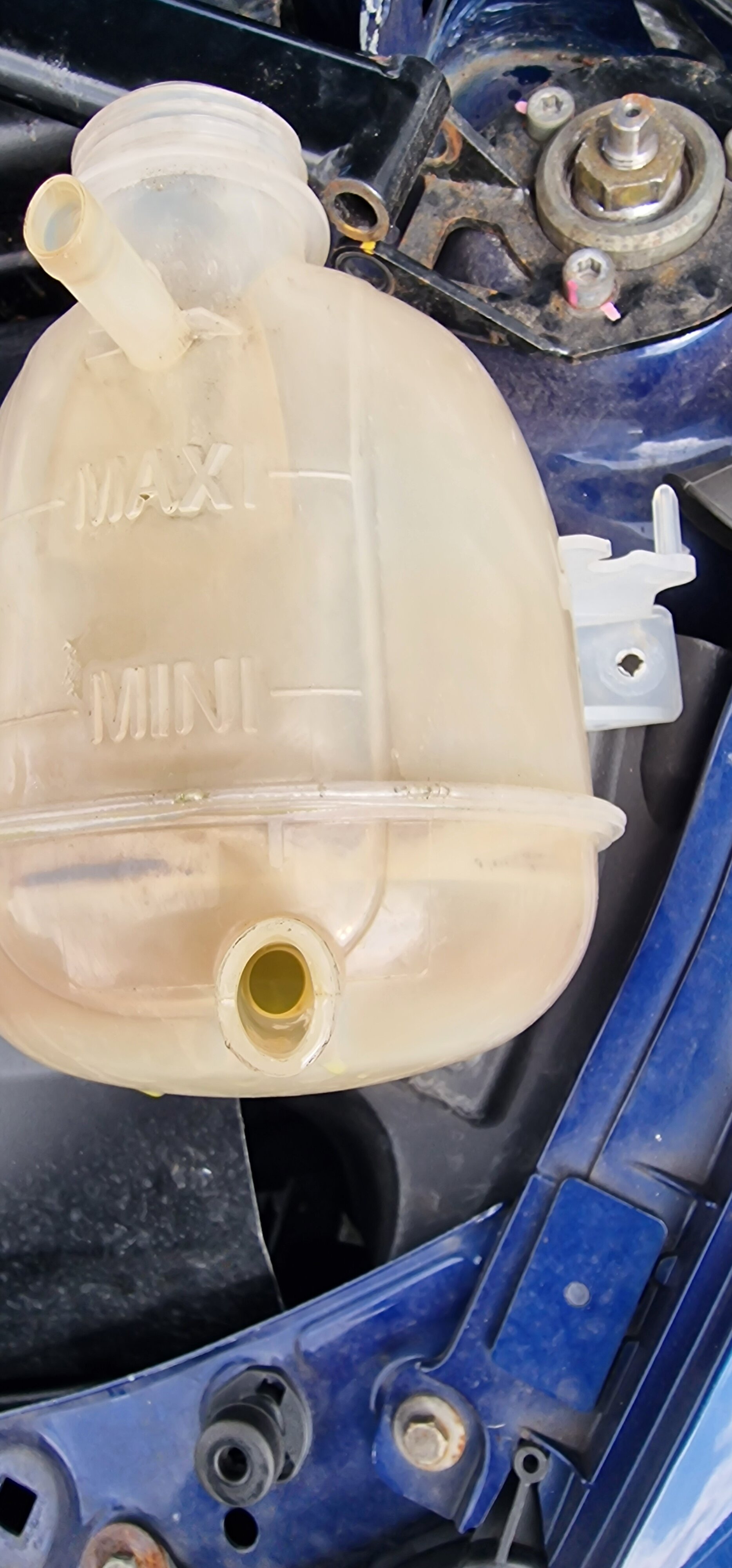

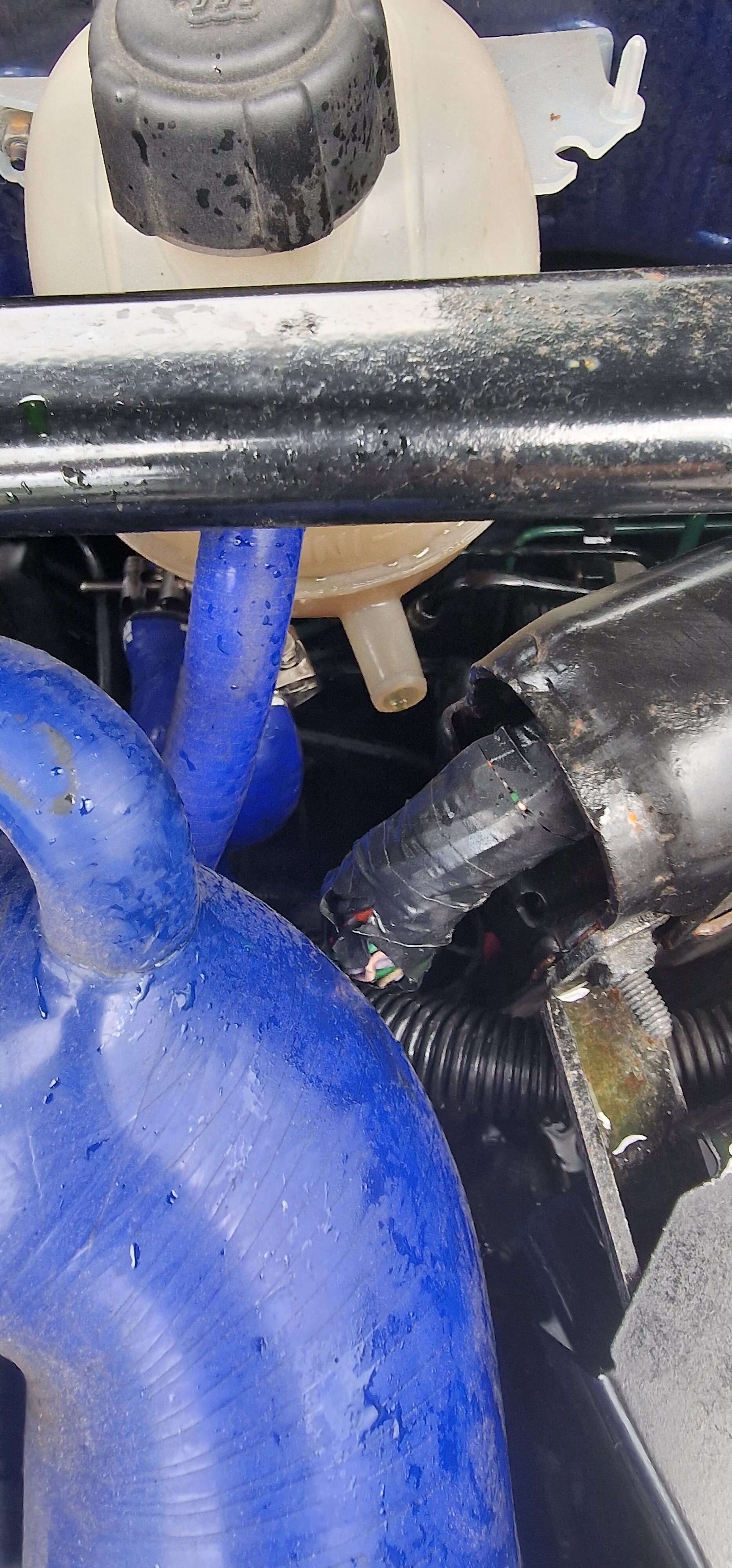

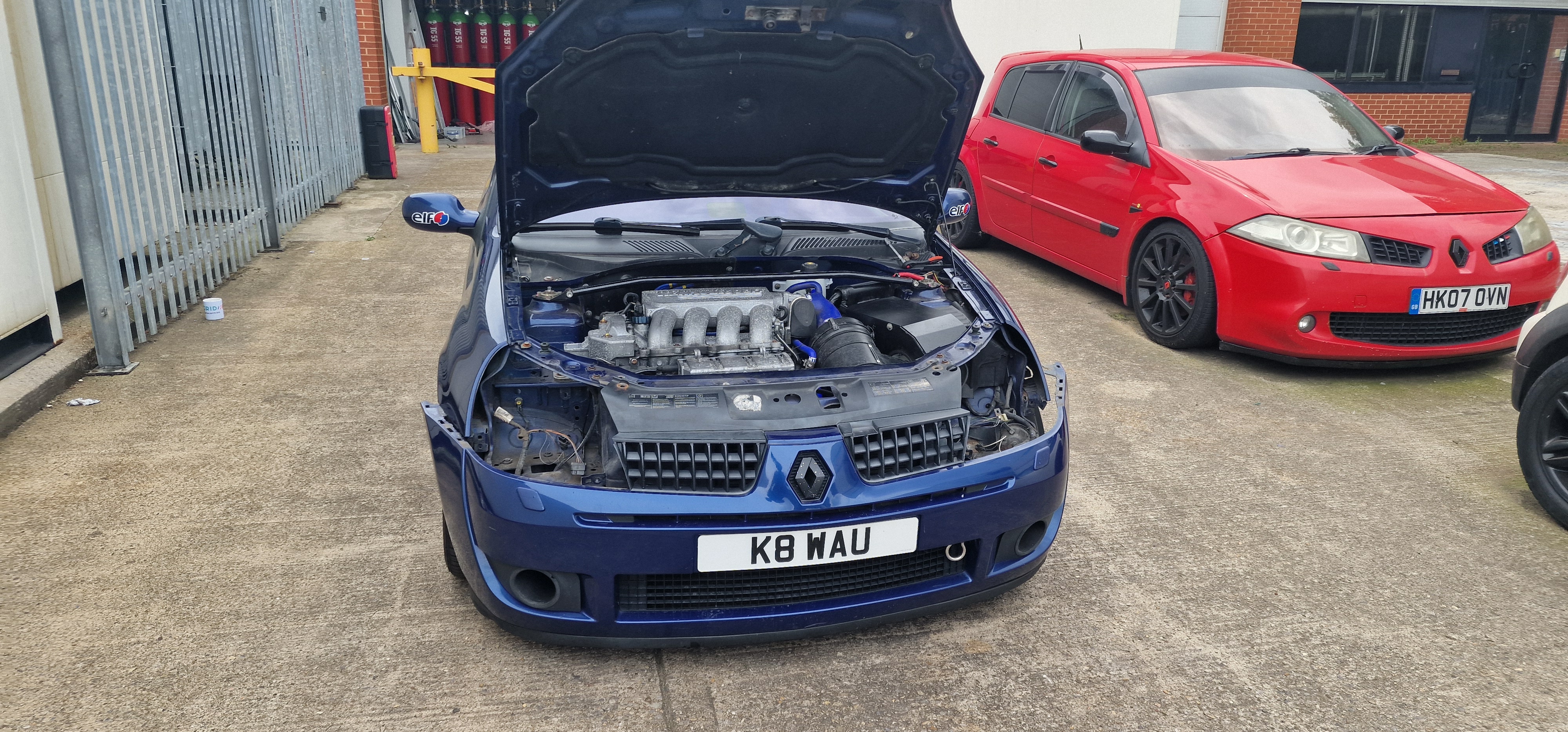

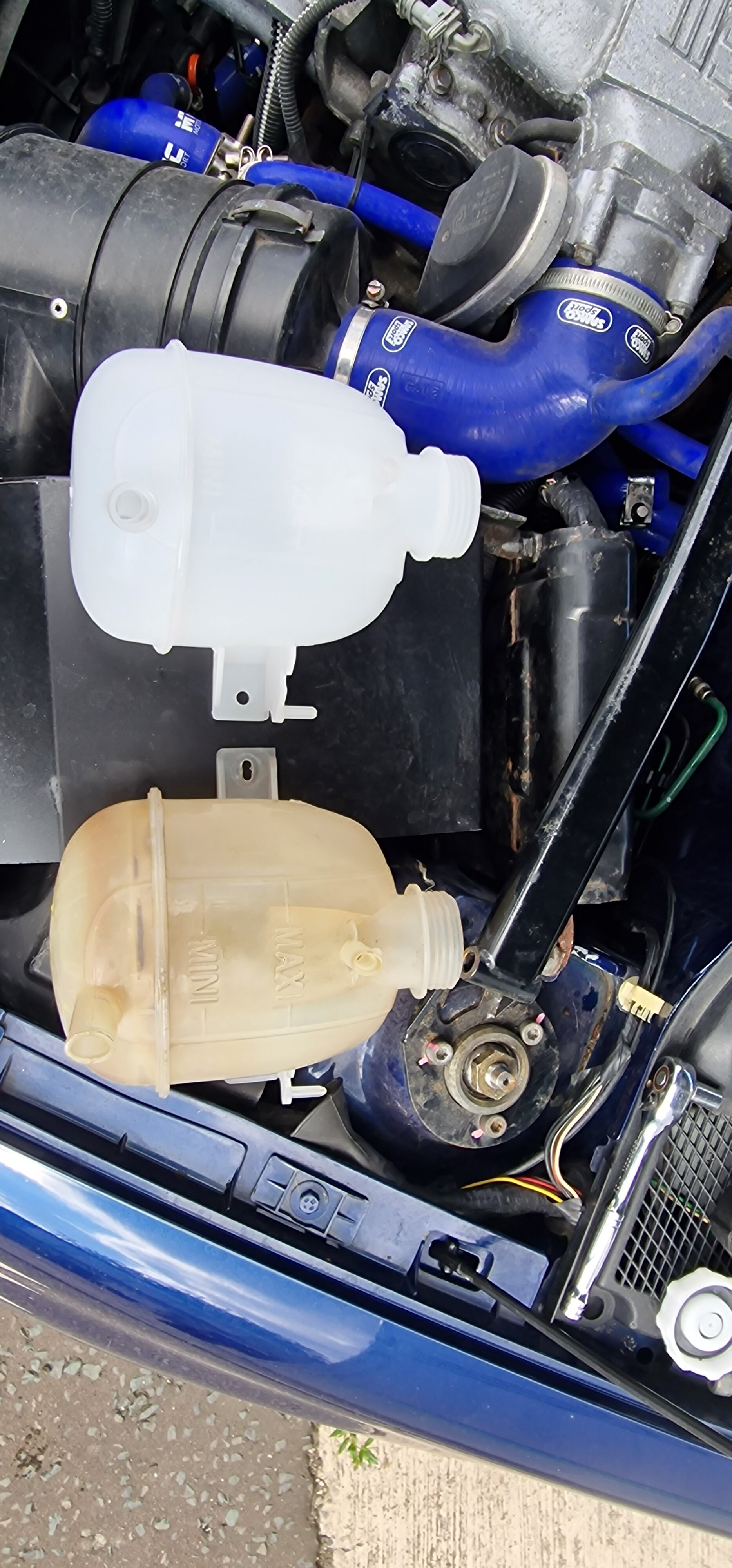

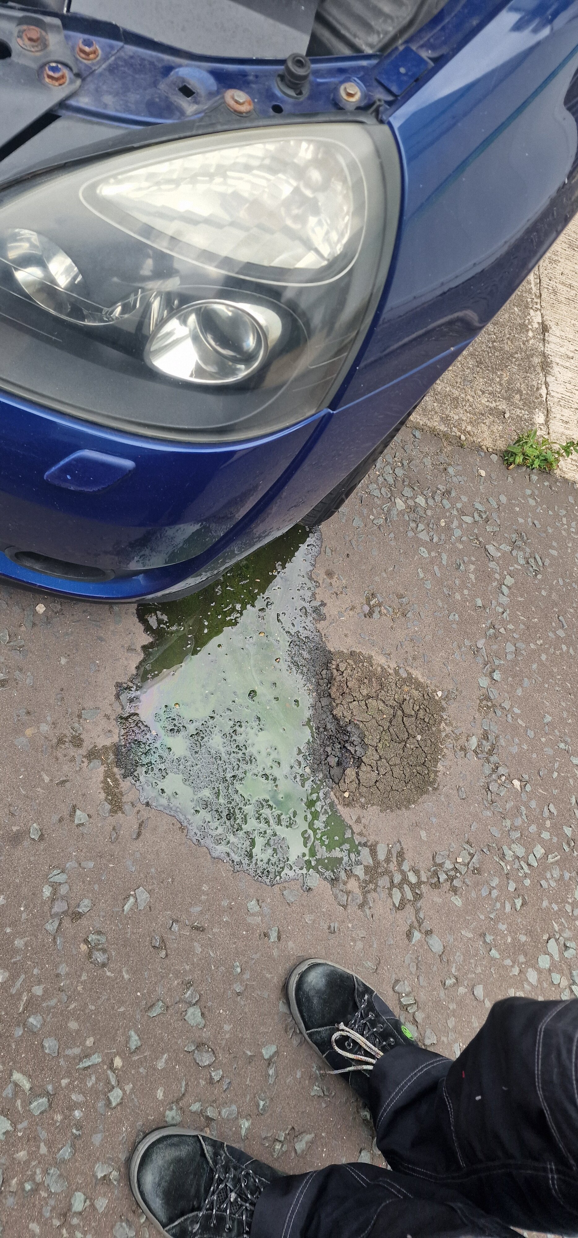

Dropped the car off at work. Parked up and smoke billowed out from underneath the bonnet and this happened
Hose had popped off but I wasn't happy how loose the pipe was clamping so bought a new expansion tank. Might as well for £16
The outlets had been overtightened by the fat stupid ham handed c**t (me) that did them up last time
New fresh genuine type D
Many orange bolts
Will keep an eye on it and hope it doesn't do it again

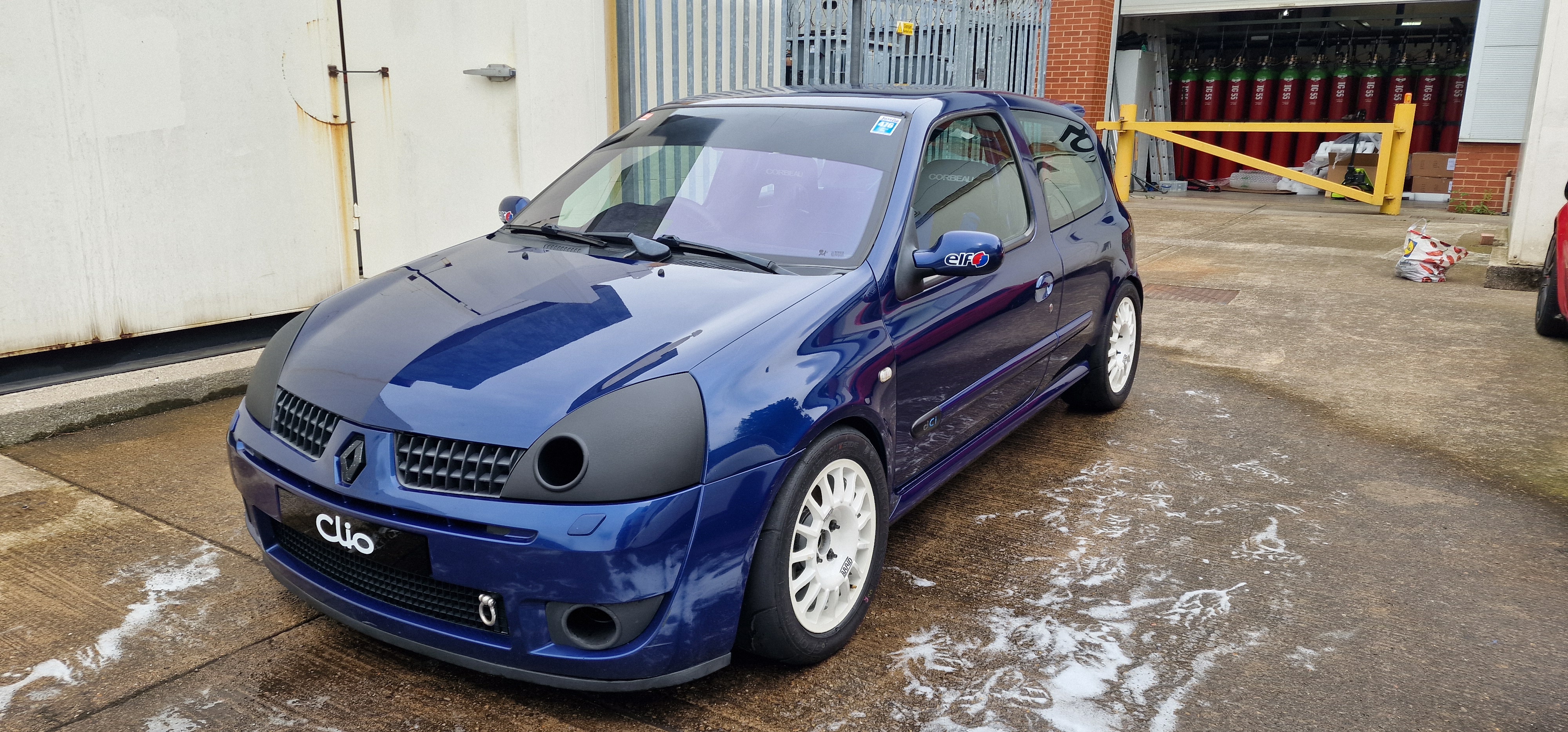

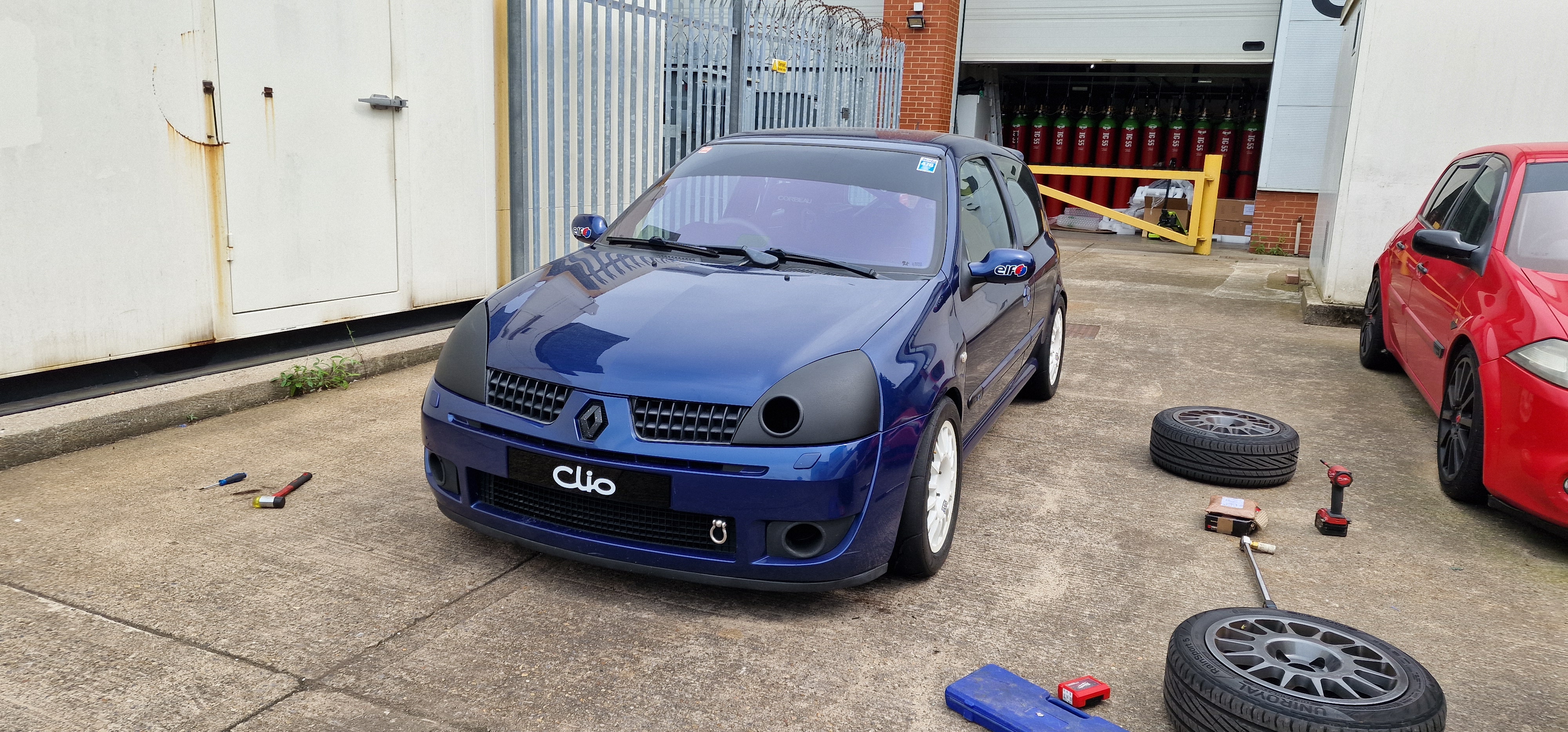

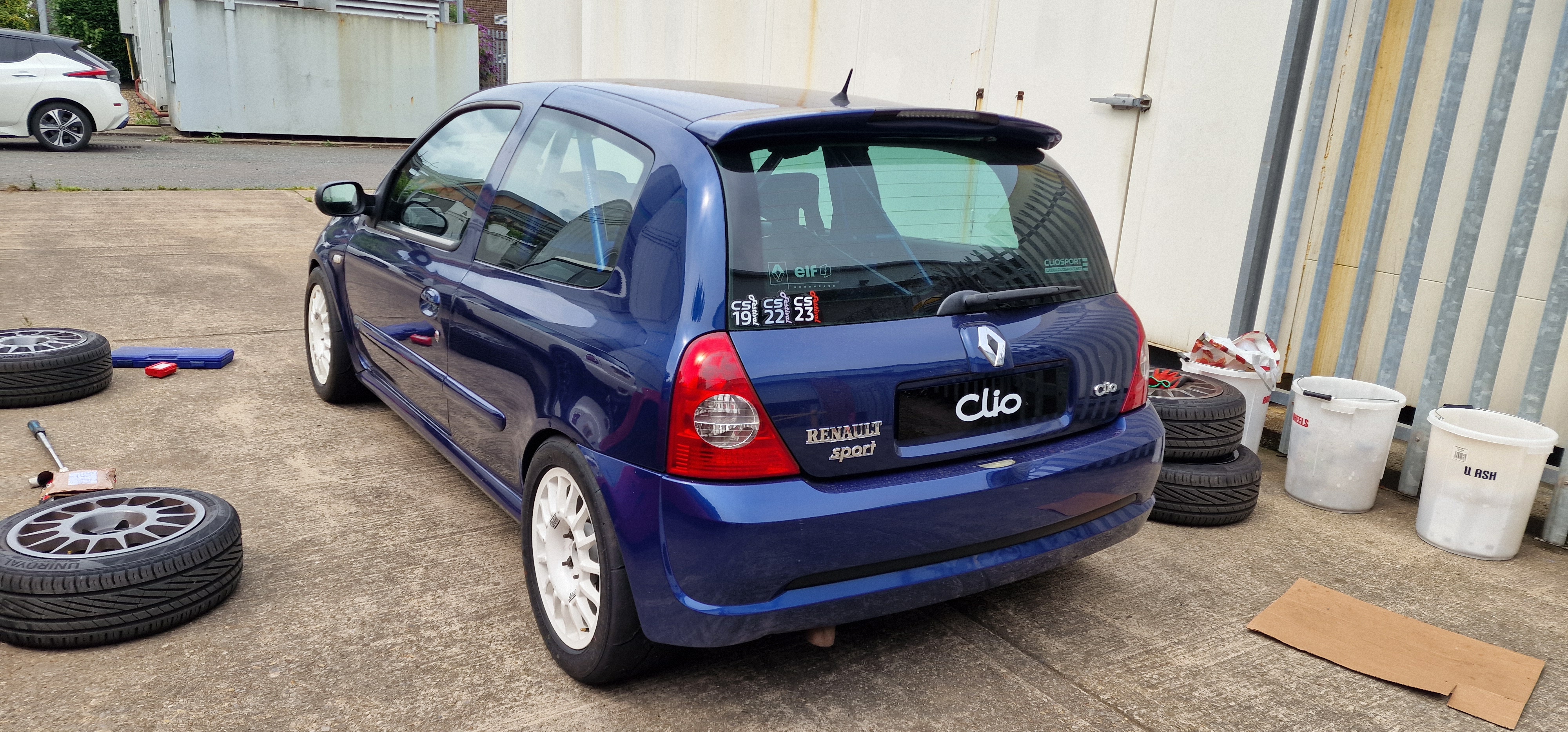

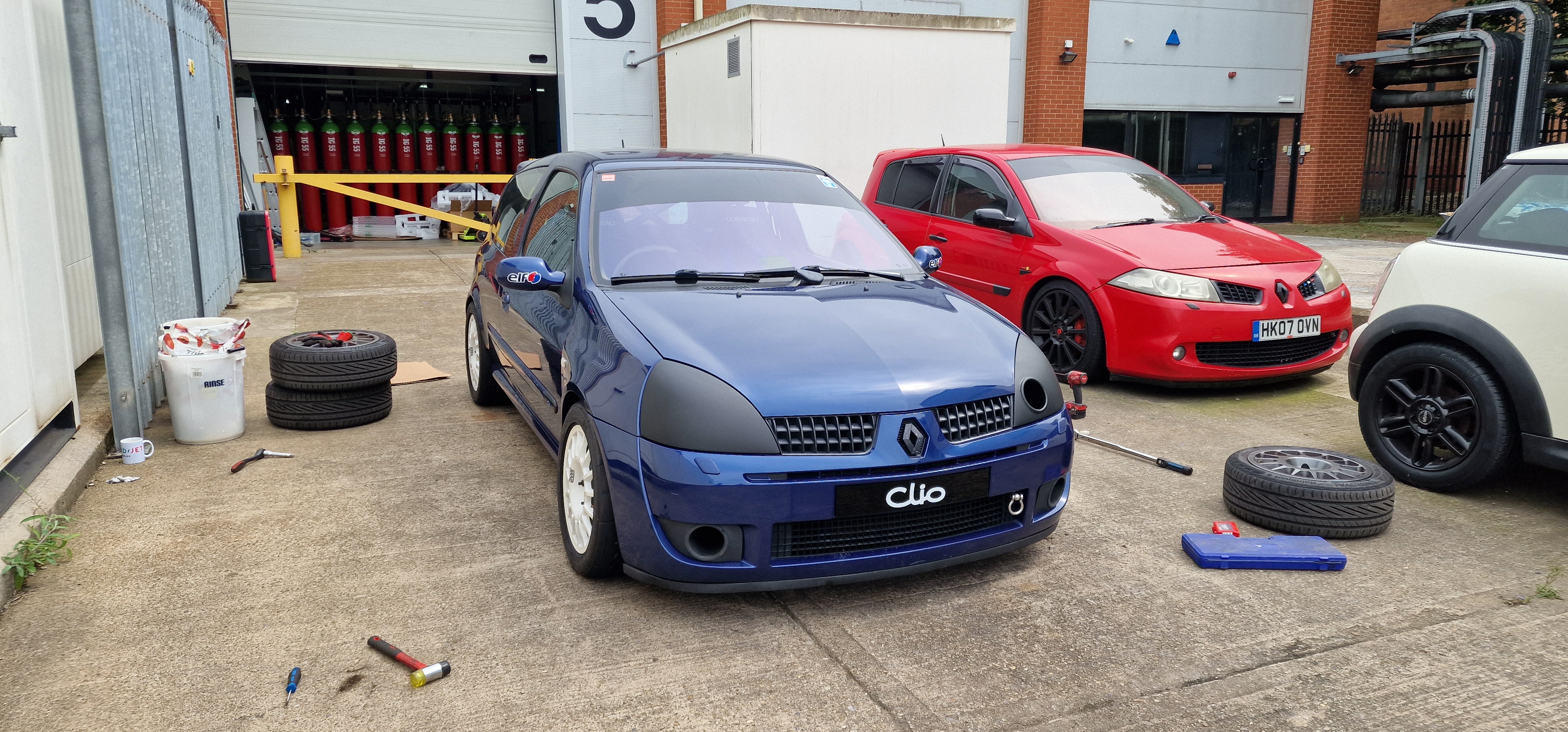

Bit more prep

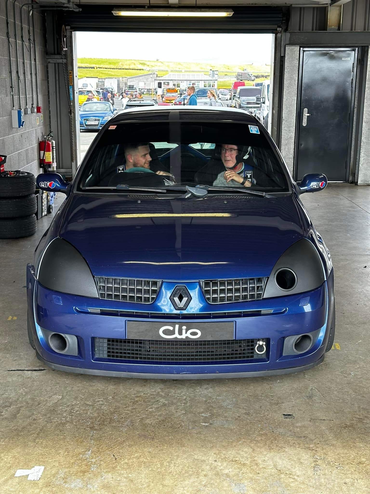

Headlights out
Blanks in, DS1.11 pads in, track wheels on and number plates off
View attachment 1703546View attachment 1703547View attachment 1703550

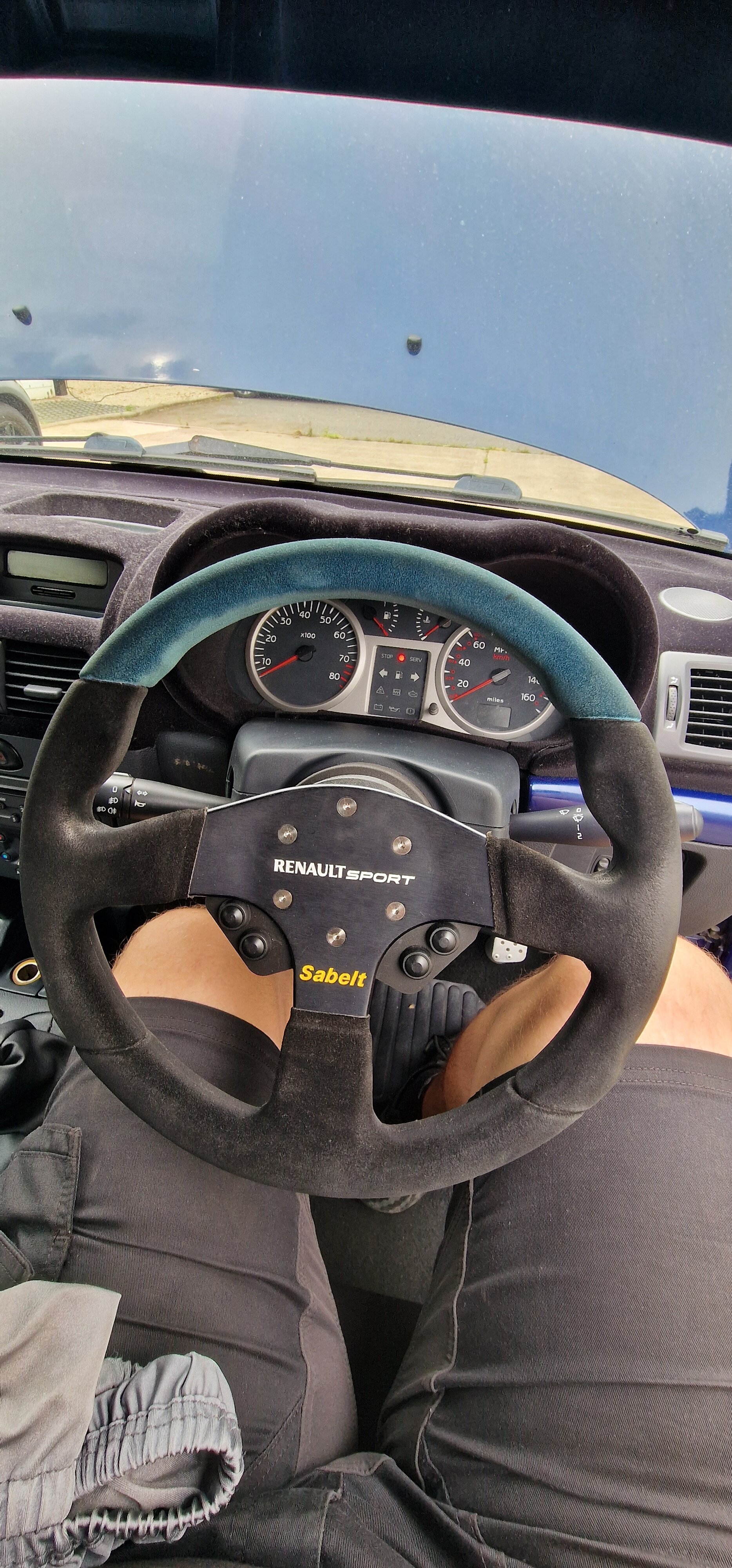

Swapped my steering wheel to a Sabelt one

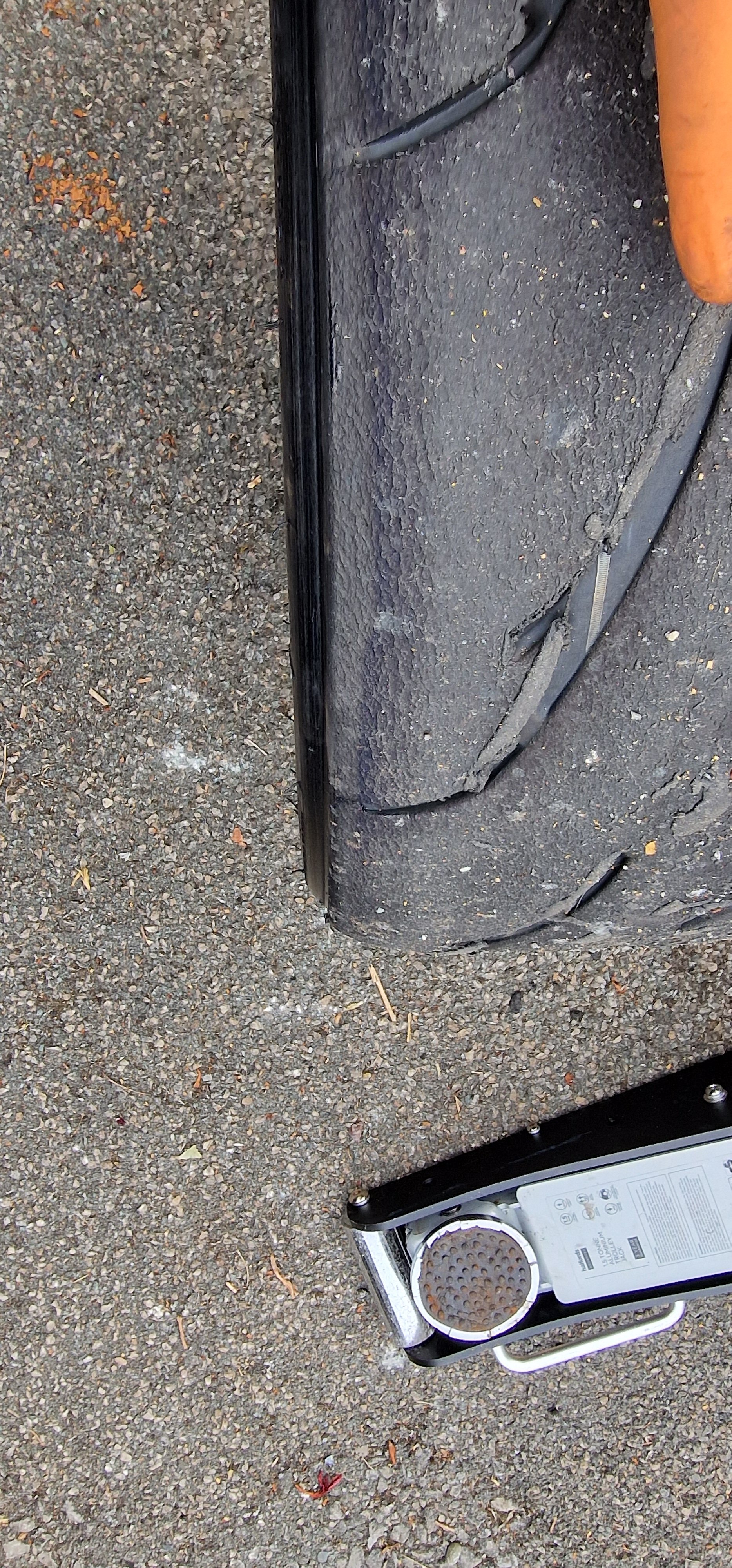

How's your NSR tyre?
It was rubbing good and proper coming out of Peel down towards the Crorkscrew 😅
Self clearanced 😂 I think it was @Sir_Dave who came over and went "your rear tyre is puffing loads of smoke round every right hander". Not exactly great when it's 90% right handed corners at Anglesey

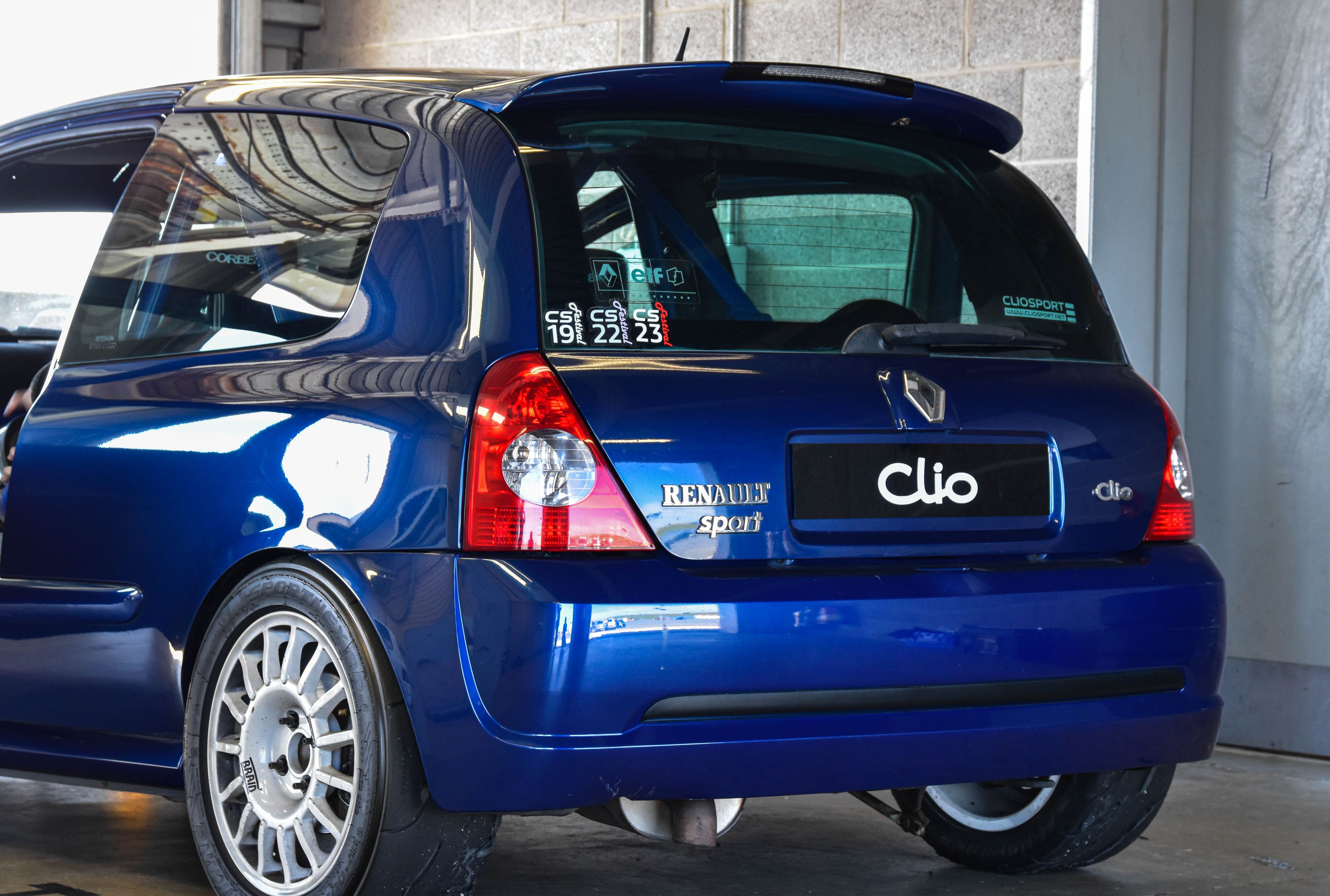

I need to get some rear camber shims ordered and probably use my cup racer 2118s instead of these Braid wheels with daft offset

I couldn't hear f**k all over the sound of the car tbh 😂 I think they're something daft like ET25, they were custom made by Braid to whoever spec'd them. I reckon they'd be perfect without any spacers, except they just catch my brakes ever so slightly
At one point I thought my OS driveshaft started to click it's c**t off but it was just the tyre catching my bumper

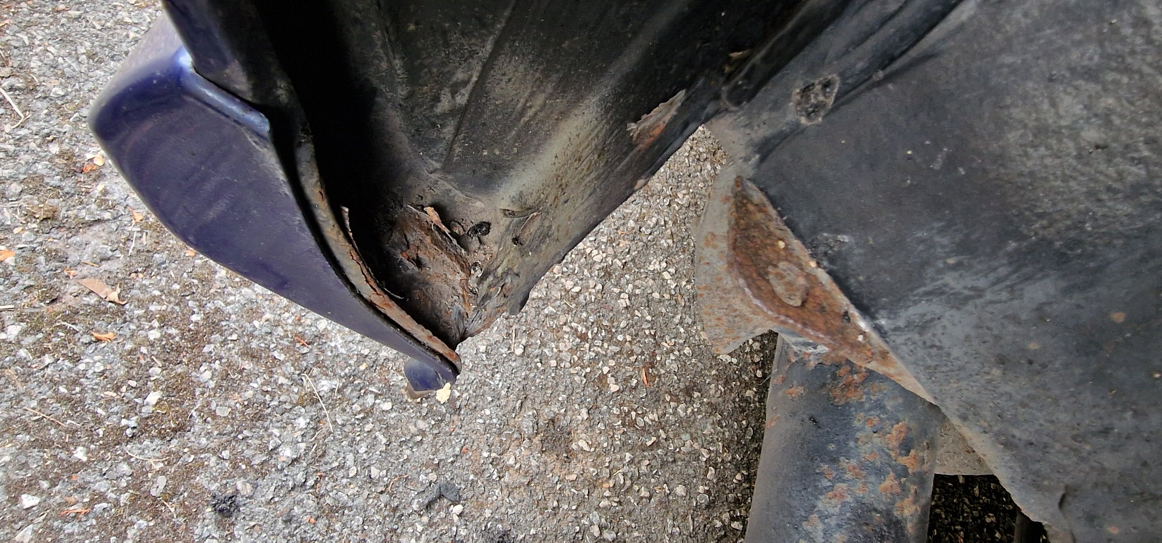

First of all. I've just taken my track wheels off, I suspect I need to have both arches repaired at some point this winter🥲😭
Many rubbers
Arch decided it was hungry and wanted to eat my tyre

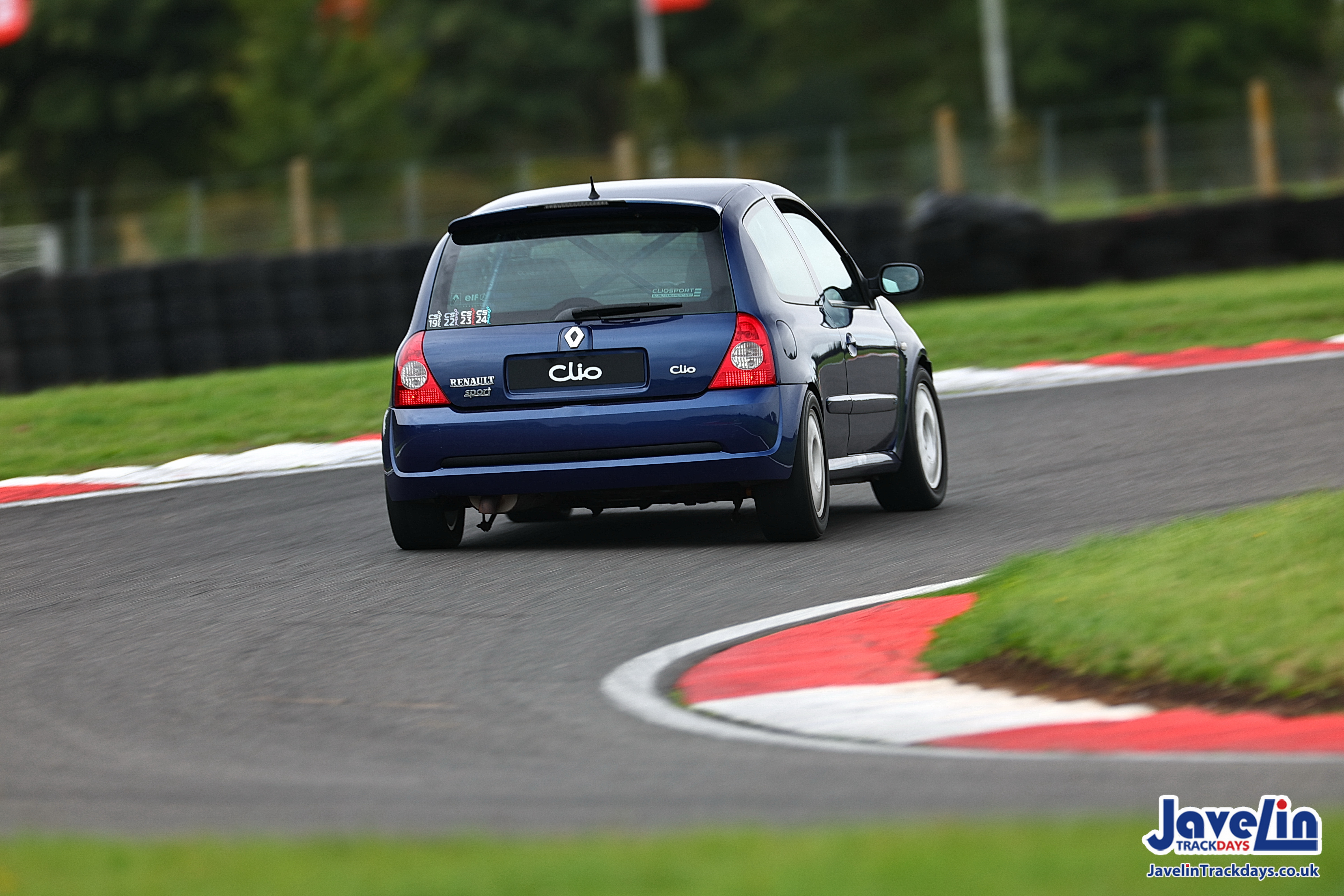

Track pic spam

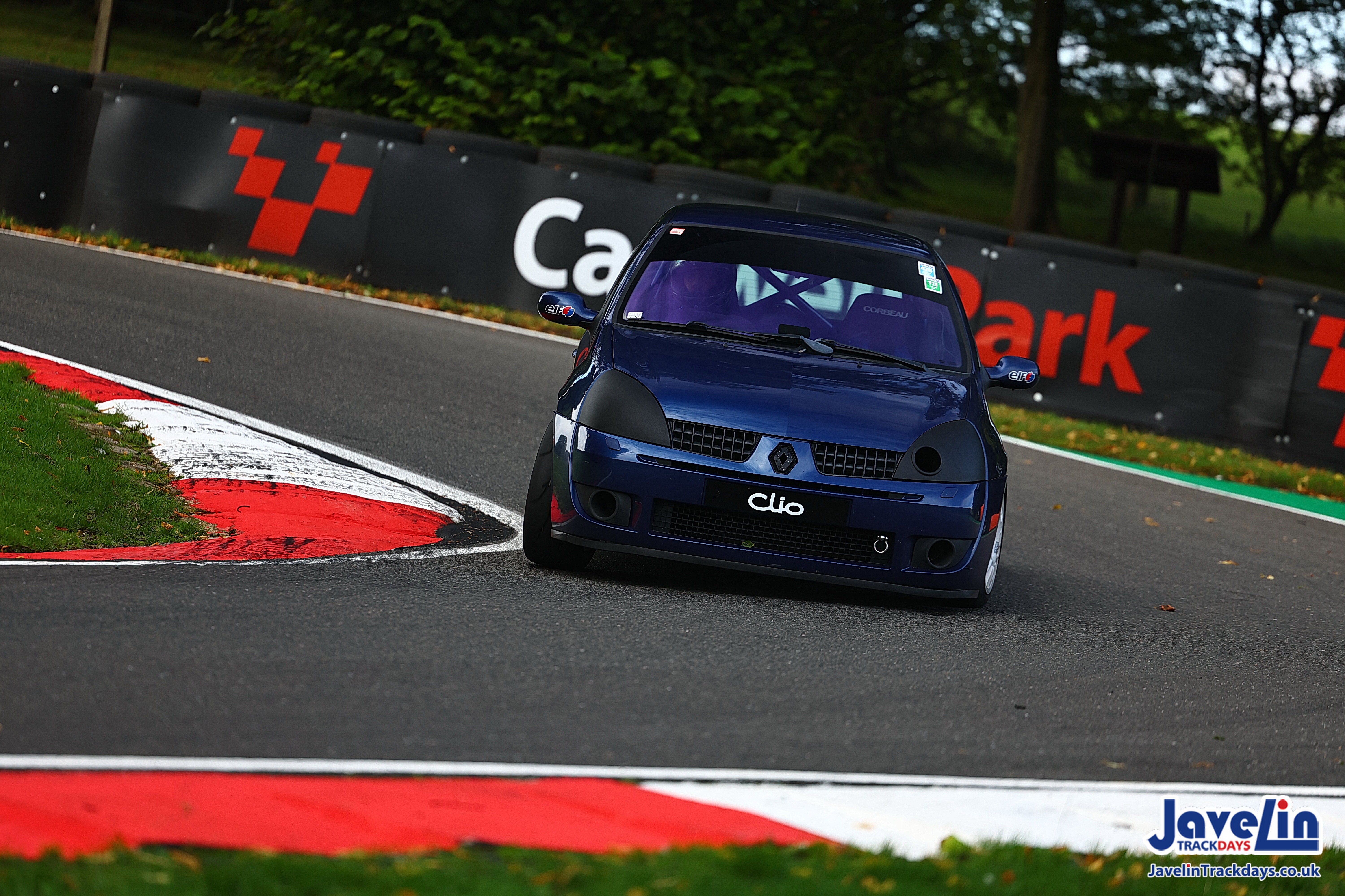

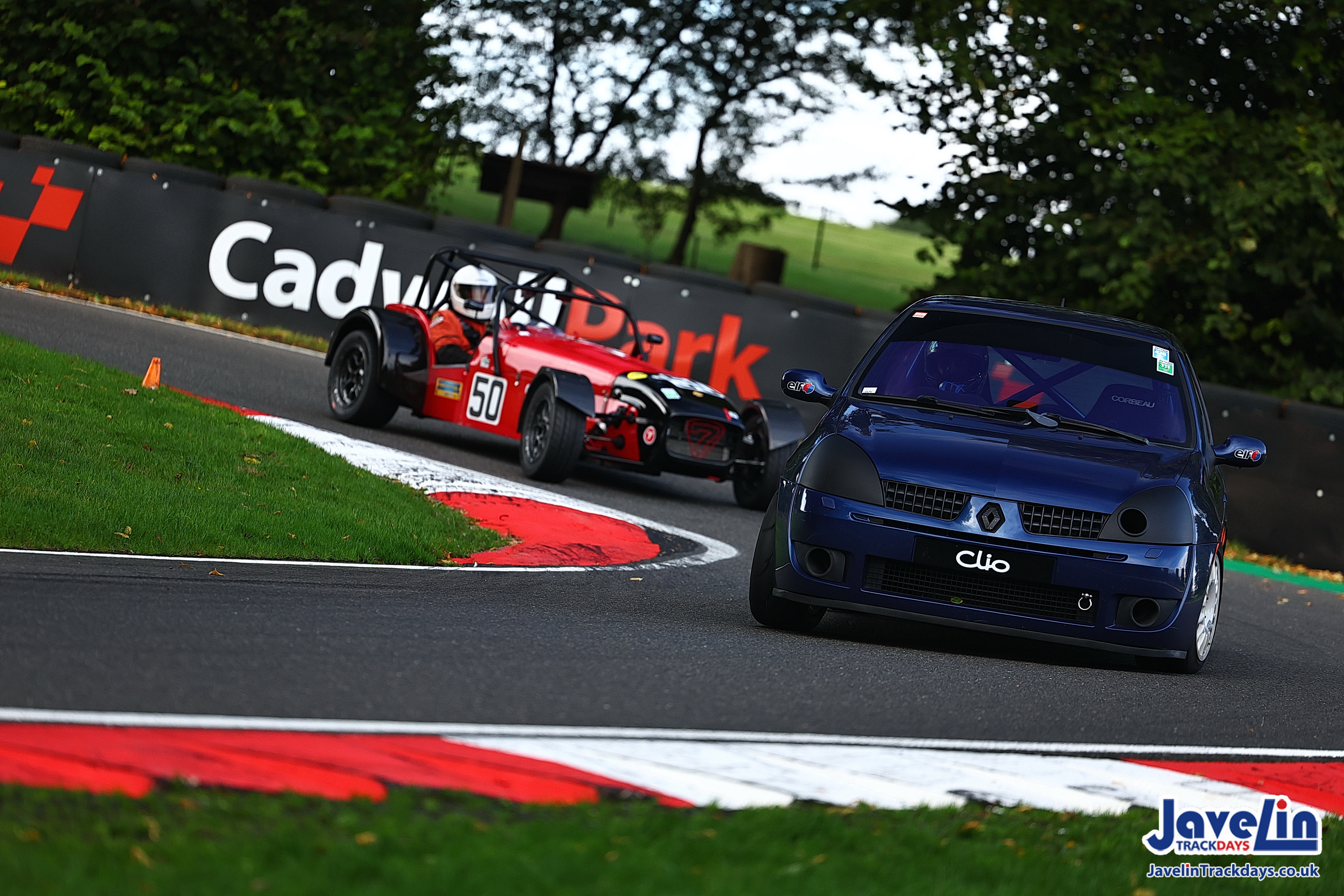

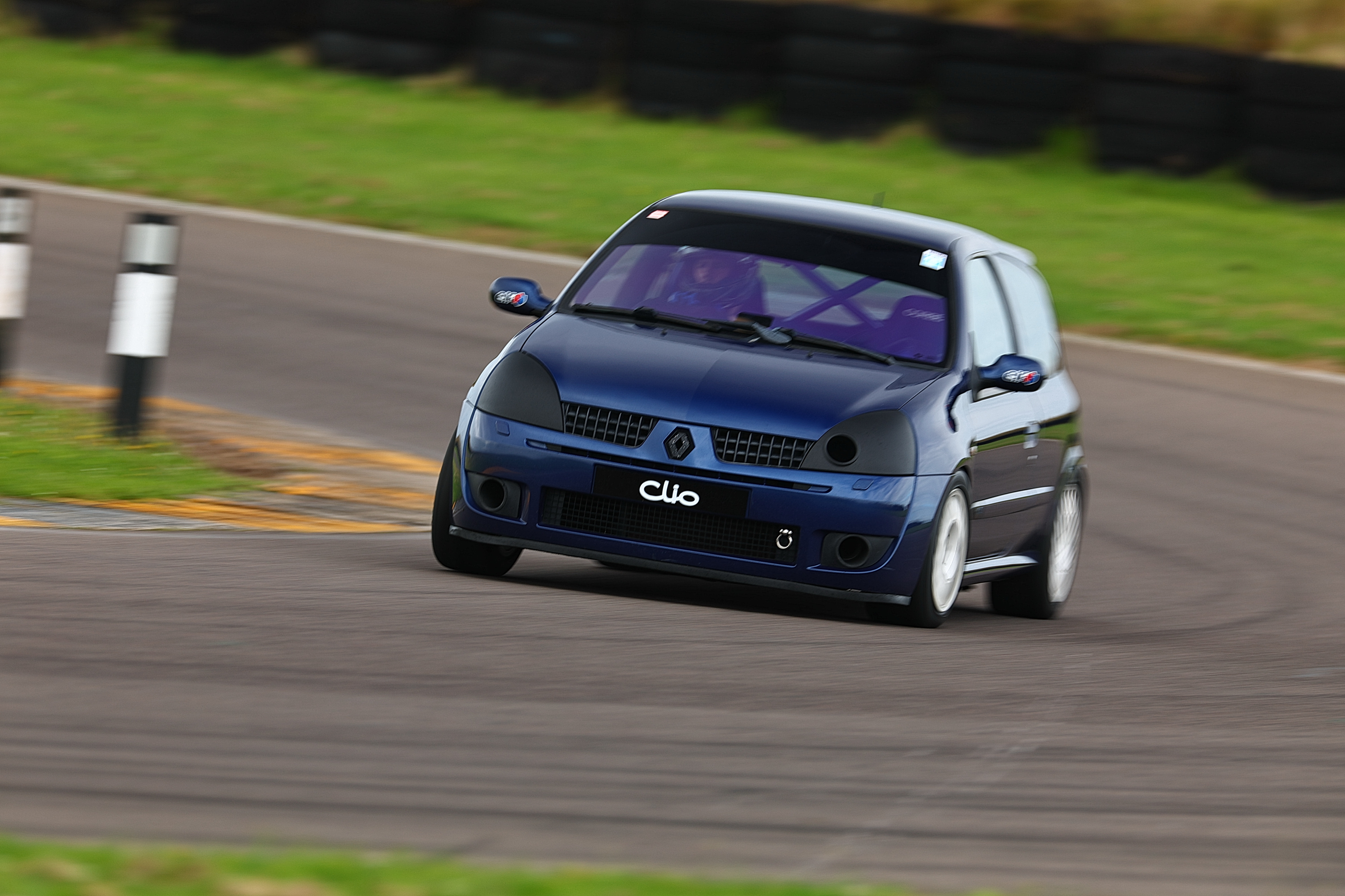

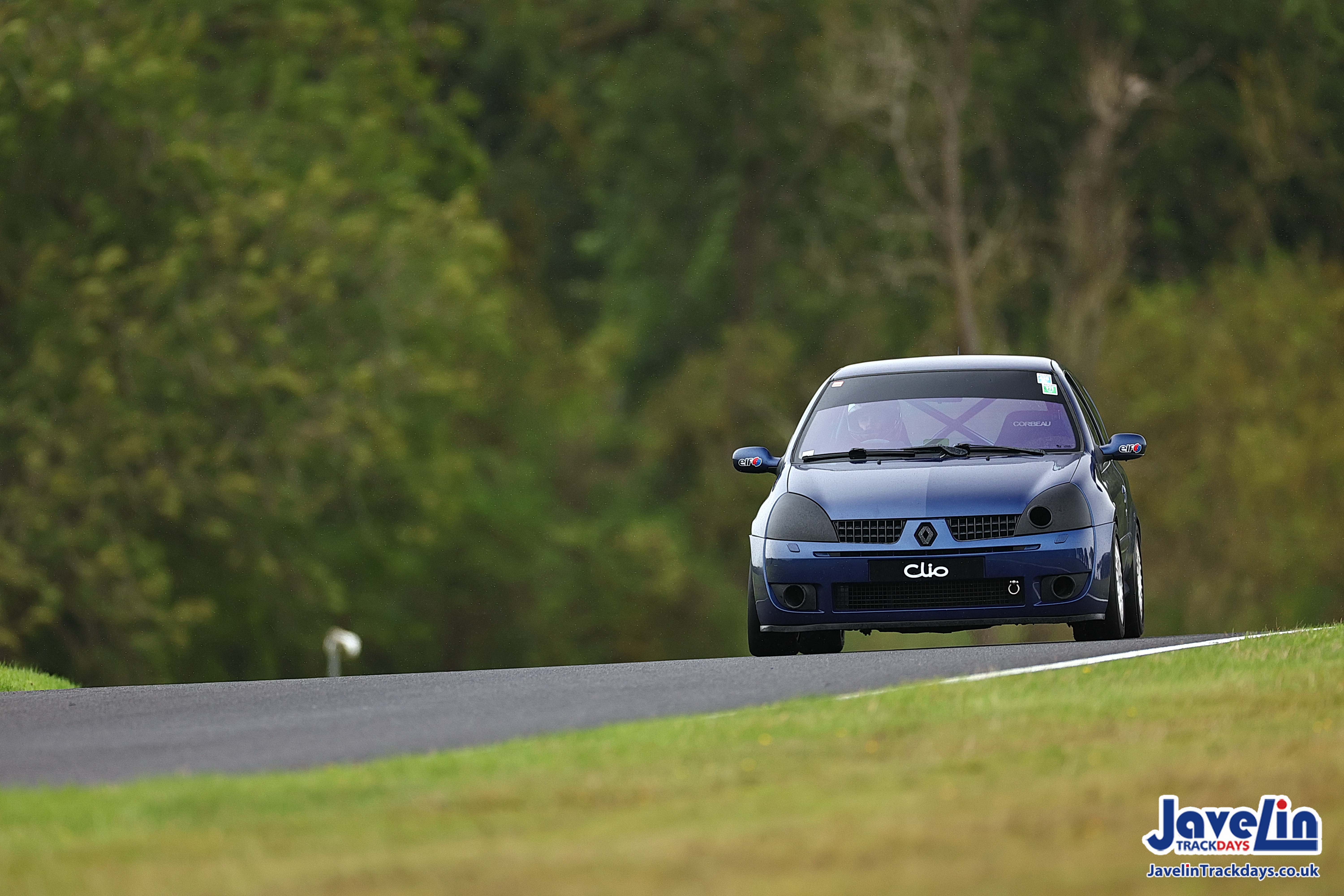

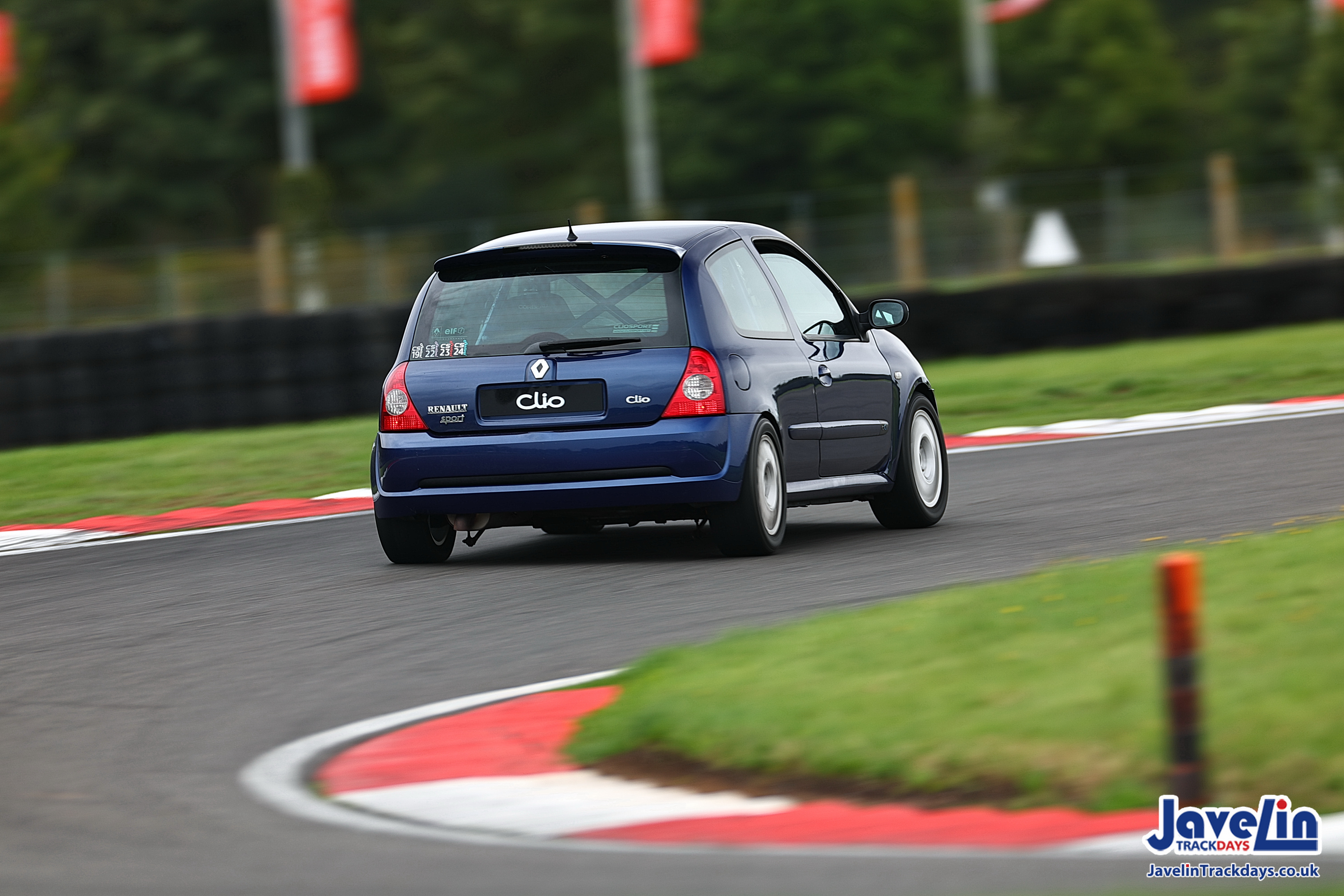

Cadwell 10/09/2024
Started off by hooking the battery up to the Clio... Wouldn't start, battery was on 7v😑 Off to Euros I go, £68 later and I have a fresh Bosch S4, didn't want to risk charging it and then it still being shagged and ruining my day
6am Tuesday morning, locked and loaded
Dinnertime pause whilst the rain rolled in
The car was pretty much faultless but has highlighted a few things
  1. I'm a slow driver, having only done 5 laps of Cadwell last year I was keen to keep the car and myself in one piece so I was very easy on it and took my time (unlike some of the spastic c***s yesterday that decided to just dive up the inside of you mid corner)
  2. The car has more pace, I was very easy on the brakes and only had a few moments where I thought I was gonna run out of track but still managed to get it round
  3. Coming under the bridge and into turn 11 the car kept jumping out of 3rd and into neutral because of the sudden bump in the track. The first few times it caught me off guard and I had to hold it into gear after that
  4. AR1 are awful in the wet, properly properly awful, I had a moment coming into hairpin where the arse end tried to come around on me. I corrected it pretty quickly but snapping the steering wheel to one side with no power steering caused me some right jip with my dodgy wrist. I was just too lazy to swap to my wet wheels because it looked like it was drying up (which it was)
  5. I kept slipping/slouching down in my seat, every so often I'd have to boost myself back up to avoid crushing my tezzies with the crotch strap
Overall I had a great day, me and @SharpyClio had 2 mega-long sessions in the morning where we must have been out for a good 30 mins at the very least. I did another 2 afternoon sessions before calling it quits at about 4pm because the rain just wasn't letting up and everyone else had fucked off too. The purple Puma, the MK5 Golf GTI and the Blue Fiesta we're mobile chicanes through the day and just never seemed to let off whenever they did move over, useless f*****s

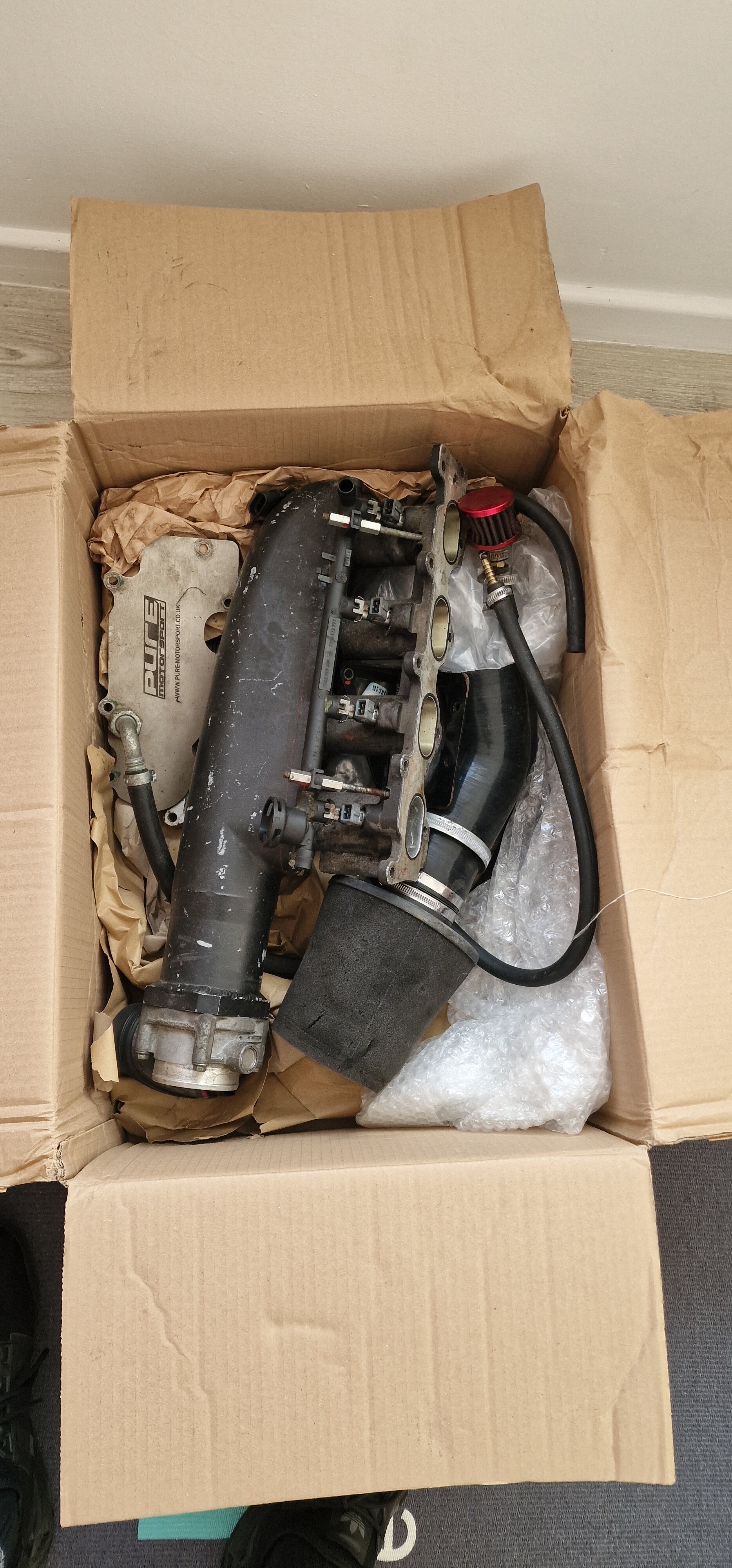

In other news my inlet has arrived

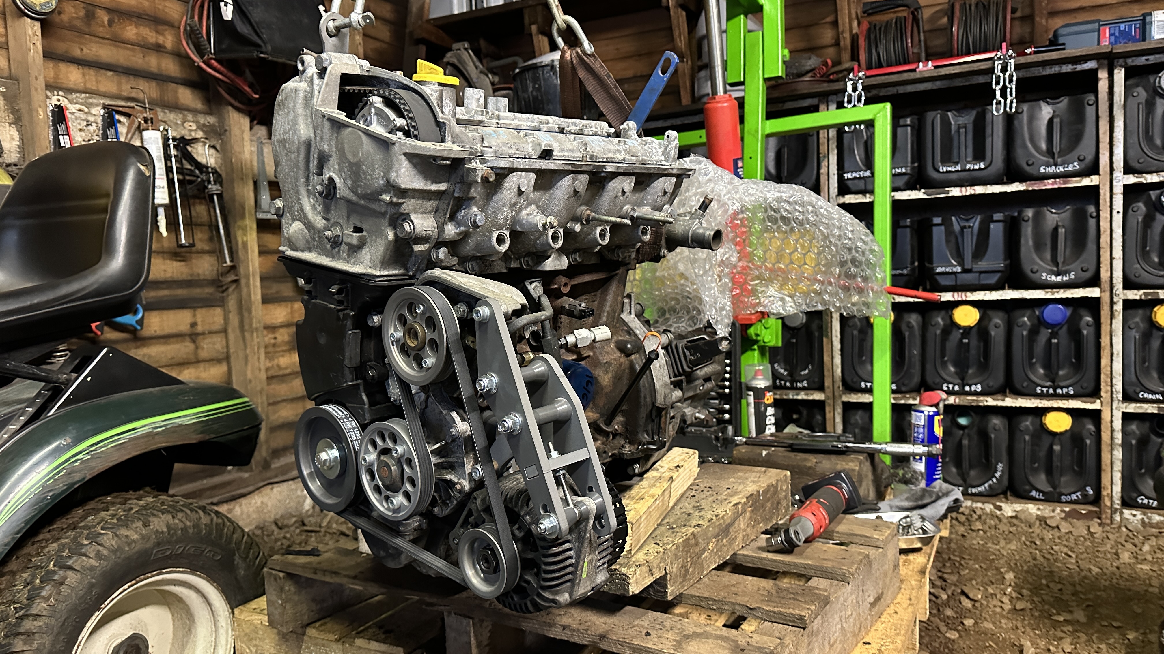

Are you planning to fit the Tessa as it is, or going for a cam upgrade at the same time?
Car looks spot on btw!
I'm undecided
Got 3 options though
  • Build new engine with 200 engine parts, fit Tessa inlet then map @ EFI
  • Put 200 cams in my engine, fit Tessa inlet then map @ EFI
  • Put Tessa on and map @ EFI
I've already got the 197 cam timing tool and this engine does need a cambelt and the lower pulley is pretty shagged. I have all the bits apart from the belt kit, just CBA innit
The logical thing to do would be to throw the cams in, put a new crank damper pulley on whilst I'm in there, it gets a fresh belt and then the inlet. That should see me around 190bhp I'd hope, it'd be good fun too. Then just leave it as is for a while until I get the urge to build an engine
chazza114
I'm undecided
Personally I'd go throw the 200 cams in and the inlet, then go get it mapped. Might as well get the most bang for you buck from the map session, rather than having to go back again in the future if you only did the inlet.
Might as well do what I did and throw on the PMS lightweight pulley kit while you're at it :LOL:
Speedo Gonzales
I've only got 2 pulleys anyway, alternator and water pump🤣
