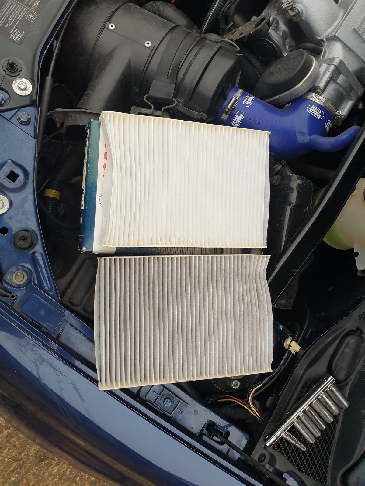

Slapped in a new cabin filter, I couldn't remember if I'd ever done one on this one but I had one in the garage spare so there was no harm in throwing it in

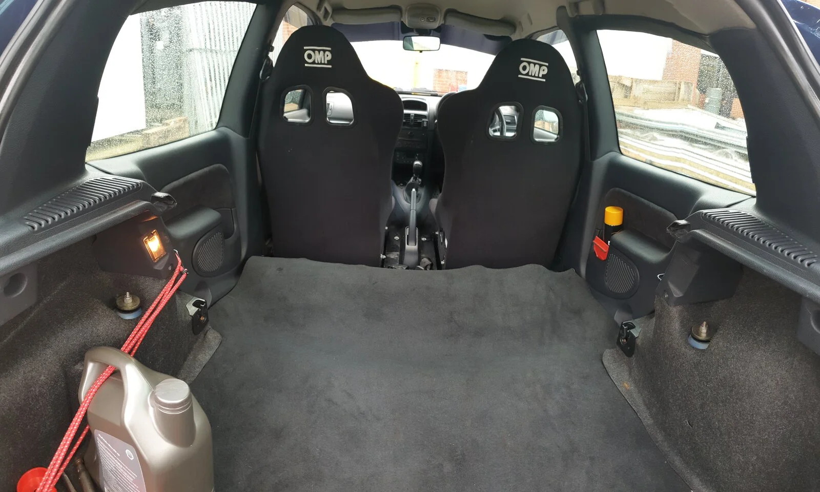

I've forgotten how ace it is to drive an asbo spec car every day. Especially when some dole dosser tried to race me in a Vectra with a fat bird in the back seat, see ya later c**t. Its ace for shopping too, no back seats so theres nothing that wont fit. Including a 6ft3" Christmas tree😂

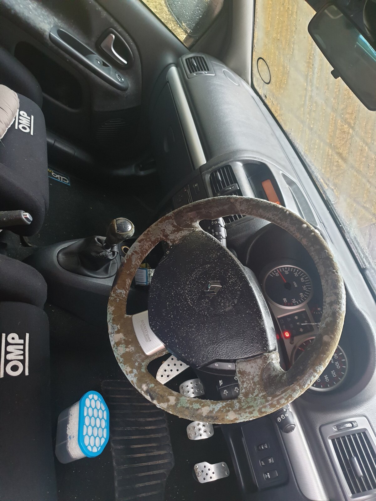

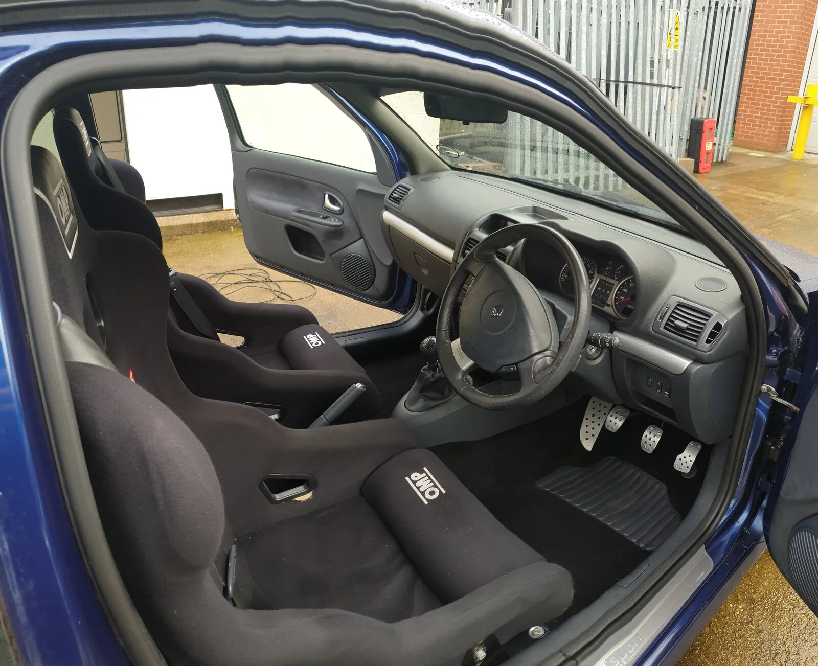

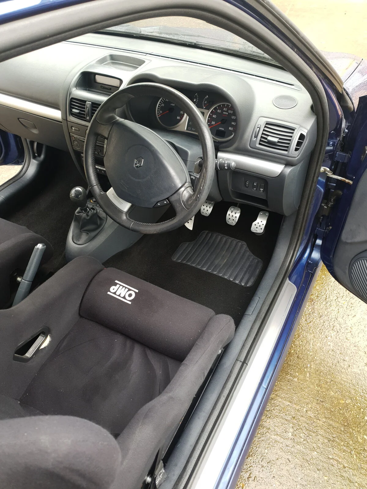

Because the car had so much mould in it and smelled like a gypos nutsack I bought a steam cleaner and blitzed the whole thing! Karcher SC2 filled with a Dettol and water mix
Everything came out feeling and looking like new! (Apart from the steering wheel and gearknob because they're just worn to f**k)
Pics of the lovely, clean and fresh car
Just a reminder of what the steering wheel looked like before

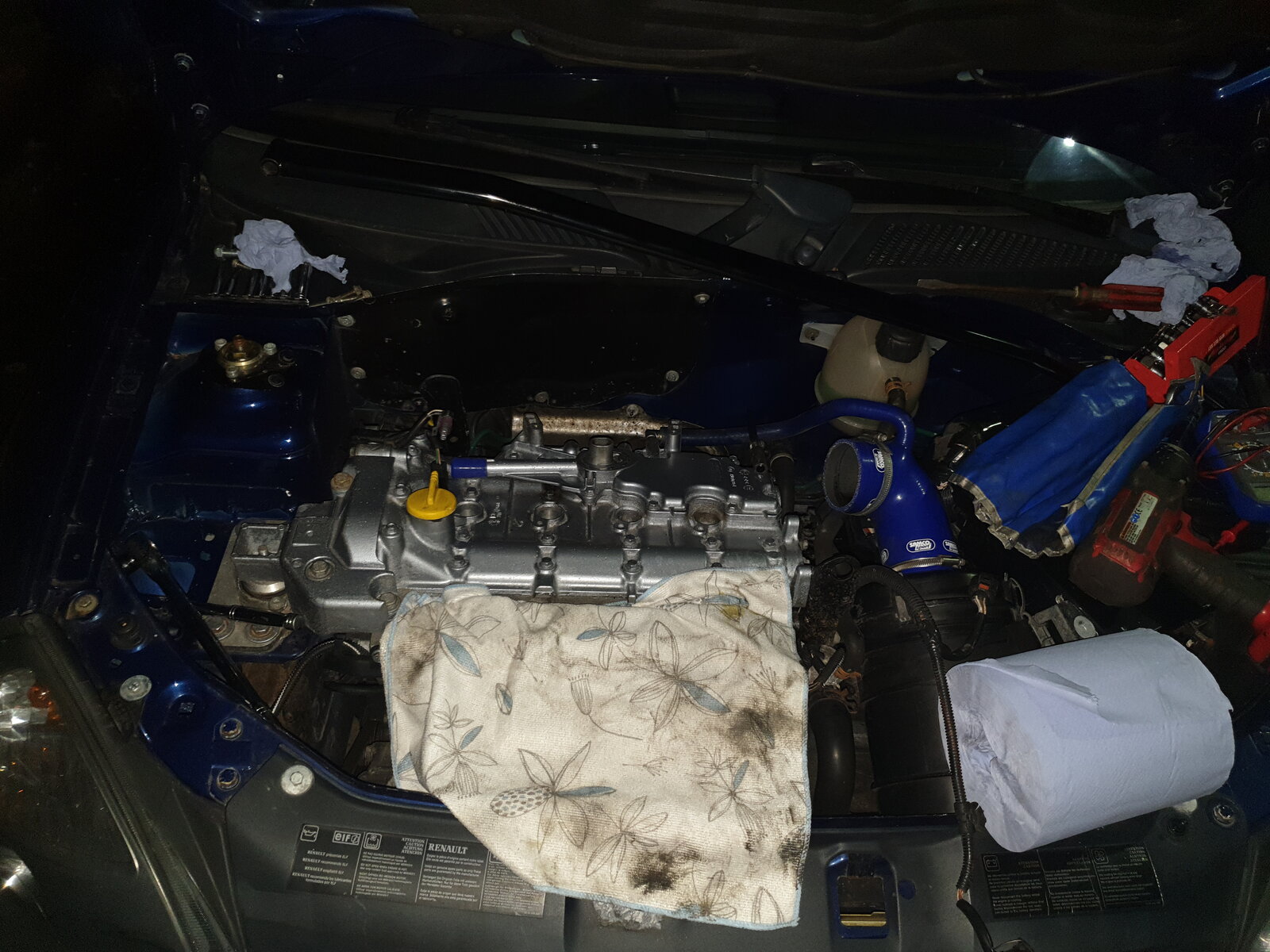

Unfortunately I got water in the engine bay after spraying the underside of the bonnet. It drove fine at first, then I parked it up for a few hours at work, came out to it and it was sputtering like f**k. Drove all the way home with it kangarooing like f**k
Got home and stripped it down and there was an amount of water in the first hole around the spark plug😑 Dried it all out with bluroll and now it drives spot on again.
My mrs held the torch for me, definitely baby Yoda-esque. I wont make the spastic mistake again without covering the engine

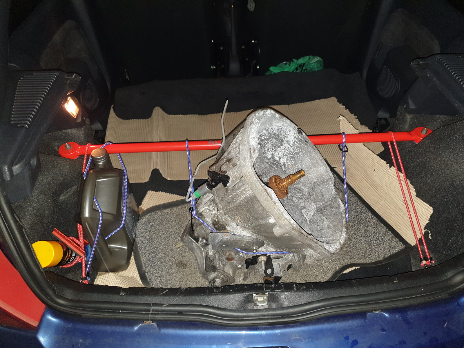

The perfect gearbox transport vehicle
Megane box is off for a rebuild and a 250 LSD. The JC5 130 apparently only has 60k on it but it's getting a health check, new synchros and seals throughout for peace of mind.
Carrying them PK boxes on my own was a f**king hassle. Cant reverse the car up to the garage because theres 2 meganes in the way😂

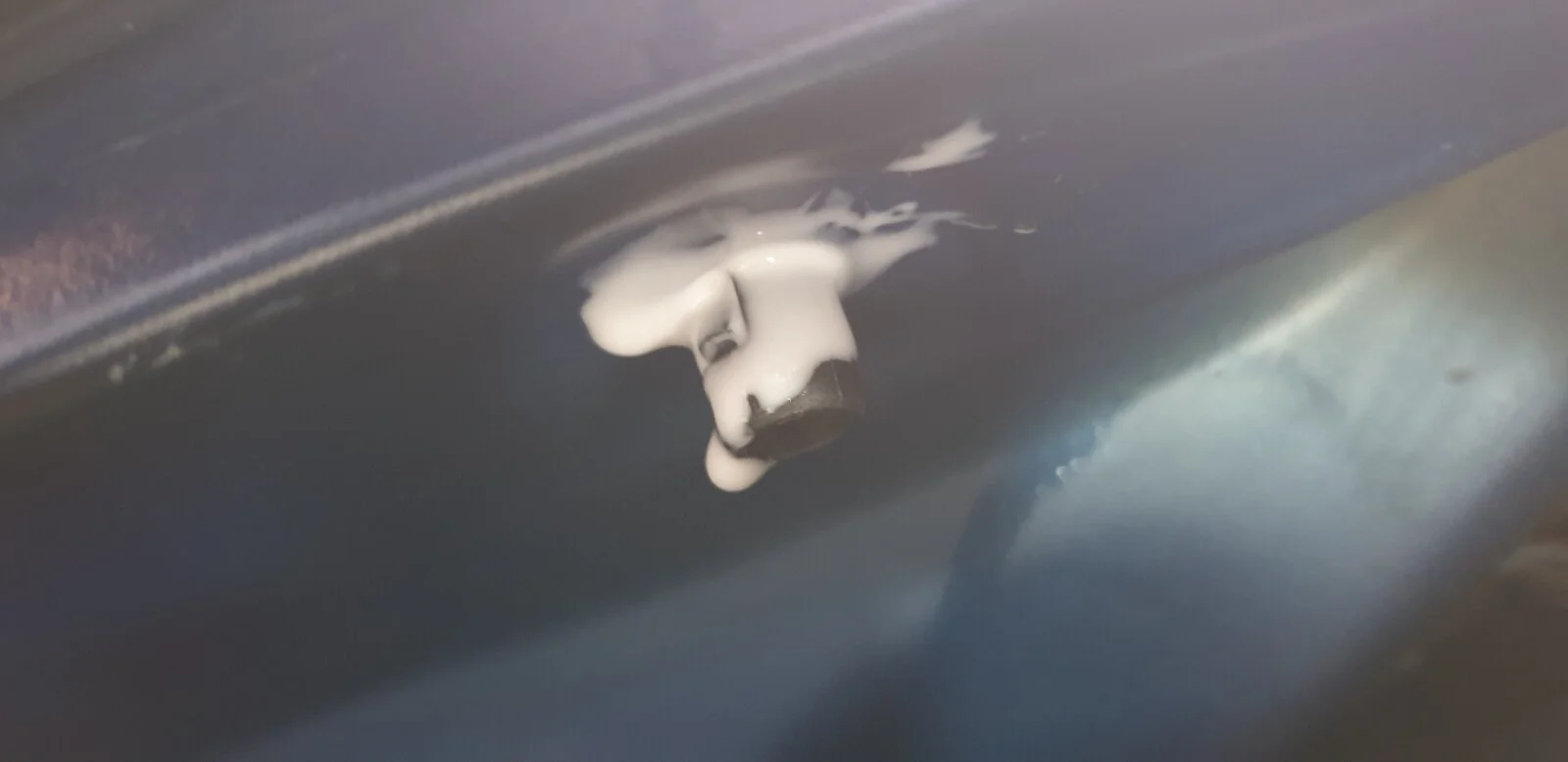

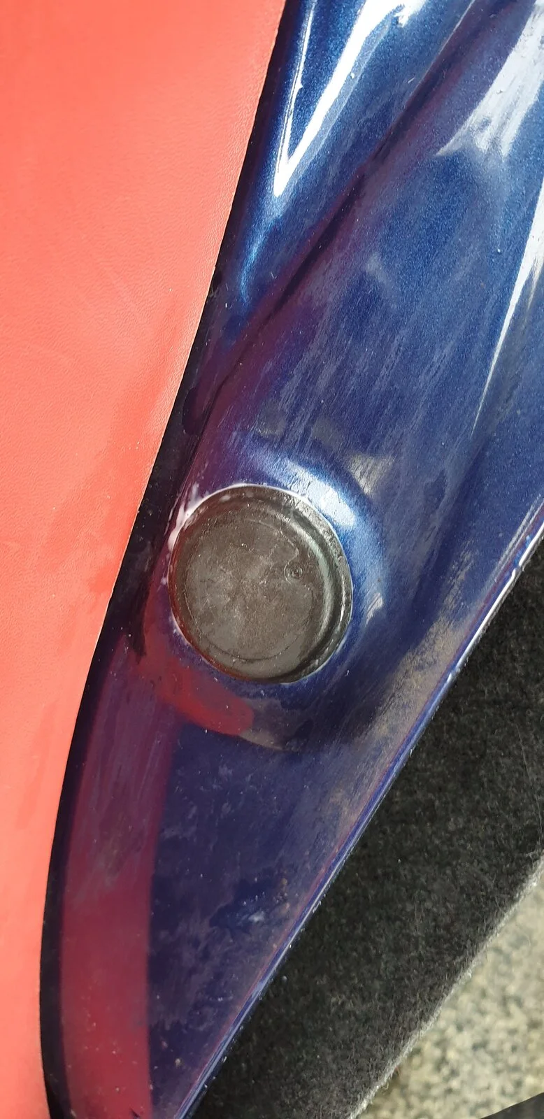

As with any Clio that hasn't had this mod done... they leak like a sieve
So I cummed on the grommets next to the rear lights to stop a pond filling my car

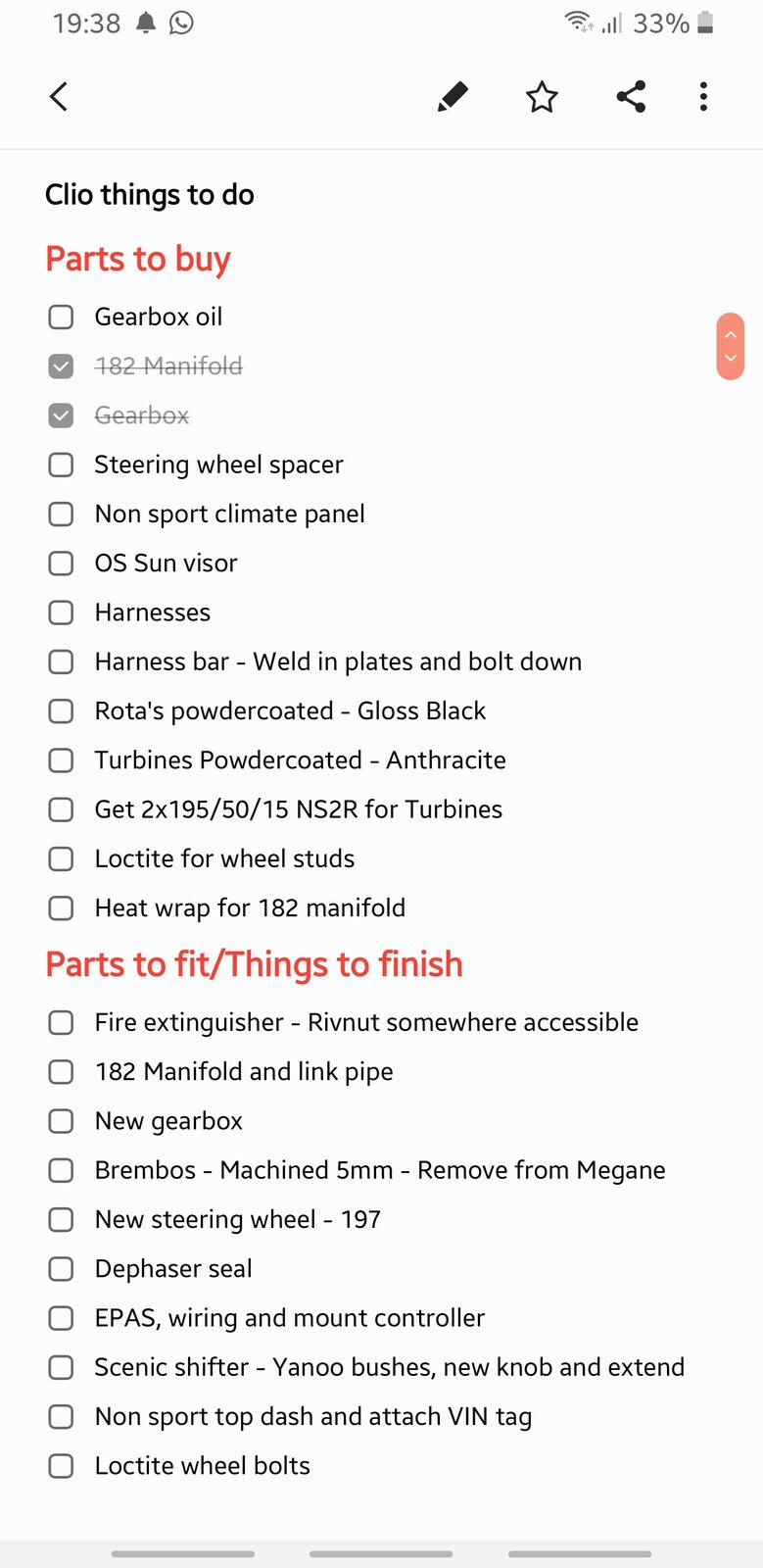

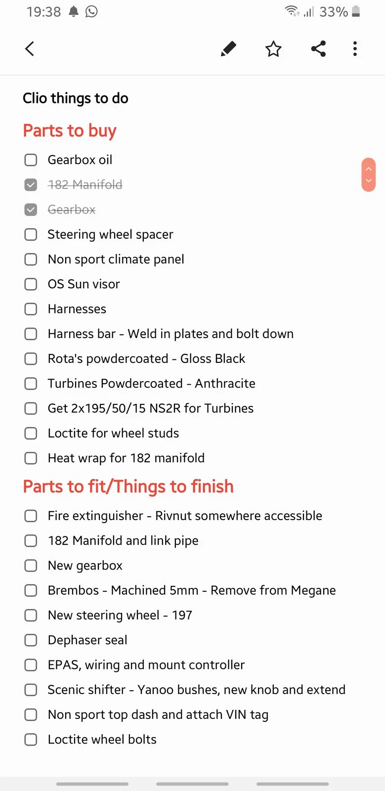

Really need to pull my finger out and get s**t sorted with the car. List of things to do is as follows
Theres no doubt I've forgotten something so the list will only grow more

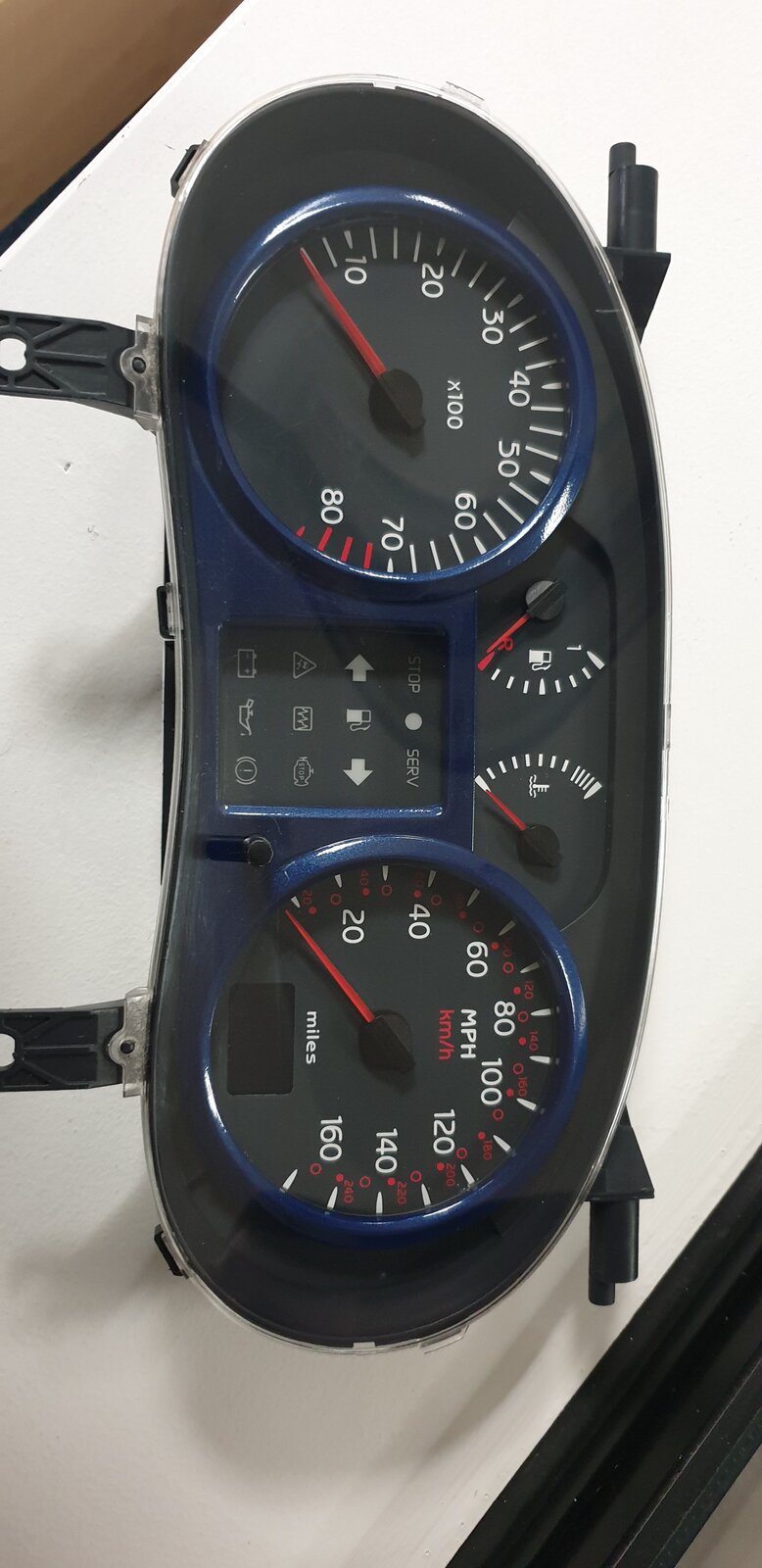

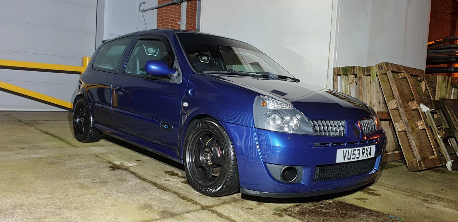

A while back I painted some spare shitty dash strips in Monaco blue. I painted the spare dial surround I had too, Monaco is a proper nice colour!
Just been keeping it clean for the past few months, cant be arsed doing any big jobs on it
Might give it a machine polish this weekend while I'm at work. Nothing better to do and it desperately needs one!
