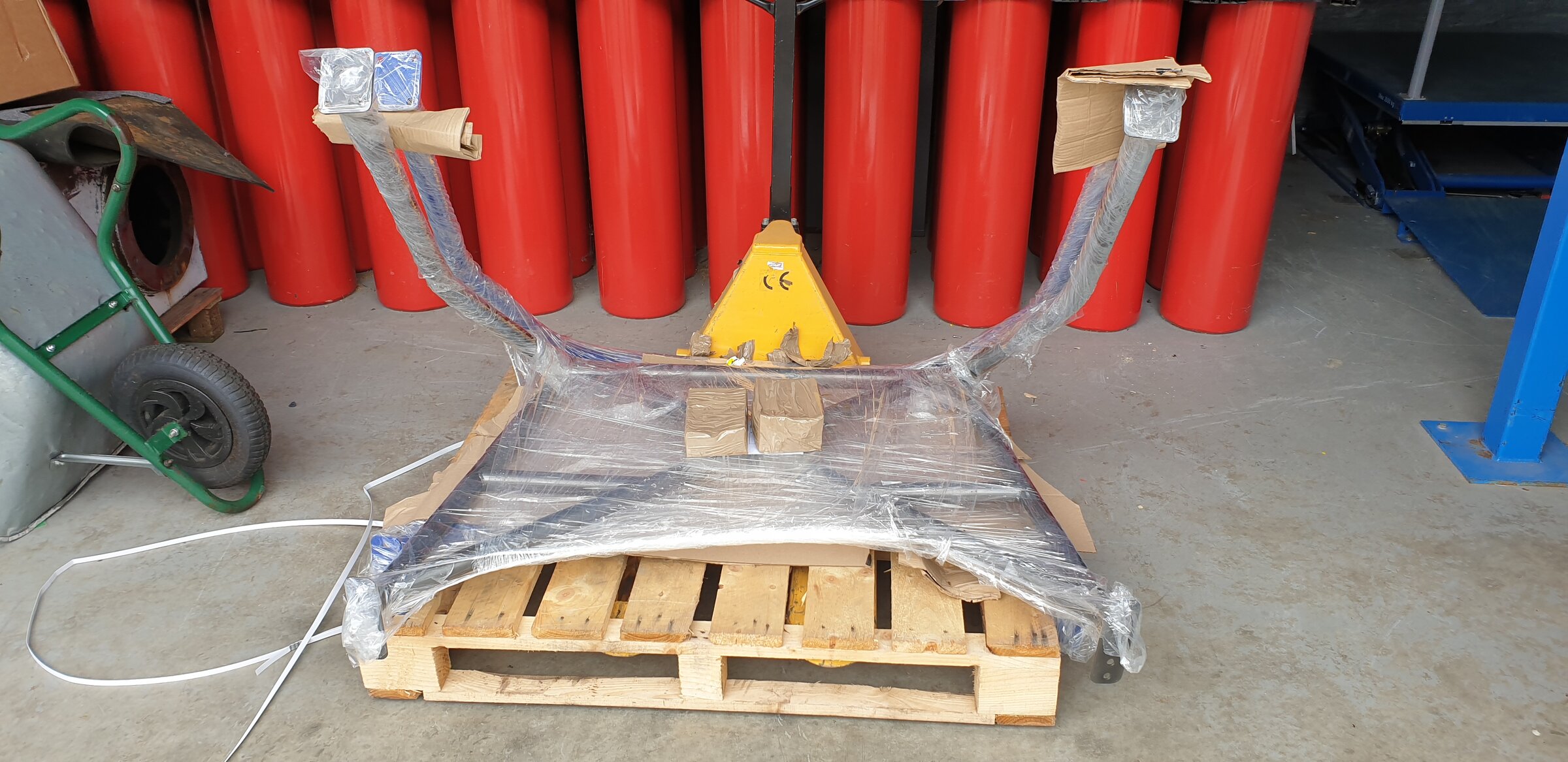

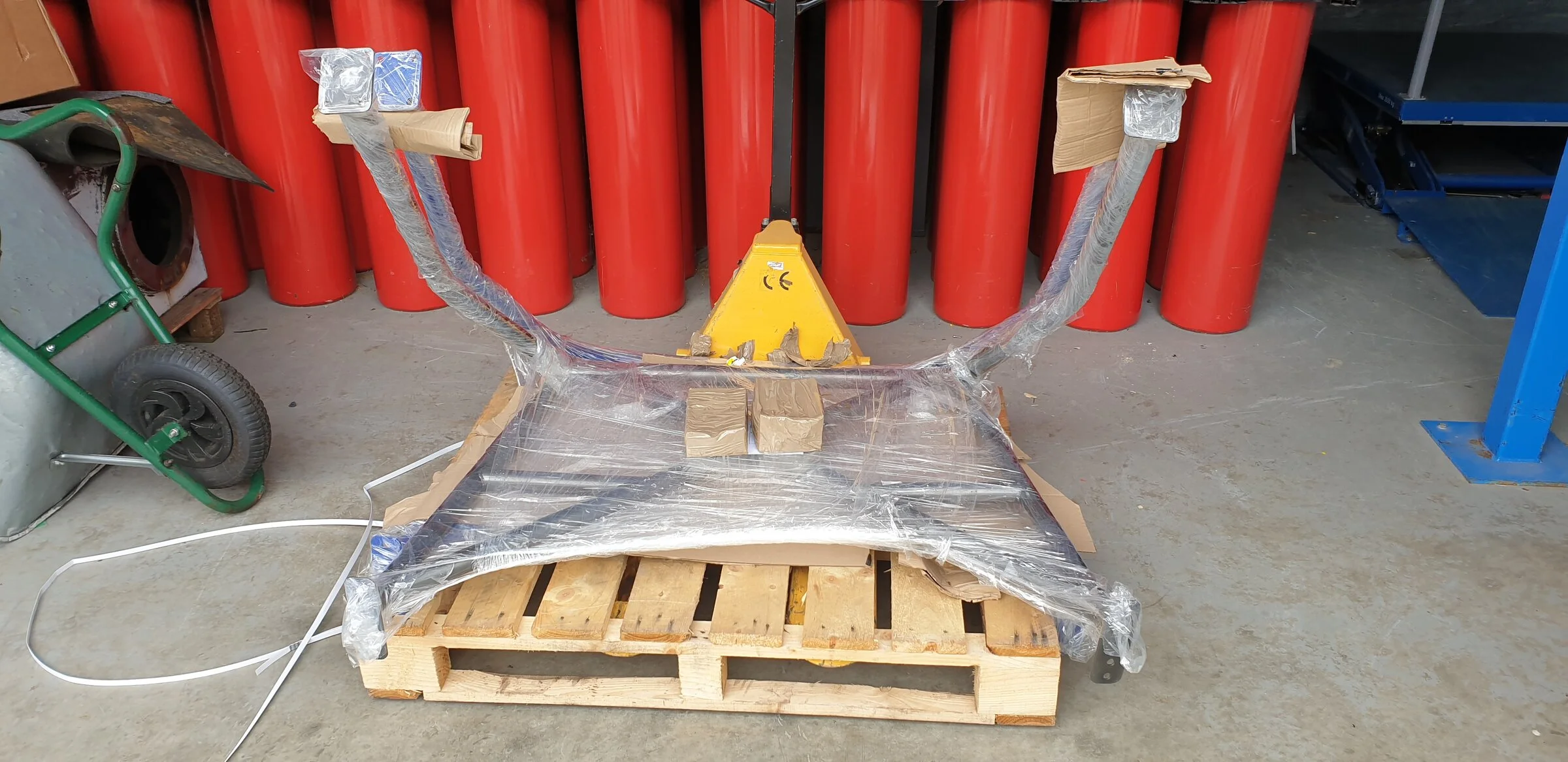

Got a nice delivery the other day

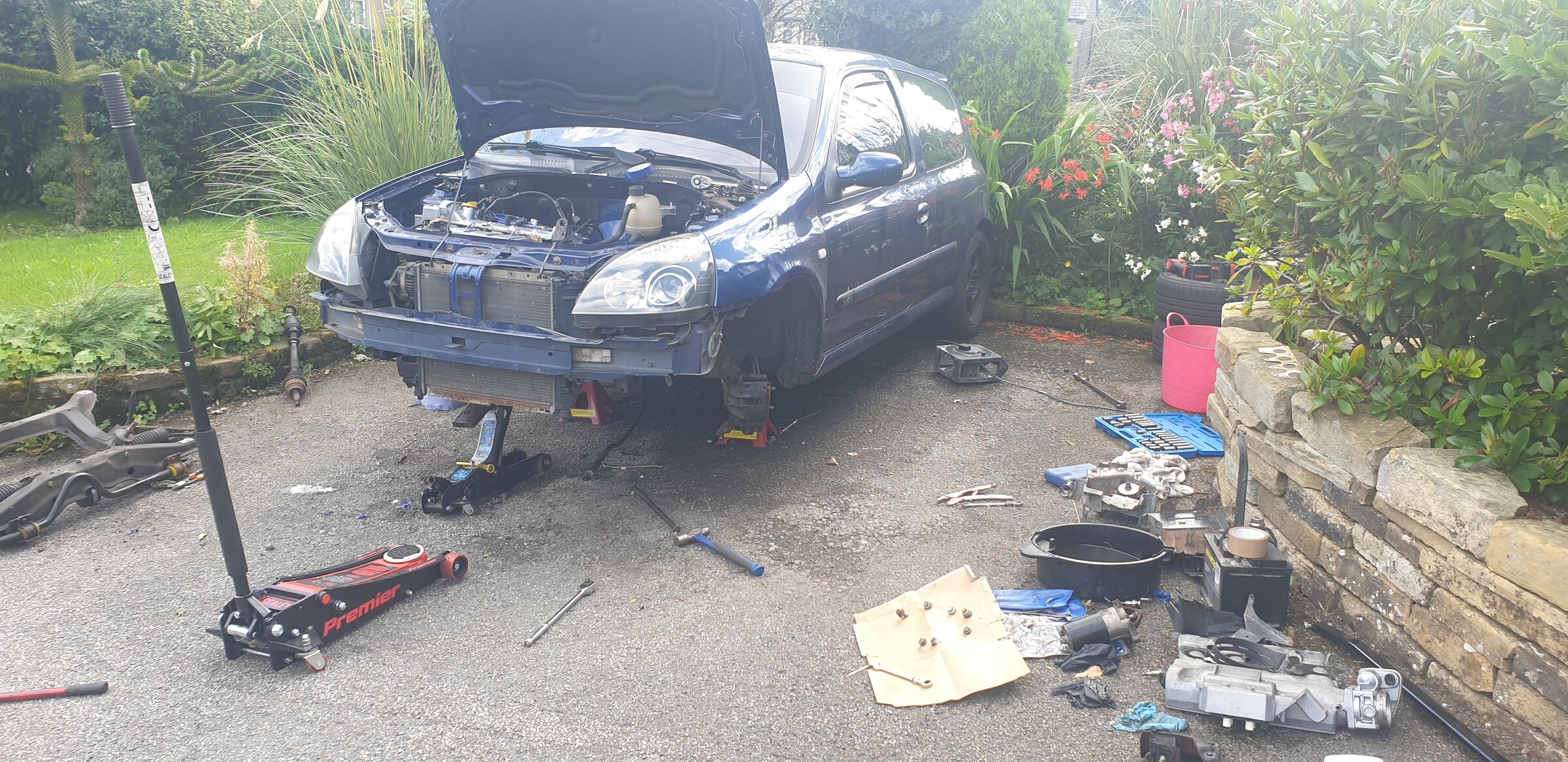

Part 1

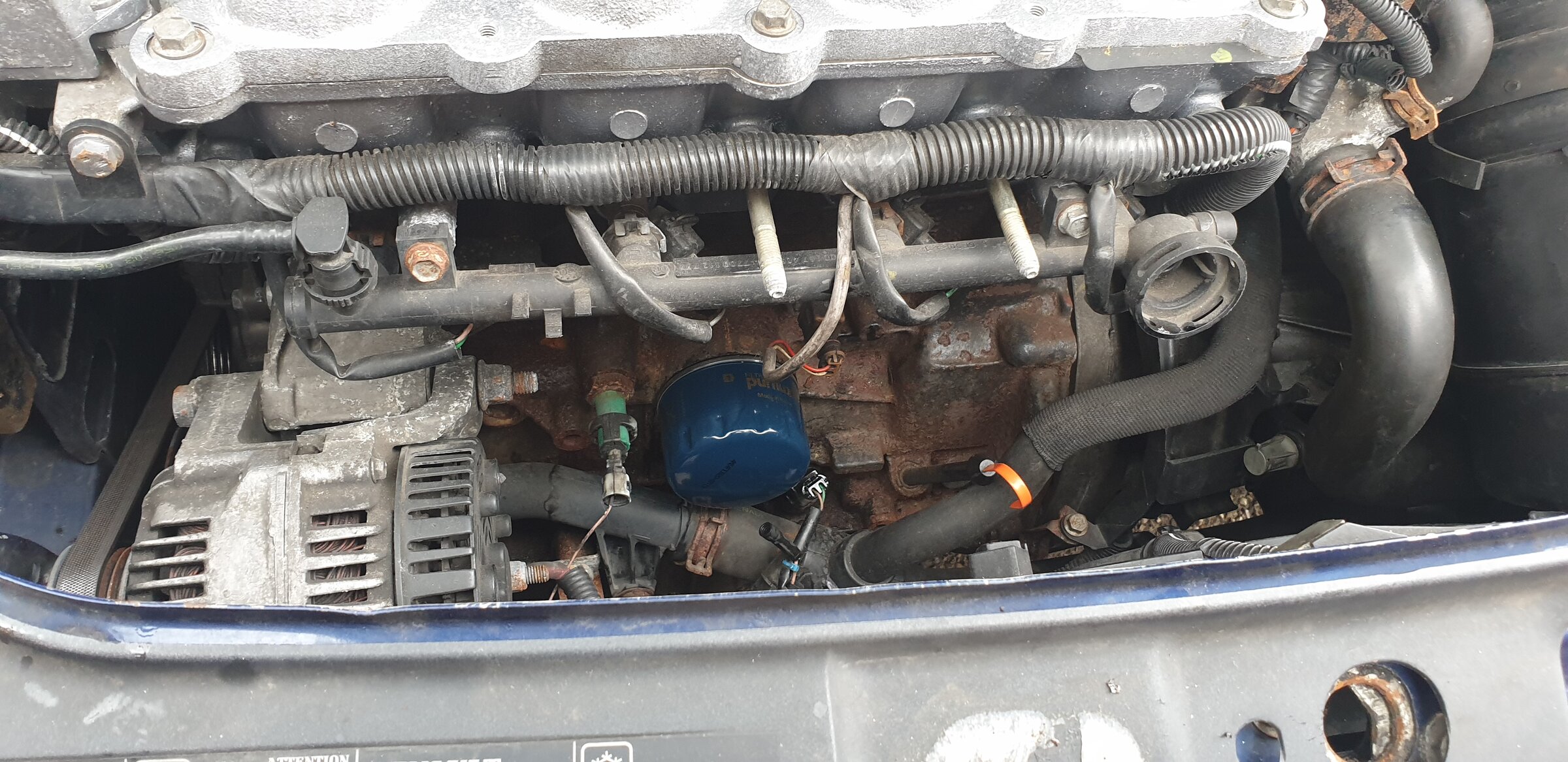

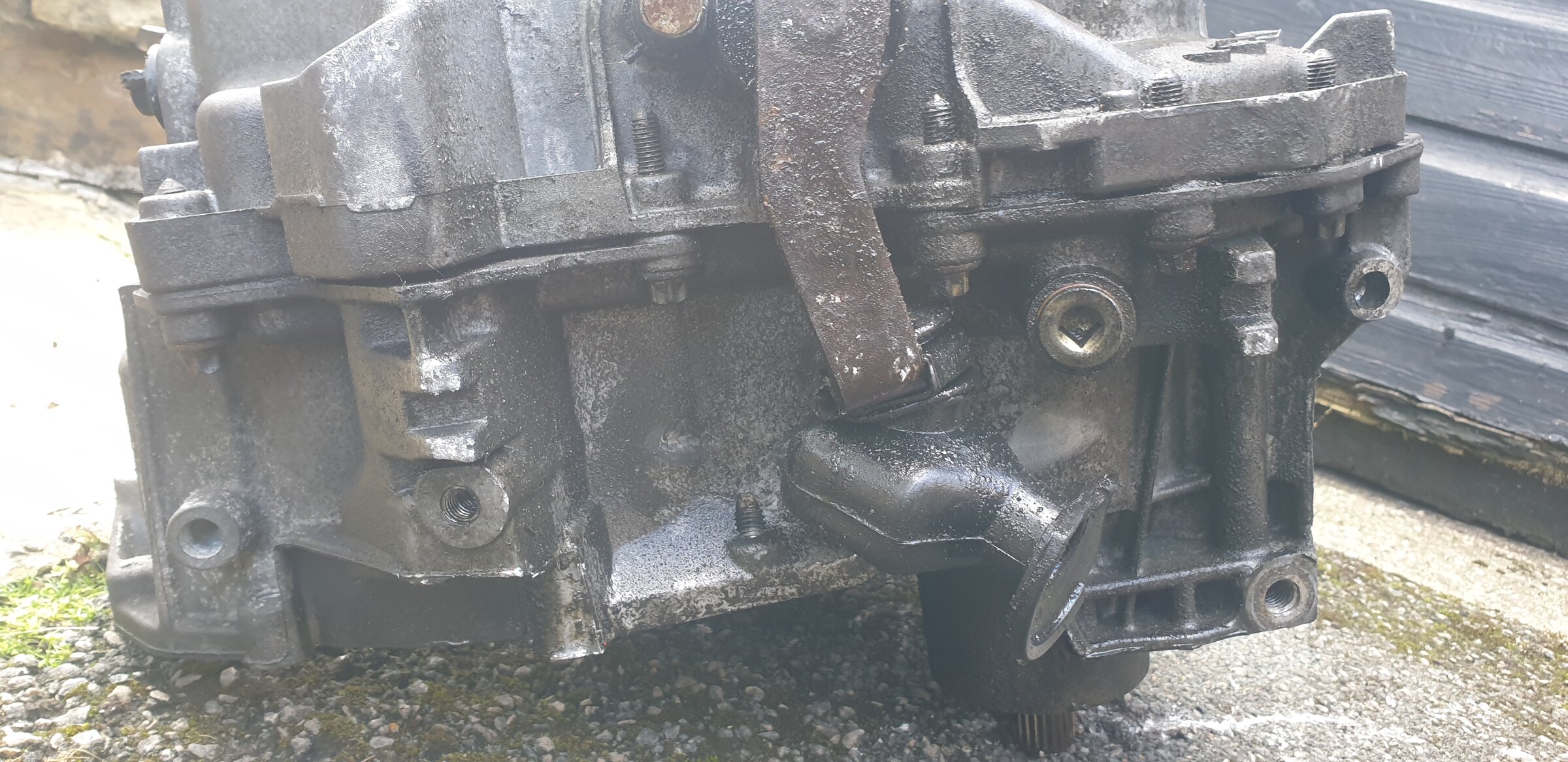

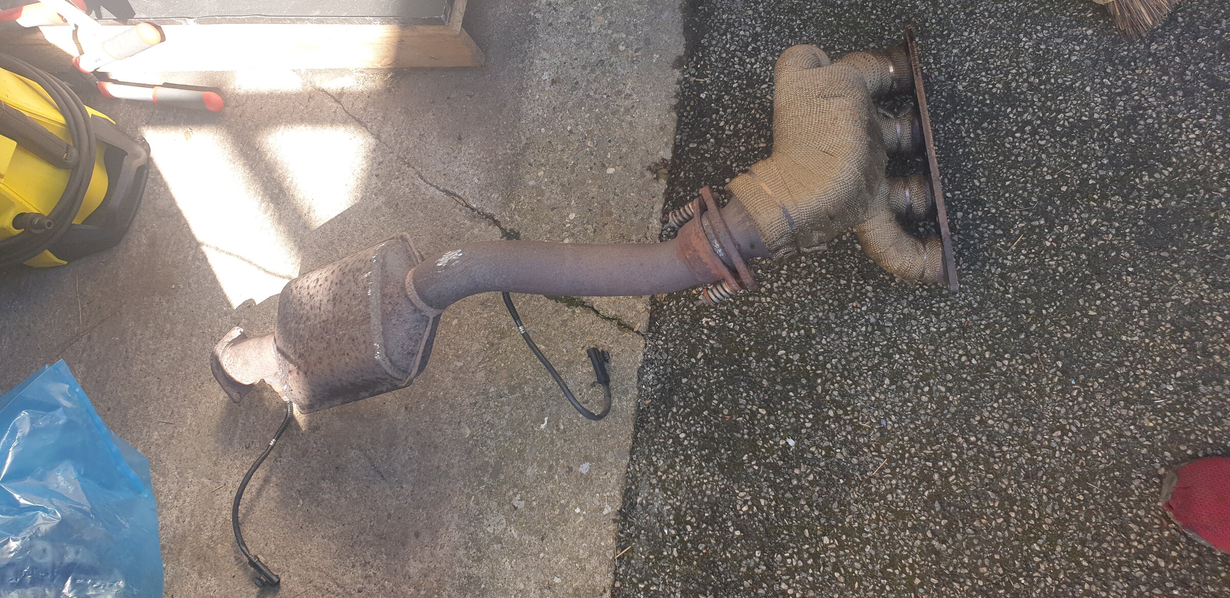

Stripped the gearbox, manifold and cat off the other day. On the passenger side the selector seal had coated that side and my CV on the other side had just decided to exit all the grease onto the block and everything else in sight. After a few hours I had the subframe off, box out and the manifold and cat out
Considering the car has only been together for 1 year and less than 4k miles this is what I looked like after 3 f**king hours of tinkering!

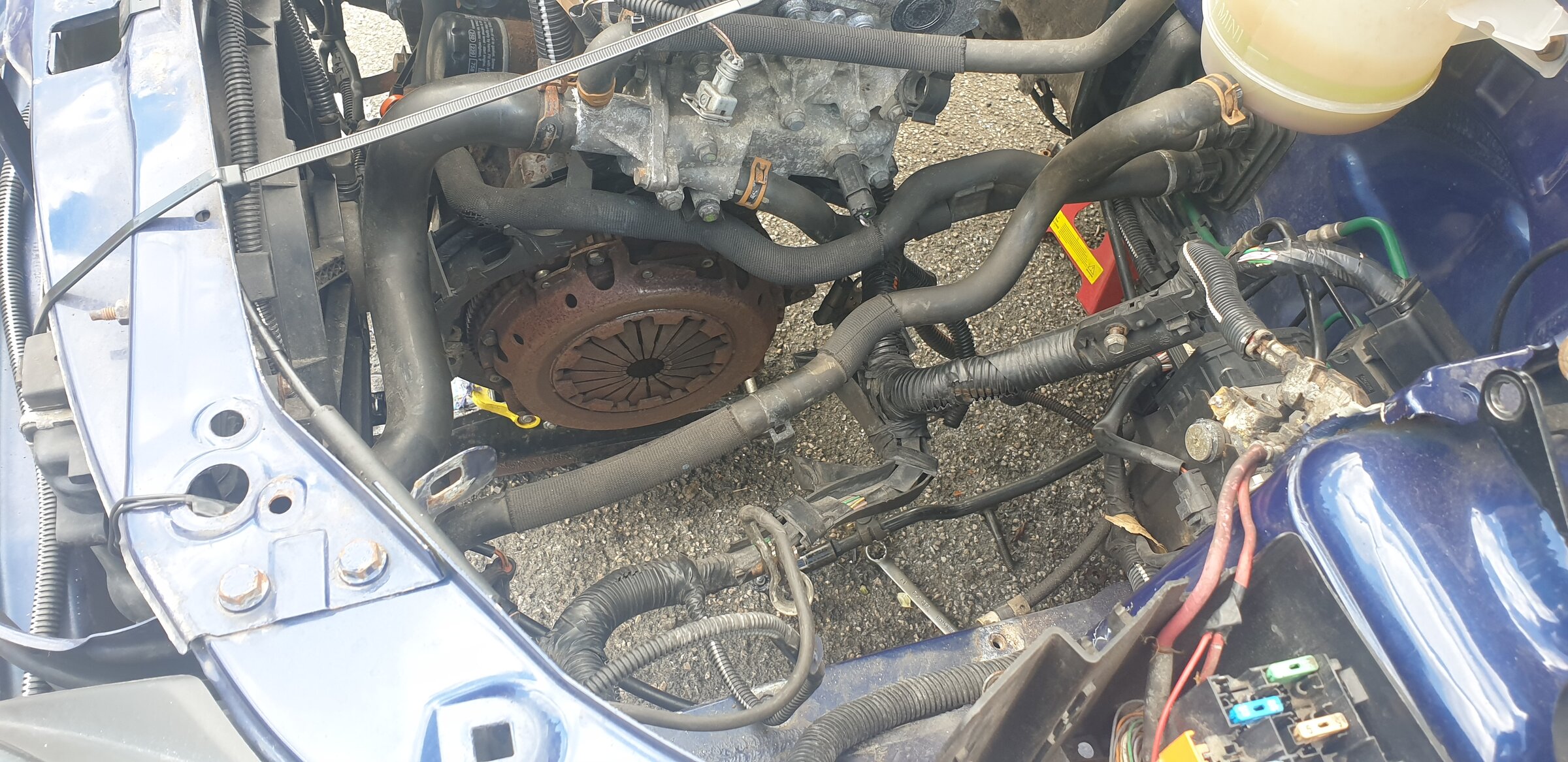

Box out
The clutch is still completely fine for now, its not a hard job to remove the box and change the clutch so I'm not worried about it. Its standard power so it should cope. If not I have a few good used spares from cars I've stripped
Even after a mere 4 hours it looked like a bomb went off

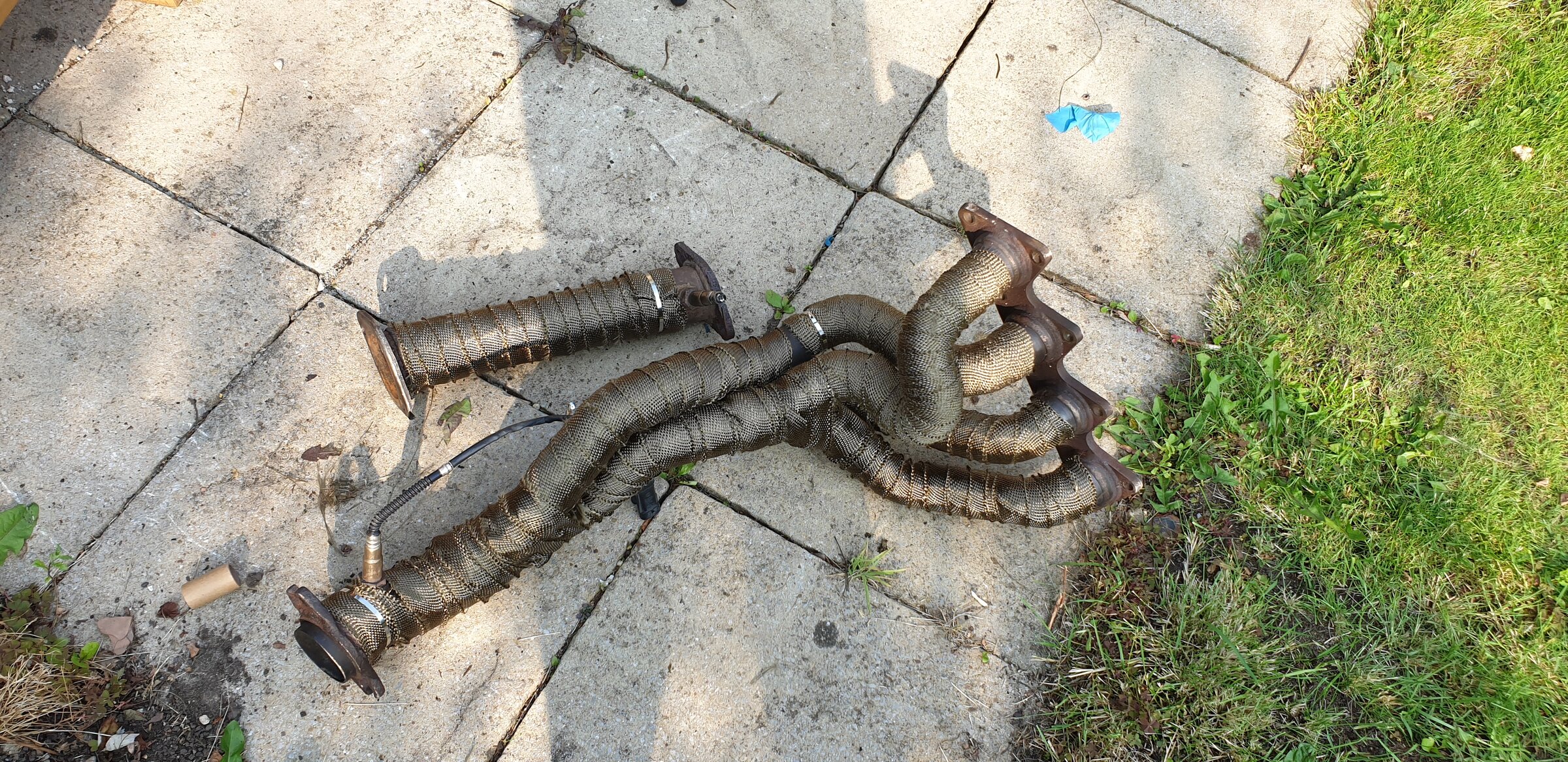

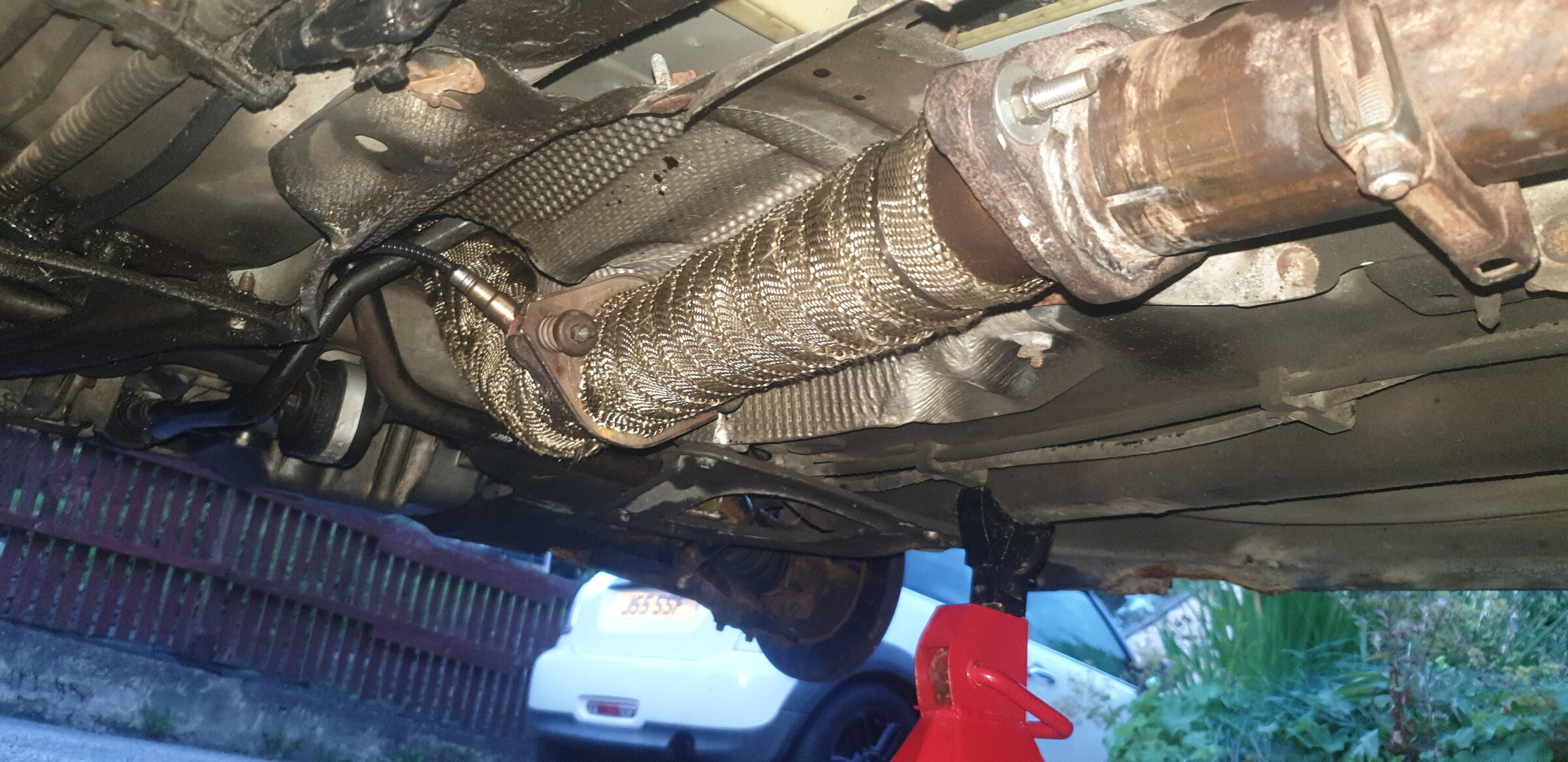

I heat wrapped my exhaust manifold and link pipe... I did this mid August on the hottest day of the year so far🤦‍♂️😂 Shorts and a vest wasnt a good idea because I felt like a leper afterwards
This came off, the exhaust wrap does actually work. Engine bay temps were reduced in comparison to a standard manifold, tested using a Fluke temp gun too so not just a guess. For the sake of £20 its a good way of not melting stuff. The all important cat departed which will pay for other things👀

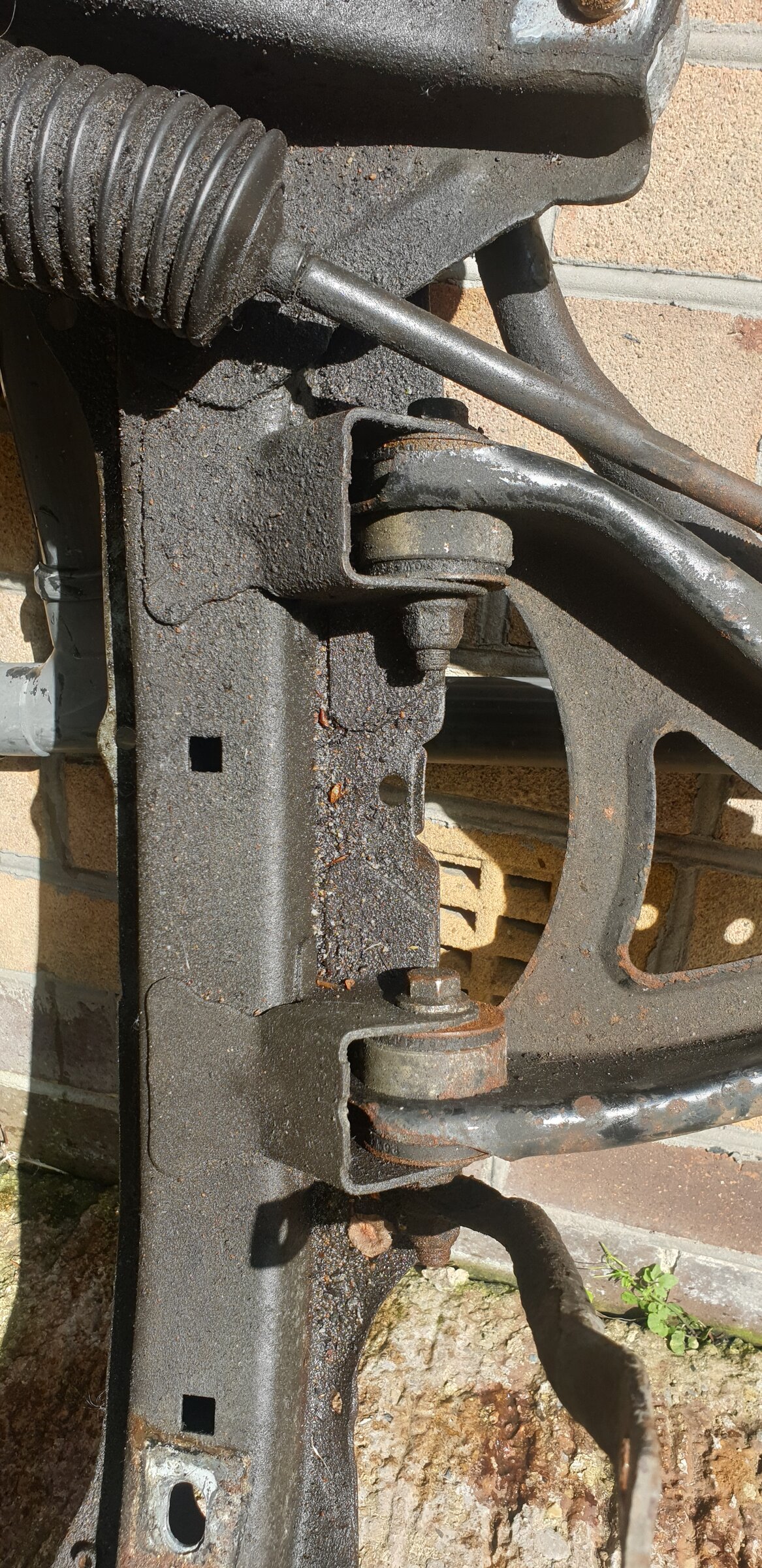

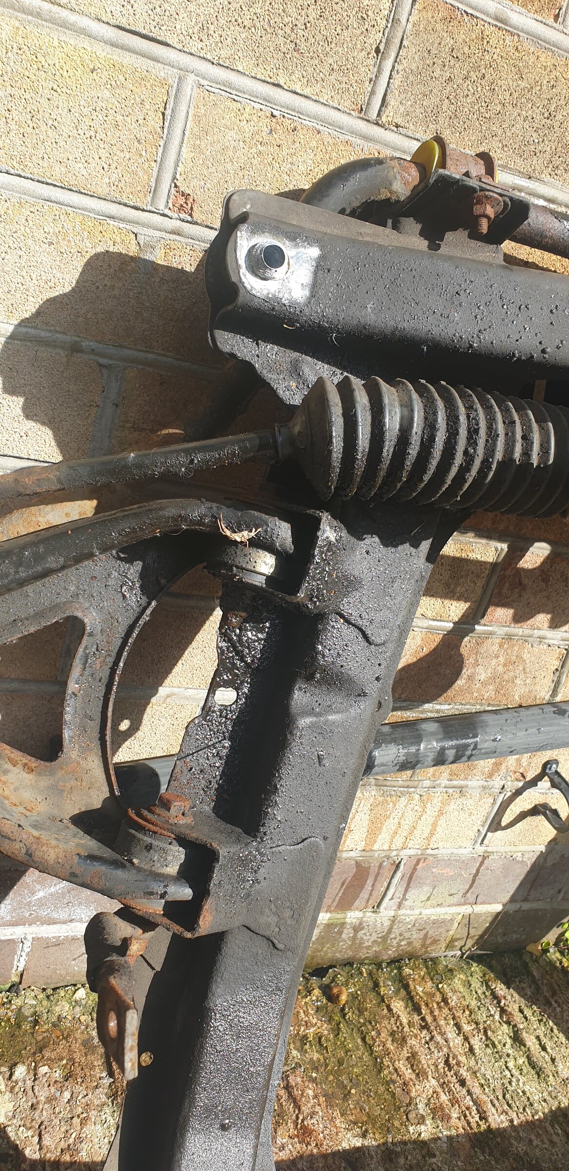

State of the subframe. Bearing in mind I cleaned this 1 YEAR AGO! That much f**king oil and grease on it Donald Trump declared war on it ffs
I manhandled the box into place, it slid on first time with no issue what so ever. Obviously I got nervous, pulled it back off again to check if the release bearing was sitting properly😂 It was, I was just being a paranoid weirdo but its better to be paranoid than bolt it all back up, press the clutch and hear a slight clunk😢

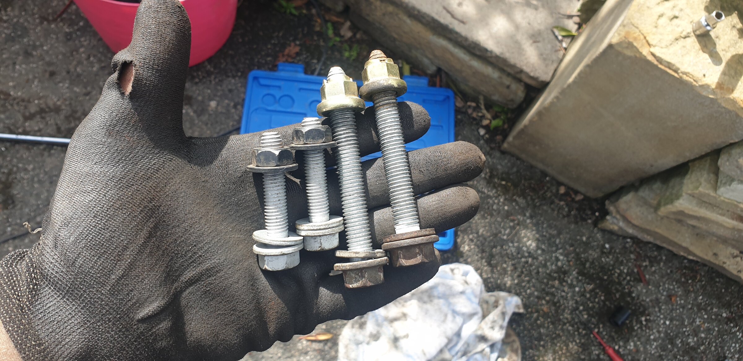

My subframe bolts were crusty so I checked my bolt buckets, found some MK3 Clio subframe bolts which were slightly longer but less fucked. I just used the standard nuts on the rear bolts though as they're mahoosive things. The front ones i just grabbed some other 10.9 grade bolts and some fresh nuts. If its good enough to hold a MK3 together then its good enough for a MK2
Standard amount of copper grease needed on a subframe bolt. It was carefully torqued to 16 ugga duggas on setting 2 of my Milwaukee gun (dont worry I spread that amount onto the other bolt too before you all cry)
State of the old box. Will keep as spares for when I get a diff, it looks nice in the garage next to the other 3 gearboxes I have in there 😂

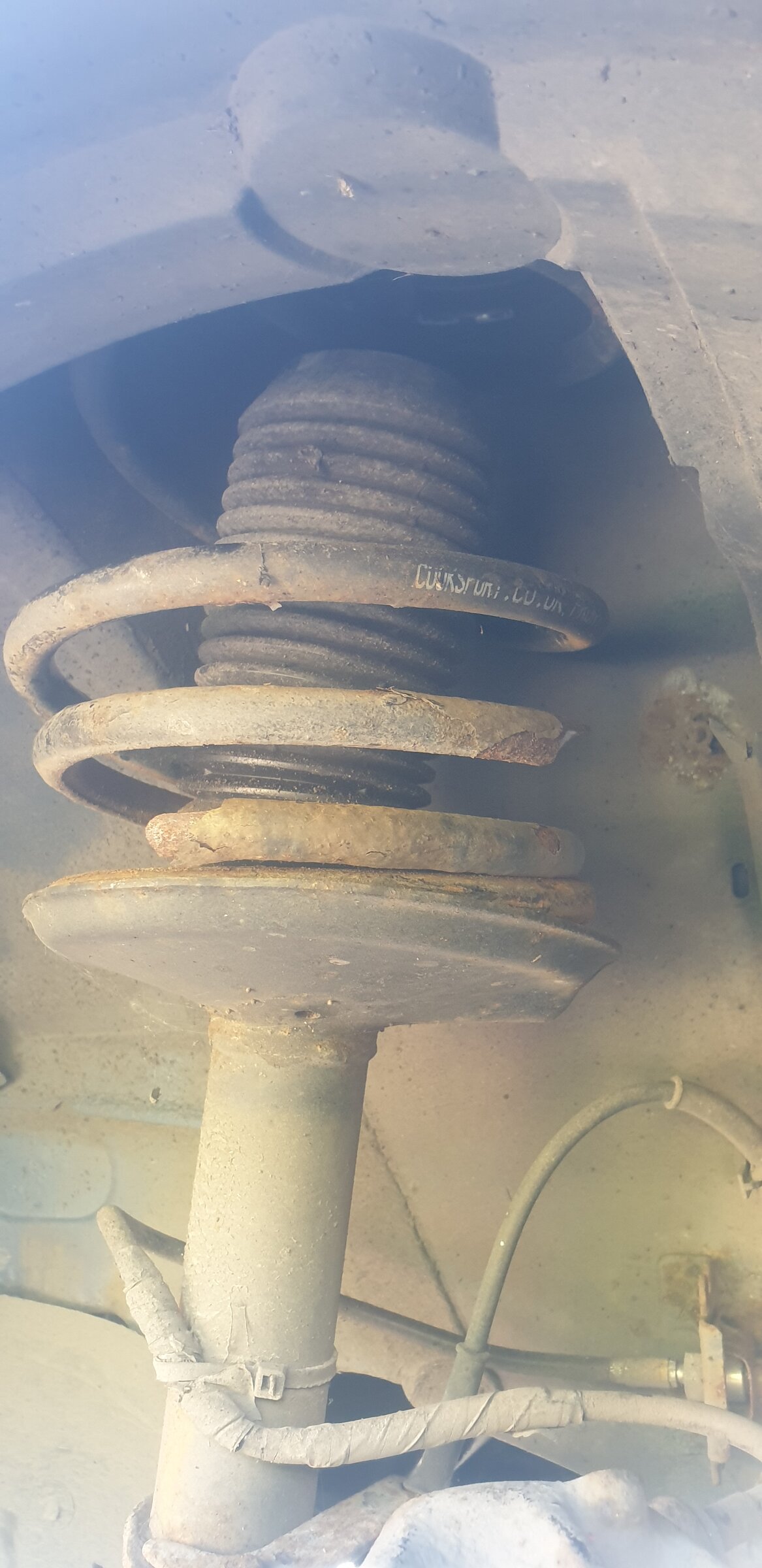

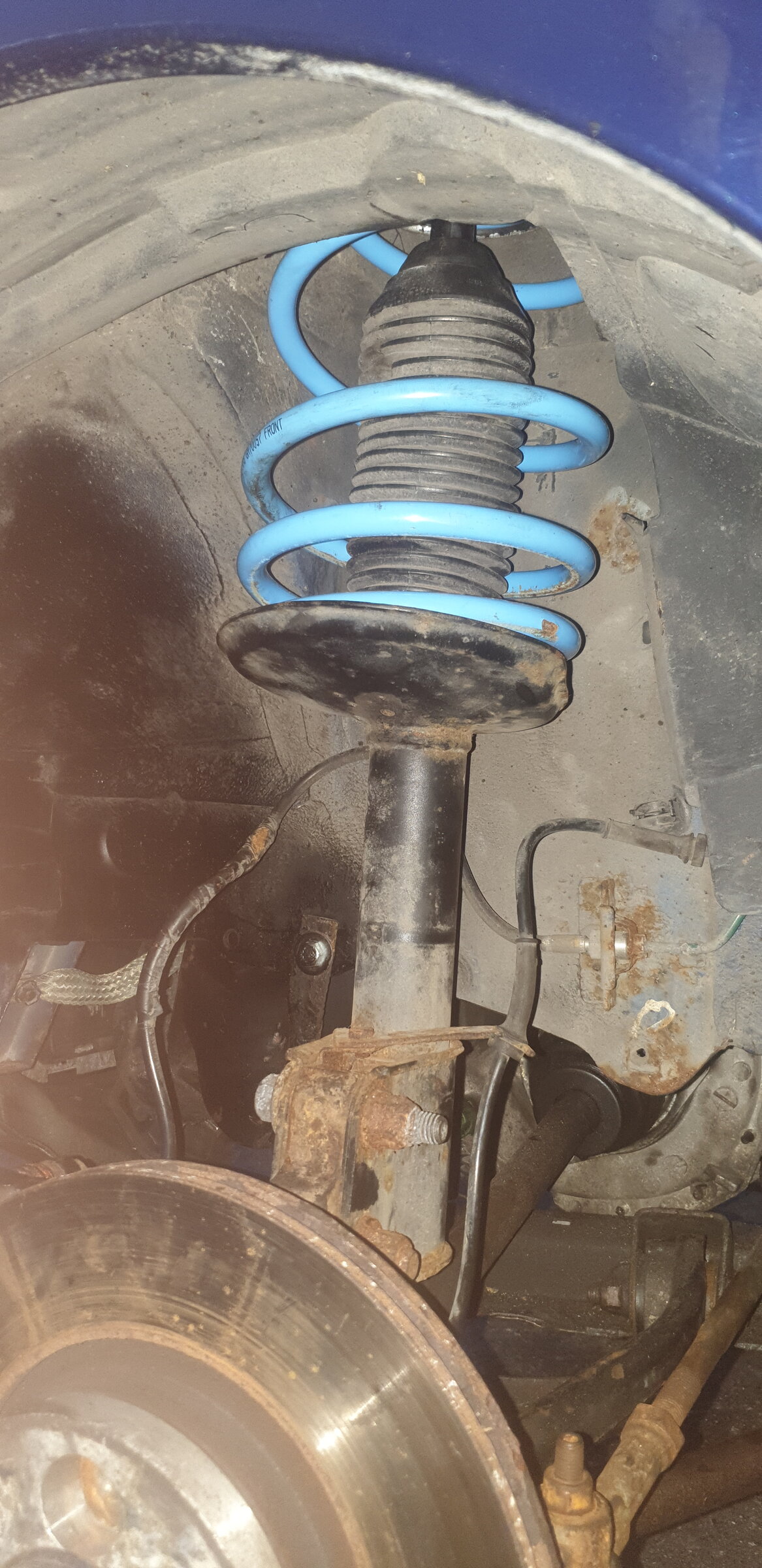

Whilst under the car I noticed this
No not the cable tied brake line @Louis! Pretty sure that spring aint meant to look like that🤔
Swapped all my springs for some Grams ones i had in the garage

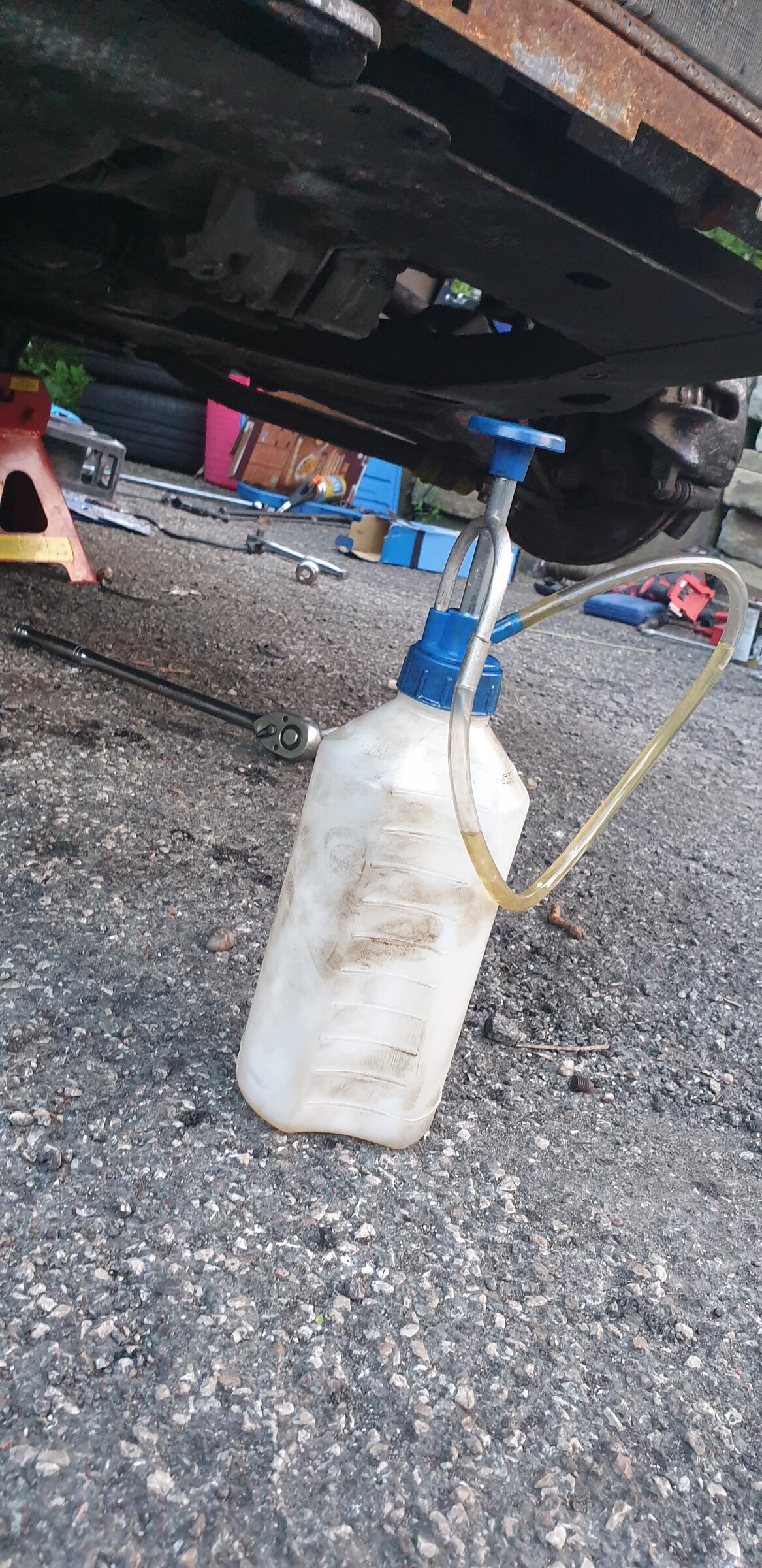

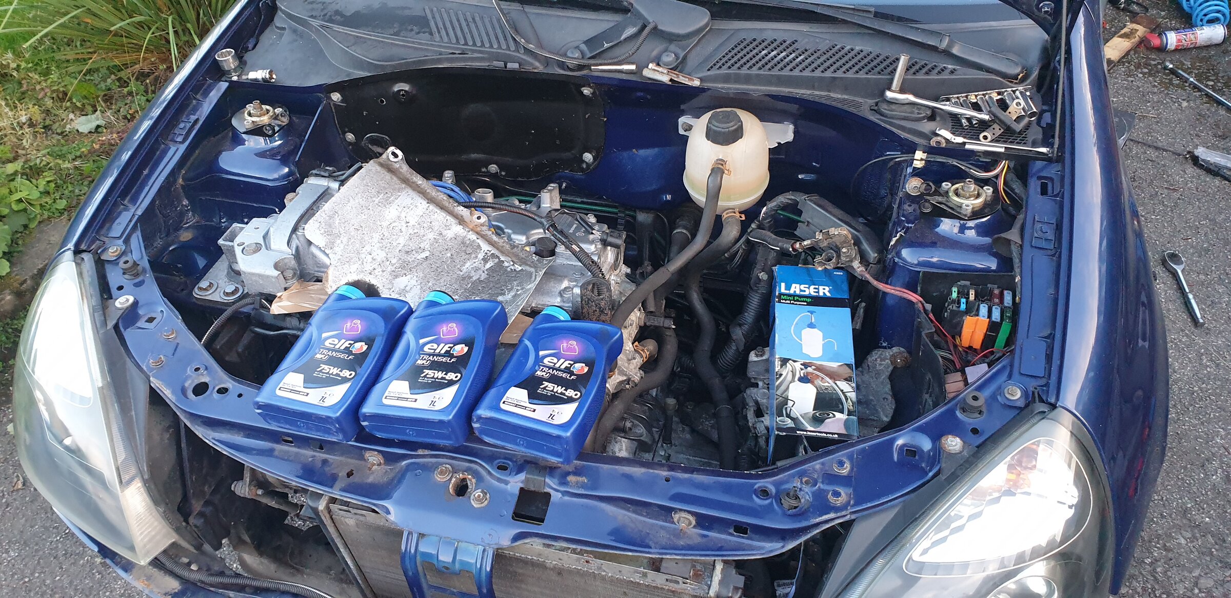

Filled the box up with standard NFJ
This is one of them tools worth its weigh in gold!! Took me all of 2 mins to put over 3l of oil in the box!

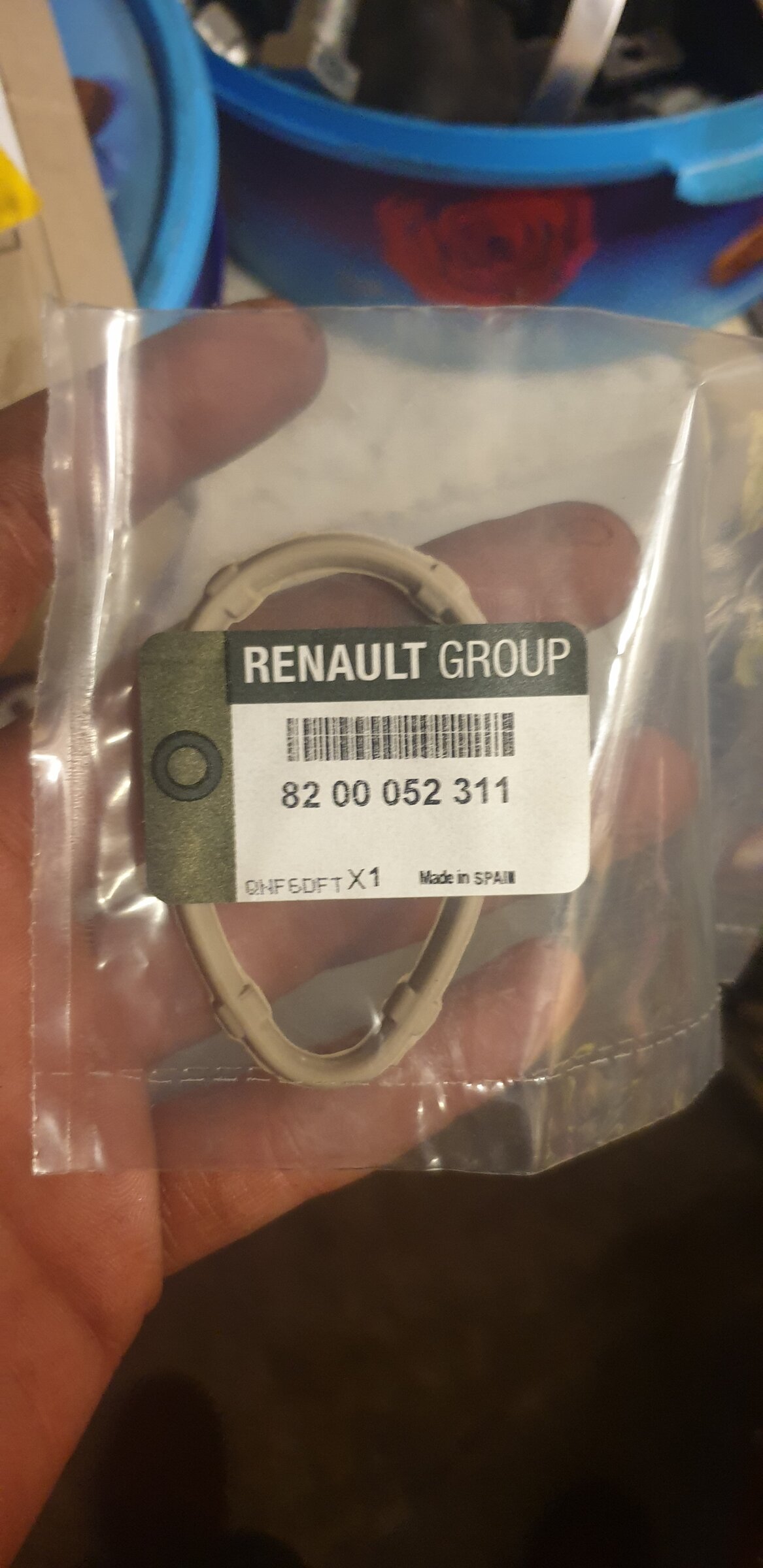

Fitted the inlet up with a new breather gasket, part nunber in the pic for anyone wanting one

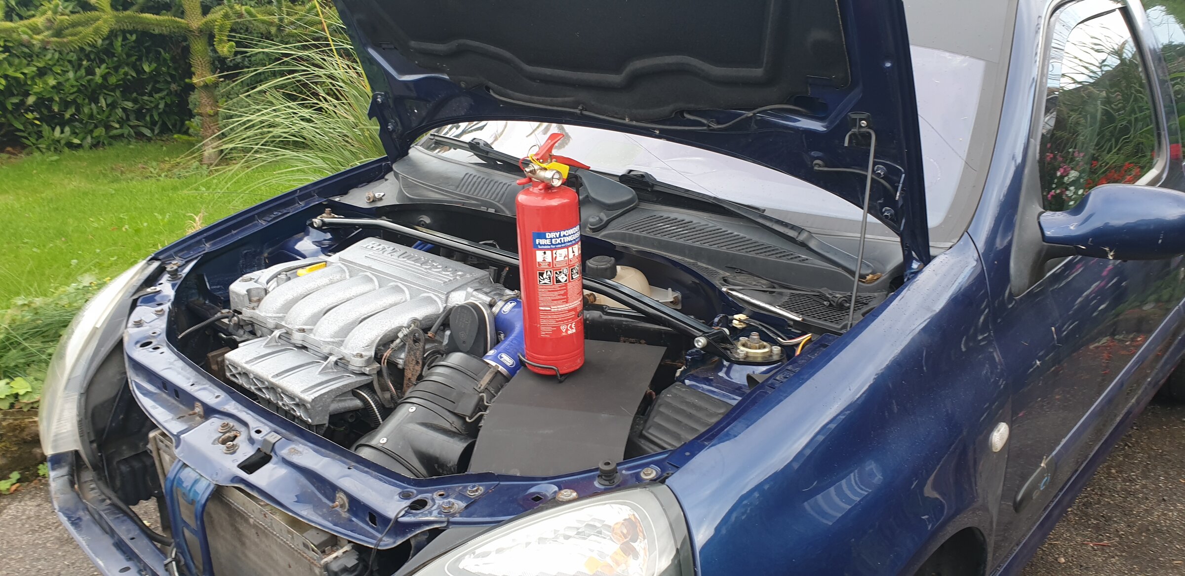

All back together and ready to fire... or maybe not fire... fingers crossed
Started like it was never apart, although my dash had other ideas🤔😂😂 ITS CHRRRIISSSSTMAAAASSSSS😂

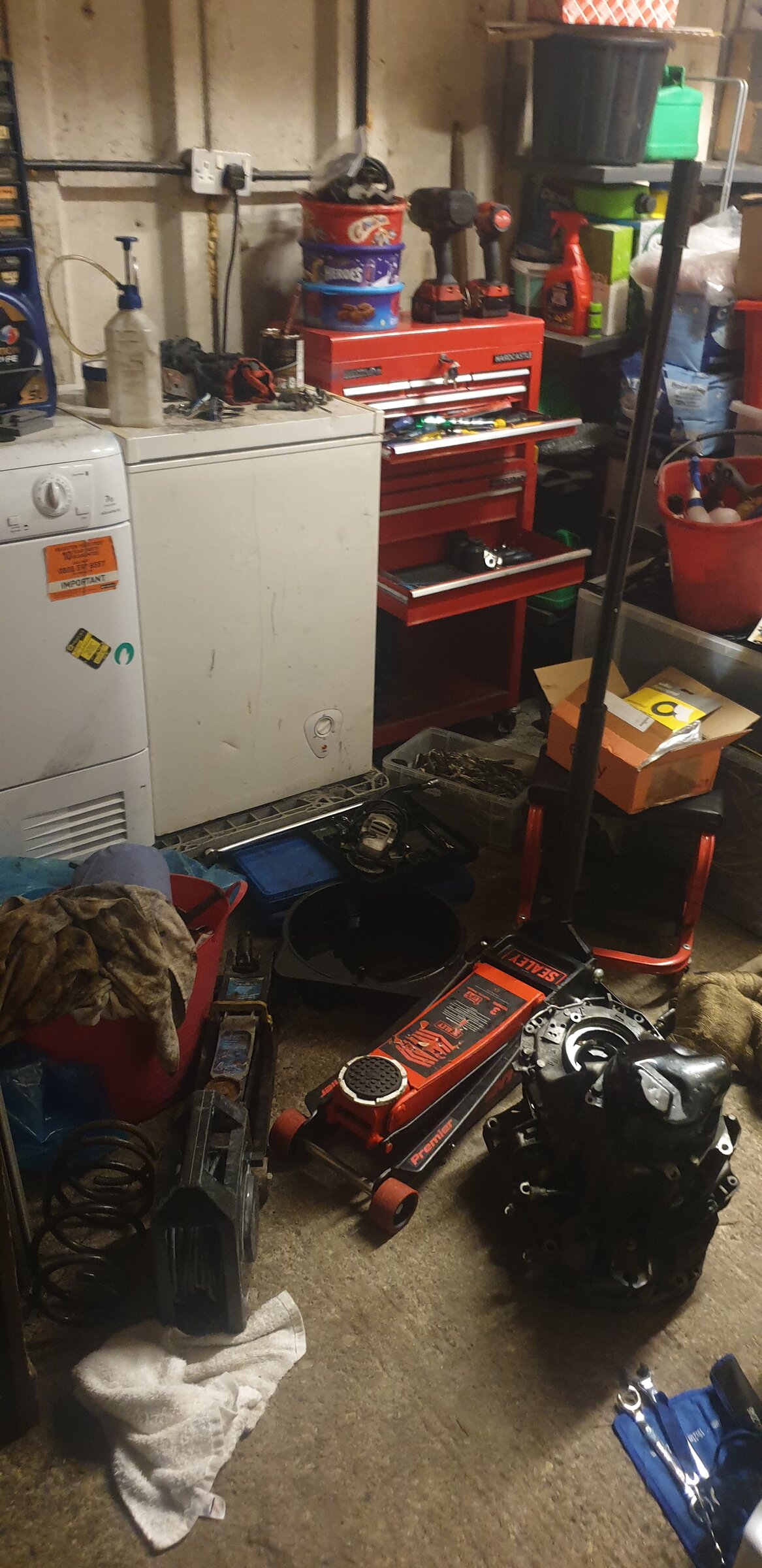

This was the state of the front section of my garage afterwards, absolute disarray. Nobody has time to tidy away after a long day. Just cheb everything in the pink bucket and shut the door😂

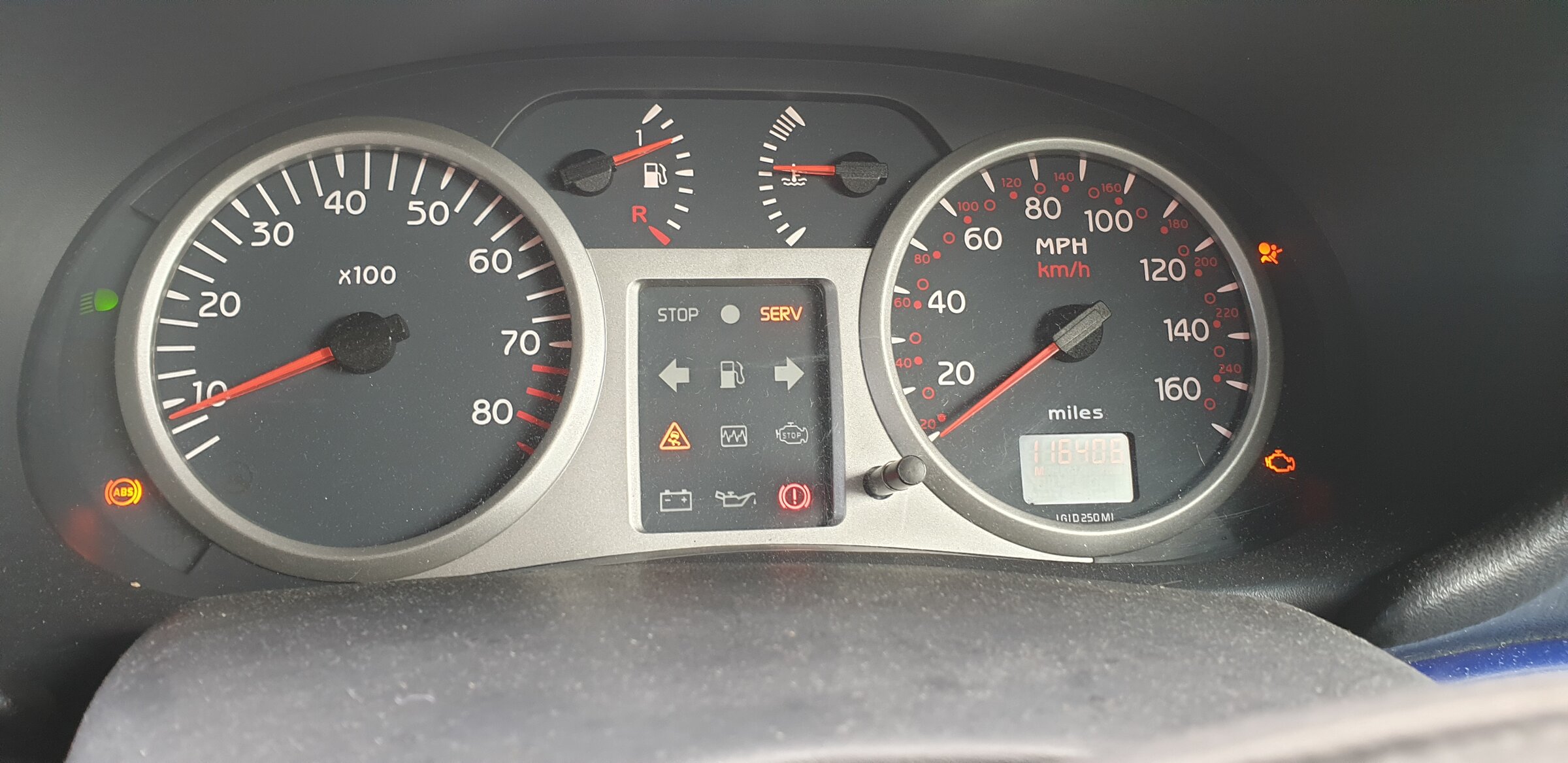

Did you sort out all the lights?
Some, EML was because of the decat which has gone off, ABS has gone of since driving it but airbag, TC and serv were on before because my angle sensor is a dick and my steering wheel airbag is a shithouse😂😂 Ive got an RS Tuner with all modules but need CLIP to reset the angle value

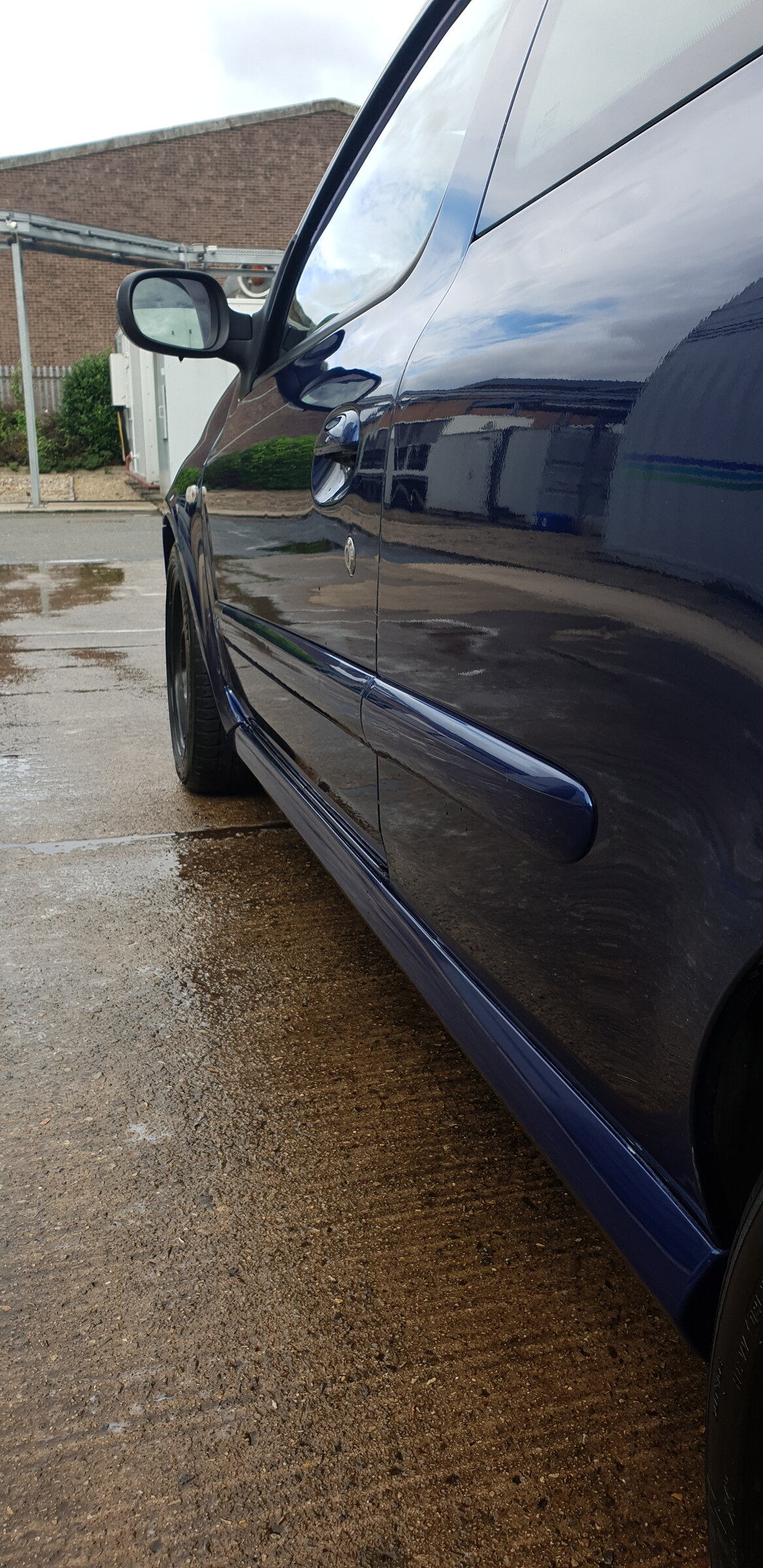

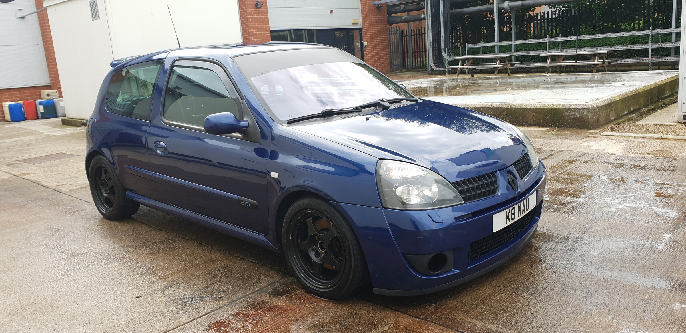

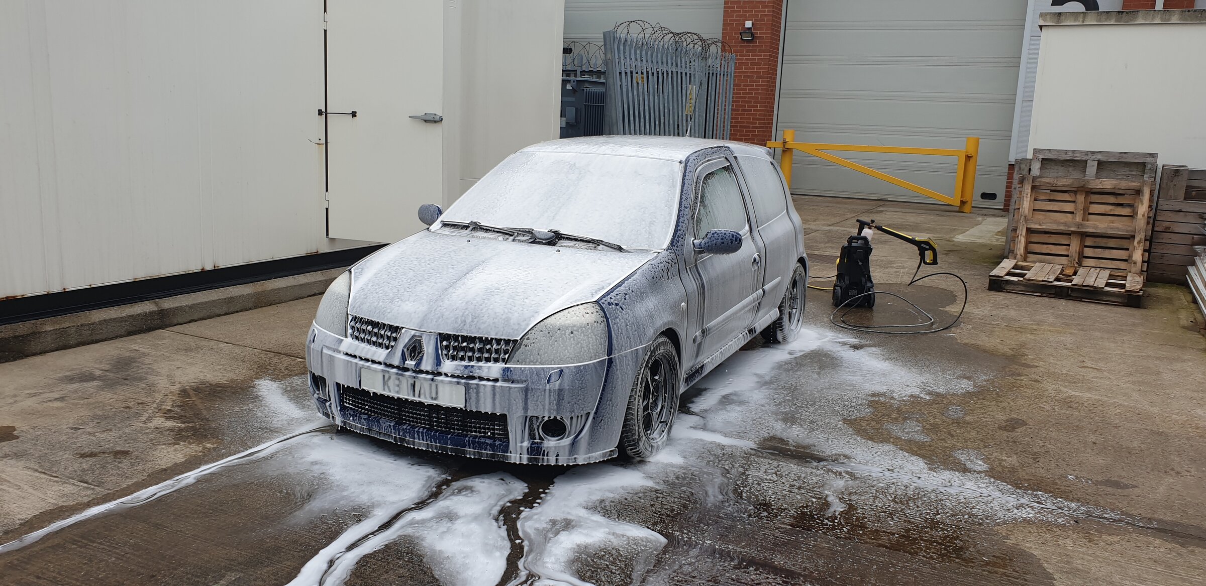

Gave it a wash, it had been sat for 2 months unloved

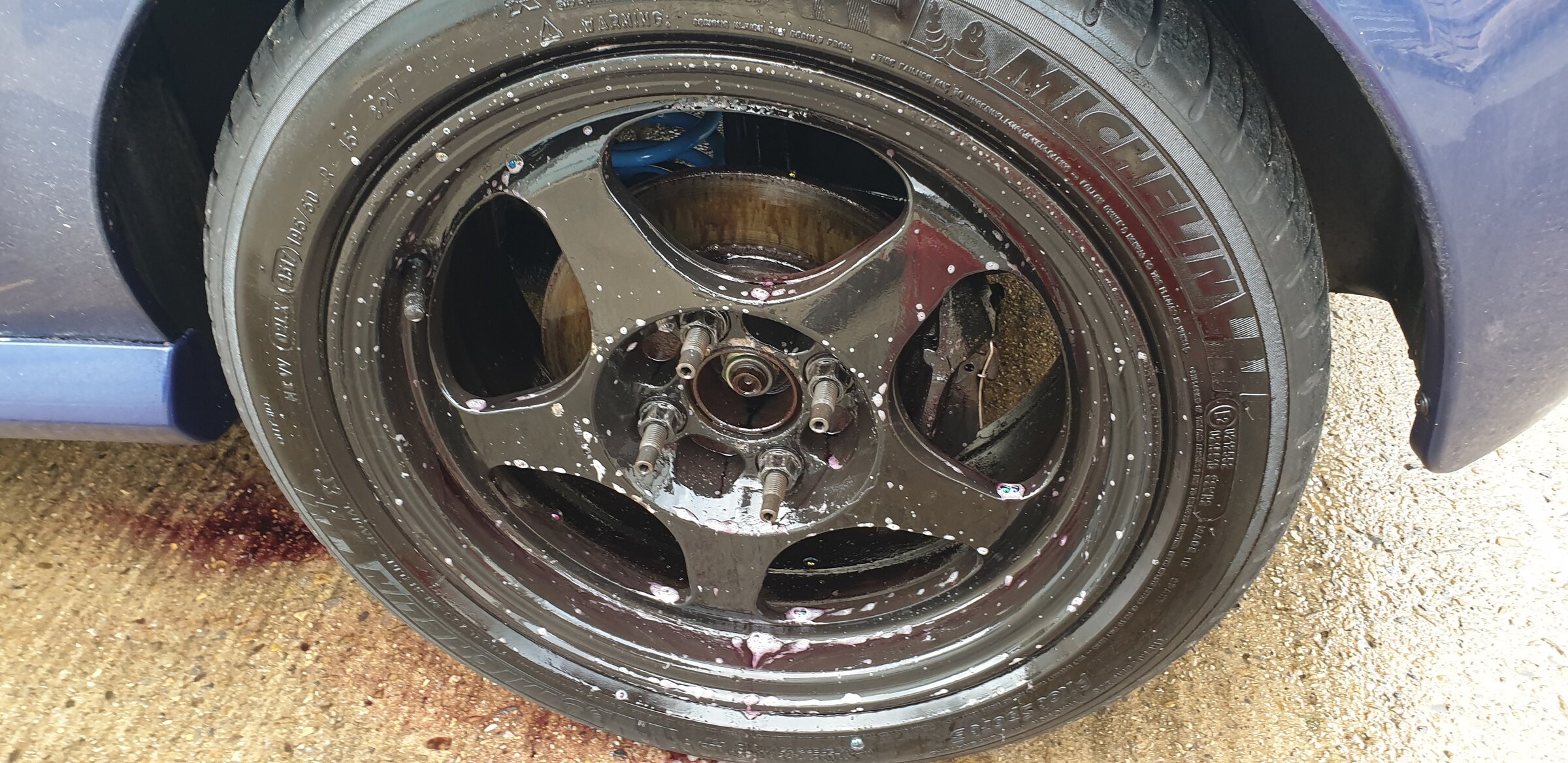

Need to get these Rota's powdercoated, I painted them in my garden whilst I was hammered😂😂

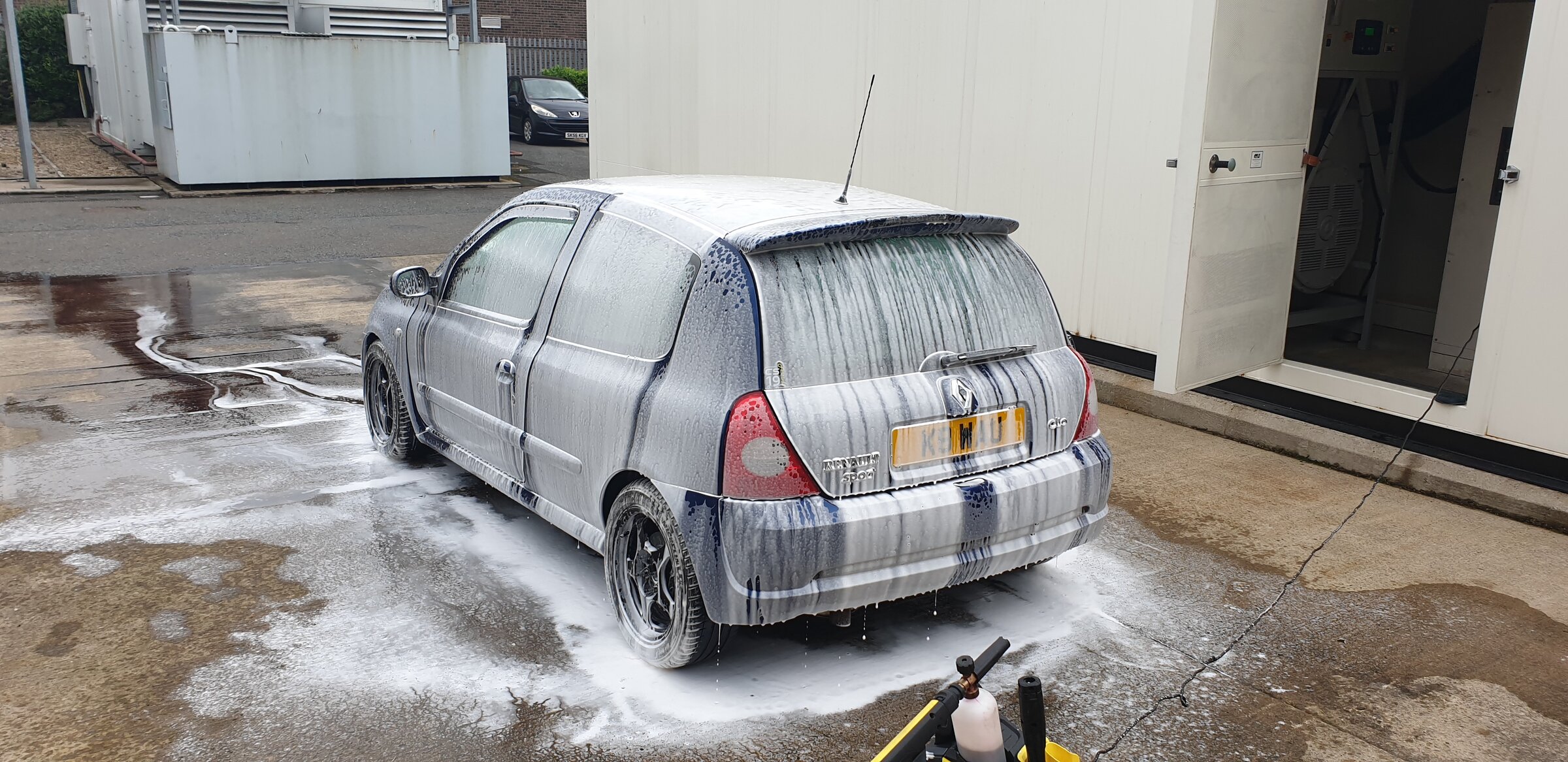

First time using Bilt Hamber auto foam. Properly good stuff, way better than the last s**t I used!!
Used Sonax BSD as a drying aid, works way better using it like that compared to using it on dry paintwork as it leaves a weird streaky residue

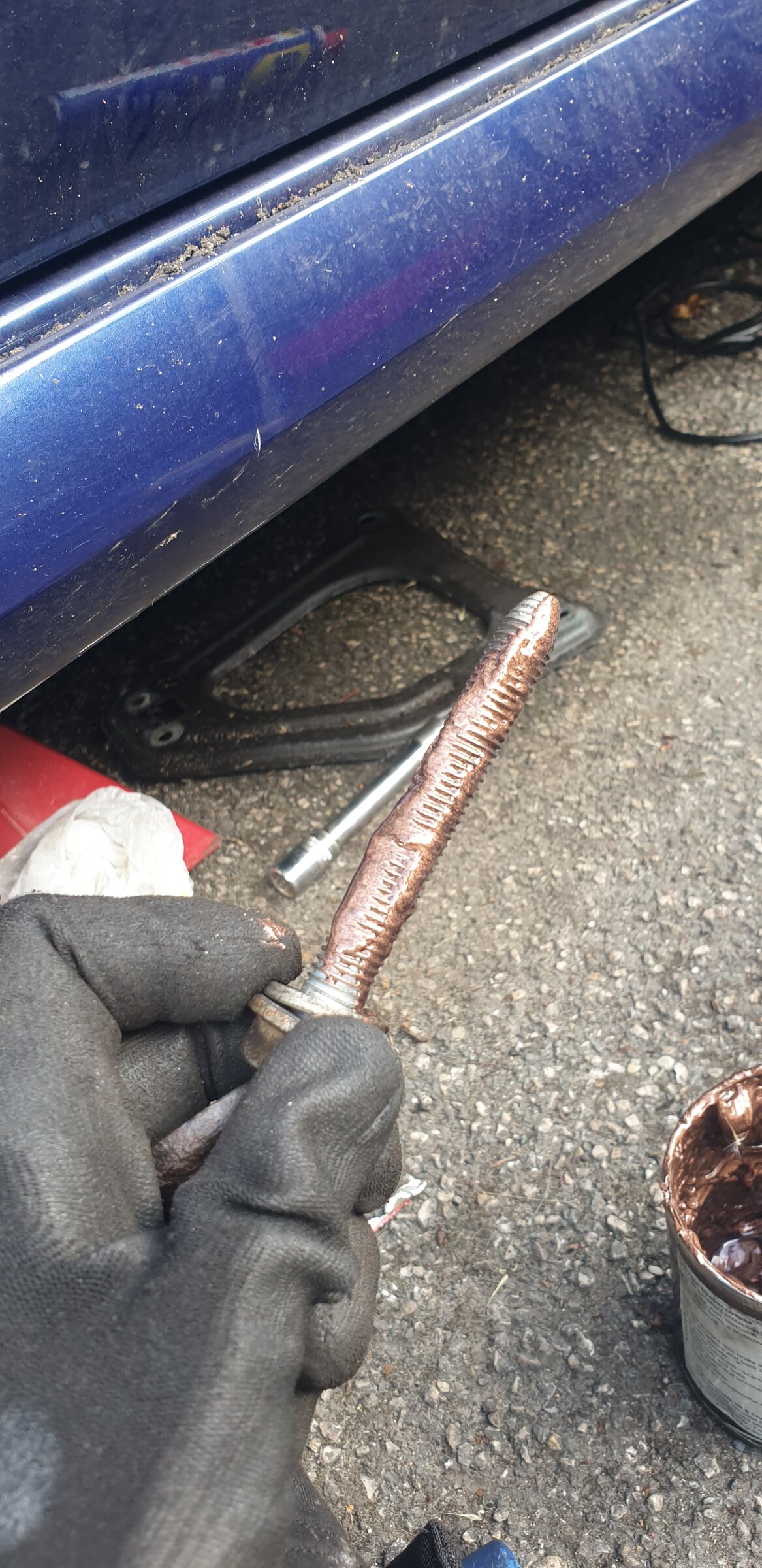

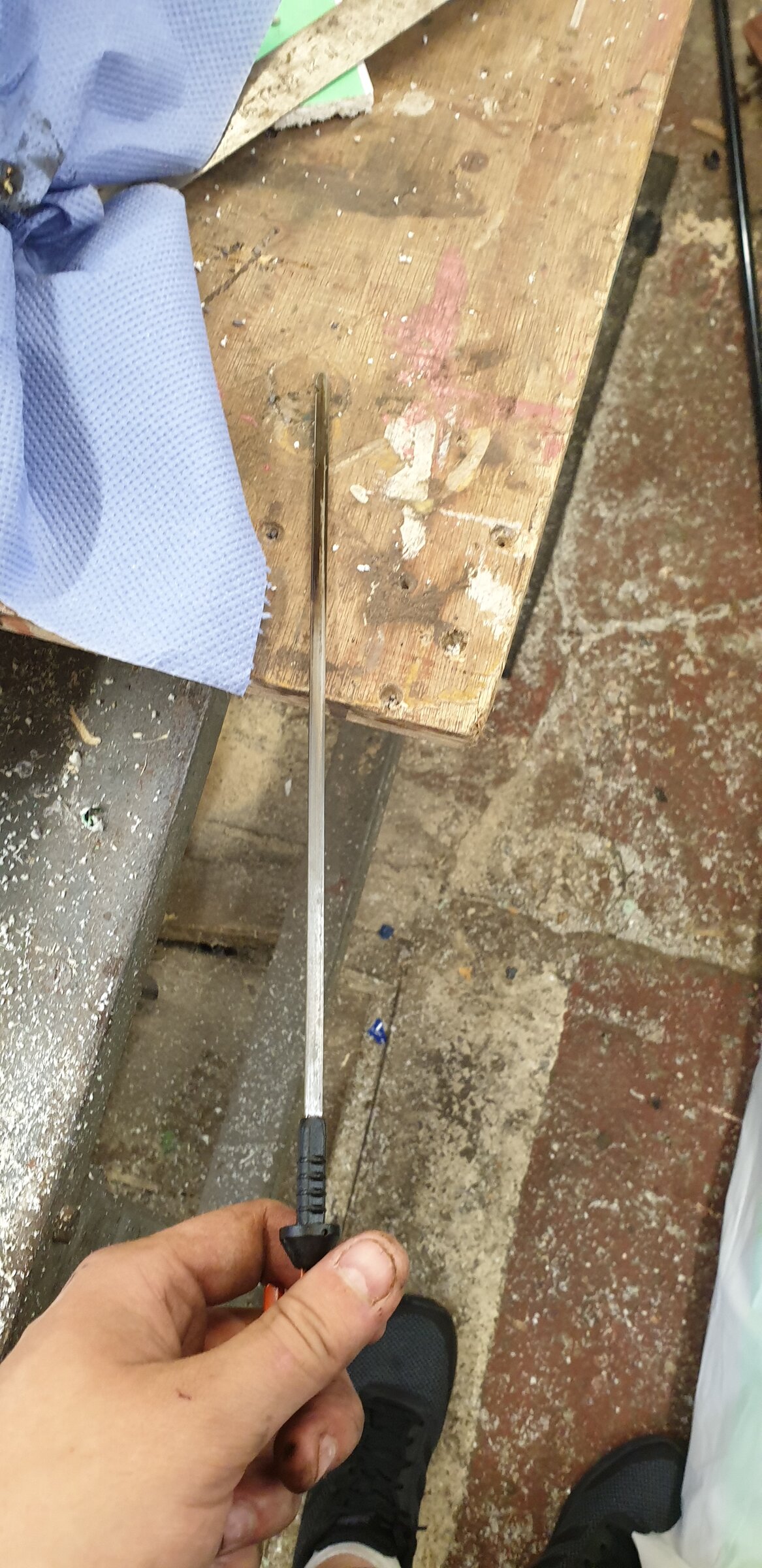

Oil + Filter
Genuine Purflux filter and Shell 5w40

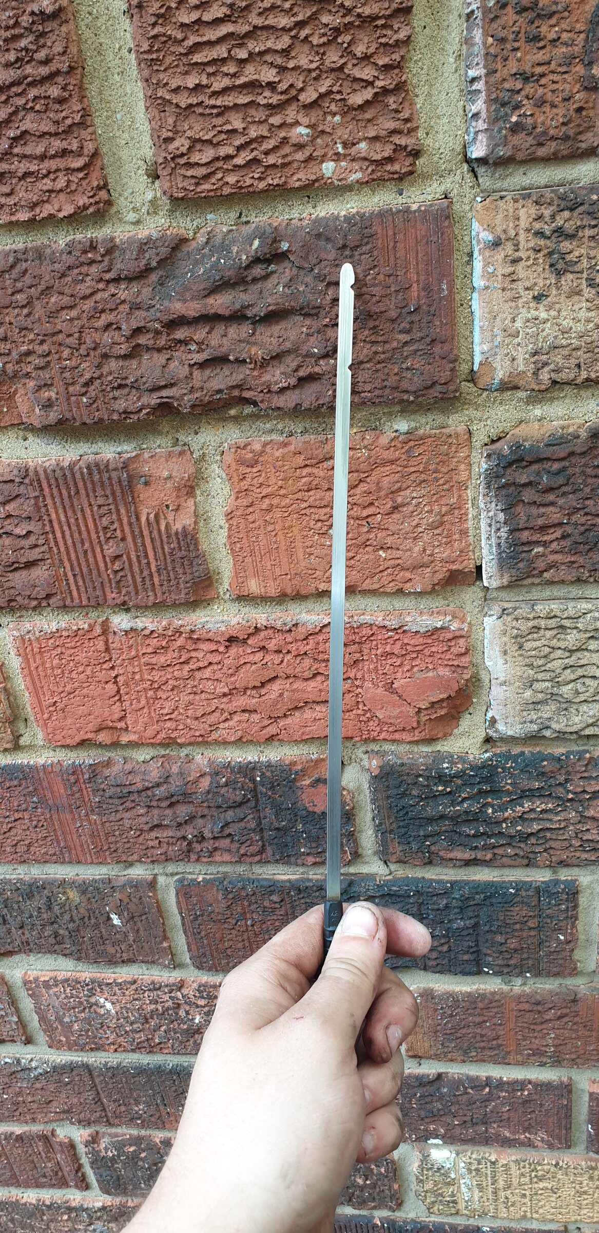

Cleaned the dipstick too, was a bit grotty. Brake cleaner and a dish sponge scrubby side for anyone wondering

Car looks very tidy mate! I thought the Rotas would look awful but they really suit the car.
It was my mums, I asked her if she wanted it back but she was like "nah you're alright son, although it would make my spoons look good" 😂
Yeah the slipstreams do look quite well. Fingers crossed I can get my hands on some B14's soon so I can drop it down a tad as it has quite the arch gap on cup shocks and grams springs
