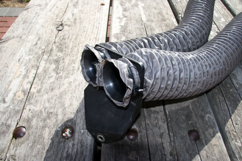

I was told this before and now I really believe it. If you've got a 172 ph 1, I suggest you try removing the two standard cold air feeds and replace them with much bigger cold air feeds (like on mine in the photo). I did this at the weekend and it seems like a much bigger power gain compared to having the inlets improved.
My thanks to someone else on here who suggested it.

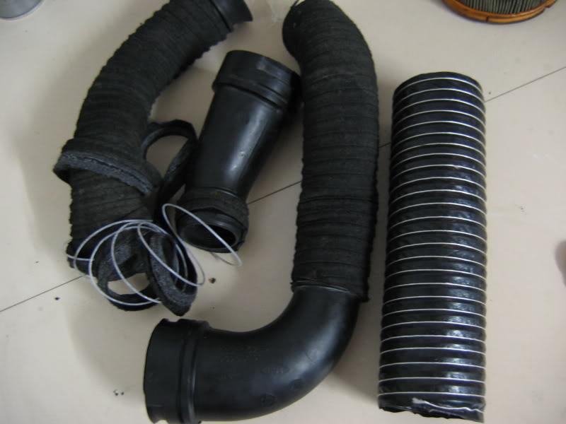

Just take off the air filter housing by unscrewing the jubillee clip on the throttle body housing, remove the rubber band holding the housing in place and pull off the two air feeds. You might want to replace the air filter and I use an ITG filter.
Then remove the front part of the wheel arch liner on the passenger's side of the car. Do this by unscrewing three little screws (one on the wheel arch and two under the bumper) and pulling out two fir tree clips.
You can then see a 13 mm bolt holding the horn and air feeds on. Unscrew it and remove the two air feeds.
Finally just connect the new air feeds on the housing (I used 75 mm CAF) using jubilee clips, cut it to about 0.5 to 0.75 m and shove the ends of the CAF back down into the wheel arch. Basically that's it, job done.
Dead easy.

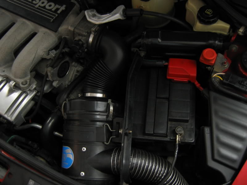

I agree that the whole caf needs to be wide from end to end. Ive just upgraded mine, quite simply the most simple effective mod ive done, you can see in the pic below how restrictive the standard feeds are. On the left are the standard feeds and on the right the 70mm piping thats replaced it. The standard feeds get very narrow at one point. Wacking a ITG in helps aswell.

For all the f4nnying about with these CAF's your time and money would be better spent ditching the OE intake pipe!
Your gains are only as good as the air that goes through your throttle body. IKs only stops the crap

Im on about the inlet pipe. Pretty obvious where the main restriction is just by looking at the photo's.
The straighter the smoother the pipe the better air flows. there's not much point sorting one area (the CAF) and neglecting the other (the inlet)
