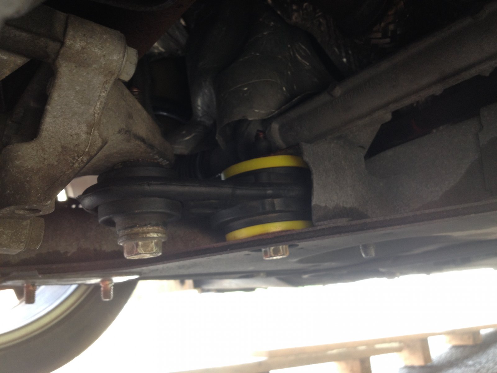

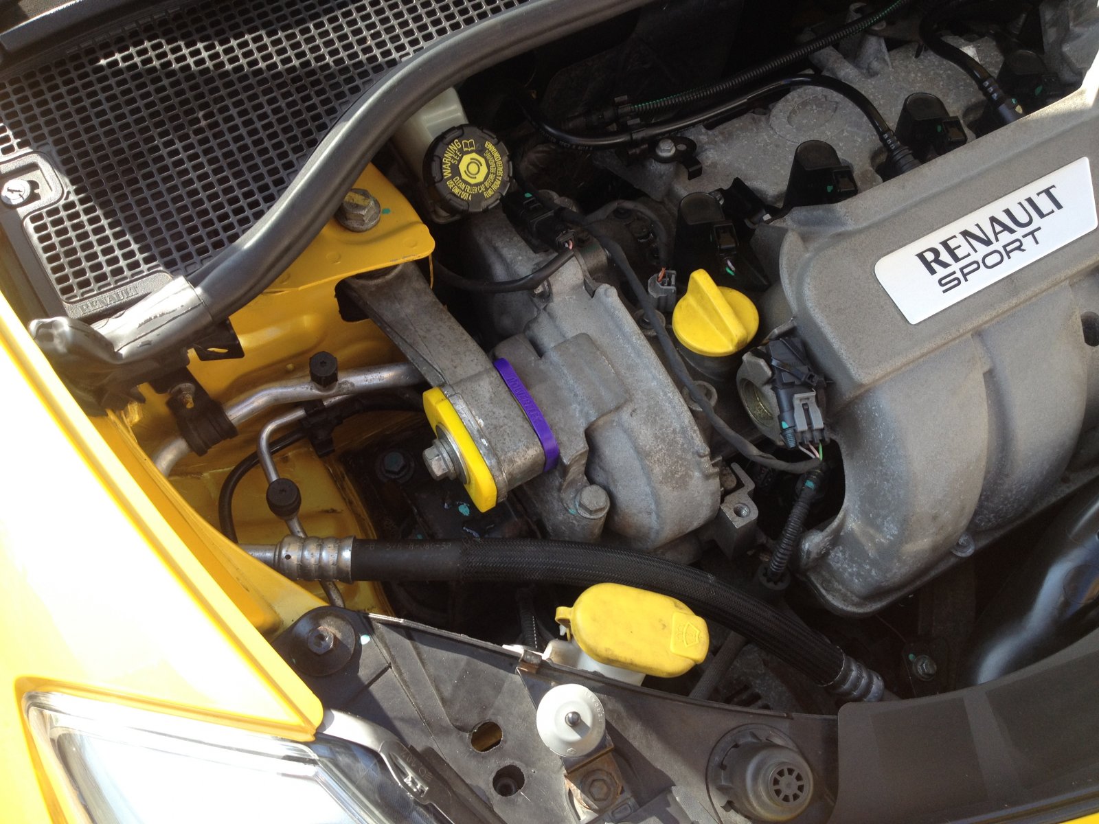

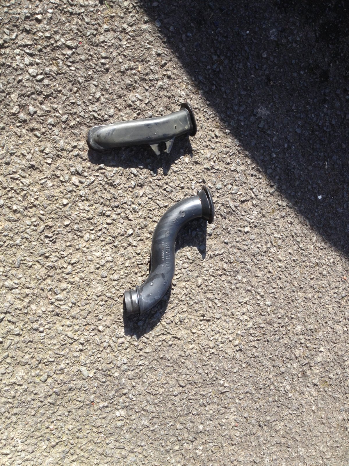

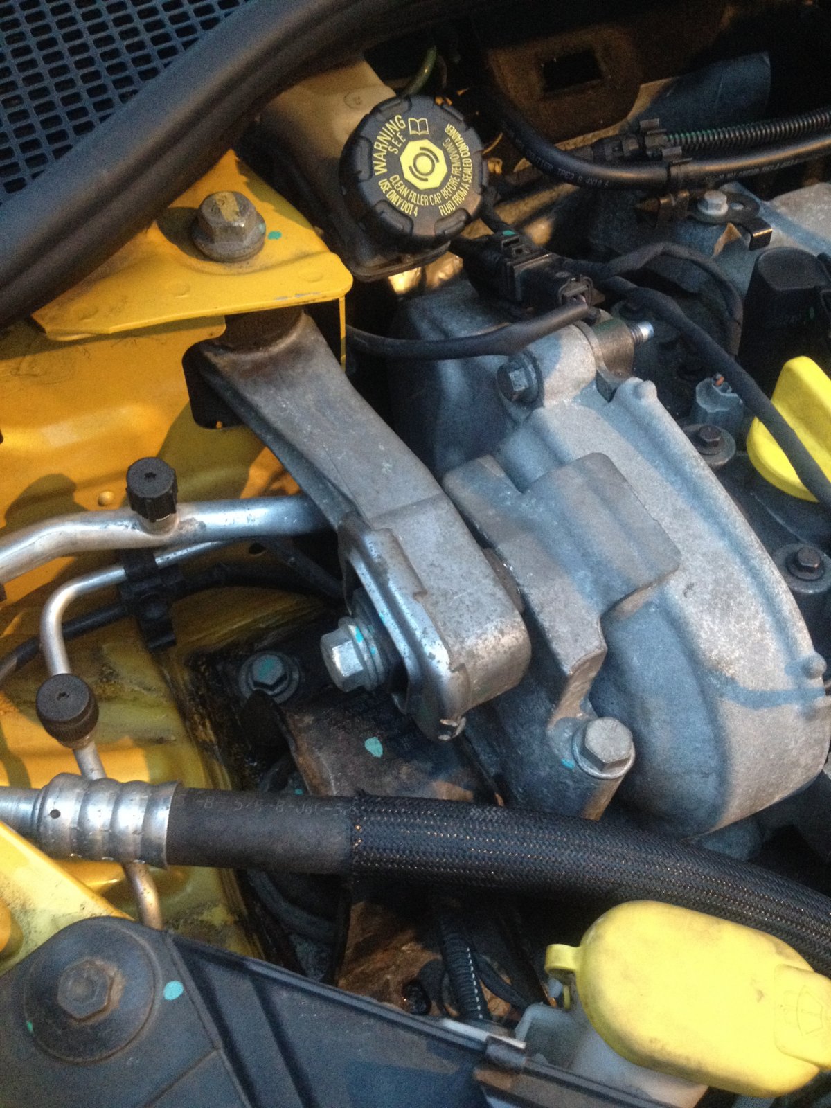

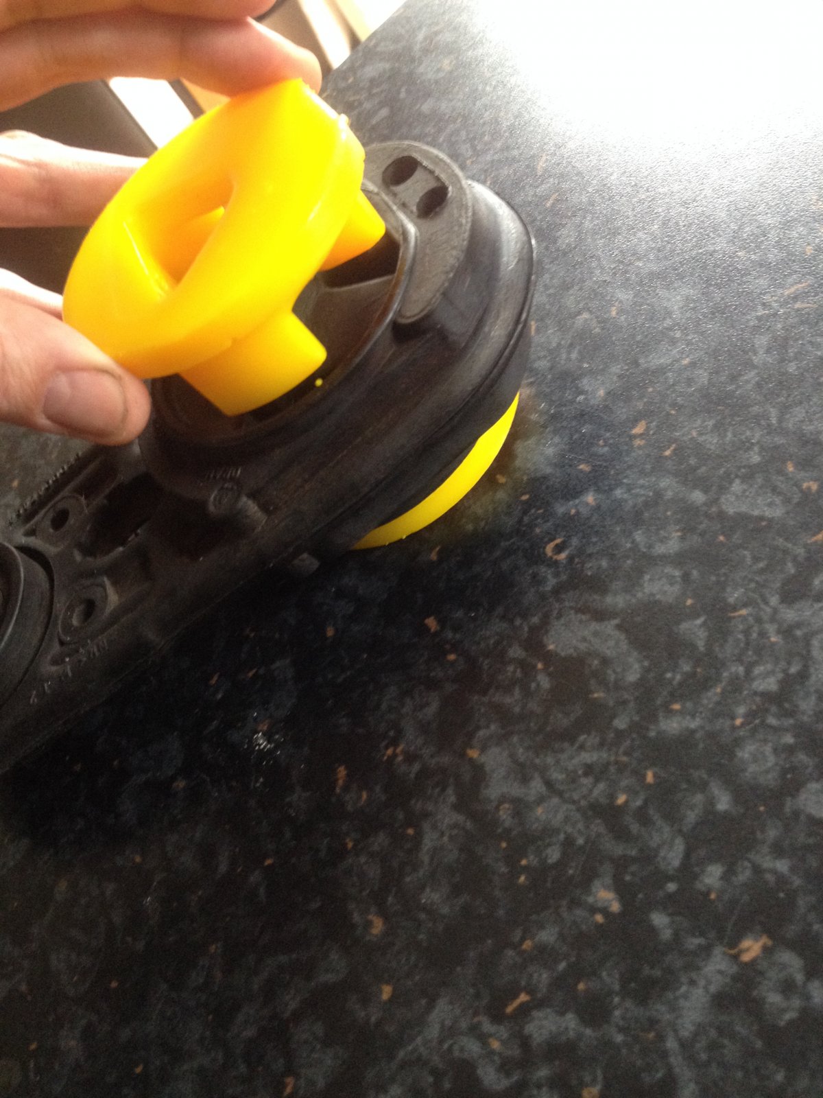

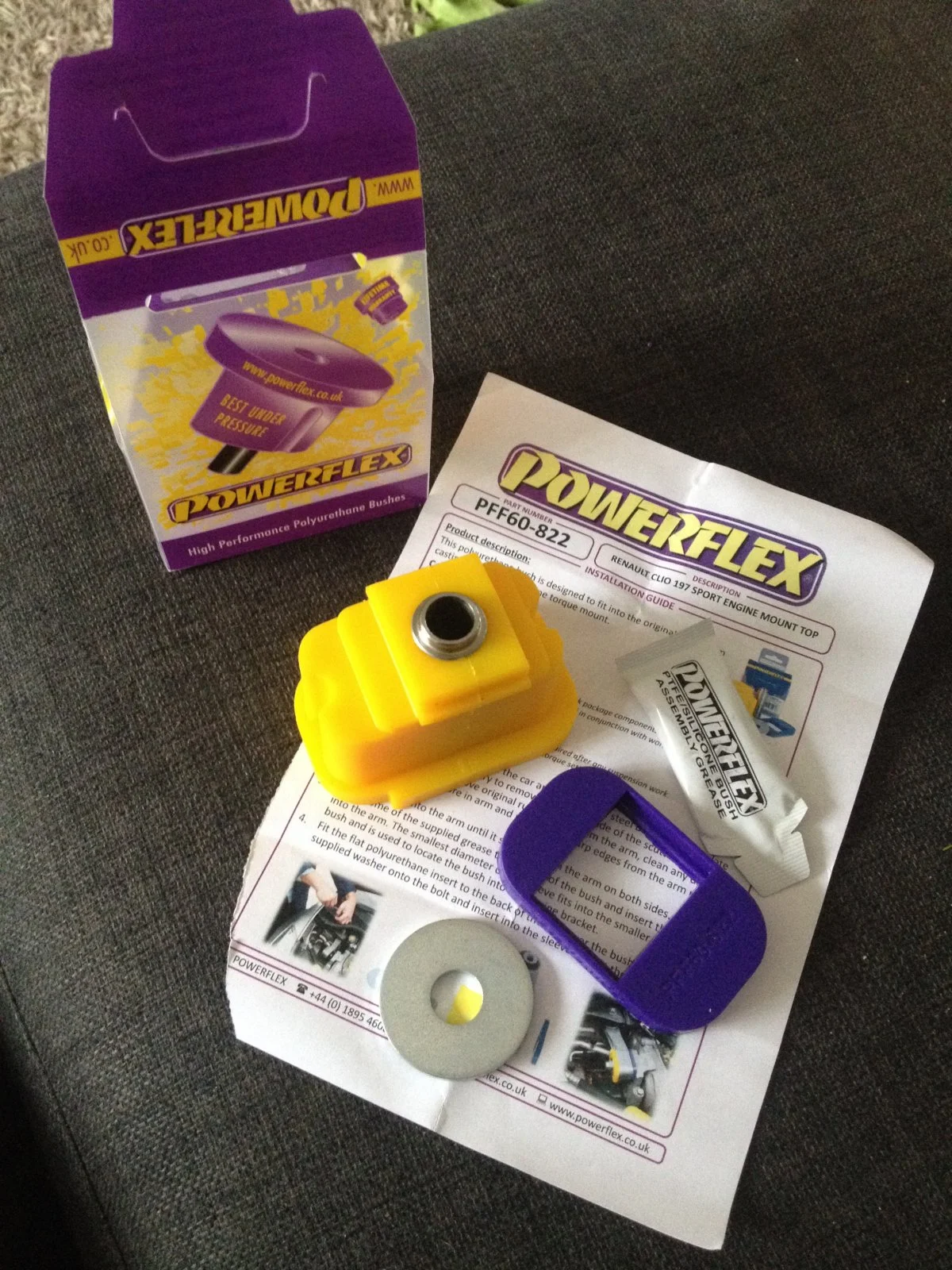

Yello 200 had just had a brand new original renault manifold so a very worth while investment is to fit updated engine mounts to reduce engine movement and the manifold flexi's braking up - a very common and expensive issue with the mk 3.
Before
After
Just waiting for the lower dog bone to turn up now. These 2 reduce the engine movement but create very little vibration.

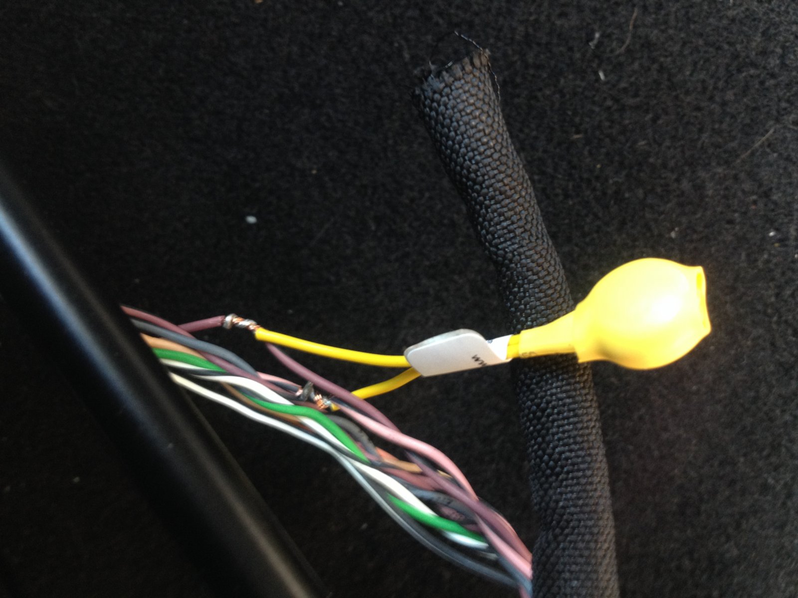

Also fitted a pair of seat resistor to turn the airbag light of due to fitting the recaros (no pretensioners).
£8 (the pair) of eBay - job done and no airbag light.
Also worth noting that Recaro do sell these resistors but cost £45!!! And do exactly the same job.

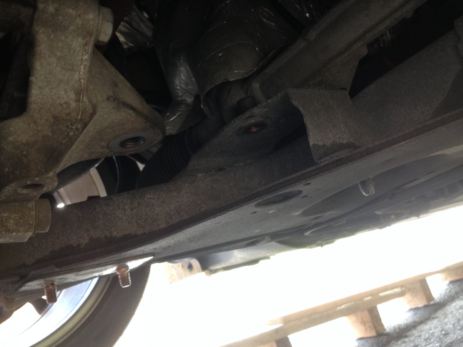

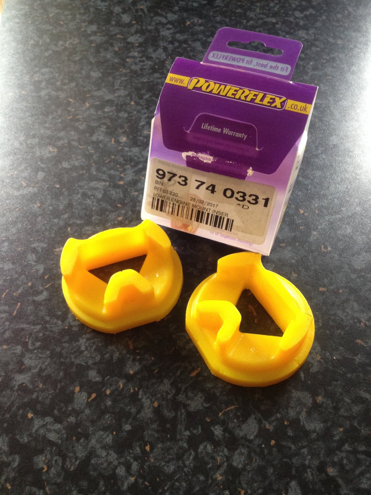

A couple of small updates on the LY.

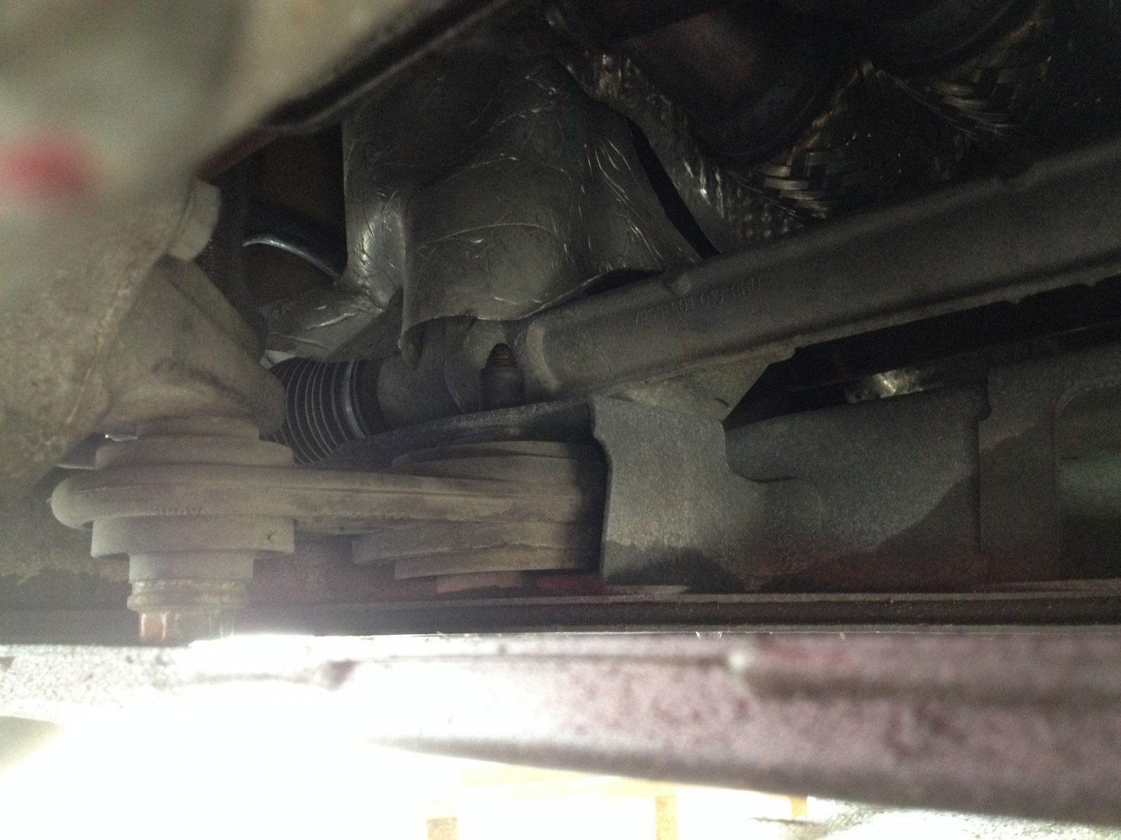

Bottom Dogbone Powerflex - makes such a difference with gear selection and really stops engine movement (a must have to protect my brand new original manifold) with no vibrations.

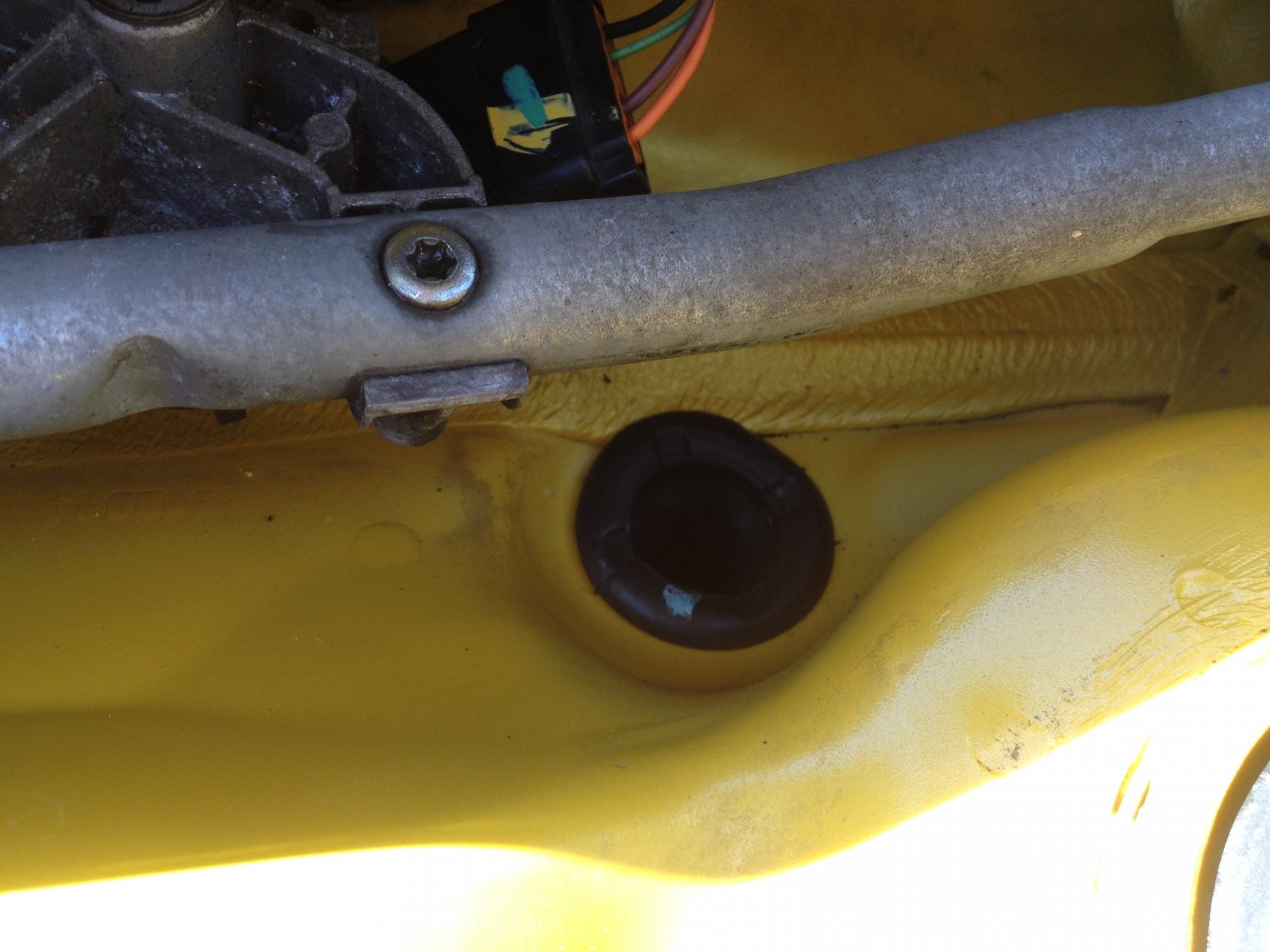

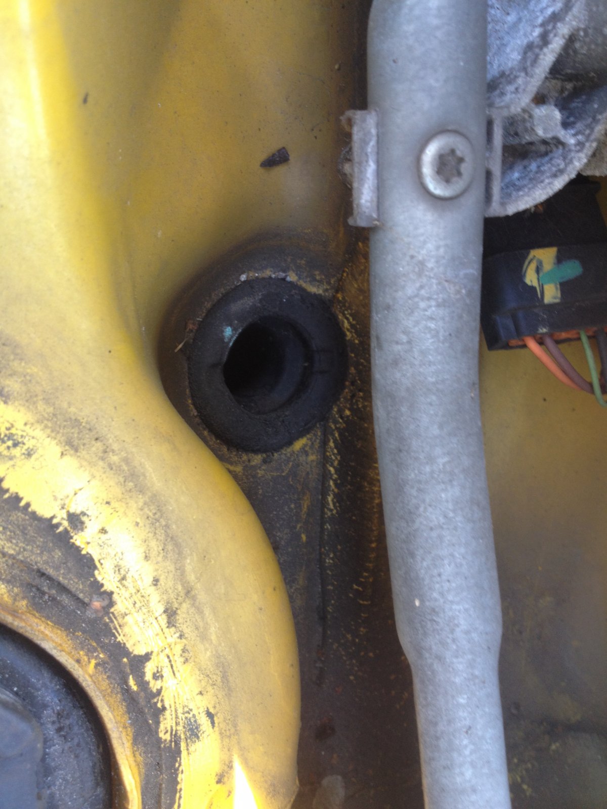

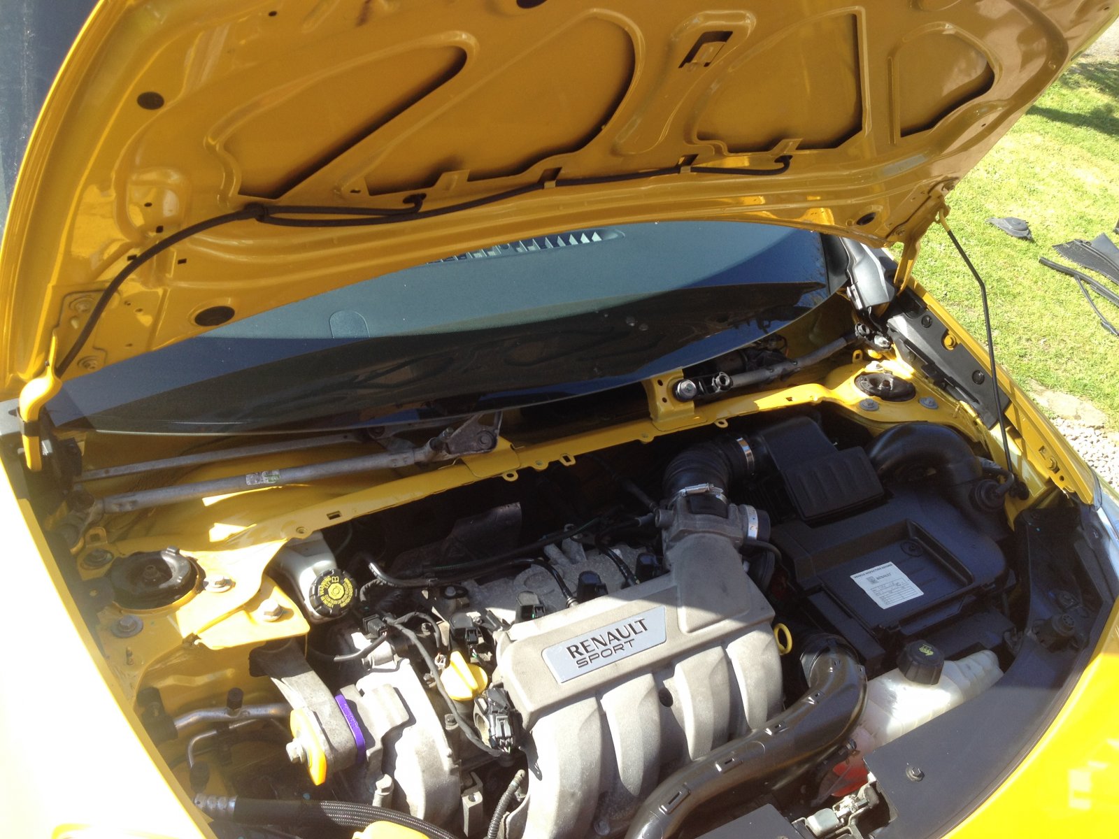

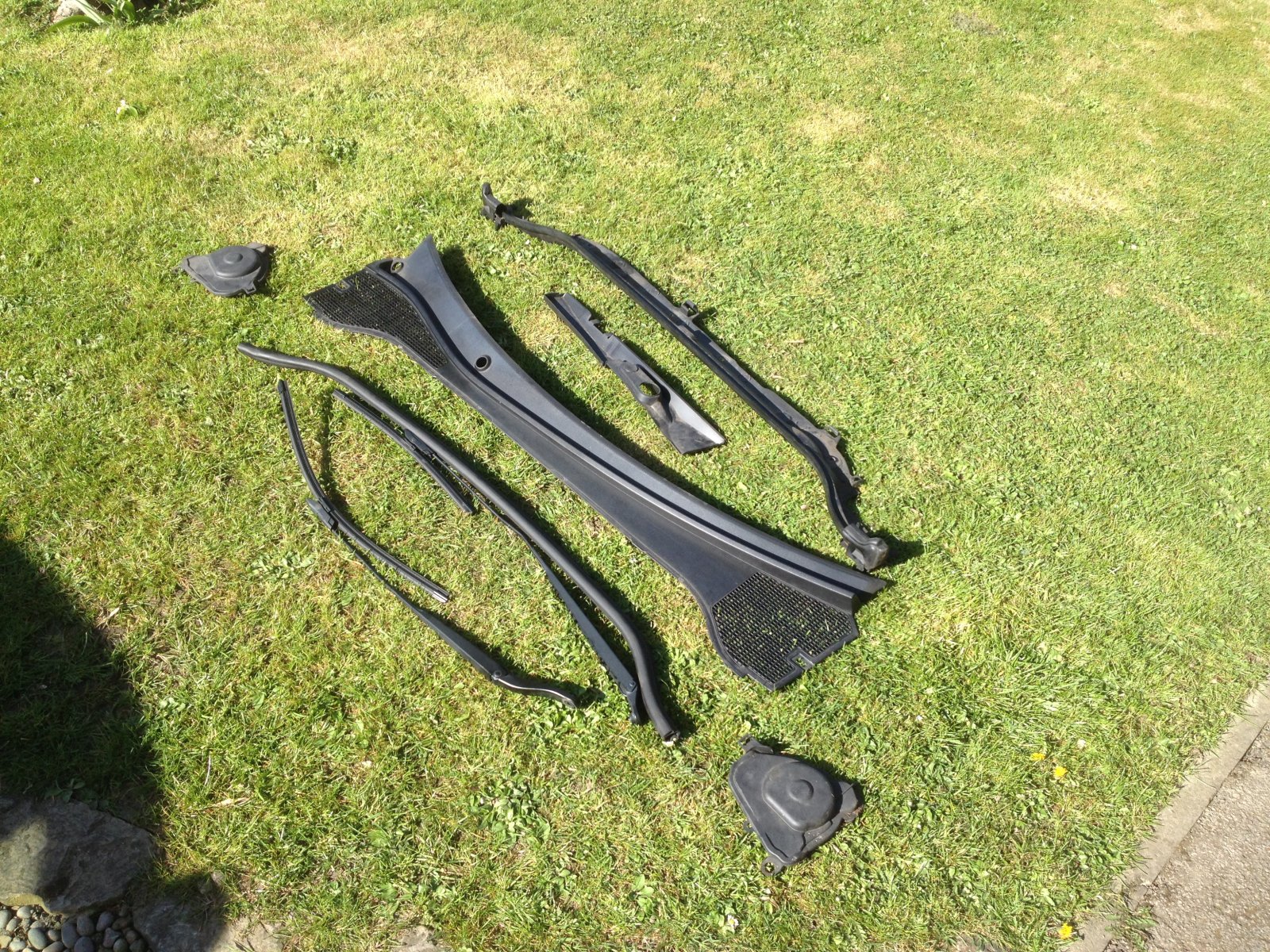

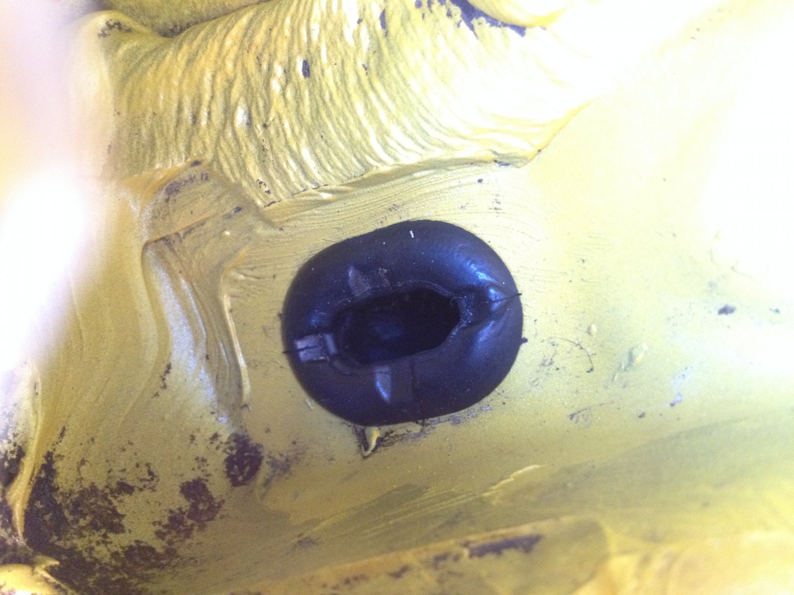

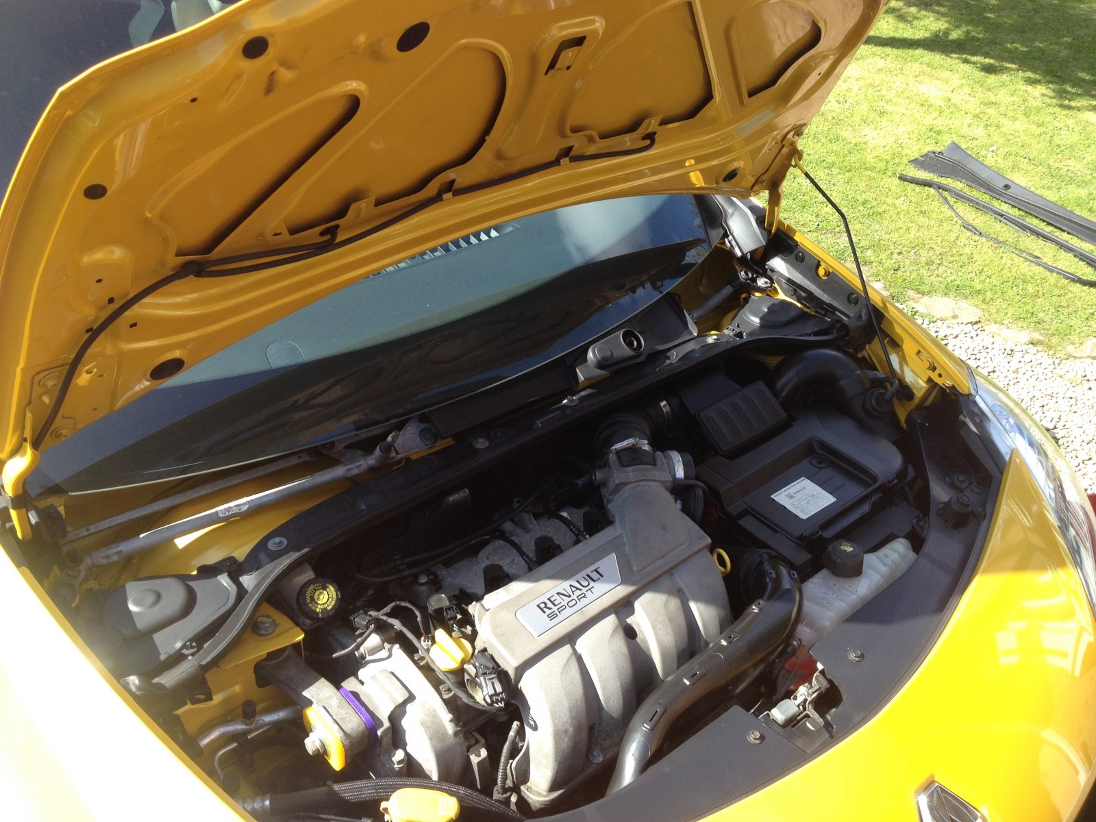

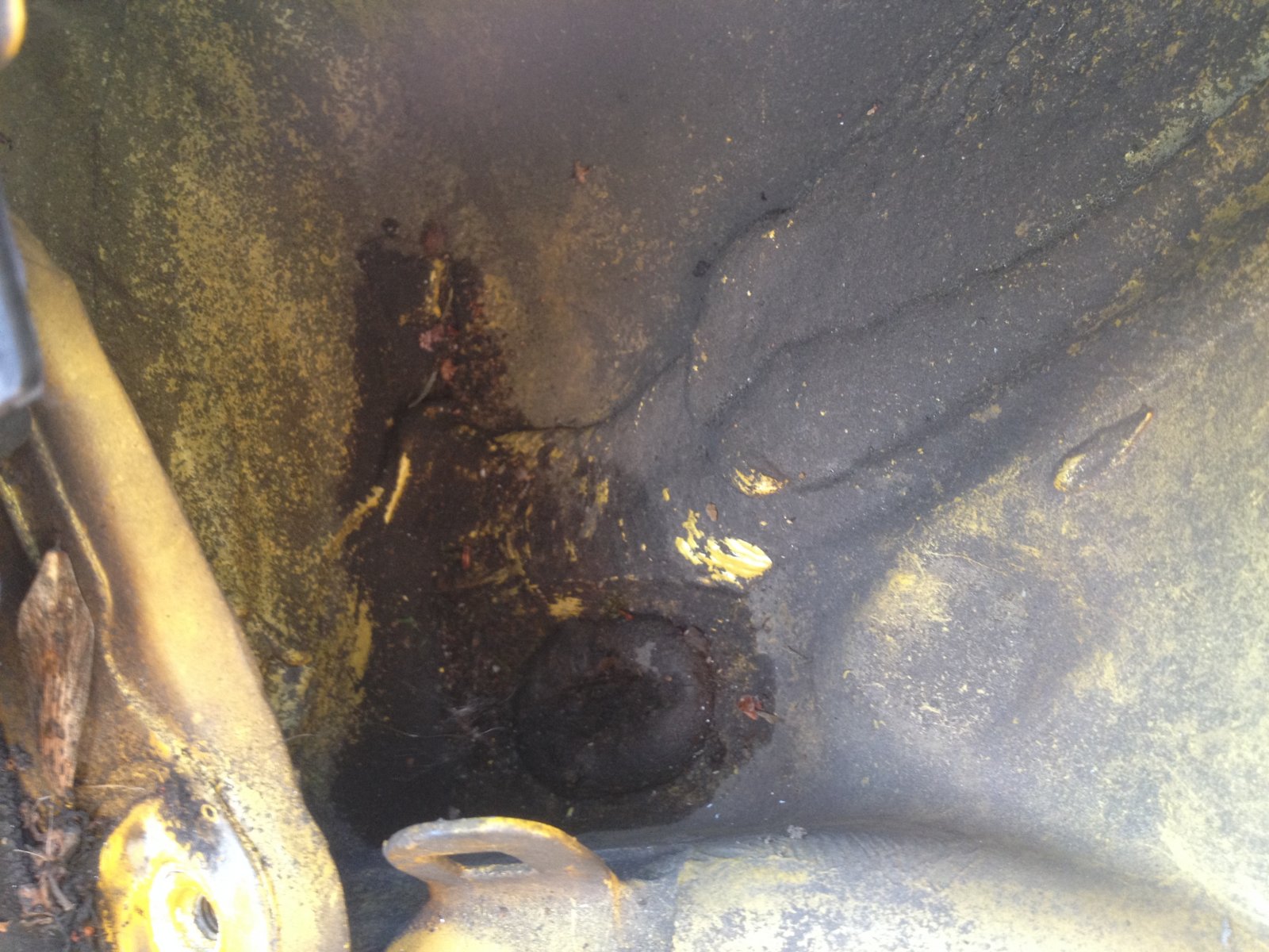

Scuttle clean out - wanted to make sure the drainage points were OK and it's a good job I did as one was completely blocked :(
Parts removed to get access:
Wiper mech moved:
Drivers side drainage - blocked!!
Passenger side drain half blocked:
Offending items removed and cleaned:
Back in:
Good clean of the scuttle area:
Putting back together:
