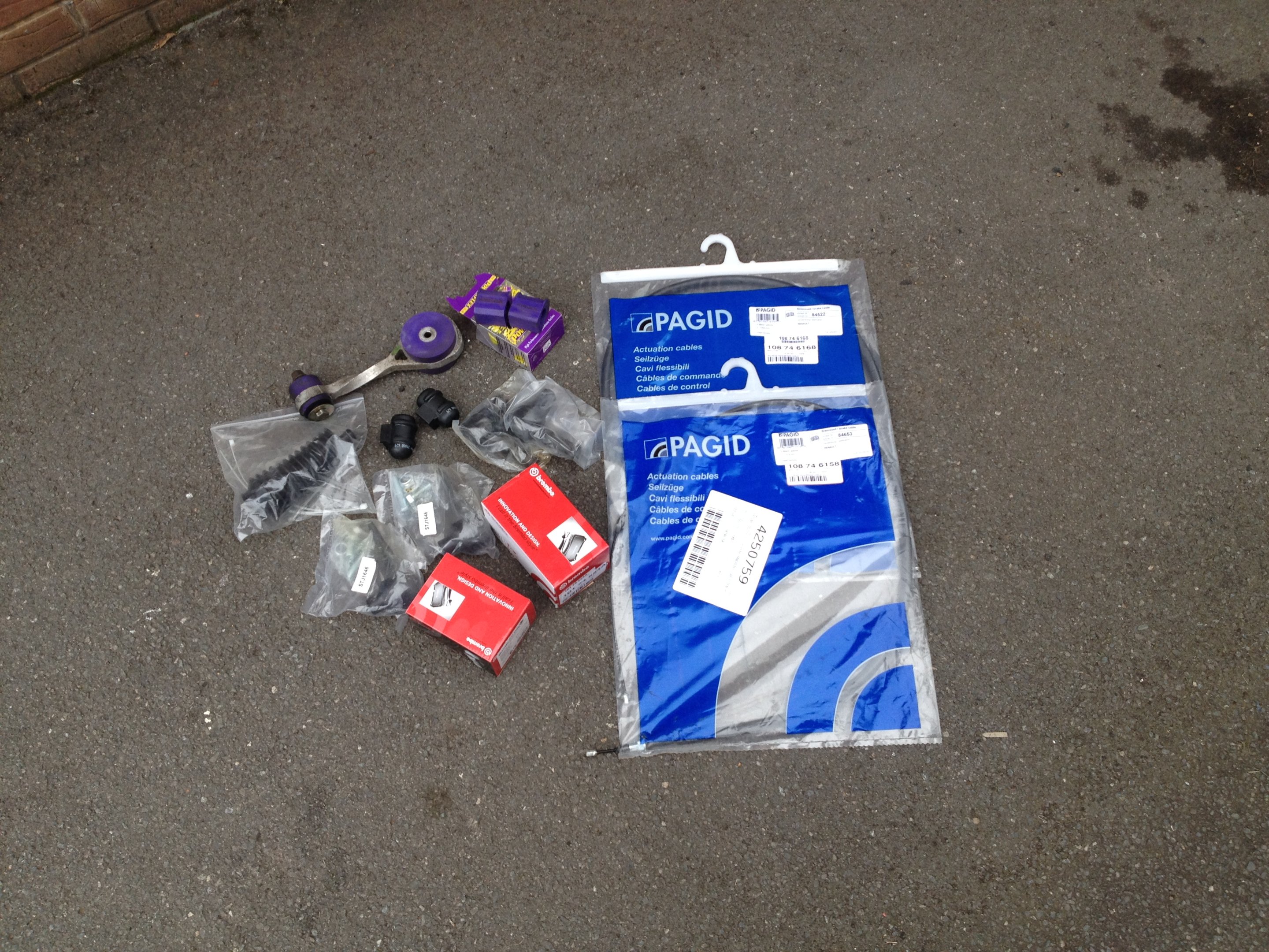

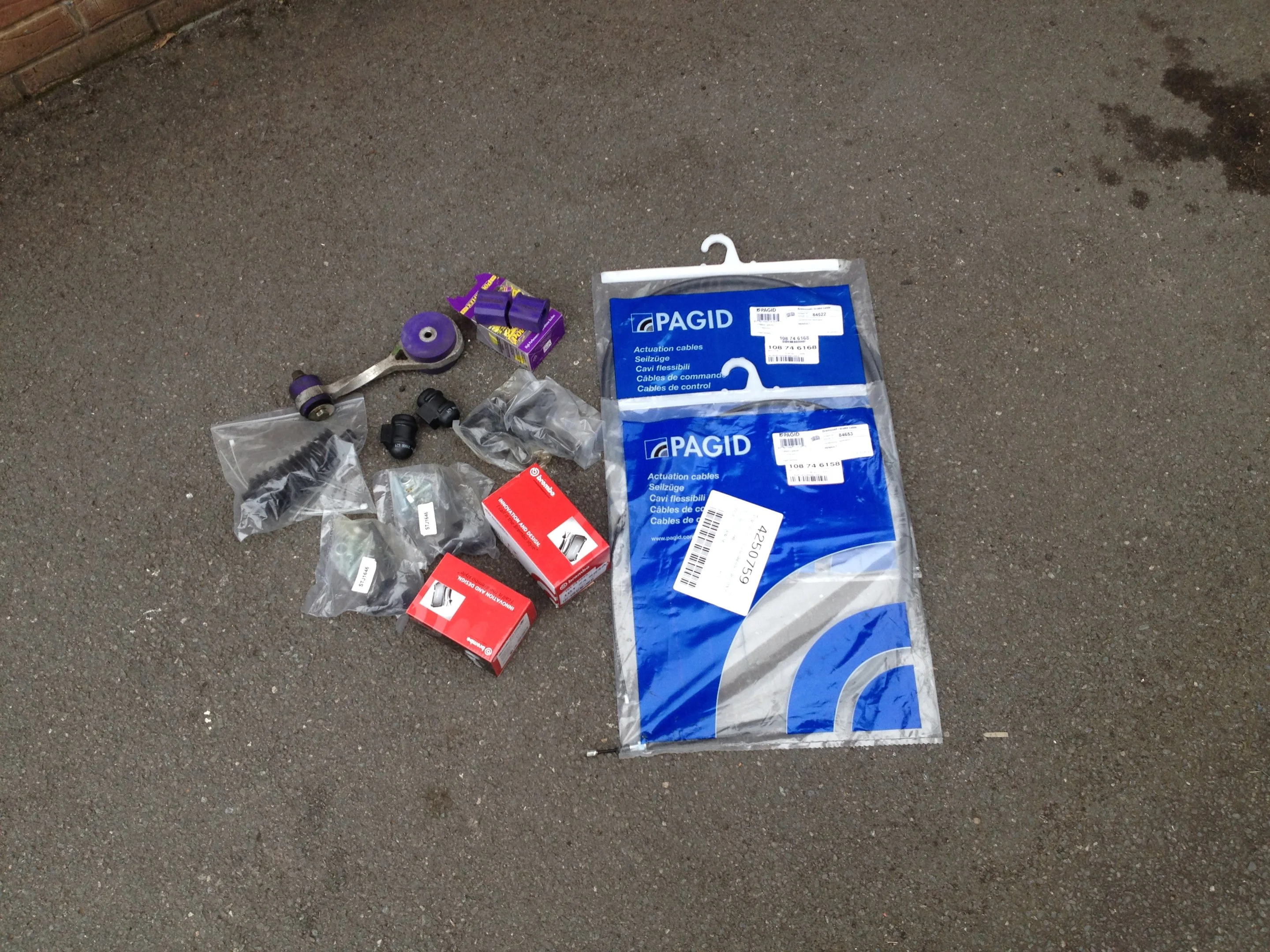

A few parts bought:
Front Brembo pads (HC discs already on and very new).
Rear Brembo pads (rear discs brand new at time of purchase).

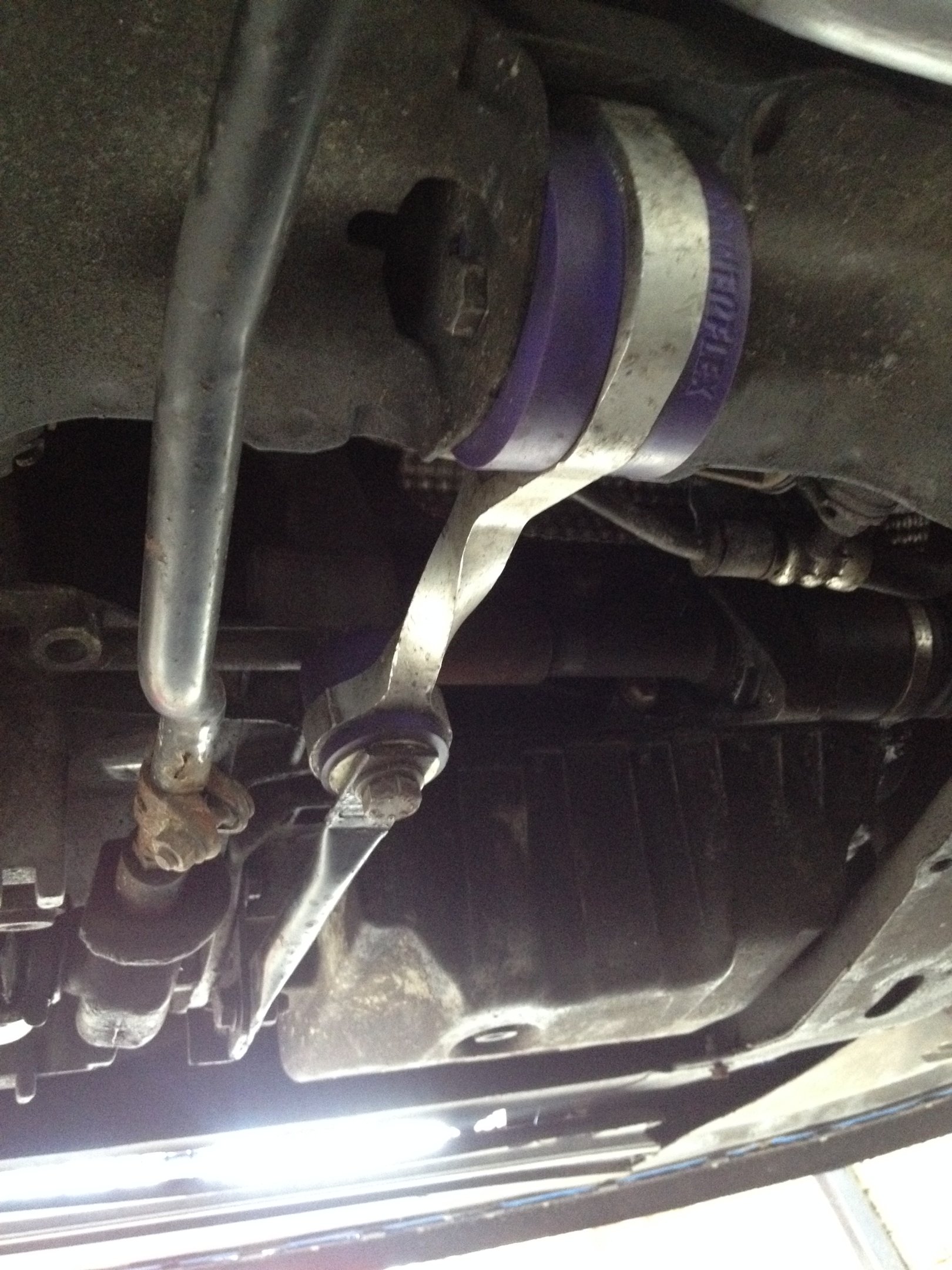

Powerflex inner ARB bushes.
Standard outer ARB bushes.
Track rod ends.

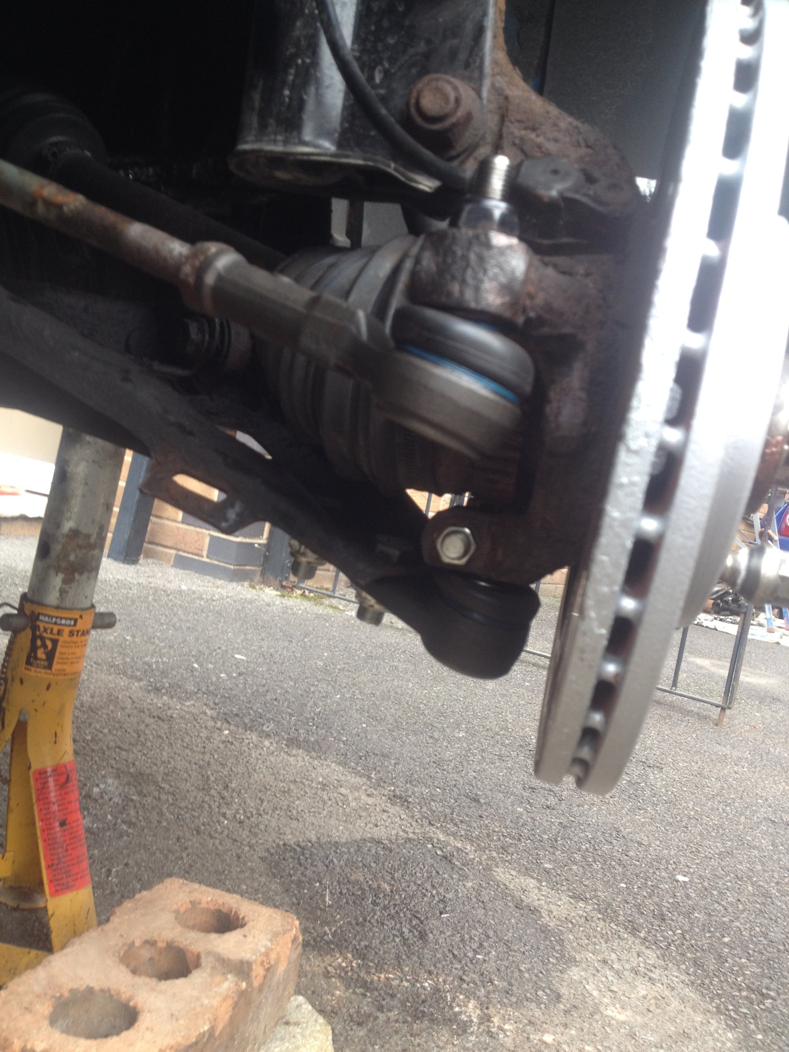

Bottom ball joints.

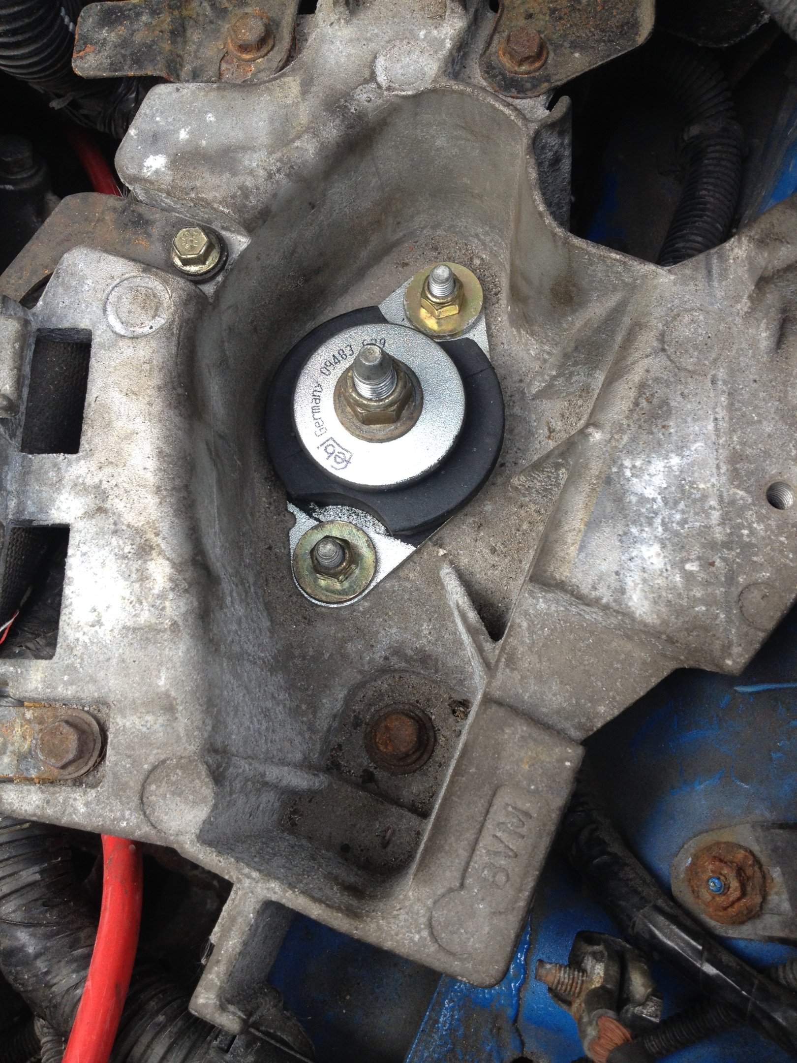

Upper powerflex engine mount.
Powerflex Dogbone mount.

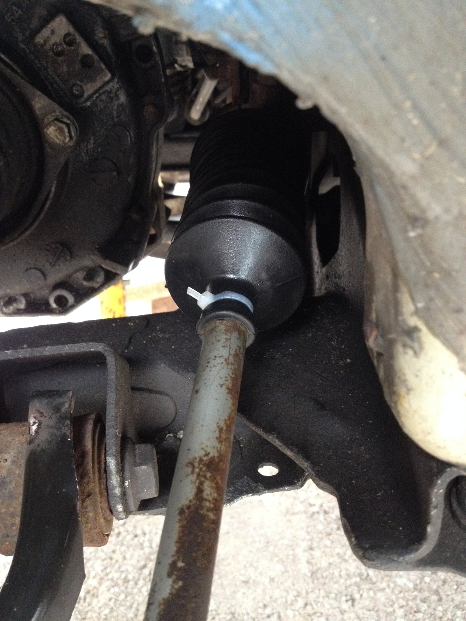

Passenger side steering rack gaiter.
Handbrake cables.

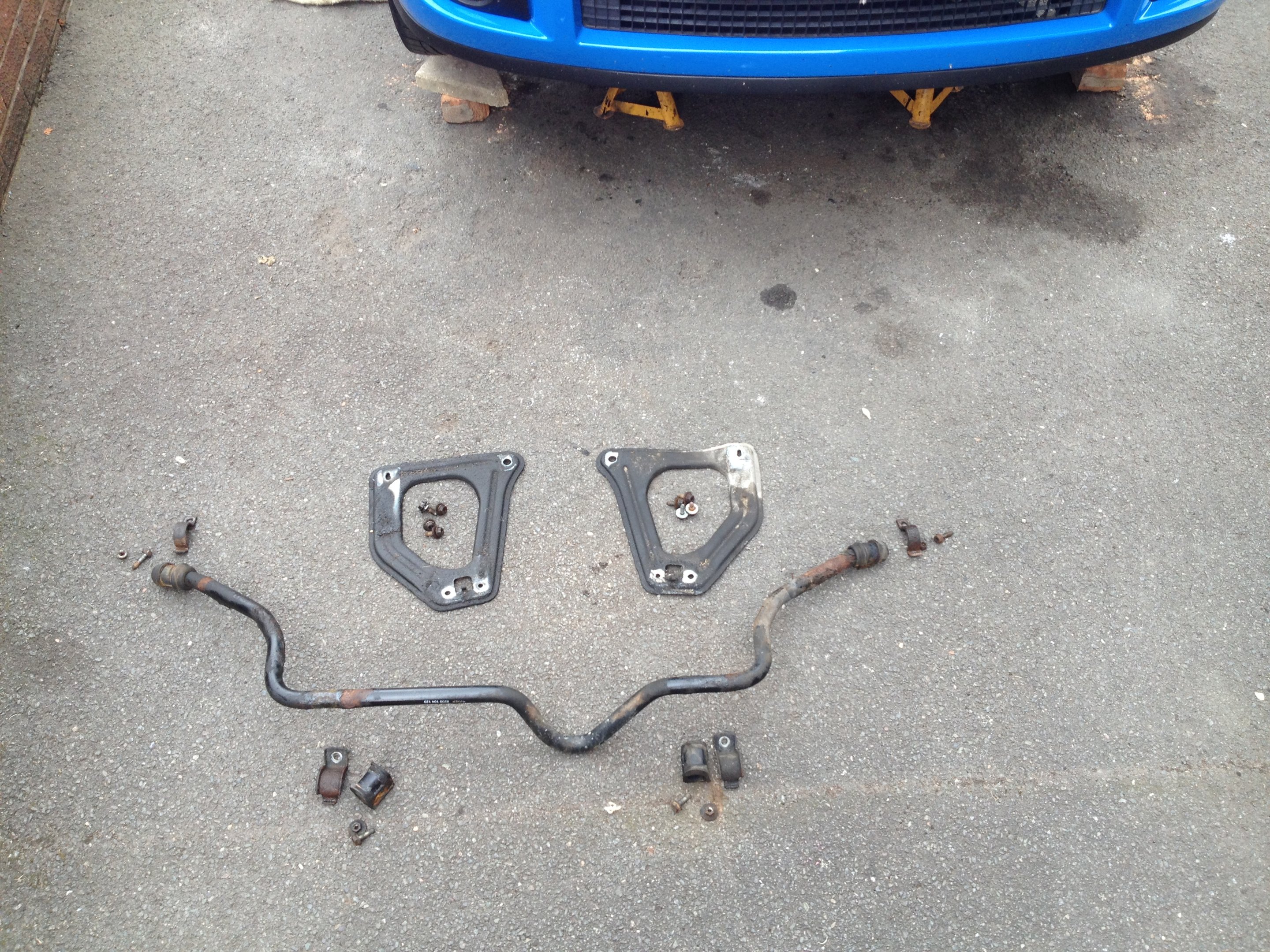

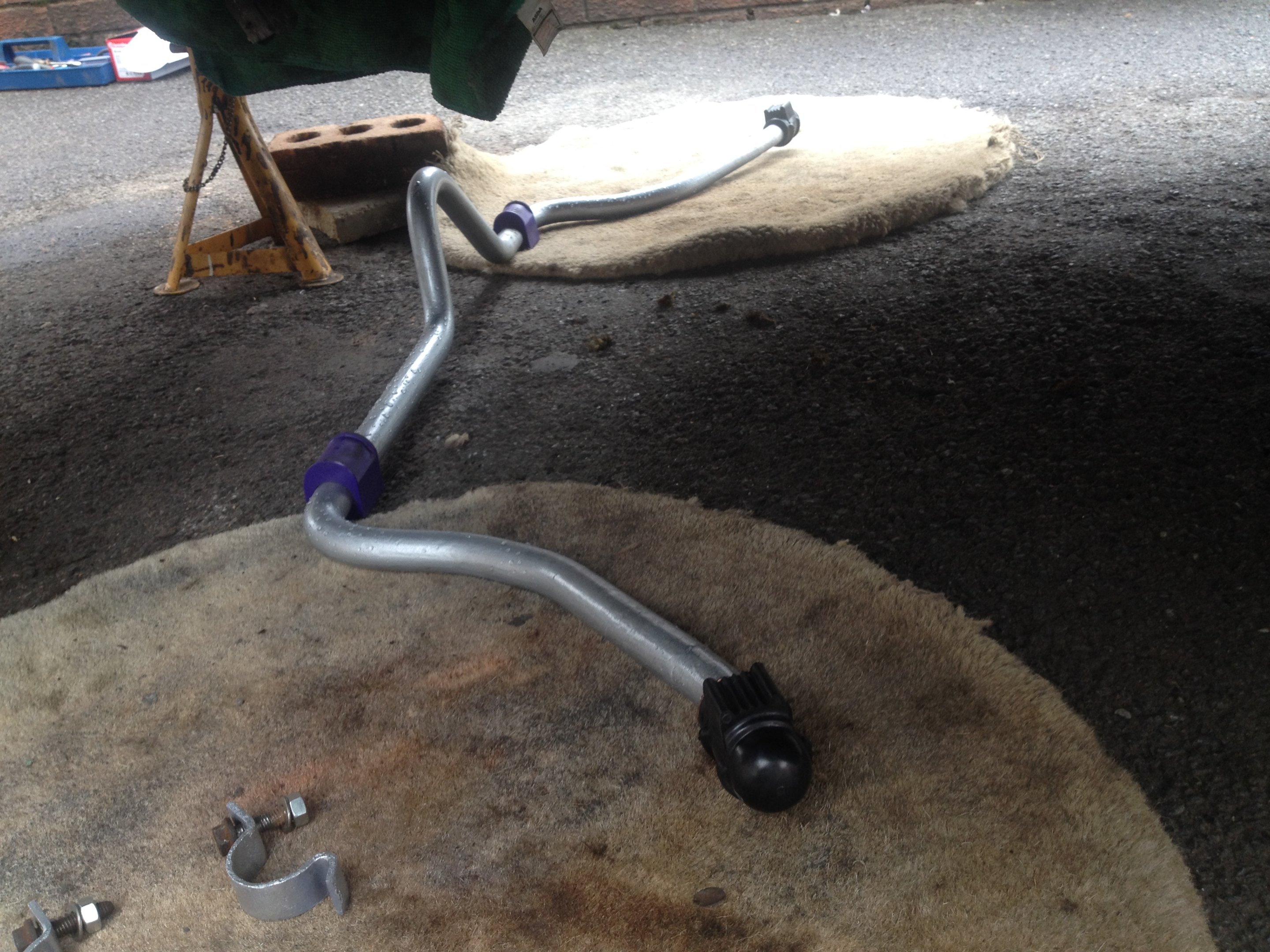

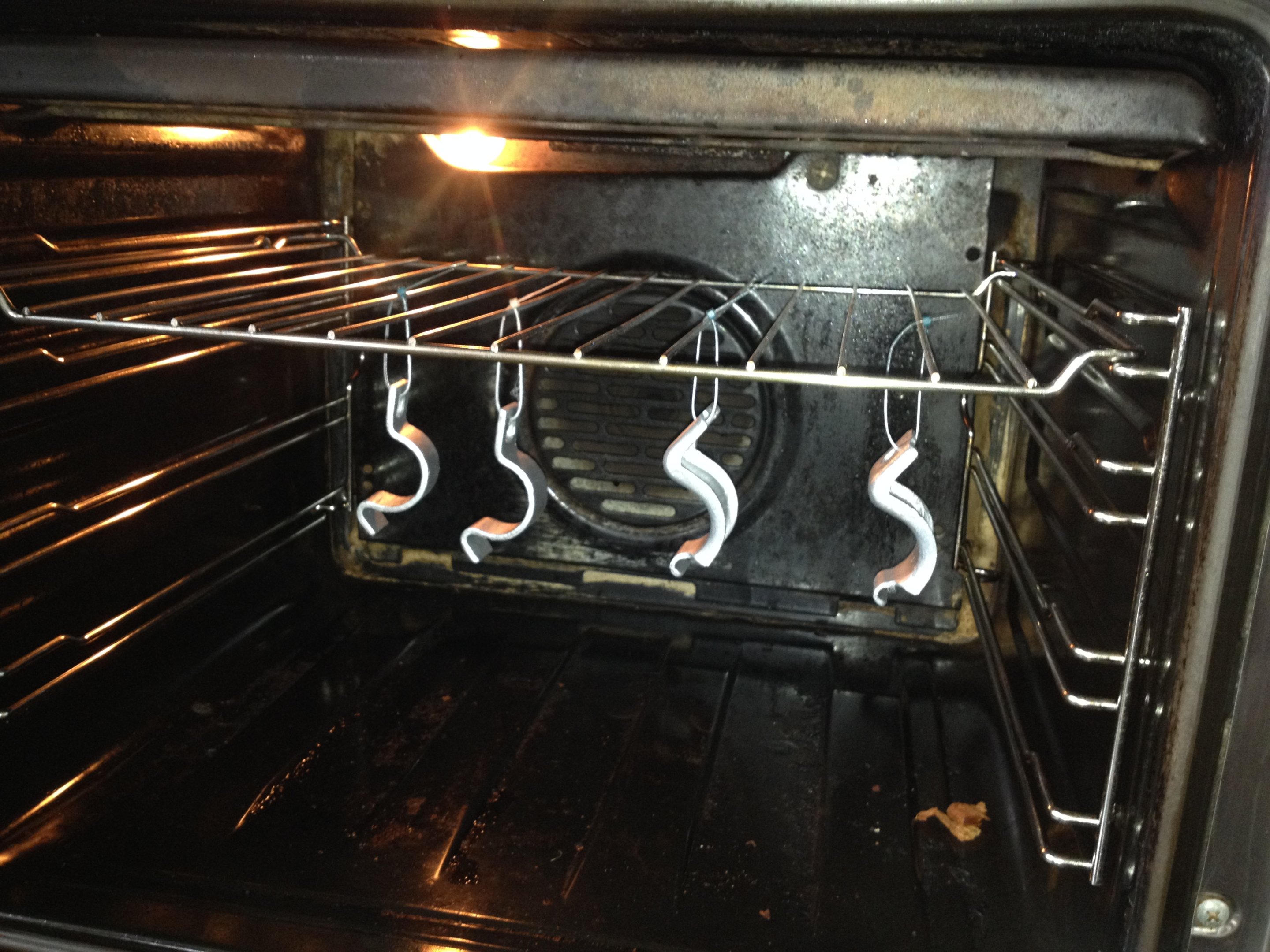

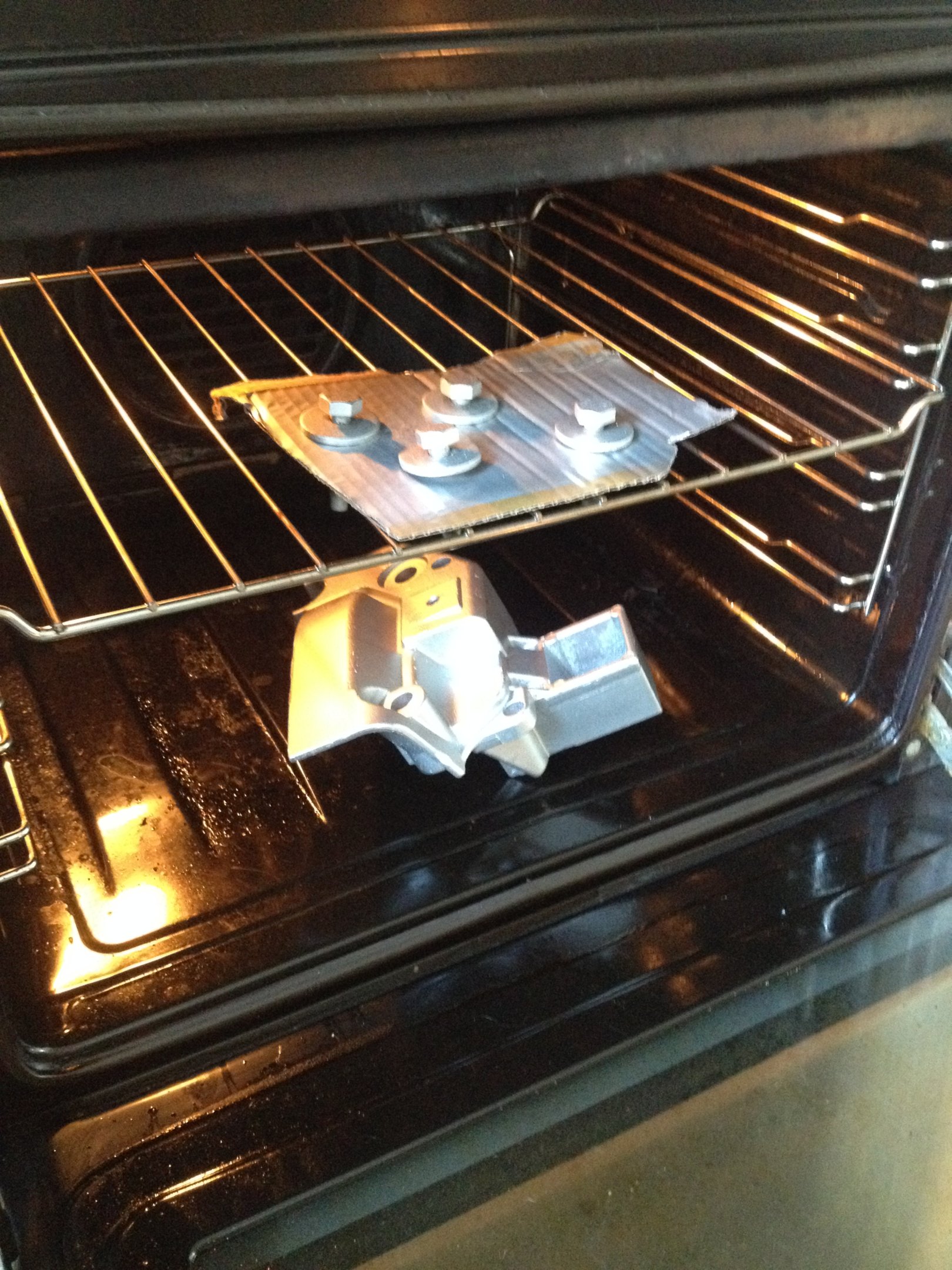

In order to replace the ARB bushes I dropped the entire ARB:
A lick of paint:
Reinstalled the ARB and not to bad using a pair of grips and a prising bar. Also fitted news bolts all round.
Bottom ball joints fitted and track rod ends. Upon removing the old bottom ball joints I found somebody had actually fitted the incorrect 10mm holed ones. 12mm now safely fitted.

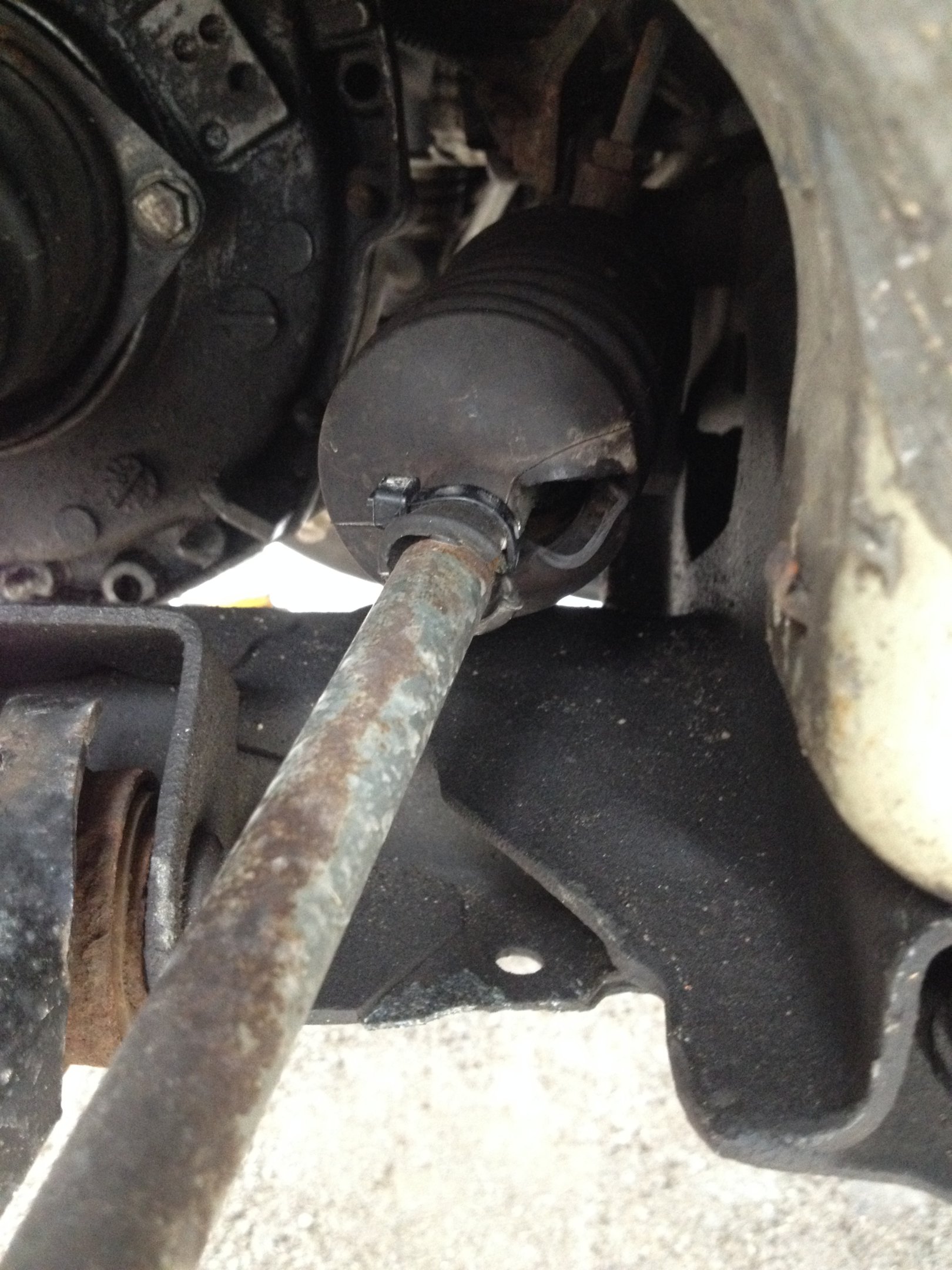

Split gaiter rubber replaced:

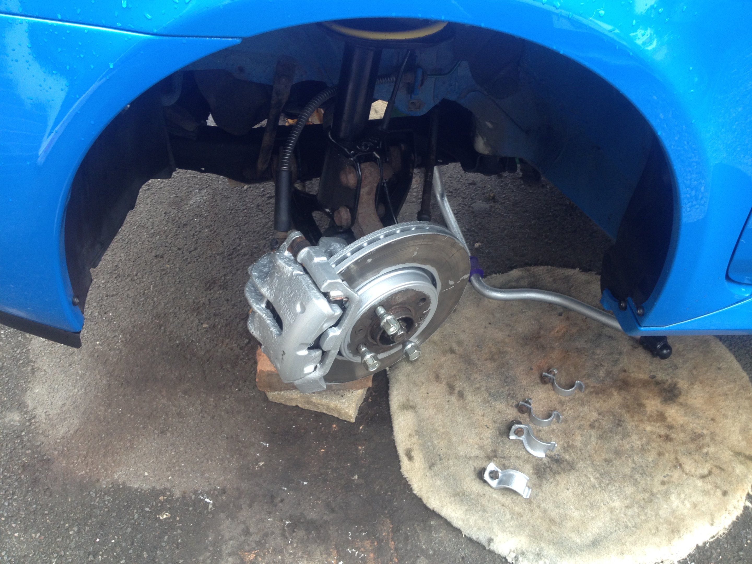

Front brakes sorted with a fresh coat of paint. Pads were ceased in the holders and the sliders ceased - now all sorted :)

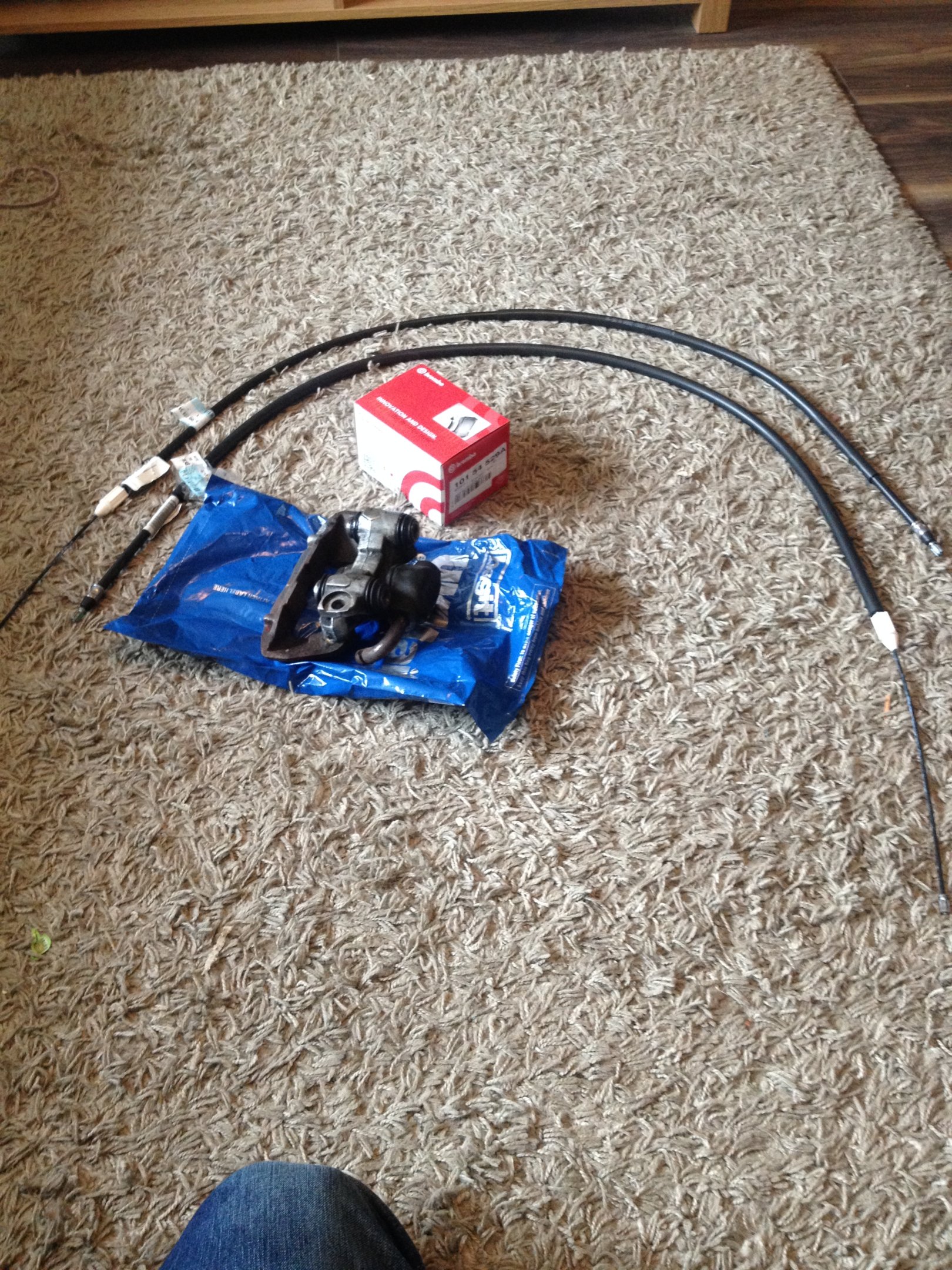

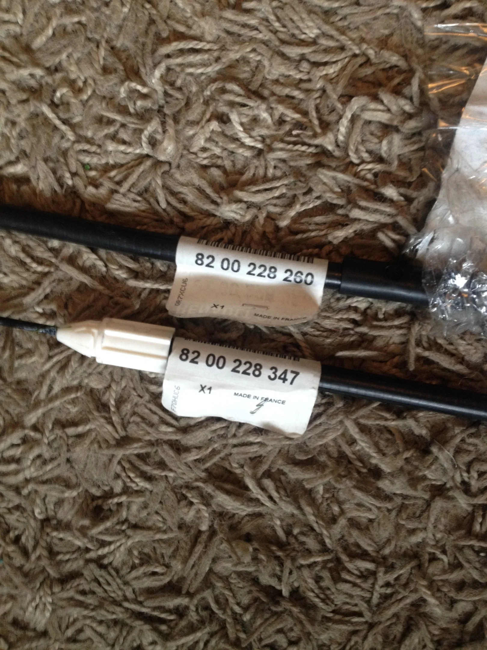

Currently on with rear brakes BUT so far my recently bought ECP handbrake cables had to be returned - yes they don't fit - outer sheaf is 20mm to short - apparently since they bought Pagid out they have gone back to the old design!! I am currently waiting for genuine Renault ones from Renault Parts Direct to arrive.
Also discovered the drivers side rear caliper handbrake lever to be broken - got a replacement ready to go but waiting on the handbrake cables to arrive.

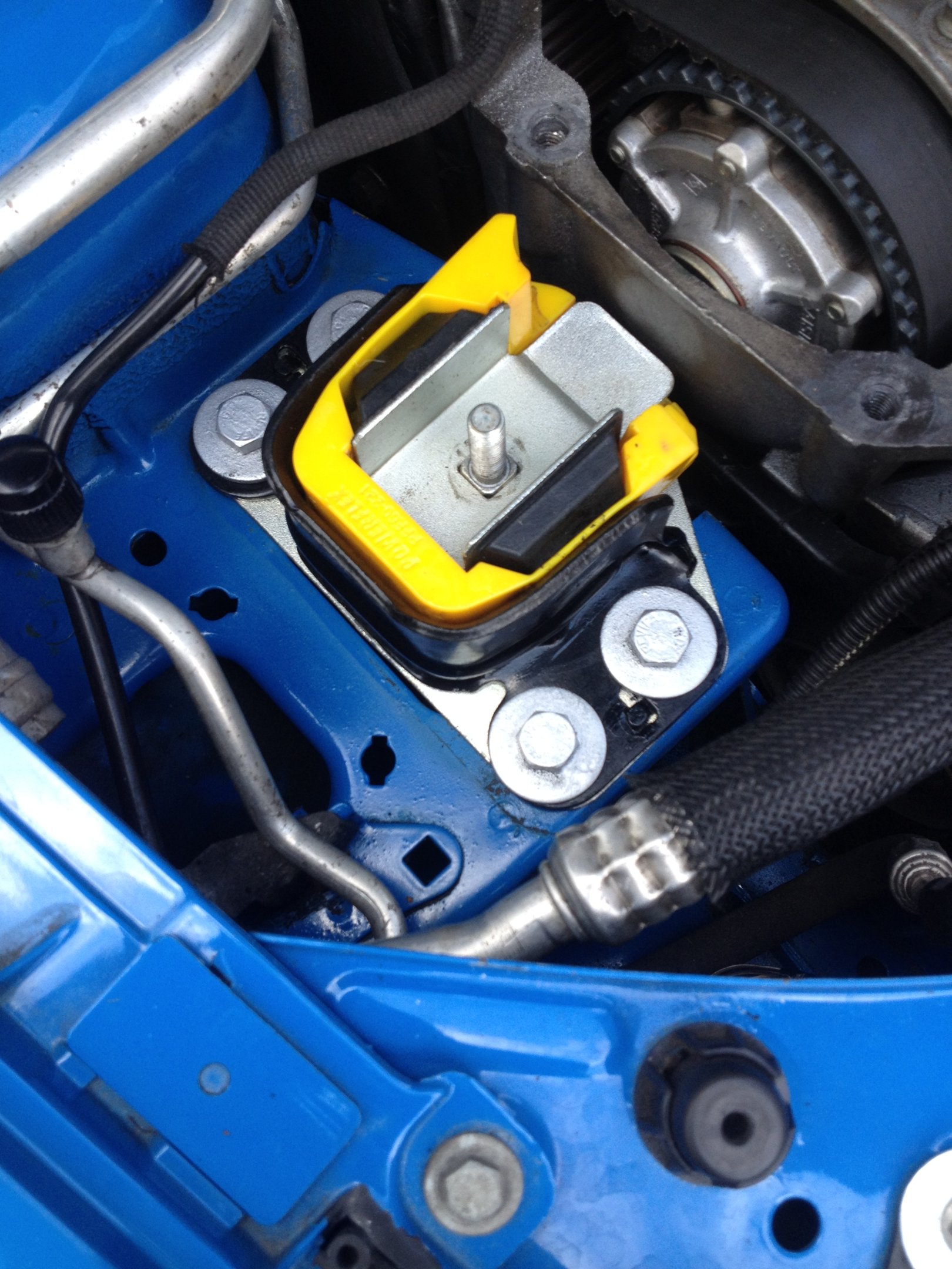

RB 182

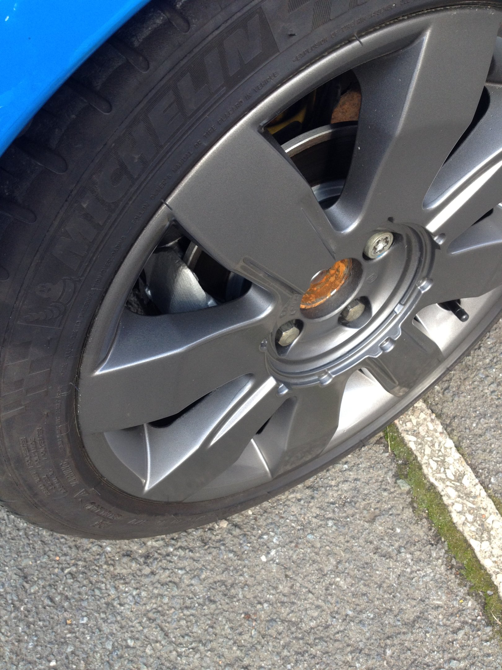

Wheels

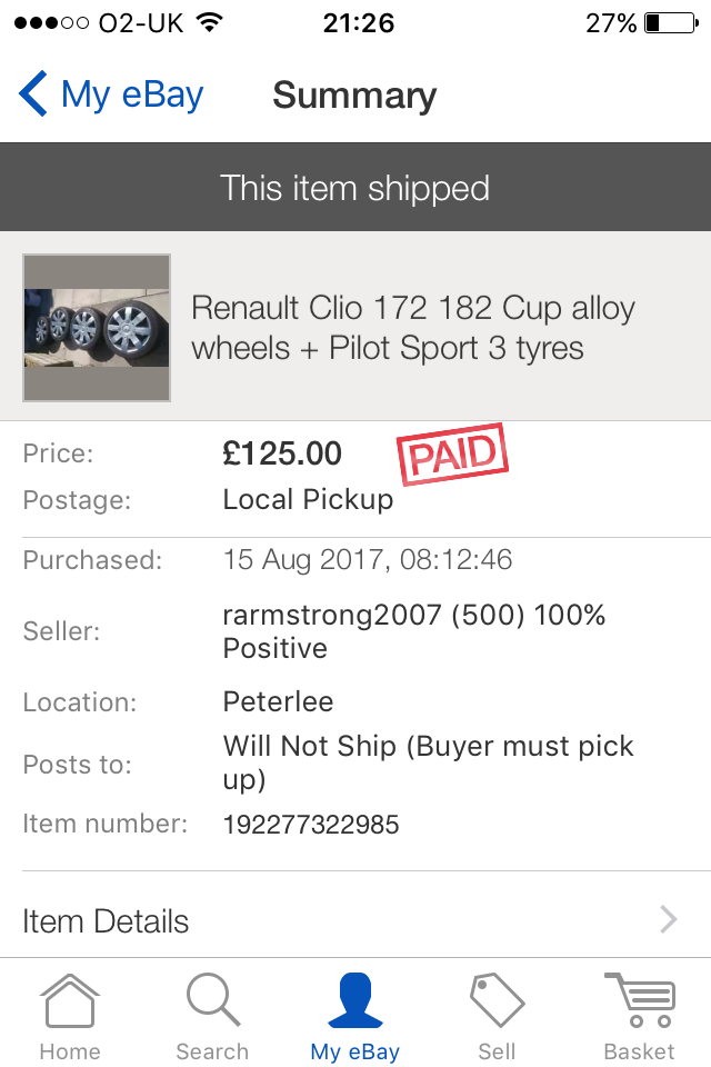

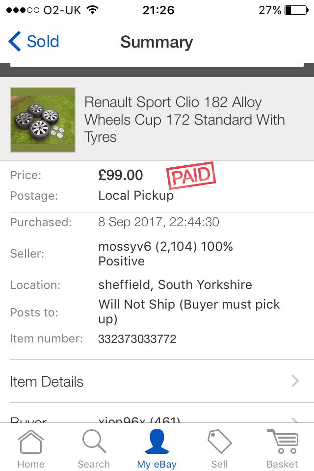

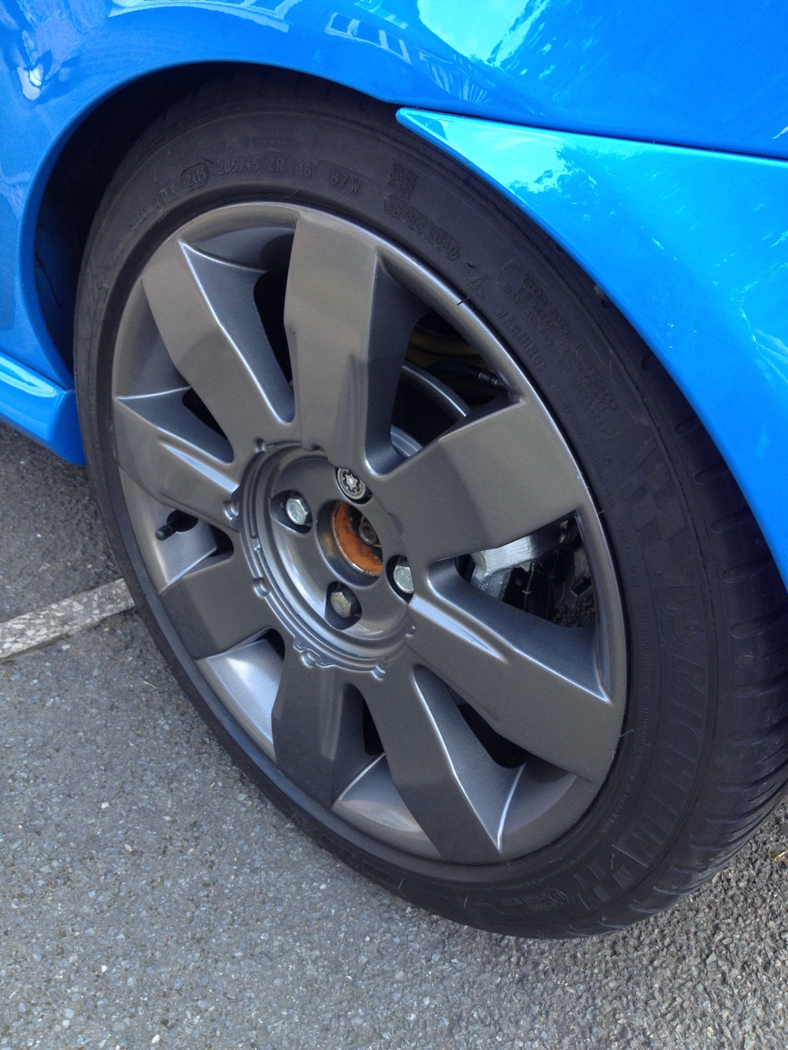

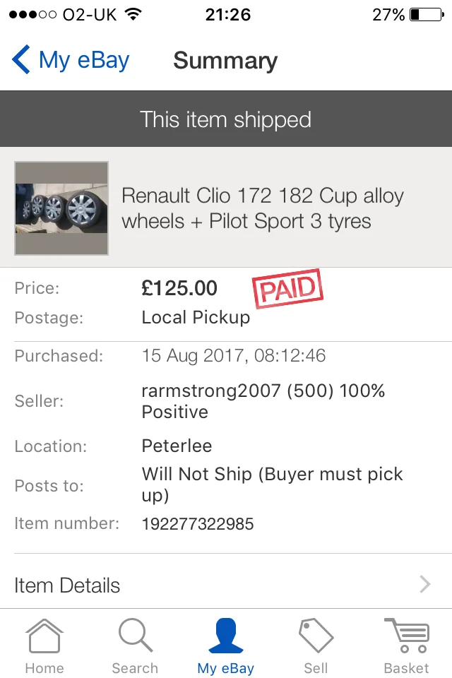

Old wheels with mismatched tyres sold:
New standard wheels with Michelin Pilot tyres bought:

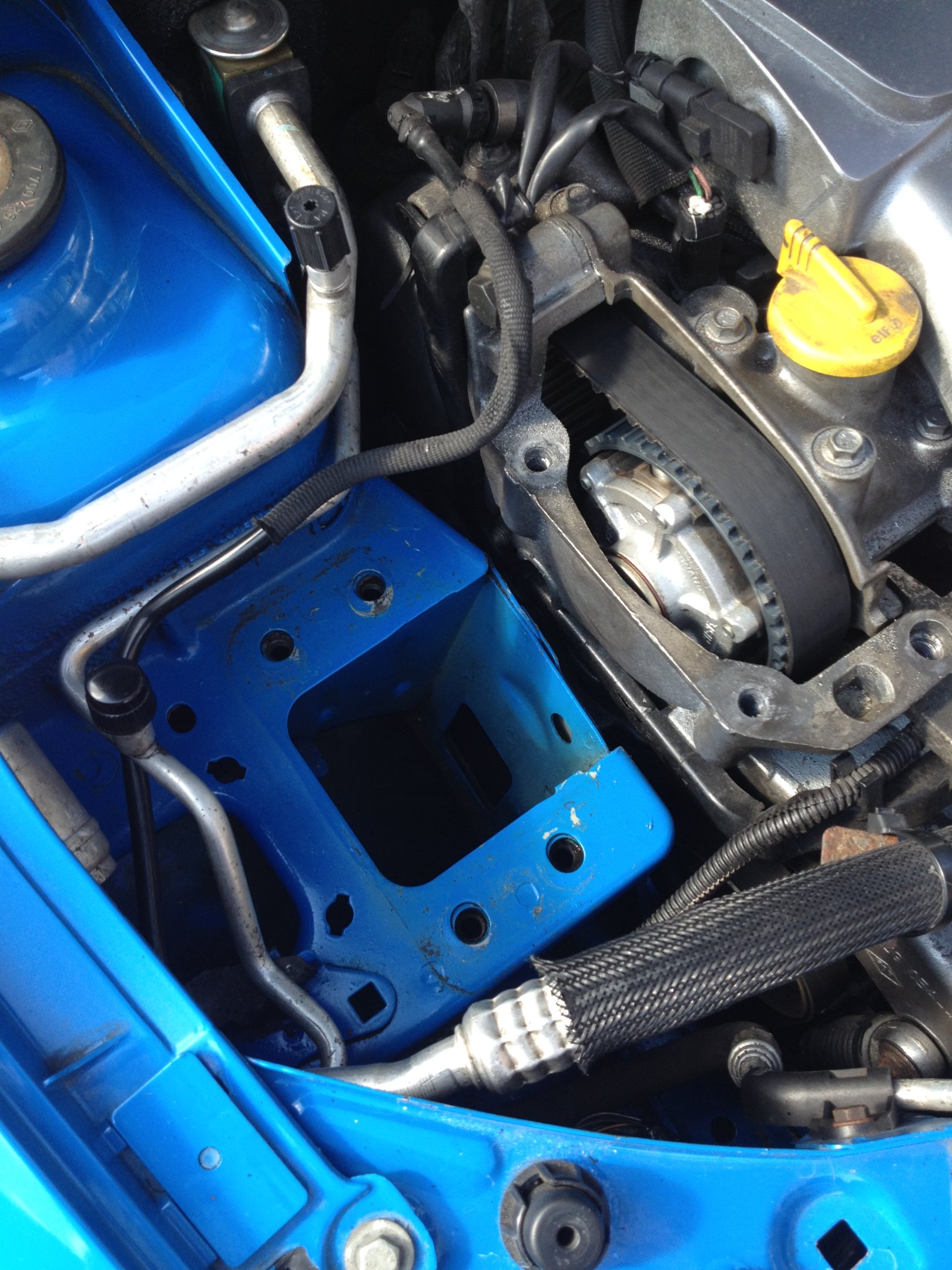

Outer powerflex ARB bushes bought (but not fitted yet):

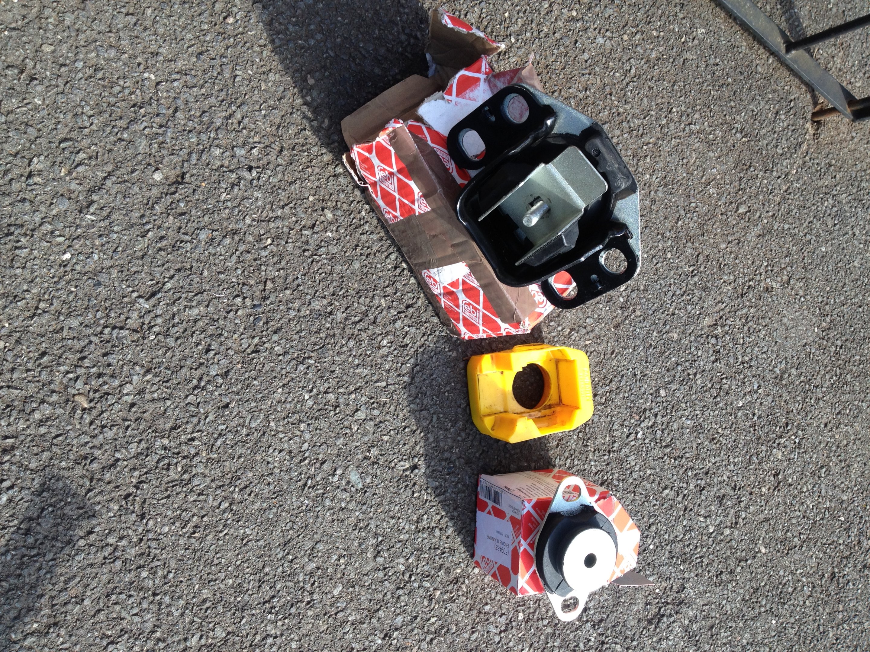

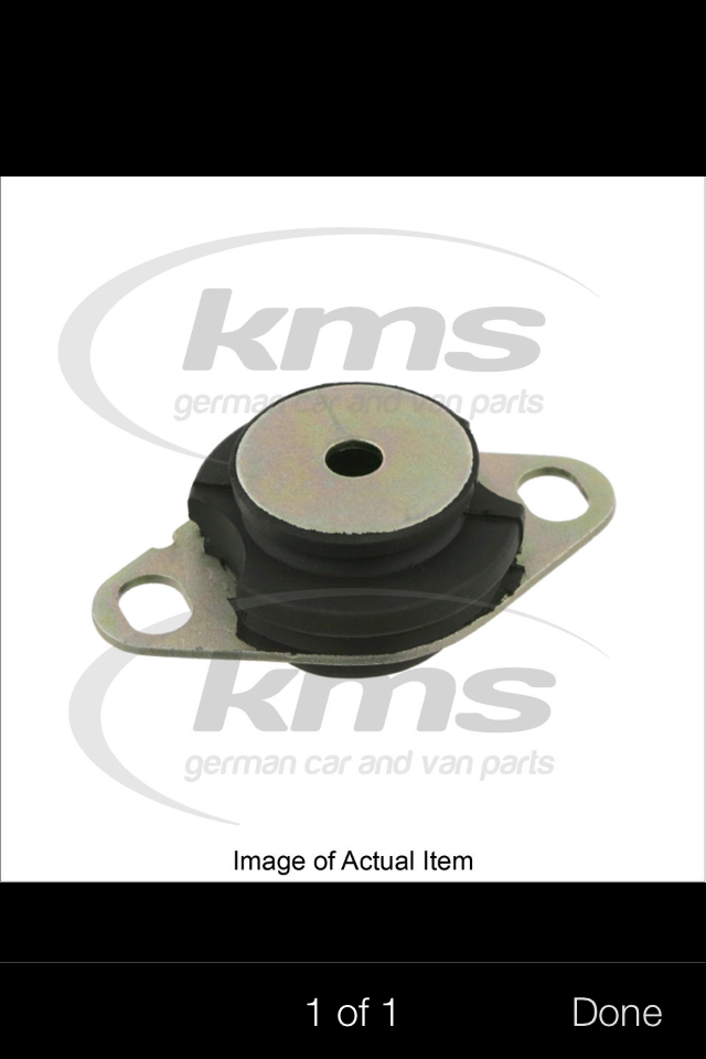

Replacement gearbox mount bought (not yet fitted - standard bought to keep down the vibrations):
mossyv6
  Trophy,V6,5GT,AG200
That's a nice touch selling one set of wheels and getting a new set for ALMOST the same price, especially with those tyres! :up::up:
Yeah winner there
Thanks you 2, the top wheels came with the car and had mismatched tyres and saw these on eBay so put an offer which was accepted, so came together nicely :)
You're a proper wheeler dealer Paul[emoji16][emoji16]
Call me Del Boy :) picked up a near new tyre for your old set and just waiting to get it swapped over and then sprayed up in anthracite :)

REAR BRAKES:
New Brembo pads, genuine renault handbrake cables and a replacement drivers rear caliper.

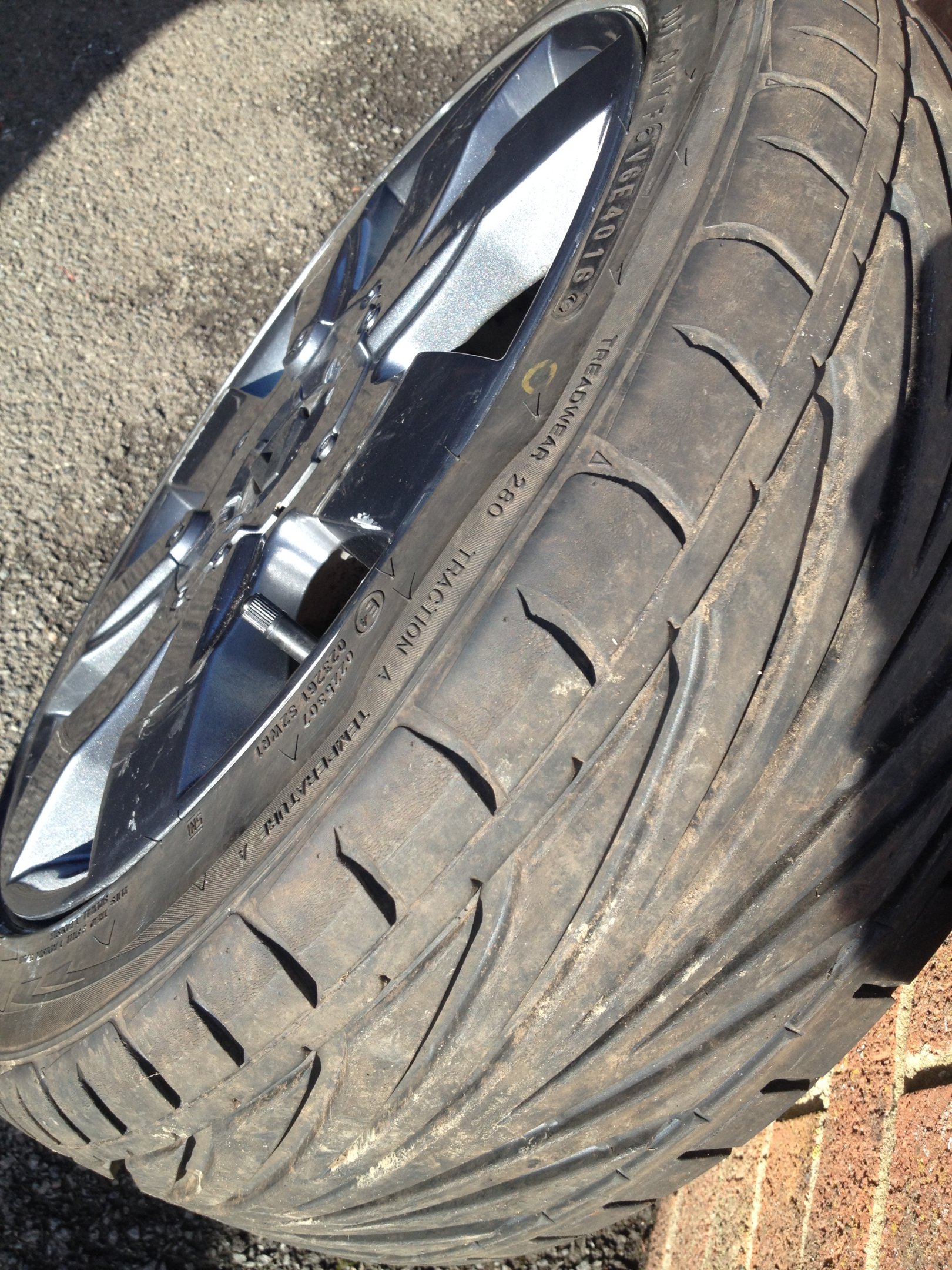

Finally got my replacement tyre fitted on my set of spare wheels to be greeted by this fat egg:
Fortunately the eBay seller refunded my money straight away :)

It's always a gamble with second eBay tyres - had it this issue before :(

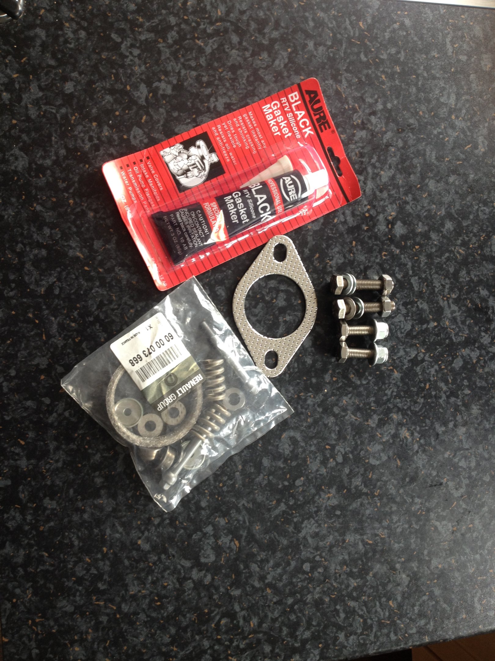

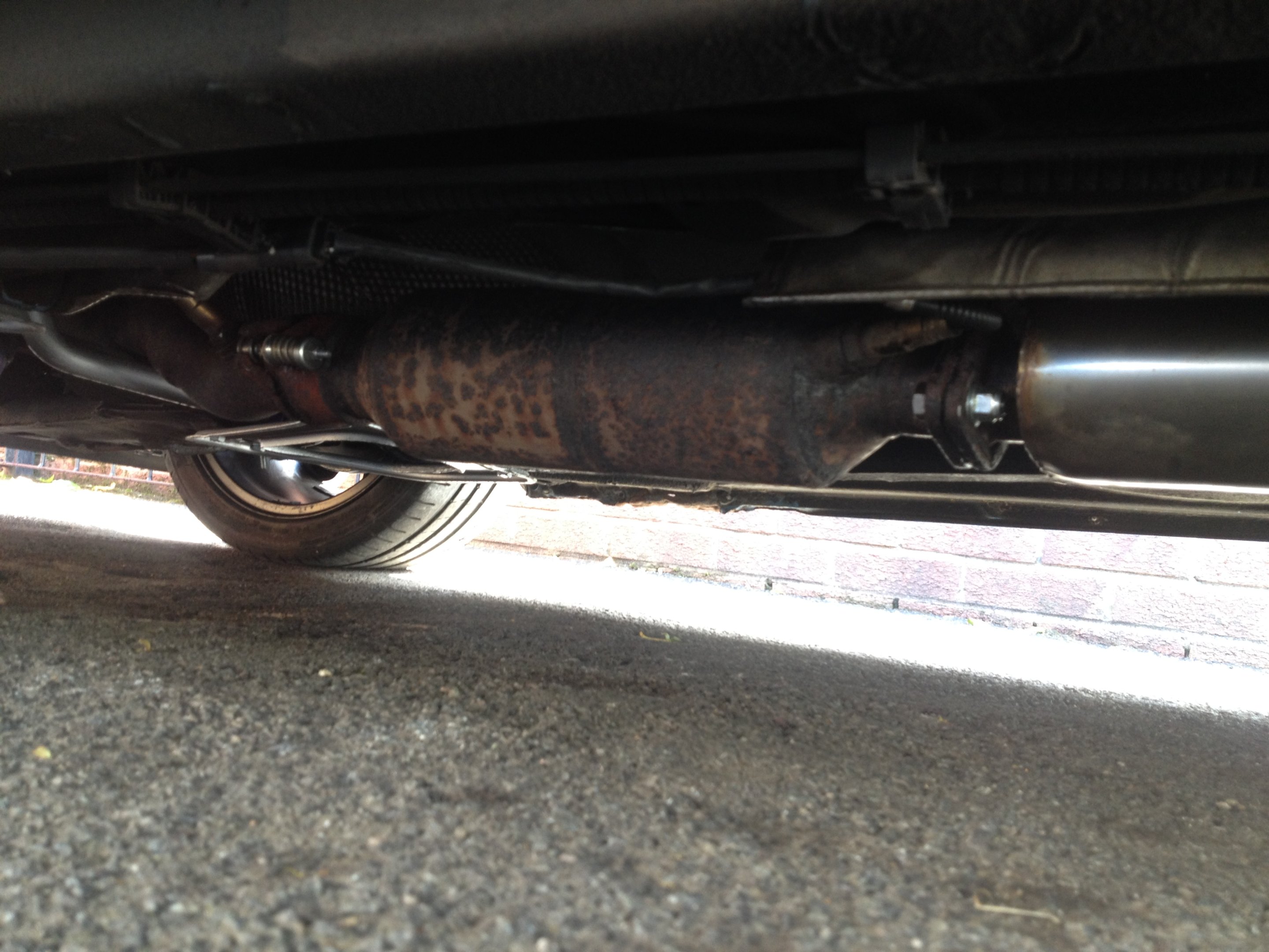

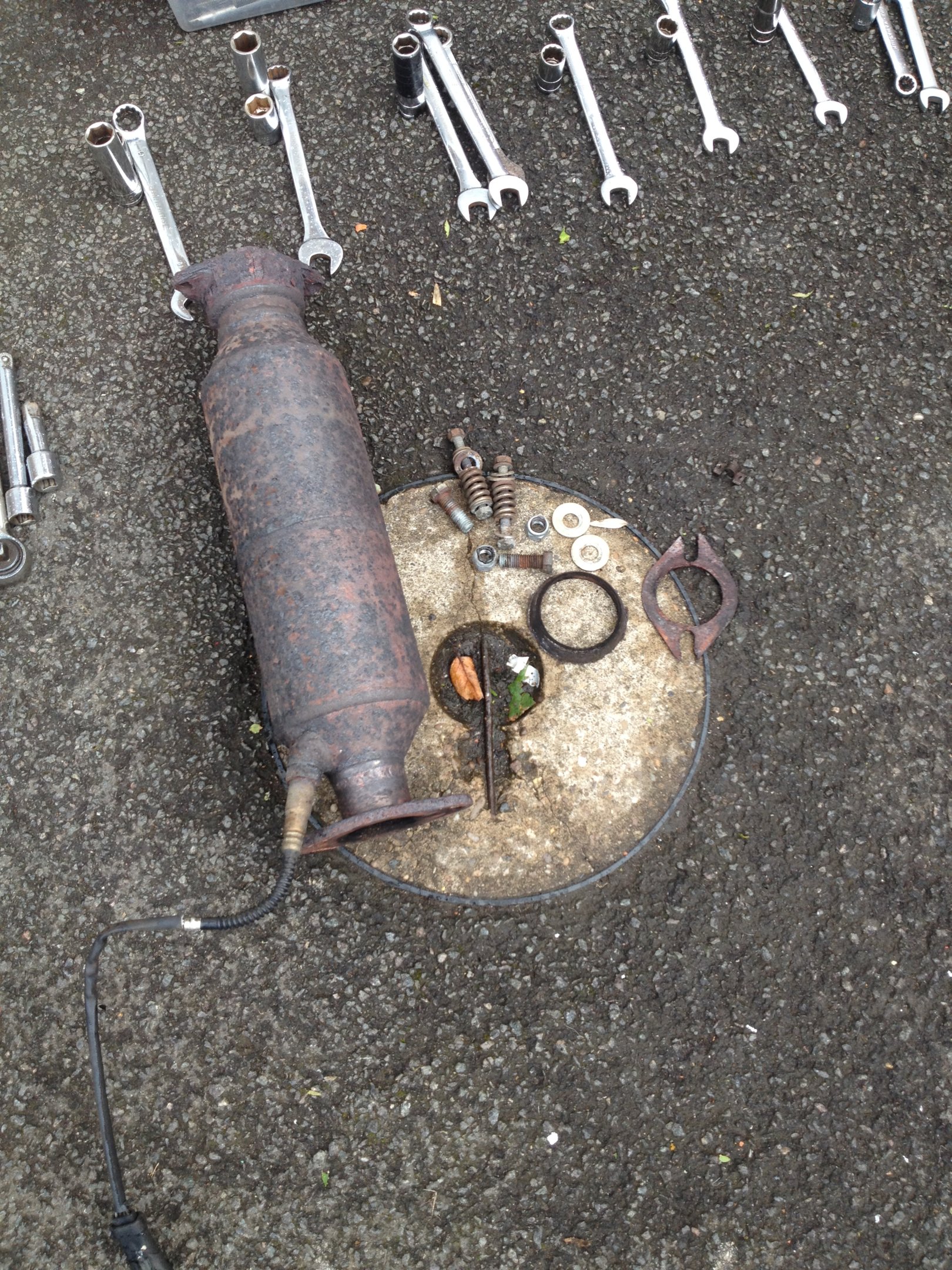

Exhaust Cat re-seal. Exhaust has been modded at some point with the olive joints chopped and bolt in joints done but not sealed very well. Also did front of the cat.
Removed:
Fitted:
