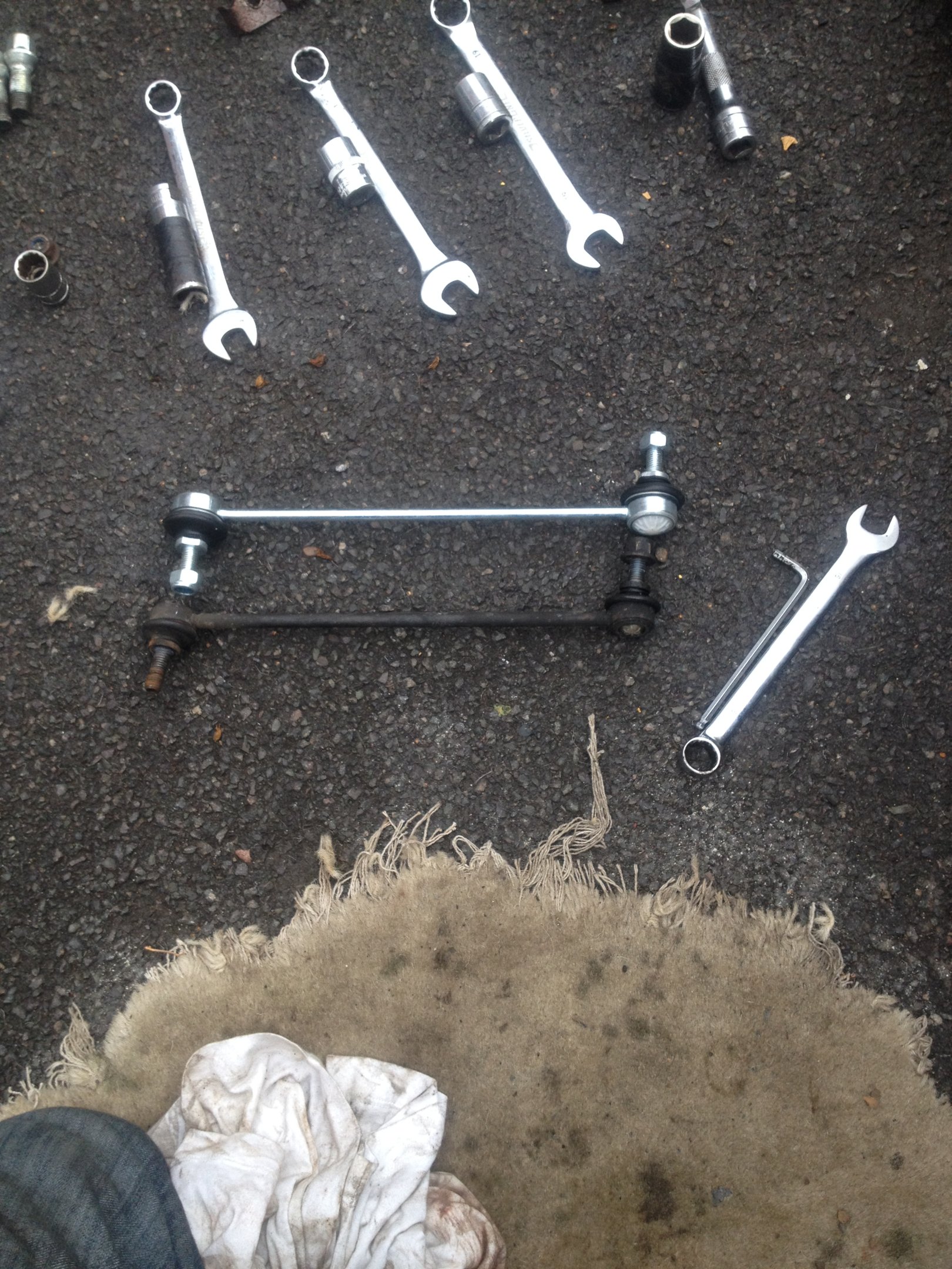

R26 - following done in last few months:
New tyres - all 4 Michelin Pilot 4's and tracking - not cheap but so worth it.

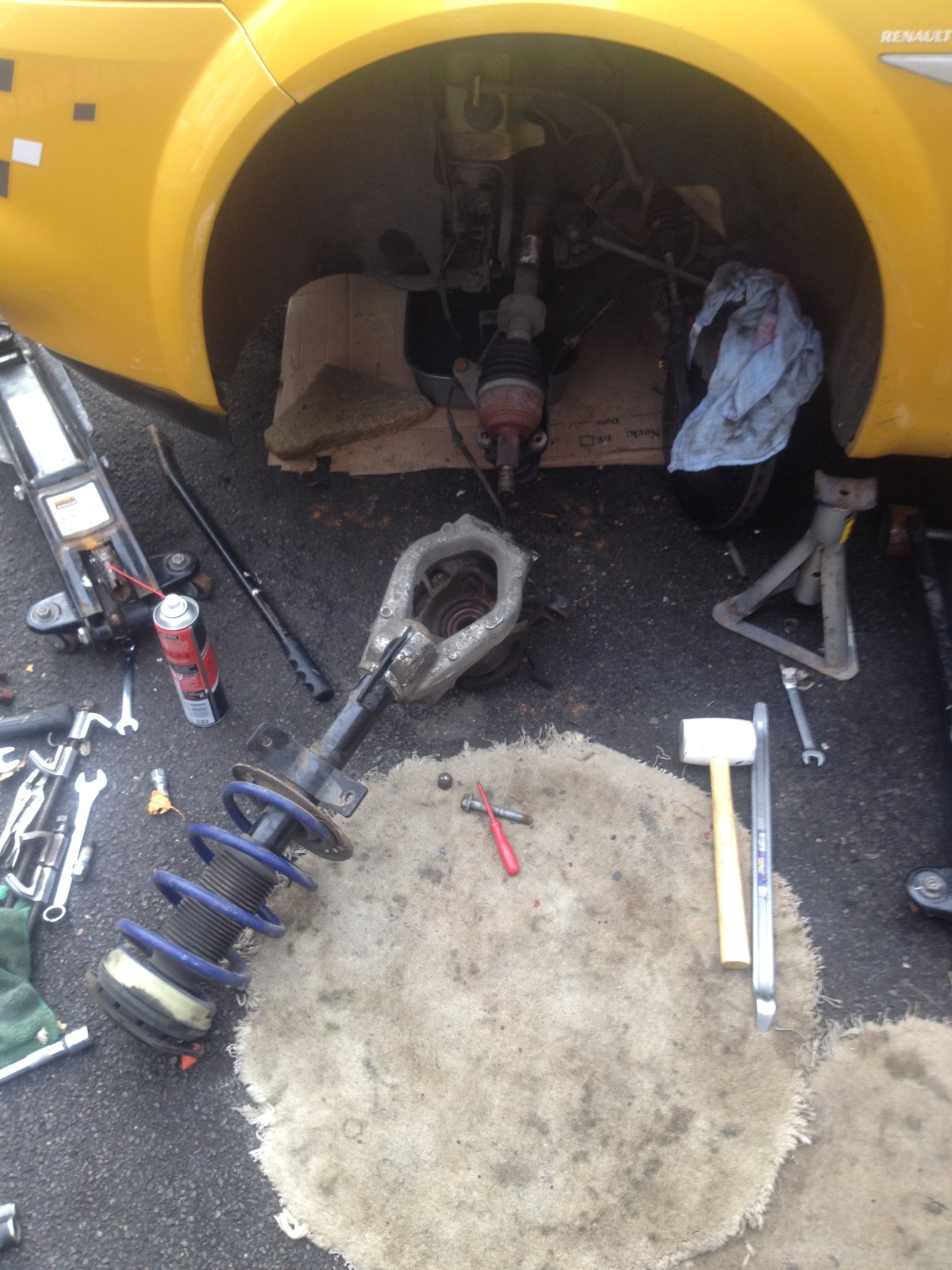

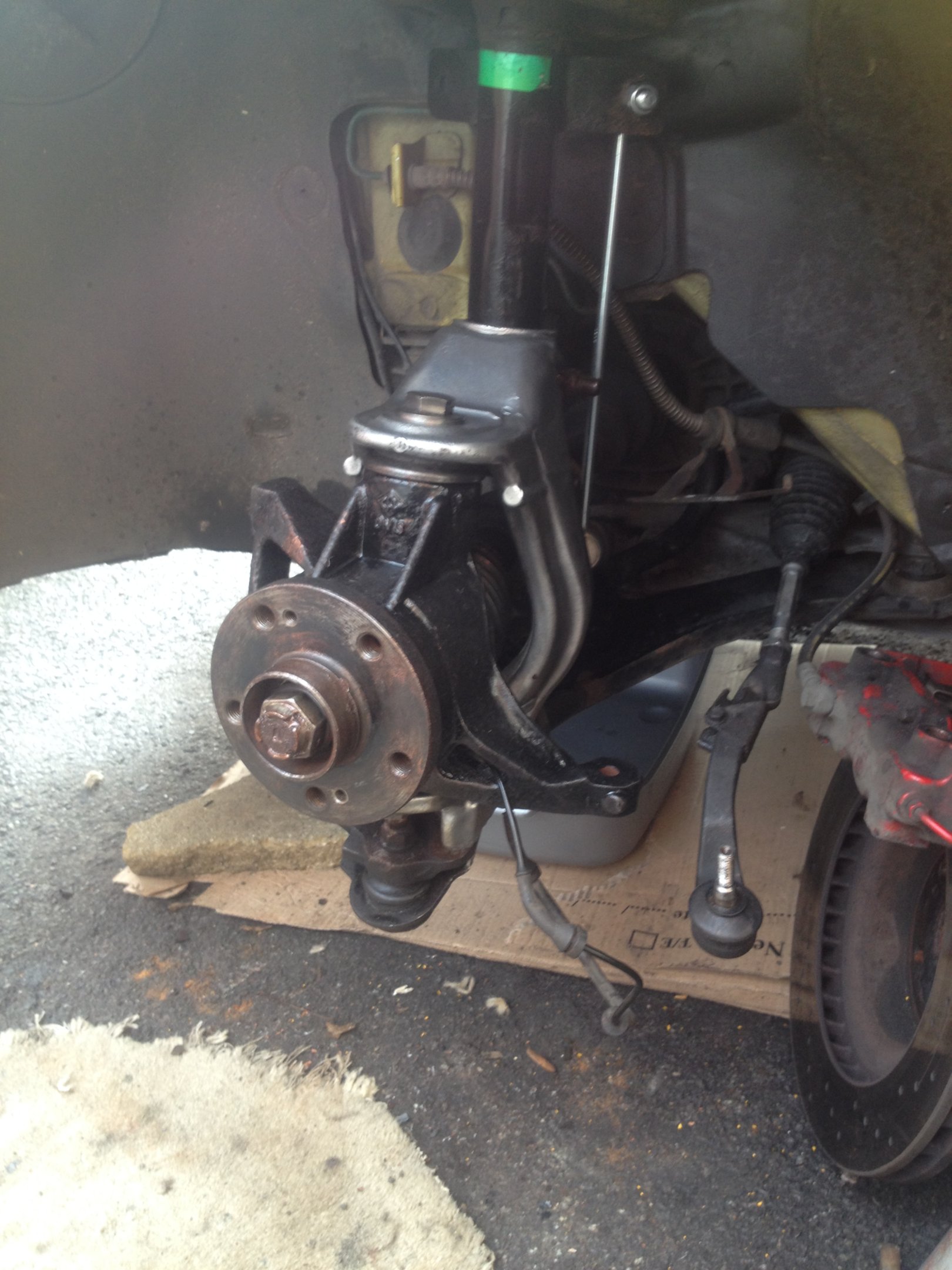

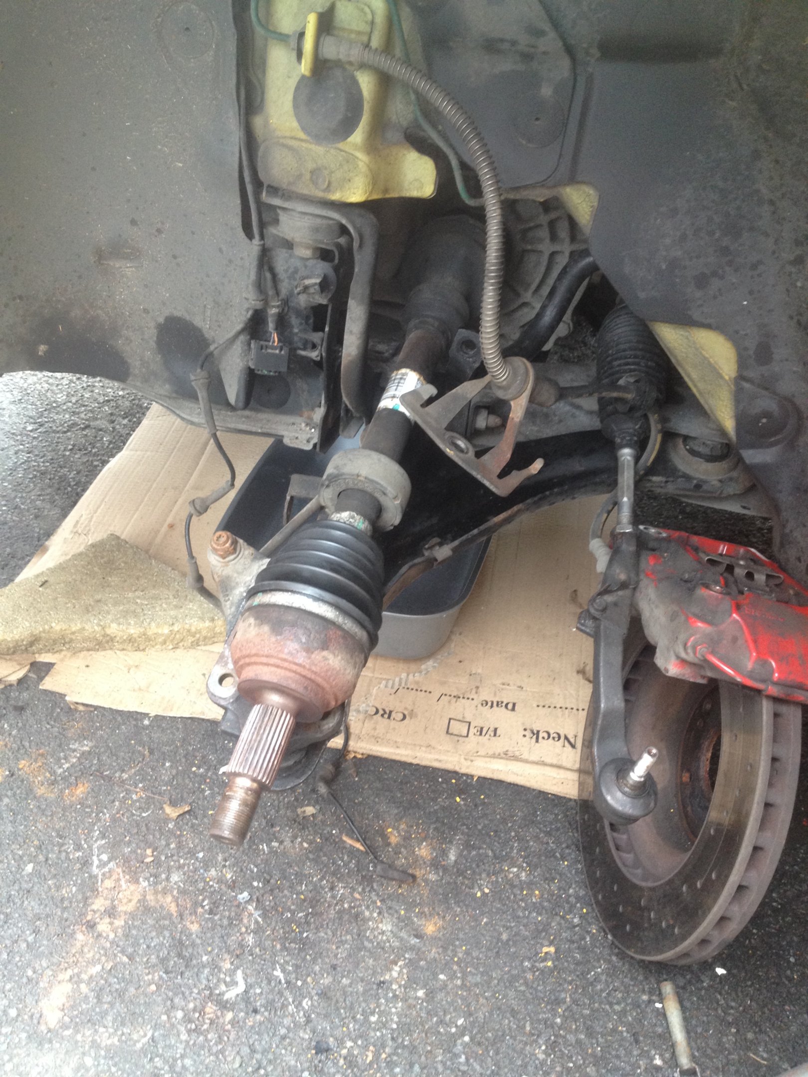

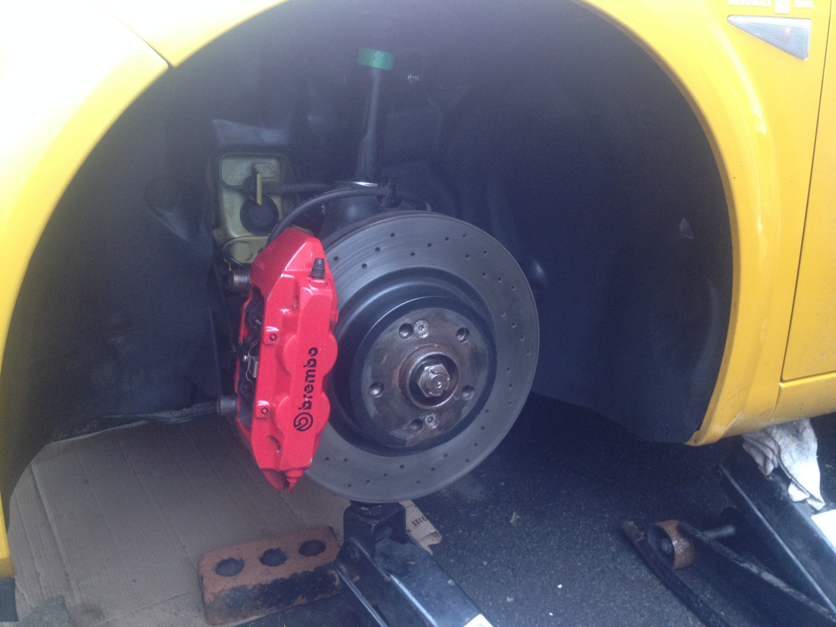

Passenger side hub replacement - wheel bearing was shot so replaced whole hub on my drive - took me a while, lol.
All new drop links - stuts and wishbones.
Inner and outer track rod ends - genuine renault.
Car is back to driving arrow straight as the broken wheel bearing was grabbing/pinching the drive.
Oh and hit 54k miles!

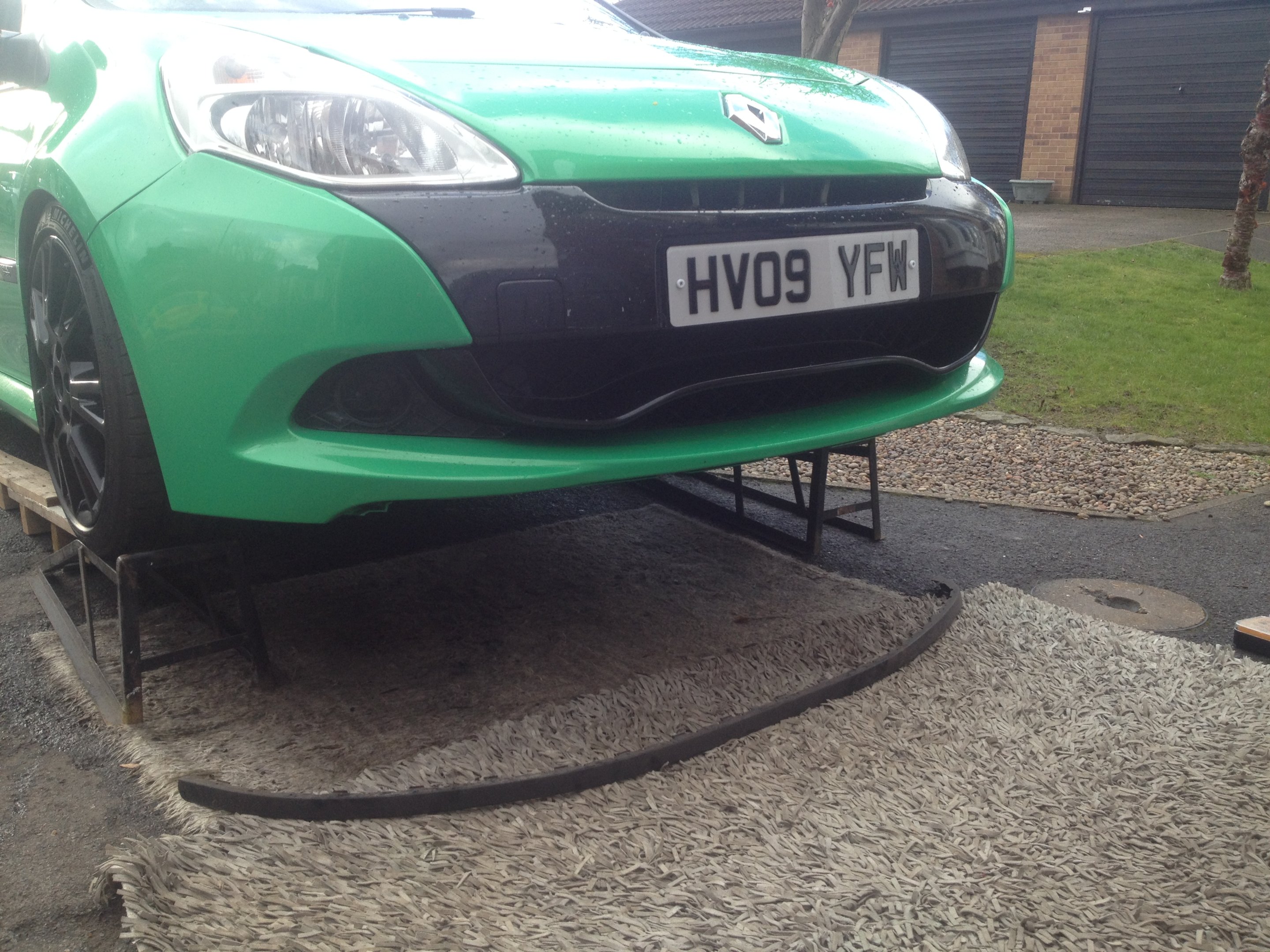

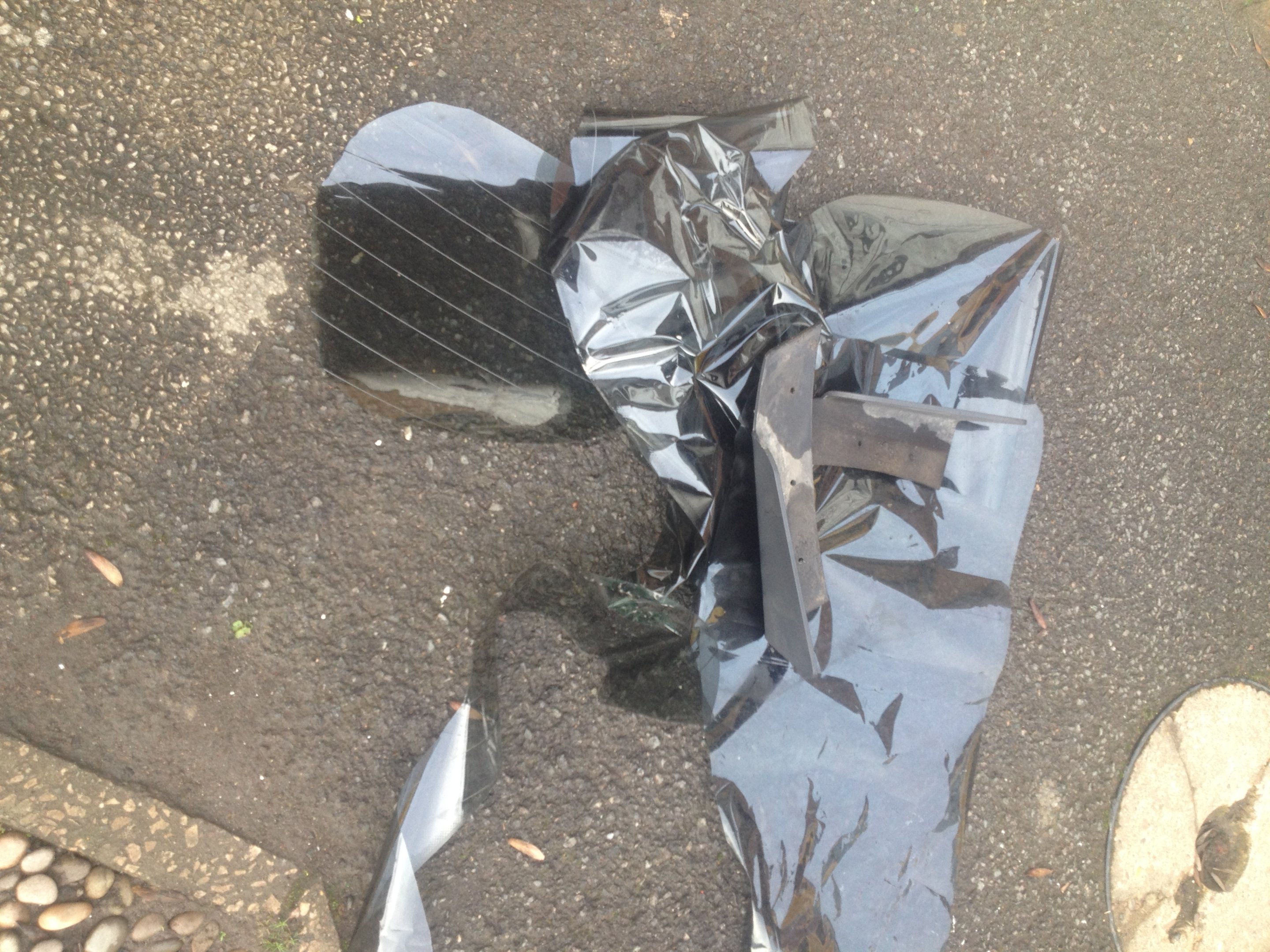

A few items removed:

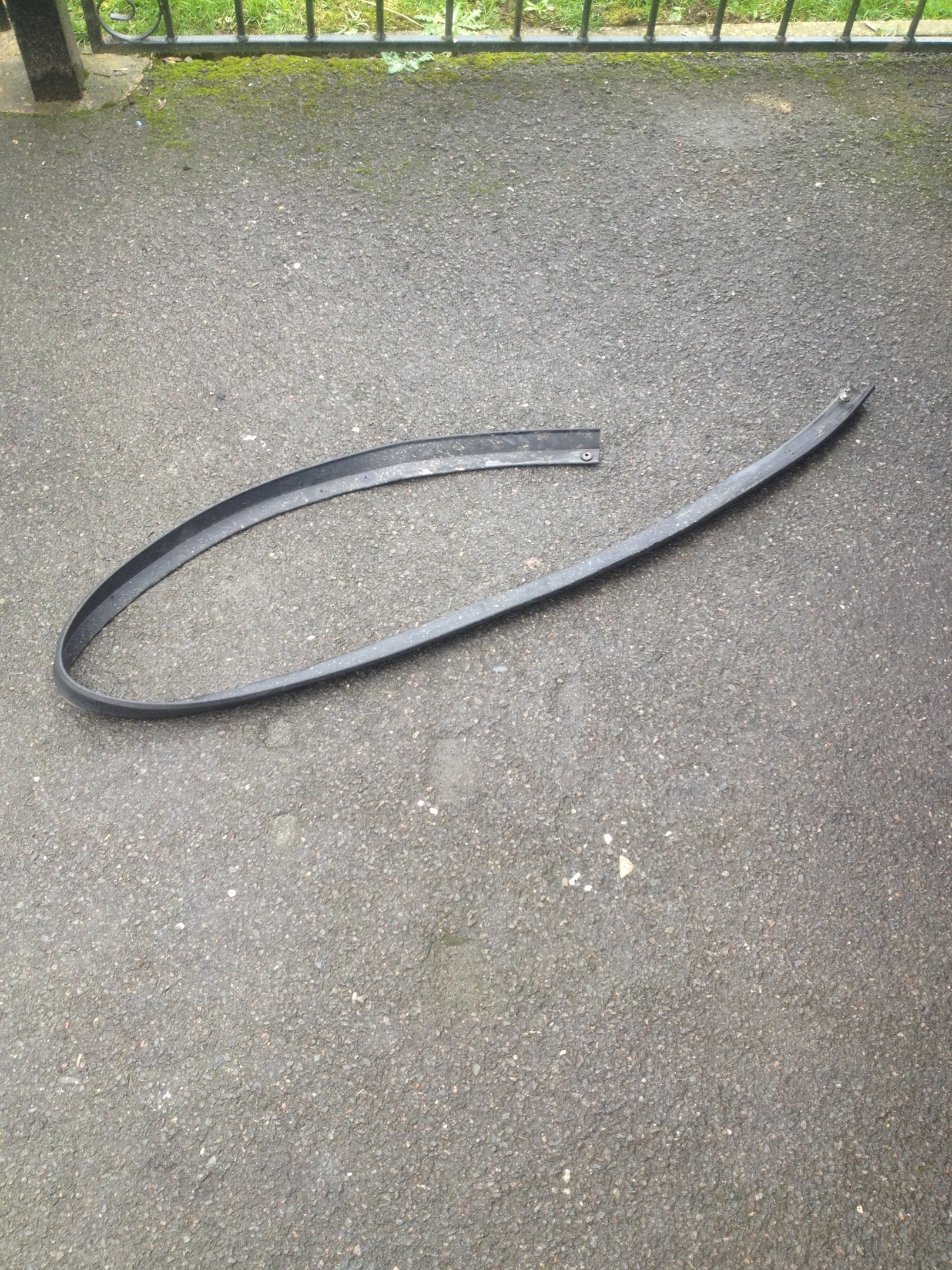

Removed the tint from the back 3 windows, side winglets things and the stuck on front bumper splitter.
When I removed the splitter I was greeted with a missing original splitter:
But I had a new skoda splitter in the garage which was accordingly cut and shaped and screwed in place. Trickiest bit was shaping the corners with the curved recess but came out really nice. It even fitted the original clip holders :) screwed it in place and all good :)
During fitting:
Before:
After:

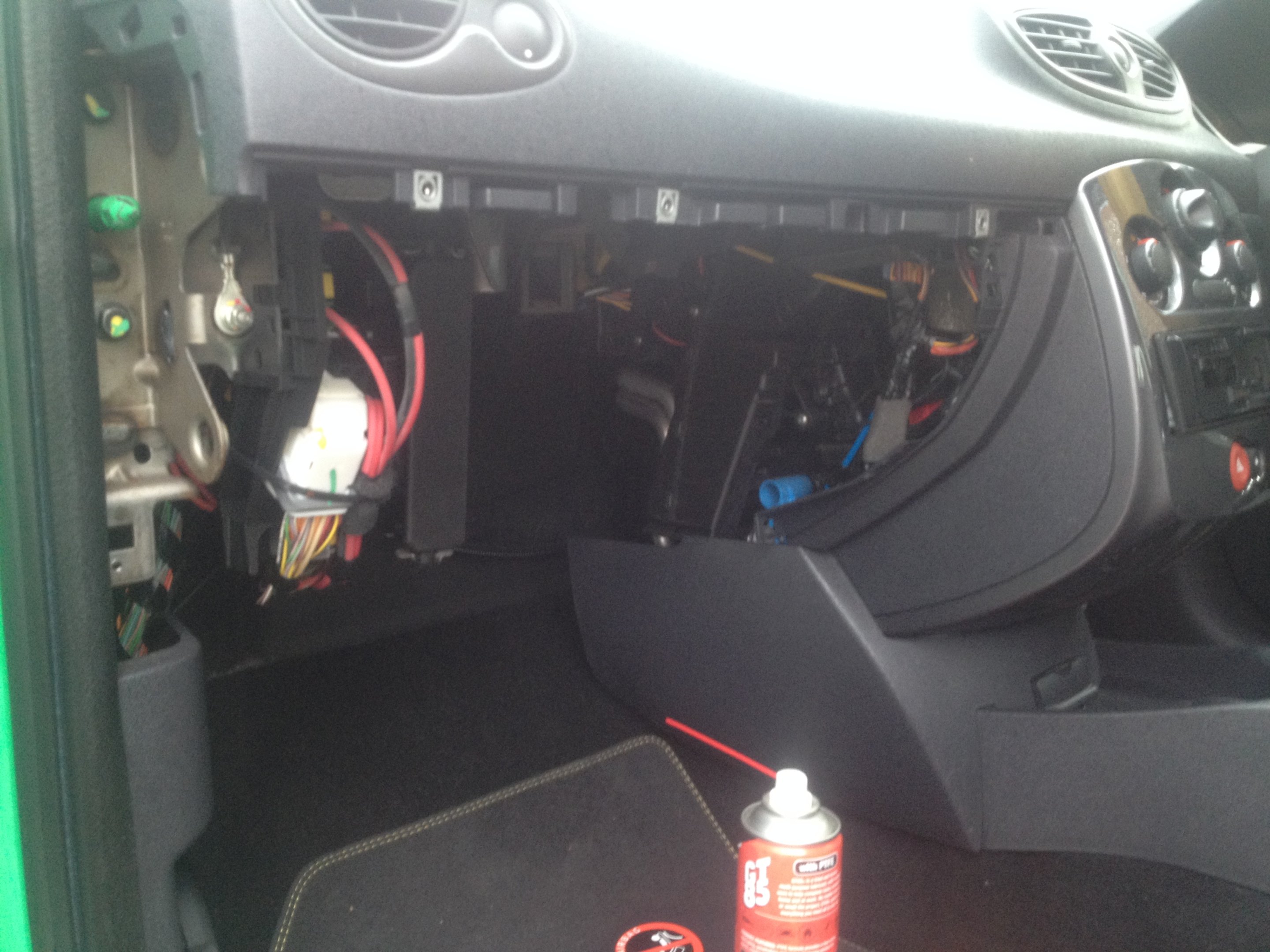

Heater speed 4
When I bought the car the heater wasn't working on speed 4. The car came with a new resistor but thought I would try a quick easy fix and it worked:
Removed the glove box, unplugged the resistor plug, GT sprayed plug and socket - job done!! Took 10 mins and free!
