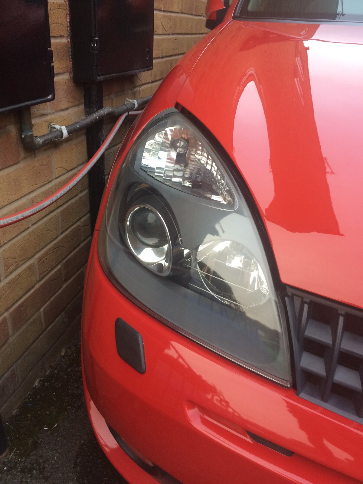

Headlight restoration (yes I know there xenon/none cup).
Took a couple of hours but came out like new.
Usual routine of 400 to 1500 wet and dry then polished with cutting compound, polished and sealed.
Sorry no before photos but they were yellow.

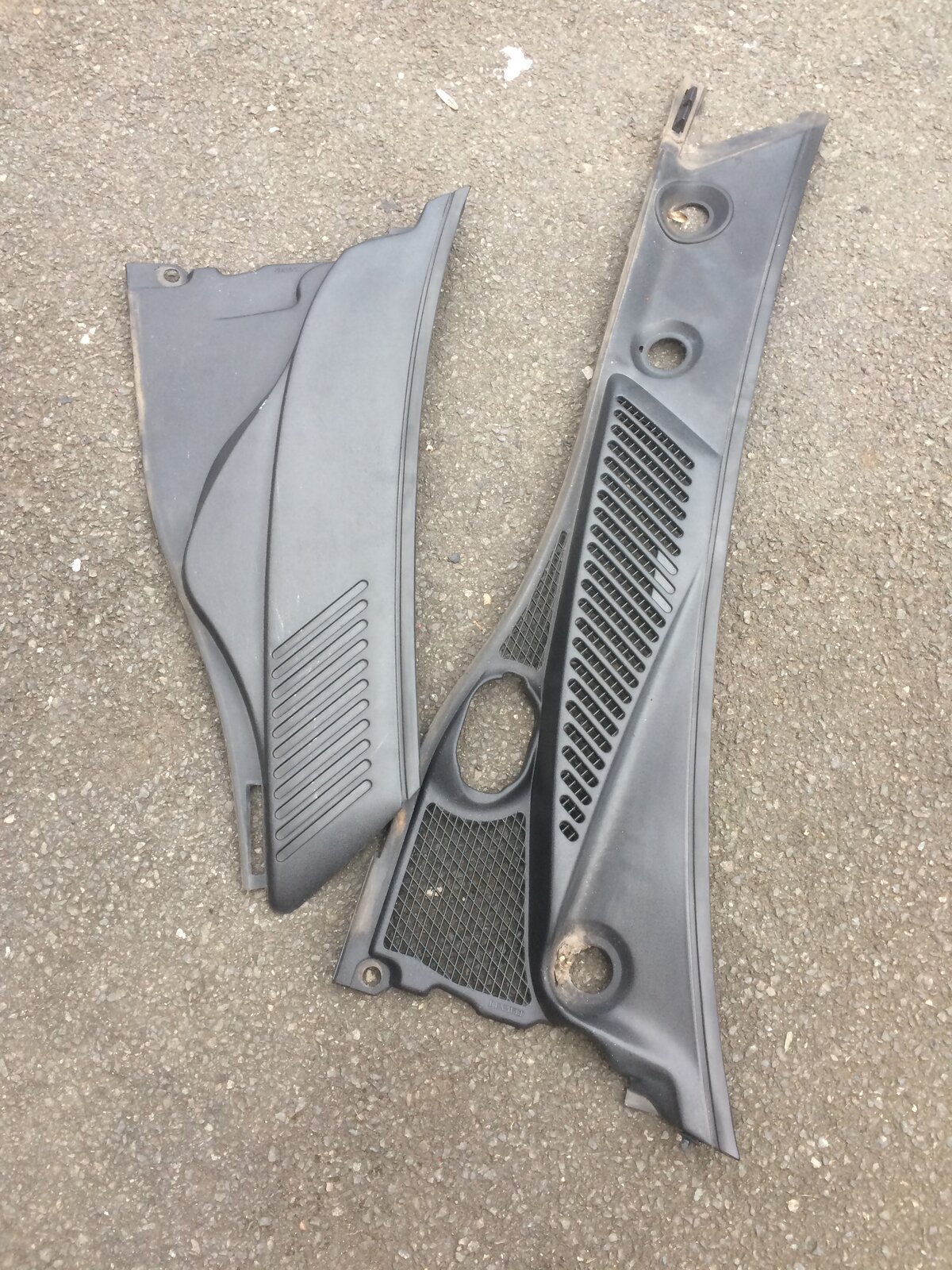

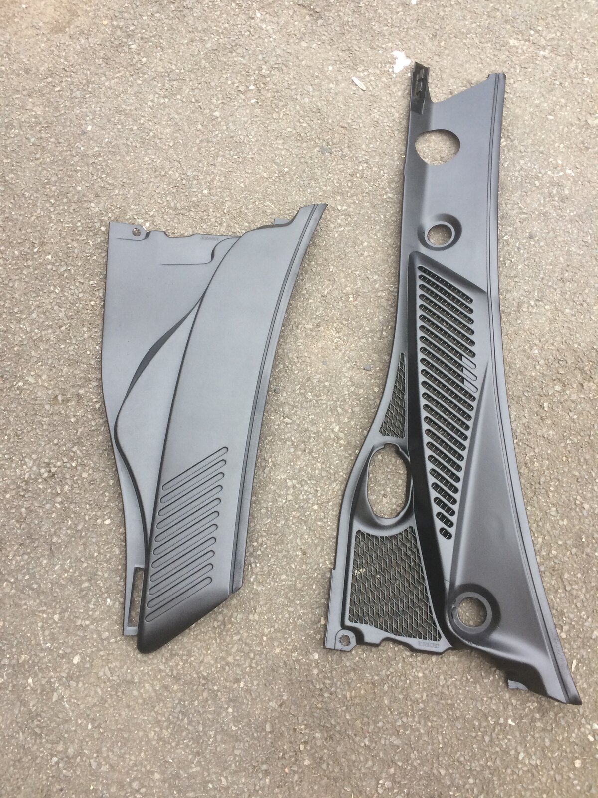

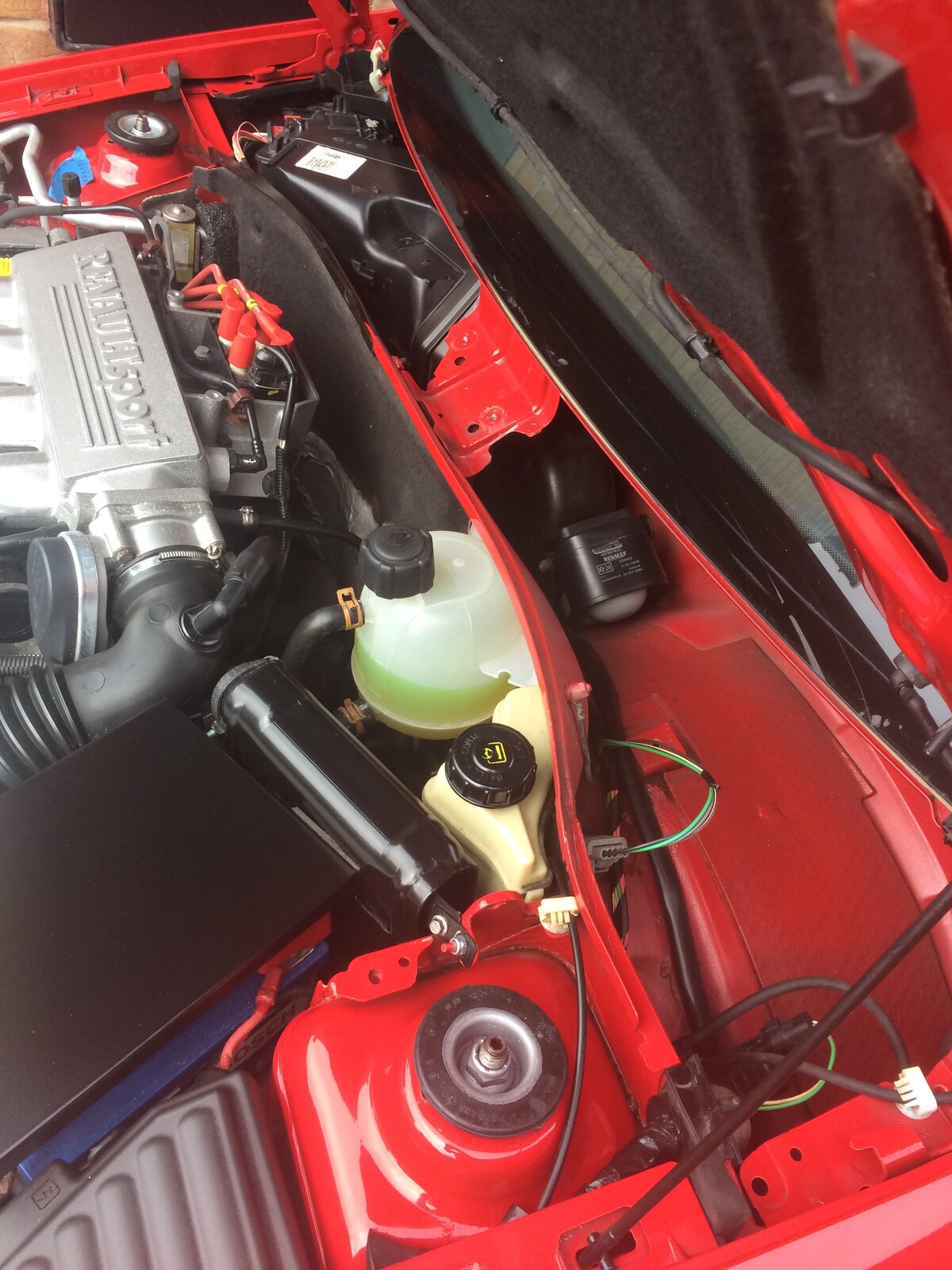

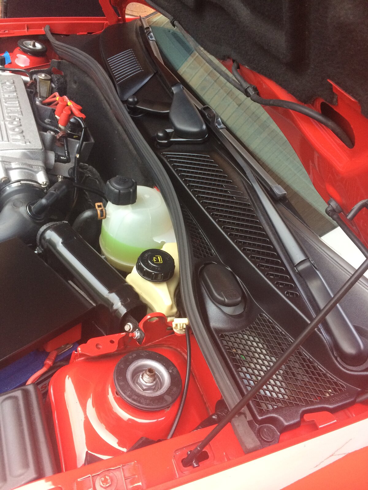

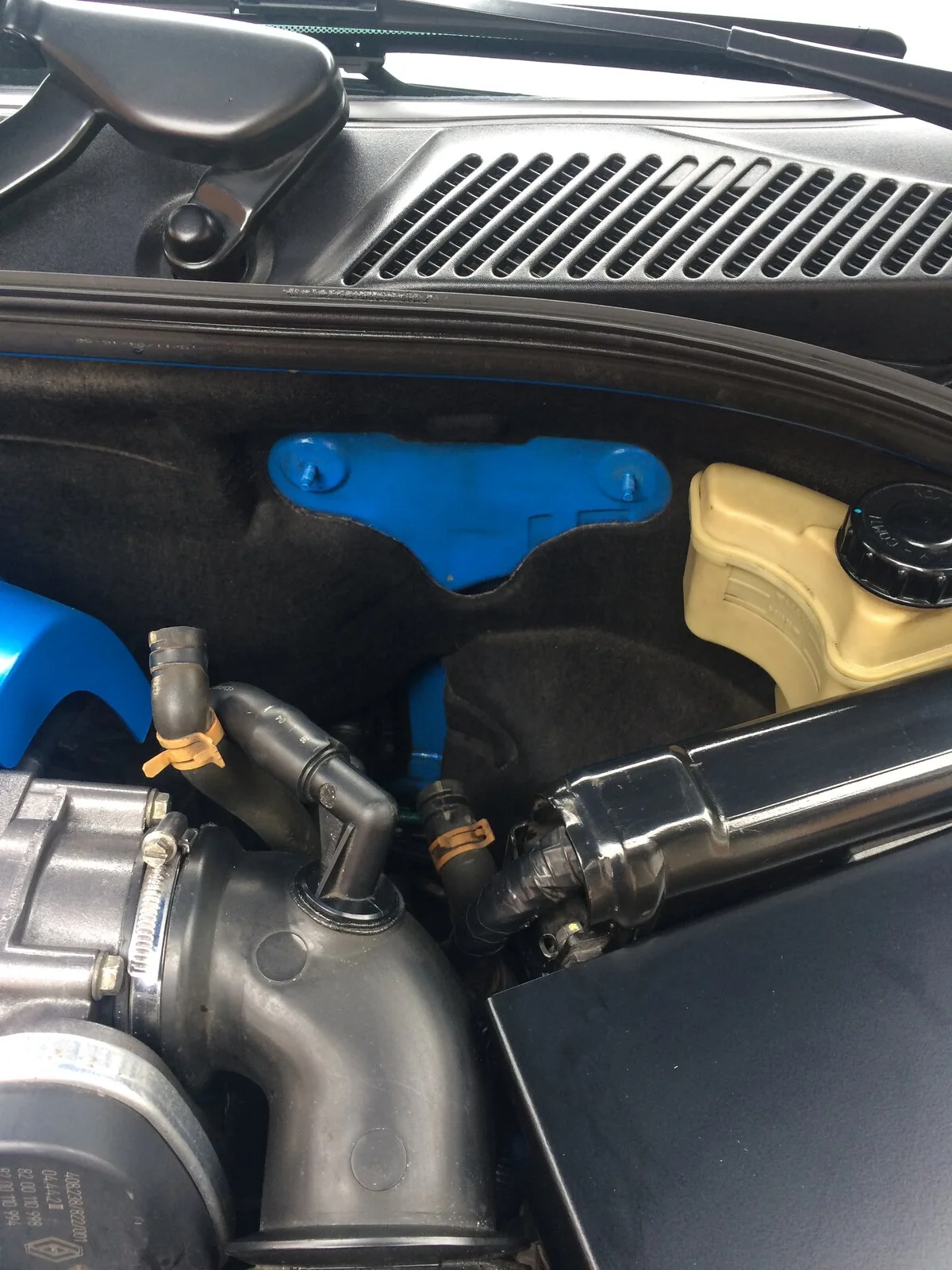

Scuttle panel restoration

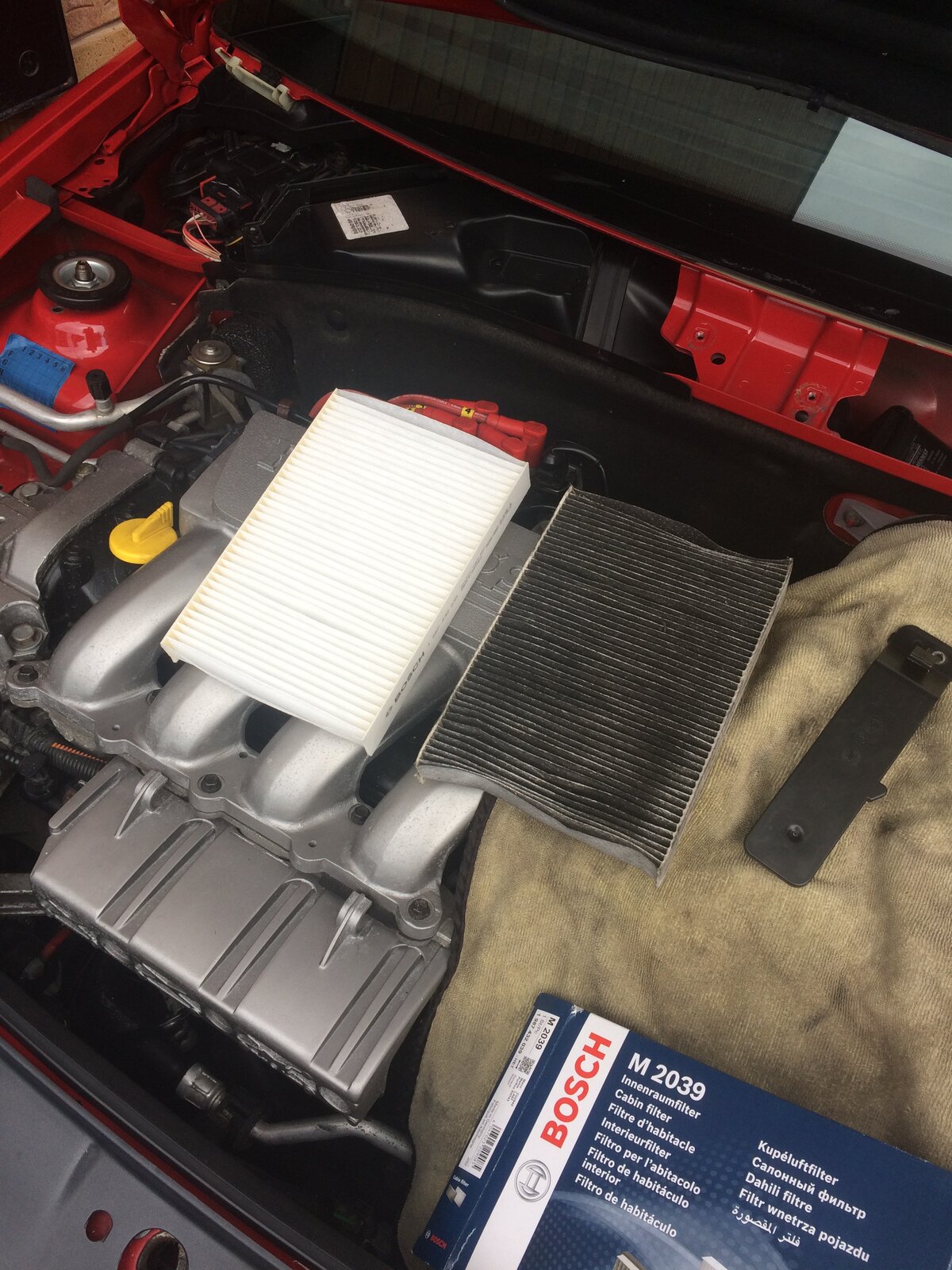

Plastic scuttles were faded light grey, wiper arms marked and a bit scabby, new cabin filter to fit and also check the drains were okay and thorough clean.
Scuttle panel removed:
And painted in satin black:
Scuttle area cleaned up and drainage channels checked and all good:
Cabin filter changed:
Wiper arms sanded back and painted satin black (sorry no pics).
Everything back together:

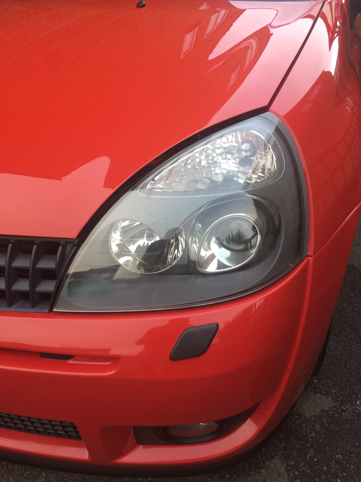

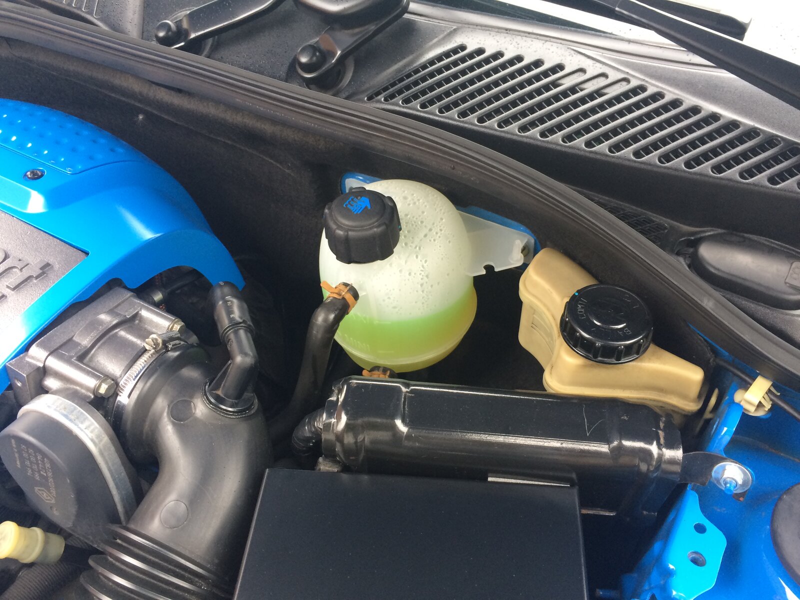

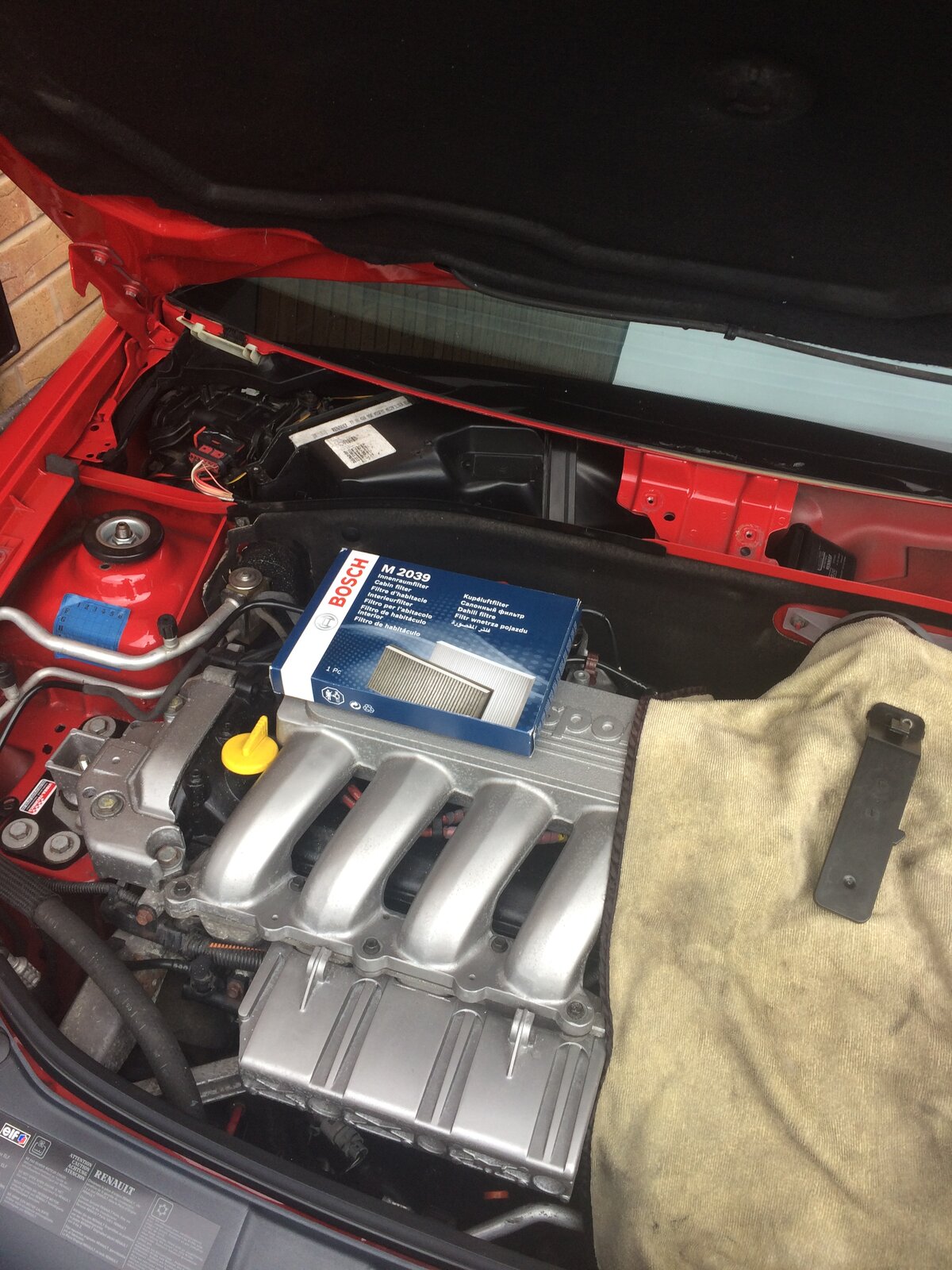

View attachment 1433394View attachment 1433387
That's looking fantastic Paul, top work!
How easy are the wipers to remove? I wouldn't mind cleaning mine up similar
mossyv6
  Trophy,V6,5GT,AG200
Thanks Louis - they’re quite easy to remove but can be stuck on the spindles shafts due to rust. If they’re stuck on, undo the 13mm nut slightly and give the nut a tap with a hammer whilst pulling on the wiper arm up and they eventually come free.
I cleaned the shaft spindles up with a wire wheel and put a coat of copper grease on before putting the wiper arms back on.

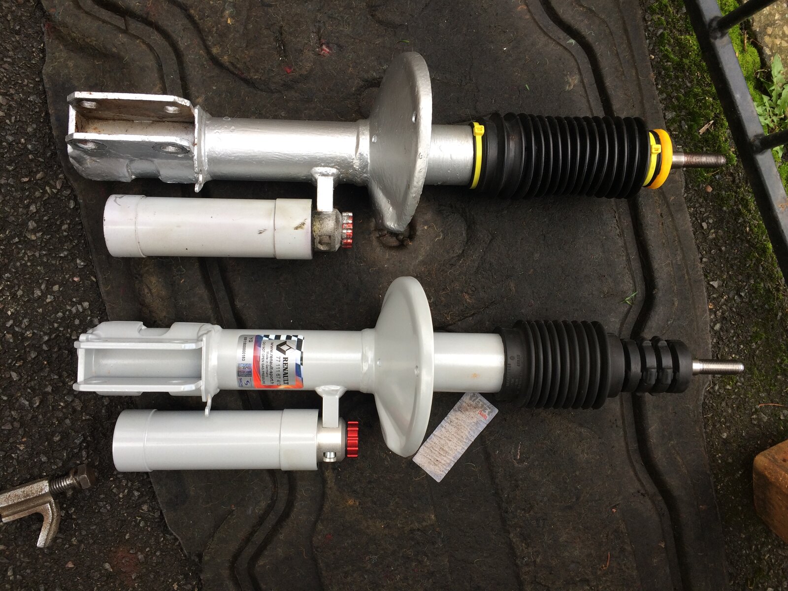

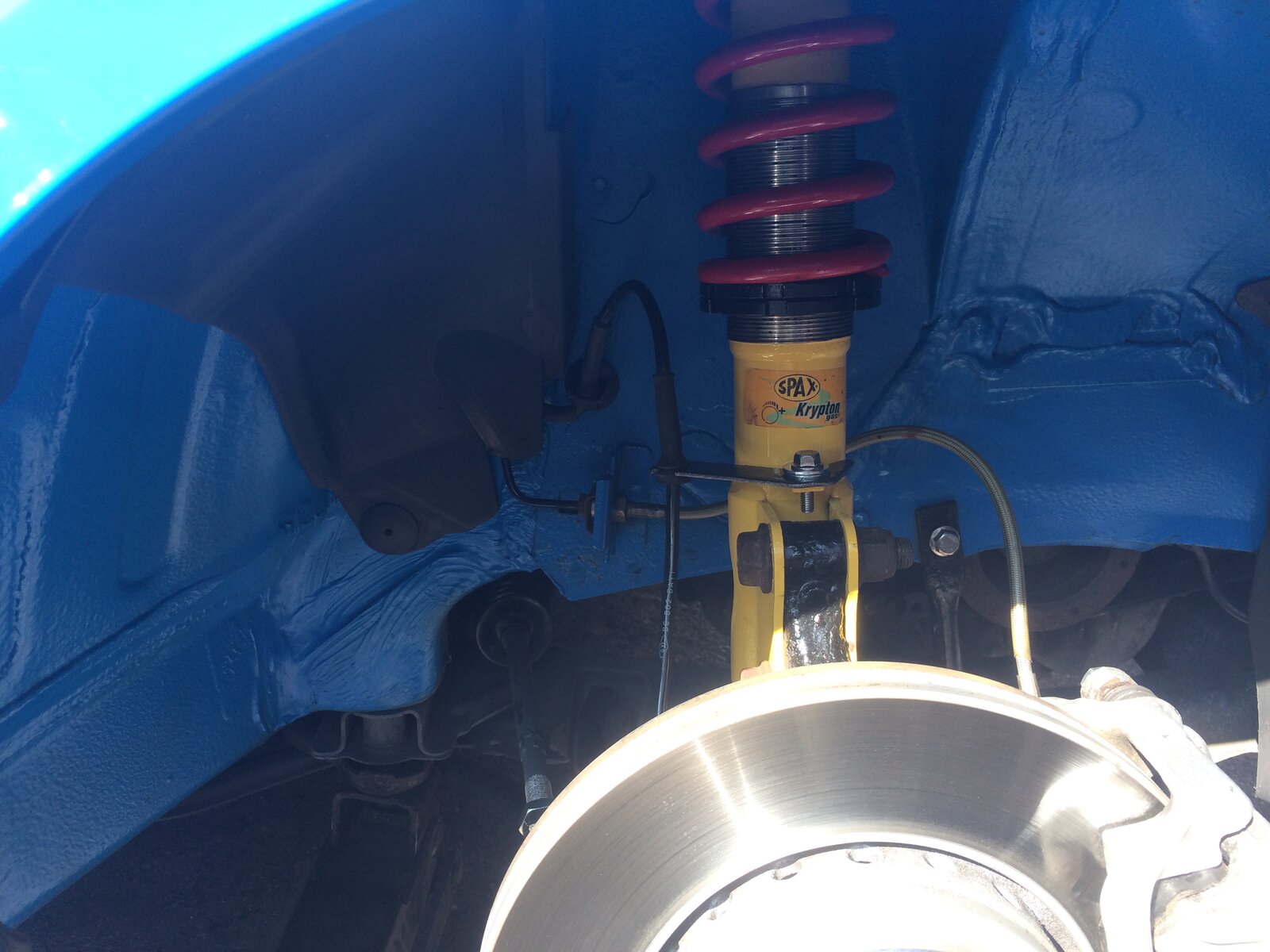

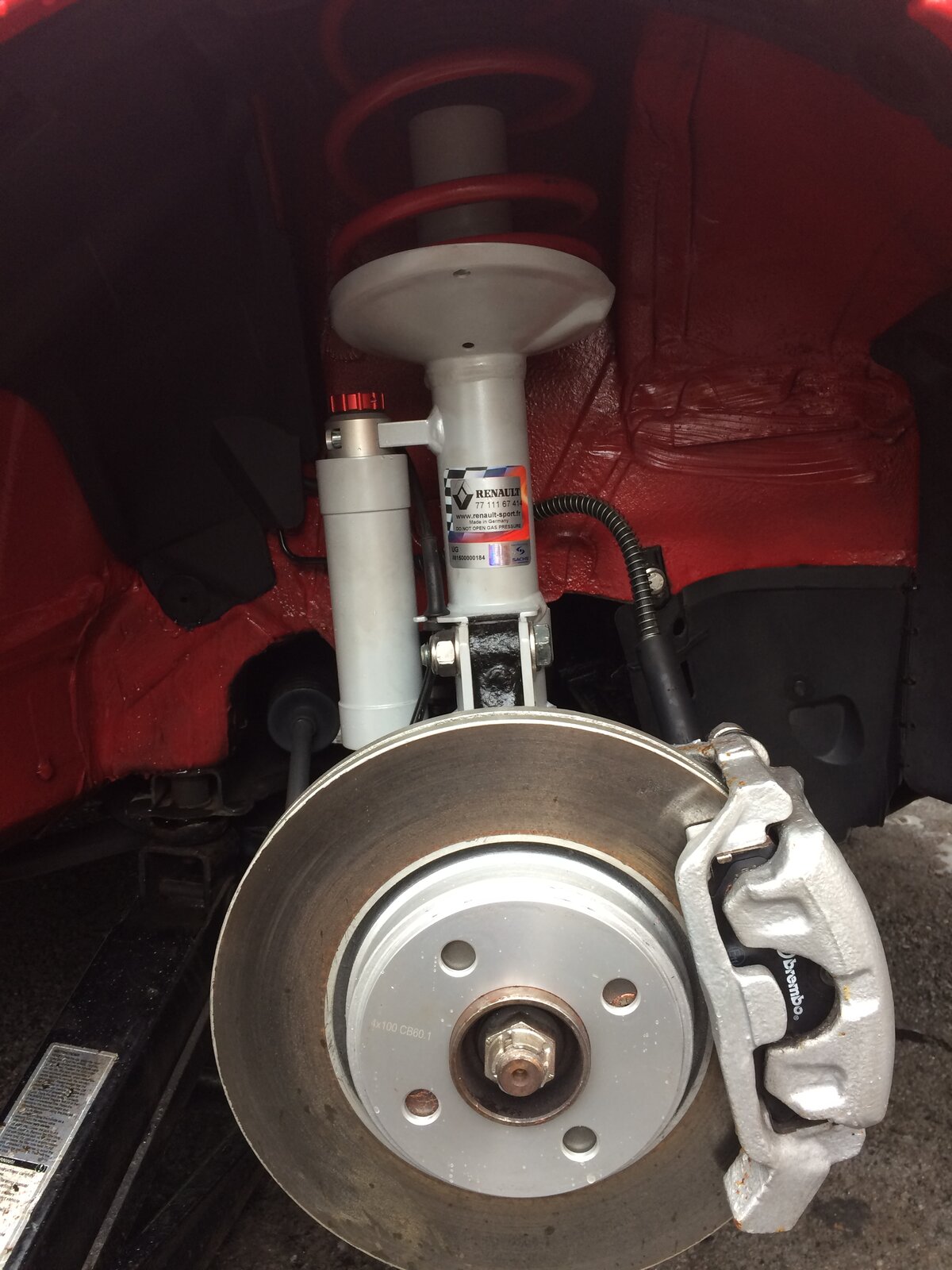

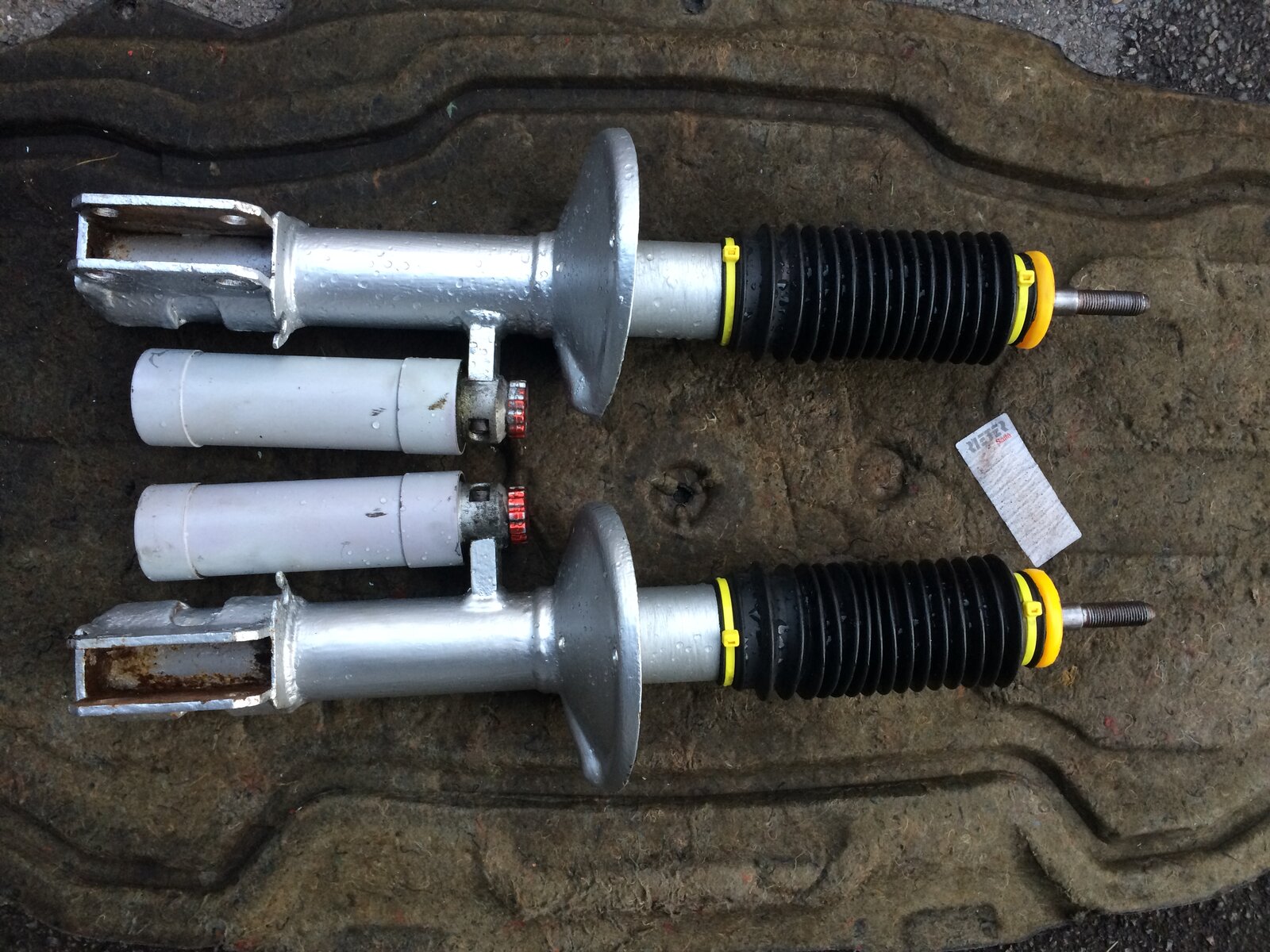

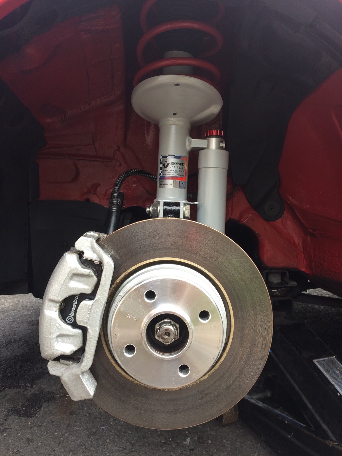

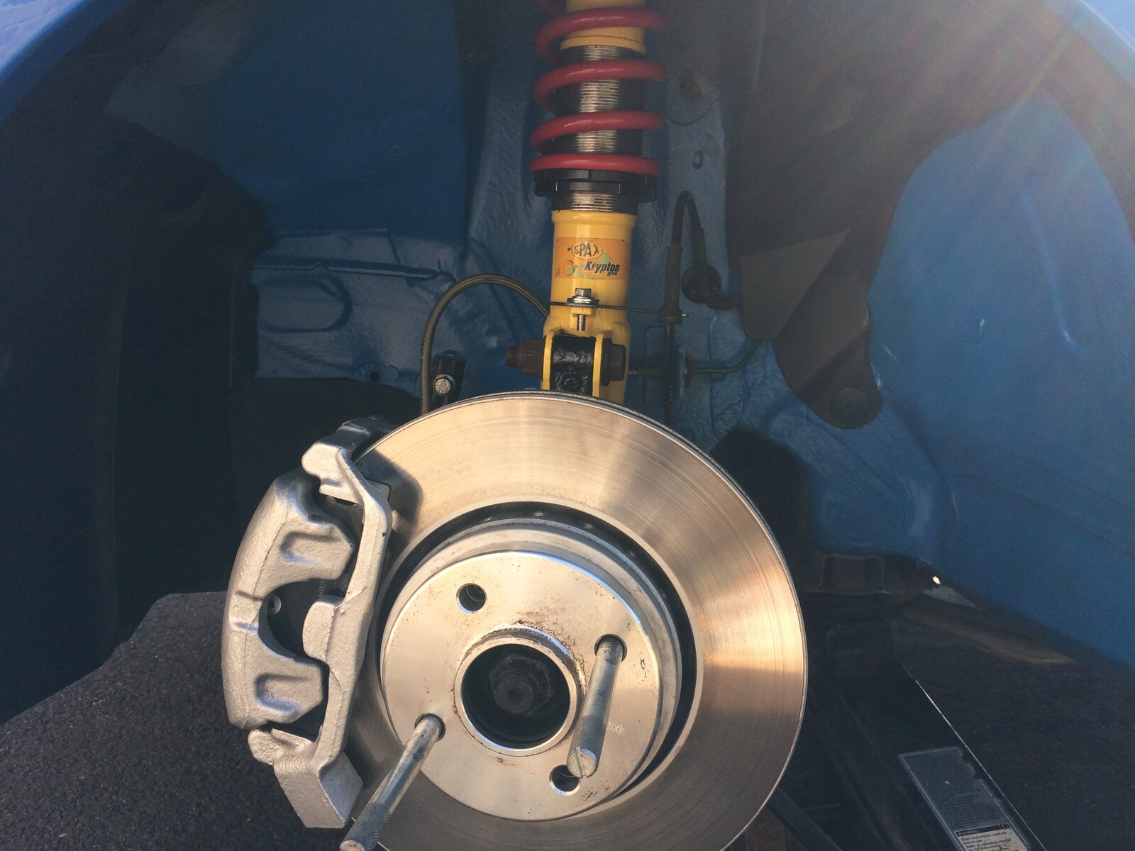

Change of coilovers. Bought some Spax adjustable coilovers from @Ardvark172 a few weeks back, gave them a full inspection and all good :) so gave them a refurb and fitted them this morning.
I had fun and games setting the camber but with the help of my Chinese camber tool we got there!
And how the car now sits.

Just spotted your old storm meglio for sale on pistonheads Paul.
How much is a refurb on the sachs these days?
I will have to take a look at Pistonheads - how much is it?
Not sure on the true costs but I’m sure it’s £250 + per shaft but very worth it.

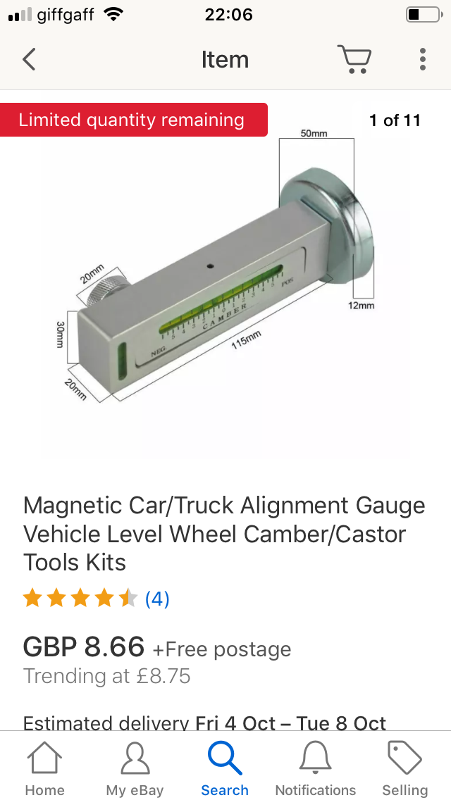

Do you happen to have a link to your camber tool?
Thanks mate.
It’s a Chinese job - think it was about a tenner. The whole set up takes a bit of time as prep is key but basically make sure the car is level across front and rear axles and use the rear discs face as zero degree marker and then attach to the front disc face and go from there.

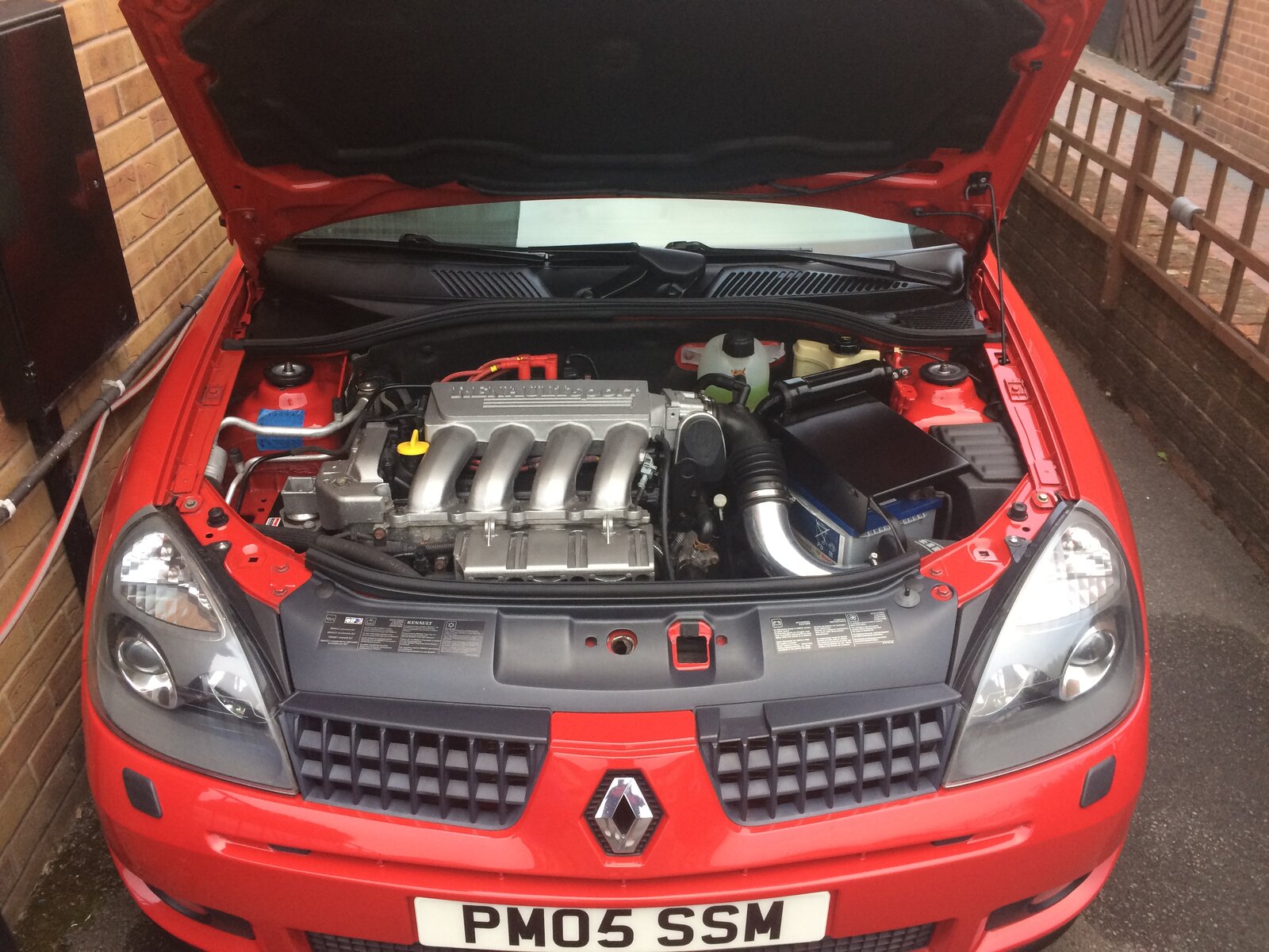

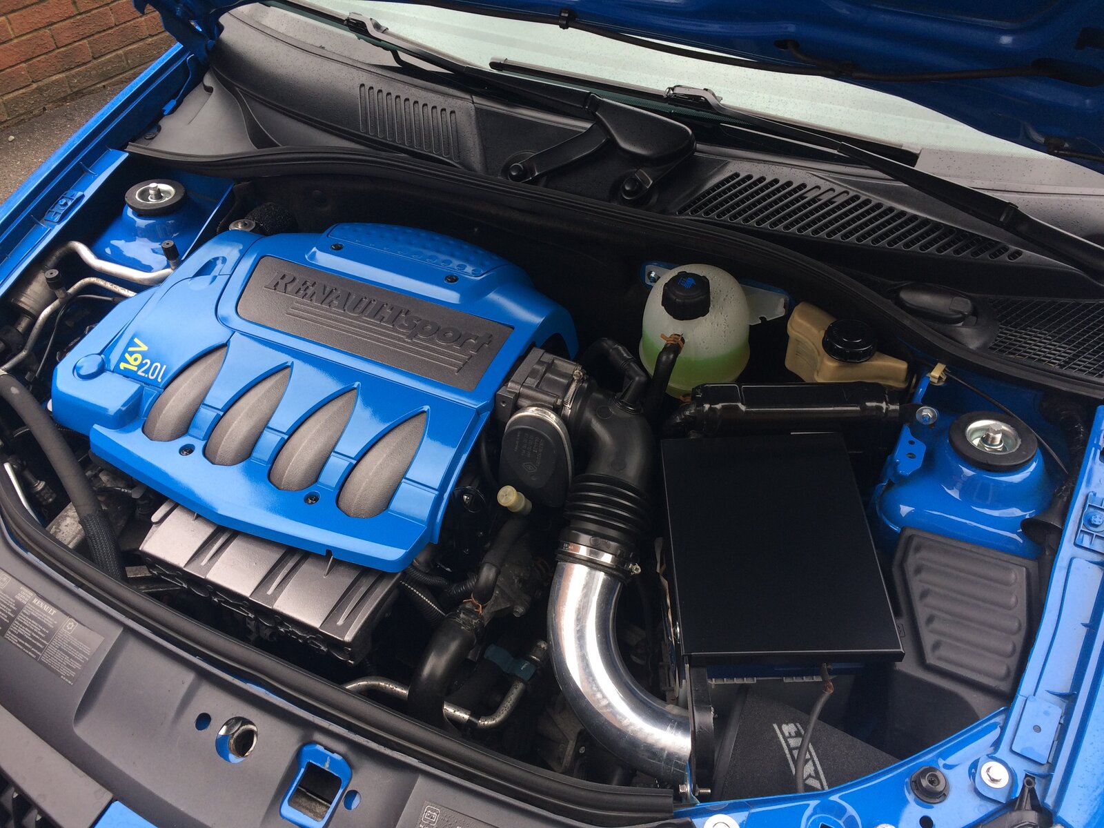

A few bits done under the bonnet.

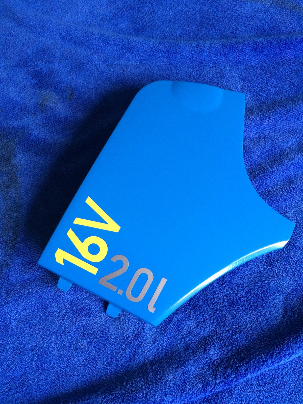

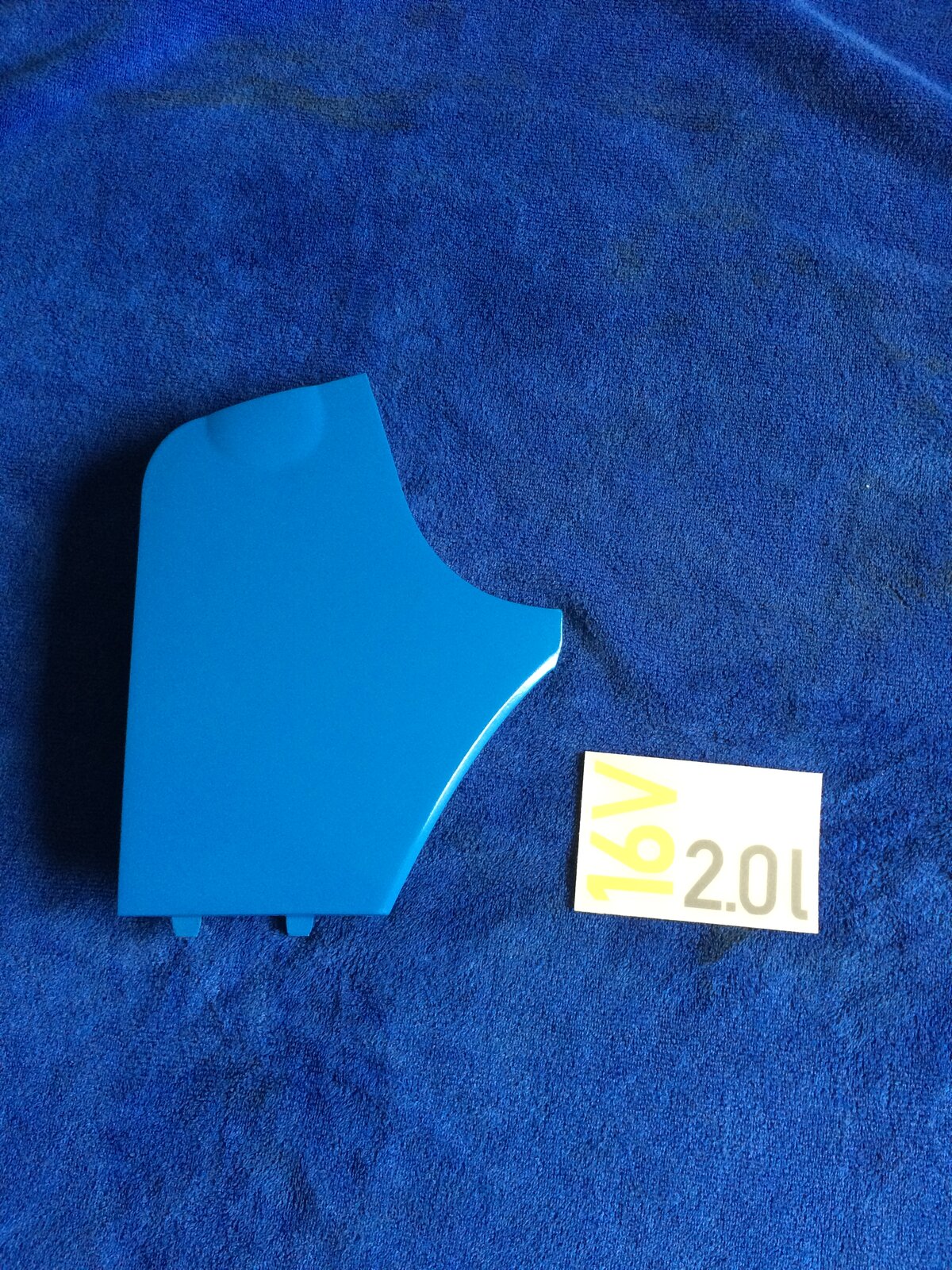

Fitted 2.0 16v decal on the engine cover. Sprayed the cover a couple of months ago.
Sprayed the engine lift bracket:
Also fitted my “fatty” induction from the Trophy and this how it’s looking so far.

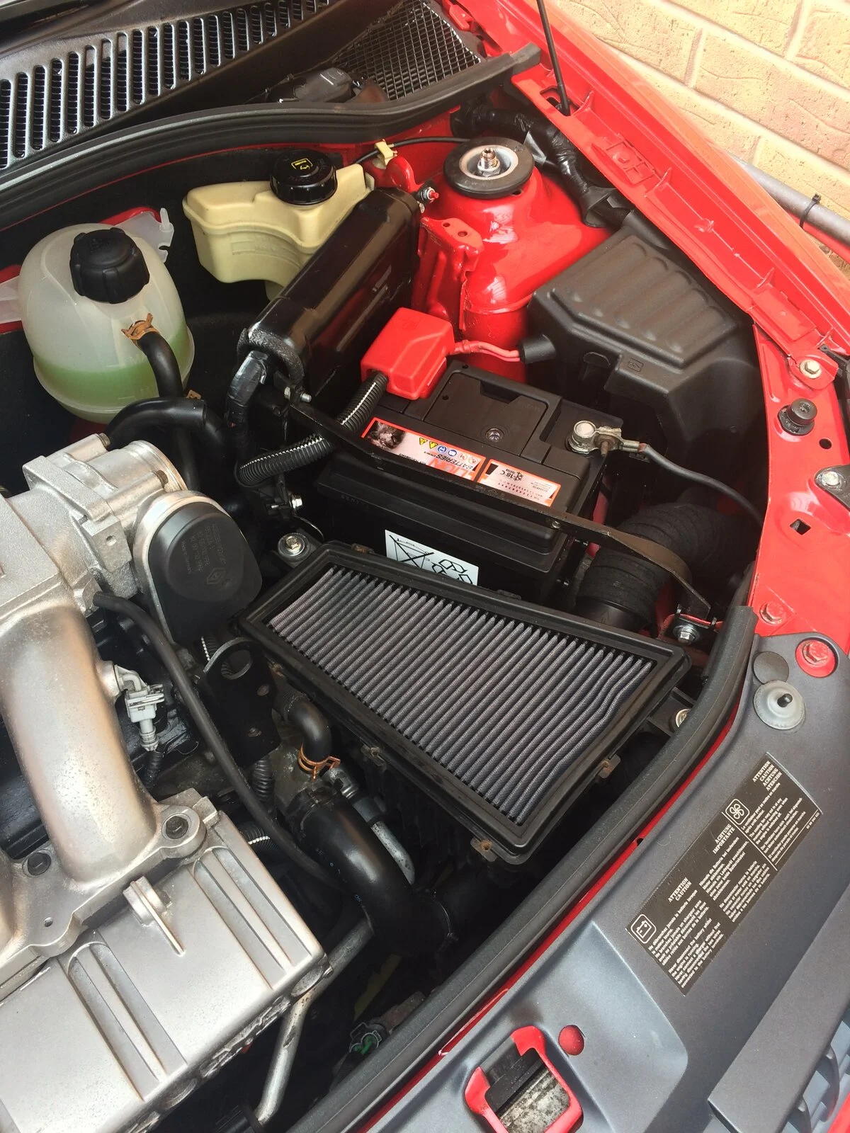

Clio Trophy

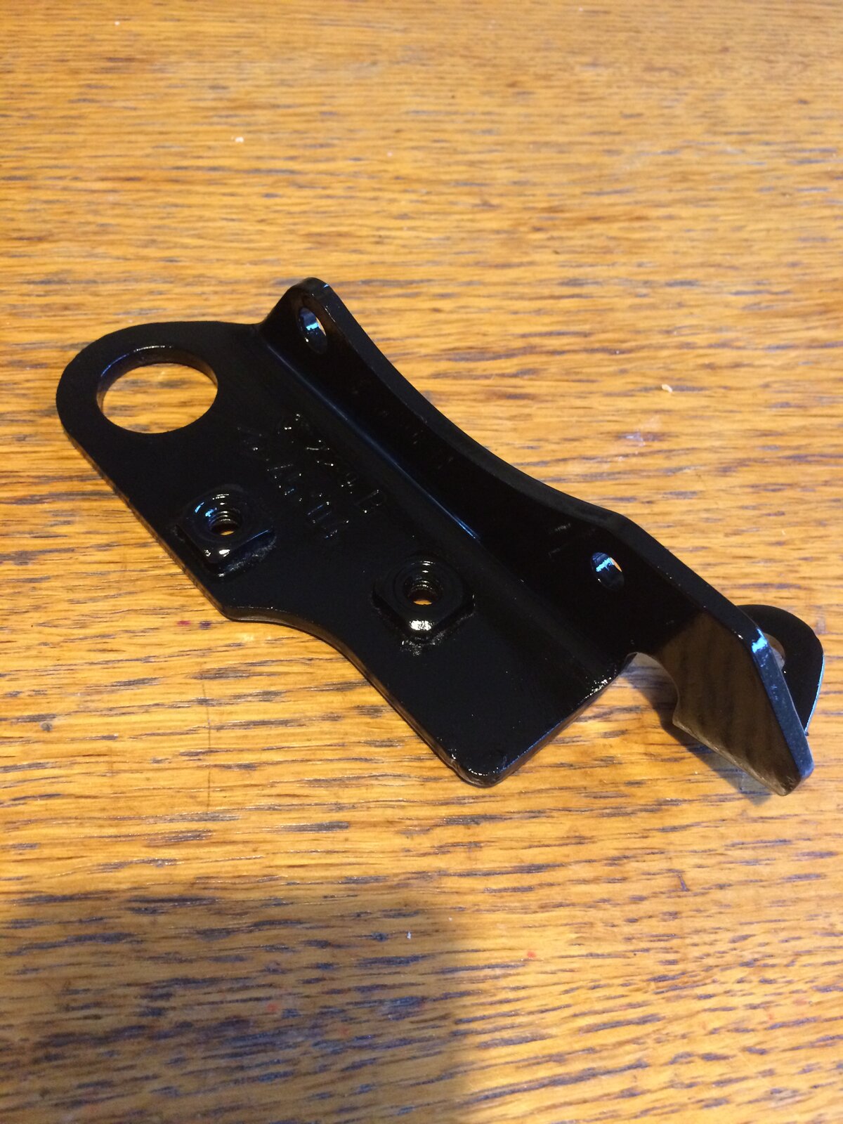

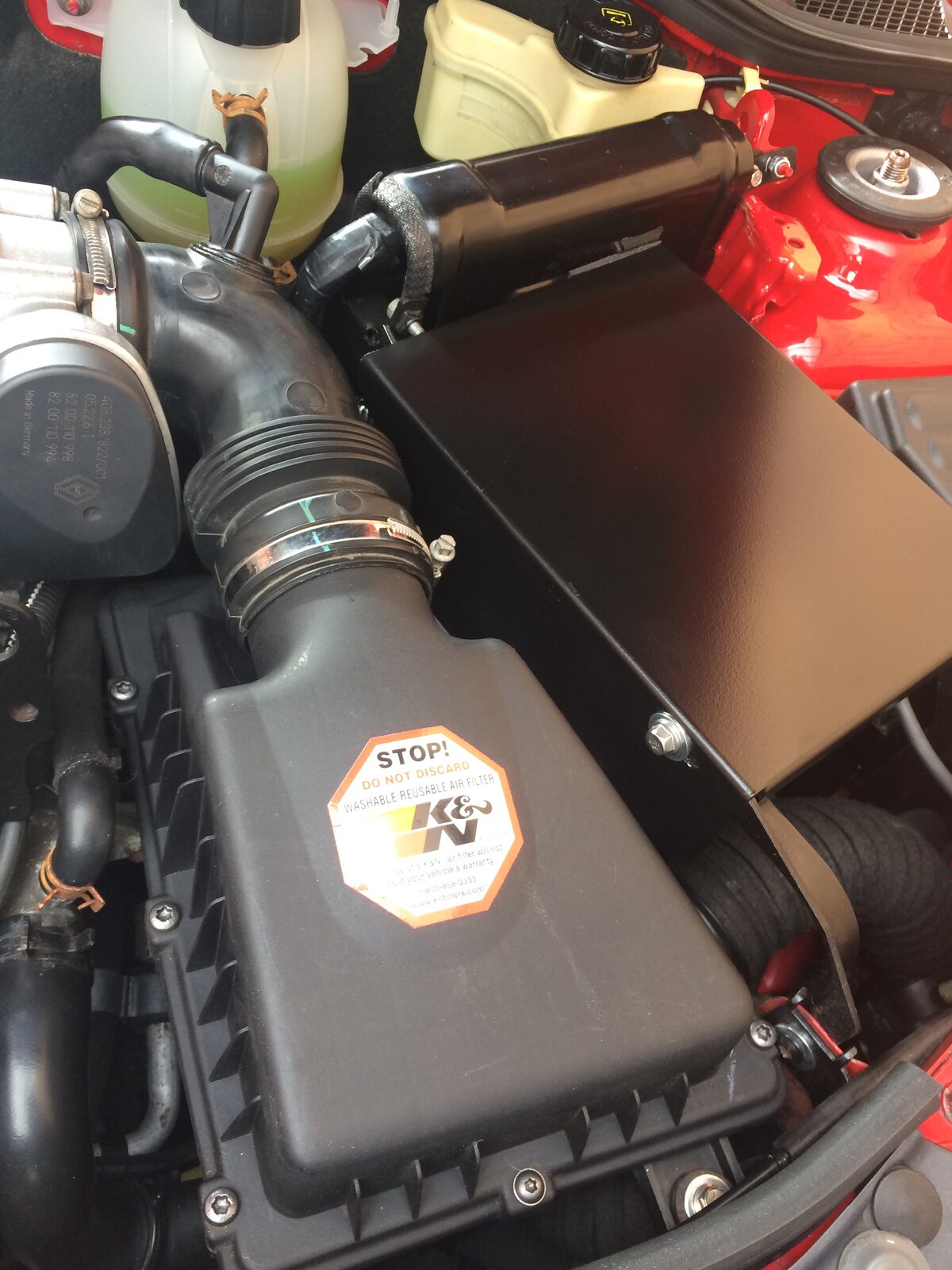

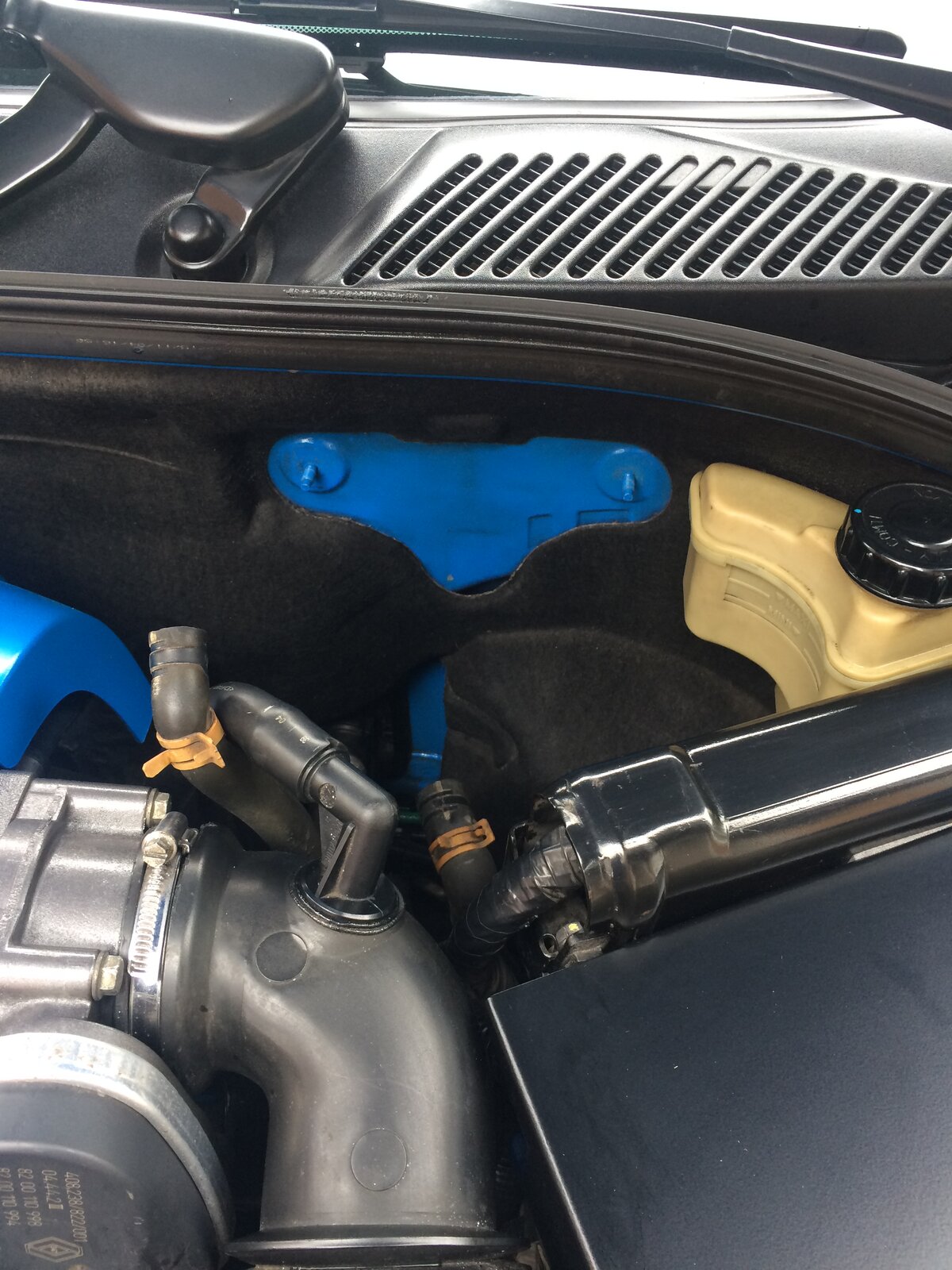

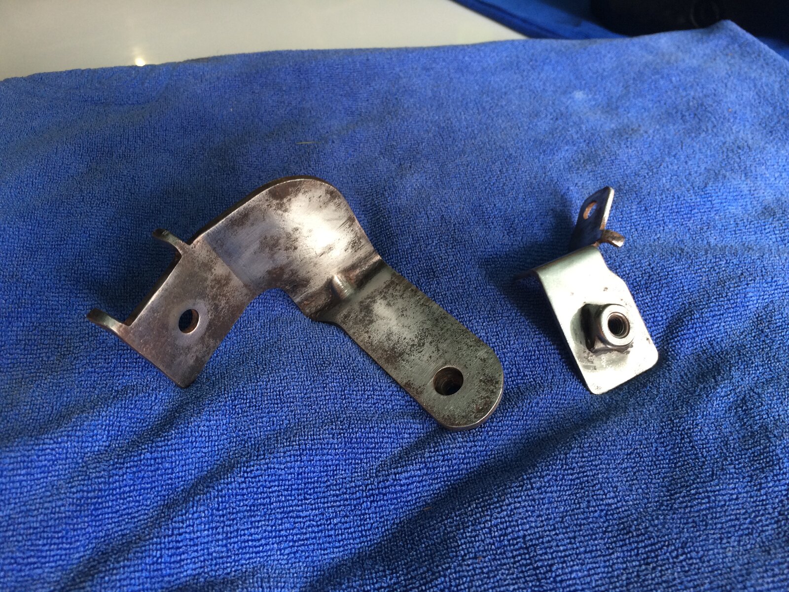

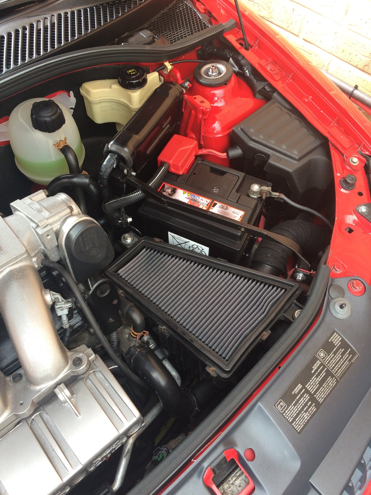

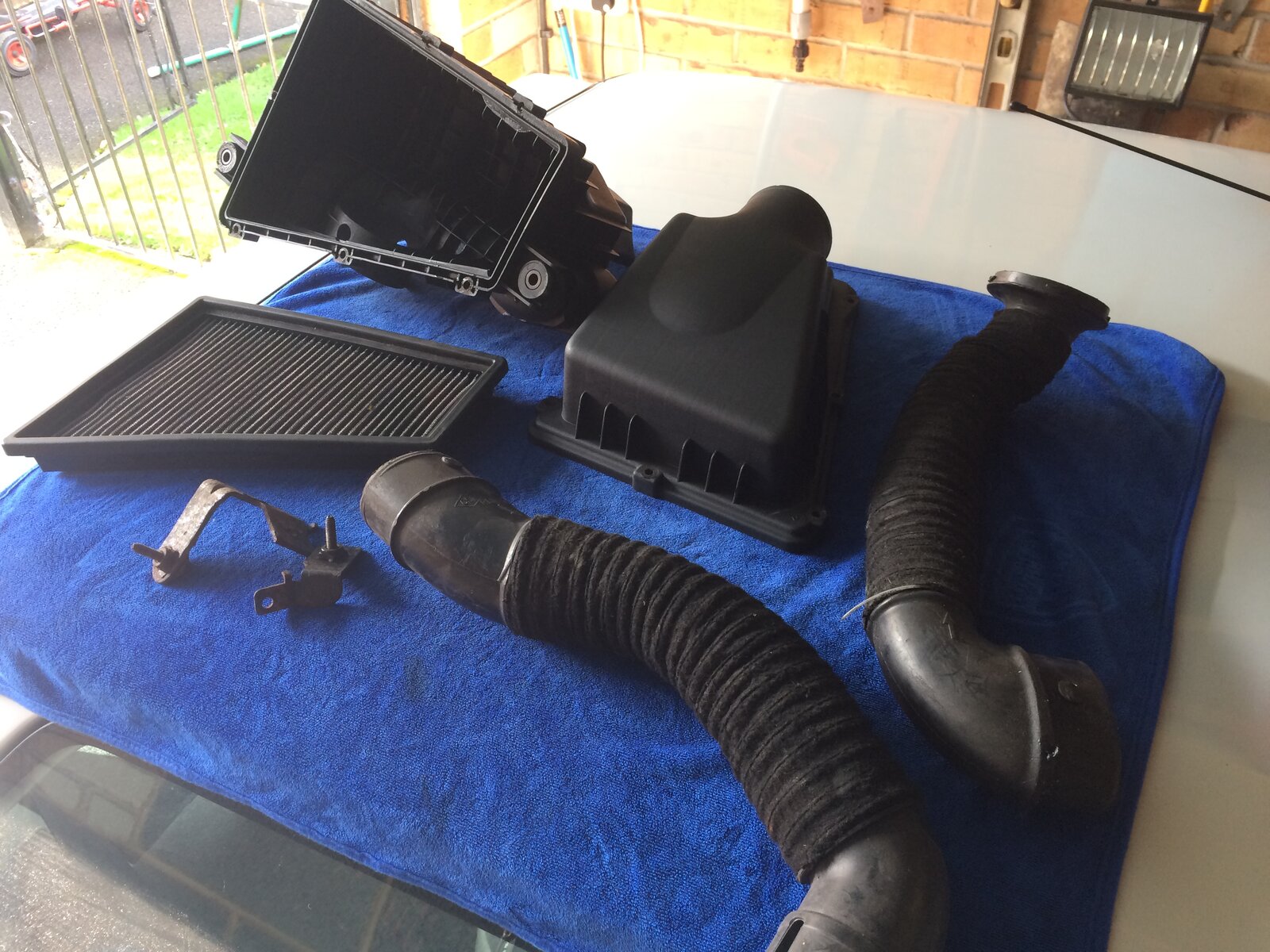

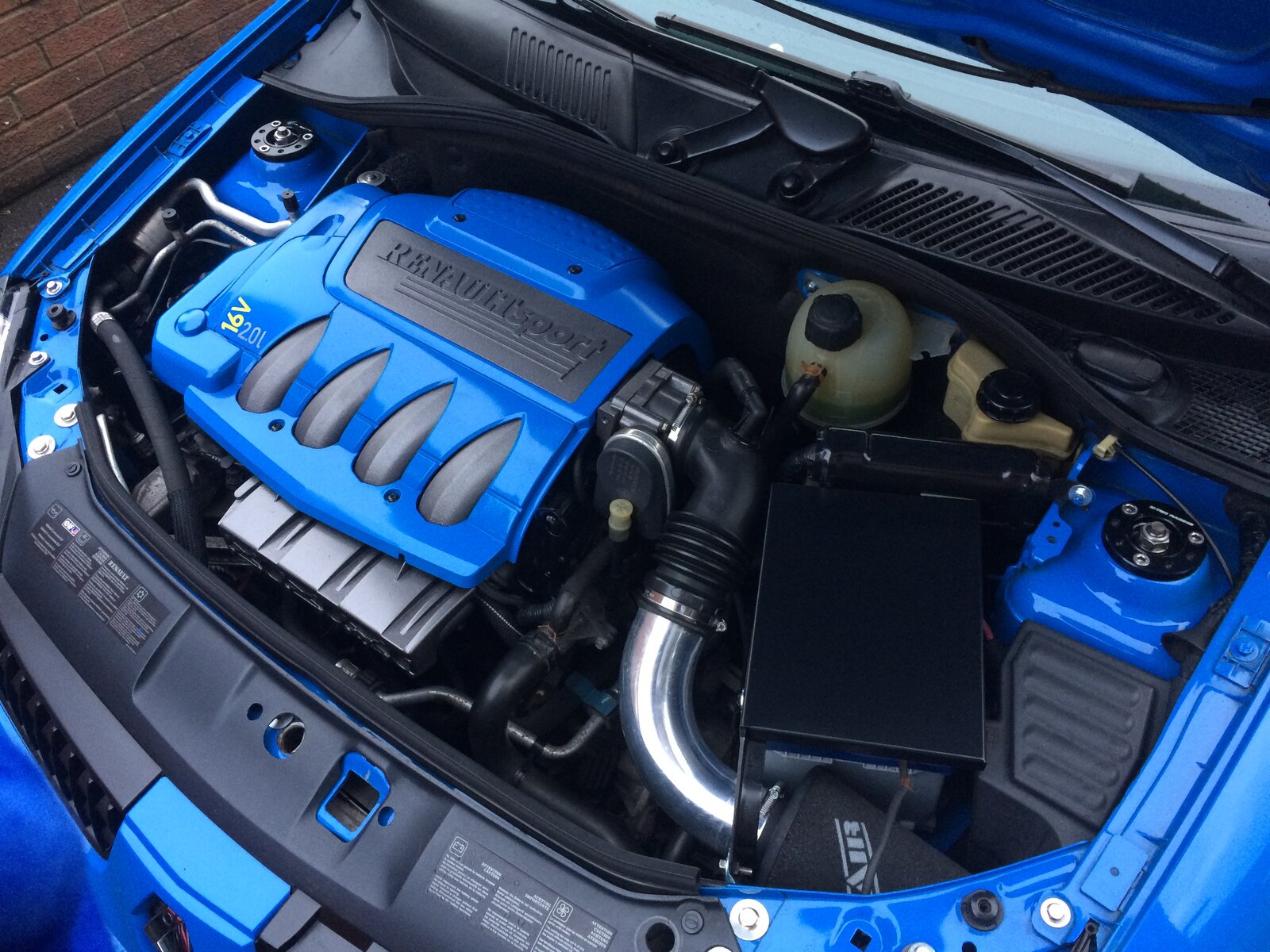

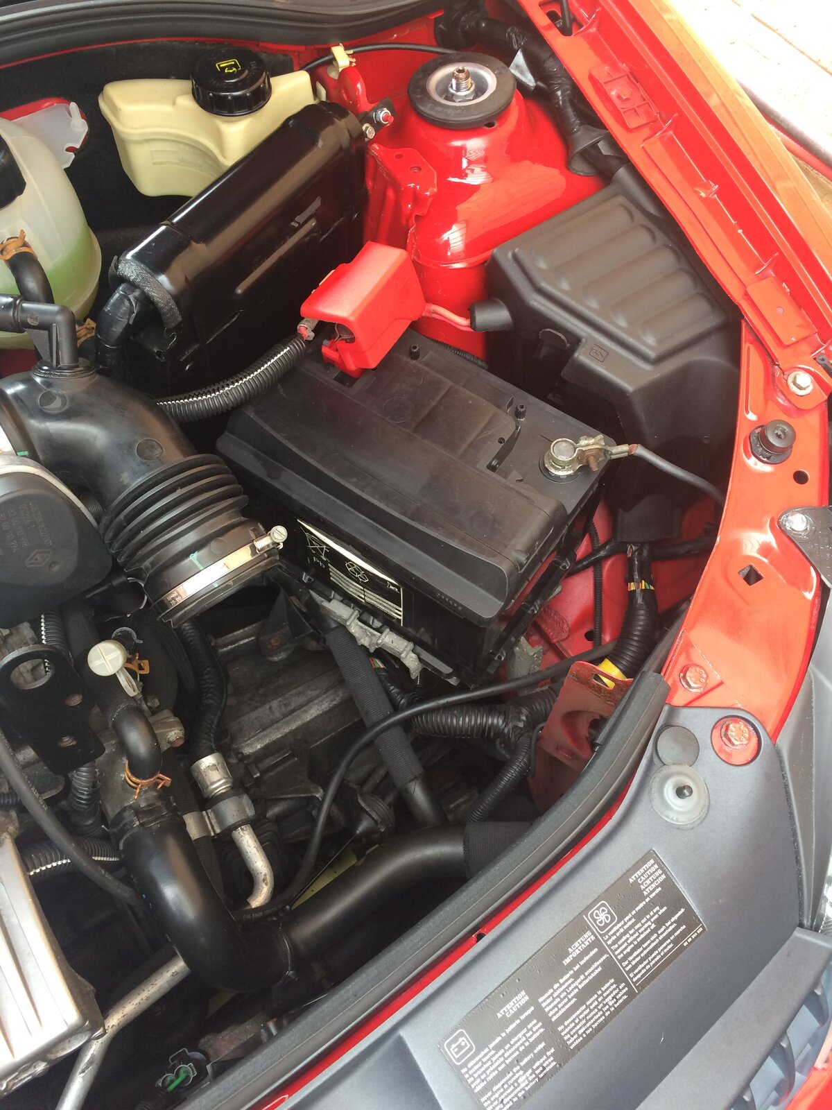

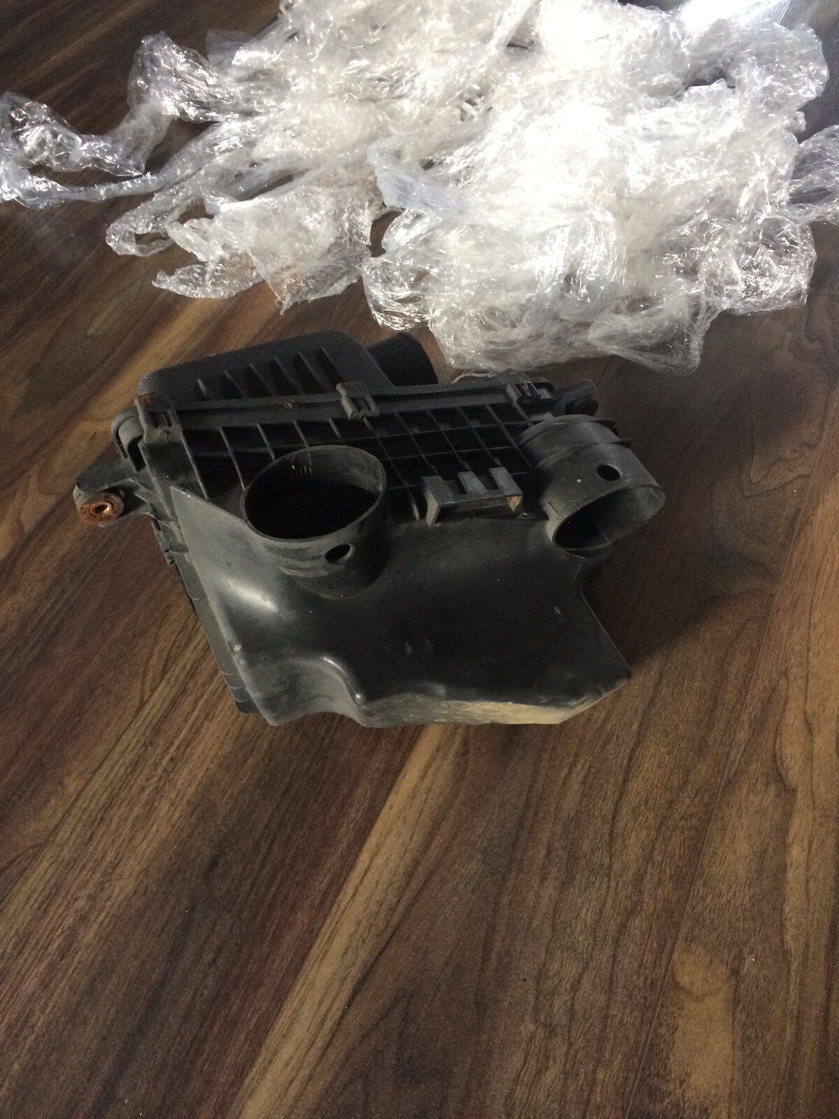

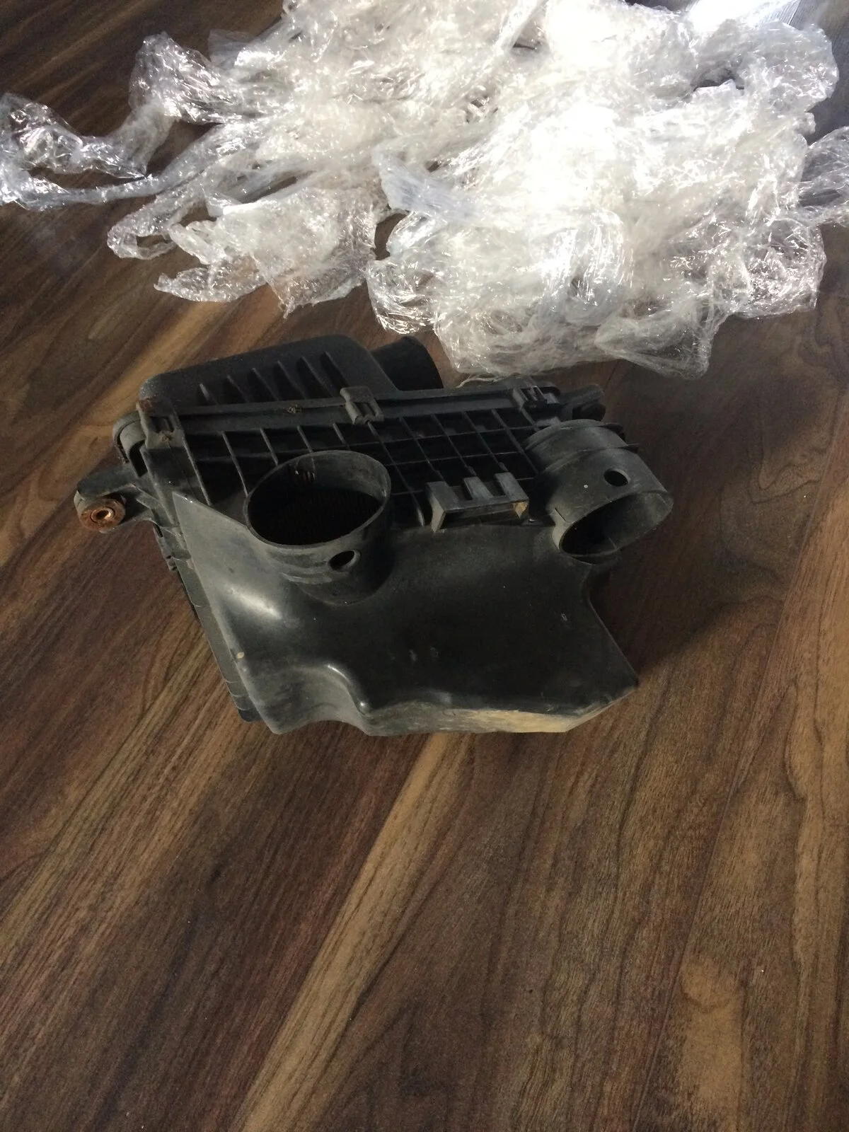

I moved across my Fatty induction to the Racing Blue and sourced a standard air-box.

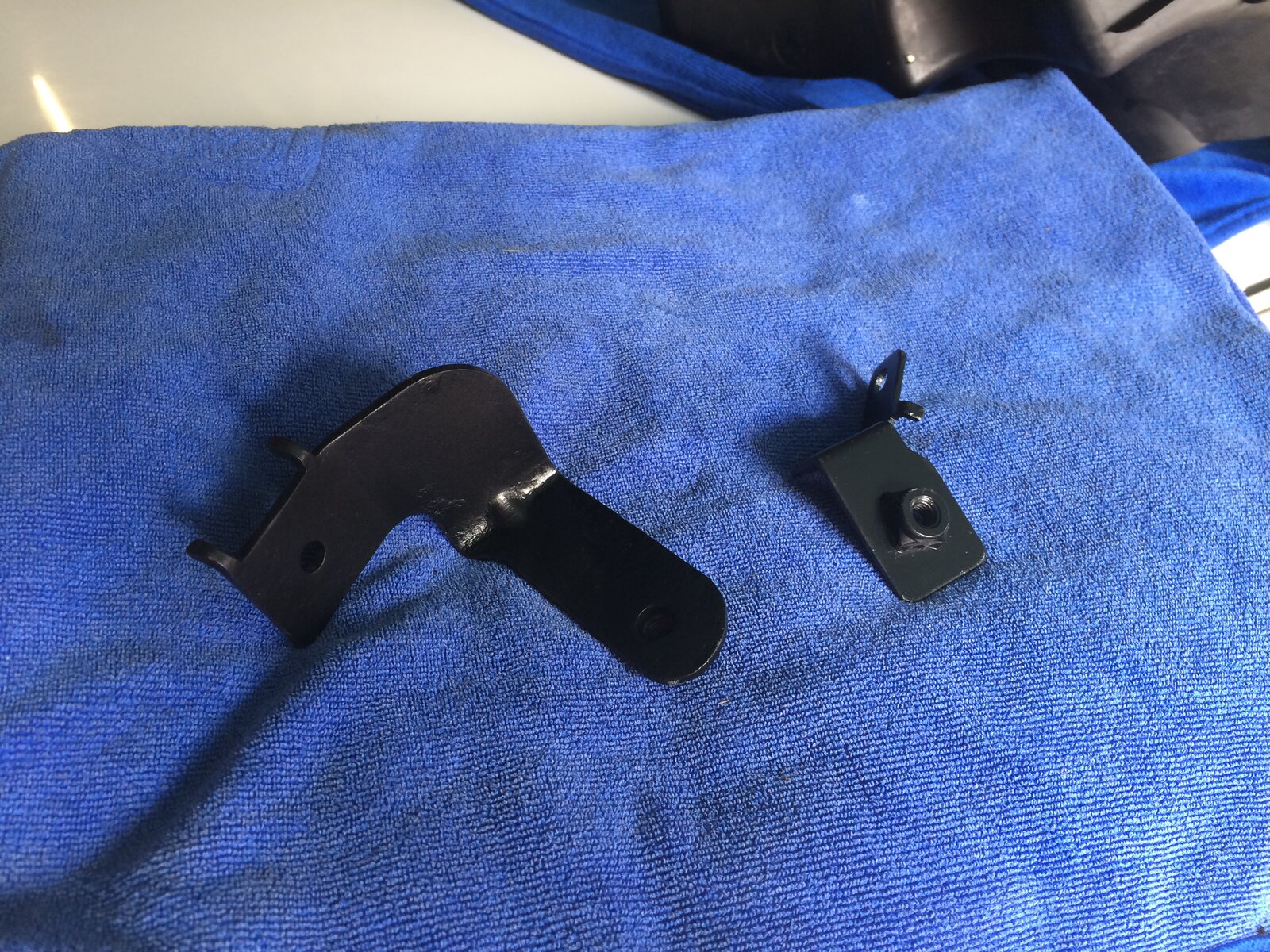

Managed to find some standard airbox brackets and stripped the paint off:
And painted:

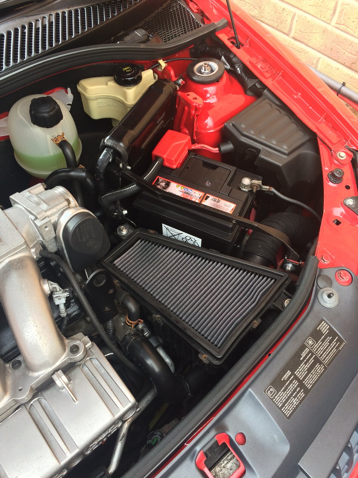

Removed items and realised the battery from the Racing Blue was a large one:
New smaller one bought - £28 from ECP :)
Airbox, pipes and a K & N panel fitted:
All back together and an original spec K & N sticker put on the airbox:
And painted:
When I ran a standard airbox, I found that night heater hose out of the trucks fitted on the 2 inlets. I replaced both of those fabric pipes with the corrugated night heater hose and it allowed me to run them to better areas for cold air feeds.
I even extended the fins in the bottom of the wheel arch liner to catch more air and feed it to the main air feed.
It definitely made an improvement, but I changed over to the v6 airbox in the end mounted directly to the TB. With no bonnet skin, it was a massive improvement as the amount of cold air was vastly increased.

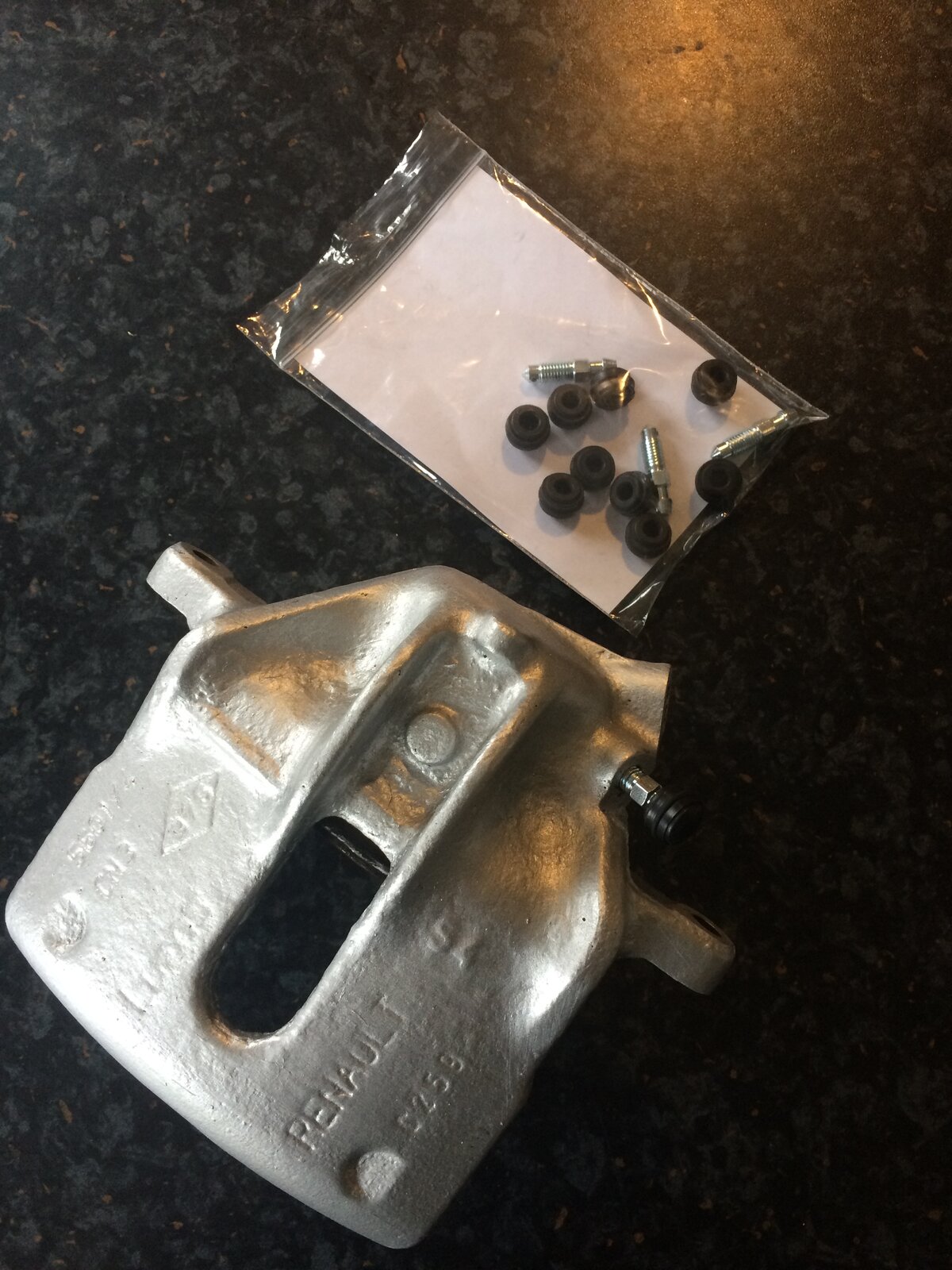

A new MOT gained but advisory given for sticky front brake.
Brakes stripped and found the caliper pot sticking. So replacement found, cleaned and painted with new bleed valve.

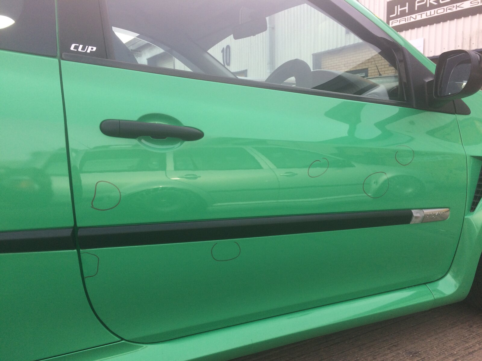

A trip to PDR man for a few car park dents removed :)
Now all dent free :)
