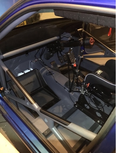

Cheers @JamesBryan.. yeah take a look, I made my own custom setup to move it back [emoji1360]
The way the shifter is as standard it's too far forward.
To get the right distance for your legs if you're tall, means the shifter will be too far in 1st, 3rd and 5th gears.
Moving seat forward means your knees would be up to the steering wheel 😂
Thanks for that I think I'll go down the path of moving the standard shifter rearward and just extend the linkage underneath.

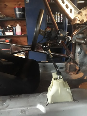

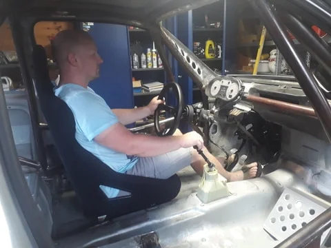

I've thought about this as well, but I just used a Scenic shifter, and bend the shaft about 45 degrees. Now it is in the perfect position with my deep dish steering wheel, and my seat mounted as far back as possible. Check my build thread for pictures.
Thanks for that Scullyg40 that looks perfect in height and location. Now Ive just got to find a scenic shifter.
