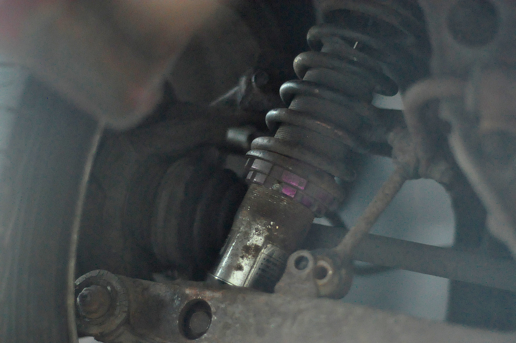

This is what I'm up against:
HKS HiperD by j0eyD, on Flickr
Not much adjustment left, as you can see. Unless there's a way of taking the lower adjuster ring out and making sure the big one doesn't move?
Do these only adjust by the spring? If so you need both of those loose and wound down.
I know how to adjust them. I'm saying could I take the smaller bottom locking ring off completely and wind the top ring all the way to the bottom of the thread and try to wedge it in? Or perhaps add the smaller ring on top of the large ring to tighten it - the opposite of how it is now.
Would need to see if the spring clears the smaller ring, I guess.
You need to lock it, otherwise there's potential for the lone ring to come loose and wind off the body and then you're in a whole world of s**t. I don't think you'll be able to run the rings the other way as getting at it will be a right c**t with the spring. You could tack weld the one ring at the bottom, and accept the fact you can't raise it again?
Hmmmm, I think I'll see how low it goes with them both in then. Don't want to have to weld anything, I'd be better off buying different coilovers at a later date tbh considering these will still be worth a fair chunk.
