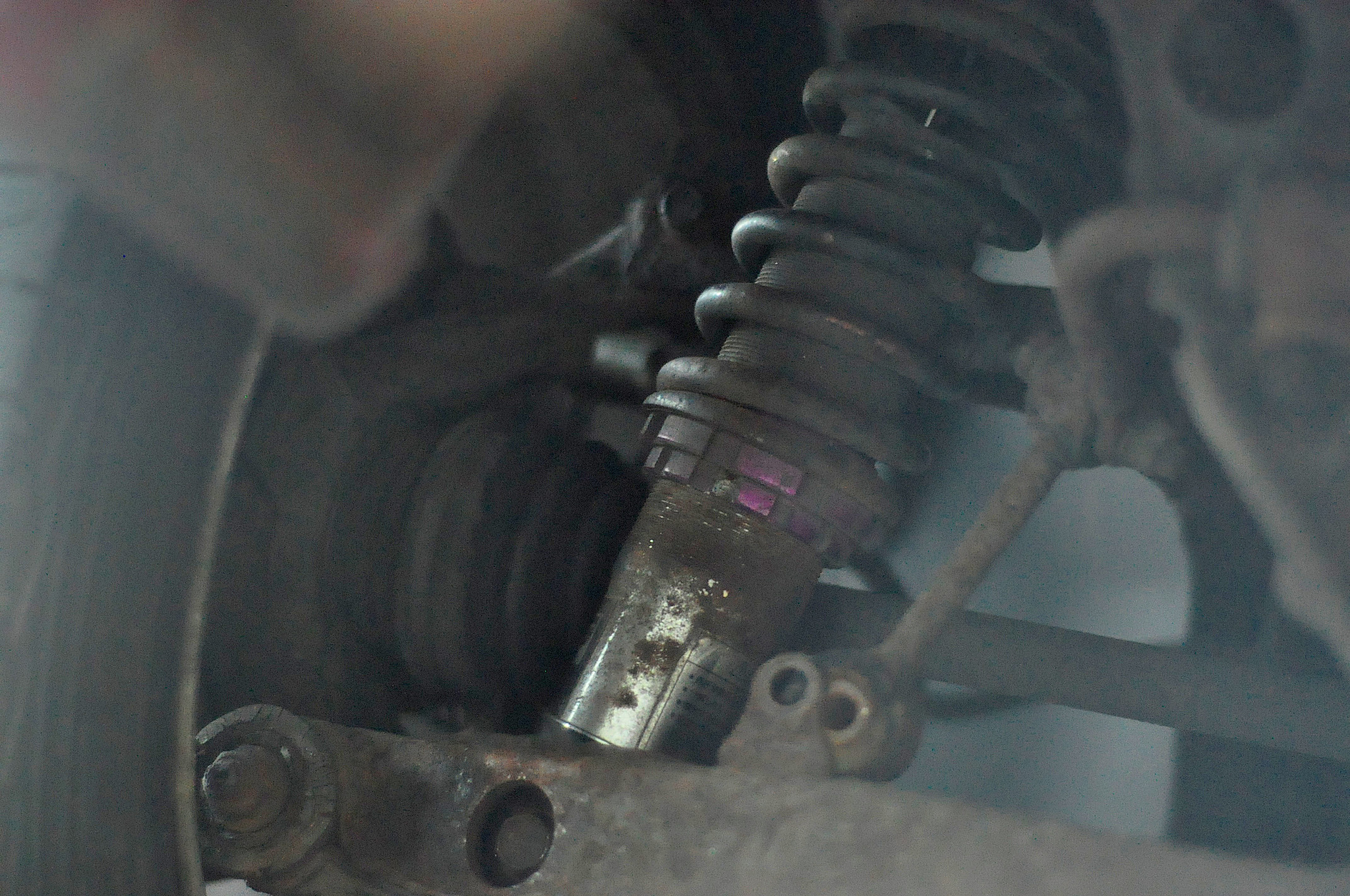

This is what I'm up against:
HKS HiperD by j0eyD, on Flickr
Not much adjustment left, as you can see. Unless there's a way of taking the lower adjuster ring out and making sure the big one doesn't move?
That is a lot of adjustment! Hammer + chisel the bottom ring until it turns and then move it backwards and forwards progressively until the thread has cleaned up.
I refuse to be a pikey and use a chisel. Nigh on impossible to find replacement parts for these and I don't want to damage anything... I'll get them loose, I just want to be a bit careful!
Its not pikey mate, and the rings will most likely be the same size as any other coilovers (If you somehow manage to break one). The worst you will do is deform the edges a bit but I can't see them cracking. Ram on!
Hmmm, fair enough! I'll see what I can do with the rest of the NW lot. I'm sure they'll come loose eventually (and we might well end up using hammers tbh)
