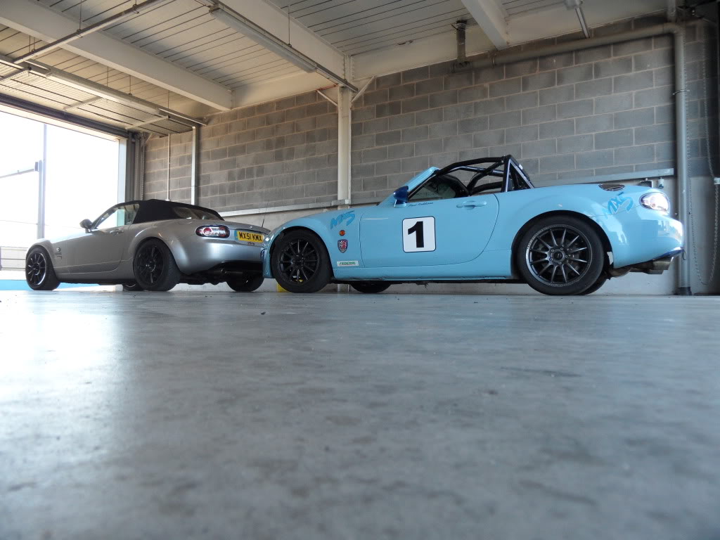

spec is
Suspension
Fereral 595 RSR - tyres fitted earlier this year
HKS Coilover Suspension
Kosei Alloy Wheels – very light
Adjustable rose jointed ARB links
Thicker 1.8 ARB’s
Poly Bushed
4 pot Willwood brake callipers up front
Big brake kit to rear – standard calipers spaced out with larger discs (inc bias valve)
Goodrich hoses
1.8 Diff
P5 Frame rails
Front and rear strut braces
Mr Fast lower front subframe brace

Soooo a bit of an update. I don't know why but with every car I own a simple health check needs to be done.... with this one more so, basically the car produces quite a bit of blue smoke. Having never owned a forged, nor turbo'd car i thought it best to seek professional advice, so I took it to autotronix developments in rotherham who have done an amazing job with the car and its come back with a few things that need looking at. However they managed to notice that there was a "slight" blow from the exhaust. This actually ended up being the downpipe hanging off the turbo as 4 studs had sheered off inside it leaving just 2 nuts holding things together... This soon became zero.
In a 2 day period Clive managed to turn the car around and have it all sorted in time for Silverstone this weekend. A fantastic job done by Clive and the confirmation that the car/turbo are all healthy was such a massive weight off my shoulders :D
For anyone in the Rotherham area,I can't recommend Clive enough
Edit: oh and the lexus lights are gone.
One thing that worries me a bit is the fact I was close to maxing 550cc injectors at 240bhp let alone 280bhp!
That waitey good sir is a very good point i've never even considered, its going back in for mapping at some stage because at WOT or high revs its fantastic... as a road car its a bit of a pig at times. Will check whats left of them then.
Performance 5 (or FM if you wanna get overnight parts from.... well, the US) will fix you up for all the extra-fuelling needs you have.
