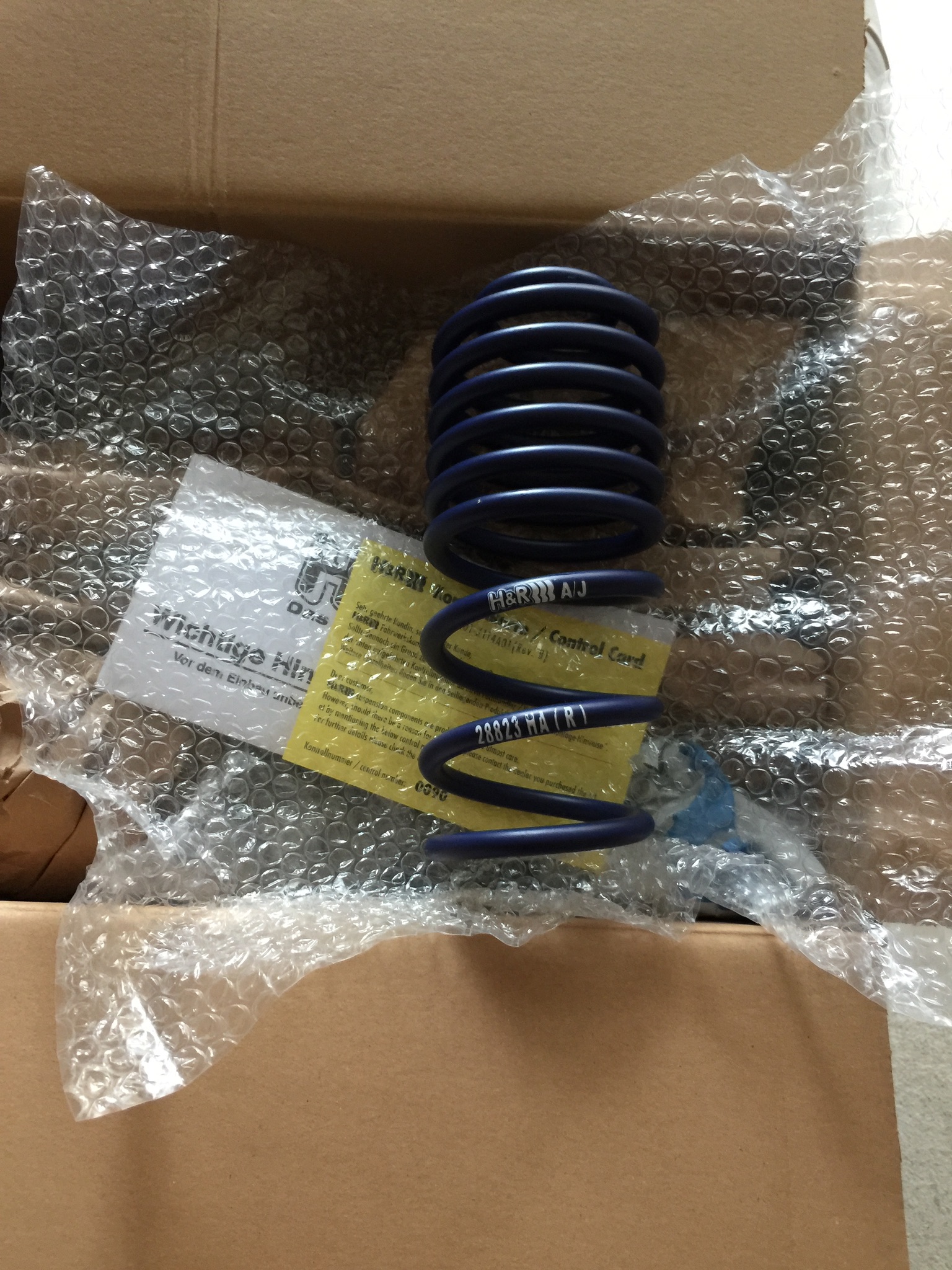

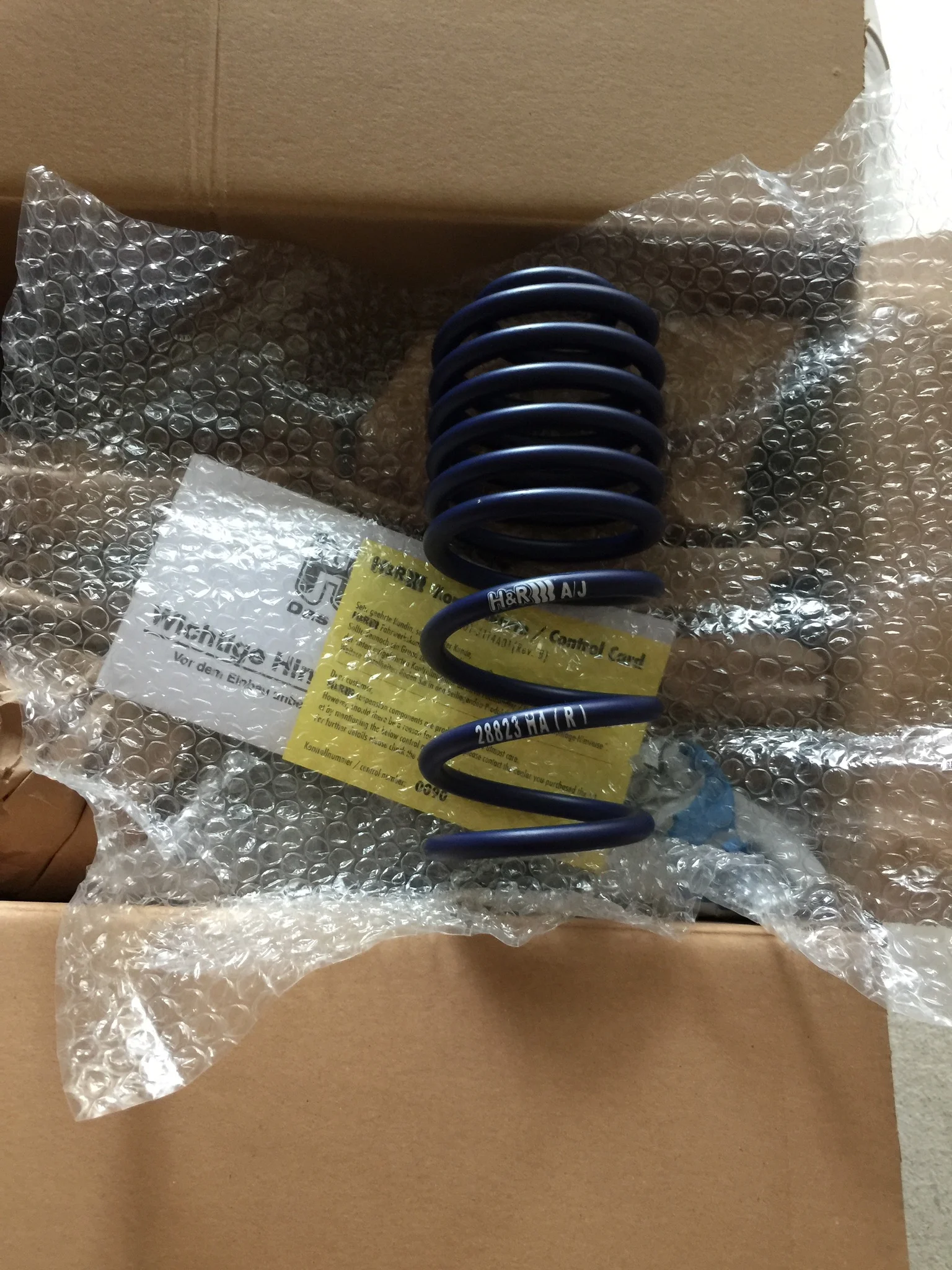

Springs have turned up today for the edc also new oe brakes pads for it plus spreader plates for the 182 to adjust the lap harnesses as they need better placement.

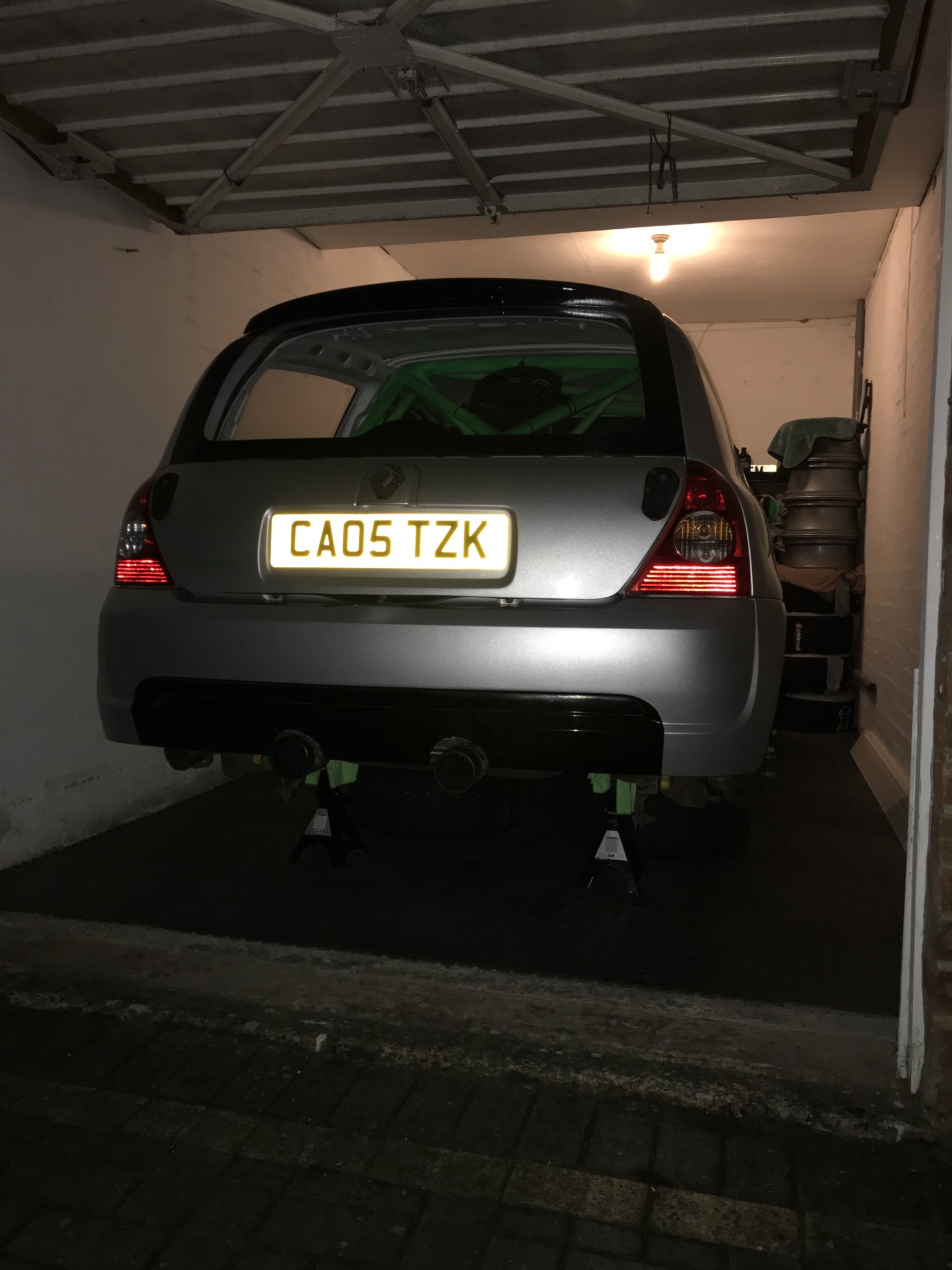

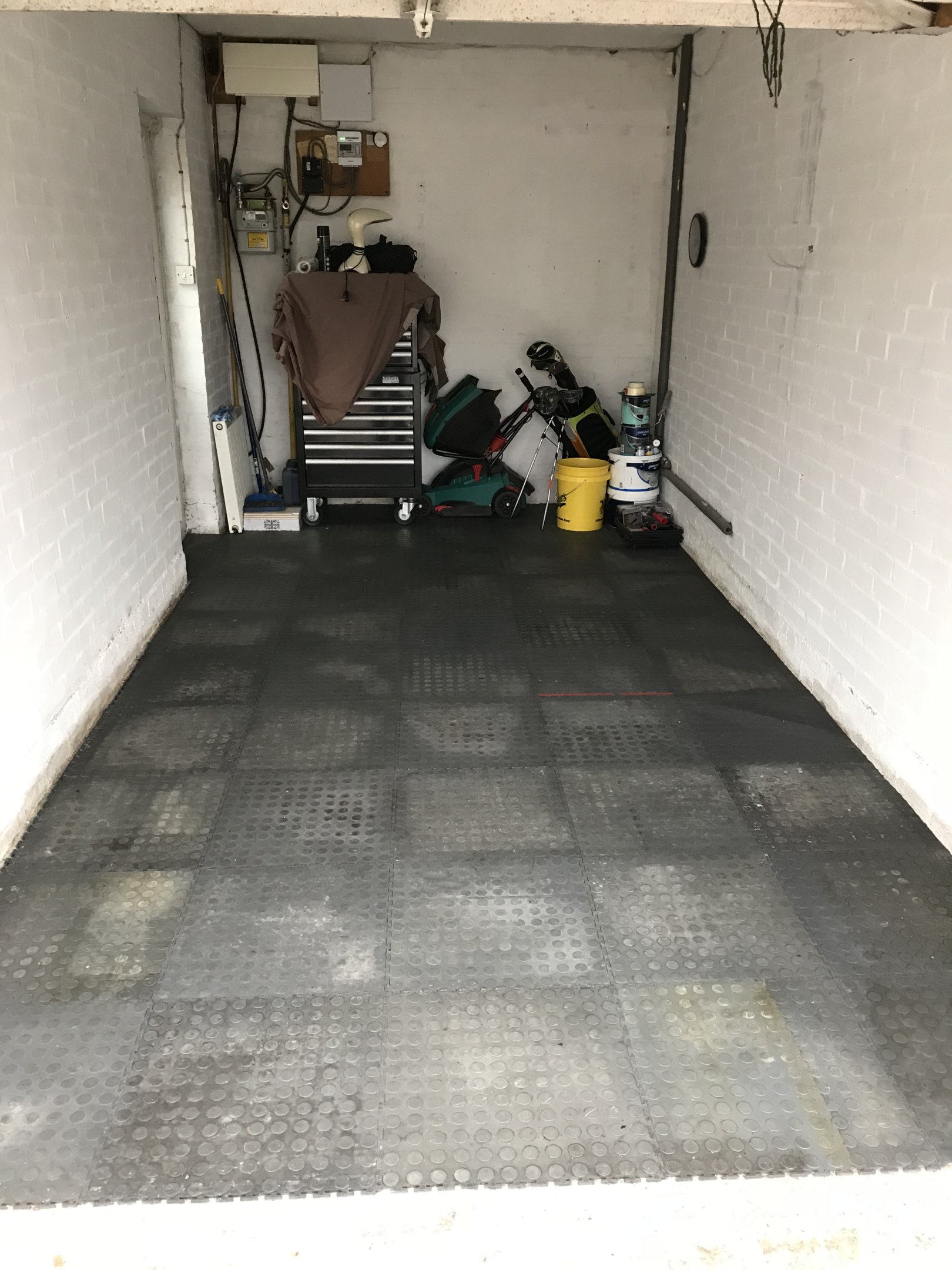

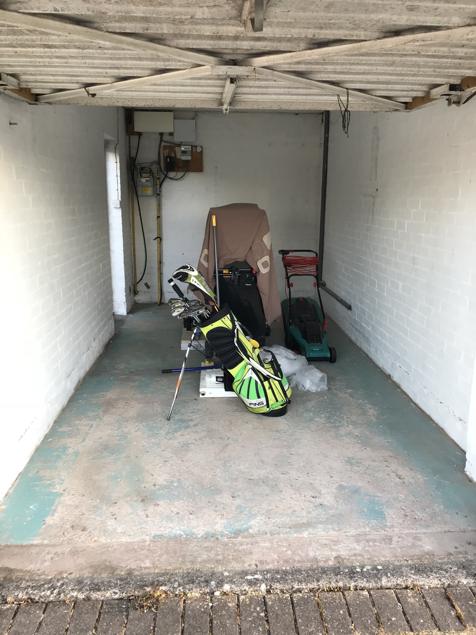

We got the keys in August and before anything went in the house I made sure the 182 fitted in the garage haha which it did so I now have my own little area the car can live. A garage picture before and after
Before
After

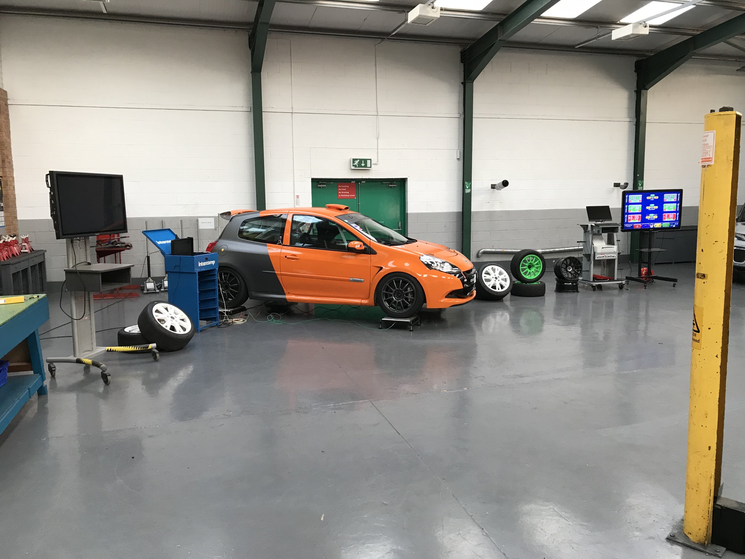

Managed to get my work bench in as well just working out how to store my spare wheels, the floor looks much cleaner now I have moped it. There’s enough space for the car and space to work on it so I can work in the dry also the cup racer just fits as well.

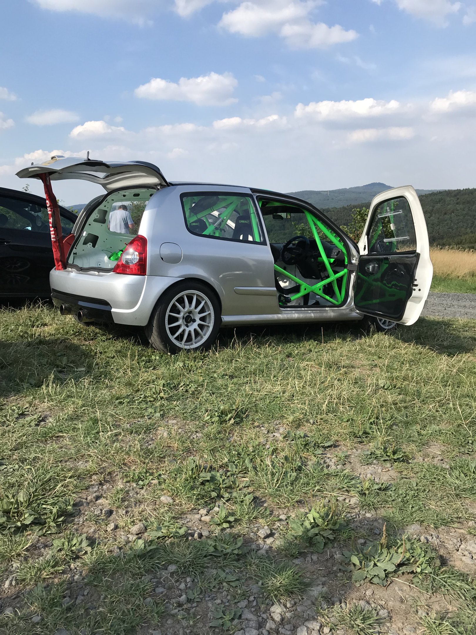

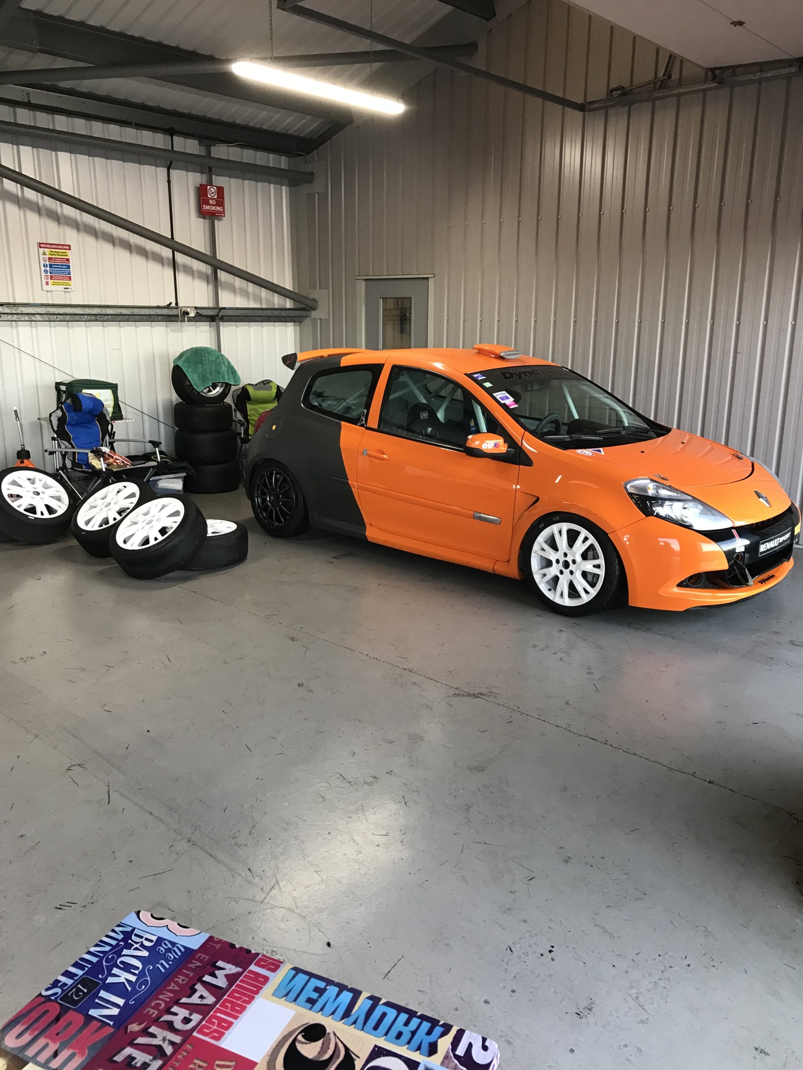

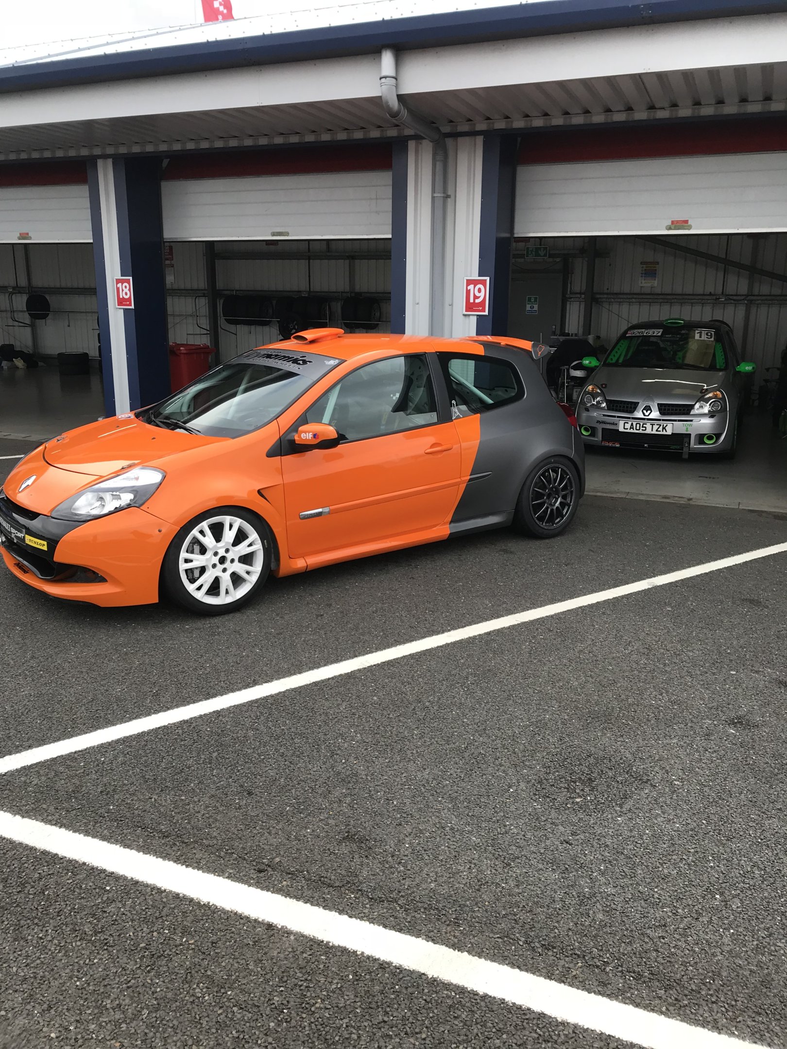

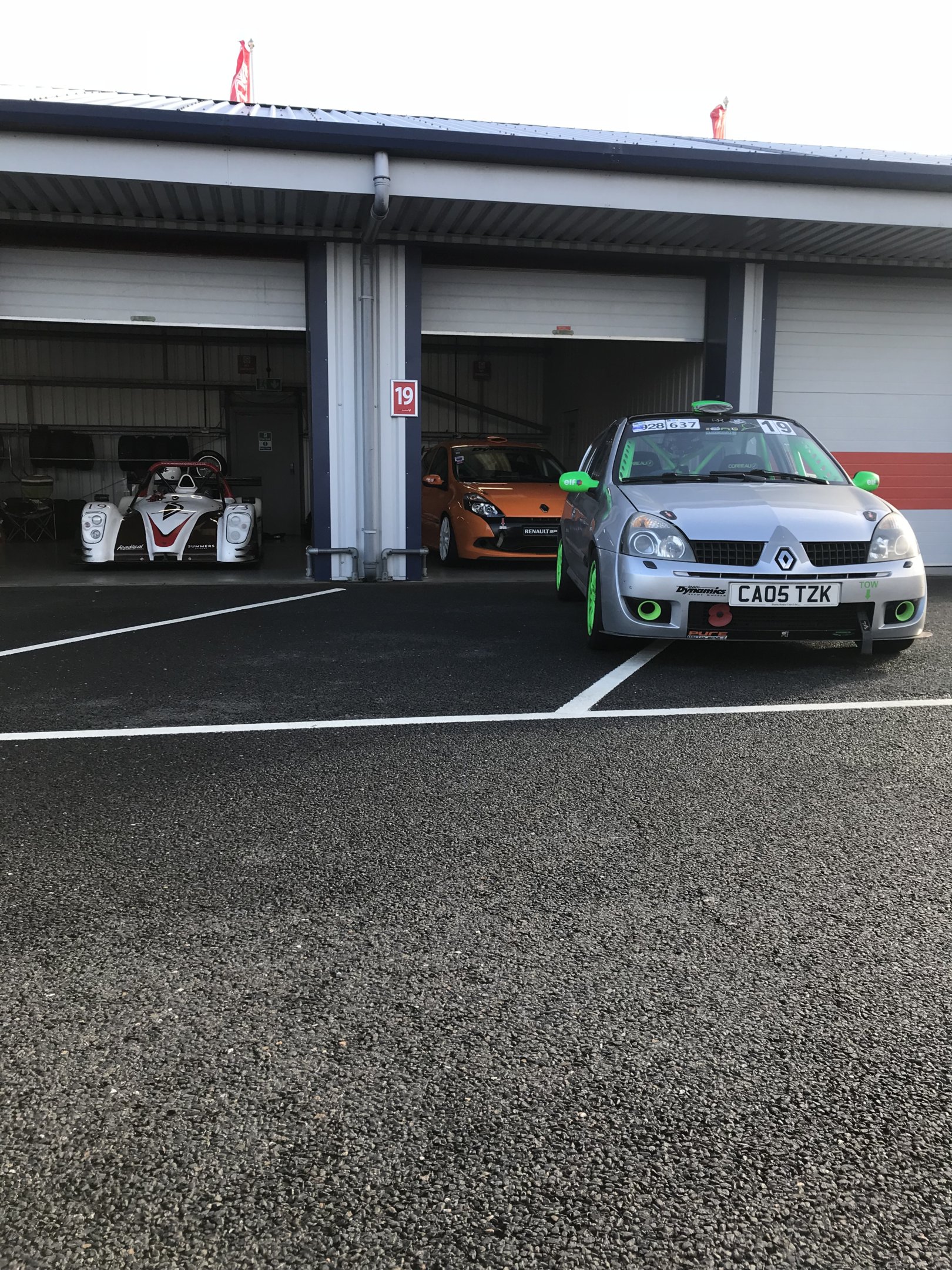

Both the green and the orange car have had some track time this year which is good hopefully next year plenty more with a few more new tracks to go on.
The Green car has done
Bedford x2
Nürburgring x1
Blyton Park x1
The Orange car has done
Bedford x2
Oulton Park x1
Blyton Park x1
I will put plenty of pictures here of all the track time and food in Germany lolin no particular order
Germany was extremely hot and no air con was interesting lol had to use the towel to try and cool the inside of the car. We ended up walking 44 miles on this trip. We were not on a track day this year we just did a few tourist laps

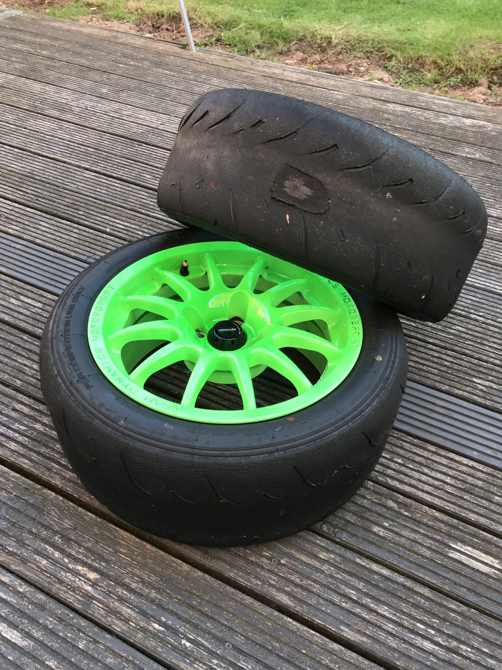

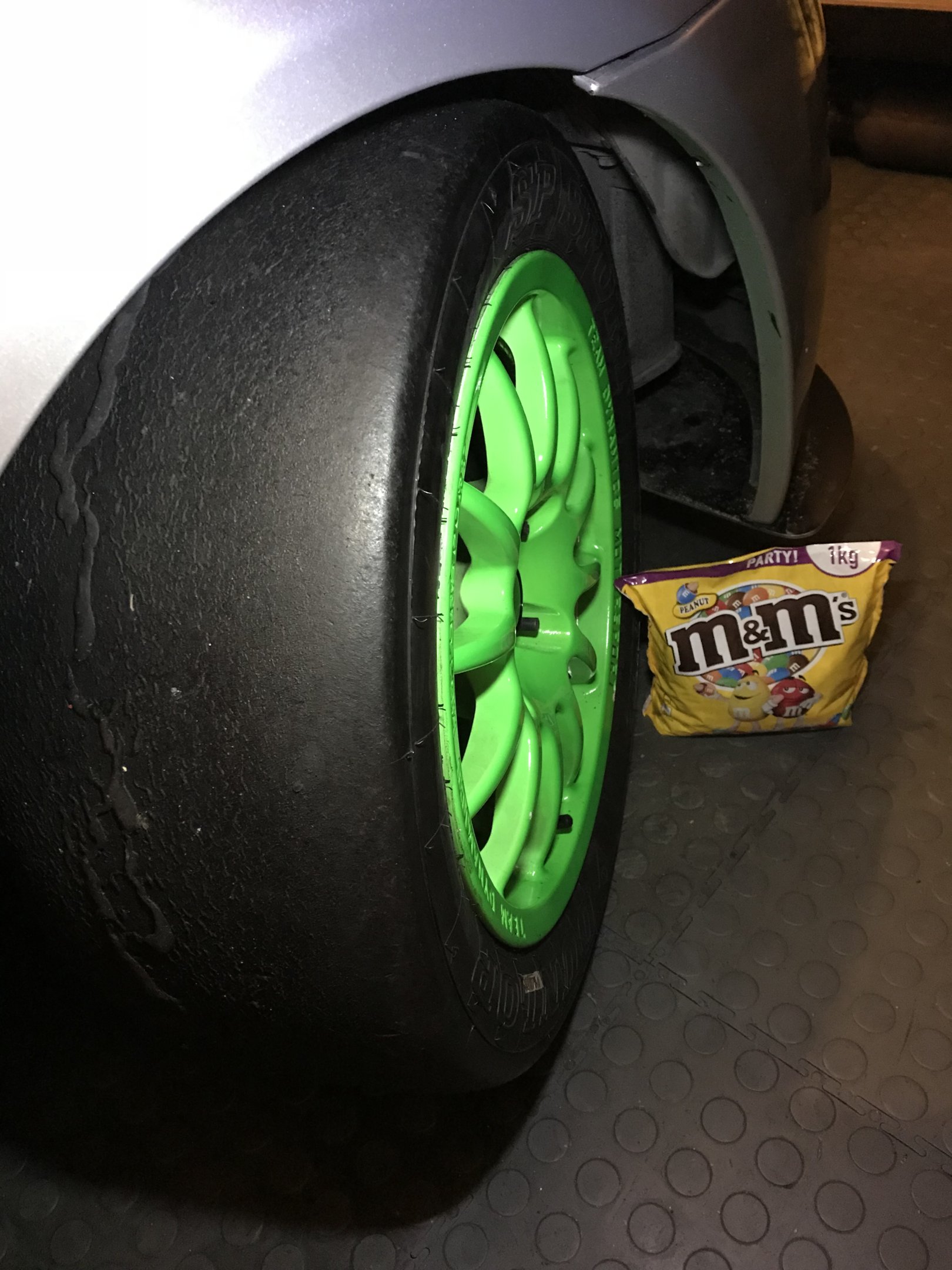

I have got my monies worth out of my front tyres on the green wheels it hasn’t helped my abs wasn’t worked since finishing the car however that’s fixed now turned out just to be a wire had come loose haha.
My friend has a Radical and amazingly the front tyres are the same size as the Clio so he very kindly offered me his used front slicks he doesn’t use anymore for free so I thought why not give them a go. Interesting going to slicks, the first time I tried them on my car it was the wrong conditions it was very cold and really struggled to get heat into them, the next Bedford track day was warmer and they performed loads better must admit I preferred the feel of the AO48s but to be fair the cars not fully set up for slicks so I would imagine I am not getting the full potential out of them but they were free so I can not complain but good to try.

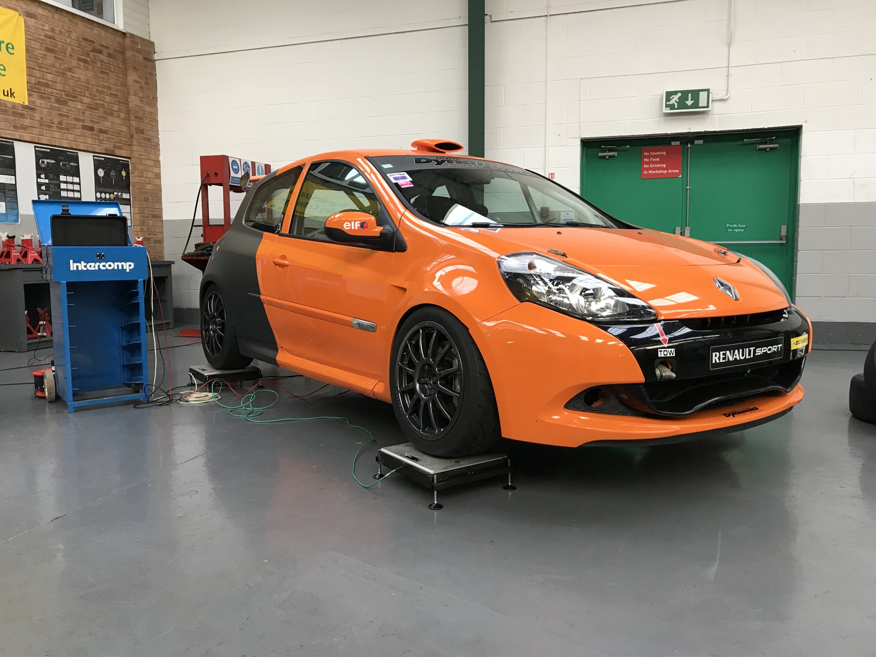

Snett 300 is our first race. Bedford is local to Charlie who looks after the car but always have trouble with noise there.

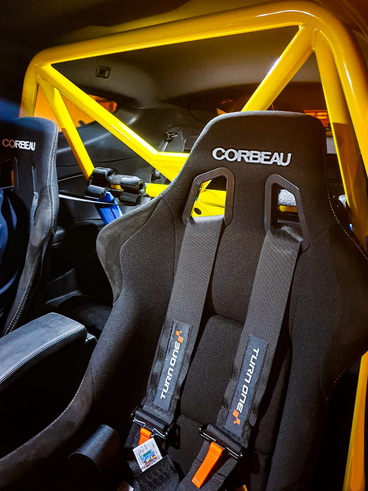

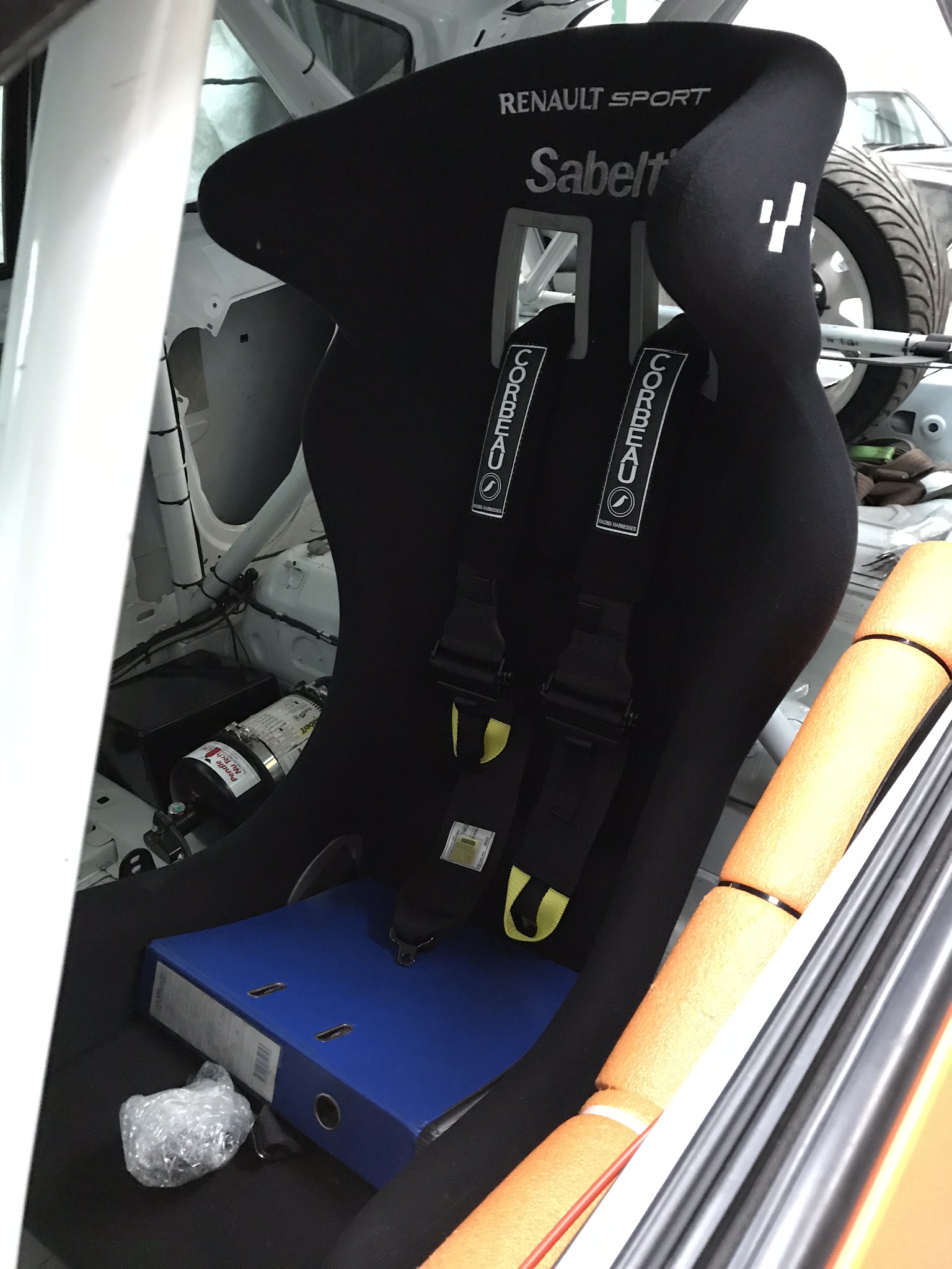

New harnesses for the car this year I have upgraded to 6 point and 2” into 3” belts to work better with the HANS device.

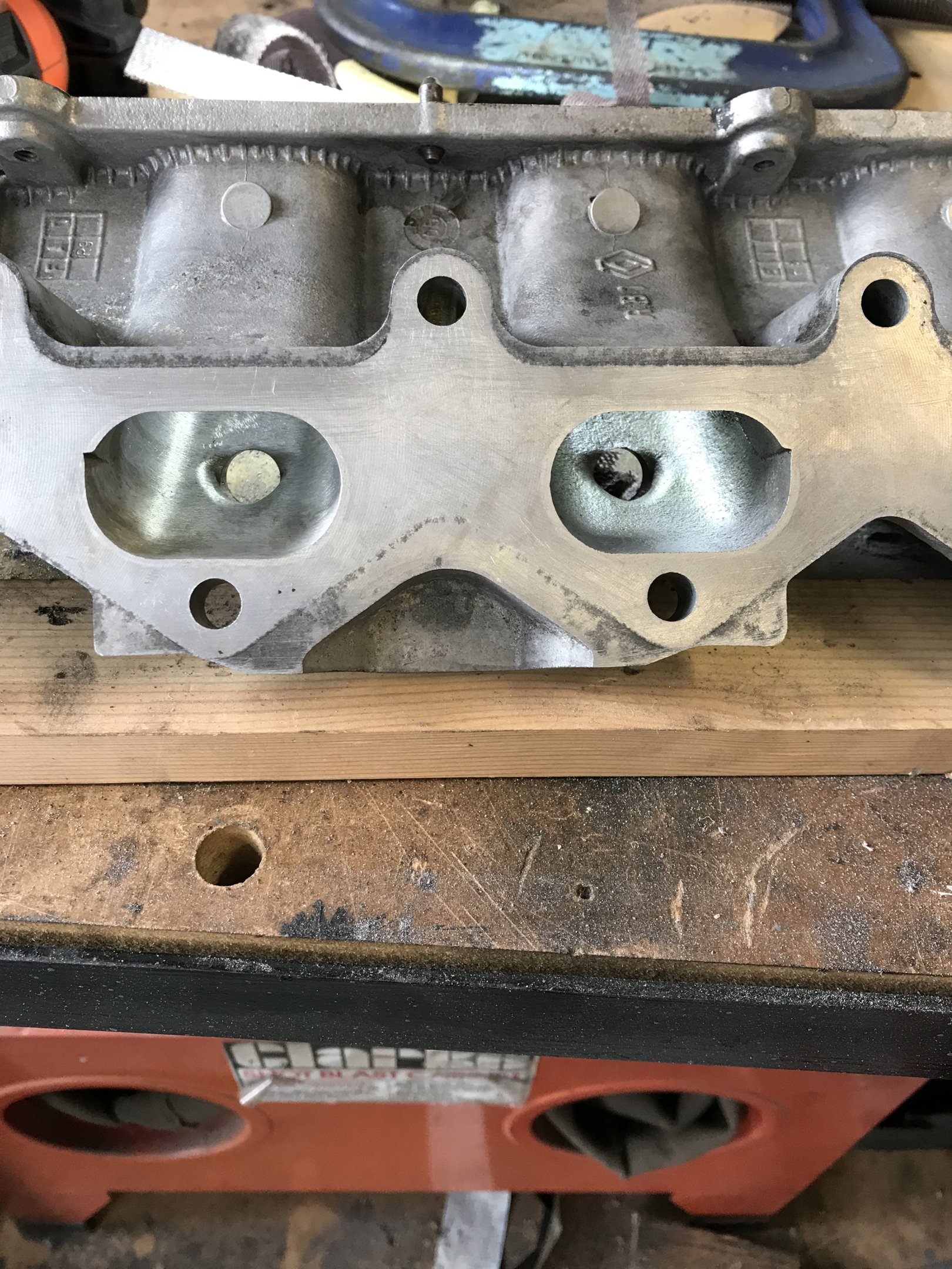

This is the car currently I have got the inlet manifold off so it can be smoothed and matched to the lower manifold (separate post for that because me and a guy from work have done it so plenty of pictures)

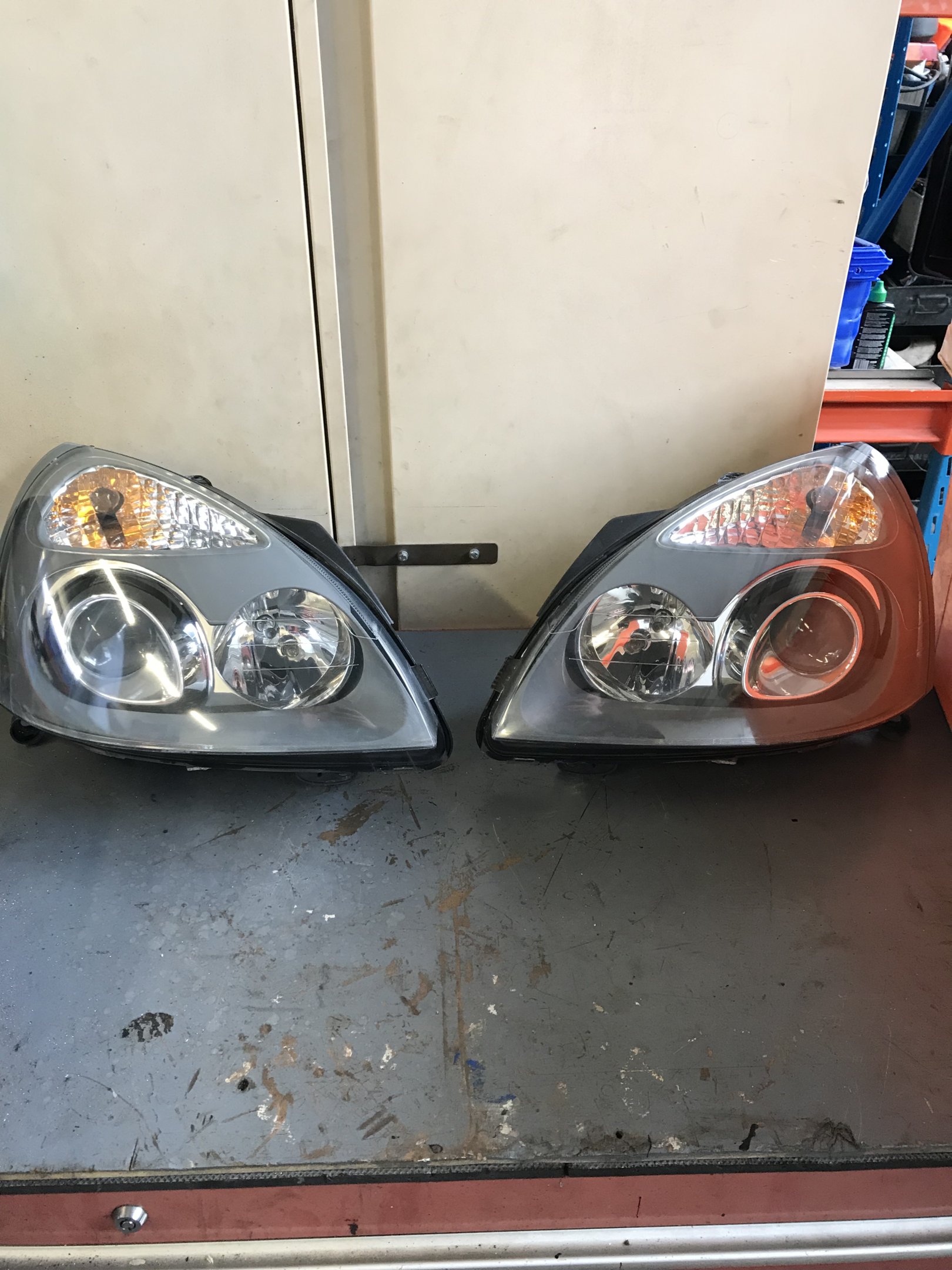

Headlights are out to be polished and freshened up. Some more updates to come :)

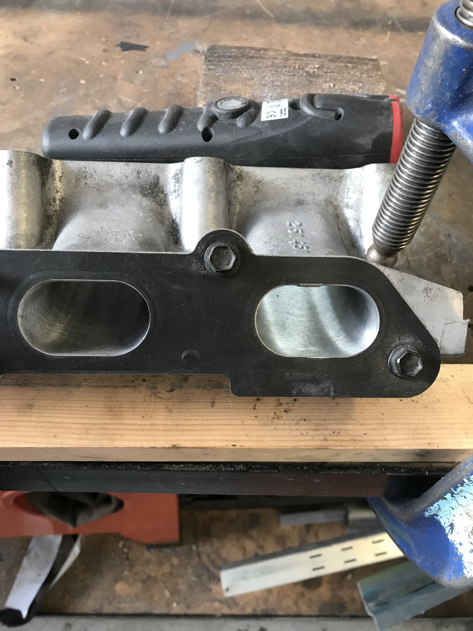

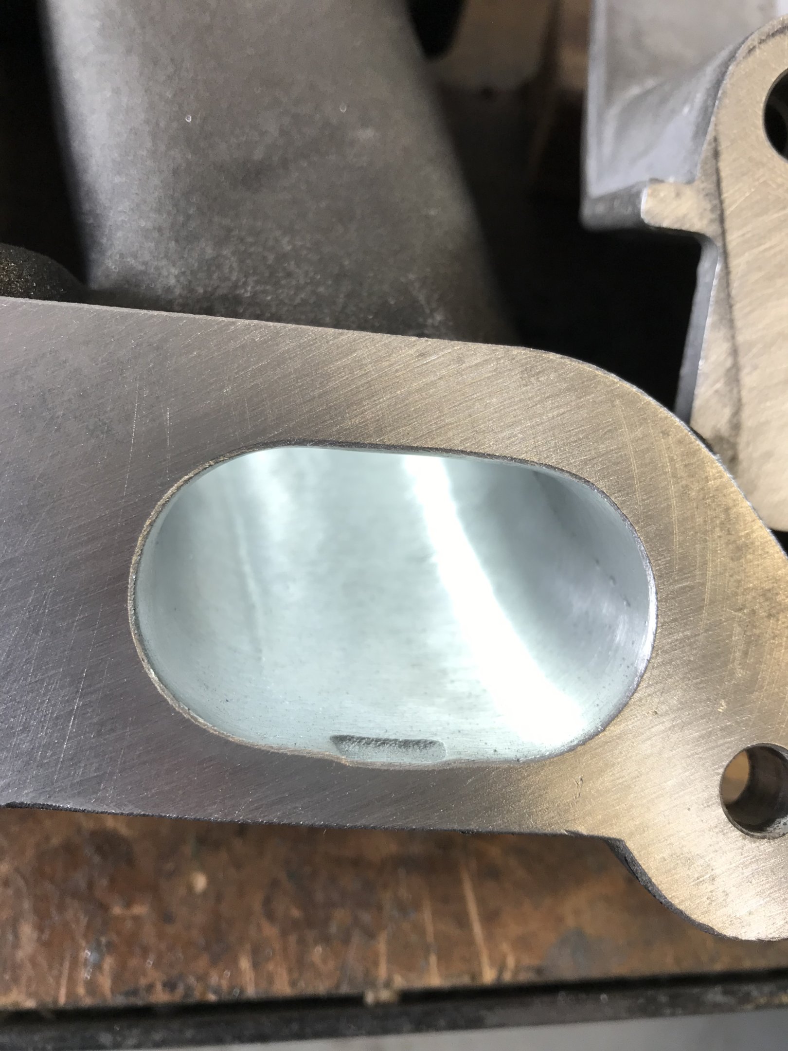

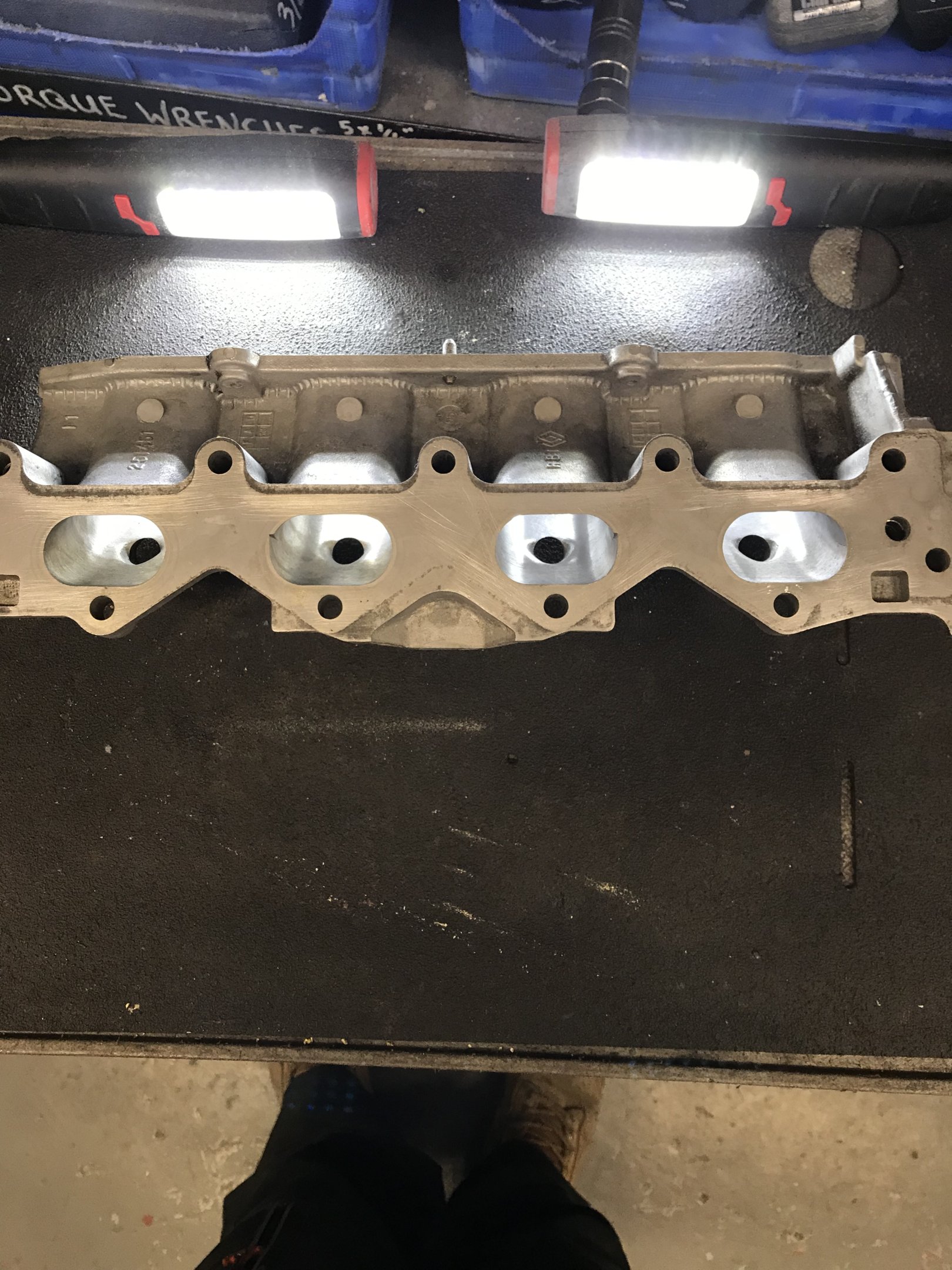

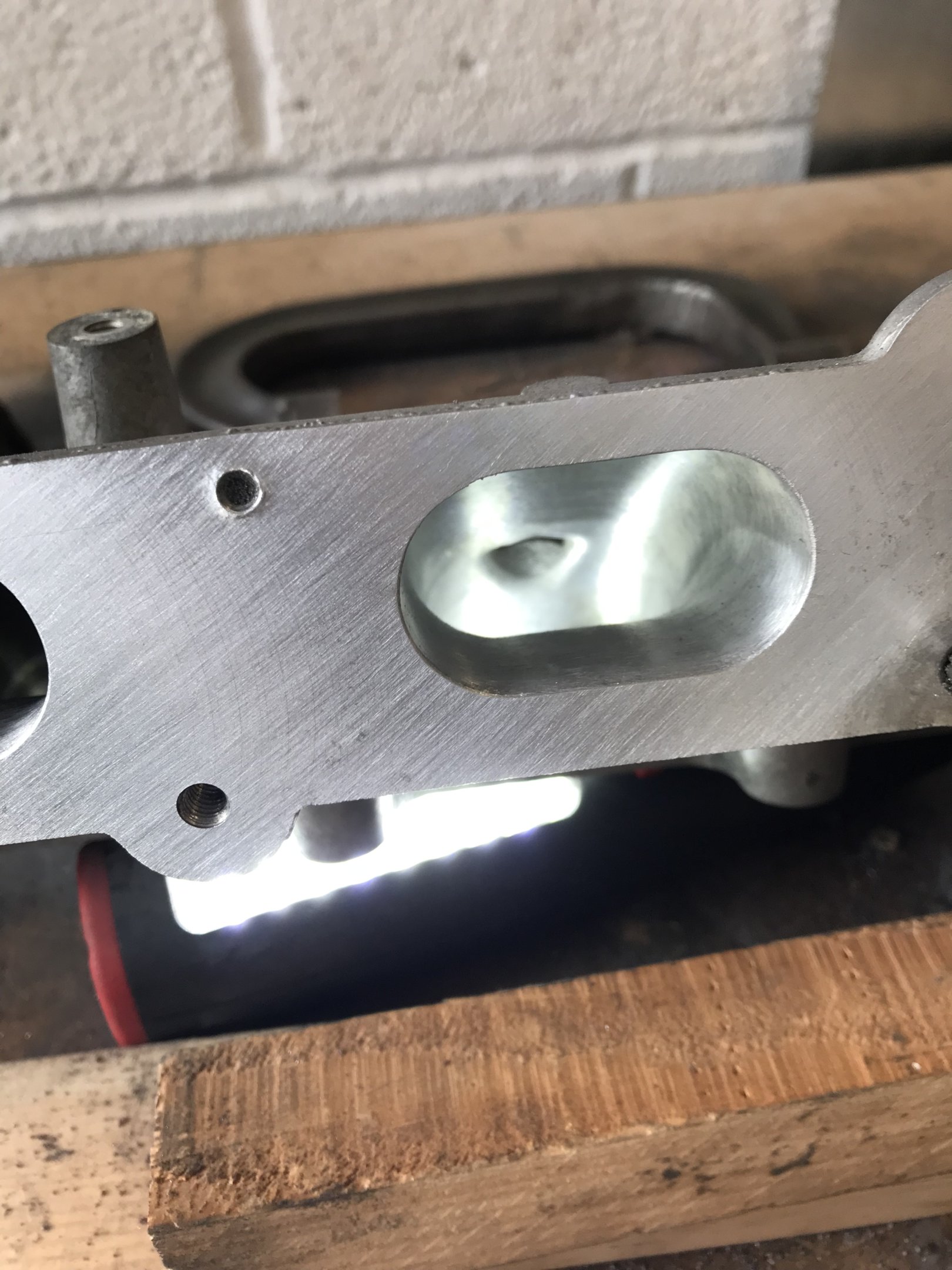

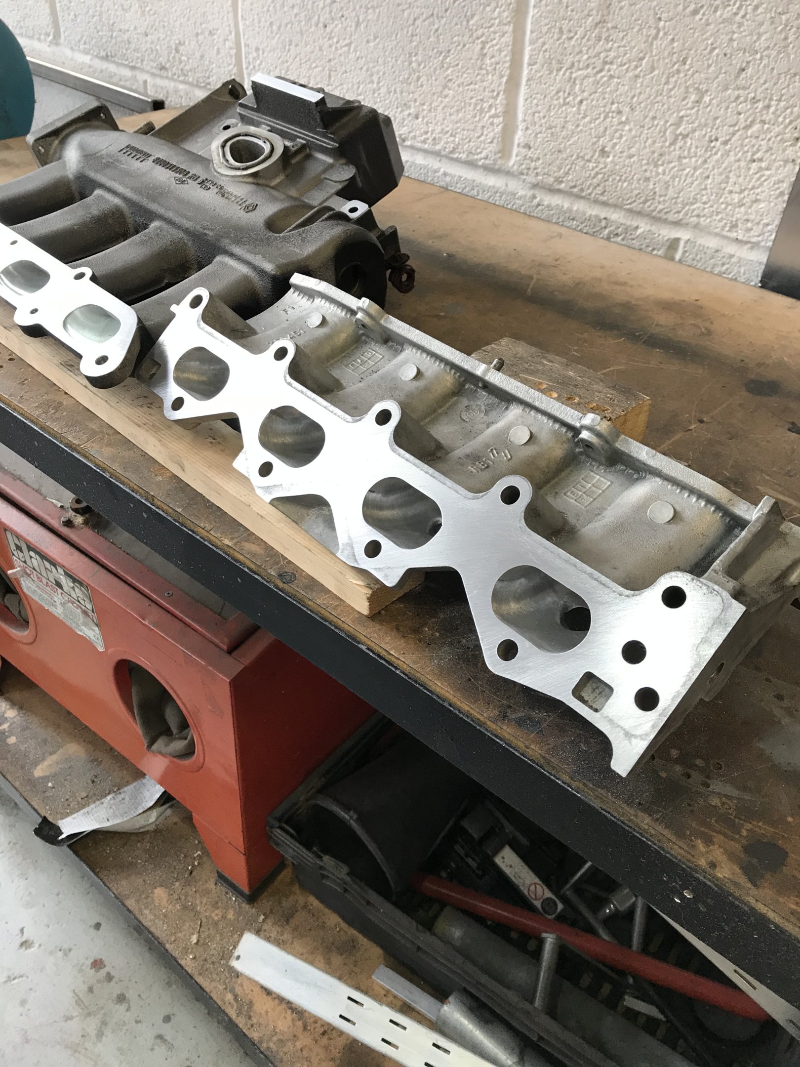

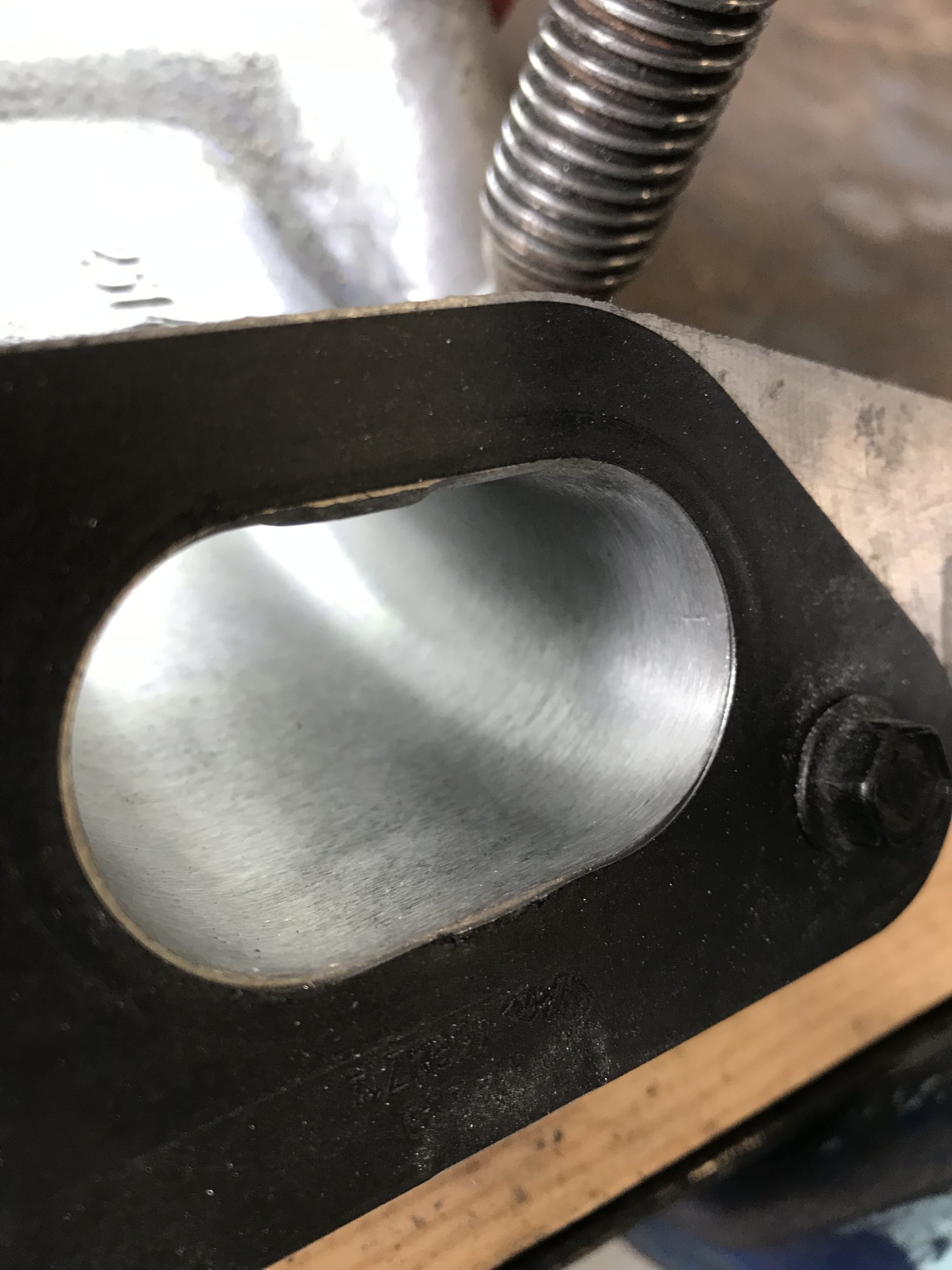

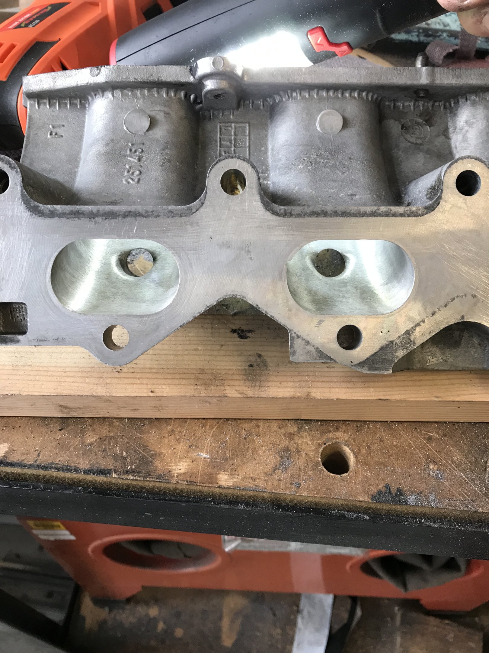

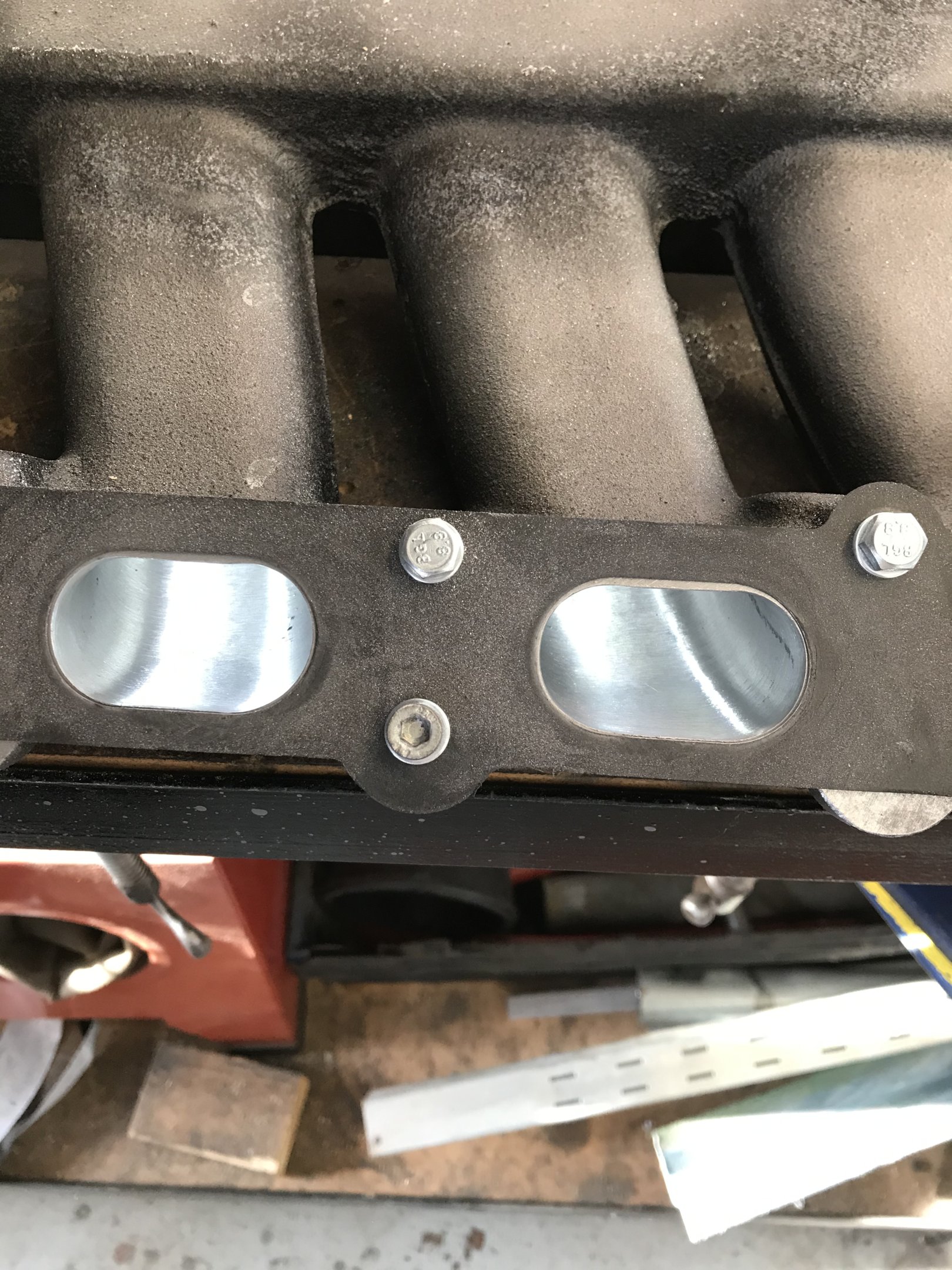

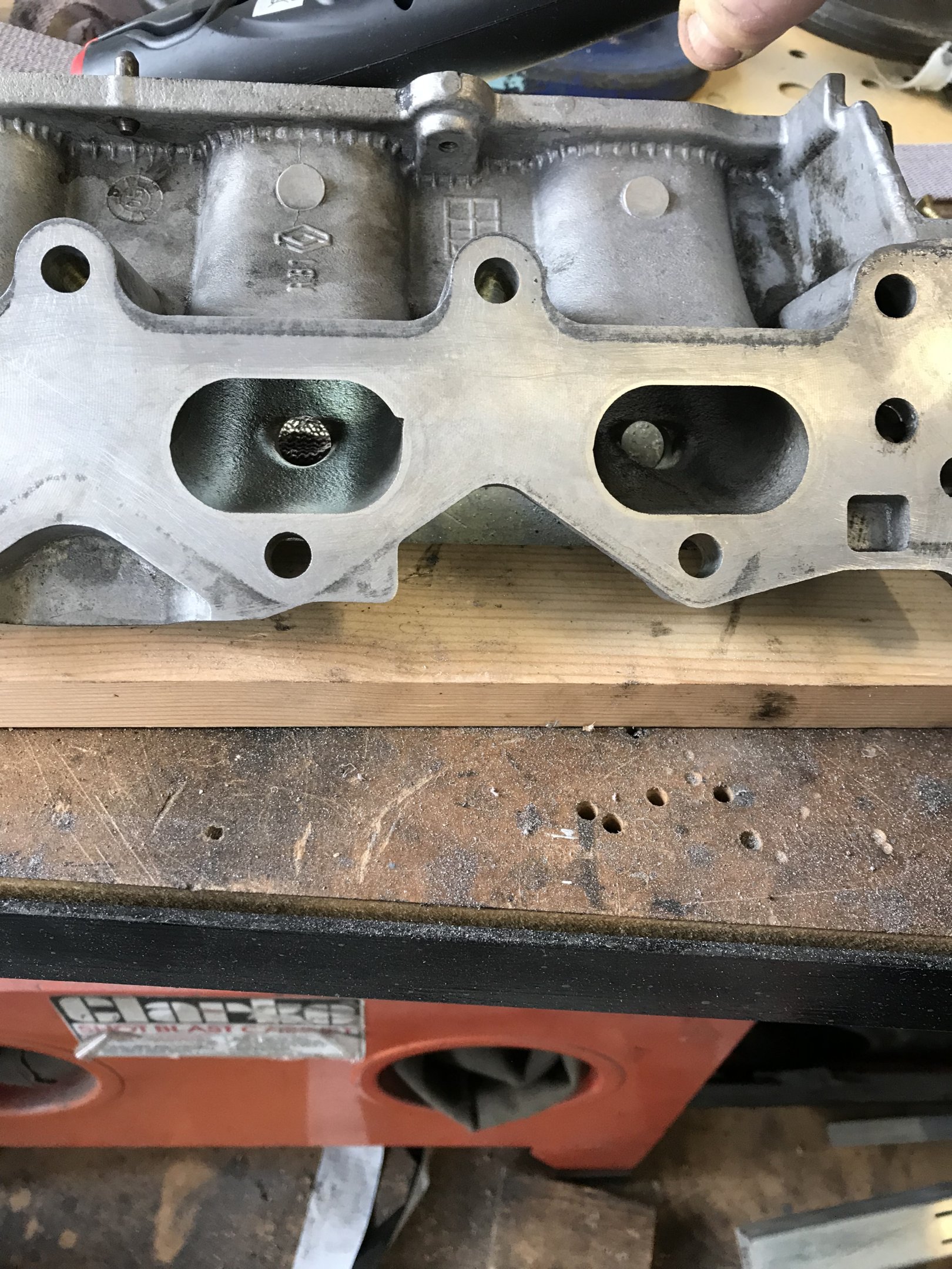

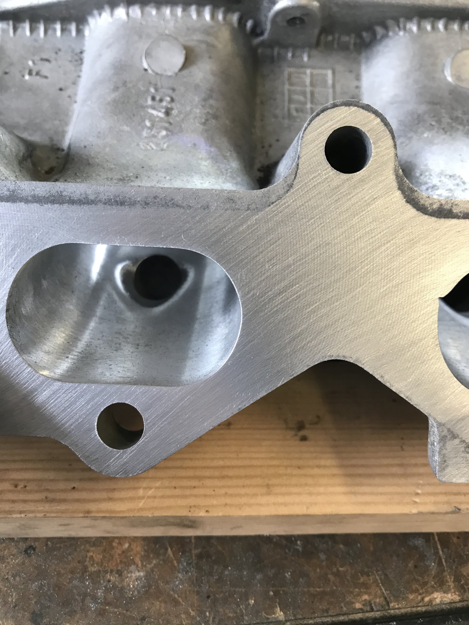

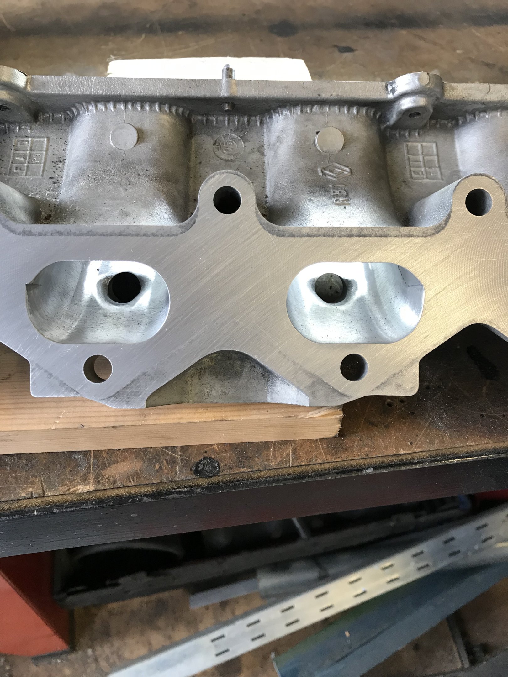

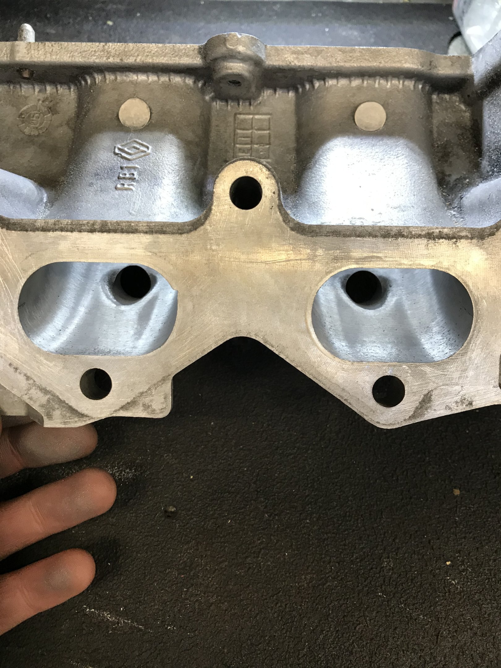

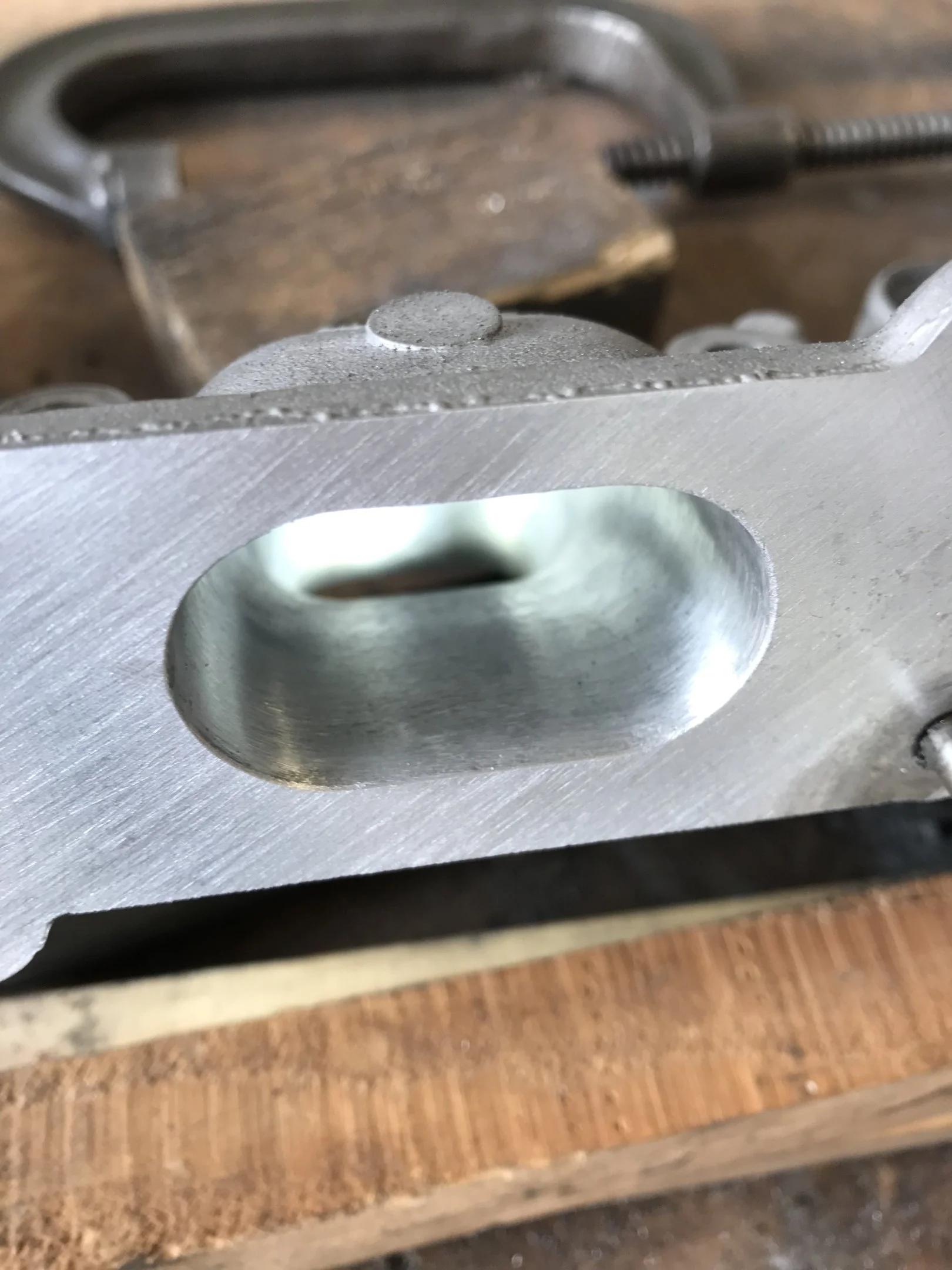

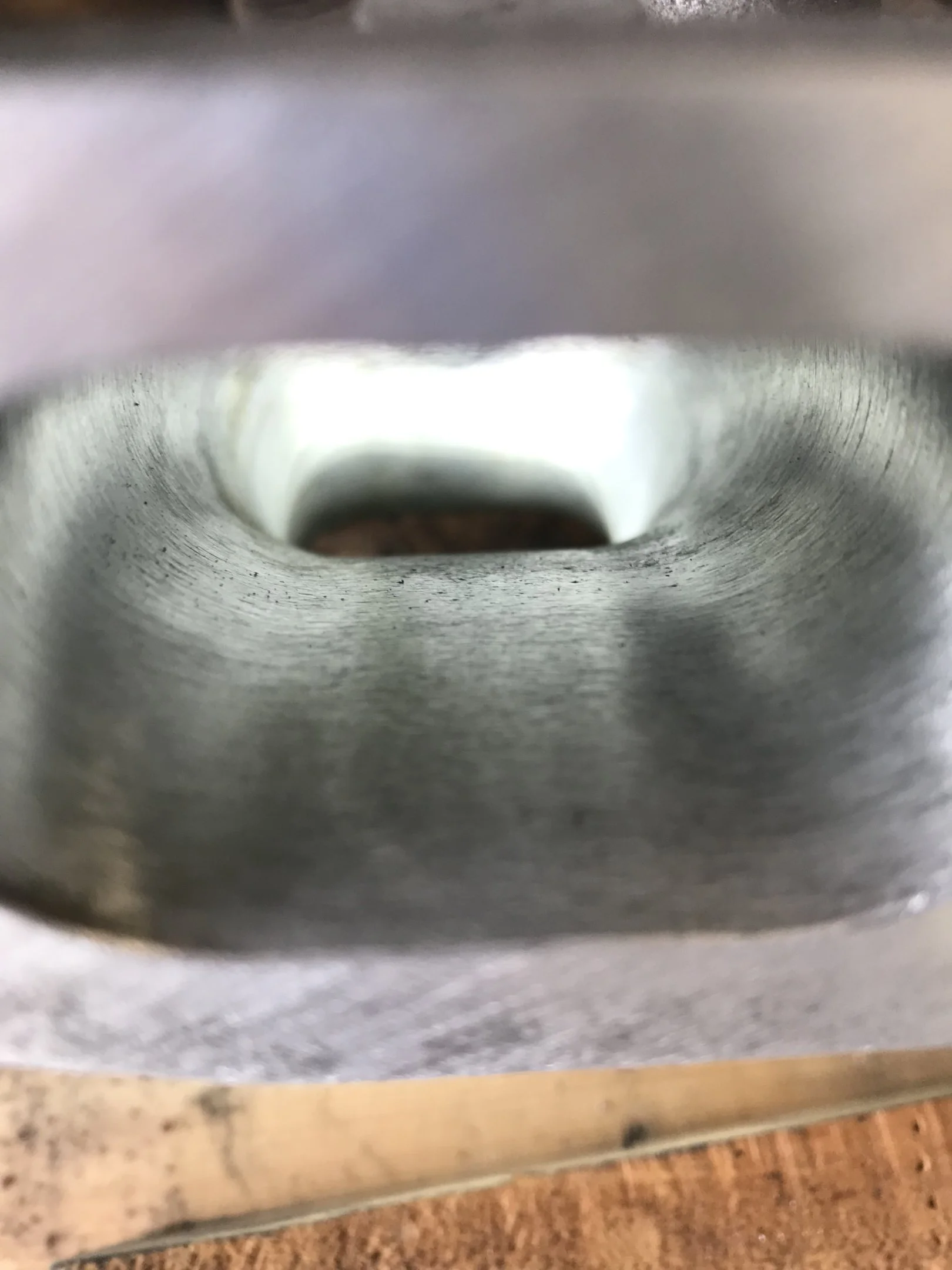

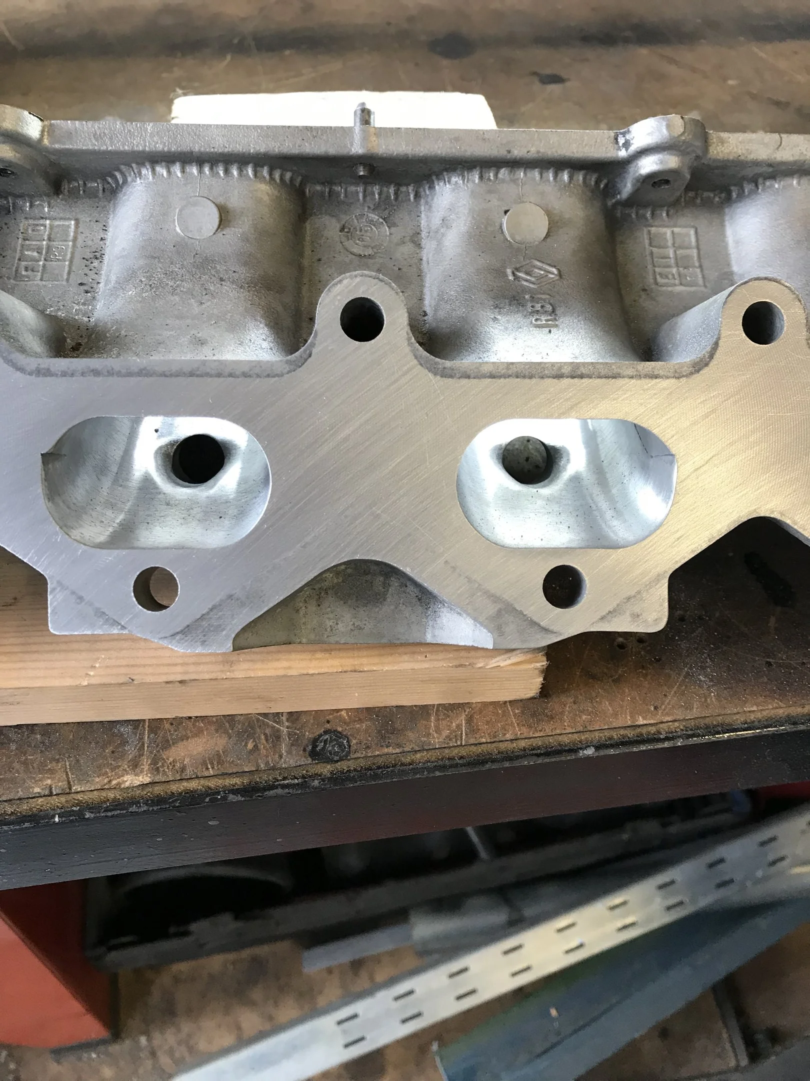

So me and the guy from work (Neal) have had a play with the inlets smoothing them and matching them (Neal ports heads for classic minis and is one of the best in the business his name is Neal GT on Facebook go check him out if you are into your classic mini stuff or if you want a mini cylinder head doing).
Anyway this is how the inlets started
It has a pretty rough casting finishing but not terrible for a factory inlet and it has the RS lower inlet I might add.

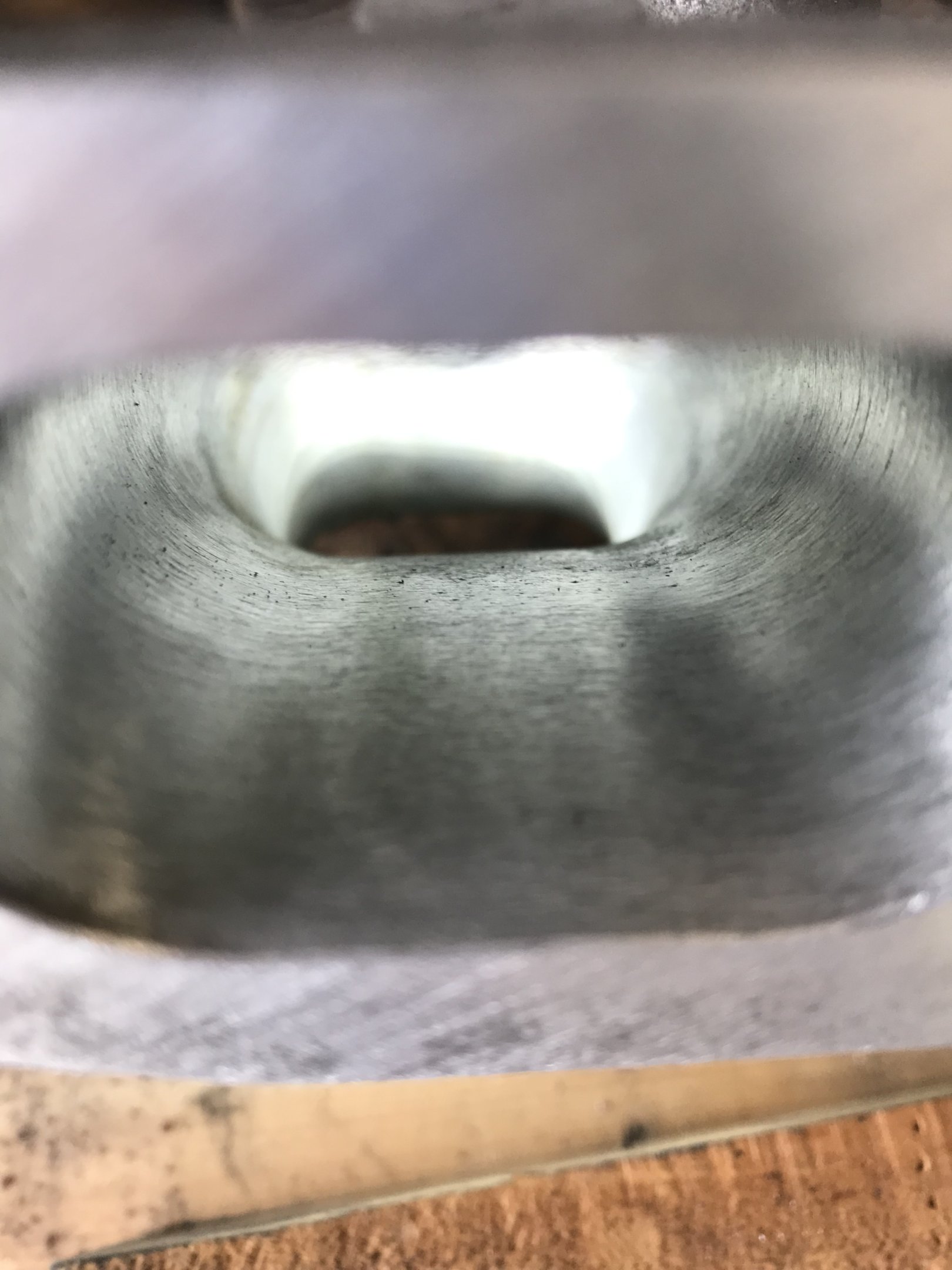

We started with 80 grit (that they use on flatting blocks) on a drill, we made from threaded bar a holder for the 80 grit to wrap round and we just cut a slot in the middle of the bar and the 80 grit folded up sits in there lovely.
Made a start with the 80 and gave a finish like this

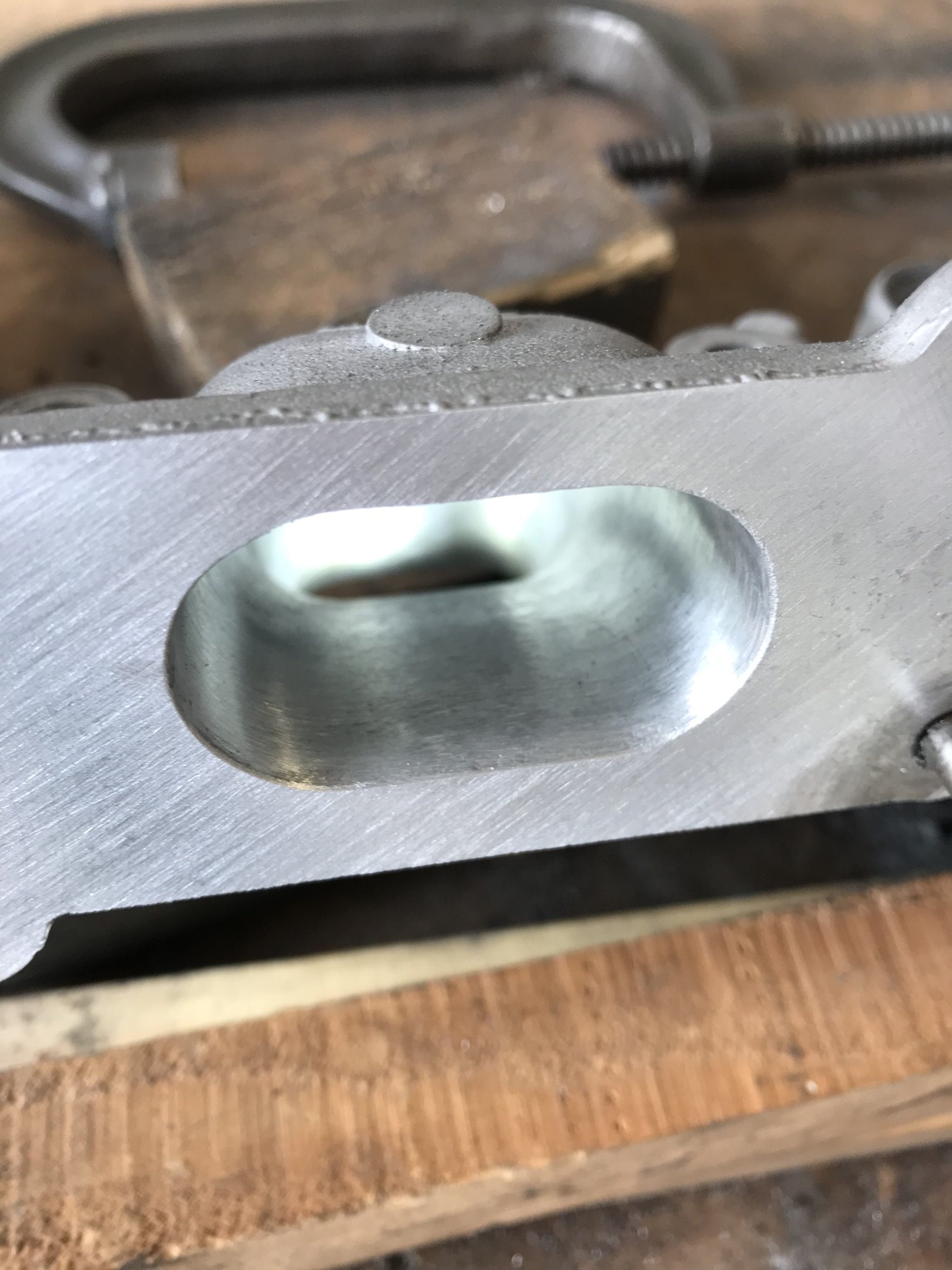

We left the matching side of the job till the end as we didn’t want to open the port too much when smoothing (left has been done right factory)

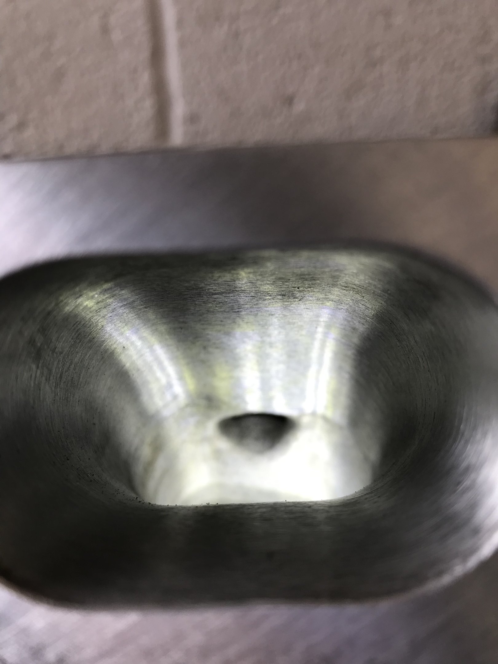

Continue to work with the 80 grit we found 80 grit DA disks work really well to shift the larger amounts of metal.
Worked the rest of the ports and came out with this.
We then went back to the 80 grit block stuff (I will get pictures of the paper and grit when I get to work Monday so you know what I am talking about) this works really well before you use the 240 grit as it isn’t as aggressive
So it then looked like this
Top part next
Same process with the top part of the manifold
Smoothing and shaping all the time and started to use the gasket as a reference

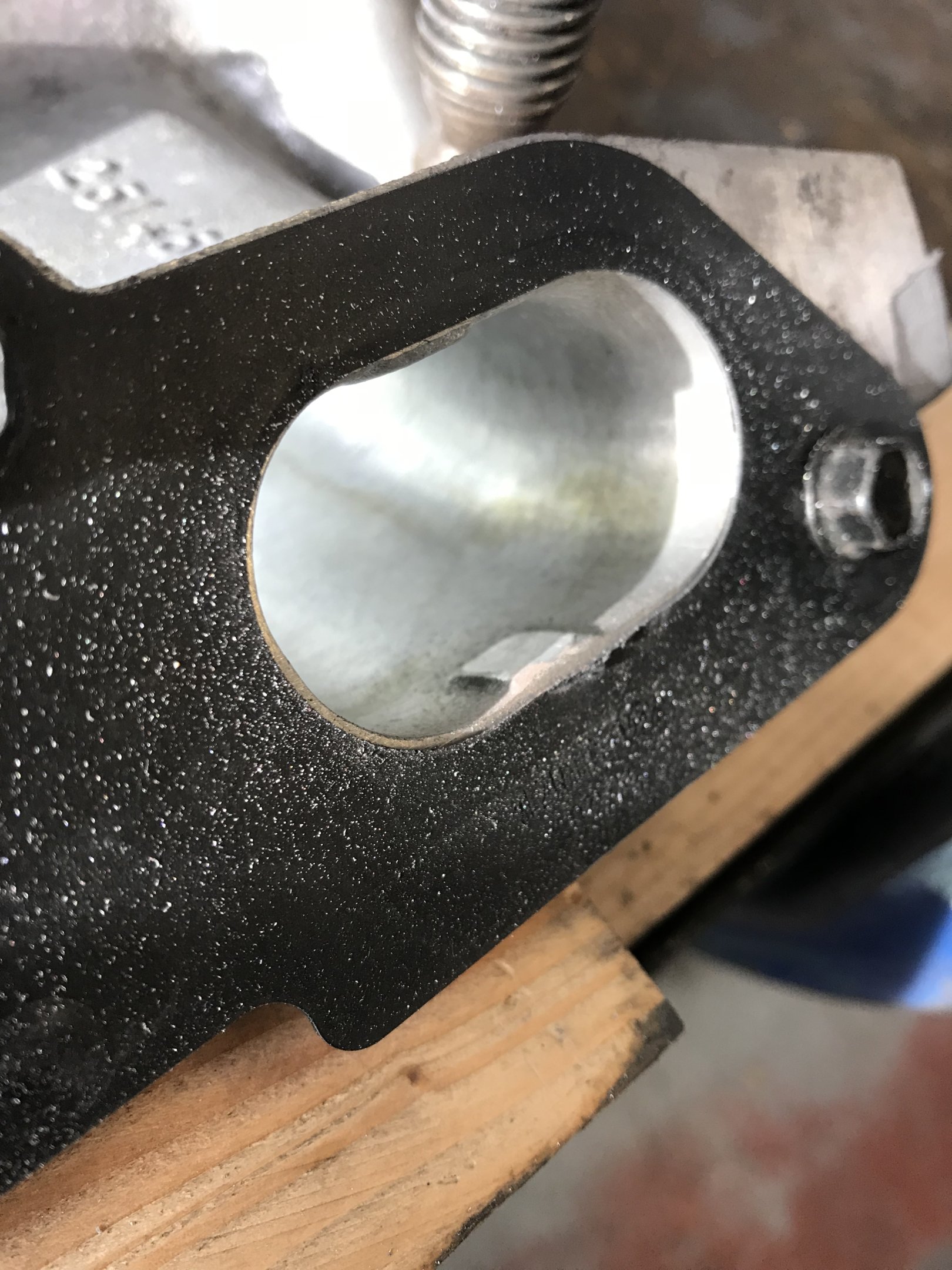

Got rid of this step with a dremel and a stone but nothing too aggressive and then smoothed with the 80 grit once gone
After with the 80 grit
Then matched everything to the gaskets and once done used a needle file to round the edges off and then finished with the 240 everywhere and job done took us about 6 hours to do on and off here’s some pictures of the finished job

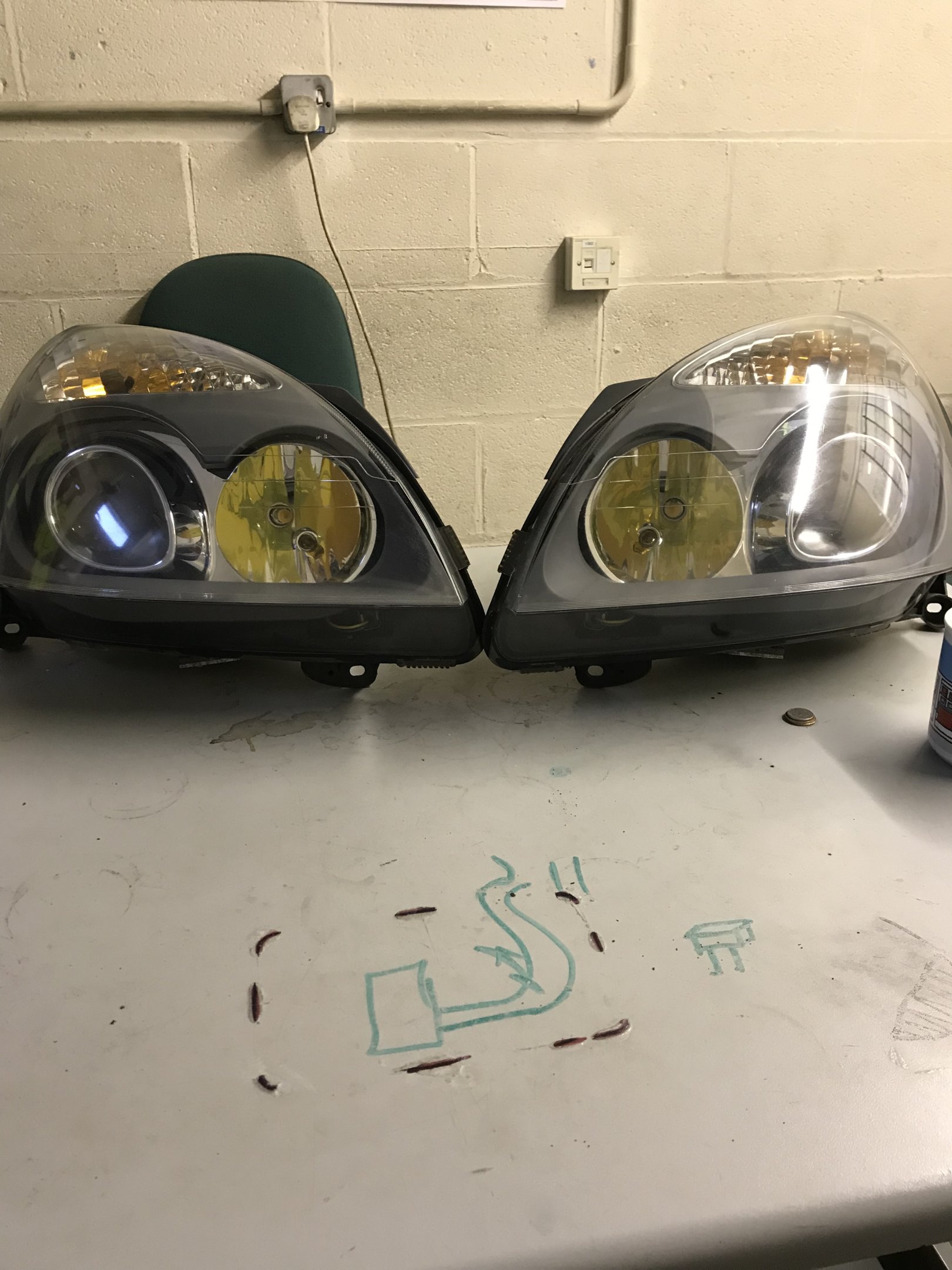

Polished the head lights up to freshen them up again and went for some new bulbs for main beam and side lights
They look wicked when the lights are on

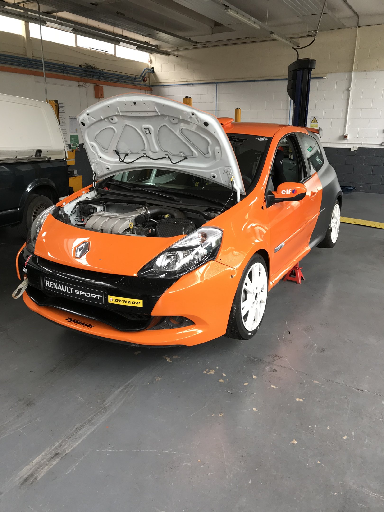

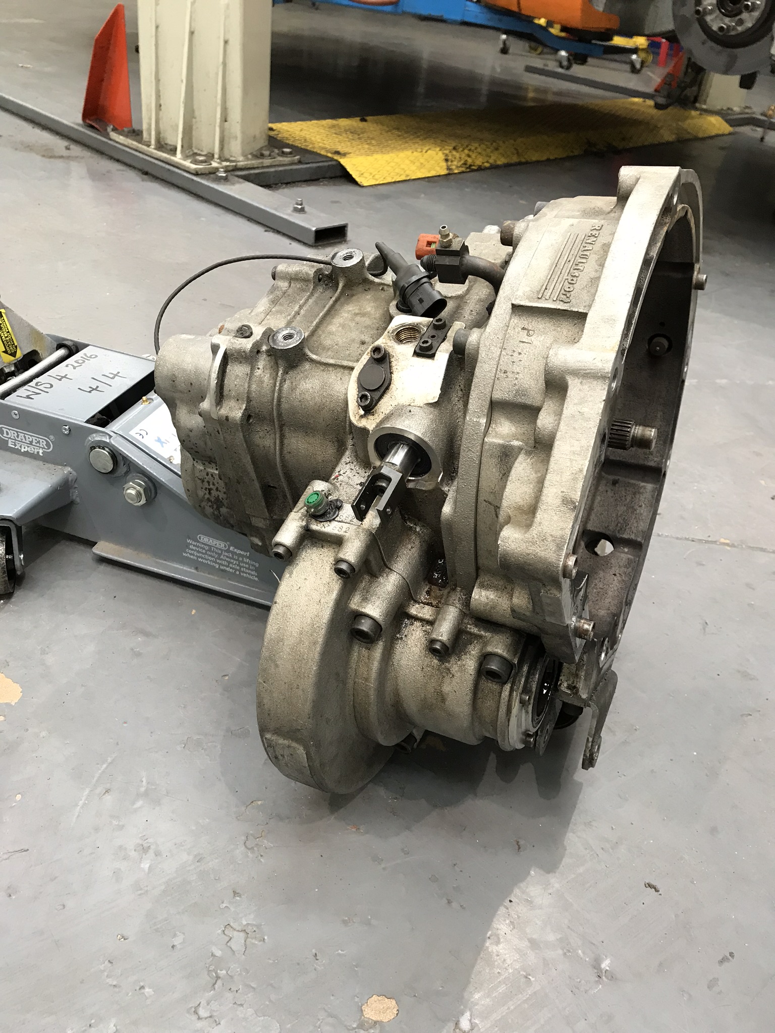

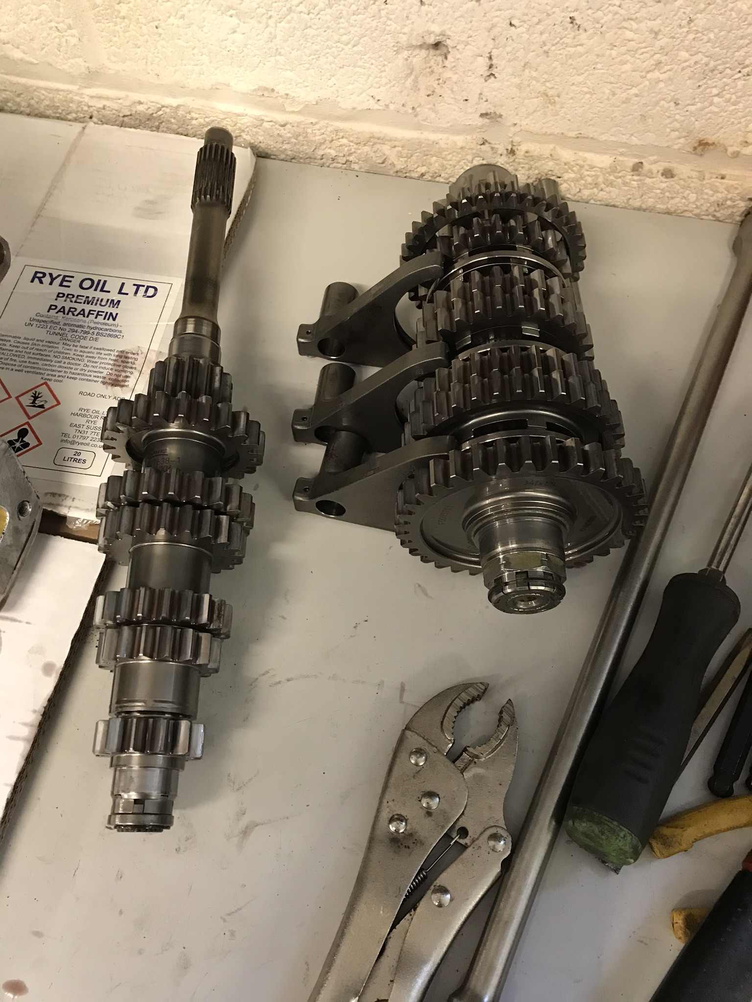

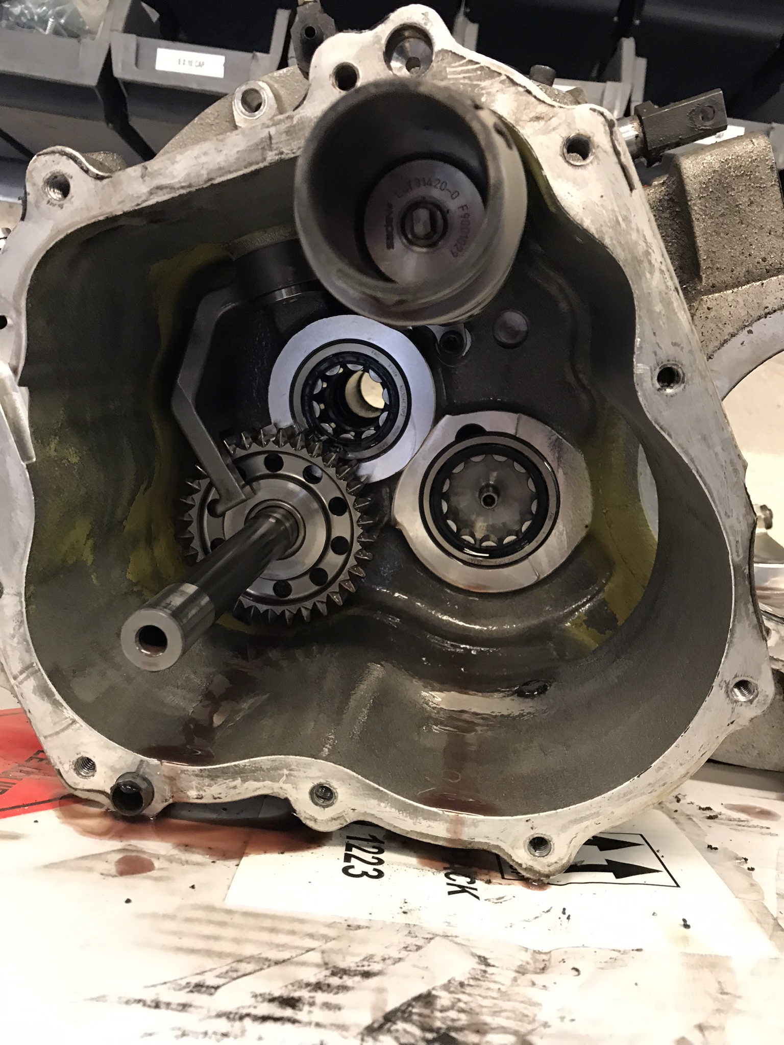

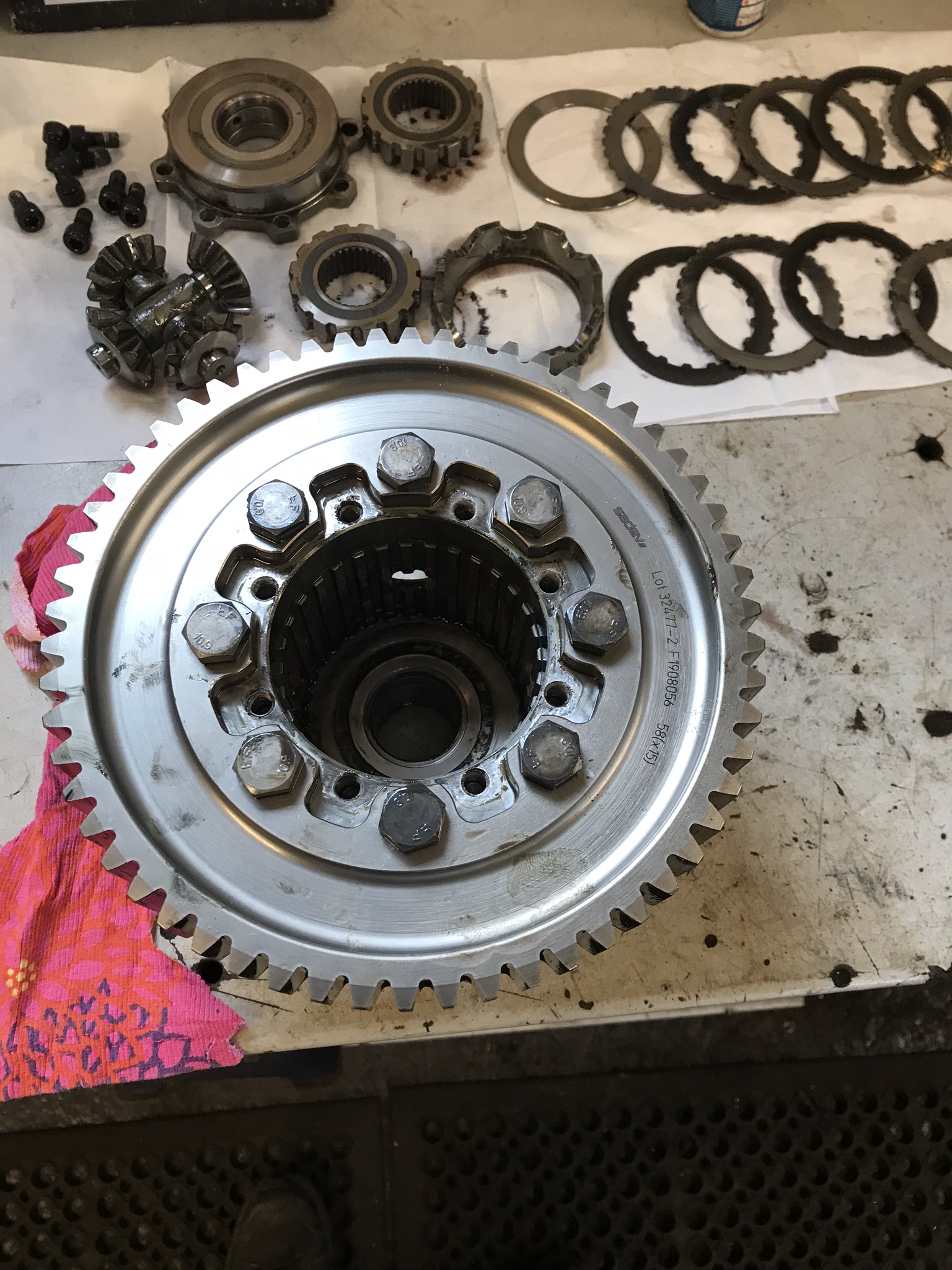

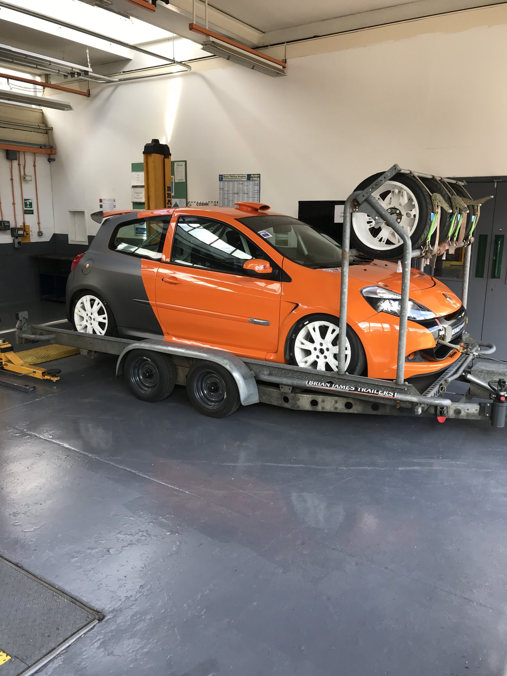

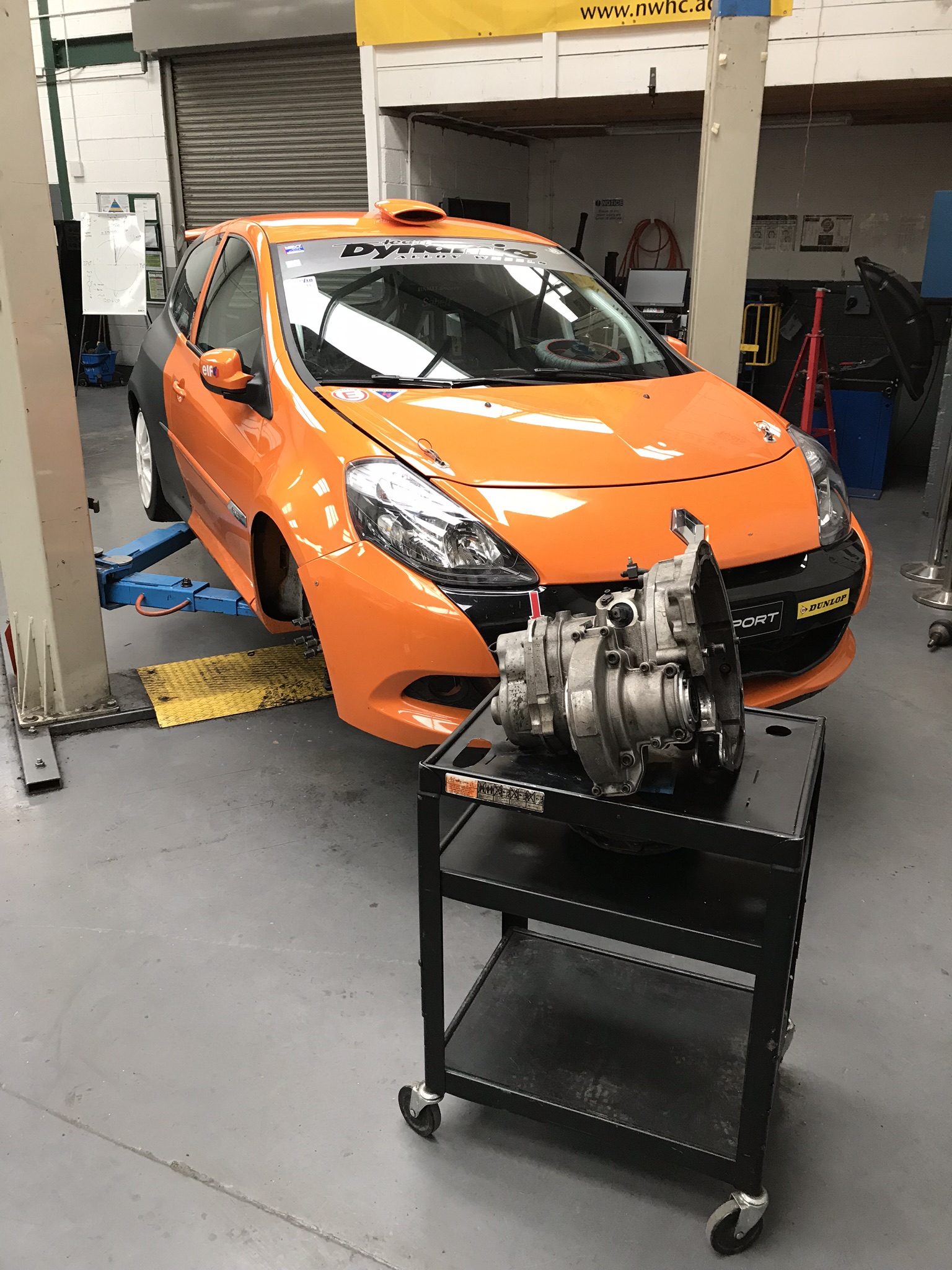

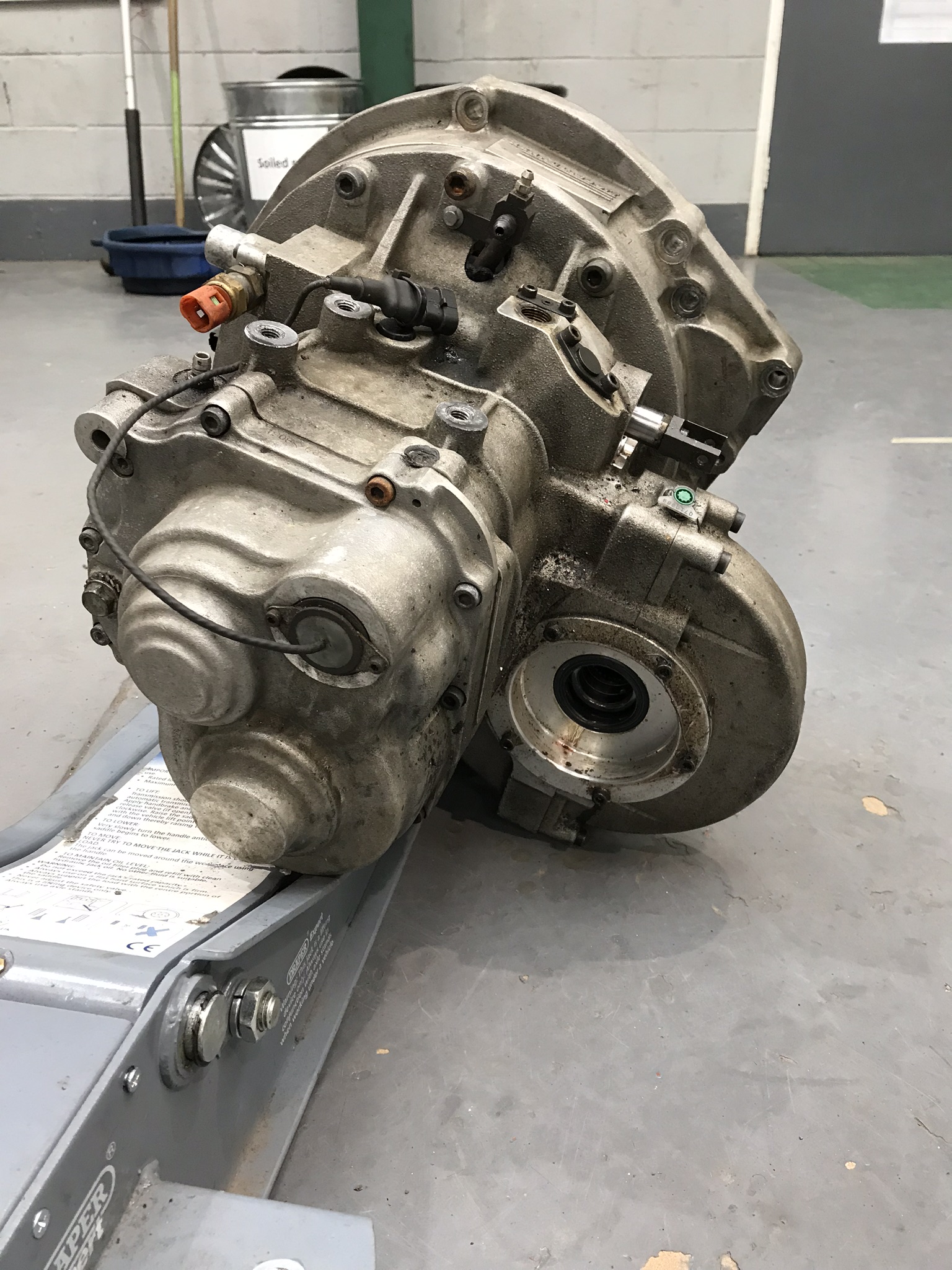

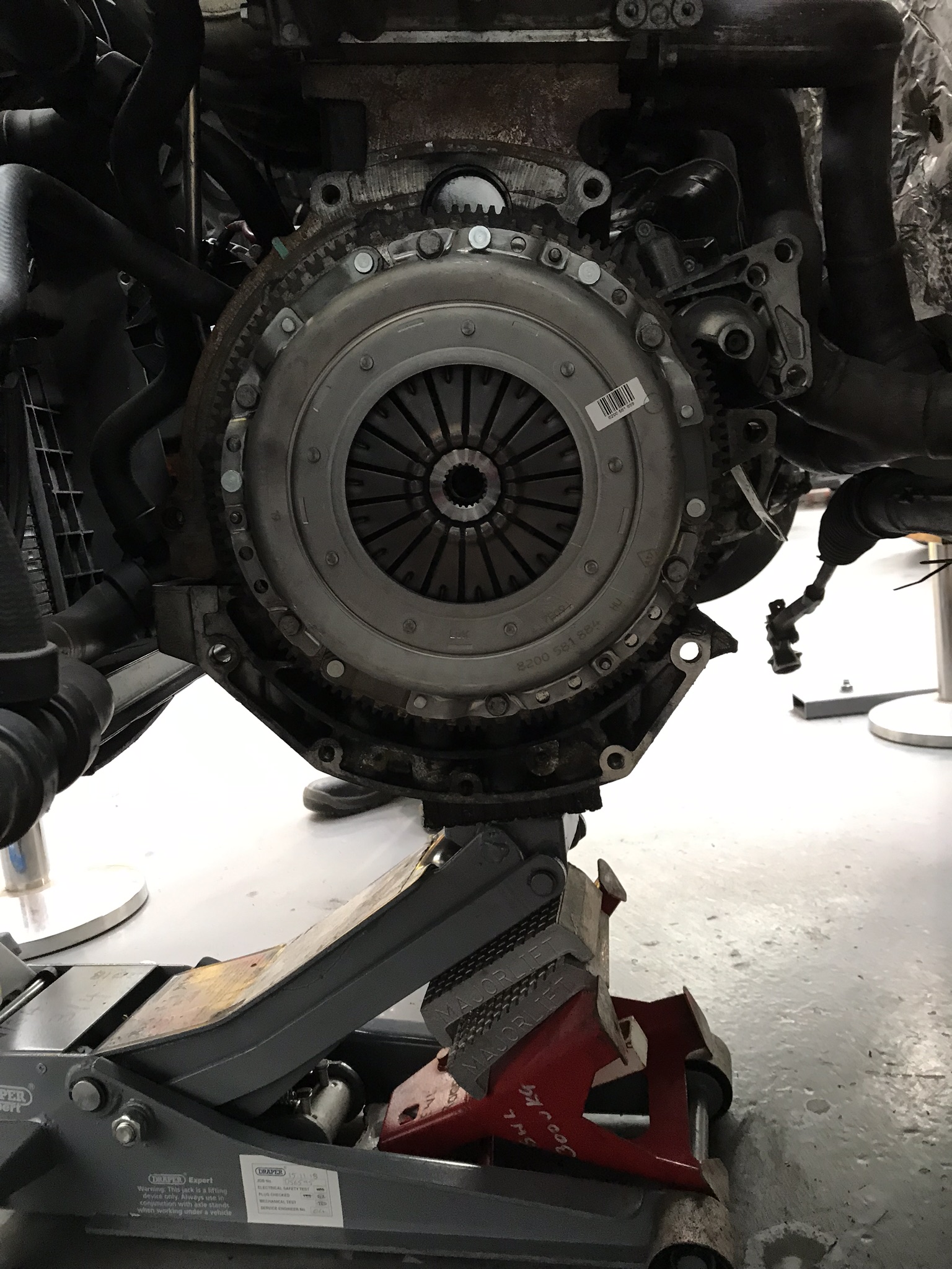

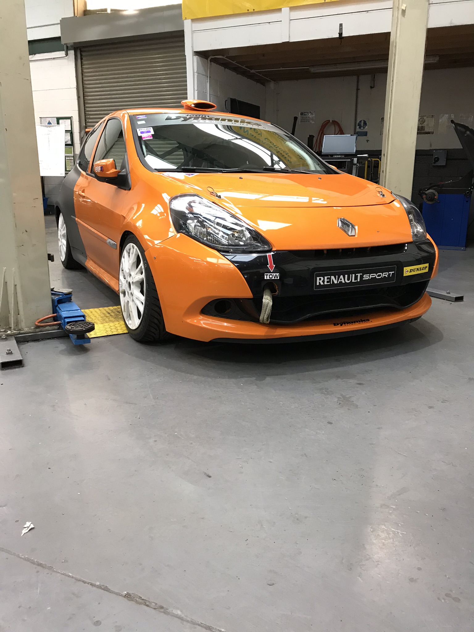

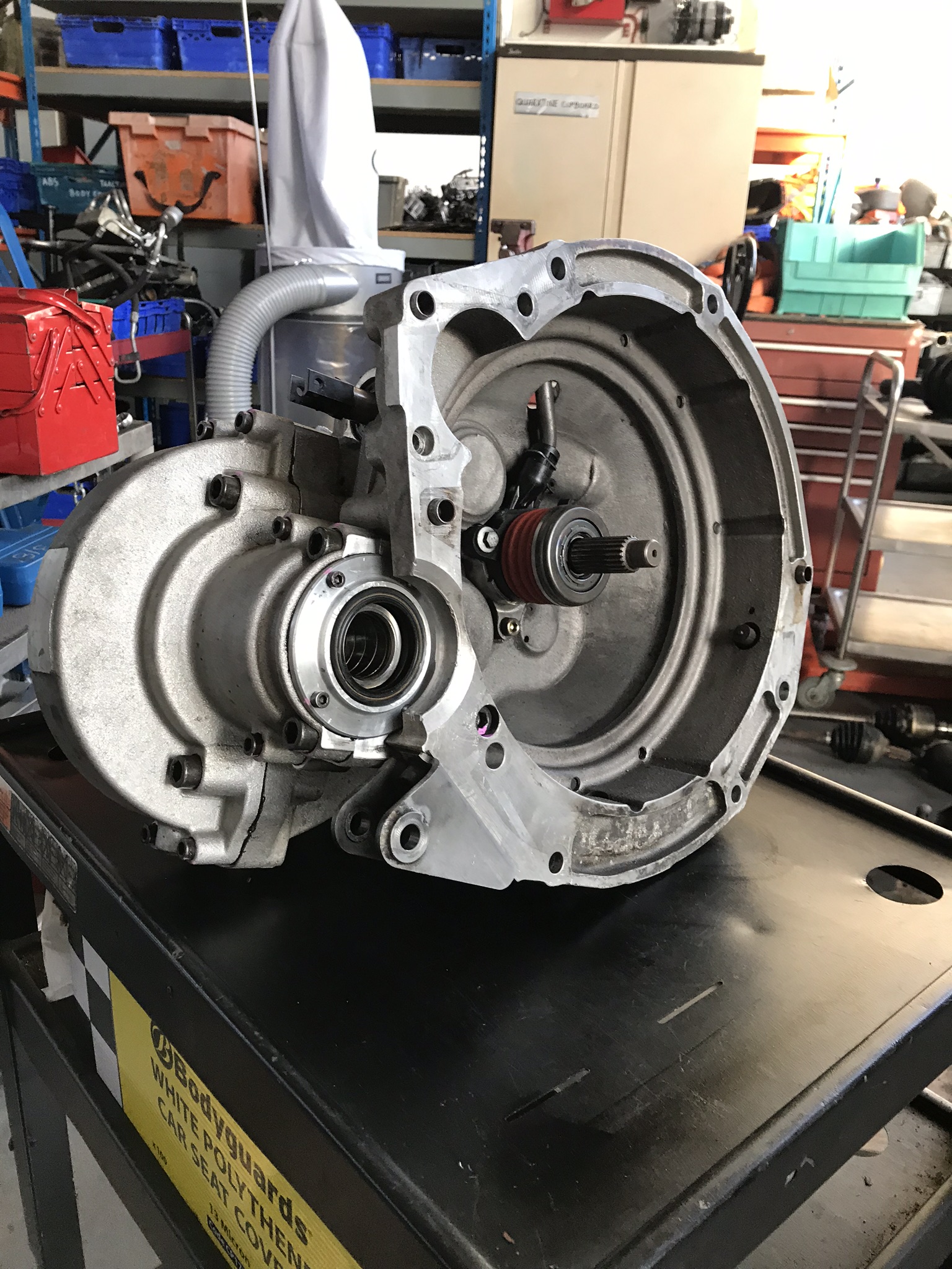

Took the cup racer to work to take the gearbox out and have it inspected and freshen up.
1408616

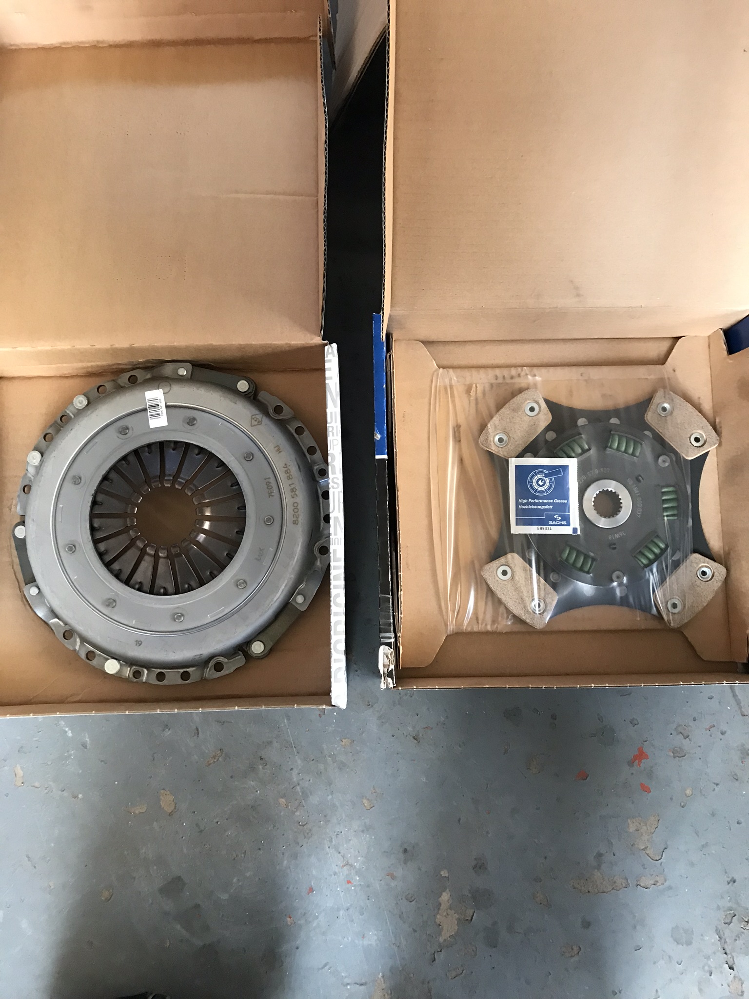

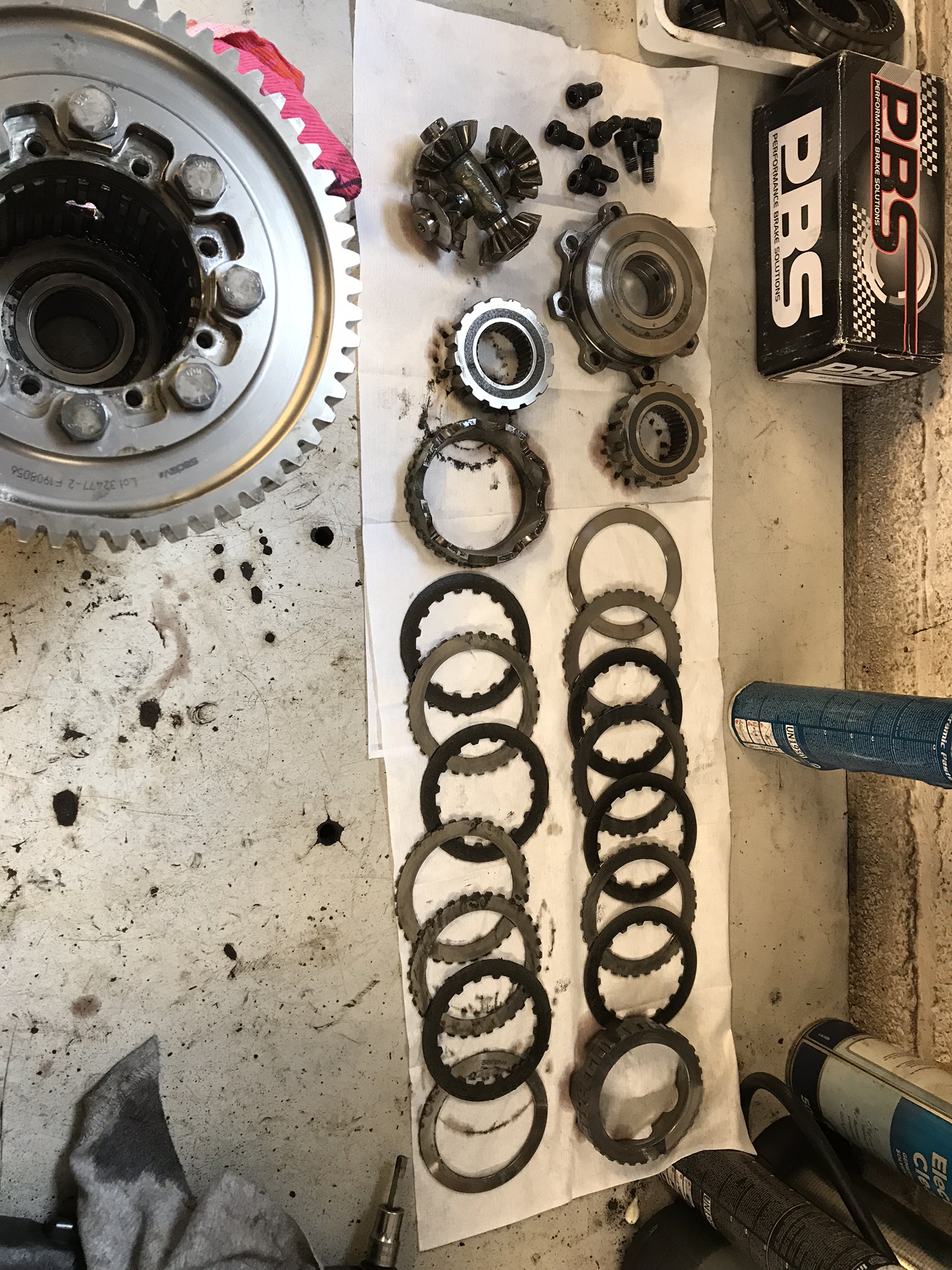

Car ended up needing new diff plates, new clutch and pressure plate and new seals all round apart from that the gearbox was like brand new inside. Work was carried out by Jade Developments in Barwell.
Here’s some pictures of the box stripped and a few other pictures.
1408617
1408618
1408619
1408620
1408621
1408622
1408623
When the box was sripped there was some strange yellow grease all over everything which didn’t help the diff plates but all sorted and cleaned now.
Like I say the car had a new clutch and pressure plate it looks lovely shame you won’t be able to see it haha
1408624
1408625
And one picture of the freshly rebuilt box
1408626

The new harnesses are in on the drivers side they look wicked and very light (for the cup racer) we tried to fit the new passenger seat but pie in the face moment it doesn’t fit it’s too wide for the car so a standard size one will be ordered soon but we shall stick with the OMP one for now.
1408627
These harnesses are loads better and easier to adjust thanks to the yellow pull toggles.
