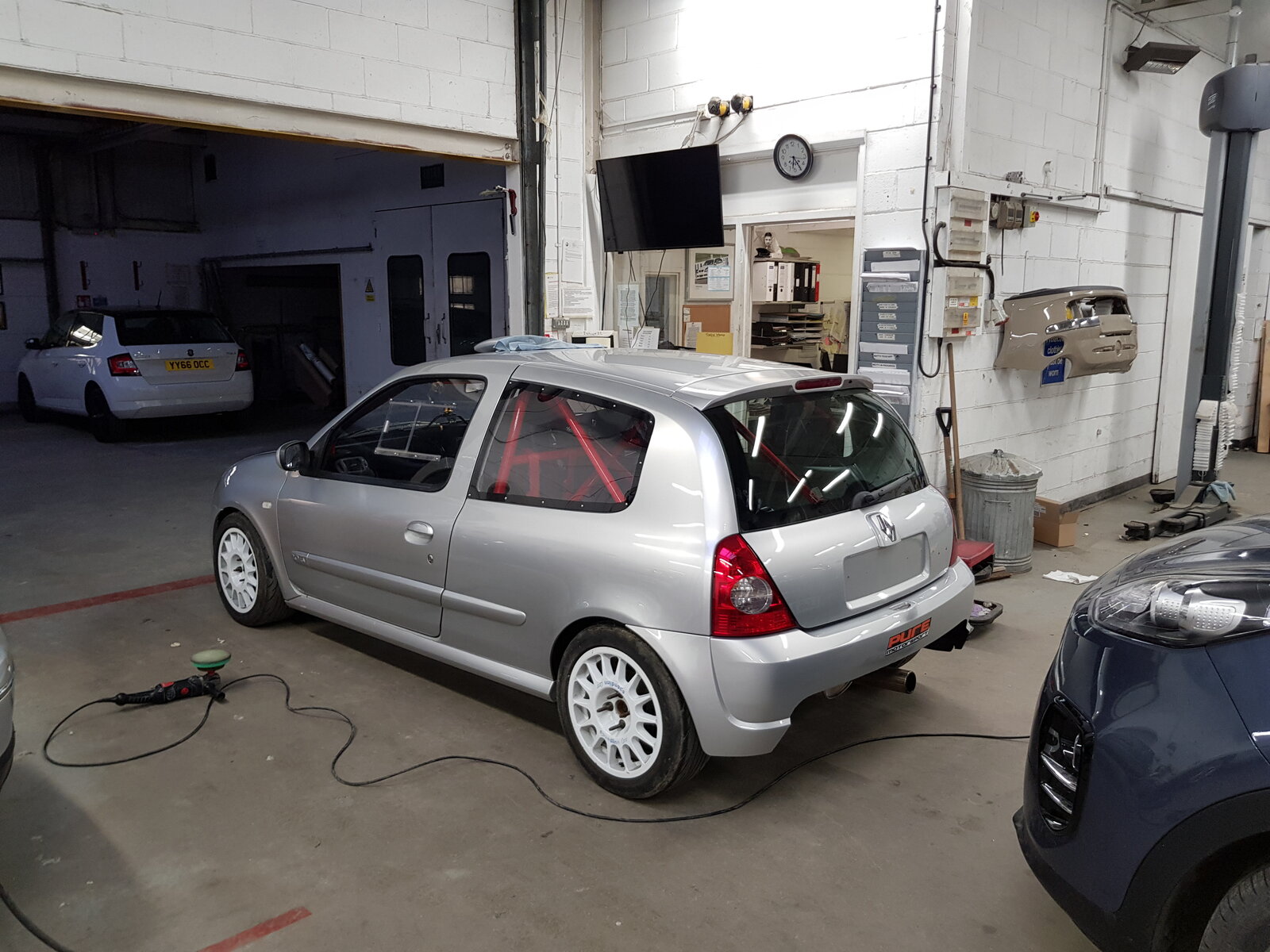

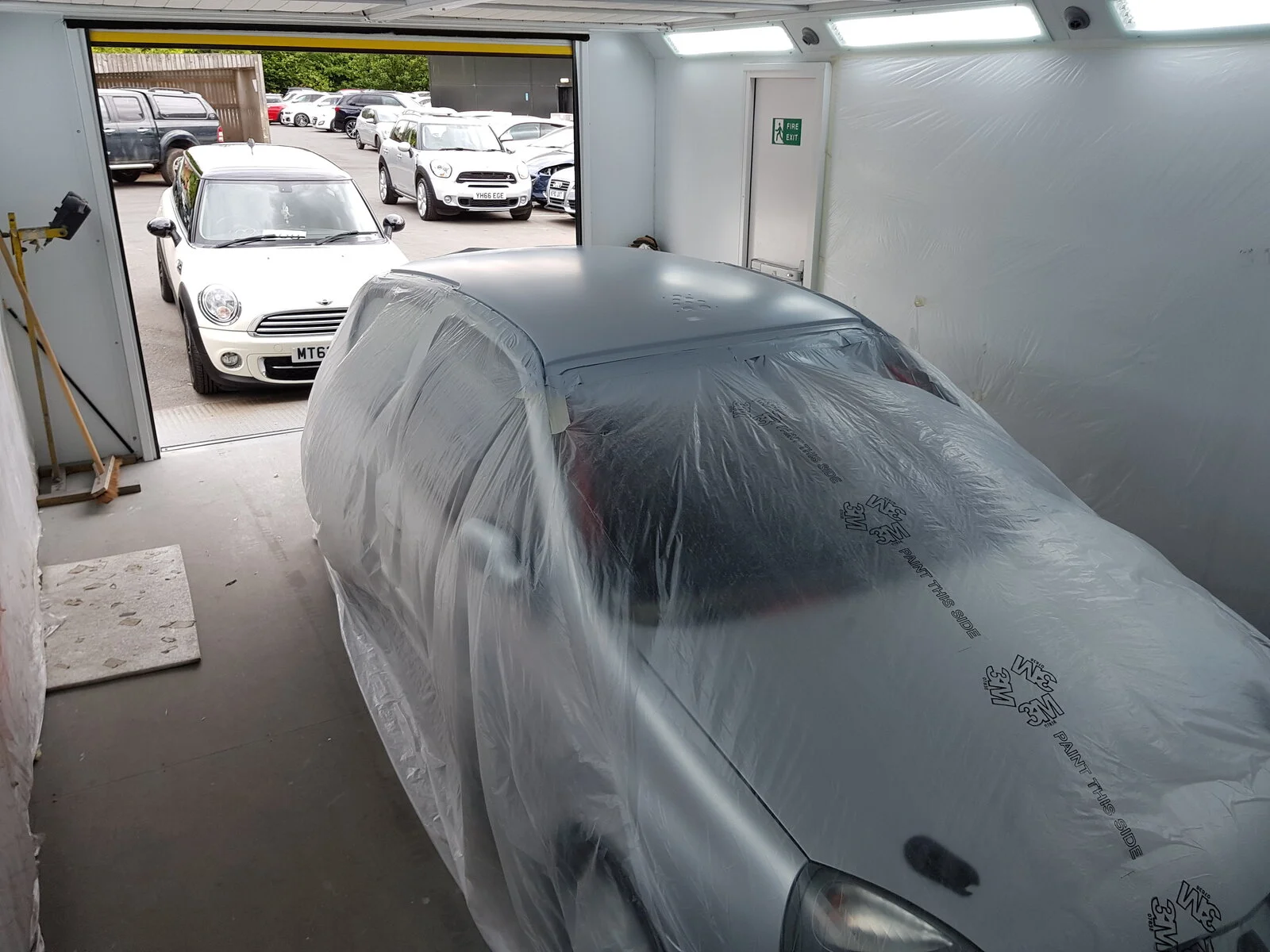

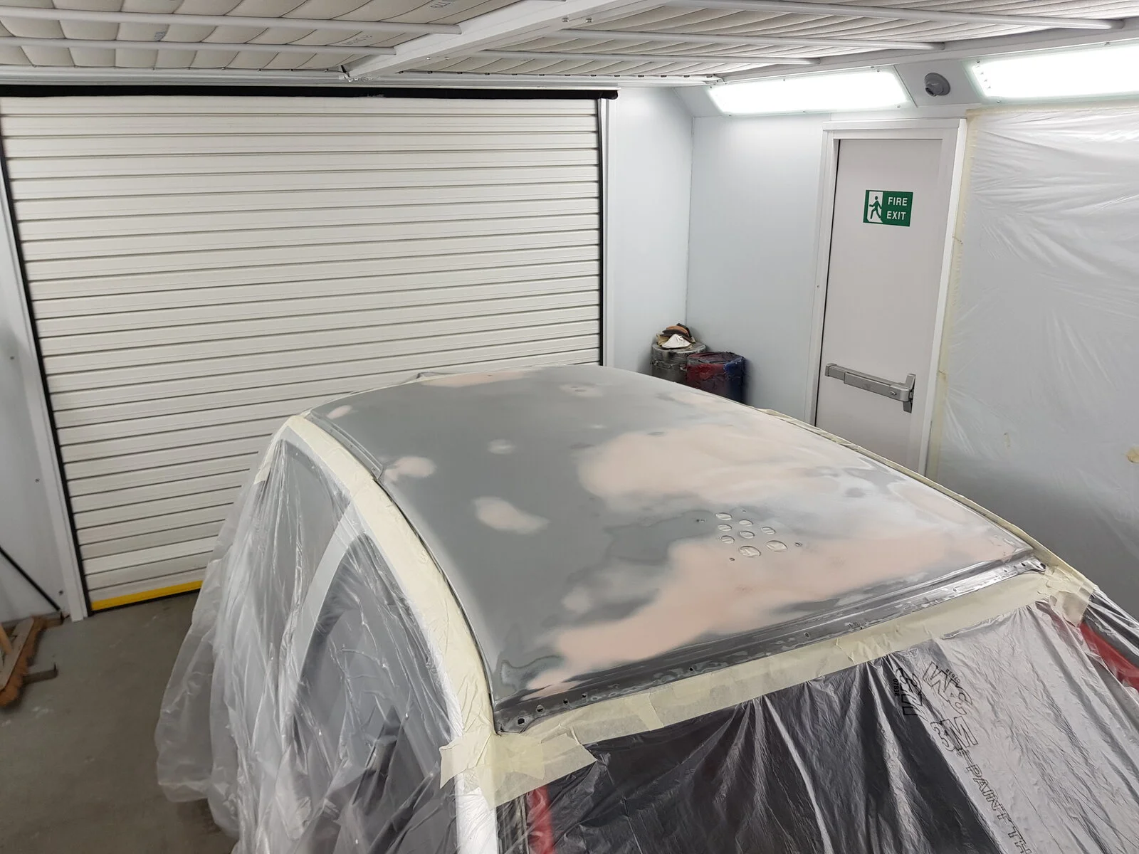

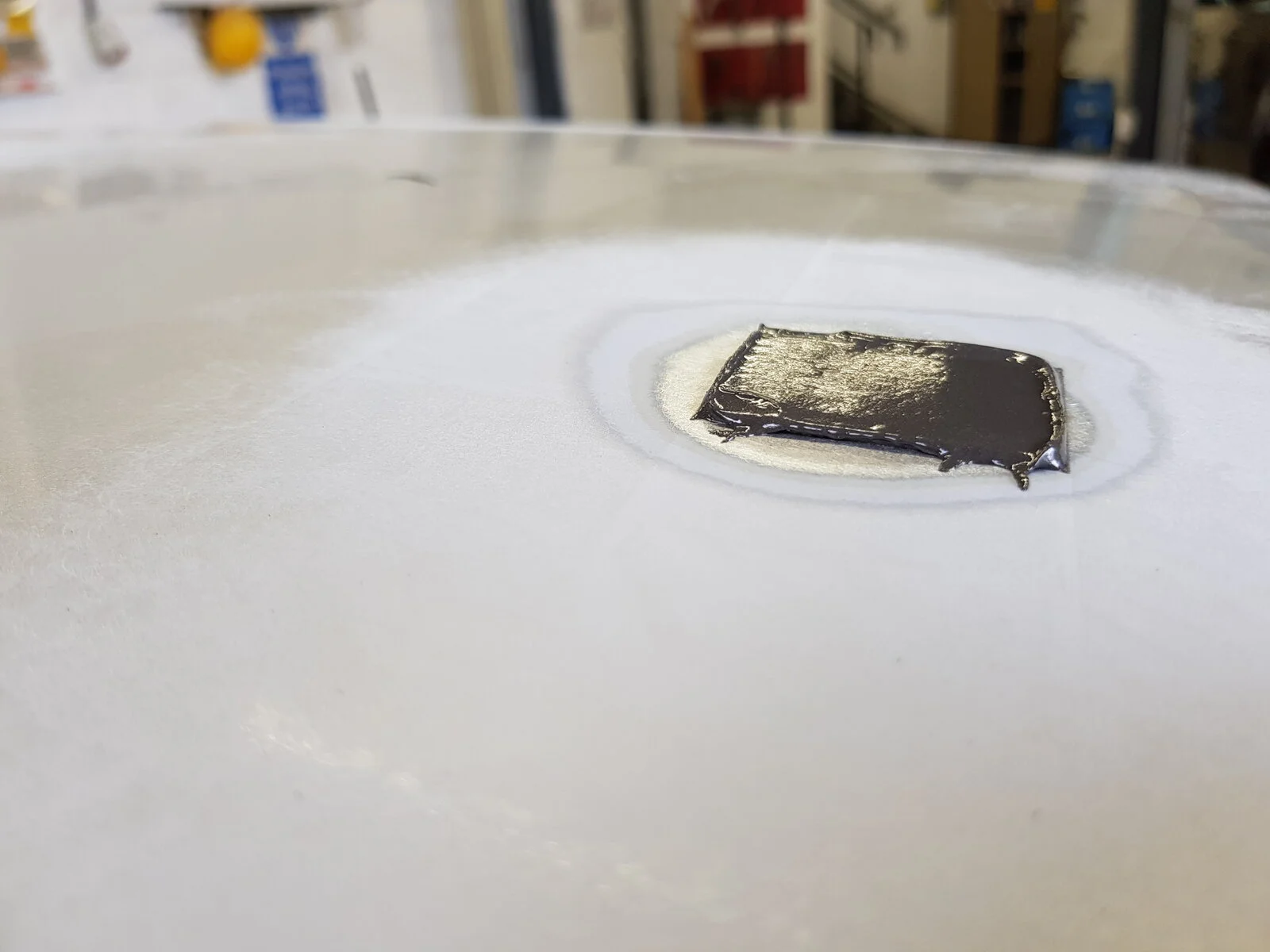

So the panel bond has dried and now I have to dig out any bonding that is on the top side back to clean metal and now apply metal filler. This is why I tapered the hole to start with so the metal filler isnt just sat in the hole it also becomes part of the roof skin to stop a fault line showing when it gets hot in the sun.
Same again I used the heat lamp to cure it then used a d.a. sander with 80grit to make it flush with roof skin then body filler to finish.

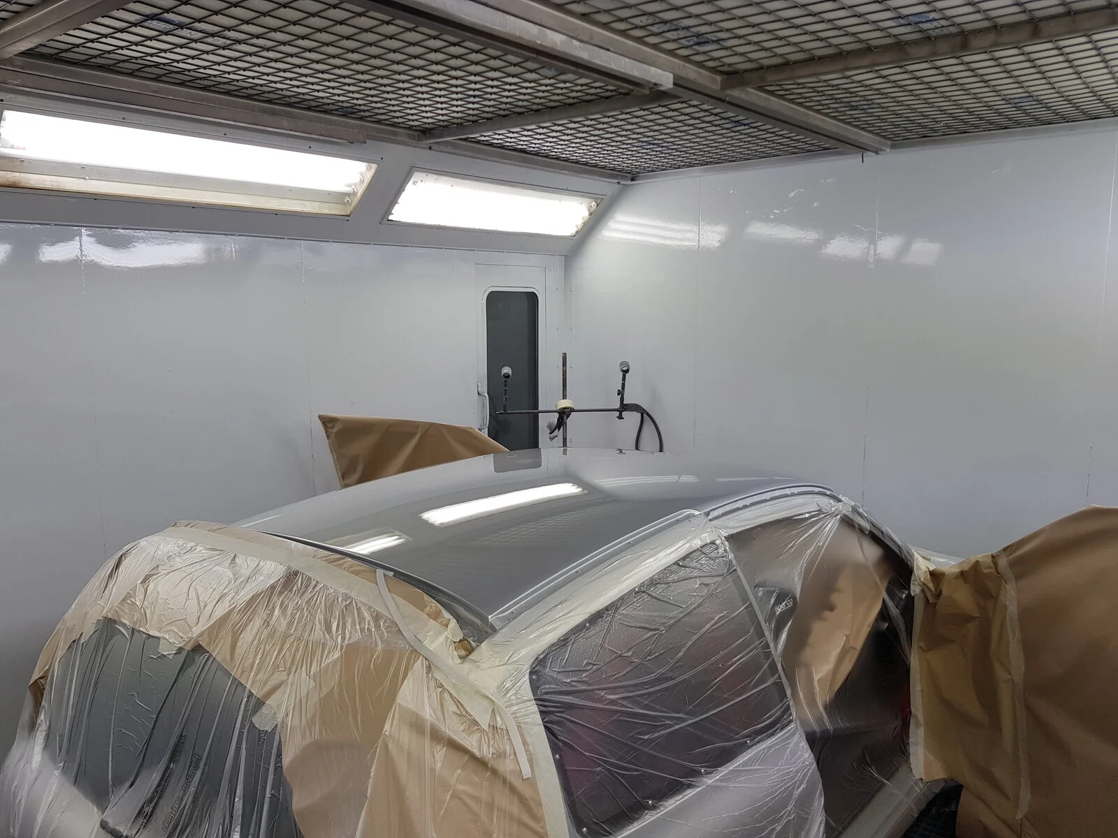

So next was primer, I prepared the full roof skin and masked it up ready to go.

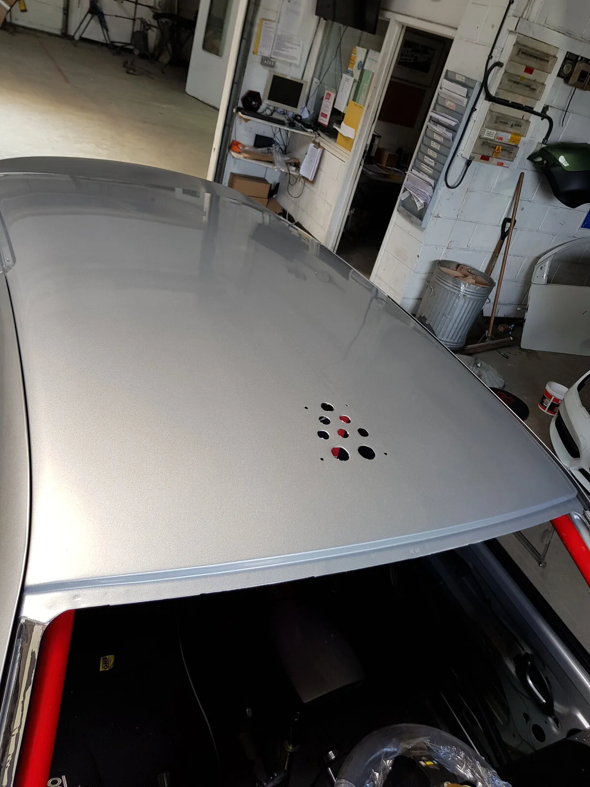

Then I flatted the primer, removed the tailgate hinge bolts to pull the tailgate away from the roof so I dont get a masking line it also saved removing all the wires and then masked up to paint.
Came out nice.
Slightly lighter shade but it wont matter it matches the bonnet and bumper and will most likely paint the rest at some point so it will match at some point.

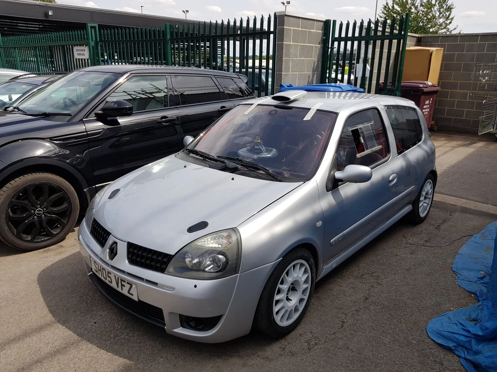

Next was the screen with a new rubber set.
Which basically brings me back to square one apart from the bonnet which I cant be bothered to do at the minute, but I did fit new catches which literally I check everytime I walk past it !!

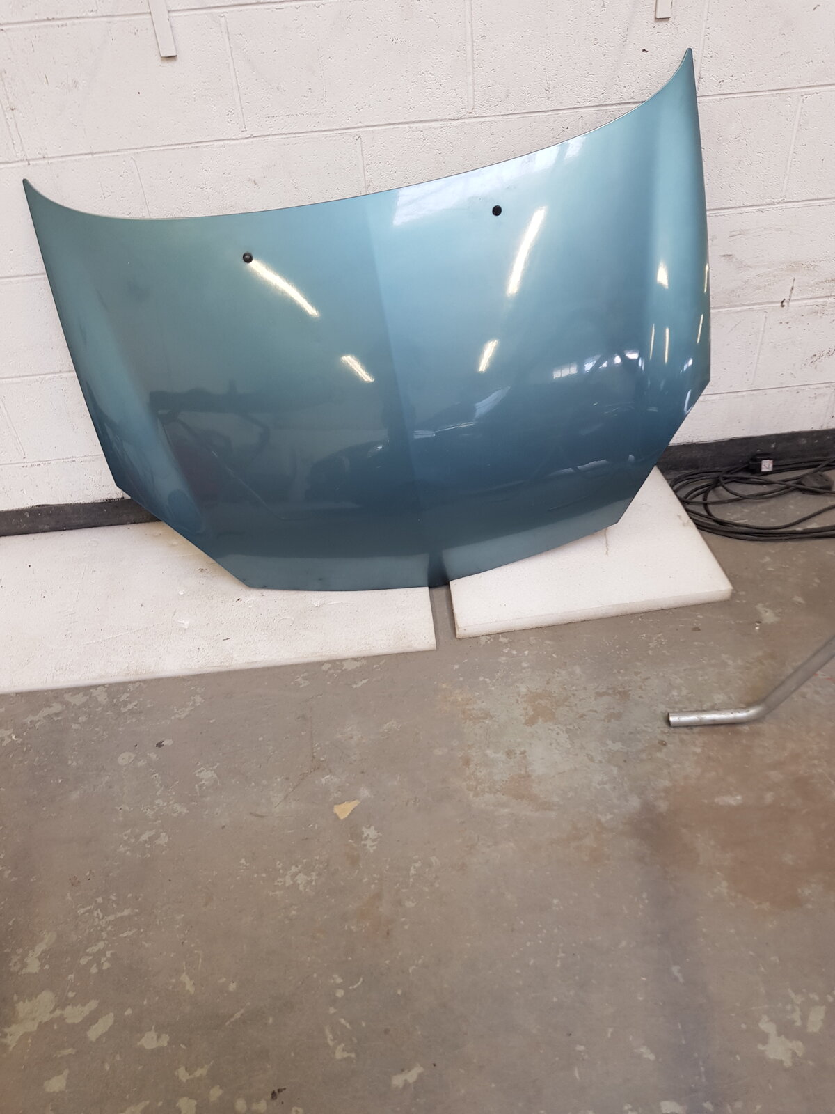

At some point I do have another bonnet and a set of bonnet vents to fit, but that's not really at the top of my list. Body work always comes after mechanical soundness.

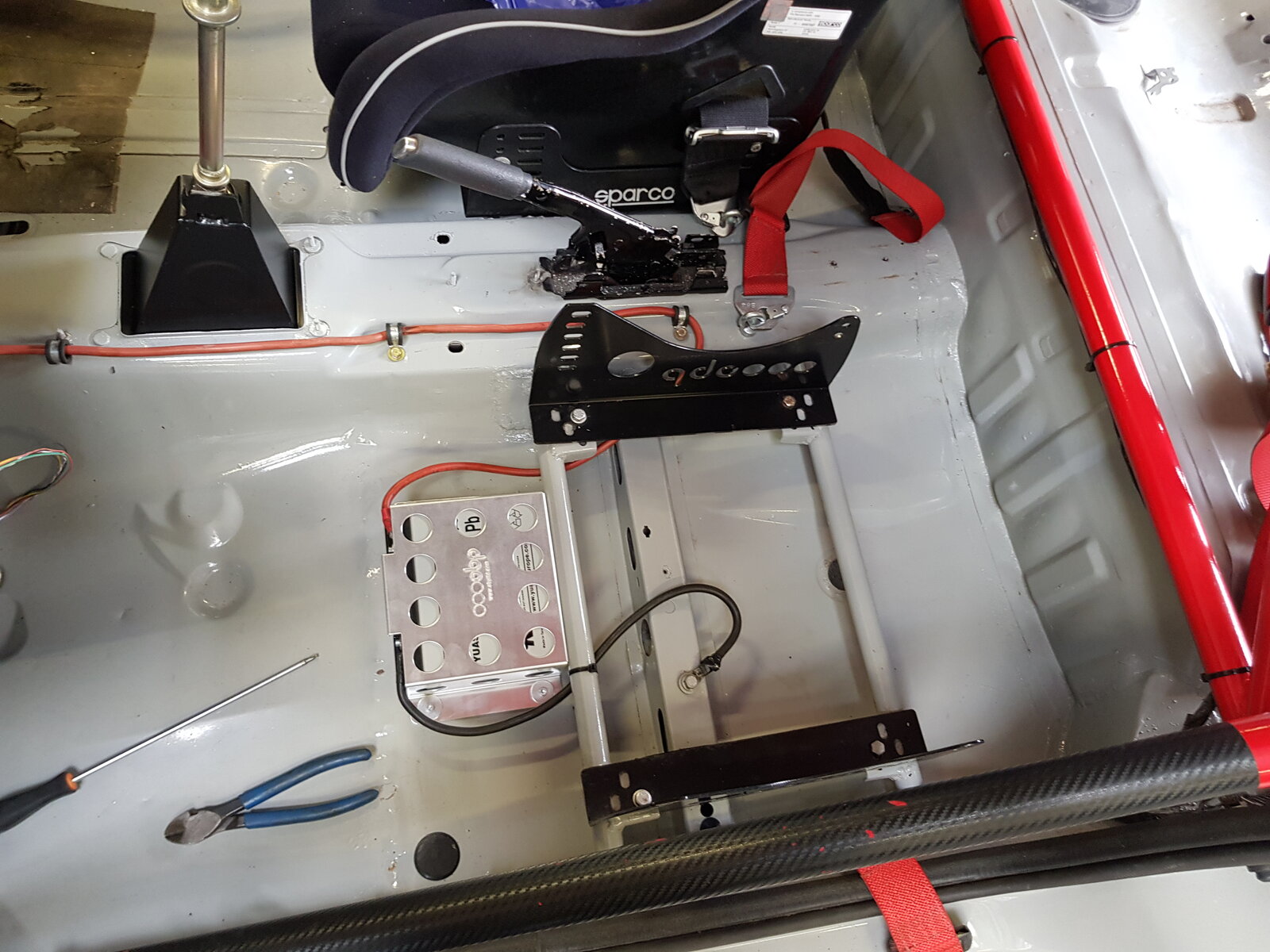

So whilst it was sat at work and all of my tools within reaching distance I figured I should sort some bits inside that were bugging me. Starting with the dogsh1t battery setup. I hated it!

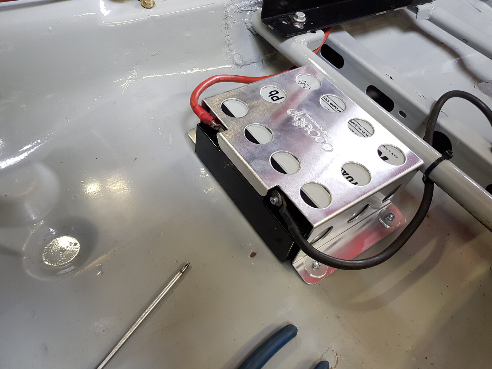

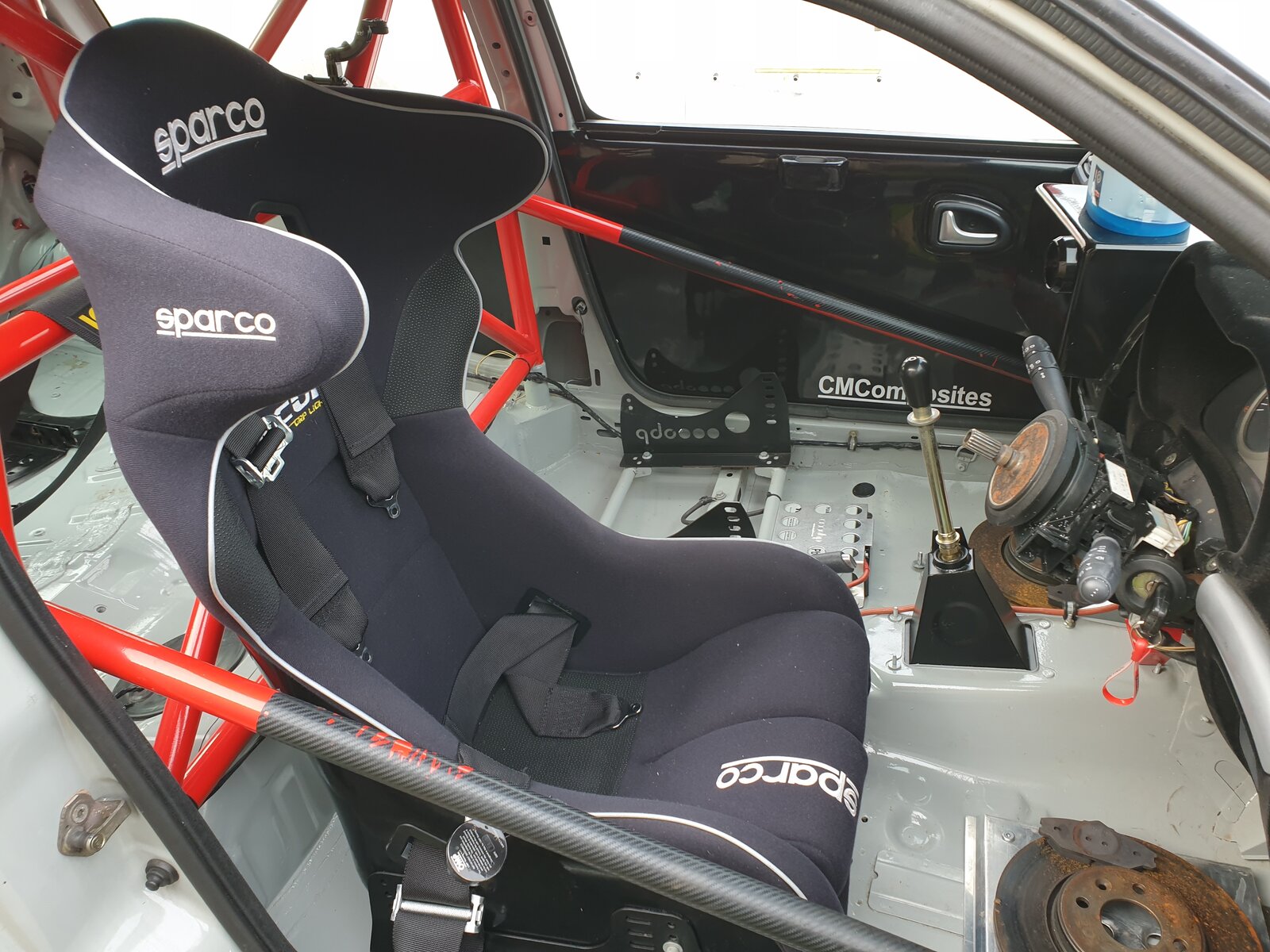

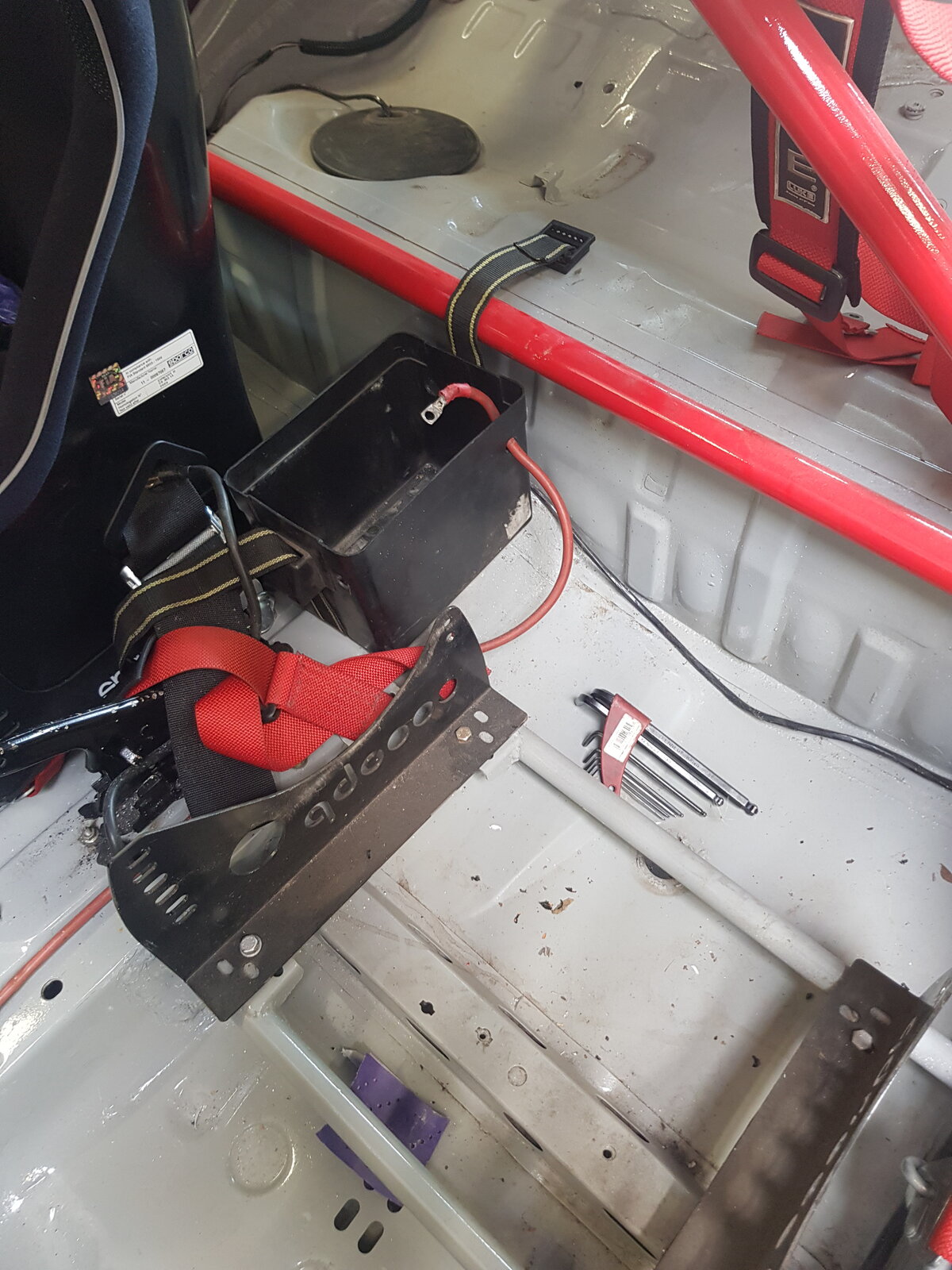

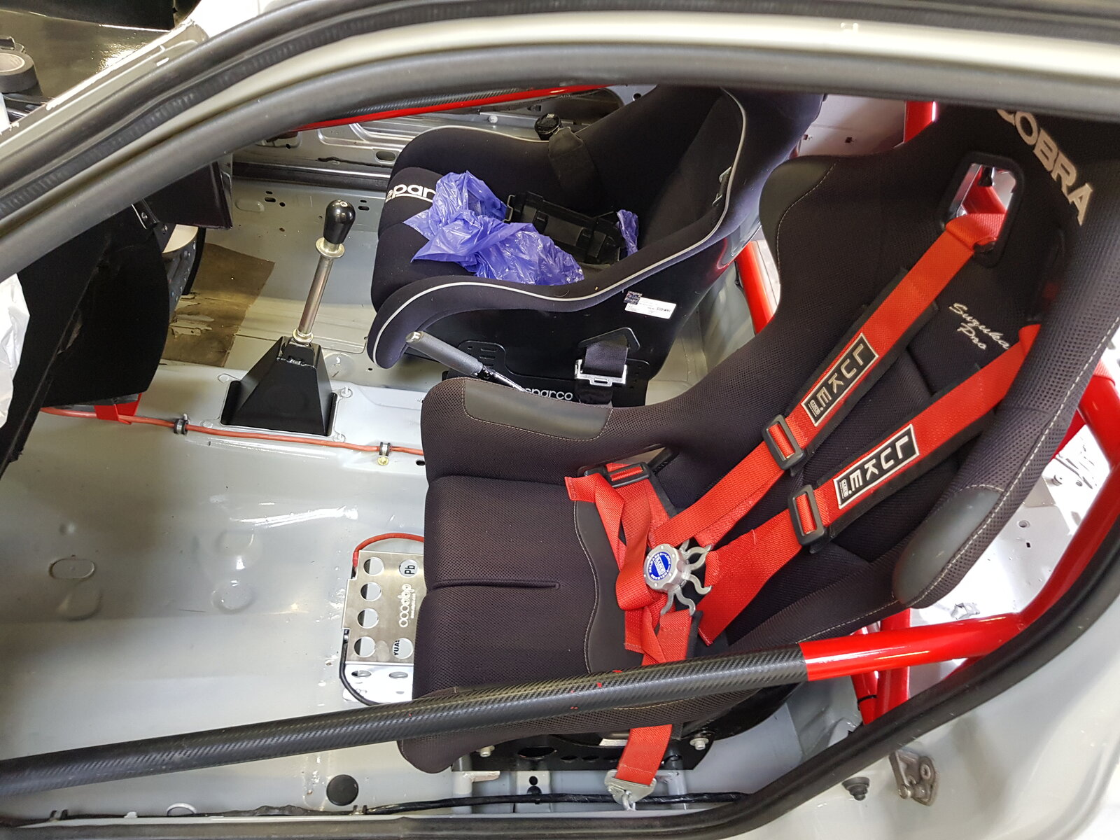

So I gave the floor a good lean up and fitted the OBP cage that I had bought which was 100% better!
I was waiting for the propper terminal attachment so had to use some panel bond EMC screws until the turned up.
Then I vacuumed and blew the passenger seat off to get and dust and dirt off it and put it back in, loads better.

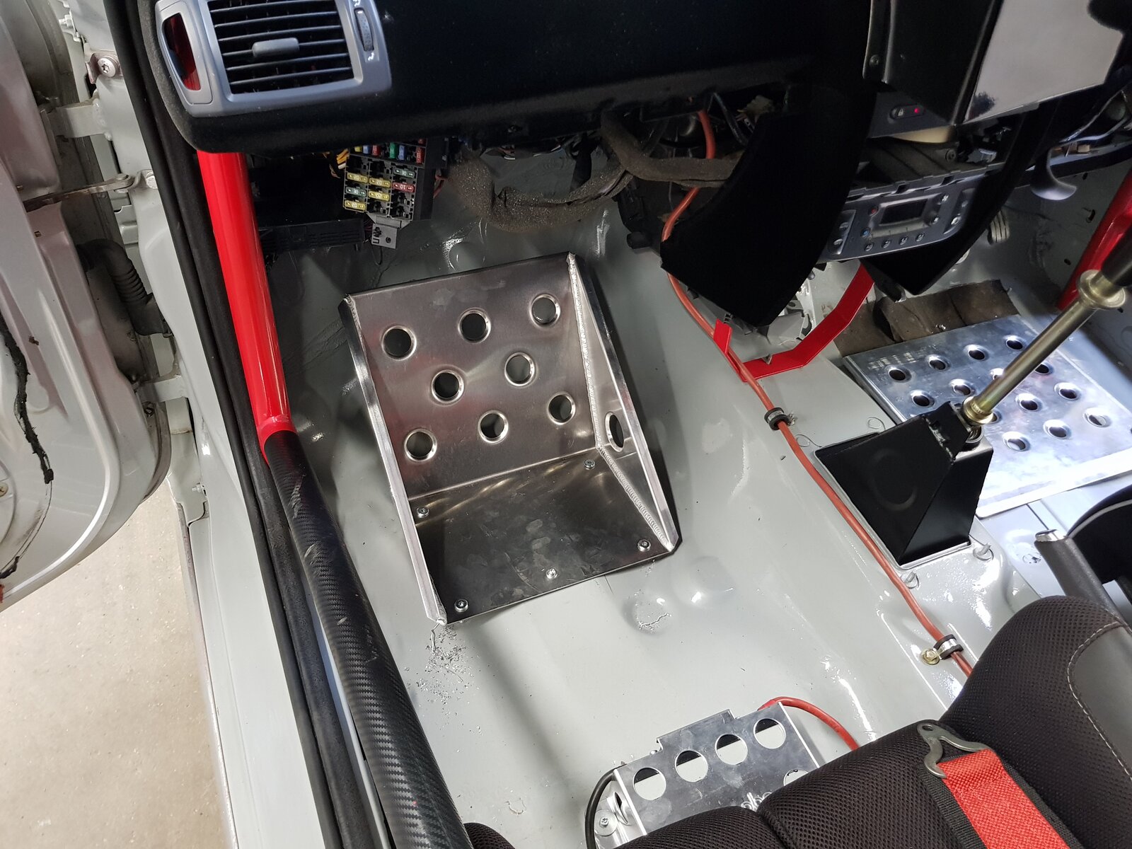

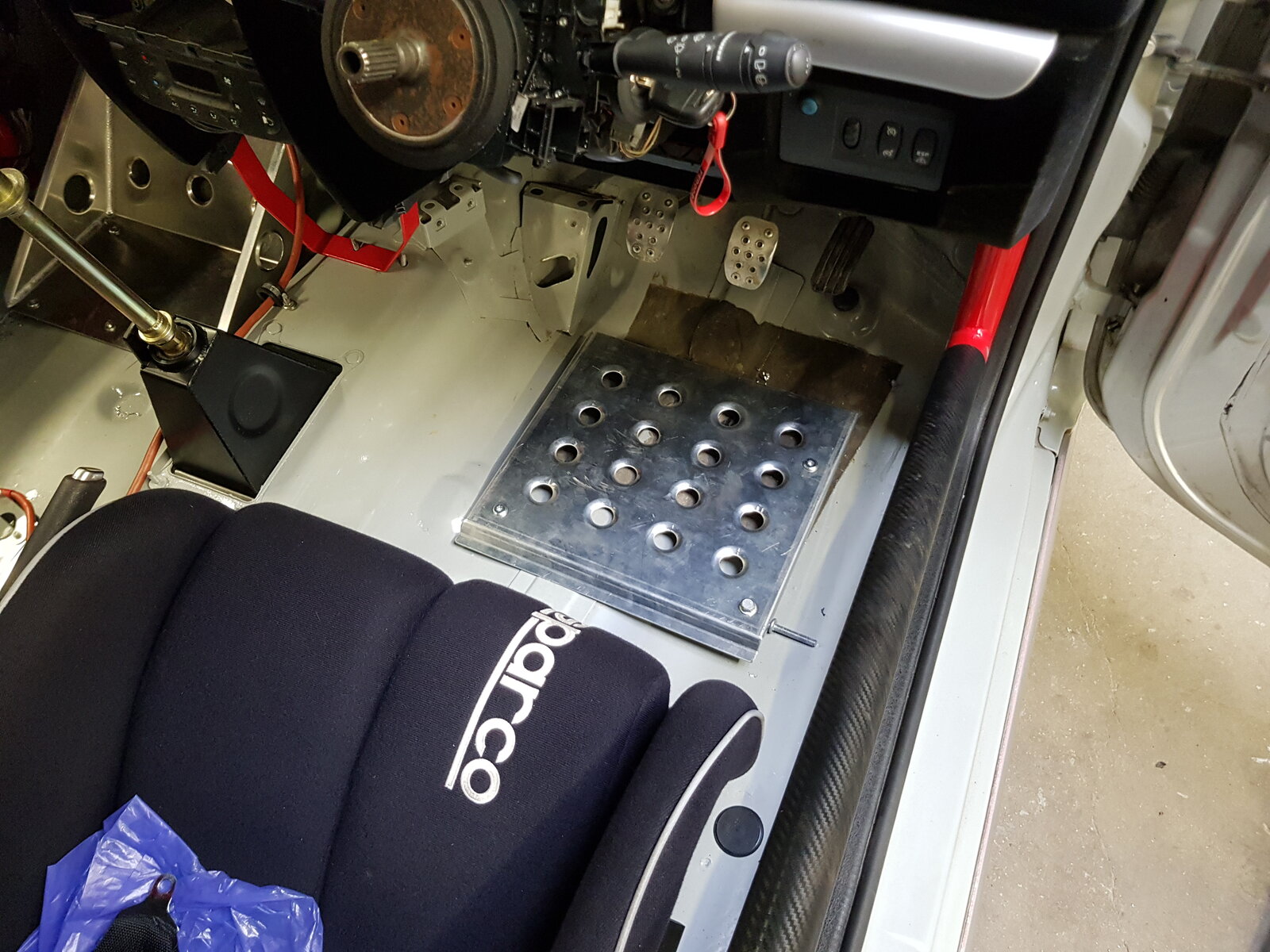

Next was the drivers and passenger footrests.
Which I would encourage anyone to do as it's so much more comfortable than your heels arguing with the strengthening brace on the stripped out floor.
N.B. dont ever take that strengthening brace out, it's there for a reason. Stops your ankles being trapped/smashed to bits in a head on collision
I should have taken that grip tape off before fitting the drivers side really

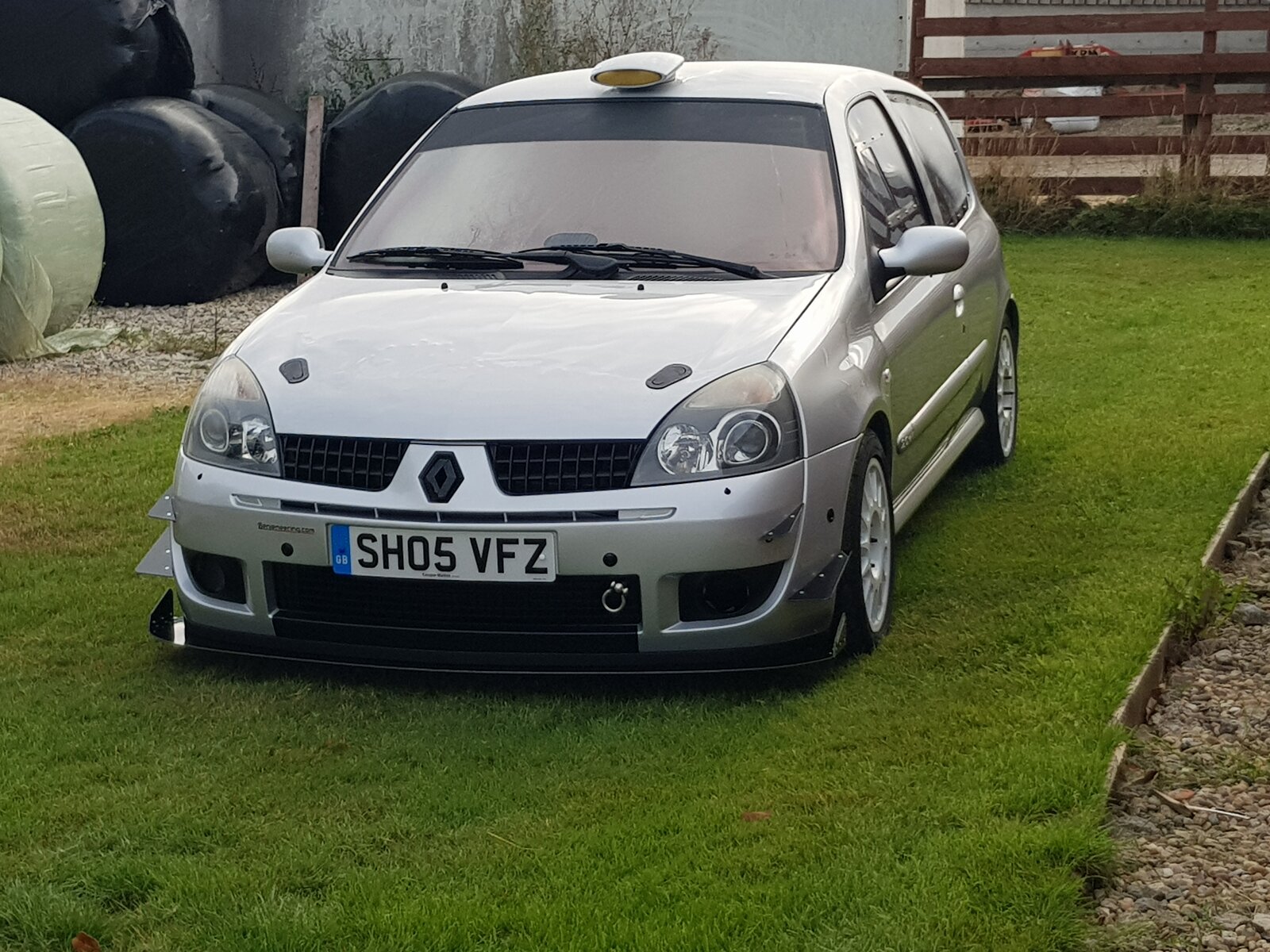

1985michael182

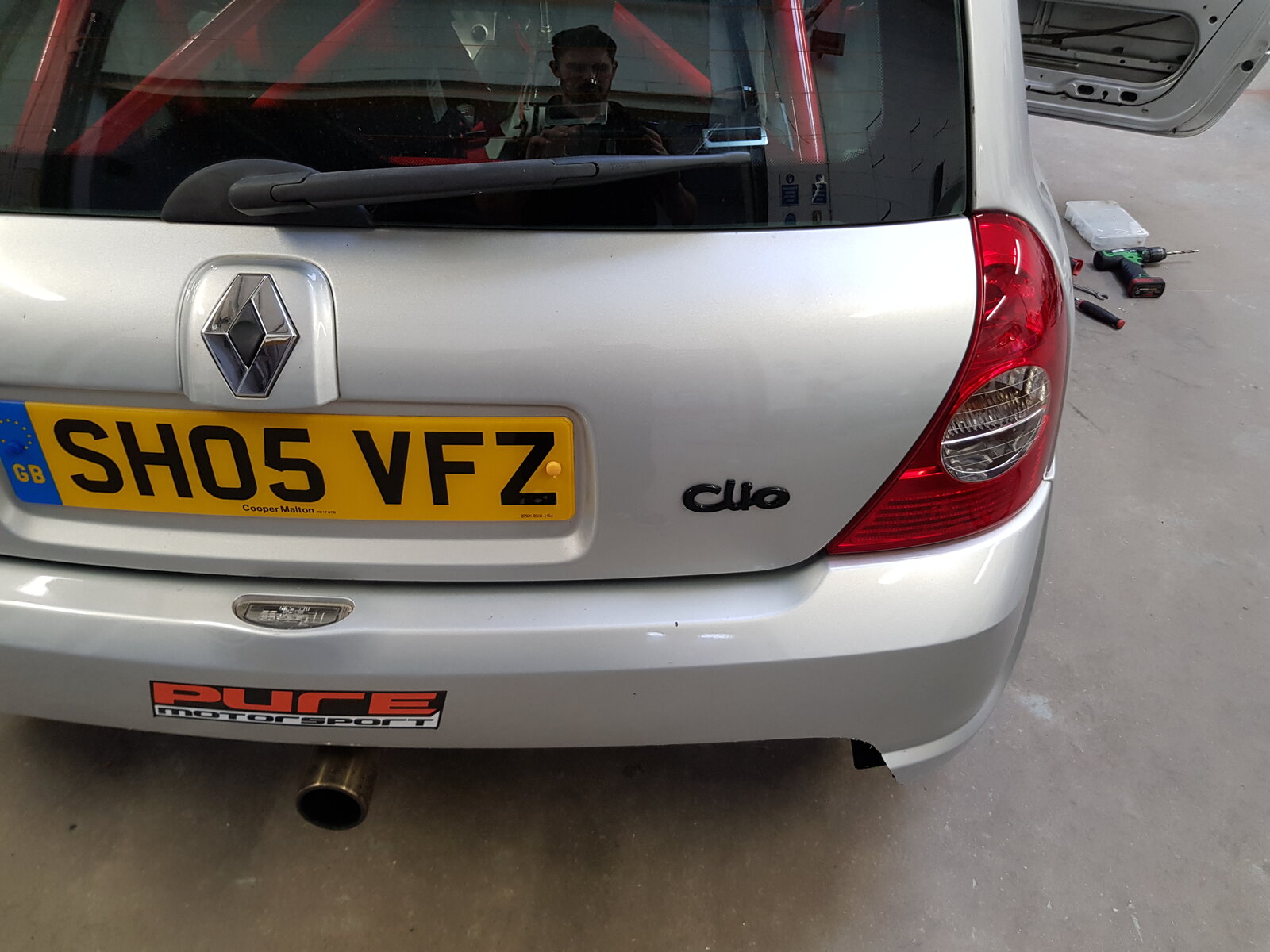

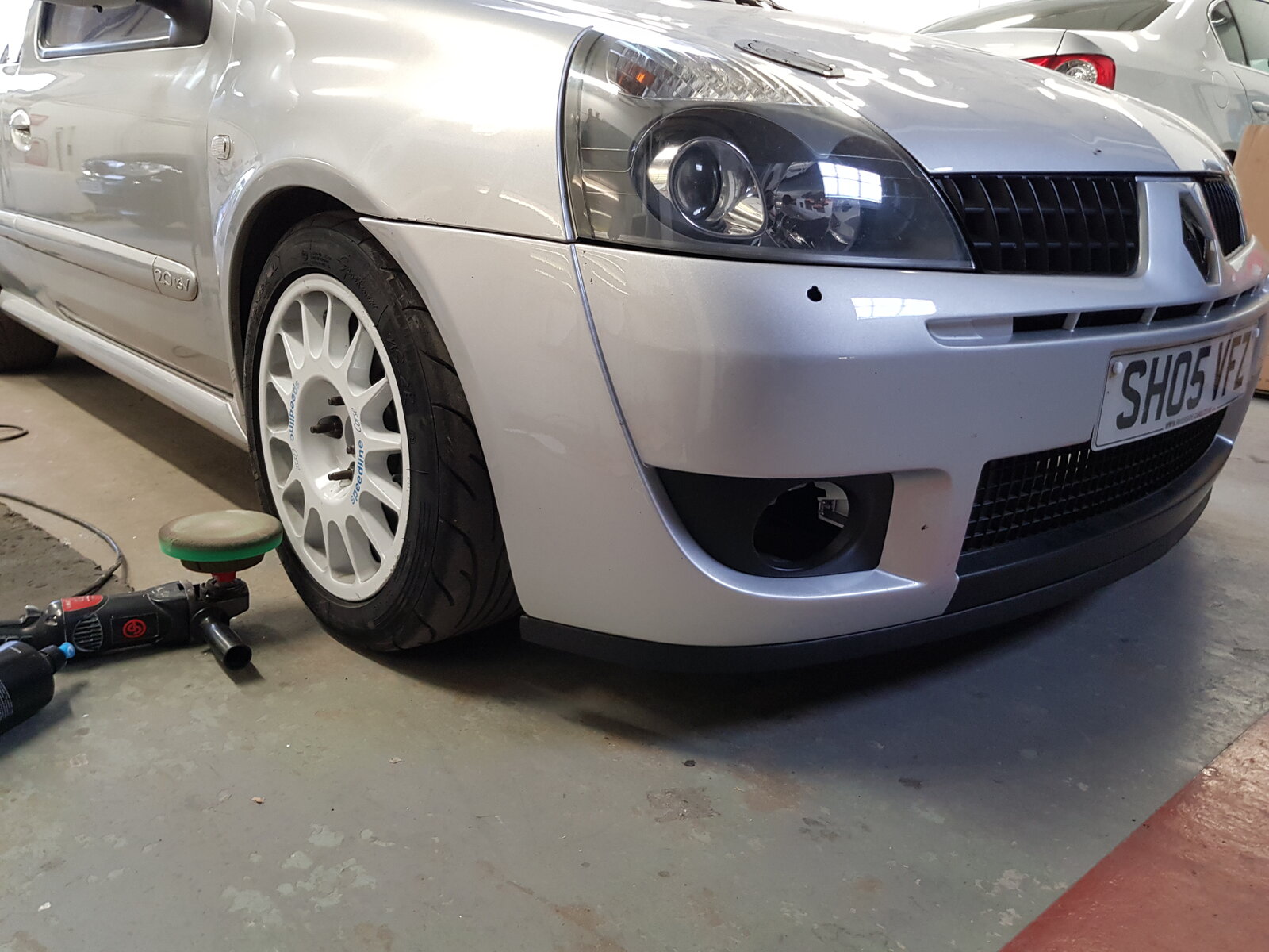

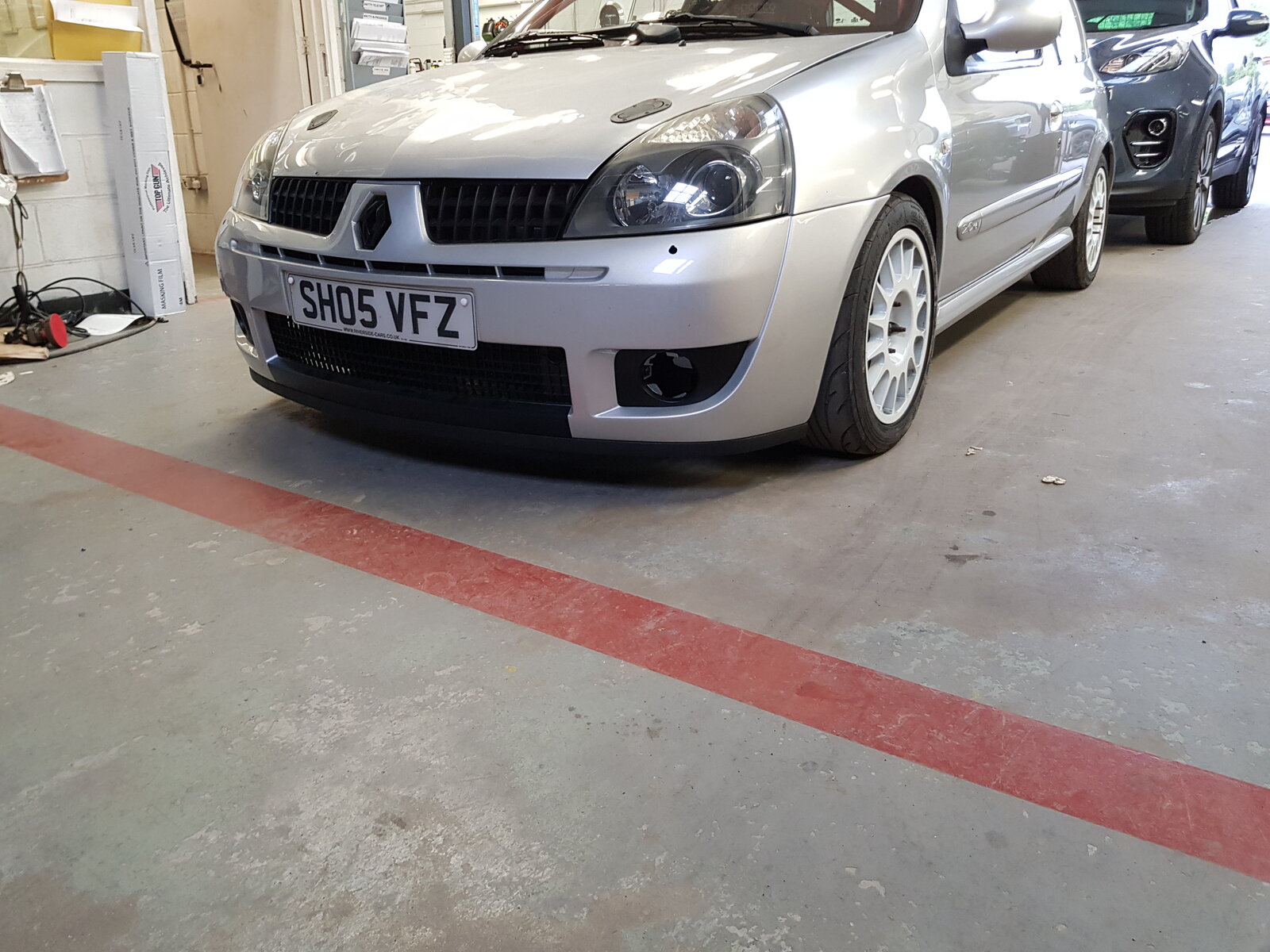

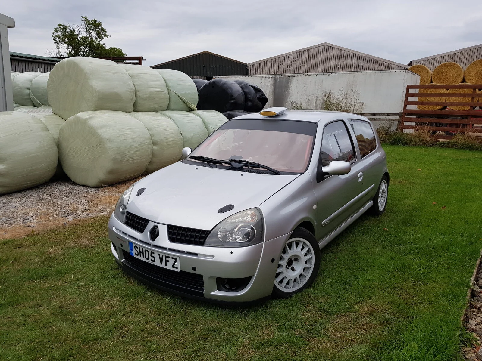

Last things to do before it can go home is to fit the ebay special genuine skoda fabia front splitter, which I've got to be honest looks basically the same as the cup ones do at a fraction of the price and it wont crack or smash into a million pieces if gets hit by even a fly!!
Then I machine polished the full car to within an inch of its life! Every panel, all the lights, I even did the windows!
I also refitted the fresh gloss blacked clio badge and it was ready for home.

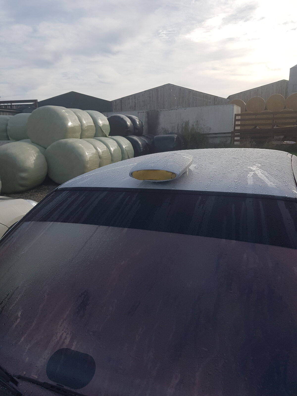

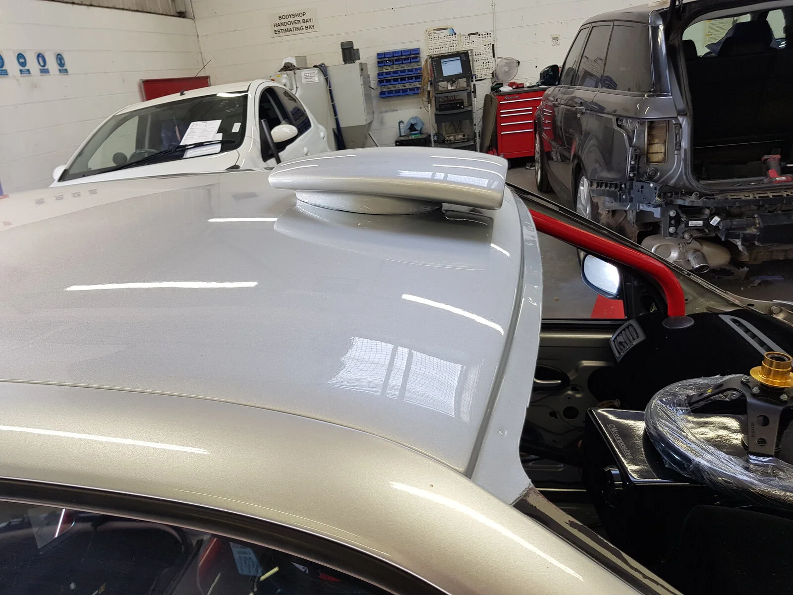

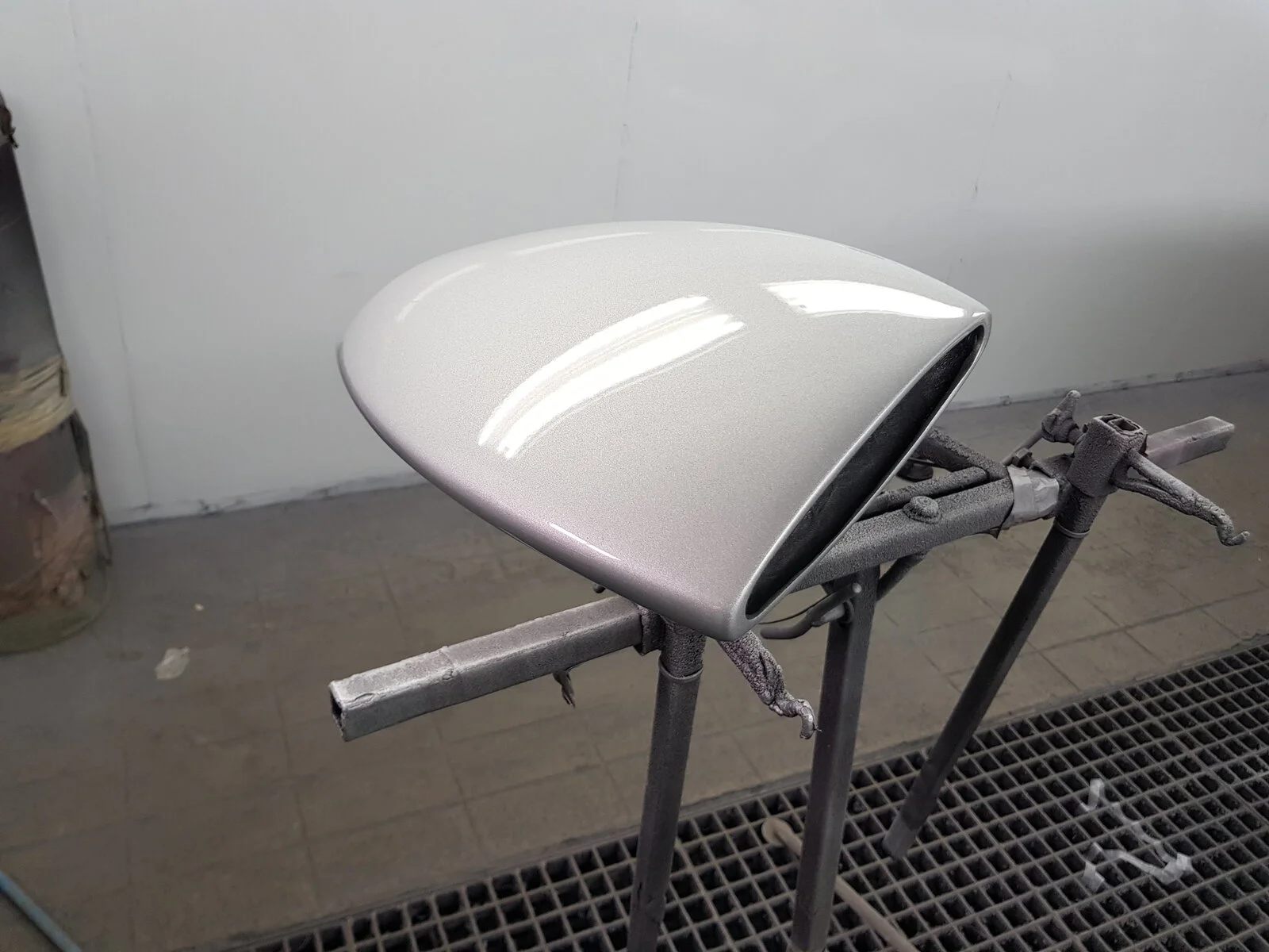

One little problem I came across was the roof scoop leaking water in through the huge hole! So I over came this by putting sponges into the openings as we all know a compressed sponge will not soak up water, which did the trick.

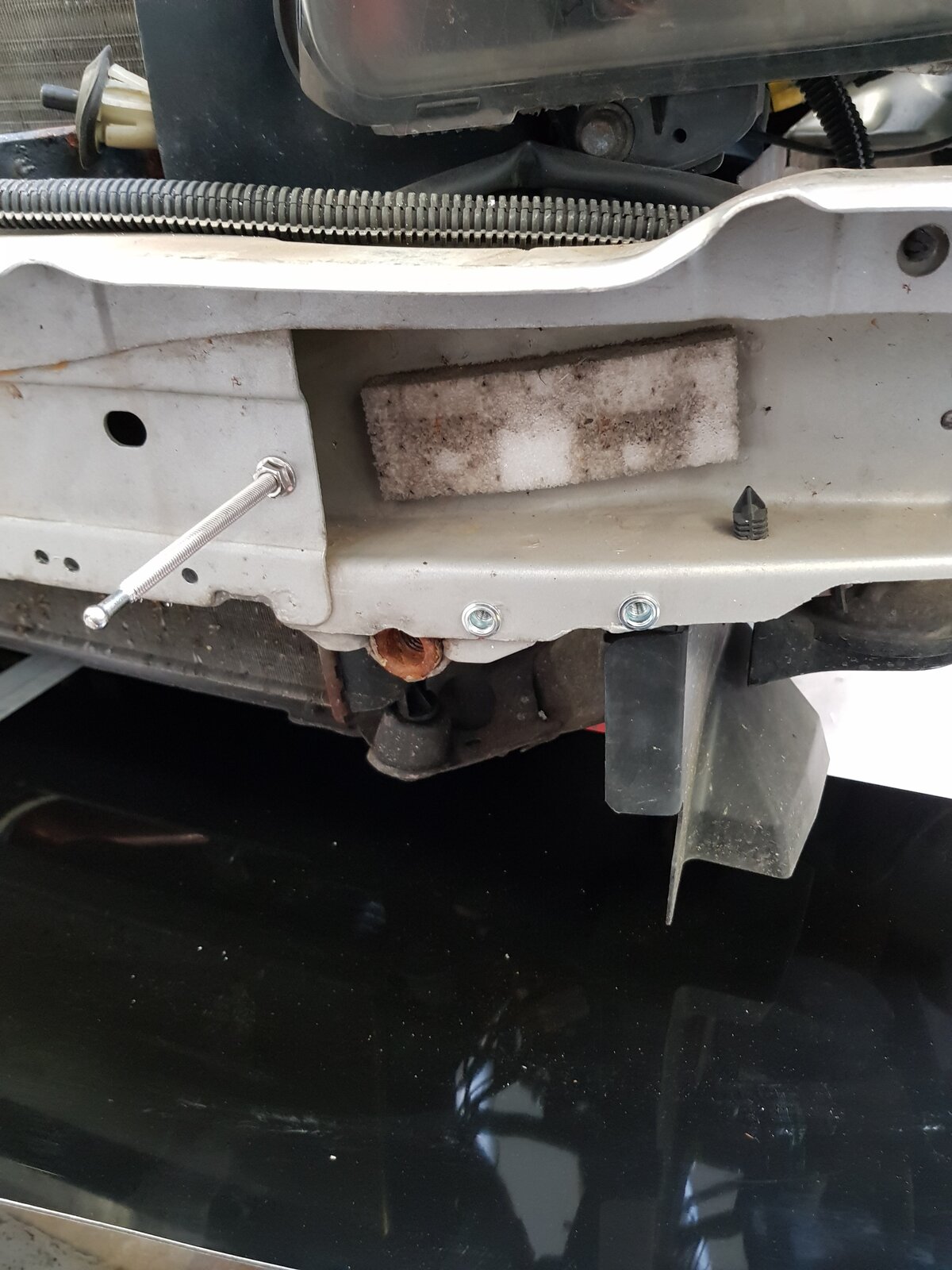

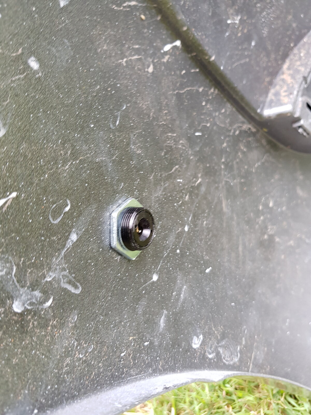

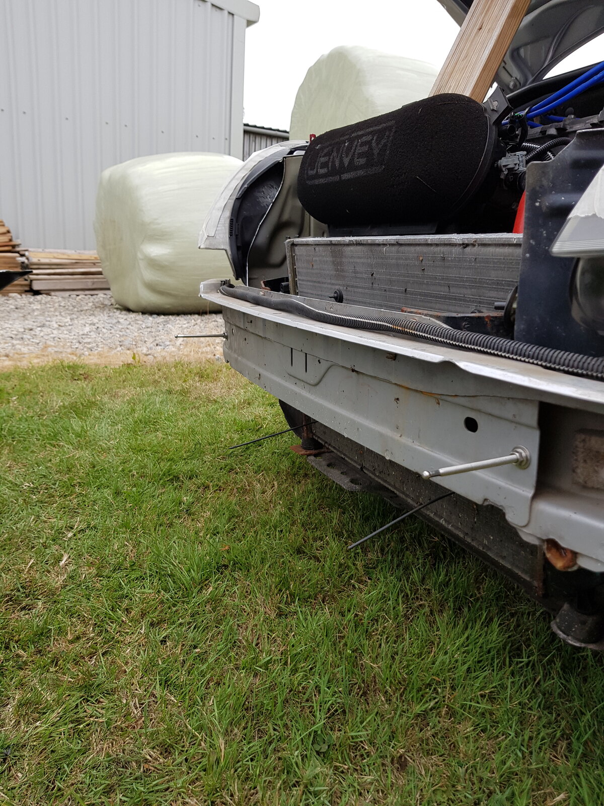

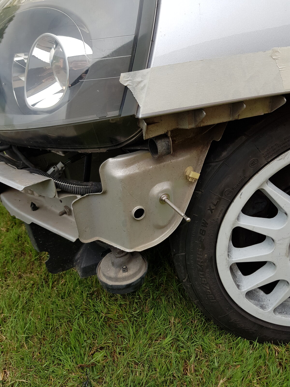

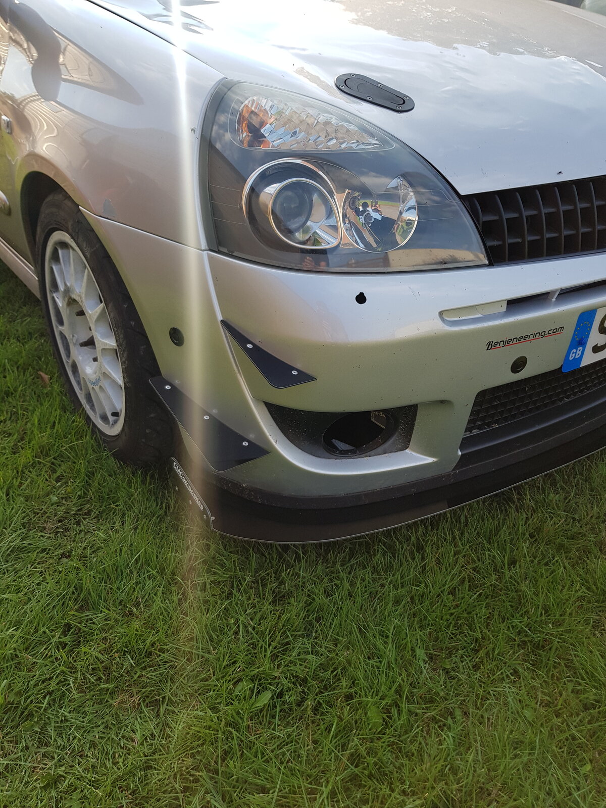

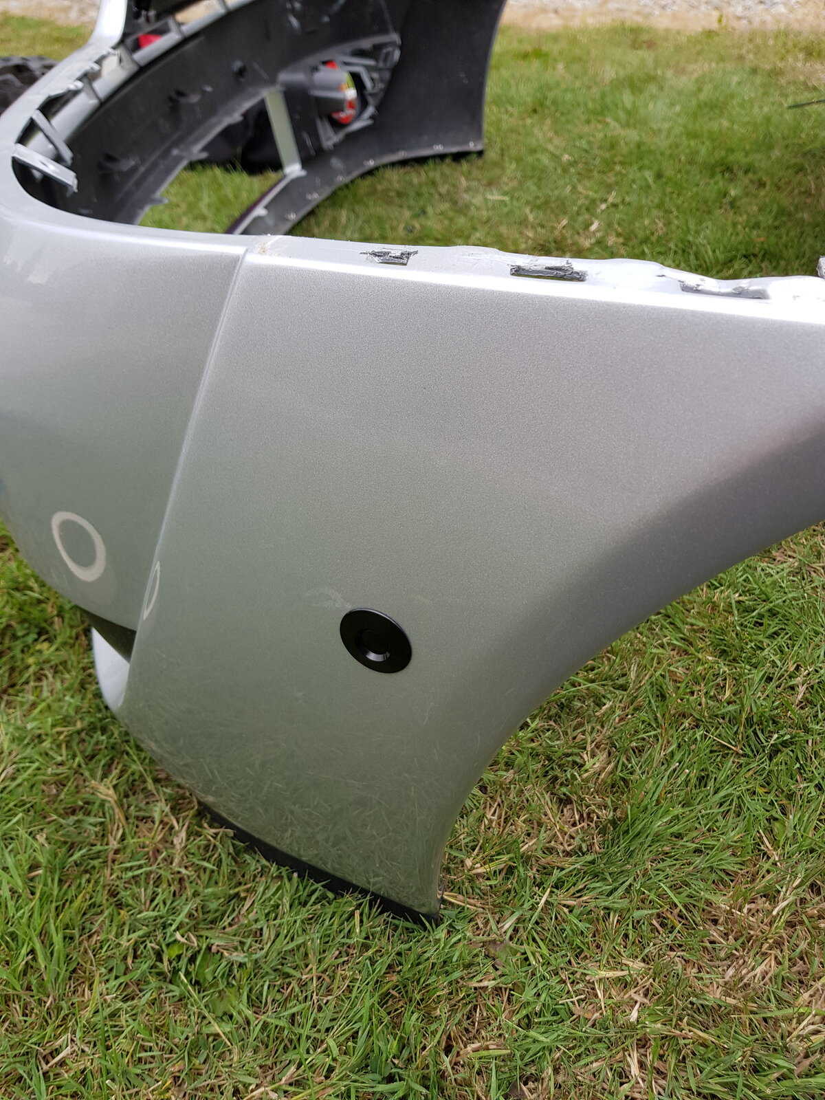

After waiting 2 weeks for the push button quick release mounting form Benjeneering.com to turn up they had finally arrived at work and promptly fitted them that night.
Pretty self explanatory to fit, just took a while to figure out where they would be best mounted.
Once I worked it out I adjusted them so I could fit the bumper without them trying to push the bumper back off.
I then refit the bumper and pressed hard on to the mounts so they made an indentation on the inside of the bumper which I could use to drill the holes
They look a little like PDC sensors 🤣 but they are there to do a job
But.....

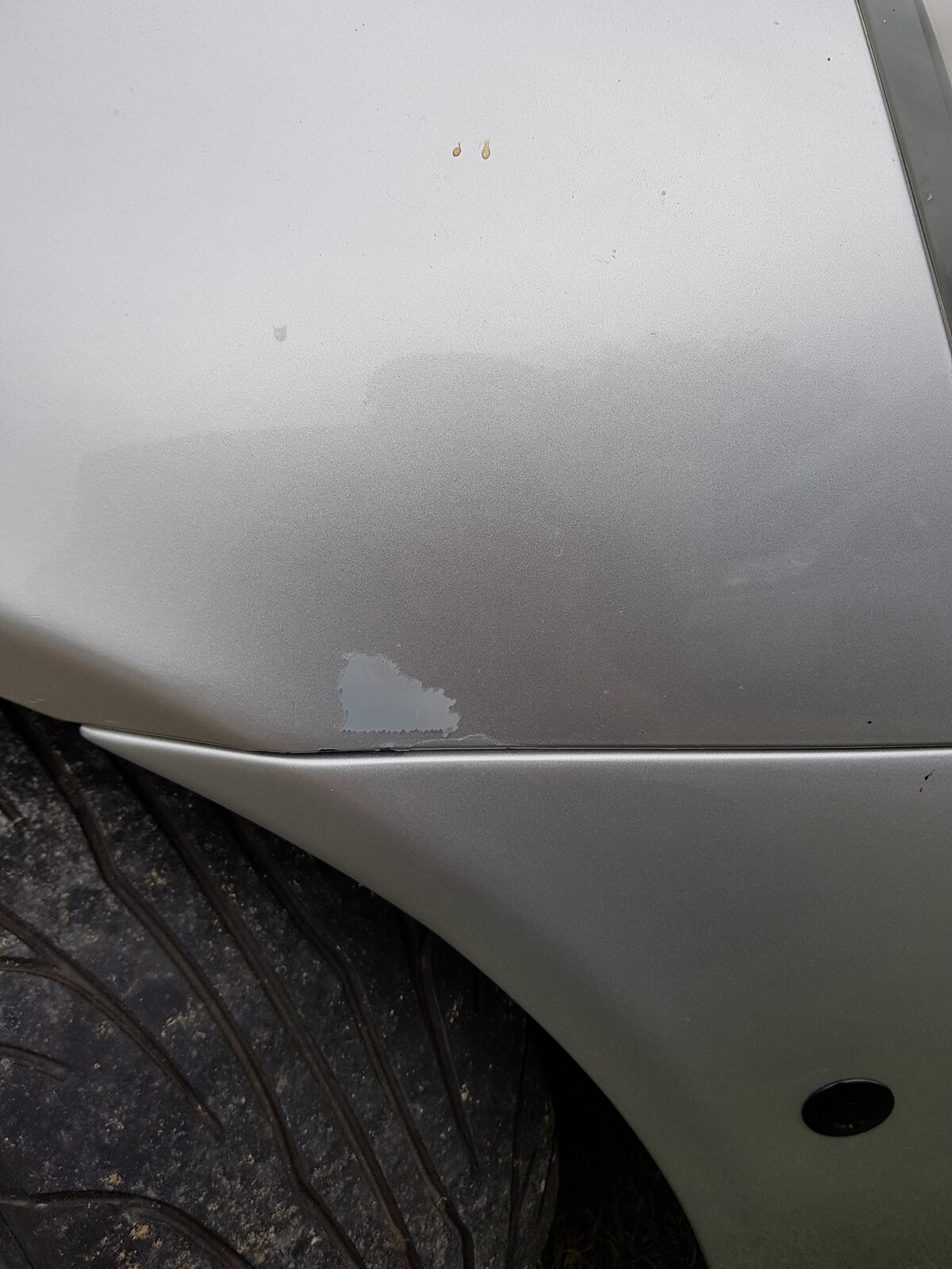

Yet another set back, I masked the wing edges up so I didnt damage the paint taking the bumper on and off and quickly wish I hadn't bothered!! Pulled the tape off and a big chunk of paint came off with it from a poor previous repair 🙈 FML
If I didnt have bad luck I'd have no luck!!

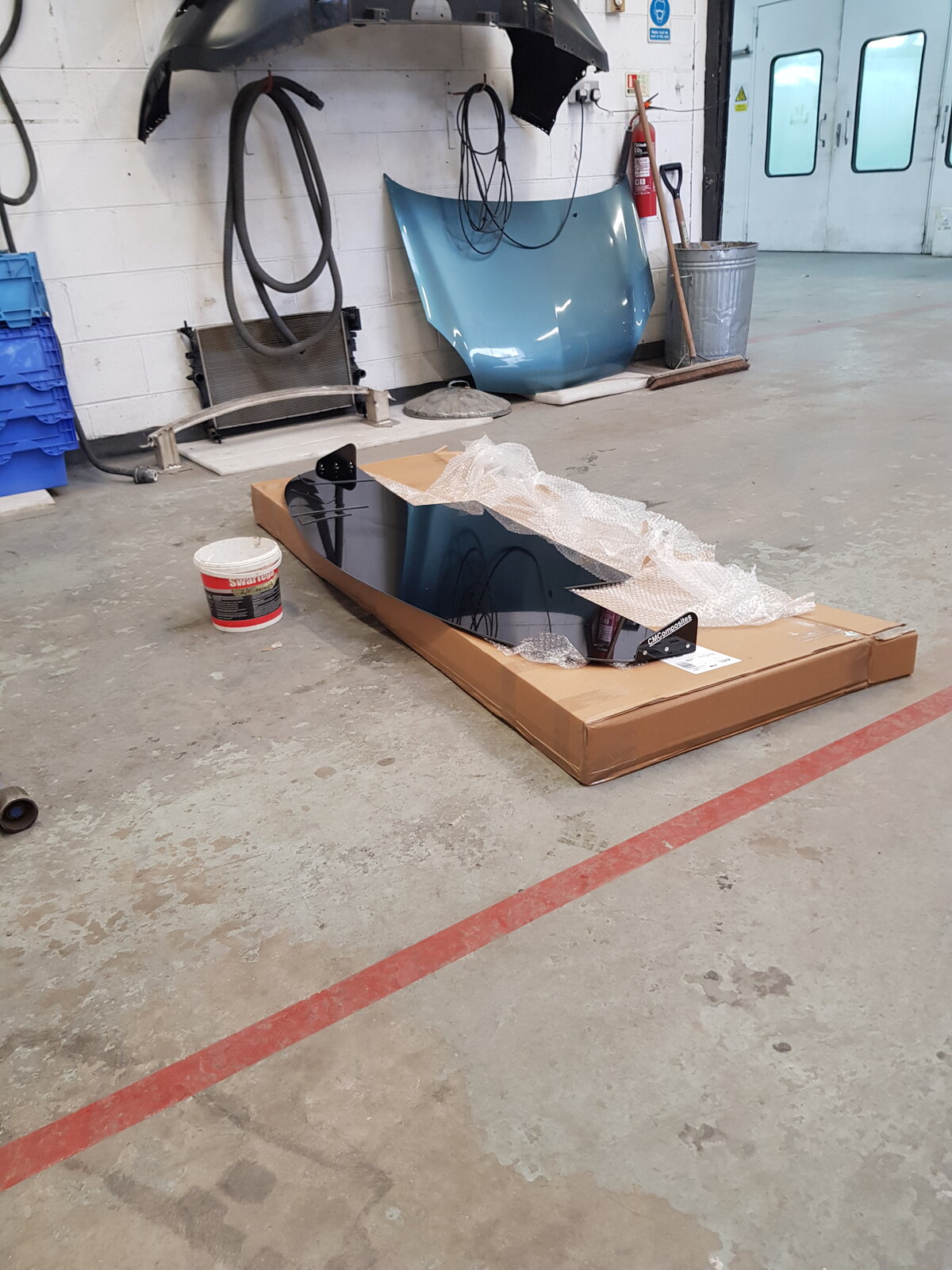

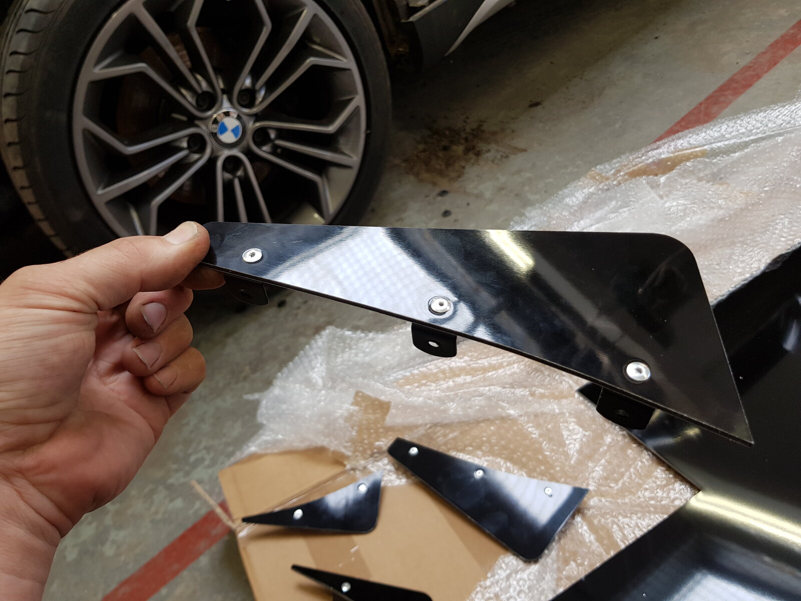

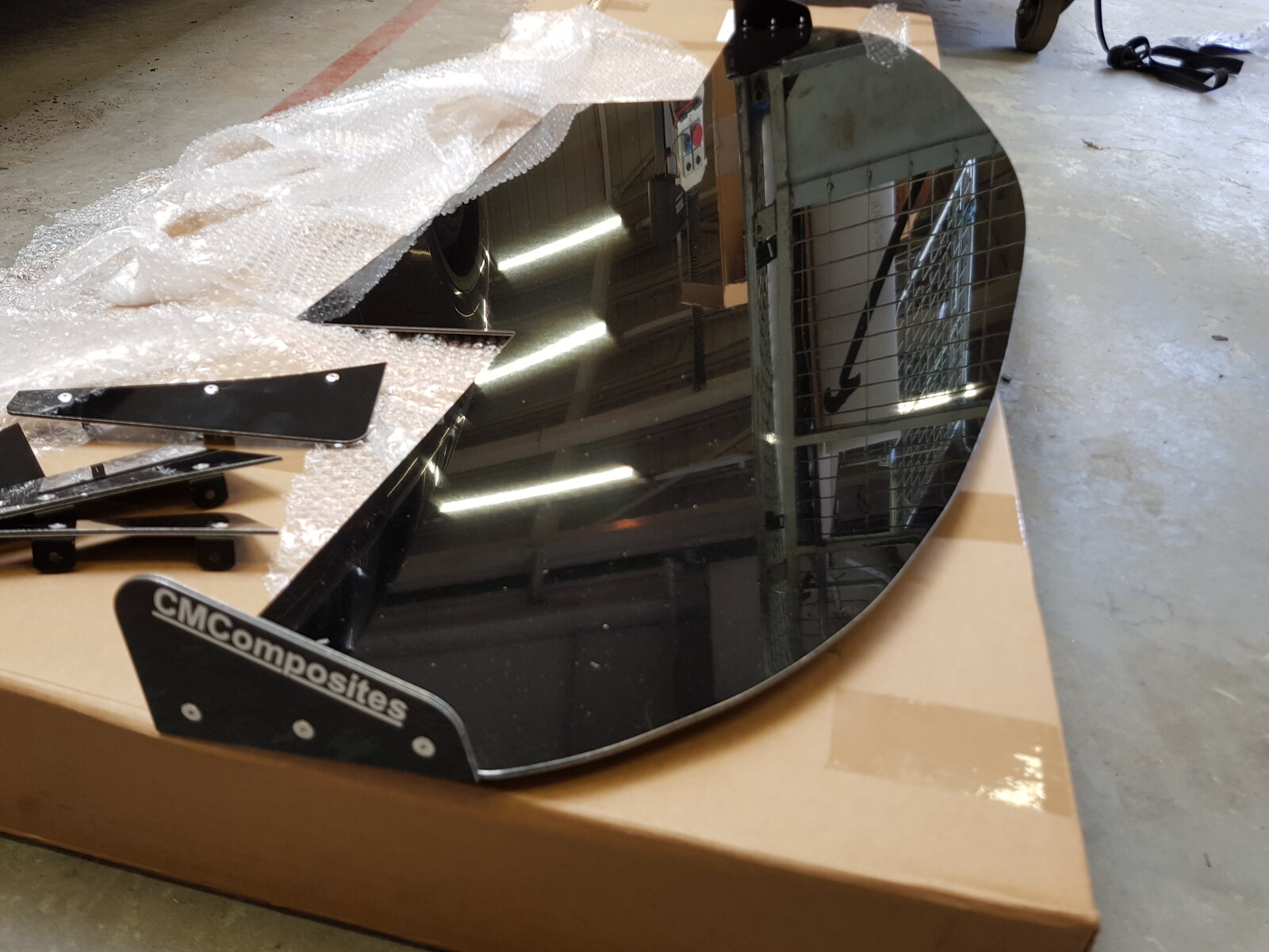

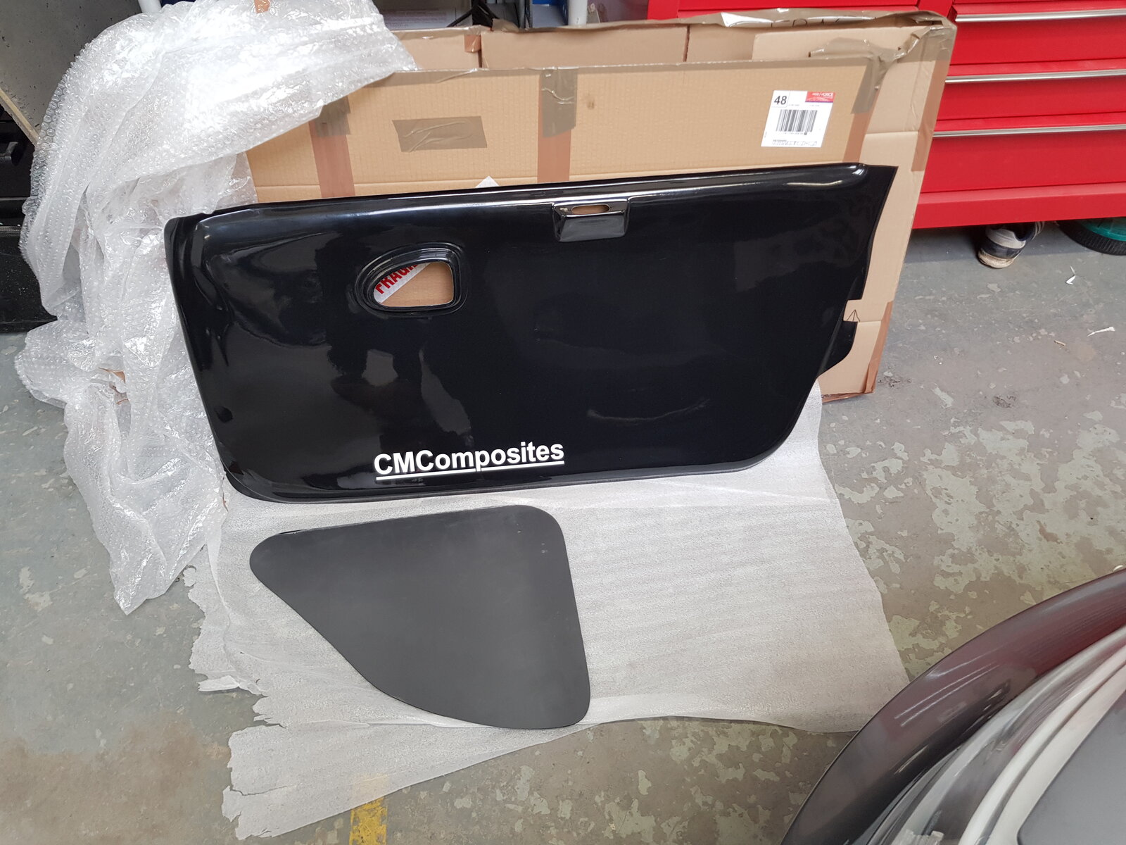

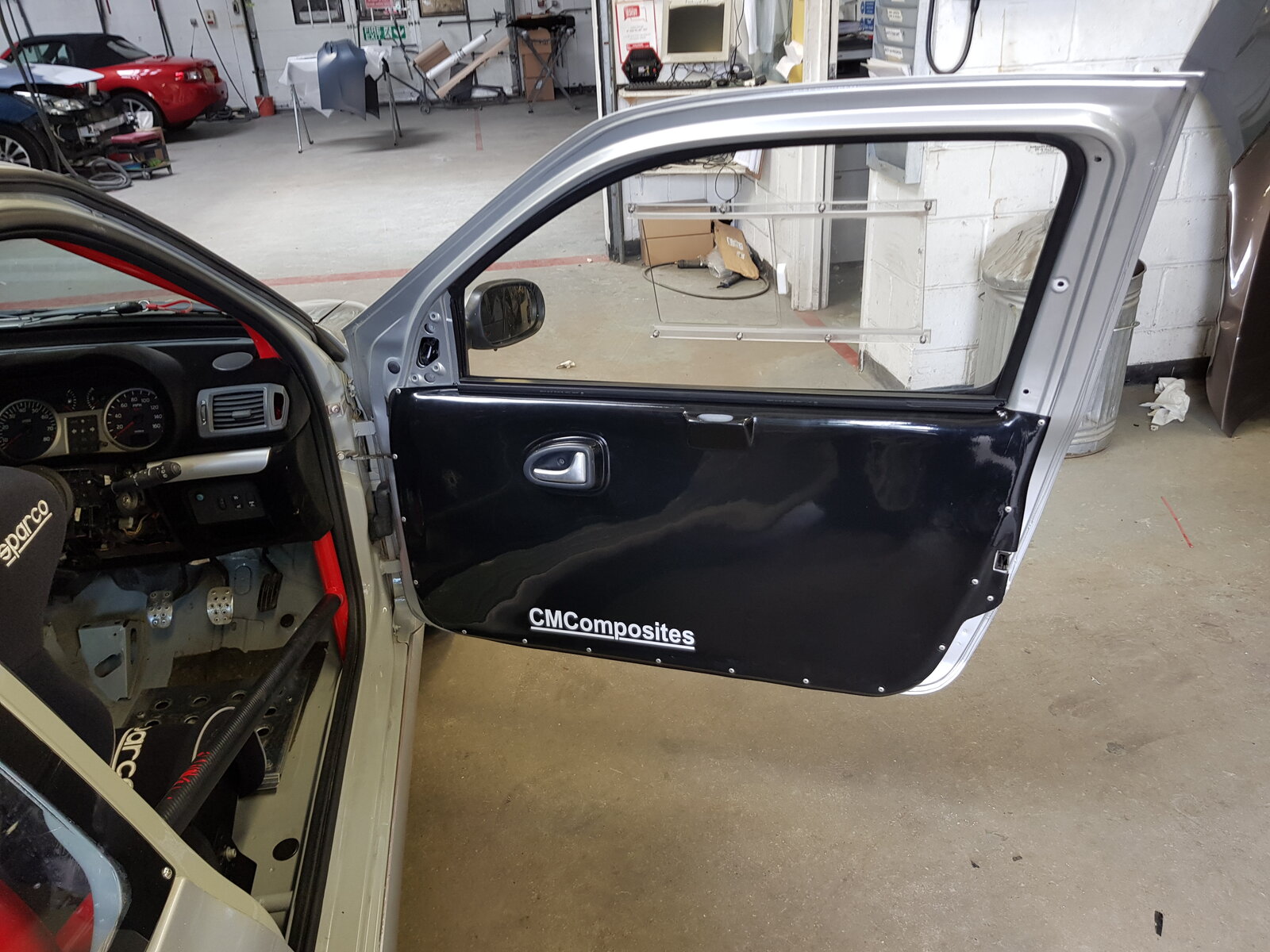

Some large boxes turned up at work in reception and I was told to move them immediately as they were in the customers eye line. I couldnt remember ordering anything so when I eventually remembered it was a nice little surprise.
CM composites goodies had arrived !
Door cards are super light, nothing to them but the splitter was heavier than I thought it would be. It's like a composite plastic sandwiched between to sheets of ally. It was a lot lighter than the wooden one i had removed when i bought the car but still not what i expected.
So waited until the weekend and went to work on the Saturday morning in the clio and then work on it in the afternoon after I had clocked off

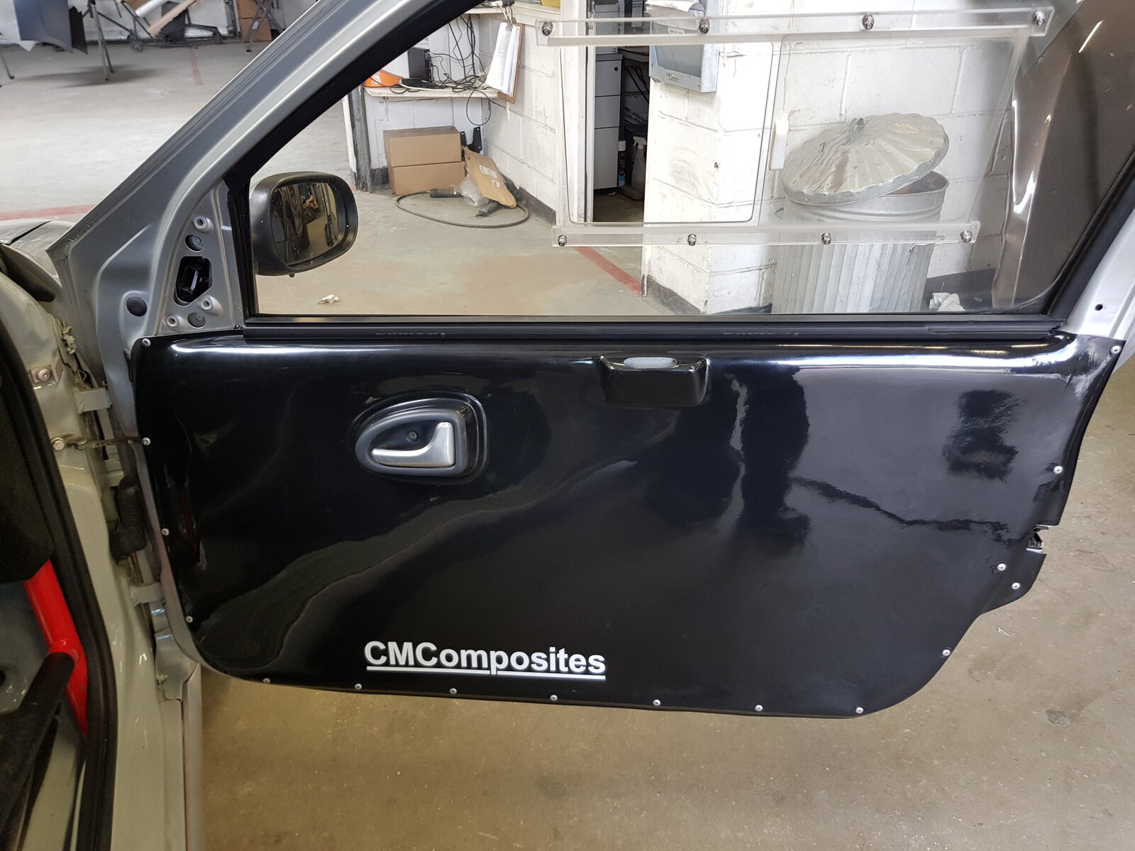

First I did the door cards as the bare doors where really annoying me. I tidied up all the loose wires that were no longer used and tie wrapped them up so they wouldnt rattle inside the doors.
At some point I'm going to get the wiring diagrams and strip any none essential wires from the entire loom, but for now this will do.
Really happy with them and gives it a professional look

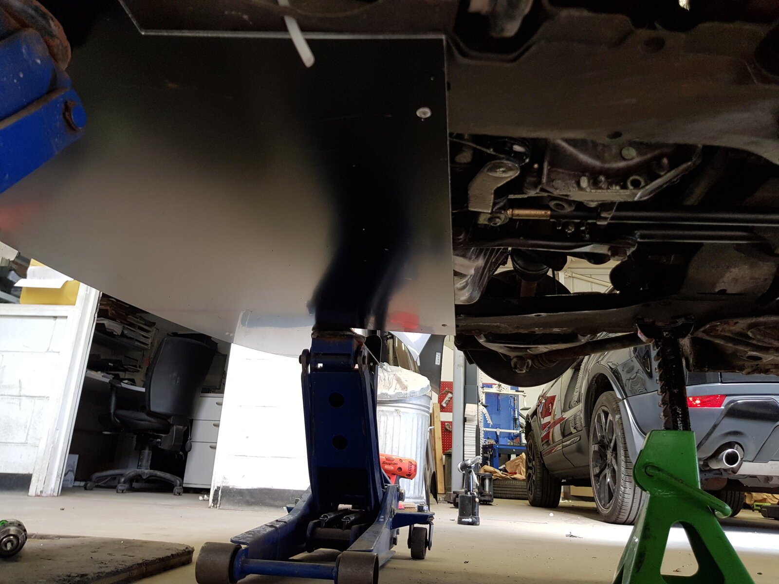

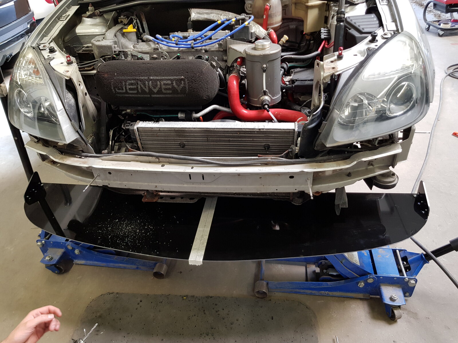

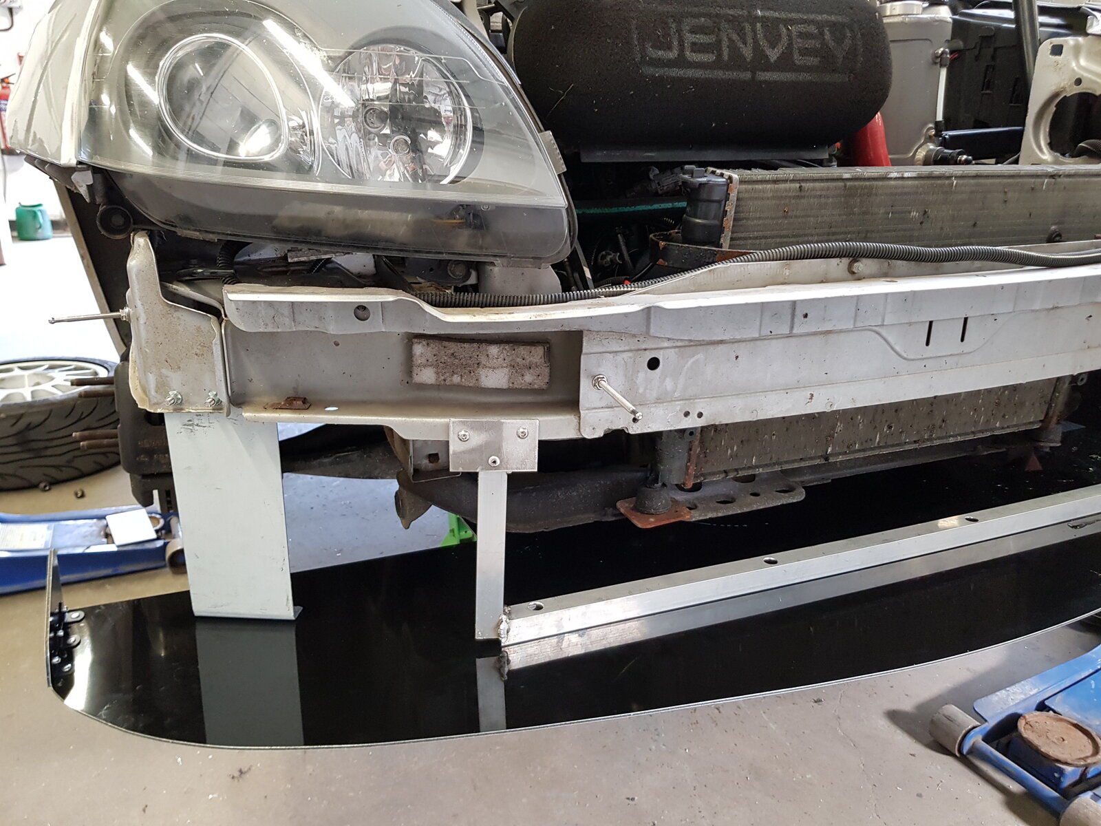

After a large amount of head scratching and you tubing I figured out how I wanted to mount the splitter.
Firstly I wanted to mount it in a way so that if I knocked it, it wouldnt get damaged or damage anything else.

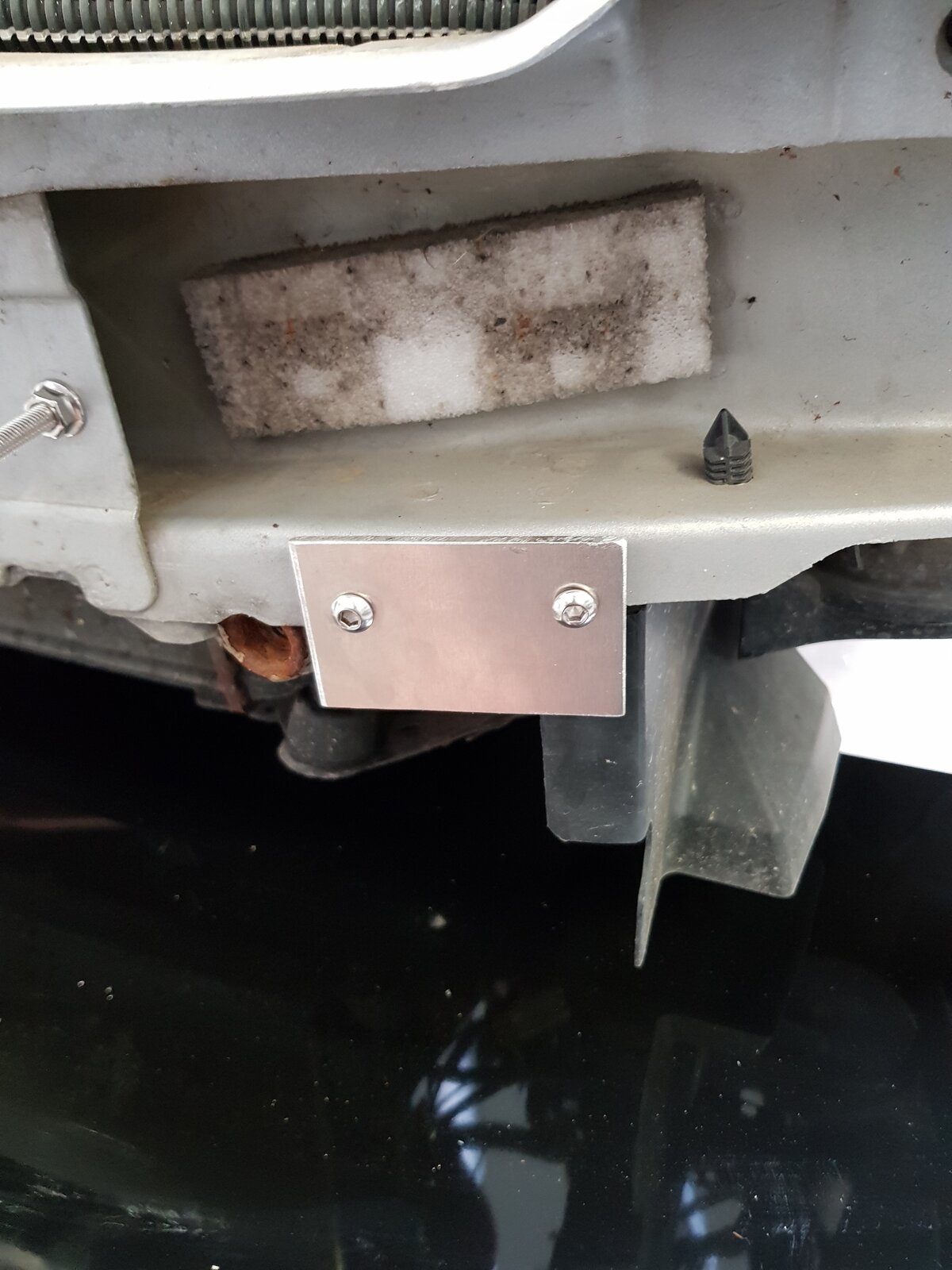

So I marked the centre line on the splitter and measured up underneath on the subframe to square the splitter to the car.
Then I drilled 2 6mm holes through the rear of the splitter and into the subframe and fitted 2 aluminium banana rivets.
This was for 2 reasons.
#1 it holds the splitter square whilst I fabricate the front mounting bracket.
#2 the rivets are strong enough to hold the splitter in position but if I knock the front edge the rivets will just sheer off and take the impact with the front edge remaining ok. A little bit like a crumple zone. Then all I would need to do is fit 2 new rivets and away we go again. Rather than mount it with bolts and screws and hitting something and it trashing the front edge like I have seen on so many track cars.
To be continued...
1985michael182

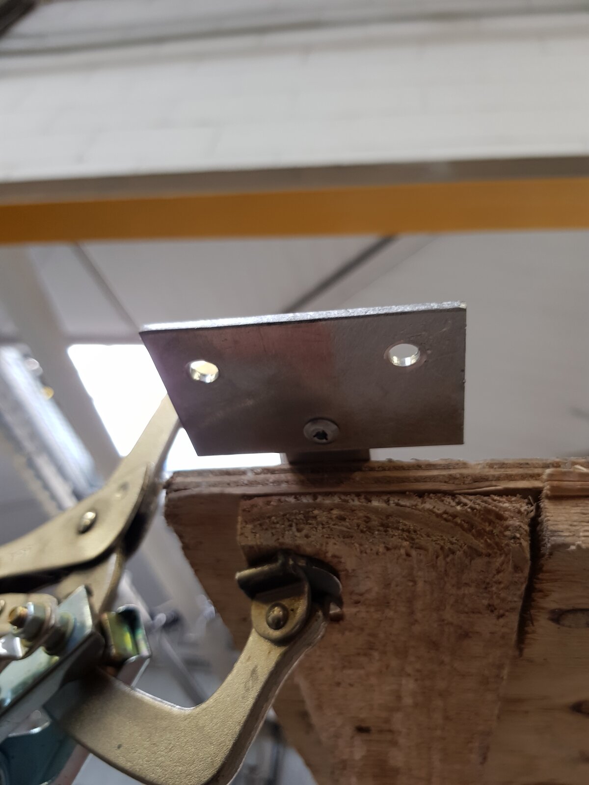

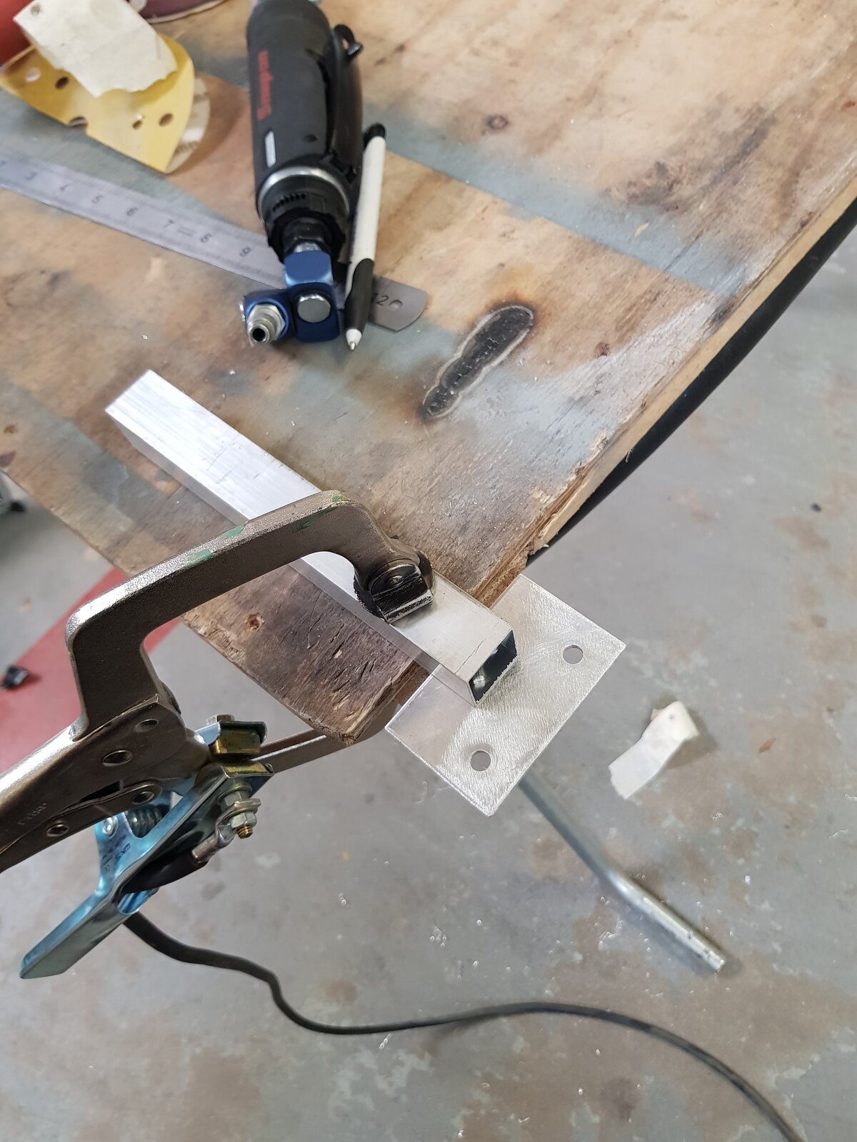

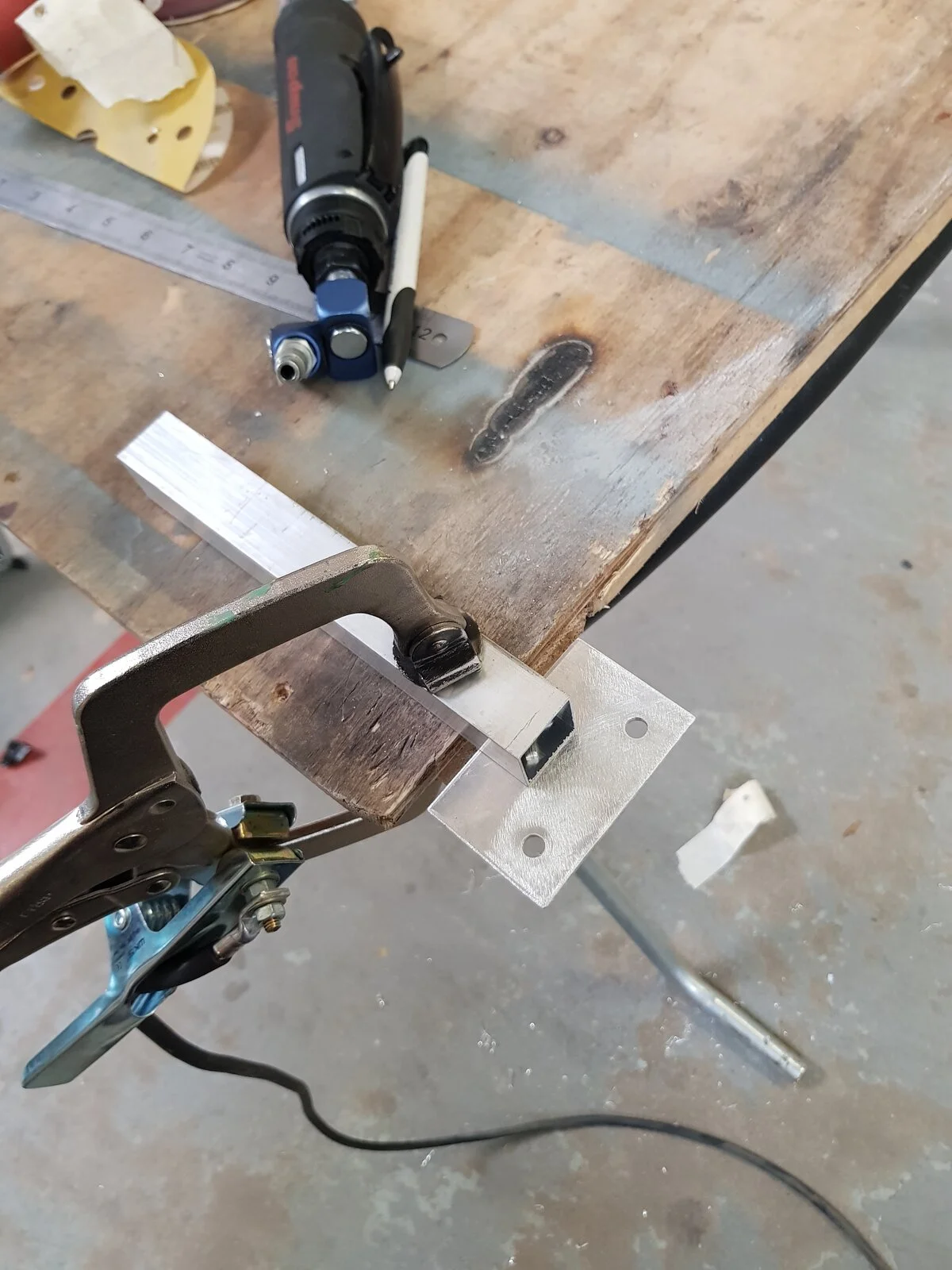

Next I drilled into the front cross member and fitted 6mm captive rivnuts.
I made 2 alloy plates and attached them with caphead bolts.
I then used some aluminium box section I pulled out of the skip from a sales sign that had buckled in the wind and was not repairable. Cut it to length and rivited it in the position I wanted.
I then clamped it up and welded the 2 parts together and refitted them to the car.
I then cut a piece of box section to run between the 2 uprights to keep the centre from sagging.
I drilled 4 x 6mm holes through the box section into the splitter to fix it with the caphead bolts facing upwards but they where too short so I drilled a larger recess in the top of the box so the nuts now sit inside the box section with the nice smooth caphead on the underside. I then welded the uprights to the horizontal parts.
Appaulogies for the aluminium mig welding, its bloody hard to get right with the spool gun. Not the most aesthetically pleasing but it's not going to fall off!

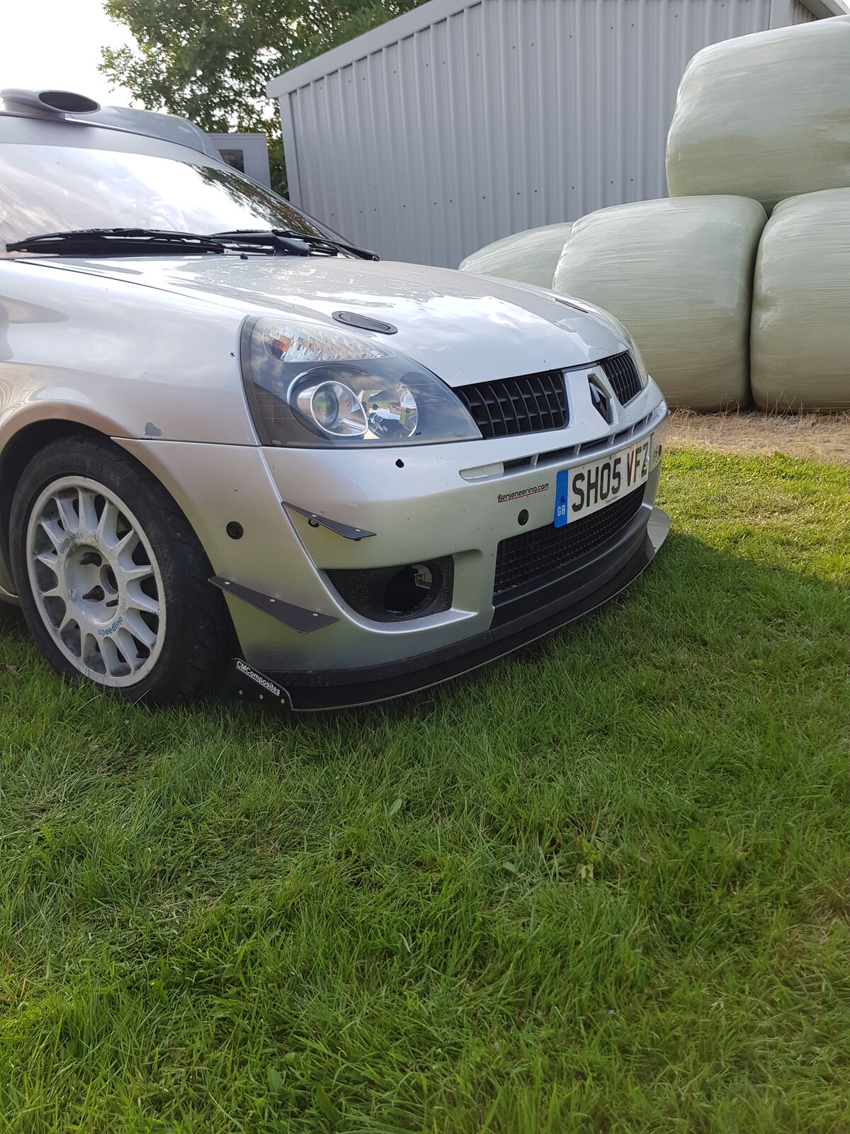

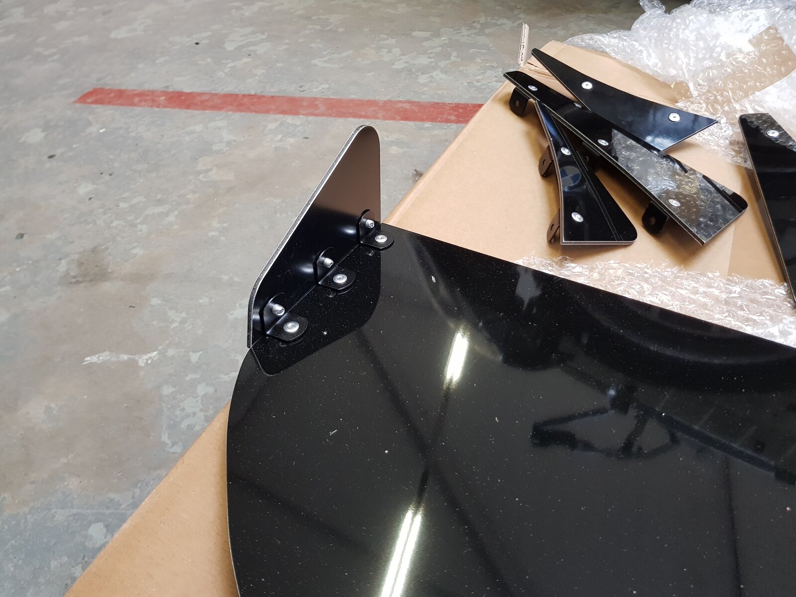

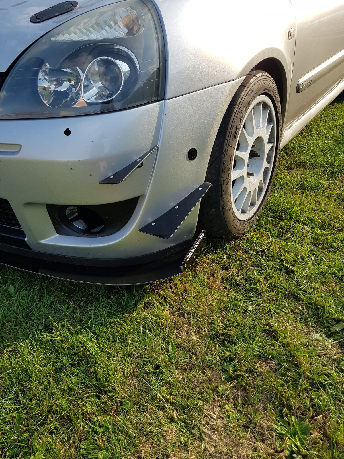

Later on after tea and after cutting the grass 🙄 I finished off the bumper with the canards or dive plates or fins or what ever you want to call them.
I lined them up at the same angle as the end plates just because it would look odd otherwise and I could get both sides the same.
Happy as a pig in 💩 😁
1985michael182
I originally rivited the canards on as that's how they were held together but have since used more of the caphead bolts for security. Main reason being I caught one with my leg and pulled it off...
So clearly they weren't on good enough

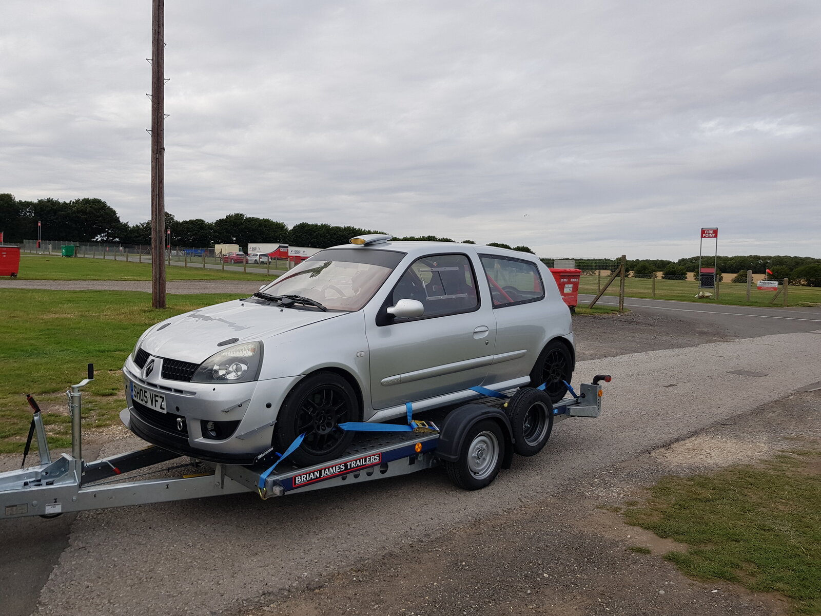

All of this prep work was for one goal.... the track.
Me and around 10 other friends had all booked on at Cadwell park for a 105db day and it would be my first time on track with this car. I had prepped the car to the best of my knowledge and now I just needed to drive it.
Cars with us,
My clio182ff
Eddys clio172cup
Andy's clio172cup
Jeffys clio172cup (my old one)
Mehmets clio172
Lee's mk2 vr6 golf
Aaron's saxo vts
Matt's focus st170
Ryan's clio172

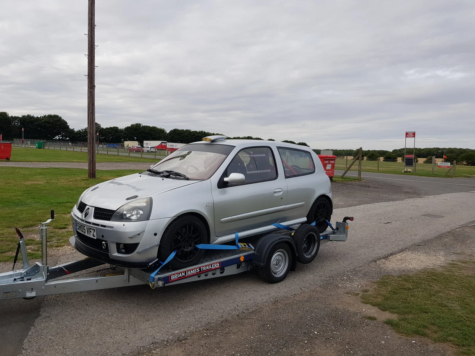

So night before I got loaded up ready to bounce early morning.
So we met up with the other guys and convoyed all the way.

Really glad I fitted the roof scoop as it blasted fresh air at me all day. The lads where taking the piss all day until they realised I wasnt getting out of the car dripping with sweat like them.

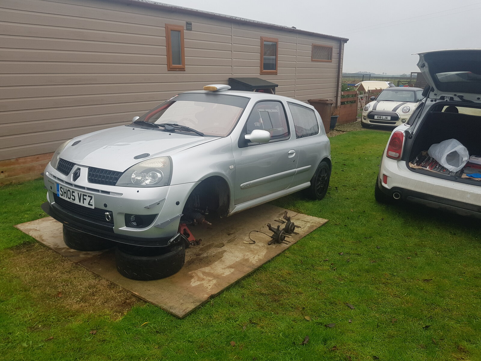

After Cadwell I gave the car a good clean up, removed all the track muk and ferrous brake dust.

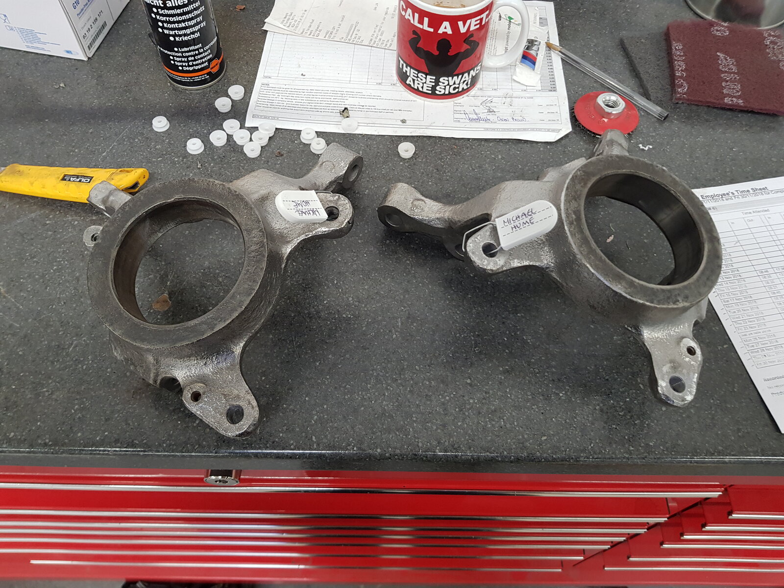

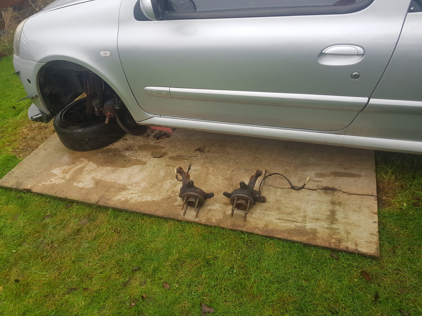

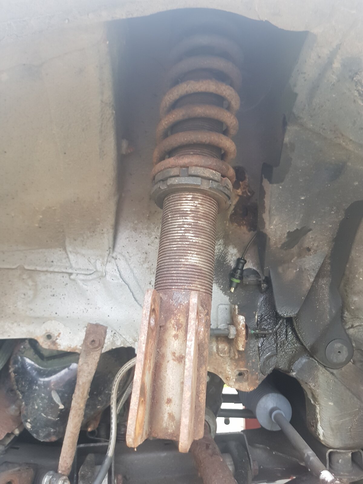

I had been picking Mark's brain for a while regarding his Role centre/ bump steer kit even before Cadwell. So now was the perfect time to get one bought and fitted to try and help the lack of turn in.
So I got the car on stands and removed the hubs.
It was at this point I realised how corroded the struts were
I took the hubs to work, steam cleaned them off, popped the wheel bearings out and gave them a quick sand blast. Put name tags on them and sent them to Mark.

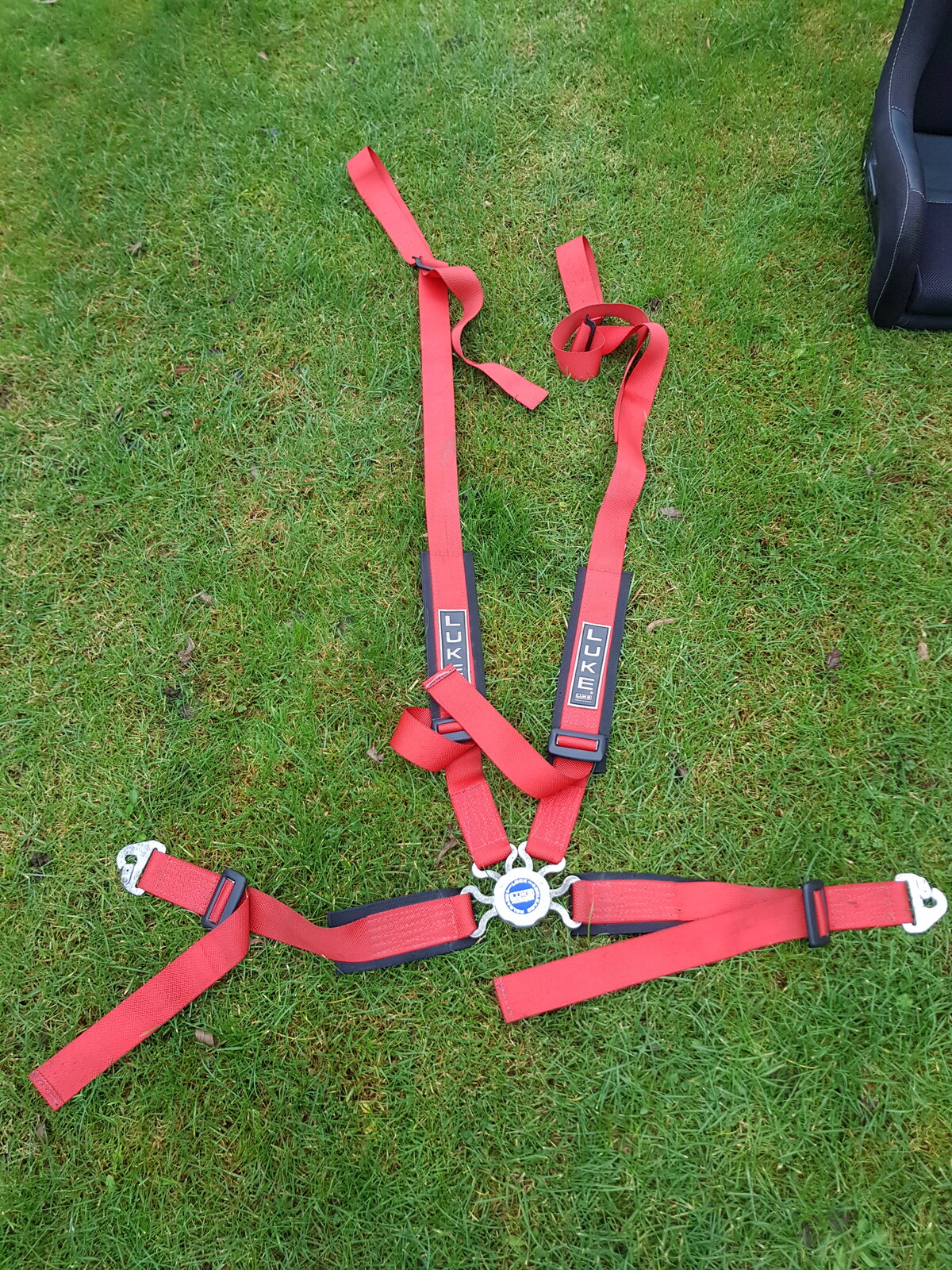

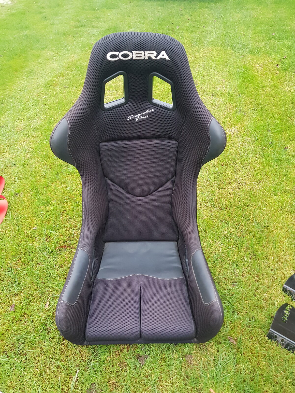

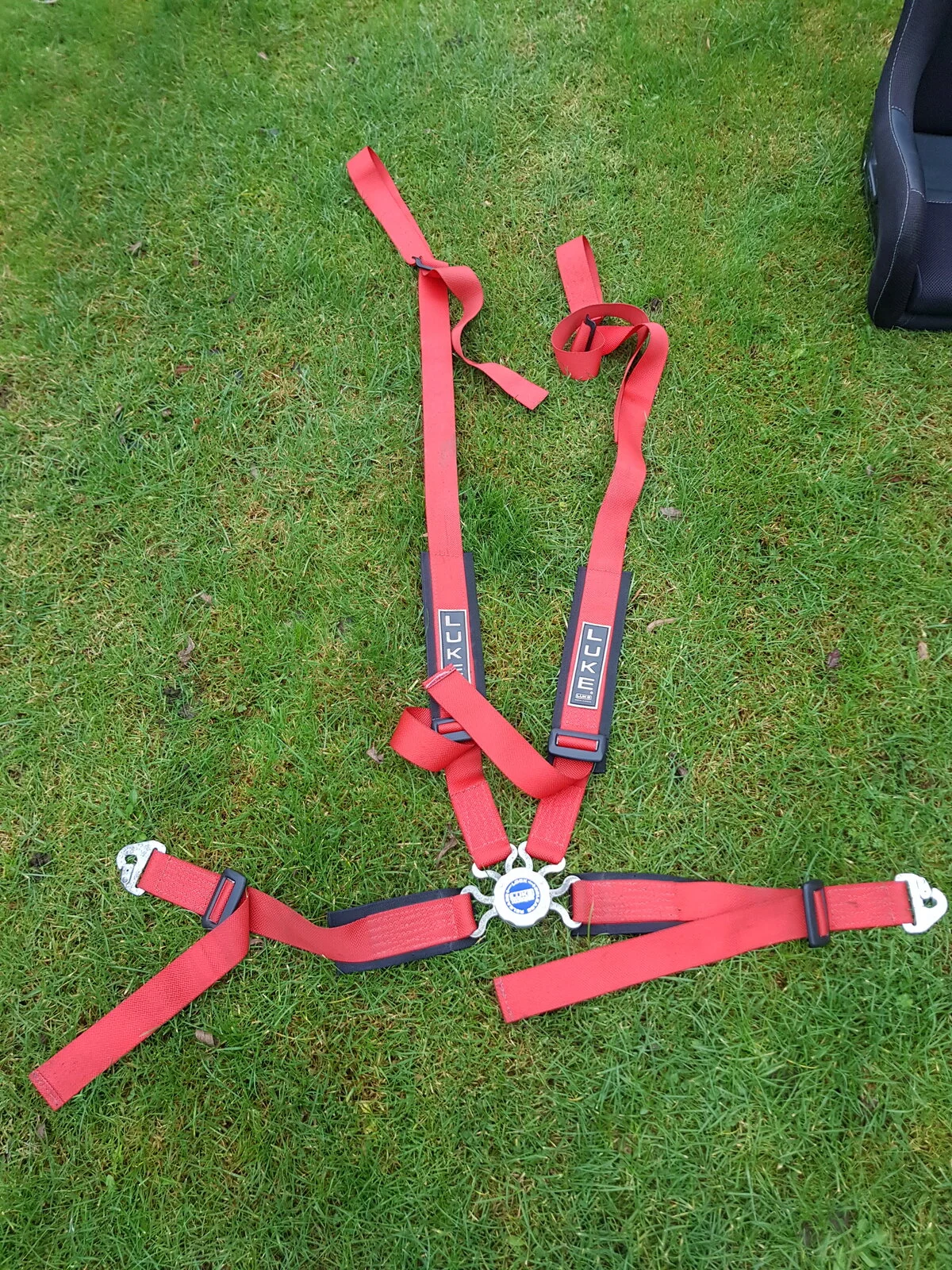

To fund the kit I sold some unwanted bits. 2 x Sazuka pro bucket seats and a set of Luke harnesses.
Which then left me with the one seat which came out of my impreza hill climb car originally.
