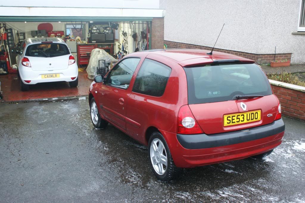

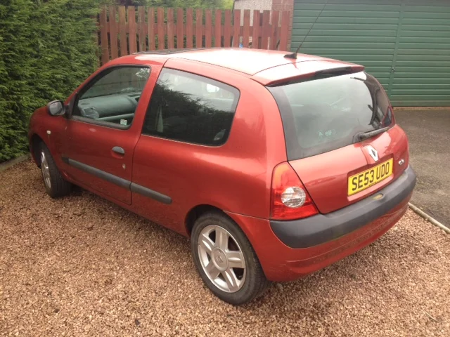

Only one poor Iphone photo at the moment. I have estimated £250 to return to clean condition (minus the mods), going to try and keep it an uber cheap project without cutting corners. Will keep updated with photos and budget.

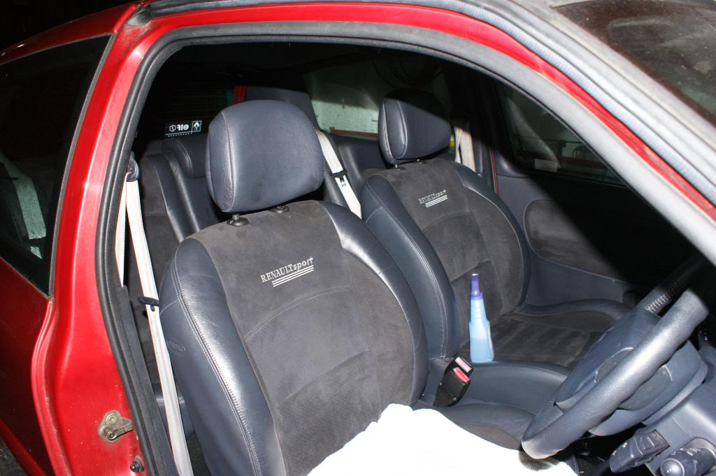

So managed to source a 172 passenger seat and finished fitting it all. New carpets, underlay and doorcards also. Interior is smelling 100% better now. When all the carpets were up, I scrubbed the floor with anticeptic detergent stuff which helped.

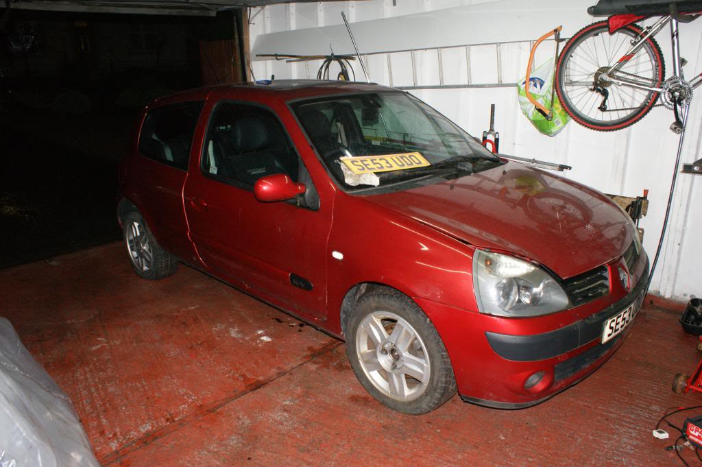

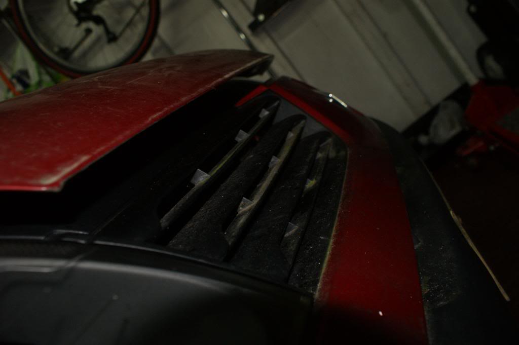

A photo of how dirty it is. Lots of moss growing on her. So looking forward to the outcome of a detailing session.

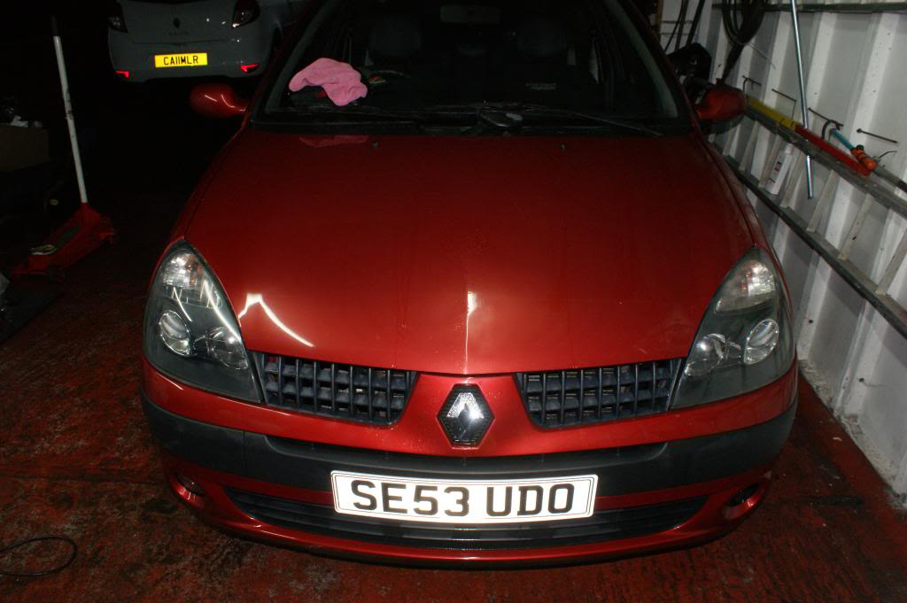

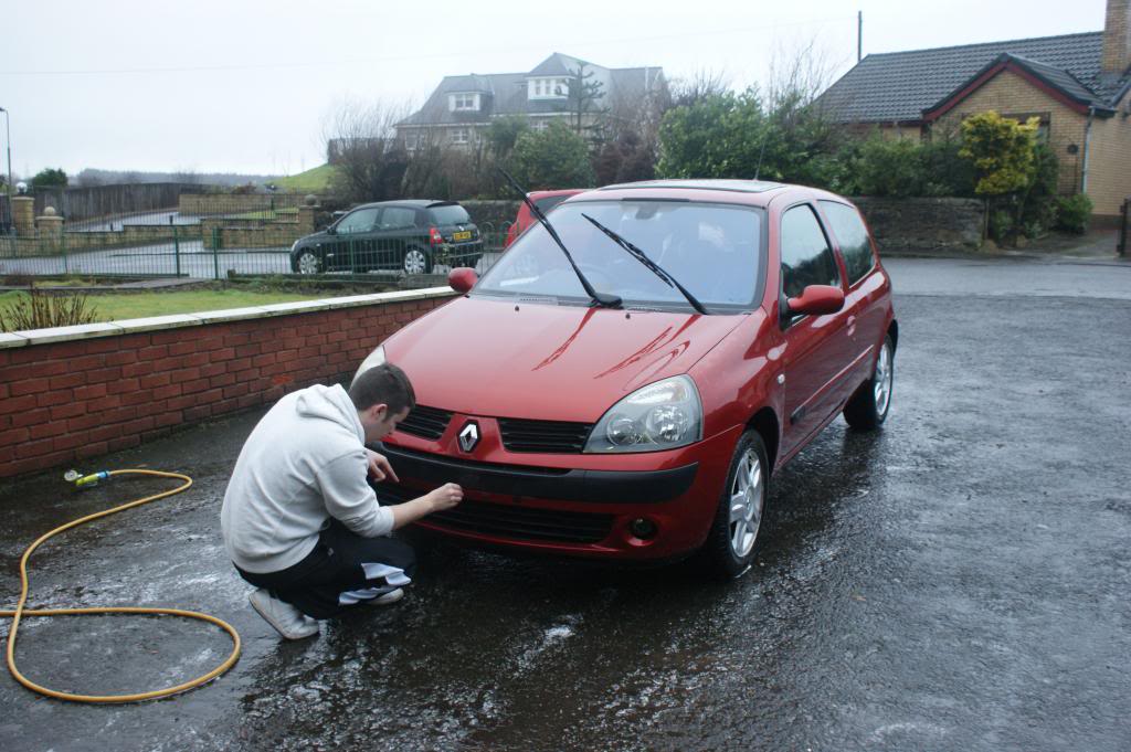

Another update. Although the weather was crappy today we got quite a bit done. Picked up the xenons from Dave and John on here and was roped into buying a RS grille as well.
Got back to the garage, flattened and machine polished the headlights as they were really cloudy. Started striping the front end to fit the headlights and grille, had the lads round to lend a hand which made things easier. Fitted new plates and gave her a quick wash. Also gave the offside front wing a quick going over with some compound and a hard pad to see how the paint would come up, after a couple of mins I was getting good results. So shouldnt take much to restore to her former glory.
