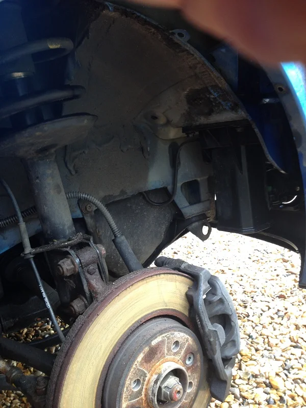

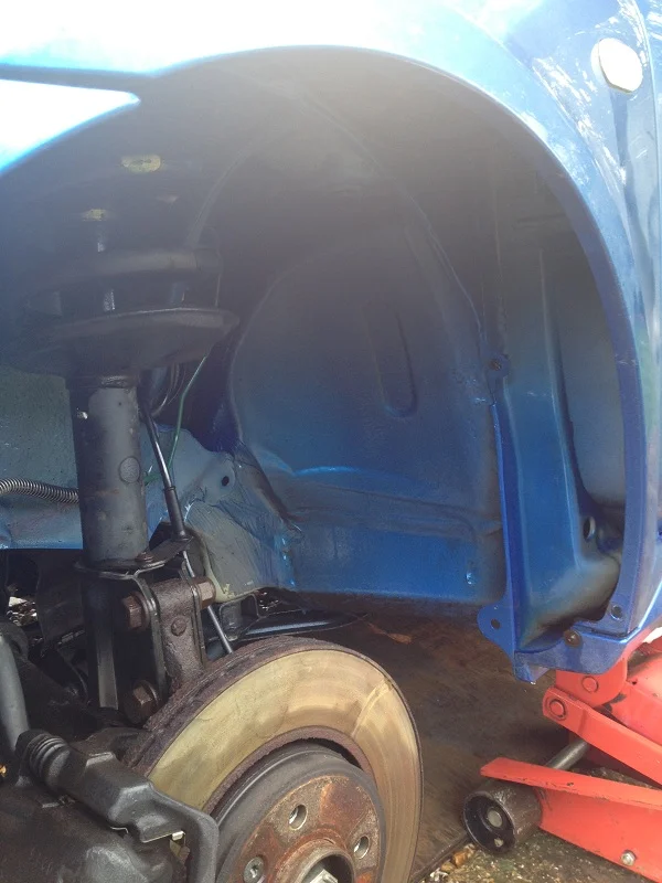

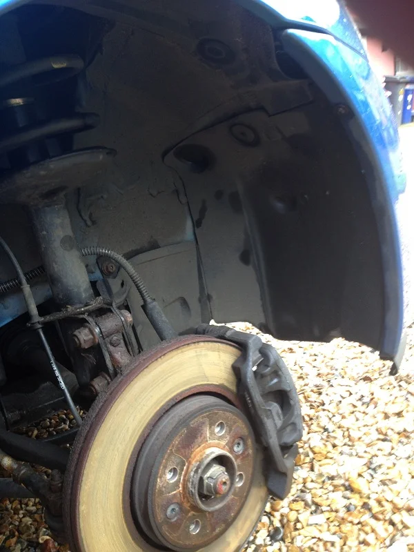

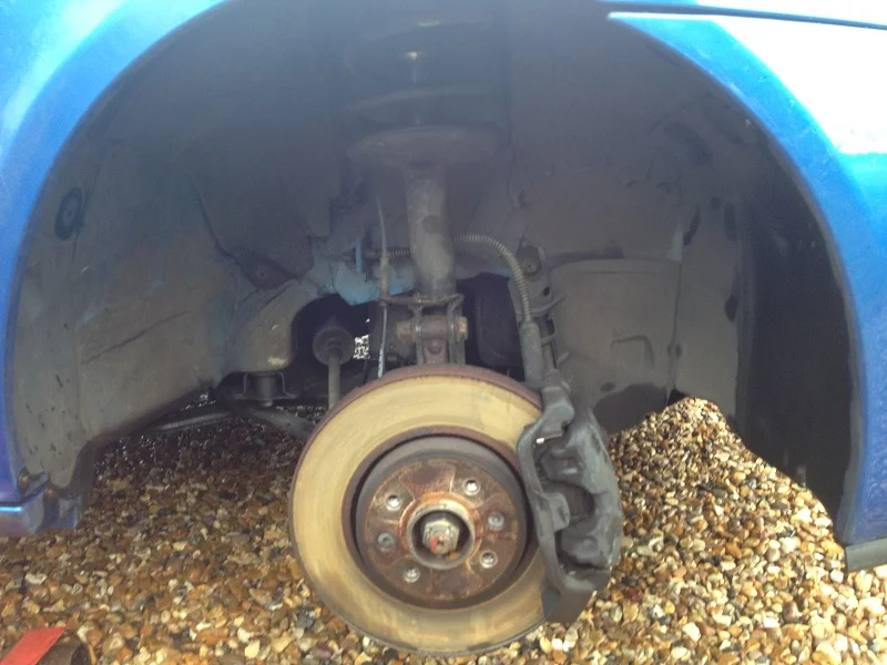

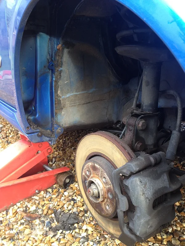

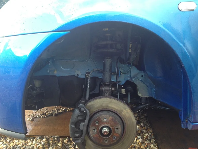

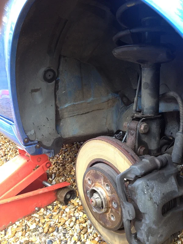

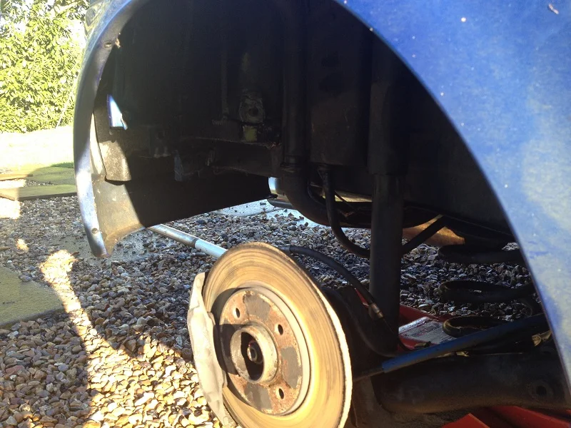

I removed all of the inner arch lining, pressure washed the worst off then used muc-off and a brush :)
Same process for the back but photos don't really do it any justice.
A little before pic there but the sun was getting the better of my focus hence why there is a hand in a few shots!

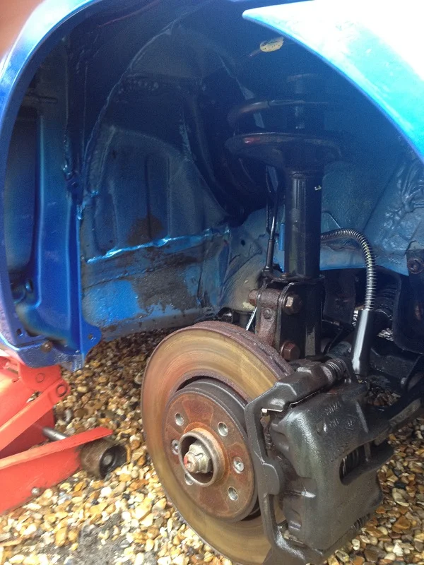

Liners out

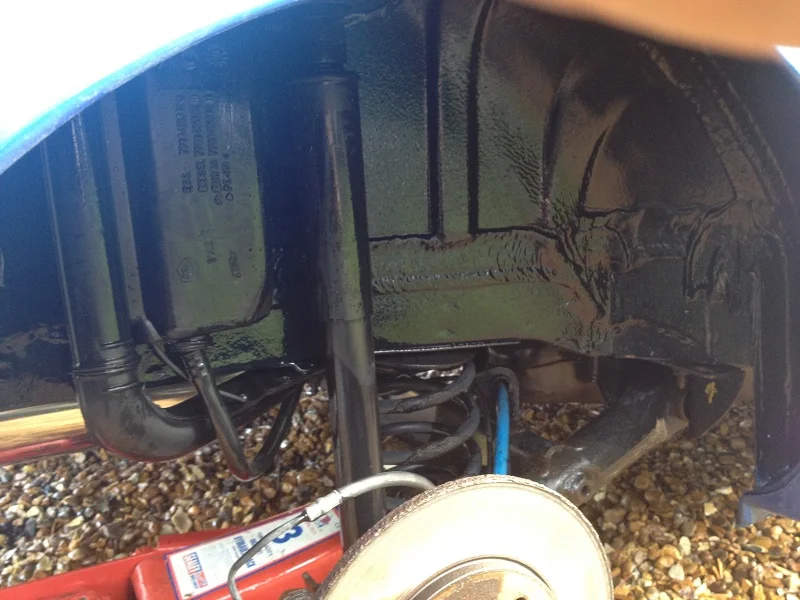

Clean:) What looks like dirt on the footwell, isn't. Its the remains of some underseal or waxoil.
So all clean ready for me to waxoil the inner arches once dry. I washed the underneath of the car aswell and will be waxoiling that too.
All dry in the garage :)
A couple of dry inner arch shots.

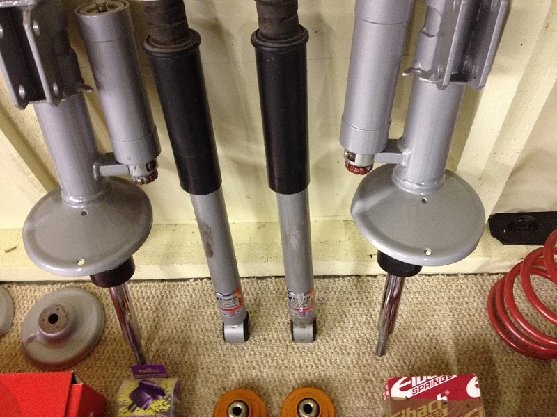

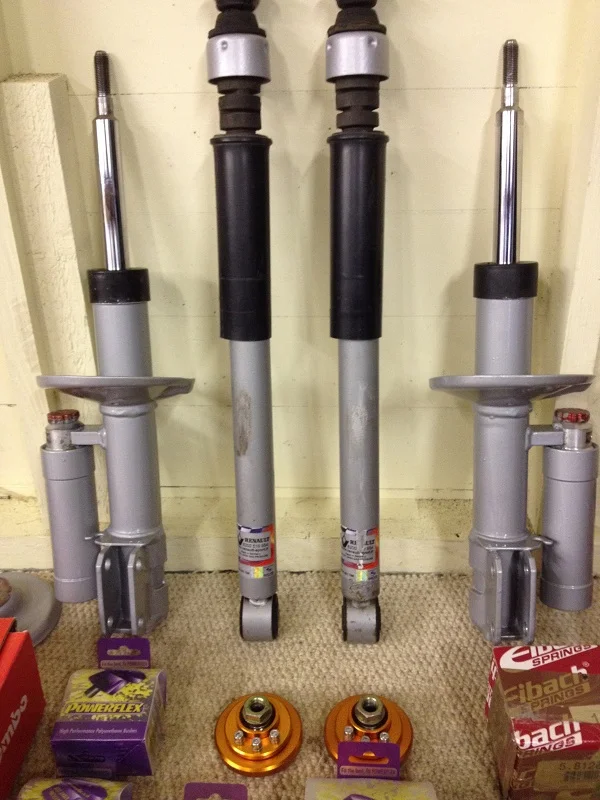

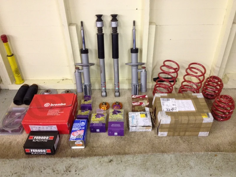

Right the parts to be fitted....
-Sachs Trophy dampers
-Eibach Sportline springs
-AST top mounts
-Full polybush set
-Brembo HC discs
-Ferodo DS2500 pads
-ATE brake fluid
-HEL braided lines
-Genuine rear discs and bearings etc.
-Genuine rear pads

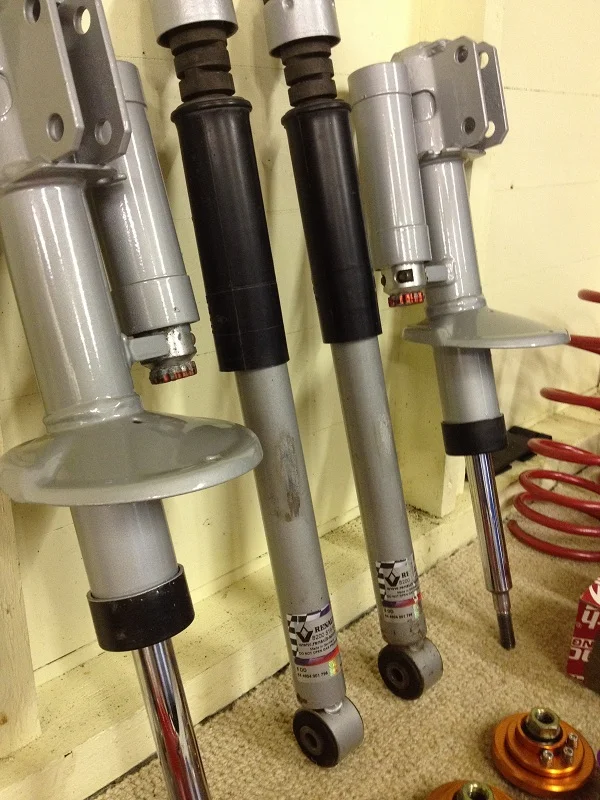

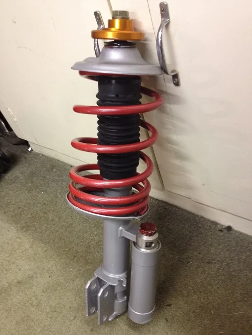

I refurbed the front dampers myself. I shot blasted them, followed by a few coats of red oxide then around 4 coats of 2 pack silver then 2 coats of lacquer. Didn't turn out aswell as I had hoped but their ok to sit underneath my car:eek:
The rubbers had perished so I purchased some rather heavy duty replacements. They are made for an old British motorbike's front forks, they fit perfectly :D
Hoping to get this all done by the end of the week.

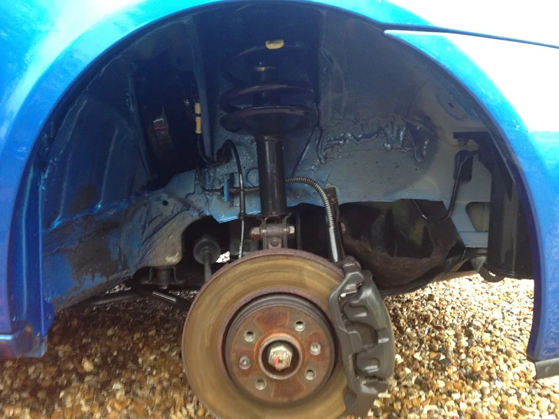

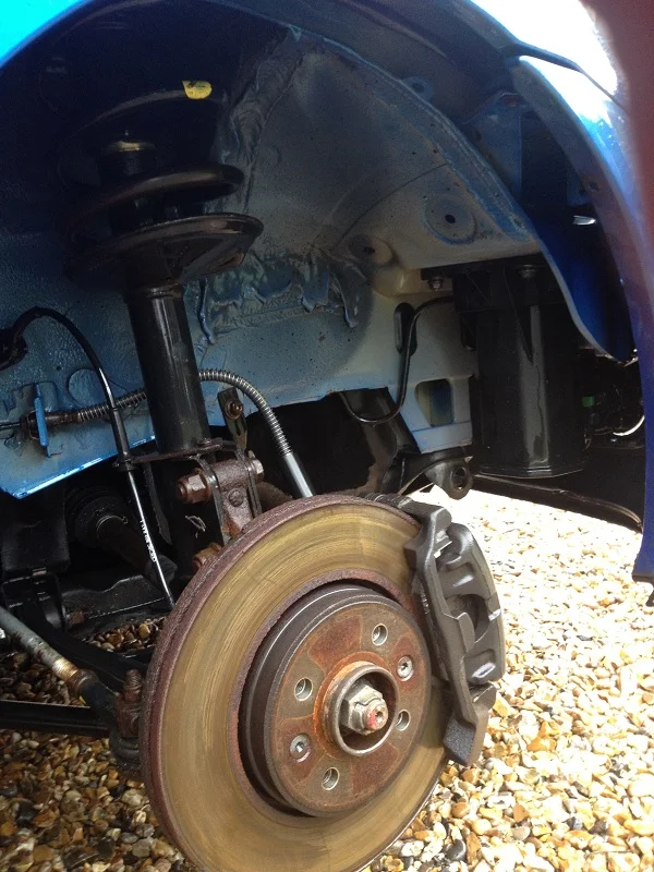

  ph1 172

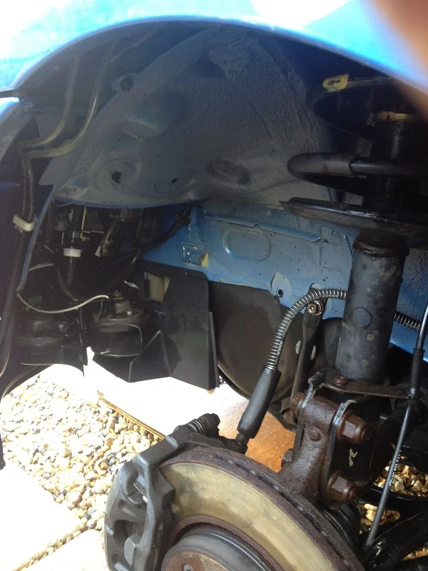

Been working on it for most of the day and have achieved effectively sweet fa:(

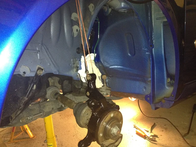

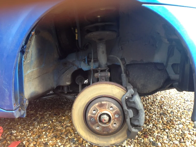

Bottom ball joints did not want to move. (Doesn't help that I haven't got the proper tool!) So I got a bigger hammer......which worked a treat:)
Cleaned the hubs up and gave them a couple of coats of hammerite.

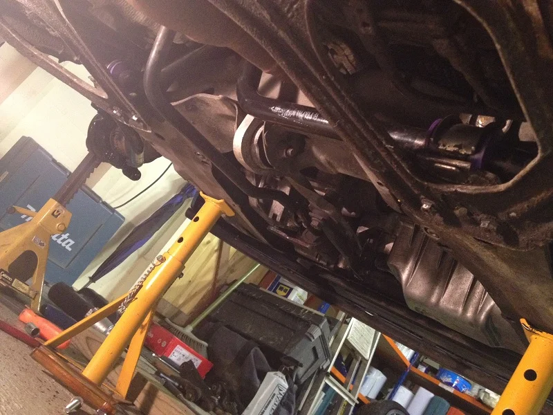

The biggest PITA was the front ARB polybushes:mad:
The new versus the old

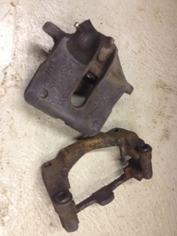

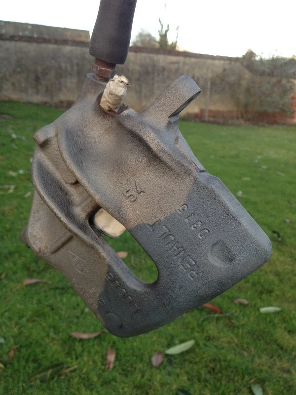

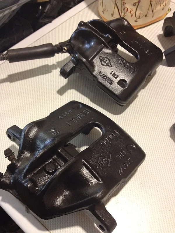

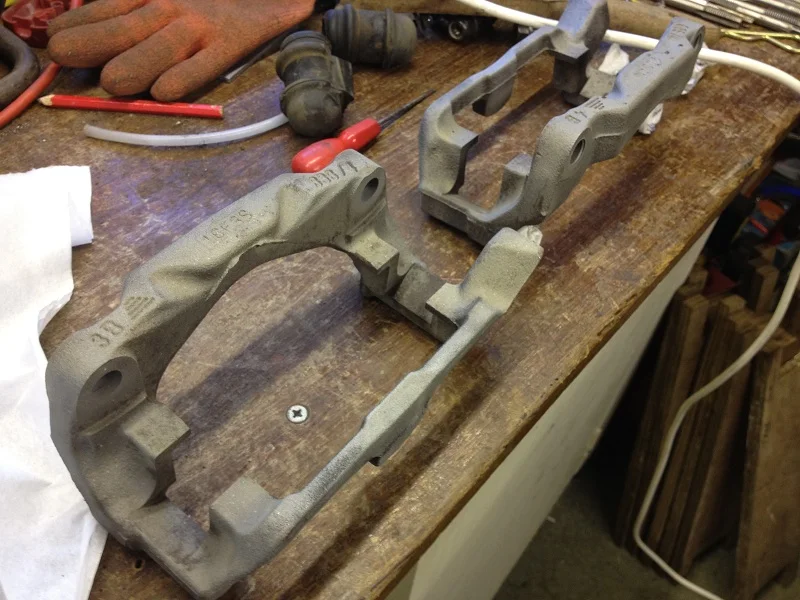

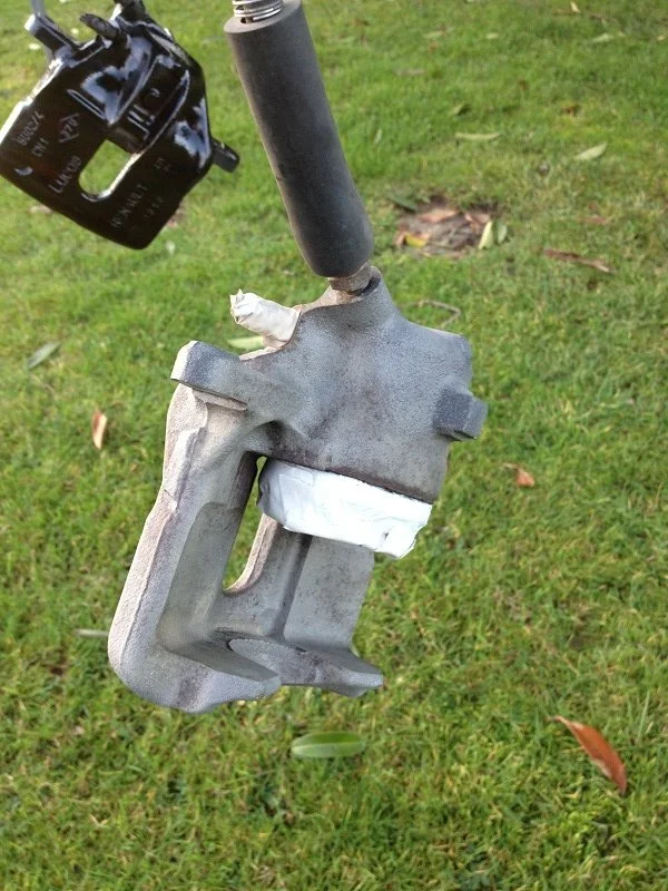

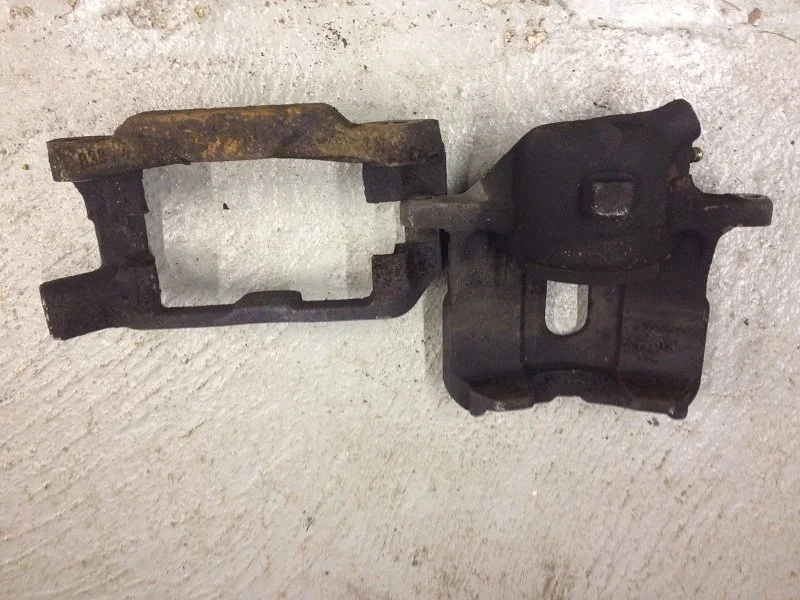

Also some before shots of the caliper. I will be shot blasting these and spraying them satin black, possibly tomorrow.
  ph1 172

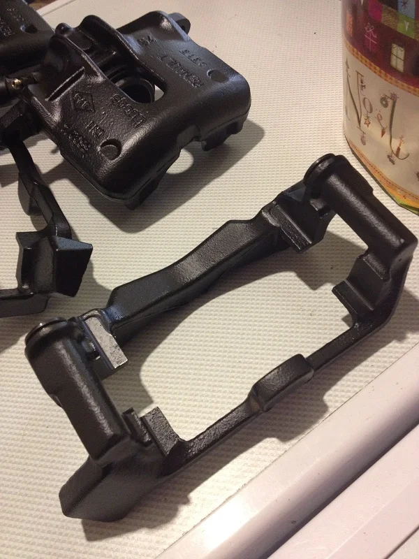

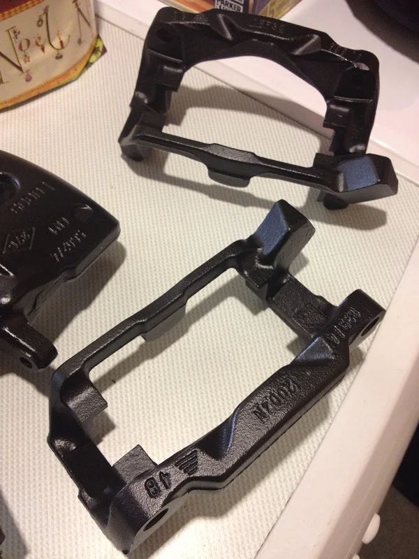

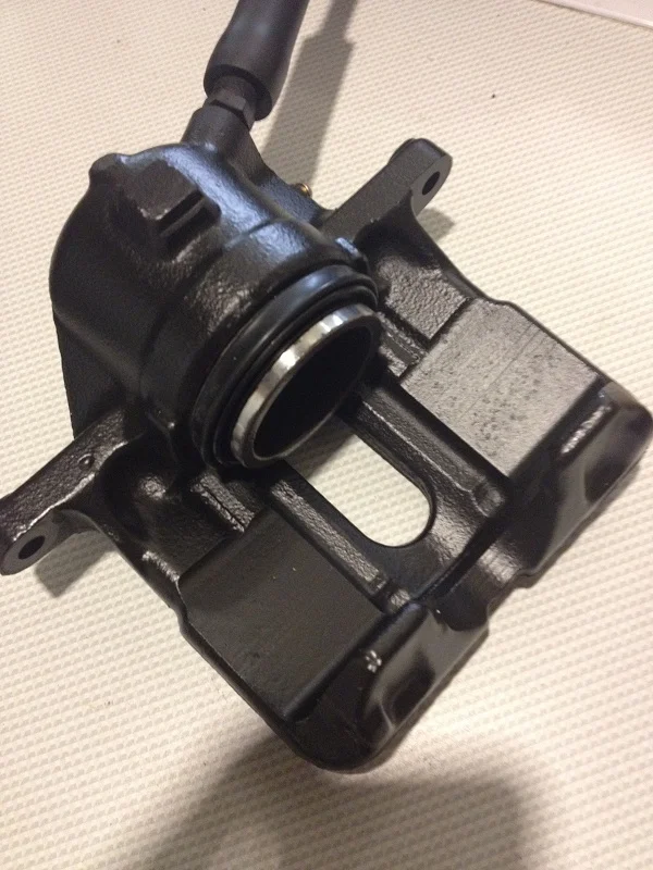

Shot blasted the callipers today and gave them around 4 coats of heat resistance paint.
After shot blasting.
Now dry from painting.
Quite pleased with the result. Also before painting I removed the pistons and gave them and good clean up and clean the dust seals. Good as new:)

Unfortunately I did not get my bottoms arms back today so progress has been slow and well not much worth talking about tbh.
Cleaned up all of the bolts that came from the car, and a couple of new nuts here and there. Setup a calliper so I could test fit the pads and see how much needs to be taken off. Followed a diagram off here as a base then trial and error. Used a pedestal grinder which made the job easy as peas :approve: Gave the bits I ground off a couple of coats of heat resistant paint and job was a good one.
Hopefully I get the arms back tomorrow.
  ph1 172

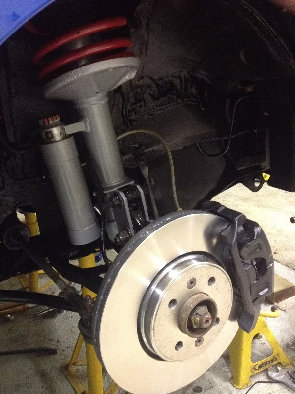

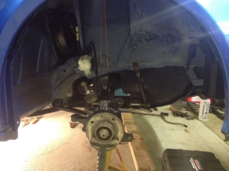

Finally I got the arms back today.....at 7:30pm:(

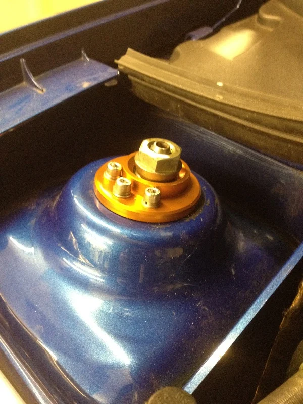

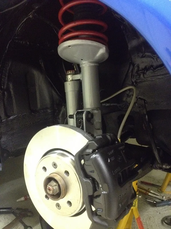

Unfortunately I only had time do fit the calliper, disc, bottom ball joint and arm and a damper, spring and top mount. Also I gave the inner front arches a couple of coats of waxoyl. Once the other side is done and the weight is back on the wheels I can change the track rod end, which currently will not budge:mad:
Anyway, a couple of pics of the "nearly" completed drivers front.
Unfortunately this damper fell over when it was drying up against the radiator and as the paint was still soft, it now has a carpet print on it!
Also where does all this dust come from in a clean workshop/garage? Look at the top mount, its only been in here a few days!
Will get the front finished tomorrow and then can make a start on the rear:)

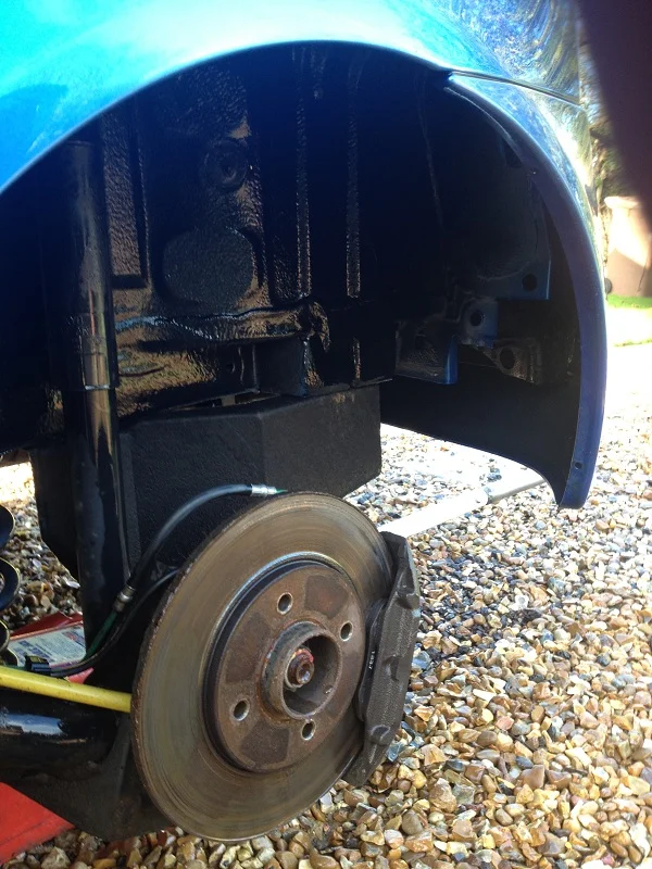

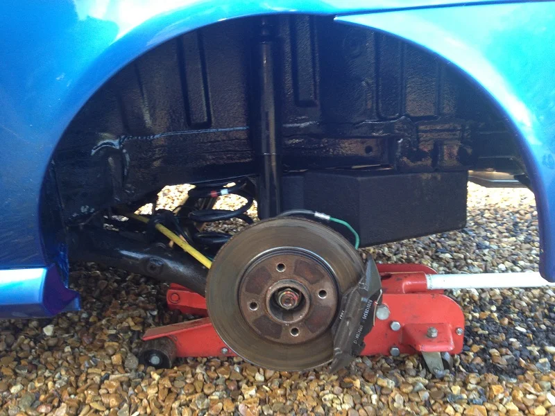

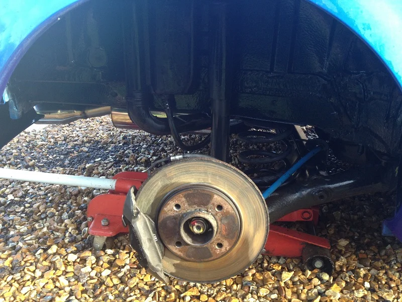

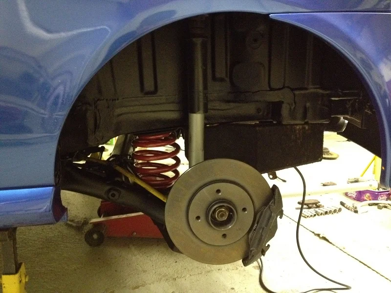

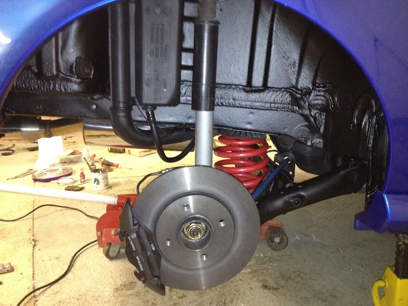

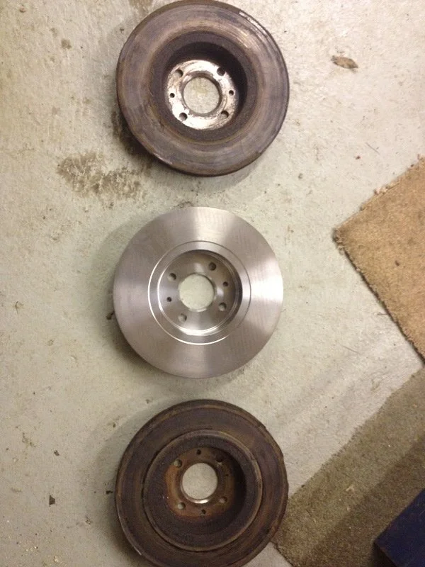

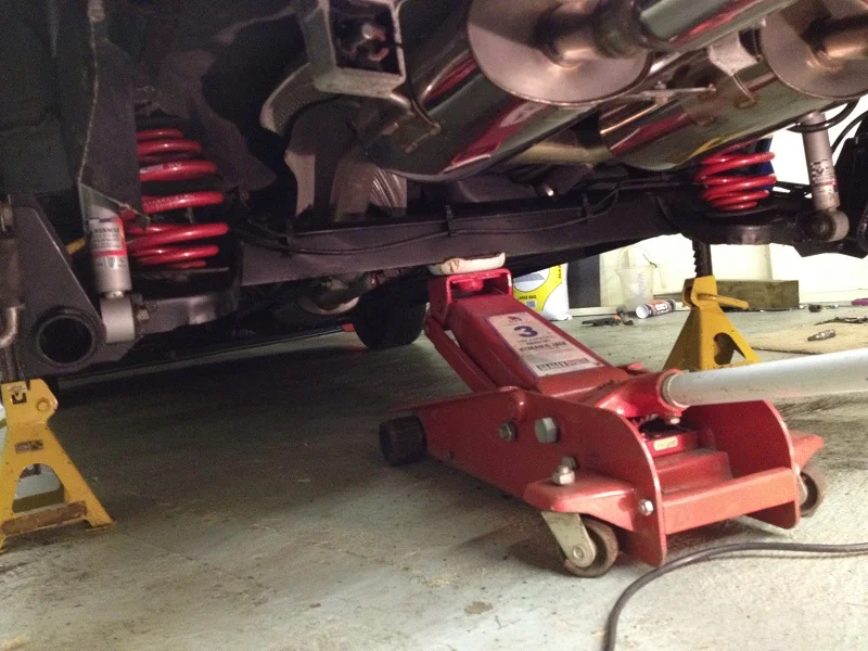

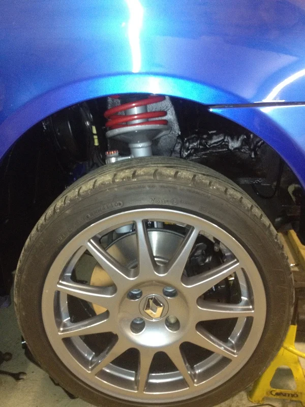

Got the rear done today. Nice and easy:)

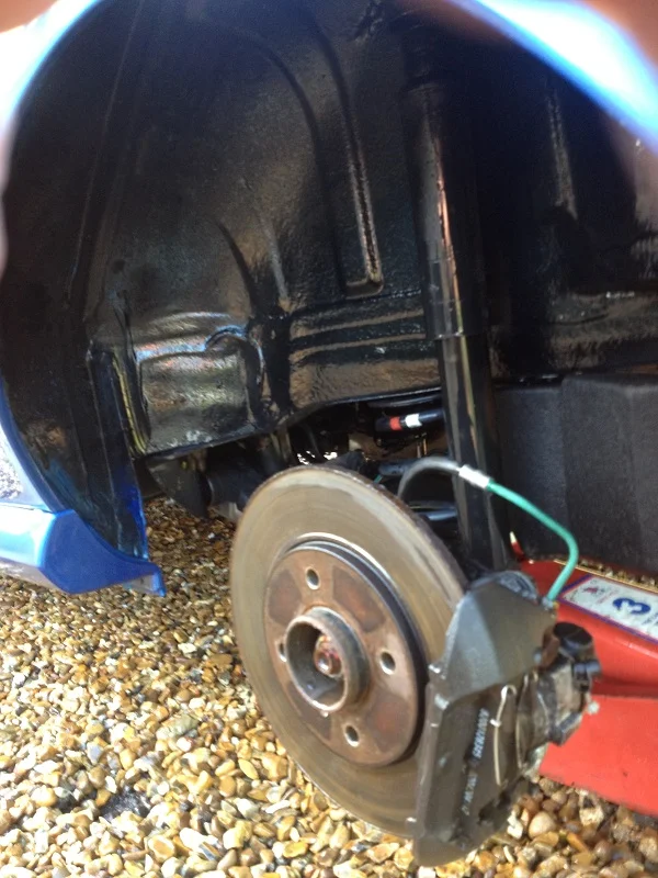

Rear braided lines on, new discs and bearings, new pads, shot blasted pad carrier and sprayed, sportlines and Sachs dampers and waxoyled the inner arches and rear beam. Sits abit high atm at the back but hoping they will settle after a little while. The drop on the front is good, seems to sit a little lower than most that I have seen, maybe the AST top mounts make it sit slightly lower than to original top mounts?
Just got to fill it up with new brake fluid, bleed them, change the track rod ends and get the suspension and steering geo done.
Oh and give it a wash as it is now covered in dust! Where does it come from?!

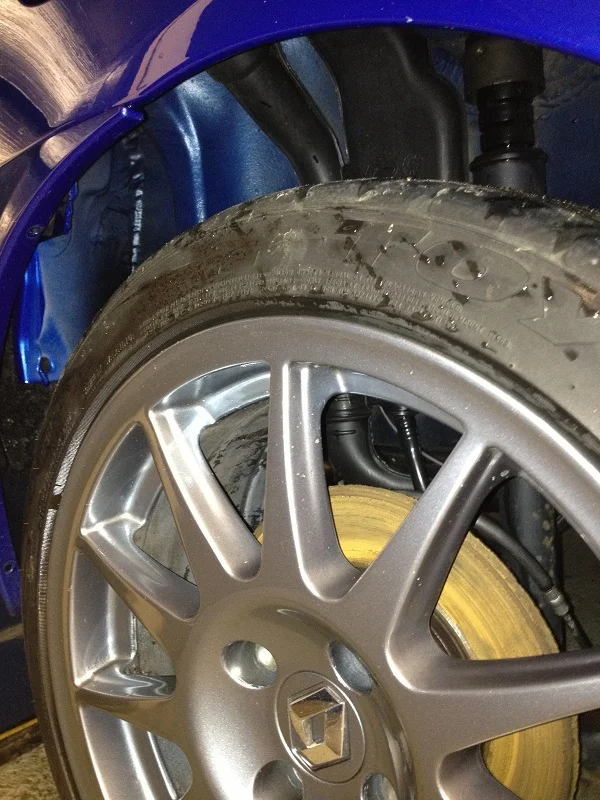

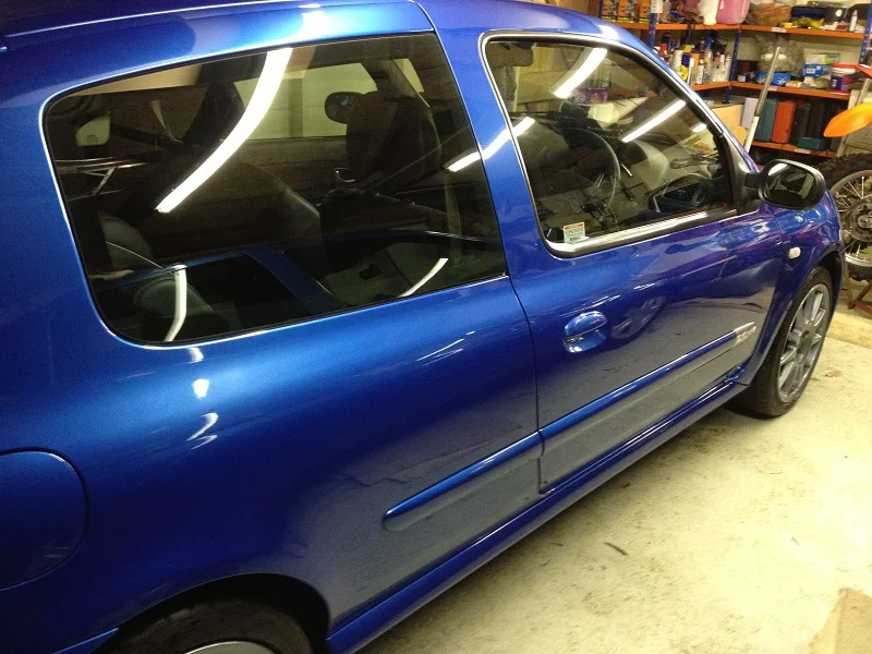

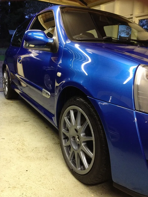

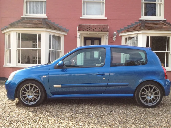

Right, last day off before I go back to work so I thought I would give her a wash.
Awful photos I apologise :eek:
How its sitting now.
Also found a pic of the damper built up just before it went on.
Easy as peas to fit:approve:
The car will be trailered to Danny @ 519 Automotive on Thursday to have the suspension and tracking setup and also the brakes, I cannot wait to get it back and test it!

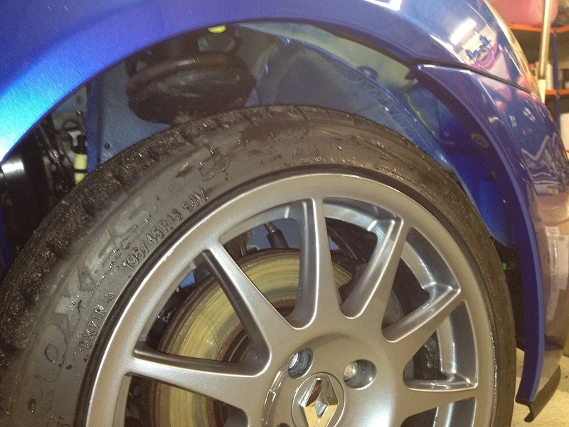

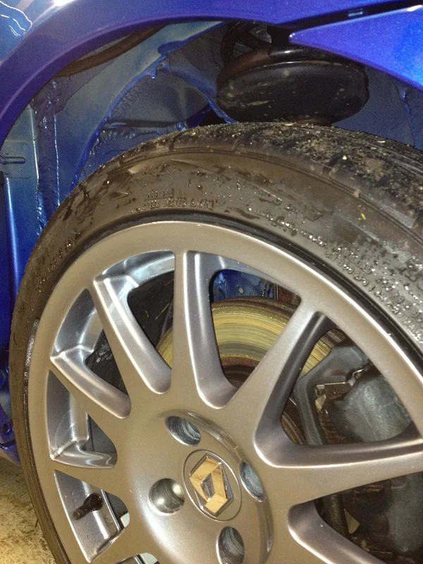

Little update
Had a problem with the rear springs in that they were sitting 15mm too high at the rear, so I sent them off to Coil Springs LTD and for £55 they heat them back up, re-form them, re-harden them and then powder coat them in black, oh and deliver them back to you:)
I purposely had them lowered about 5-7mm lower at the back as I plan to strip the interior from the rear, so hopefully it will then sit level
If anyone is having the same problems with their springs, let me know and I can supply you with the details you need
  ph1 172
looks good now :) better than sunday ;)
Handling was abit iffy aswell with the rear end in the air!
I prefer the nose down look.
Don't panic! Once the rear end is stripped out it will raise about 10mm so will have a slightly "nose down" look
I'm not one to copy but Rhys your car is pretty much exactly how I want mine. Perfect that!
Aww chucks:eek: Well what can I say, you saw it here first;) Next up is tyres!
due to traction the car is meant to sit lower at the front.
Engine on the front, power at the front !
Again, once the rear end is stripped it will be balanced so it will look right again:)
