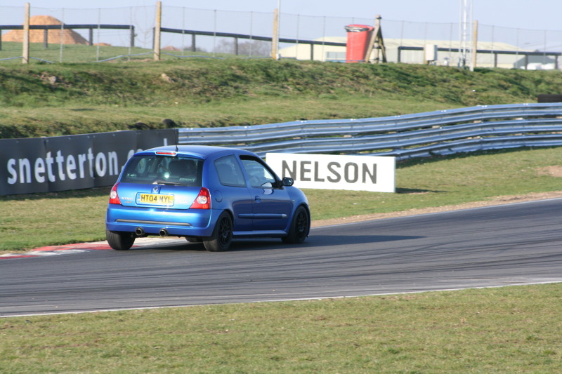

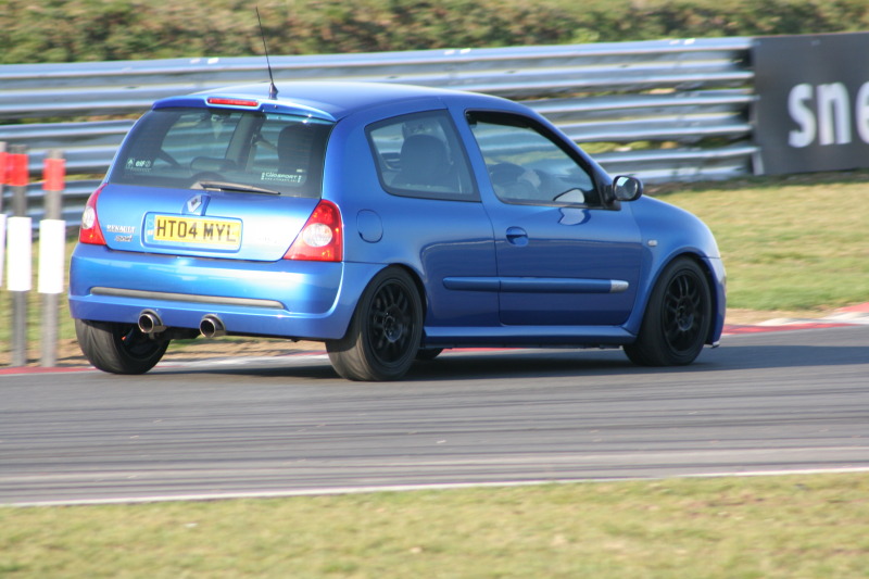

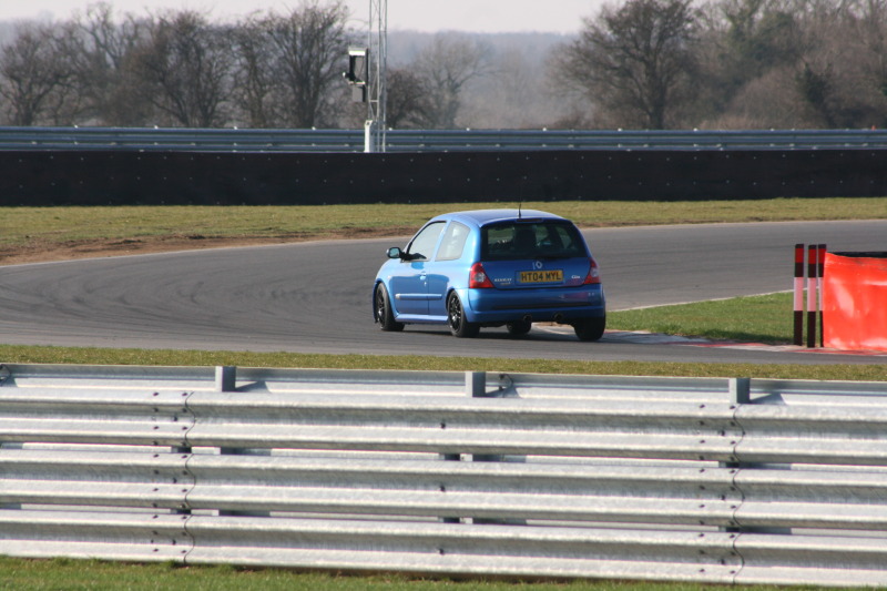

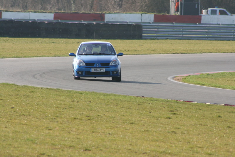

Few pics for you from today,
  ph1 172
Thanks for those Dan:)
Was a really good day, and thanks Lewis.
A few problems that I need to address
-PAS fluid boils more than my kettle. Going to put a bigger reservoir on
-Cooked my brakes quite a few times so need to take the fogs out and arch liner
-Front disks are grooved now and make loads of noise so might need new ones.......again!
-Suspension is too soft up front so need to get them unpinned and need some Koni rears with an ARB
-Sort out my understeer problem
Other than that it was good;)

Dont get the dampers done until you fit the anti roll bar mate, makes a massive difference and will help cure some of that understeer :)

looks awesome on track!! I would strongly recommend the ARB as Chris said, it really makes the car loose that initial roll and gives it that balanced feeling. Buy one before the 'ring' aswell you wont regret it!
How much camber are you running aswell?
