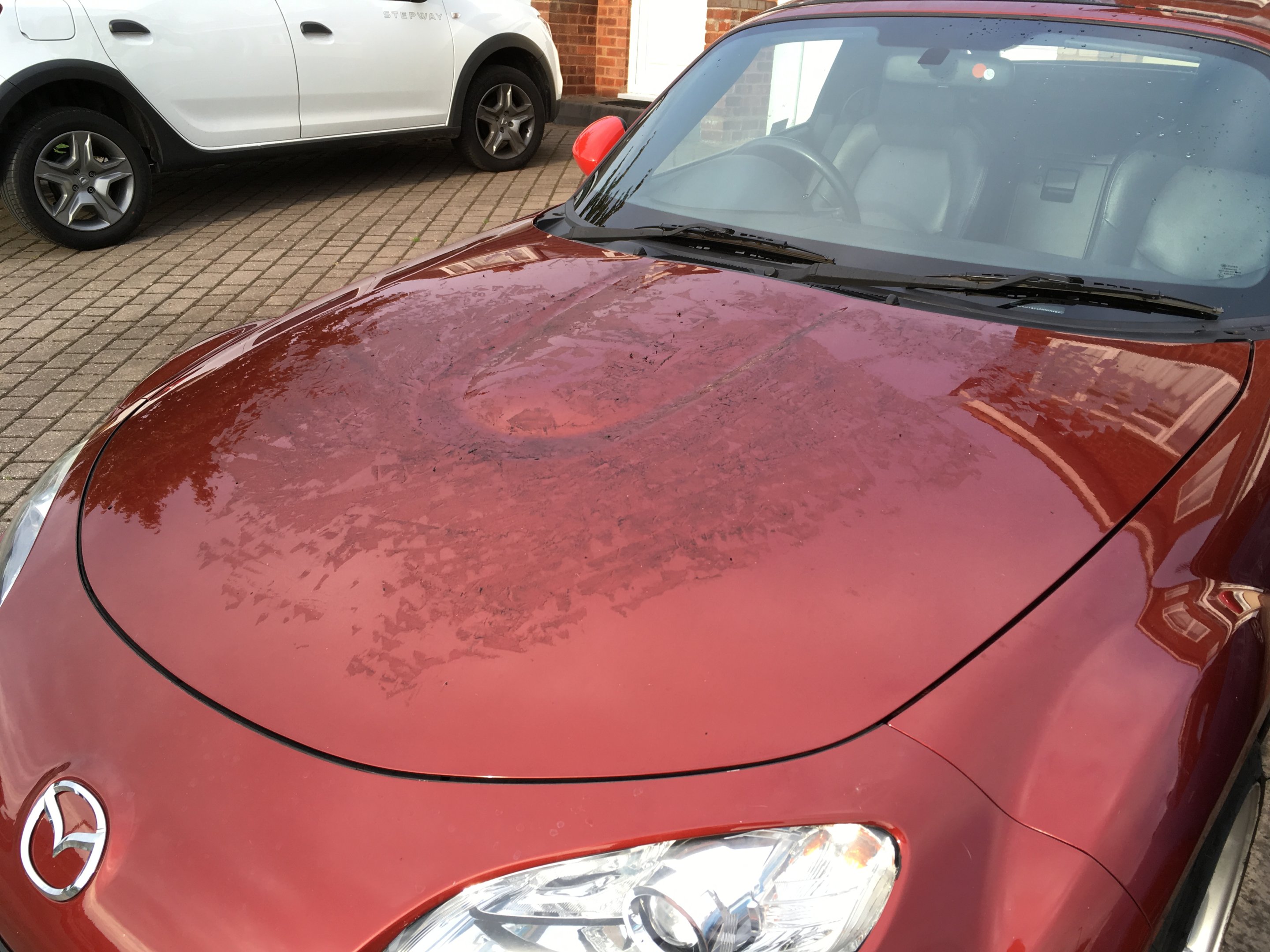

The cosmetic mods aren't to my taste, so I'm going to spending some time making it look more 'normal'. First thing to go will be the wrap...

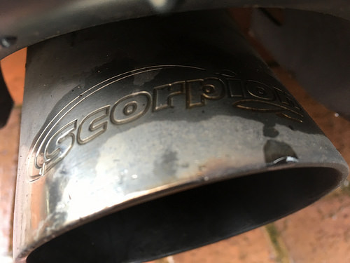

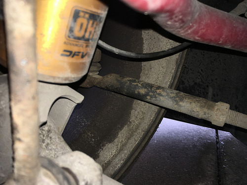

Luckily for me the paintwork underneath is good, and better still it's the colour I originally wanted... So a bit of a win win there! After closer inspection it also appears to have Ohlins coilovers, Eibach anti-roll bars and a Scorpion exhaust too.

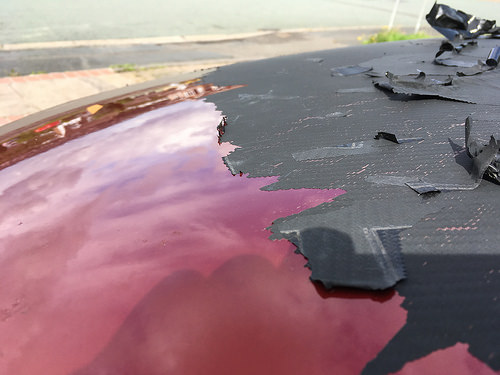

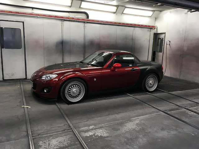

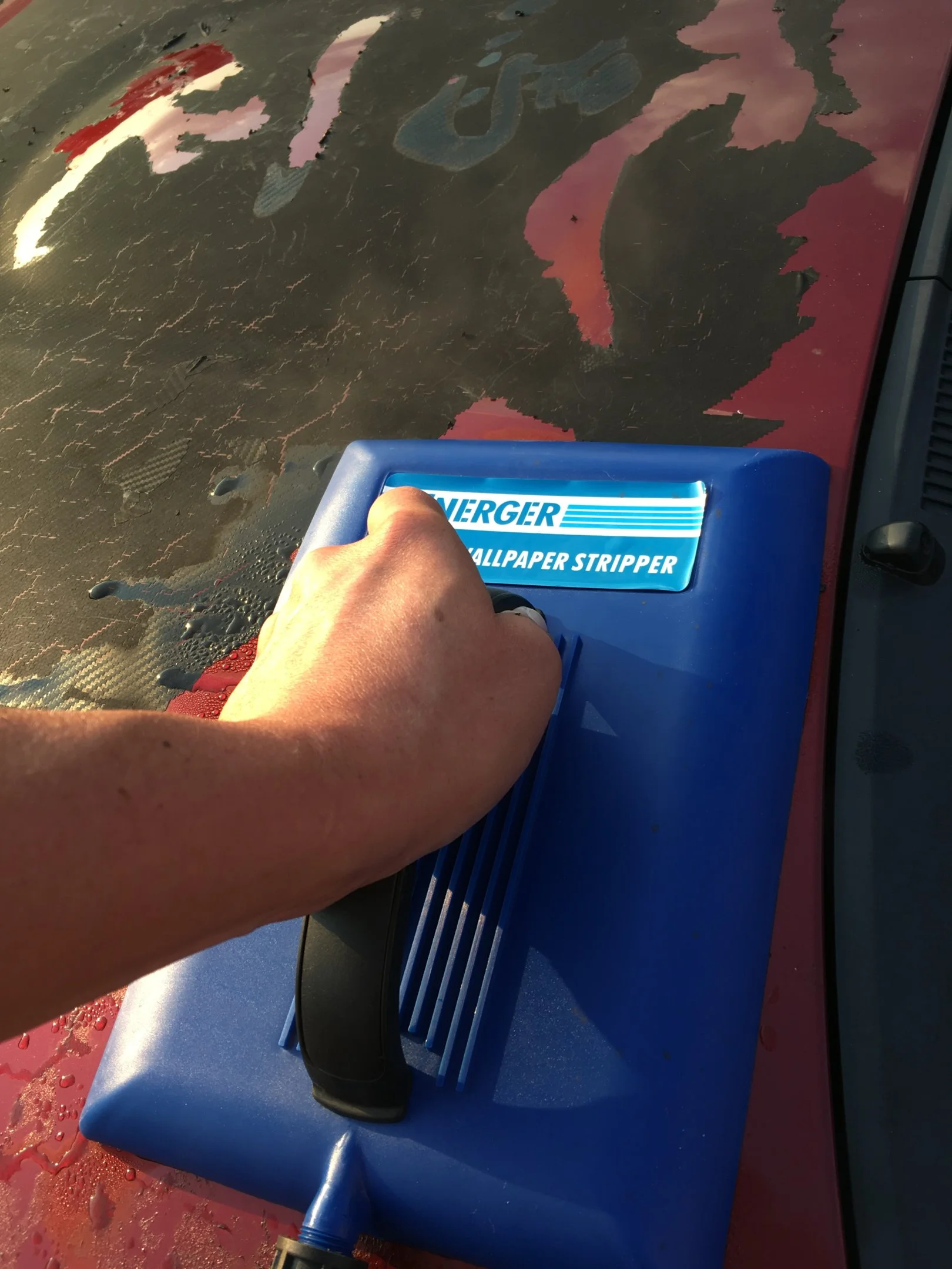

The only issue I've got at the moment is getting the f*cking wrap off! The main bodywork of the car is just matt grey, but the bonnet and roof are carbon effect and it just doesn't want to budge... I've even borrowed a heated paint shop booth and at high temps it's still a nightmare to peel off...
If anyone has any ideas or suggestions they'll be very welcome!
Once the wrap is removed I'll get the mirrors and other bits painted either black or matching red, then swap the stance wheels for something more to my taste.
Jekyll
I'd add some degreaser to it after it's been on bake. Let it soak for a bit then peel off. The body shop your using should have some.
I'm not saying it'll work but it certainly will help. I don't know how stubborn the carbon wrap stuff is.
Mr Burns
  Swift Sport
Cheers for the suggestion. The worst part is that the carbon wrap won't peel, it just breaks up. It'll going to take weeks unless I can find a quicker way.

It's an absolute b*****d to remove wrap. I fucked up the rear wings when I was wrapping the kitcar. Was so much of a c**t to remove, I ended up buying new wings!
The most success I had was with a heat gun. Easier with two of you so one can heat the vinyl, and the other can use both hands to peel off the wrap

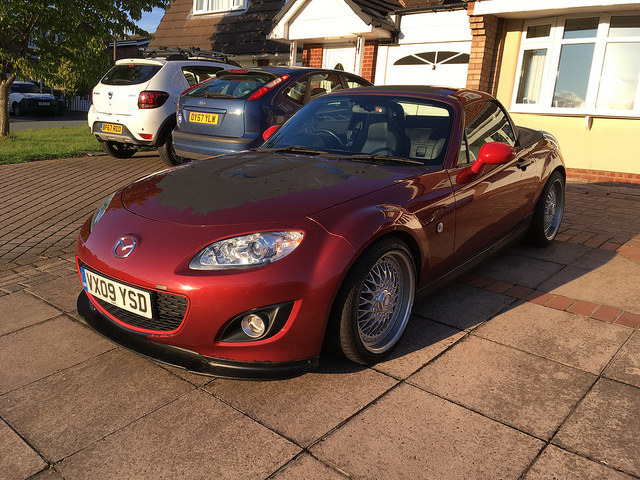

Luckily it's all off bar the roof and the bonnet which are changeable if need be... I'm certainly thinking of getting the bonnet repainted or even buying another.

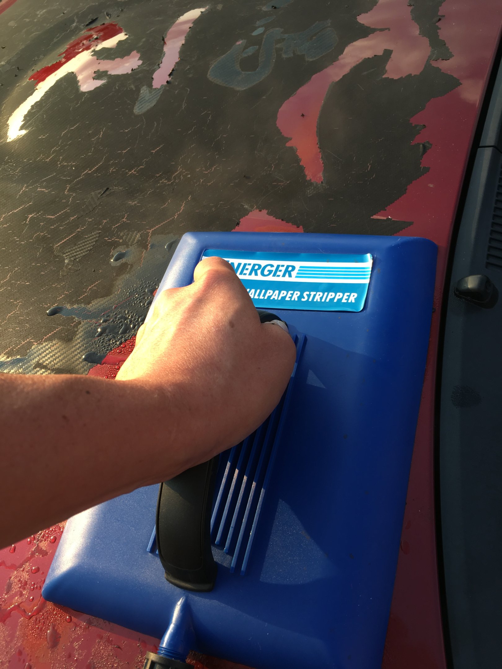

If you scuff the surface of the wrap does it help the steam penetrate and help lift it off??
Obviously only do that if it won't damage the paintwork underneath.
Mr Burns
  Swift Sport
All the steam really does is soften the glue and the wrap enough for it to peel a little bit... It speeds things up but still takes hours!

It will be lovely once the wrap is fully removed and the wheels sorted. Just in time for winter..lol
That's kinda why I moved on from the Mk1... I can book winter trackdays and not feel guilty about tracking a 27yr old car, plus I've still got the ST for a bit of variety.

I'll get the glue off with solvent remover, which my mate who works at a bodyshop gave me.
Wheels are 5x114.3 unfortunately, but I've heard it's a common fitment.
I might keep these wheels for the road and buy some more for trackdays. Either way I should be significantly quicker than I am in my Mk1.
