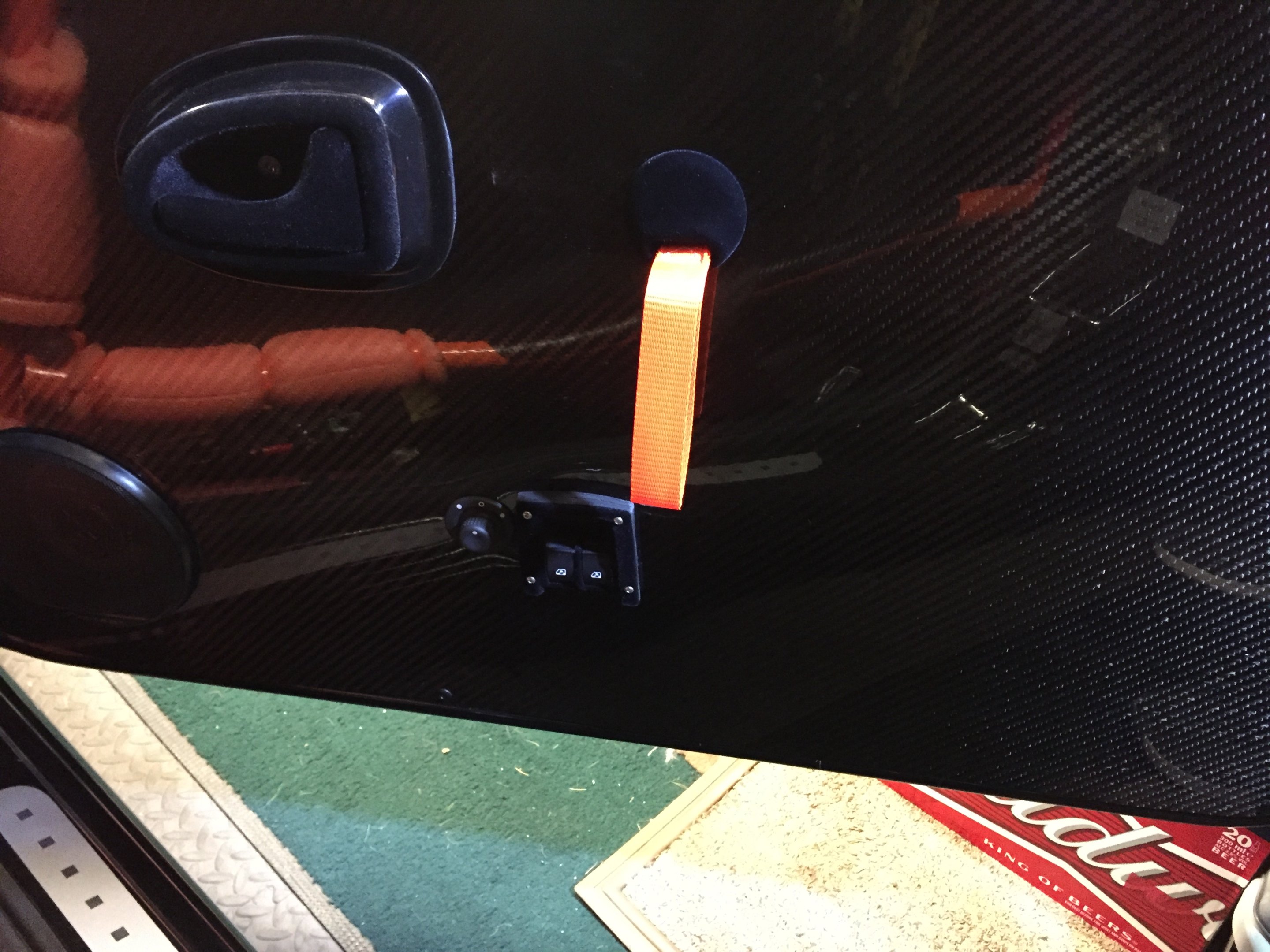

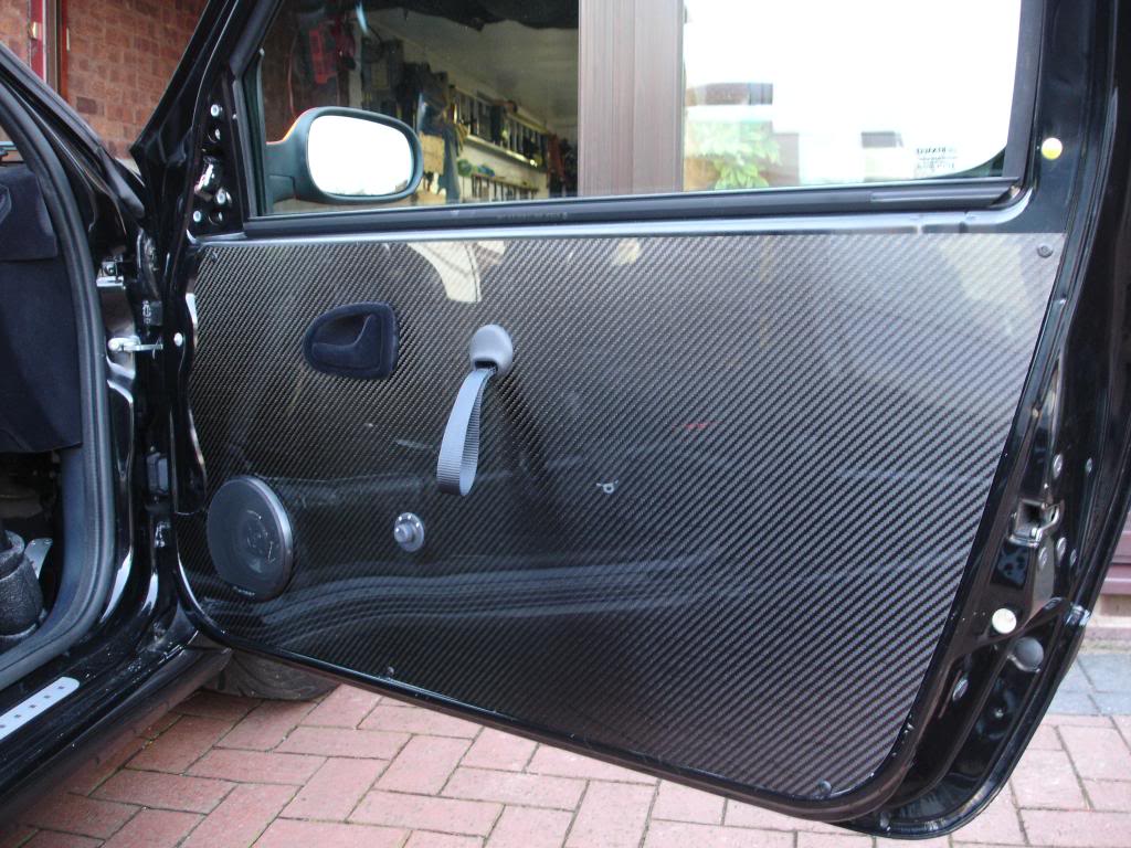

The carbon door cards are all fitted now just need the handle spacers

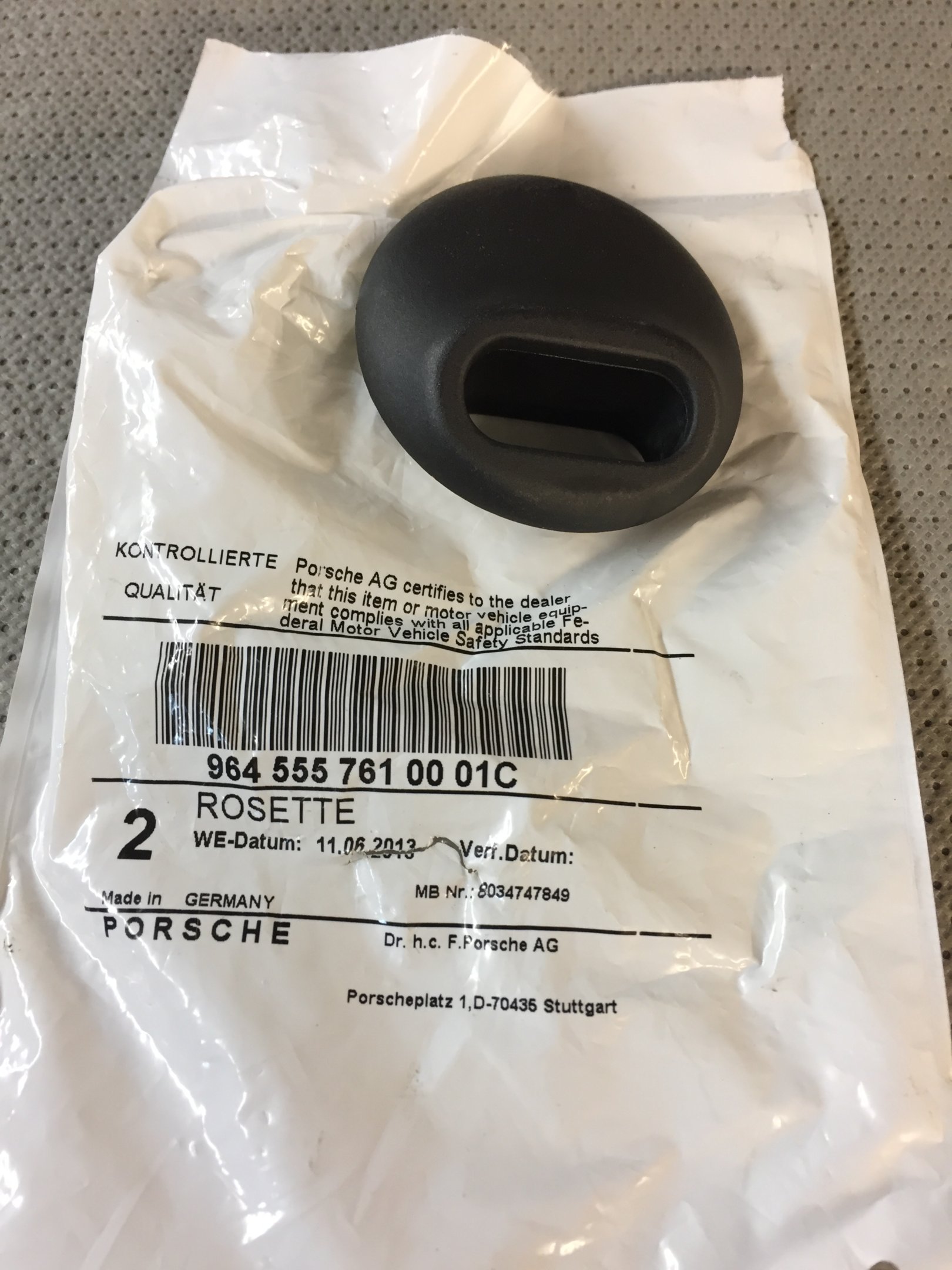

What door pulls are you using and what are the surrounds from? They look quite neat.

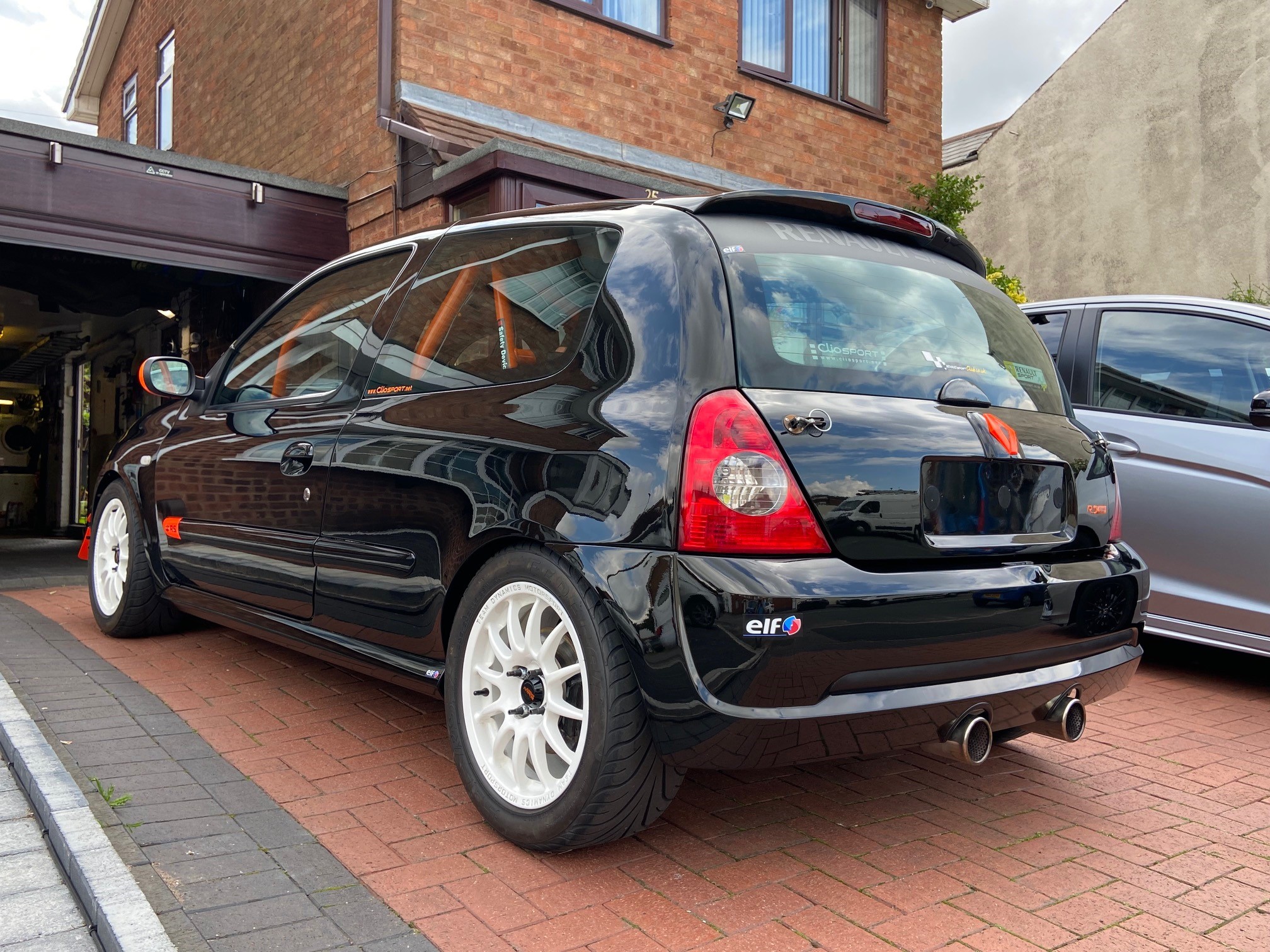

It is Halfords anthracite wheel paint same as what I used on the inside just lacquered on the inlets.
http://www.halfords.com/motoring/pa...s/halfords-wheel-paint-anthracite-spray-500ml
How did you get on with this paint? Does it go on ok and how durable is it? Does it resist scratches and stains ok? Does it give a smooth finish that doesn't trap dirt?
The door pulls are TRS ones and the surrounds are from Porsche, I will sort you the part numbers out later they were only a couple of quid each.
The paint is really good I have not lacquered it but it seems nice and durable, never going to be as hard wearing as a professional paint job but it only cost about £25

Yeah would appreciate the numbers for those. I like a nicely executed door pull!

I am more than happy with the finish and the advantage to a rattle can if it gets scratched it is easy to touch up again.
These are the door straps and Porsche trim.
https://www.ebay.co.uk/itm/TRS-Moto...p-Race-Rally-Grab-Handle-Single-/251472870112

Perfect, thanks guys, will get a set of those. Cheap really.

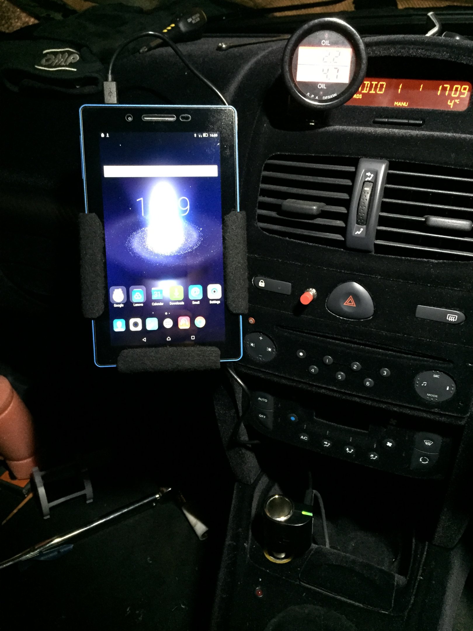

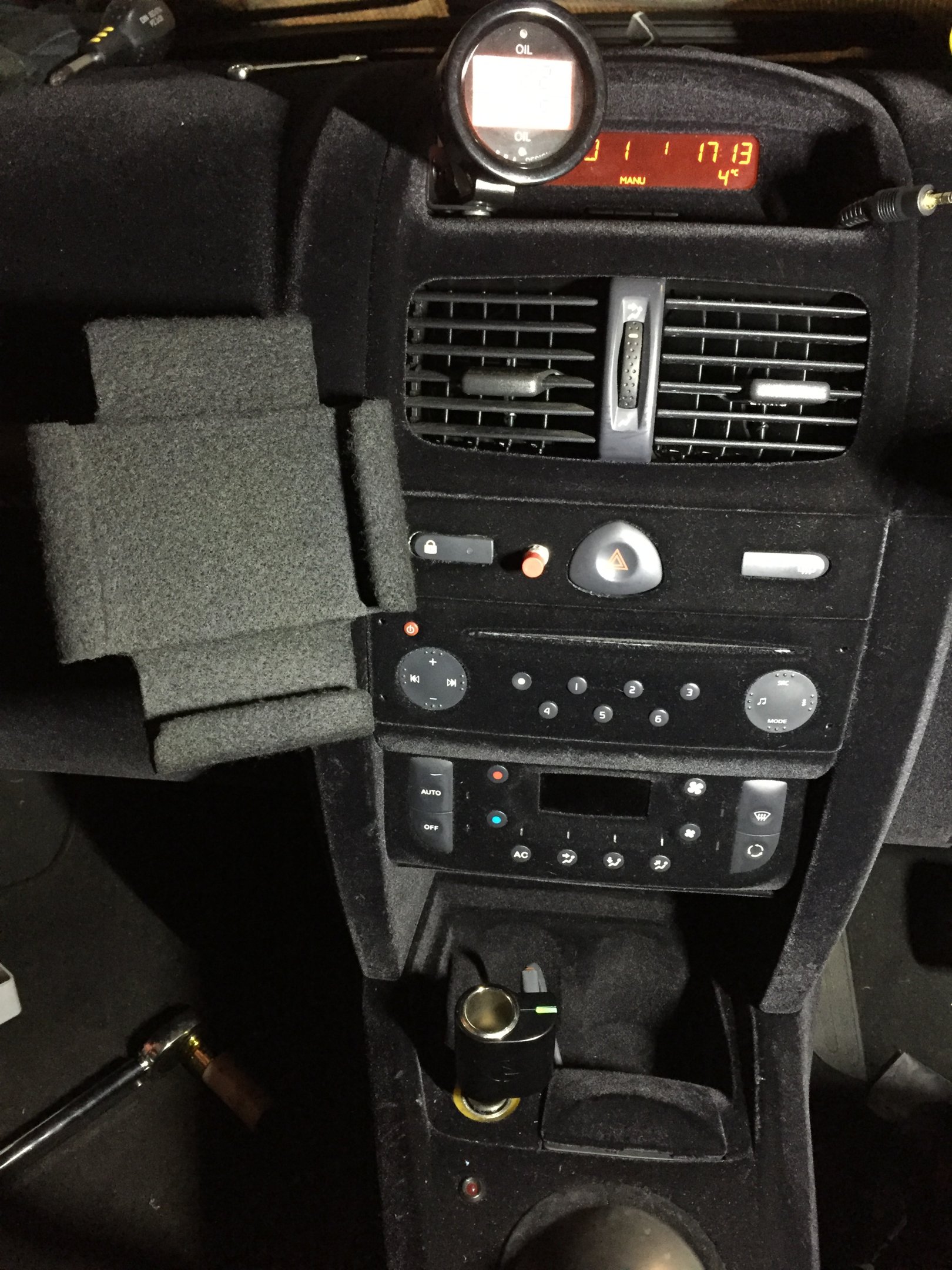

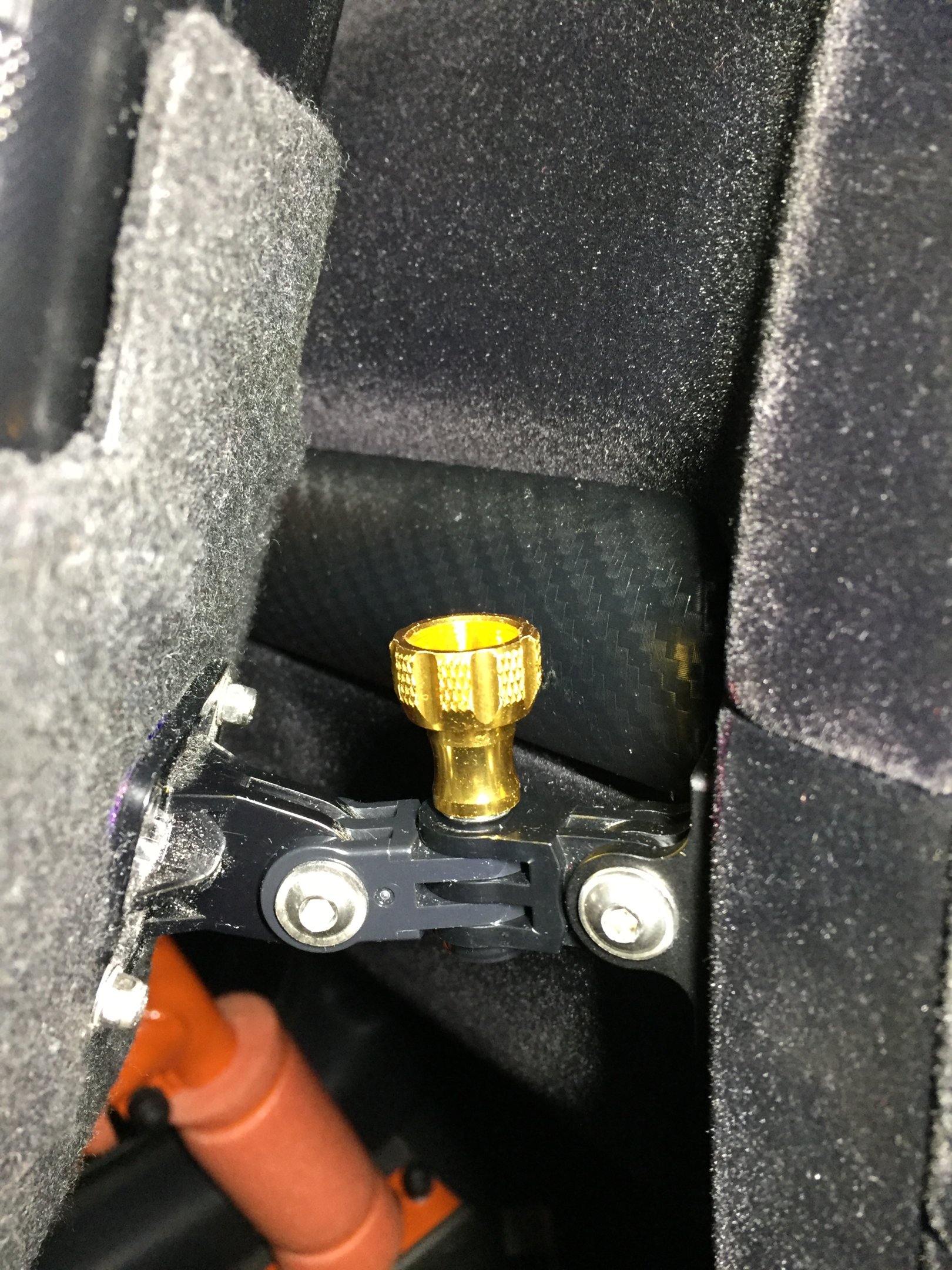

I brought a small tablet in the black friday sale as I had a thought of using torque pro app or Harrys laptimer on it also use it as a sat nav but then I needed a neat way of mounting it as I don't like all sorts of crap stuck to the screen, after a lot of searching I gave up and decided to make my own.
So with some thin aluminium sheet, go pro mounts and some sticky backed felt the mount was made I am pleased with the way it has come out.

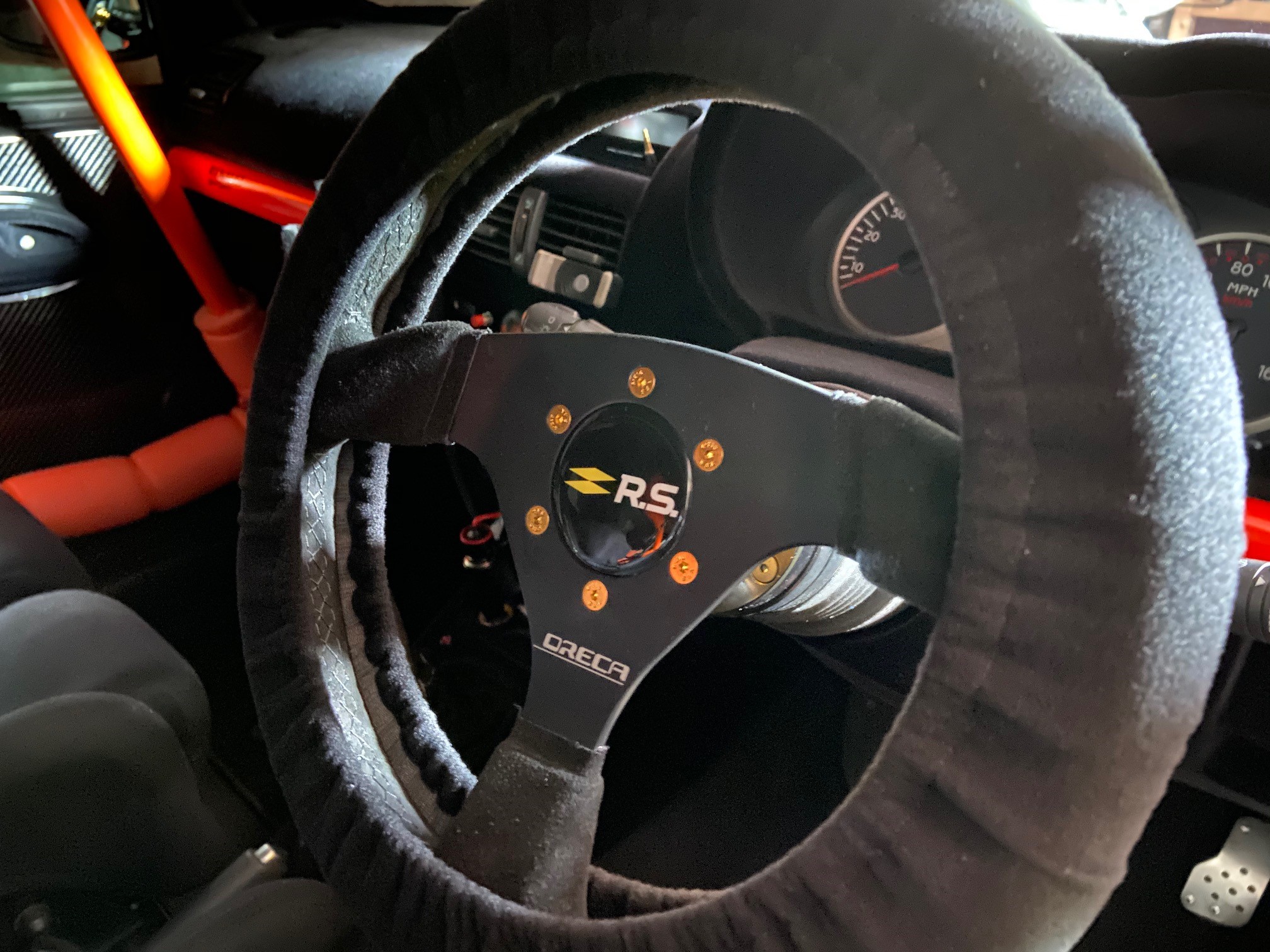

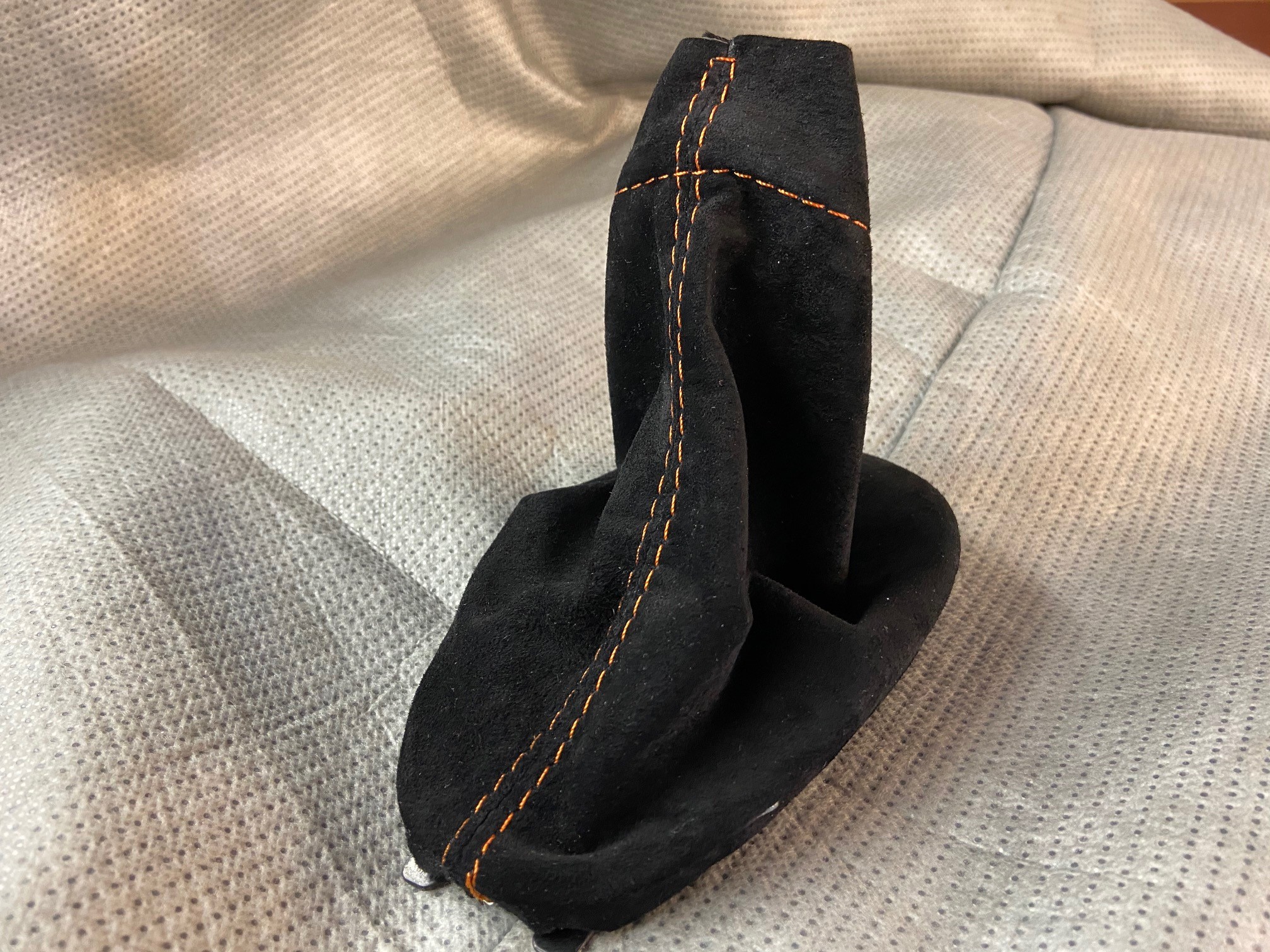

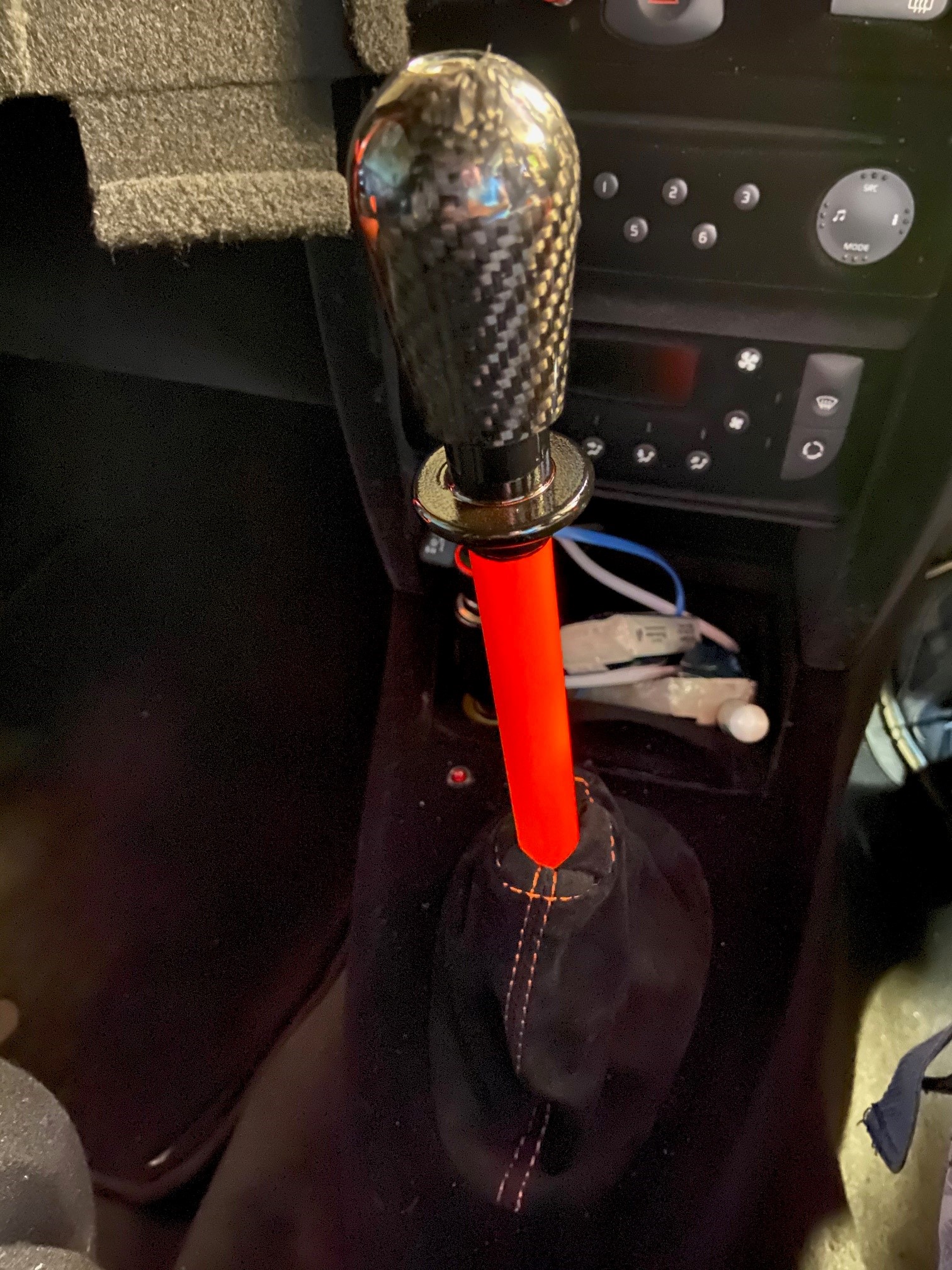

I have not done much now just refresh a few painted parts changed the PMS shaft to orange, had a black suede gear gaiter with orange stitching made and carbon skinned the shifter knob.
I never liked the hole in the centre of the steering wheel so had a gel badge made up.

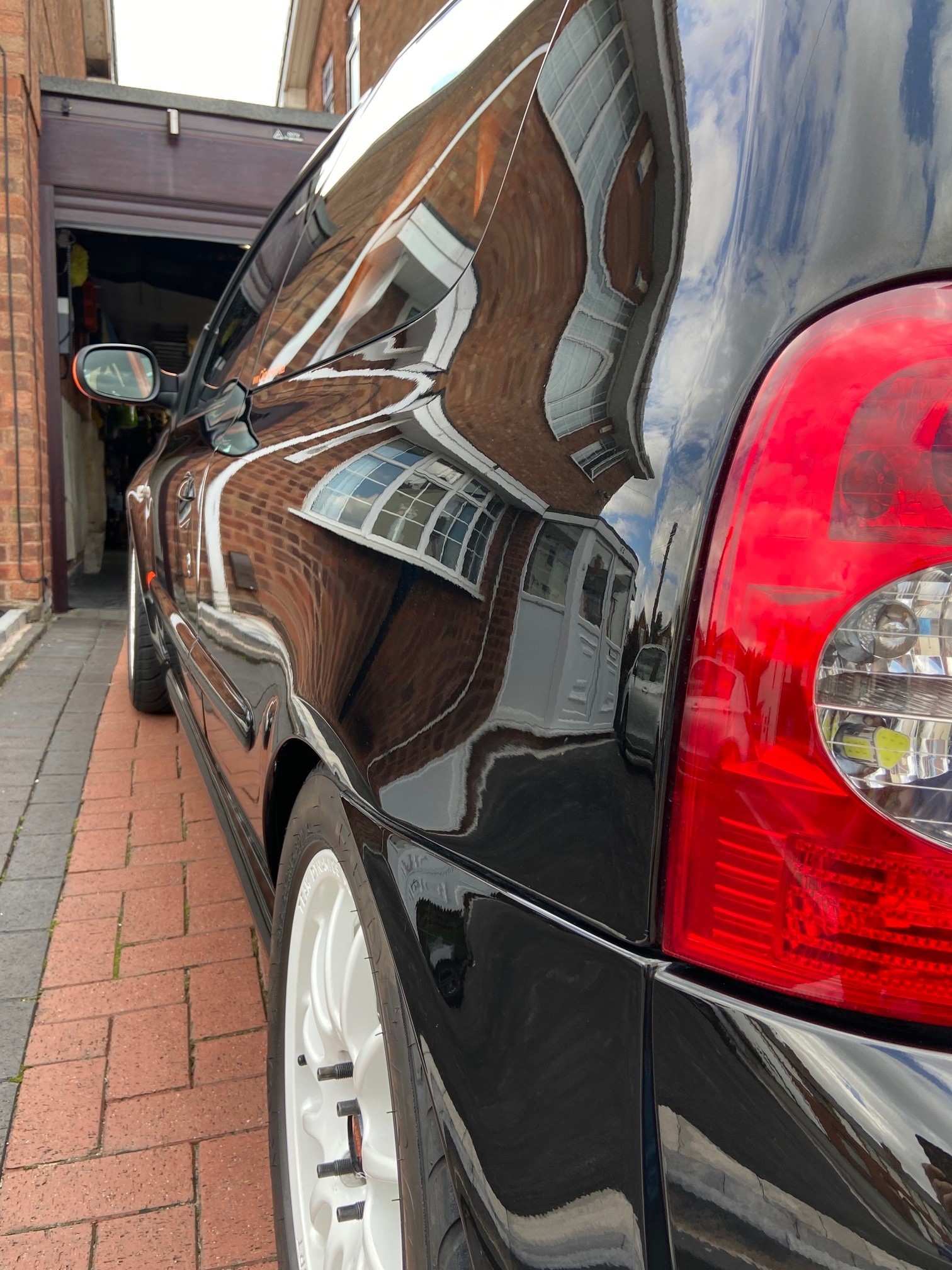

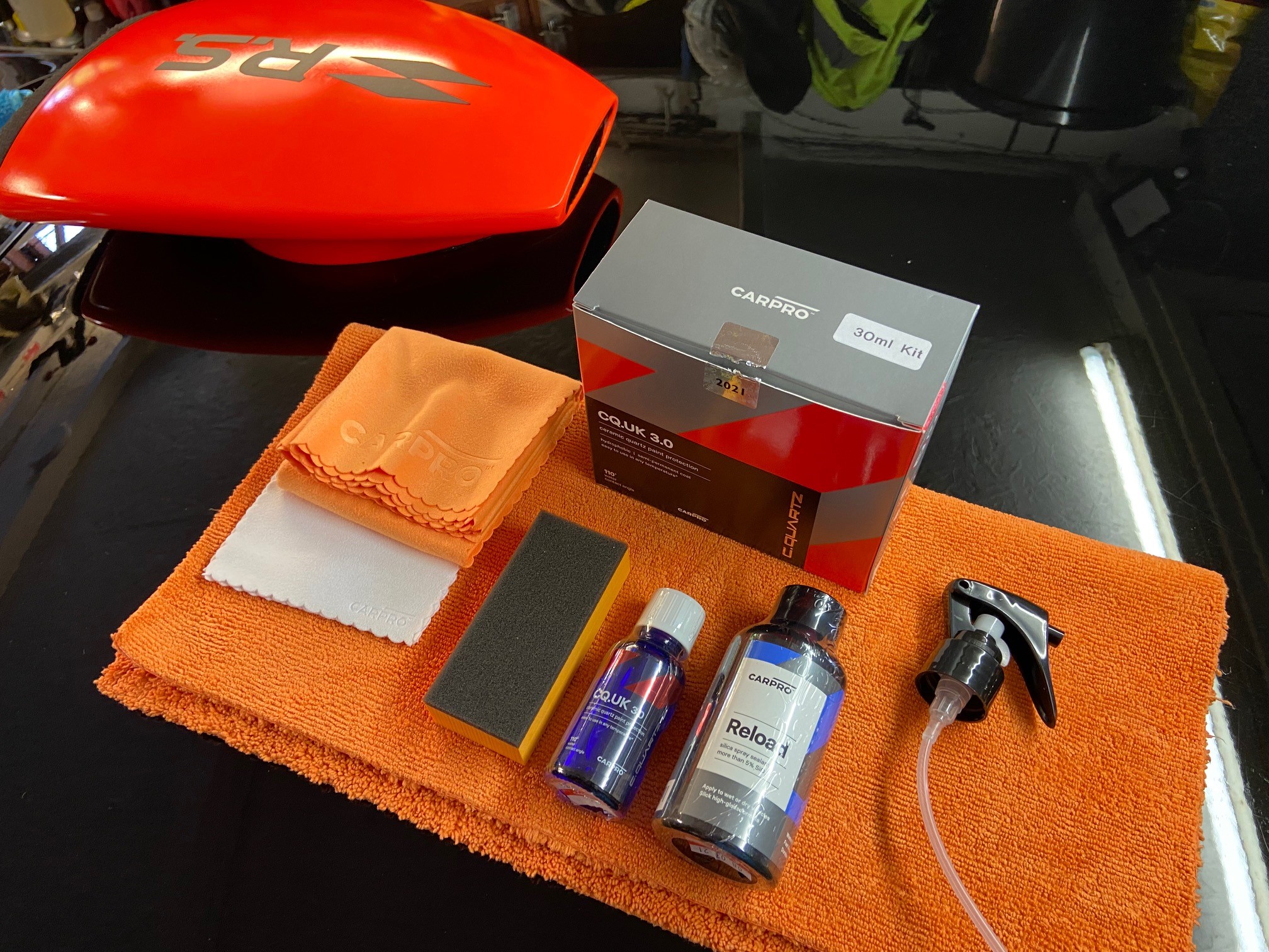

Over the last week I gave the car a 2 stage polish and then ventured into the world of ceramic coating, applied 2 coats of Carpro CQUK 3.0 and a coat of reload.
It has come out really well.
