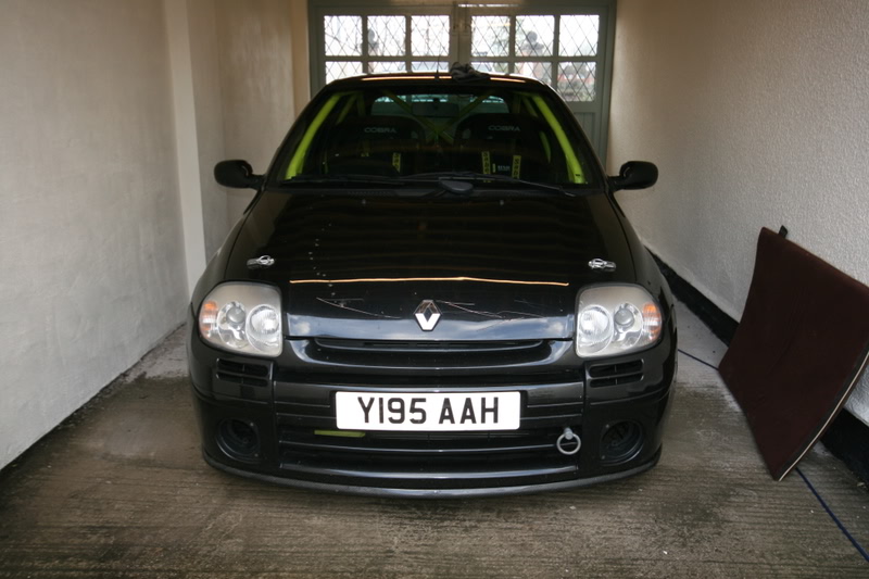

before the car goes back to angel works i decided to sort (have a go) at fixing the shocking state of the paint,
whilst buiding the car for the last year the paint was coverd in dust and allsorts. so when i wiped out the mop and bucket.... it was a swirl city!
process was..

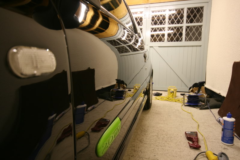

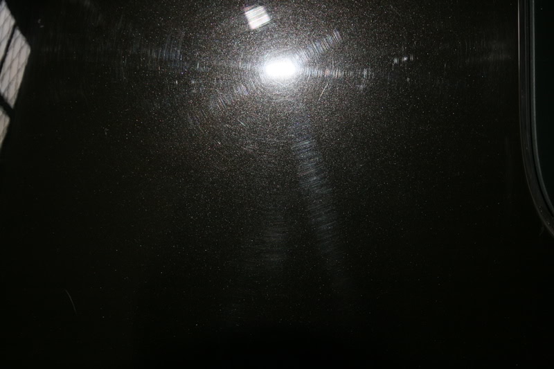

some shots, it was really hard to get soem decent pics. i only did one rear quarter and one quater of the roof..

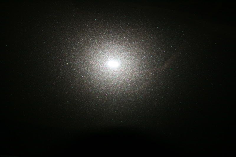

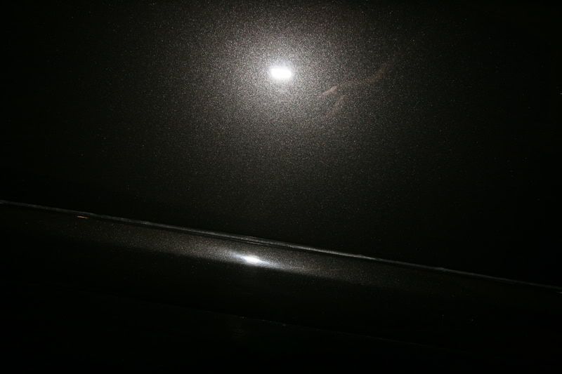

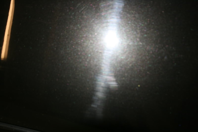

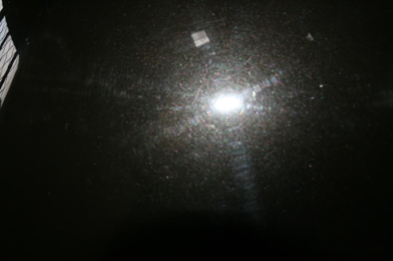

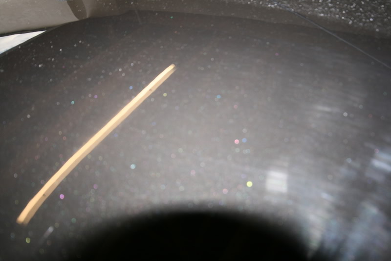

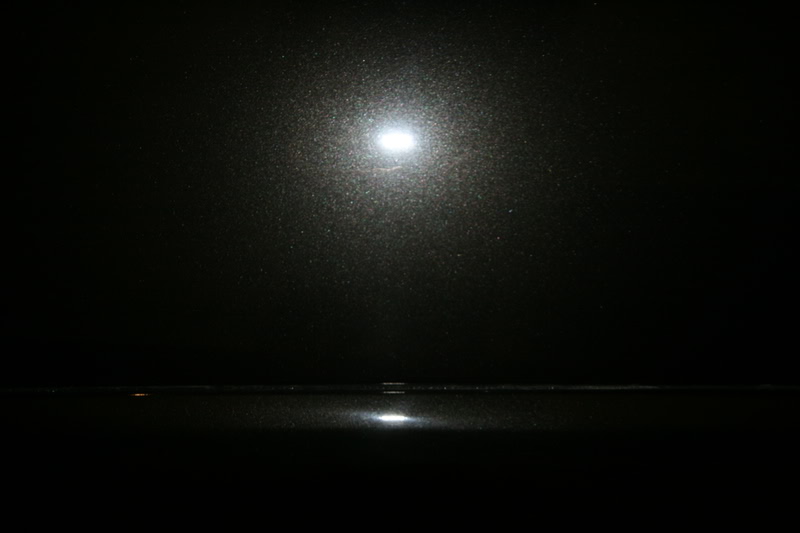

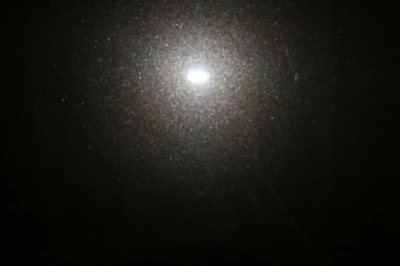

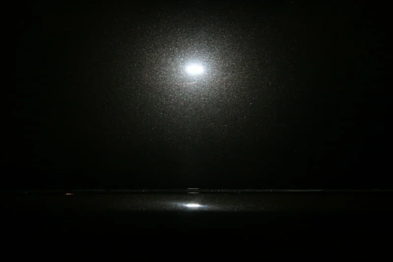

roof before;

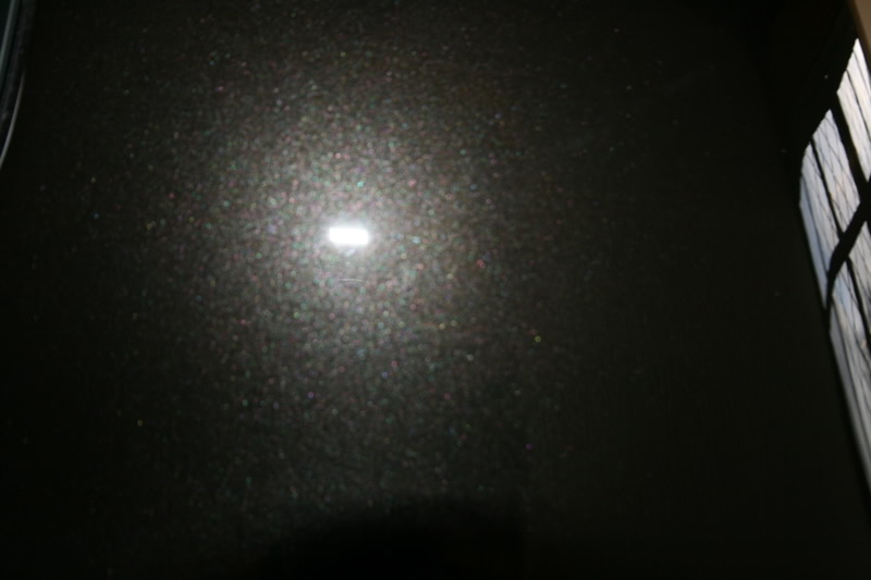

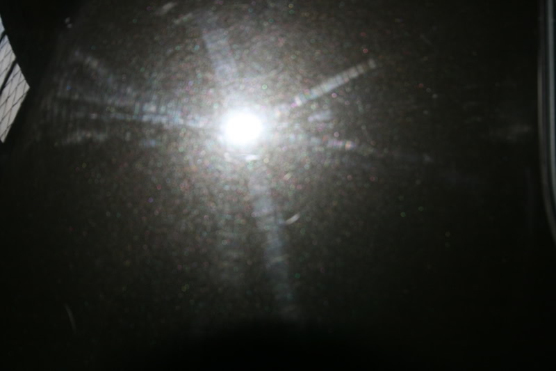

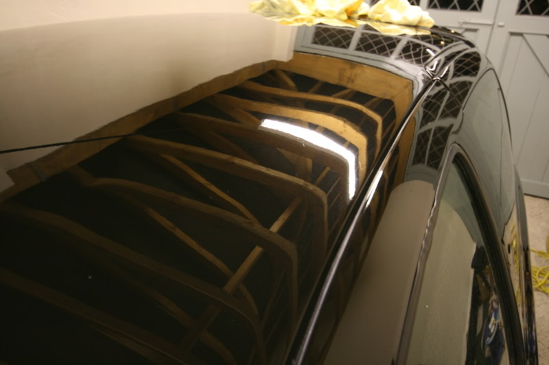

roof after

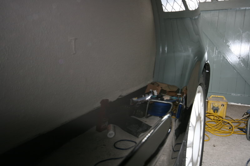

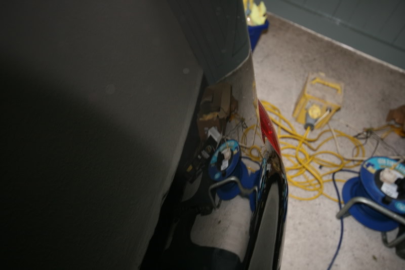

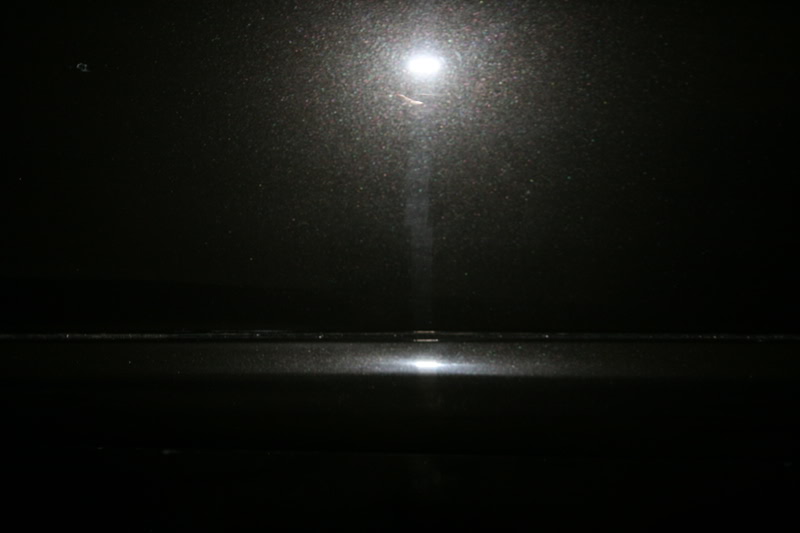

rear qauter before

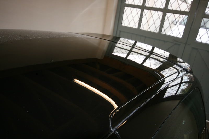

rear qauter after
from inspection with a LED light, i got rid of all the swirls and marks!
that line you see on each "after pic" is the stainles lip on the lense reflecting.
what you think?

looks alot better,
im so glad my car is silver tho lol
not been following the progress of this at all really, whats its going to to ben for now? yet more toys?
  106 GTi

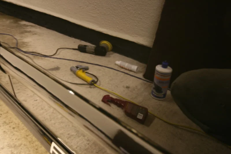

4 inch pads should allow you to do the front valence, a lot looks like it will need to be done by hand.
  CS Dungeon
Do what you can be bothered on the bumper by hand using a filler heavy polish
As per your other post, SRP & EGP should mask any remaining defects which have not polished out
Front bumper will be pebble dash'd after your 1st off anyway lol
Car looks loads better btw

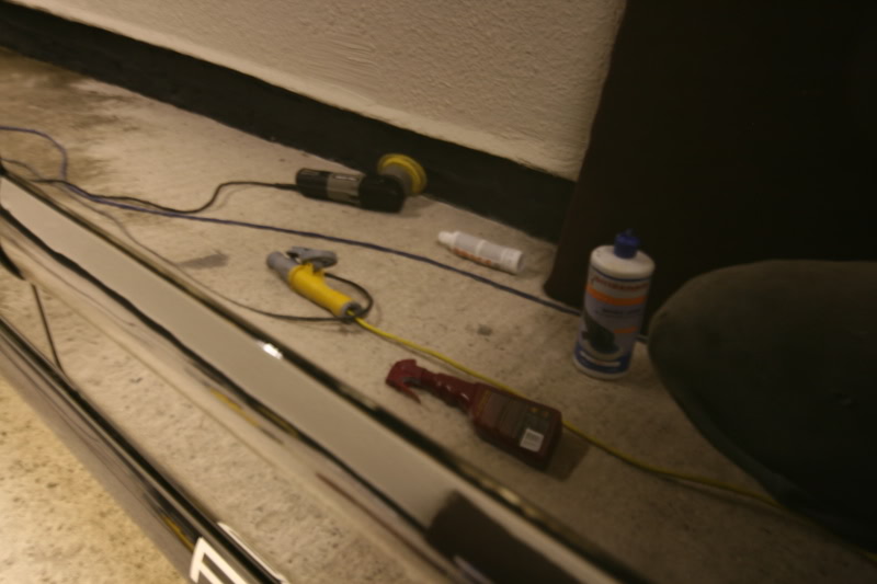

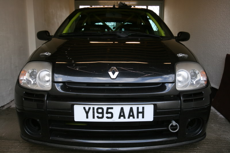

A further 4 hours last night,
managed to get 70% of the door, wing and n/s front section of the roof done.
same process as in the OP

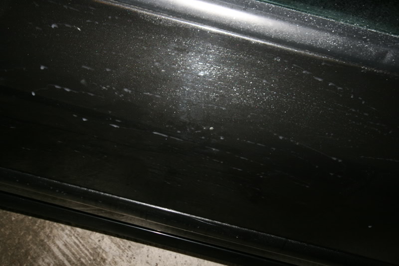

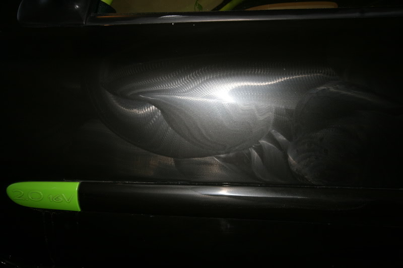

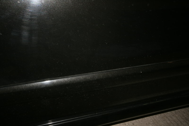

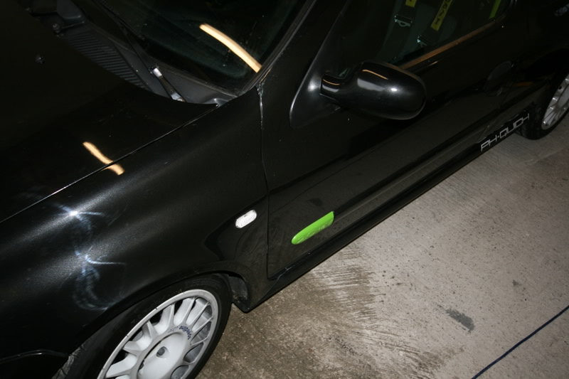

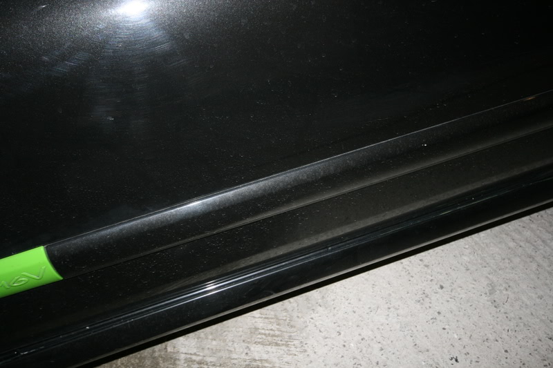

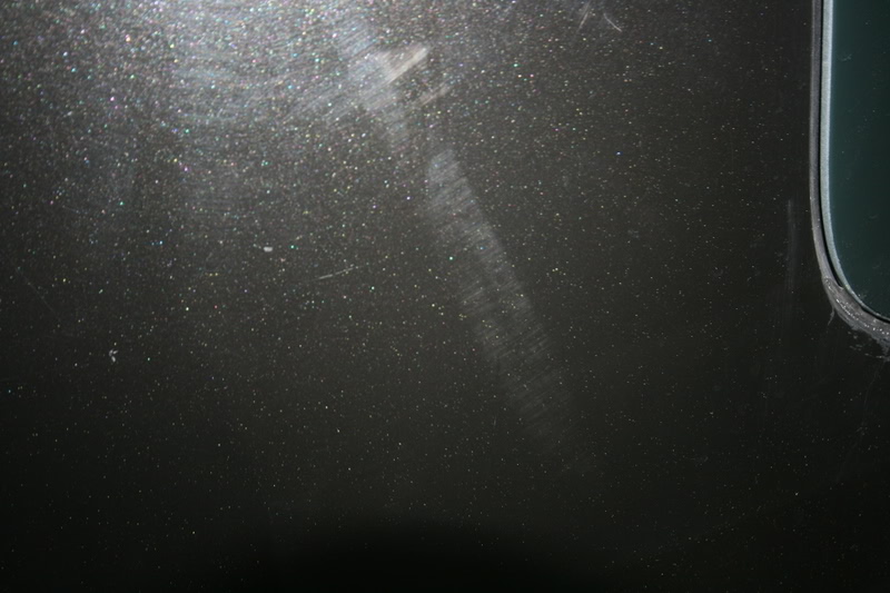

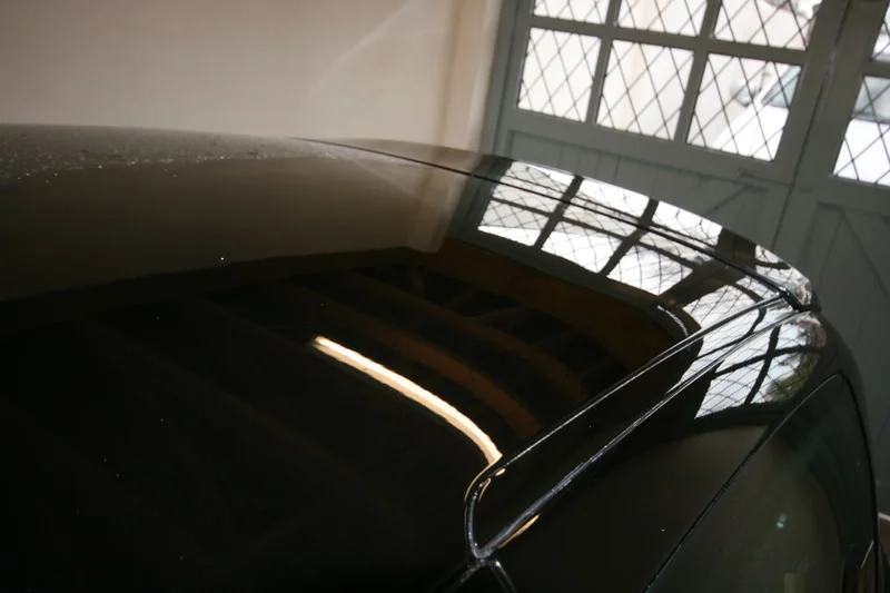

soem shots of the shocking paintwork before, it was hard to get any decent pics, i have no light pen and no tripod!
nice wing ..

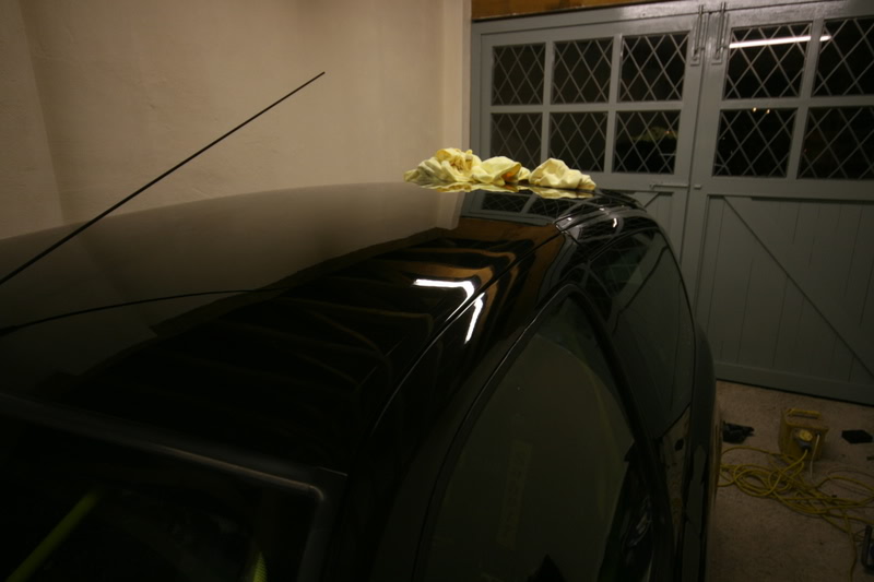

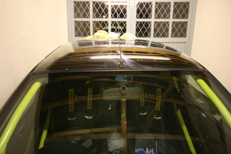

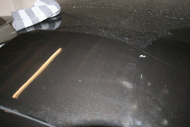

roof!

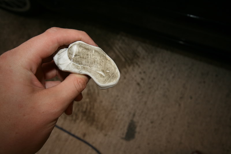

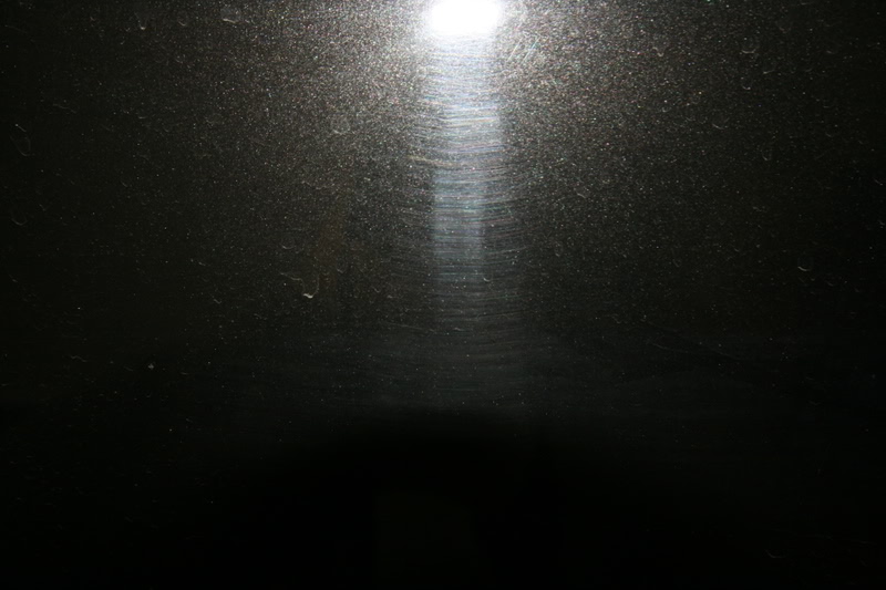

then used the megs clay to remove the shizzle..
this was just off a tiny bit of the roof!
after the clay!

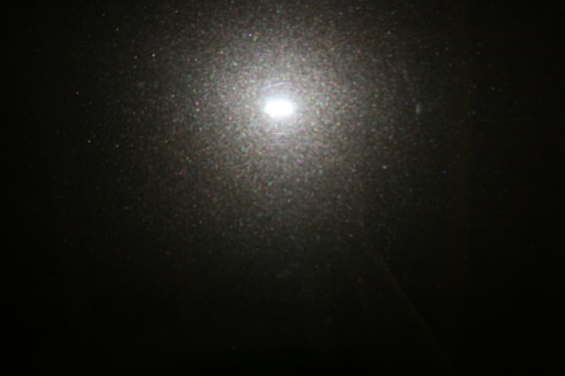

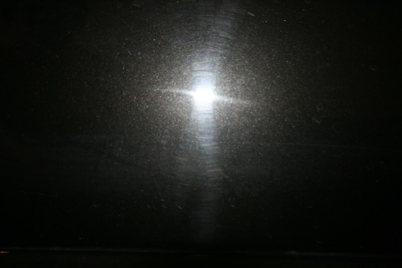

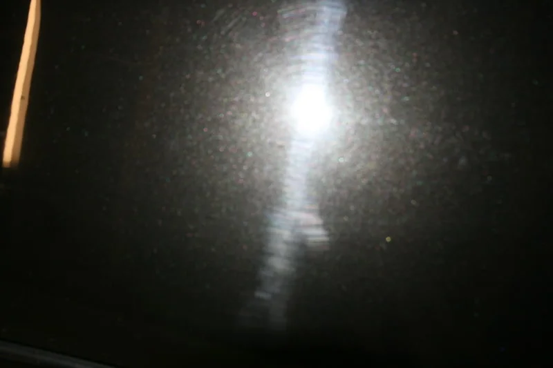

then the 2 passes with powergloss on a lake county orange pad, i had to use a quick spray of detailer as it was drying out too fast!
after one pass of powergloss

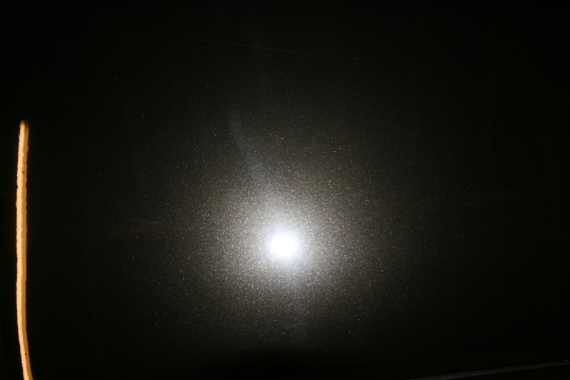

two passes , seemed to remove 90% of the RIDS and swirls..but a bit "dull"

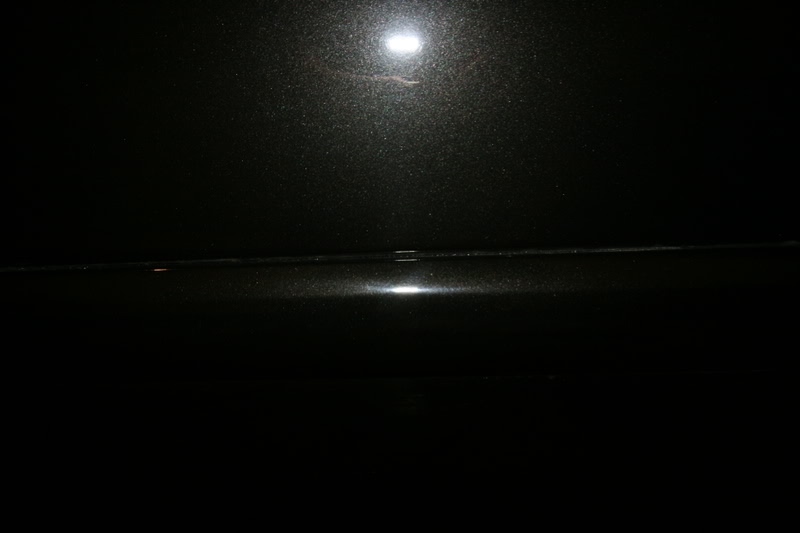

then two passes with the p091L on a yellow pad
after the first pass (getting there!)
second pass,

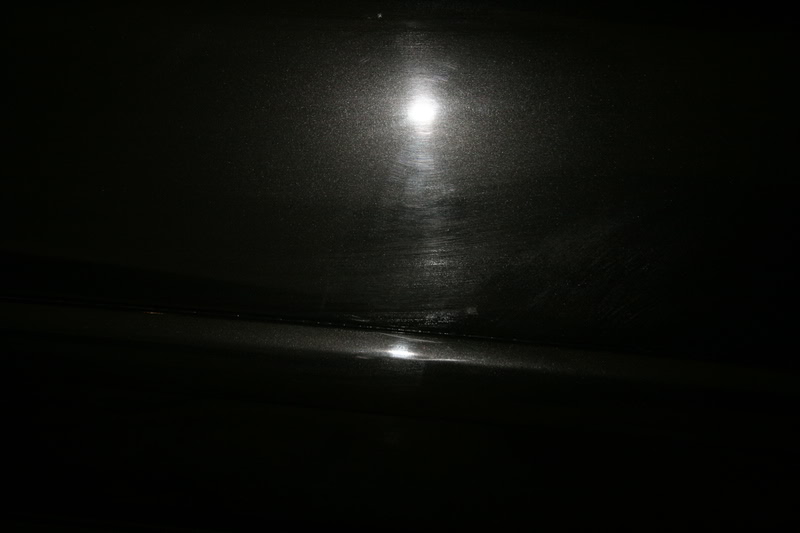

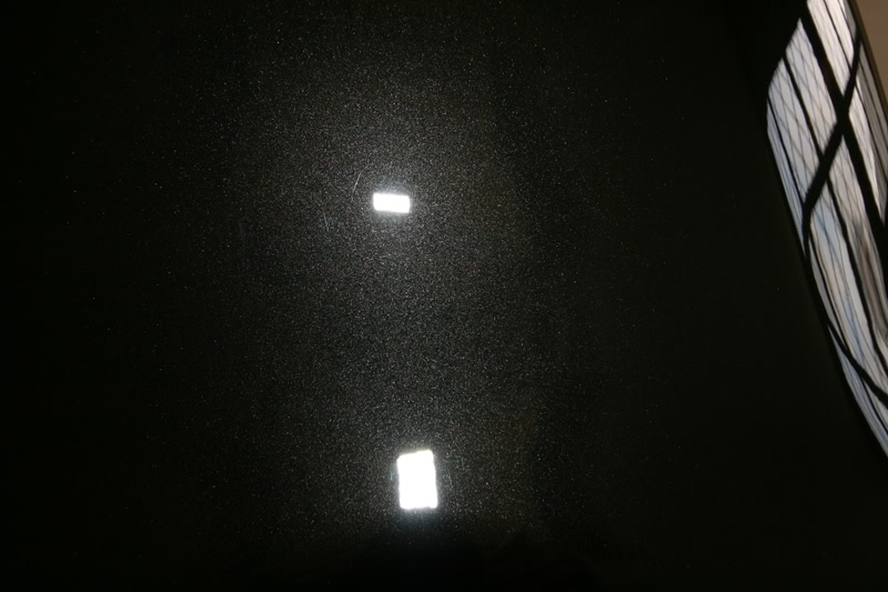

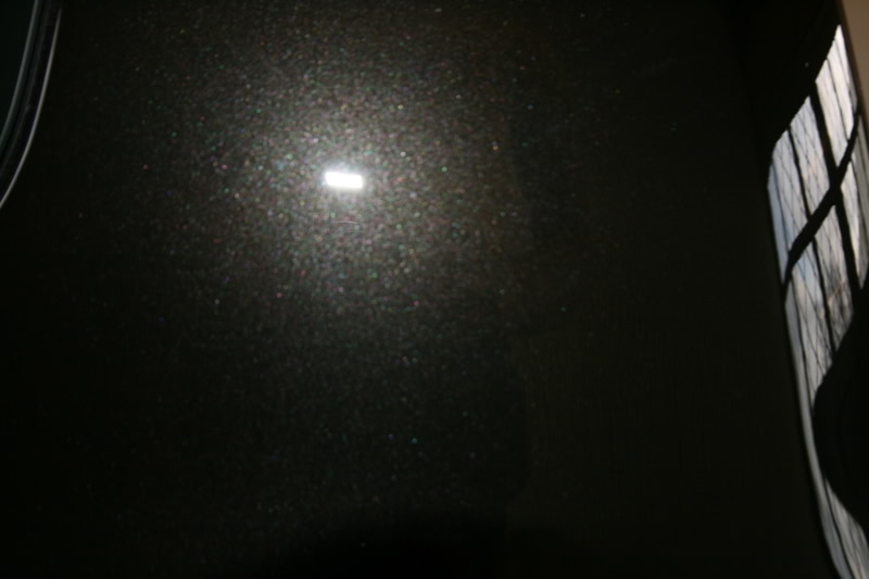

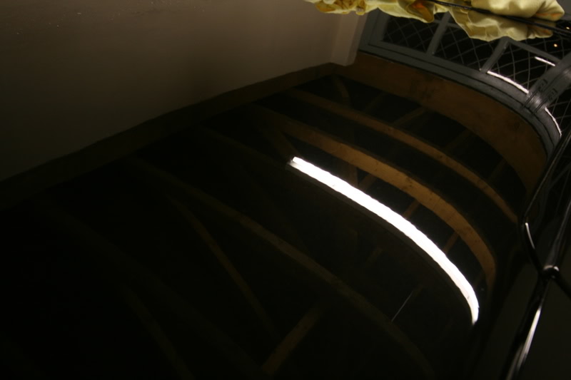

I am now confident that all (as far as i can see) of the swirls and RIDS have been removed! just needed the po58rd to bring it too life!
None of the "front on" shots of the 58rd came out too good, i will get some more tonight!

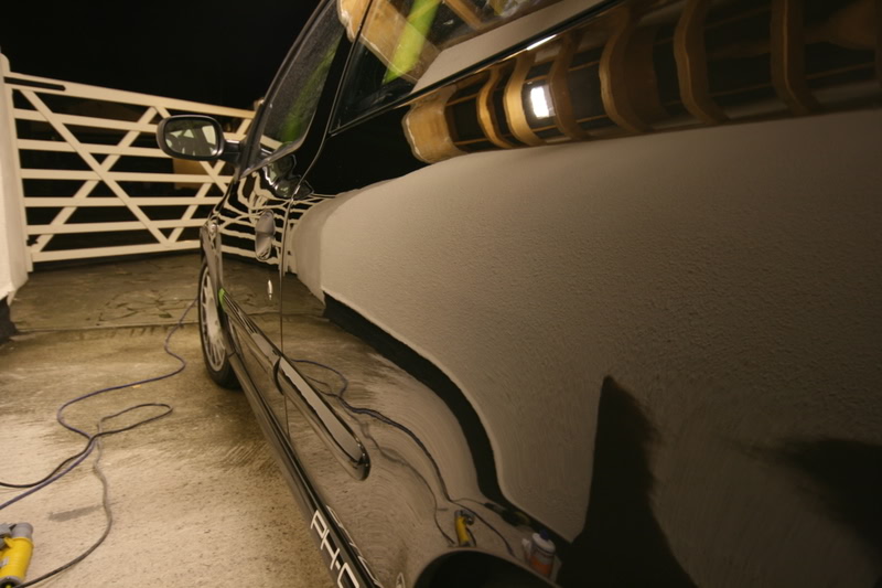

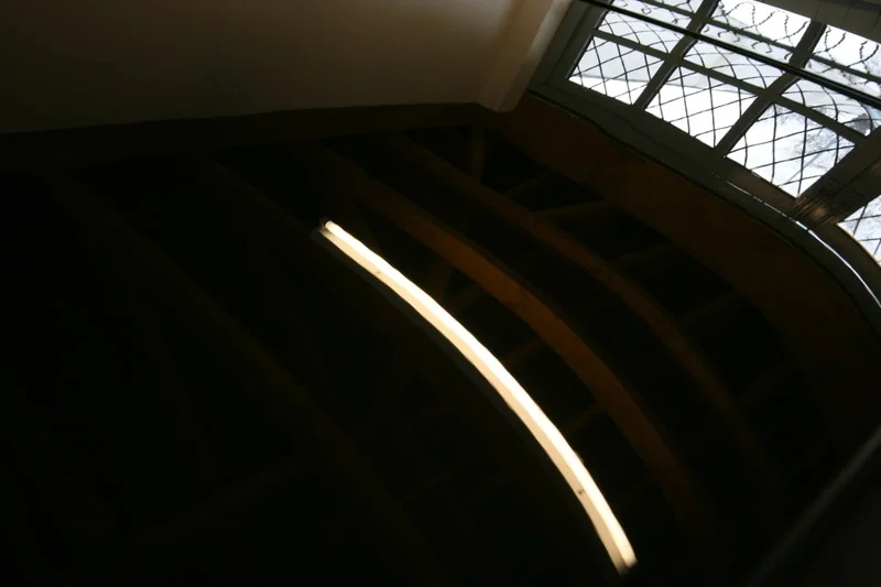

but here are a few shine shots! the paint it starting to look awsome!
sorry about the shaky shots! need a tripod!

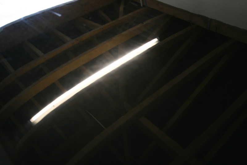

few of the roof, i only got one pas of 58rd on this, still needs to more to shine it up
half and half!
