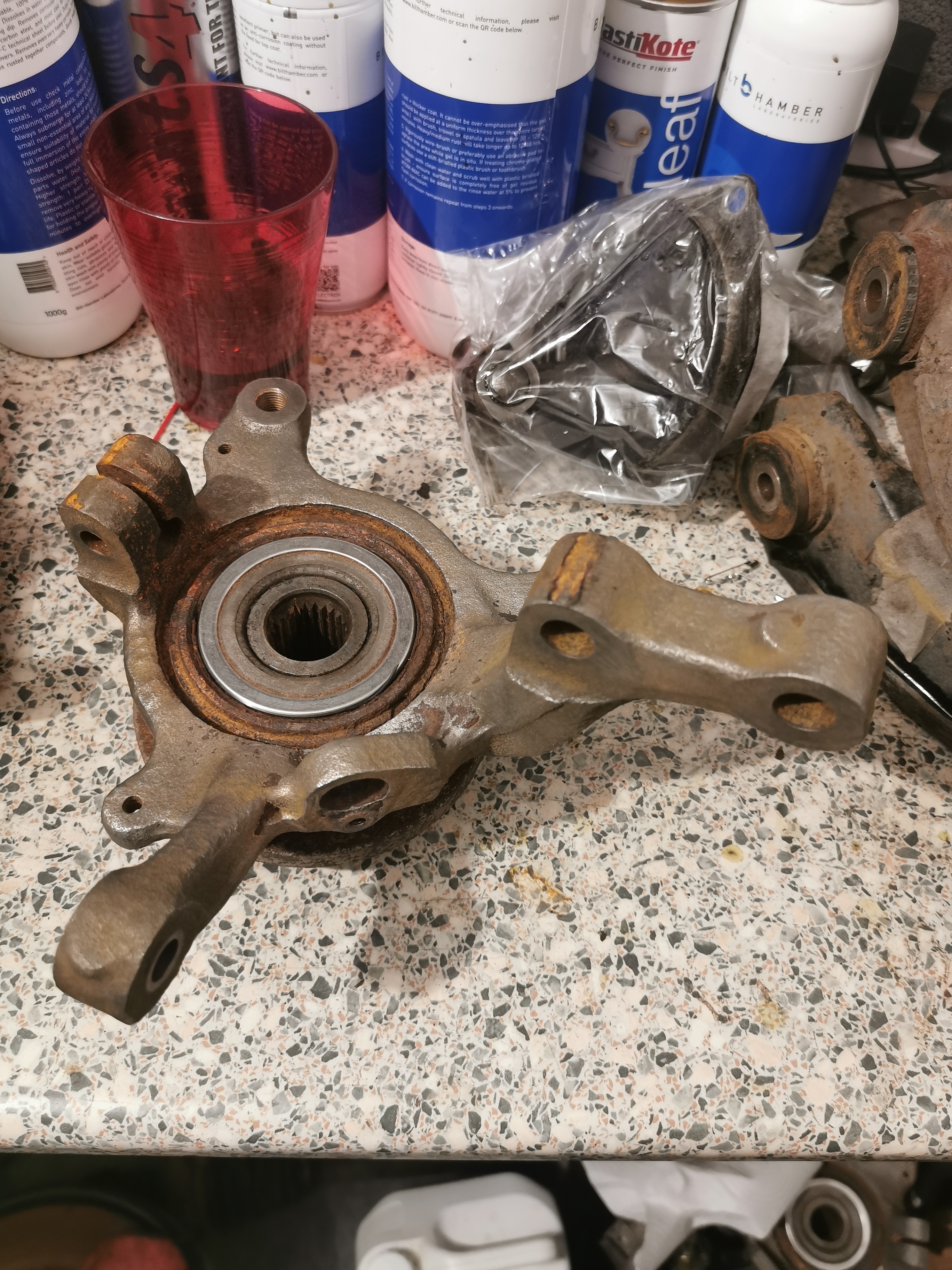

It's getting worse😂. I got fed up being stabbed by bits of wire brush so any parts that would fit went in a bucket of deox-c for rust removal. F me that's impressive stuff! The hubs came out 99% rust free which I really didn't expect.
I've since blathered them in hammerite and taken them to the garage for new bearings fitting. One of the bearings was rough as fook so they wanted doing anyway. Thanks to @Romanian Tyre Fitter for tagging them onto his autodoc order👍. While that was ongoing Kyle collected my gearbox and dropped it off with his mate who works at a box refurb place. Yeah it was fucked! The planet gears had no teeth and every serviceable part was fucked by the lumpy soup. So I needed a new box and luckily @Louis had his old one still and sold me it for a very fair price. Off that went to Kyle's mate and eventually I've got a refurbished box that should work😁. It's now sat in the house while I await a new clutch.

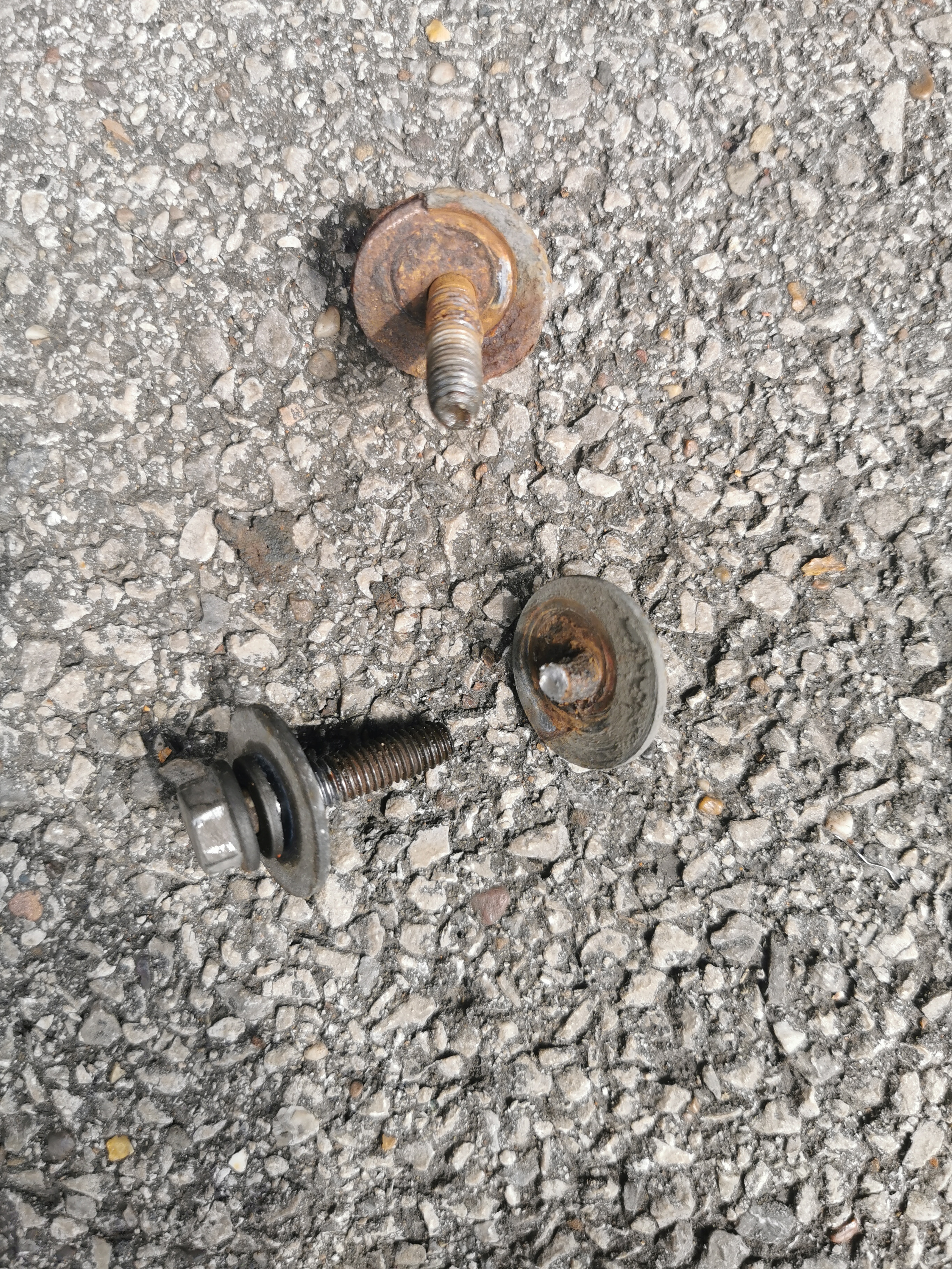

But there's still other jobs to be done. All that rust needs sorting while I can get at it. That meant removing the carbon canister.

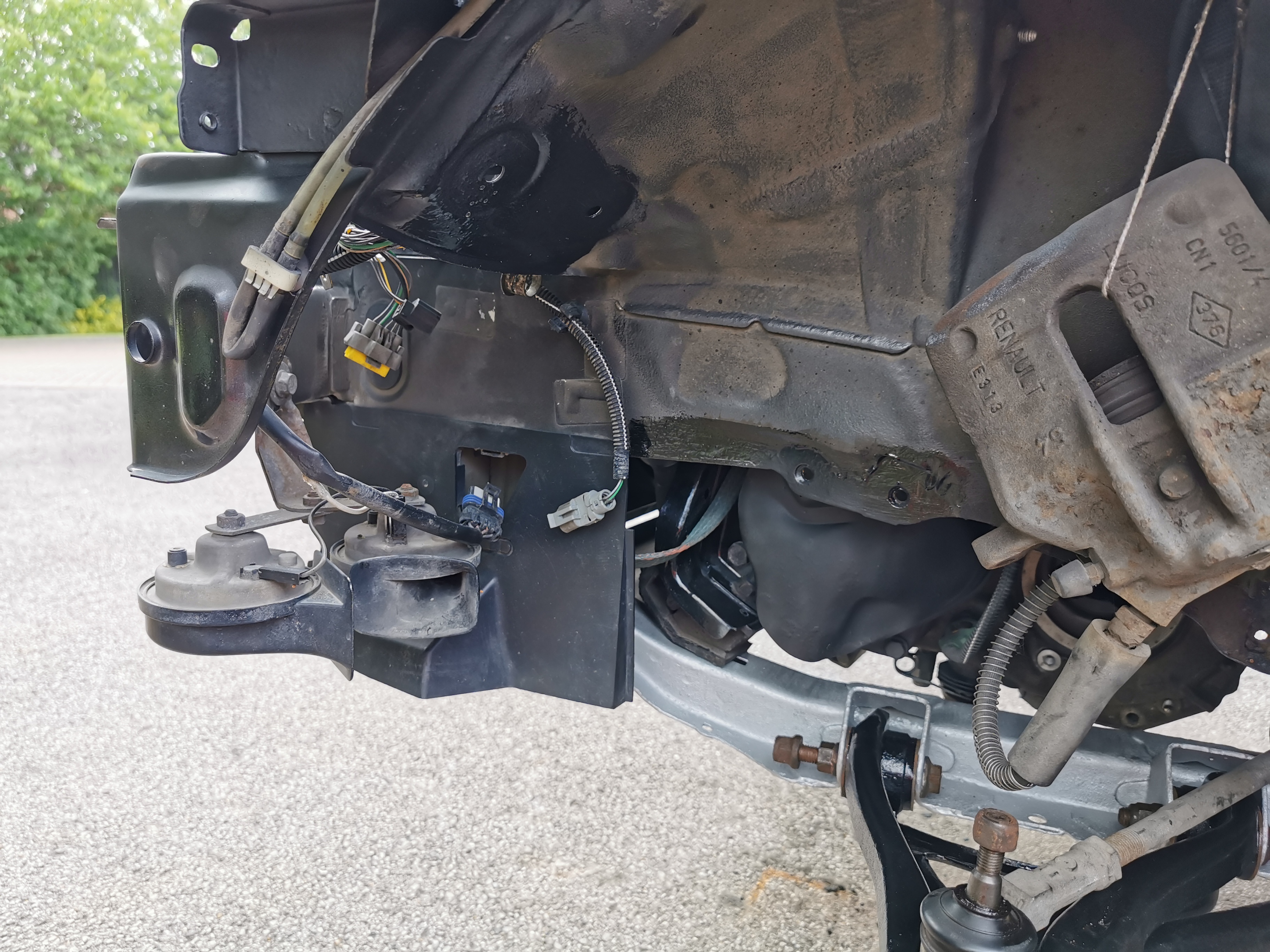

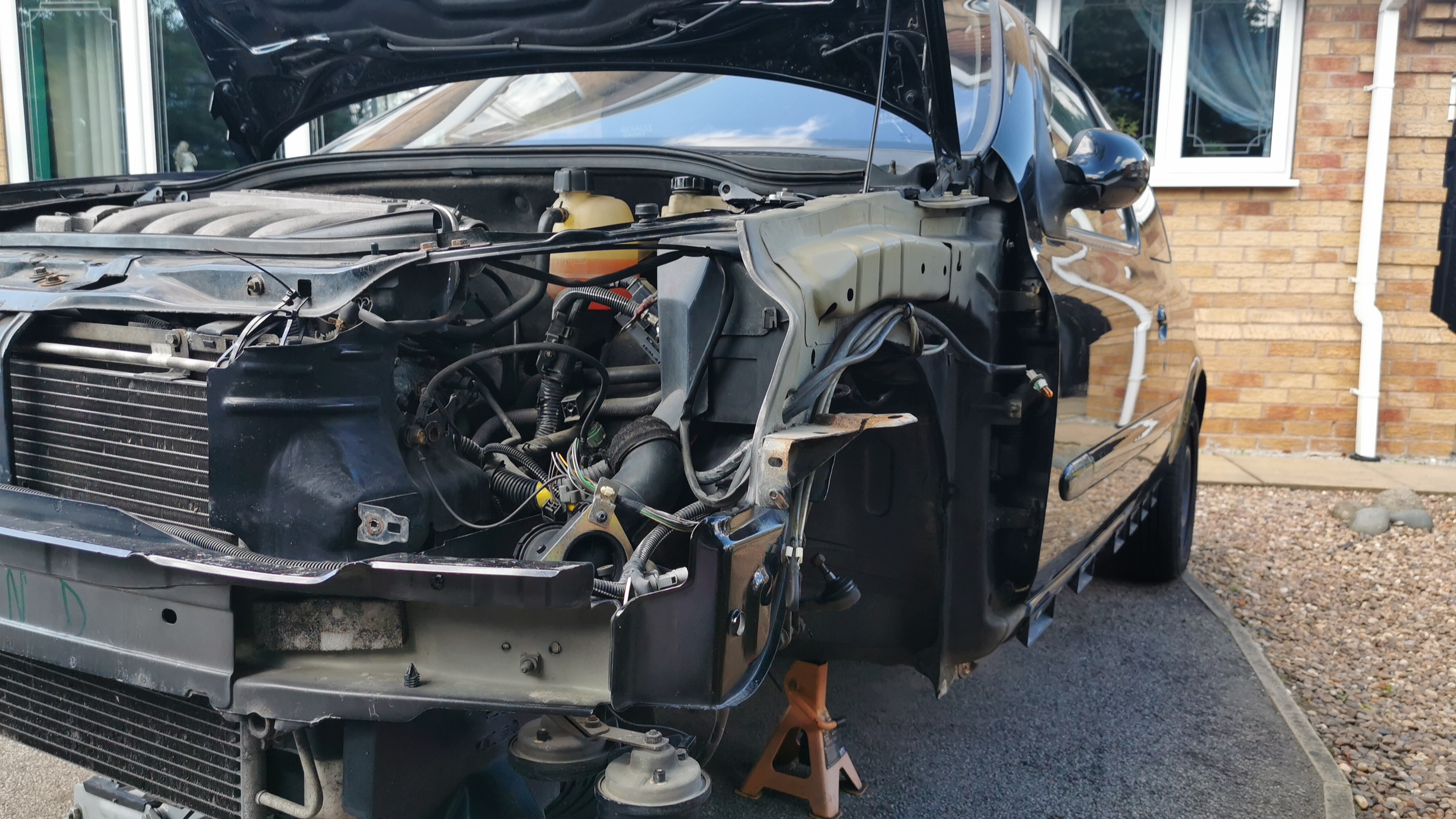

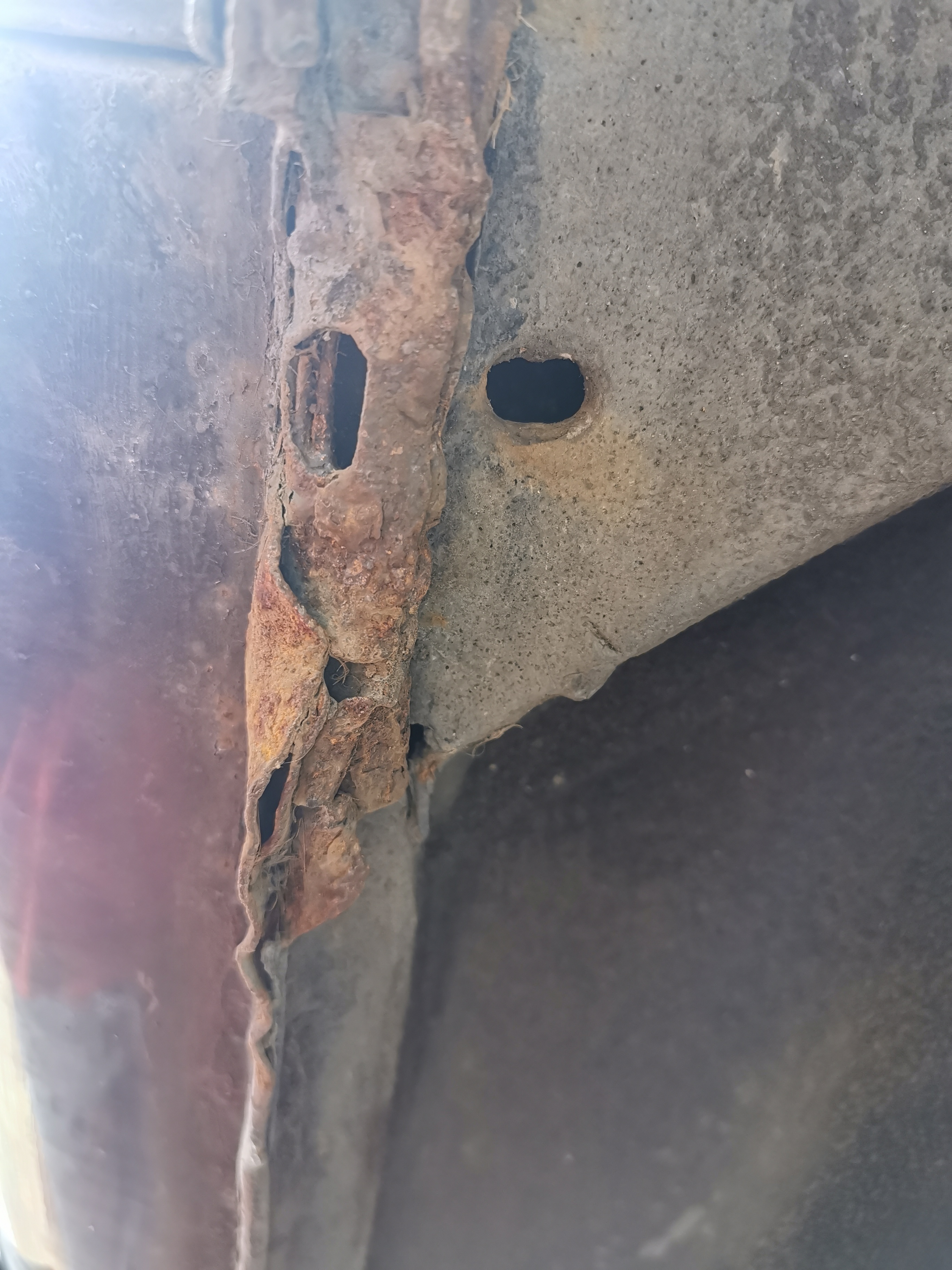

And it's not going back on again😆. Considering that's the only bolt that's snapped on me I'll take it! Rust brushed down and treated with hydrate 80, electric and some black paint. I need to remove the front wing to do the top of the bumper bracket but can't because the battery isn't fitted. But I could take off the passenger side. If you've ever taken a wing off you'll know what a piss about it is to get to all the nuts. One which ultimately led to this 😭.

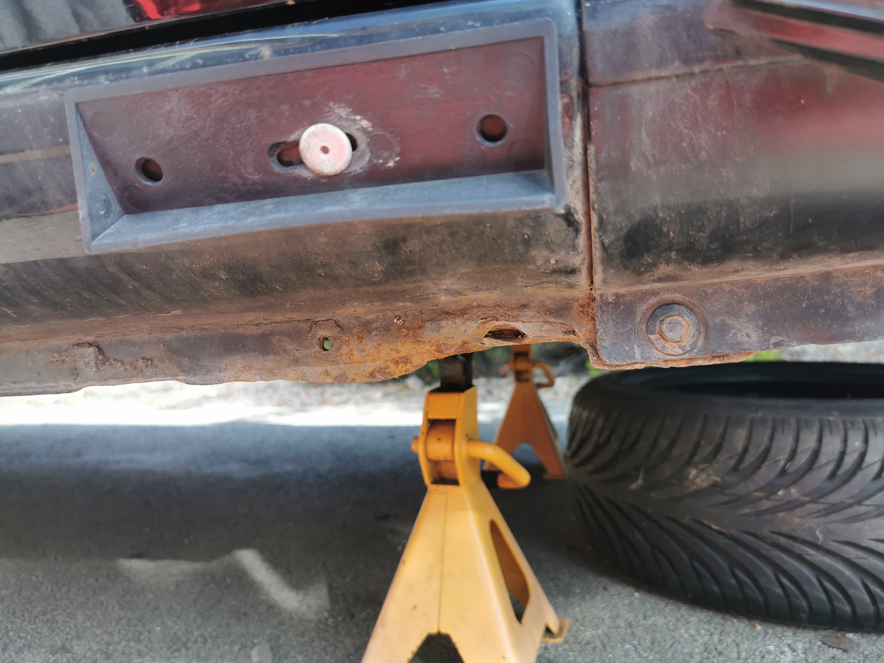

Not exactly sure how that happened while fighting the wiper arm but the windscreen was pitted to fook anyway so a new one will be welcome. While the wings off I can try to tackle the flat jacking points. How any mechanic can do this to someone's car I don't know. They were bent over when I got the car so I should have seen to them earlier to be fair but never had the time to strip the car down to get at them properly.
Still a work in progress so I'll update when they are finished. Hopefully the skirts will sit better too after.

Your jacking points look like mine🤣🤣
Although mine look a bit more battered like someone has taken a lump hammer to them whereas yours look just a bit bent🤣

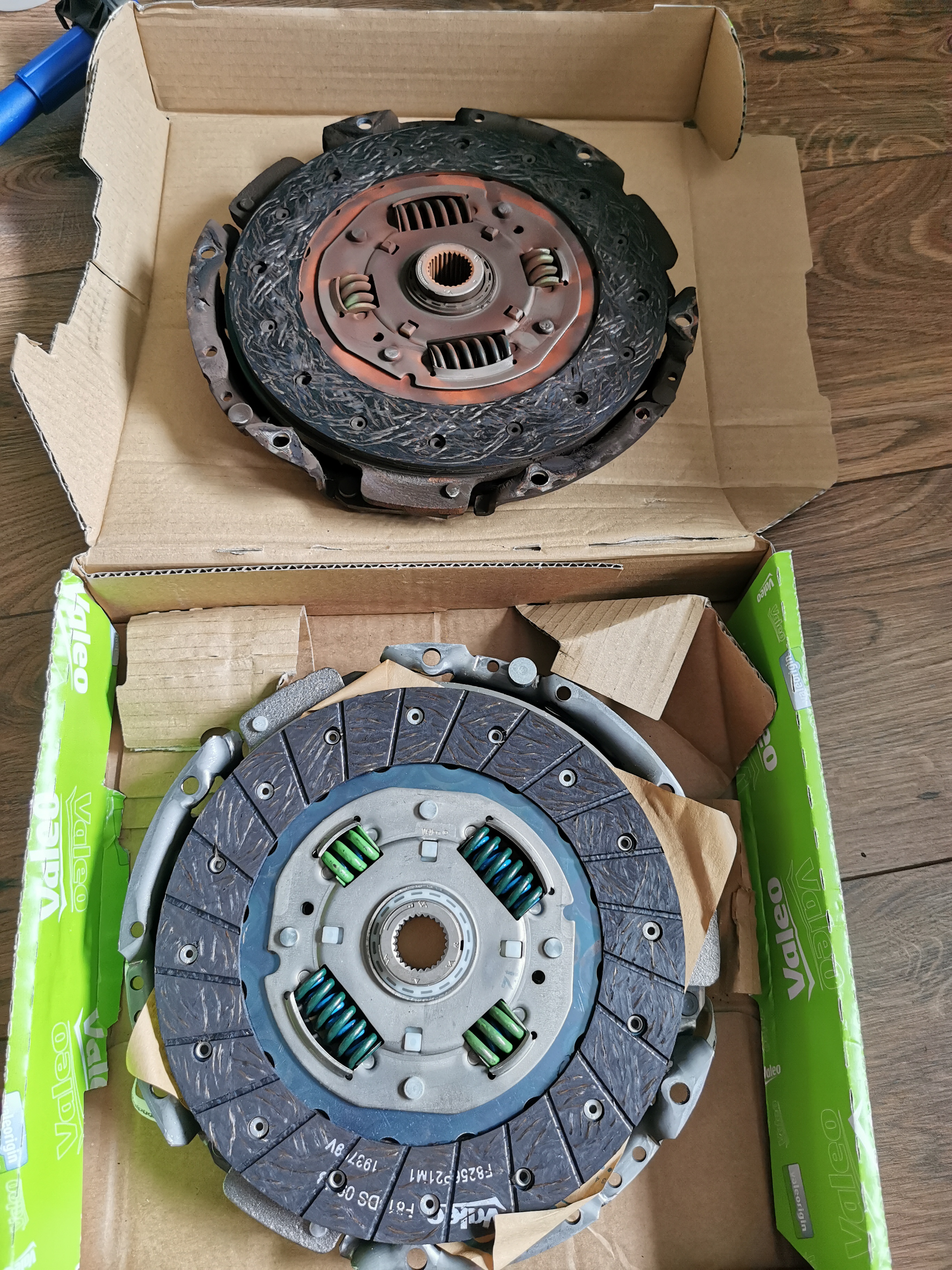

New arb bushes and clutch have arrived and the hubs are back together with new bearings being fitted at the garage. Paid for the hubs with beer and the clutch was a on amazon at £25. Ever the sceptic I ordered 2. It didn't take long before the seller emailed me but to my surprise they said only one was available at that price and they would refund me for the other. Today I got a refund for £30 and the price on amazon is now £125. Someone definitely fucked up there but I'll not complain😂.
I now have all the parts to put the car back together, it's just the know how that's missing🤔😂. I'll do it next week. Maybe.

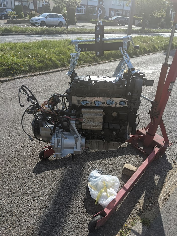

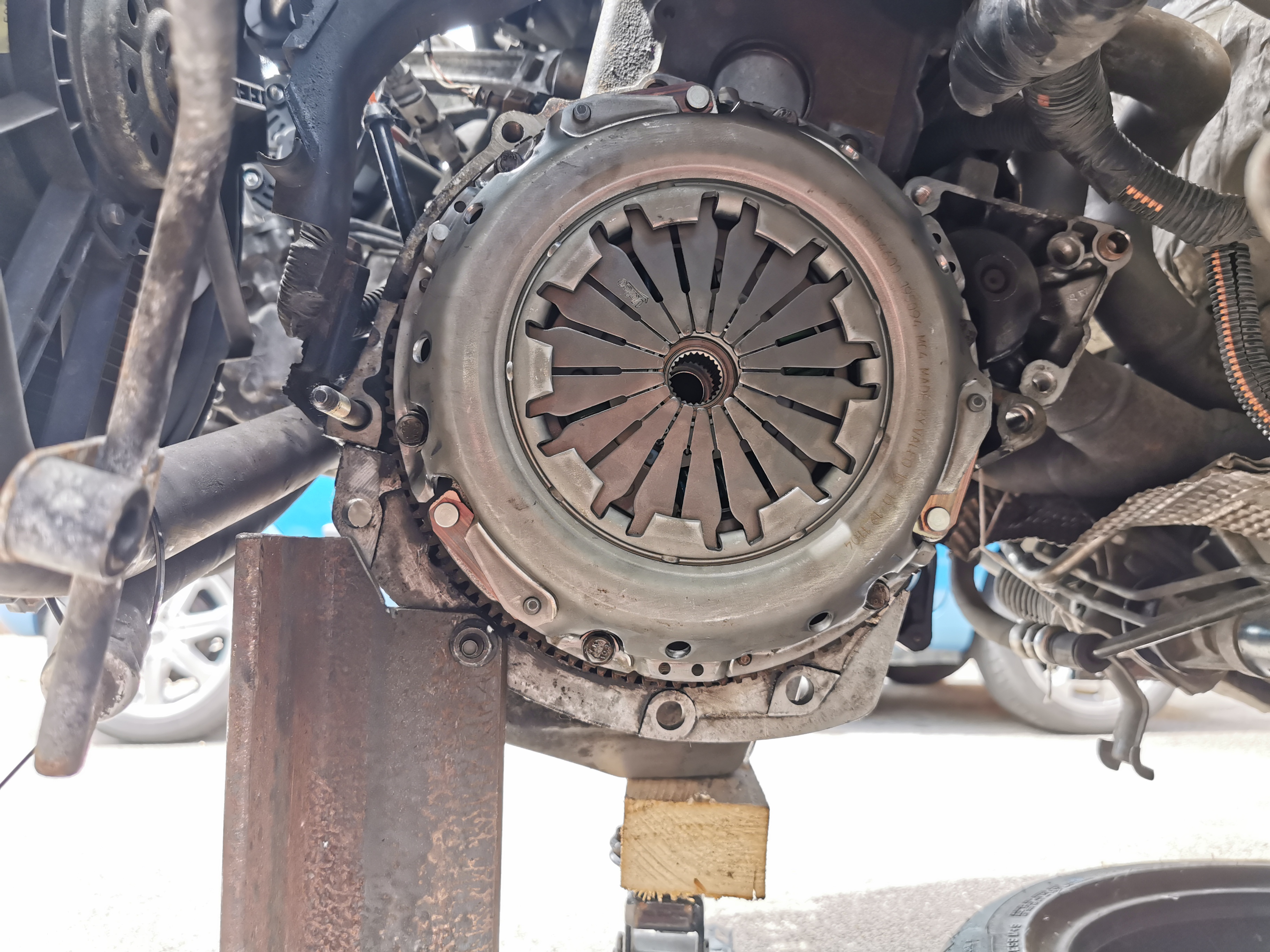

Clutch and gearbox back in and the engine is no longer supported by a piece of angle iron. Taking lots of pics as I removed parts and bagging and labelling all the bolts was the best thing I could have done all those weeks ago. I'm not looking forward to wrestling the subframe and the bloody steering rack back in.

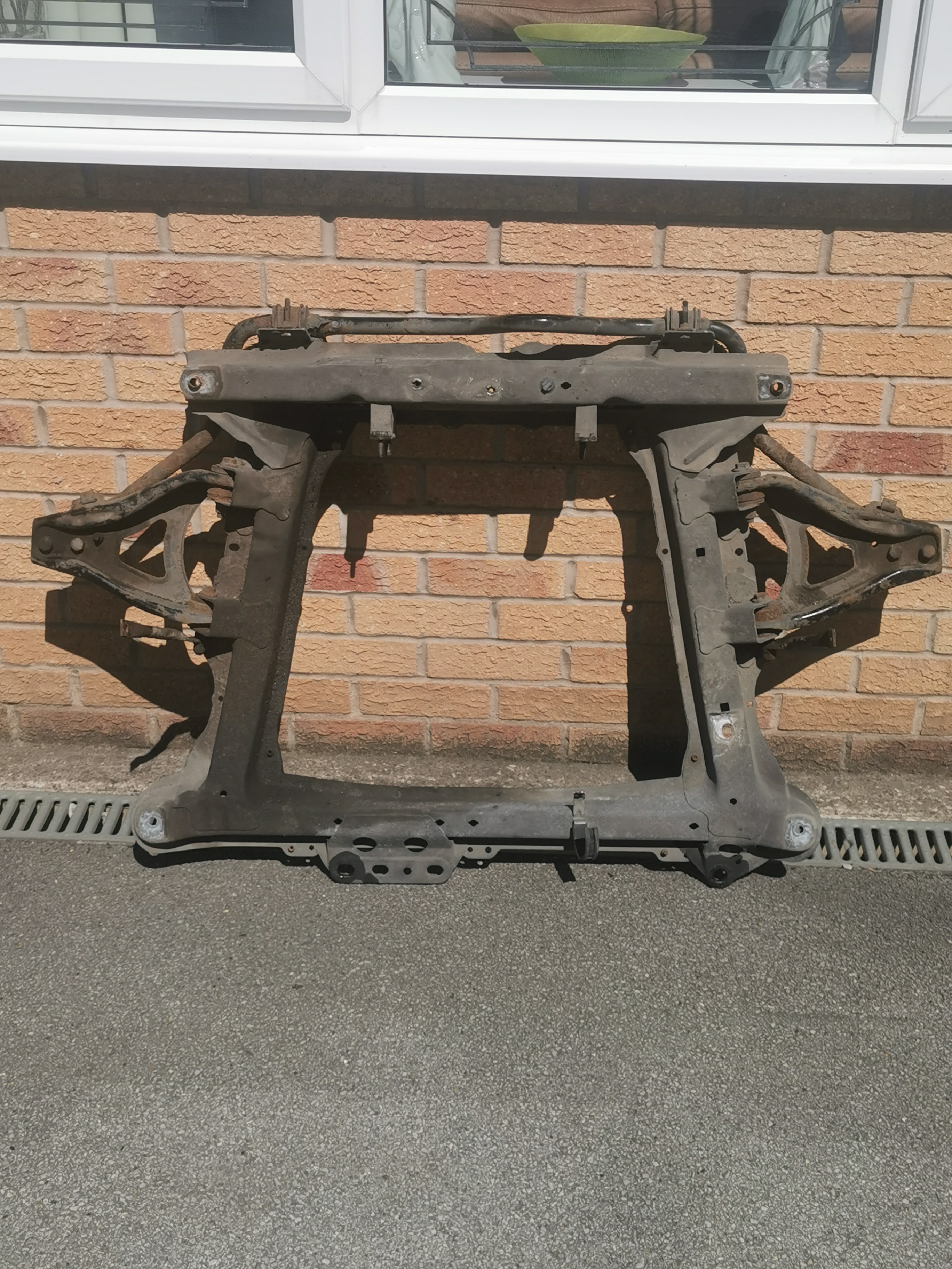

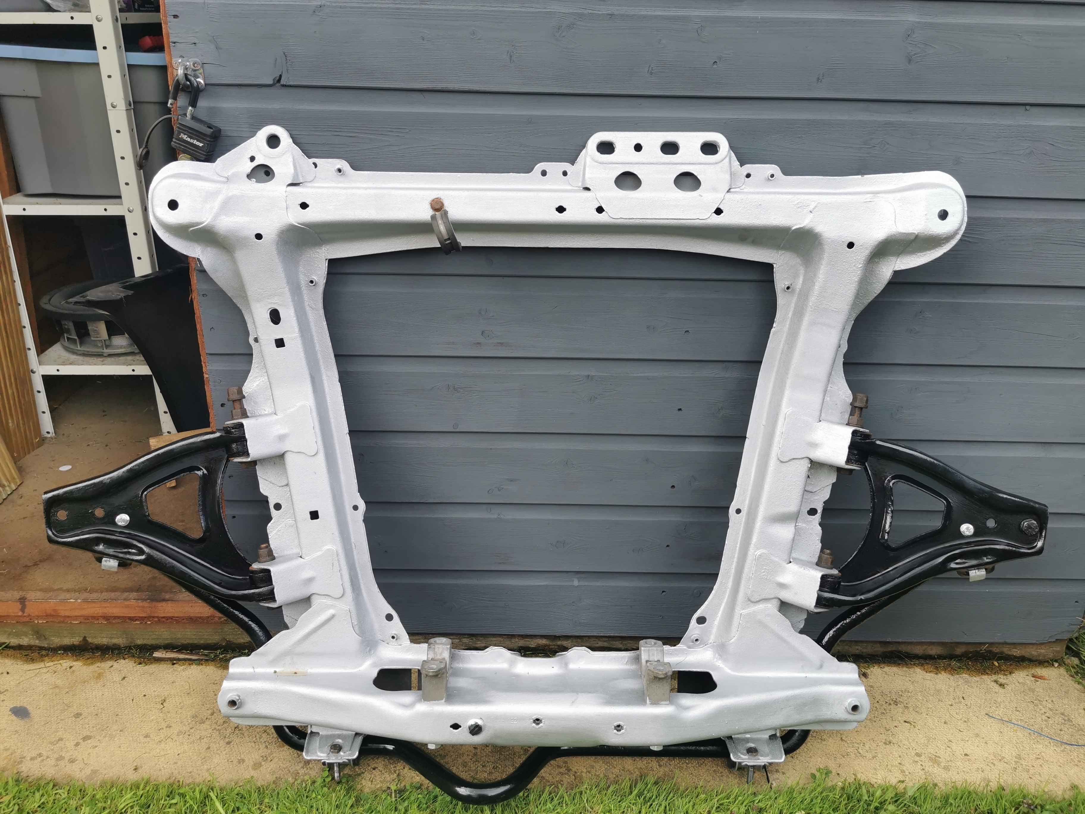

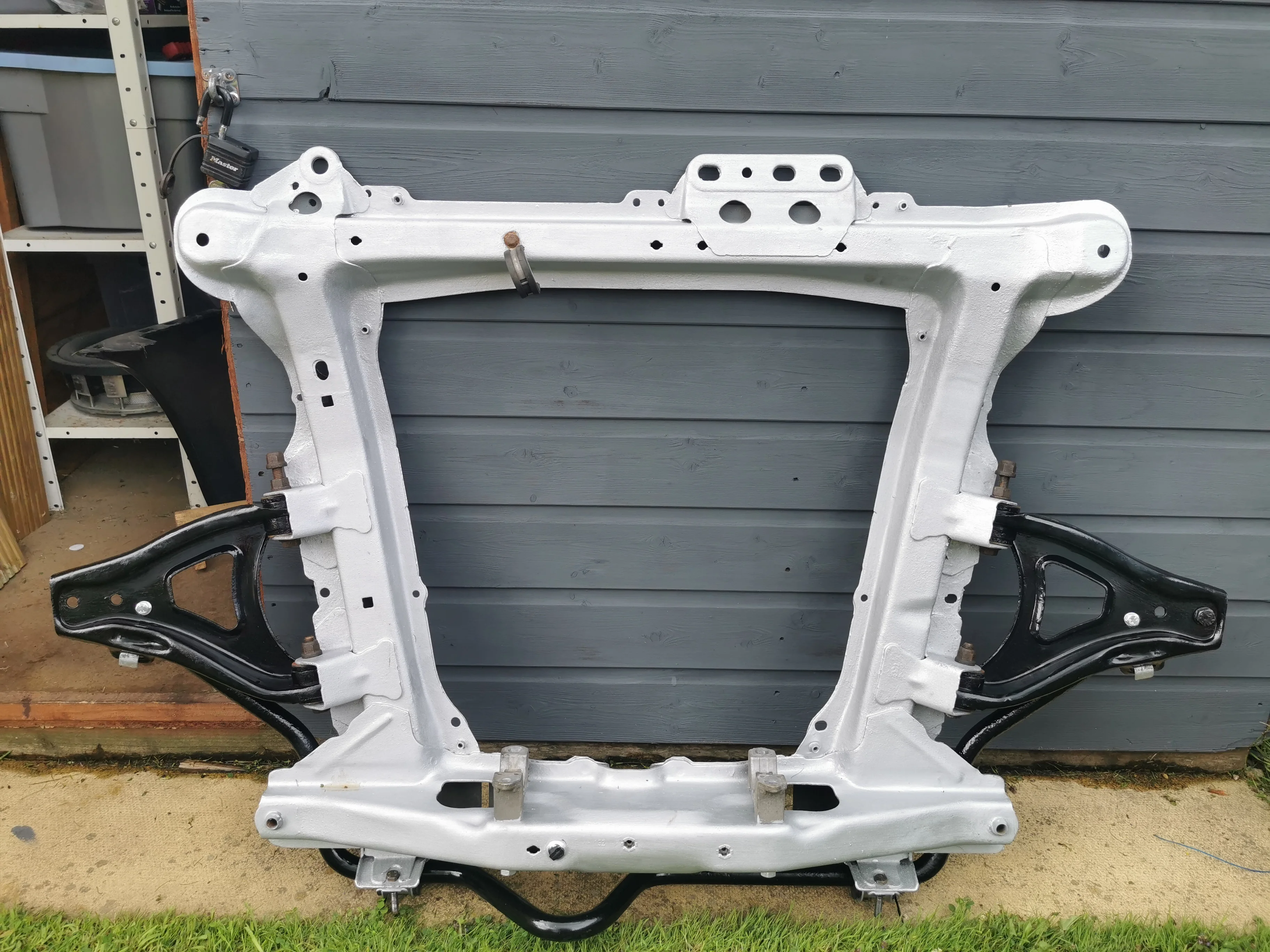

Managed to get some more parts put back on today. And took some off. The subframe was filthy and had some small patches of surface rust on so while the wishbones were soaking in deox I scrubbed the frame and treated the rust spots before coating in zinc primer and a coat of hammerite. I also replaced a couple of Riv-nuts that had given up. Refitted the wishbones and arb including new powerflex arb outer bushes as I had to cut the old ones off.
Before:
After:
Had to wait until the afternoon to fit it with the help of my teenage son. I actually got him up early and told him I needed his help and the bugger pissed off to the gym for 2 hours. Manning a jack each we managed to eventually get it back in place, squeezing it past the steeing rack on the passenger side being the most tricky part but once it was up against the chassis it all lined up nicely. Bagging and tagging all the bolts when removing them again saved lots of time and I've not got any left I don't know where they should go. It always seems that I took off more parts than I've put back but I can't see any brackets or wires that are loose so hopefully it's all good. Attaching the heat shield to the subframe is a job that belongs firmly on the never to do again list! Hubs and drive shafts to fit next and the ecu needs to go back on when I've fixed the broken bracket.

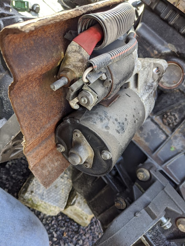

After testing power and earth's to the starter and running a wire from the solenoid to the battery all I got was a lazy few truns form the starter. Tried it with the battery from the 1.2 and still dead. So I ordered a new starter. After reading every post on the forum about replacing the starter I've come to the conclusion that it's all bolloks. That f**king thing won't come out. f**k me there isn't even room to get the heat shield off it. So after 3 hours or so pissing about I've got a disconnected starter, 9 out of 10 bloody fingers, and a full swear jar.
